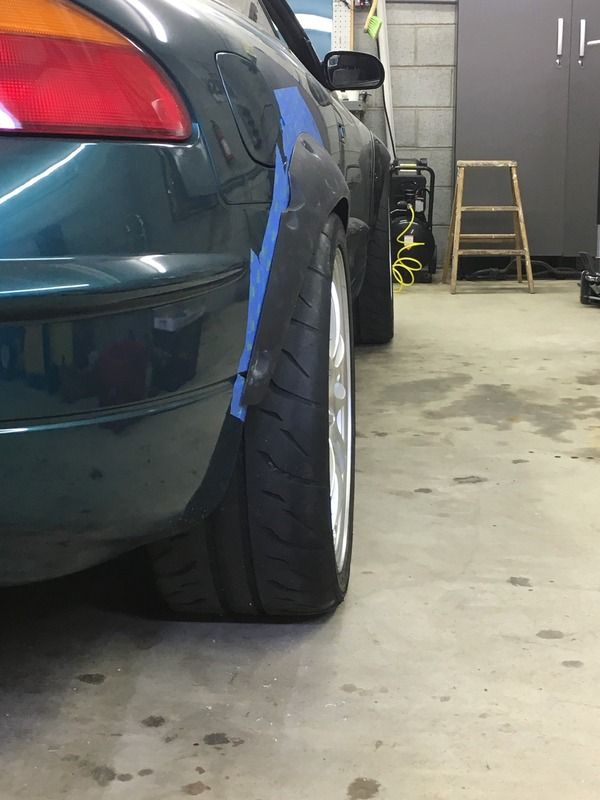

I'm curious about the fitment of your rear flare right here. I can see the cutout for the fuel filler door, but you installed the flare significantly lower than where it was designed to be installed. Did you do this so you could keep a more "correct" ride height and not mess with suspension geometry but still get the aesthetics of reduced wheel gap? I'm installing mine soon and saw this post. Thanks in advance for any info you can provide!
More or less, yes. Also, the wheel offset needed to run 285 wide tires pushes the rim out passed the wheel well. I need the height to A - keep proper suspension geometry and B - keep the tires off the body.
Great. So looking over your thread, you cut the fronts fenders, but other than drilling holes, you didn't modify the rear quarter panels at all? You have no rubbing issues under full suspension compression? Assuming because of the higher ride height. So why did you cut in the front? Was it so you could run a slightly lower ride height or were you running into other issues at stock height?
Sorry for all the questions, just preparing myself for this fender flare install job the best I can by seeing what others have done. Thanks!
The rear has more roll resistance. I only rub if I autocross at a bumpy venue and while in mid-turn. It also rubs on big dips at highway speeds. There are only 2 or 3 places that I can remember off the top of my head where I have to be careful while driving around. Otherwise, its a non issue. Keep in mind!... I run really high spring rates.
The front rolls quite a bit more so cutting the fenders is necessary unless you run stock ride height. I'm about an 1-1.25 inch drop in the front.
