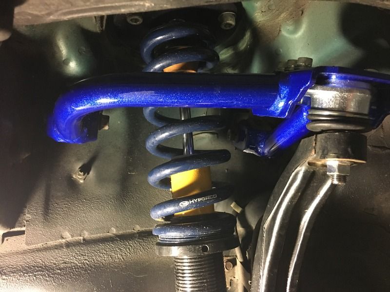

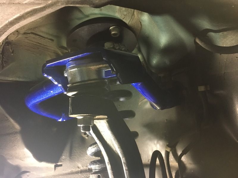

As you guys know, I lost a bit of negative camber when I raised my ride height to fit the new wheels/tires. Well, being that this is really the only option we have available right now, I picked up a set of the megan racing UCA's.
This brought my front camber back to where I wanted it to be. Negative 3 degrees plus.

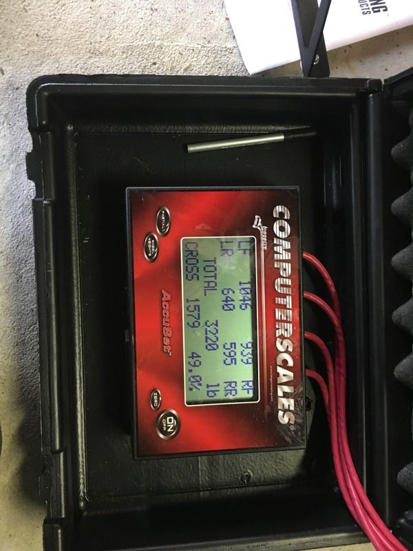

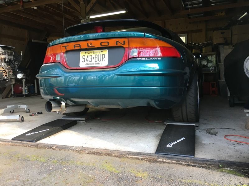

And last, I drove up to Sam's place as he borrowed a set of corner weight scales and we corner balanced our cars.
Still porky. 3220lbs race weight. 3047lbs without me in it. Getting the corner weights in check nearly forced me to rid most of the front rake I had set up in the car. I had done this to help get the rear to rotate better. I was a bit skeptical to how the car was going to drive now, but to my surprise, ridding the rake and adding 550lb rear springs made the car easier to drive. The shocks are on their last leg and rebound is set to full stiff, but its driving better than before.

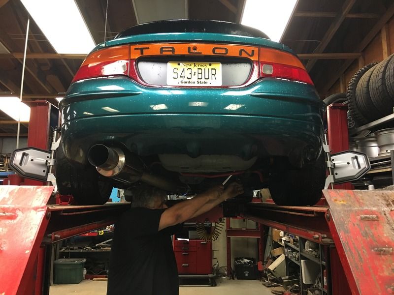

Fast forward to last weekend, 5/27/2017, and NEPA had there next event. This time at Pocono raceway. I made sure to get an alignment for this one. LOL
-3.4 degrees camber up front. -2 in the rear. Just a smidgen of toe-in in the back to pre-load the bushings, and .07 toe-out on each side up front.

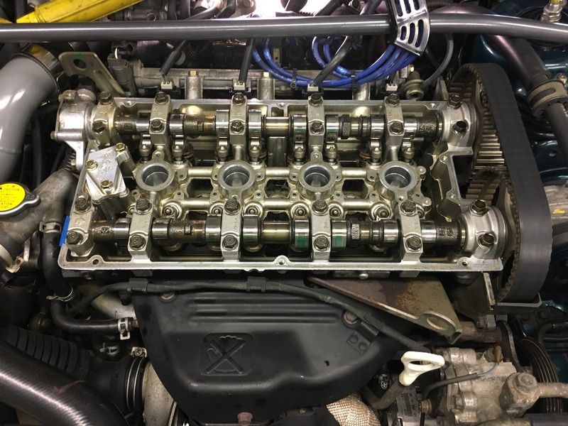

Shortly after my last events (double header on June 4th), my motor started to develop a rather destructing sound. It almost sounded like there were some loose marbles under the valve cover. The sound was very faint at first, but slowly got worse to the point that I was afraid to turn the motor over. I had a few buddies come by and listen to it idle and help diagnose. One said bearings, the other said timing components, and I was assuming it was something in the head. Now here is the weird part.... My mind was going a million mph and I pretty much wrote this motor off at this point. So, what do I do....? Grab the throttle and rev the crap out of it. Over and over for about 5-6 seconds, even hitting the 2-step which is set to 6000rpm. What happens after that? The sound disappears. The motor is running smooth, as if nothing ever happened. WTF!?!?
Pulled the valve cover and visually, everything looked fine. Cams were in there place and the rocker arms will still tight. Hmm.. What the hell could that have been? Threw the valve cover back on and did a compression test. Just about ~180psi across all four. Great, so the valves are still fine. Bottom end sounds fine. The timing belt and components were inspected and it turned out to be ok. Again, what the hell could that god awful sound have been? The only thing I can assume is one of the lifters were stuck closed and bouncing around under the rocker arm. As I free revved the motor, the increased oil pressure forced it unstuck. But, here is the kicker. I have a Kiggly HLA. Oil pressure to the HLA's is regulated to 15psi. I couldn't think of anything else so I replaced the lifters anyway. Picked up whatever set extremepsi is selling. (I think ITM?) I also poured some seafoam into the lifter galleys just in case something was crudded up in there and limiting the flow of oil to the lifters.
Started the motor and the sound was still present. But, I was expecting some type of sound as I just installed new, unfilled lifters. It takes a bit for them to quiet down after a dry start. A few minutes later, everything seemed golden. Took the car for a spin and it seemed fine. Put about 100 miles on it over that weekend and everything seemed fine. Phew! That was a good bullet to dodge. If I had more serious motor issues, my season would have been more or less done for.
