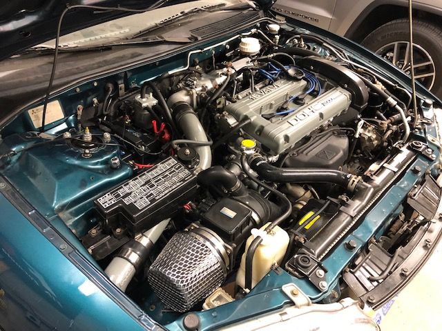

Motor is all buttoned up at this point. Flushed the oil and coolant, did a boost leak test, and wired in the factory BCS with a .025 restrictor to run ECU boost control. Once the car is on the road and running smoothly, I'll start on a Speed Density tune and work on building a true cold air intake.

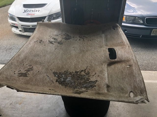

Took the interior apart to remove the headliner for repair. The fabric started to sag about 2 years ago and at this point, had all but fallen. Ordered some black fabric and glue from Amazon and will be tackling this on my own. I also bolted the rear seat belt assemblies back into the car. I took them out for weight savings, but the SCCA SP ruleset does not allow removal so back in they go.

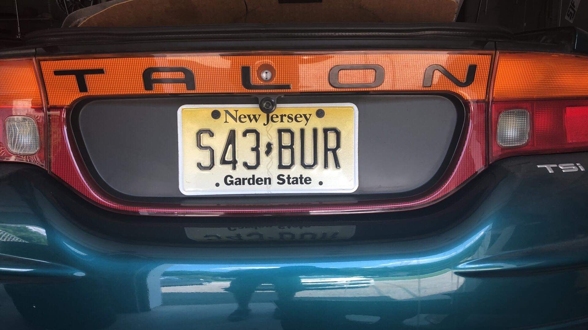

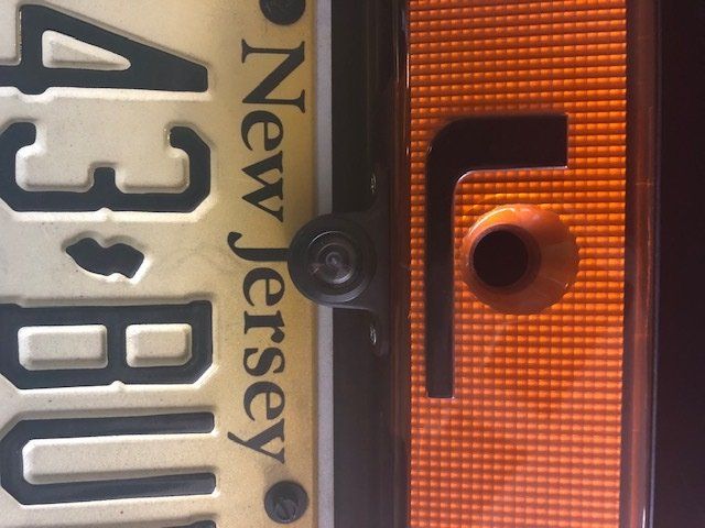

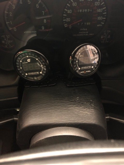

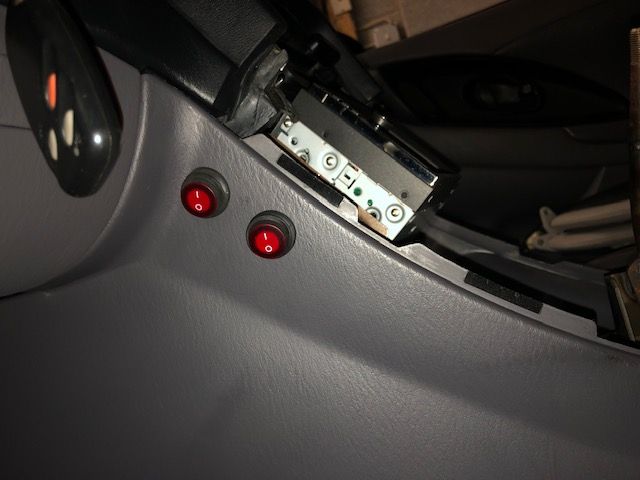

This also gave me the chance to run the new wiring for the back-up camera, wideband, and switches for the intercooler fan and accusump. Yes, I said back-up camera. I'm not sure if you've ever seen an SP style spoiler, but they completely suck for rear vision out of the car. Think nascar style, but 10 inches tall and at 60 degrees from the trunk lid. Its not typical, but I had this camera laying around since 2012 so might as well put it to good use. Install came out pretty good I think. Doesn't look too gaudy like most aftermarket camera mounting solutions.

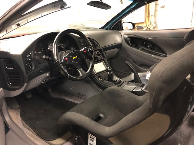

Mounted 2 3-prong light up switches for the accusump and fan. Easy to reach and the red light will let me know, at a glance, if I left anything on or off. Originally, I was going to drill and mount below the radio, right in front of the shifter, but I quickly changed my mind once I realized I'd be drilling into my black center console. The kick panel is easy to replace should I have to. Gauges are mounted in my favorite spot, right on top of the steering column.

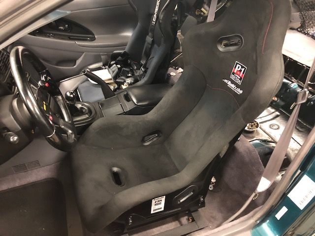

What really started getting me excited is when the seat bolted in. I sat in, grabbed the shifter and steering wheel, and immediately felt a rush. I can't wait to get this thing back on course!
Buddy Club P1 Limited Edition seat. A friend had this style seat in his 240sx a few years ago and I remember how comfortable they were, even on trips greater than 1 hour. Sitting in one a few years later confirmed what I remembered. Glad I got one. Using side brackets, it bolted right up to the Corbeau slider and mount I already had on the car. The Corbeau seat on the passenger side will stay for now until I can grab another P-1.

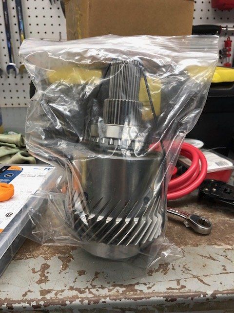

Quaife center LSD for DSM/Evo 3. This particular unit has never been used, and has been deburred, REM, and Cryo treated. I know these things have a bad reputation, but my car is not tailored for drag racing nor does it make a lot of power. I'm willing to take the risk. I'll get this thing on over winter for the 2020 season. (Unless i'm really bored one weekend this year and have time on my hand. :p ROFL)

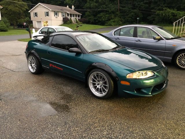

These set of wheels are 18x10.5 with an offset of +30. 10.5 is gooood... +30 offset is baaaad. I think they might fit in the front, but absolutely not in the rear. In talking to Bobby Gould and a few OG autocrossers, I settled at 17mm spacer in the rear and 23mm spacer in the front. This gives me an effective rear offset of 13. I can just about squeeze my pinky in-between the tire and knuckle arm. The 23mm spacer up front gives me an effective offset of 7. This was done for 2 reasons. 1 - I had that size spacer laying around. :p 2 - I wanted the front track width to be wider anyway. Why? Because AWD cars understeer. The wider front track should make this easier to manage.
Tire diameter and width play a large role in deciding which rear offset can fit. I'm currently on 265/35 tires. They are about 25.3 inches in diameter with 9.7 inches of contact patch. (This is about the tallest tire you'd want on a DSM.) When it comes time to squeeze on the 285 or 295 tires, I'll have to revisit the spacing. (I want the 295's to fit, damnit!)
As mentioned above, the current tires are 25.3 inches in diameter. It does rub ever so lightly in the front. This is with about 100 miles of driving on NJ roads. (used tape as its a fresh surface for the tire to rub into)
I can live with that. But, I'll be paying much more attention to this at the next autocross as it that should stress the suspension into more movement than simple road driving can do. Why is this important to me? Well, this test will make a big determination on which size slick I can run with. 295's also have a 25.3 diameter and this is what I want. But, If these tires rub too much, I'll have to settle for the smaller 285's which are 24.9 inches in diameter and much easier to fit on our cars.

Welcome to the rubbing club LOL just make sure its not going to get your shock spring as i mentioned.
That offset wouod not of even fit in front as i only just got them in and thats with the lightly ground down knuckles. (I know you know this but this is mainky for others reading im saying again) just be safe with spacers as they are not the strongest things to use and the loads you will likely put on them might cause a fail so just keeo an eye on them, last thing we want is you to break something over spacers

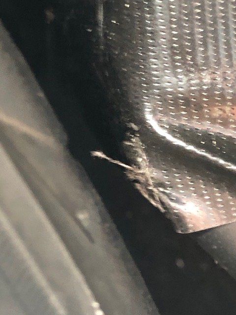

I haven't noticed any tire touching of the shock/spring or knuckle, but I'll double check. Have you noticed your front tires getting damaged from the rub?
What do you mean about the spacers? I have ARP extended studs and spacers, not the bolt-on type. Its very common to see cars in grid with extended studs and aluminum spacers. The important thing is to make sure you either have the proper hub bore rings or use conical type lug nuts which center the wheel when tightening.
i got a few marks yes on the tires, if i had not ground my knuckle down a smidge previously i would have hit being ET25 only a few mm but it is tight now but safe enough i am happy with, infact here is a little write up i did about it (I forgot i did this till just now) https://www.dsmtuners.com/threads/w...tire-yes-it-has-some-clearance-issues.520016/
as for the spacers i ment if you bolt them in and then use the other bolts pushed into the spacer they are an issue strength wise they tent to pull out of the spacer over time when removing the nut and heat etc, yours is a different story, length of spacer your using vs extended studs means your putting all that force on the outer length of the shaft and its the weak link, closer to the hub the better ideally so just be cautious, what you are doing is adding stresses and bending forces within that stud and if it was at hub area those forces wont be seen so in this instance i personally would run bolt on spacers over your setup if it was my car.

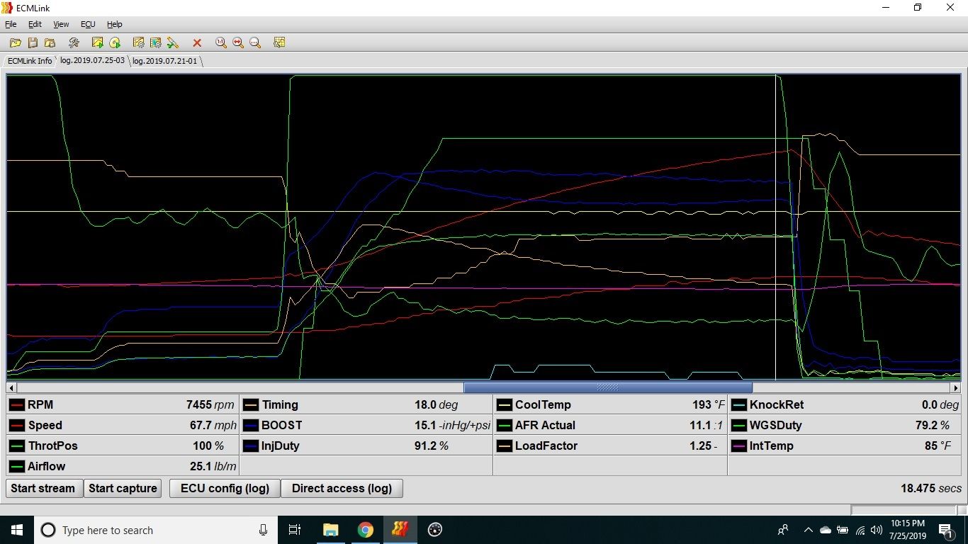

Started tuning and very surprised at how the turbo is responding to the smaller intercooler and the stock BCS.
15.1psi at 7500rpm with the little T25? I verified that my sensor is the OMNI 4 bar and set the correct altitude in the logger. I didn't believe it at first, and still a little skeptical, but otherwise this is great. I didn't think the little booger could do it.
Don't mind the knock... still working on the timing map.

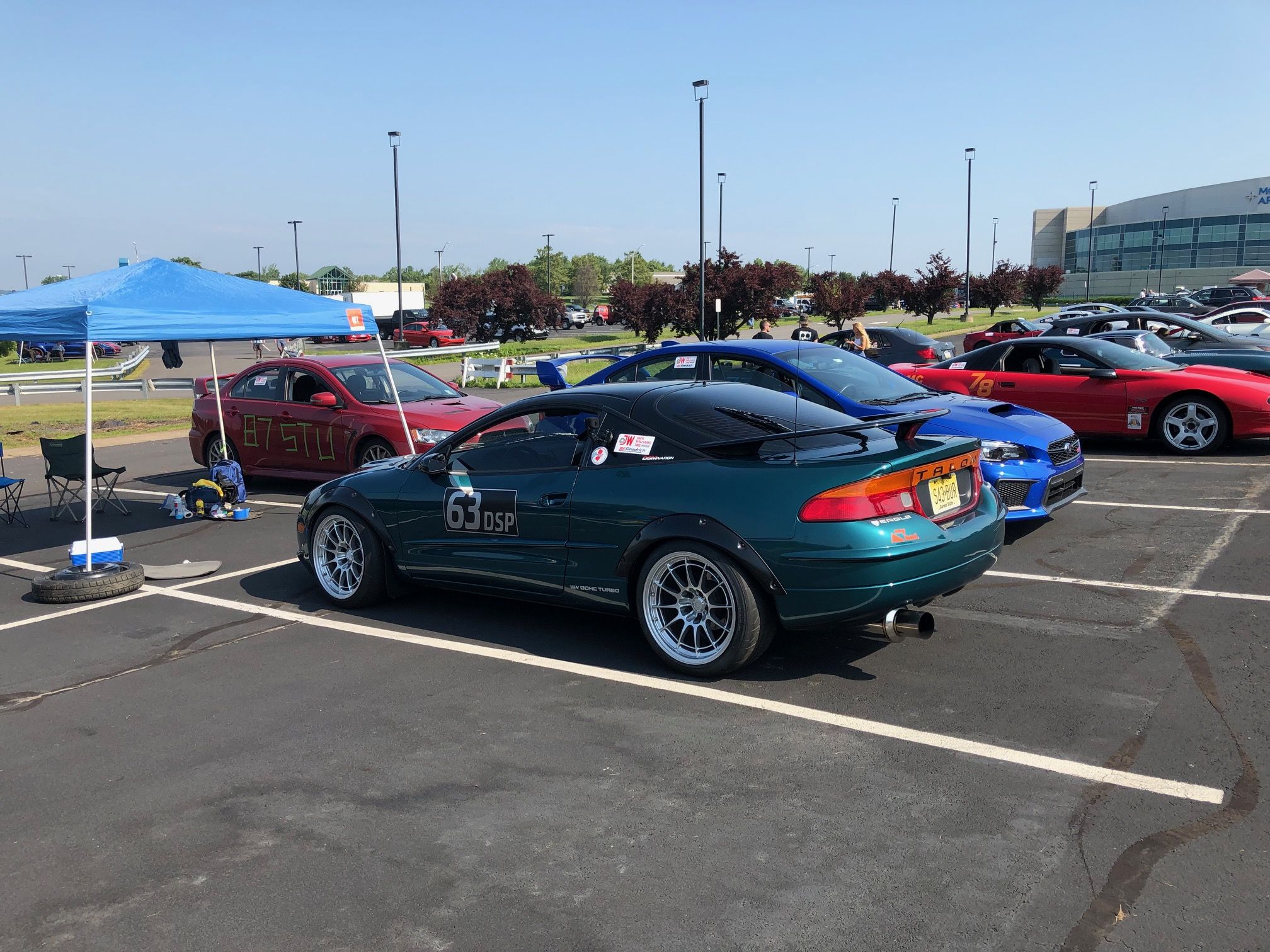

NEPA SCCA solo @ Mohegan Sun Arena - 7/28/2019
Packed the car up the night before, got some fresh fuel, and wiped it down to give it a little shine. I was so excited to autocross the Talon that I could barely fall asleep the night before.
This site is about 100 miles from my home so heading out early (5:30am) is a must. Got there at 7:30am and unloaded the car. Put my new class decals on the doors and proceeded to go to tech. I wasn't running until 4th heat so the car sat all of the morning and most of the early afternoon. Unfortunately, an STR miata driver lost control and totaled his co-driver's car on course which added some time for heat 2. Ended up hitting the course around 3pm. I couldn't sit still all day long! haha
Grabbed my helmet and headed out to grid. 1st run starts and i'm super focused. Car feels a little down on power, but it could just be me as the last few cars I've autocrossed have an insane amount of power. Whats exciting is that the car is handling amazingly. Hard left after the start followed by a 5 cone slalom. Wow, the car is very composed through the slalom. A little juke to the right followed by a left/right offset. Brakes are a little touchy. I don't think I like it. Need pads with a little less bite. Here comes the off camber to on camber banked right hander. Wow, the car has an insane amount of grip. Into a 3 cone slalom.... uh oh, whats that? Check engine light is flashing. Motor doesn't sound too happy. Finish out the rest of run 1 at 50%.
I pulled into grid and a few friends notified me of a lot of smoke coming out the tailpipe. I pull back into paddock to do a quick inspection. Initially, I thought my T25 gave up. Pulled the intake pipe. Little bit of oil in here, but nothing terrible. Grabbed the compressor wheel and the shaft play is fine. Ok... WTF is going on? Opened up the laptop and turned the boost allll the way down and pulled 1 degree of timing out across the board. The car is going to be a turd, but hopefully nothing catastrophic happens.

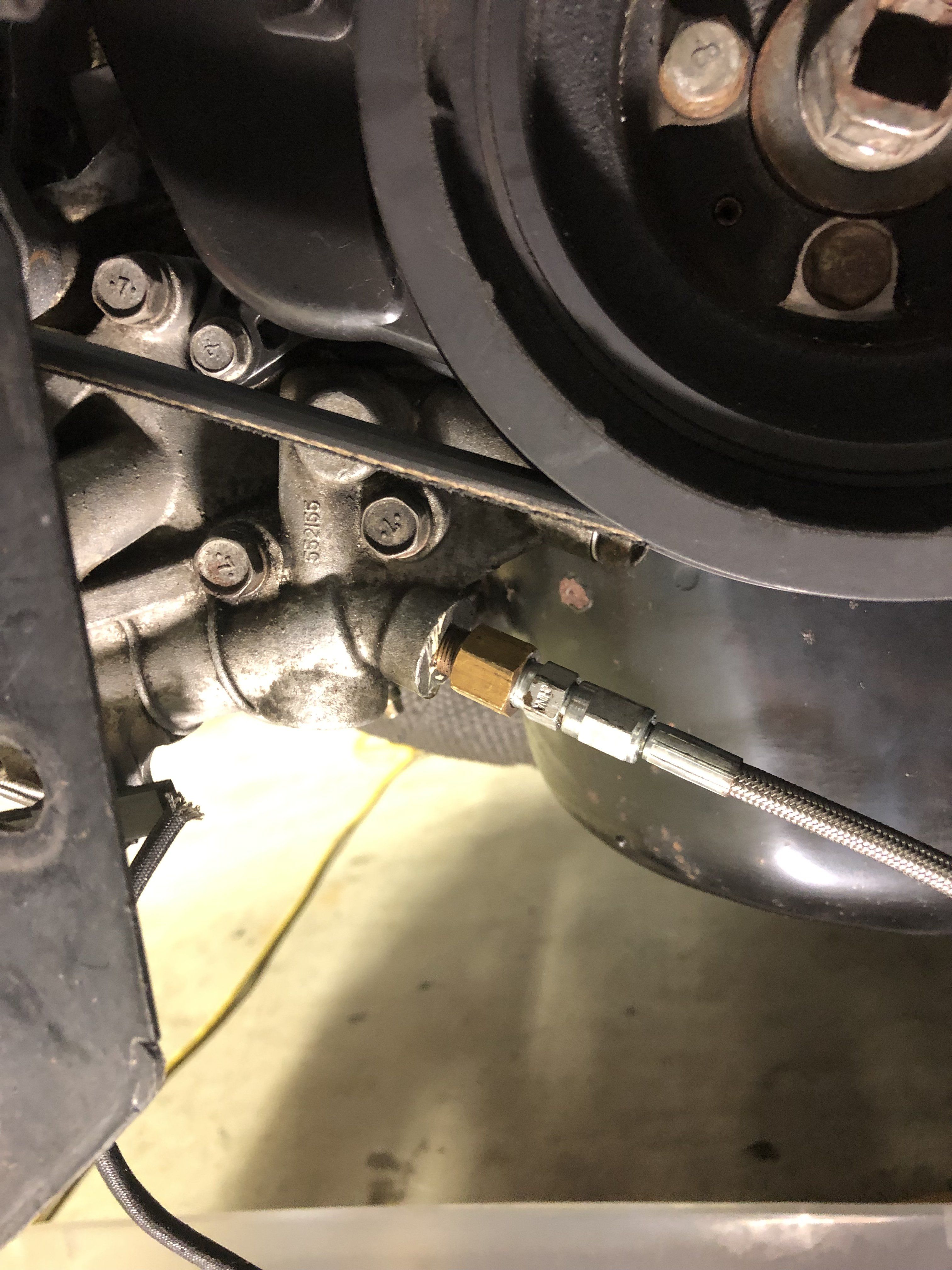

Went to pack the car up and noticed my accusump is at 20psi. (Its in the trunk) That's low and pretty much just air pressure at this point. Did I forget it on while the car was idling to cool off? Hmm... no I didn't. Lets try to refill. Ok, that didn't work. But, I just did 3.5 runs? Motor is seemingly working fine considering the circumstances. Whatever, lets just get out of here. The car sat off for about 20 minutes before I head out. The drive to the gas station was about 2 miles and in those two miles the motor developed some noises and vibrations. I didn't want to risk it and just called a tow truck.
:cry:
The motor does start up, but its not happy. I'm sure the 7.5 quarts of oil that is in the pan is not helping. What is going on? Why did my accusump dump all its reserve in the motor? Is my oil pump dead? The factor oil pressure light is not on so what gives?

I plan on doing some testing with the accusump removed from the motor. An oil pressure test should tell me a bunch and will also send the oil out to get tested by blackstone labs.

That sucks about the car. I wonder if you foamed the oil from having the pan overfilled. It doesn't sound like you have a way to read or log oil pressure.
