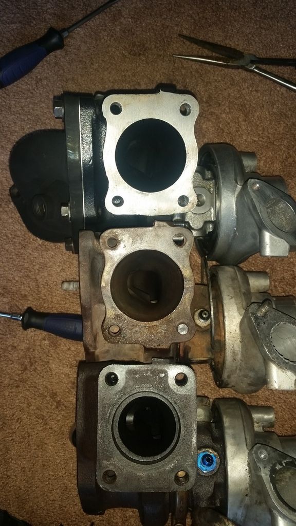

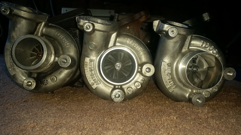

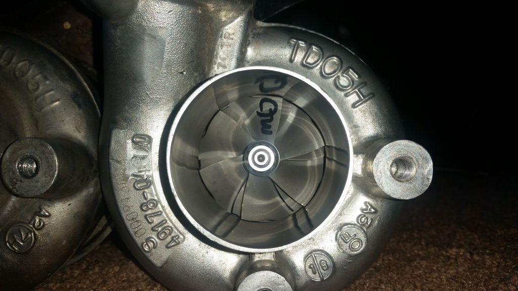

Decided to get all my turbos together to compare them all finally, here’s some pics of everything!

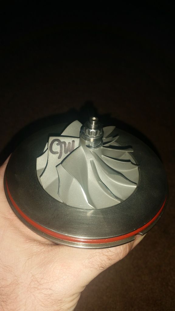

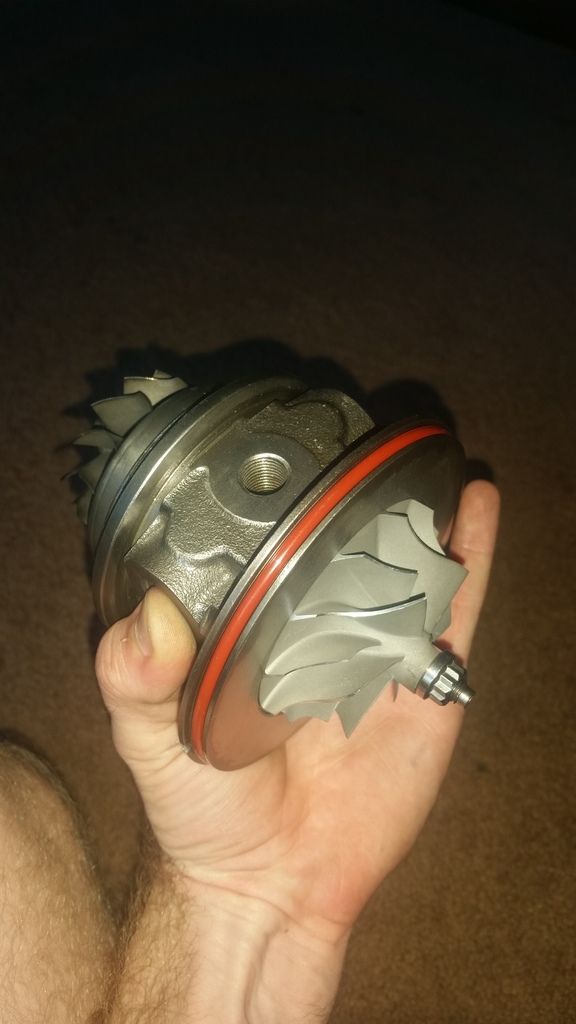

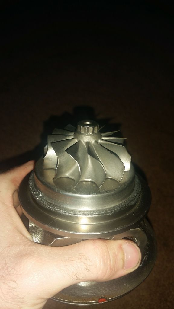

My brand new MHI center section out of my 20g, this thing is gorgeous if I do say so myself, cant say enough about Justin Whitesells Quality of workmanship

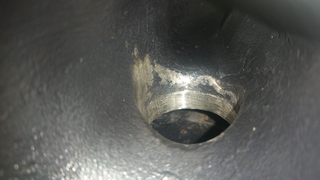

He also ported the waste gate flapper to help with any boost creep which is notorious on these internally gated turbos,
20g turbine housing opening
14b turbine housing opening

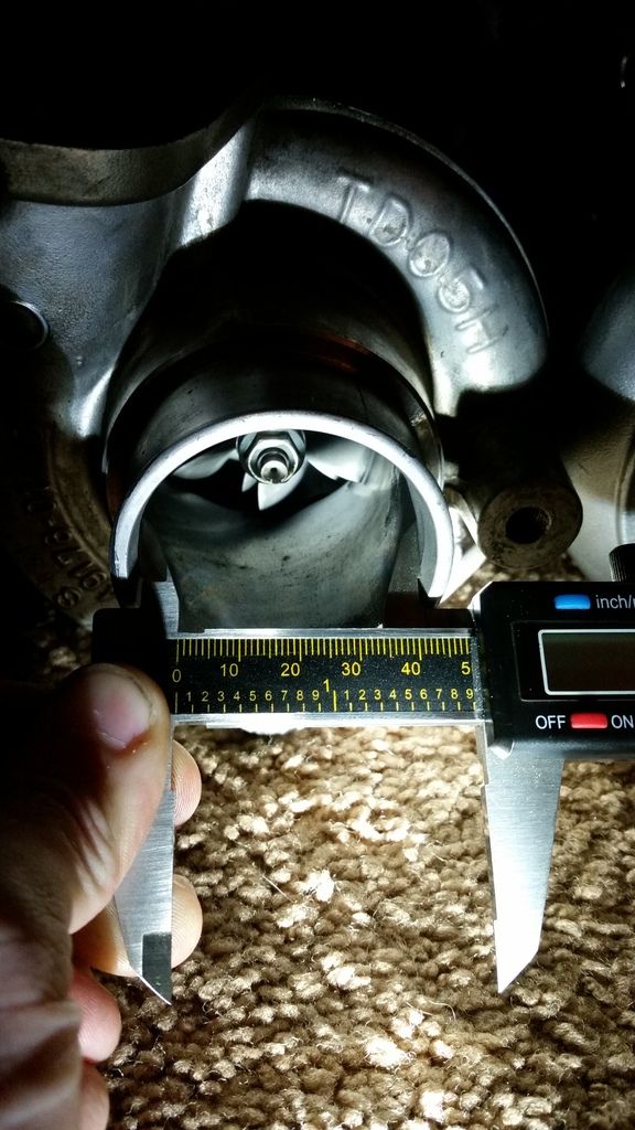

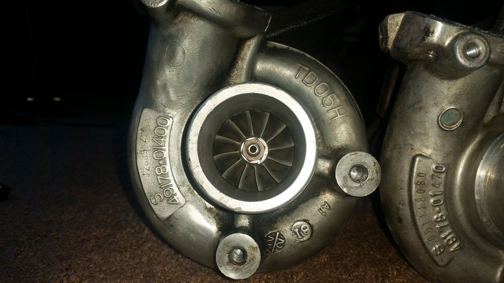

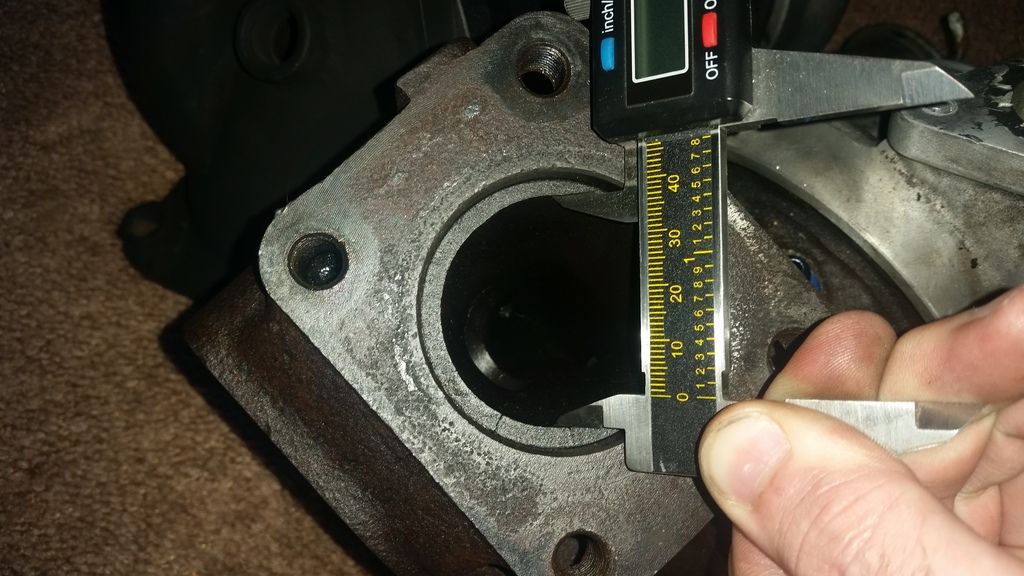

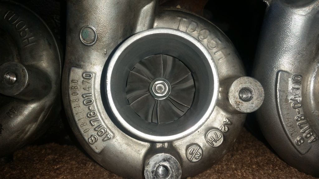

Compressor sides all compared to each other, 14b left, 16g middle, 20g right

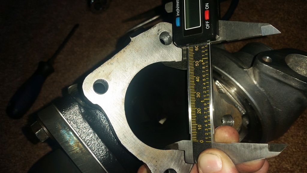

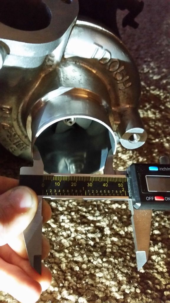

The 16g opening looks about 48.5mm
The 20g opening around 53mm

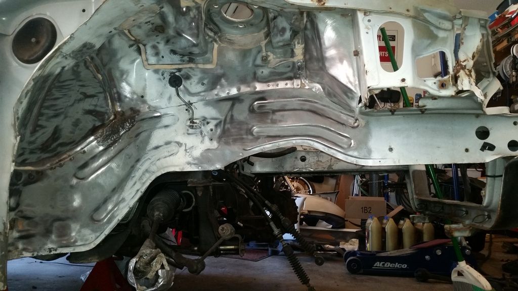

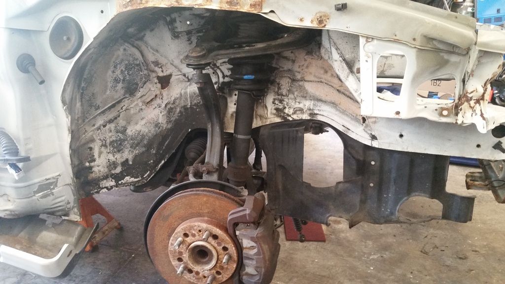

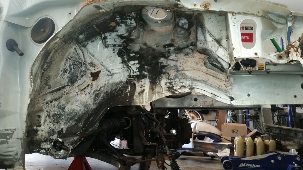

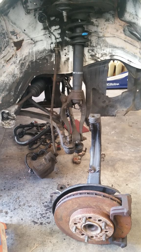

Well after going through @greengoblin 's Build thread, I saw him clean up his wheel wells, and figured since I will be planning on daily driving mine for a while, I don’t want any rust to accumulate or start, so, I got a couple wire brush wheels for my pneumatic drill and went to town, be ready tho, this is VERY time consuming, 20 year baked on sealer from the factory doesn’t like to come off, and it is very messy, dust will definitely get everywhere!
My plan was to get the wheel wells to as bare metal as I could, check to see if I have any rust, and then proceed to spray the wheel wells with some etching primer, and then coat them with bedliner! After watching a Line ex commercial for trucks and how awesome that stuff is, I knew itd be perfect for helping to protect against rock chips, rust, or anything else I could throw at it!
Today’s progress, I was only able to clean up one side, from starting at jacking car up, removing wheels and all the suspension components in the wheel wells, to getting to one side stripped as best I could, took about 5 hours total! All in all im excited about getting the other side done tomorrow, and hopefully getting to lay some primer and bed liner on Saturday, we will see if I can stick to that timeline, and of course will let everyone know how my experience goes!
Heres some pics I snapped during the process
Before digging in
Finally got the lower arms separated from the spindle, had to use my dads 10lb sludge hammer on the lower ball joints to pop them out, used the screw the nut back on a couple threads and go to town banging away, seemed to do the trick nicely!
Got everything cleared out of the way, it was full of dirt and road grime, but heres a
Before
After
Heres one little patch of rust, doesn’t seem to be rusted through, just some surface rust from what I can tell, I hope when I spray the etching primer that will help stop the rust from getting any worse!

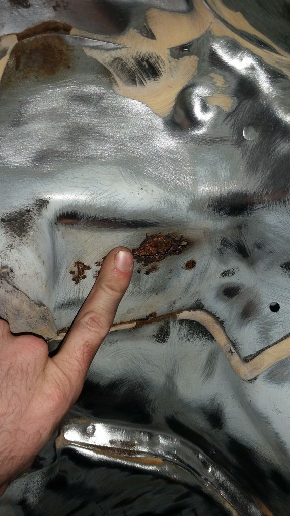

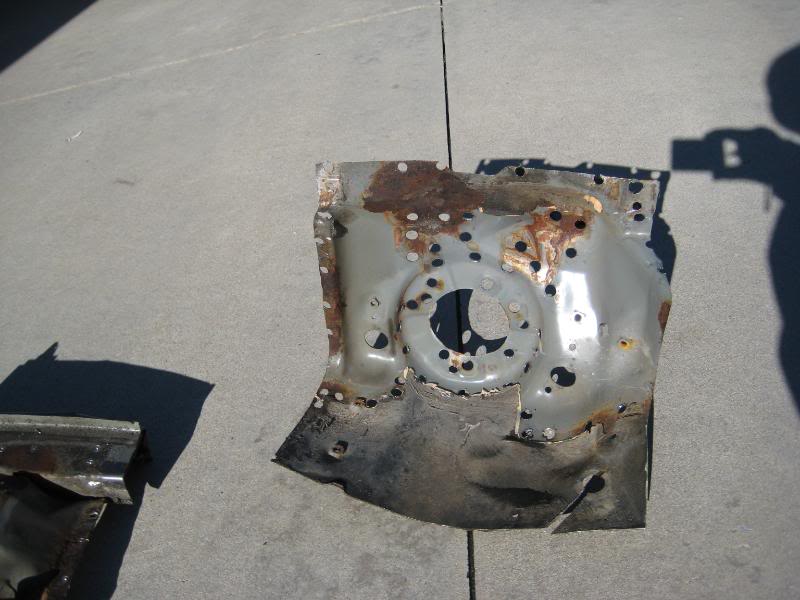

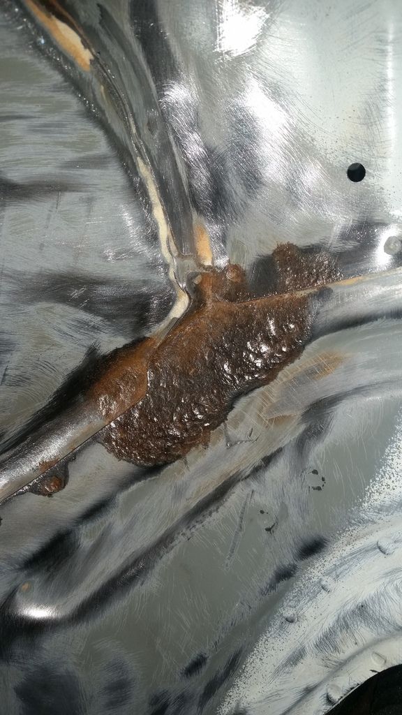

Found some rust that went all the way through the inner layer, I put my finger there for a size comparison, could have been a lot worse when it comes to rust, I’ve seen the horror stories of the entire tower being rusted through so I was happy to see a small amount on mine

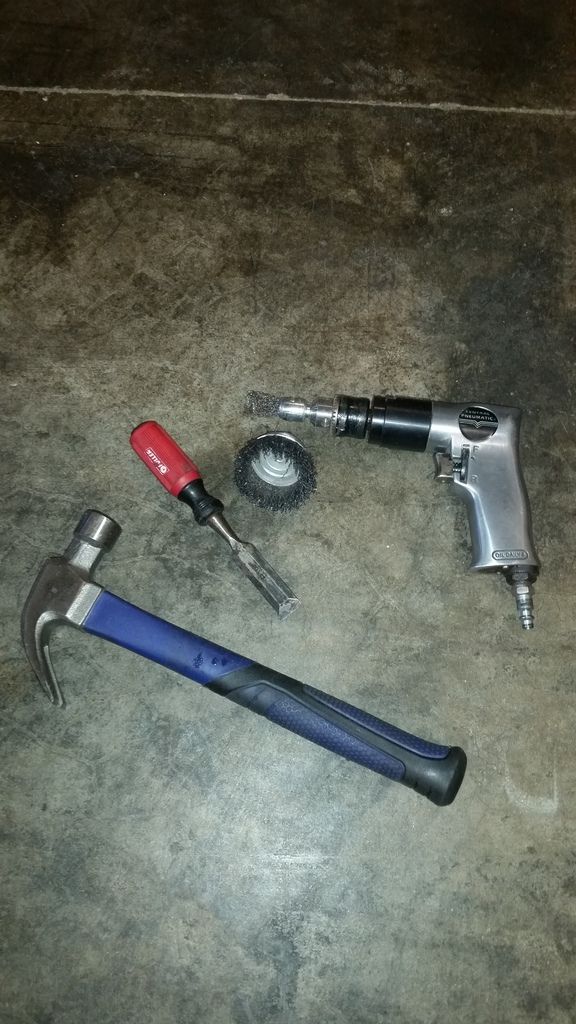

And here are the only tools I used, for the larger patches of sealer ‘stuff’ I found it easier to use a hammer and chisel to knock away at bigger chunks and then came back with the wire wheels to fine clean up!
And this was all I could sweep up, there was a lot that had blown away in the garage, but I wasn’t kidding when I said it was messy!

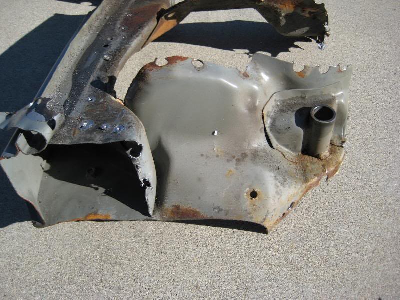

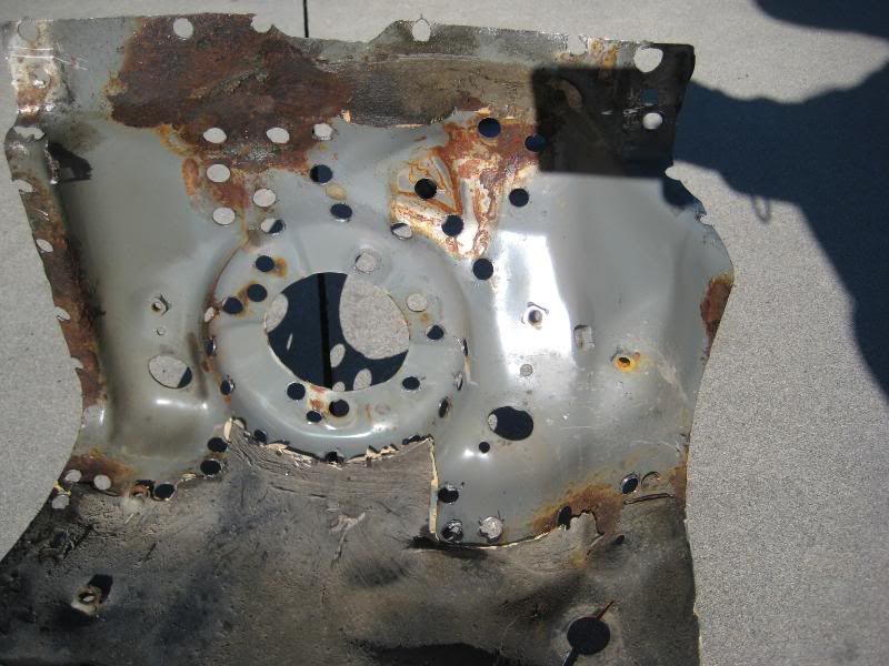

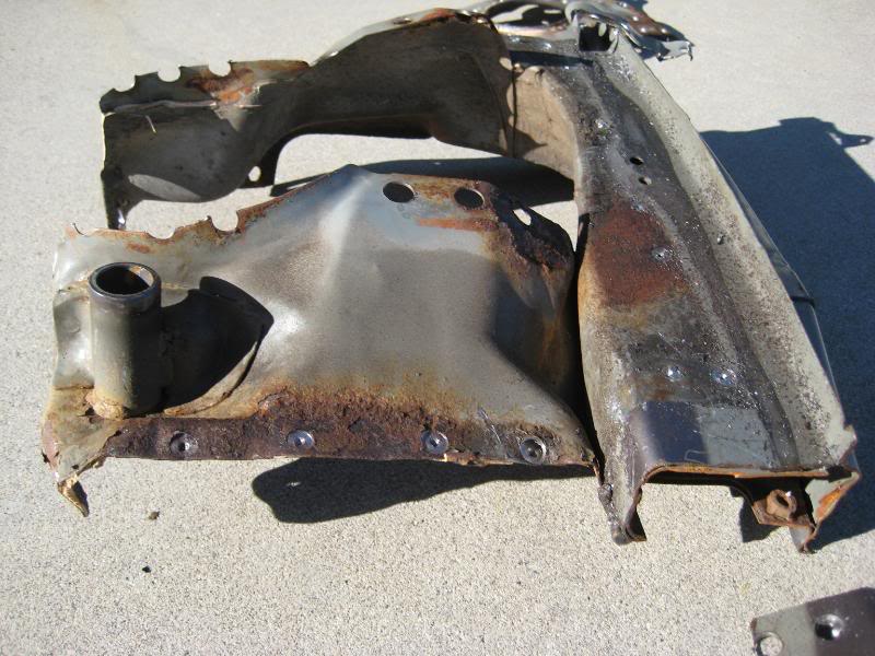

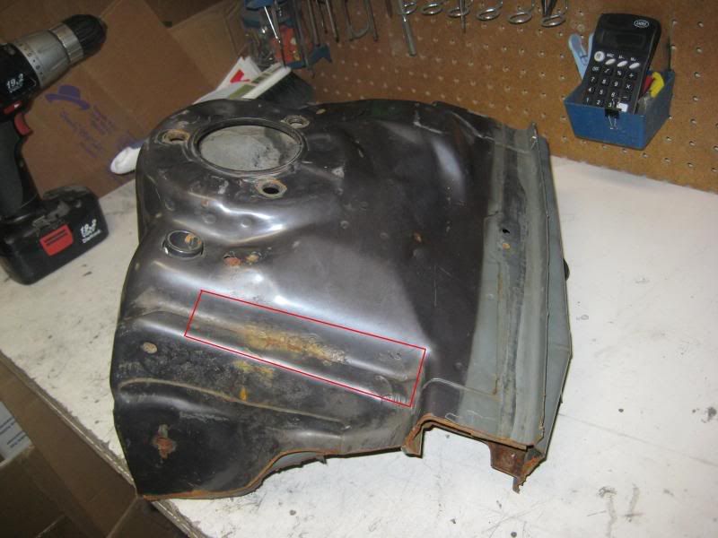

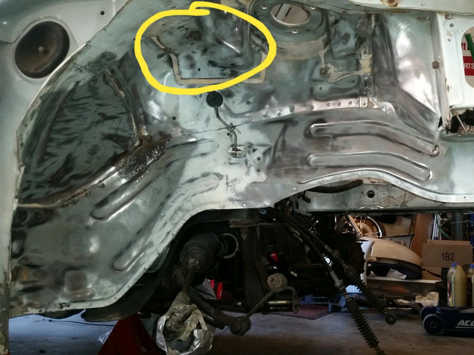

I circled the area, from what I can tell it doesn't go all the way through to the engine bay side, only in the fender well! @greengoblin
So my only concern it is possible that the rust is actually coming from the inside out. That area around your inboard upper control pick up point is a bit of a high stress area. It's made of several layers of sheet metal that are all tack welded and boxed together. It's also right under where a lot of people have strut tower rot. Make sure you take your time and explore the rust thoroughly and look closely up on top of the tower too. Often rust can be present but actually still be hidden under paint. Look for bubbles in the paint and the like. I'm not trying to scare you, only help you get it taken care of before thing go south. It might not be any worse than what you see but looking will not hurt.
