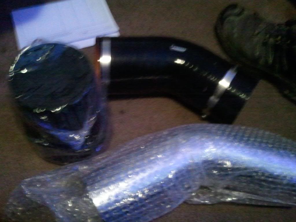

-FIC 1250cc Injectors
-STM turbo intake w/ K&N filter(car had no filter when purchased:banghead:)

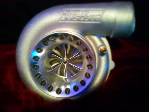

-PT6262 CEA Turbo w/ported shroud and ball bearing upgrade

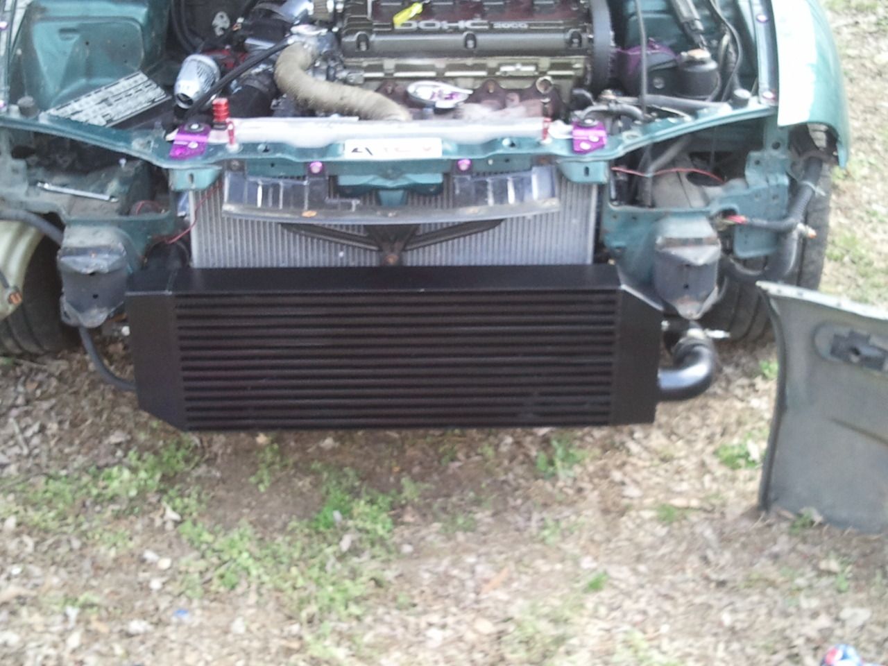

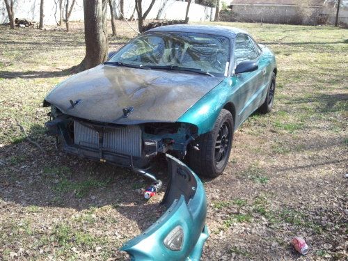

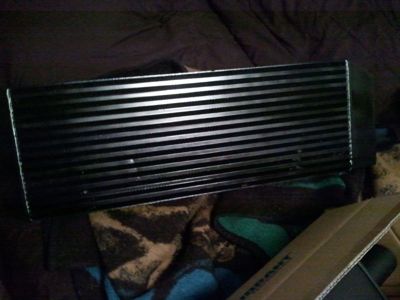

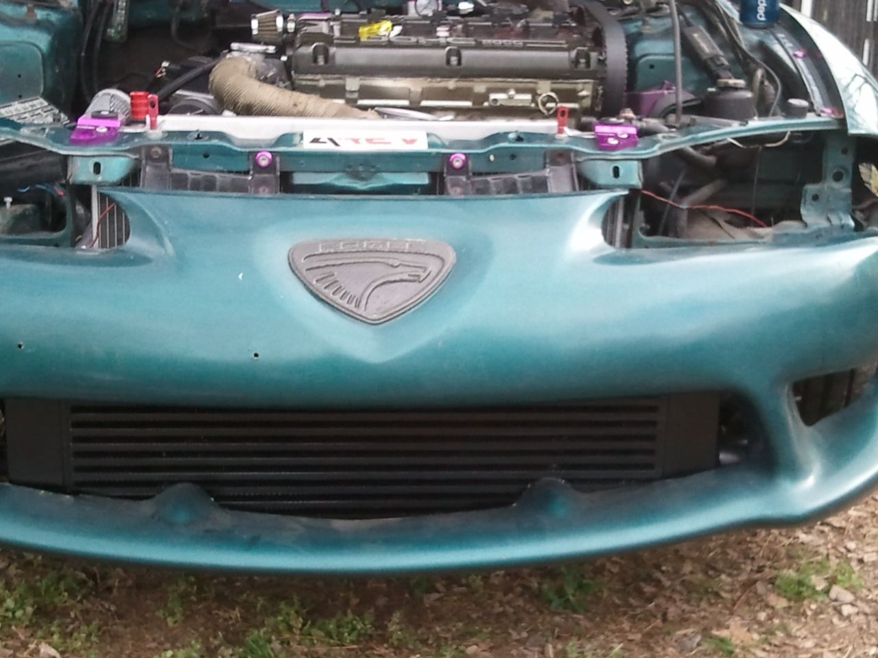

So for starters I wanted to black out the Front mount. Even though the HKS BOV is a dead give away, I wanted to have a stealthier appearance.
Here's the front stripped down. And yes that is a soda can in the lower intercooler piping, didnt want any critters taking up residence.
Here it is all blacked out.
Installed no bumper
With bumper on

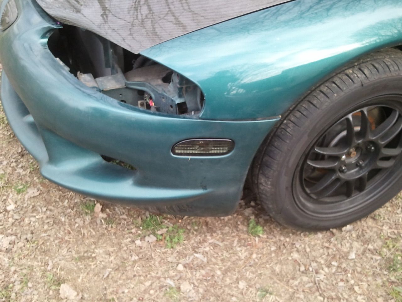

As I stated before, The P.O. Took a rattle can to the old Side markers:ohdamn:. For a few extra bucks I picked up these on Ebay.

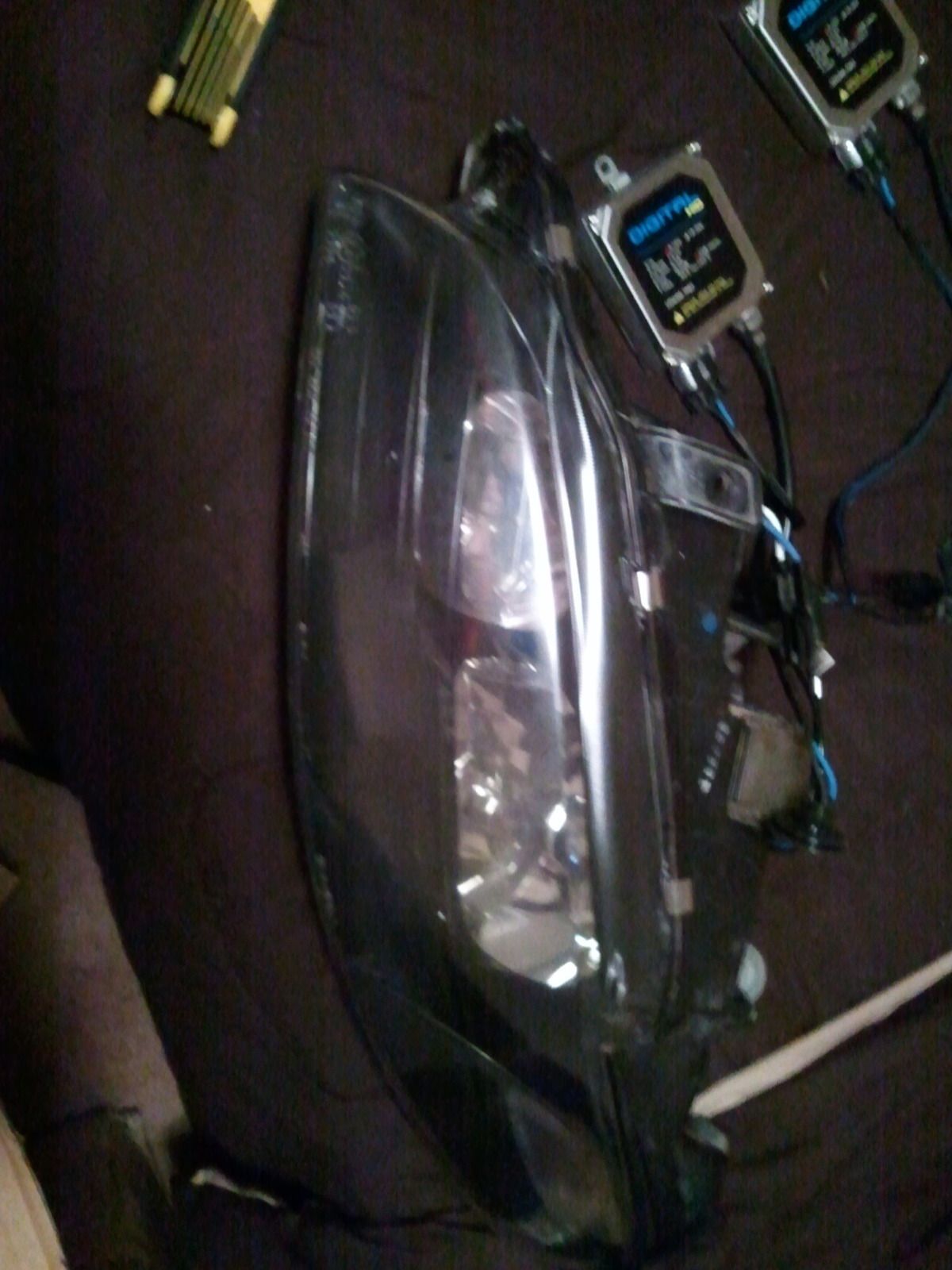

I wanted black housed headlights but everything was or looked cheap so I went with some OEM eclipse GSX headlights I'll have to test fit and see what all I will have to do the bumper to compensate for the different angle on the inside. Here they are with the HID's in but not installed, haven't got there yet.

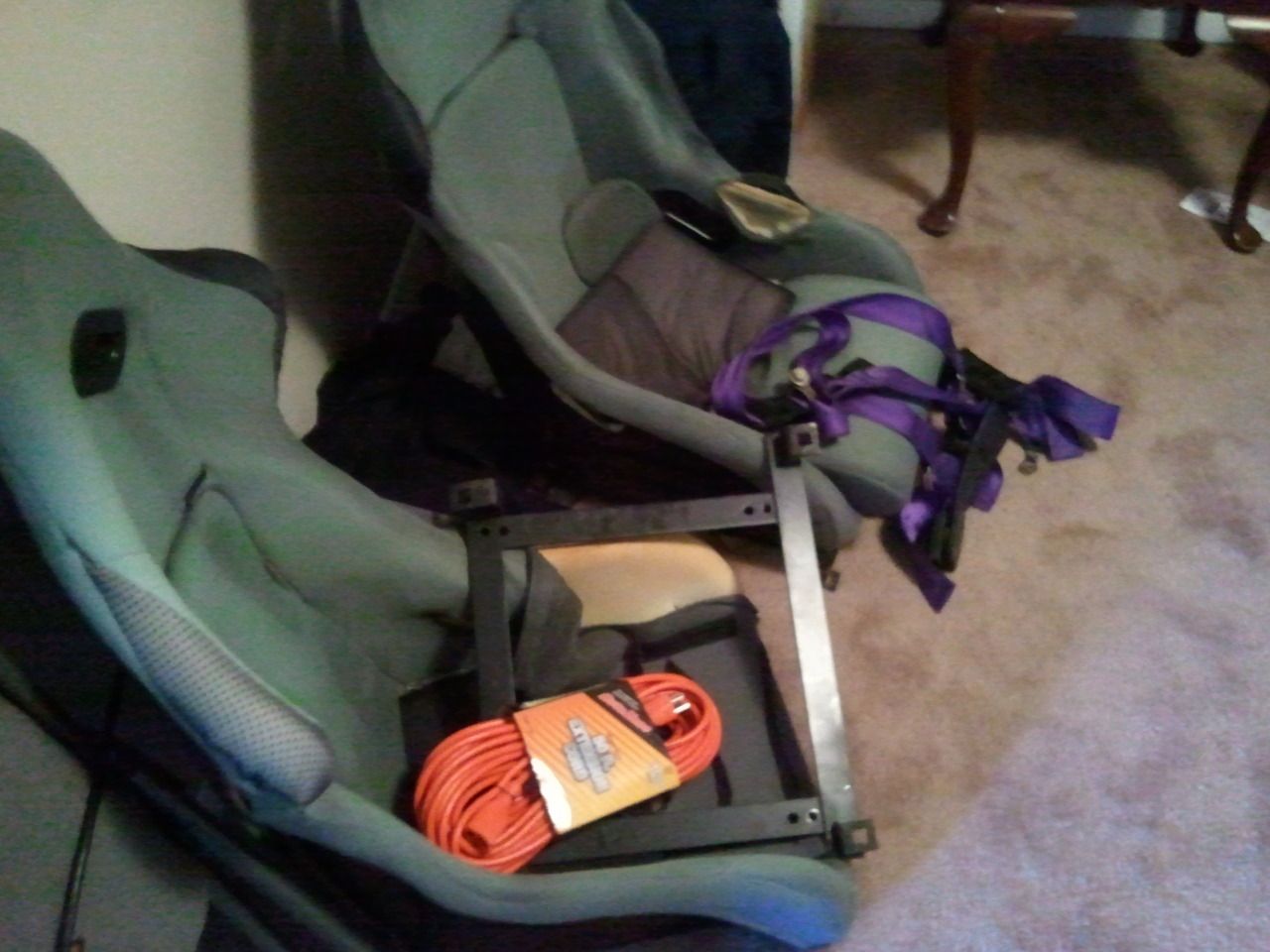

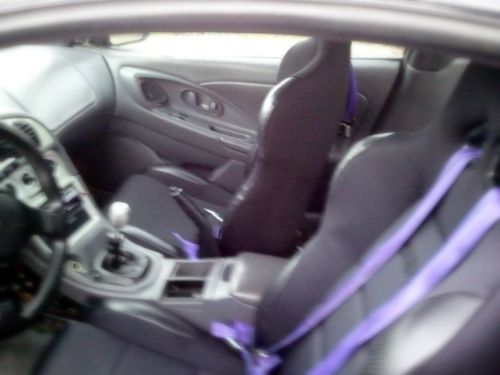

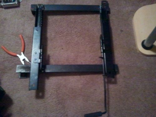

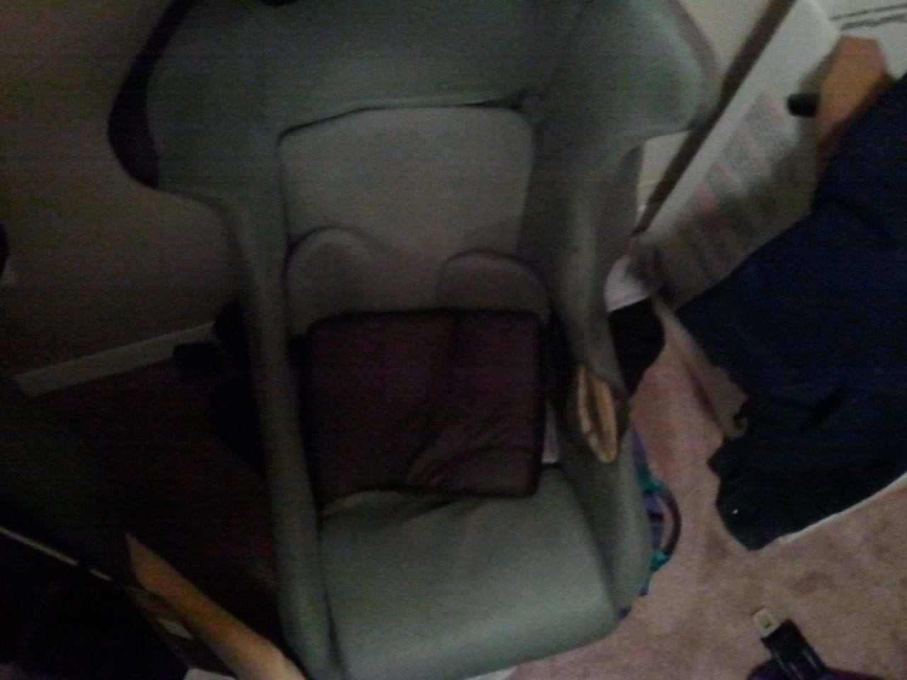

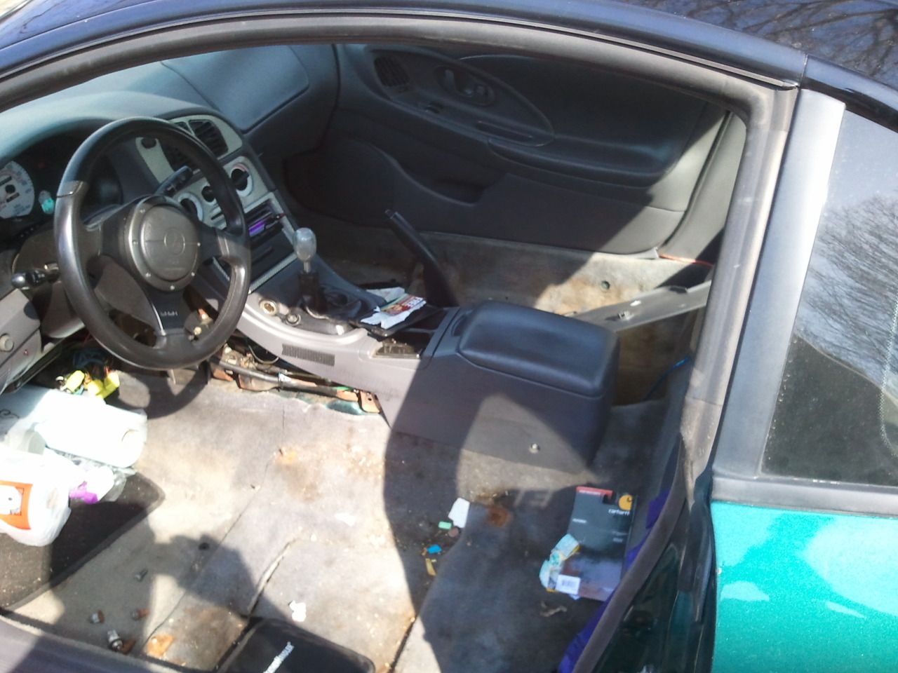

Next was the seats. The seats that were in the car when purchased, were just awful... real awful. I'd have been better off with a 5 gallon bucket with a 2x4 duct taped to the back, more comfortable too.
Case in point.
Got them out and definitely going to have to be cleaned while it's easy to clean the carpets.

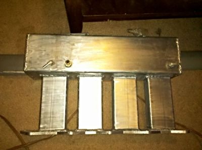

The rails were picked up from the machine shop. Got them welded on to the existing frame that was already on the car. A little grinding on my part and they were welded together(quite nicely I might add).

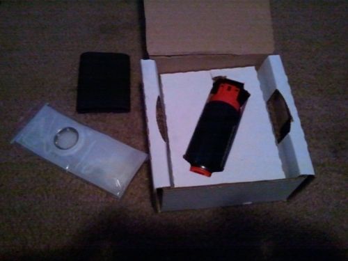

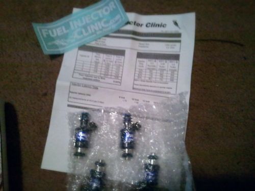

Thursday(3/28) turns out to be a great follow up to Wednesday. Air and fuel both arrived. FIC 1250cc injectors, Aeromotive 340 pump, and STM 4" intake.

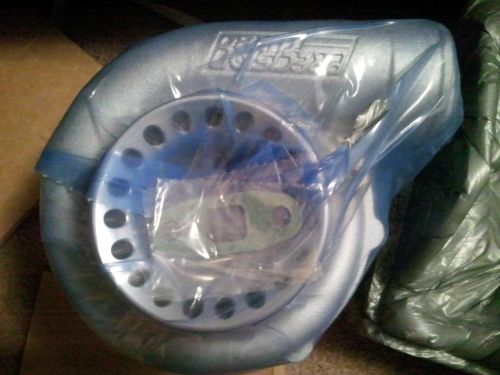

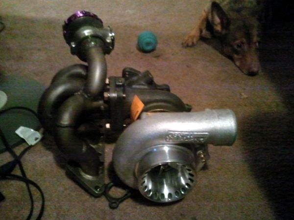

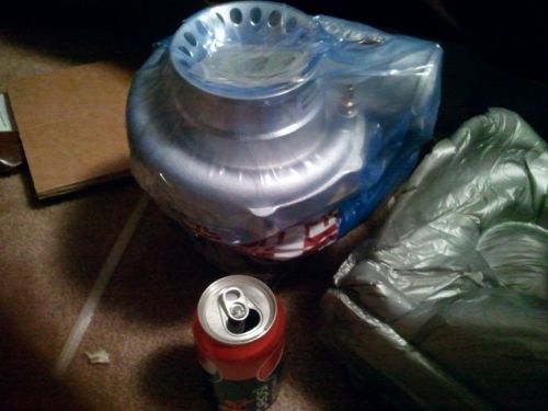

Friday was the big finale. The big daddy got in the mail and today had to be one of the longest days of work ever... I could just hear it calling me.
It just dwarfs the 12oz can..
No words....

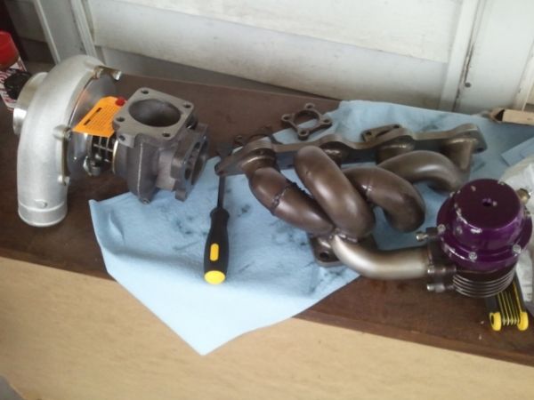

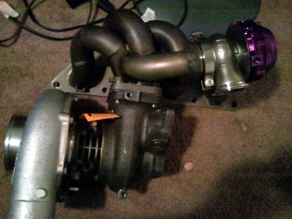

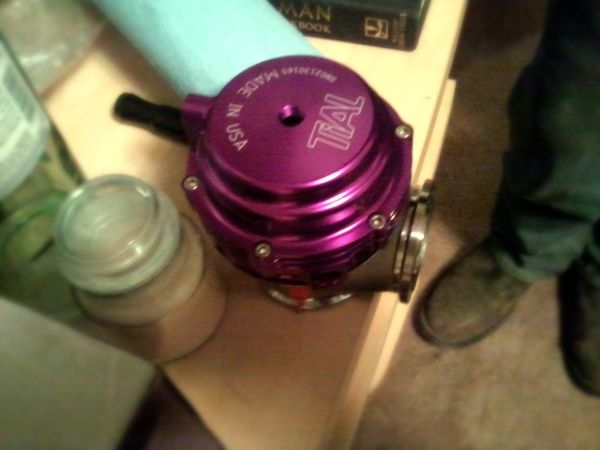

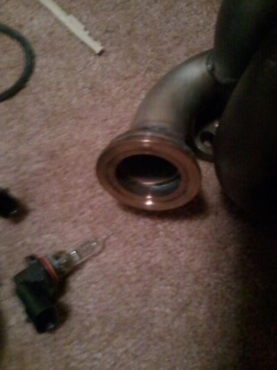

I test fitted the manifold to the new turbo and old wastegate. This is what it looked like.
I ended up running in to several things I should have been prepared for, but well I got a little excited and jumped the gun. So note to self next time new shiny things come in, calm down and do all your research and don't rush into like I did.
Since I had down time after further examination, I decided to toss the wastegate. It seemed well rough, and no brand name anywhere or any marking for that matter. I decided I would rather be safe than sorry, and not leave the well being of my new turbo up to a questionable vital component. So I ordered a Tial MV-R44 wastegate to replace. It came in yesterday and here is what it looks like with the V band flange welded in and test fit.

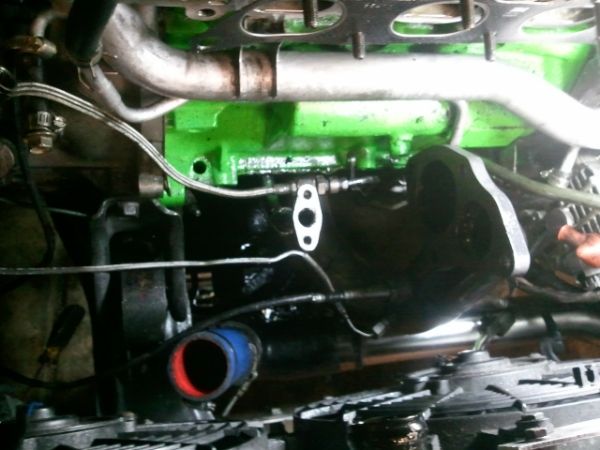

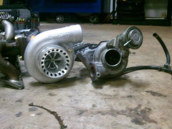

I got the 16g turbo out had to do some modification to make the water pipe work. Going to have to replace the O-rings now but small price to pay. A few small odds and ends like oil fittings and the new turbo would be ready to put back on.
Here's a side by side of the two turbos.:rocks:
The Engine bay looks pretty lonely now ...

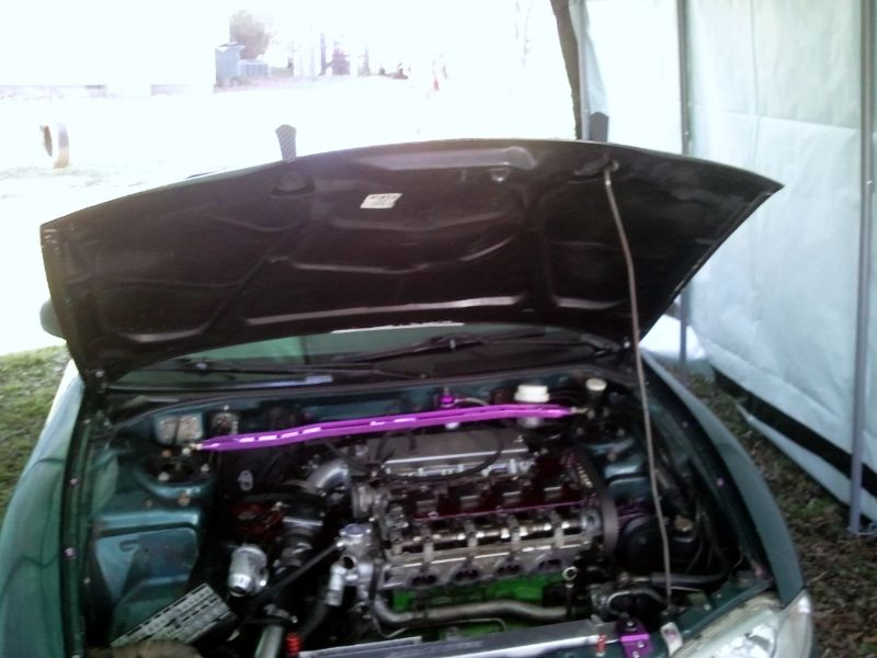

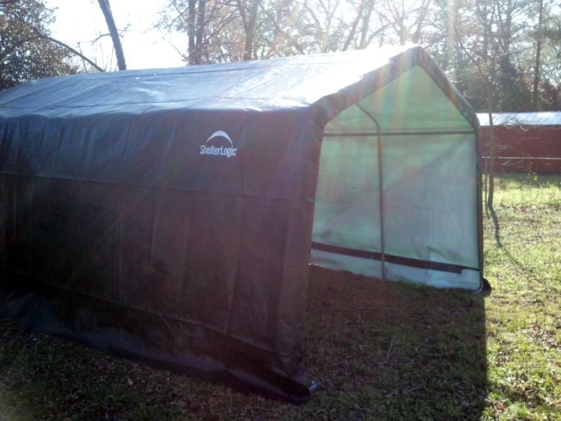

Unfortunately not much to update on. Mother nature kind of took the week from me. But I decided I would not loose more time due to weather so I went out and picked this little thing up.
Not as cheap as I would have liked but it seems sturdier than the normal temporary pop-up gazebos that are for like a nice picnic or something. But as luck would have it the day after it is assembled, clear skies and beautiful 60-70 degree weather.:ohdamn:
I rolled her up inside. fits pretty well. The thing is 12x20' so I would hope so.

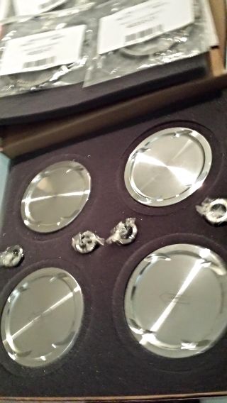

Pull block, new rings, new pistons( I'm going to bump the compression ratio, from 8:3:1 to 8:5:1 or maybe 8:8:1 to make some more low end to compensate for the lag of the newer turbo. I may need to go further into the block though other than a small amount a smoke It seemed to be running fine.

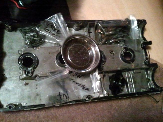

First off here's the cylinder head pulled from the car waiting to be shipped off. Stubborn thing did not want to come off.
[/URL][/IMG]
Have a good trip Mr. Cylinder head, can't wait to see you when you get back!
[/URL][/IMG]

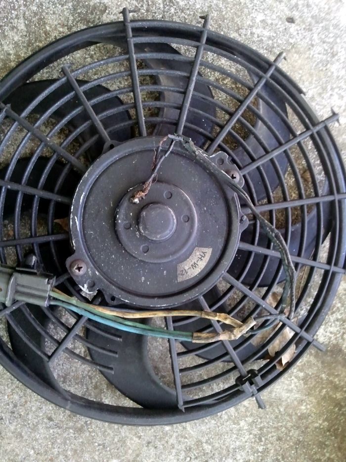

Hatch was leaking, found that out the hard way... Got an OEM weatherstip for it. Also got in my replacement Odyssey battery in.
[/URL][/IMG]
I knew it was small but I was not expecting that small...(that's what she said)

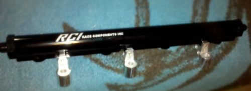

Small update. New fuel rail came in. RCI black fuel rail. Was kinda wanting the purple to match everything else, but no one seems to carry one. Even though that is what lead me to the RCI to begin with but He hasn't made anymore so black it is. There is enough purp under the hood anyways. Well that's all for now should have an update on pulling the engine by the end of the week. It's normally dark by the time I get around to doing anything so I haven't really posted any of my actual progress on the car so I'll try and fix that as well.
So in a previous post you may have seen my intake manifold with the new 70mm throttle body on it. Well it was looking pretty rough, so I decided to clean it up. My first attempt was bead blasting. A shop around here was gracious enough to let me borrow there booth free of charge. Unfortunately there compressor was not quiet up to par. I got as much as I could but after two hours I had enough. Brought it home and got the Dremel out. Went through countless wheels to get it finished. I'm glad I'm not trying to keep it polished because I didn't do such a great job, and you can see all sorts of lines in it. I'm going to take it to get powder coated haven't settled on a color yet but I'll be sure to post it when she's done.
