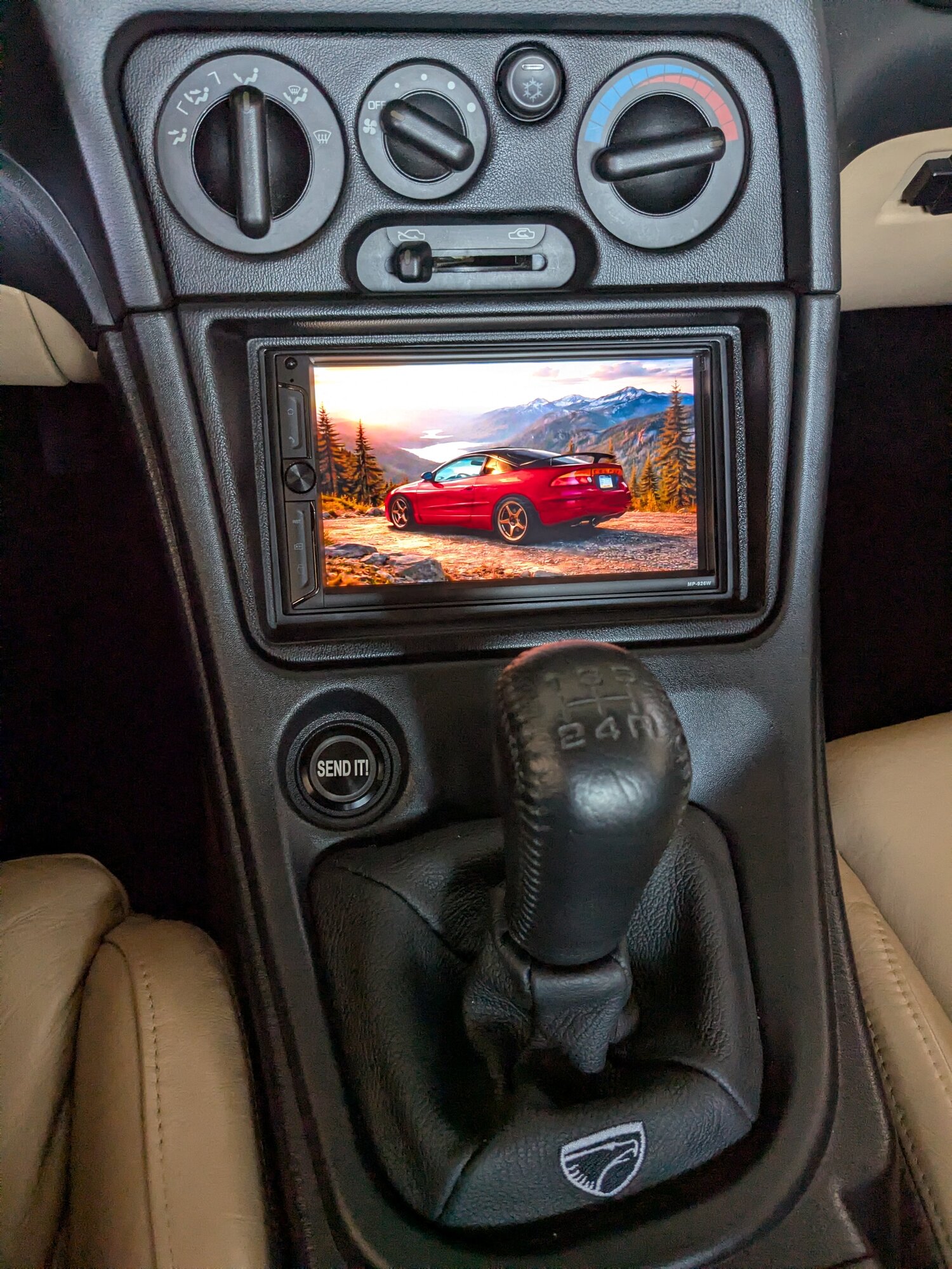

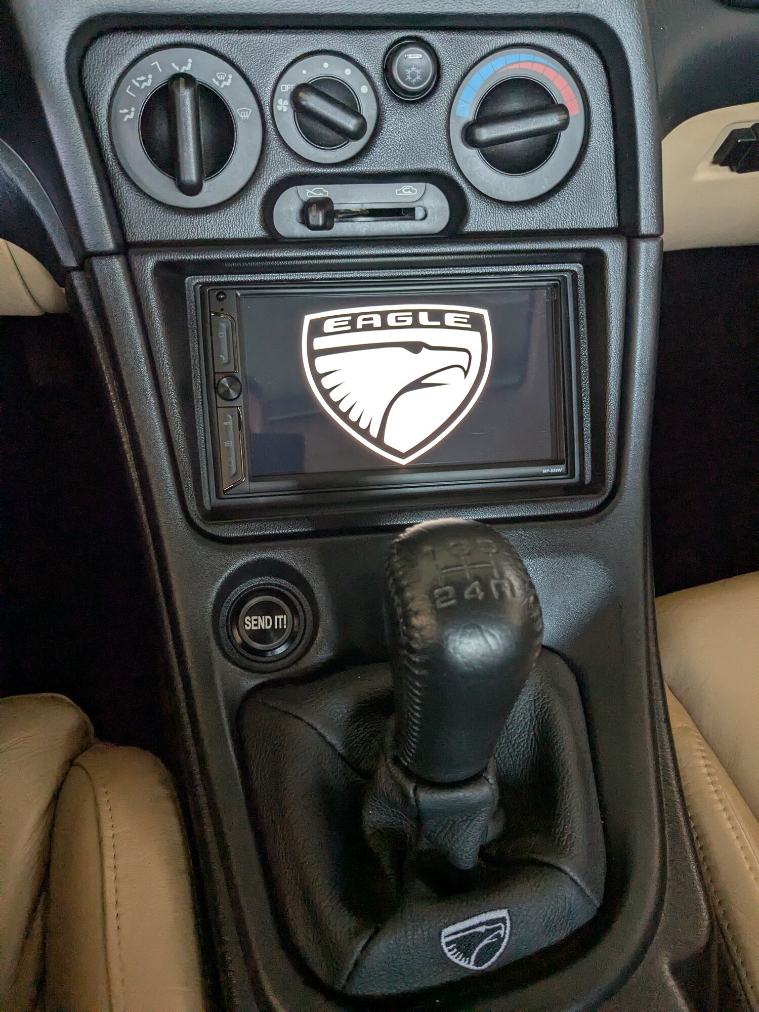

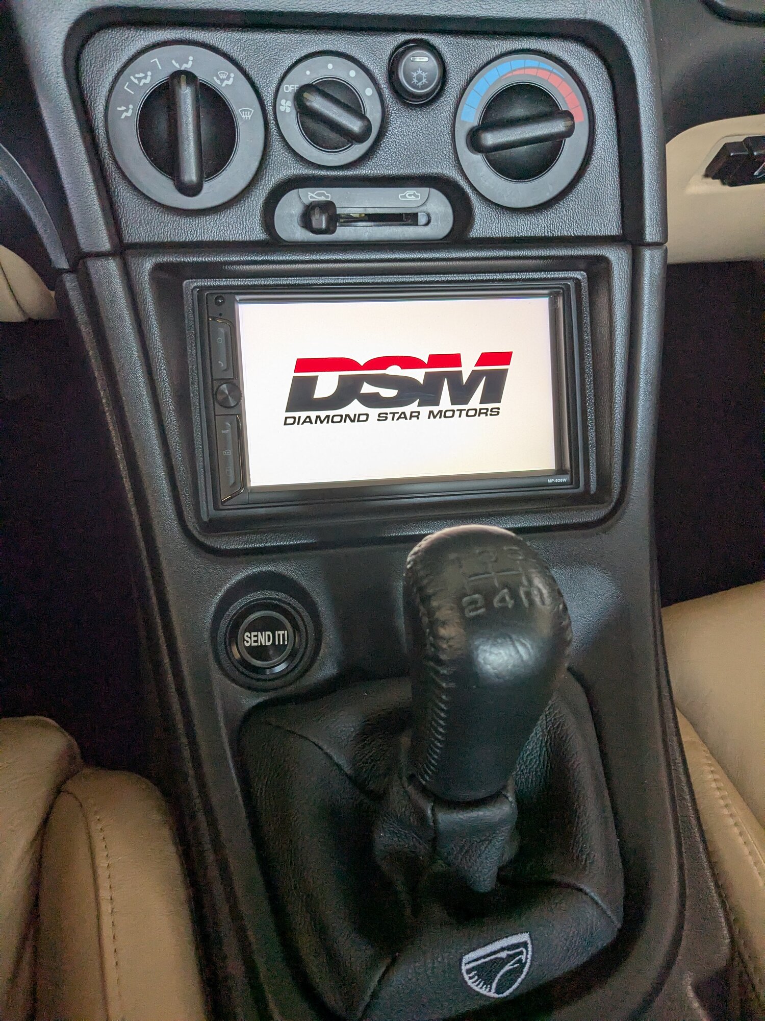

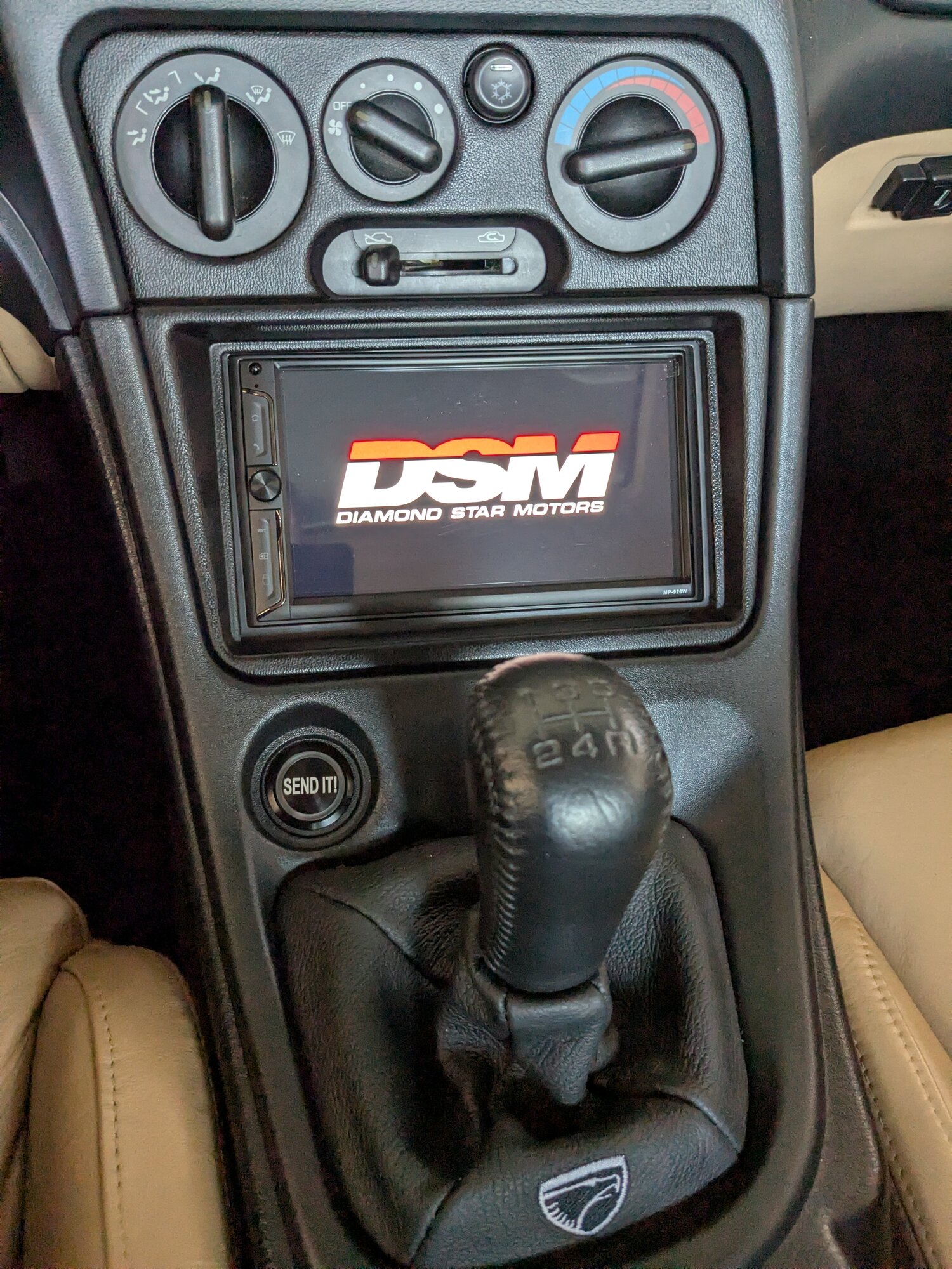

Finally got the interior buttoned up. New head unit which I'm in love with so far. It's a PLZ MP-926W unit from Amazon. Wireless Android Auto and all the other goodies to go with it. I also installed my new rolling anti lag button in the lighter spot. The fit and functionality is perfect and it even has an orange ring when lit to match the factory lighting.

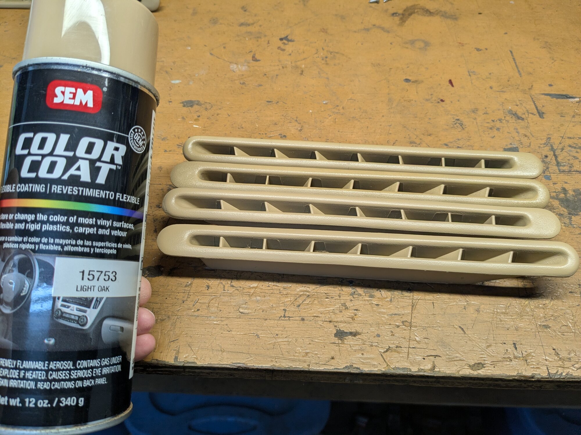

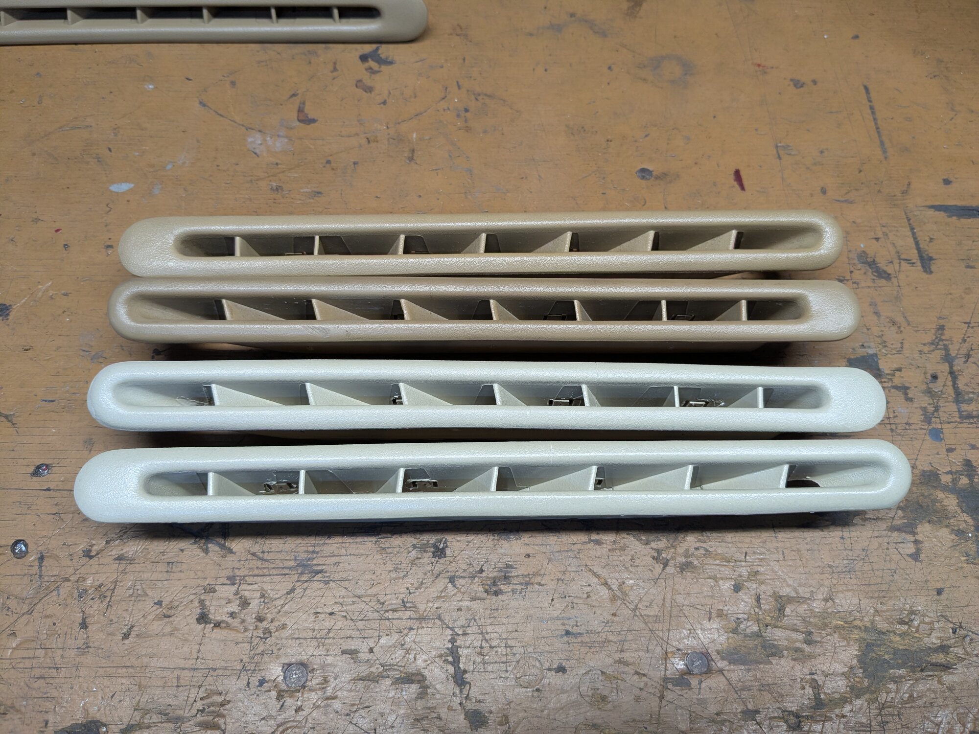

I also started to swap out my door vent trims. Mine were in decent shape but not great and I purchased a 3d printed set and painted them to match to the OEM. They came out great.
Top set is OEM and bottom is new set in both pictures.

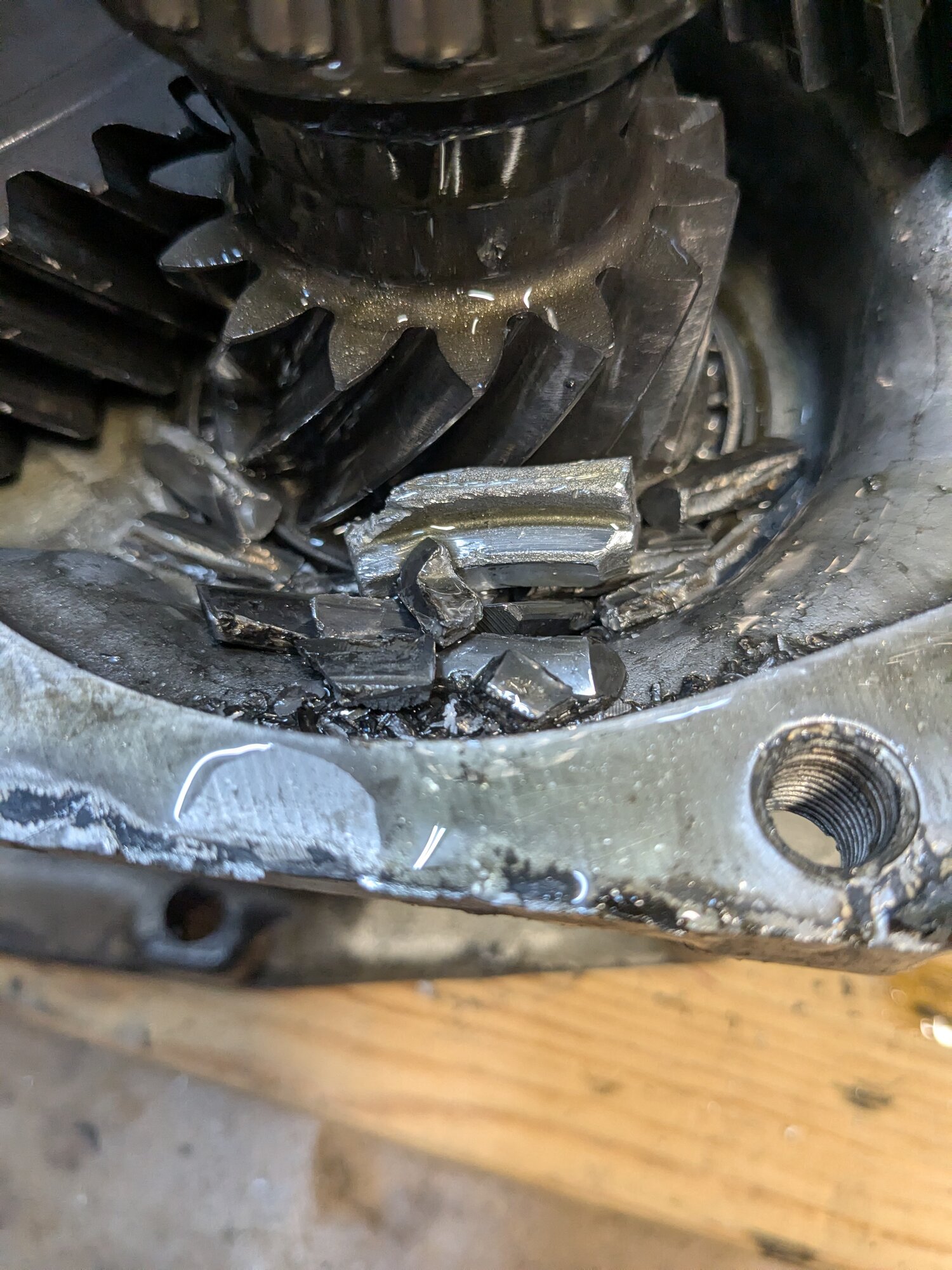

I have an unfortunate update today. Took the car to the local Father's Day car show - big show with over 600 cars. While on my way home I did a pull and completely stripped out 2nd gear. I've made good power since 2009 in this car and this is my first trans issue, so I guess I've been lucky. I have a spare 'built' trans here that I can throw in but it has seen better days so I'm not gonna do that. I also have two 'built' trans with stripped 3rd gears. I also have some NOS EVO 3 gears here. I think I'm gonna shut it down for the year and talk to some professionals and weight some options. This 3000 lb car making mid 600s HP and lower 500s TQ to the tire is in a tough spot transmission wise.
Sorry to hear Nick, but you have been very very fortunate to have gone that long with that trans. I think it's time to consider the "D" word (aka Dogbox) or go auto like some of us have. :(

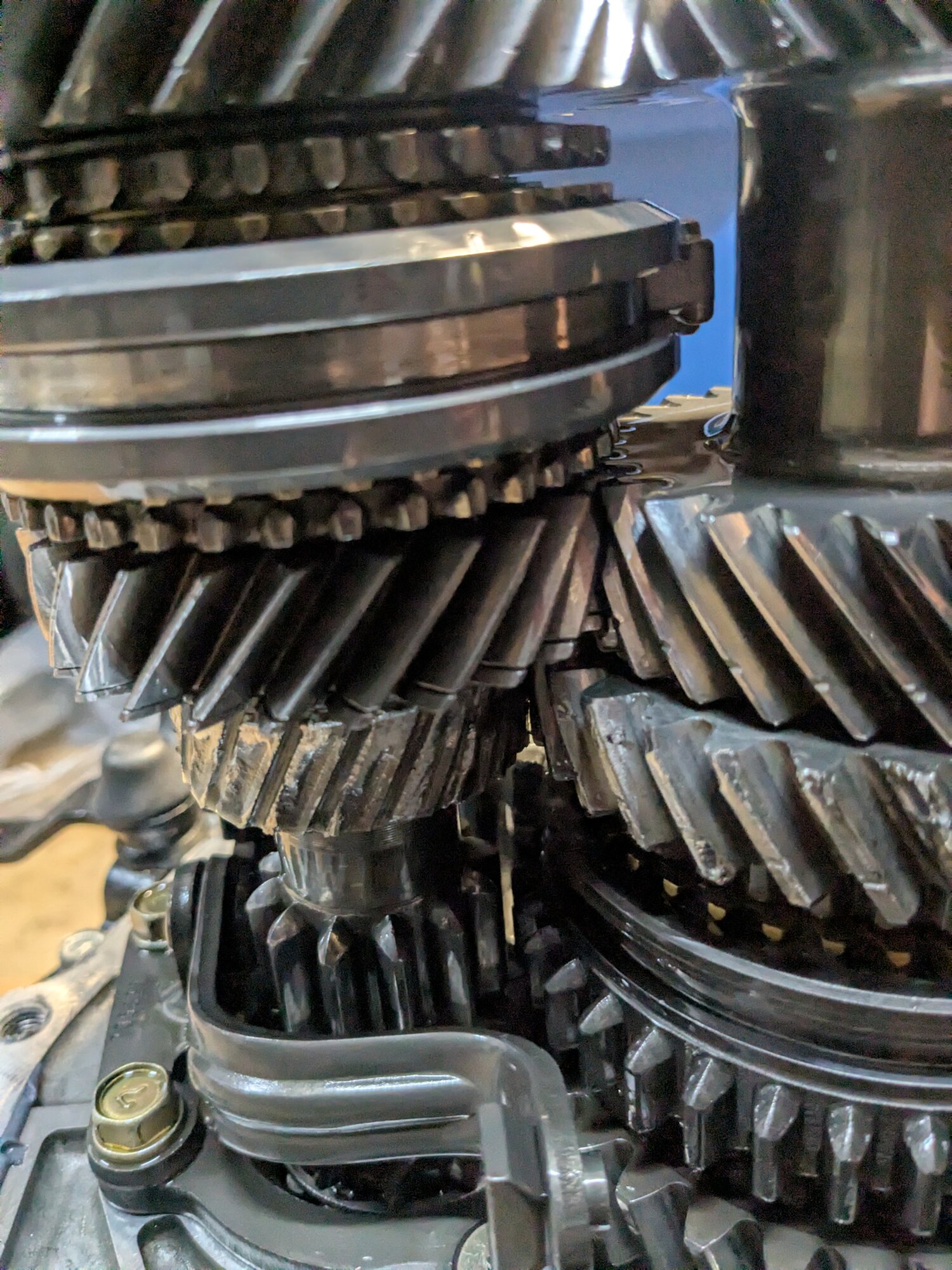

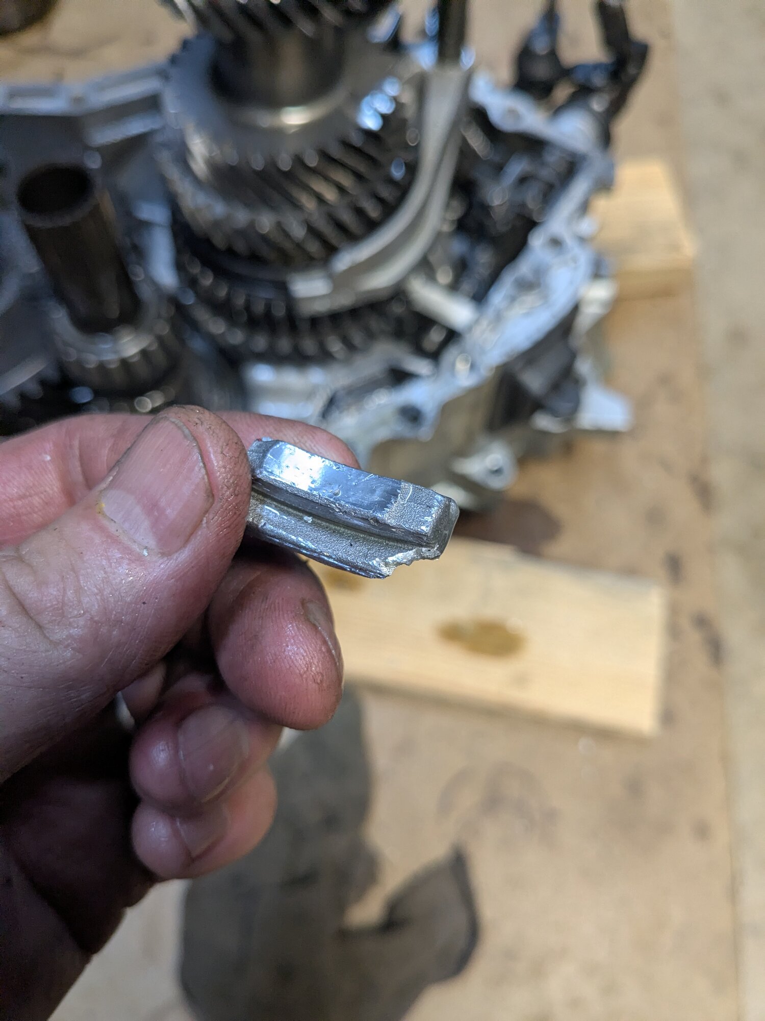

Finally had some time to pull the trans and dive into it a bit. Pretty much what I expected, stripped second gear and broken 1/2 shift fork.
At this point I'm pretty sure I'm going to go with a PAR straight cut synchro set. I have a spare built trans here but I really don't want to install it and have it in the back of my head. I just need to figure out the best way to sell off what I have here to help fund everything. I have quite a bit here and I even have some NOS EVO gears put away.

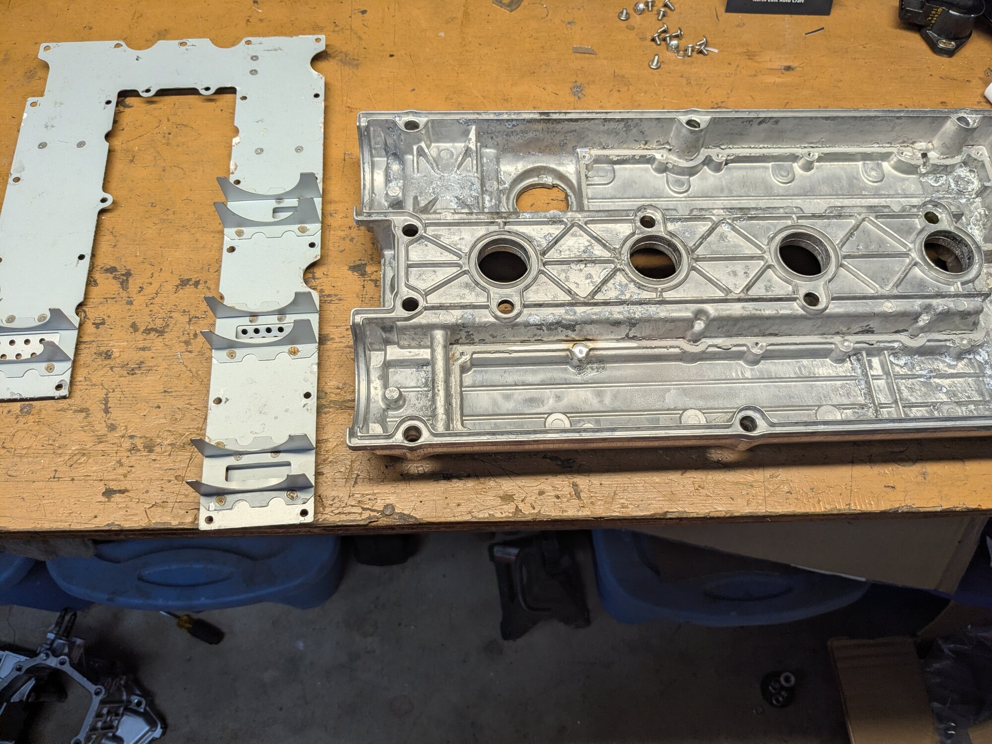

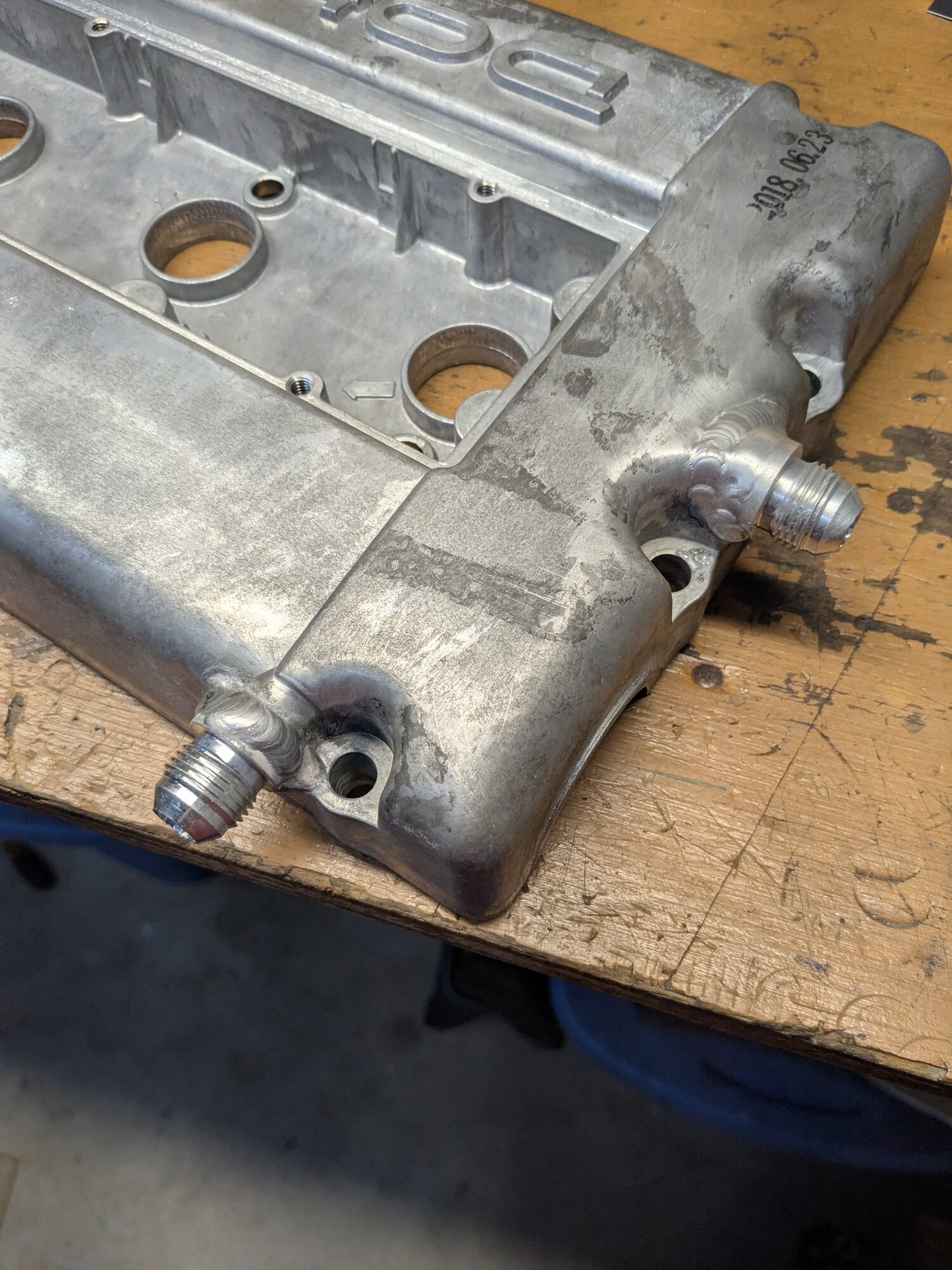

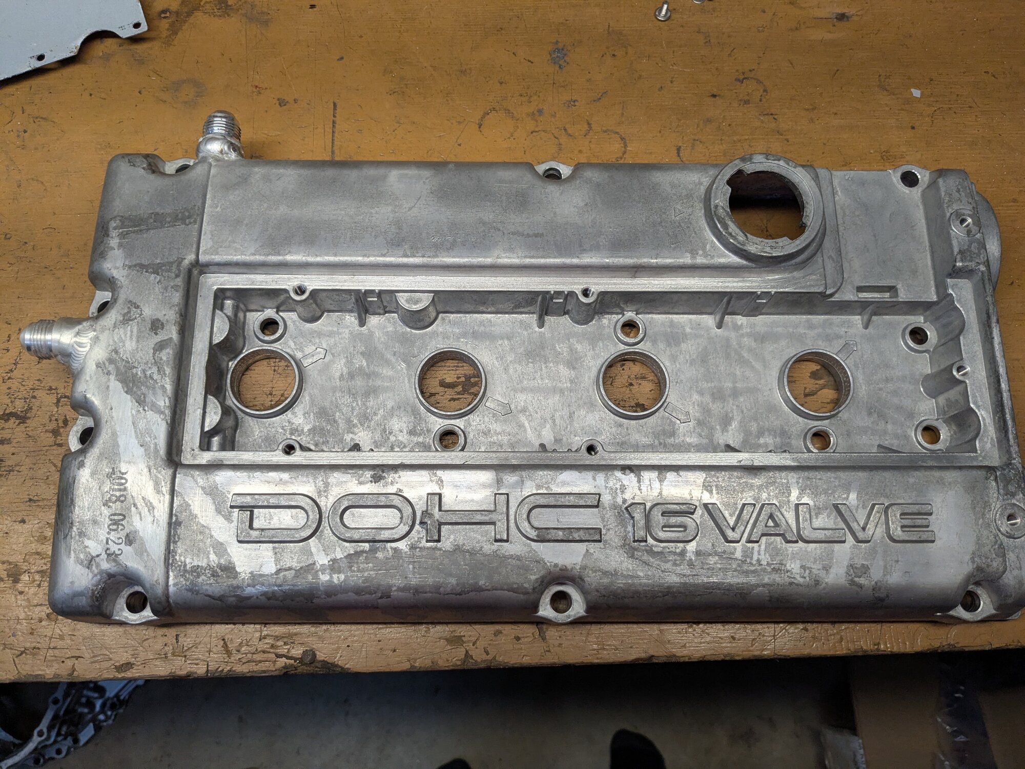

Small update on a side project for the car. I've been hanging into a NOS Hyundai valve cover(the thicker reinforced version) for quite some time so I decided to put it to use. I pulled the baffle and had a friend weld two 8an fittings for breathers. I then drilled and tapped the holes for baffle reasonably. I'll most likely color match the cover and polish the letters at some point.
Looking good!
Make sure you somehow secure those fasteners so they don't back out and fall into the valve train.
I considered removing and tapping the baffles on mine for better access and cleaning. Then I noticed everytime someone removed them, the baffles were welded back in and no removable fasteners. At that point it clicked and I realized it was rivets from the factory for a reason.
