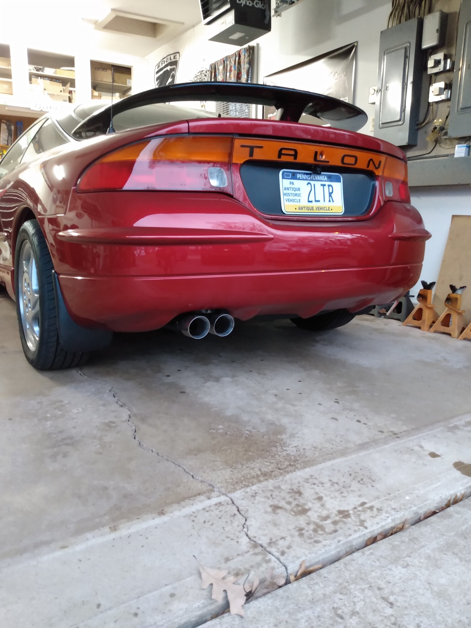

Ok, nearly 12 years without a single update is a bit crazy so I guess it's time. I will try to give a decent story behind the car and I guess I will upload some random photos from over the years and hope for the best. Enjoy...

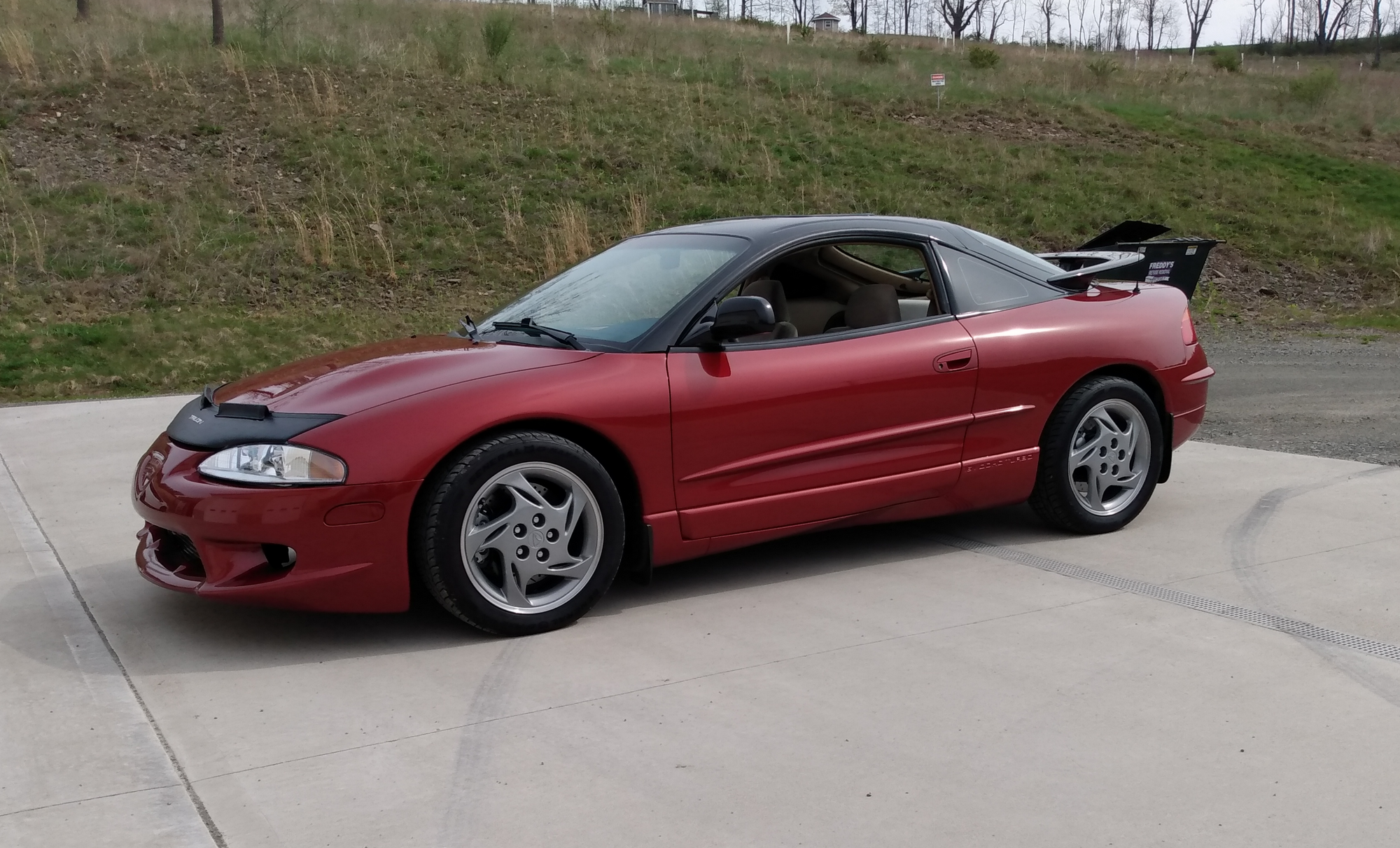

In late 2008 I had been into DSMs about 9 years and owned several 1Gs. At this point I wanted to change it up a bit. I was gonna look for either a Galant VR-4 or a 2G, specifically a 97/98 Talon AWD, so my quest started. I am very picky about what I like and I really really wanted a Paprika Red with black/tan interior. After many months of searching I couldn't find one and basically gave up on the 2G idea. I did however find a Galant VR-4 a couple hours from me that was very clean so I was planning to pull the trigger on that car. I spoke with the guy several times and I gave a small non-refundable deposit and made plans to pick the car up the following week.
Within days of that deal I find a 97 Talon AWD in the Paprika/tan combo that I really wanted. It was super clean, had a fresh paint job, rebuilt motor(6 bolt), and some decent mods. It was two states away from me and about 5 hours but that wasn't enough look away. I contacted the owner right away. After many conversations/phone calls we agreed to make a deal. My best buddy(also a DSMer) and myself rent a trailer and take the ride. We met in the middle from both of us, about 2.5 hours. I took the car for a short test drive and everything was as stated so the deal was made. I contacted the owner of the Galant VR-4 and told him the situation. He was cool with it and we moved on.

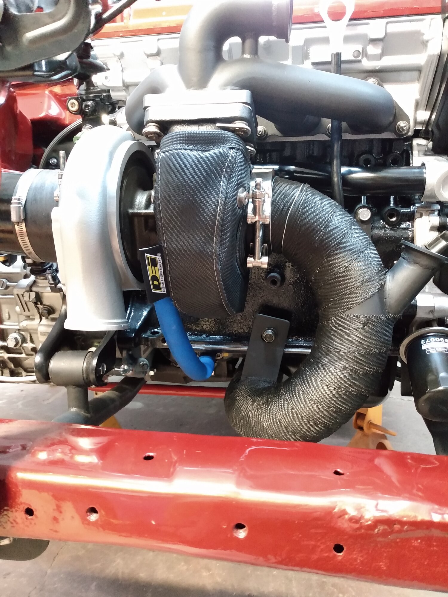

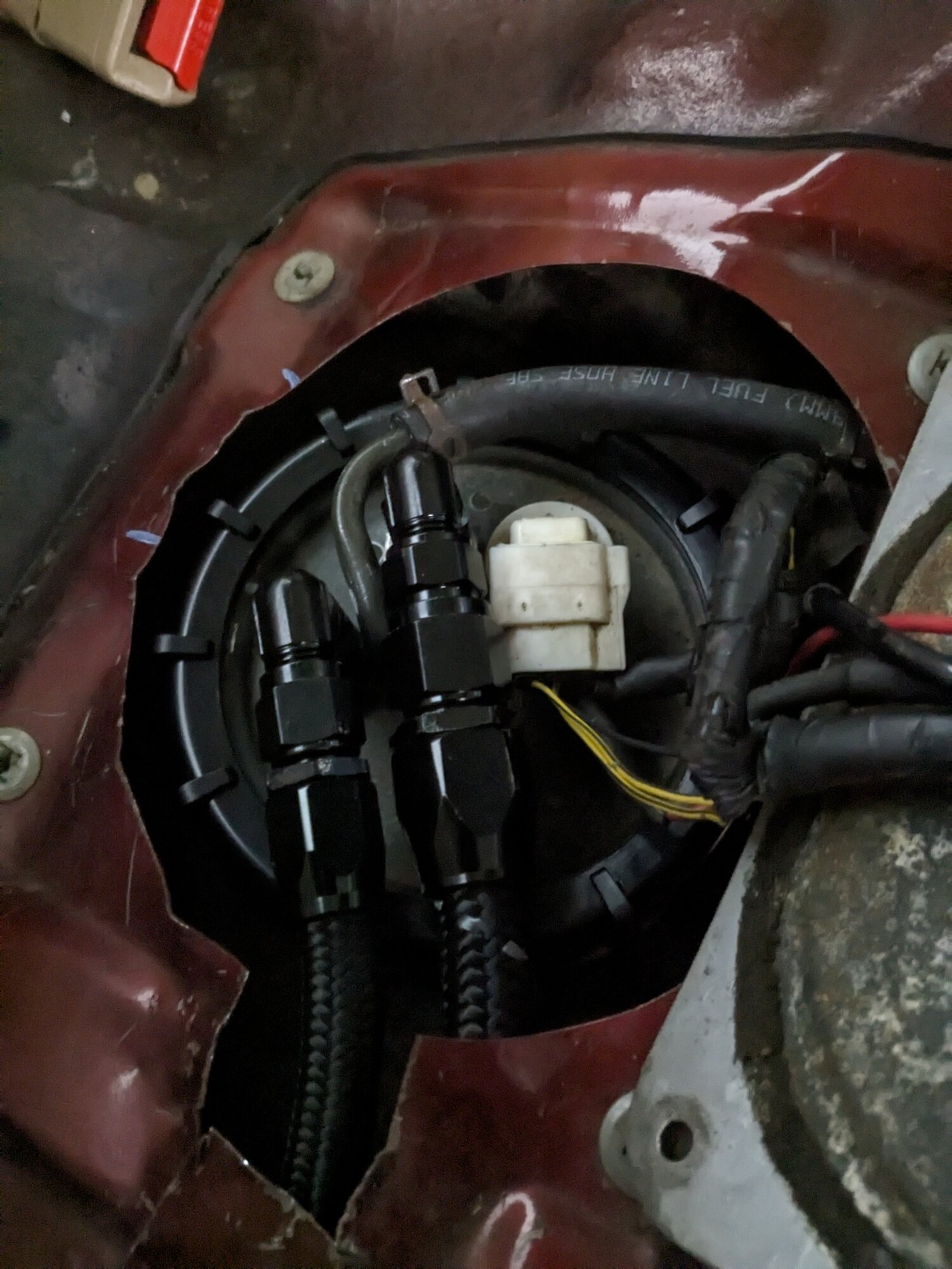

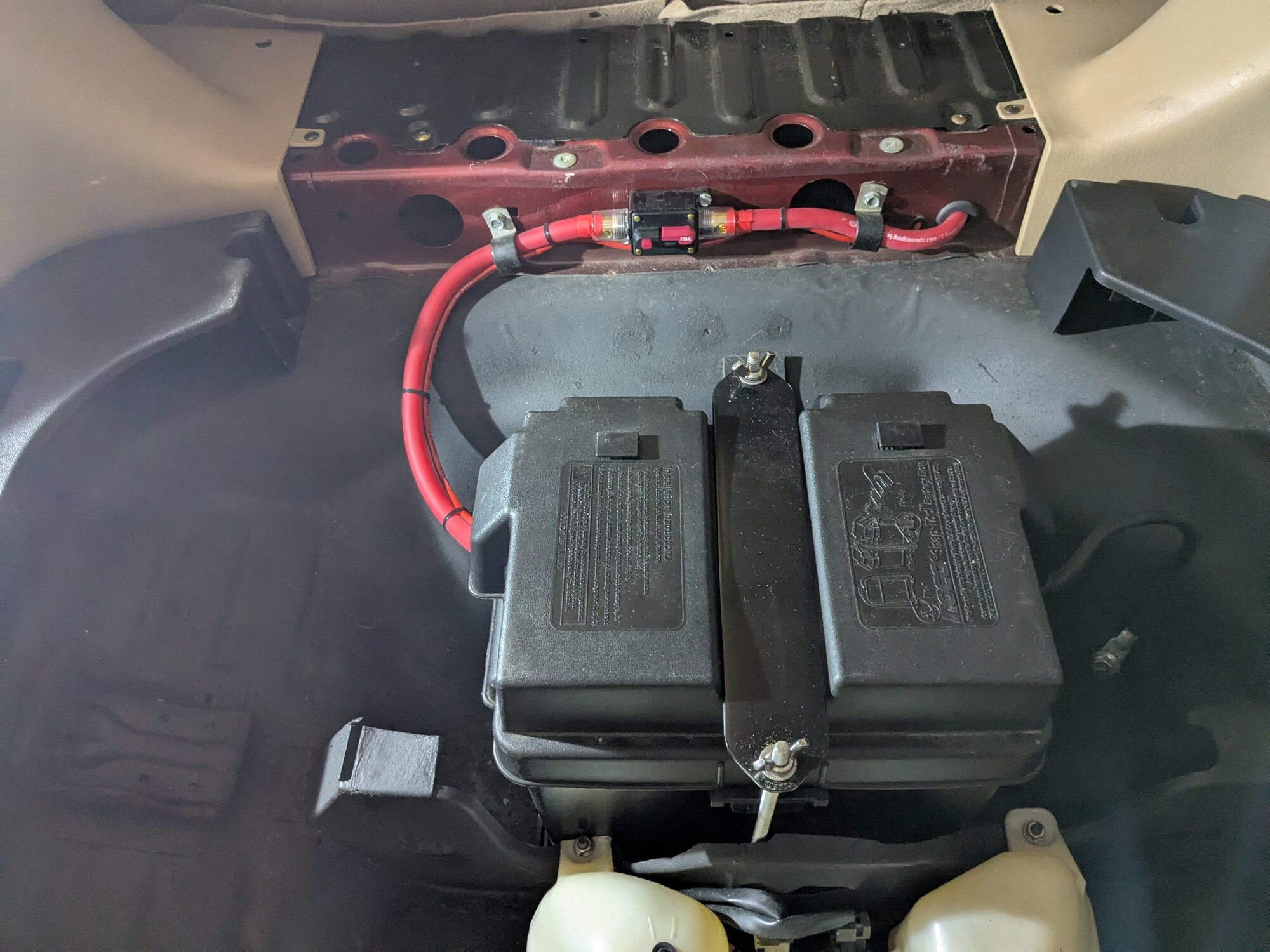

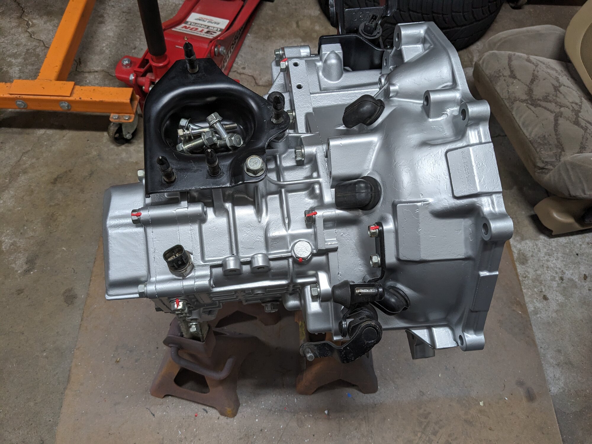

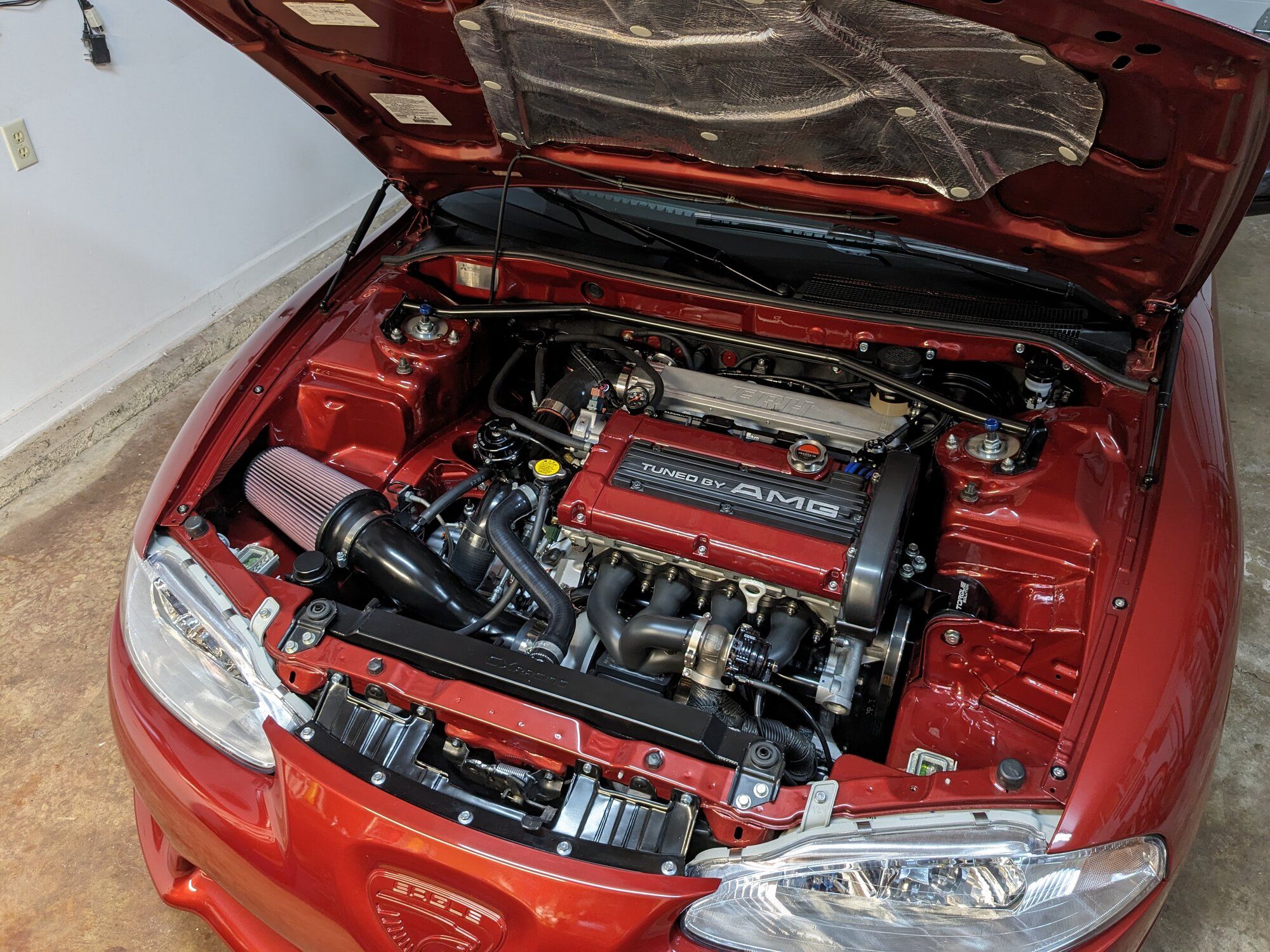

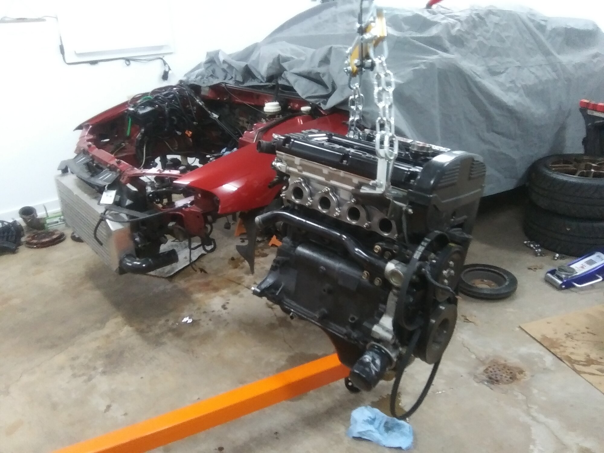

I enjoyed the car a short while in 2008 and over the winter I wanted to do a few things so it was parked. Early into 2009 and while going over things closely I noticed the engine had crankwalked. A 6 bolt with only a few thousand miles on it and it was shot. That was when the first tear down happened. This first round included a rebuilt motor(which is still in the car today, Mahle/Eagle combo, lightly ported head and HKS 272 cams), some suspension mods, brake kit, Cyclone intake, 1150s, water/meth, battery relocation, alt. relocation, light rewire, 56mm HX40, ACT 2600 with street disk, etc. All this was nearly 1 year of total time, from early 2009 to early 2010. At this point the car was very clean and ran really well.

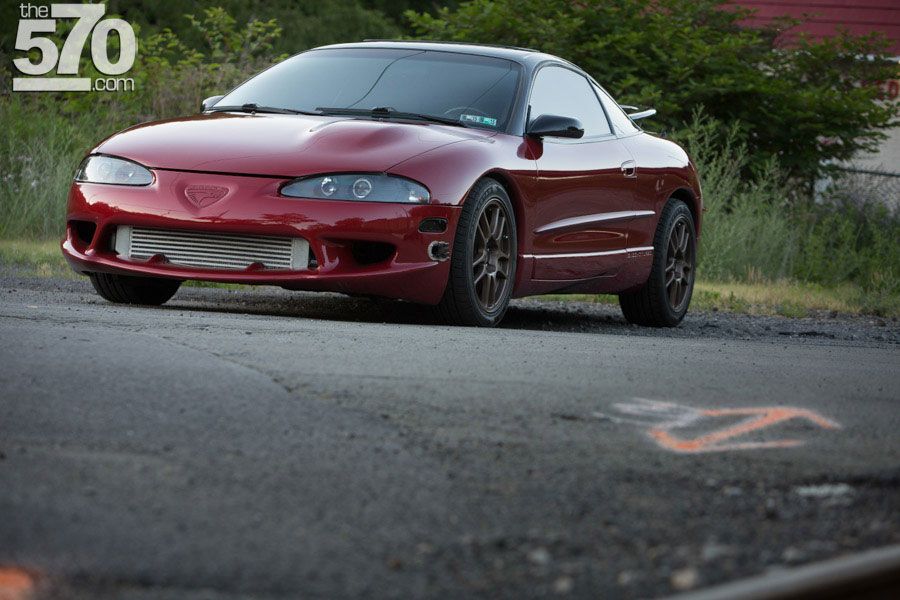

2010 was a great year. Took nearly all summer to get it running great and just enjoying it. Late 2010 we got wind of some no-prep airport drags held by a local Corvette club. My DSM buddy and I headed up to that and had a great time. This was honestly the first time I thought the car was pretty fast as I was beating cars that were ~500 hp pretty easily. The very next weekend there was a dyno a couple hours from us so we went with a bunch of friends. My car did about 525/510 off the street and ended up 565/524 after dialing in. To say I was stoked would be an understatement. I had hoped to see 500awhp when all was said and done but mid 500s was insane to me - especially in 2010.
Over the next 10 years(2010-2019) I just enjoyed the car. We did the airport drags for a few years and my car did amazing every year. Almost every year I did something over the winter to just keep tweaking to my liking. I really wanted to do a wire tuck at some point but didn't want to be down an extended period of time so I always put it off. In 2016 and 2017 I got into some street 'list' racing. This was all no prep 1/4 mile with a bunch of rules to keep it real to street cars(full interior, DOT tire, inspection, etc). I did pretty well in that and made it up to the #3 spot, not being able to get over the hump with two CTS-V cars. Both were very low 10 second cars so no shame there. I had an absolute blast with everyone involved in that and really earned some more street cred. At the end of 2019 I wanted to dyno the car again because I was going to switch up the setup a bit and wanted to see the differences. We had a local AWD dyno at this point so of course I went there by myself just to play a bit. Ended up making 608/510 on e60 and 60mm HX40/Cyclone combo. I was super happy with that and the car always ran and it ran great.

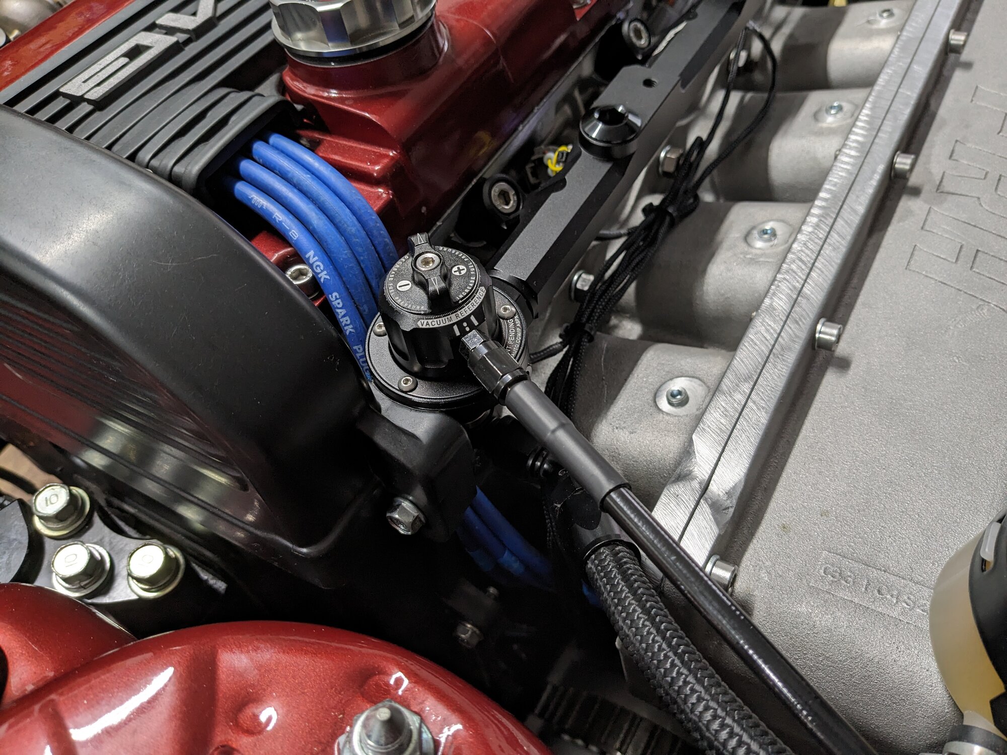

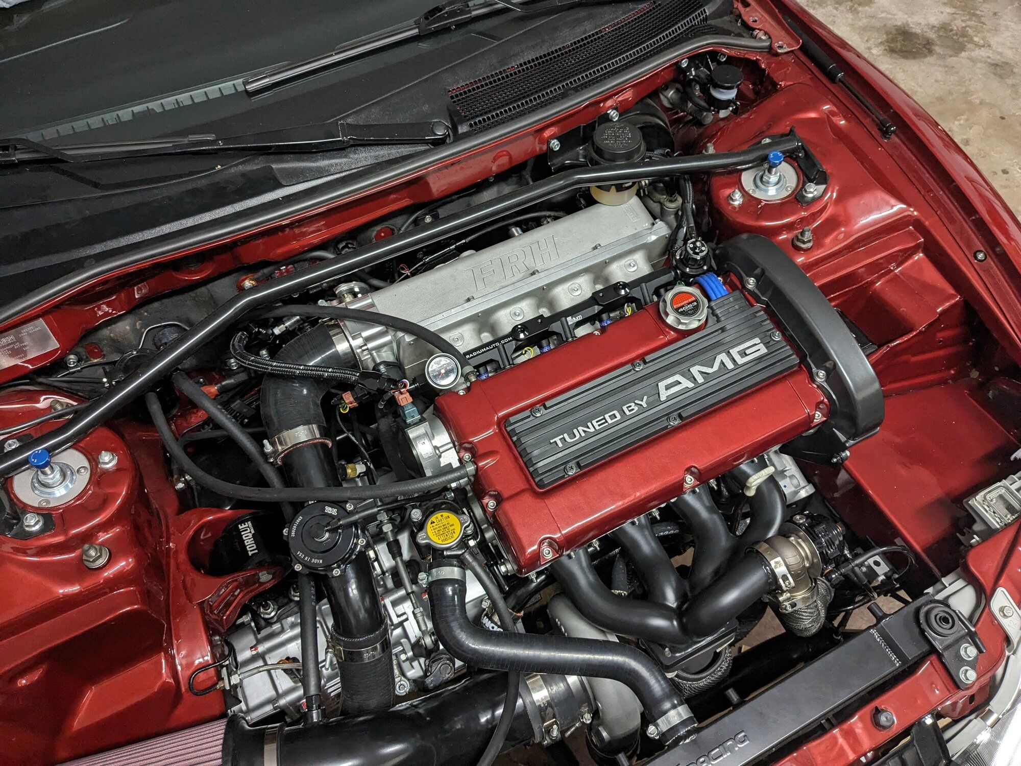

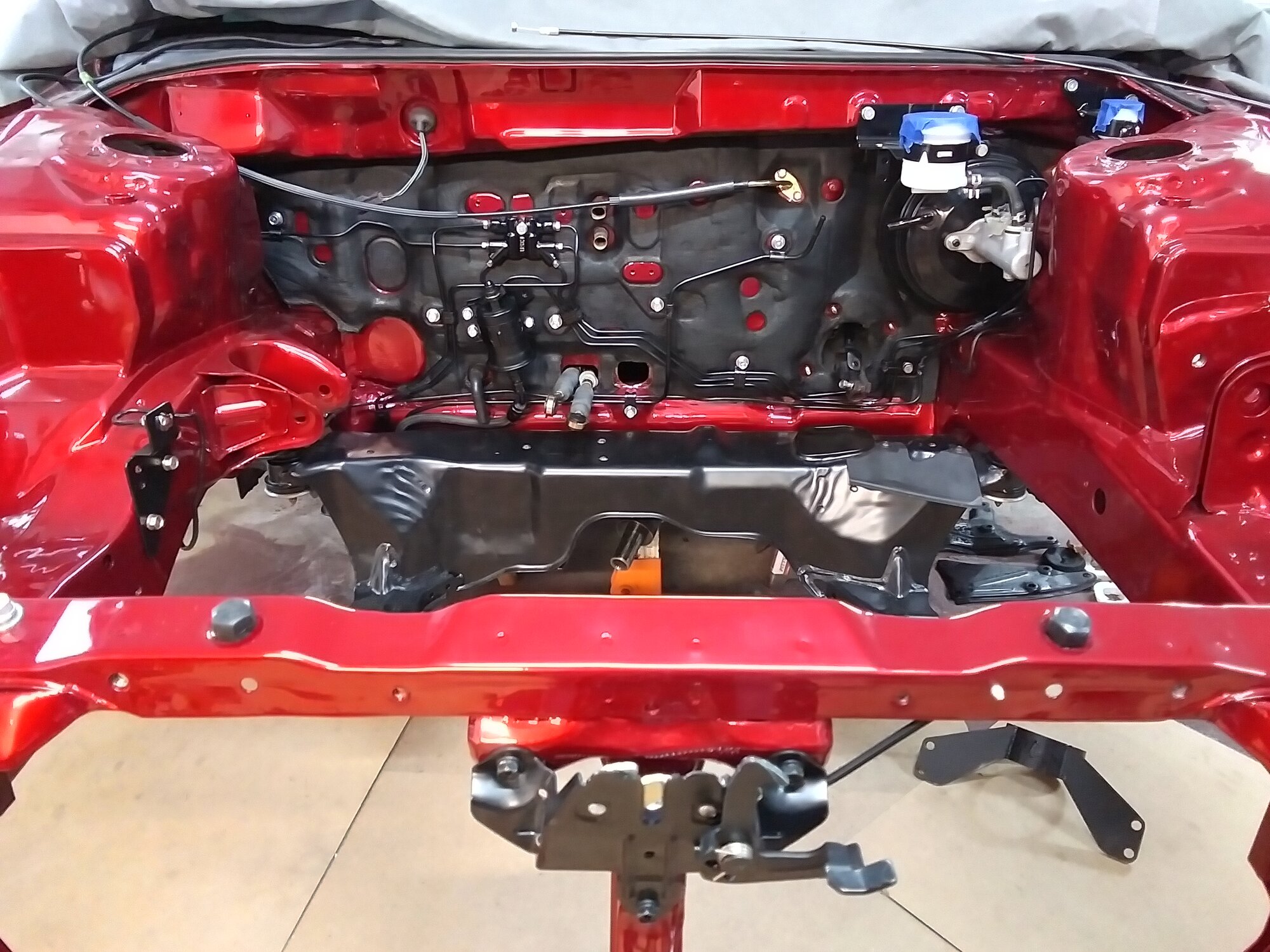

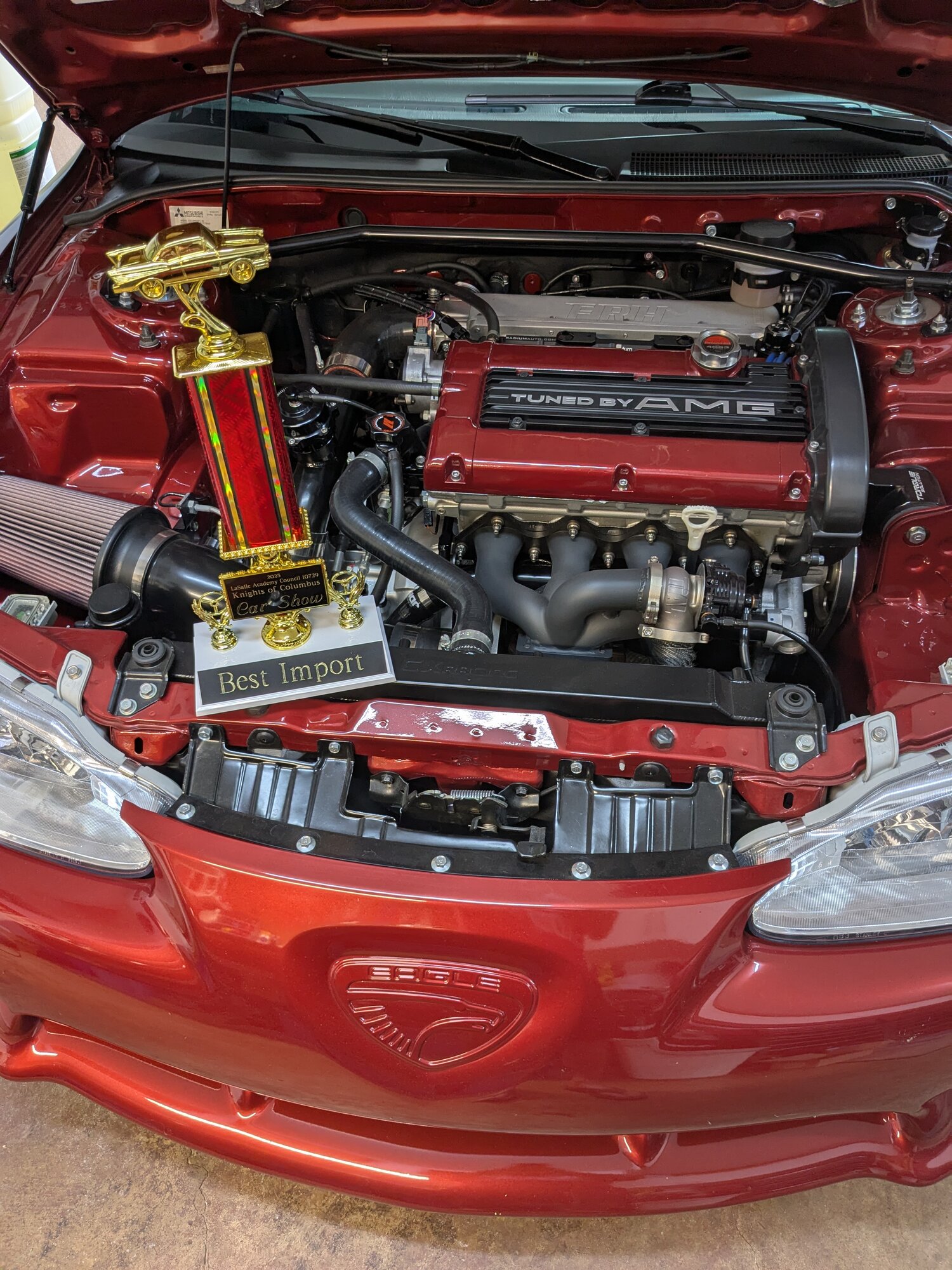

In very early 2020 I was gonna pull the trigger on the wire tuck. My options were to either purchase all the tooling and do it myself or talk to Ohm racing. After much debating I decided on the Ohm Racing purchase. I was in talks with them for probably a month to make sure I get everything just as I wanted. Literally as this is happening COVID shuts everything down. I immediately decided that 2020 is a wash and I'm going all out on the car. So not only a setup change and wire tuck but I'm pulling everything and shaving the bay. I had been a hoarder of NOS parts for years so I decided it was time to put them to use before I die and my wifes dumps everything. At this time I also have the motor freshened up(new bearings, clean up, etc), suspension upgrade, alum. driveshaft, another clutch swap(my 5th and FINAL setup), wheels, every fuel related item, and a TON of powdercoating. I also replaced every OEM nut and bolt with brand new OEM hardware. Literally everything that can be seen was replaced. The list was huge and I wouldn't be able to put everything on here, just trust me on this LOL.

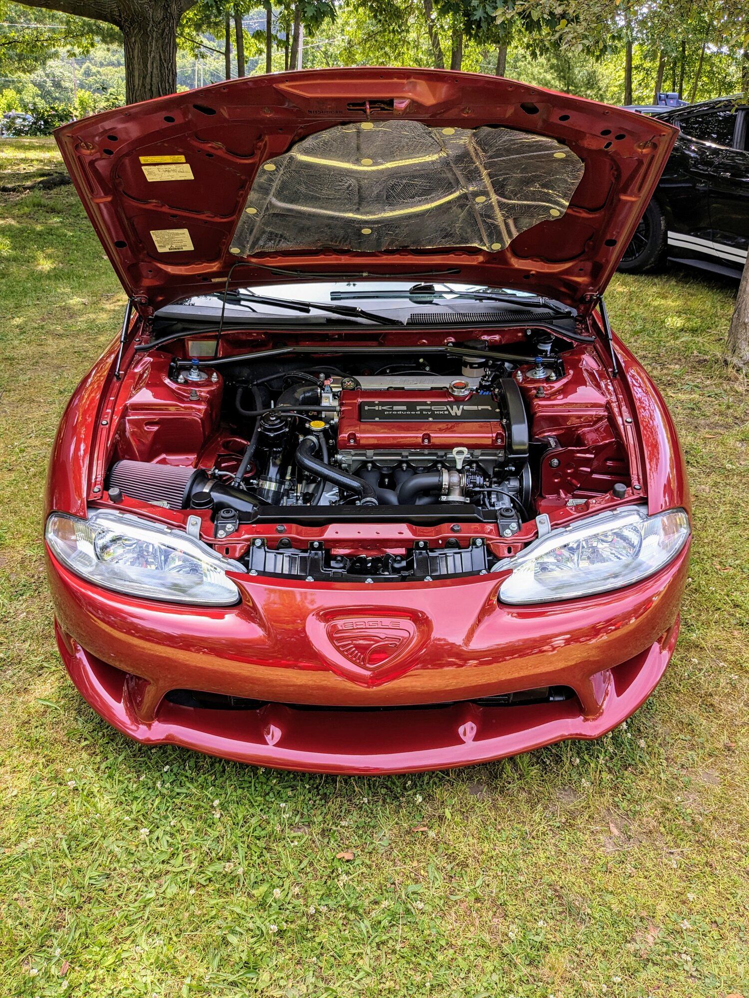

In 2021 the car is back, after just over a year. From 2021-2025 I really enjoyed it and started taking it to car shows much more often than I used to. The attention it has gotten in the last 5 or 6 years has been amazing. I even took it to a MOPAR show in 2025 and won a trophy LOL. I actually stopped racing it 'officially' as I just lost interest in it to be honest. I take it out, do a pull here and there, and go home happy. The local dyno closed shop so I was never able to re-test the car but that's ok. I went from 64 lbs/min @ 38psi on the old setup to 74 lbs/min @ 40psi on the new setup. It's amazing what cams, intake manifold and some fueling can do.

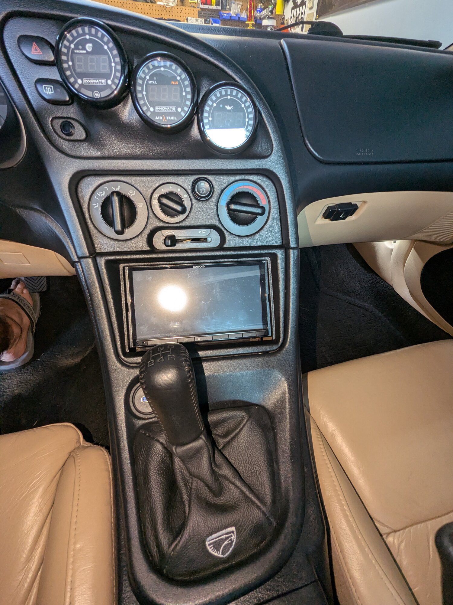

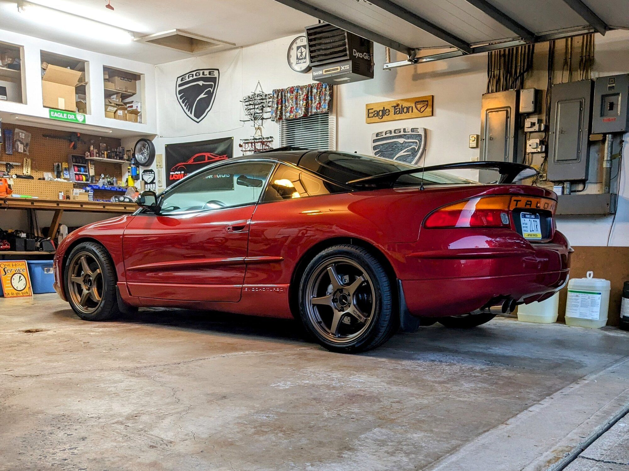

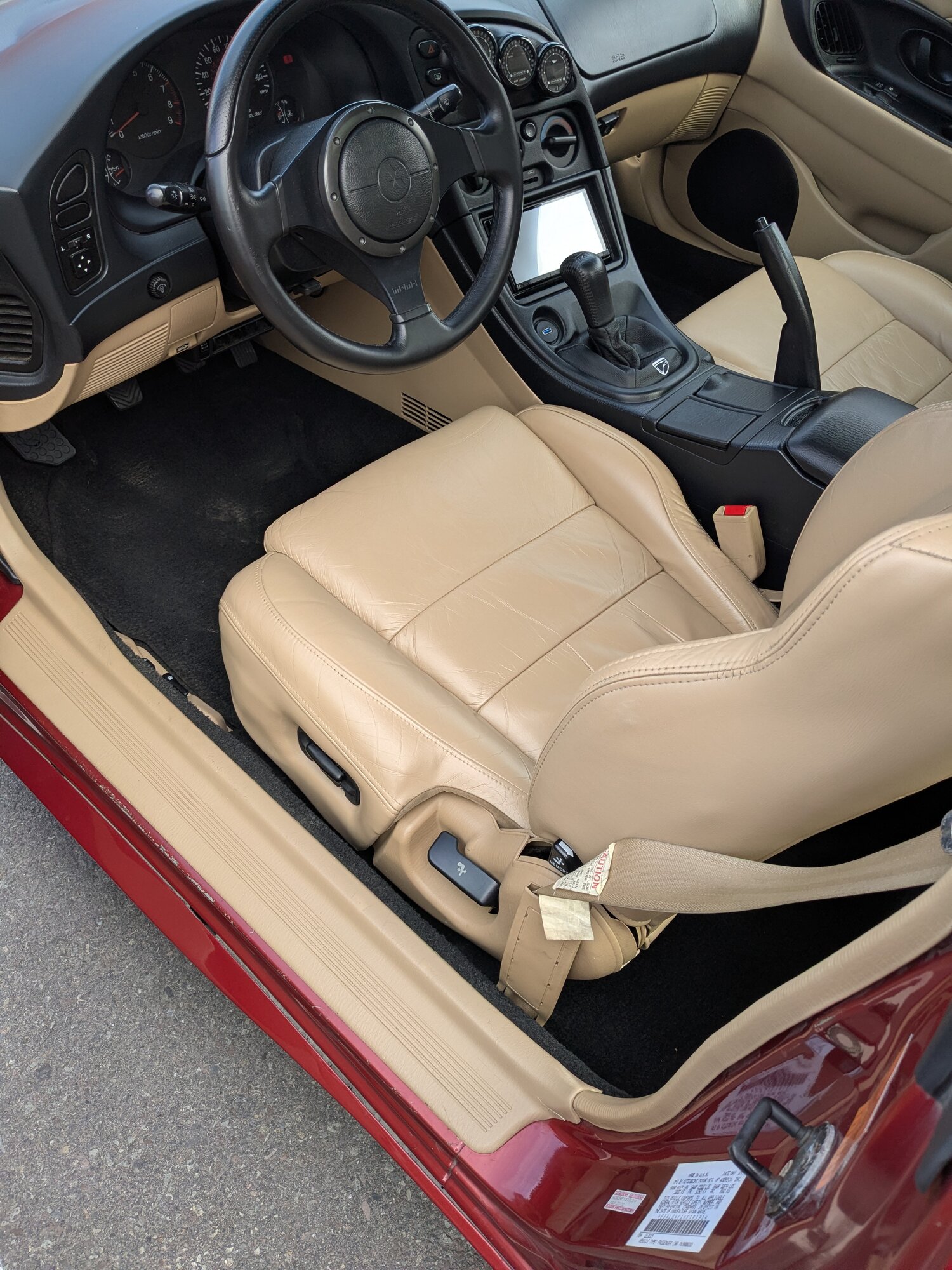

Overall, I can't enjoy this car more than I do. It's still very street-able and performs perfectly. It's not a daily driver but it's not supposed to be. But I can get in it and take it anywhere without worry. I've driven it 1-2 hours away on several occasions and there's never been an issue. I really have always tried to keep it OEM+ as much as possible and it's just what I like. The only thing it's missing is A/C and cruise, and that doesn't bother me a bit. Everyone that takes a ride with me just can't believe how it rides like stock but pulls to the moon. The goal is to take it to a handful of shows this year, scare myself once in a while, and be happy.

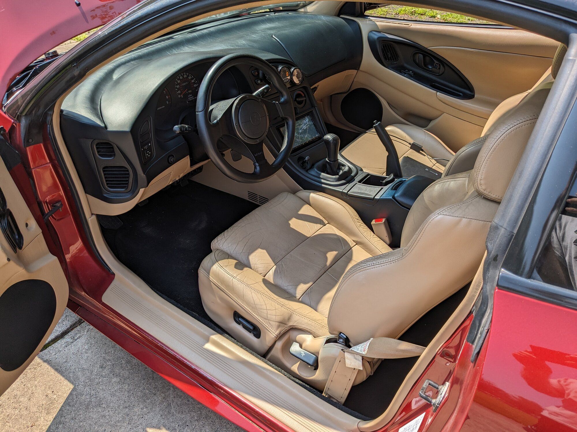

Jesus Christ, 2009?! Was it really that long ago? I remember it like it was maybe 5+ years. This car has always been and will always be one of my absolute favorites. That interior shot is so clean it almost looks AI generated. Spectacular.
