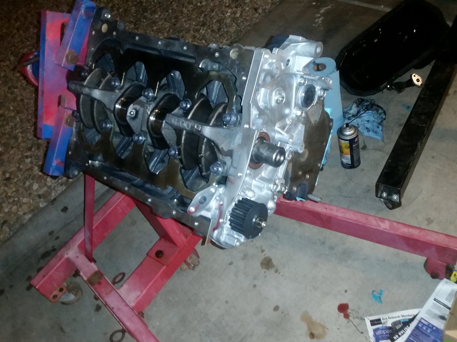

Recently I started got around to tearing down my 6 bolt that had some bad rings and started to build everything for a 20g. I had been running just a 14b on a rebuilt oem 6 bolt. I only put 8k miles on it, but it had 120psi across the board and leakdown test pointed to the rings.

Stock Bottom end, ARP everything

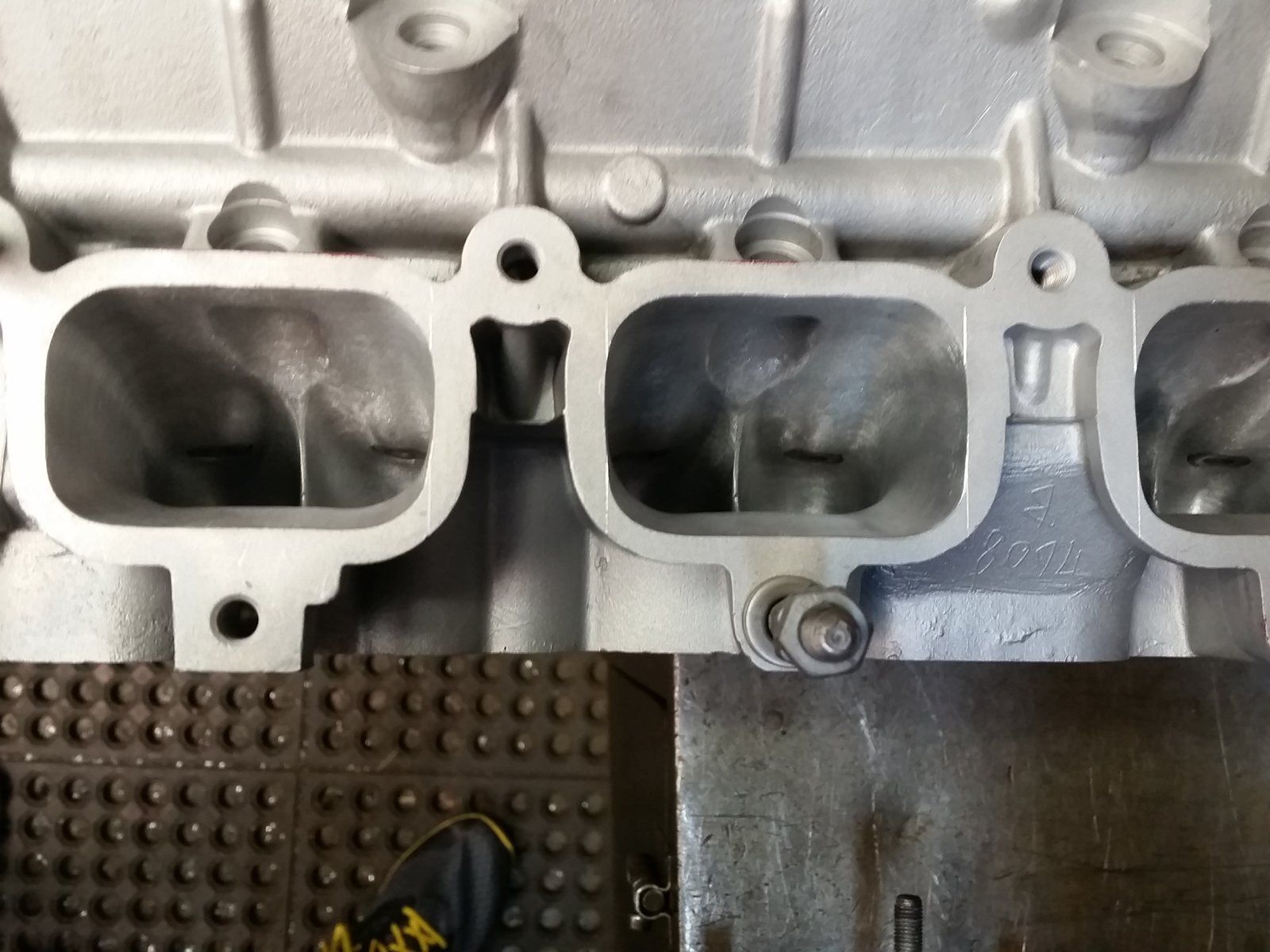

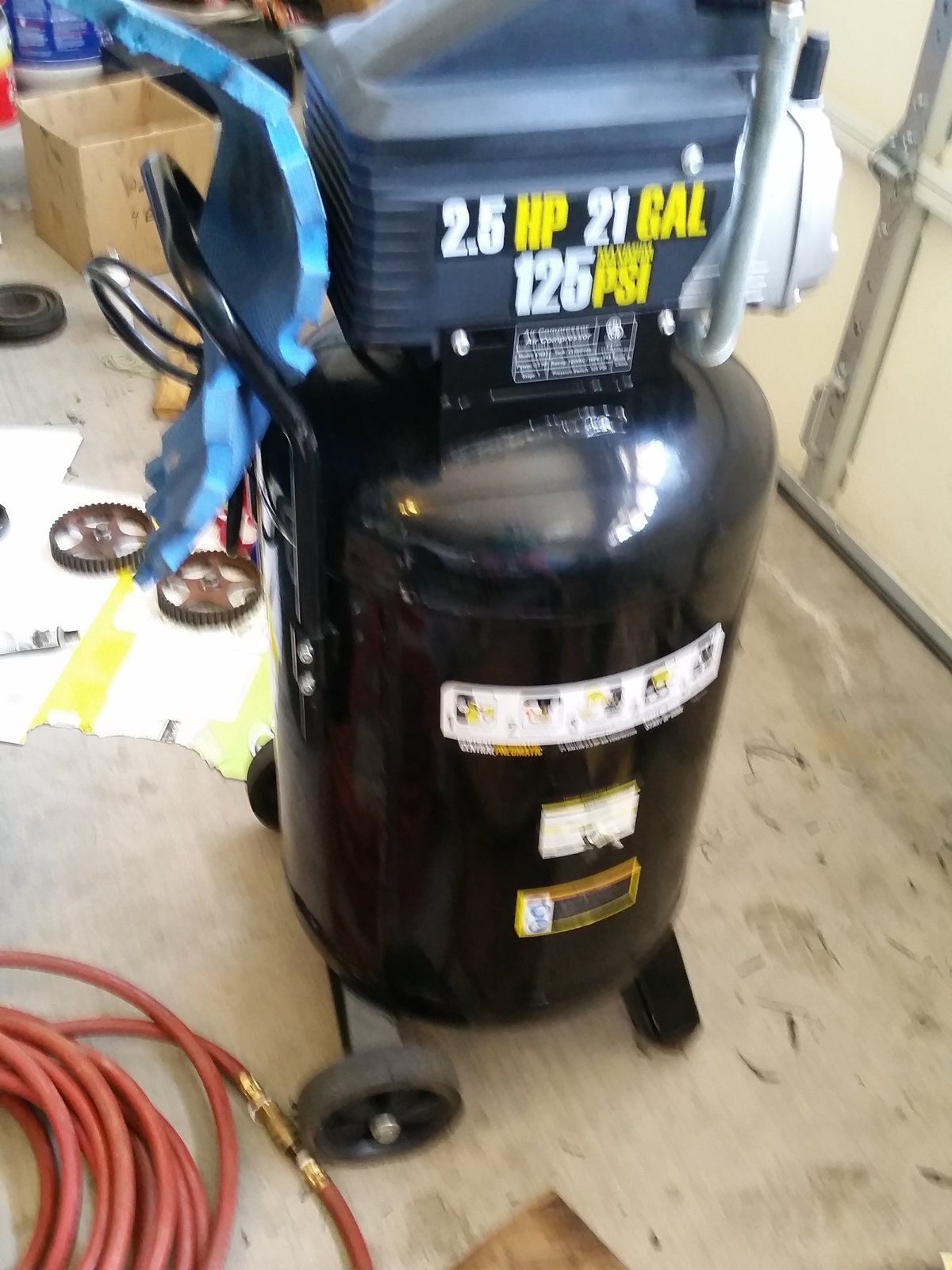

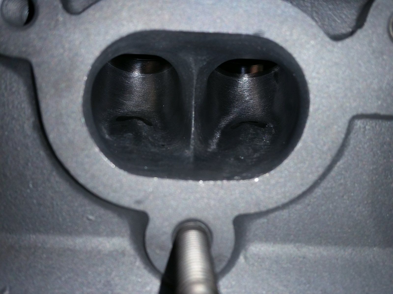

I picked up a 2.5hp air compressor for cheap on craigslist with some tools and a die grinder which has been most helpful. I have some pictures of the port job that was done at a local machine shop. CNC ported. I still have to port the intake mani to match the head.

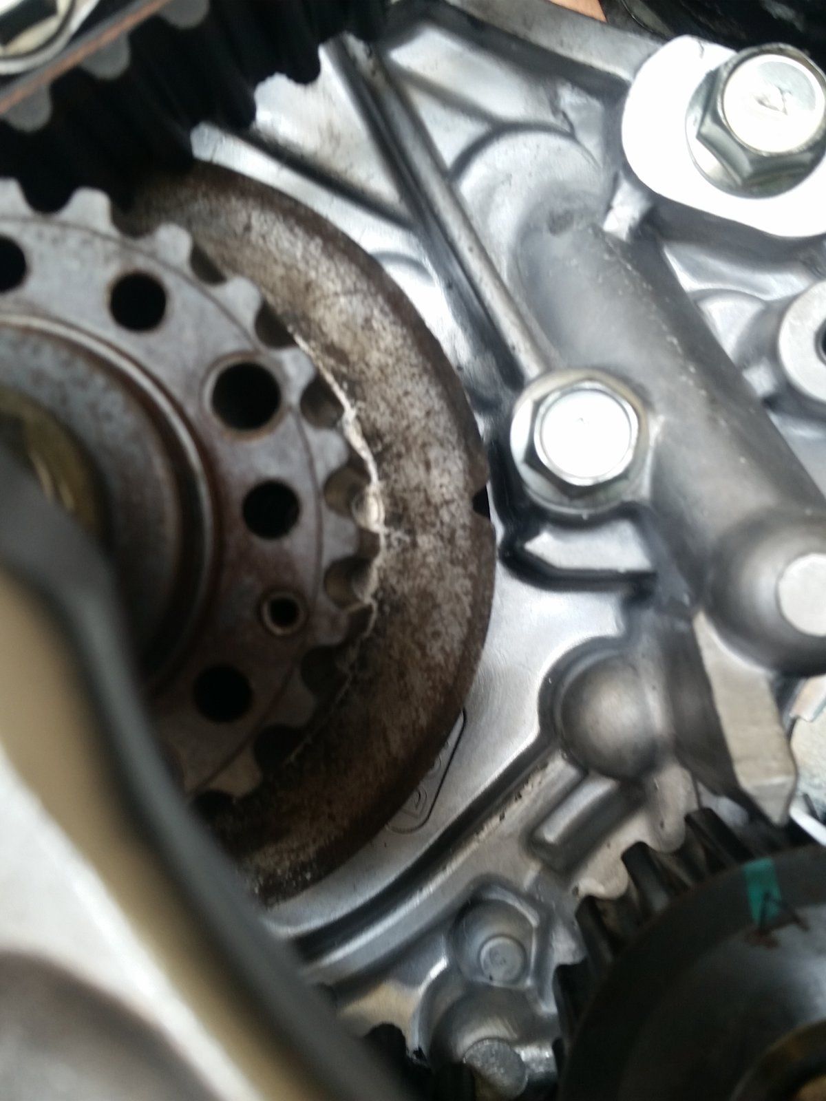

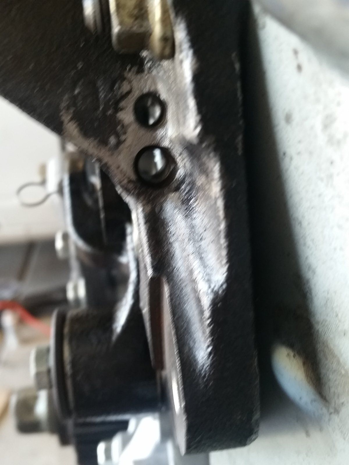

Currently, I just got the timing belt on the car after doing some fab work on the Motor mount for the 6 bolt swap (grinding away the ear to clear the 1g water pump and drilling and tapping a new m8x1.25 hole for the special tool so it contacts the 1g timing tensioner arm).
After that, I did the timing job. I have the kit from jay racing which made it a lot easier, however I swear it took me 4 times to do it bc the crank looked like it was one or half a tooth off. Finally got it however.
