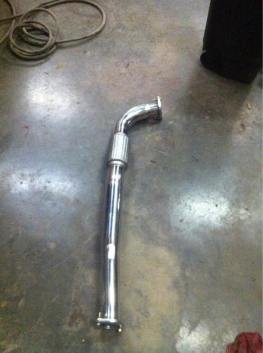

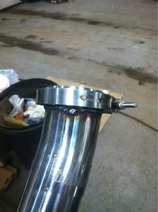

V band welded on the downpipe.

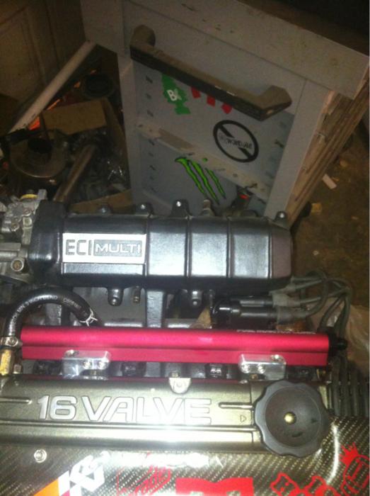

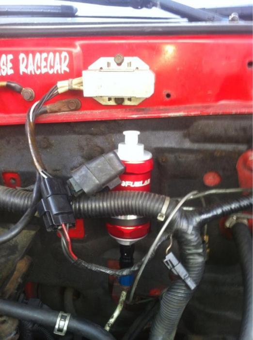

Fic fuel rail installed

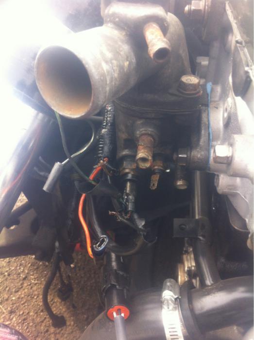

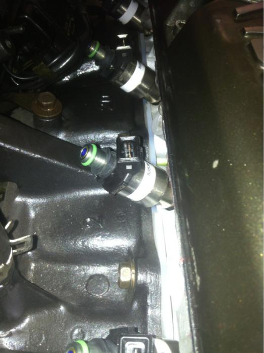

Well I finally got the engine dropped down in the bay... But I broke my oil feed fitting inside the ofh.. So pissed about that.. I'll get it fixed when it warms up and stops snowing LOL.

Just for the record, Im not sure if its the picture quality, or my eye, but you may have the balance shaft delete plug in backwards. Im not sure what method you used to plug it, but it appears that its the proper plug (rubber and metal) just in the wrong way.
I cant really tell with the picture blurry. But this might be a good heads up!
Looks awesome man!
I two used part epoxy.. Tbh I couldn't find a decent video on how to put it in.. It's the oem plug. If I can get it back out without damaging it when I take my ofh back off to repair it ill switch it out the right way

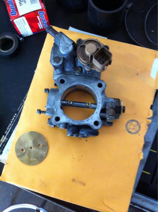

Got a little more done on the talon. Ofh is off and the broken brass piece is out..

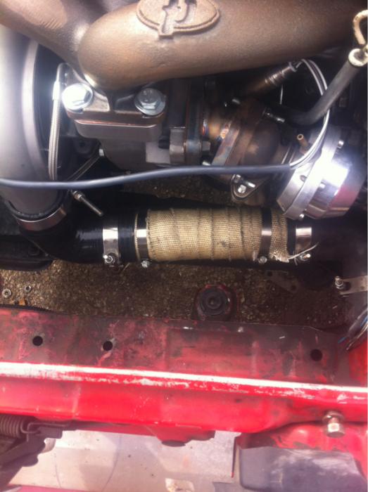

Wrapped the lower ic pipe to keep the heat off from the wastegste dump under boost.

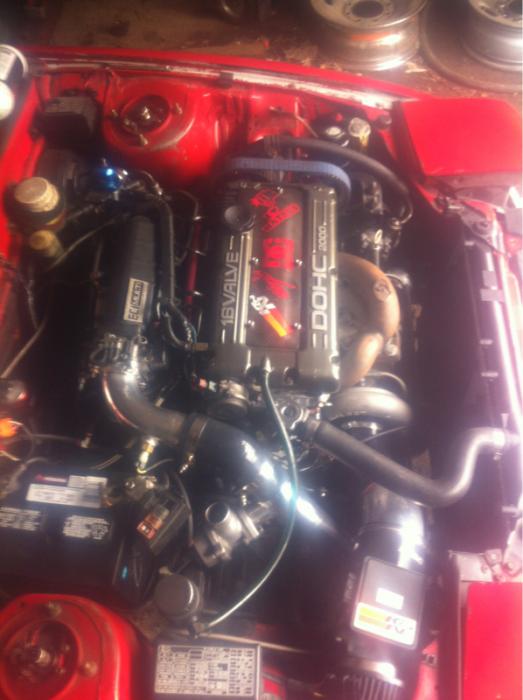

It's been a while since I've posted in here... The talon is just about ready to be broken in. Working some bugs out of it right now.
Been a long time since I've posted or even been on the site! Had to look at your car, looking great man!!! PS might be getting back into a dsm.... a 95 converted to 97 eclipse, only 82k miles on it too! it shall be my baby :p

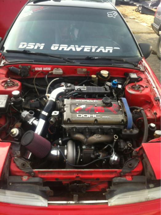

How the bay is looking. Few more bug that need worked out.. Can't wait to get this car back on the road though.. I've missed driving it
