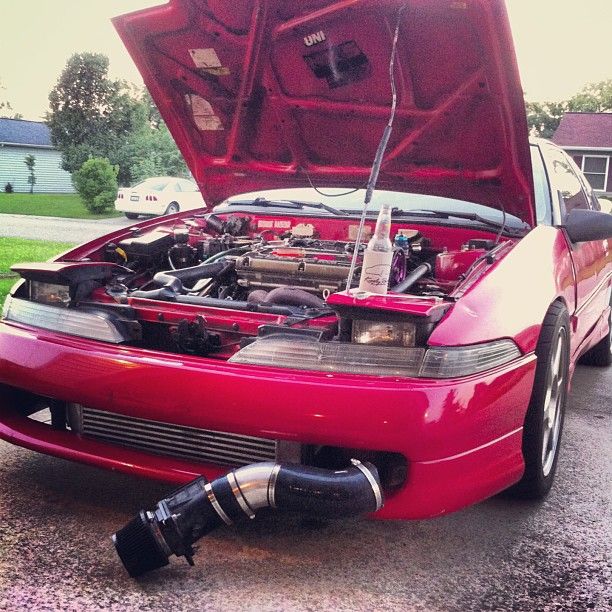

Well I figured it was time to make a build thread of my own. I chose doing a street cat build because I didn't want a dedicated race car. I do want to take it to the drag strip and even try some autocross events locally but I don't want to have to trailer it anywhere.
I bought my 1991 eagle talon tsi from a
Friend of mine, it was in rough shape to be honest but the price was right. It did run but it needed a good bit of maintenance work that he neglected to do. It had a eBay 20g on it and eBay intercooler setup that looked awful tbh LOL. But it ran amazingly well.
I ran this setup for a good while until I got a hell of a deal on a pte 5031E and 680cc injectors. I couldn't pass it up.
I had this setup at 26psi but with the eBay intercooler setup I kept blowing charge pipes, and fixing them was a total pita. So I ordered a vr speed short route intercooler kit. Problem solved.

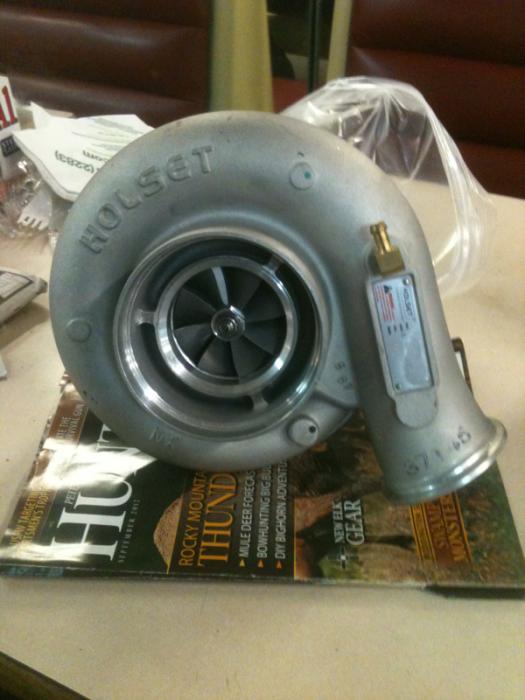

Well I got a package in today...
Hmm I wonder what it is....

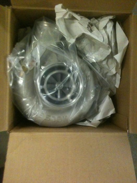

Holset hx40w. (60mm 8 blade compressor wheel)

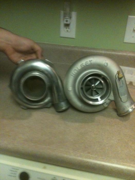

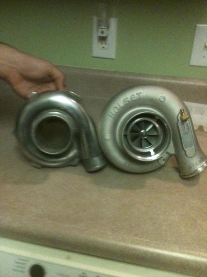

Not much going on.. Ordering the bep housing Friday for my holset.. I did get bored and took my old pte compressor cover and stood it next to the holset.. Huge difference

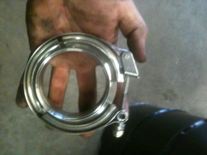

And my vband assemblies finally came in. So I have all my stuff to do the cat back on it
Slowly but surely it's getting done.

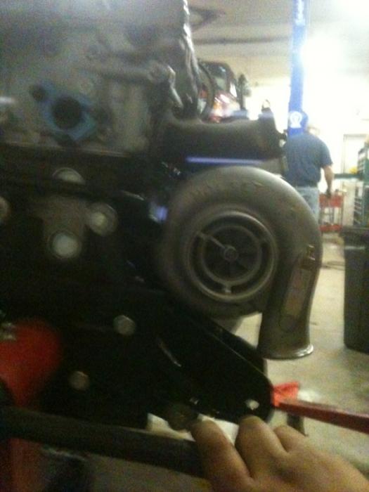

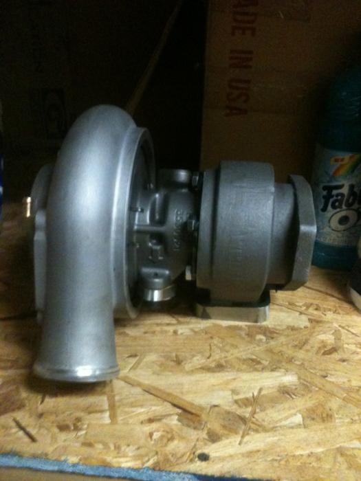

Ordered my bep 55ar mitsu turbine housing. Will be in Tuesday.. I'll def post pics up when it gets here. I also ordered a new oil pan as well since I had to take mine back off to have the 12 an oil return fitting and the old pan is pretty bent up where it bolts to the block. I have a feeling it'll be a source for a leak later on and I'd rather just buy a new one.
I got something in the mail a day early LOL
This thing is heavy for its size. I was amazed how heavy it is. So I'll have to get it bolted up to the holset tonight when I get home.

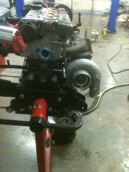

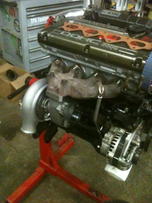

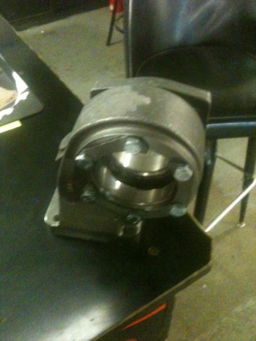

Here's some more progress pics I took:

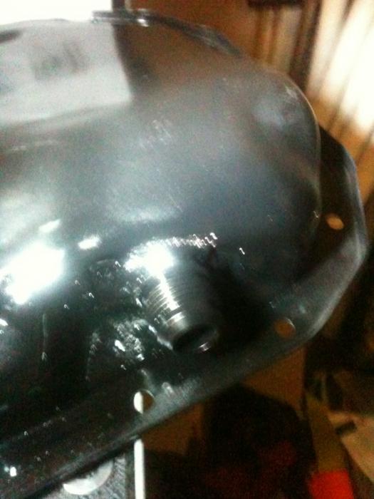

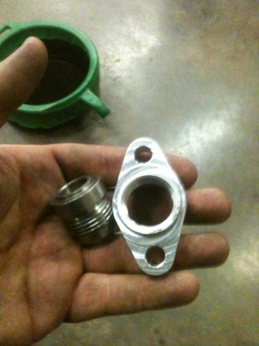

Fittings to start oil return line
Bung welded in to the new oil pan and painted

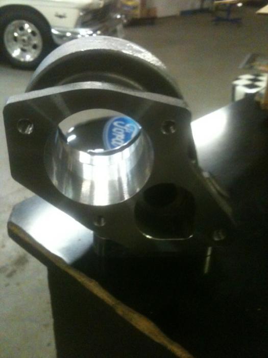

Bep .55ar housing bolted up

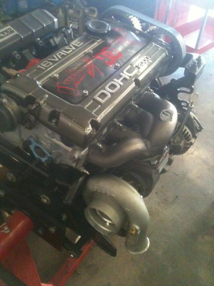

I Just had to see what it looked like mounted up LOL.. Need to order my fp race exhaust manifold now..

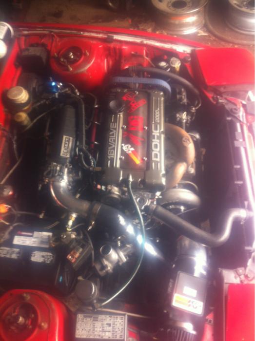

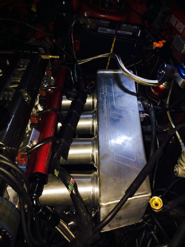

No real updates. Probably going to order my oil feed line tomorrow. I need to hurry up and buy my fp manifold here soon while it's on sale. I did however take these pics from today when I "modded" my water pipe to clear the compressor housing.
