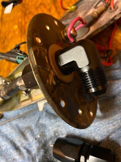

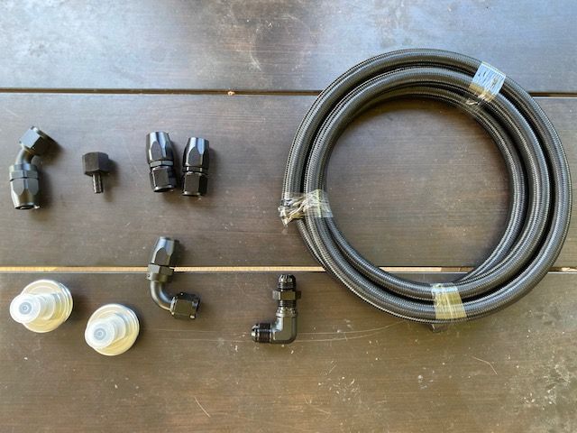

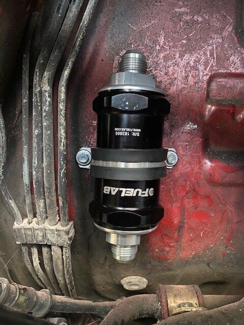

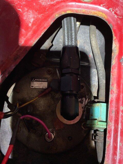

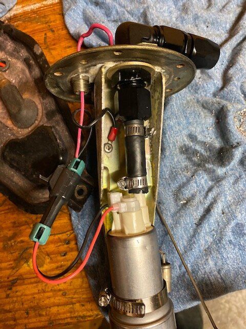

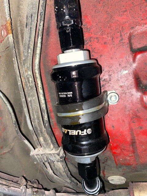

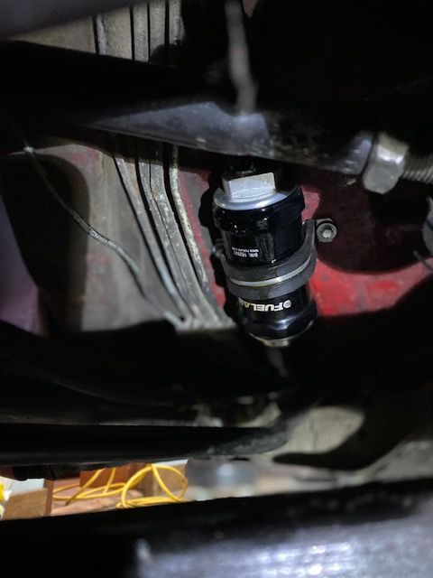

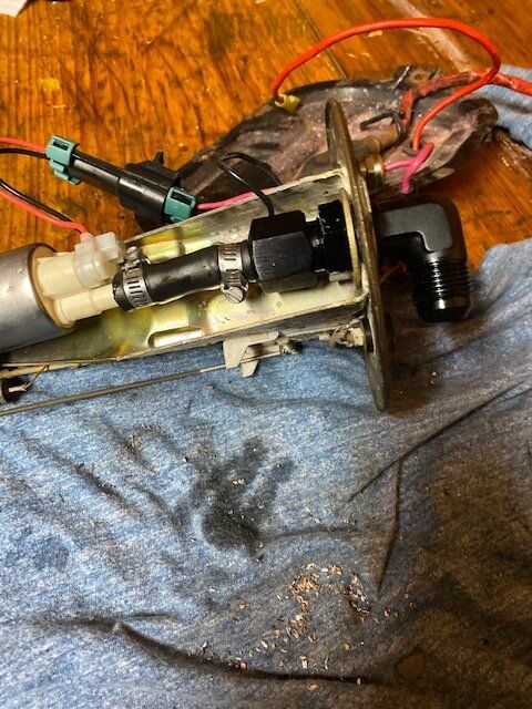

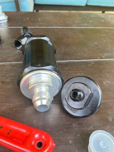

I redid my my fuel feed with 10an line lines and fittings in order to get rid of this lean fueling issue from 3-4k. Kevin Jewer has been working with some of his customers on this weird phenomenon and apparently the large the line the better. I also relocated my fuel filter to right above the rear sub-frame.

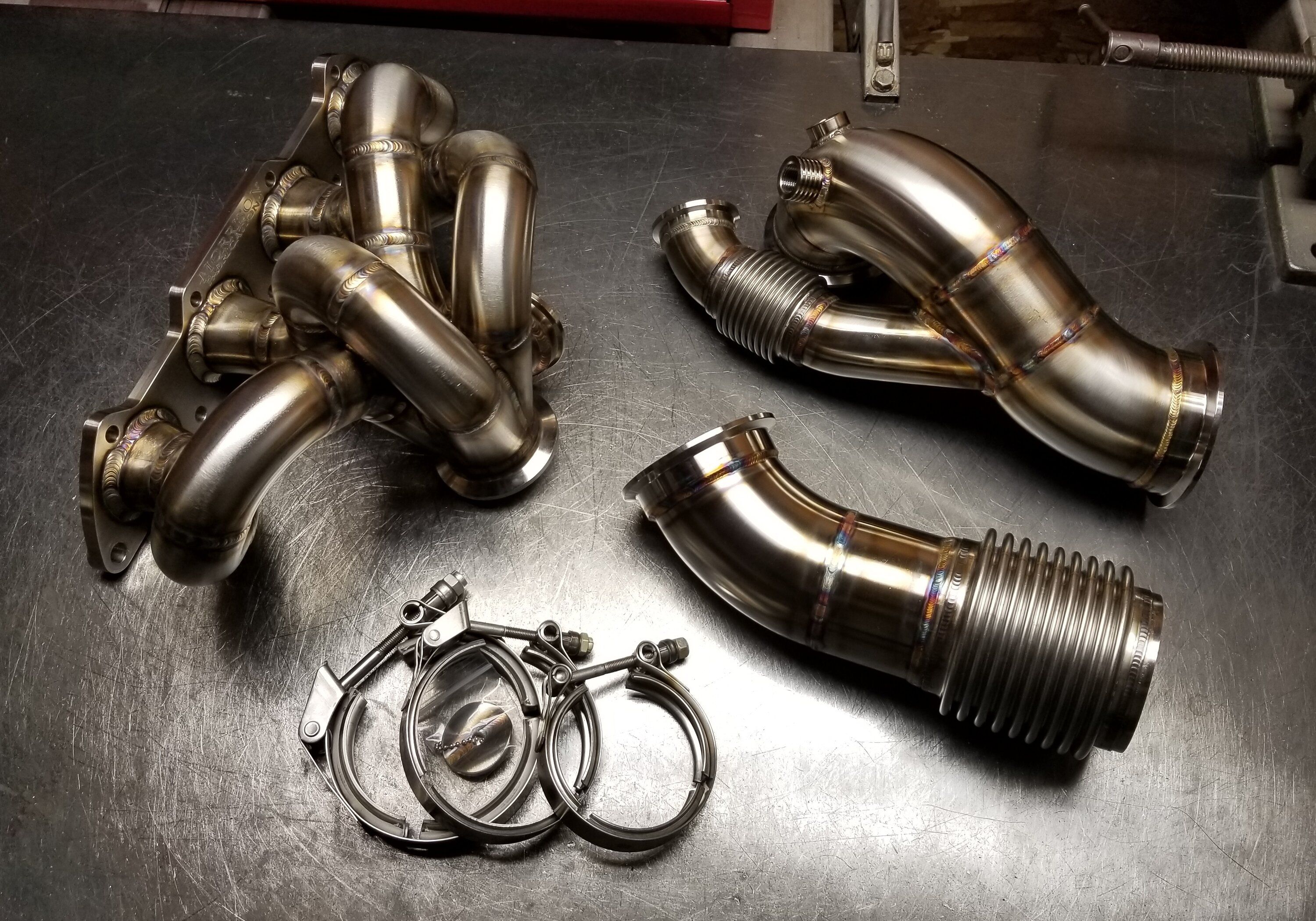

I think that little flex section on the outlet of the wastegate is a really good idea.
These parts look really good all around.
If I ever wanted to not have an external dump anymore, I'd sure go for this.
I'll be real interested in seeing how much clearance you have to the back side of the radiator once all this stuff is installed. I guess I mean, what kind of fans you can fit there. On mine, I have a good sized fan on the passenger side, but a very small fan on the driver's side, and even then there is a fitting on the wastegate that barely clears the fan motor on the back side of the small fan.
Also, I always appreciate a good quality photo, and this photo is very good when you look at it full size (3000 x 2101 pixels).
Hmm, "search google for image" doesn't find this picture anywhere, and I don't see it on the Morrison Fab web site. Which kit is this?
Its the hot parts kit, I see under the kit link on the homepage page for morrisonfabrications.com. I'm looking at the same one.
Well when I click that picture it takes me to the Morrison Fab Instagram post for it, and there they call it a "DSM Xona V-band with a recirculated hot parts setup" and it doesn't say whether it is a small runner or large runner. But that description is what I was looking for. When I drill down through "Our Products, DSM, Manifold and Hot Parts - I don't see it there! They've got 17 kits there! Wow. So maybe this is a brand new kit and Vegas is the first person to get one?

That picture is of my actual kit, to my knowledge, that shipped today. I plan to run dual pusher fans on the other side of the radiator so no clearance issue for me :)
