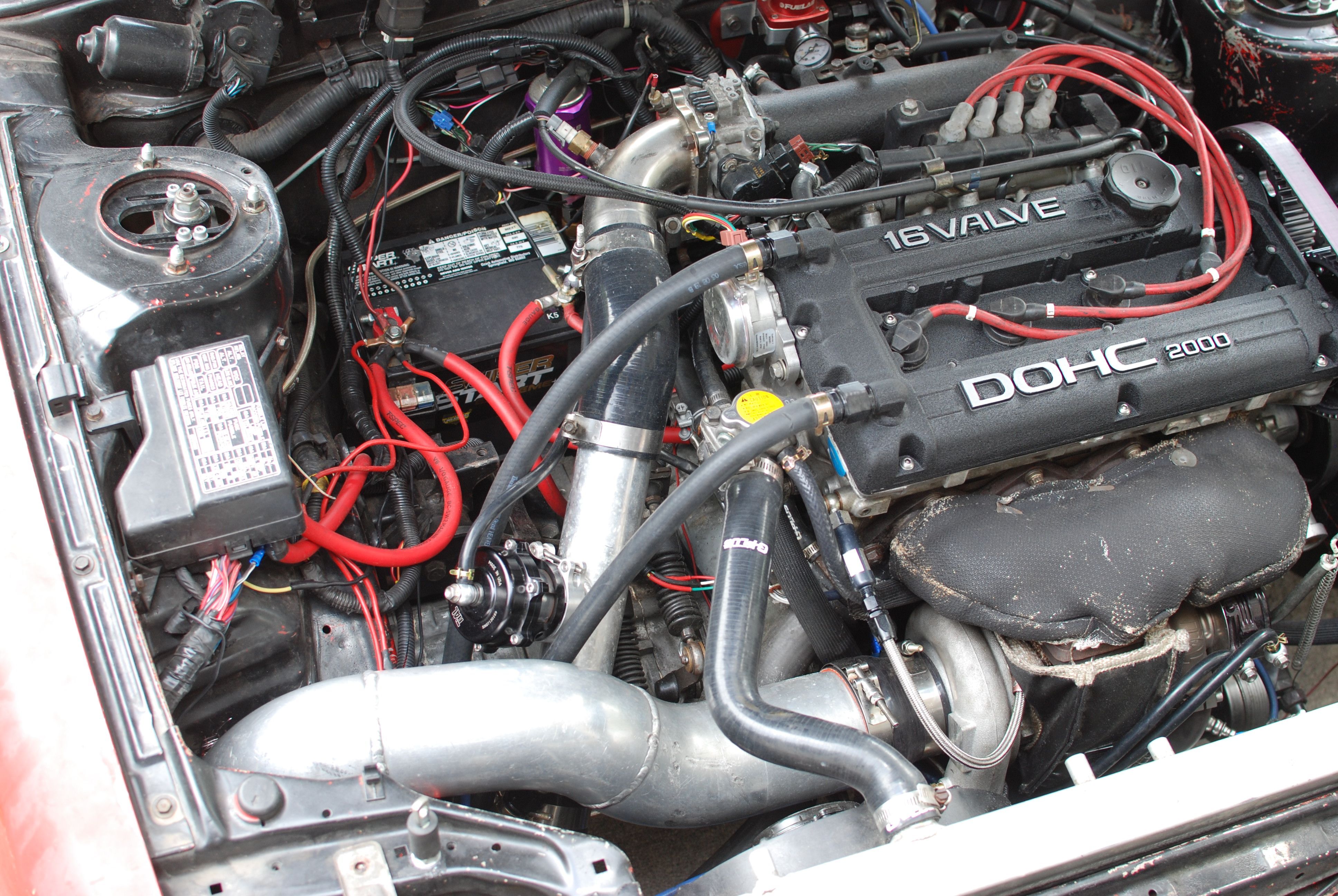

It's all worth it when you feel 500awhp with the turbo whistling :)

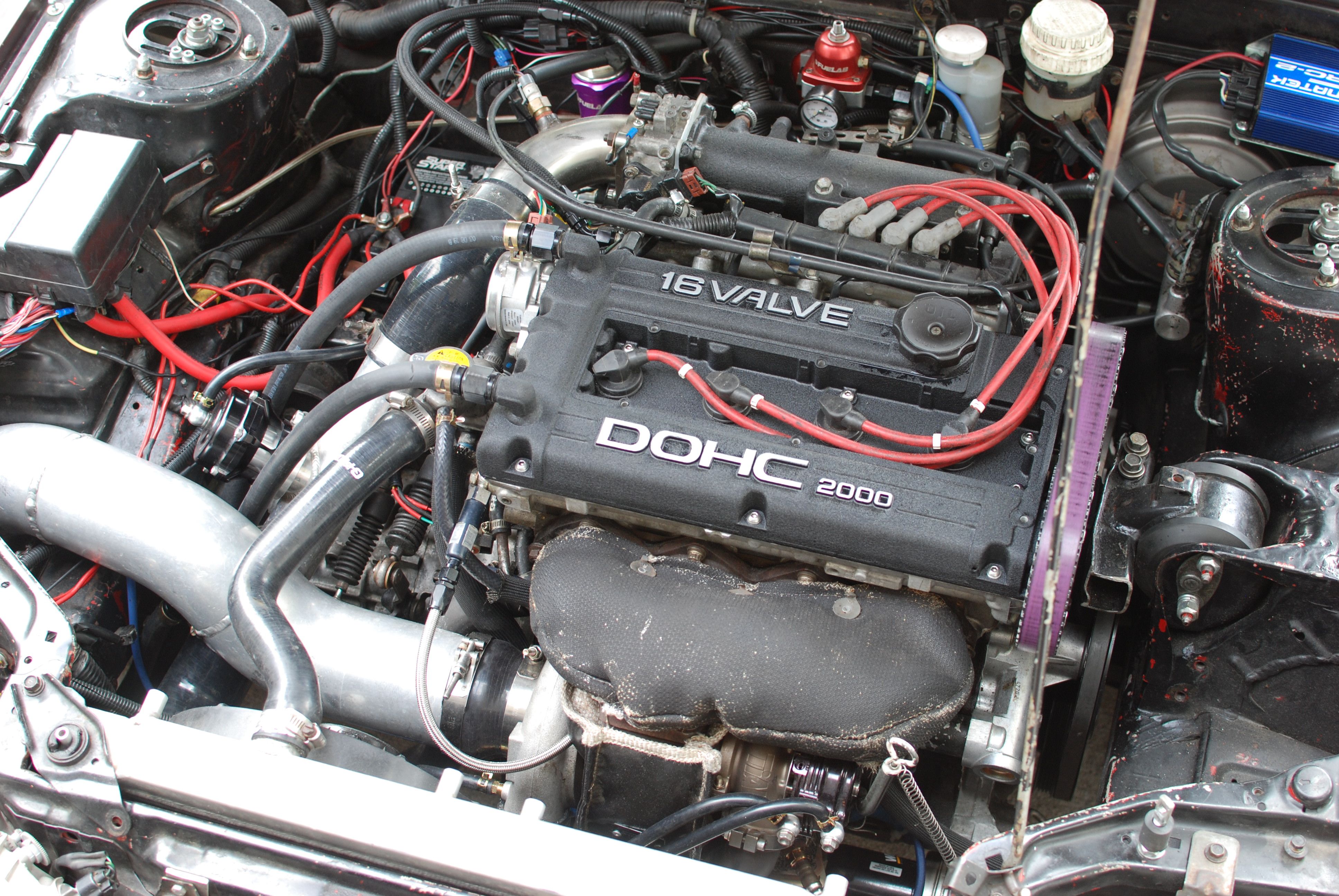

I've been real busy making changes to the talon and getting it remote-tuned. It's currently on 34psi and out of control. Will be maxed out and done within the week.

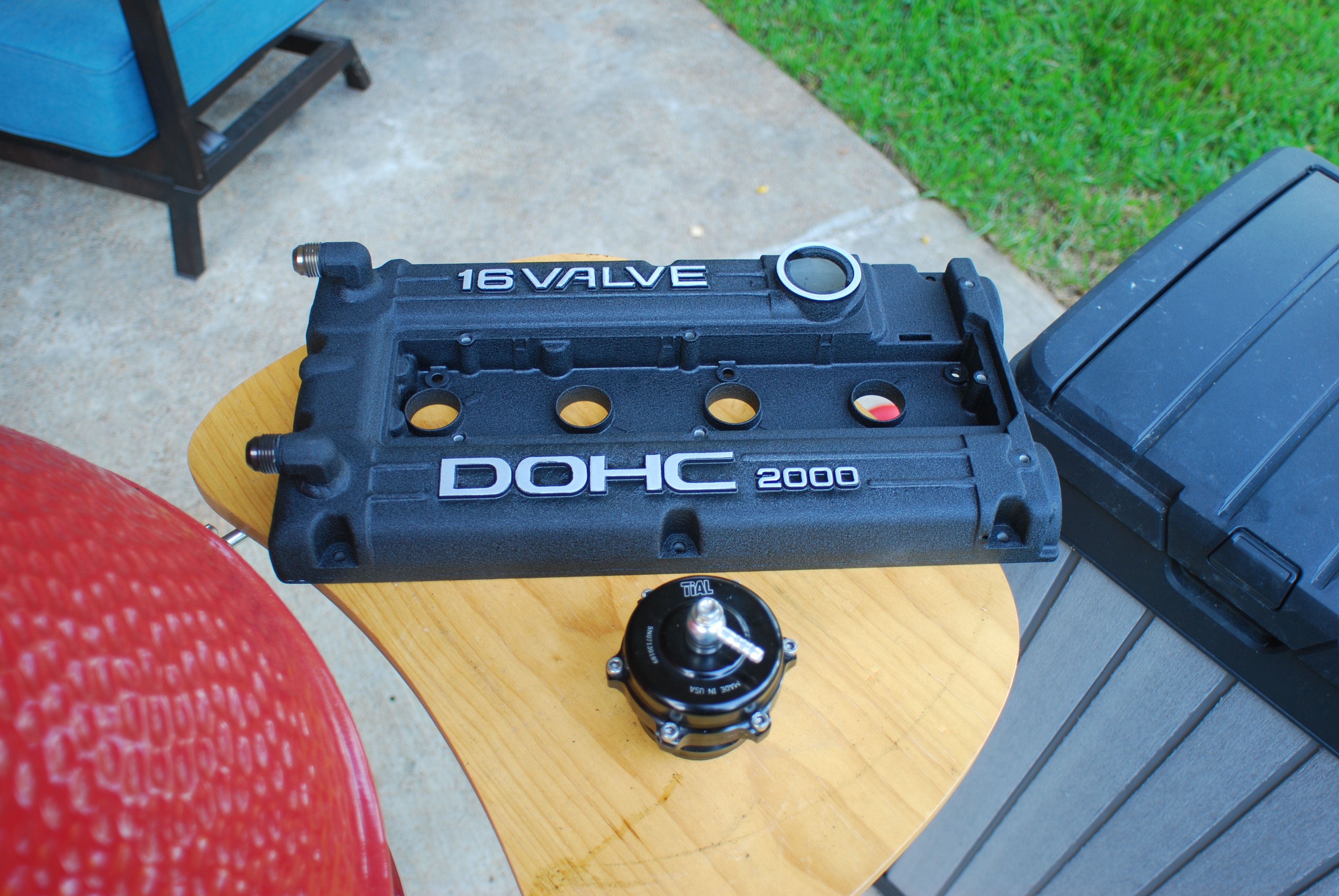

I decided to revamp my pcv/ventilation setup. I sent off a spare valve cover to get powder-coated with dual 10an outlets to a Gamble catch can that I relocated to the passenger wheel well area. I got a 10an bung welded onto the new cool-air-intake pipe for some vacuum. I also traded my pink TIAL bov for a black one. Going for rugged black look.

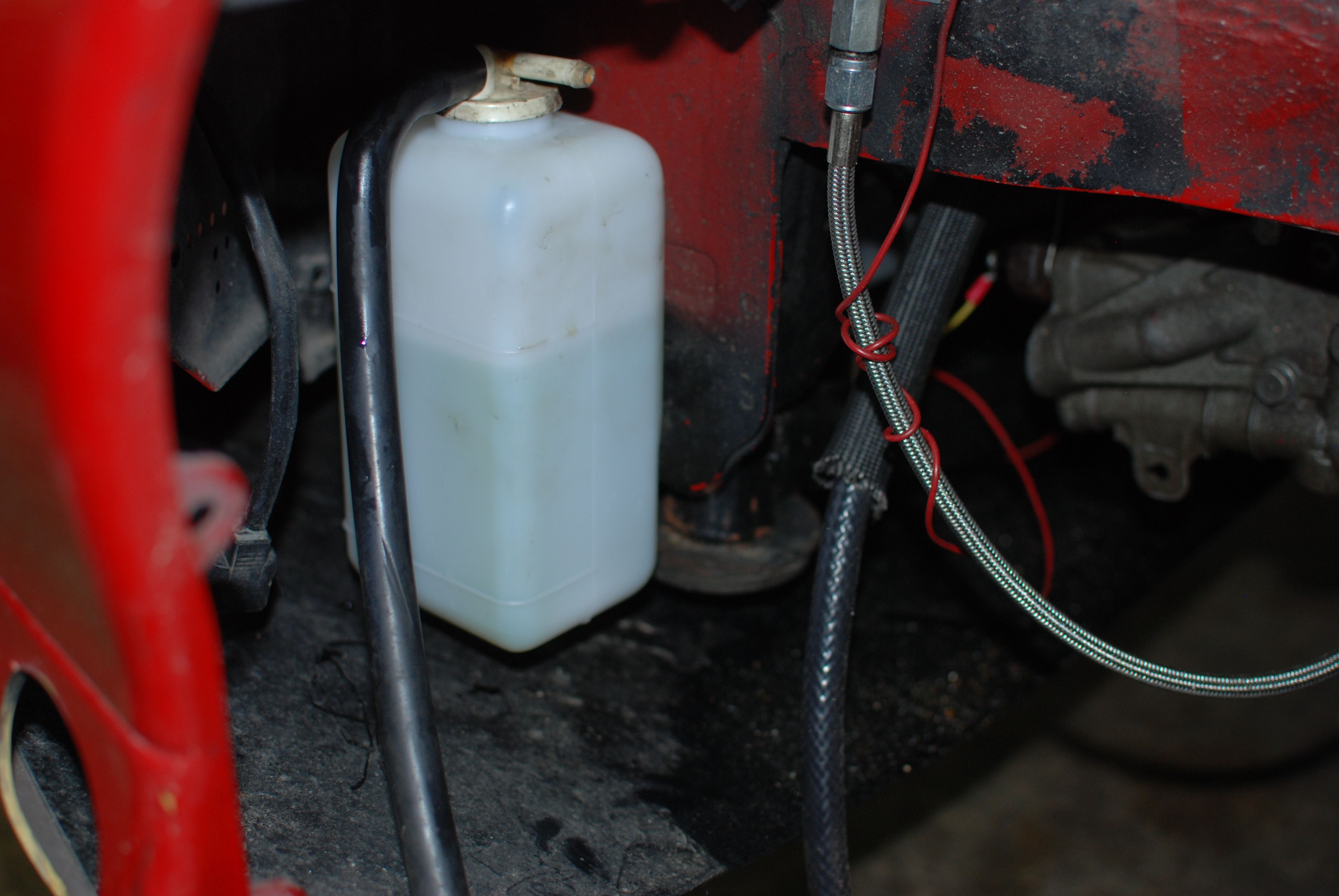

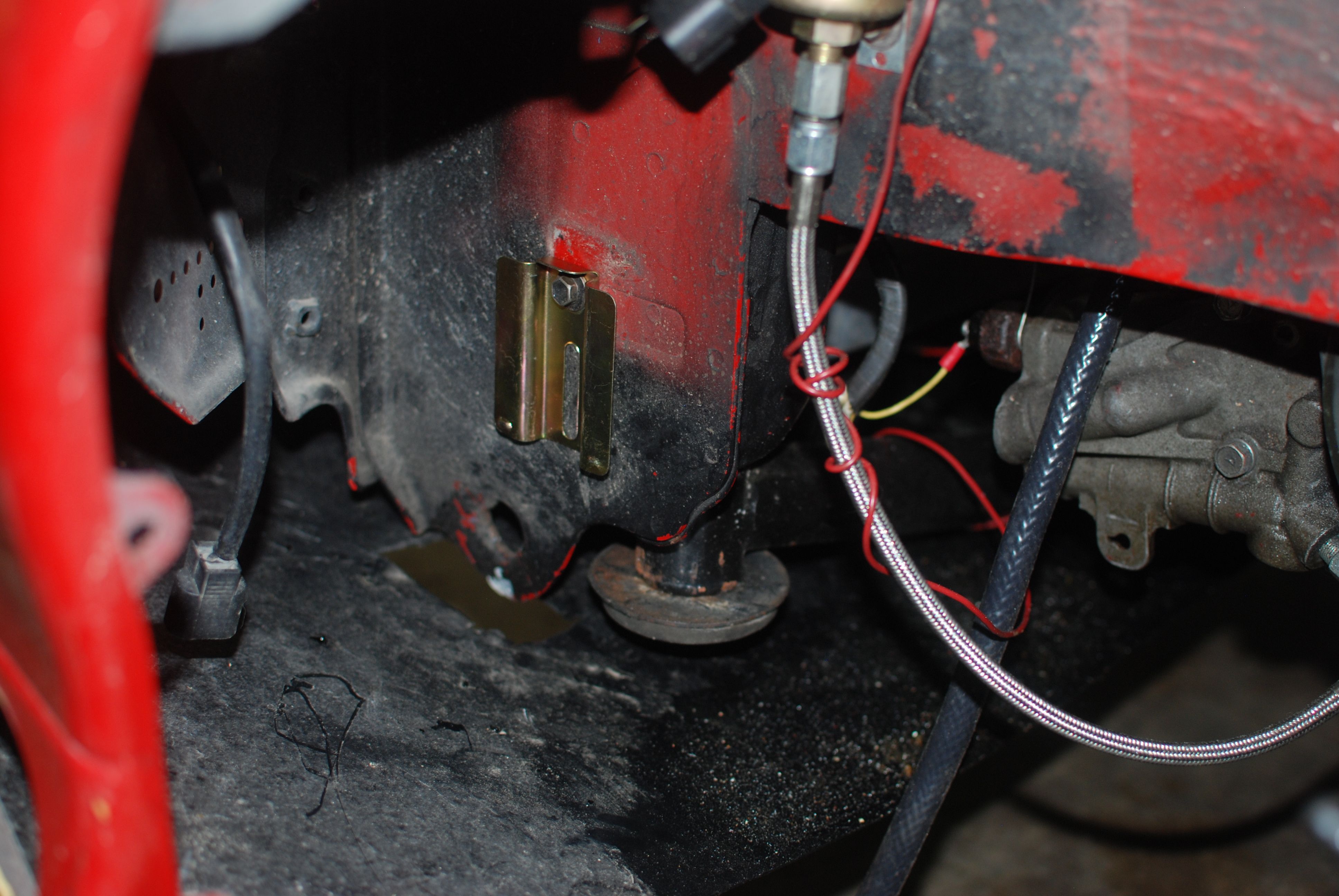

I bought a dinky little coolant overflow bottle off Ebay for $16. Took it a month to get here, but I'm really happy with it. I relocated it to a perfect spot where my broken wiper-fluid reservoir used to be. I love relocating things out of sight
Nice man. Looks really good and I KNOW the feeling. Its a blast! :thumb:

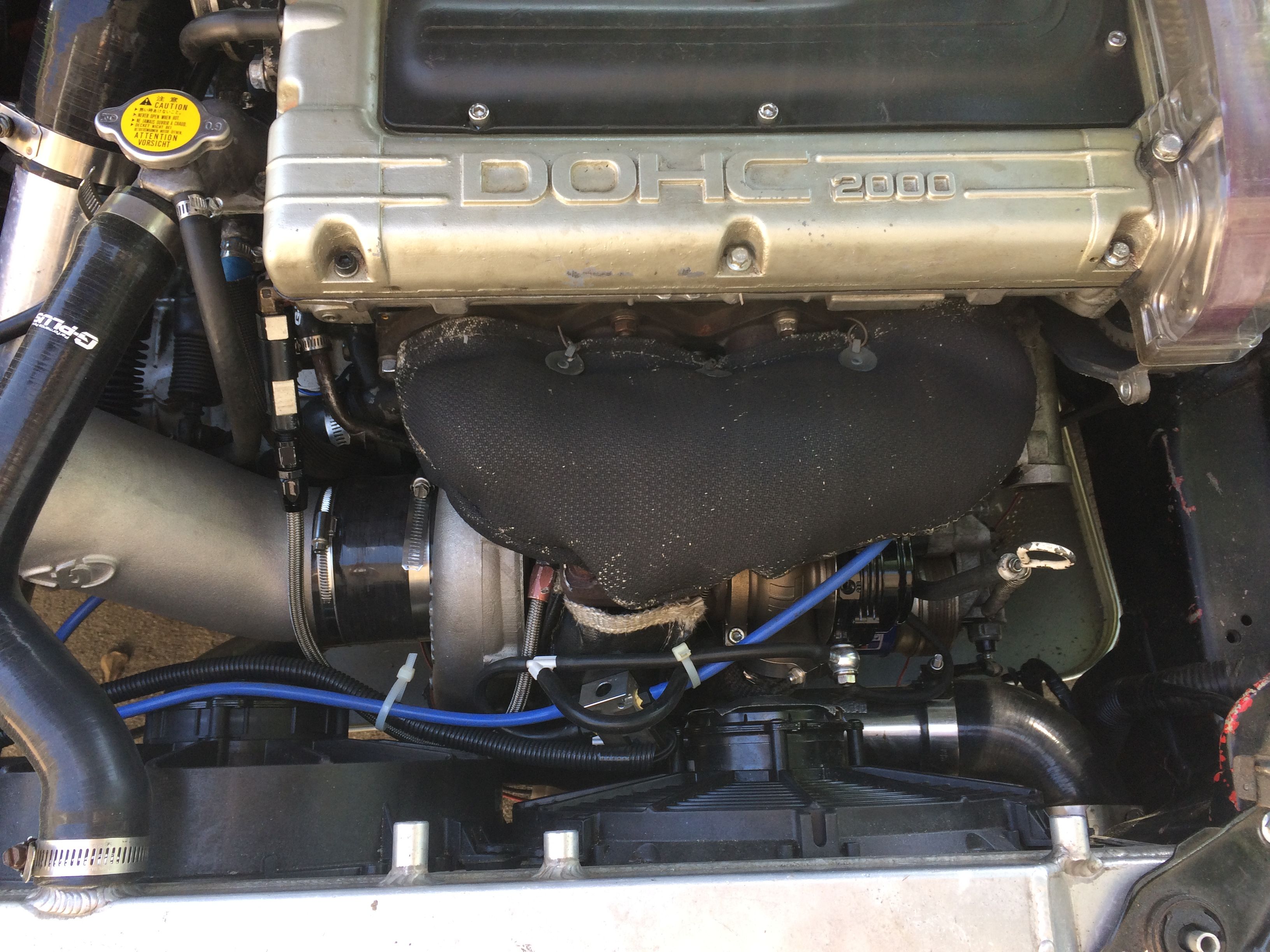

Hey Vegas, what material is that you used for your ducting? Also I’m looking to get the same turbine blanket for the fp30 housing, can it be installed with the turbo on the car? Again I love your car, very motivational thread for sure:hellyeah:
It's called ABS. here is the video that inspired me:
The turbo blanket can be installed with the turbo on. It's very easy. Both of my turbo blankets SIGNIFICANTLY reduce under-hood temps. However, the manufacture recommends not running it on our turbos as oil can leak from the turbo and build it up in the blanket and catch on fire. I always wondered why they made that blanket for the fp30 turbos then said you shouldn't use it....
Thanks for the kind words about the car. It's coming along pretty well now :)
Thanks! I was cutting up the original ductwork plastic to make a bottom and side plate but the ABS looks really easy to work with.
Good info! :thumb:
My Subaru neighbor told me this is a problem with Subarus. On our cars, I don't know, I suppose it's a lot easier for inspection purposes to not have it wrapped. I chose to not wrap mine because my turbo housing isn't fancy stainless, it is cast iron. So not wrapping it should make it less crack prone.
