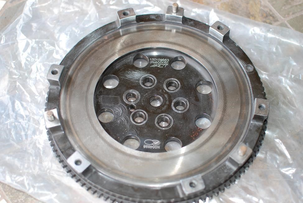

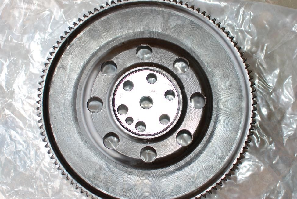

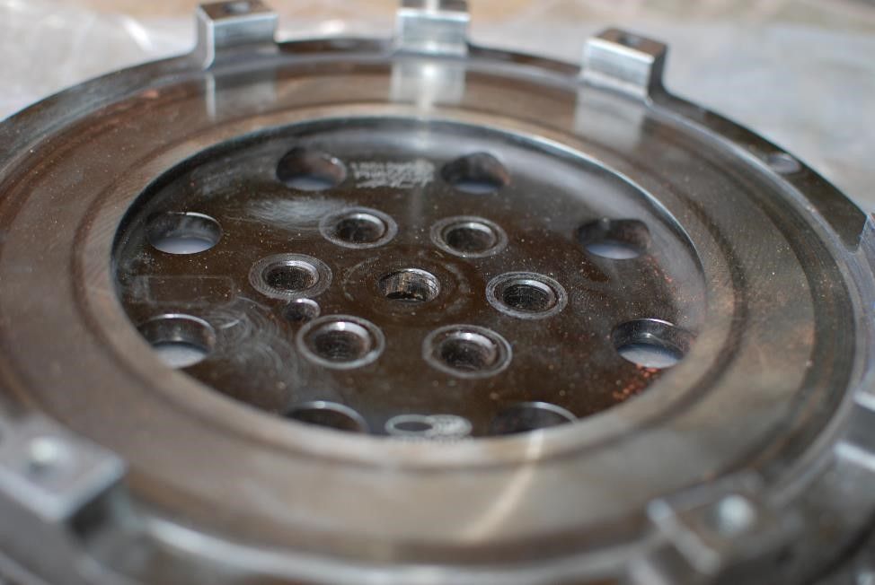

Im not surprised at all. I even remember him having engagement issues with THAT exact flywheel when he installed his SouthBend clutch. Man I do NOT miss being friends with that dude
It was for sale as "New" then when I got there I noticed it was used. He said he put a couple miles on it then went with a different setup. Of course, I install the thing then have to go through the trouble of taking all that shit back off and paying for a resurface because of that guy. This was a year later and I moved to Houston already so that was the end of that.

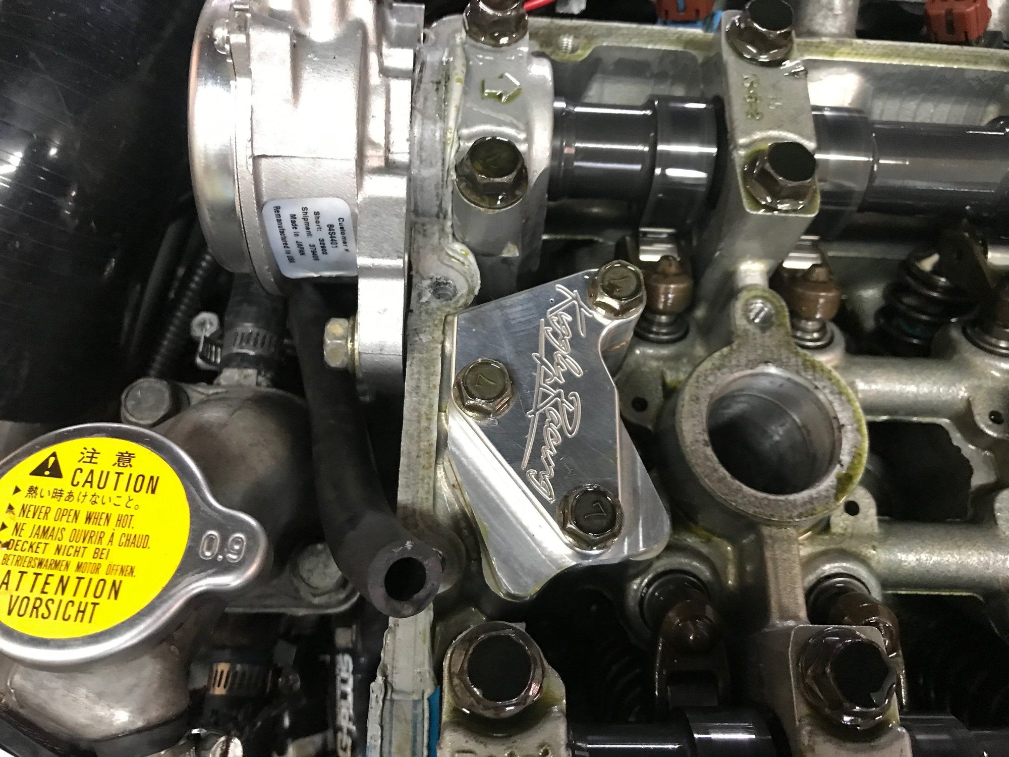

Well, I have the car running really well right now. The bucking/sputtering issue just went away randomly and to this day I don't know what it was. I sent the ecu and injectors (hi-z 1650s) out for servicing and both came back fine. So far, I've put 400 miles out of the 700 miles South Bend said I needed to break-in the new clutch. The car is currently switched to gasoline for convenience. I can't wait to turn up the boost on this thing; I know it's going to rip. I wound up installing the Kiggly HLA pressure regulator.

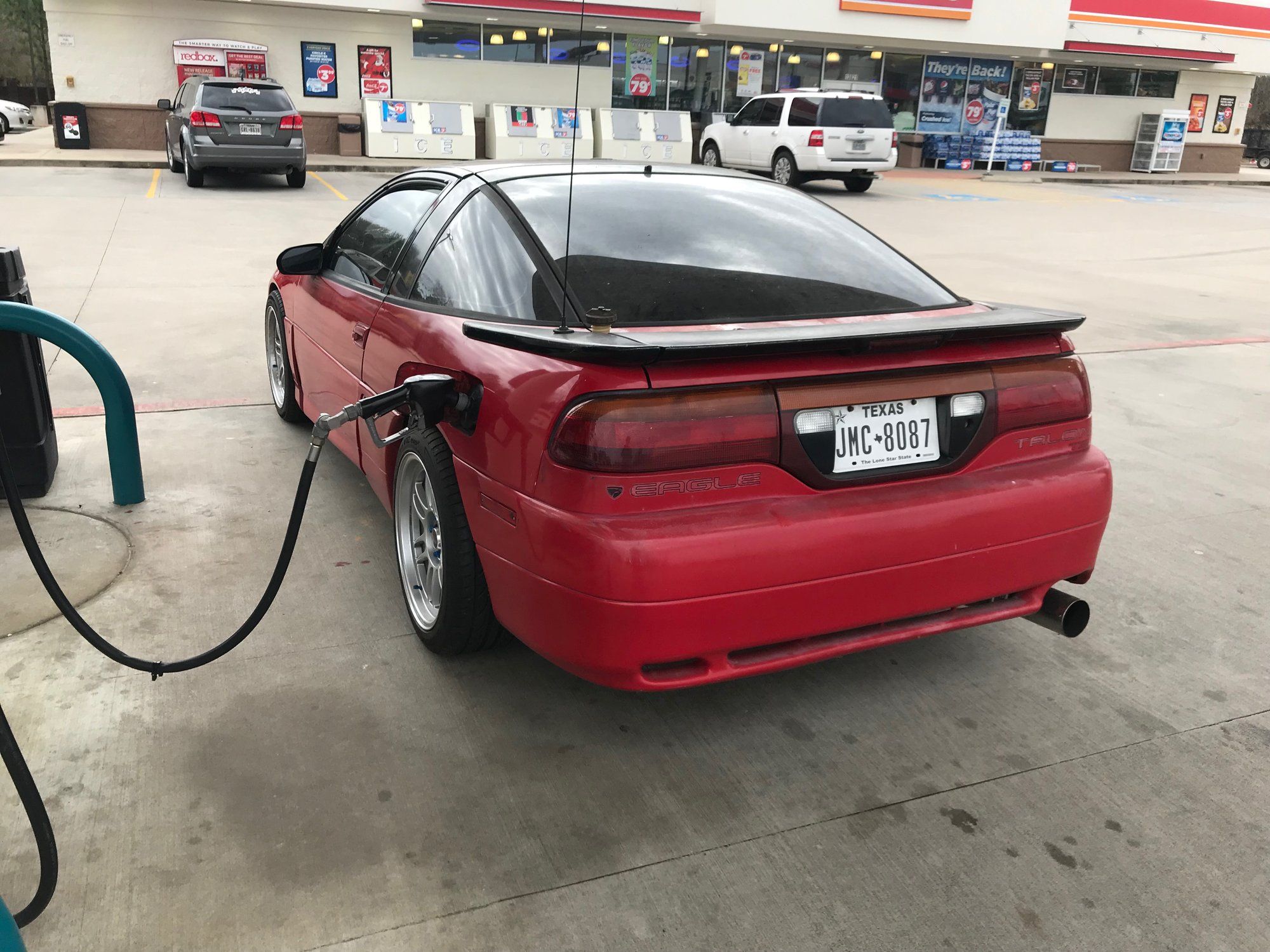

I've put several hours lately into trying to find a way to buy E98 for reasonable $ - the idea being to avoid "winter blend" E85. I don't think I'm having an actual problem with it, but it annoys me that the 30% of it that is gasoline, nobody knows anything about the gasoline, like, what octane is it? Probably 85? 87?
I would have thought that in Houston where you are, there would not be a "winter blend". But I see on your post #88 it says "Minimum 70% ethanol" just like what I see here.
Have you ever measured the ethanol % of your E85 there? Is your car flex fuel?

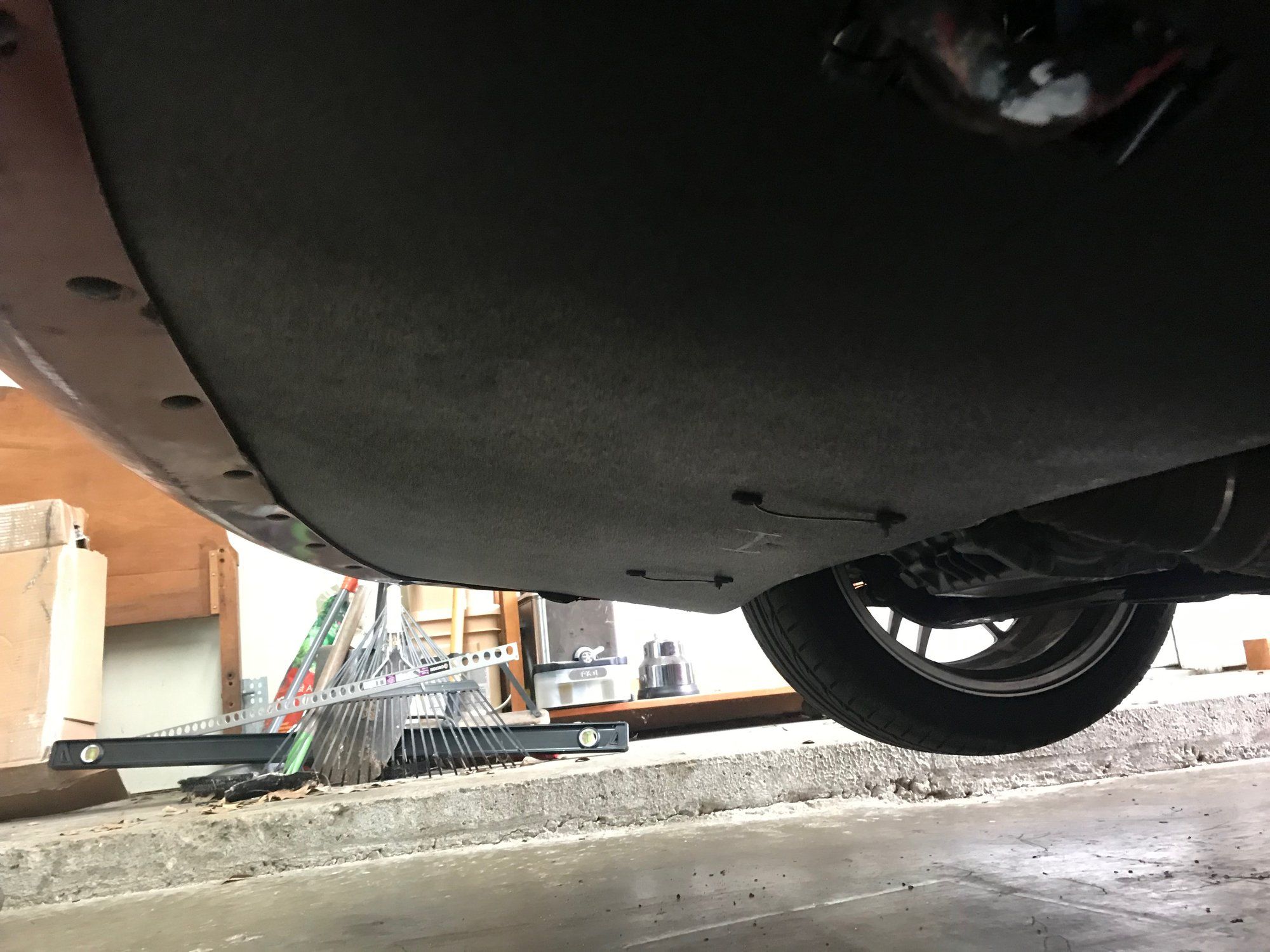

I've been happy with my little custom-made under-tray I made for the talon. I had to cut some holes into the tray put in some rubber grommets and secure it to the crossmember with zipties. I don't know if it helps but I imagine it isn't hurting. I have a pretty robust radiator/fan/shroud system now so we will see if I ever have problems in the Texas summer.
