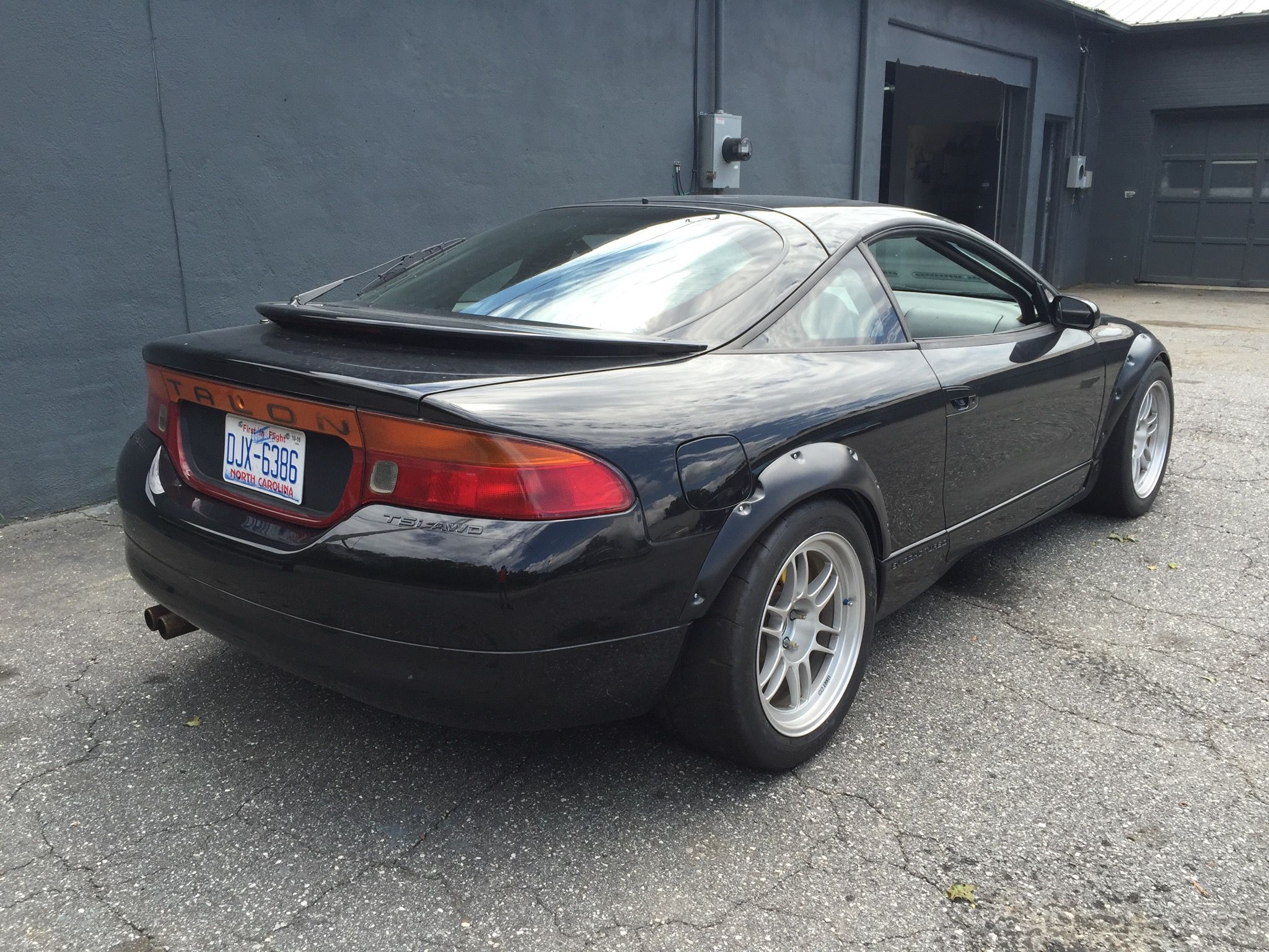

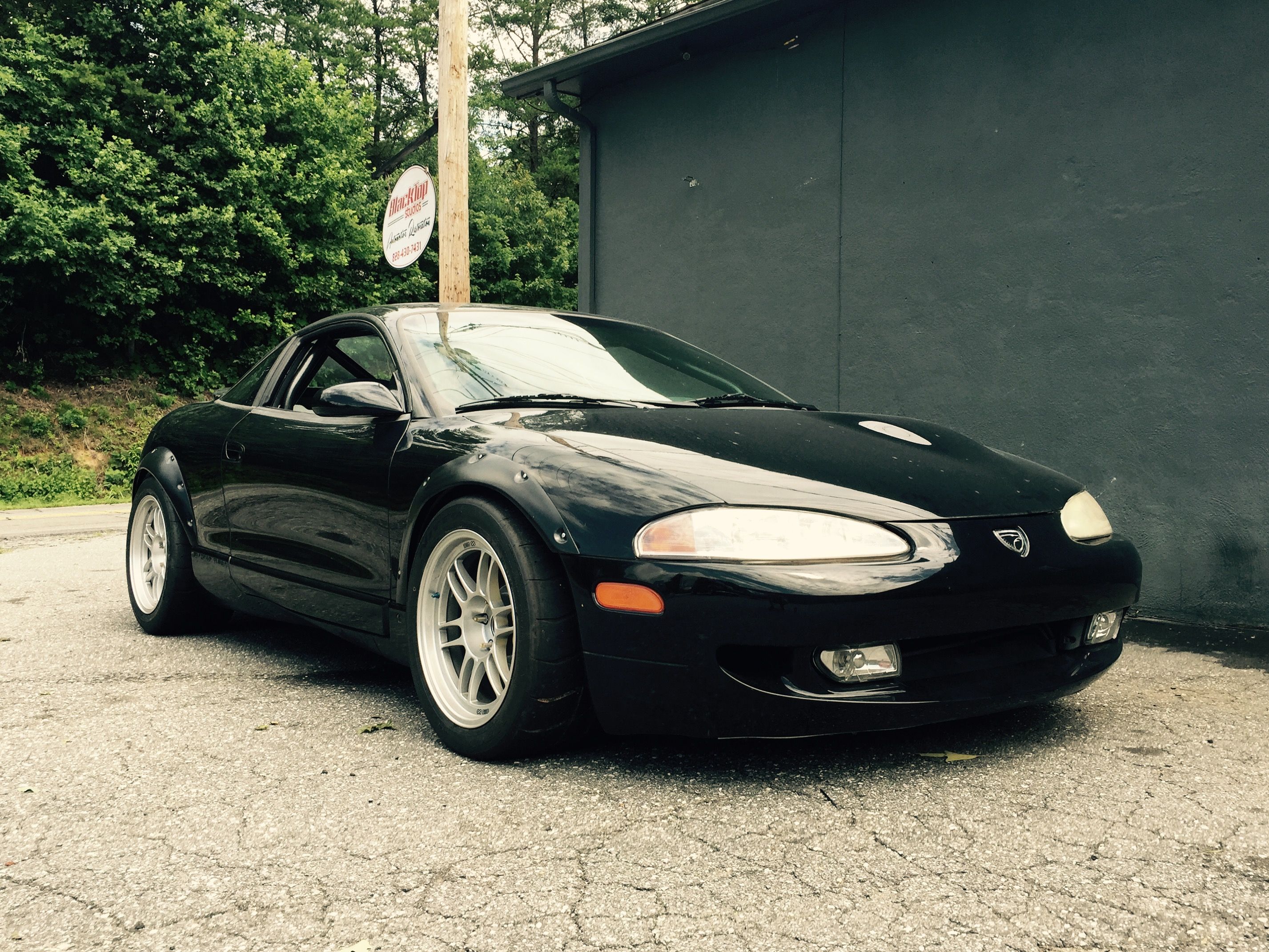

My name is Roger and I drive a 1995 Eagle Talon TSI AWD, I’m Talons 2nd owner and purchased him way back on July 11th, 2015 in Seattle, WA. He was bone stock when I got him and the previous owner bought him new off the showroom floor. So what did I decide to do? Turn him into a racecar of course!
Some of you may say not like that I took a now rare, bone stock 2G and hack it up, but… It’s not every day you get to build a car the way you want w/o having to worry about other people’s mods.
Here’s some pics of the day first got him :

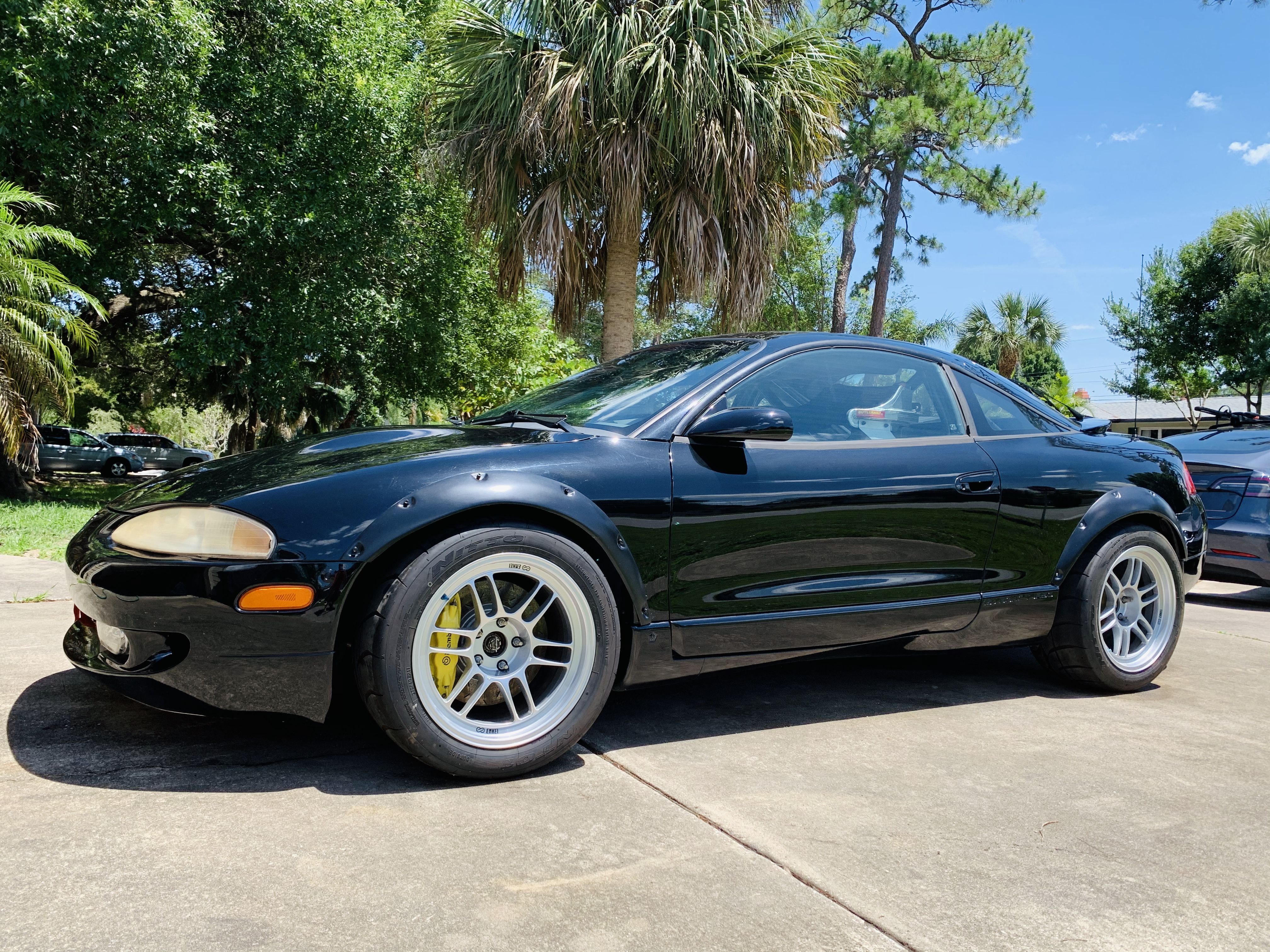

Two of the first things I wanted to improve on Talon were the brakes and wheels.
Brakes:

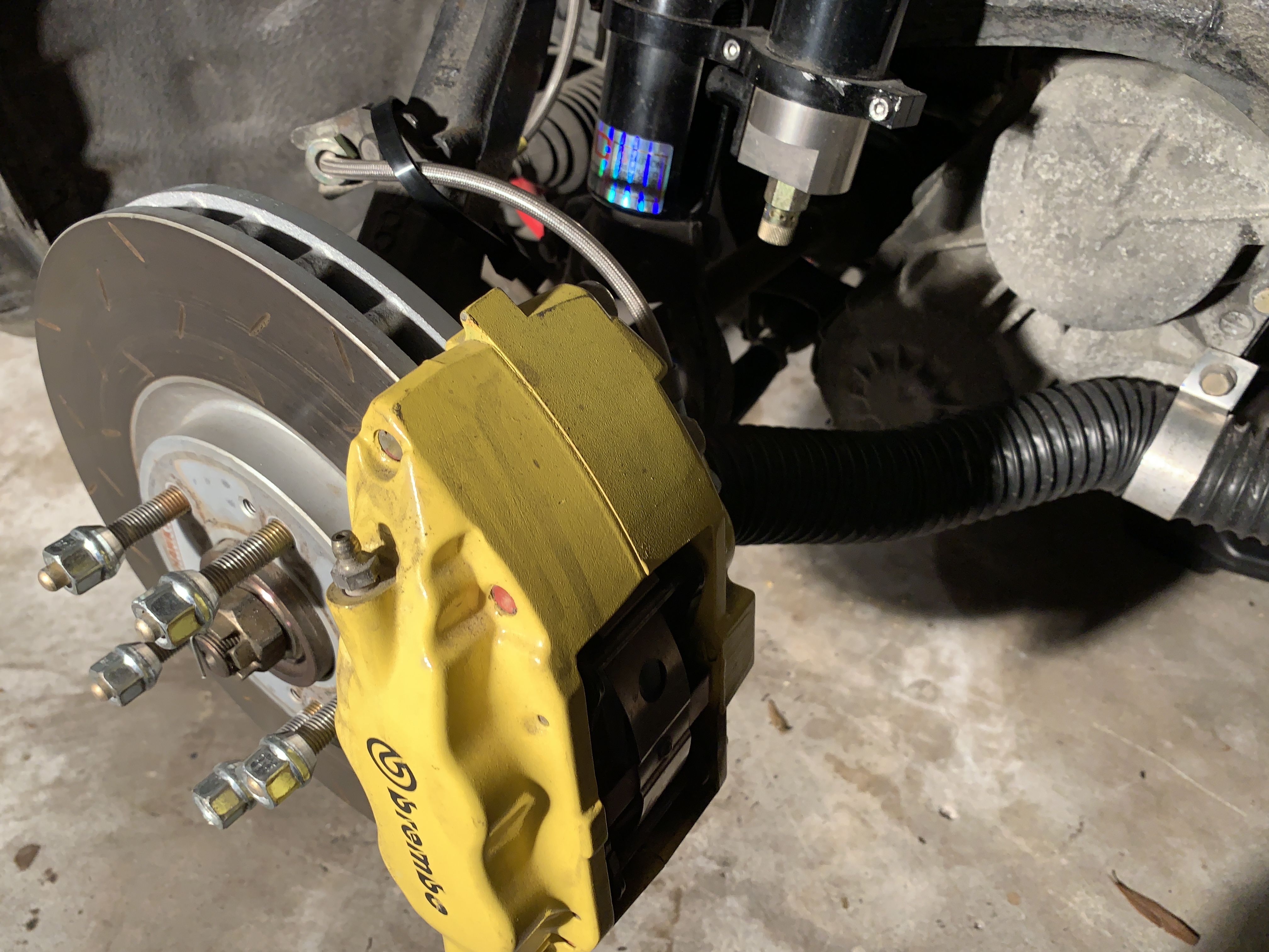

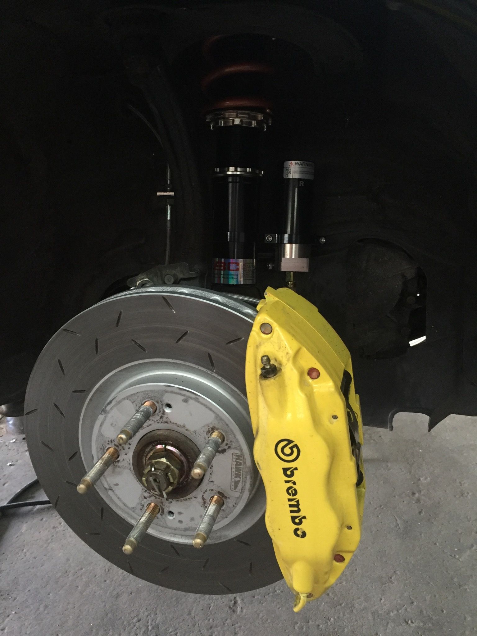

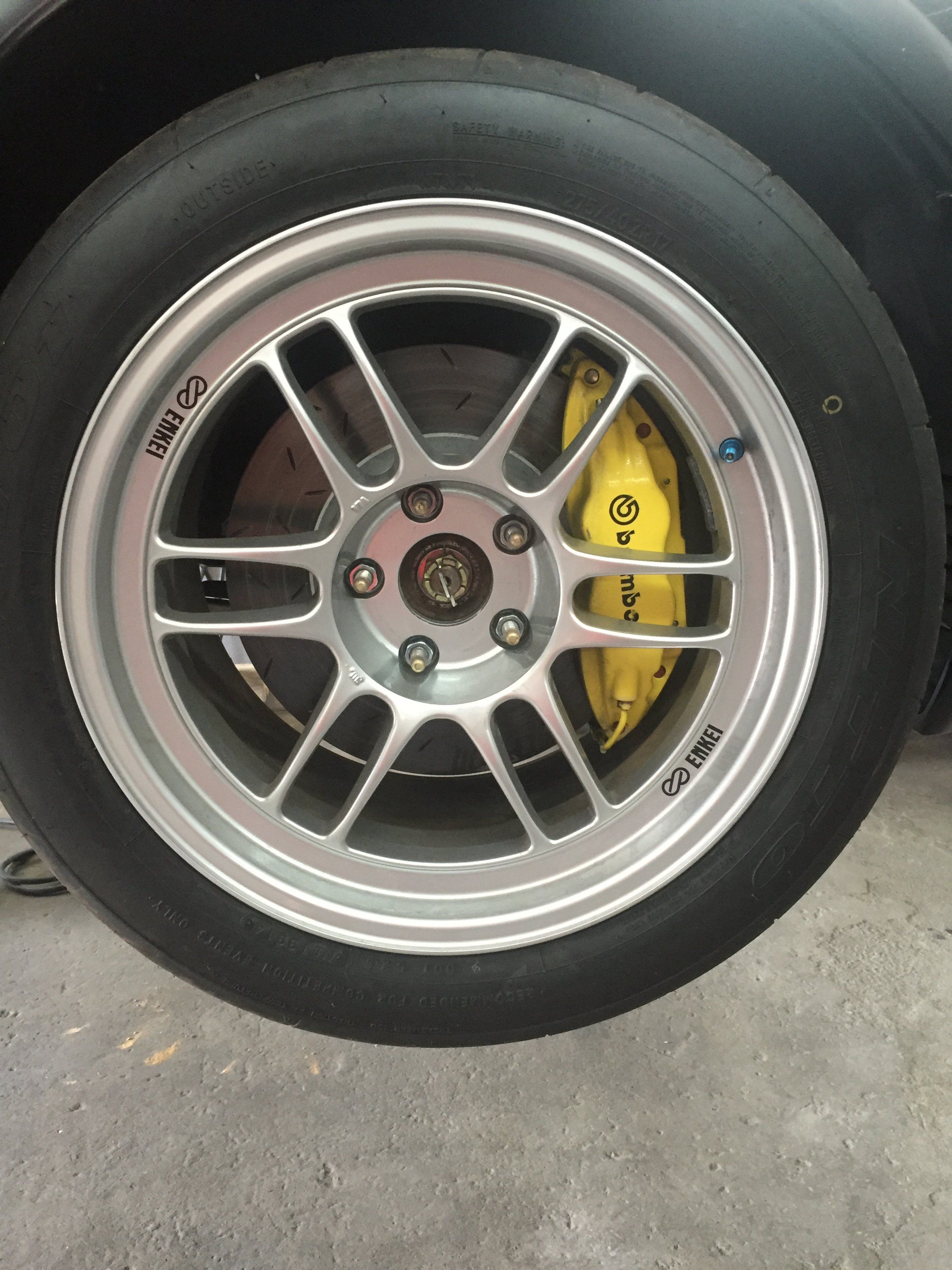

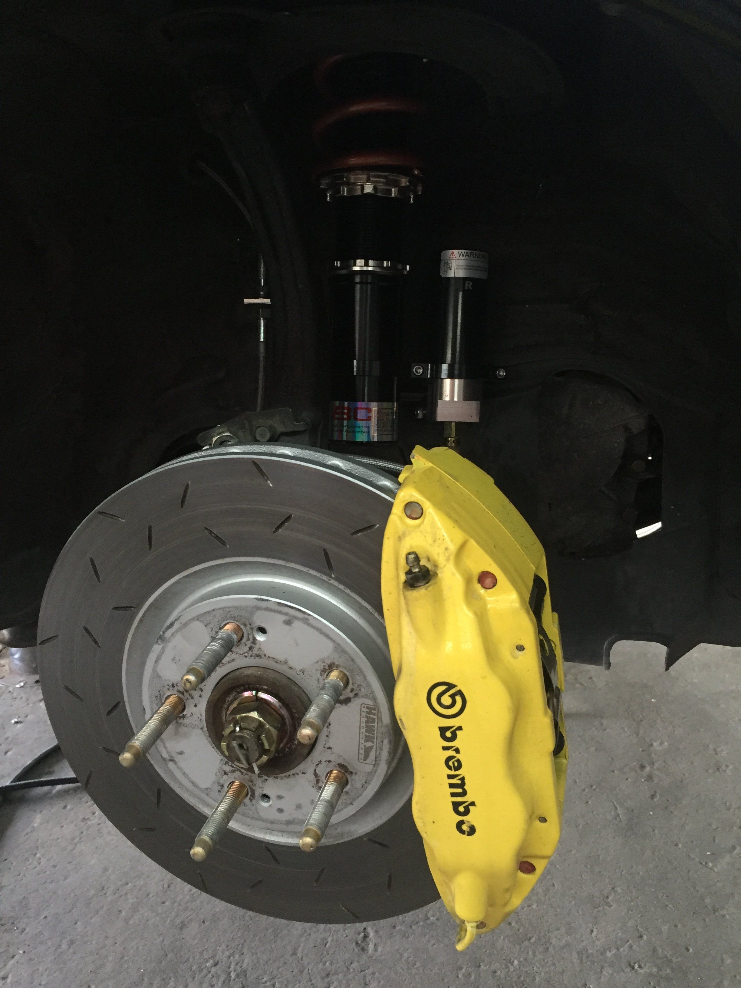

For brakes, this meant Galant knuckles, front/rear Evo VIII/IX Brembo's, new rotors, stainless steel brake lines, EBC Yellow Pads, and a set of Enkei RPF1's! @ec17pse just happened to have a set of knuckles available so I snagged a pair and made a new friend to boot. :) As a measure of safety and since it's already torn apart, new OEM front wheel bearings along with ARP wheel studs were installed.
I can't remember where I found the Brembo's, but the Seller stated they had been rebuilt and repainted. After I received them I quickly realized that they may have been rebuilt but it was years prior and the paint job was garbage. Thank you people internetz for being so very honest:notgood:. These will get rebuilt at some point in the future but for just getting the car broken in they will have to do.
Having heard that the Brembo's have a tendency to overheat on track days when using a bigger / stickier tire, some EVO brake ducts were installed. I can't remember who made these but you should be able to find them if you Google around. These provide direct cooling to the rotor, pad, and caliper and they've been plummet to some NACA ducts underneath the nose.
Lastly, in order to save some weight and because I like to look death in the eye, I made the decision to delete the ABS system.
Wheels:

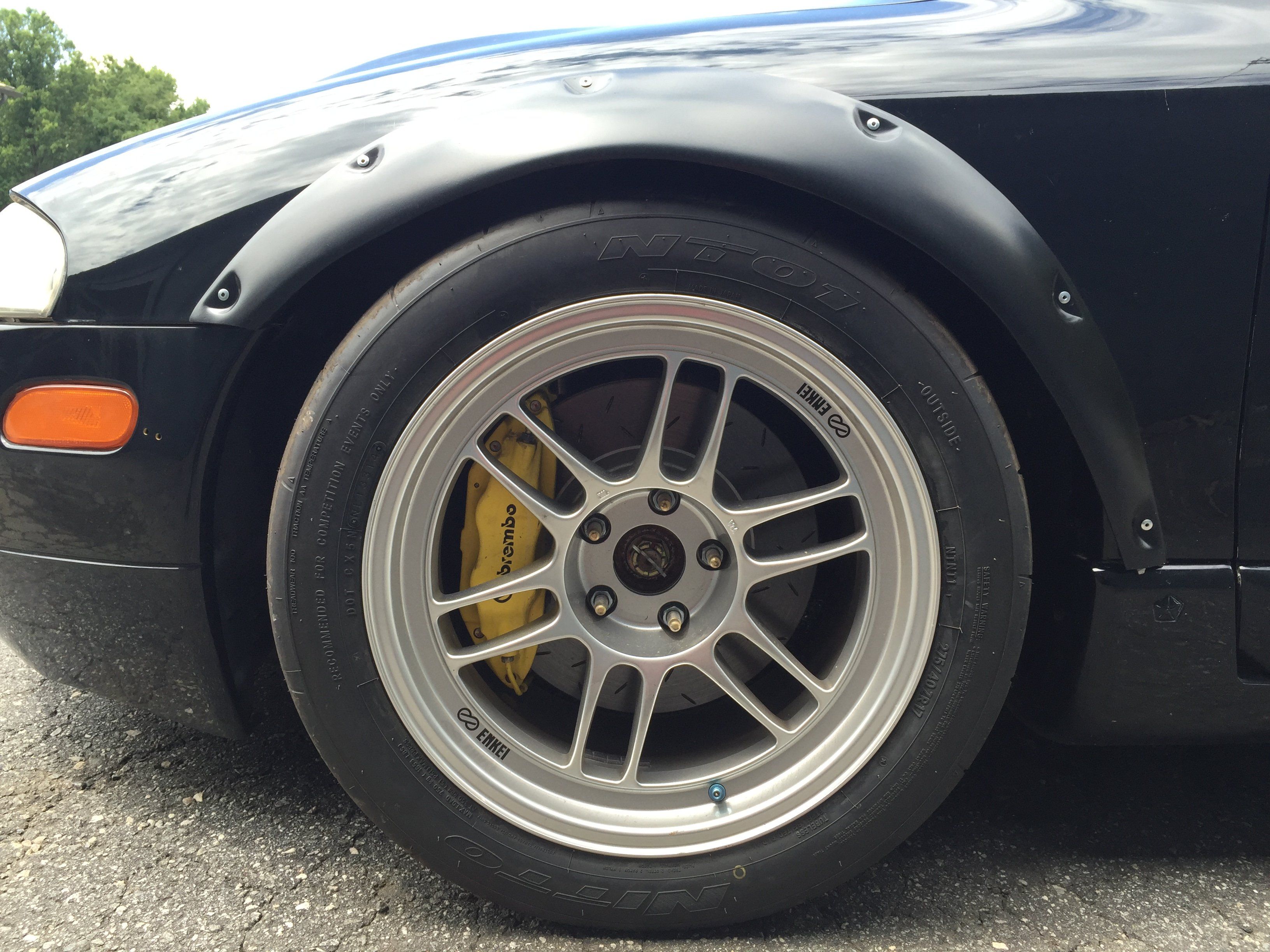

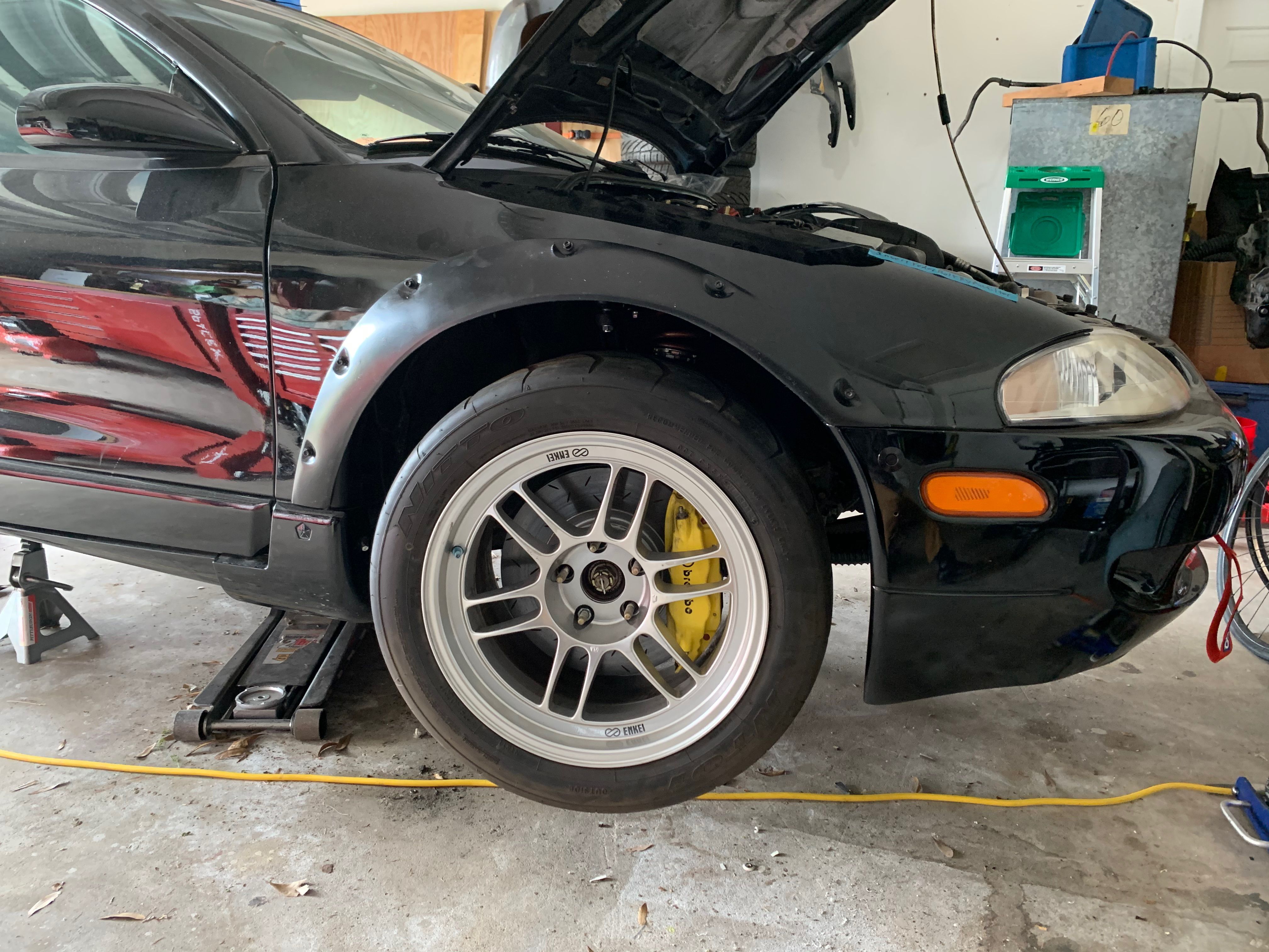

As luck would have it I found the perfect set of used for one season AutoX season of 17" x 10" +18mm RPF1's on Facebook marketplace. These were way wider than I was planning on going but the offset was such that they would work w/o having to go with wheel spacers. This also meant that I now had to get some kind of fender flare in order to make them safe for track days and road use. But we'll talk about that in another post.
These are wrapped in what are now 3 year old 275 x 40 x 17 Nitto NT-01's.

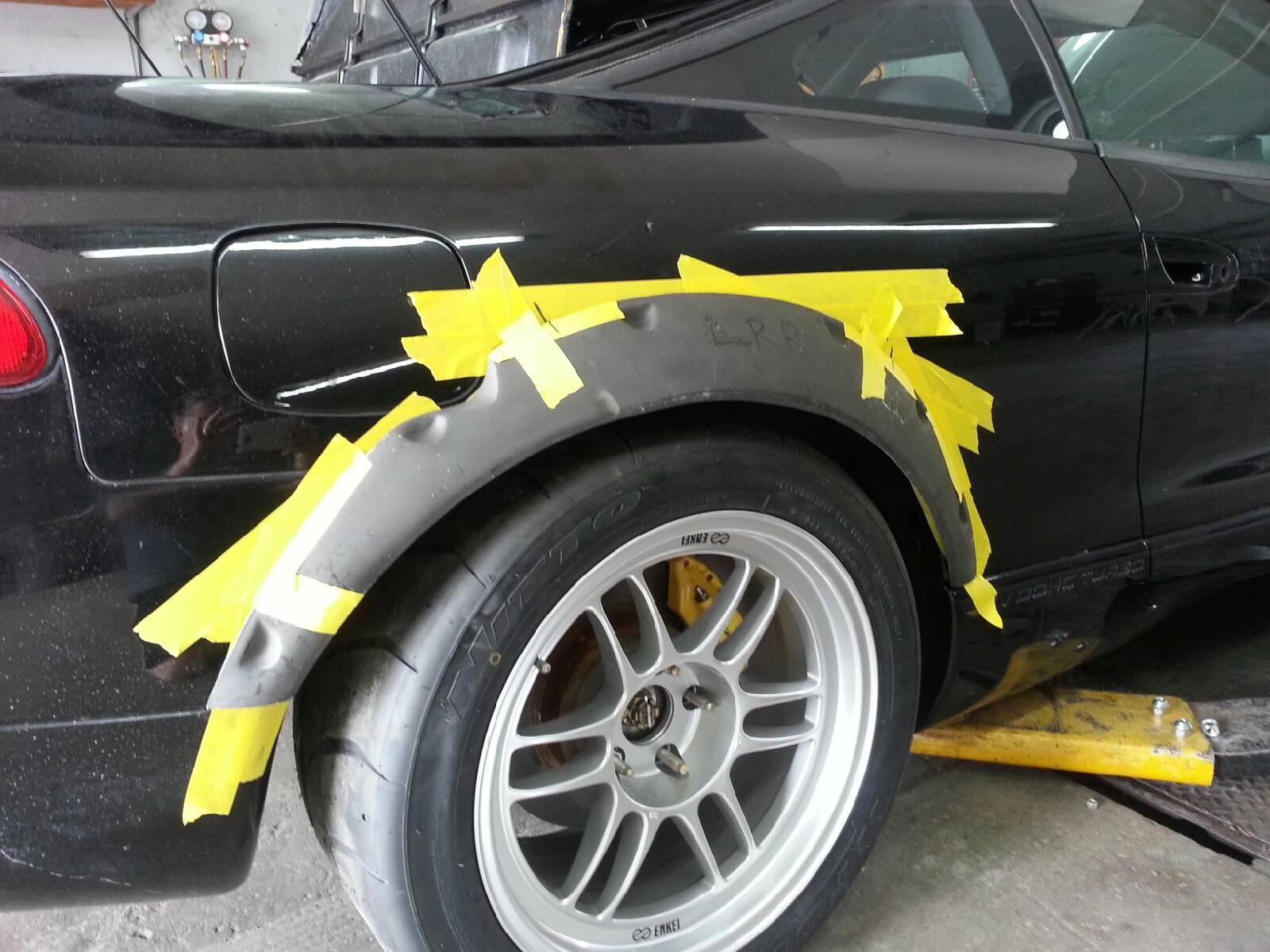

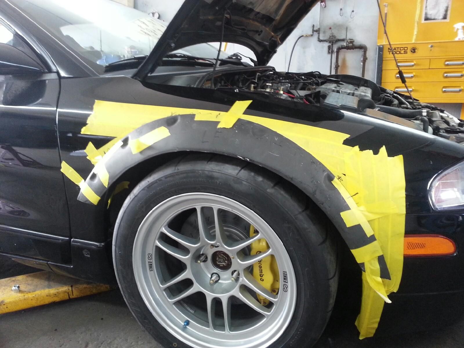

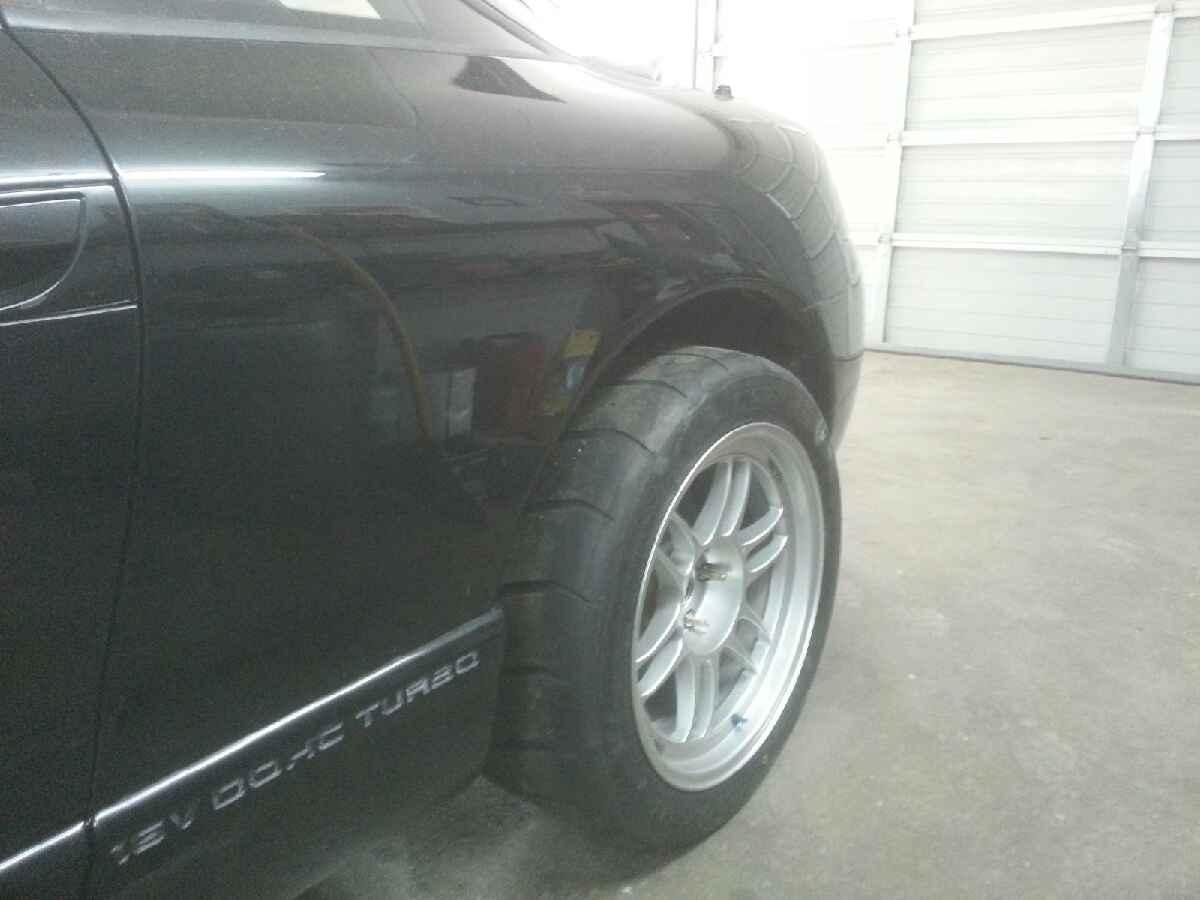

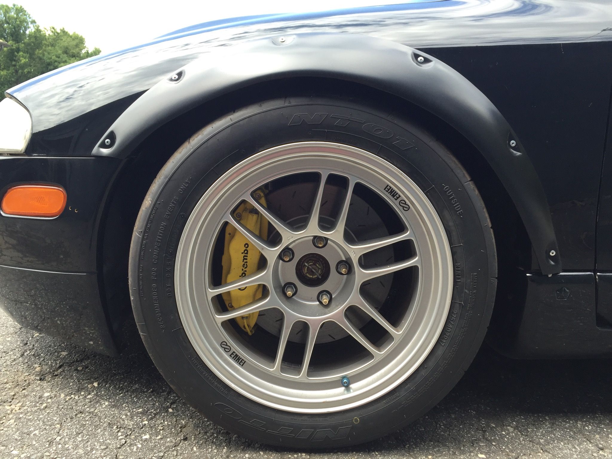

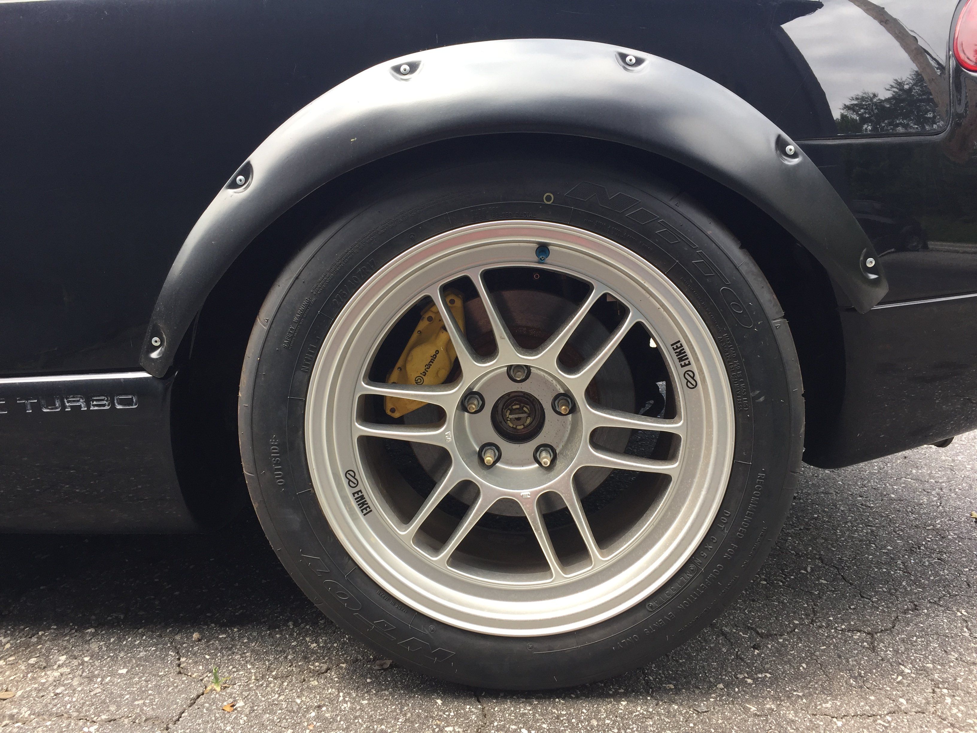

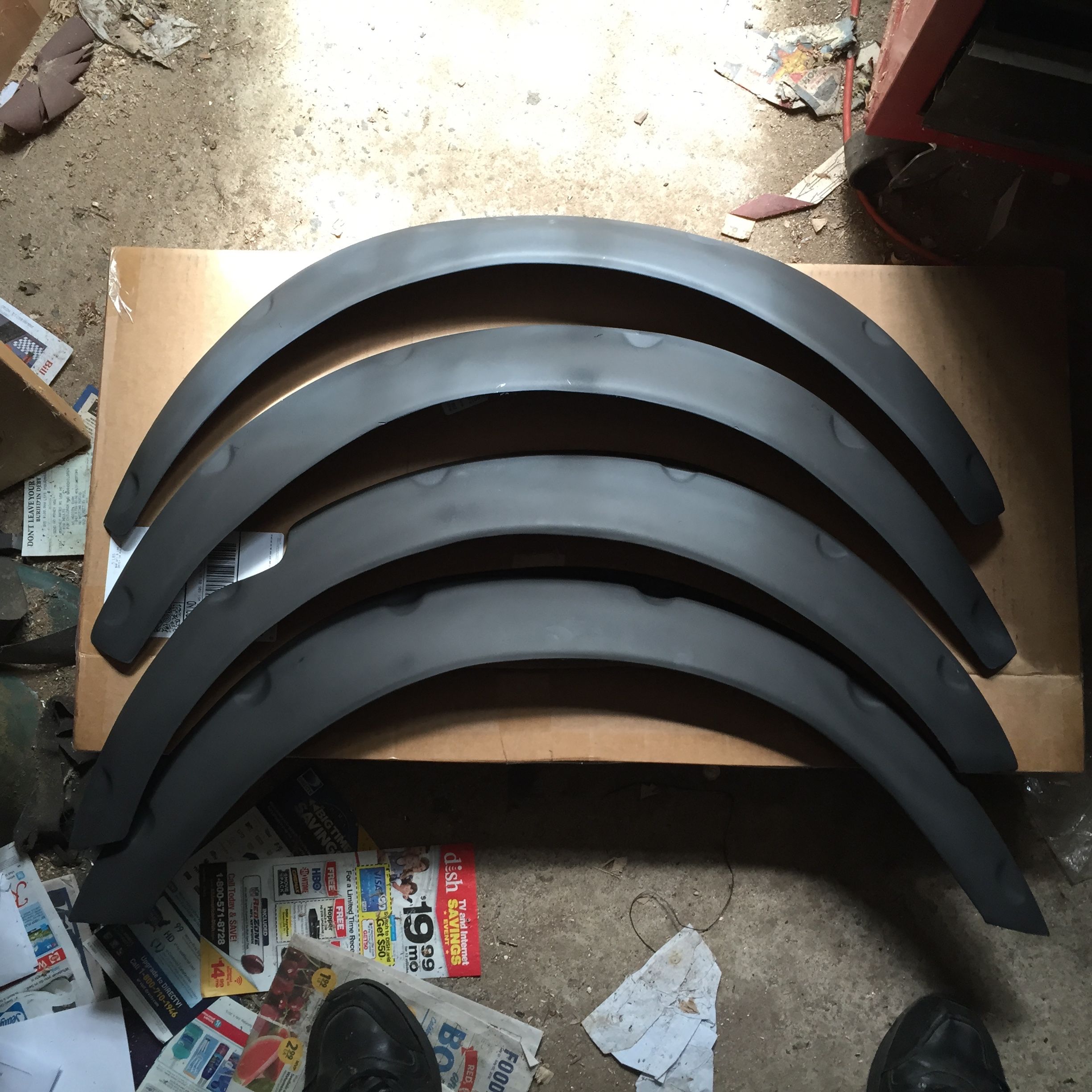

In order to accommodate the wider wheels and tires I was deciding between a set of 240Z fender flares, a generic set from Summit and the 2G fender flares from Carbonetics. Having heard that Carbonetics can be slow to mail out product, I messaged them on Facebook beforehand to see if they had a set of fiberglass flares in stock. They did, and within a couple weeks they arrived. Phew...:thumb: I decided to go with fiberglass in instead of carbon so I can repair them myself in the event of a wreck or tire failure.
The quality of he part was poor to say the least which you can see in the photo below. First off, they were all super thin maybe 2 layers? So before doing anything I had to add another 2 layers of fiberglass to a several spots just to get decent stiffness. Second all of them were twisted, so some fiberglass added was to bring the flare flush with the fender. One of which was so badly twisted that I thought it was going to break when securing to the fender. The top flare (Front) has a noticeable flat spot in the middle.
Maybe this is being nit picky but I wish the edges of the flares were parallel with the ground.
Has anyone else had similar experiences with buying fender flares from other suppliers?

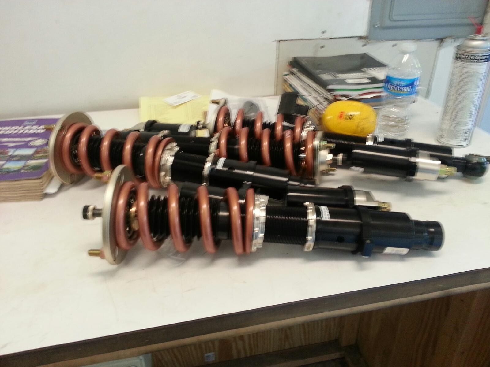

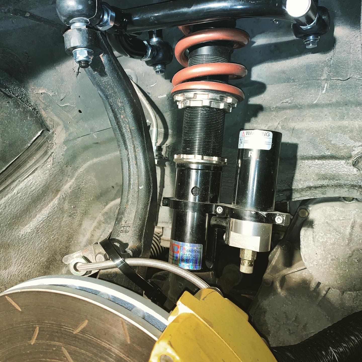

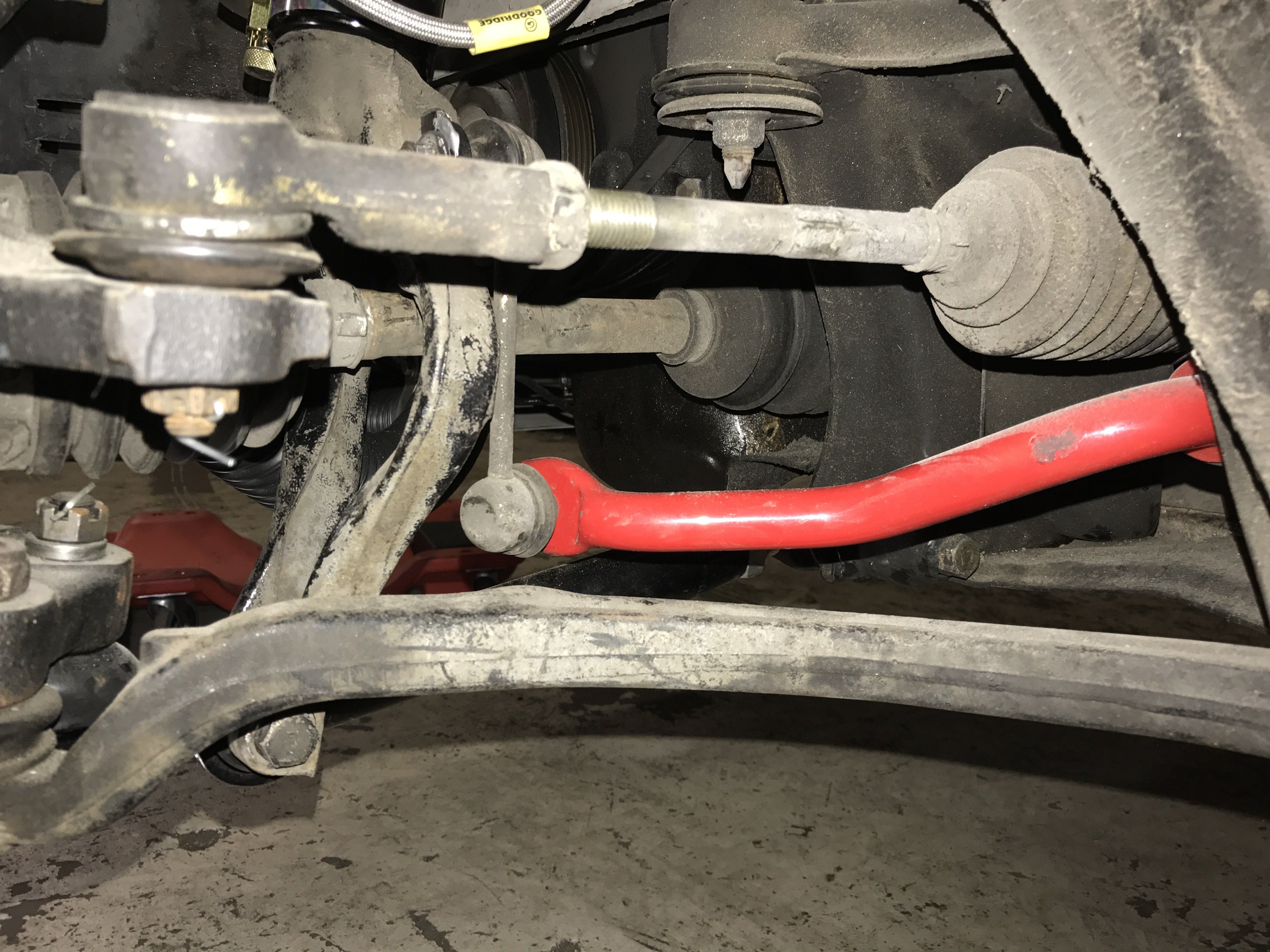

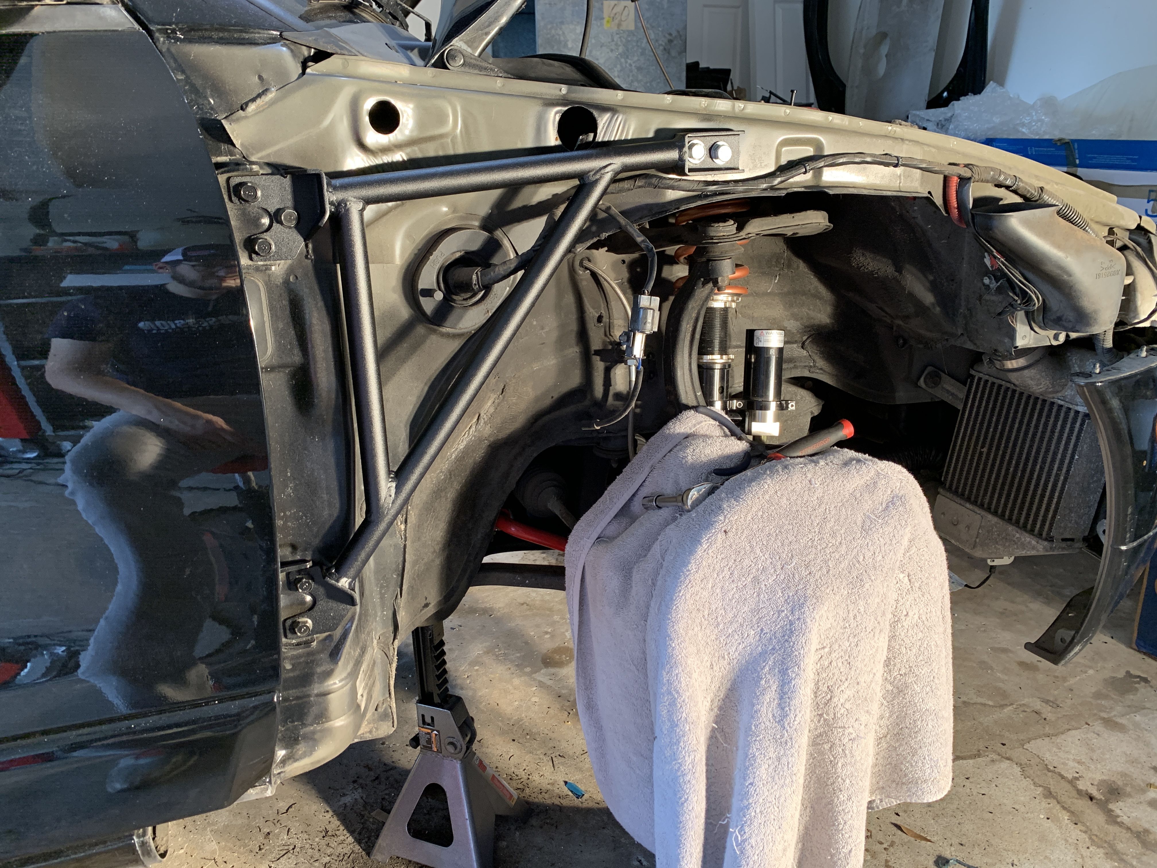

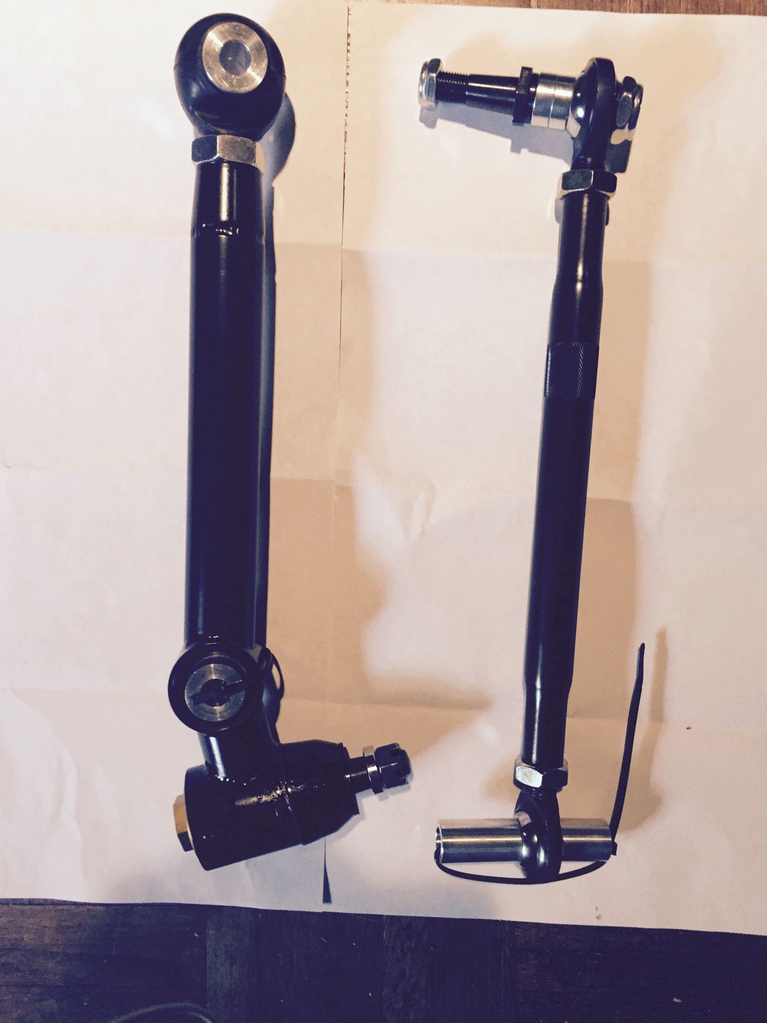

For this post I'm just going to go through what was done to the front suspension because I wasn't able to perform before/after driving impressions. But what I can say is that even before the car was set-up properly it drove phenomenally well. The steering was super precise and I feel like the car rolled into the corners well.
  • Volk Metal Craft / @99gst_racer Lower Control Arms

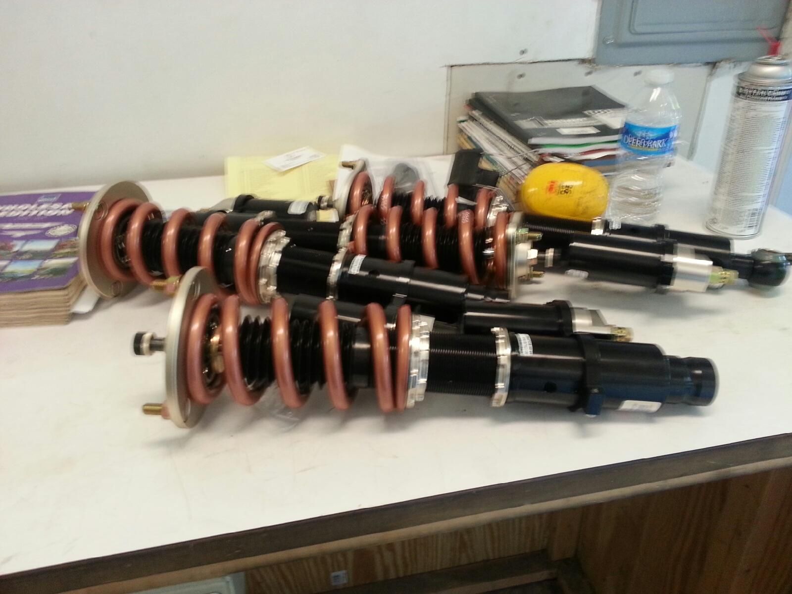

  • BC Racing ER Coilovers with Swift Springs (15k Front and 16k Rear)
  • BC Racing Spherical Top Hats, these had to come from the UK b/c the USA branch would not sell them to me.
  • RM Front Sway Bar from STM

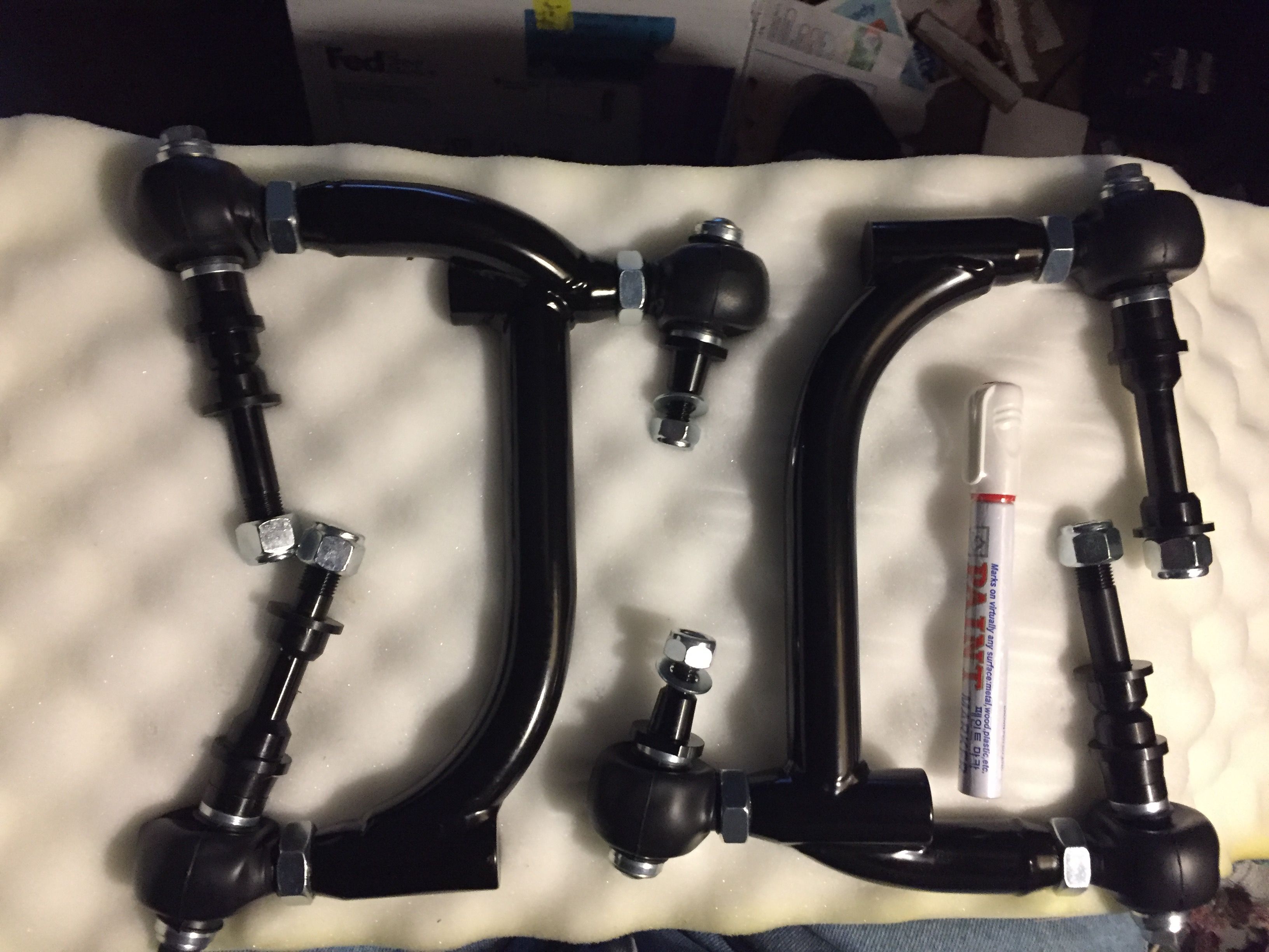

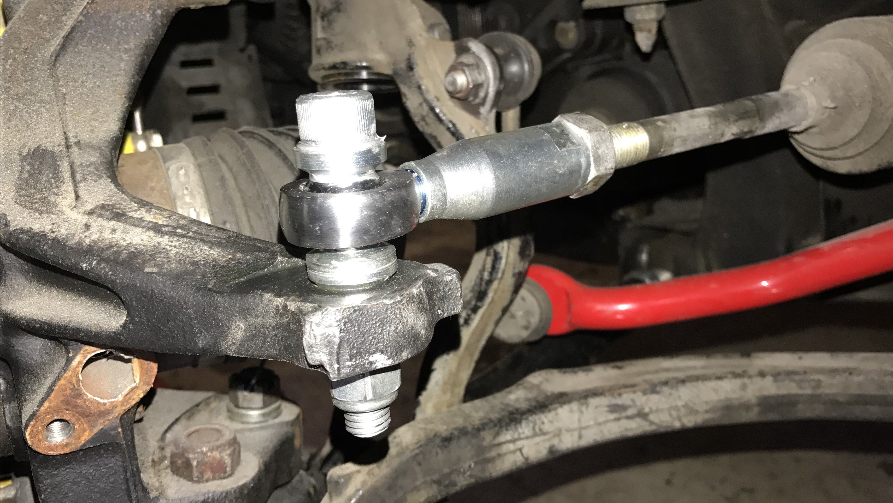

  • @ec17pse Front Upper control Arms
  • @ec17pse Tie Rod Ends
  • @greengoblin Front Chassis Braces

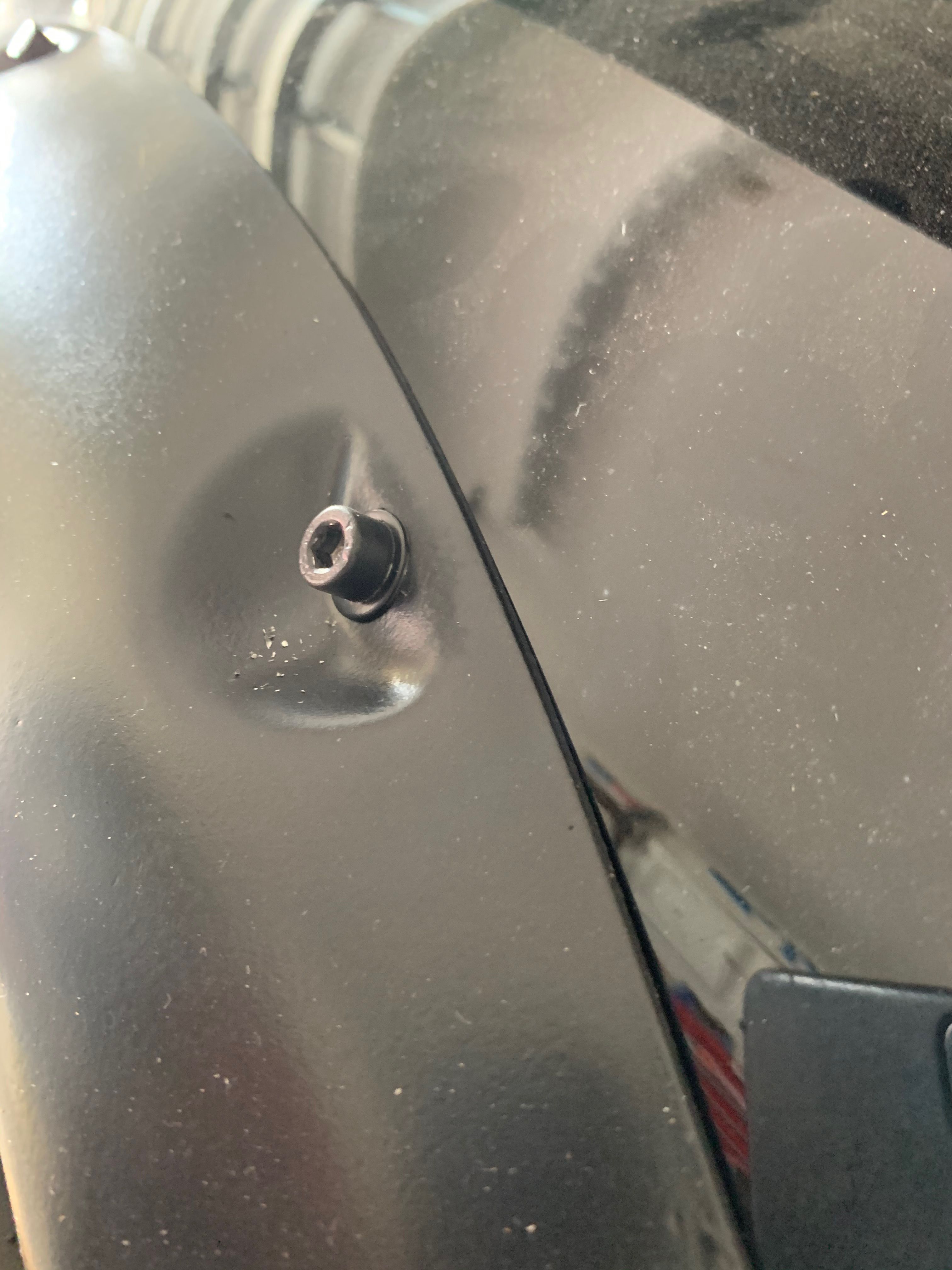

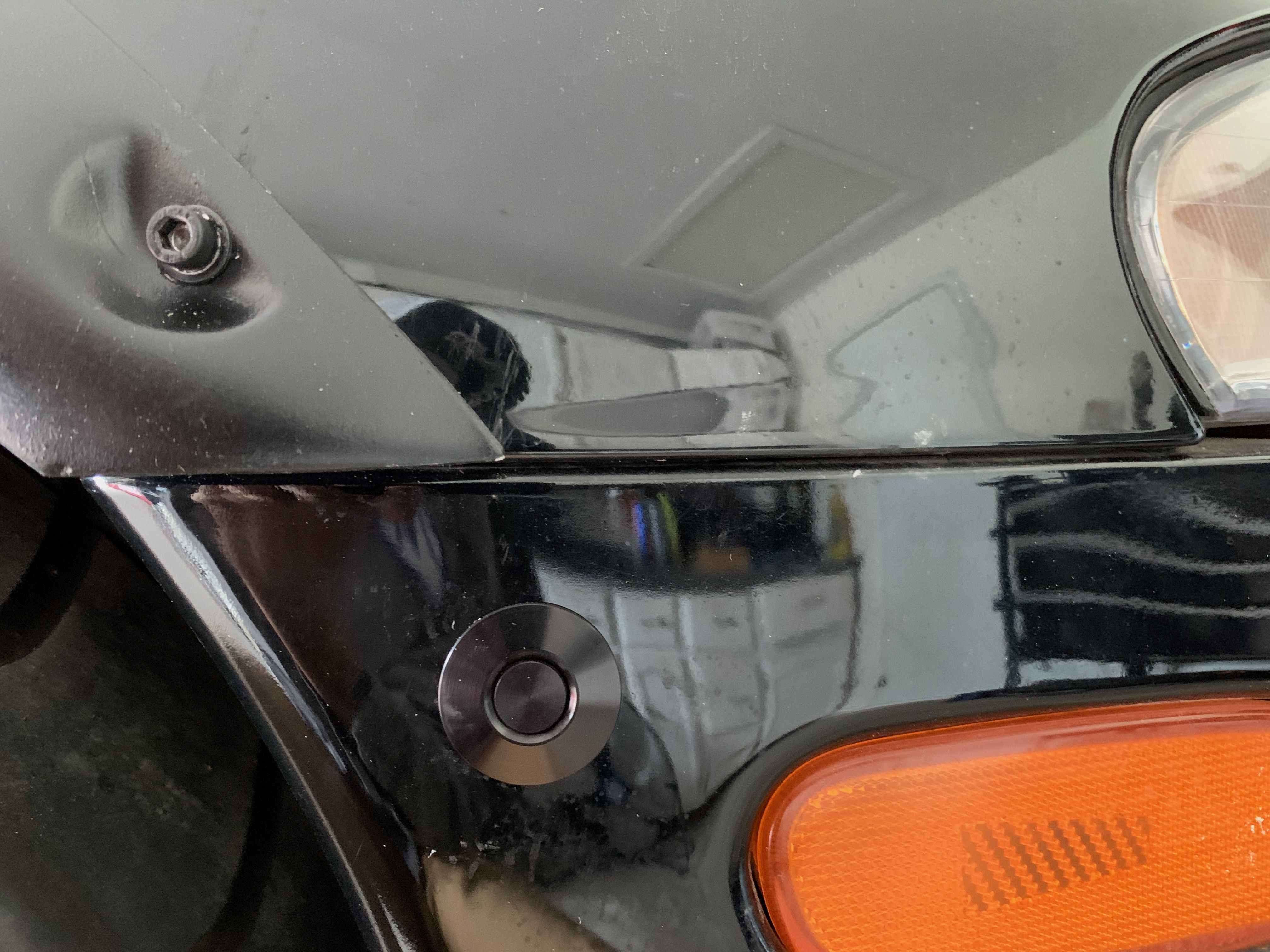

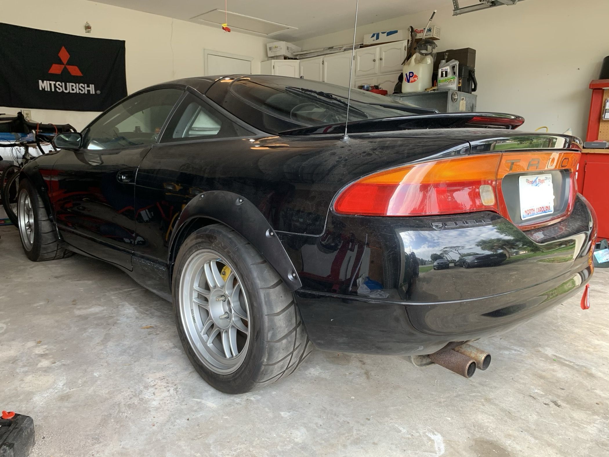

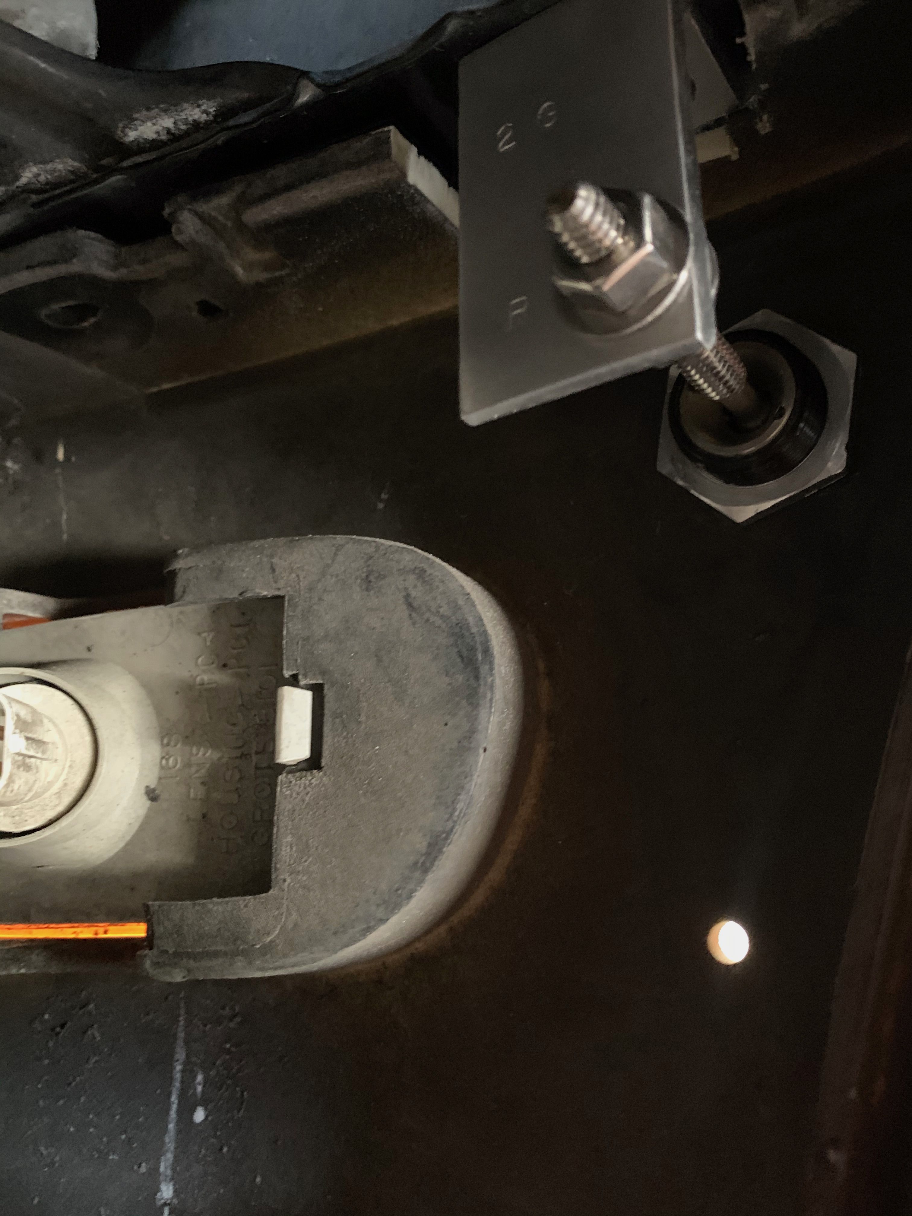

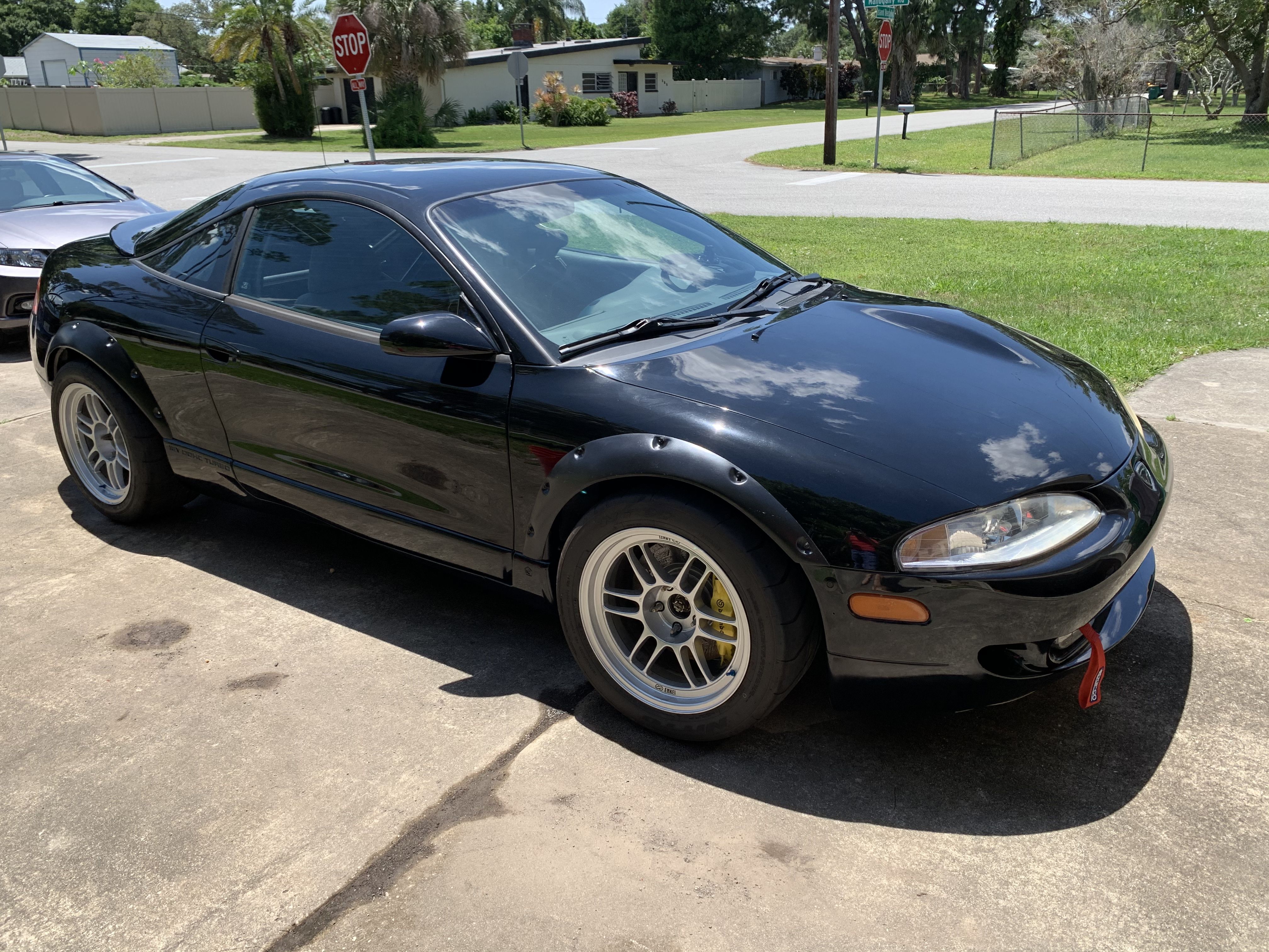

Finally got the right front back together the other day. I decided to replace the rivets that hold the flare to the fender with bolts instead b/c I wanted to make the car more easily serviceable in the event I need to A.) Replace the Flare B.) Need to cut/roll the fender due to tire rub or C.) some other reason I can't imagine.
I used stainless steel bolts, lock washers, and nuts just as an added step against corrosion as they'll prolly see rain at some point. So you may notice that they're painted... due to social distancing and quarantining I choose to shoot them with a coat of paint instead of going back to the "ACE hardware and Racing Supplies" for black oxide coated ones.

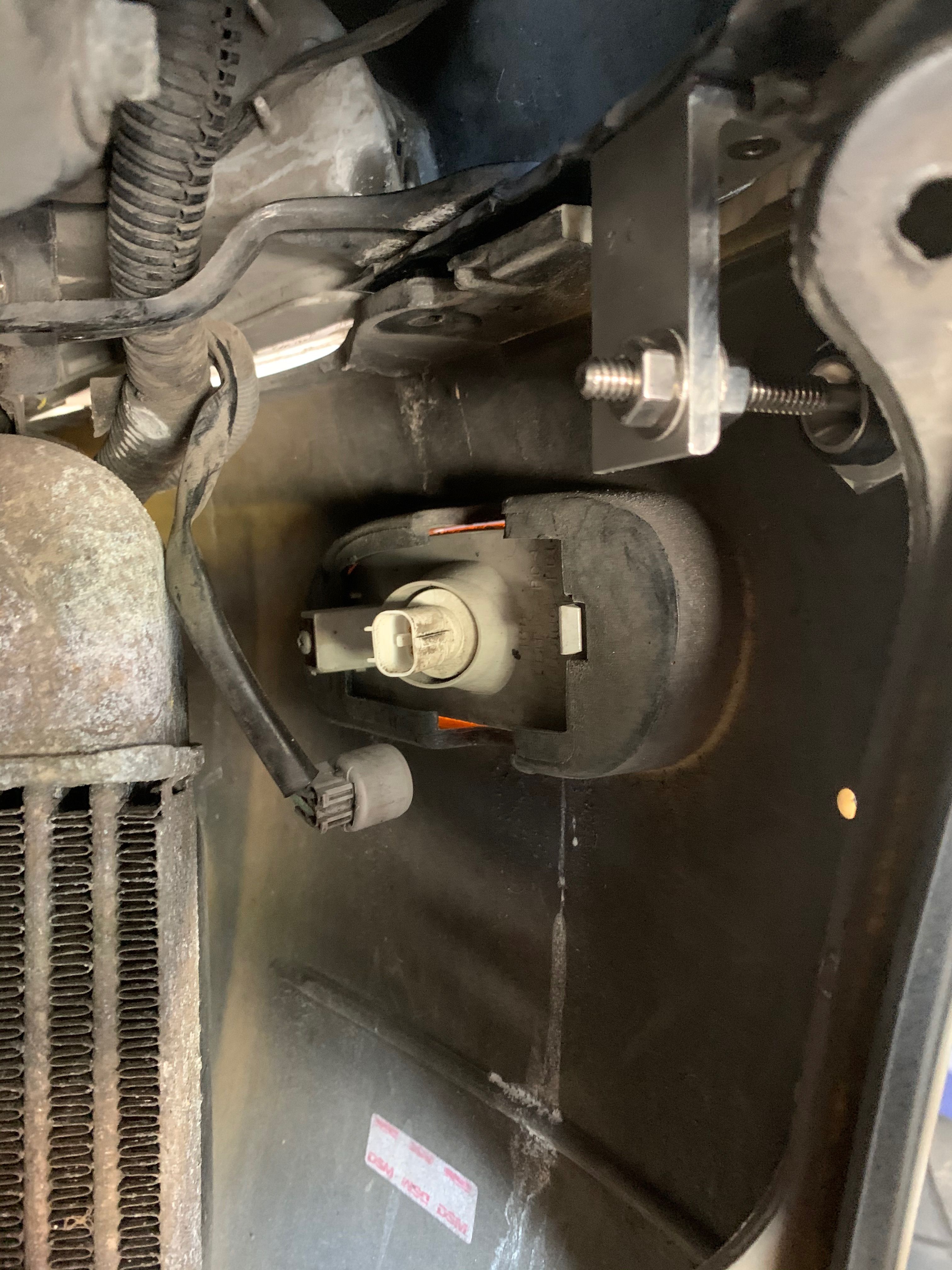

As part of making the car easily serviceable, I added a front bumper quick disconnect kit from Brian Mitchel https://www.facebook.com/brian.mitchell.0911. He was super easy to work with and responded quickly to a DM on Facebook. If you're on here Brian please let me know and I'll leave you a positive seller review! :thumb:
When installing this kit make sure you drill the hole for the push lock carefully, I messed this up slightly on the passenger side. I was able to fix it by relocating the bracket from the underside of the fender lip to the top but it was my fault and got lucky by being able to fix it easily.

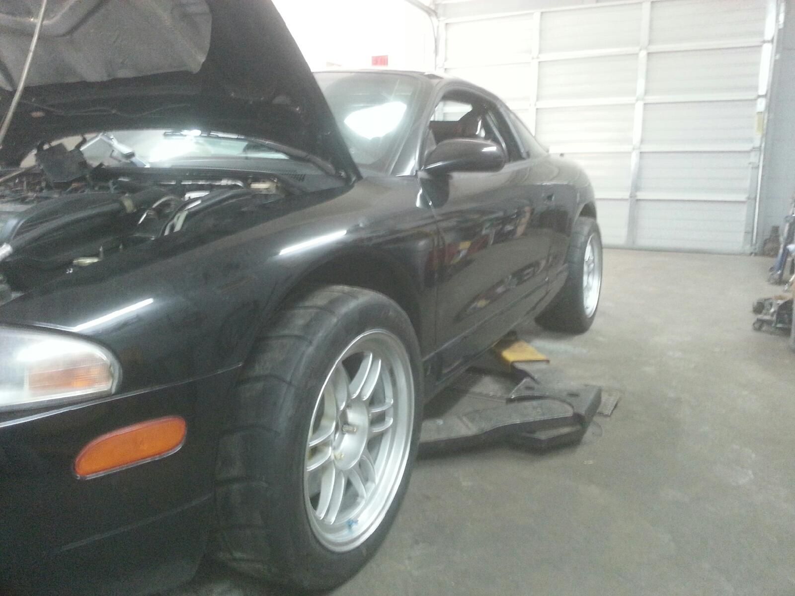

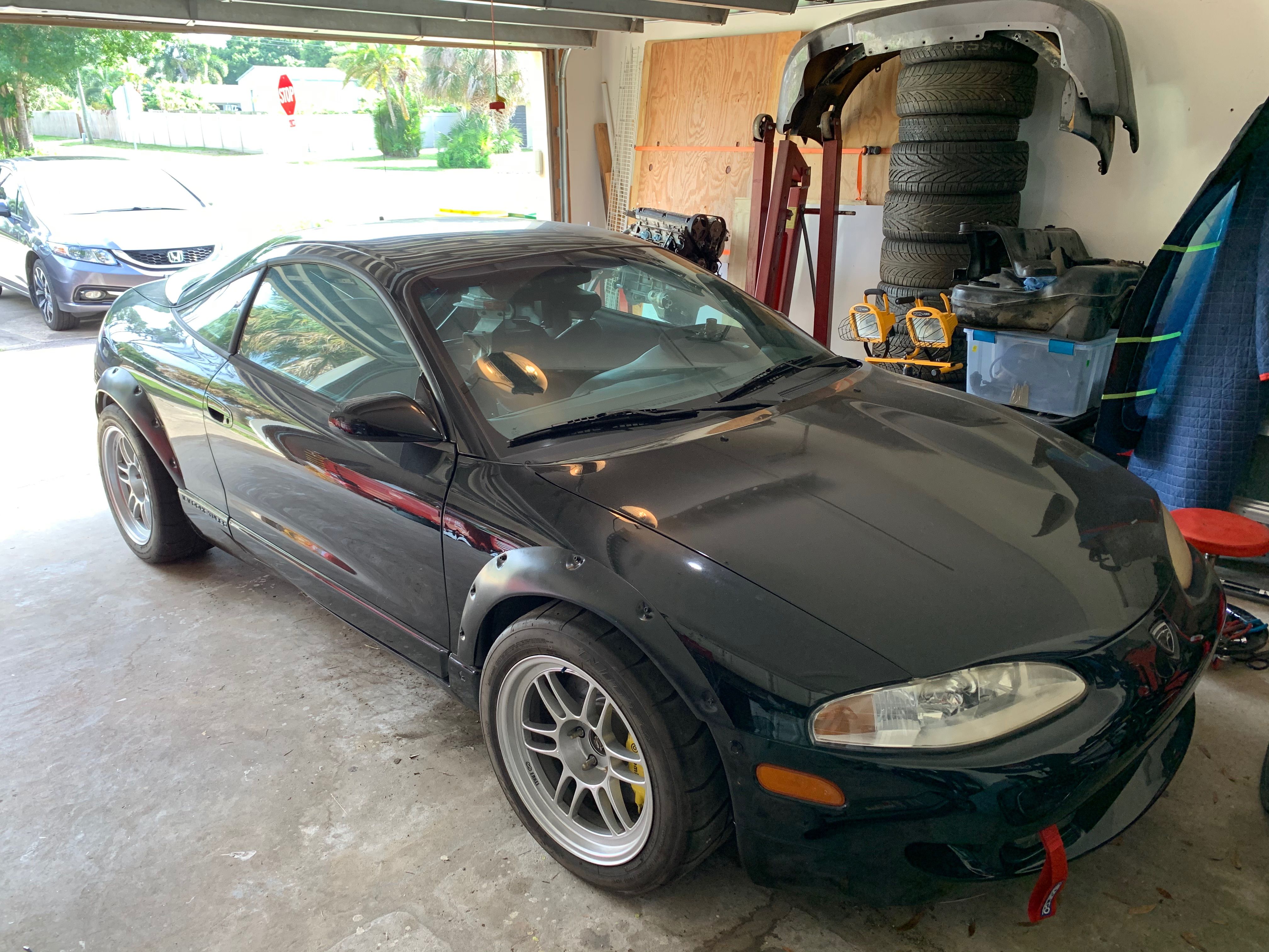

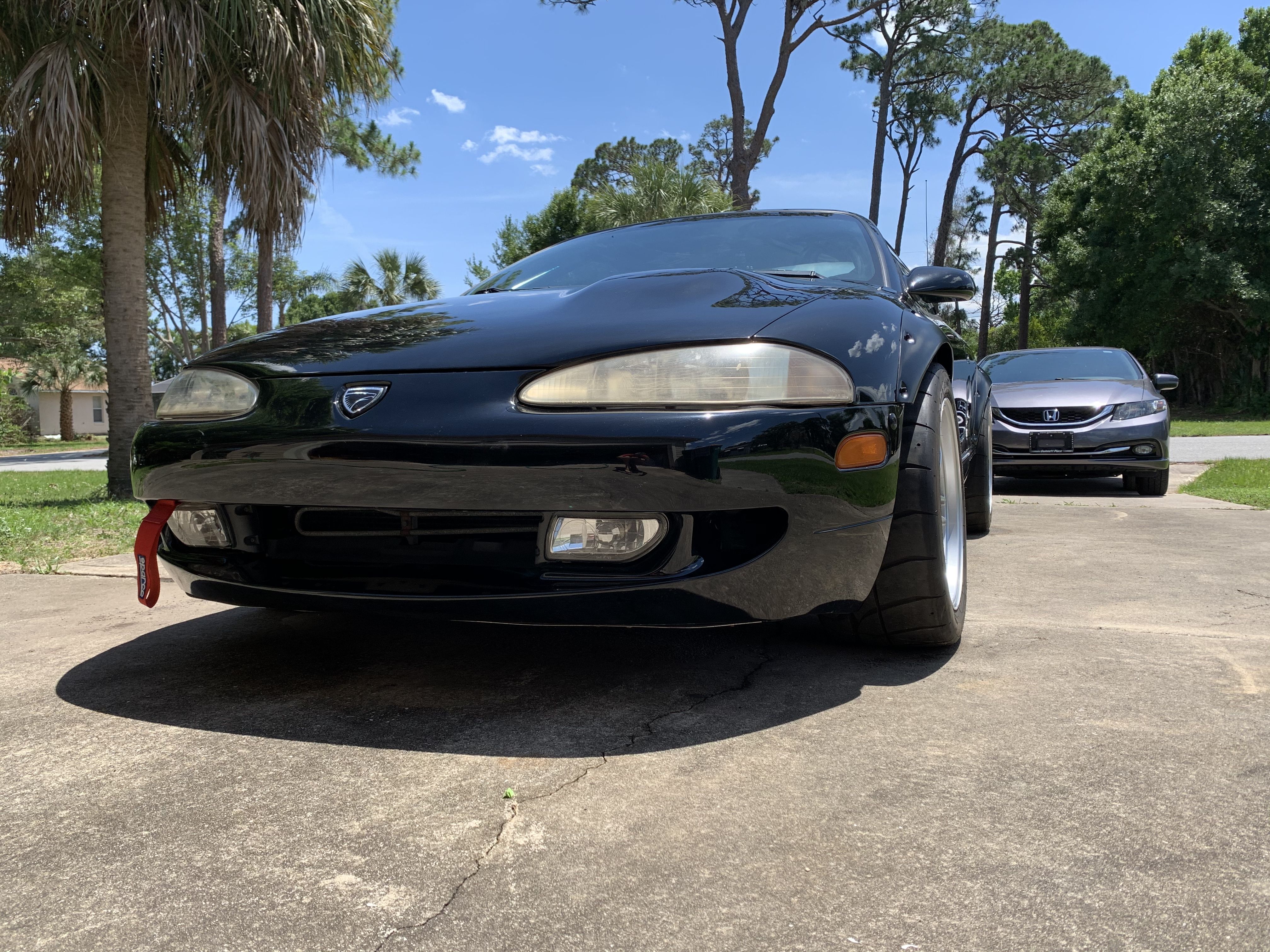

Today was a great day! Got the left front put back together ready for set-up! Here's a pick of the car on the ground for the first time in 8 months. Nothing radical but it's ready for the next Dan Partelo to do his magic in setting up the car.
https://www.facebook.com/DanParteloRaceCars/
If any of you have any recommended specs for road racing, please feel free to comment!

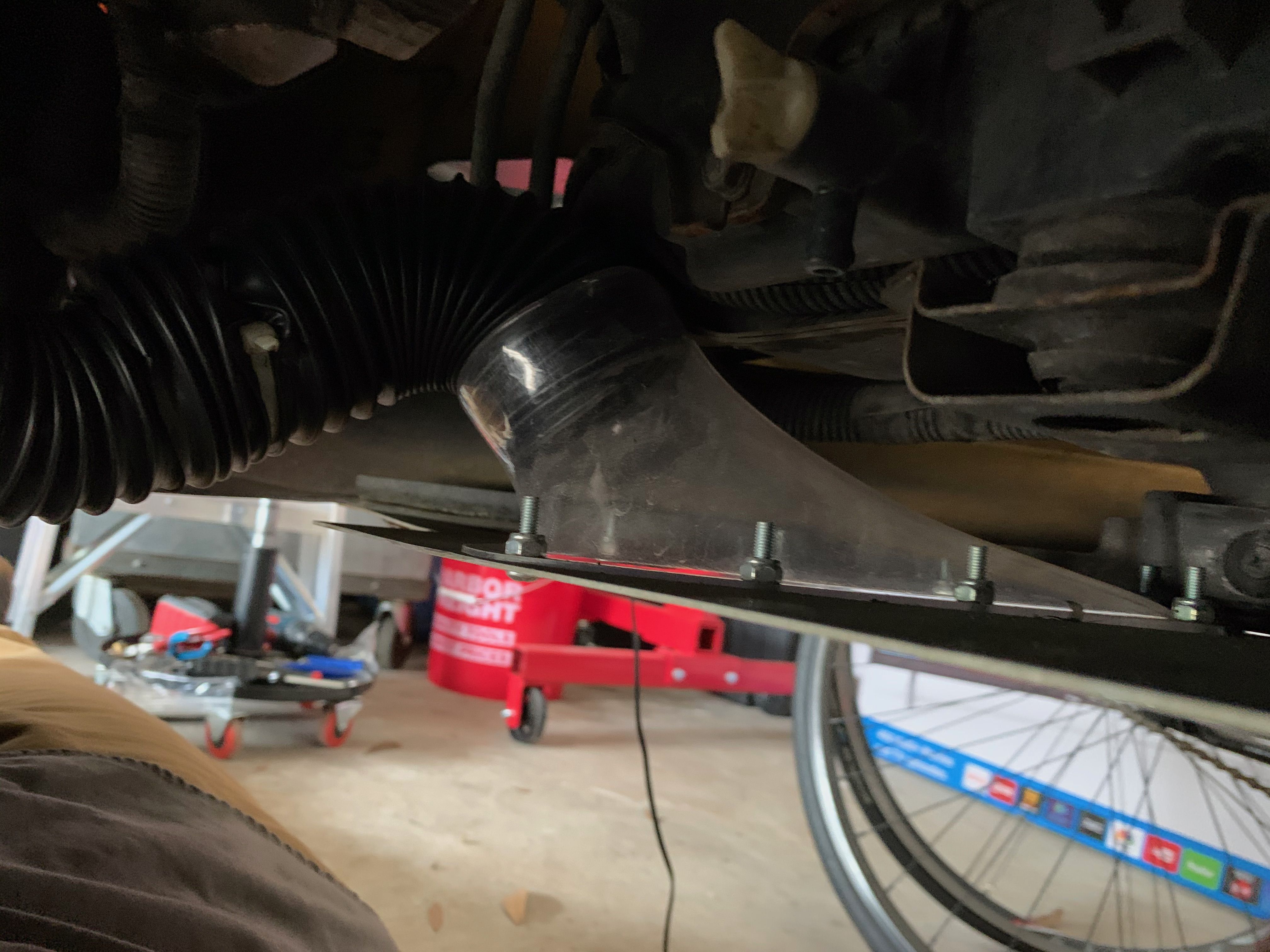

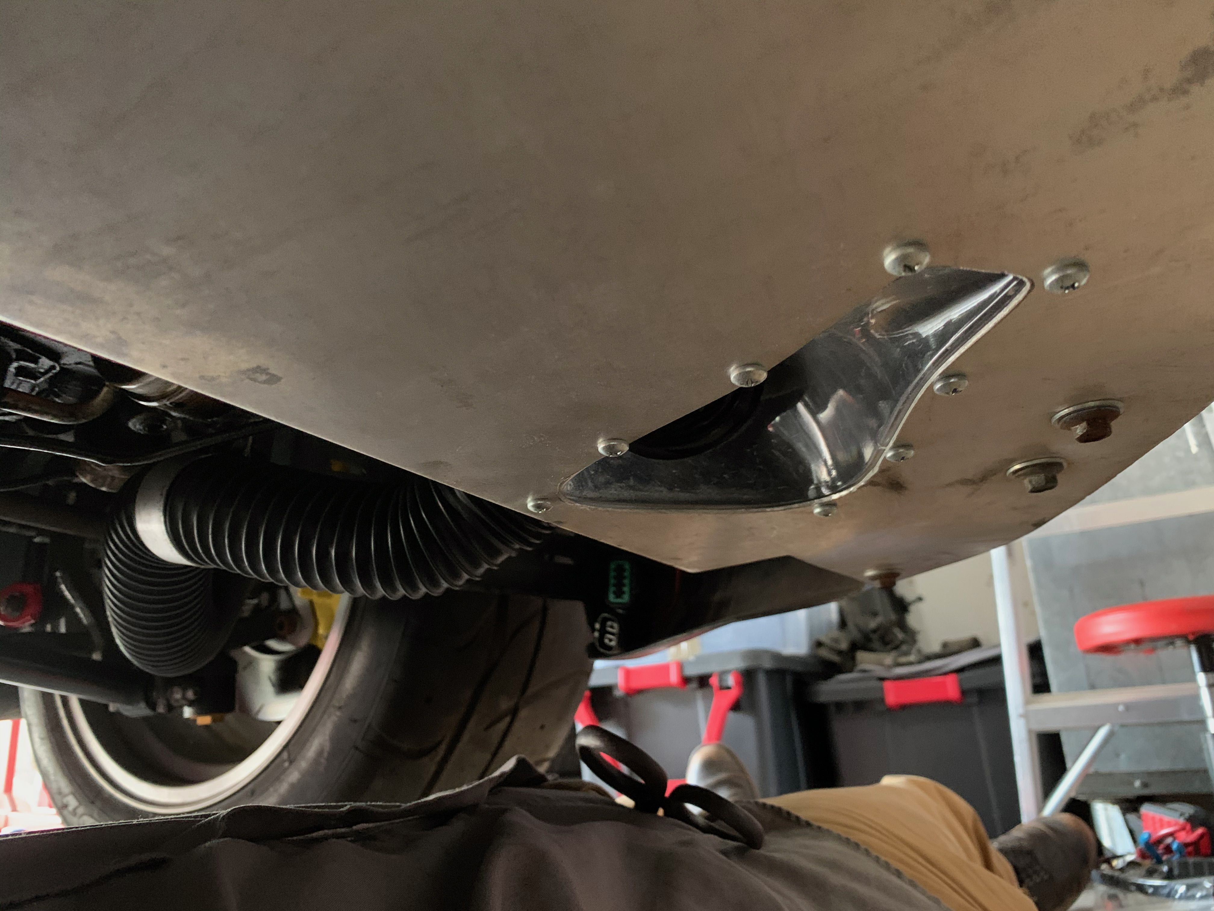

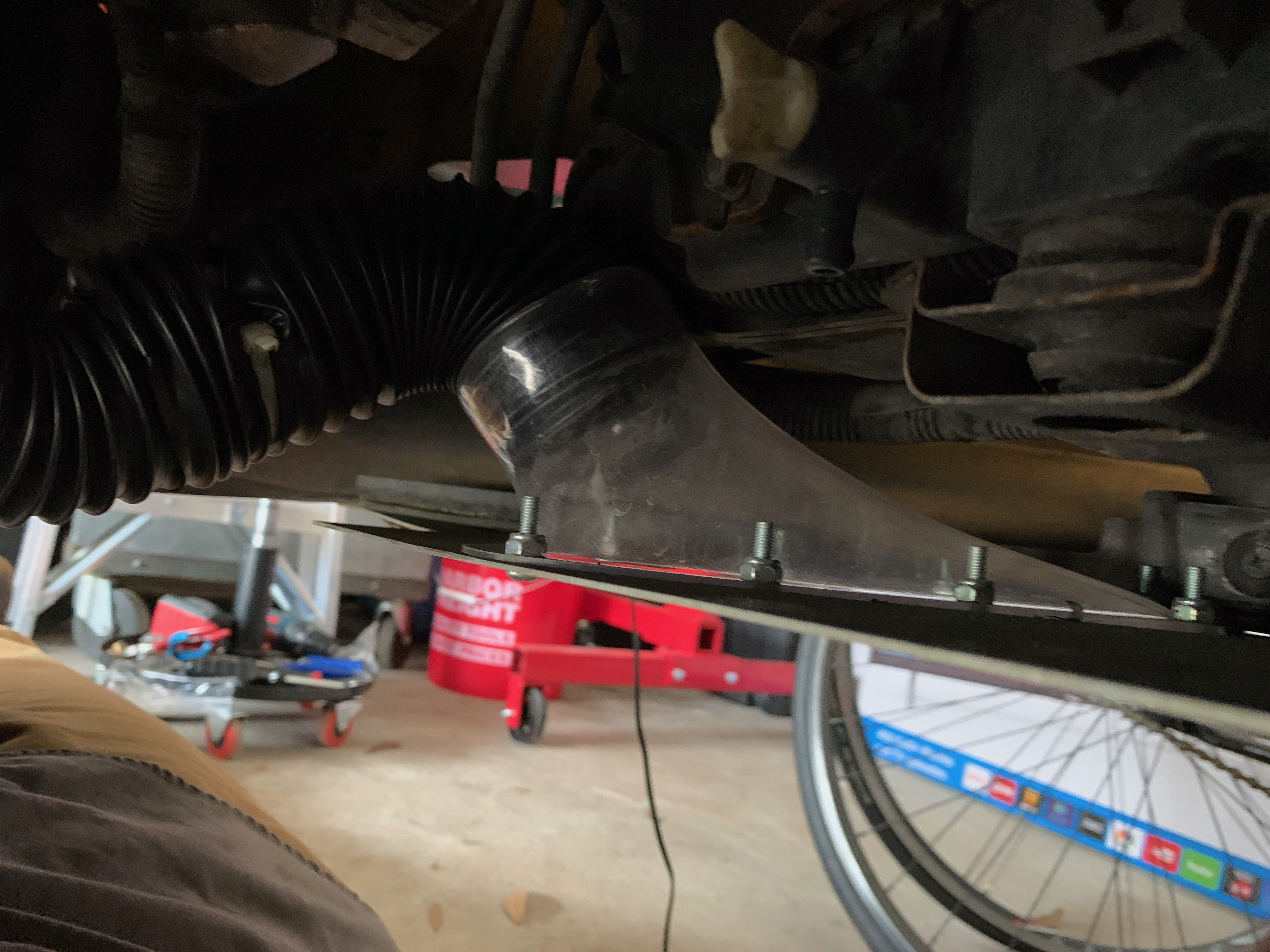

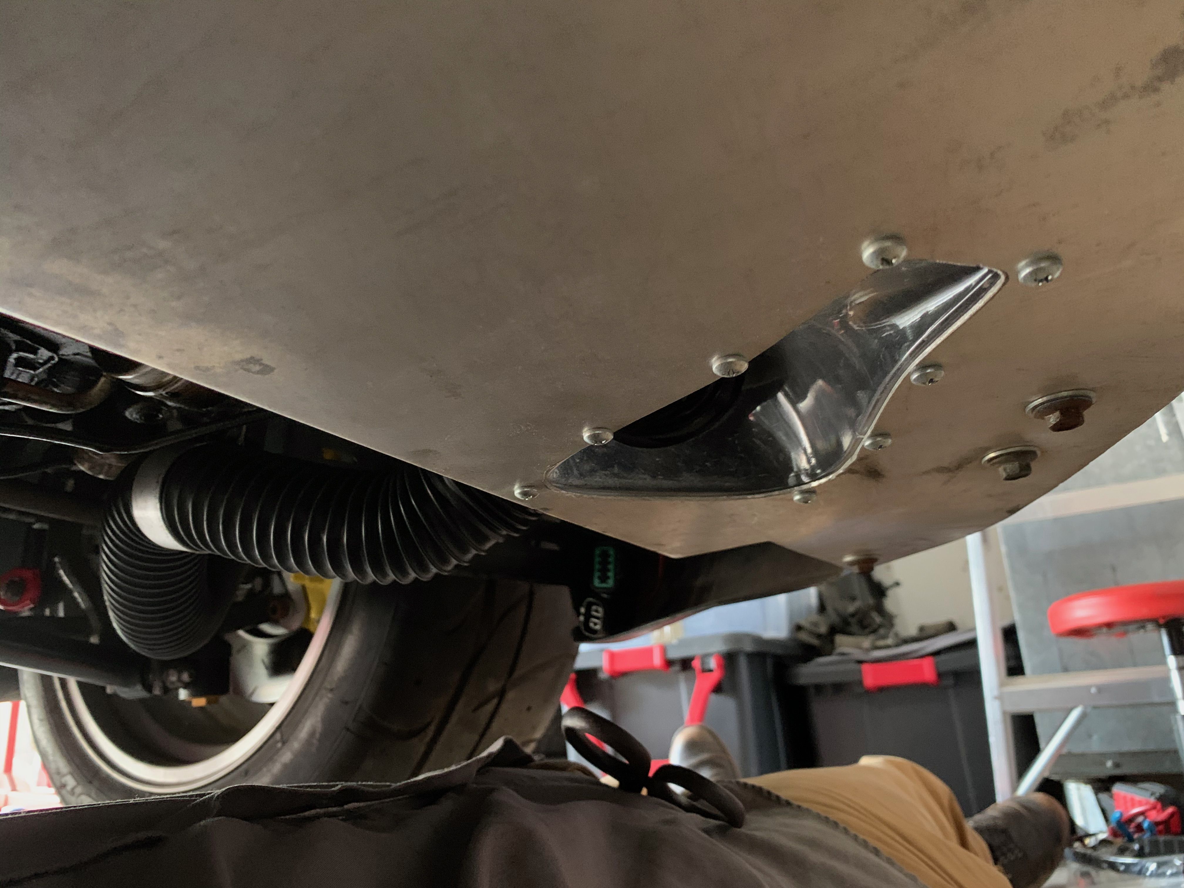

One cool thing I meant to show you guys the other day was the under tray my Dad made years ago when I was AutoX'ing heavily. It's a a super simple piece to make and it worked great not only for lower speeds but I could tell a big difference in brake feel when carving up the the Tougé (mountain pass). It's just a NACA duct cut into a piece of aluminum that's bolted to the underside of the front bumper. We also cut out two holes in the middle of the panel for the frame rail bolts.
If you go to do this, make sure your NACA duct exit hole is the same as the brake ducts. You can kinda see in the photo's that I had to use two different size of ducting in order to make it work. If this happens to you just slide the smaller duct into the larger duct and zip tie.

That’s much easier than trying to run it from the front openings.
