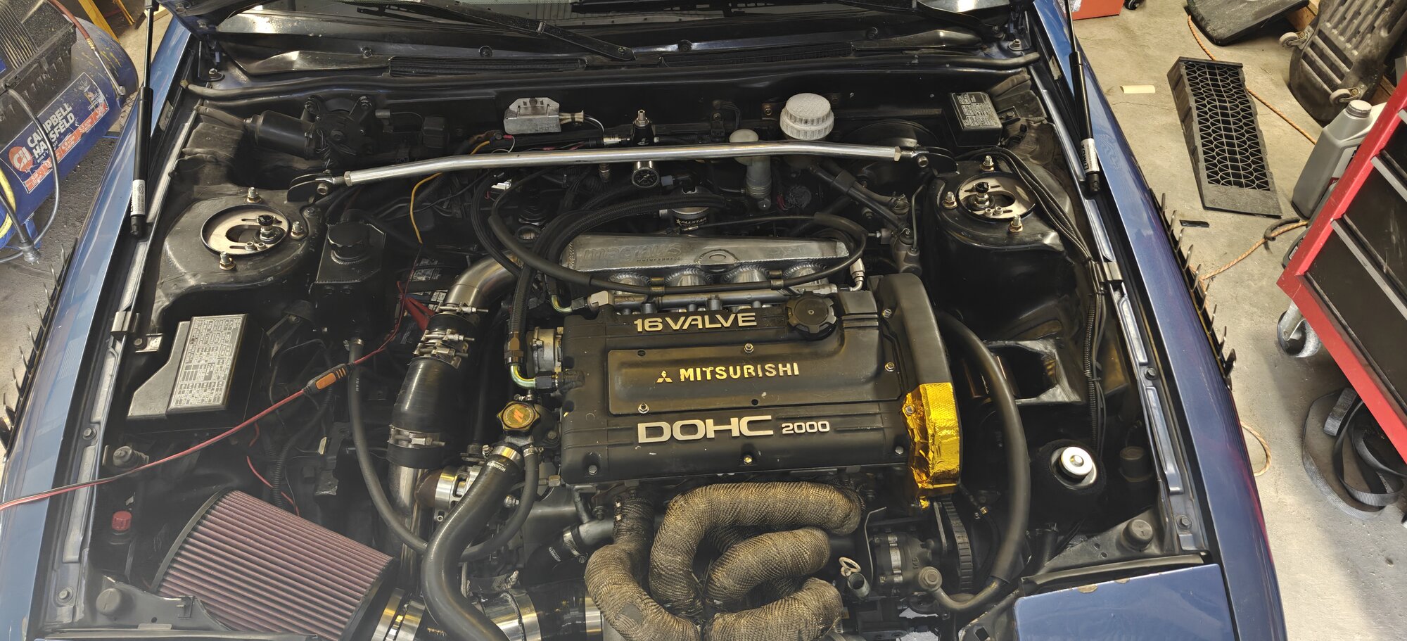

Current setup highlights for road racing:
BC coilovers revalved by RedShift Motorsports, 14KG front springs, 12kg rear springs
Evo8 Brembo with upgraded stainless steel pistons, titanium shims, gloc R16 pads front, r10 pads rear, girodisc rotors
Evo8 rear differential
Evo8 wheels
Since no one posts alignment specs: Front: -3.5 degrees camber, .04 toe out Rear: -2.5, 0 toe

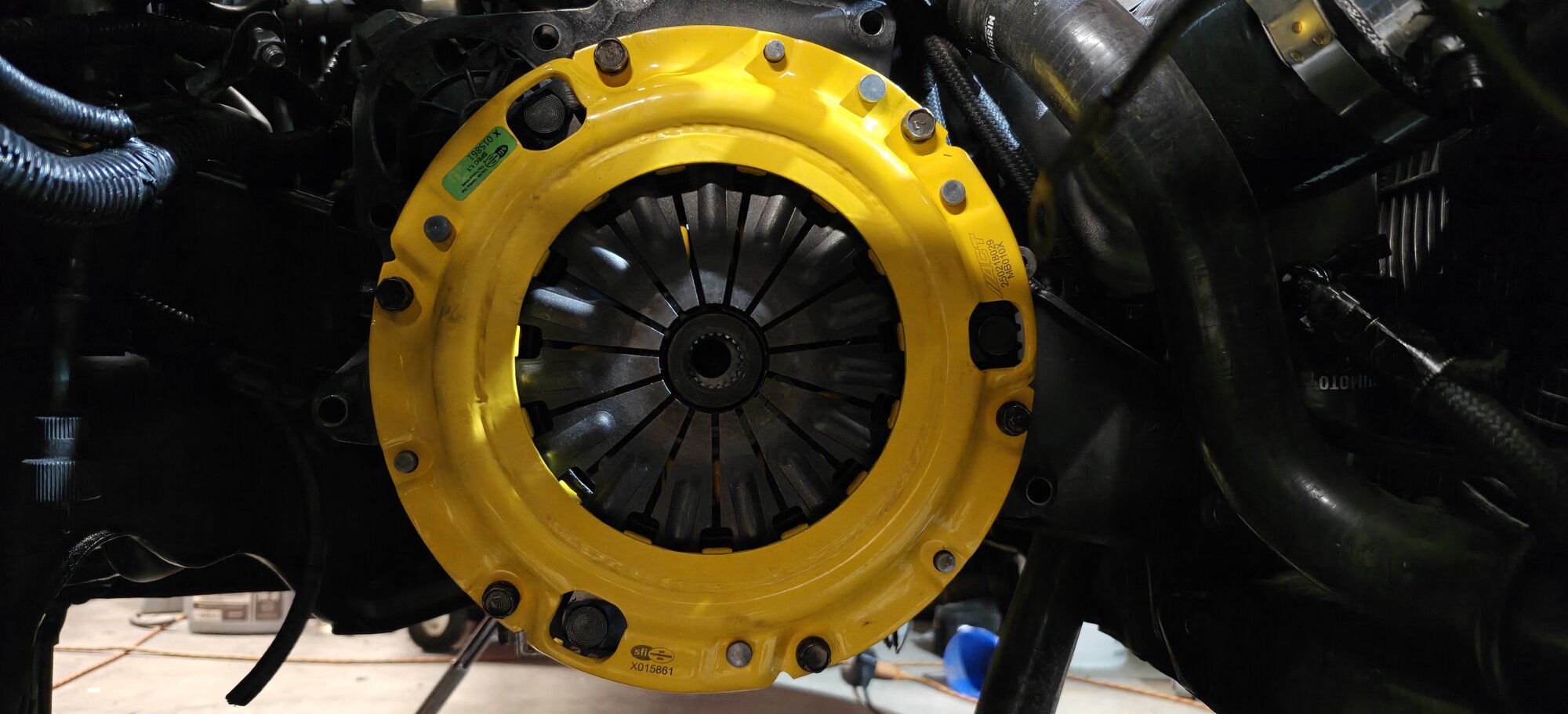

Future plans, twin disc clutch because these ACT puck clutches are only lasting a year and I have the NEAT Gearbox gears on order. Then I can turn the power up if I feel like it.

This past month I had the ECU repaired after discovering the boost solenoid driver was toast when I changed over to a EBC controlled with ECMlink and it wasnt working.

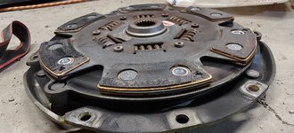

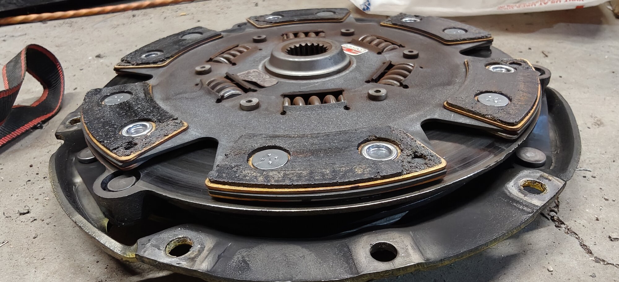

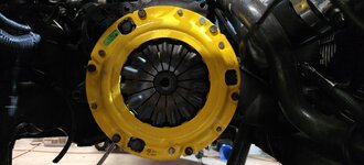

Was tuning the boost when the clutch started dragging at high rpm.
Replaced another falling apart 6 puck clutch. Was running a Comp disc but I have the same issue with ACT disc, 4 or 6 puck, sprung or unsprung.
They all fail this way. They hold the power but then start dragging

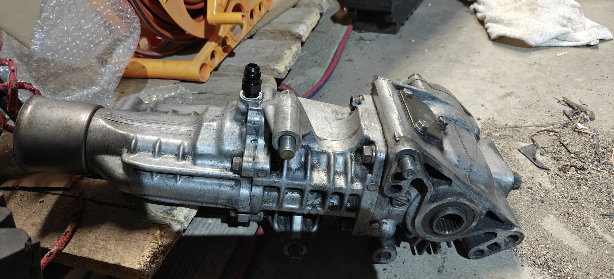

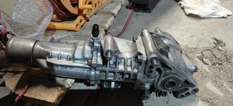

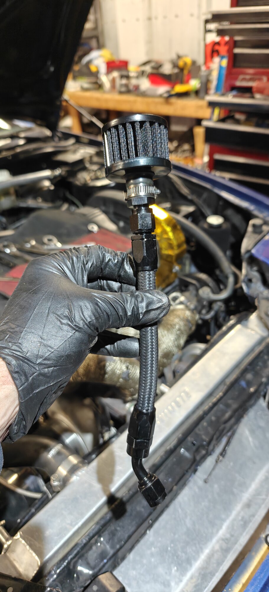

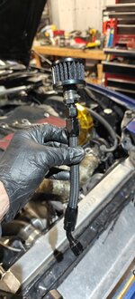

Added a 6an vent to the transfer case since it looked like it was seeping fluid out the breather

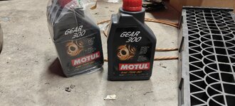

Filled it back up with Motul 300 in the trans and Redline heavy weight in the transfer case

Probably a competitive advantage - suck in all the air and there's less for the cars around you on the track to ingest. :D
You gotta be sucking in half the neighborhood with that air filter ... 😳🫨 Nice car!
Ya my buddy said my last filter looked small, so I bought the biggest one I could fit. Helps it stay cleaner longer too.

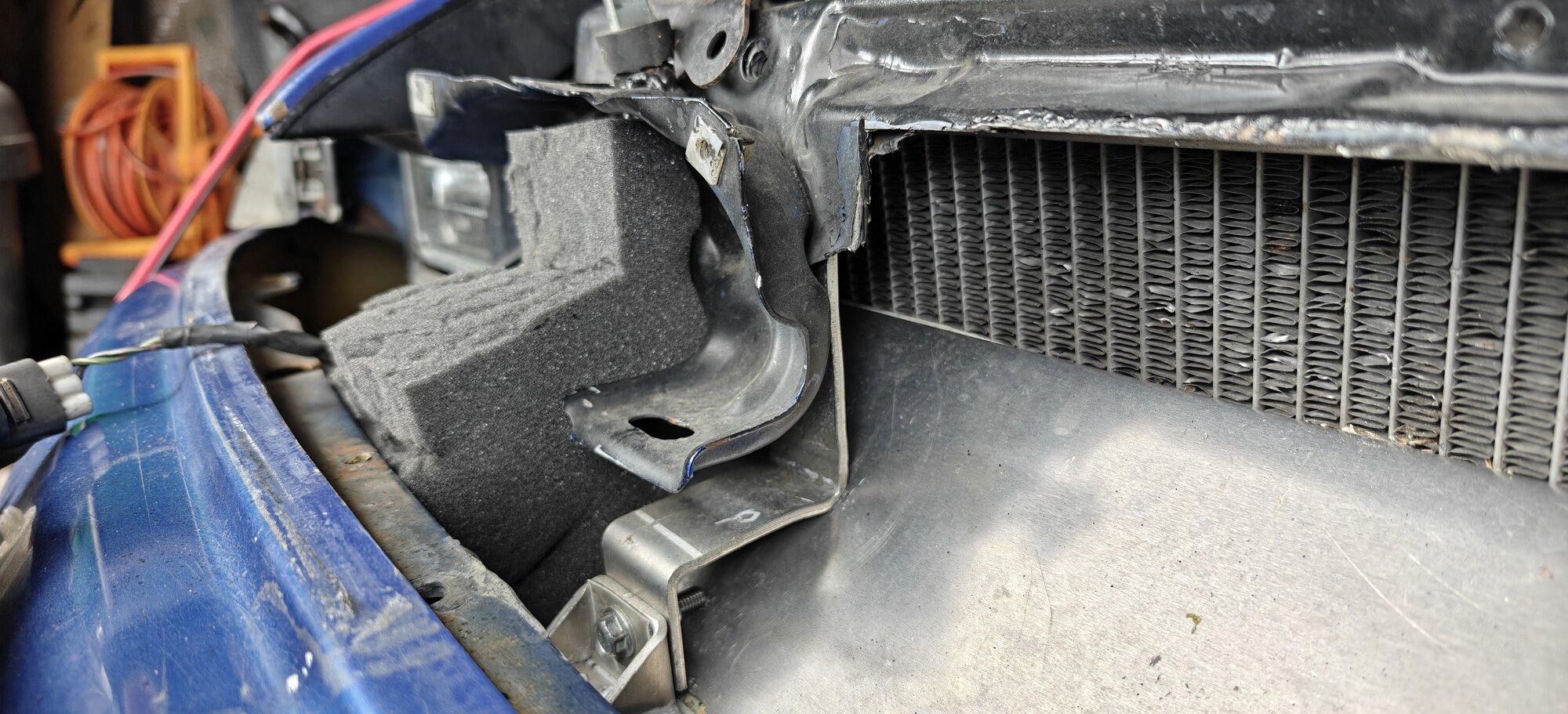

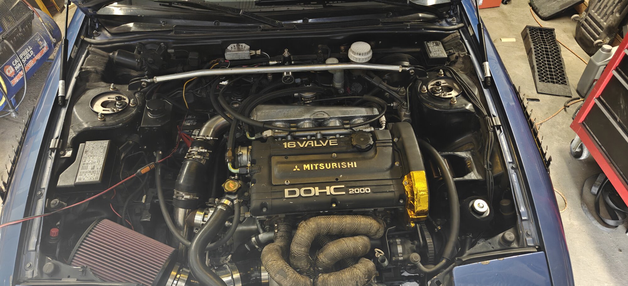

Just saw your post about your temps getting pretty hot. My old PWR radiator did pretty well but I still struggled with higher temps - it's not easy to keep things cool at a high plains desert road course with a turbocharged car and a huge FMIC. My plan was to try to create ducting to ensure air was going through the FMIC and radiator and not escaping on the sides, and then try to direct as much of it as I could up through the hood vent.
The tricky part for you is that your exhaust manifold is bigger than what I had, making it more tricky to do that. I never completed my vision for that ducting project but I had some fairly unique things started to clear out a little bit of space to do it before I moved on from it.
Ya the packaging on my manifold... could be tighter. Even with that, there is just no room with a manifold and turbo sitting there to duct it the right way.
I am just going to focus on making the ducting better in front of the intercooler and sealing the whole front up so air is only coming in through the intercooler area.
Also going to ditch this mishimoto, but that wont happen till end of summer or over the winter.

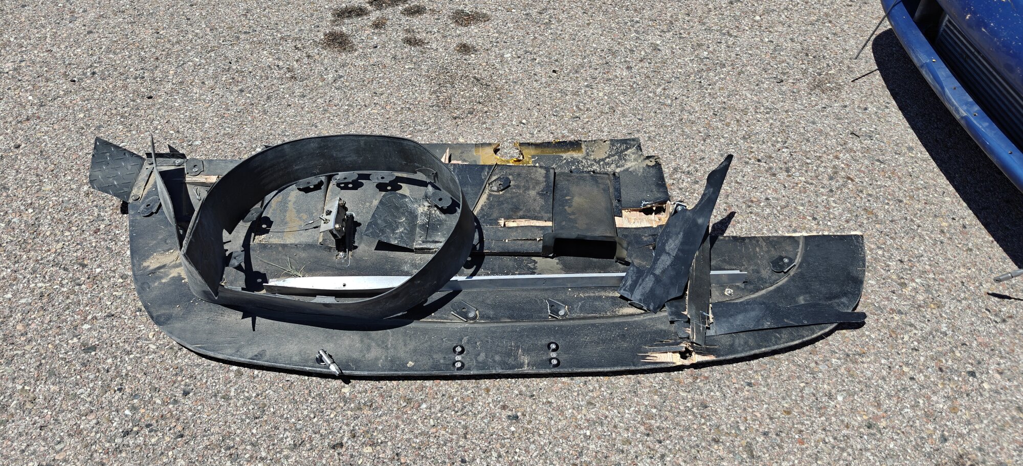

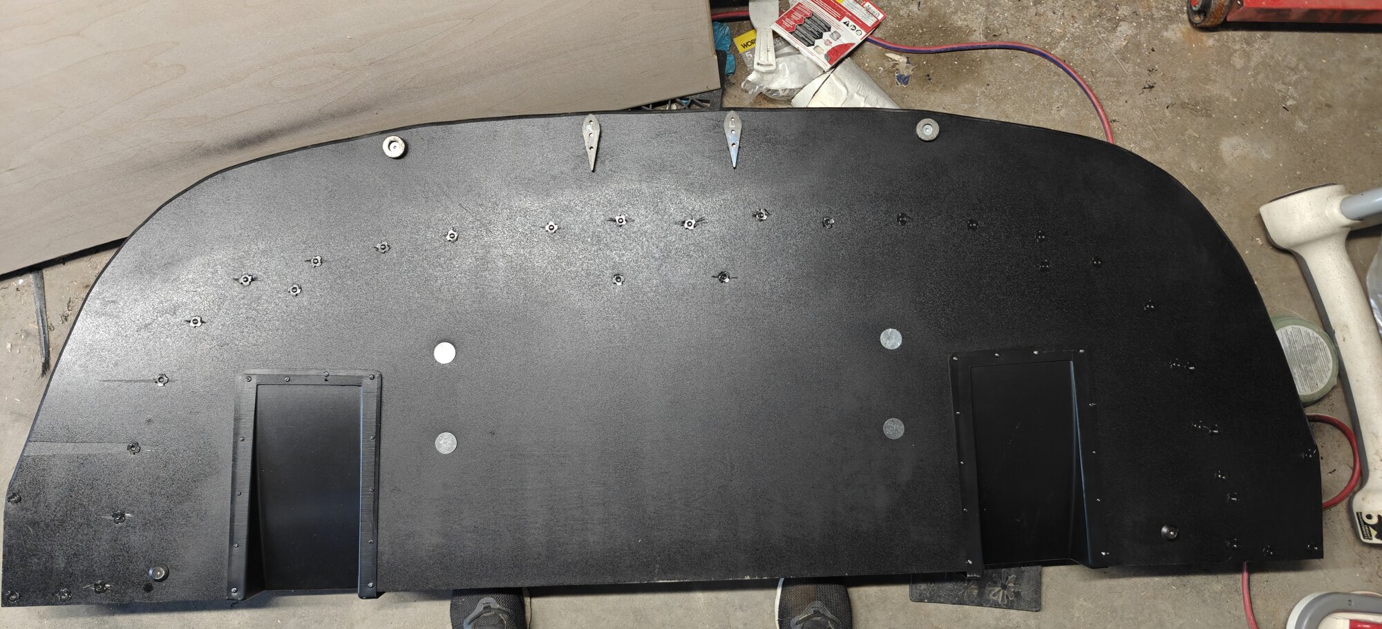

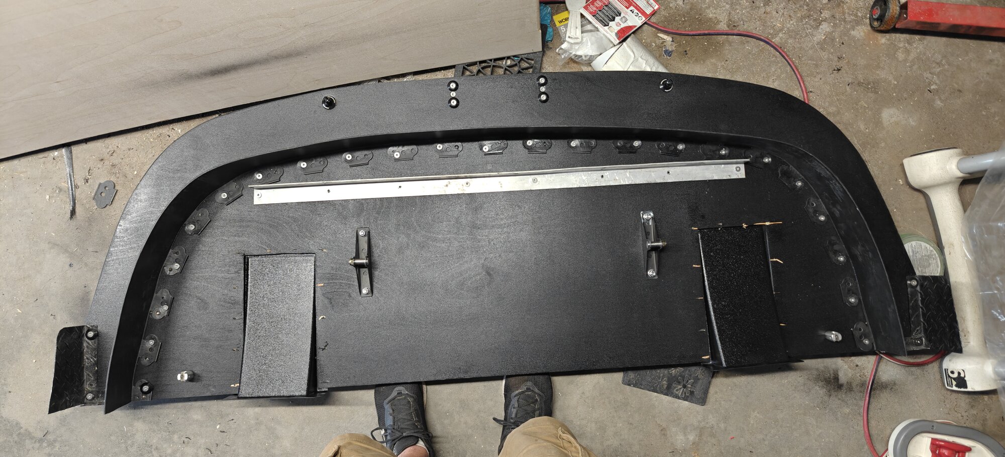

Rebuilt my splitter, 20 hours or so of work. Basically the exact same as before. Although I moved the placement of the support rods in the fender so they were easier to access.
Other then that I didnt do anything to the car.

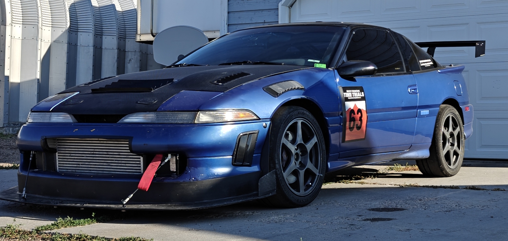

Ran a race at High Plains Raceway. It was 83-89 air temp, car was running too hot.
I boiled off a half gallon of coolant unbeknown to me. After last session car didnt come down in temp as much on the cool down and then in the pit it was getting hot at idle.
Any who, my driving sucked, I keep braking way too much. So I was a little slower then i wanted to be. Car makes too much power. I was hitting 148 mph down the back straight pretty easy.

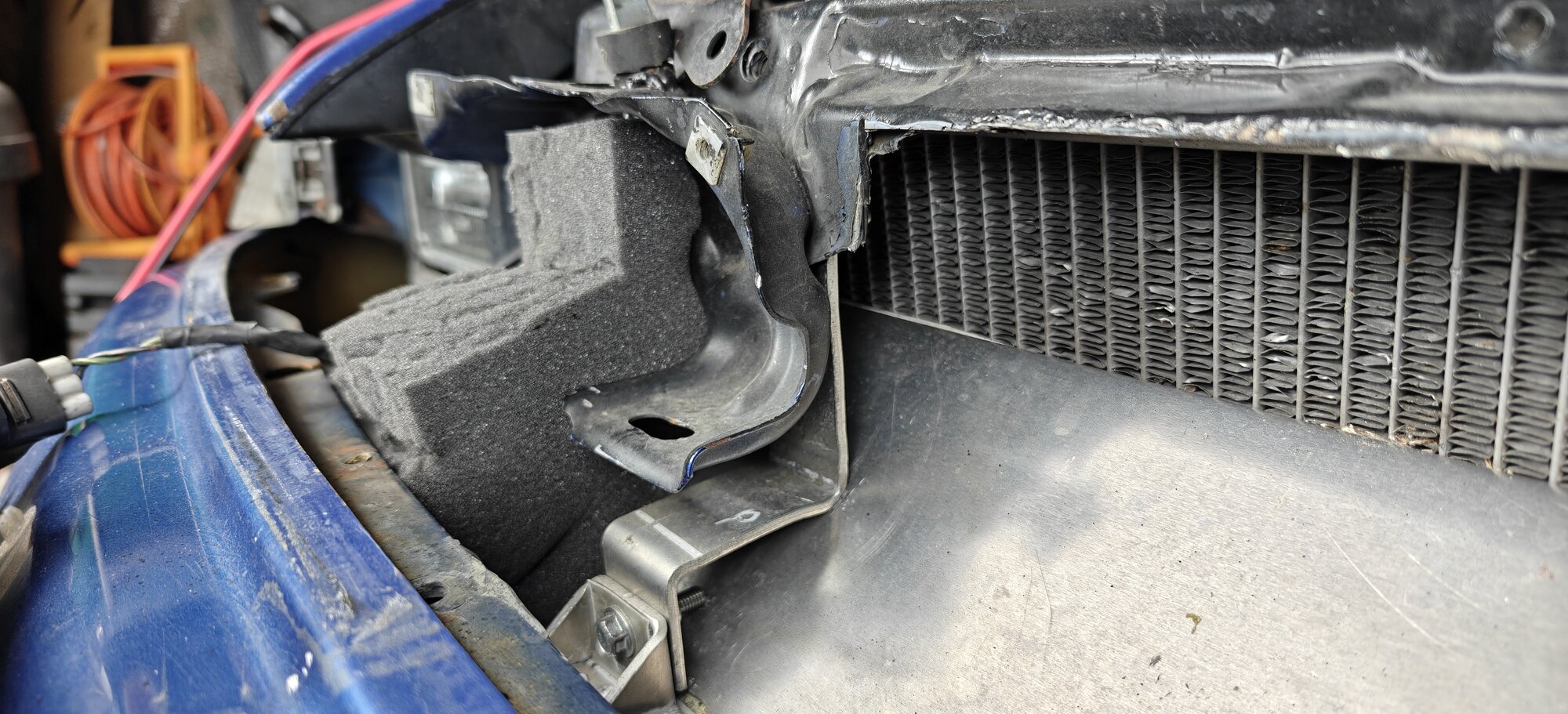

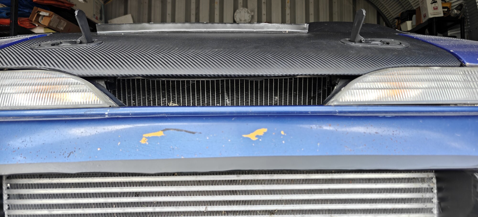

Cut the bumper up to expose the intercooler all the way. I think the angle behind the bumper was too steep and just producing a vortex of stagnant air.
Also added gurney flap to the center hood vent. We'll see how it does at the track in month.

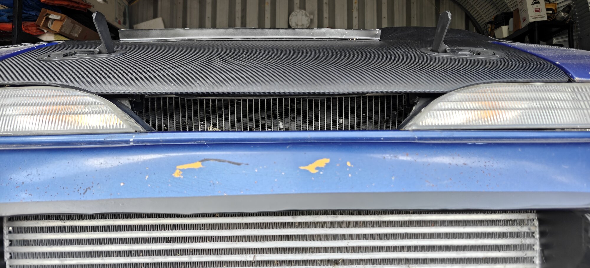

One thing I thought about doing once a while back, was putting a small fan at the base of the hood vent to pull air out. I don't know that it would help much, but it could make up for any pressure and heat build up that is being too stubborn to exit through the vent. Just because the vent is there, doesn't mean the hot air is necessarily moving through it, since there are other pathways for it to go.

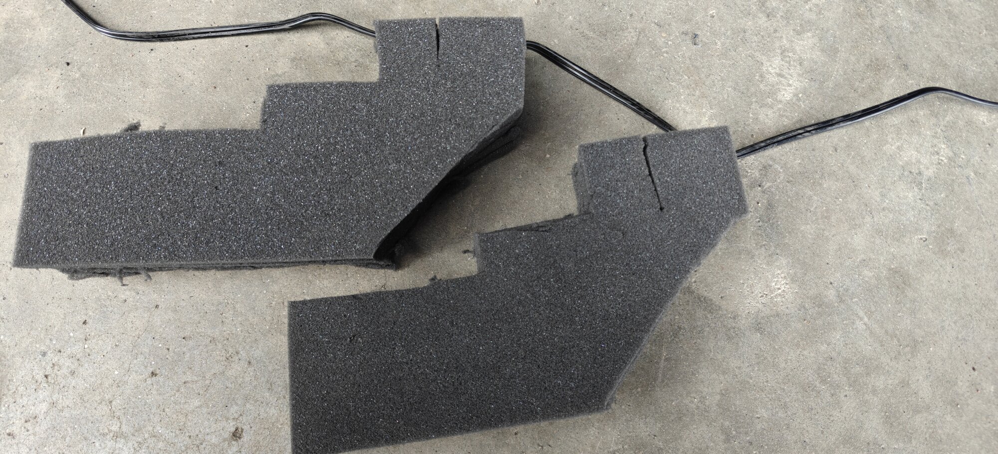

I'm going to seal up the whole front and make duct between the blinkers so air is only coming in through the radiator. I m sure the vent flows more then a fan could, but I have zero room anyways. Had to notch the vent to clear the manifold.

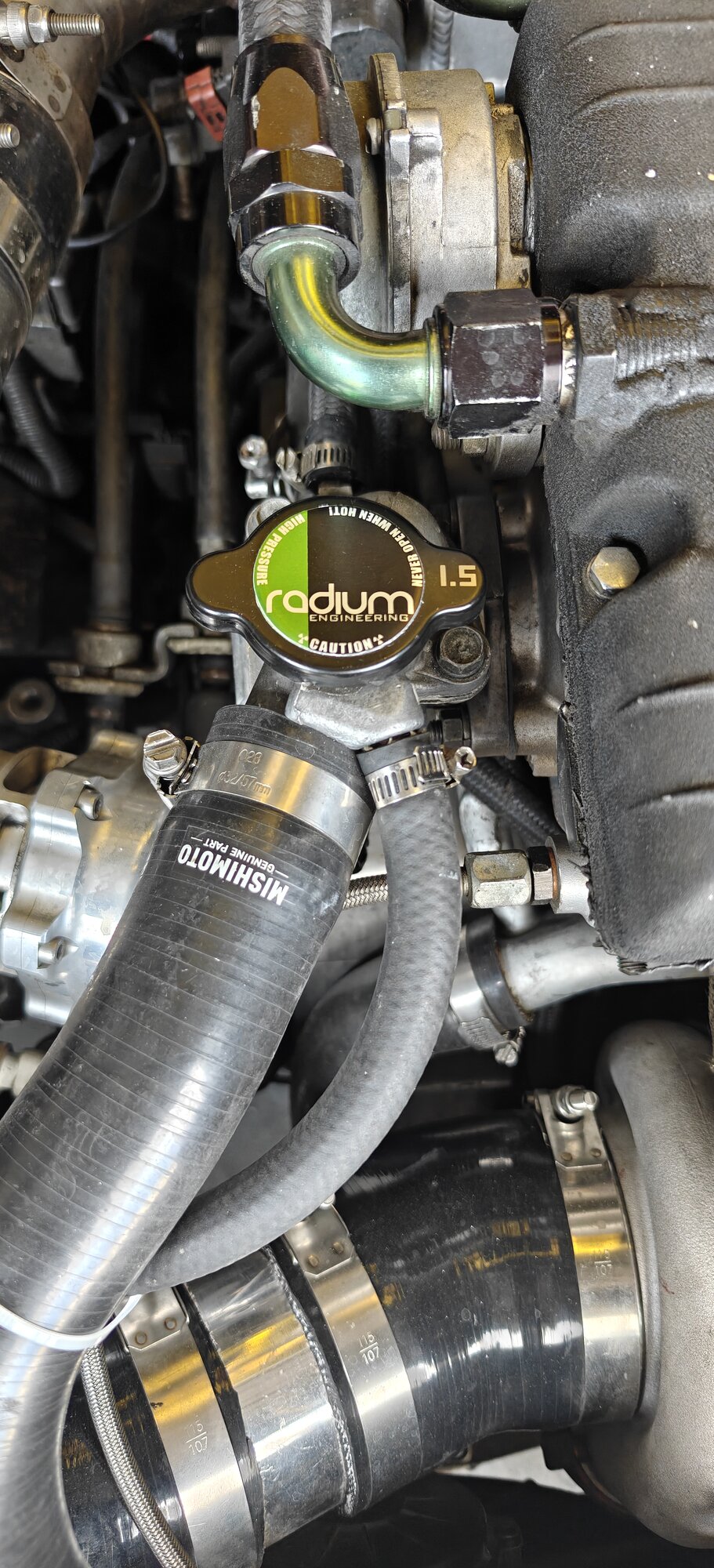

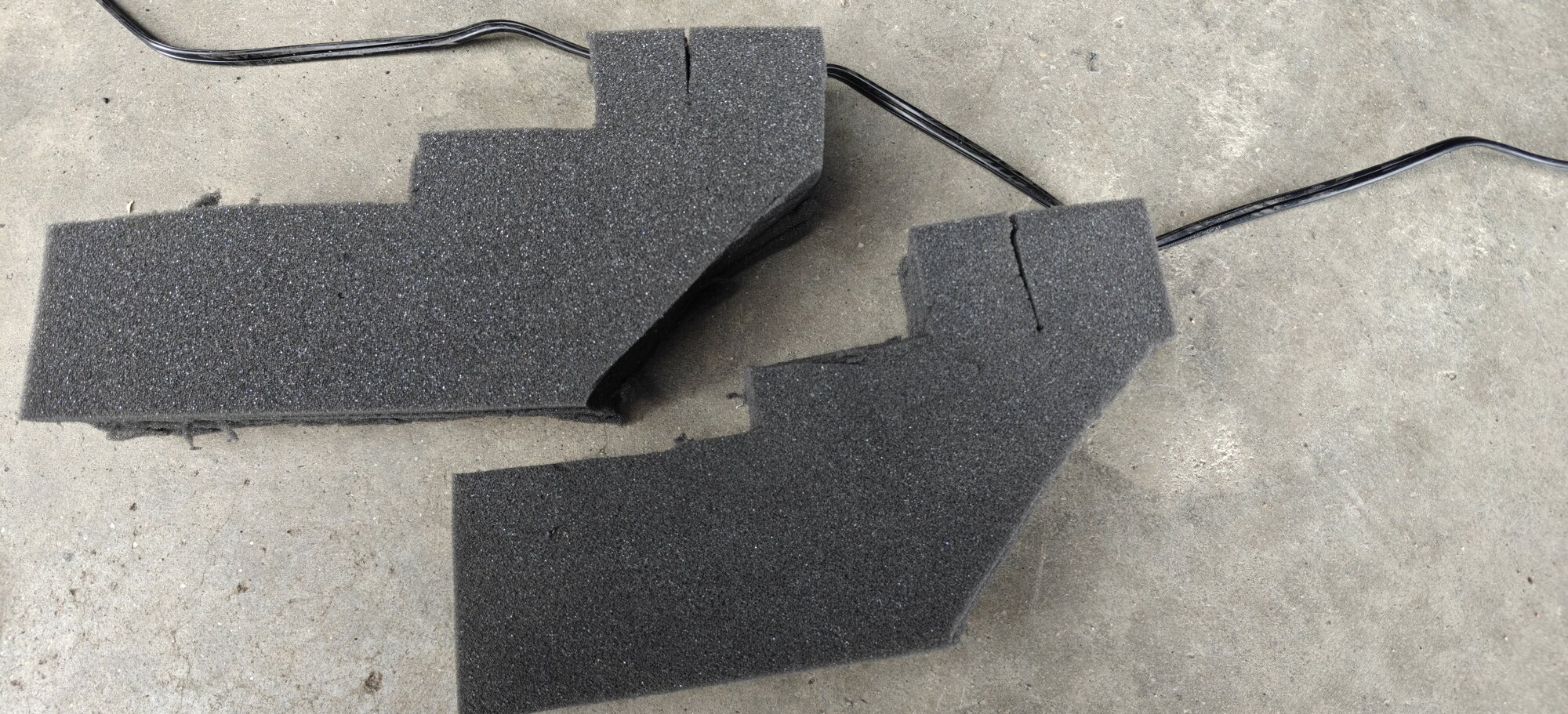

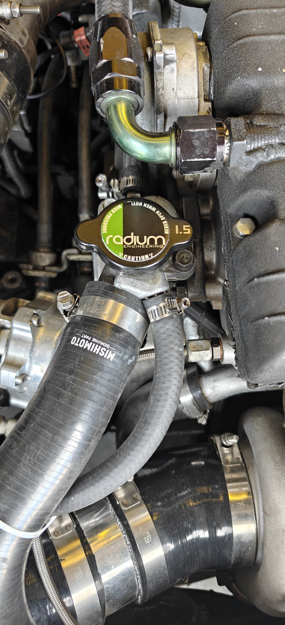

Cut some foam to stuff into the bumper and behind the blinkers to keep the air from spilling out. Removed the horizontal piece from the upper rad support hood latch area and cutout the hood latch stuff off the hood so it wasn't blocking flow.
Also put in a 22 psi cap to keep the water from boiling
I remember contemplating removing that piece but was worried I didn't have enough support for the FMIC... I should have just added some extra support and removed it.
