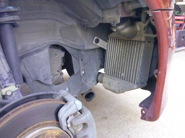

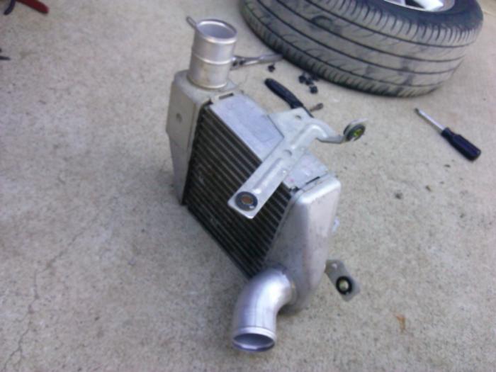

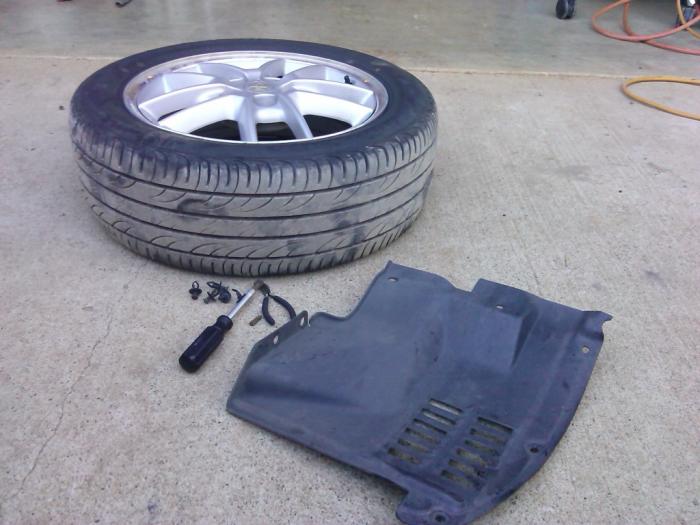

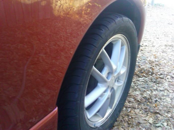

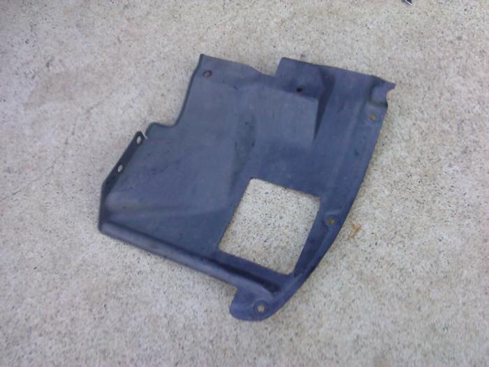

OK so cleaned the intercooler with gas and degreeser.
now she is nice and clean...then cut out the lovers behind it in the tire well.
And installed new premium pads all the way around...IMG_20140124_131603_248.jpg
