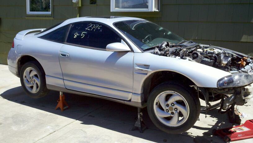

Bob_Goblin Time Attack Build
My first DSM and I am going for the something most folks dream of.
Bob_Gobblin
Proven Member
99
9
Sep 27, 2014
Salem, Oregon
  • Ownership Status:
    I own it
    Year:
    1995
    Model/Trim:
    Mitsubishi Eclipse GSX
    Turbo Type:
    Transmission Type:
    Manual
    Build Type:
  • 1/4 mile and 1/2 milebuild
  • Mods-Bolt-on:
    HID headlights
    Full cage is in the works.
    Mods-Engine:
    Manley Turbo Tuff H Beams
    Manley Turbo Tuff Crank
    Manley Platinum Sig Pistons
    Manley +1 MM valves
    Kelford 272/276 Hl cams
    Kelford beehive spring And Ti retainers
    DW300 fuel pump
    PTE 1600 cc injectors
    ARP 2000 head and main stud's
    ACL Bearings
    sx400s turbo
    Balance shaft eliminator (machined by Me)
    Block machine work done by me as well. every thing is with in 0.0001-2
    Mods-EMS & Logging:
    DSM Link V3
    Mods-Drivetrain:
    Dog Box trans
  • South bend stage 3 Drag (unsprung),
  • Custom rear diff cover
  • 300m trany and transfer case input shafts.
    Mods-Handling:
    Coil over conversion urethane mounts and bushings

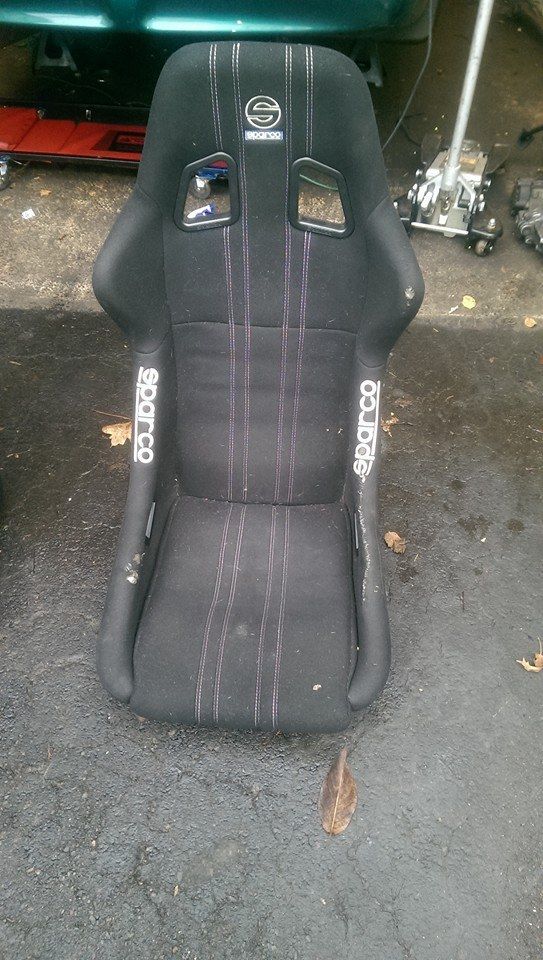

    Sparco F1 seats.
