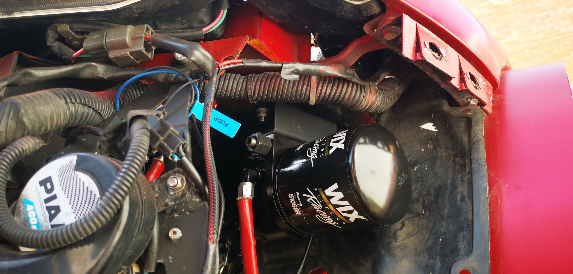

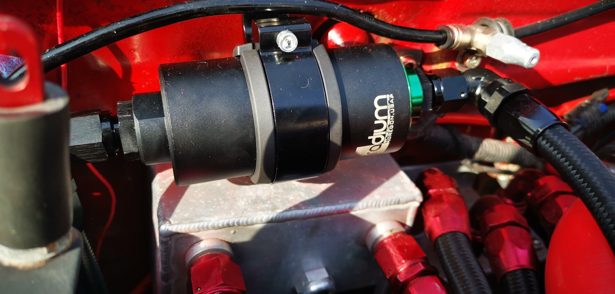

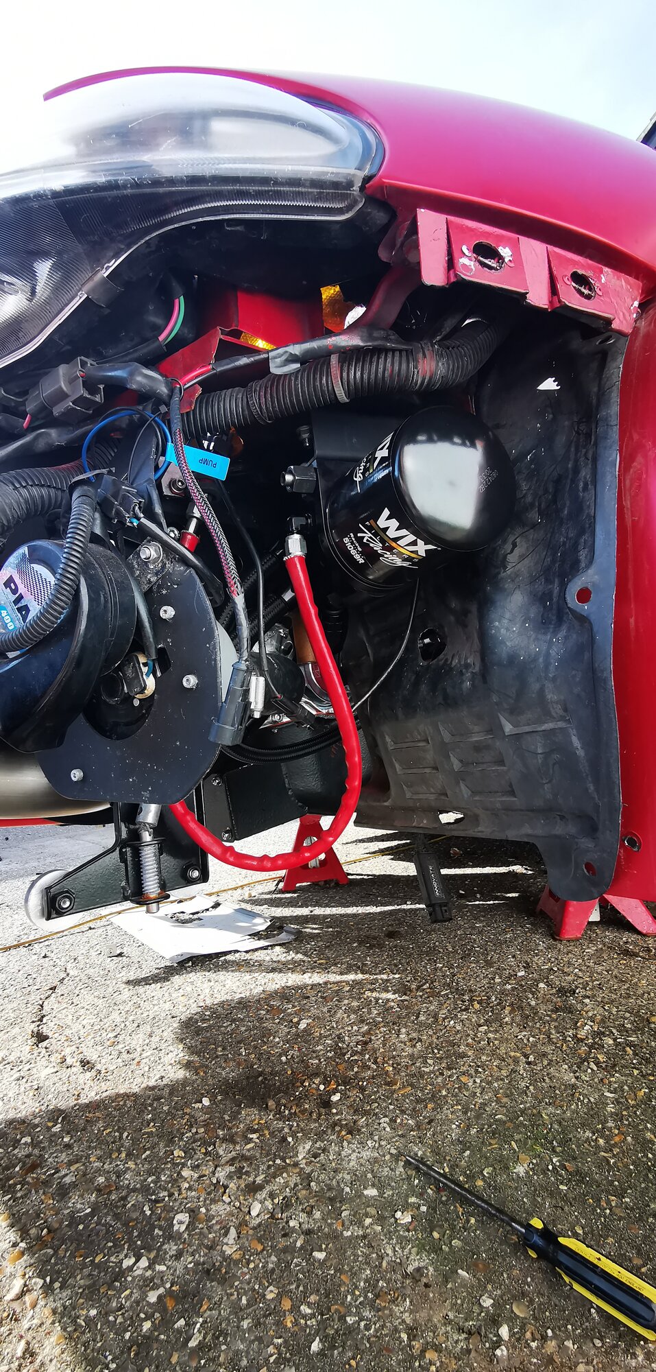

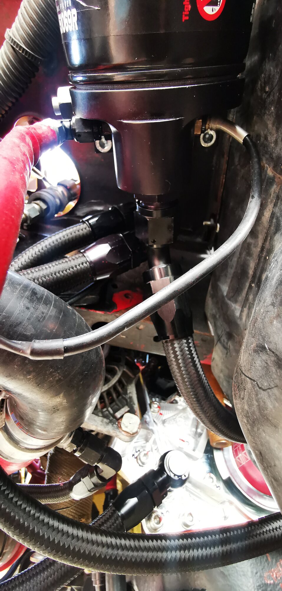

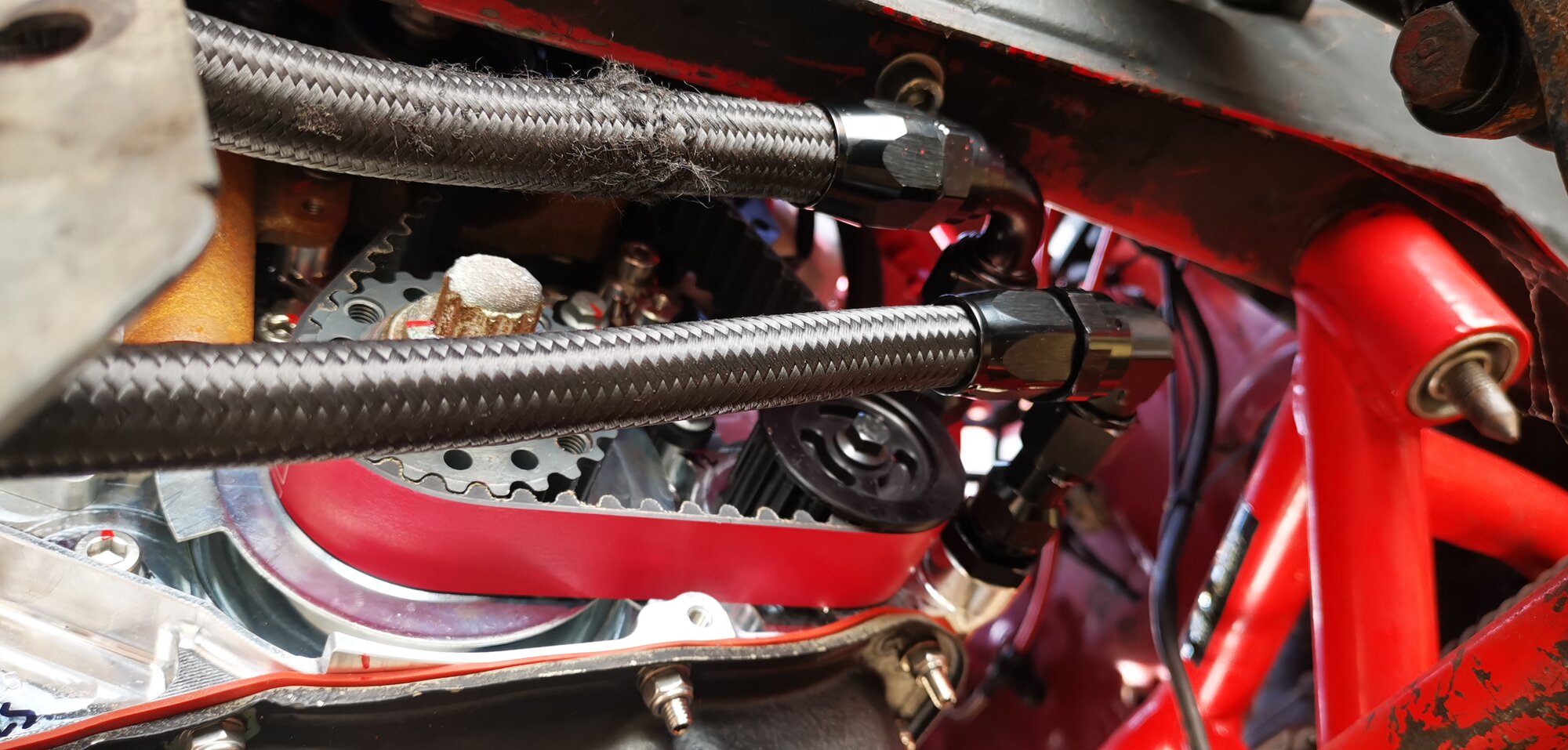

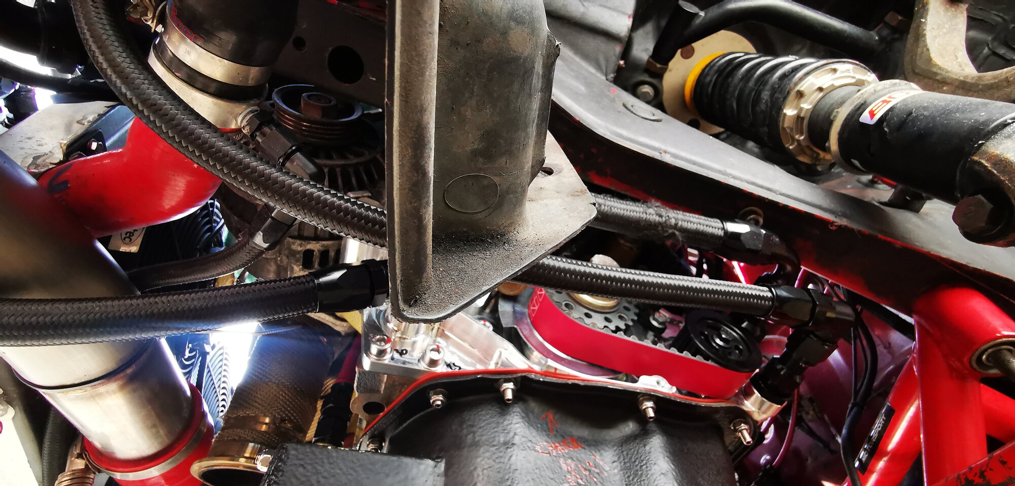

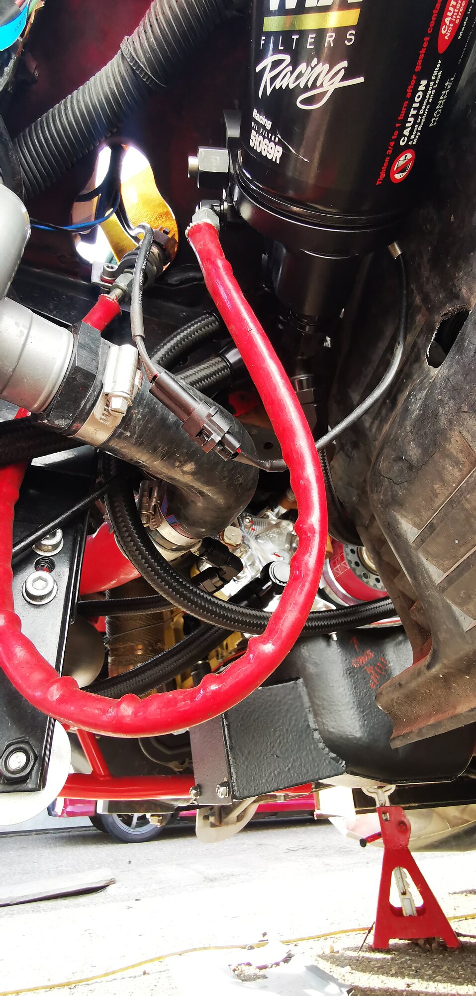

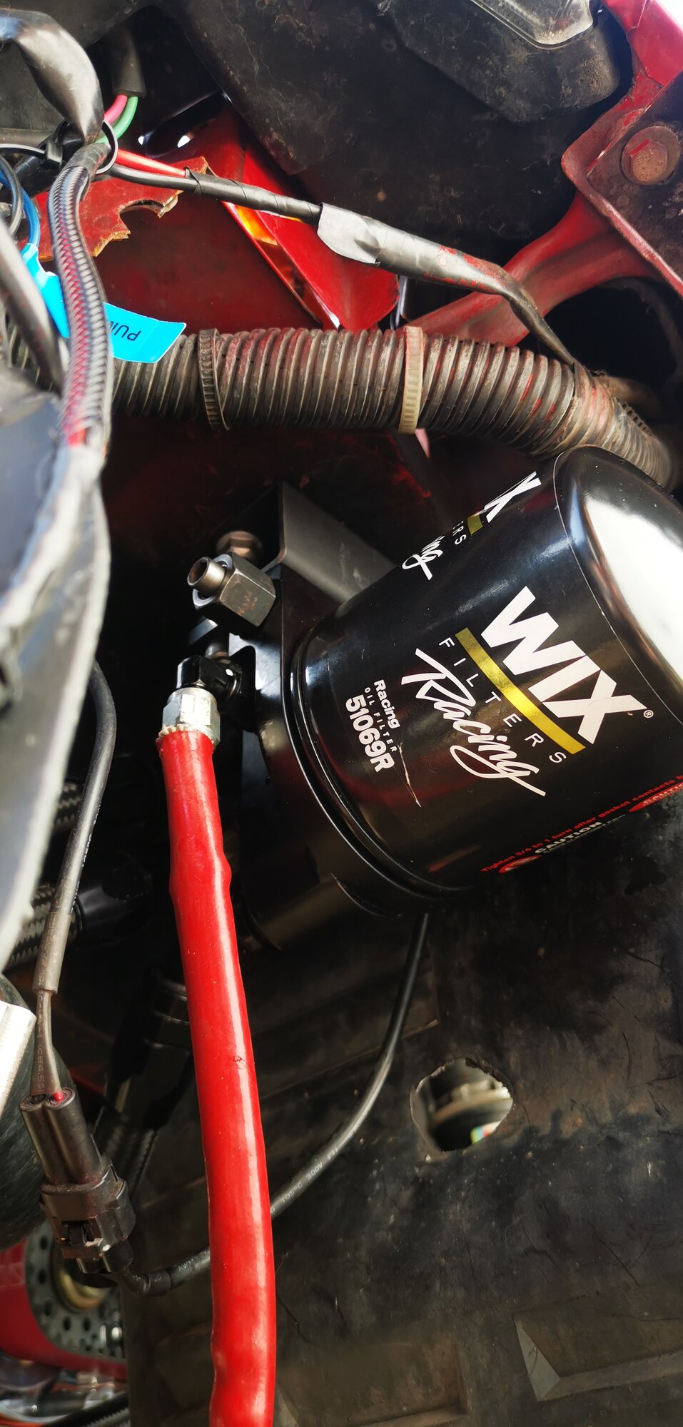

Things have been moving along at a steady pace. I made the new mounting bracket for the Aviaid OFH and then managed to get the lines all made up for it.
Since no one else seems to be using an external cooler I had to work out the routing based upon the info for the pump and housing.
So I got high pressure side to IN on the OFH to be filtered and then out to the oil cooler and from the cooler to the regulated IN port on the case. This means the oils filtered before entering the oil cooler which is what we want to happen. I also trimmed down the red spring a few mm in hope it does not add as much pre tension and create high Oil pressures! This should allow it to push the piston easily now the springs slightly shorter / less pre tension.i know how much i snipped off so can base that on the reading and adjust to suit later on.

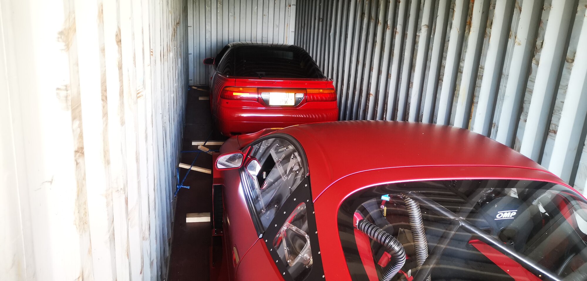

Oh and i bought my Talon home tonight so i have ALL 3 red cars in 1 spot! Never managed to do this before but wanted to take the Talon for a run tomorrow to work so thought a pic was right (even though the others are tucked up in bed 🥰🤣

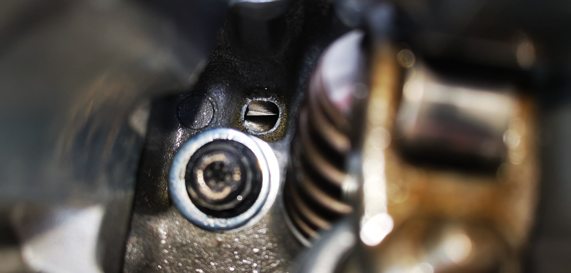

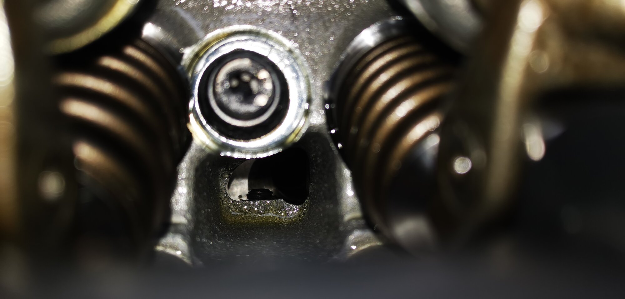

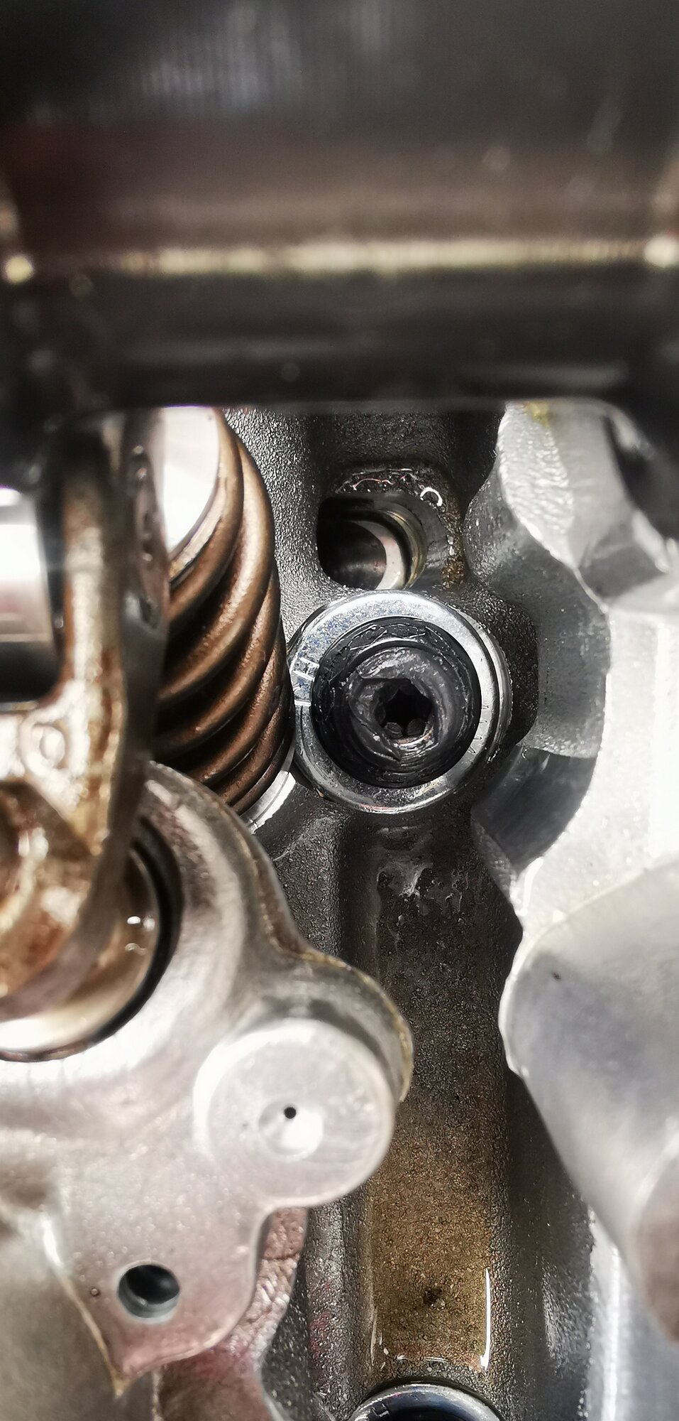

This part is to show you the REASONS for some of my block mods and you will see why I did them.
BLOCK MODS, you say??? whats those. Well, As I'm one for reading issues and how to make things as good as they could be I knew our drain system is not perfect. So for this reason, I went ahead and created recess portions in the block and this allows a smoother flowing oil way for the way back vs building up. Since you want it all as smooth as possible, it will help cover a larger surface area for the drains and allows a faster return to take place also.
Check out my pictures to see what I mean, and you will see why I opted to do this!

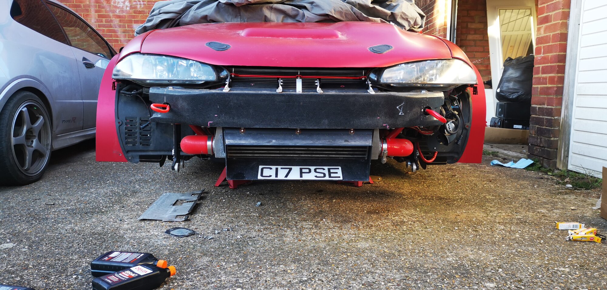

Plus a few snaps of the front with the bumper off. Just because 😁

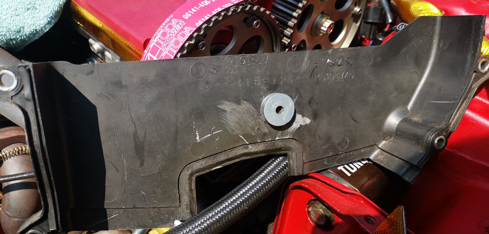

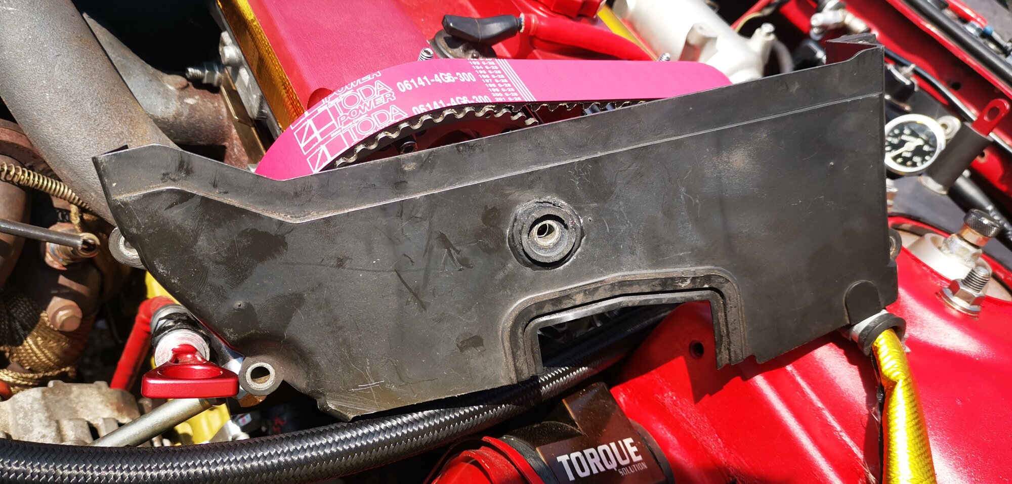

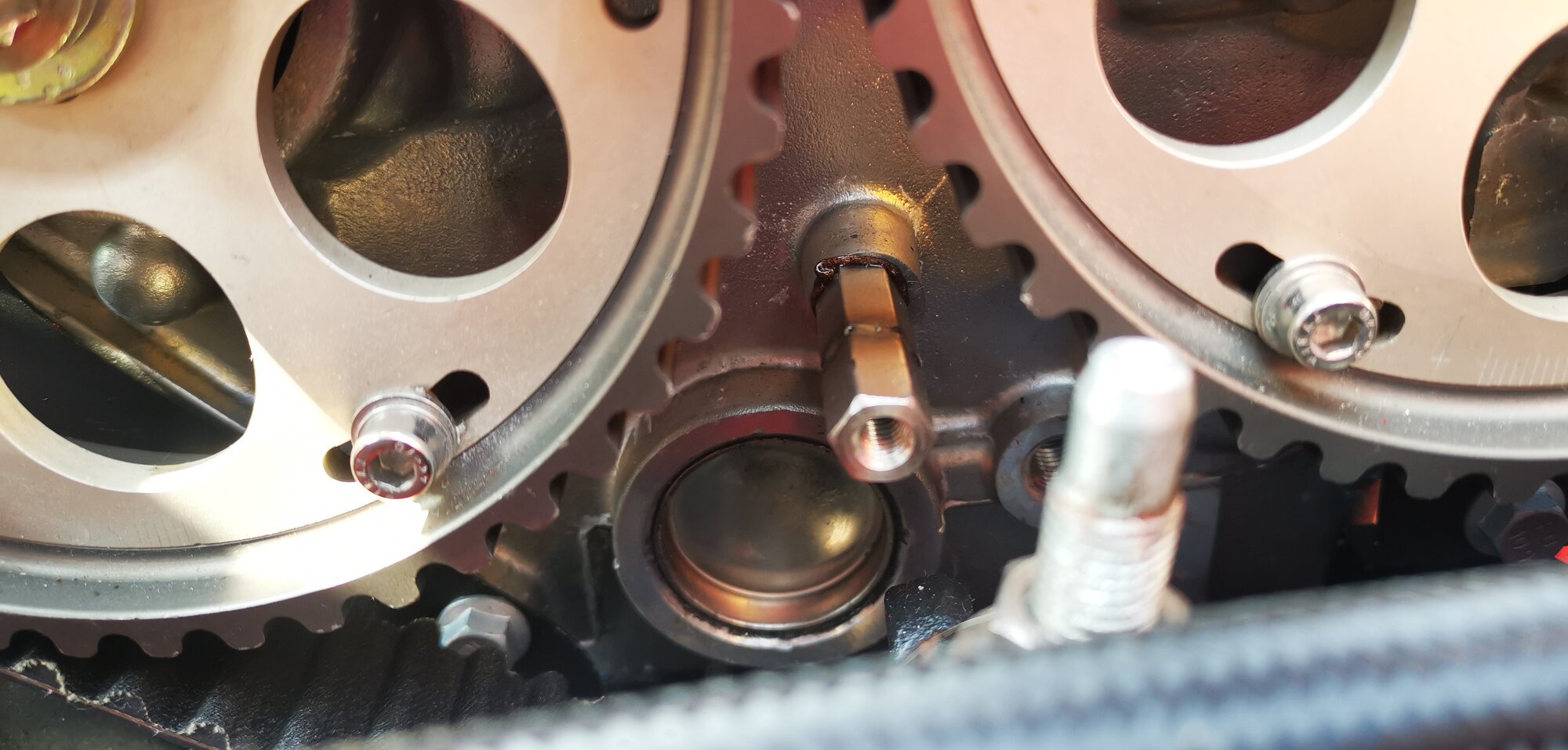

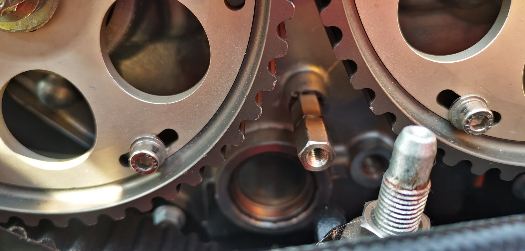

Along my way i wanted a mid cover thats very easy to remove so I came up with this simple solution! Makes life alot easier and no mount is needing to be removed for this to fit! Flexible and fits nicely like this
The head stud part is a long grub with 2 hex welded together so they can get tight and then allow a bolt from the outside in. Simple yet glorious to use. Turns a 30min job into a few mins and no need to support the engine for the mount removal either 🤘🥳

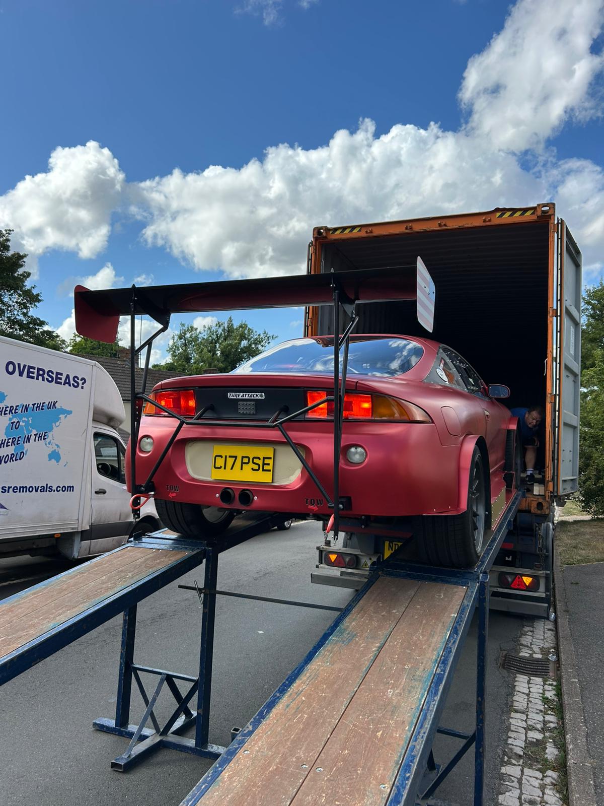

So today is the day!!! Both DSM's are now loaded and on their way to the USA! Will be arriving to Florida by the end of July so need to find someone local to Miami to have both transported to Orlando. But i got time to find some one for that hopefully.

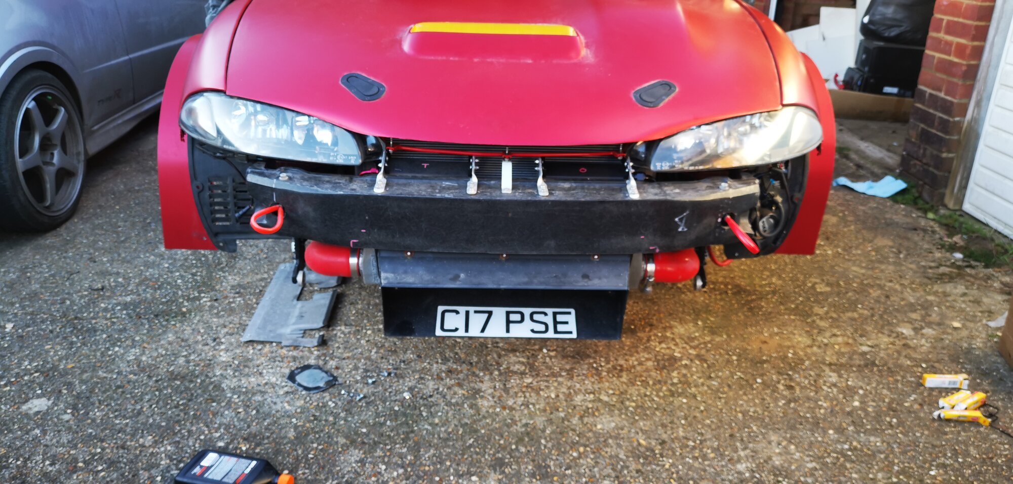

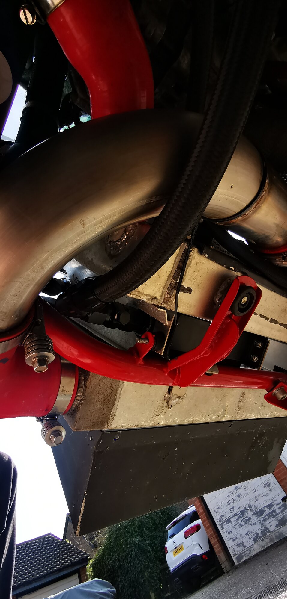

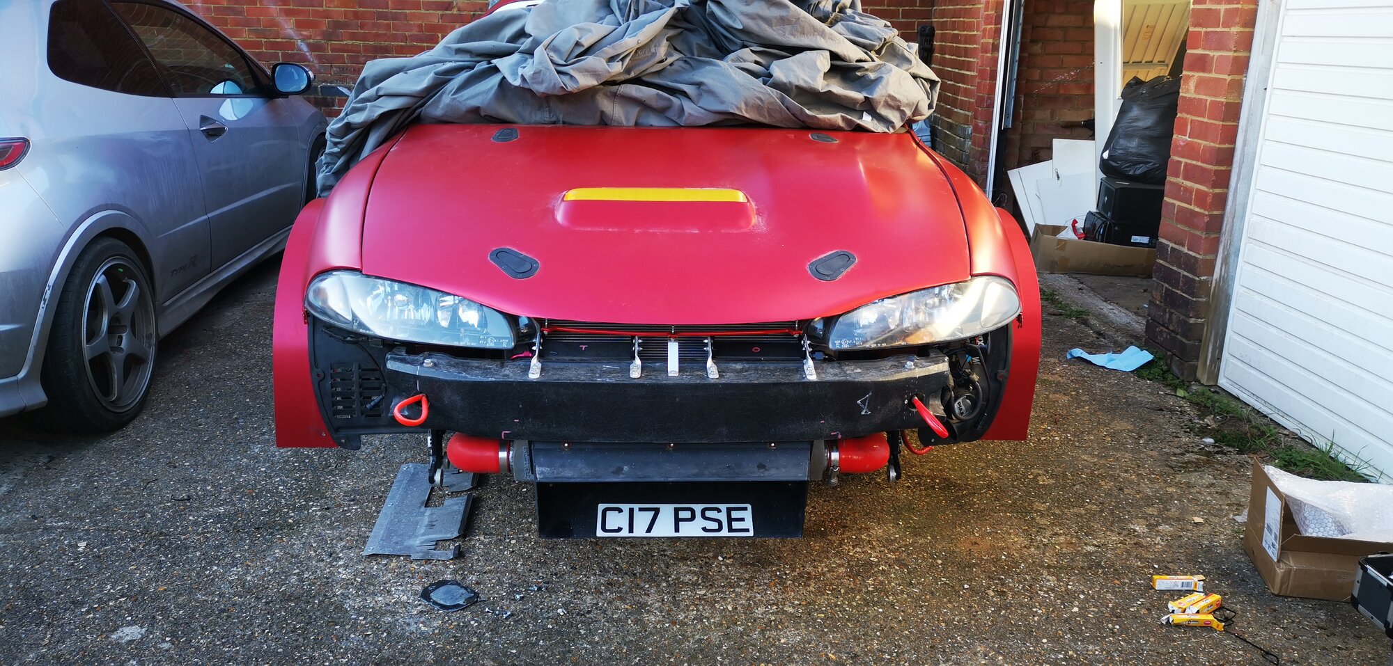

Not much happening yet, got it on axle stands now as im going to do some checks since the build and run and check it all out.

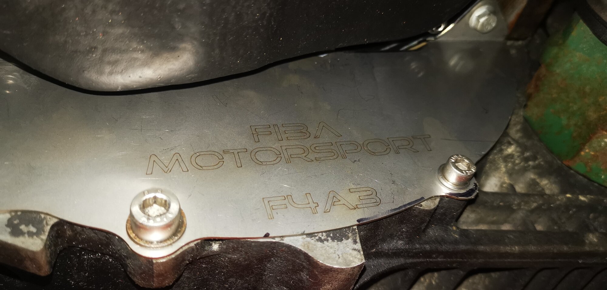

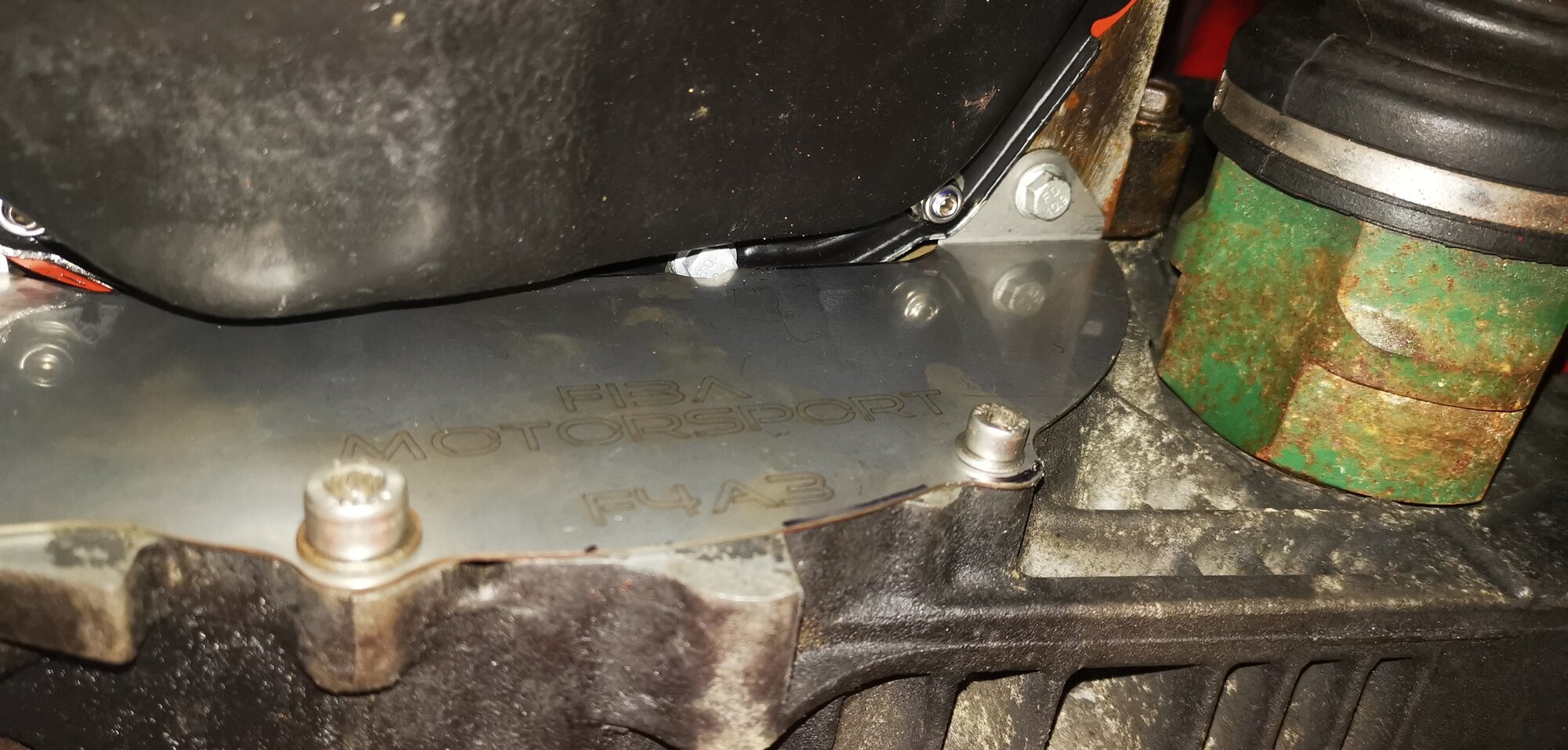

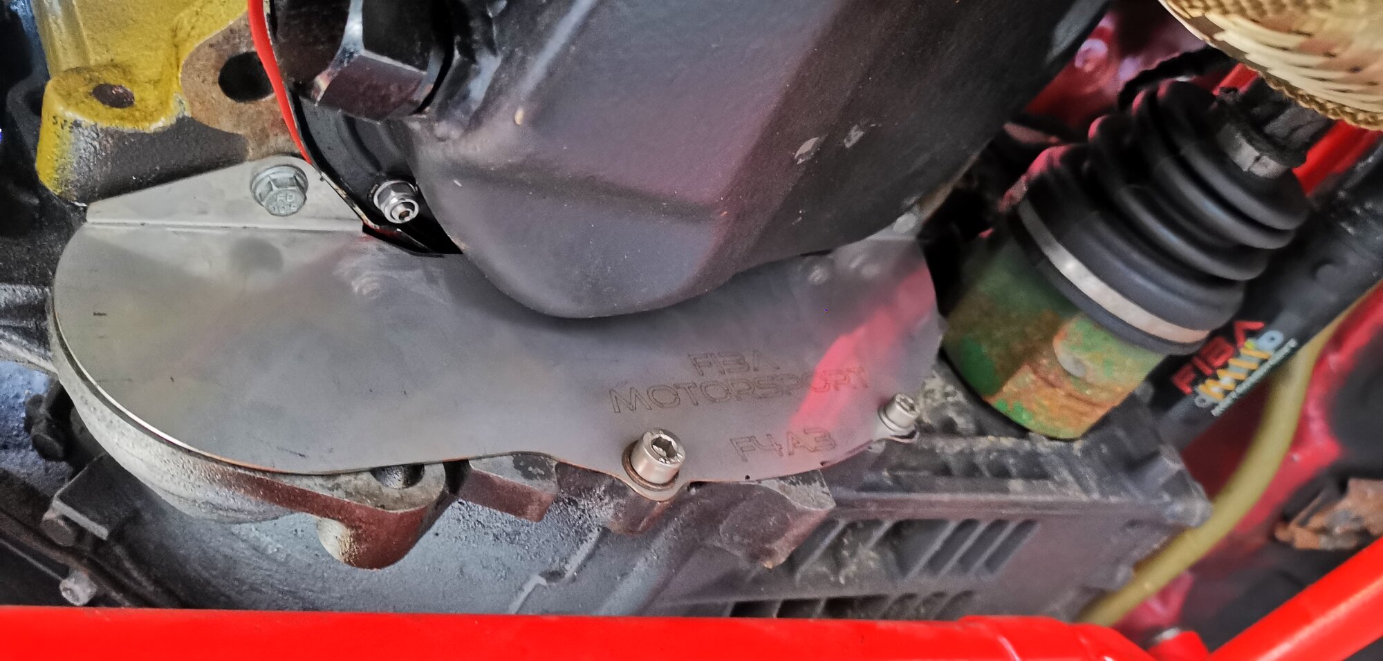

Only other thing currently is i checked fitment of my new Stainless inspection cover plate. I wanted a nice looking once for some time now and finished it before I left but never had time to final check it. Looks real nice under there
Next steps is to get the car checked over and then get a plate on it as i wish to go to some cars and coffee meets in the 2G in the cooler months LOL (feels odd saying backwards things vs the UK)
