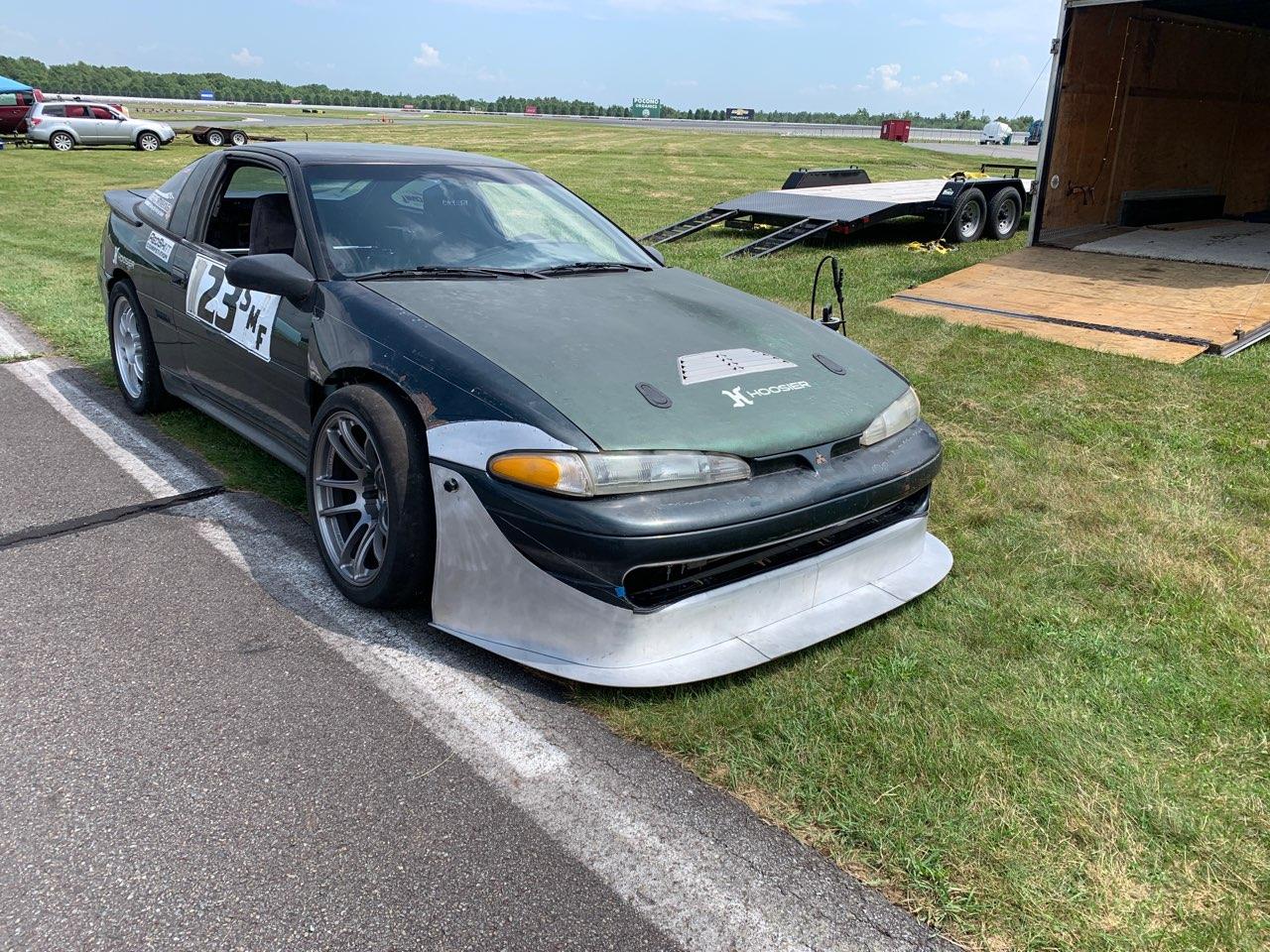

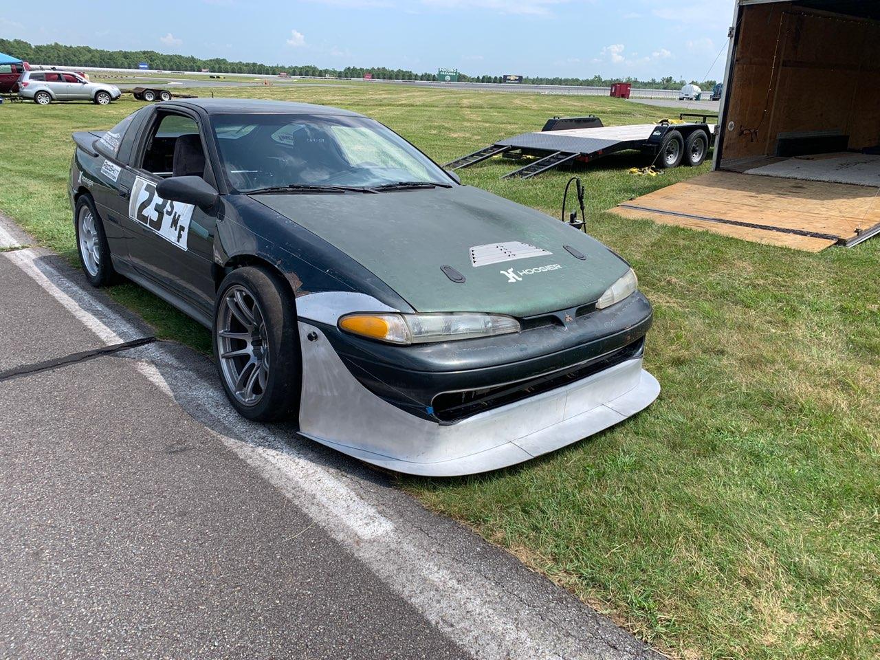

Hi everyone,
I'm late to getting a build post on here, so here's what I have so far and I'll keep updating. This is an inherited, forever car for me, so I'm purposely building this car instead of another with AWD or a better chassis, or an original turbo model.
1993 Mitsubishi Eclipse GS fwd 2.0L model originally - approx 145k miles on the chassis
-swapped on a '91 large port turbo cylinder head, intake manifold, and cam (still hi comp 9:1 NT pistons for quicker spool
-cx racing 16g turbo and tubular manifold
-3" O2 housing and downpipe, fully wrapped
-ebay 550cc injectors, walbro 255 pump
-swapped in turbo ECM and added eBay knock sensor
-Maf translator w GM 3" maf
-all 2.25" ic piping and larger front mount intercooler
-74mm throttle body and port matched manifold inlet
- a/c, factory p/s, emissions items all gone
- battery relocated to hatch and Volvo electric p/s pump mounted in that space on the firewall
- currently down to 2526 lbs in race trim
- subframe removed and reinforced along with polyurethane bushings in every front and relocation that they were still available
- upgraded front and rear sway bars
- 800/400 springs on tokicos (proper adjustable coilovers coming soon)
- outlander 2 piston front brake upgrade
- 18x12 fronts with 315 Hoosiers, 17x8s out back with 225s
- large front splitter and under tray

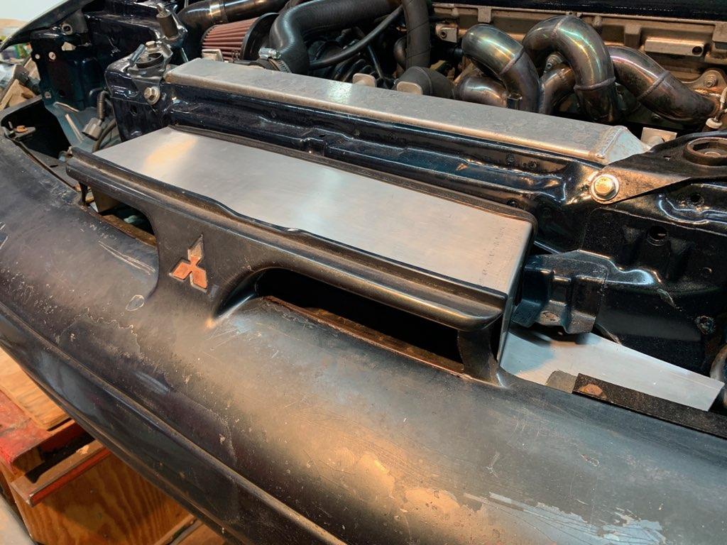

- homemade carbon fiber hood with louvers and latch removal
- fully shrouded front bumper to intercooler/ radiator
- larger aluminum radiator
- AWD Intermediate shaft with equal length CVs
- race seats and harnesses
- momo 320mm flat bottom wheel
And a bunch of stuff. I'm forgetting over 20 plus years of ownership, but I'll keep updating 🙂
