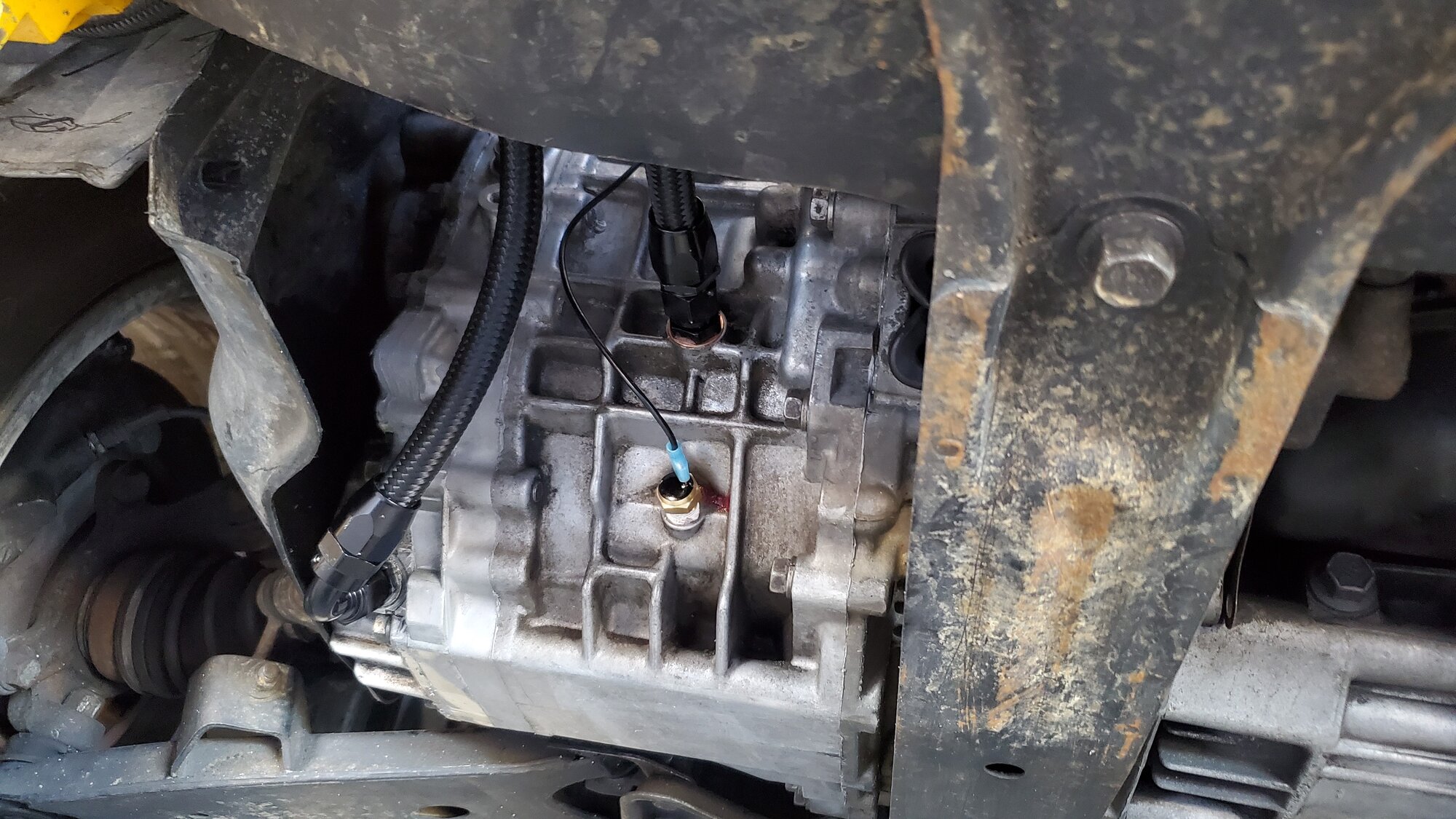

Here is some old pictures from when I did a transmission cooler on the manual trans.
I did notice the majority of the heat the trans picks up is just heat soak from the engine. I can do a session and it doesn't get hot enough to kick on.
Sitting in the pit the engine heat soaks the trans and the cooler will be on first thing for the next session.

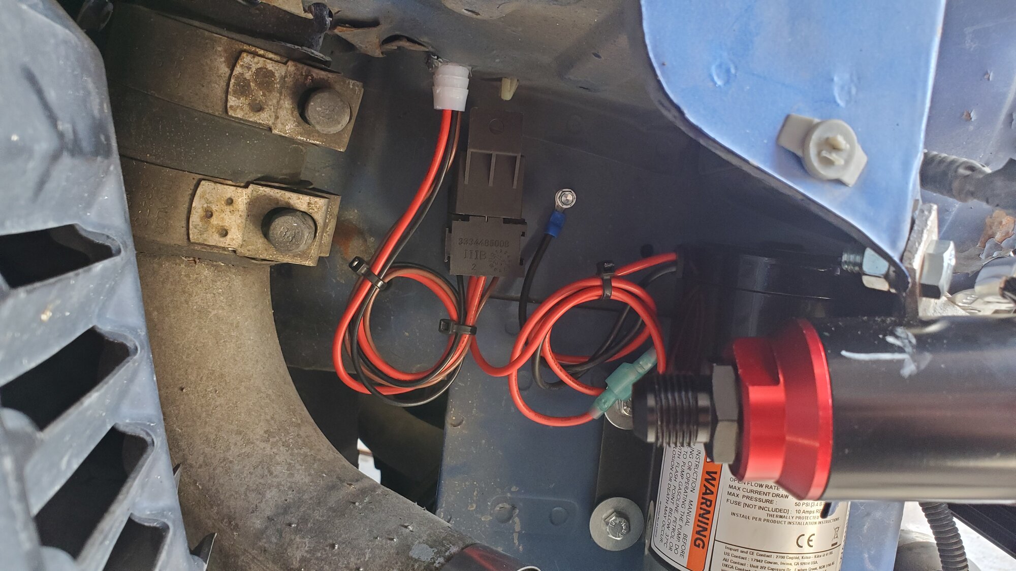

I used a Tilton continuous duty pump and wired it up to a 180 degree temp switch that I tapped into the trans case.
Feed is plumed from the drain hole, through a filter, to the pump and returned to the oil fill hole.

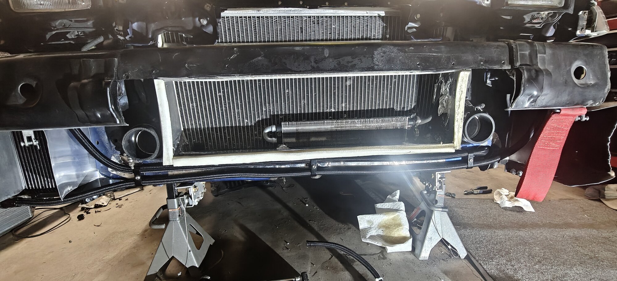

I'd like to redo the oil cooler with something fitted better, but that would require me to move the pump a little to I have room.
I have it feed the front half of the oil cooler air from the bumper and then the air exits back through the back half of the cooler. Picture was when I was still working on the duct.

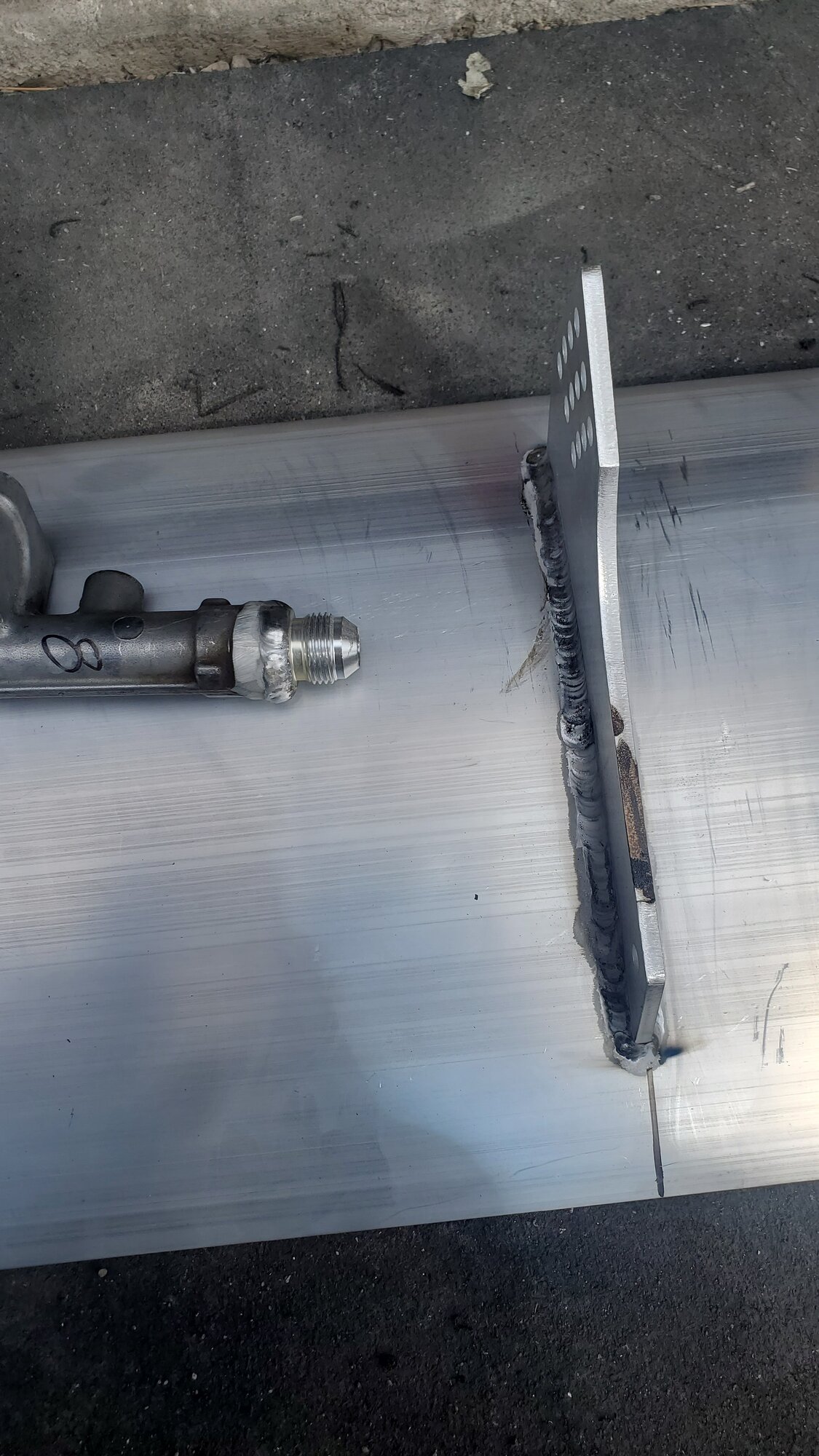

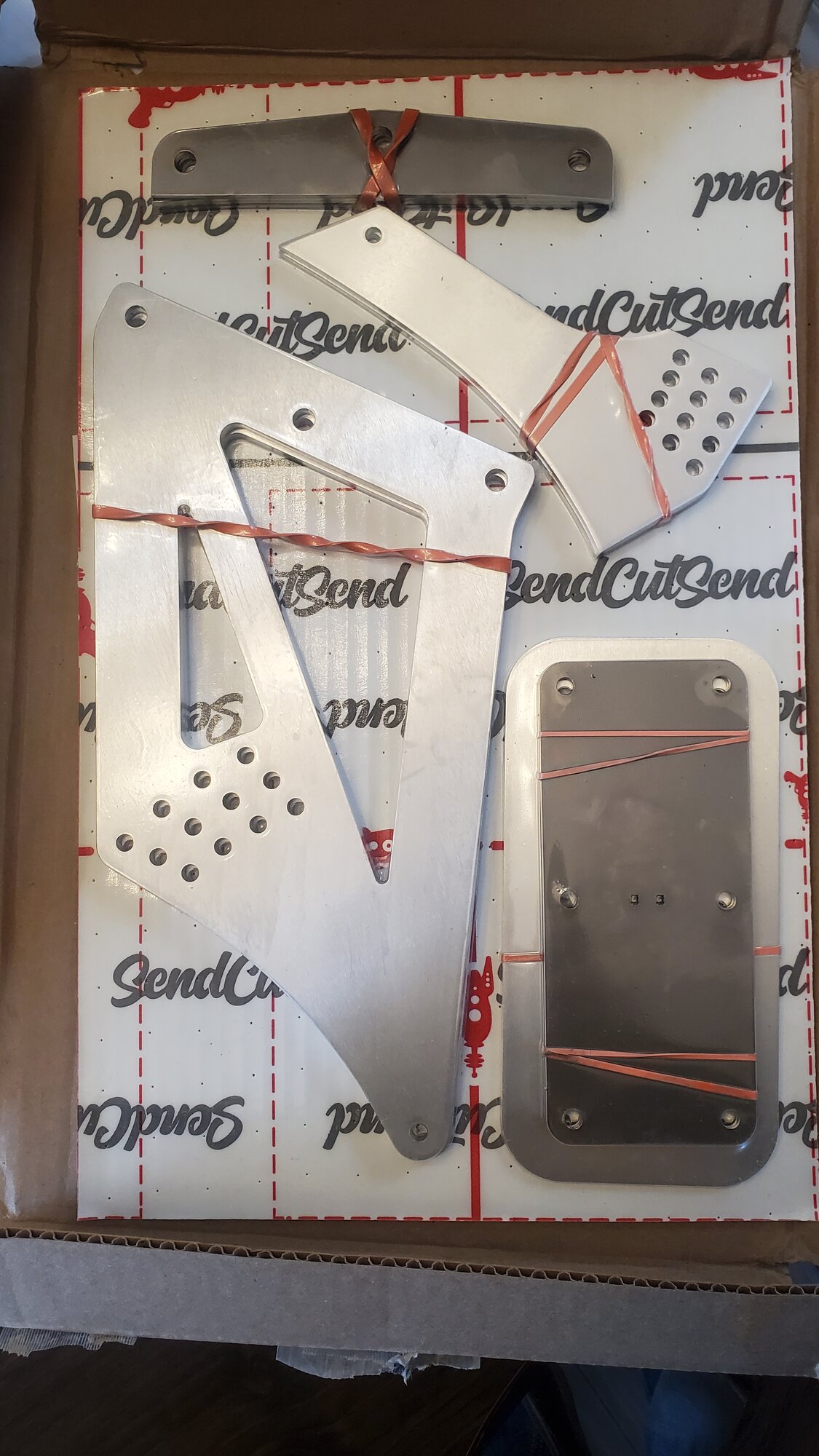

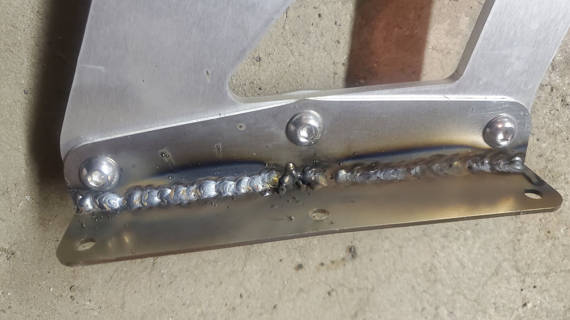

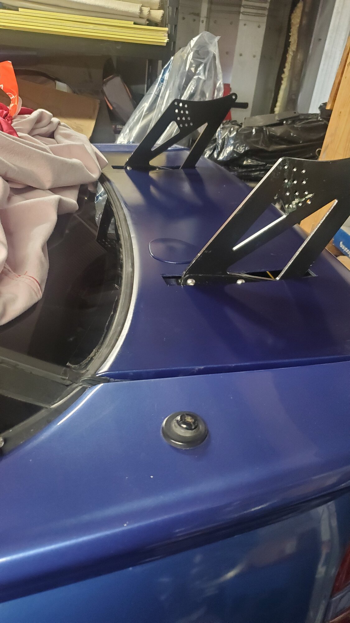

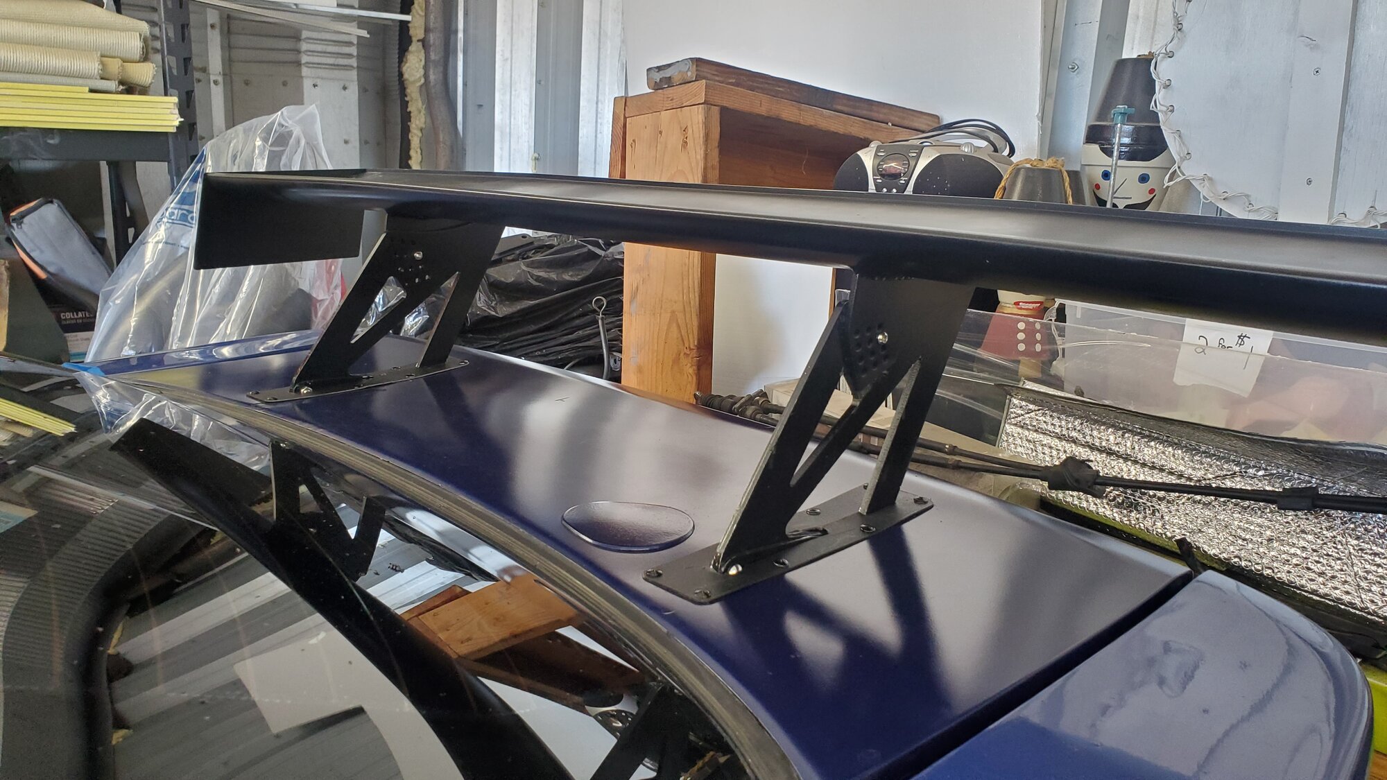

Here is how I mounted the wing.
My buddy designed the mounts and had sendcutsend make them
I welded it together for the bottom deck mount. The sandwich the thin steel of the rear decklid
I picked up another spoiler, repainted it and cut slots out to pass the wing mounts through
Wing is a 65" from Wing-logic, neighbor welded the mounts to the wing
I cut come ABS up to plug the hole up in the spoiler. Painted the wing black

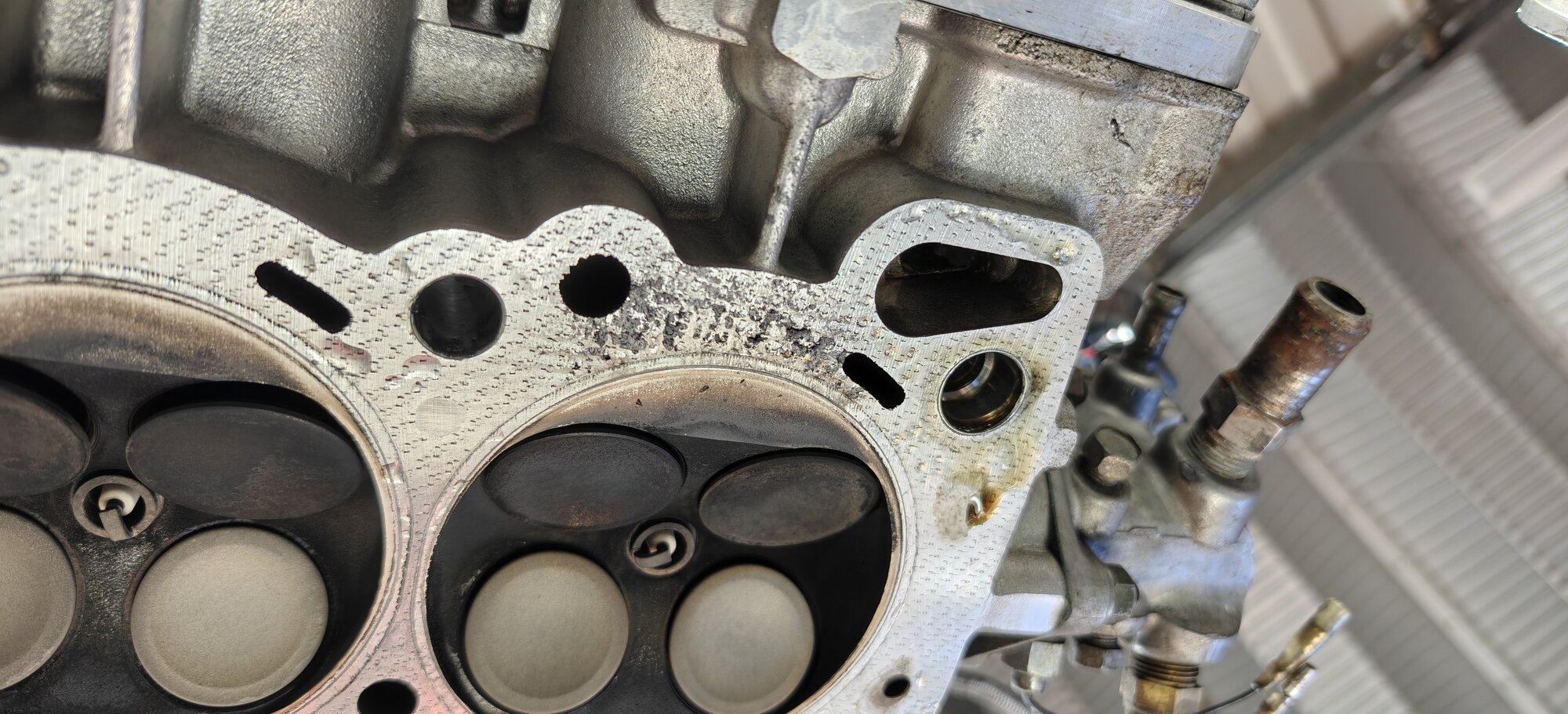

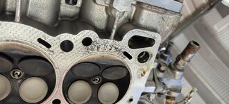

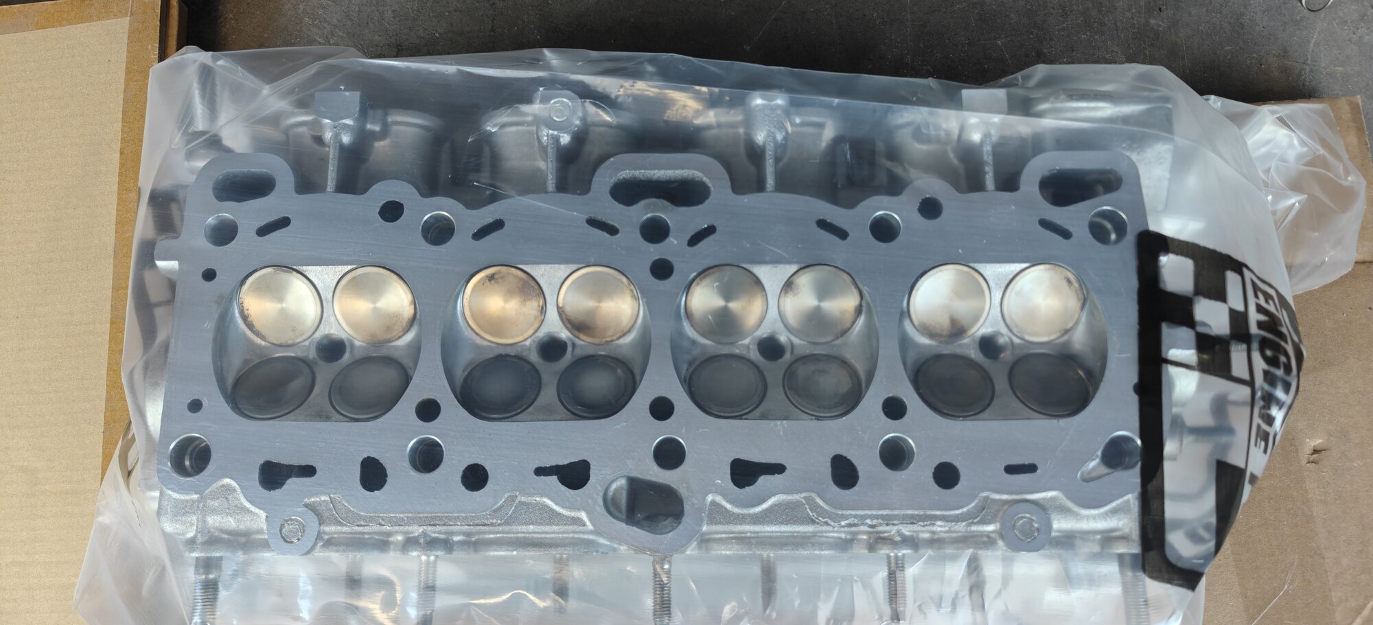

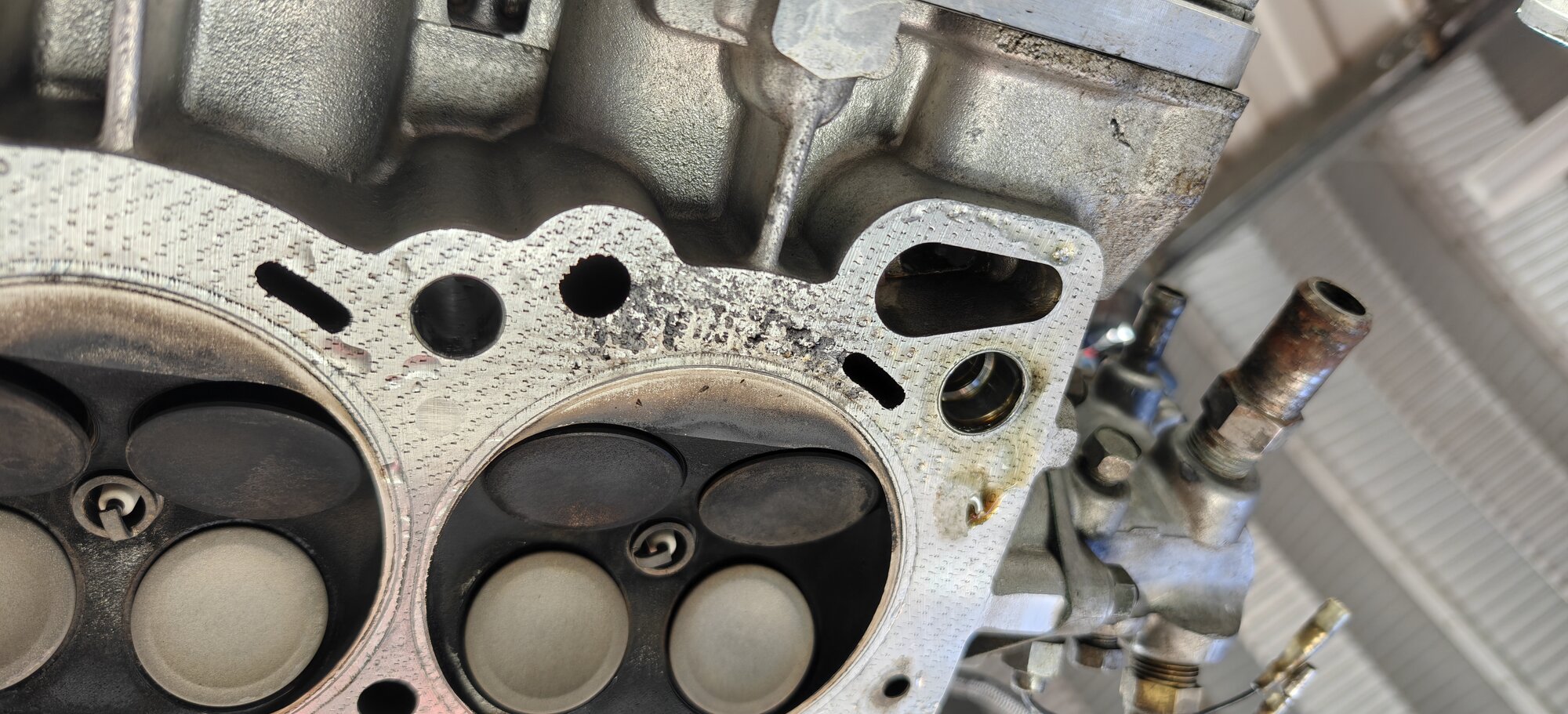

Pulled the head and scraped all the composite material off, put in a Felpro Permatorque MLS
I think this is where it had the slight leak. Going to hit up a open lapday this weekend and see if things are fixed for next season.

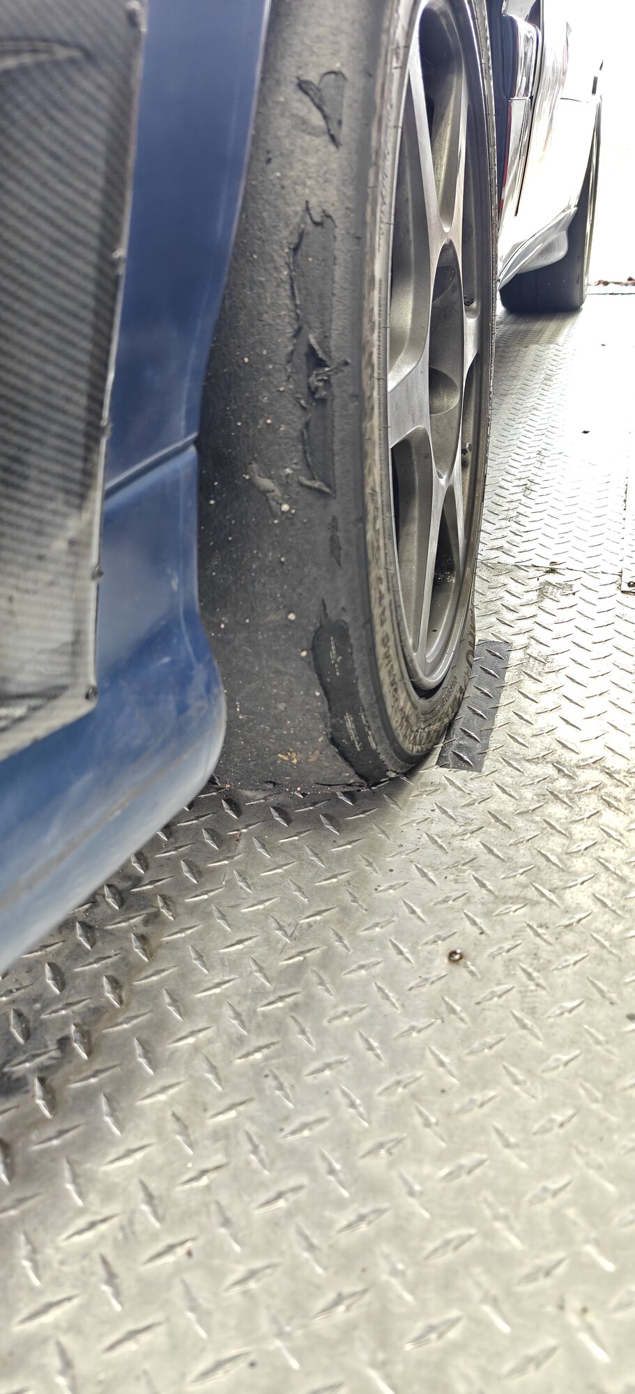

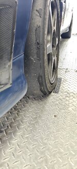

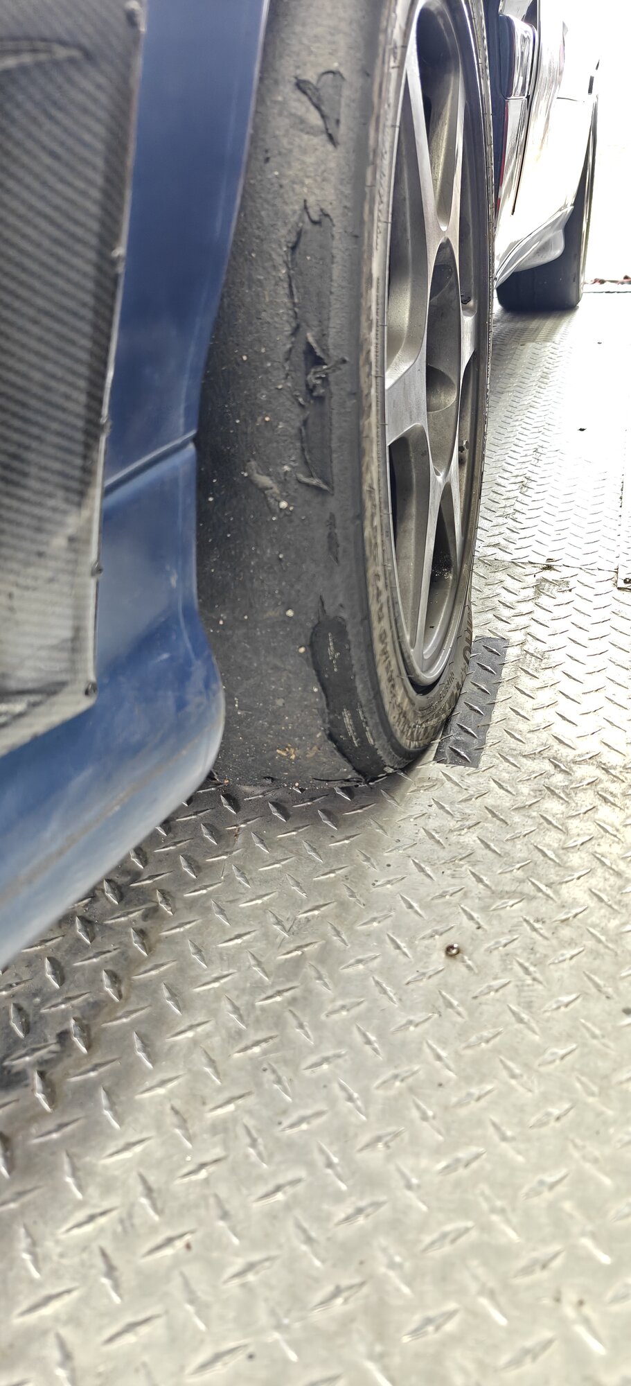

My worn out tires had no grip first thing in the morning and I went 4 off while just doing a warm up lap and damaged the splitter which then broke two laps later when I hit the brake at 147 mph. It tore the support rod through the splitter and was flapping in the wind beating the pavement. Apparently quite the light show from sparks off the titanium skid puck!
Ran the rest of the day with no splitter. Wow, that really reduced my braking ability and made the car understeer noticeably.

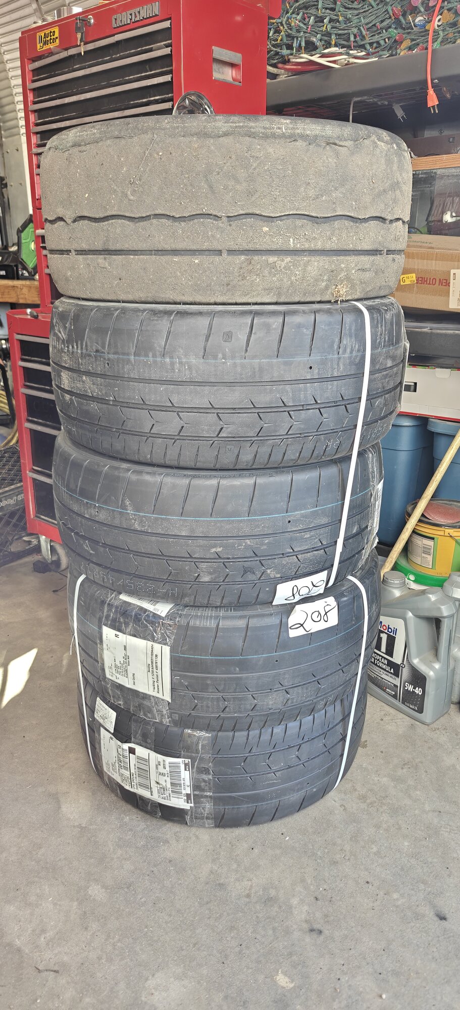

Used up the tires, basically got 9 track days out of them (10 technically but that last one was only a couple laps). This tire leaked all the air out on the drive home. Corded 3 of them.

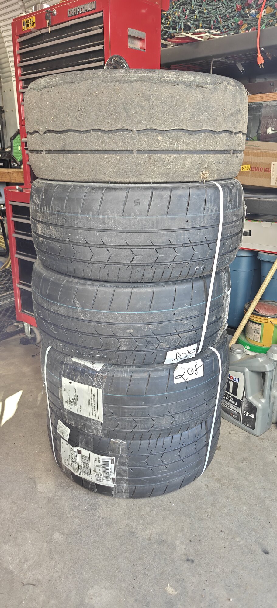

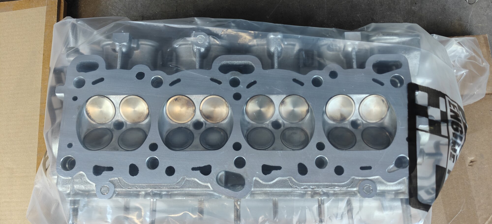

Right after the last track day I had the head pressure tested and decked. They also reground two valves. Went with the HKS headgasket.

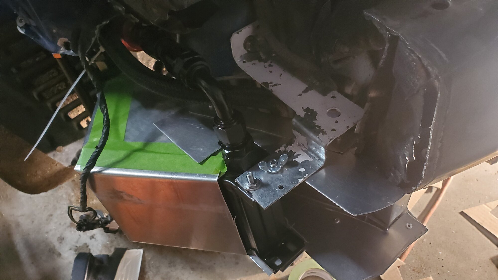

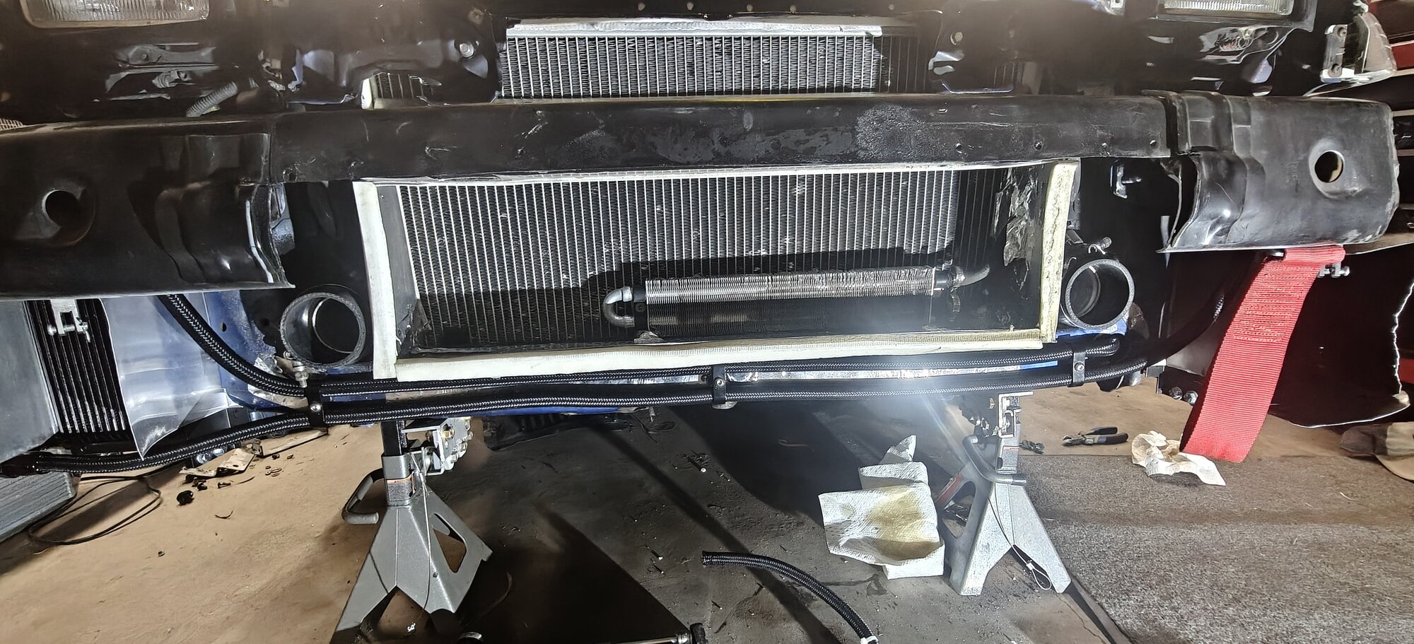

Redid the ducting to put more air to the radiator and not the intercooler
I added a second oil cooler in series

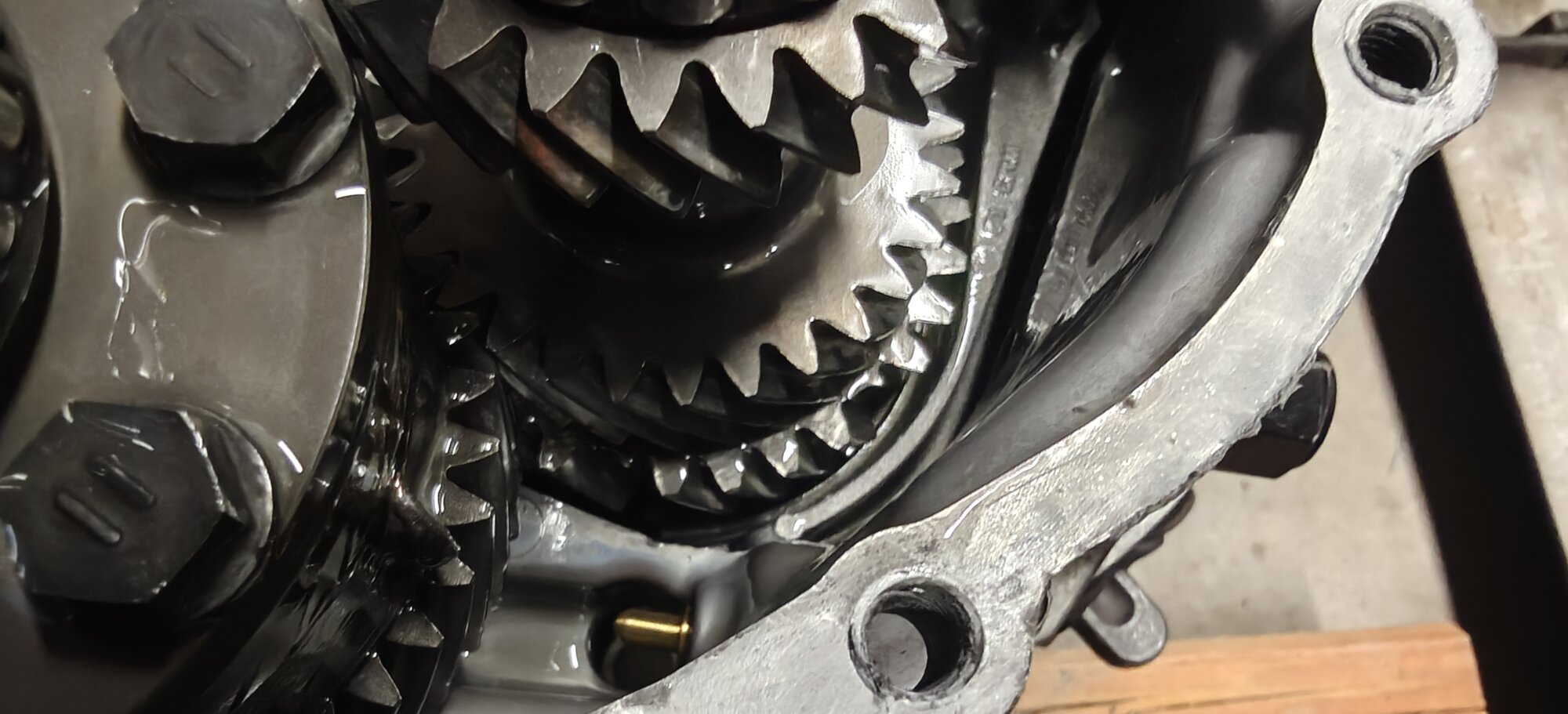

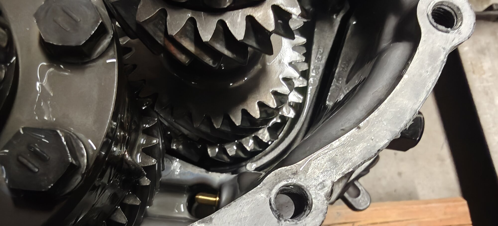

When I did the oil cooler I had to remove the gear oil pump and cooler and found it was full of forbidden glitter.
Turns out 2nd gear broke off 3 teeth. So I got a new one and had it WPC treated.

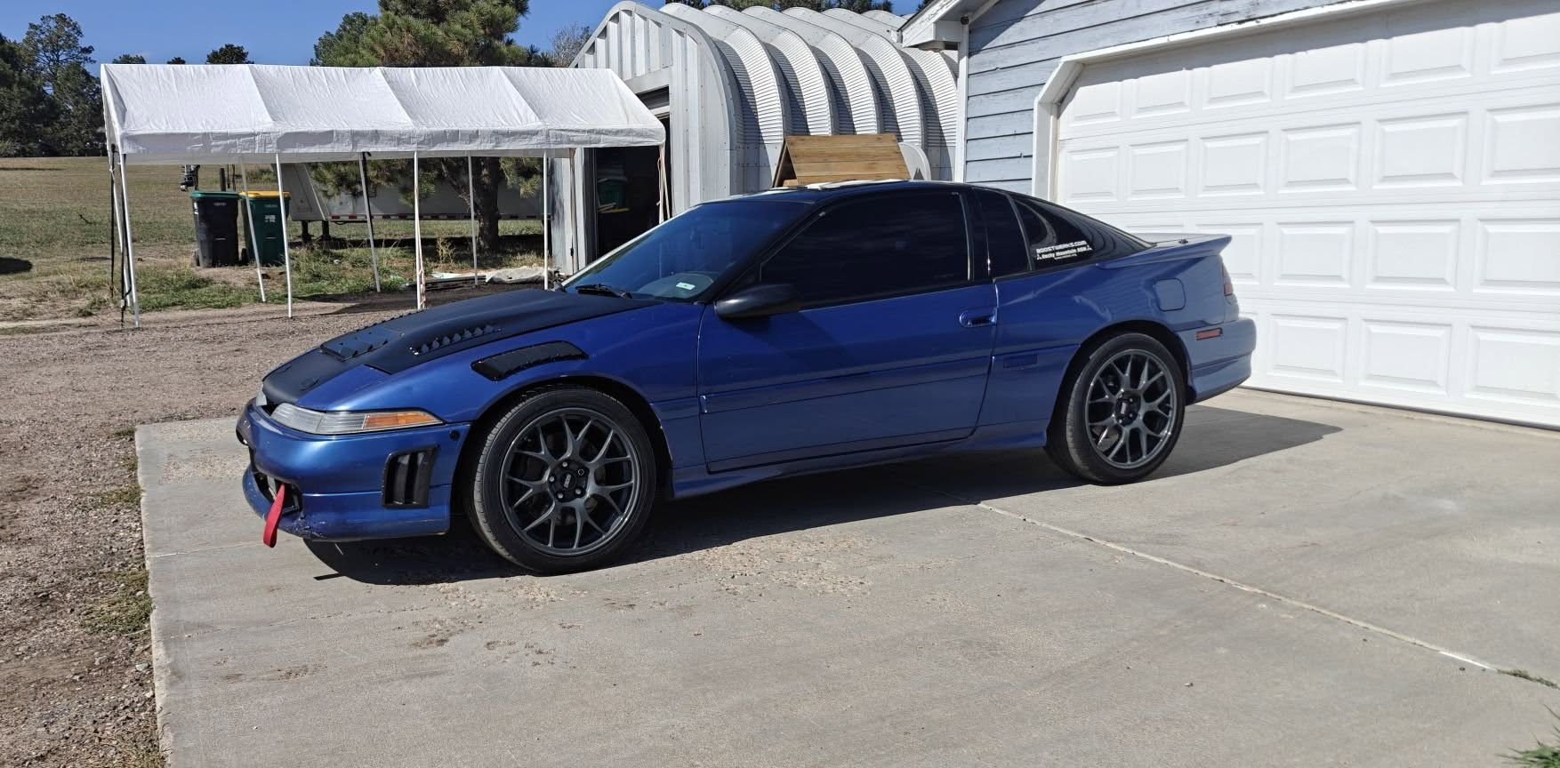

The domino effect... glad it wasn't something major.
For those of you who aren't spending your time on Zuck's crack pipe, Seth put some Evo X BBS wheels on. Looks good with that color combo. Unfortunately, I can't copy and paste his track videos here for you guys to view.

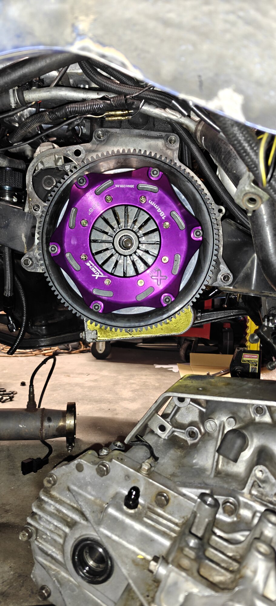

I installed a XClutch sprung twin disc back in April, re-tuned on the dyno, upped the boost back to 26psi and was running straight water.
I have 4 events on this clutch and so far its working great.
