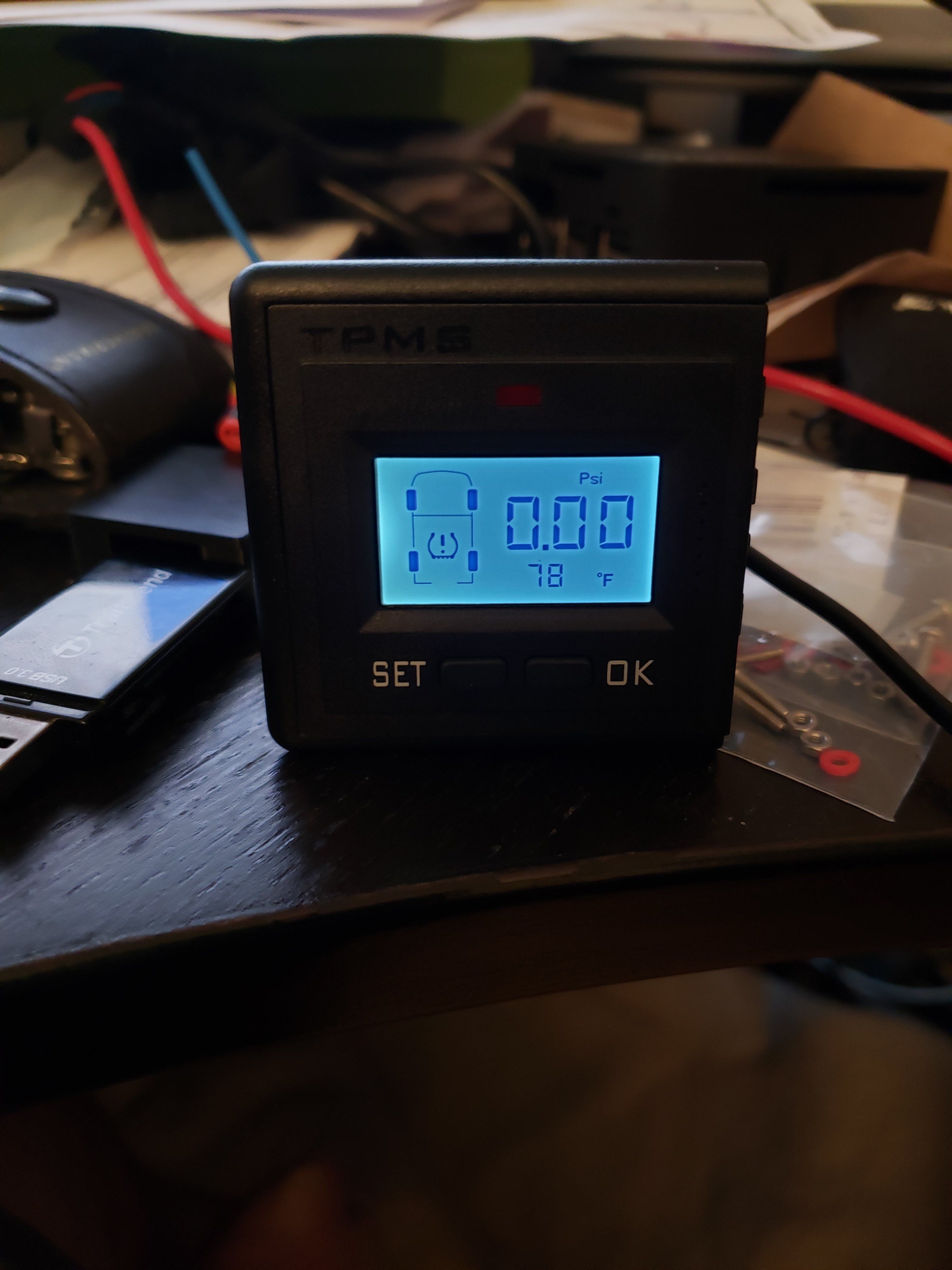

I have been working with a manufacturer to develop a low cost TPMS system that will send its data via CAN BUS so that it can be logged by any CAN capable datalogger. The only offering I could find for this when I was first interested was in the $2k and up range. I had discovered a much cheaper device years ago and shared it with people (mainly the Race Capture community), but the problem with it was that you couldn't change sensors so if a sensor is lost or bad you're screwed and have to buy a whole new system and set of sensors, which was going to be $250+. I opted to not use it, but another company decided to take what I shared, buy a bunch, and resell it. Sigh. I tabled the project for a while but decided to look into it again recently and now have a prototype that WILL let you change sensors, and it also includes a nice little display. I'll be running it at VIR this upcoming weekend to make sure everything works, but so far so good in the garage. I now have data for my tire pressure, tire temperature, and sensor voltage (to know when their batteries are low and need changing), as well as on-screen alerts flashing when tire pressures are low. There are some revisions necessary and another prototype will be sent to me soon but this test will still verify most of the system is good to go. Expecting to sell these in the low $200 range.
Here's the display, not much to see, but this is the whole brains of the deal.

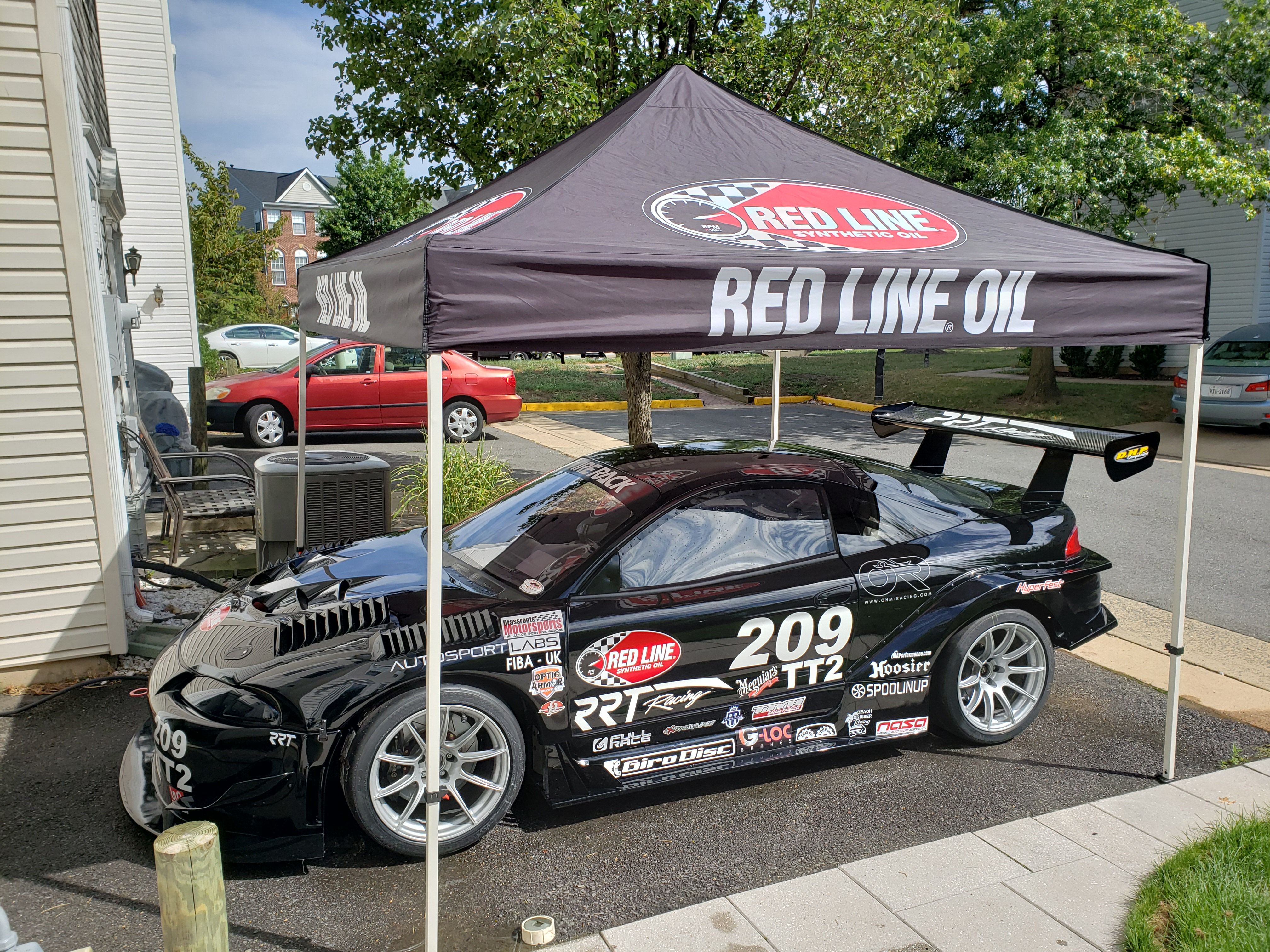

I took the time to wash the car last weekend in prep for the race. The Red Line tent came in handy as it was very hot.

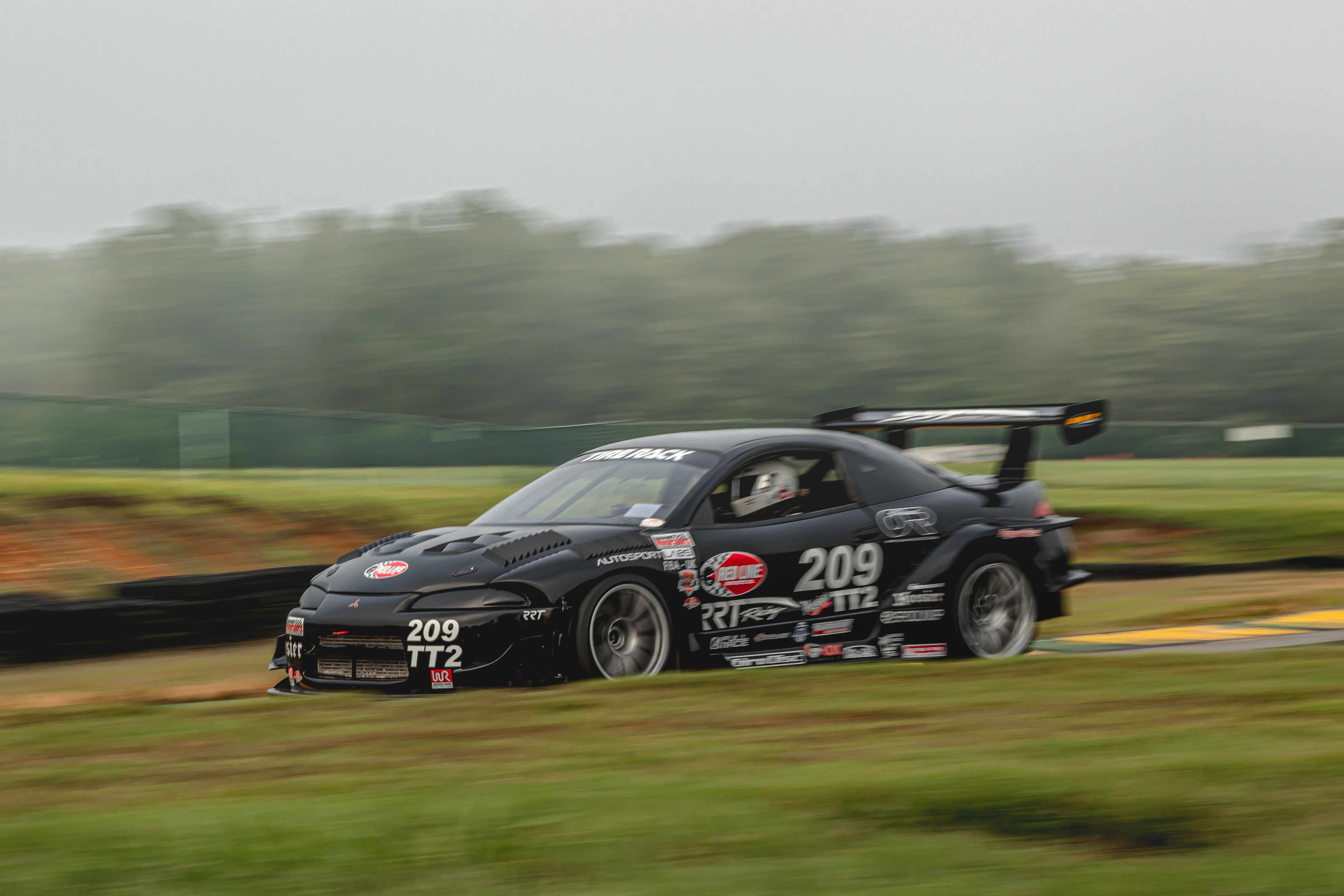

A little after that due to being rusty I came in wide left into Turn 10 and then carried too much speed into it and put two off on the outside as I tracked out of the turn. The dirt there though was really carved up and felt like three big divots as the car bounced heavily up and down really hard. This goofed the alignment at least a little as I had to turn left a bit on the long straights to stay straight, but nothing too bad. Also knocked some screws loose with the body work and scraped up the front splitter a tiny bit, along with front corner of the passenger side skirt. Nothing major. While on track though everything felt fine so I kept going.
Did a 2:04 and the car felt good. So I drove a little harder, and did a 2:00.9. Wow. I wasn't fully pushing it and on my slower R7 tires, so that made me really excited. However a lap later the car started sputtering on all right hand turns. I came in.

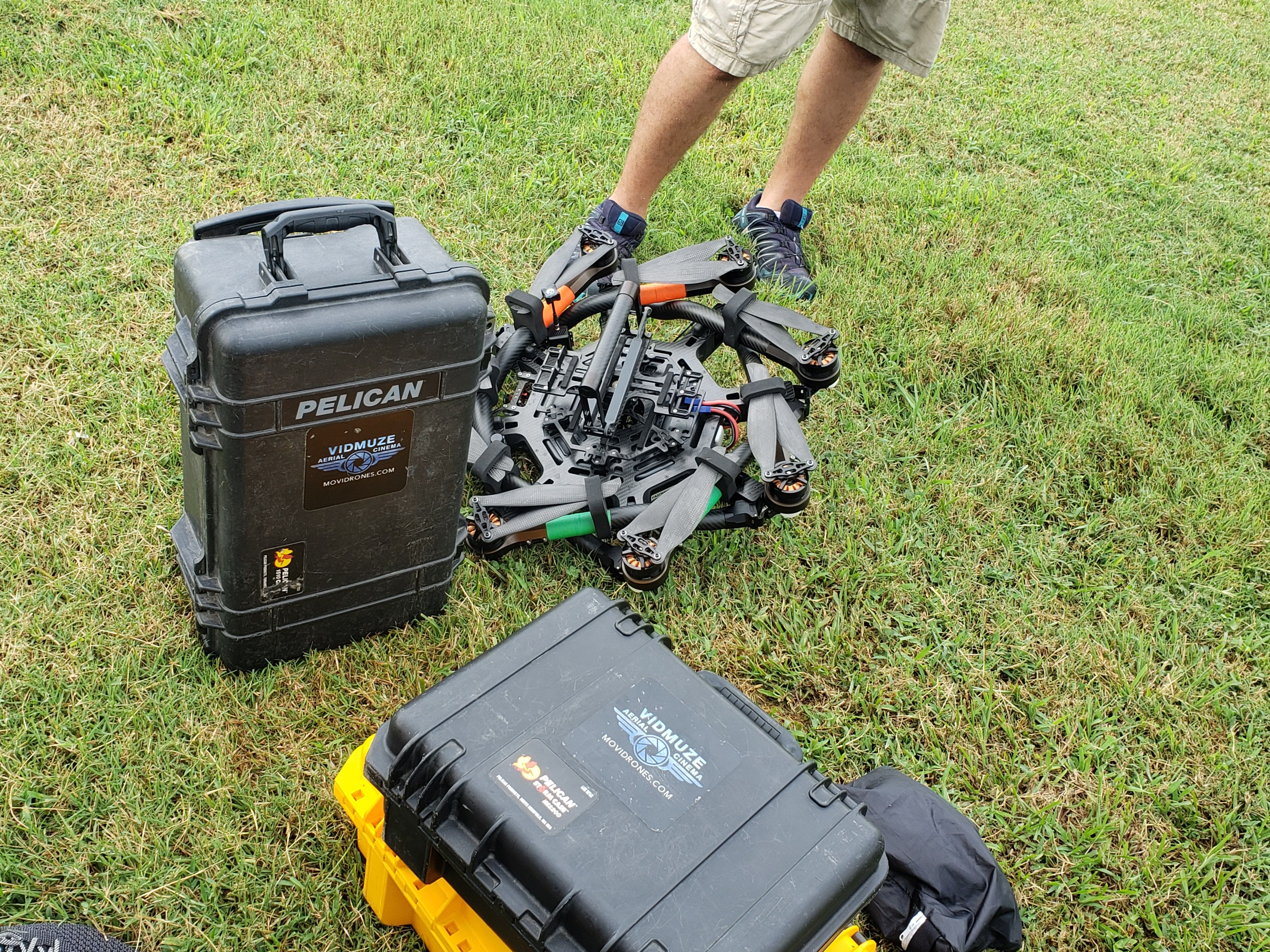

Got over to the VidMuze guys just in time and talked about the shoot. At first I was supposed to be background for some other cars so the track didn't look empty, so I sat about 10 car lengths back. They took some footage of just me though at the end which was unexpected. After we did another bunch of laps with more cars and did some cool passes with the truck. This shot was taken from the truck while we were on track.
They had drones running at various places on the track too! Was so cool to see them moving around as we drove by. Here's some of their teaser footage of the drone work they were doing that weekend, it's so good.

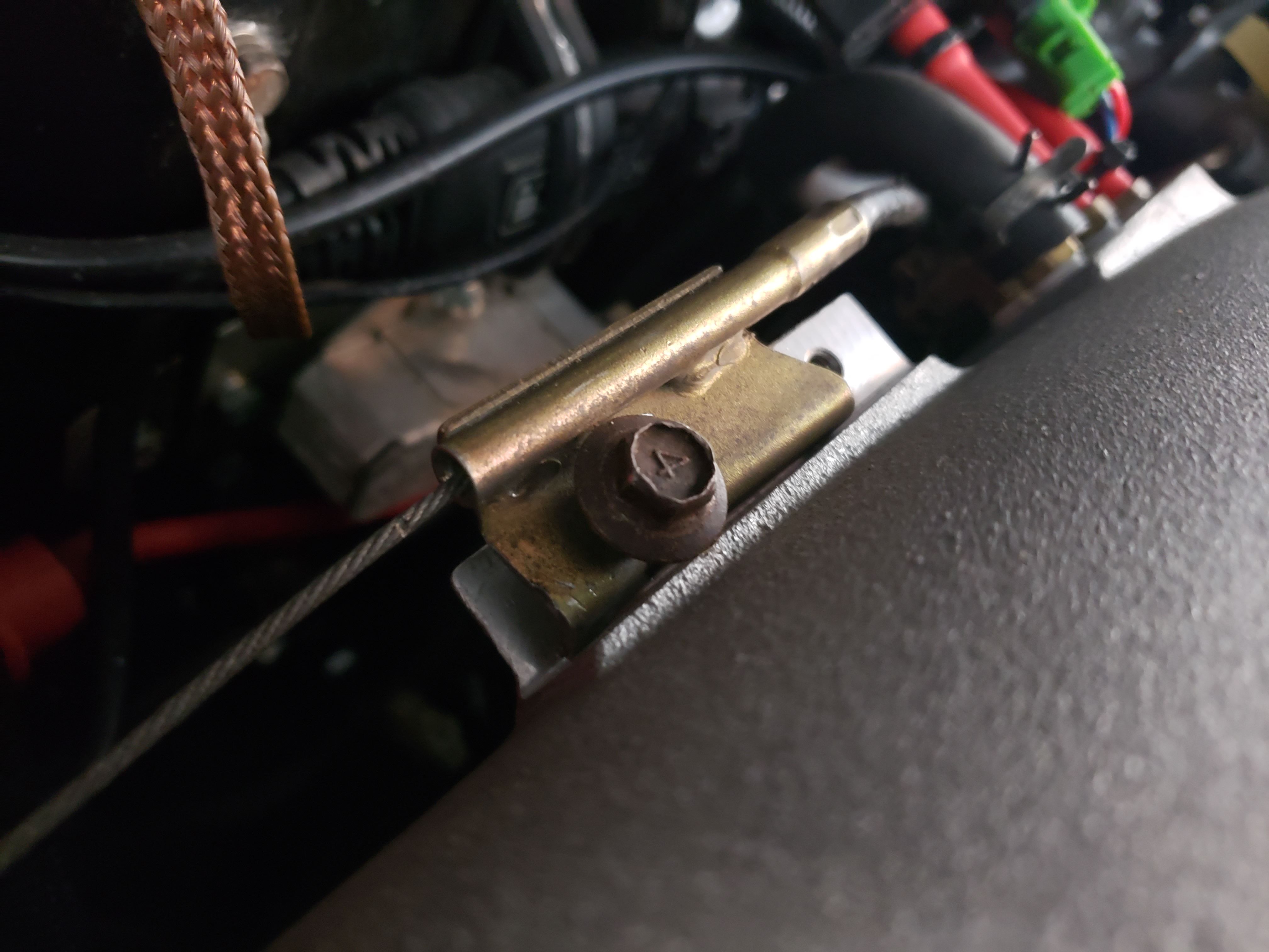

- Replace the throttle body cable. I got two new ones already, one as a spare.

- New TPMS system not working quite right. Data wasn't really updating frequently from the two rear sensors. Need to investigate, but the product just might be crap, who knows.

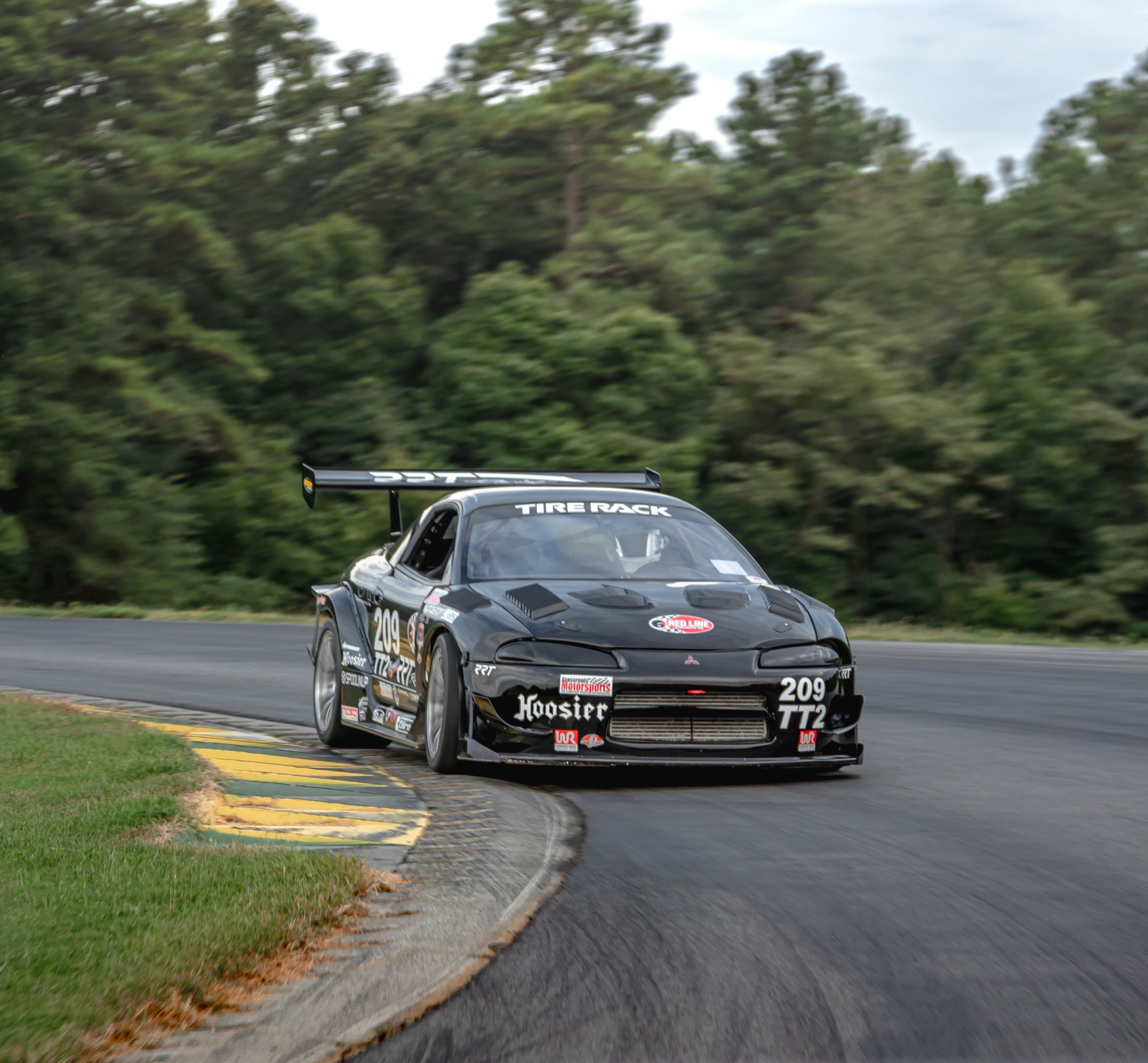

Here's my fastest lap from the weekend:
From the footage I can see:
- The car is MUCH faster now in lower speed turns than my previous fastest 2:00.1 lap time in 2015. If you run the videos side by side I think the new car is 1.5 seconds faster per lap in low speed turns than before. The car loses the time on the straights due to the boost not being quite right and being down on power (trap speeds show 5-7mph differences).
- My new brake pressure sensor shows that I let off the brakes a lot when blipping for downshifts. I need to hold steady brake pressure, and so this is lost time as I could brake later.
- I was braking too early on the back straight as I end up coasting (though I knew this while driving, i was still feeling things out with it being warm-up).
- I can carry more speed in turn 3 as I still have more room to track out.
- I can brake later into Oak Tree and carry more speed. Actually this footage doesn't show this, but on a different lap I did this really cool brake/slide that kept so much speed right up until I had to do the sharp right turn onto the back straight. Basically no wasted time braking/coasting, just one solid curved braking zone. High risk, but I think it's free time if I can learn to do it more. Really cool discovering this, it's similar to the technique used at the end of the back straight where we brake uphill and to the left instead of braking in two separate zones.

TPMS didn't get fixed. So I contacted the Chinese manufacturer and they suggested I get their repeater box they use on trucks. It just connects to the display unit. So I received it and placed it in the rear, but after October I saw the data for the rear still wasn't really updating. My next theory is that the carbon fiber dash panel is causing enough EM interference for the lower power transmissions from the tire sensors. Carbon Fiber does indeed cause EM interference and it's the last idea I have. I'm going to test the theory by using a coax extender (the antennae on the back on the display is a mini coax) and move the antennae to the middle of the car. If that works i'll pull the carbon fiber panel out and replace with something non-interfering.

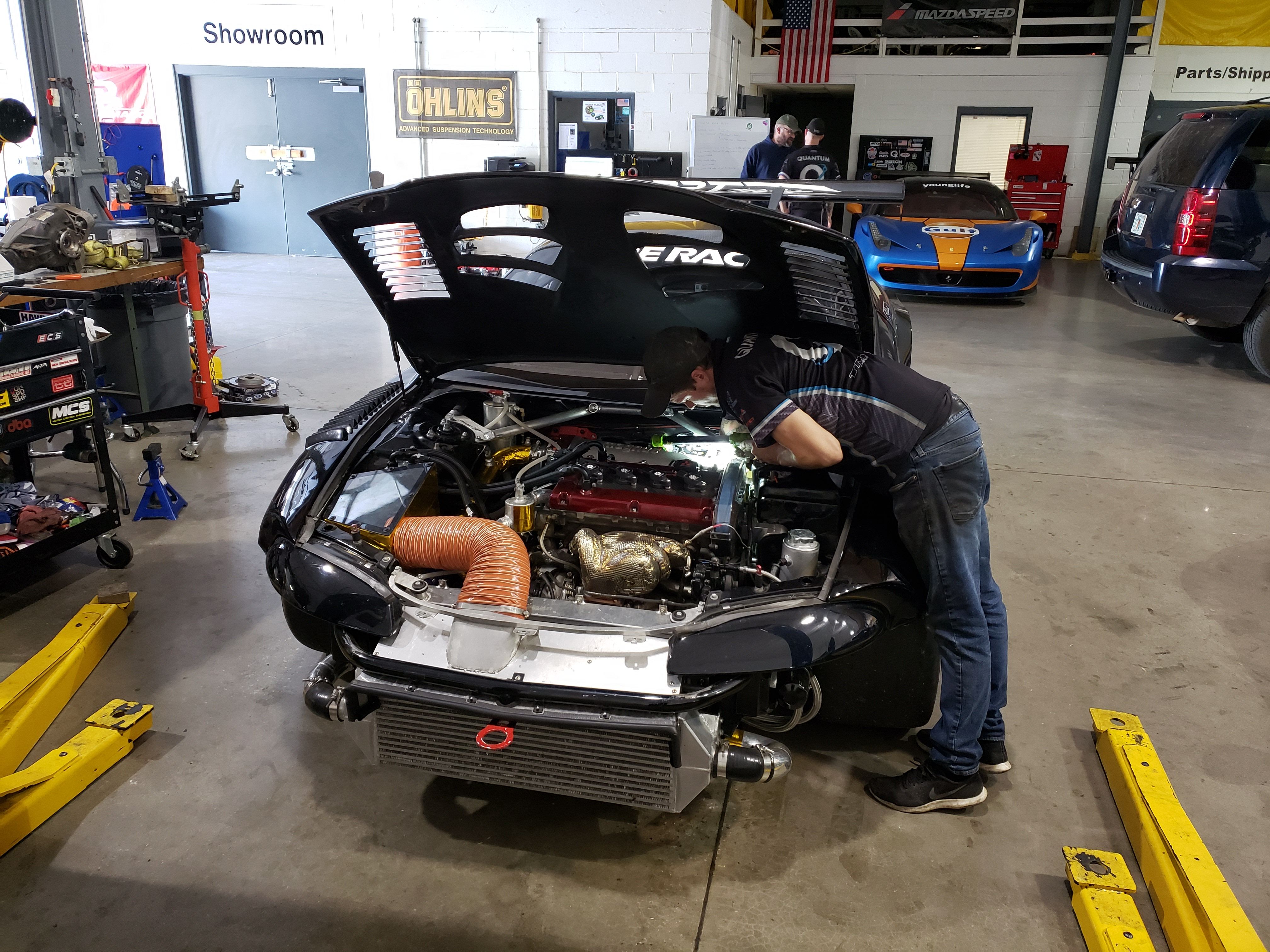

I can't recall exactly everything that happened or the order. Next day I went out and two things happened. First, within a few laps something went off in the alignment as the car was pulling to the right. It wasn't horrendous but it was having an effect on handling, and of course I had to pull the wheel to the side to keep it straight on the track, maybe like 5 degrees. I also had the power steering cut out I think once in a turn very briefly. Also, after coming in after the first session there was lots of smoke. That had me freaked out.

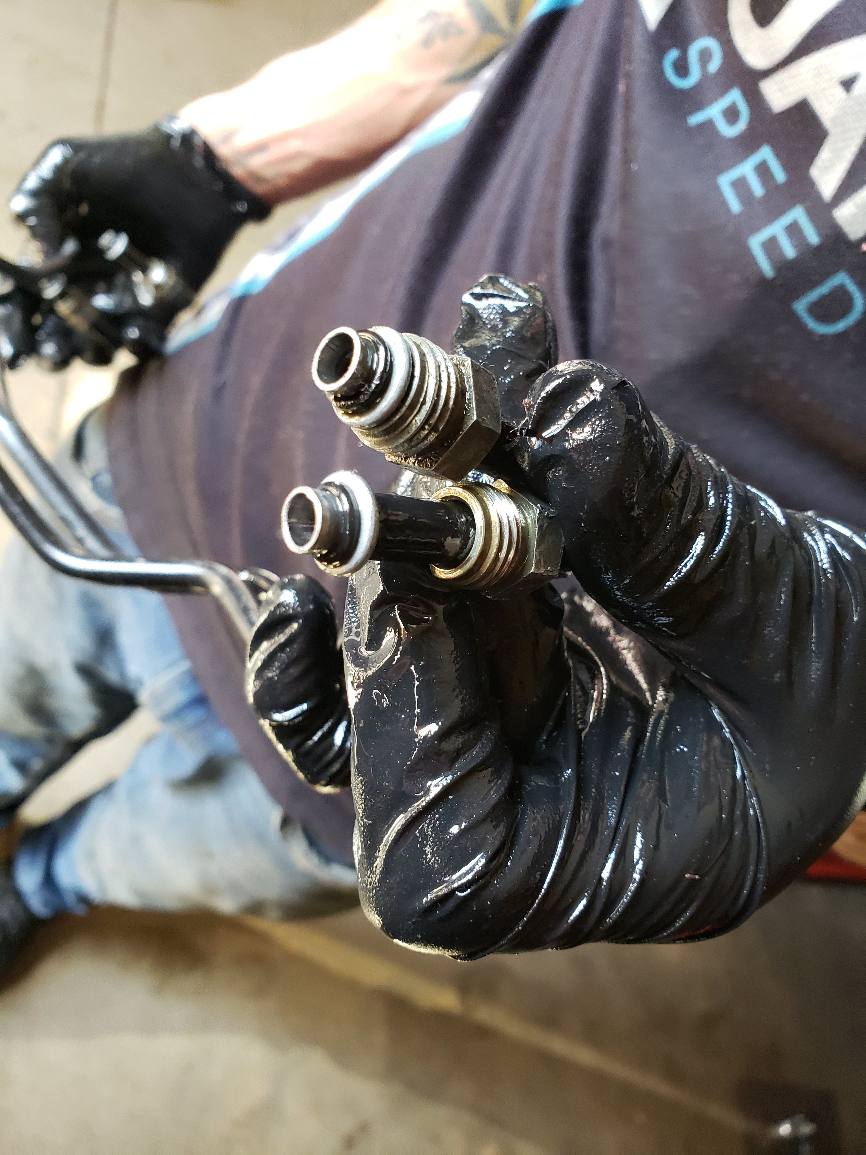

After opening the hood and not seeing a fire, I realized it smelled like ATF. Power steering. It was spewing out a fitting on on the rack. We tried to tighten it while on the car. I say we because I forgot to mention I had no help lined up for VIR, but on my way down posted on instagram asking if anyone was interested in coming by to help for the weekend (not seriously expecting any interest). Daniel Simon from NC msg'd me saying he could come down and help out. I can't thank Daniel enough! He drove down in his 2g GST and met with me on Saturday morning to give me a hand. Ok so we tried to tighten the fitting and it wasn't helping. I asked around and heard Quantum Motorsports at VIR was open on weekends to help drivers out, so I ran over there and they said to bring the car on by!

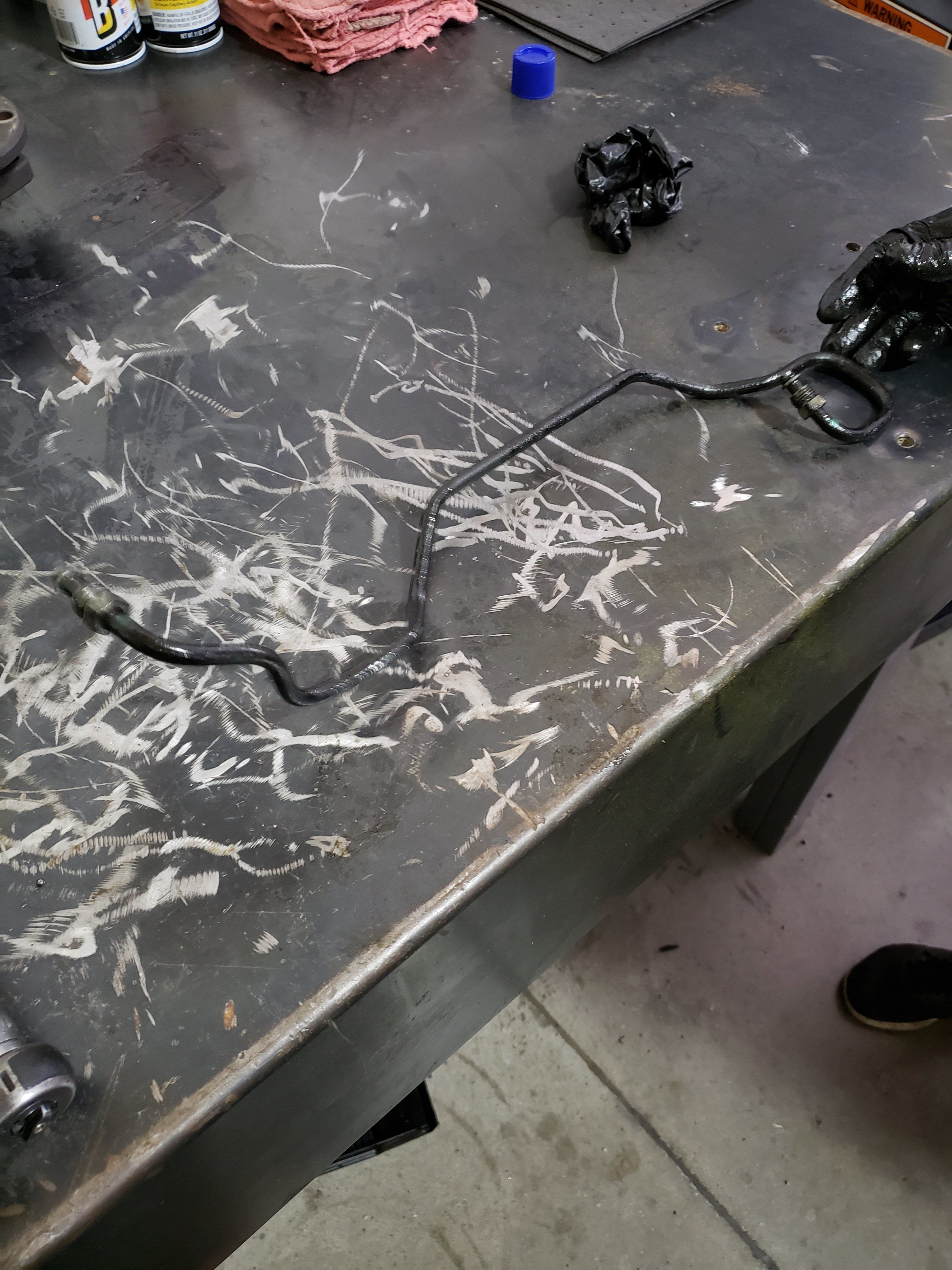

I brought the car over to them and they couldn't figure out why the fitting was leaking. It was a fitting to a hard line that links the sides of the rack, and this isn't a fitting you ever touch on these. Looking at the fitting it didn't appear to have any damage or anything, but the tech did comment that it didn't have an o-ring and usually he sees o-rings on these fittings. He tried to fit o-rings on there that he had and nothing got the fitting to seal, it just kept spewing fluid.
Shitty picture of the fitting (the left one) and the hard line it's a part of.
I realized Daniel had mentioned he runs a disconnected rack on his GST. The racks are the same, so I asked him if I could harvest that hard line from his so we could inspect it and possibly use it and he graciously let me do that. So we got his car over to Quantum and pulled that line. Well his has an o-ring, and after comparing you could tell the end of my fitting had some possible damage. Very weird, because this was a brand new OEM rack and I'm pretty sure RRT never touched this hard line/

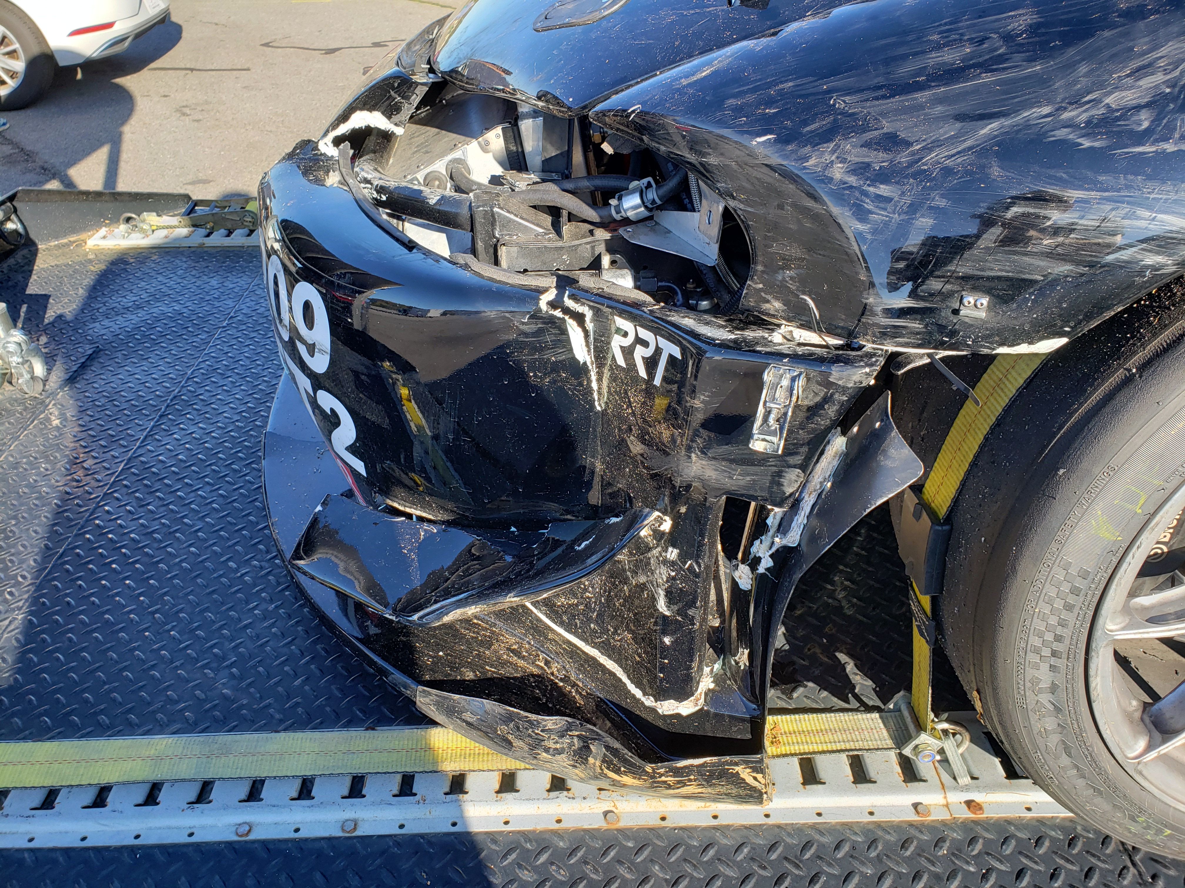

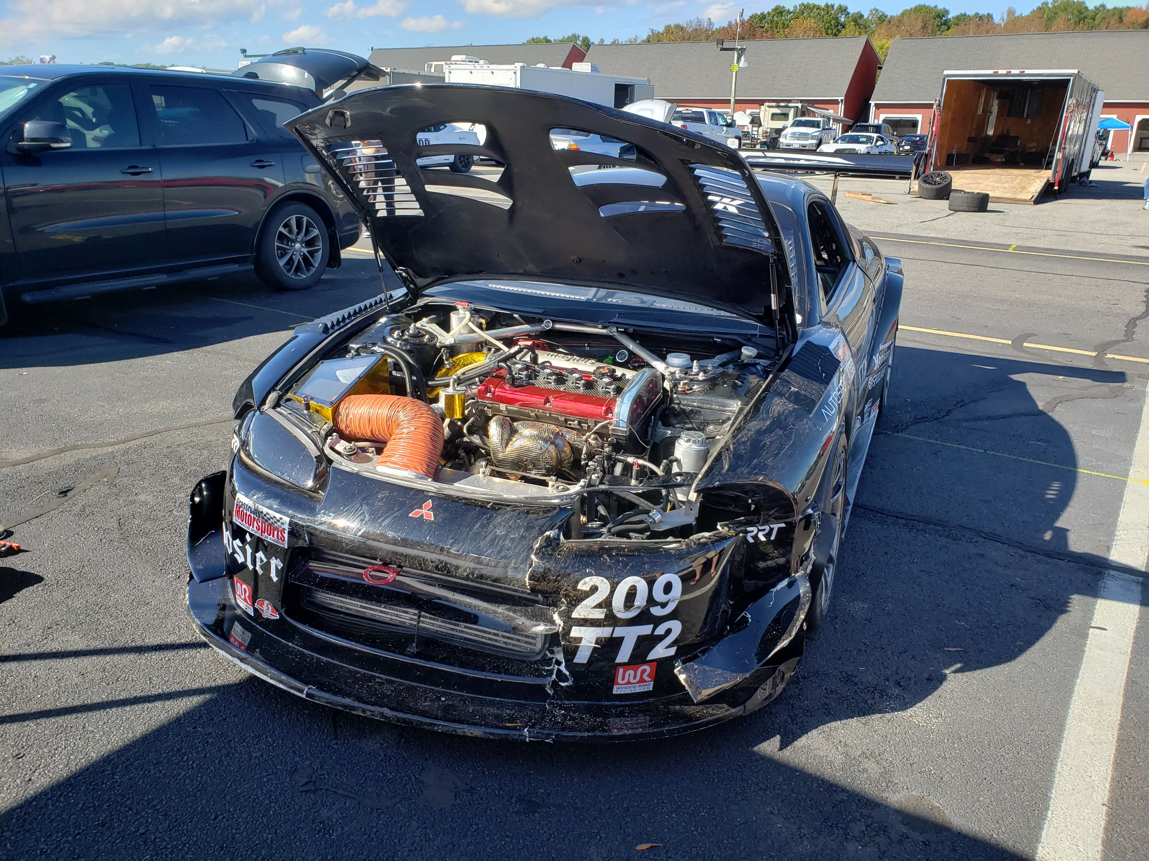

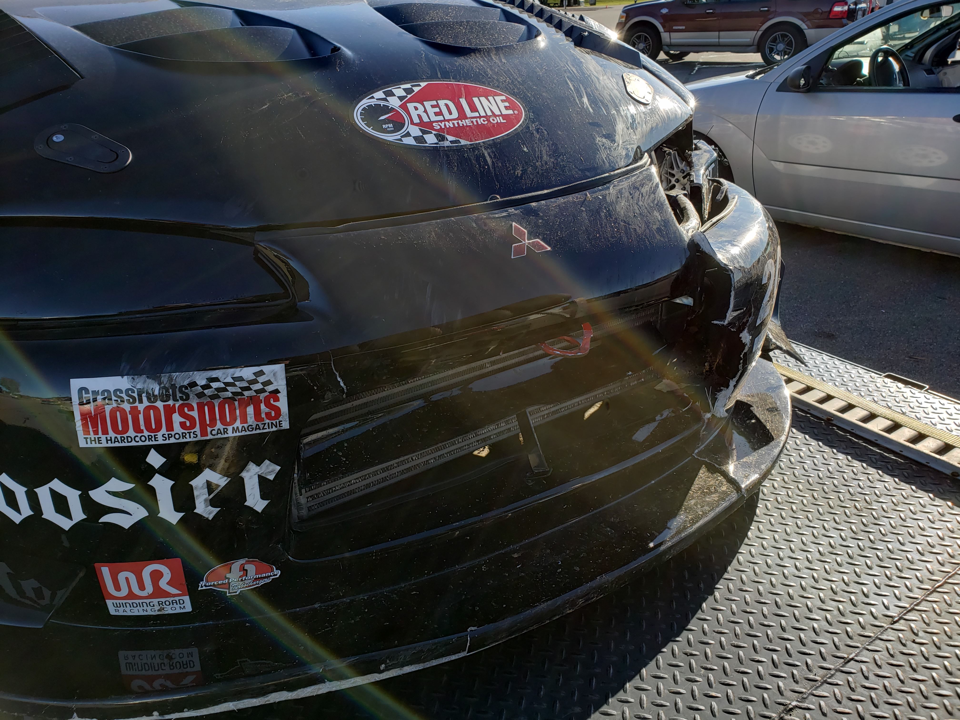

Next morning I went out and settled behind a friend in his Camaro ZL1-1LE. His car basically looks exactly like this:
SUPER nice car, and ridiculous performance for $70k. Seriously super fast, faster than my car. Well I drove behind him a couple laps feeling the car out and things were mostly feeling ok, though the alignment went out again exactly like before only after a few laps. Well, since it was feeling good I passed my friend and started to turn it up... big mistake. Up to this point I was musing about places to push it on the track and one place I've always thought about working on was the turns around Oak Tree. It's a two turn section, where you slow down to maybe 65mph. I had thought I could do this really trick trail brake into the first turn and slide every so slightly and get free rotation to then use AWD to hole shot out of there. Not sure why, it just felt like this was possible. I'd be walking a thin wire, but sometimes you get this gut feeling you can do something, like how I had to do when taking the uphill esses at full throttle at 138mph and not lifting. Well, I think the idea still can work, but my execution was off this time. I broke later than I ever have before (this is on the same lap as passing the Camaro), locked up, and slid off into the tire wall probably only going like 20mph when I hit. You can hear me yell "NO!" on video. Well, the car stalled, but I started it right back up, got a wave from the corner worker, and backed up from the wall and pulled onto the track. No issues in data, no smoking, so I puttered back to the pits.

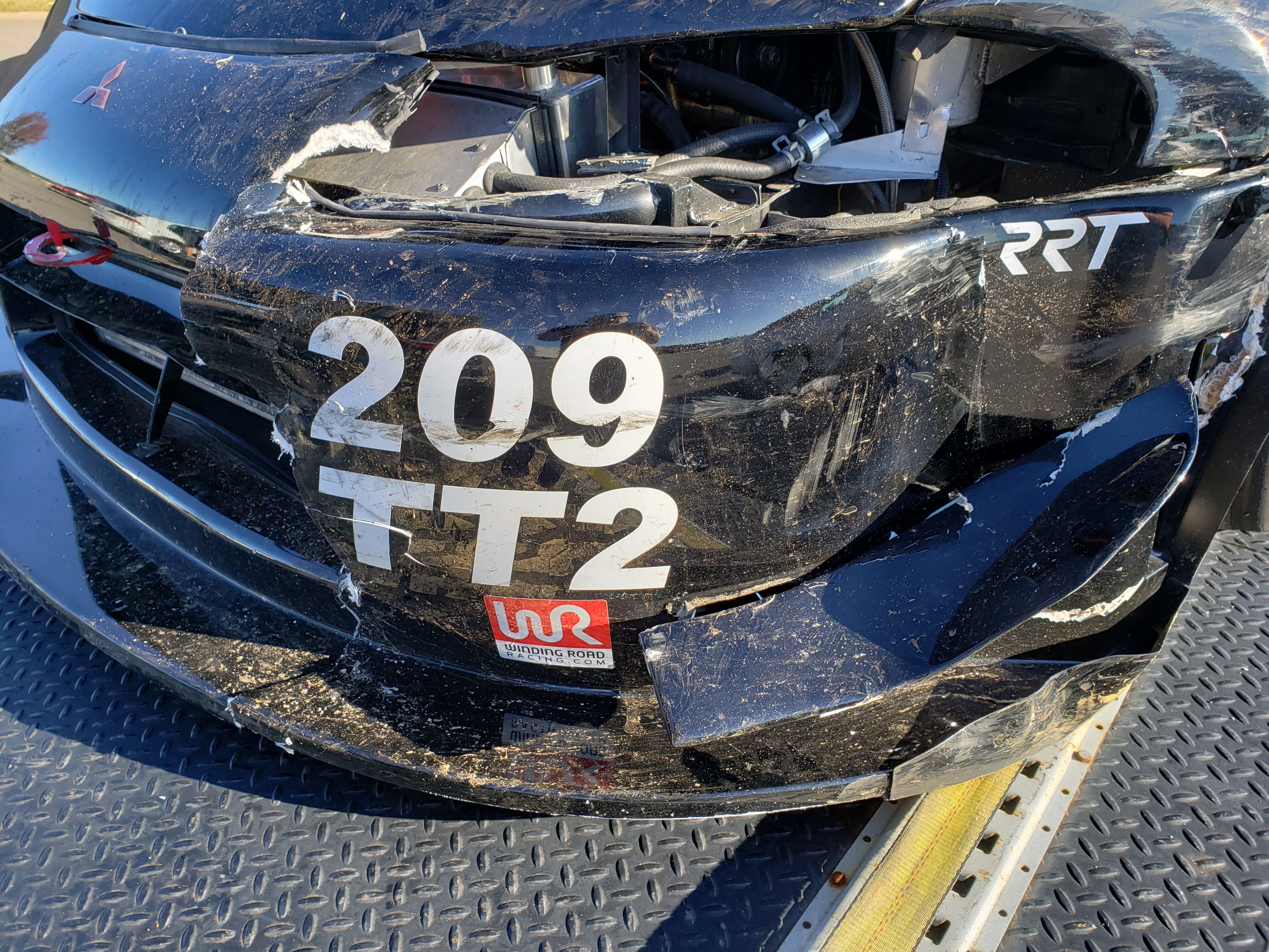

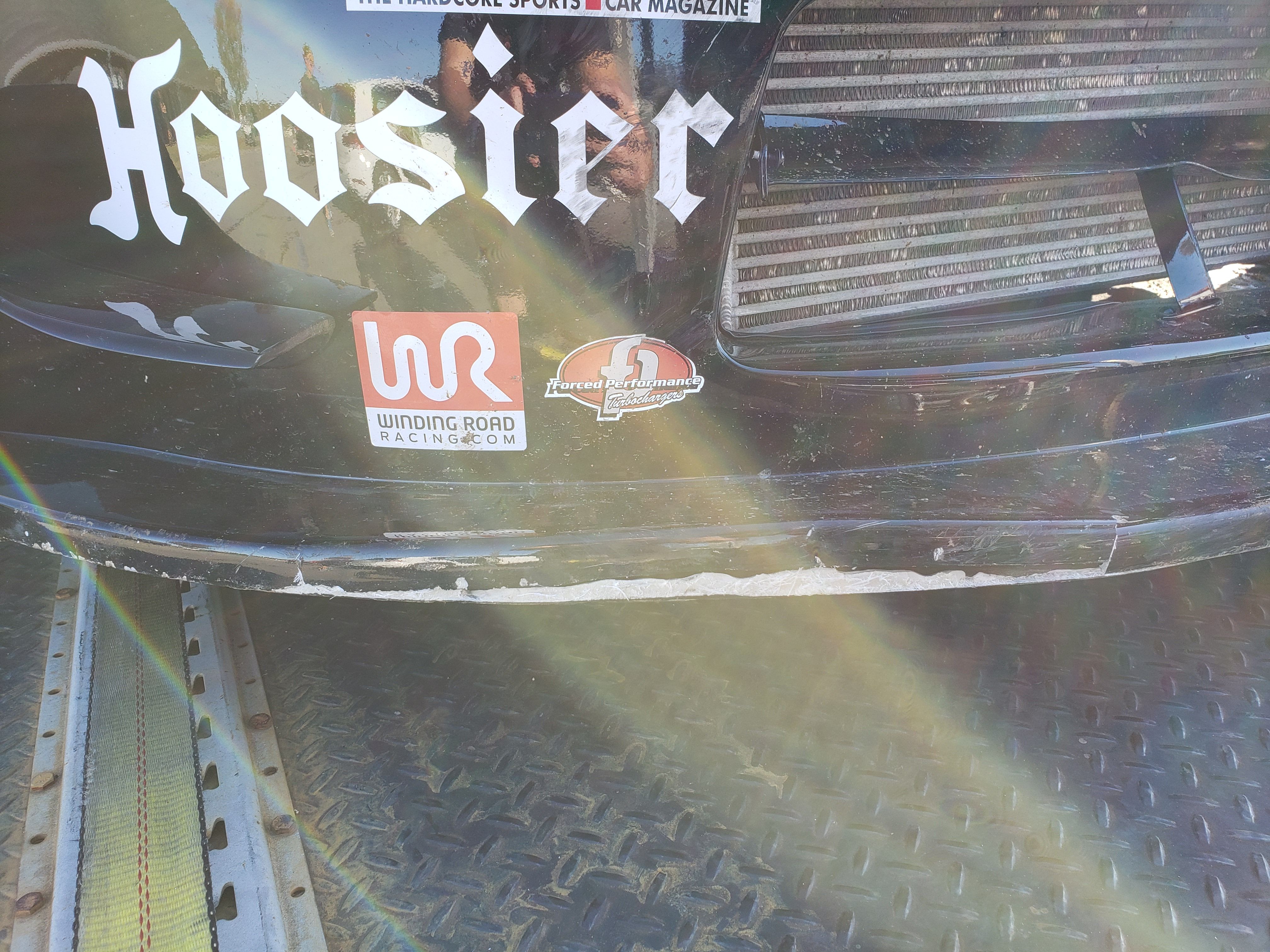

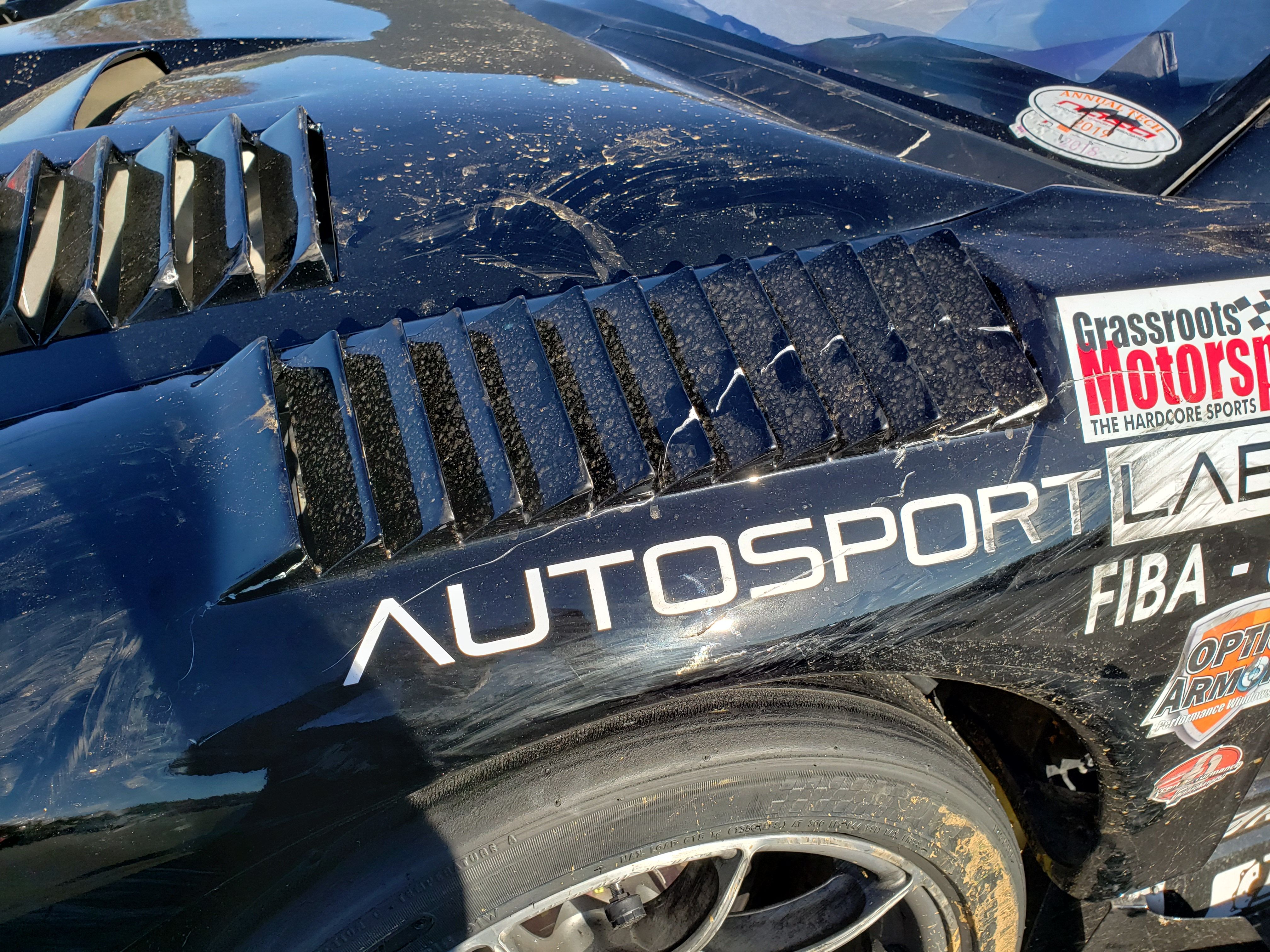

Damage was primarily cosmetic, with the front metal bumper saving me. Radiator ducting was slightly bent up. Unfortunately cosmetic damage on this car is also aero damage, and very expensive since this is basically a completely custom one-off body kit now that the molds are lost. Ugh.
And that was that. Shitty way to end the year hah.

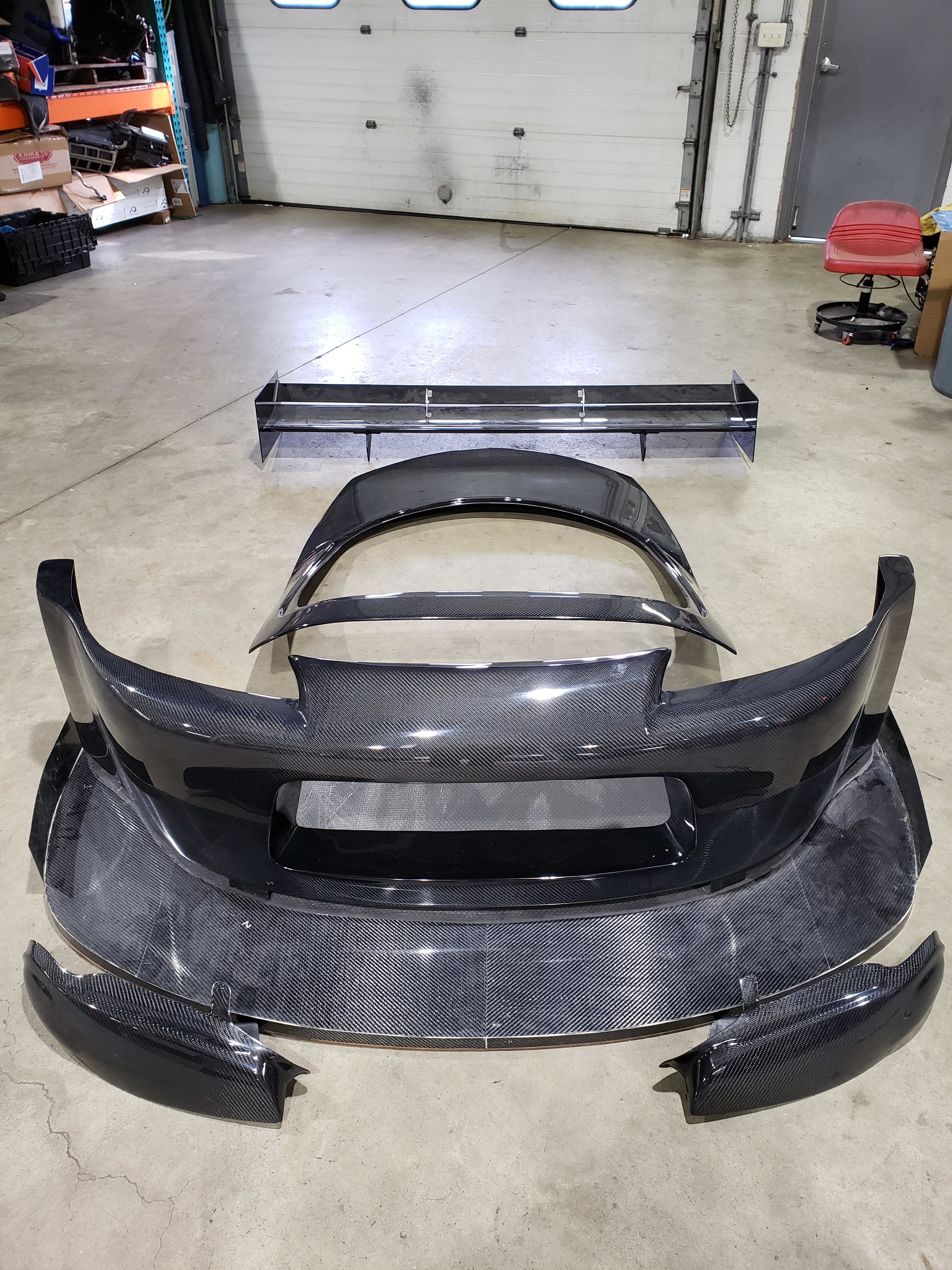

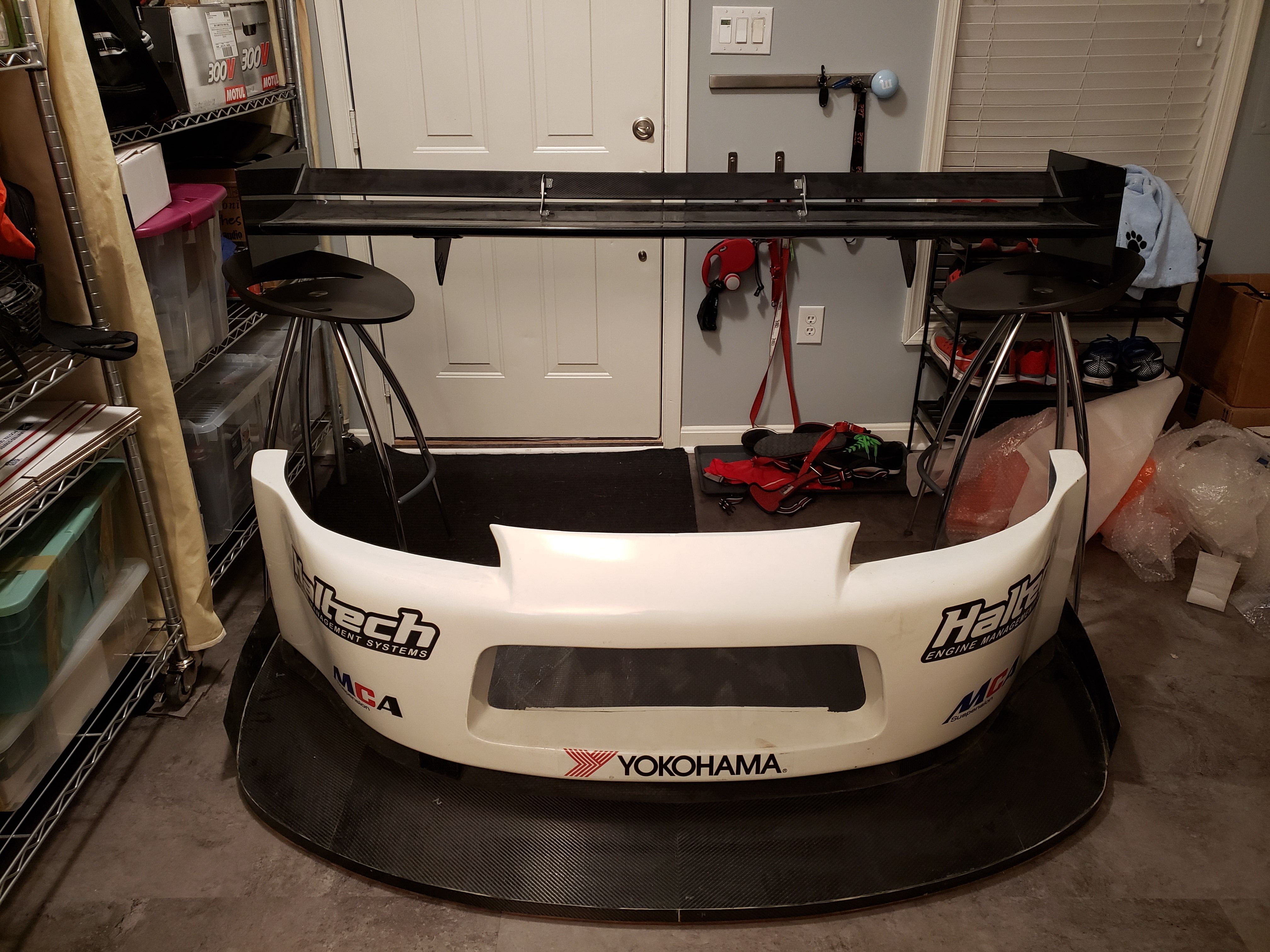

Ok so the parts all came in. Phil's V1 fiberglass bumper would be a spare and I would use Sergio's "carbon fiber". Phil's splitter and diffuser were really nice, high quality super strong prepreg carbon. The wing was in almost new condition, just minor scratches.
Phil's delivery:
Yes, that splitter is insanely huge. 10" vs the 5" I had before.
Here's Sergio's delivery mixed in with Phil's parts:
On the Carbonetics pieces, while not really carbon fiber, they look god damned good. The hatch is PERFECT, it fits perfectly and fit and finish is top notch. The headlight blanks are gorgeous, though FYI if you buy them they are missing the mounting tabs towards the outside of the car so you need to add those yourself (I told him this a year or two ago when he first made these, but he only offered to let me pay $250 additional to add the missing mounts........). The bumper cover looks great (more on that later).

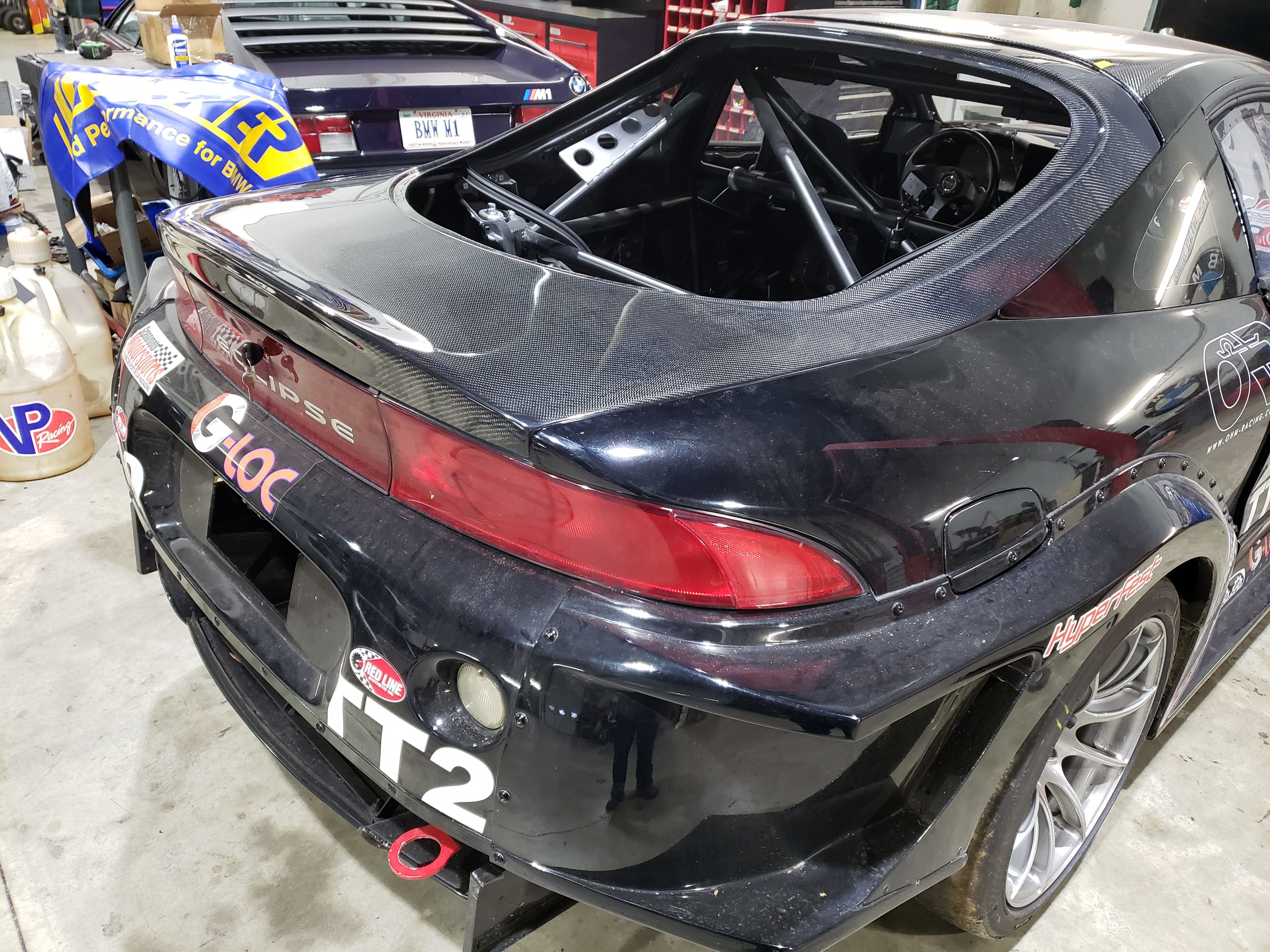

So the new plan is to get all these new parts on the car and then have Boggs Body do the small fiberglass repairs and paint. Still going to be at least $10k but hopefully a better car for it.
Pic of the hatch just sitting on the car. Perfect fitment. I think I might just paint the sides black like I did the roof, because it really is pretty.

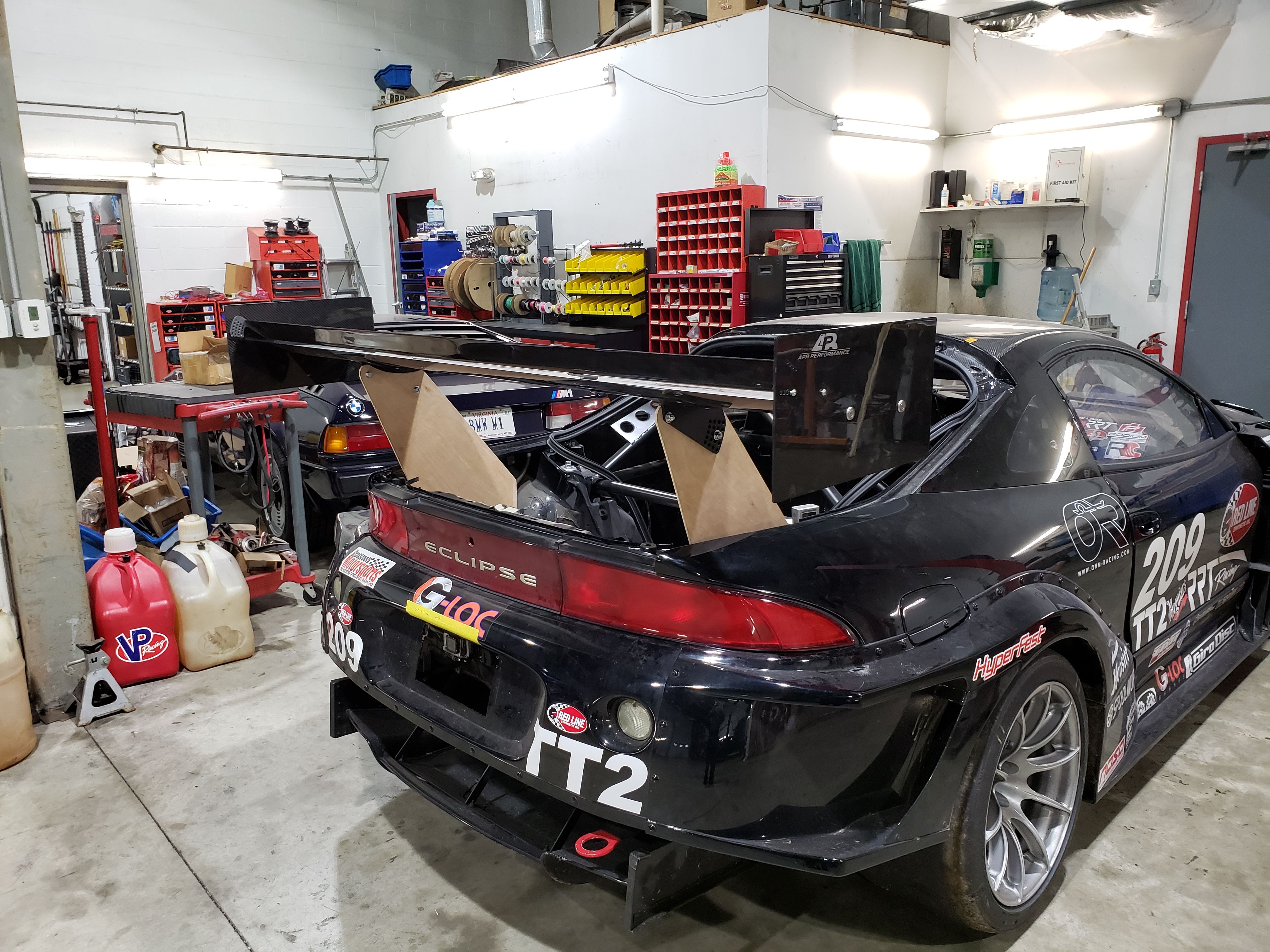

Ok so finally a couple weeks ago RRT was able to get me in to start working on the car. We started with the rear wing because I needed to get wing mount templates made and shipped out to DHP Composites (who made my single element wing I've run for years) so Dave Herald can make me some pre-preg carbon fiber uprights and that his fabrication time can overlap other work.
After a bunch of template designs Chris Comer at RRT (#comer_fab on instagrame) got the wing sitting where I wanted. We had to cut the hatch metal edge, the tail light metal mounting cages, and just a bit of the exterior plastic of the tail lights (though we did not have to enter the housing which was great). Here's how it ended up.
I would have preferred the wing's mounts be between the uprights but to do that we would have had to cut into the exterior metal around the hatch and I didn't want that.
So those uprights are now in DHP Composites' hands and being fabricated as we speak.

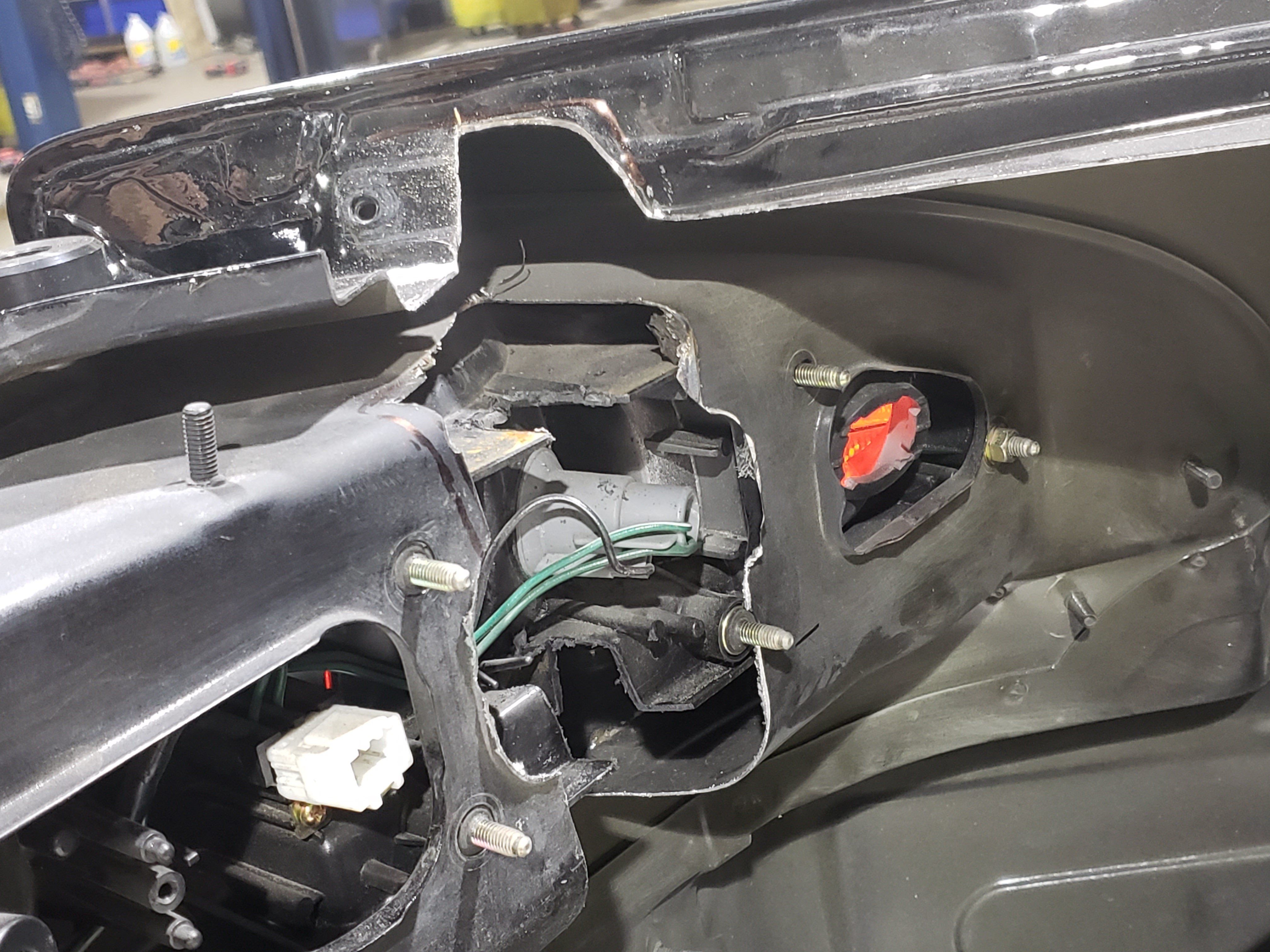

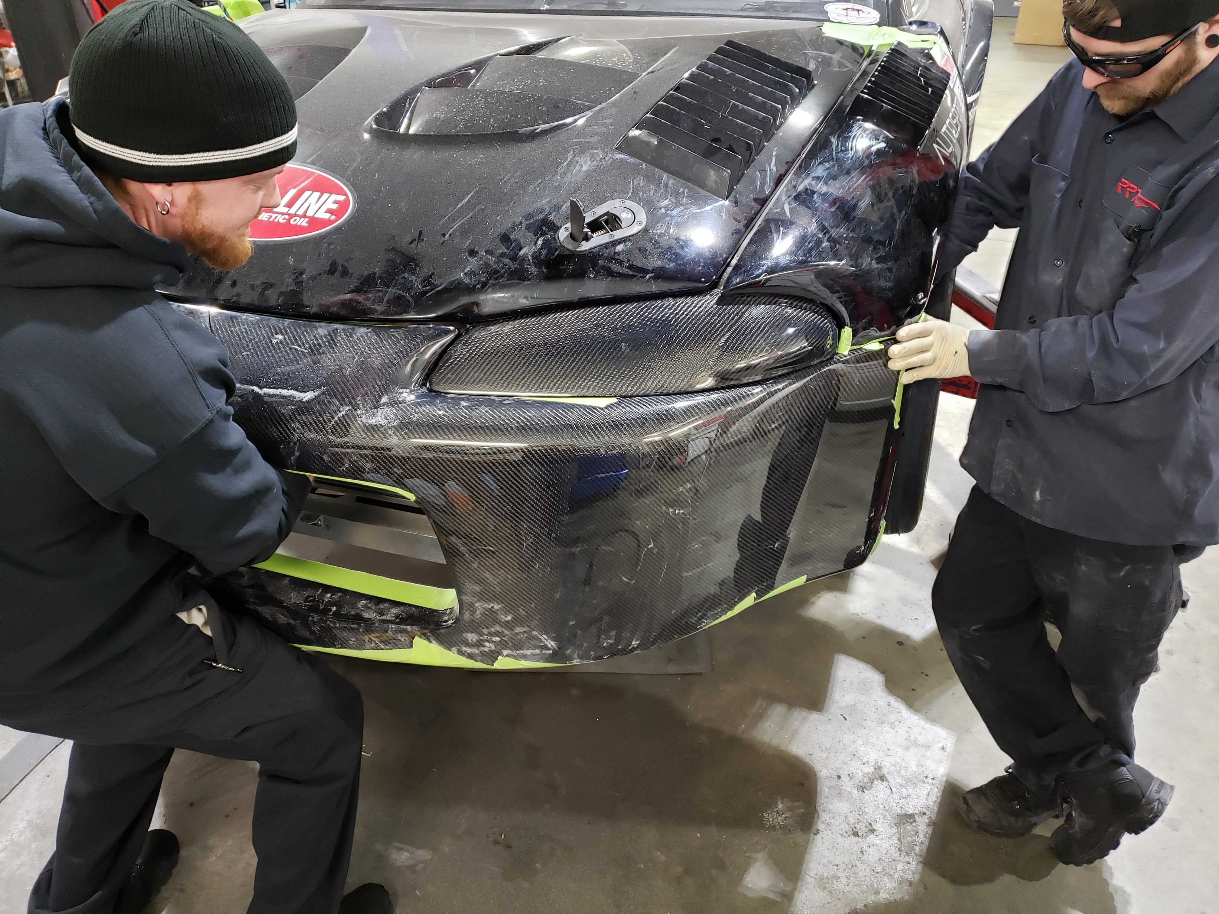

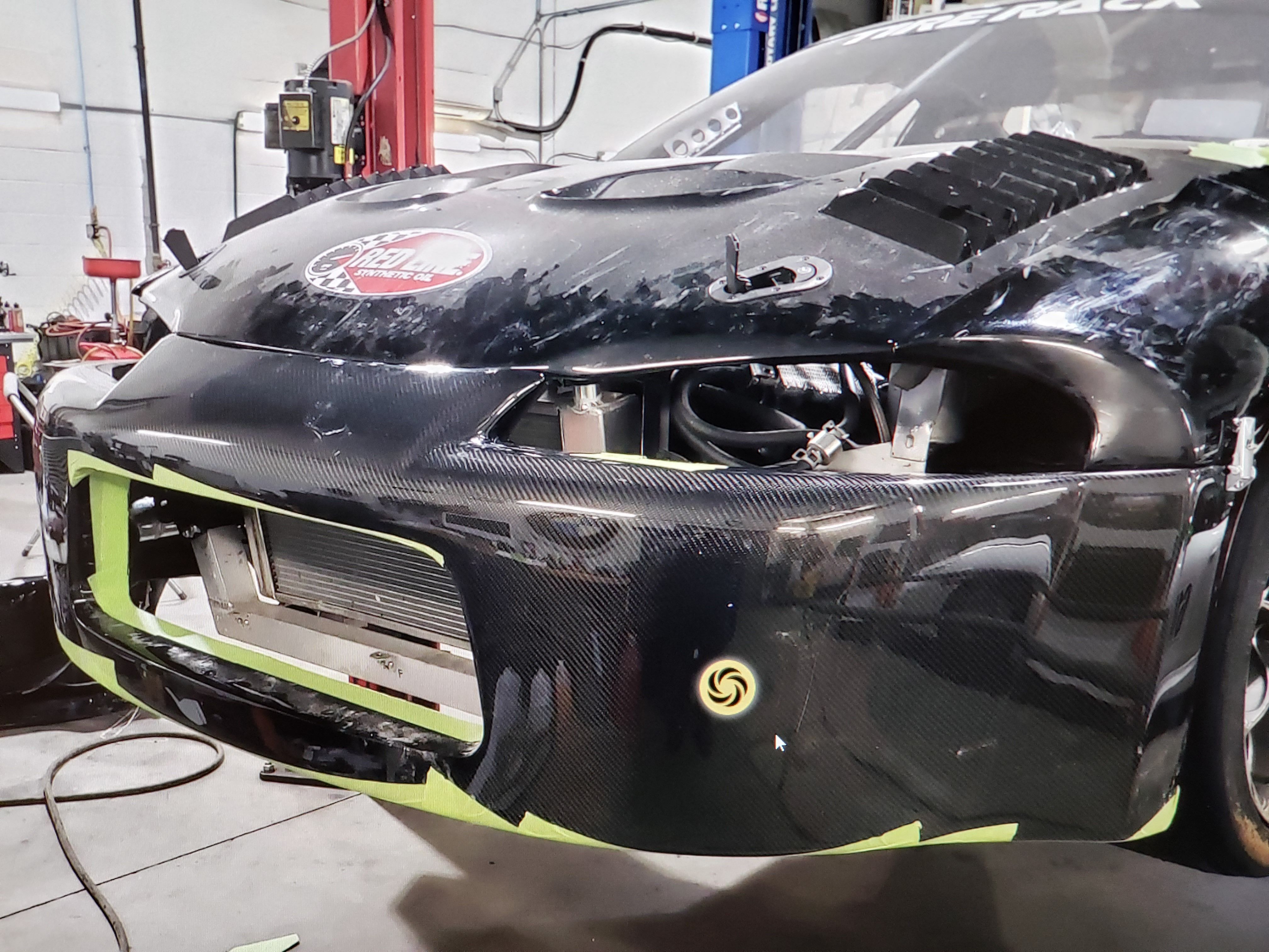

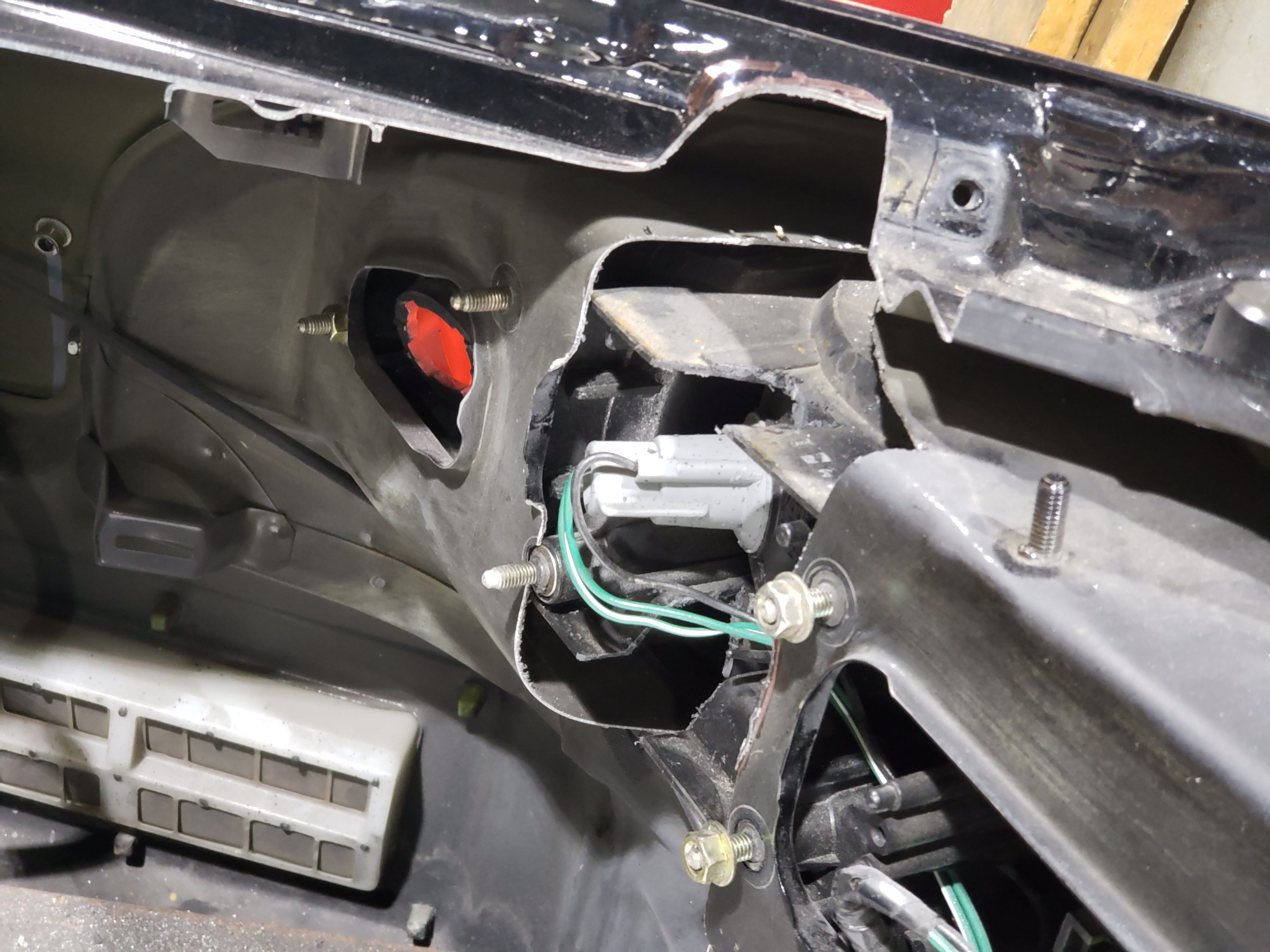

Next was mounting the bumper cover. Holy shit this sucked. When Chris@RRT first tried to fit the bumper he was convinced it was not going to work. It was sitting wider than the fenders, and the center portion's slope was much more shallow than the original and looked very weird because it created a big angle with the hood. Now Chris isn't a body guy, he's a race car fabrication guy, and so he's not yet experienced in how far you have to tweak body panels. I'm not a body guy either, but having been through what I have with this car I knew a thing or to, so I told him I'd be there in an hour to help.
Sure enough, the bumper was sitting like 1" out on each side. It did not look like it would fit, or it was horribly misshapen. However, I looked at it and thought if we just kind of forced in one way, and pulled it another, and cut out some stuff... we might get it to work. After about 3.5 hours here's what we ended up doing:
- Cut away material under headlights because this bumper seemed to be hitting the metal bumper mounts (obviously the old bumper doesn't)
- Cut out the metal bumper because it seemed to be hitting the inside of the bumper cover (again, old bumper cover sits nicely on top of this)
- Cut out the lower inside lip of the bumper cover because it seemed to be preventing us from twisting the bumper cover like we wanted to do
- Forced the sides inward and lined them up with the fenders. Idea is we'd add something to hold these outside corners in position.
- while forcing the sides, pull forward and up on the top center portion to get that surface to be parallel with the hood slope. The center dzus mount would hold this piece upwards/forwards once locked in
- pushing in ever slightly on the bottom lip with my legs while holding the top center as described in previous point. Would add a couple dzus on the bottom to attach to a vertical panel we add to the splitter to lock the lower lip into place.
Doing all this and the bumper cover looked good! I don't know what the issue is though, either Sergio's mold is poor, or something in the process allowed the part to warp. People always tell me though with consumer level (i.e. not aerospace/motorports) composite parts this is normal. I'm not convinced, but obviously I expected it based on my prior experience so there's some truth to this for sure.
Pic of us trying to force the bumper to shape before we give up on it:
Pic of the bumper cover sitting on its own, with the side clasps and top center mounts in place. Chris says it looks better than the last bumper (which actually always had a slight angle between the hood and bumper, it was never fitted perfectly but you couldn't see it in photos well).
