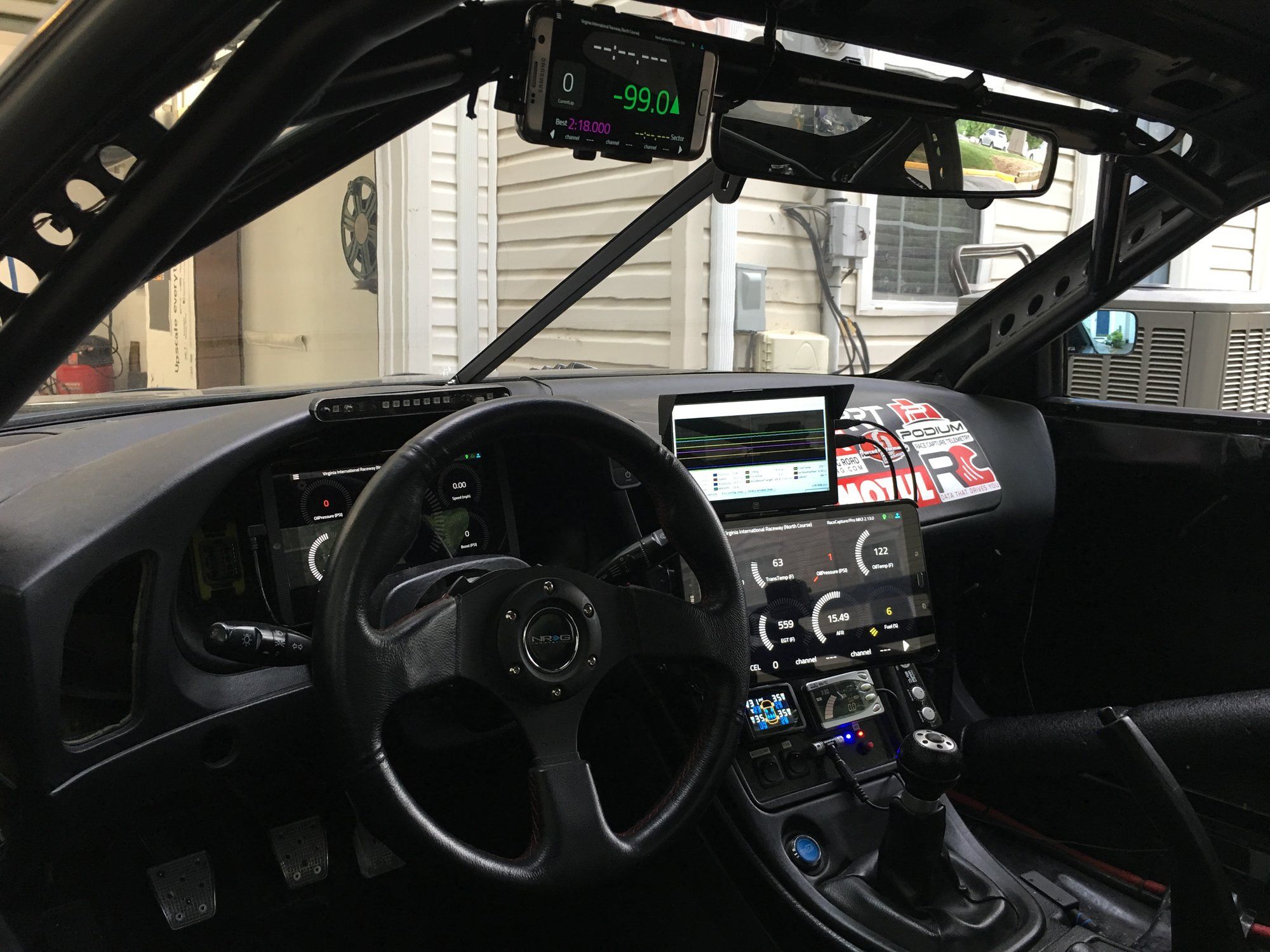

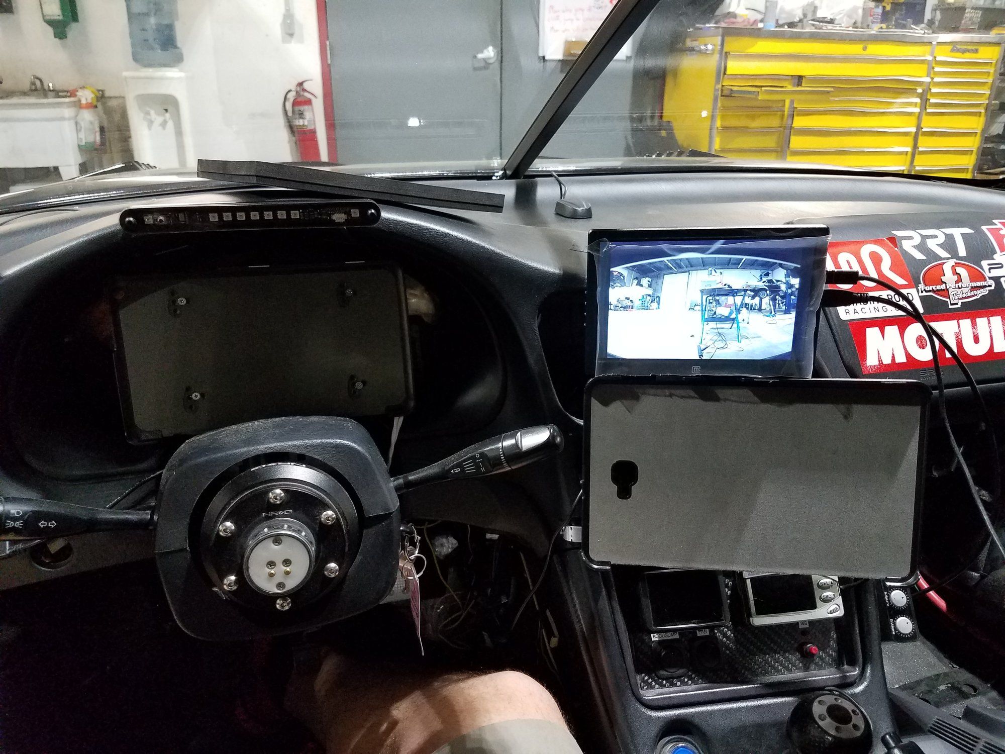

RRT did a prototype mount for my rearview/ecmlink display and I stopped by to make sure it's how I wanted. I also brought my gopro and cables to hook it up for a test. Look really cool :) It just needs to be tilted slightly from its current angle and a small hood made for it and we're golden.

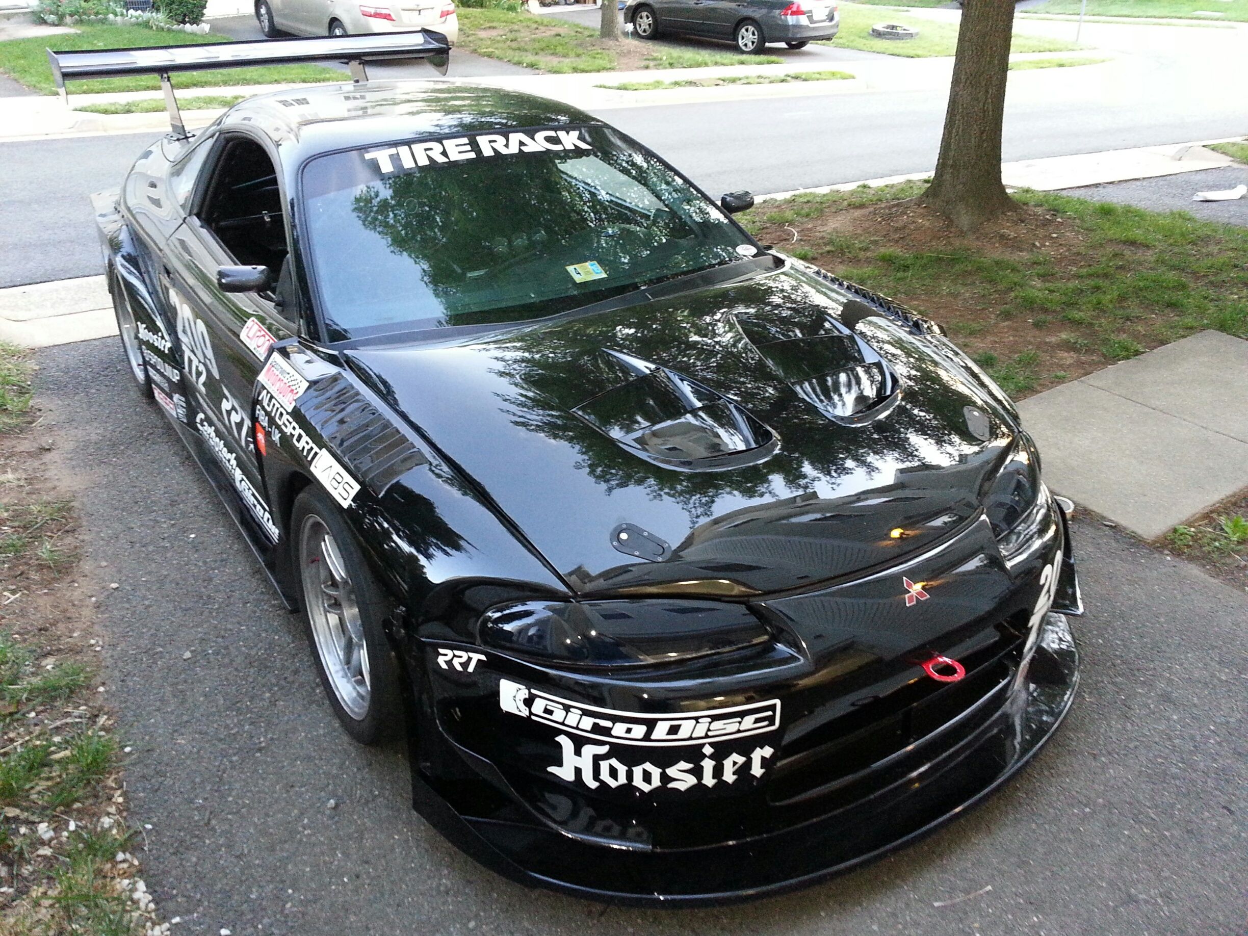

Install of the Pi running ECMLink completed. Rearview mirror is still there in the pics but I removed it shortly afterwards.
I did a lot of automation for my install and am debating releasing a product. Still deciding if it's worth my time. My setup does quite a bit of neat things I think:
- Boots in less than 15 seconds. Starts up ECMLink, automatically, connects to the ECU when available, and automatically starts capturing if not already. Takes maybe 15-20 seconds to start capturing from when I turn the key to On.
- Automatically restarts ECMLink if it crashes (though that hasn't happened yet)
- On power loss (like when taking out the key) the system gracefully stops capturing (saving to disk), and then shuts down the Pi to avoid file system corruption.
- Lights up a blue LED in the dash if capturing logs (i.e. so you know it's working)
- Saves to a removable USB drive if plugged in, otherwise to the local SD card
- Auto connects to my home WiFi and if connected will upload all logs to my Google Drive account
I'll see how it works at VIR next weekend.

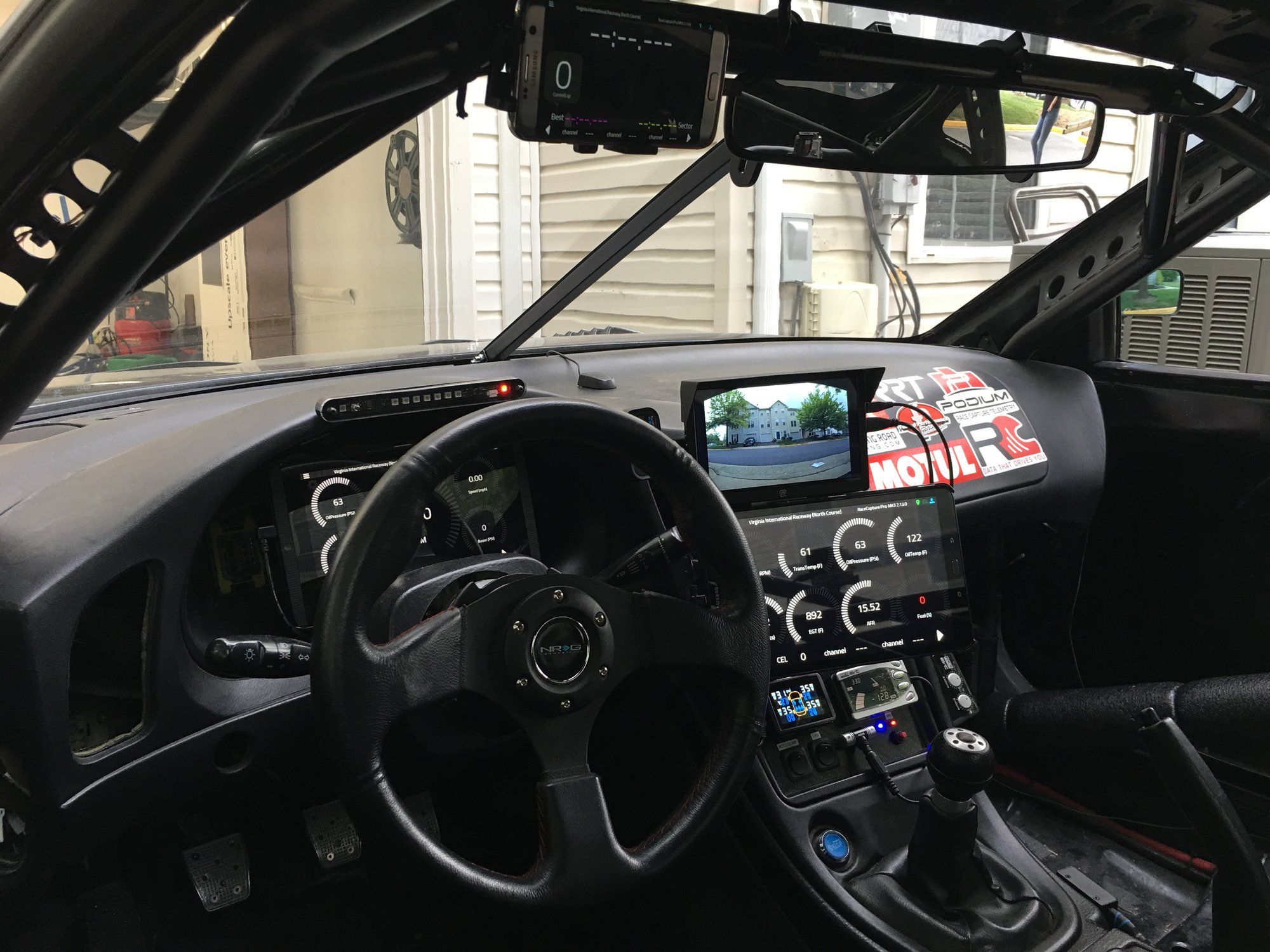

Here's the display running my rearview display. This is normally what I'll have up while driving to see out back. I used a simple push-button HDMI switch to bounce between the two. I imagine I'll rarely look at the ECMLink display and did that more for fun.

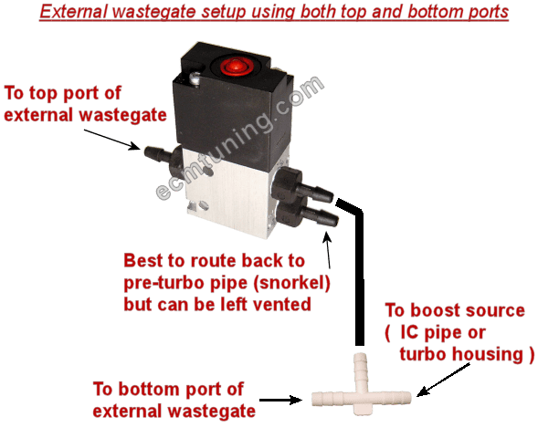

How is your ECMlink boost control set up? You using the IR solenoid? Are you running a restrictor in the signal line? How it it plumbed?
I'm using the IR solenoid for now, though in private conversations with Tom Dorris of ECMLink and some investigation I'm pretty sure the driver chip in the ECU can support the borg warner BCS so I may switch to that at some point. I have no restrictor of any kind. It's hooked up like this diagram:
fetch.php?tok=4dda58&media=http%3A%2F%2Fwww.ecmtuning.com%2Fwiki%2F_media%2Fexternal.png
The turbosmart internal wastegate is a twin port design hence the above configuration. Only confusing part about it is it's "top" port is the functional equivalent of a typical external wastegate's bottom port. I actually had everything hooked up backwards initially because I didn't realize that (though it's obvious once you think about how it's constructed).
Just discovered a problem with the rearview and man do I feel stupid for not seeing it beforehand. It's horizontally swapped from what you would expect/want from a rearview camera. I.e. what is on the left side of the image is actually happening on the right rear side of the car. This never crossed my mind. I never realized rearview cameras did this inversion, and yet it's so obvious if you actually think about it. Just goes to show how the seemingly simplest of ideas can actually have a lot of hidden hurdles to overcome.
So now I'm looking at alternatives. One is seeing about feeding the gopro to the pi and having the pi handle the image display and horizontal inversion. Another is seeing if there are any inline hdmi devices that can do the inversion. Or I just mentally get used to the camera not being like a rearview mirror.

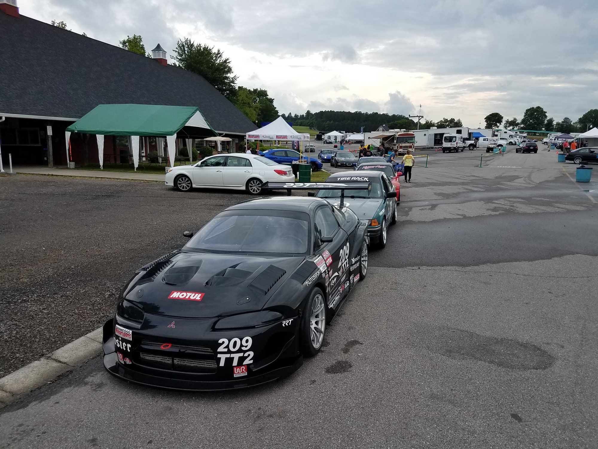

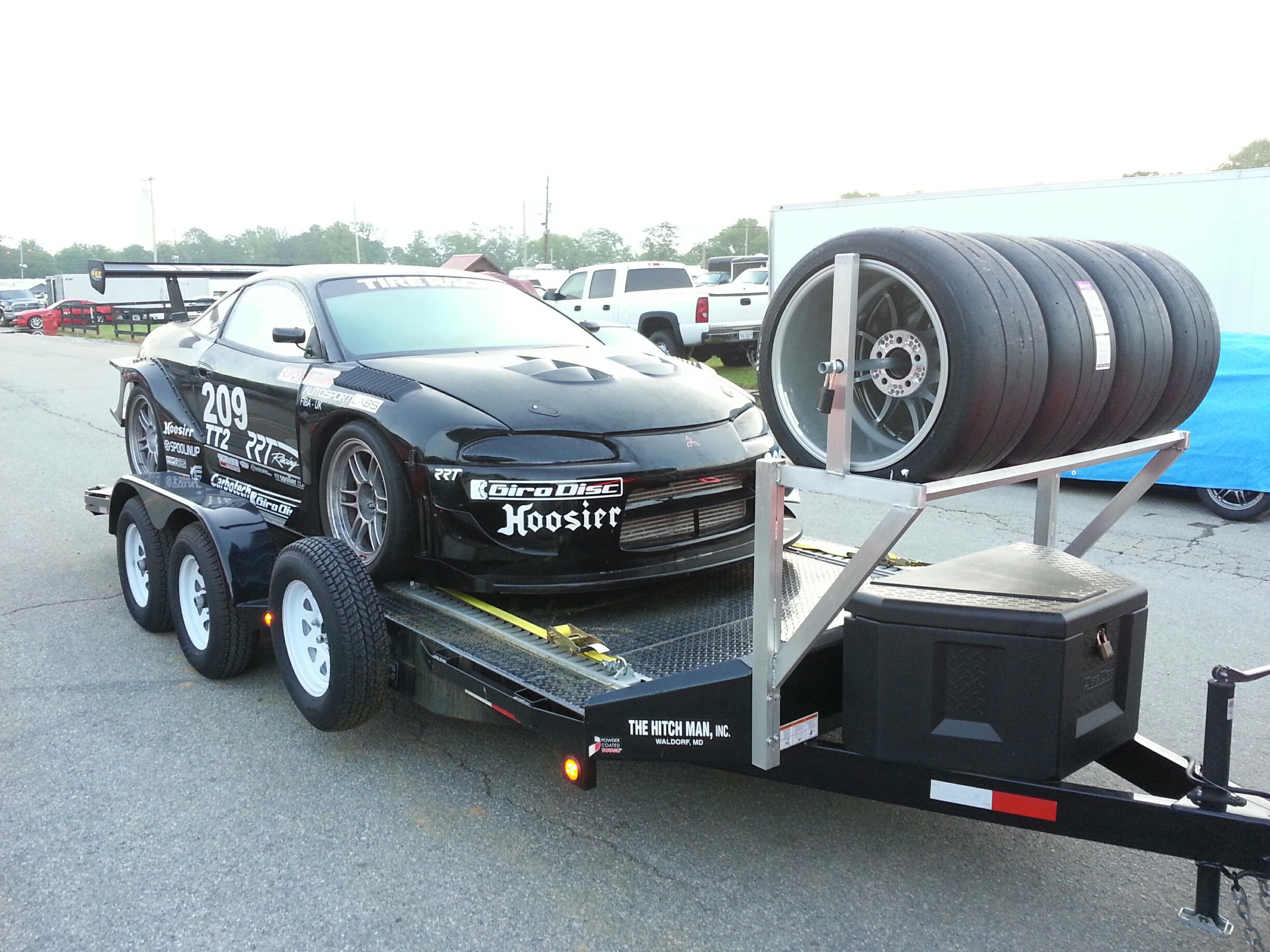

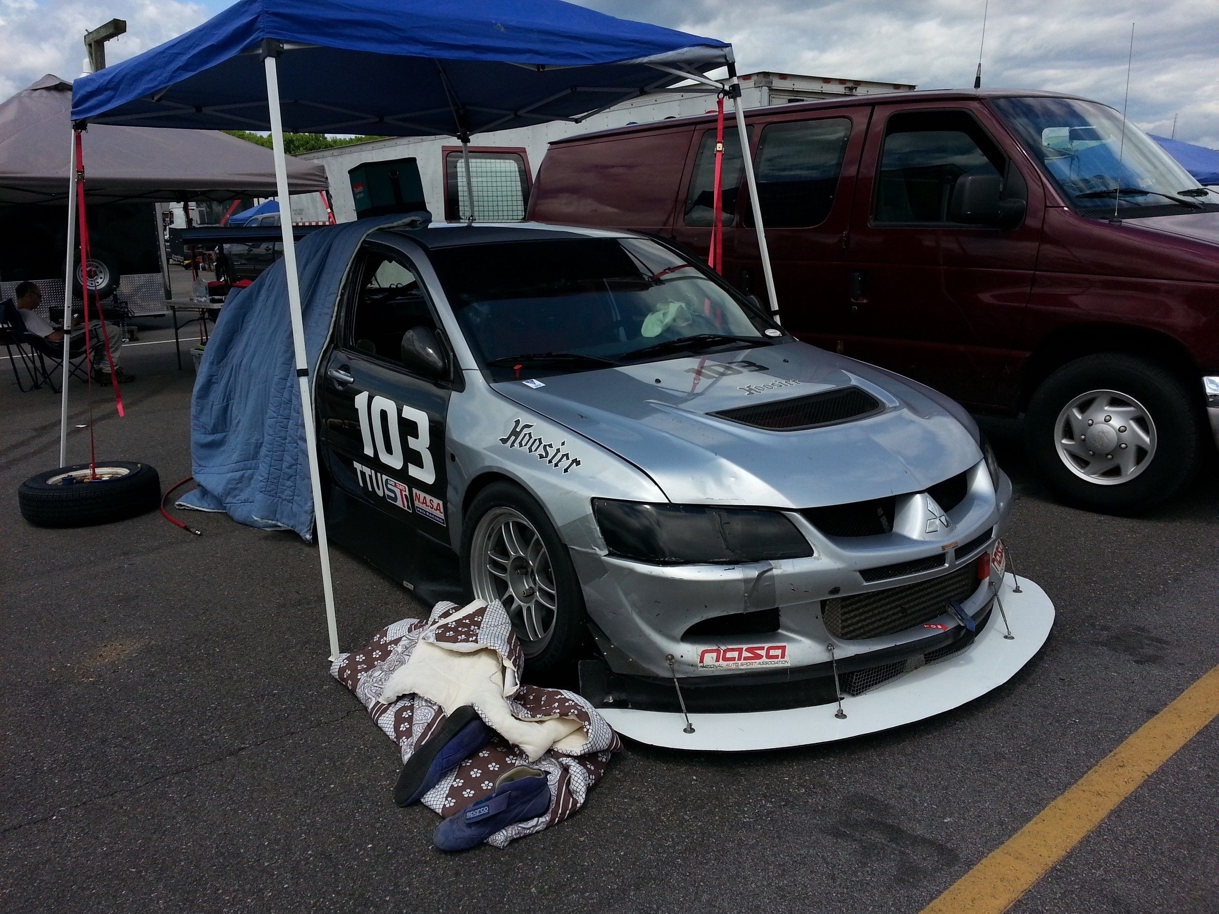

Pic from earlier when I left. I'm at VIR now waiting to get in:
