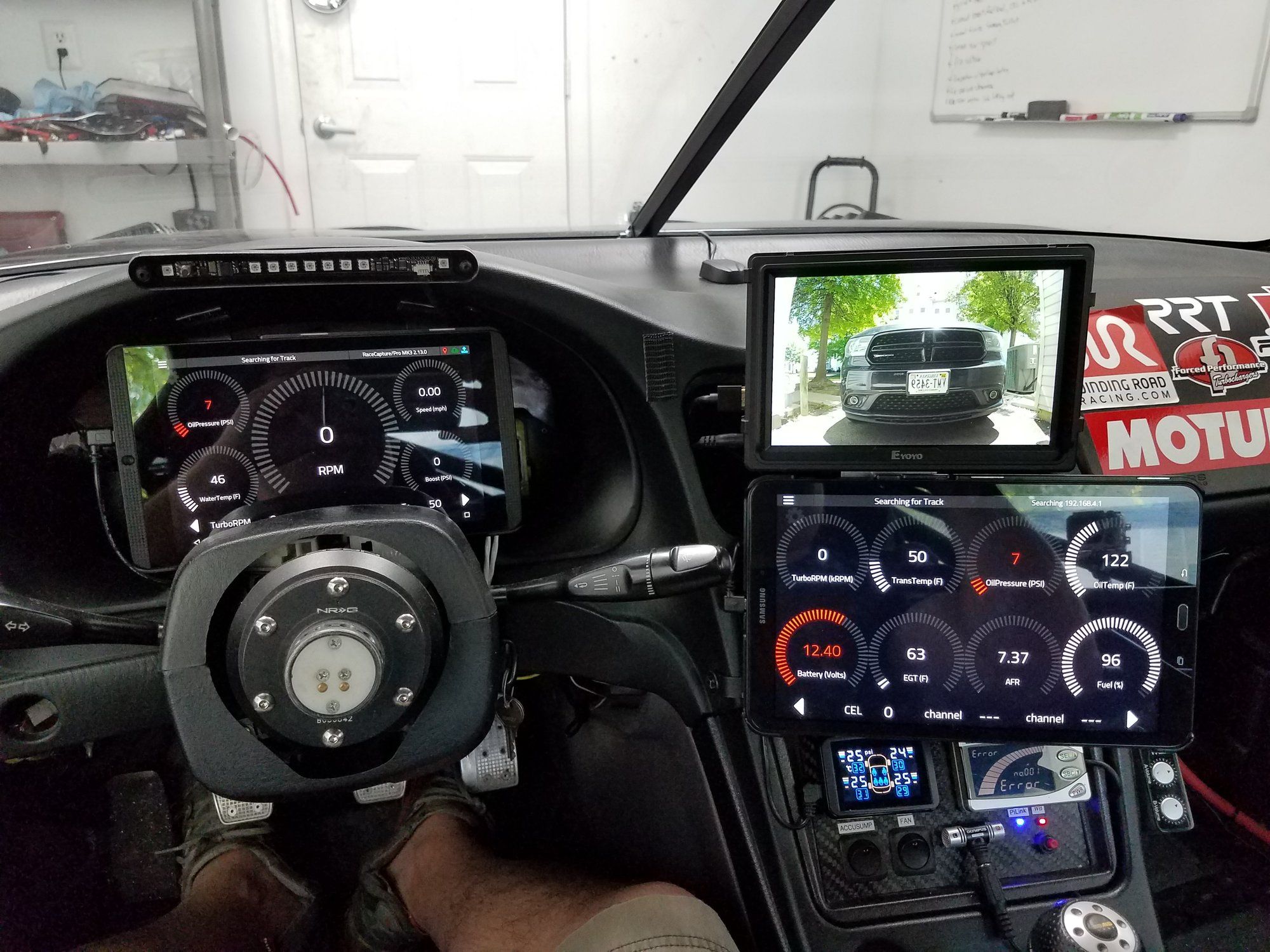

In the meantime I did solve my rearview camera issue (it was bugging me so much). I found a display that was even better than what I had that was higher resolution (1900x1200!), came with its own sun hood, took direct 12V power (rather than requiring a step-down converter to 5V like the other one) and had a built-in function to flip the image. Installed it late last week the day it arrived (thank you Amazon Prime!). It didn't come with the 12V plug as they assume you'll use camera batteries (it's targetted towards photographers that will attach to a camera), but I just cut one off a power adapter I wasn't using and wired it right the car. Hood's not installed in this pic but it just velcros in.
It's a little more expensive at $139 vs $69 for the other display.
https://www.amazon.com/gp/product/B077YL6W65/ref=oh_aui_detailpage_o04_s00?ie=UTF8&psc=1
John what is that hammer looking thing by your accusump button (looks like a mic of some kind)
Go Go Gadget Hammer!
Actually it's the microphone for my gopro inside the cabin. That gopro is in a sealed case (to house the cam-do stuff for the 12V power and auto-power on) and so using its mic sounds awful. Even when it wasn't in the sealed case it sounded awful, the gopro hero 3 black had awful mic performance if exposed to wind. So I use an external stereo mic mounted on the dash. Noticeably better.

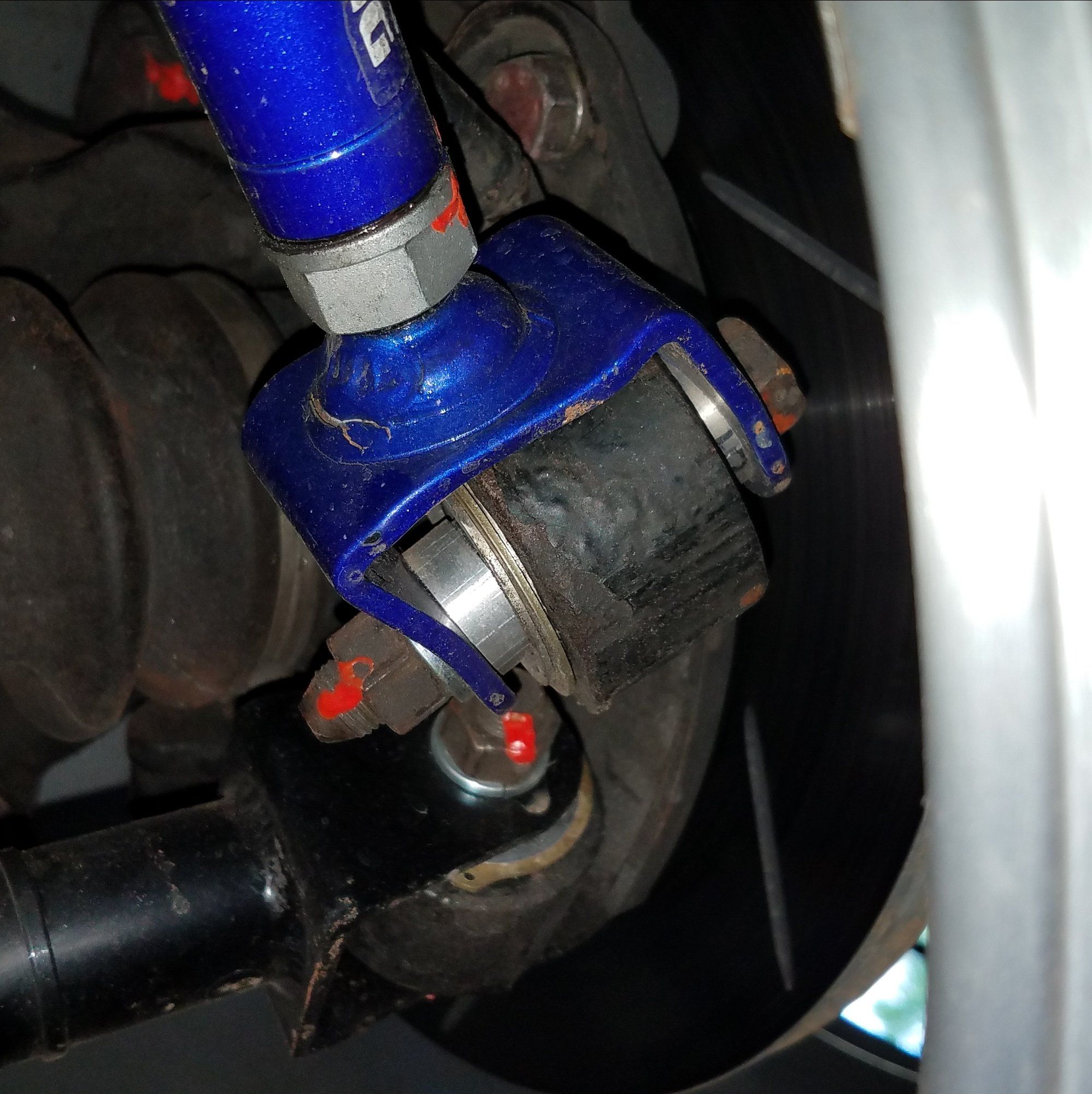

Friends don't let friends by Megan Racing suspension products:View attachment 544011
Working with Paul Volk to get a better set out asap. http://volkmetalcraft.com/product/2g-tubular-rear-trailing-arms/
You can delete this if you wish John,
John messaged me about this last night and i straight away started mulling it over and the progress of figuring out how this happened. I came to a conclusion that its shifted on its axis via the sphericals and because of this its now creating side loading on the bracket when its in motion because its essentually drooped over, my Boss also confirmed my theory.
So while the Megans are budget arms the material might not be super great but decent enough, i think they do the job but any arms placed on there will still do the same thing its just a matter of time,
The issue needing attention is the spherical bearing is needing a support ring made from nylon or poly to keep it in the upright position then that will take away any possible side loading on the bracket itself because it cannot take any side loading its Just to take the free movement out of the gap between bracket and knuckle mounting area.
If this has done it here then i suggest making supporting bushes on all the sphericals just as a precaution and widen the supporting face of the spherical.
Thats my advice i messaged John and thought i would share here aswel so we get correct info on this and make sure it dont happen to anyone else. Aka @greengoblin LOL i know you done this mod too.
This was without any impact.
I am mulling over the possibility of the spherical contributing or causing this failure, and not necessarily the arms themselves. Keep in mind though Andrew raced on custom arms with sphericals and never had this issue (spoke with him last night about it) so I'm not inclined to say the arms can't deal with the problem if designed to be better, though what "better" will be is TBD. Andrew didn't recall specifics on the design Robispec used for his car, and has no pics to share.
Paul Volk's modifying a set of his arms to beef them up and will ship soon, and then I'll discuss further with RRT when we have everything in hand and take a guess as to how to make this problem disappear.
Has any reinforcement been done to the inboard pickup mounts of the trailing arms?
No. When I was doing the transition to all the sphericals RRT looked at that area and didn't think any reinforcement was necessary. When we pull these arms though we'll see if there is evidence of any issues and address.

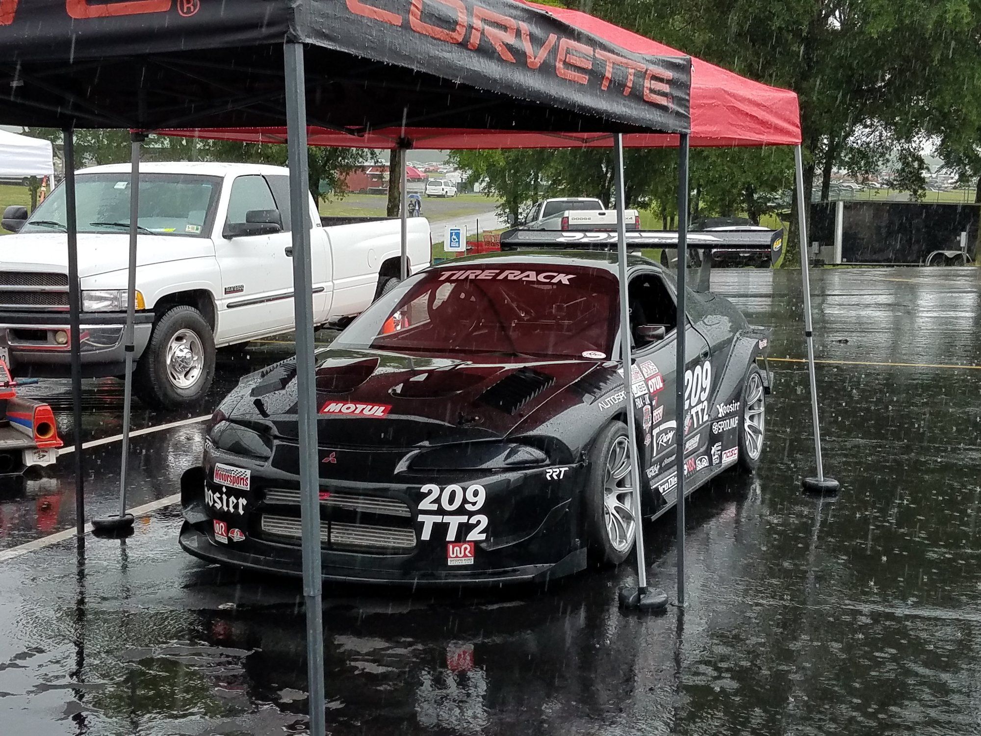

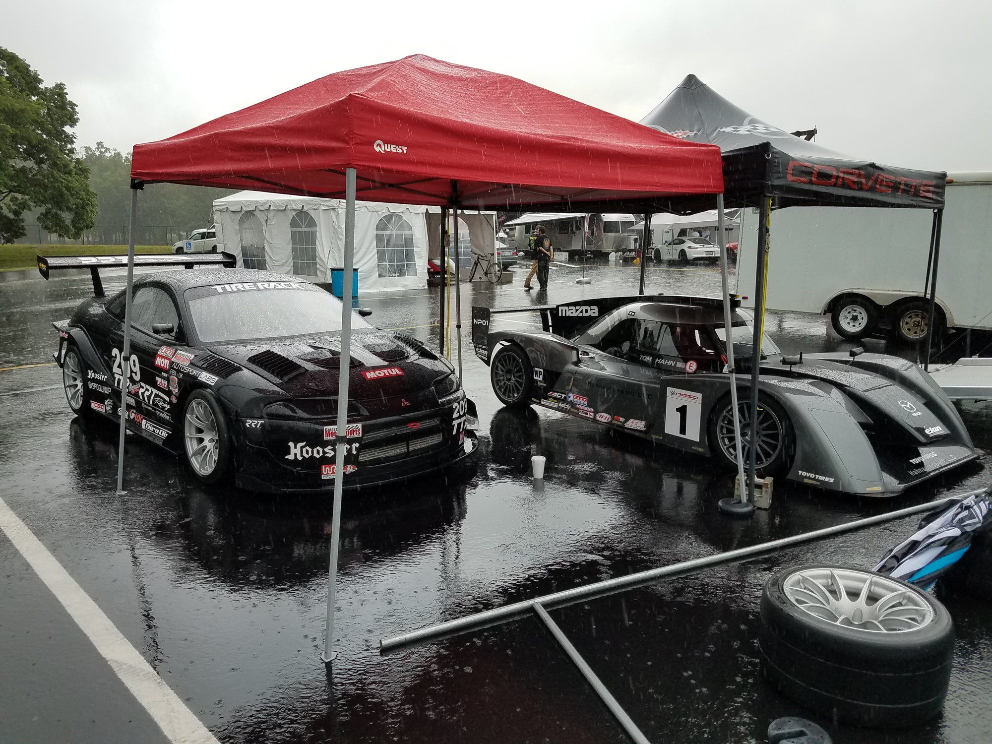

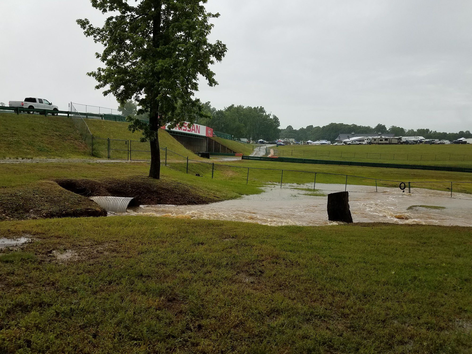

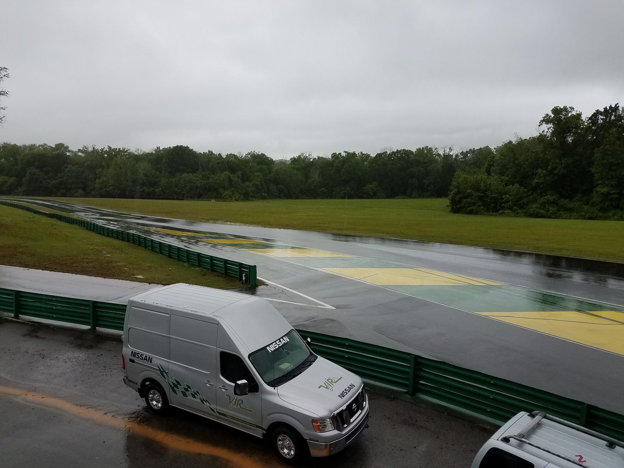

Friday, day of the Ultimate Track Car Challenge, was basically ruined by rain. Seriously crazy rain. Just nutso.
We had a couple spots of hope where the rain stopped, and the track dried up briefly. I actually went out on track and put myself at the very back because I was still very uncertain in the ABS, the rear suspension settings, and the new turbo setup. I literally kept myself last until I got bored and passed some terribly slow cars. I basically drove around the track doing maybe 50% throttle, kind of braking a bit, but most of the time I sat behind I think an RX-8, or maybe it was an S2000, who knows. We had like four dry laps before the rain came back and I came in immediately because as soon as I hit any wet pavement I started sliding around and it was scary. I didn't really care about setting a time

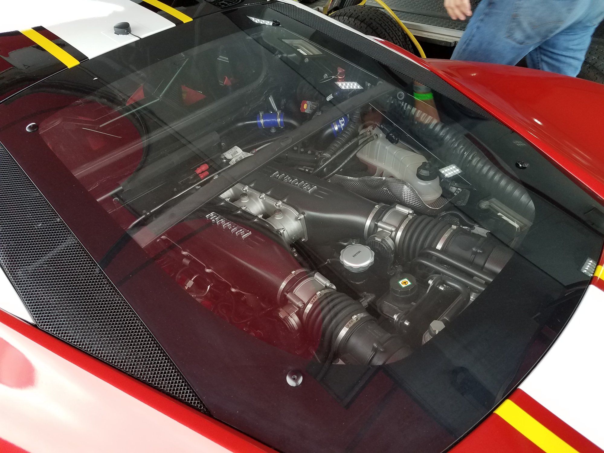

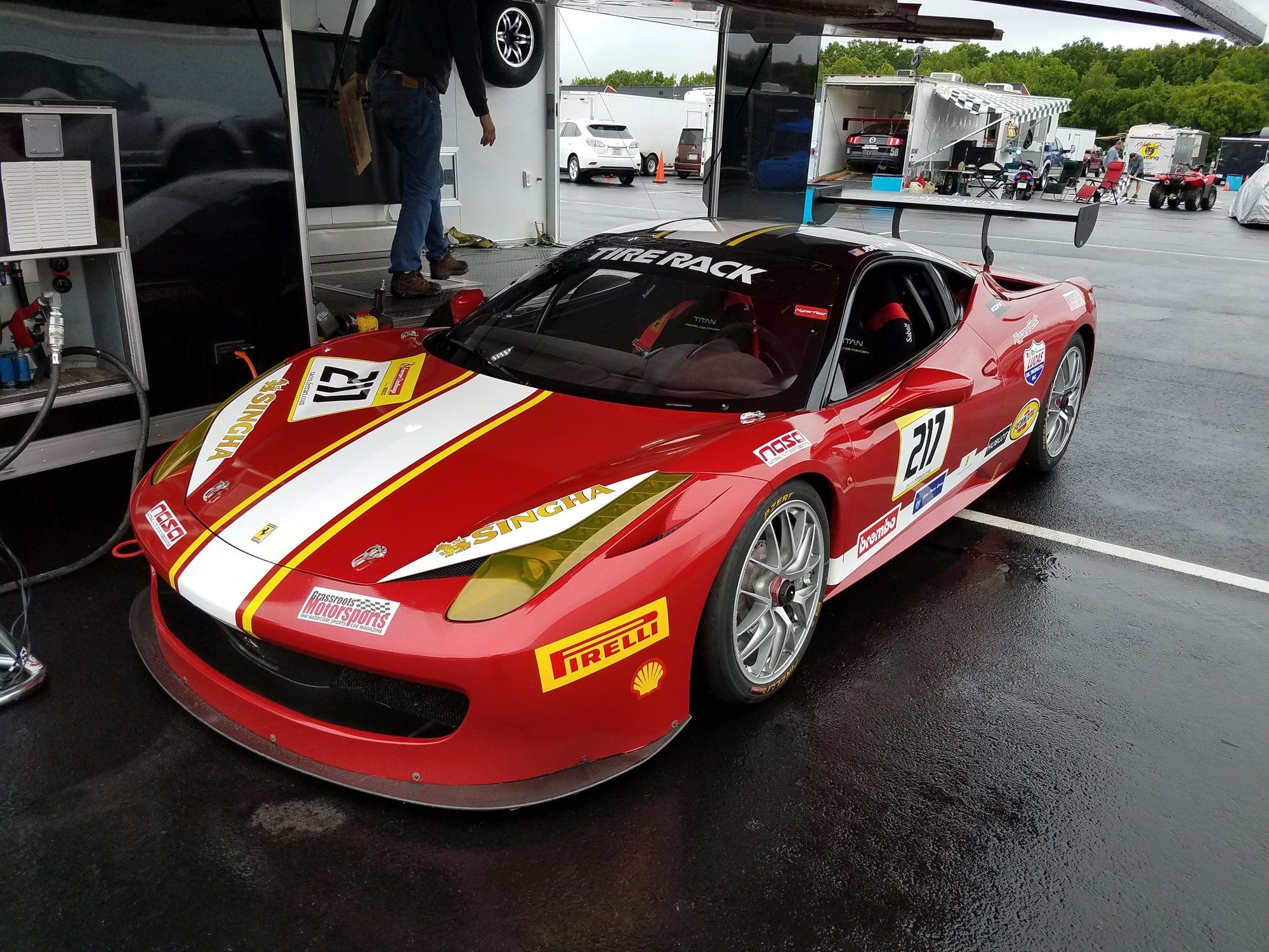

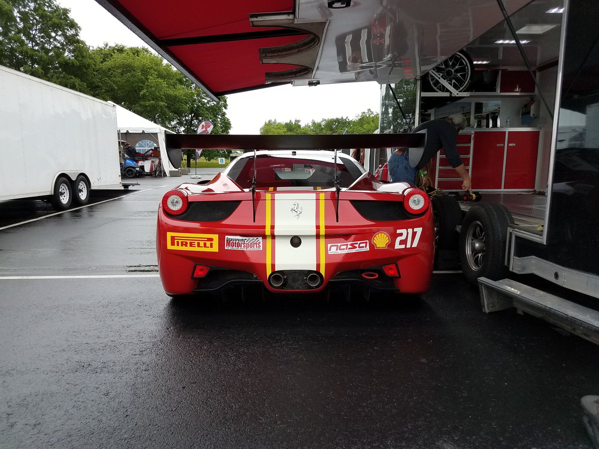

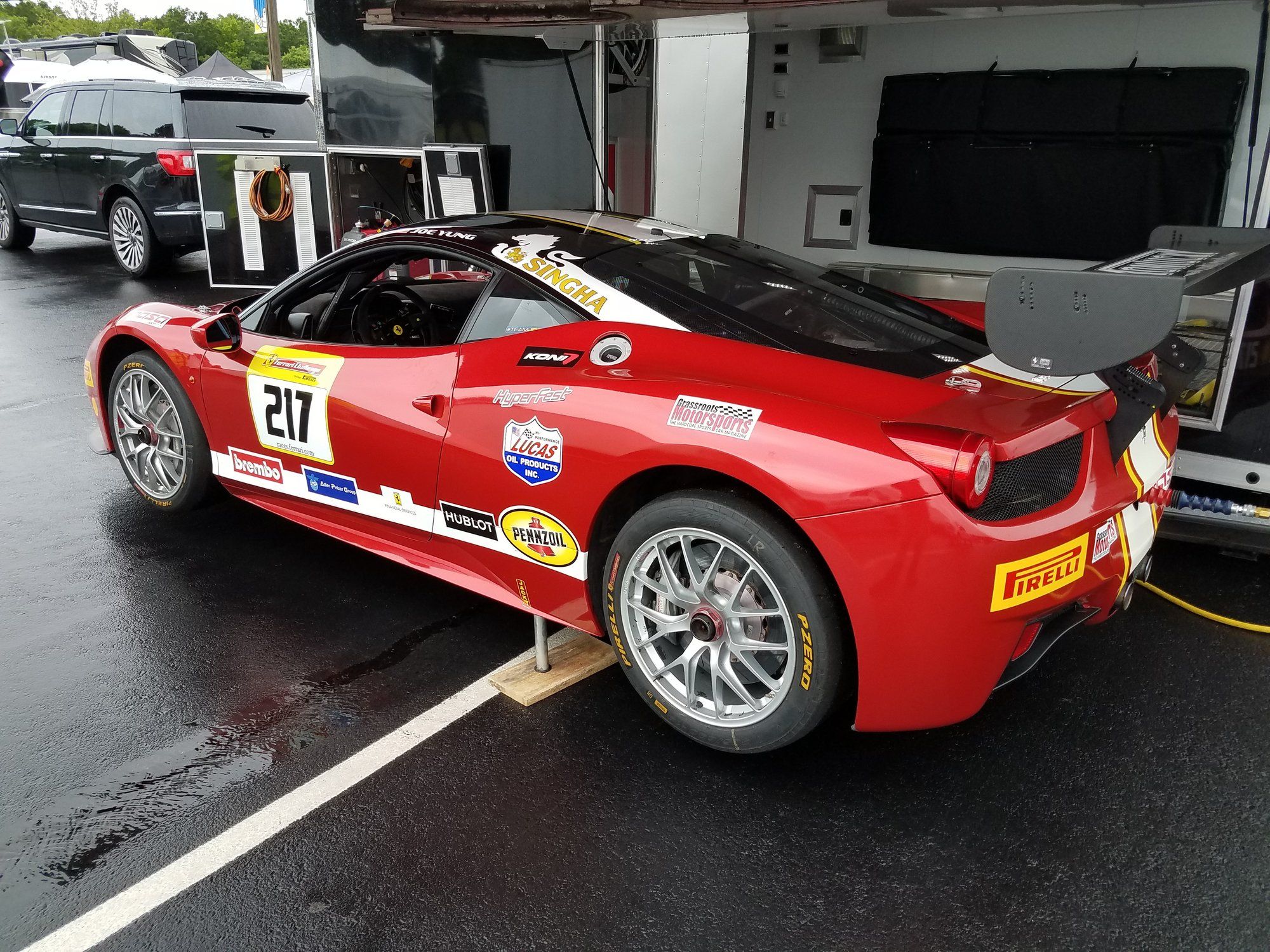

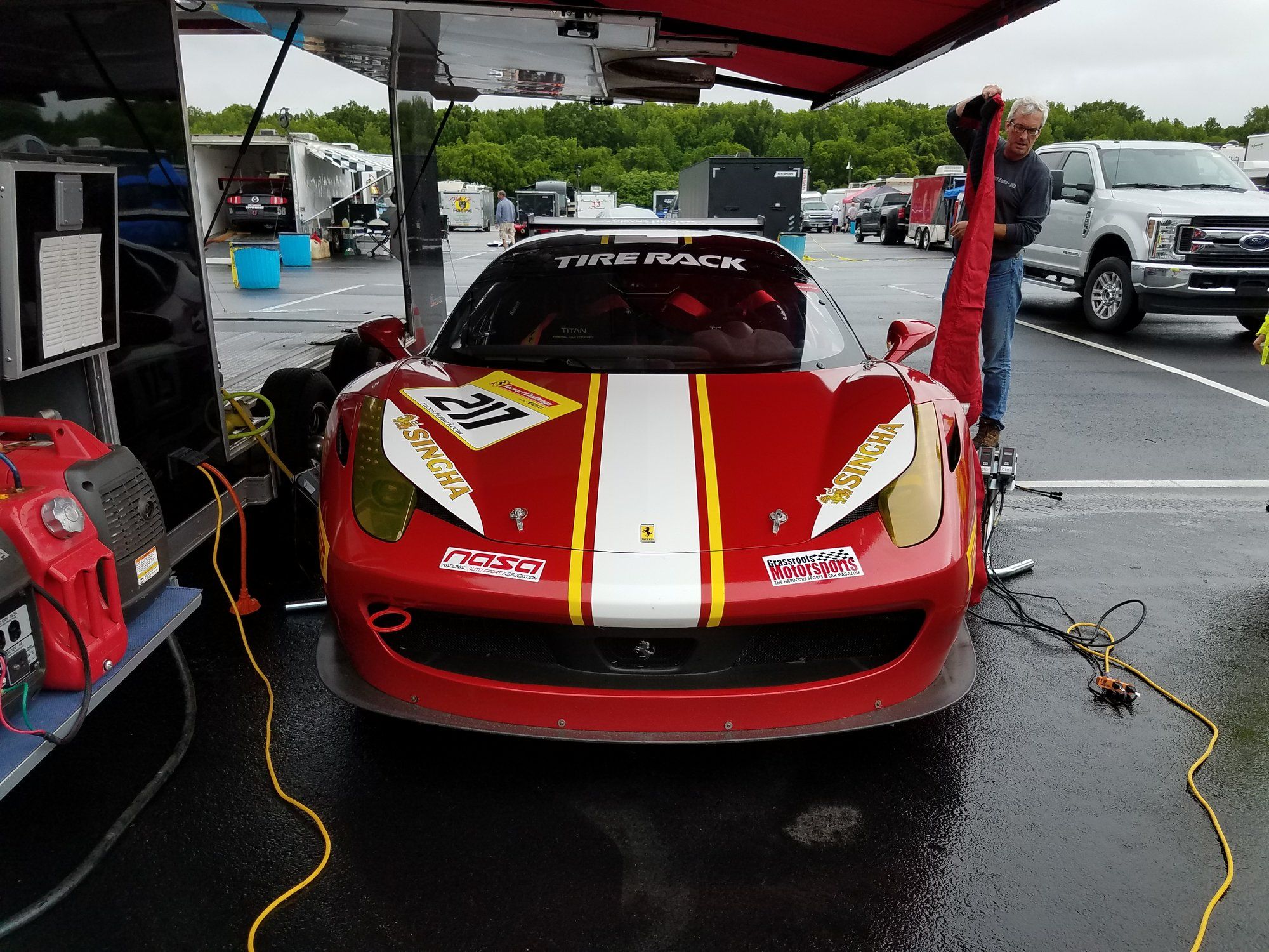

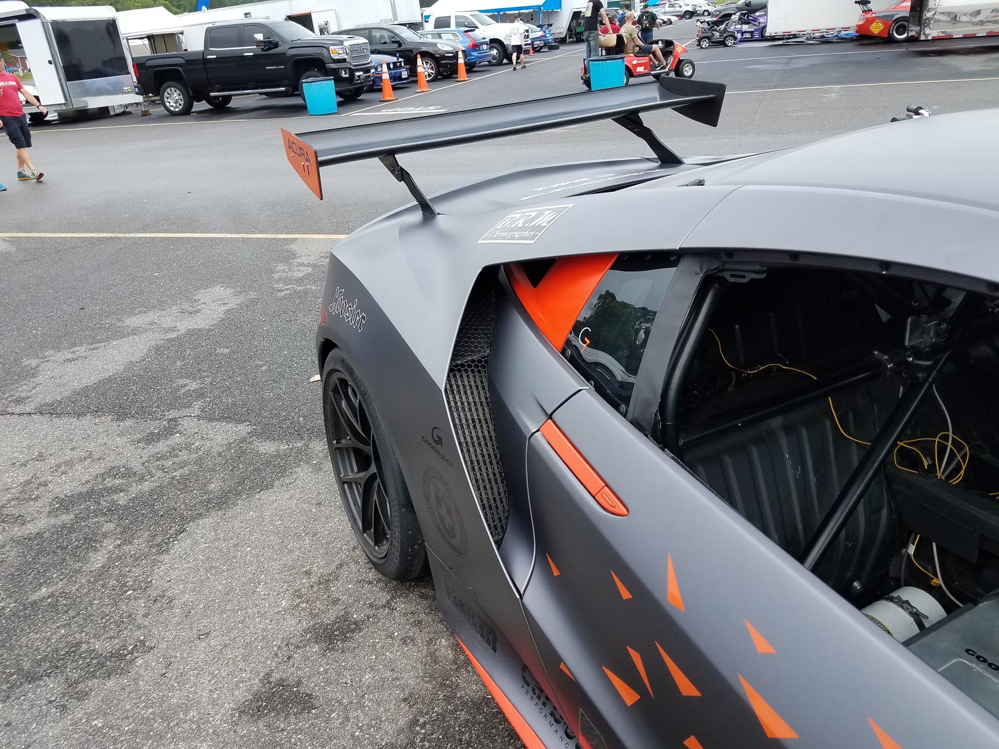

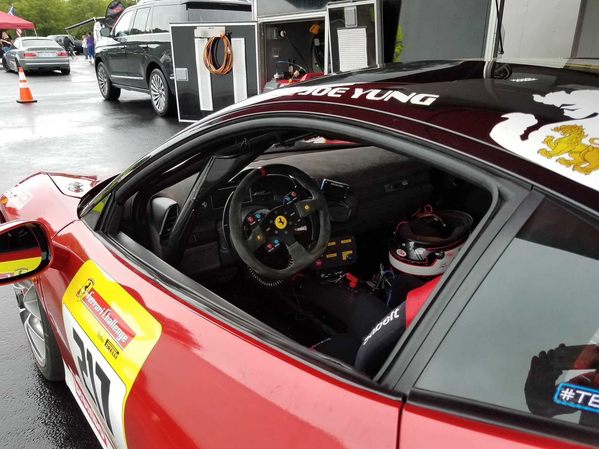

Oh this 458 Italia Challenge car... man was it nice. Vinyl wrapped, said it was actually black. Vinyl looked bad, but he's racing so I doubt he cared. The guy's trailer had a GAS PUMP built into it, as well as air compressor (which he used for his built-in air jacks on the car). He also had tire warmers. For Time Trials. Nuts.

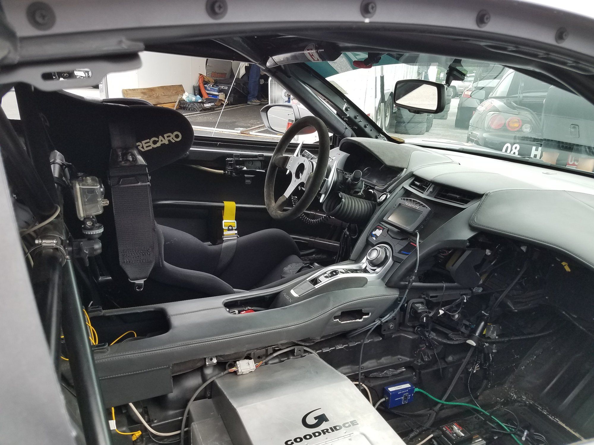

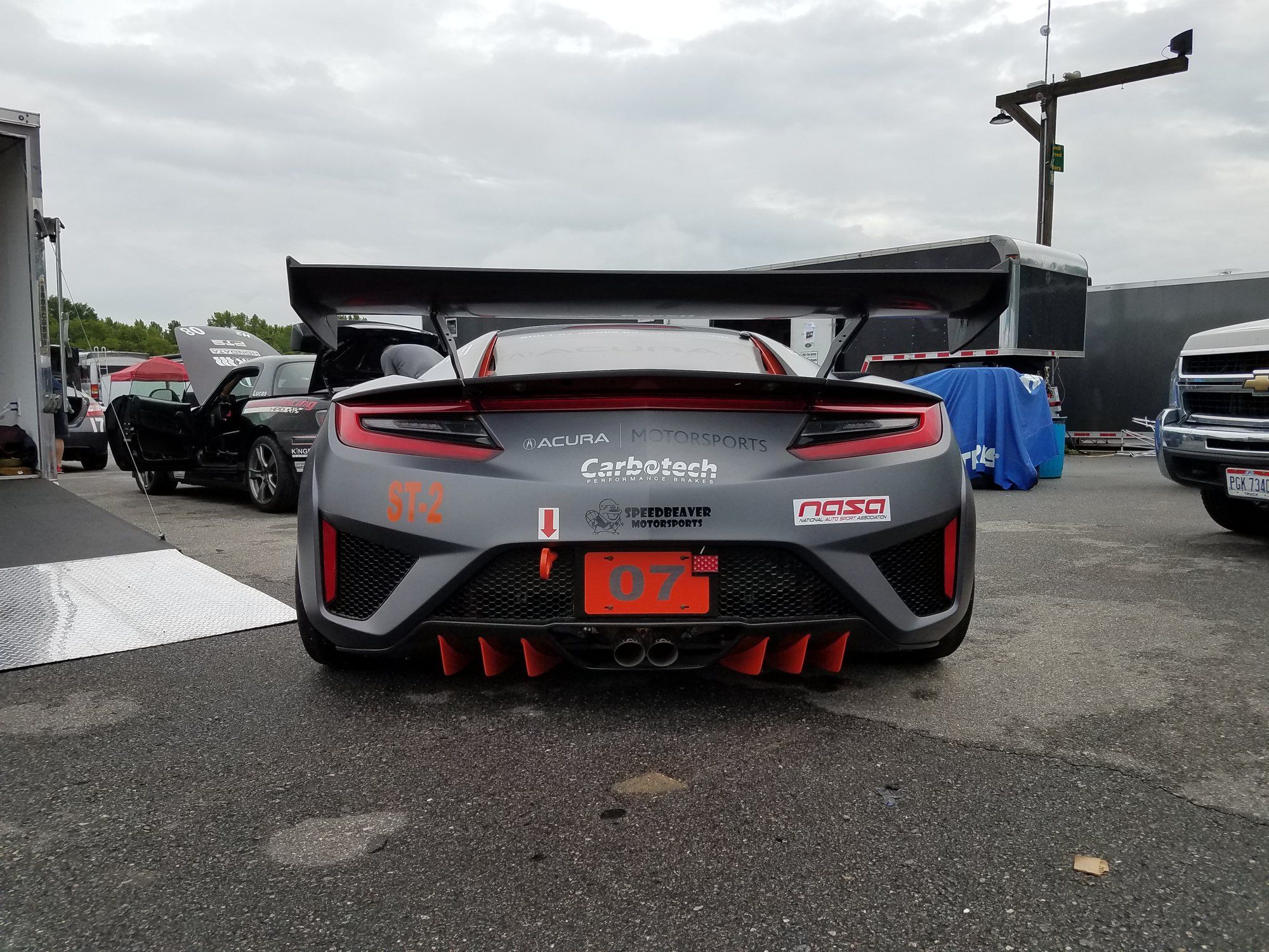

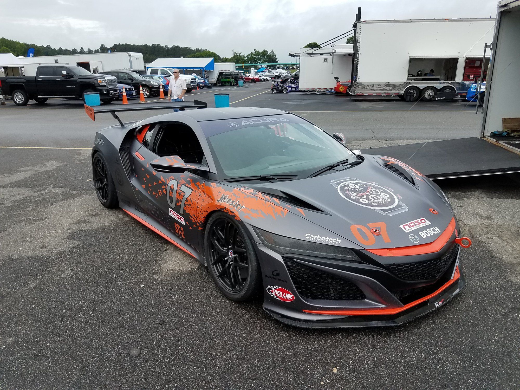

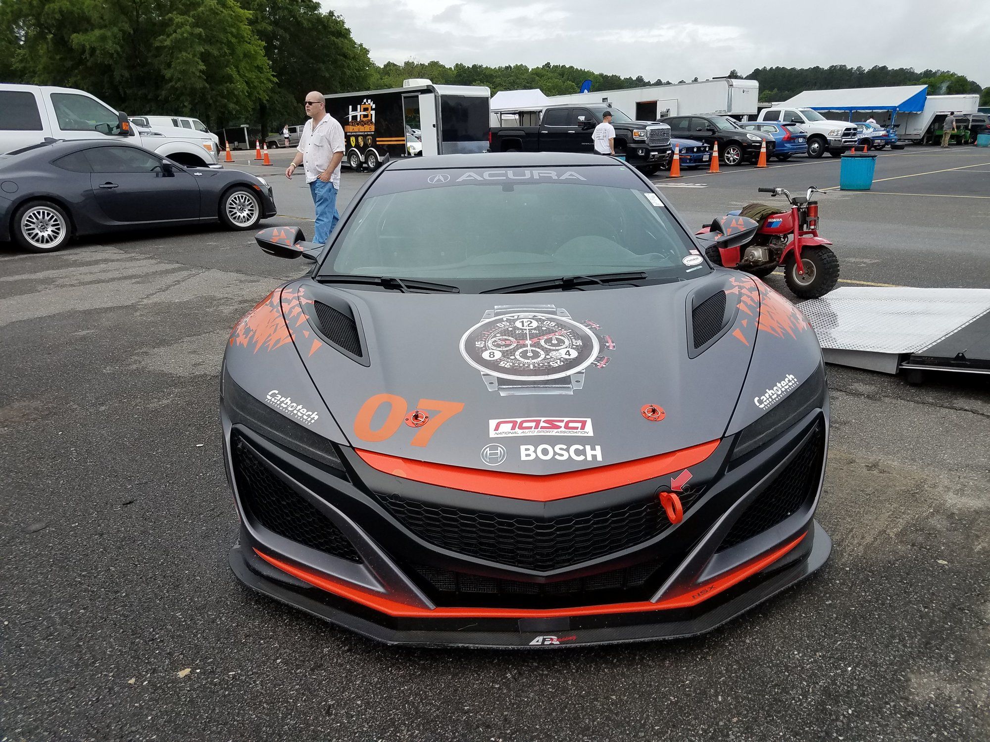

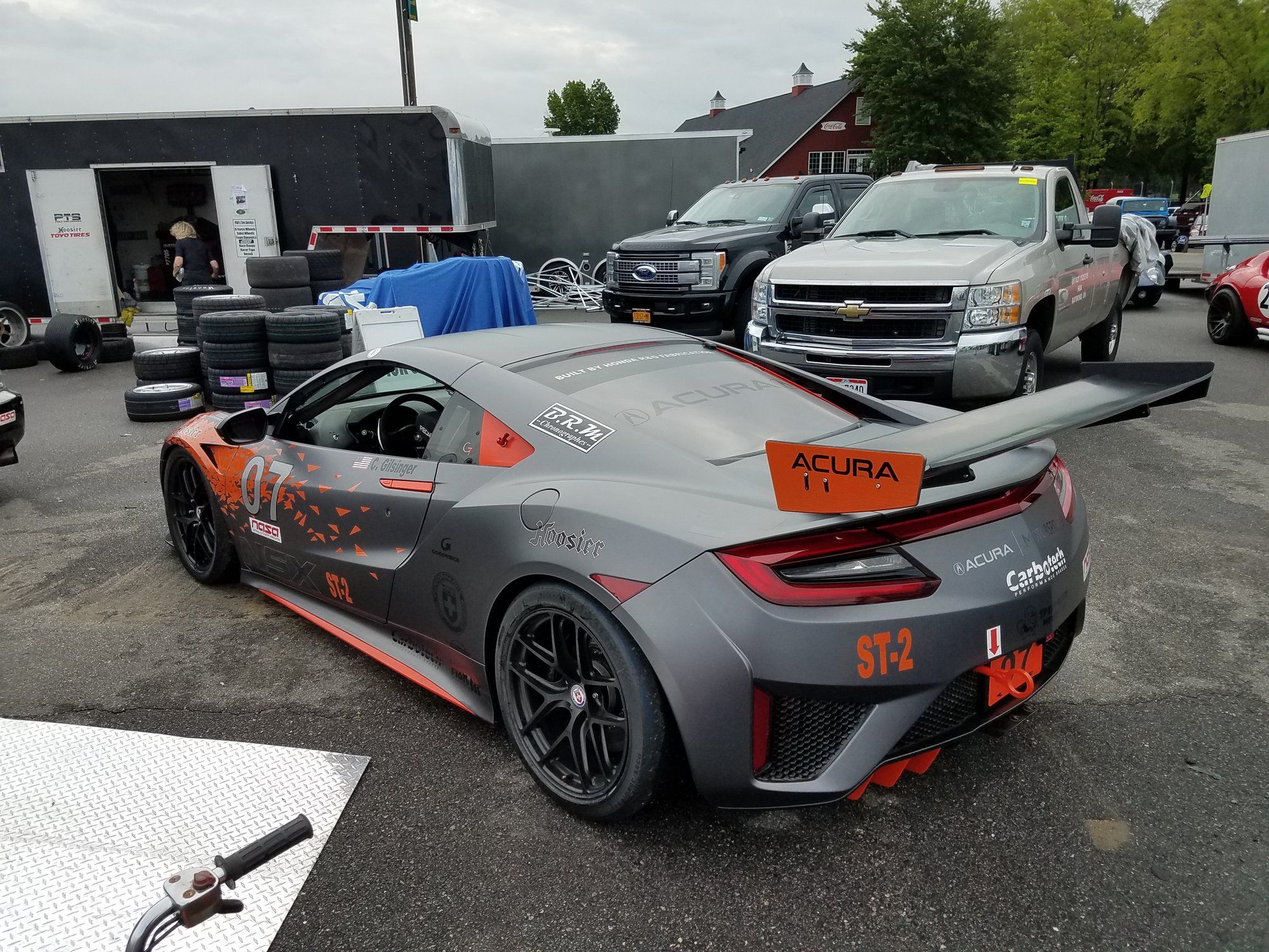

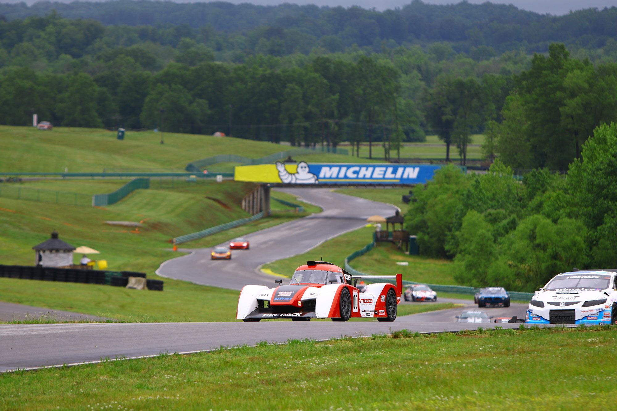

This was brought out by Honda R&D. It ran a 1:58 later in the weekend. Somehow it was in the ST2 class, and guy claimed it's basically stock weight and everything except for the wing. Of course it's extremely gutted and based on the OEM specs I see no way it comes close to fitting in ST2 but whatever. It's pretty, but who the heck would pay that much money for a 1:58?

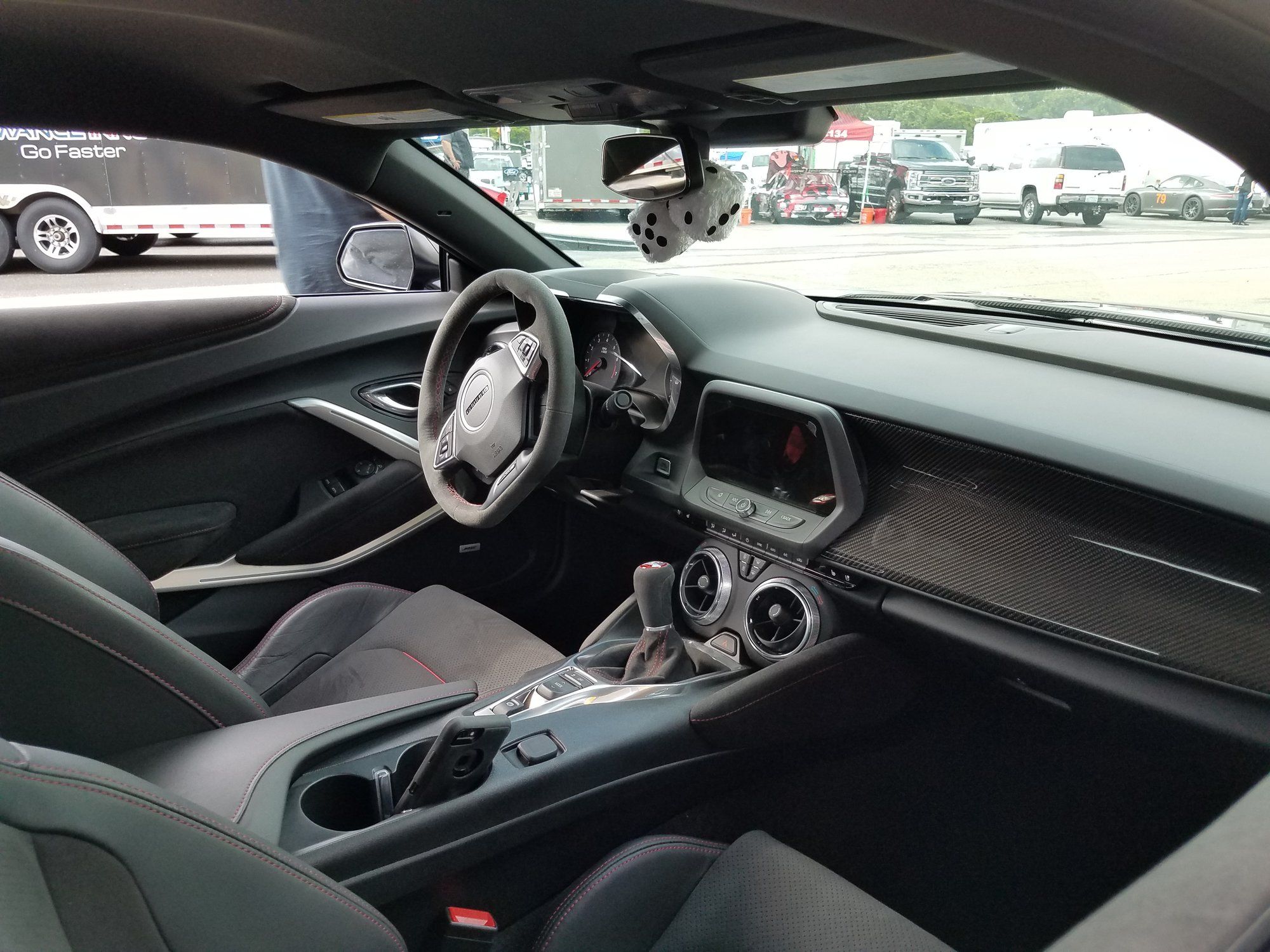

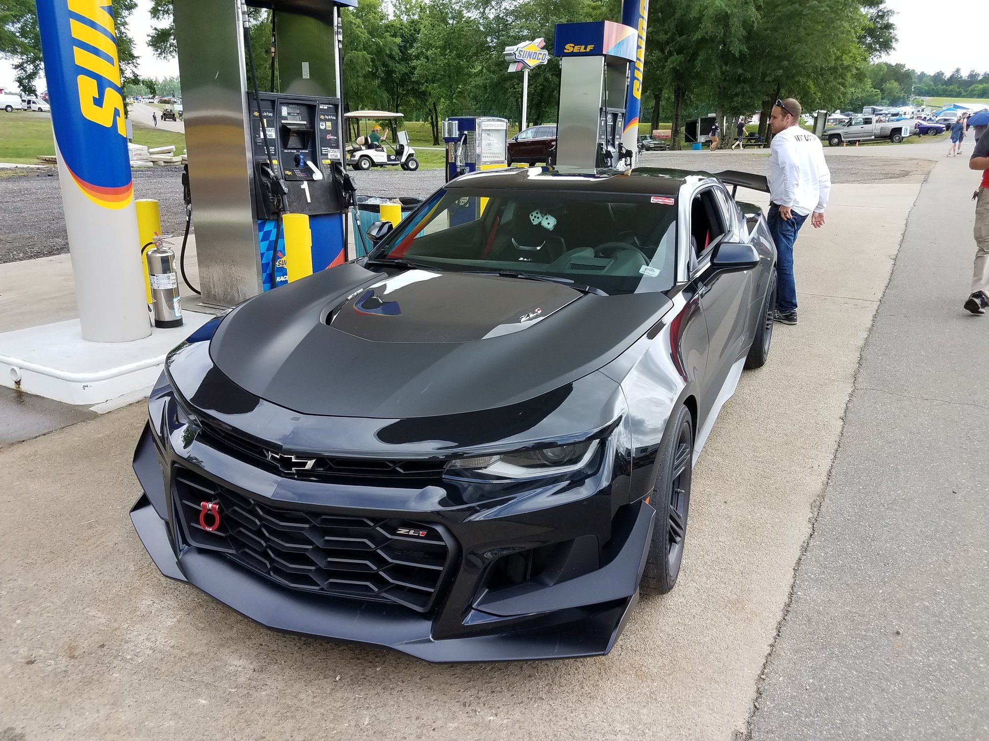

Camaro ZL1. Dear lord this thing was incredible to look at. Batmobile and then some. Such a badass car, and sounded amazing. Sadly don't know what kind of times he could do thanks to the rain.

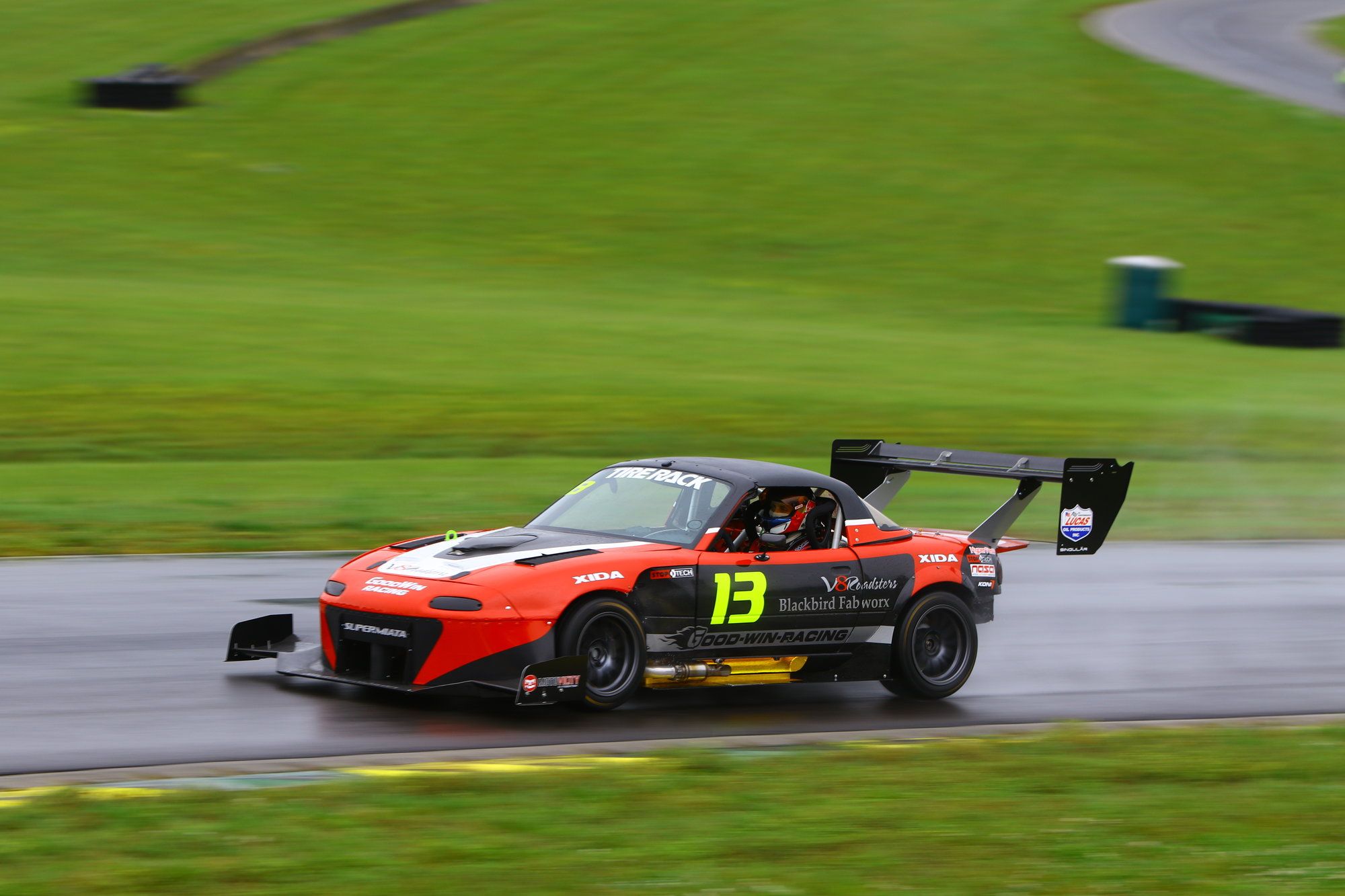

LS-something powered Miata with some solid aero from the west coast. I think later in the weekend he ran a 1:57? I forget. With practice his car could do an easy low 1:50 I think. Pretty badass.

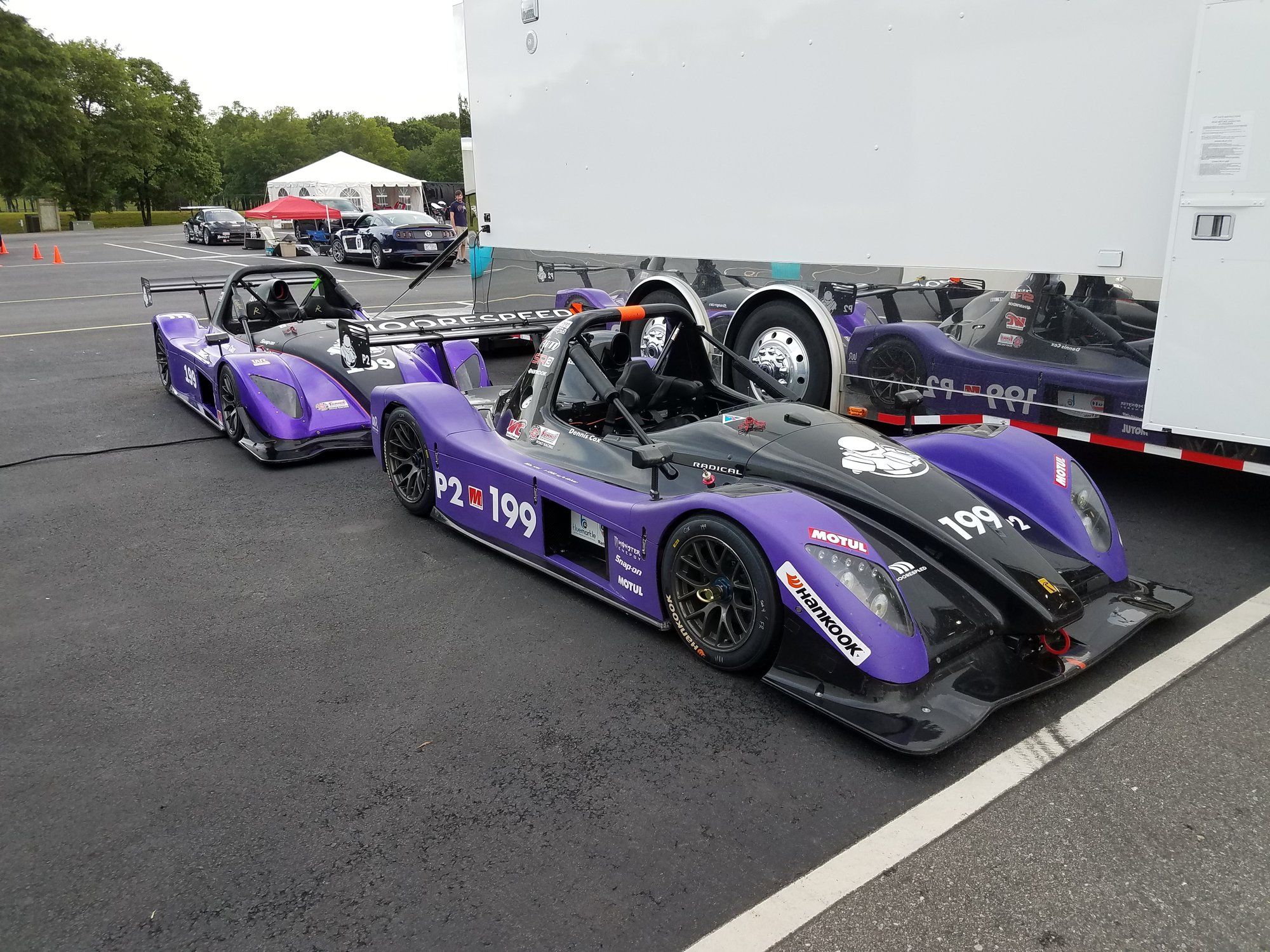

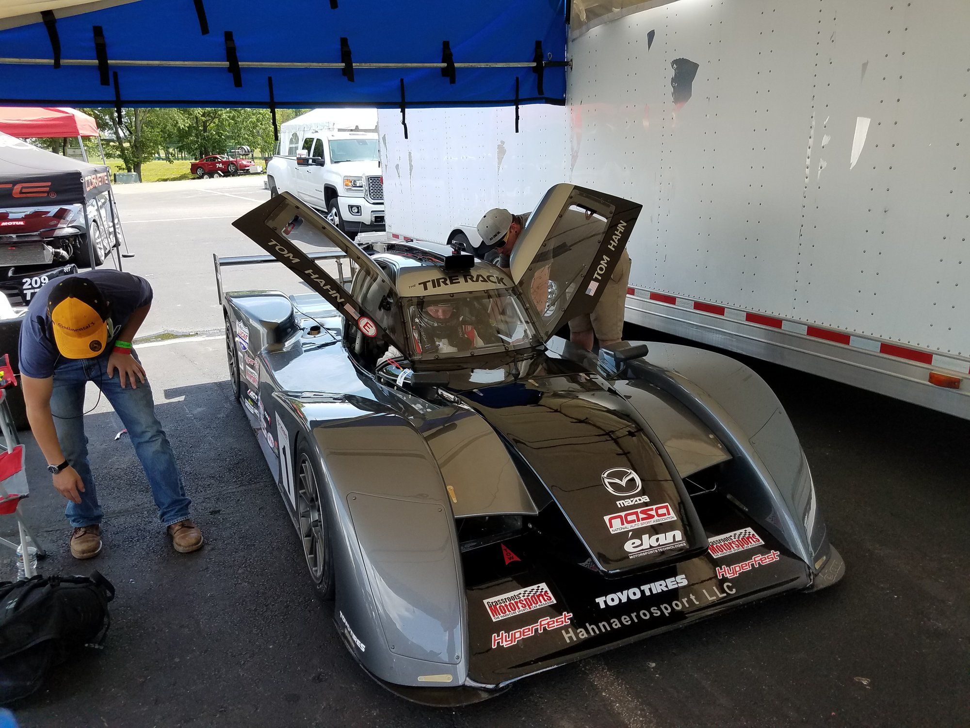

This is NASA's spec racing car, though this particular one is their upgraded version and so not actually spec. This one had a rear diffuser, Hoosier (vs Toyo Proxes) tires, about 50 more horsepower at something like 240hp, and I forget if there was anything else. He won the event with a 2:01.083 that he snuck in during the dry time, though he must have hit traffic because that car should be doing 1:55 or better. Second place was the green Superlite SLC car which you can see pictures of if you go back through my old threads as I know I posted a pic at some point.

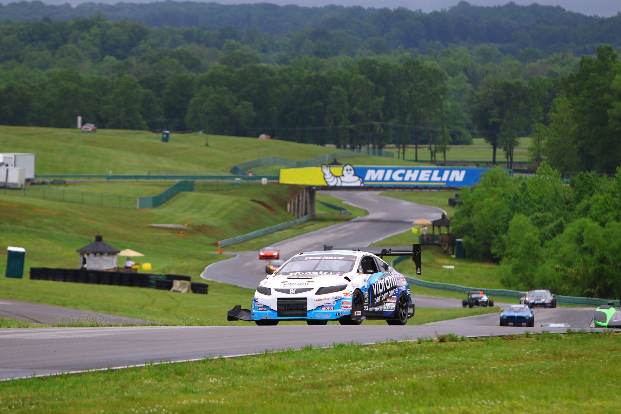

William Au-Yeung's I think 800+whp Civic. Was at World Time Attack last year. He had just blown away the Global Time Attack Unlimited record at Road Atlanta a few weeks prior with an insane 1:19. I had expected him to win the event or at least put up a good fight with the prototypes. Here's the video from his record setting run:
He did not unfortunately. His car unfortunately caught on fire I think due to an oil line breaking. I heard from other drivers he was an utter jackass when it happened, getting out of his car on the live track and running across the track to a worker's station, getting a fire extinguisher (seriously he doesn't have one?) and running BACK in front of traffic to his car. Should be banned for that kind of shit. Anyway, to his credit I believe he saved quite a bit of his car as he's announced he's going to WTAC in Australia again later this year.

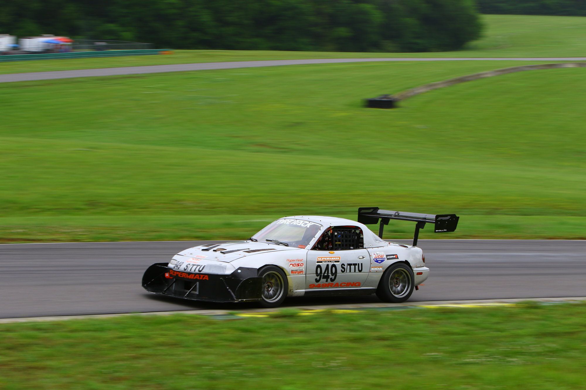

Another nutty Miata. I don't know much about this one.

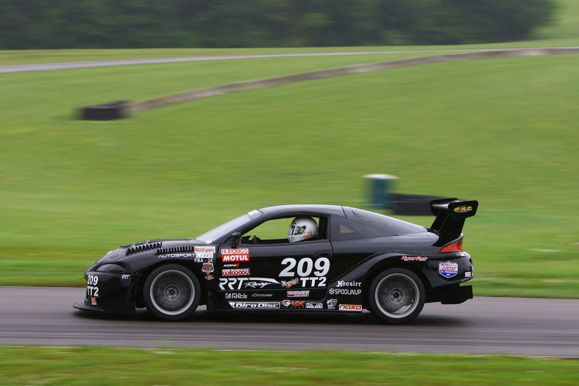

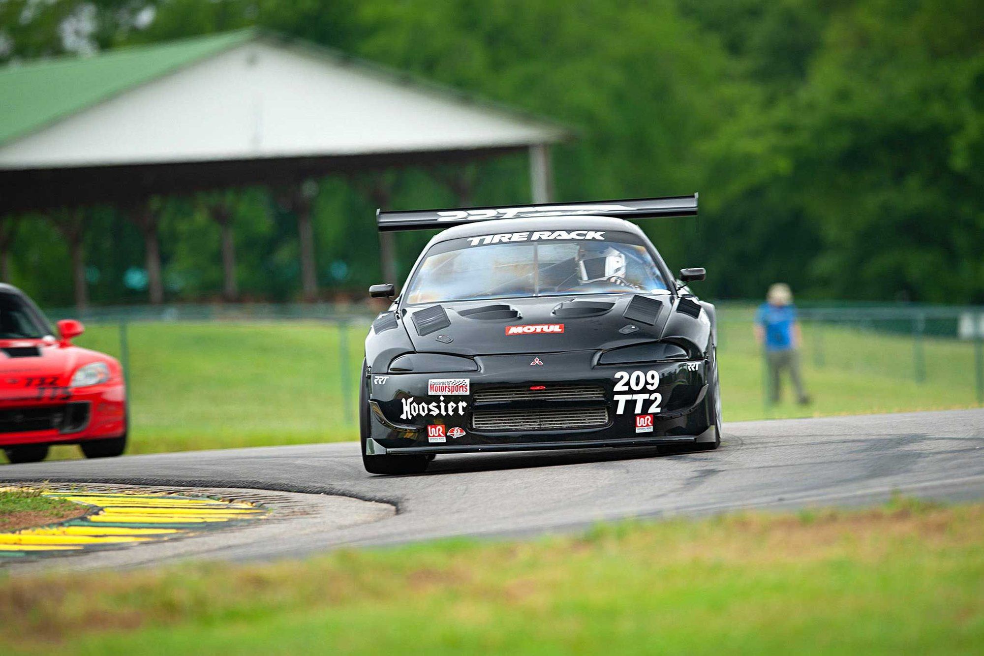

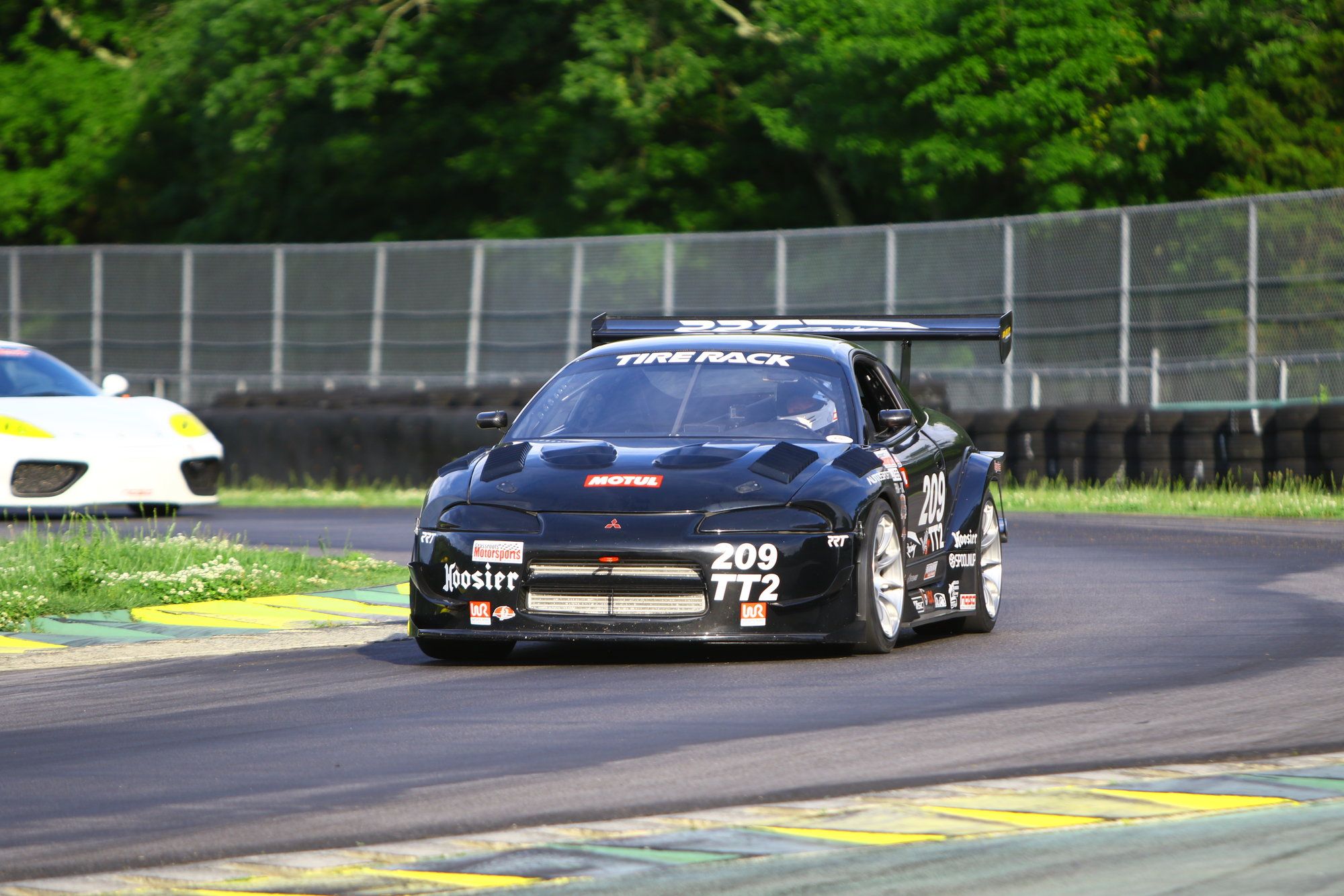

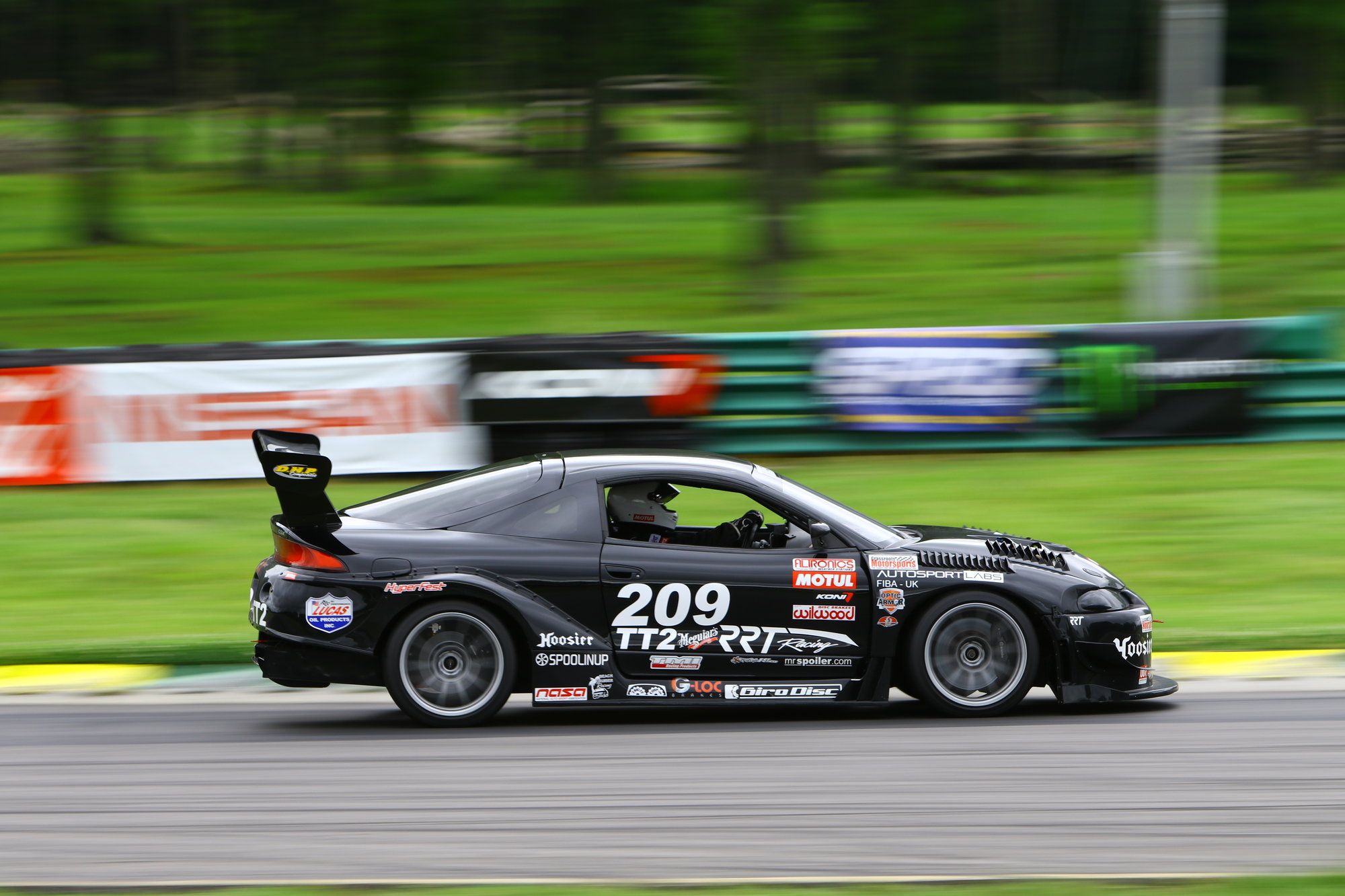

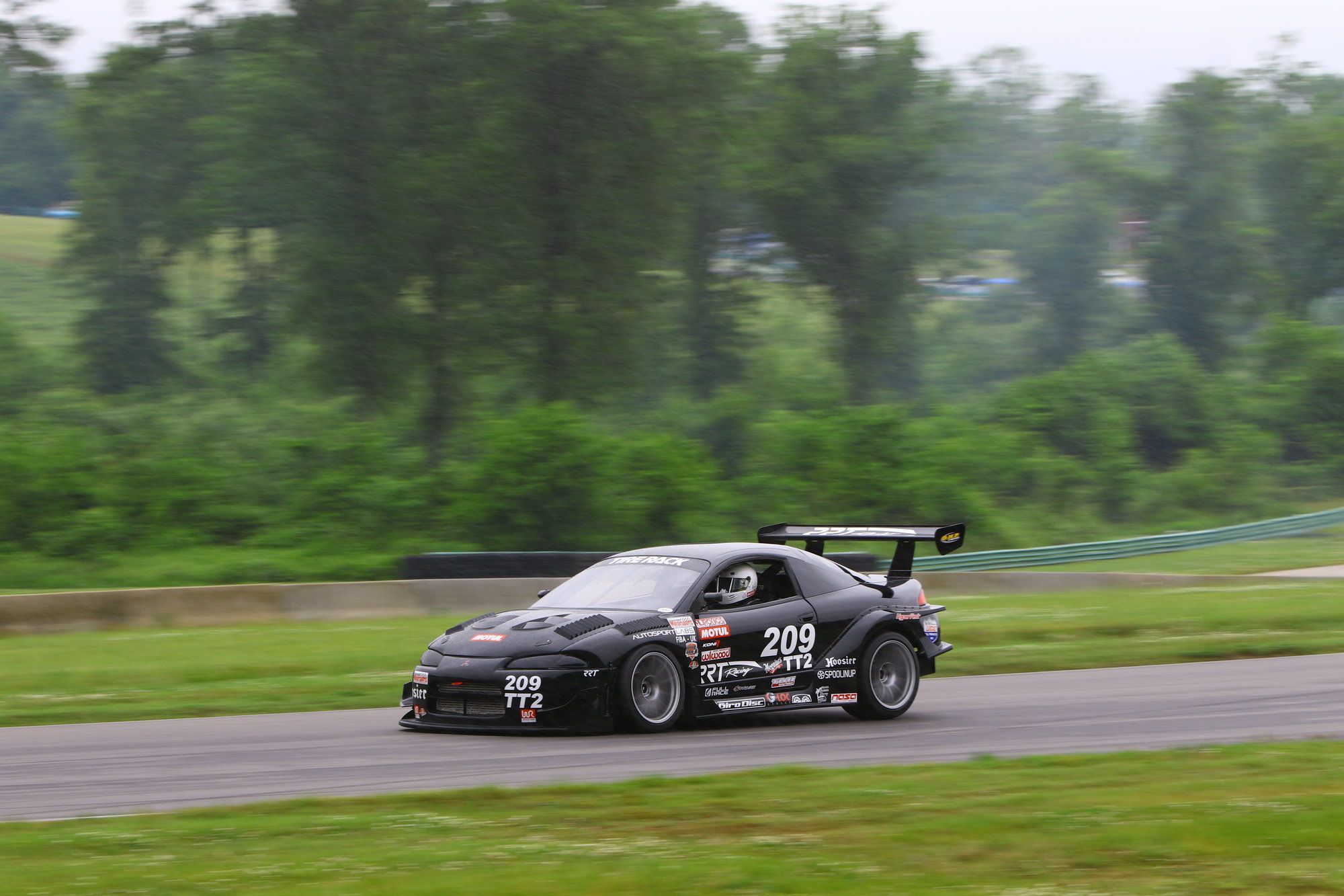

Here's some nice pics of the car from the UTCC day:

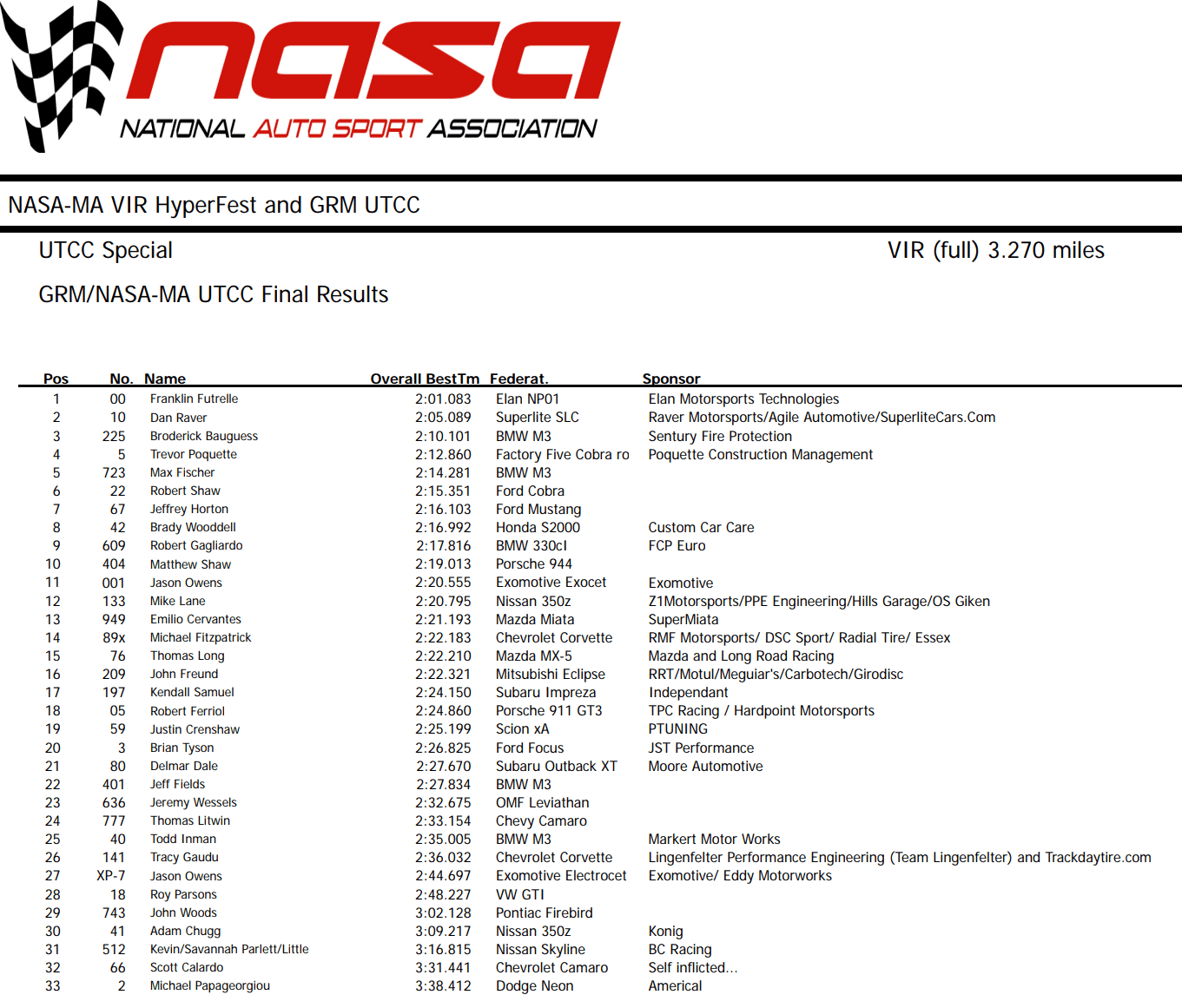

So my 2:22... got me 16th place (guess some people did find some dry time in other sessions) and this:
The reason the picture is in my garage and not at an awards ceremony is because they kept changing crap around and I had no idea when the awards ceremony was, so I missed it! Anyway, it's not terribly meaningful that I won this one THIS year, but hey it's good for sponsors, right? Three years Fastest AWD in a row, baby! haha
Here are the full results from the event:

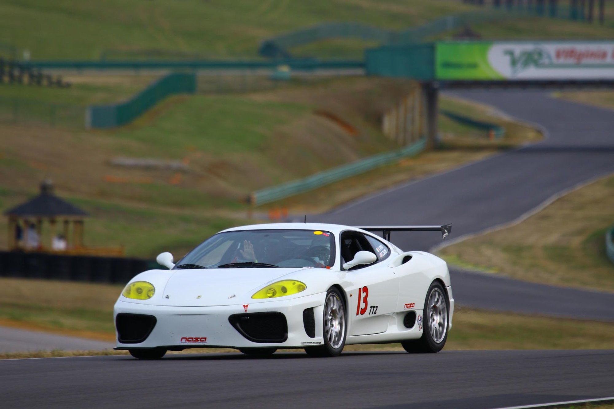

Stanley was very kind enough to actually let me grid in front of him even though technically he did not need to do that as he had a faster time thus far in the day. He's a really nice guy and still learning, but did admit he knows I've always been faster and so graciously let me have my shot at the win. I tell you, it was very satisfying "knowing" I could get that win and to go out and actually do it. REALLY felt good, even though the lap time was still shite :)
For those that don't watch the video, I ran a 2:04.280. Stanley in the Ferrari ran a 2:05.074, improving on his time, but unfortunately a Corvette pulled ahead of him with a 2:04.690 and took second place. Here are pics from that day of the cars in the class:

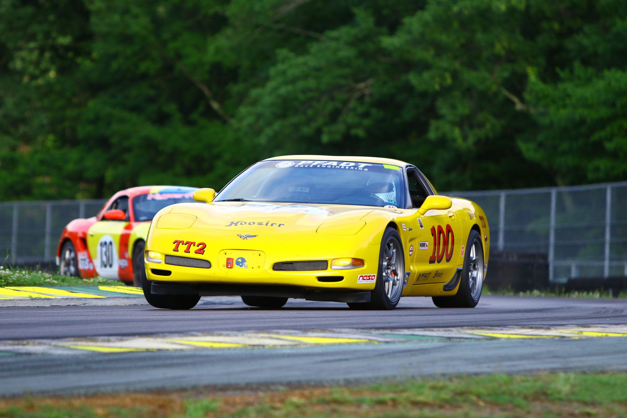

This guy got second place:

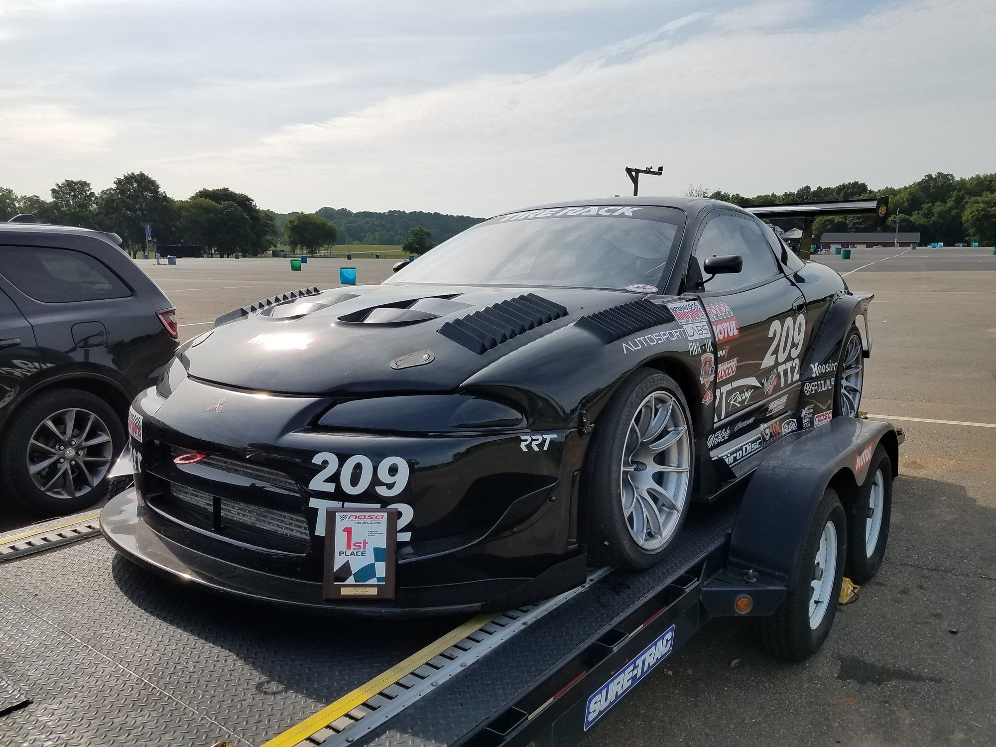

A little pose with the plaque (from Sunday afternoon, which is why the paddock is empty):
Thanks to contingencies I won two Hoosier tires (that's $800+!). I also won some other stuff but they're more like discounts on things like Hawk brake pads or stuff from Winding Racing.

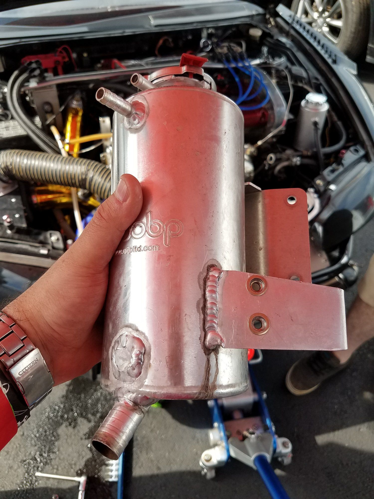

So also in the video you can see coolant spraying on the windshield. After we found the coolant surge tank cracked where the front bracket is welded to the tank.
After seeing it I realized it's just because it's a bad design. The heavy tank is cantilevered on the mount with only a small surface area for the attachment point, and with it being engine mounted there's a lot of vibration that isn't being damped. We'll look at this and think about a larger mount surface, changing to a different orientation, adding rubber bushings for damping, and possibly chassis mounting (though this is unlikely because I got stuff in the way like that stupid fuse box I need to get rid of...).
So with that and the fact that I didn't think I could win any more contingency prizes I opted not to race on Sunday and enjoy my weekend. I accomplished way more than I had expected with verifying the ABS system, testing the new turbo system and tuning changes, and getting the suspension dialed in.
