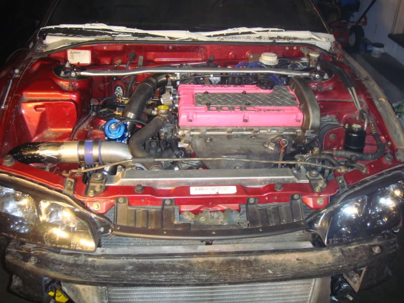

2gb talon awd spyder

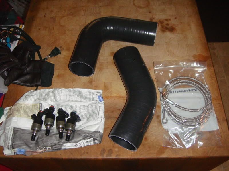

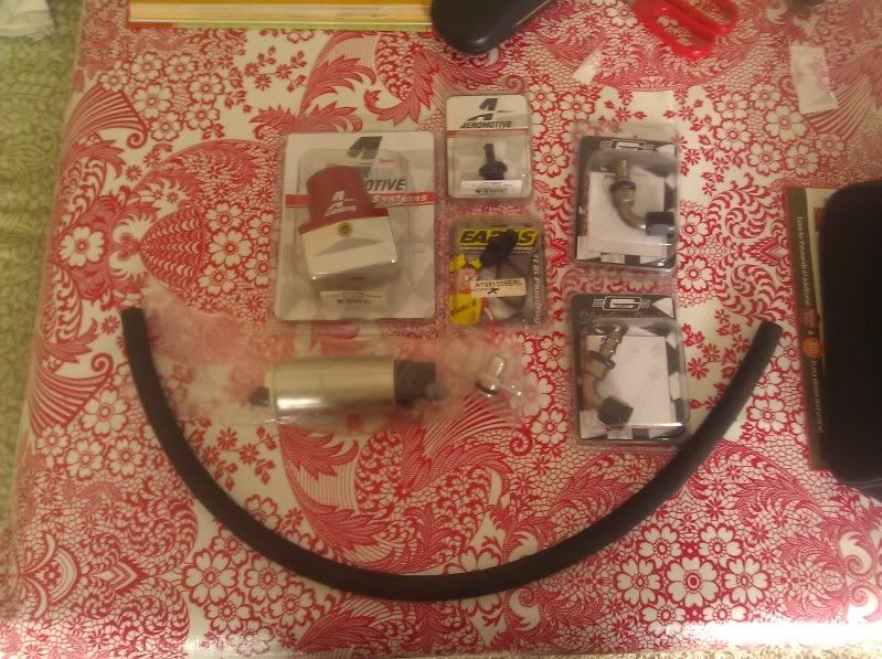

some parts showed up the other day. 1000cc injectors I got them in a trade. hts 45 and 90 coupler. just need the 45 and they were new on ebay together and I ended up getting them cheaper than just buying a 45 coupler. Also stm s.s. full clutch line it was the only black fri thing I bought.

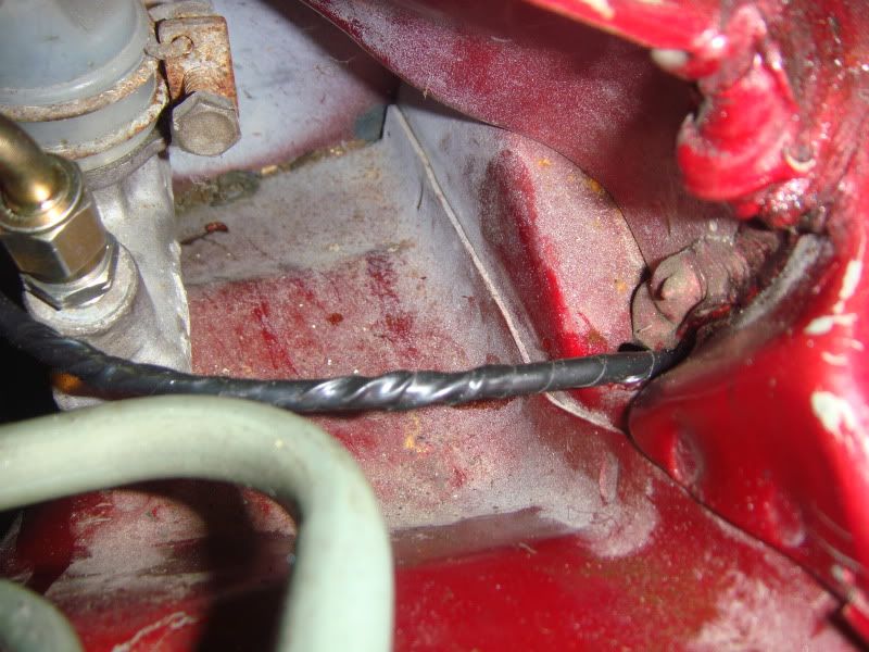

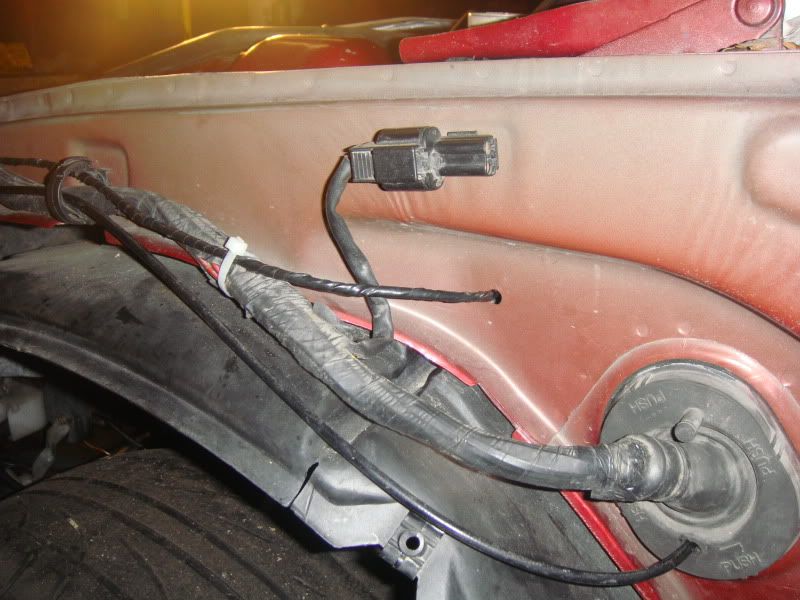

got the boost,oil gauges hooked up and the aem wide band hooked up.
ran the oil line through a pair of stock holes in the car

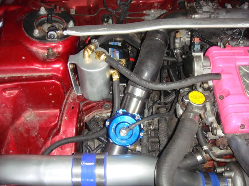

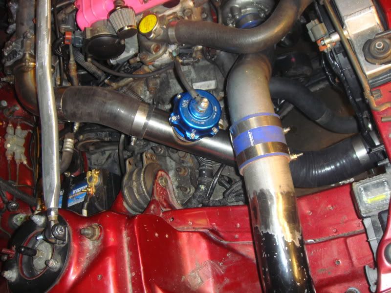

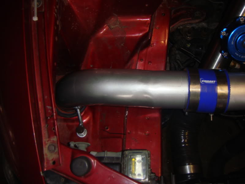

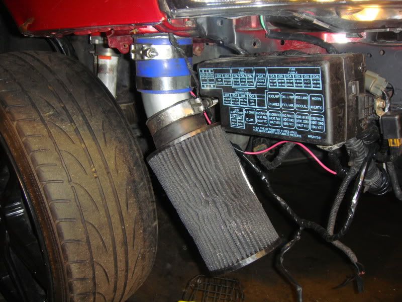

I had some extra 3in pipe and 3in couplers laying around so I made a extra pipe to make a cold air intake for the car. It fits though the stock smic hole

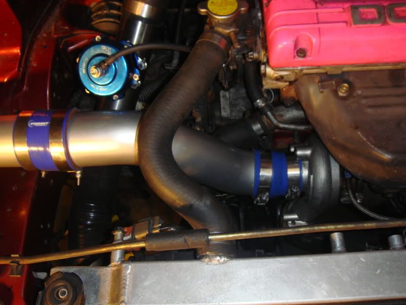

got the broken bolt out of the tranny so I could mount the shifter cable bracket and get them on. After I got them on and the speed sensor in I got the upper piping on the car.
It is getting really close now

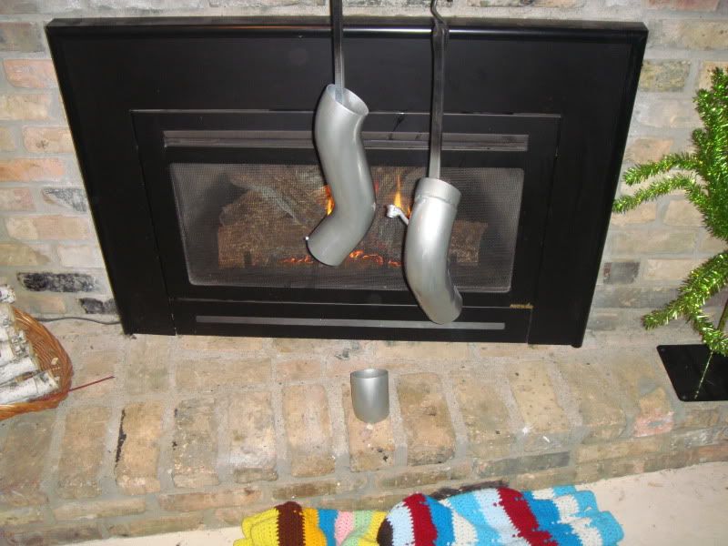

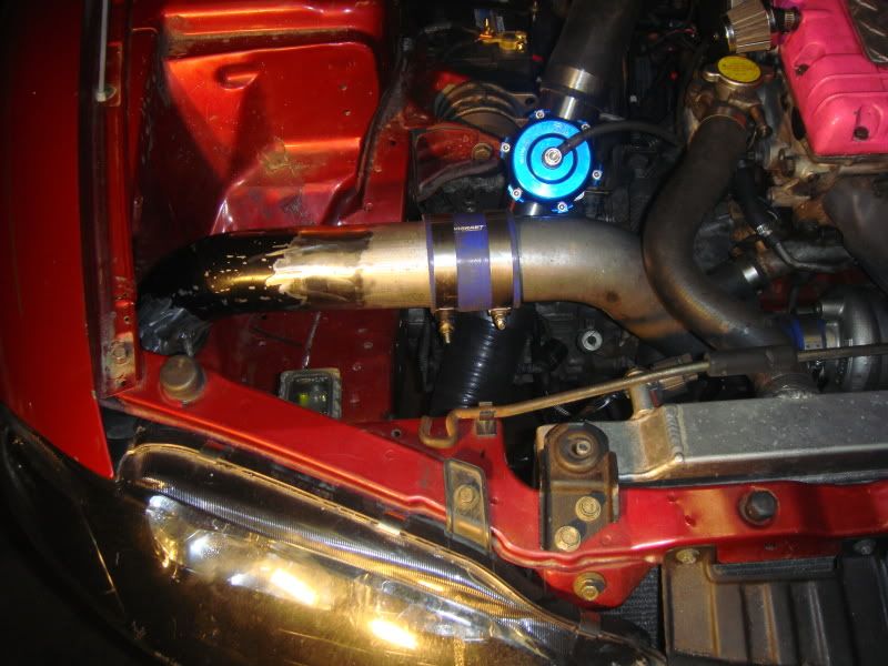

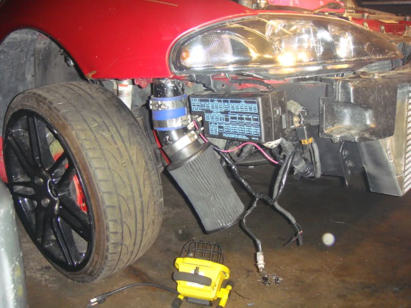

painted the intake pipe in the basement shop last night and used the gas fire place to get it to cure between coats. also cut about 2in off the cold pipe were it comes through in to the bumper the filter was lower than the bumper.

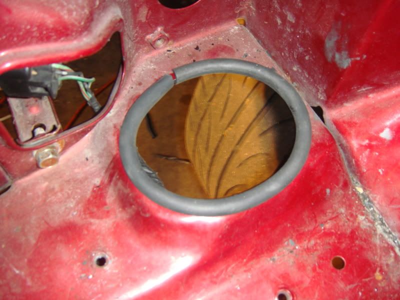

used some vac hose to make a buffer so it does not rattle on the frame
intake all back in
You're gunna use the splash gaurd, correct?
yes I am I just have not put any of them back in yet for the front frame rails or the front and rear bumpers. I am going to try to find a non vented splash sheild for the pass side. The one talon I got the rear bumper off of at the junk yard had it but was cracked already
You dont hav to run non-vented ones. The vented ones face the vents downward. So while driveing the water/etc will not go forward into the bumper space.
I know how they are vented. I still have the ones that came on the car in one of the bins so they will go on the car untill I can find a non vented on in the junk yard some day.
the non vented one would be just a bit better with the air filter there and the the fuse box
I forgot about the fusebox.
Does look great though!!!

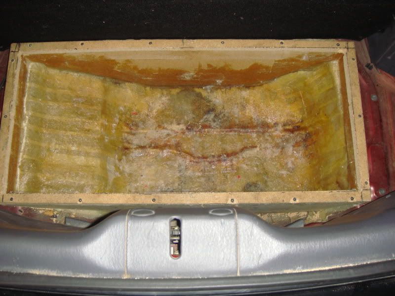

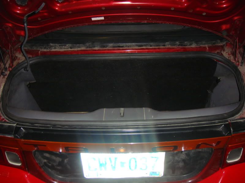

cut the top off the sub box to give me more room in the trunk. did not want to take it all the way out if I ever want to put some kind of 10in sub in it. It had a 15in flat ppi sub back in the day. just have to make a new floor since the one I have for it is cut out for the sub.
also took the tan carpet off the front panel and put black carpet on it.

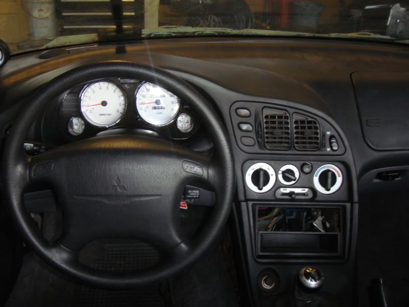

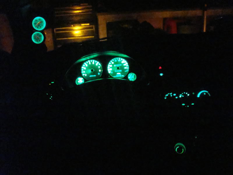

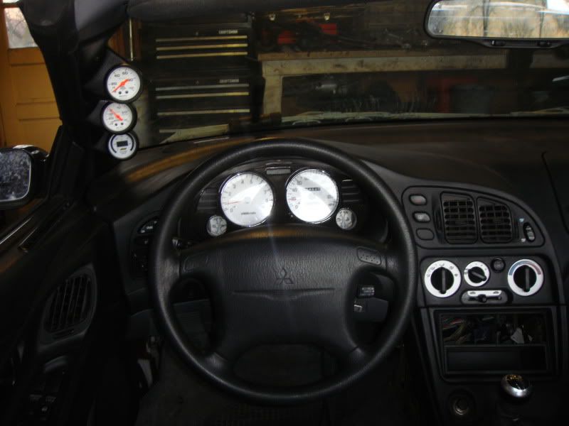

got the white face over lays installed on the cluster and hvac controls
now it match's the auto meter and aem gauges
got all the green led's in the car also

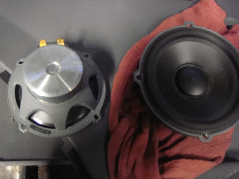

found a set of boston pro 4.5 that will go in the rear. It has boston pro 6.5 in the doors already

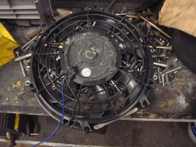

was going to buy a 10in fan for the a/c fan but found one in a box

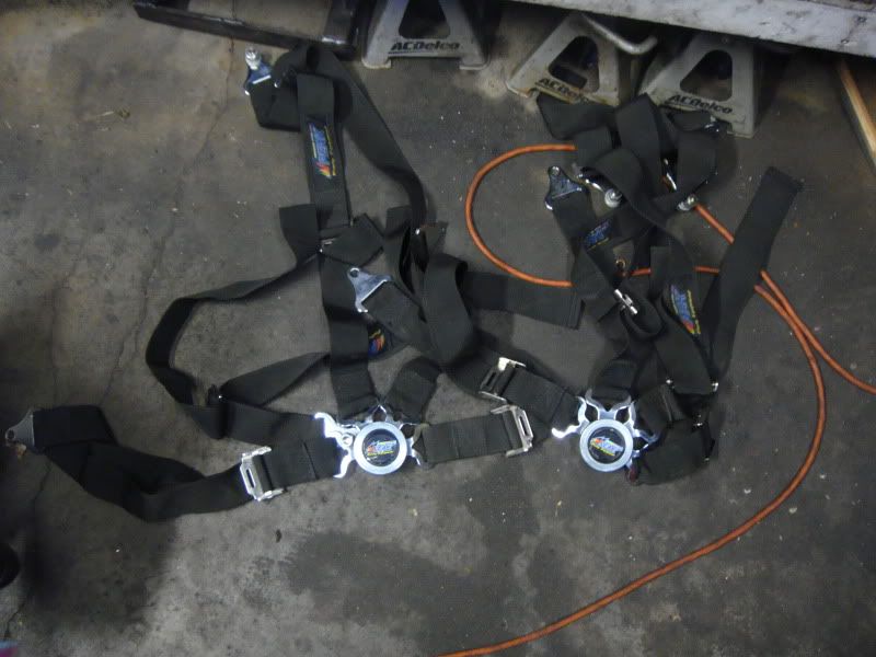

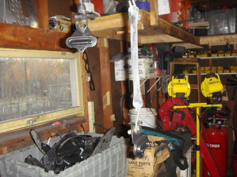

also found a set of cam lock black 4pt belts that were in my brother's old talon that I might put in the car. I would have to make a harness bar for them.

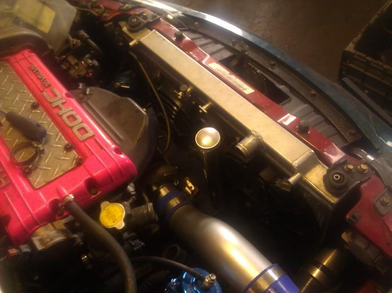

it is nice out today 42 so worked on the car a little bit.

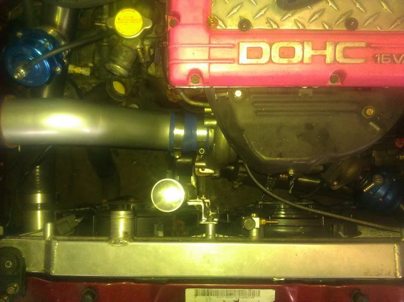

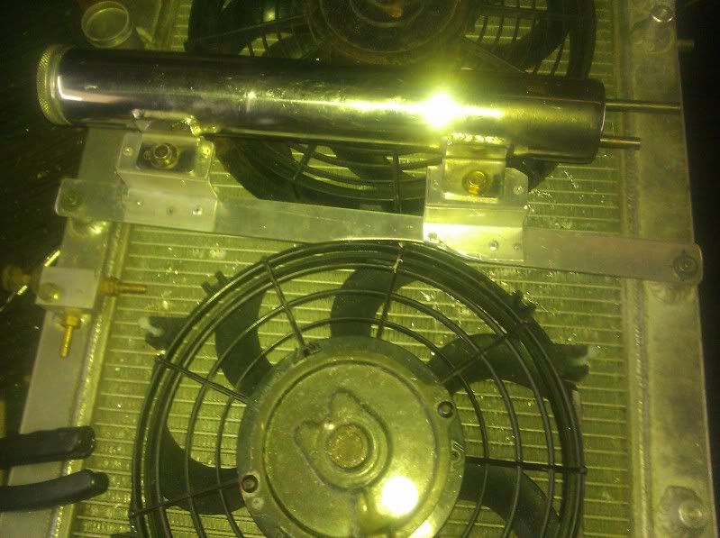

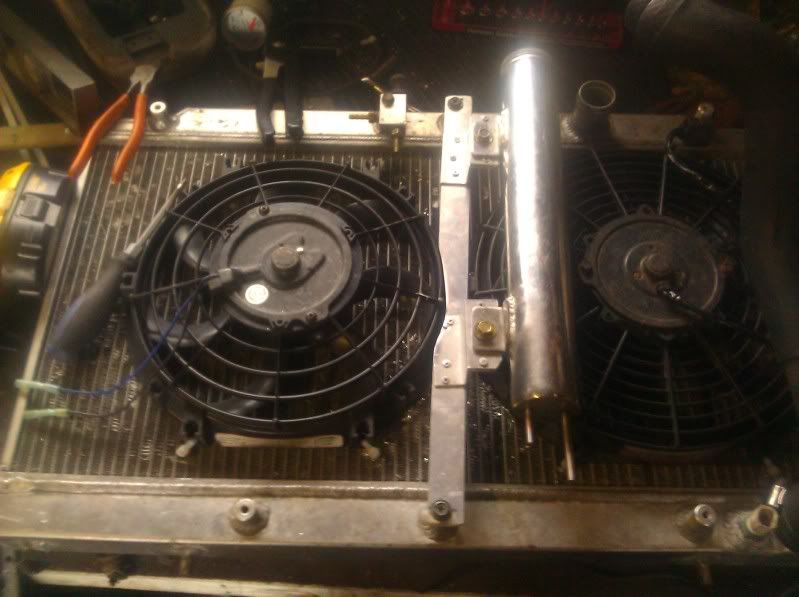

put the 10in fan on. found a boost controler in the garage and drilled a hole in it to bolt it to the radiator. Also reused the old alum amp rack from the car to hold the over flow tank.

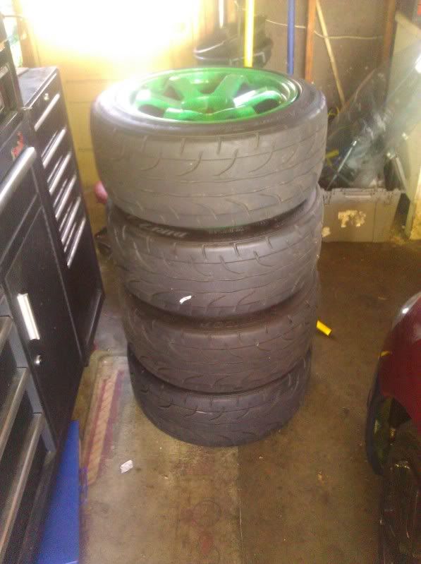

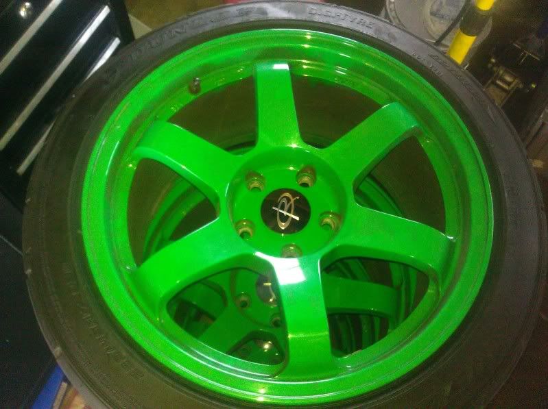

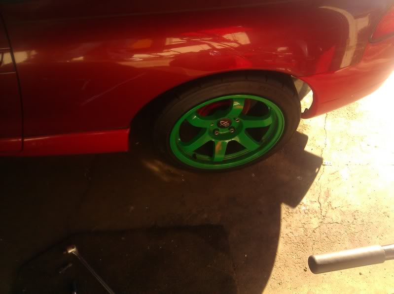

Found rims today for the car. Paided 750.00 for them. Just going to plasti dip them for now till I figure out what color I want them powder coated later on. They are rota grind's 17x9 +25 with Dunlap 245/45/17
Takata green just does not look good on the car.
They have a ton more meat on them over the rims that were on it to move around. 18x8 with 215/35/18 LOL
Love that color green haha
they were cheap. They will be plasti dipped as soon as it warms up here.
I got them them for 750.00 then that night I sold the 18's that were on it to roll it around for 200.00. So I think a set of rims and tires with a few thousand miles on them for 550.00 was a steal

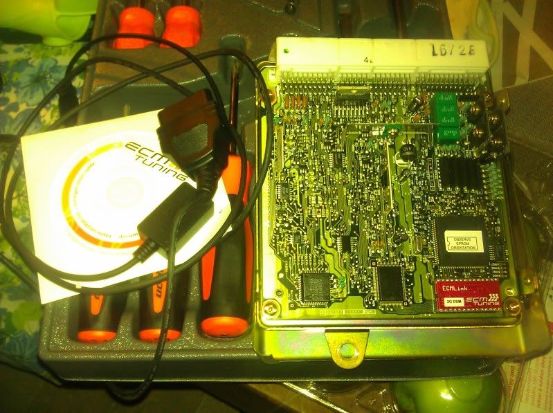

had this waiting for me when I got home last night from work.
got it used off of dsmlink for cheap now I have a spare eprom for the spyder.
The rest of the SD parts are going to be here today also

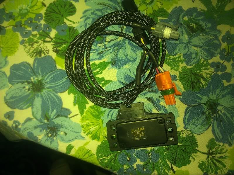

4bar map and plug and play harness since I am feeling lazy

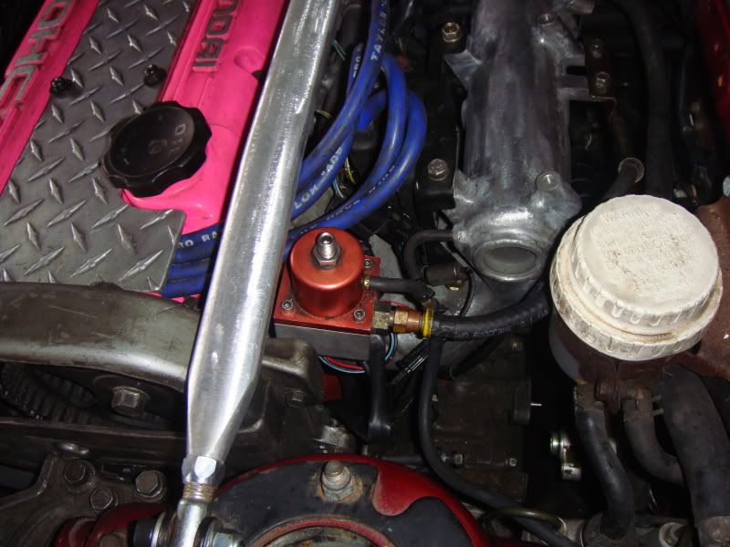

Yesterday went up to DB and talked to shane and got a good deal on new parts just. Picked up a new wally 255 just have to mod it now and a aremotive afpr since I sold the BR/SX bolt on one.
