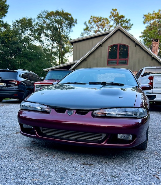

1992 TSi AWD 20+ Years of ownership

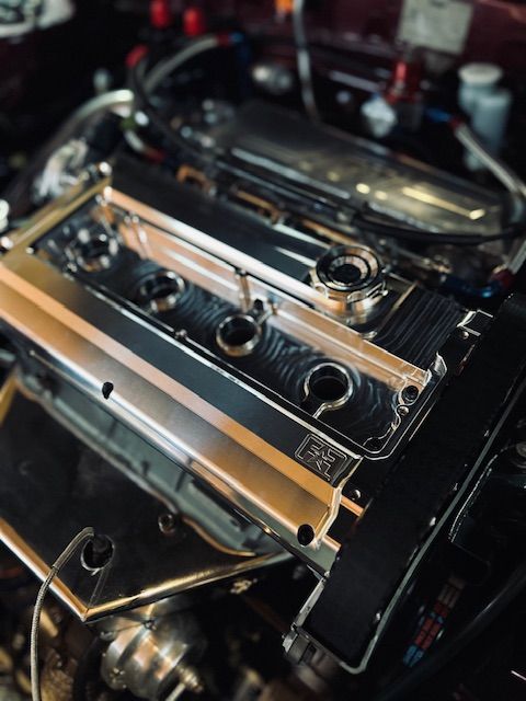

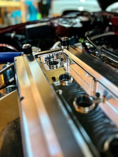

You gonna clear anodize that cover or leave it raw?
My original plan was to have it Anodized a dark grey/gunmetal color but the only place I found that seemed like they wanted to do it could only do black. Then I was going to send it off for Cerakote but time went on and I never did and was tired of looking at it and got all the pieces gathered I needed to plumb everything, so just started working on it instead of messing with a coating. But yes, eventually I plan on something for a coating instead of just the raw finish.
I also plan to stirp the old VC that has dual 10an fitting welded on, put baffles in and powder coat it again. I really like the Frontline Fab valve cover but I also really like the stock/oem one as well.
Got a small vacuum block last night that I needed and will hopefully have everything back together this weekend.
Don’t get me wrong I love the look and plan to keep mine that way, I just worry about what some have warned about discoloring/fading, the proper term is not coming to me at the moment, so am planning to at least clear mine I think. Looking boss though, keep it up!

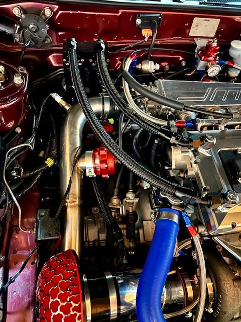

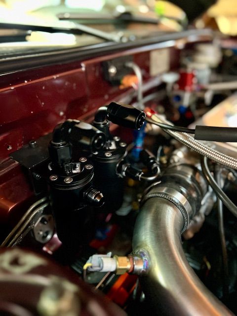

Finally got off my ass and finished the plumbing on the new catch can set up. Kids, sports, life and work always getting in the way:rolleyes:

Added a Moroso 3.5” spiral flow to the exhaust system yesterday to help tame it down some. Took it on a quick spin this afternoon and it has helped, drone not near as bad around the 3-3/5k rpm range.
Not sure if it is a coincidence but it also seems to be idling a little smoother with the closed system CC ventilation. I need to log it and do a nice long drive soon and run the Combine FT tool.

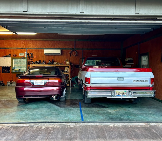

Haven’t been driving it much because I had a big workbench on the right side of the shop and couldn’t park the truck close to fit both straight. I would have to back the truck out to take the DSM out, minor PITA but was another step. Got a new set up coming an both are tucked in just fine.
Minor update 😄
