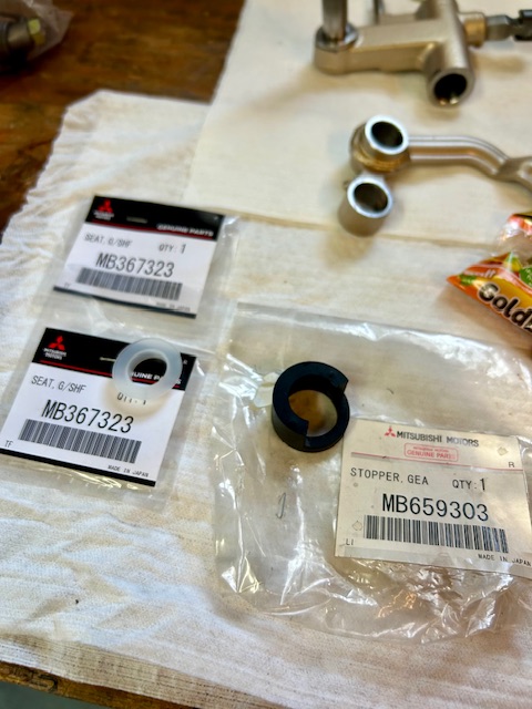

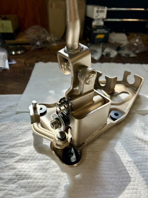

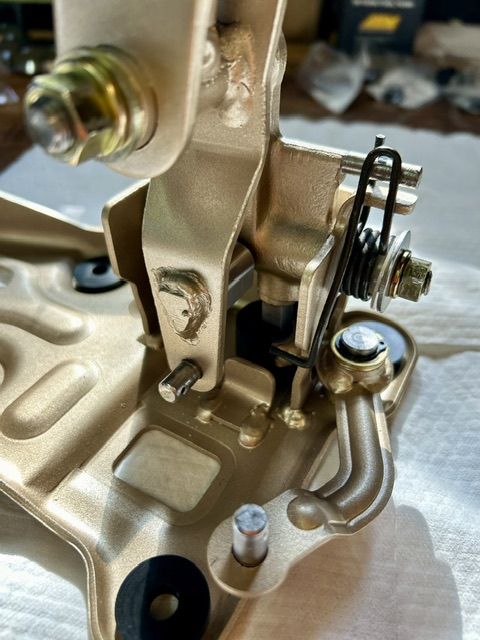

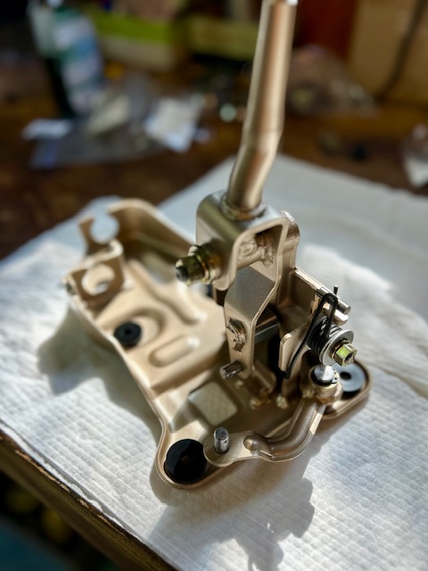

Finally got it all back together, I was a bit surprised to be able to get a couple of OEM bits that aren’t offered aftermarket. Wife came in as I was finishing up and was like that looks really good, to bad no one will see it 😆
How tight was yours after assembly? Mine was tight AF, Lol.
Yes, didn’t realize how bad mine was. LOL
Gonna take it on a spin here in a bit.
Edit. Took it on a drive, way tighter and direct. First gear pop out issue massively reduced to almost non issue and didn't grind into 5th gear. Going to tweak the clutch adjustment as well.

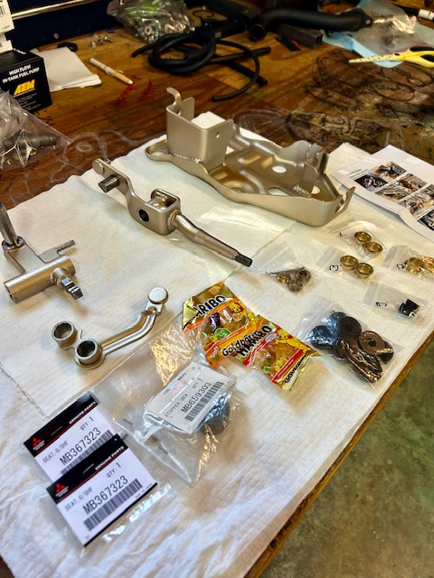

Looks amazing! Nice work! What color paint is that? What’s the print out with pictures on the right of the table?
Thank you sir!
What Cracked said.
The paint is Rustoleum gold, I can get the actual name/sku when I get home from work.
What I really wanted to do is send it off and have it yellow/gold zinc plated like the OEM fasteners but didn't dig around enough to find a place and just wanted it done.
