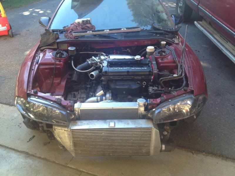

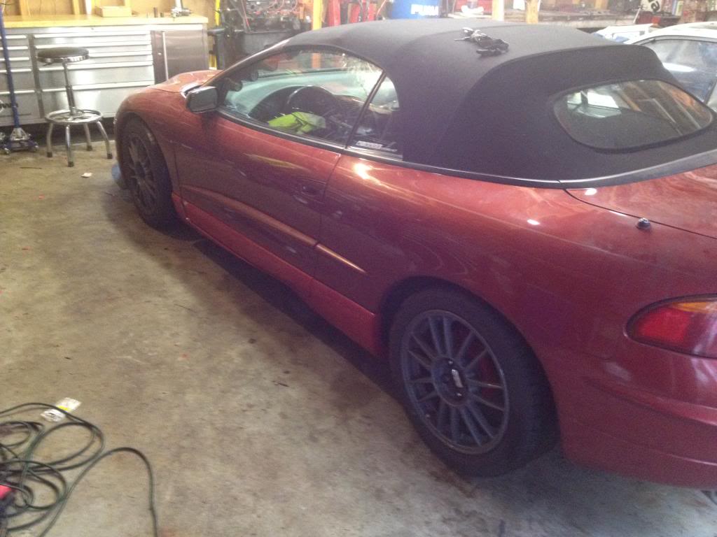

the rebirth of the 98 awd spyder after 10 years of storage
2gb talon awd spyder

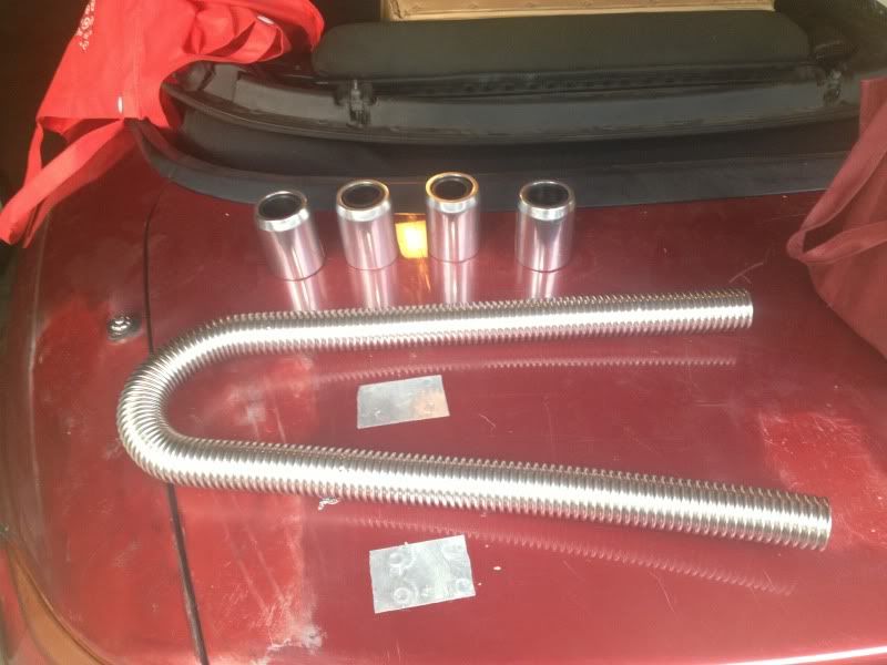

Same s.s. radiator hose kit I have I. The evo 3. Was 48.00

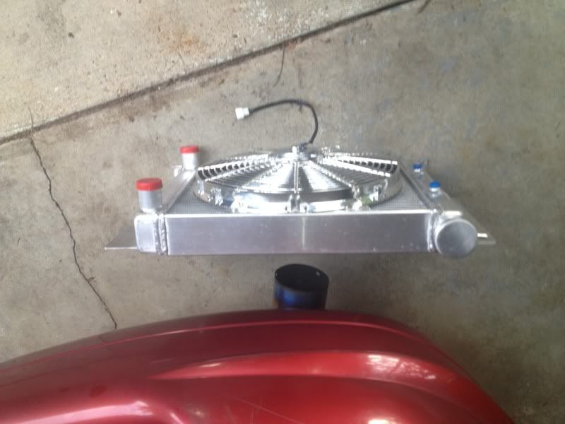

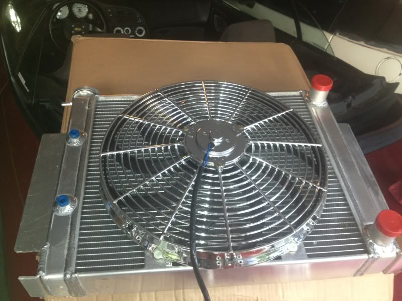

New radiator same as a afco unit. This one is just a bit taller an has a cap on it. Will have to make my own lower core support for it but it is no big deal. Got the fan with it for free and got a extra 25.00 since it was the last one. Show price was 200.00 w/o the fan. Got it for 175.00 with it.

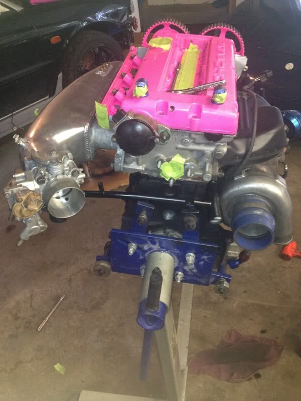

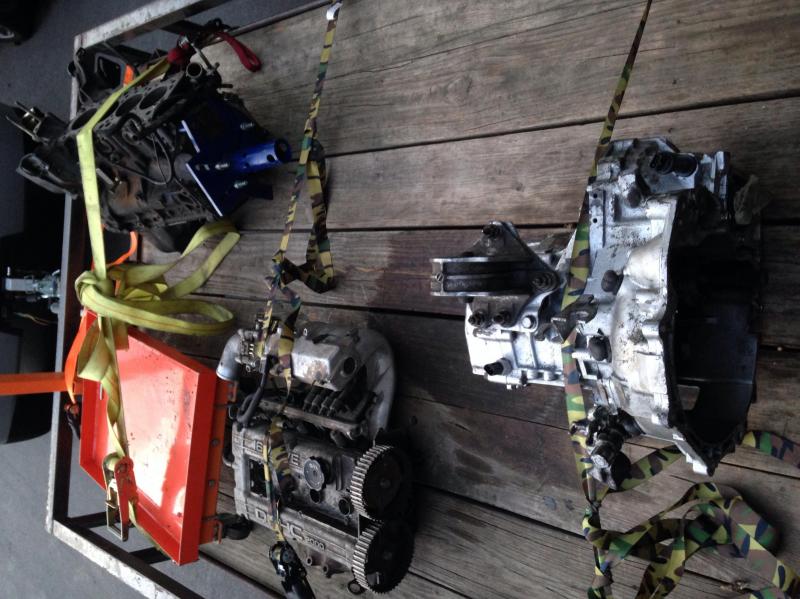

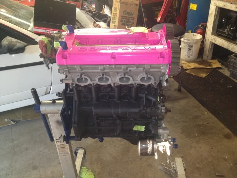

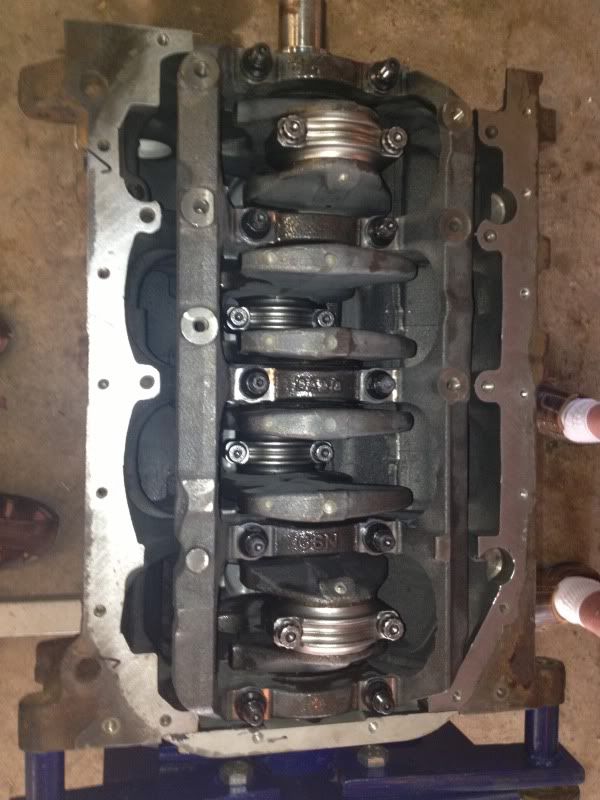

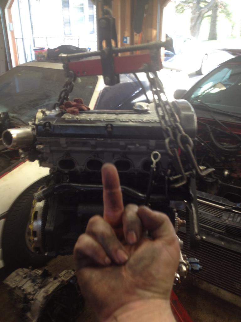

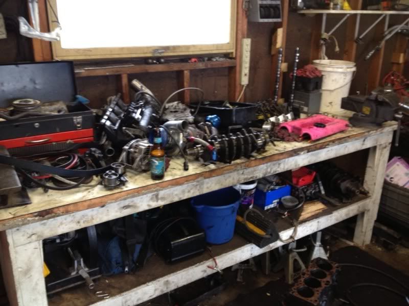

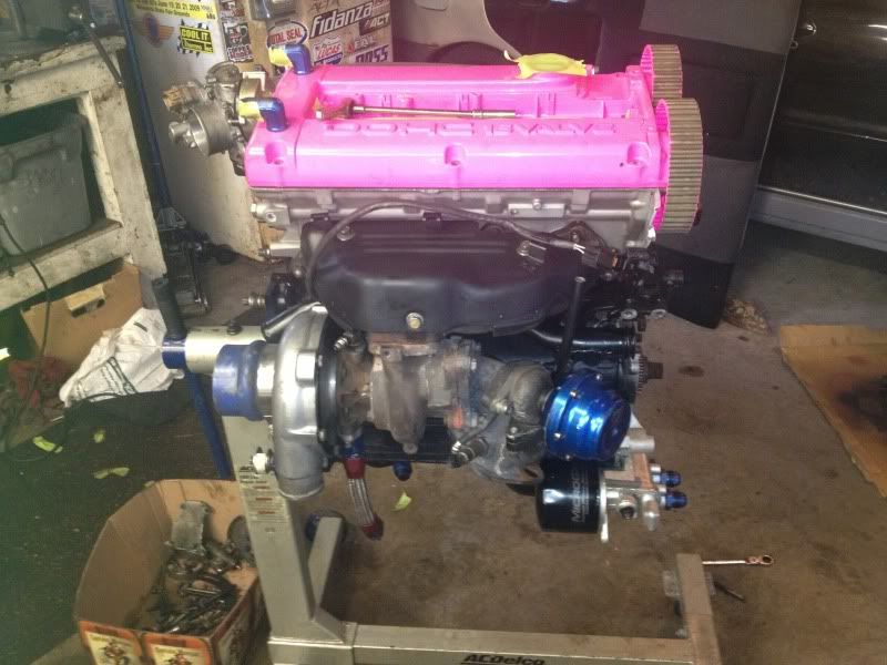

Picked up the engine and head today from gosh. He finnaly had time to get it all done he has had it since April.
Specs
99 2.4 block

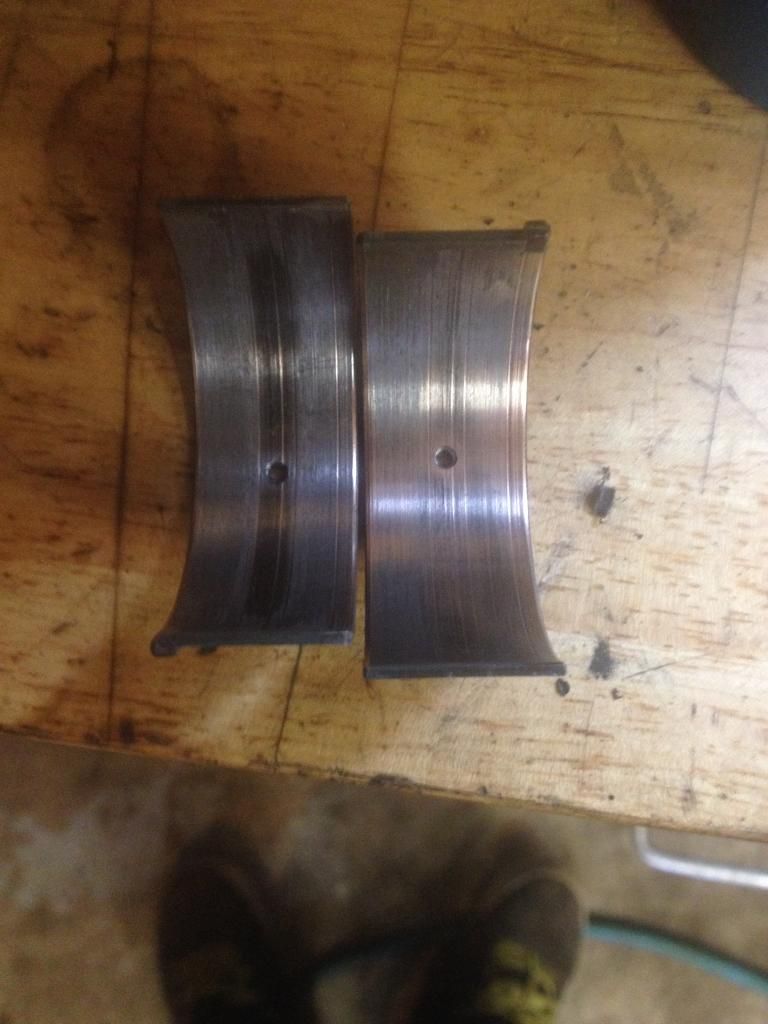

ACL race mains and rods
Arp main studs
Eagle rods
Ross 9:1 .020 over pistons
Head
Stock 2g
Valve job
New seals
Evo 8/9 valve springs I got for free
L19 head studs
Felpro perma toqure hg I got for free
Best part lots of pink :)

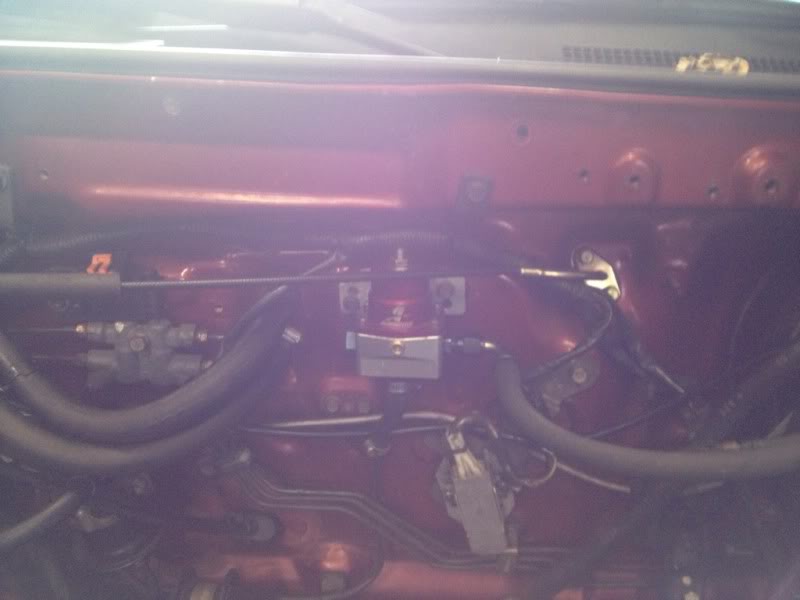

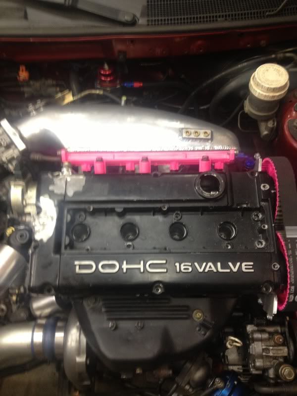

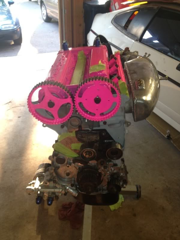

Little bit more done to it today. Also found my non rad cap upper housing. Pulled out the 2 extra water out let's on the lower housing. Just need to get 2 1/8 plugs for them now.

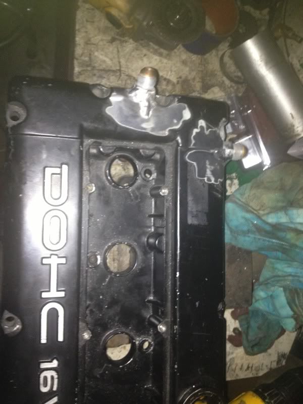

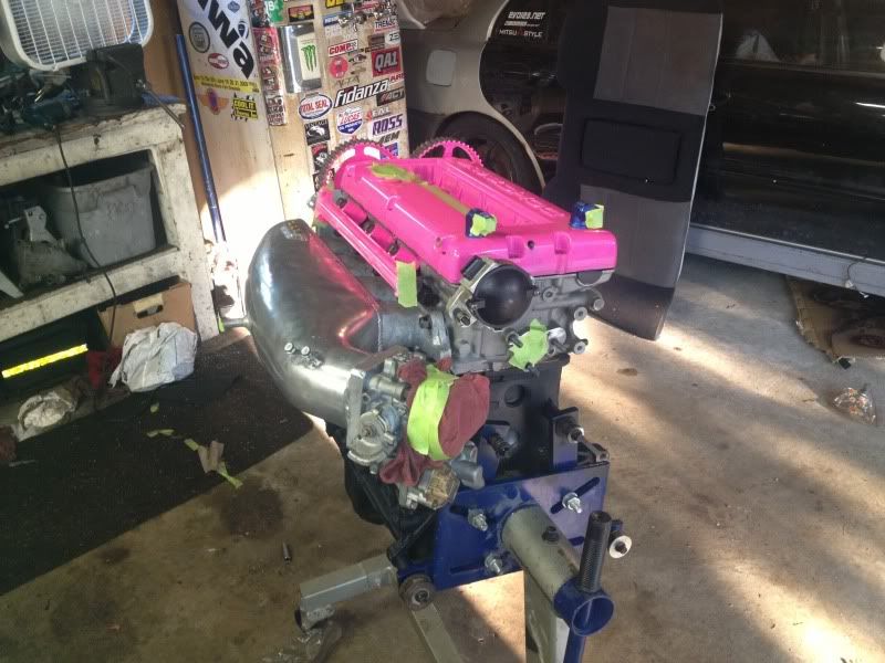

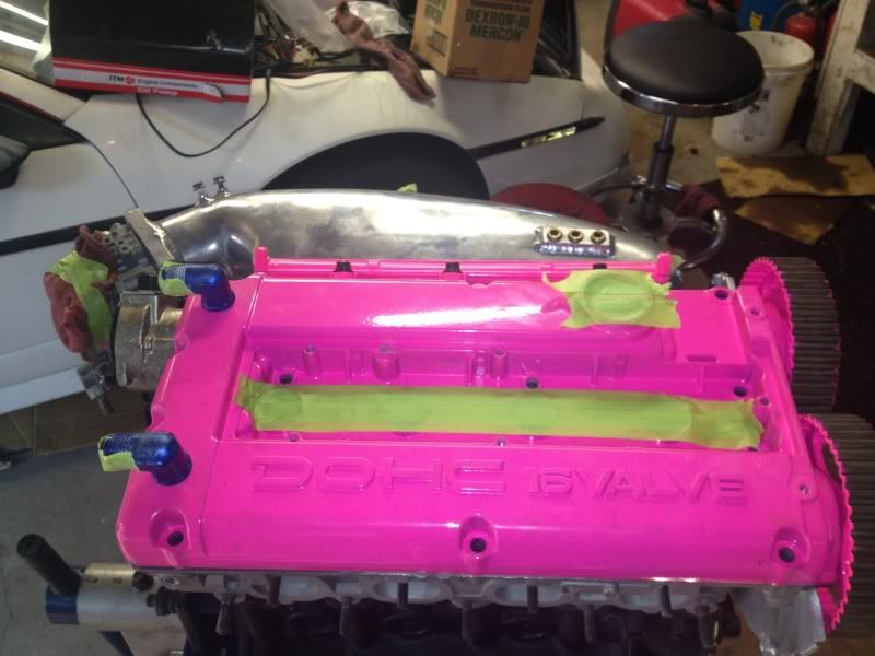

Brought my extra valve cover and some 8an fittings down to the airport to have my buddy that works in the fab/welding shop put them on for me. More of a pain now since I don't work out there any more. Any way he got them on and was just my time to drive out there.
He also fixed to small cracks on the top. Just have to sand the welds down on top and drop it off to get powder coated hot pink

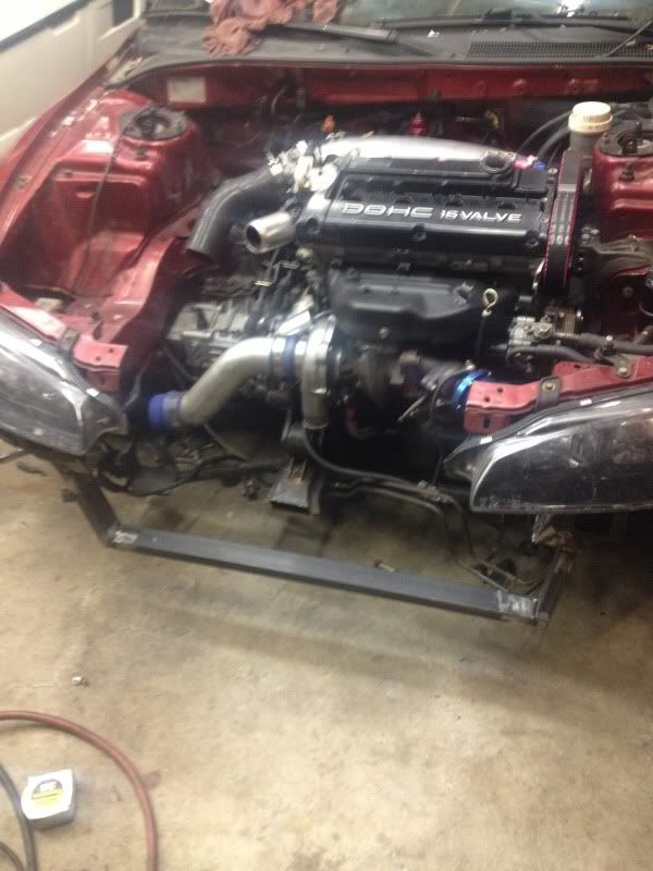

Worked on it today after I got home from Mitsubishi picking up my new lower timing cover for the 2.4

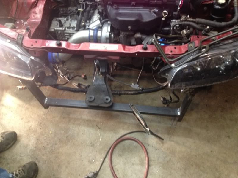

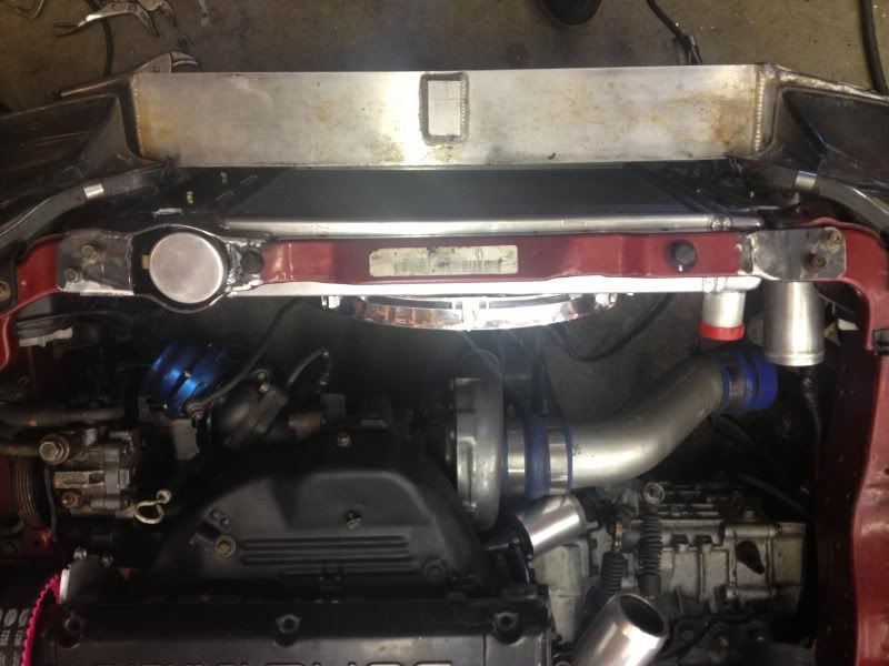

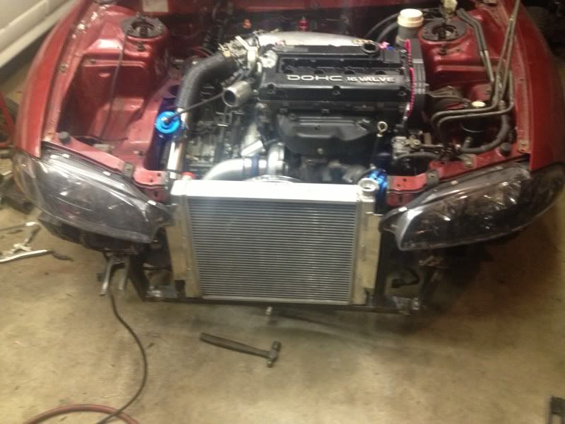

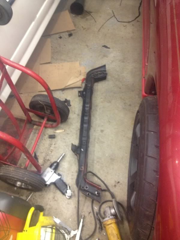

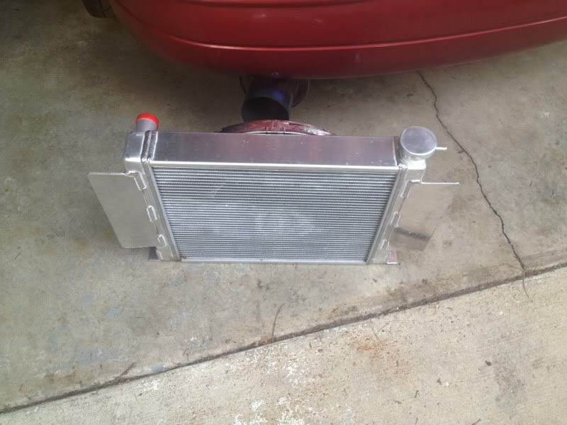

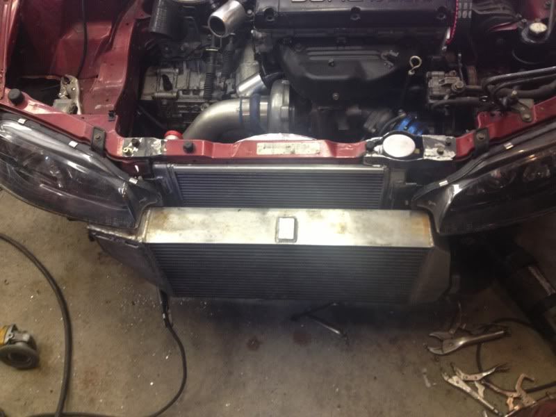

Cut the stock core support out of the car.
Used the metal I have around. Would have loved to done a tube core support but I have no way to bend one up. Hade to make it lower than the sock one to fit the hot rod radiator in the car.
Have make a new rool stop mount also that will be lower in the front.
Radiator sitting in its new home.

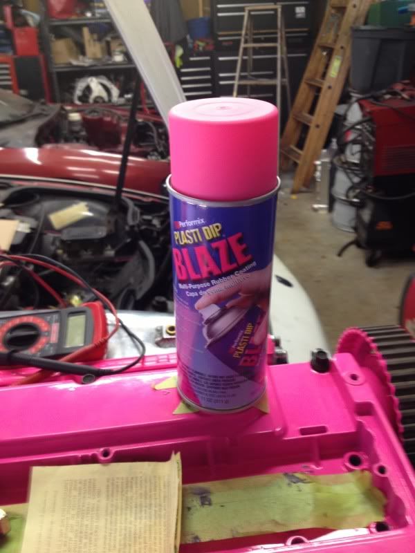

Will be using the vc as is till winter when the car will be sitting. Then it will go in to get powder coated hot pink.

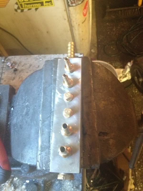

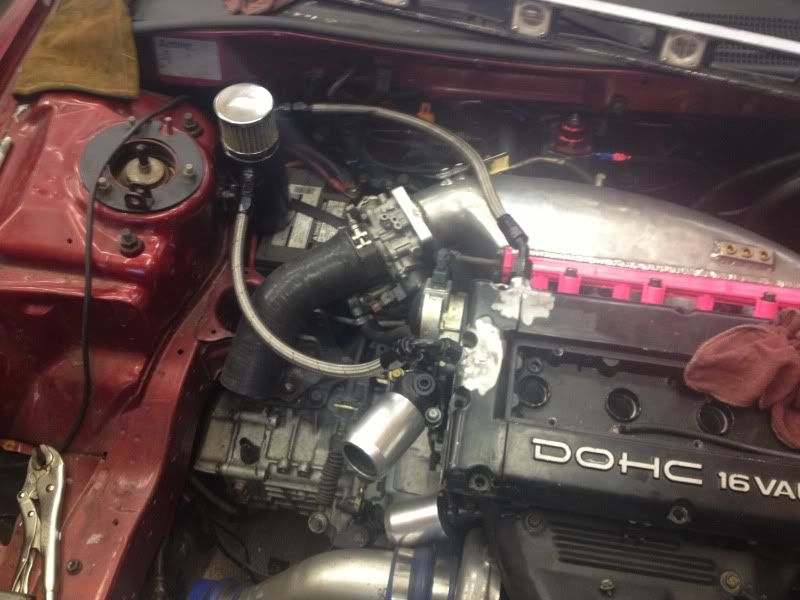

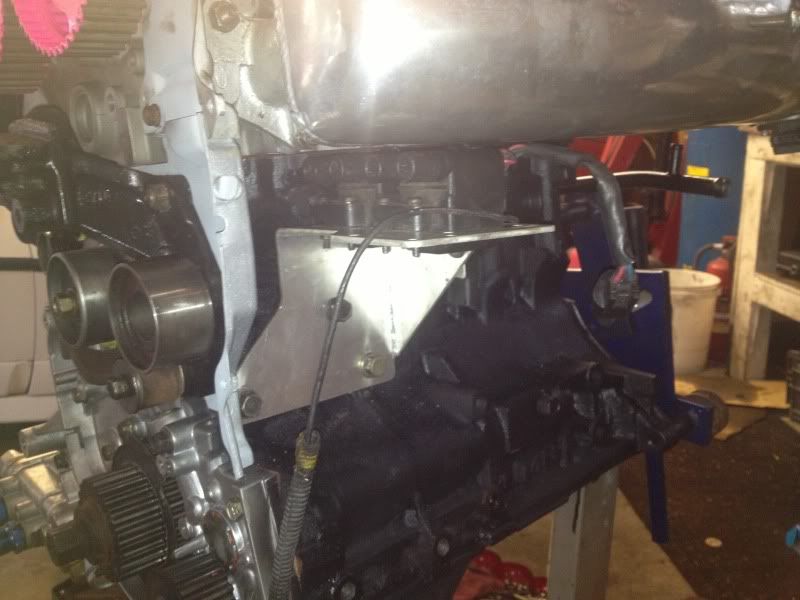

Also started making a vacuum block.

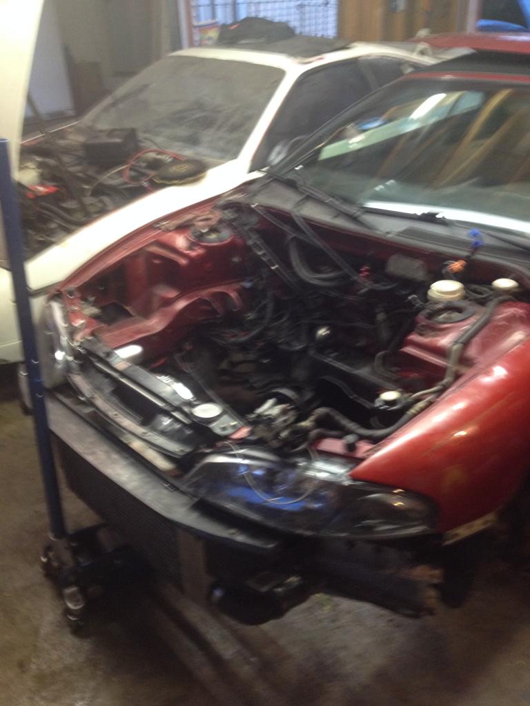

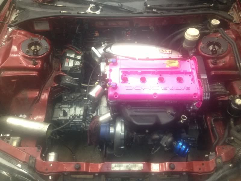

This moring the car no engine.

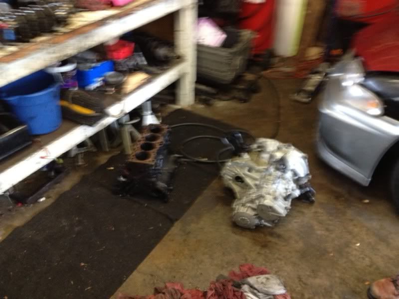

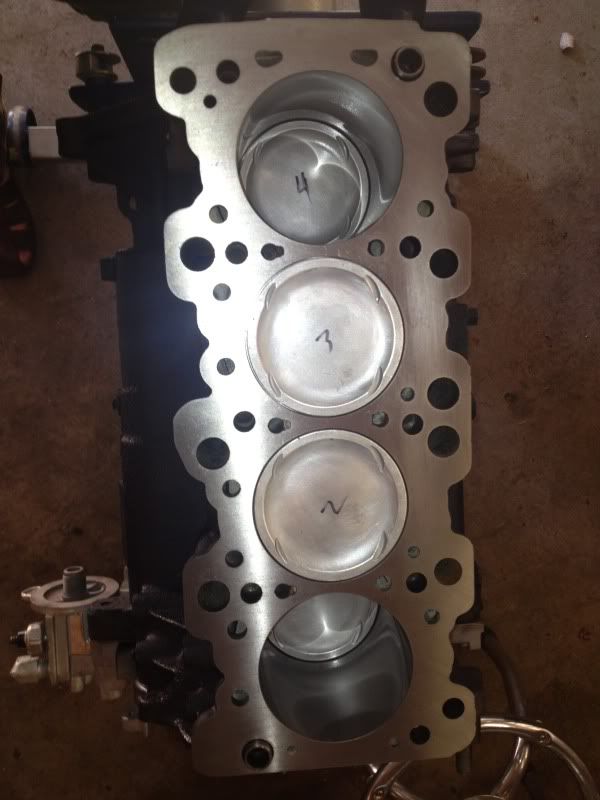

As of tonight.
So now it's a Stock 7bolt.
Parts I put on it that I had laying around.
Arp l19 head studs
Felpro HG composite
New oem oil pan with 10an fitting welded on
New oem water pump
BS elem kit
Greddy timing belt
FP2 cams
3mm lifters
