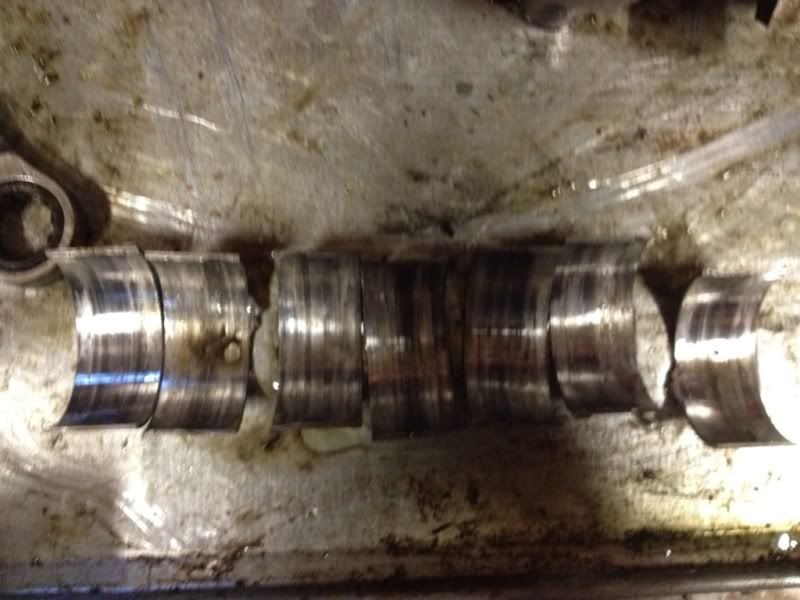

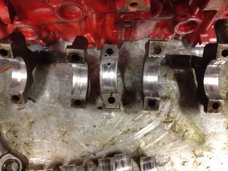

Got the spyder Tuned today at Db. Made 338 awhp on the dyno dynamics. We were going for more when the oem oil pressure sending unit blew out of the ofh it dumped all the oil onto the dyno. Got it fixed and walked over to napa to get oil refilled the car. It fired right back up no rod knock but was down 100 hp. Something got tight in the engine. So now it will have to come back apart and fixed. But it does still run right now.

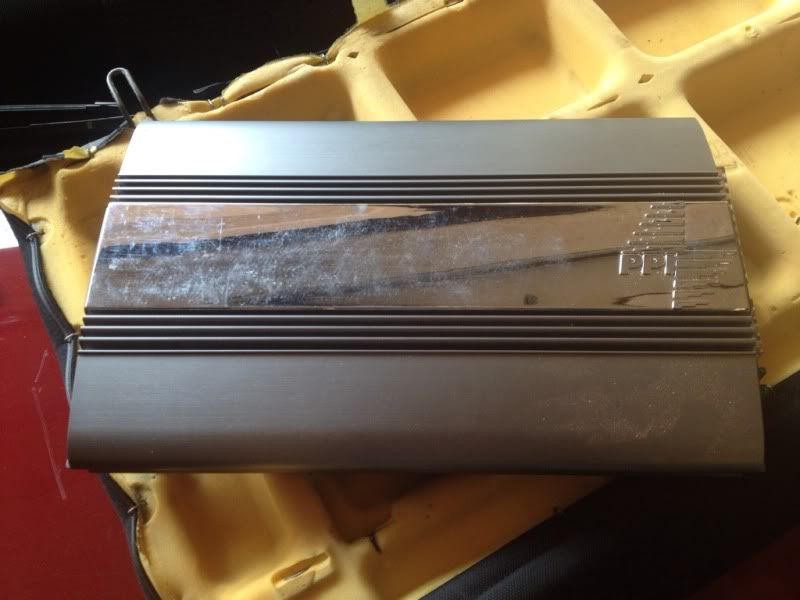

New ppi amp 5ch picked it up for 50.00 off of mnsc

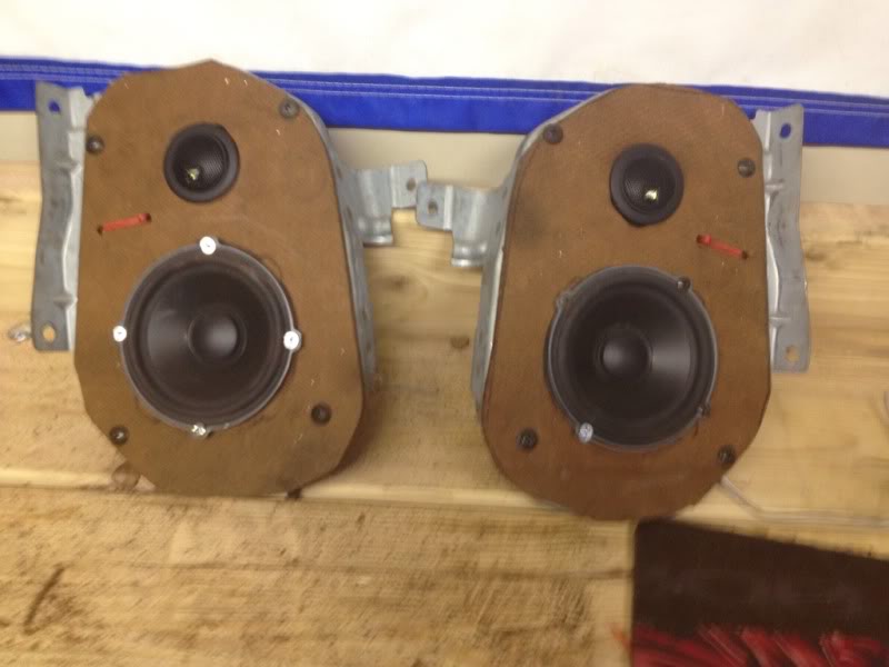

Put all the speakers back in the car all Boston pro's also rewired the stock dash speakers to run them off the deck.
Rear 4.5 Boston pro w/ 1.5 in tweets
Front 6.5 Boston pro.

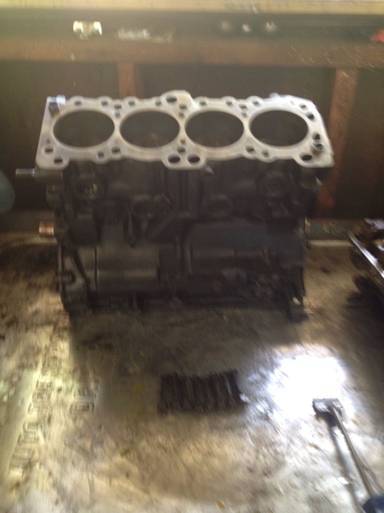

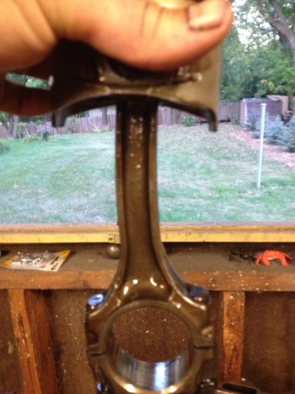

Picked up the new bottom end yesterday from Steve. It is the same set up I had in the car. 2g pistons on 1g rods. Just need to get a oil pump and put it together.

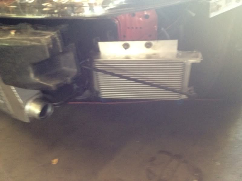

Also got the new 10an oil cooler put on with new brackets. It is a lot bigger than the 8am cooler that was on the car.

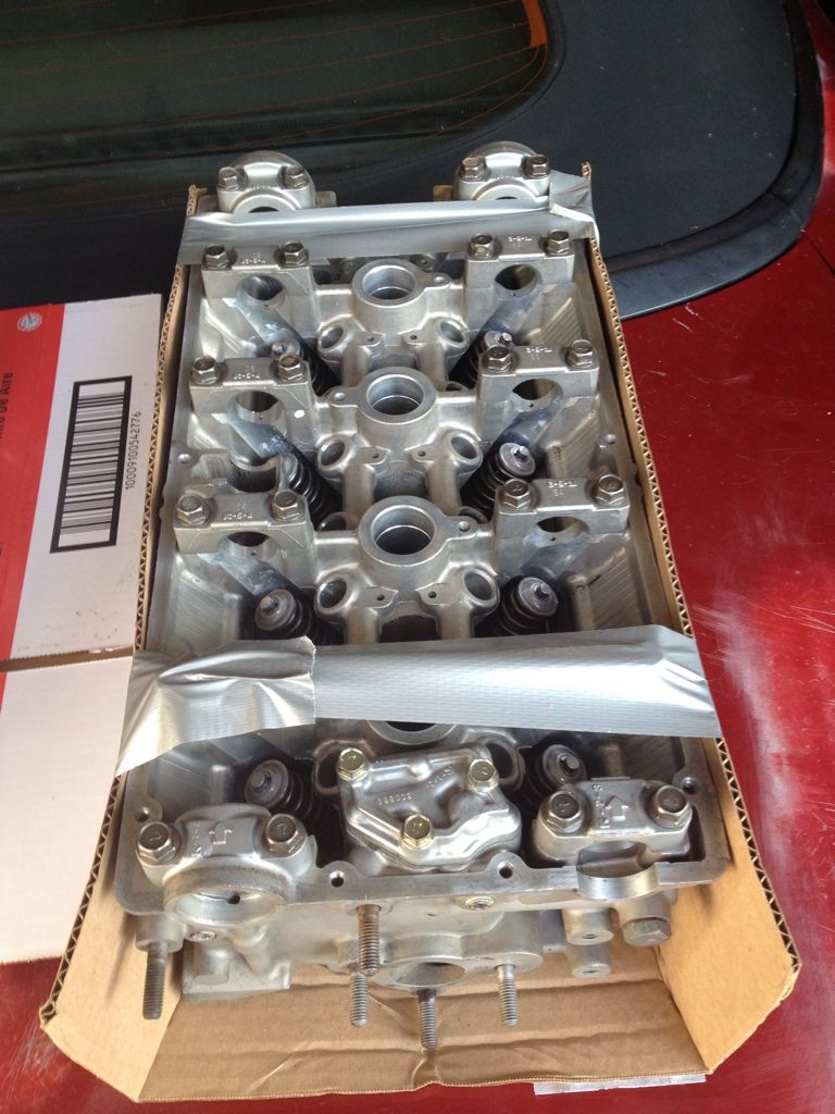

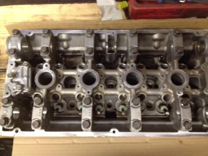

Also droped the head off this mooring at the machine shop to have it cleaned and inspected to make sure it will be fine to use other wise I will have to use a head off the shelf in the basement. It will be done Monday or Tuesday.

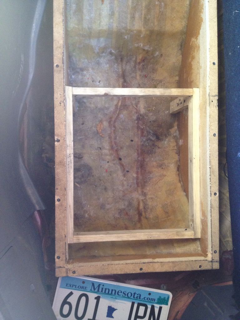

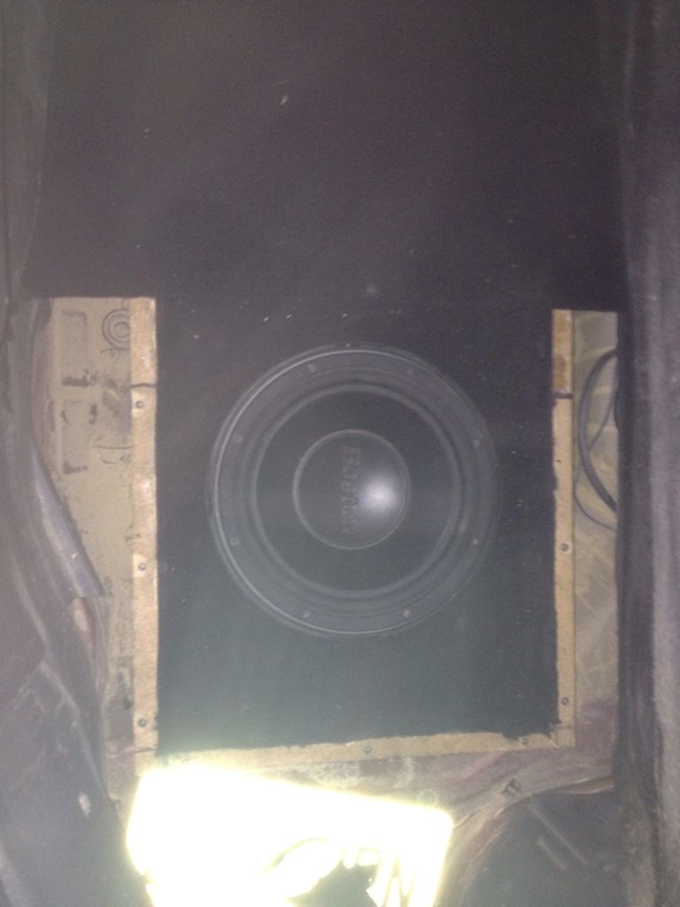

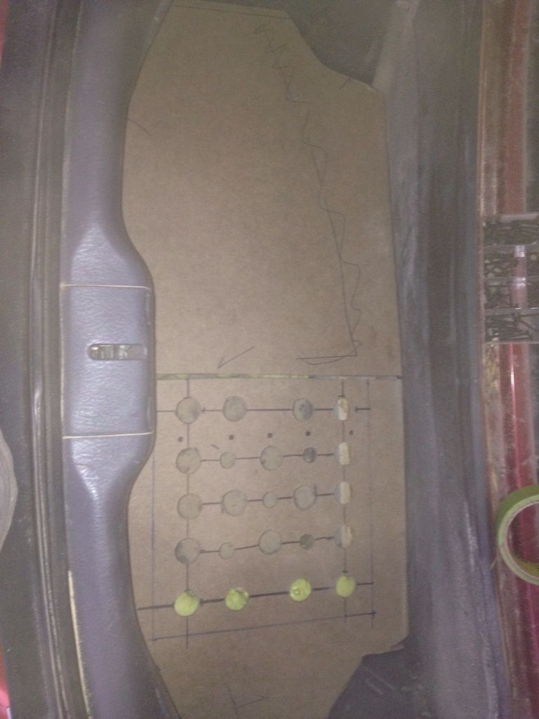

Redid the sub box today. It is now just under a cube for the Boston pro 10 that will go into it.
The new frame work for the smaller box out of the old box that had a ppi flat 15
The new top panels just have to carpet them now

Sub box is done. Just want to carpet the left side of the box that is going to be storage.
Top covers are carpeted as well

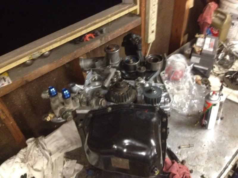

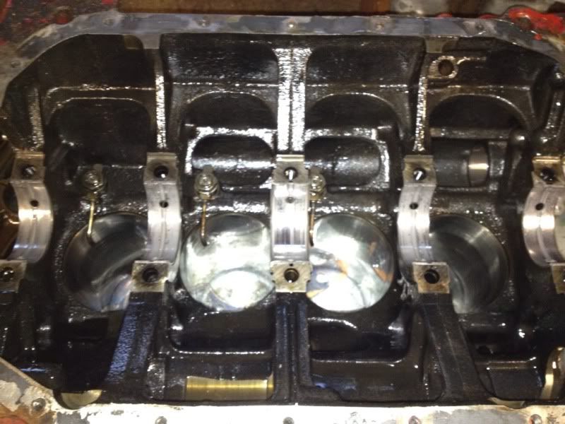

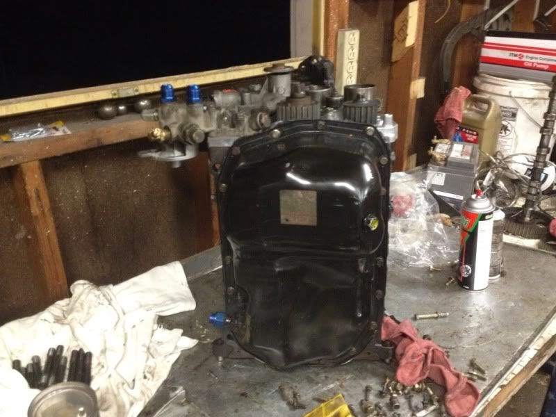

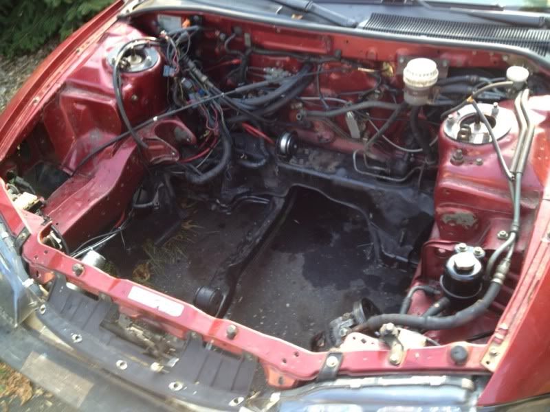

Started to put the bottom end together tonight also. Gosh will have the head all done on Friday. So next week end it should be back on the road

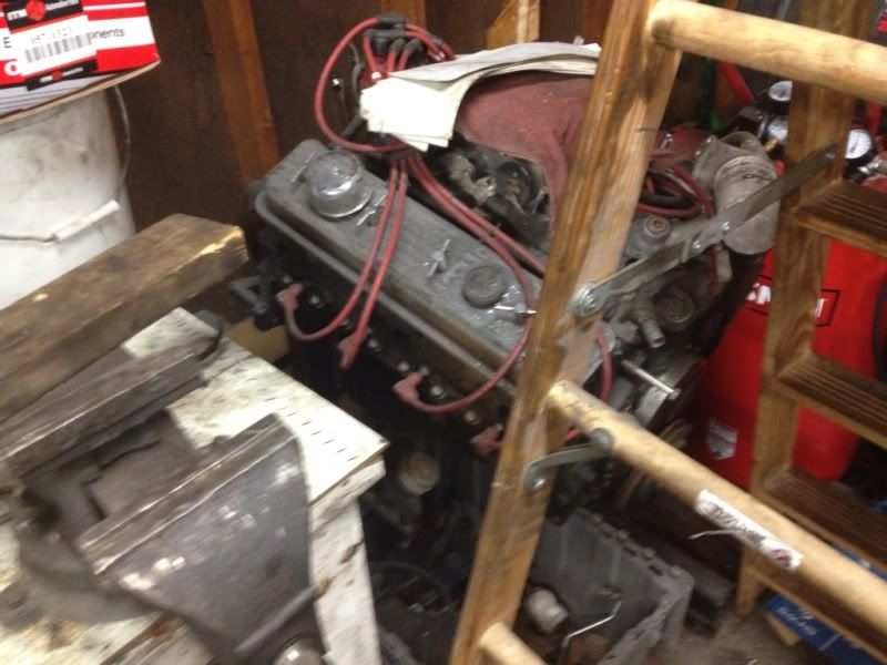

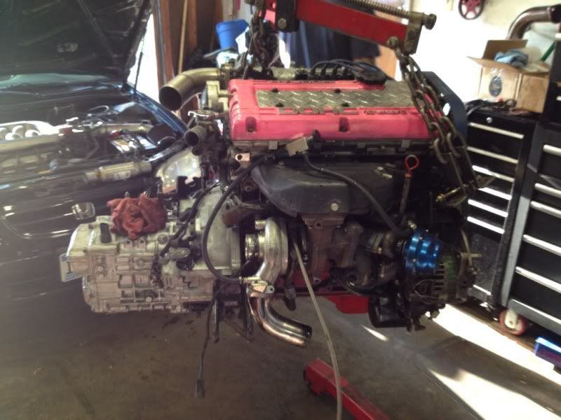

Putting the engine together on the bench since the engine stand has the sbc 383 on it right now.
The new bottom end
Also ordered a 10an fitting for the Evo 3 16g should be here soon.

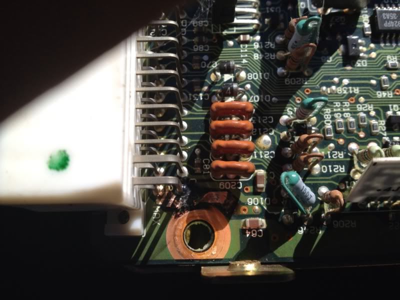

Well the Spyder is down for the 2nd since it has been running. Made it to hwy 7 on 169 on the way to work today. Shitty thing is I sold my spare EPROM to put it back together after the motor died the 1st time.
On another note. I have a turbo on the way. Got a 50trim for a great price.

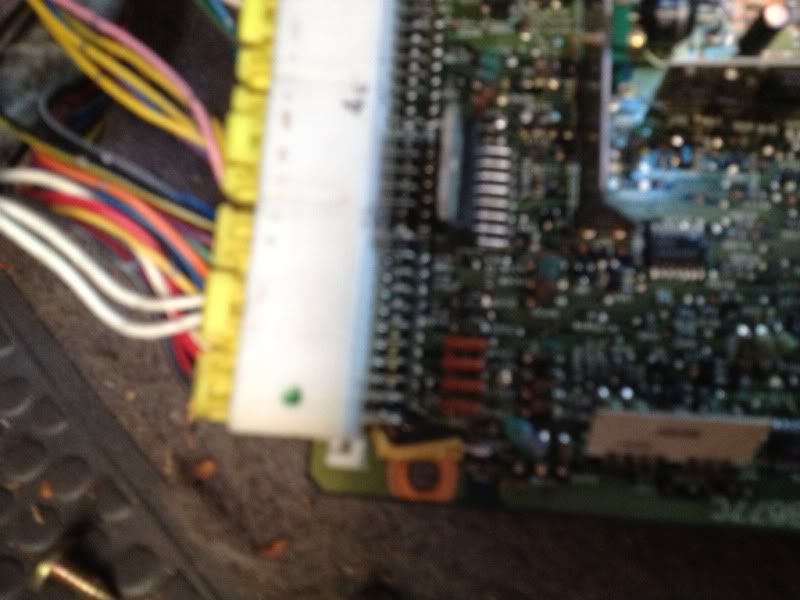

Got it fixed it was burnt all the way to the pin. Found out the o2 sensor was shorted out and burnt the trace off the board. Fixed the o2 sensor also. Now the car pulls all the way though 30psi.

Nice work on the ECU. I was yet to scroll down all the way when I was reading about the burned up pad and I was leering in on it exclaiming "you can fix that, easy!"

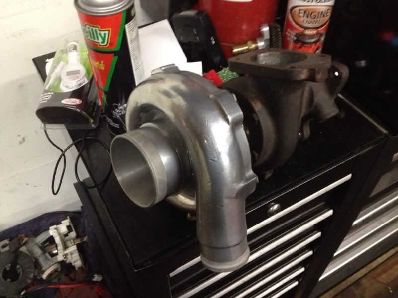

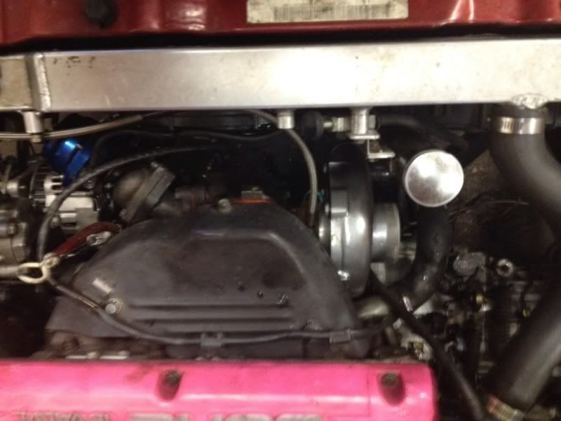

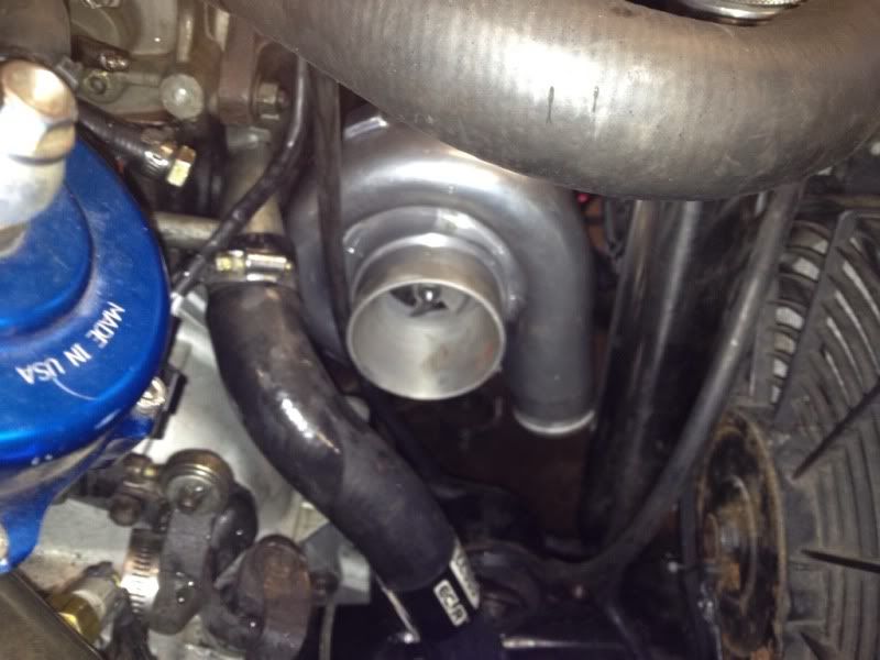

picked up a pte5031e for dirt cheap that is in great shape. the hot side was decked flat both flanges and the cold side was powder coated almost chrome. Will be taking on the evo 3 turbo on my weekend and putting the new turbo on. The only thing it was missing was the hot side clamps. It just had the bolts holding it. lucky i still had by bad gt40 and took them off that and reused them.

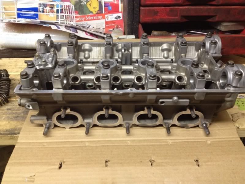

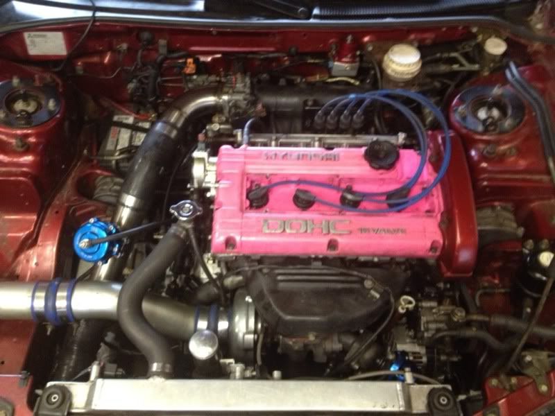

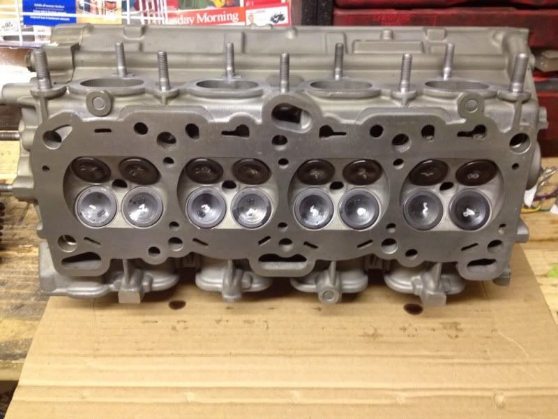

Have not updated it in a while. So there are a few updates. I lifted the head 2 weeks ago. Got new studs,head gasket and dropped the head back at the machine shop.
got the new turbo put on. Also found out the e3 16g is just fine and was not the smoking problem. So it will be up for sale now.
10-28-12
11-01-12

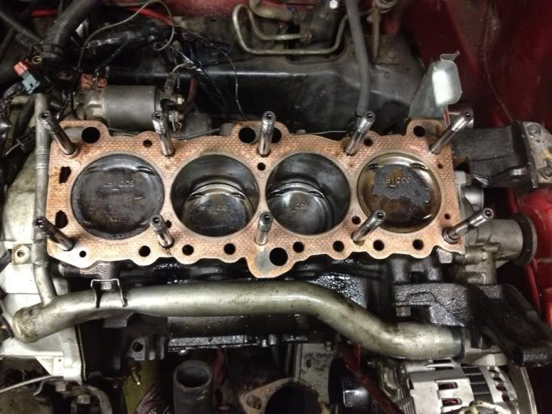

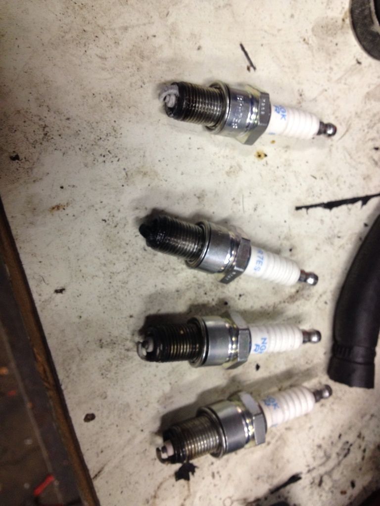

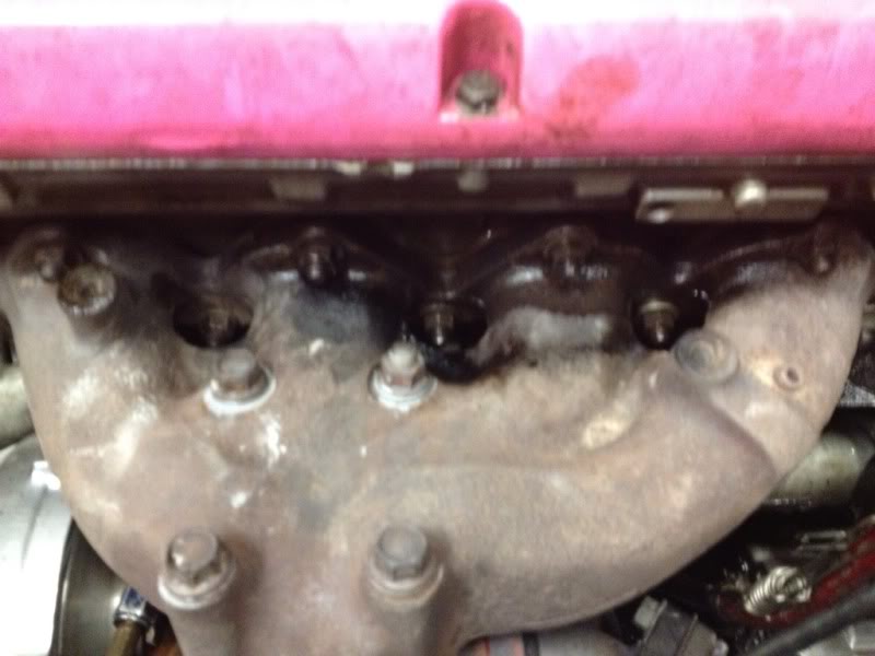

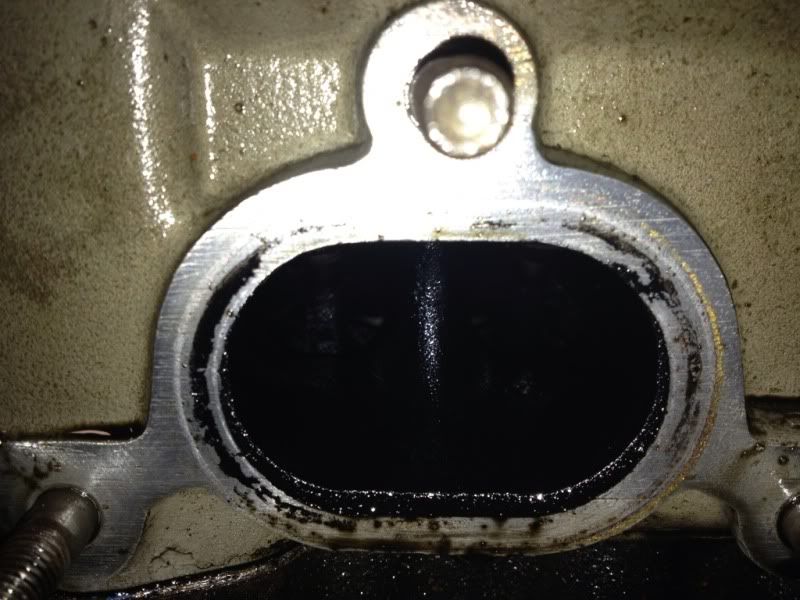

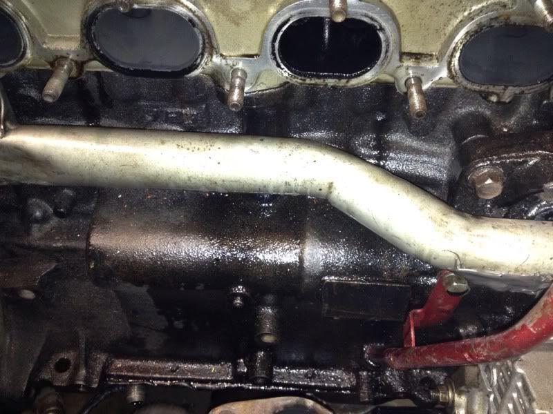

lifted the head ho the way to work yesterday. ended up dumping oil in to 2&3 and out the front of the block from one of the head drain holes.
so
head has to go back to gosh to be cleaned and checked a 2nd time
new head studs
new head gasket
find a timming cover (it broke taking it out)

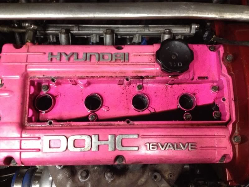

also time for a new valve cover
was going to send one off to have it powder coated hot pink them hydro dipped with hello kitty but that is now on the back burner
11-06-12
Picked up the head from gosh tues night. It is back on the car now.

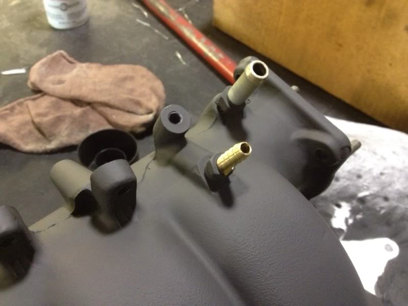

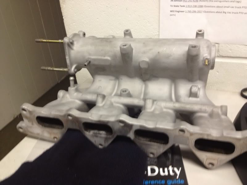

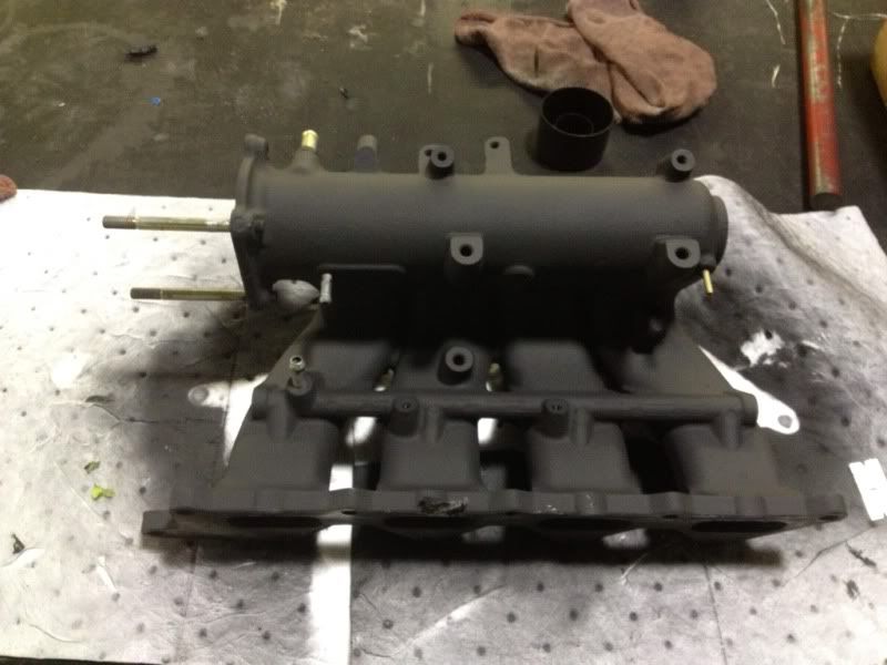

Sand blasted,and hot tanked the intake manifold
Painted it flat hi-temp black
Also used on of the stock bolt holes were the hard vac line bolted to now it is a vac port for the 4 bar map sensor

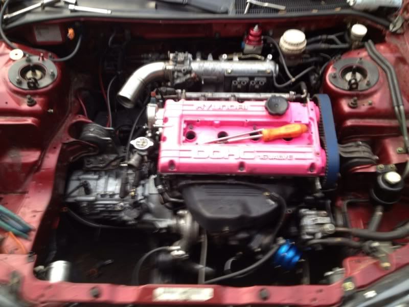

All back together
It has been running good now with the head done the 2nd time,new gasket and studs.
It is also its very first winter :( going to have to swap the winter tires on this weekend they are saying around 6in of snow.

my car is actually having the same problem it is coming into the exhaust manifold... did you find out what it was??? i did a compression test and they were all 100 except for one. which was 30. i guessed that it was piston rings but i would like to know how you solved your problem.
