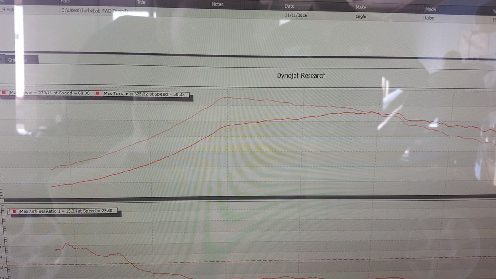

Well here's an update guys! Finally made it to the dyno! Here's a video of the first pull I think she made 260
whp on this pull? Lol my tuner came over and pulled out some more power out of her, here's the best pull she did that day! We lowered the boost and made more power with some fine tuning.
279whp 325Tq She's blast to drive! 20psi on 91oct

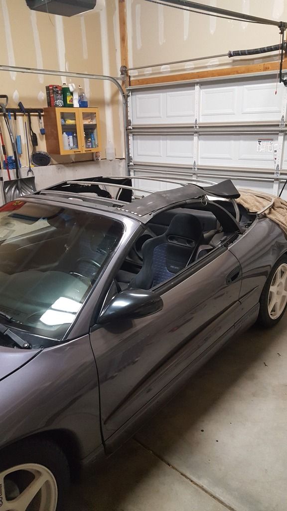

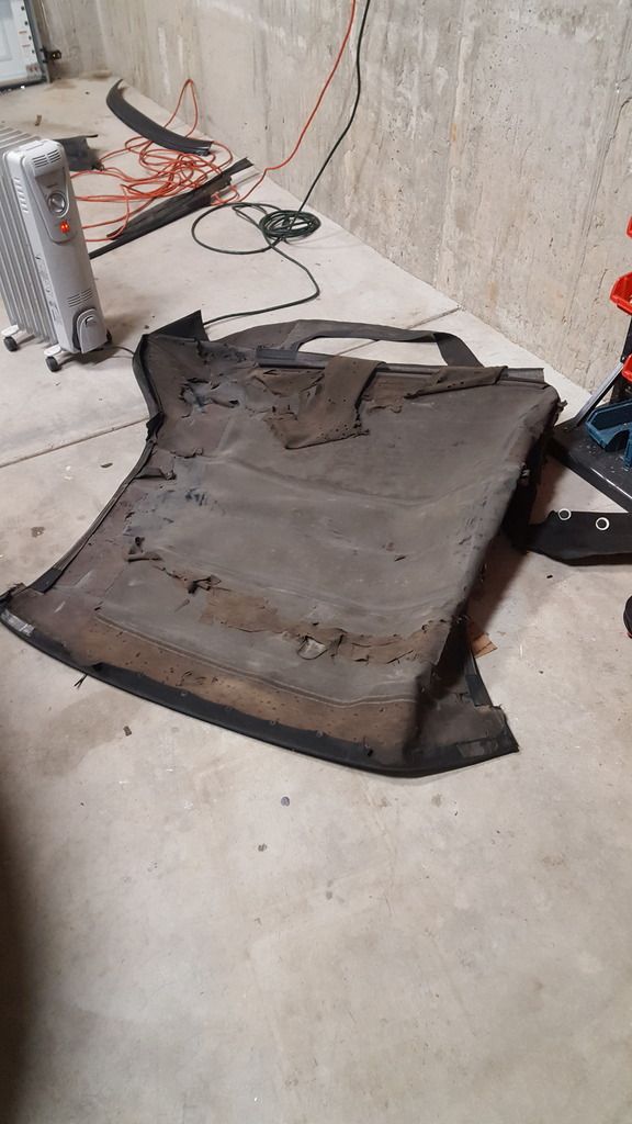

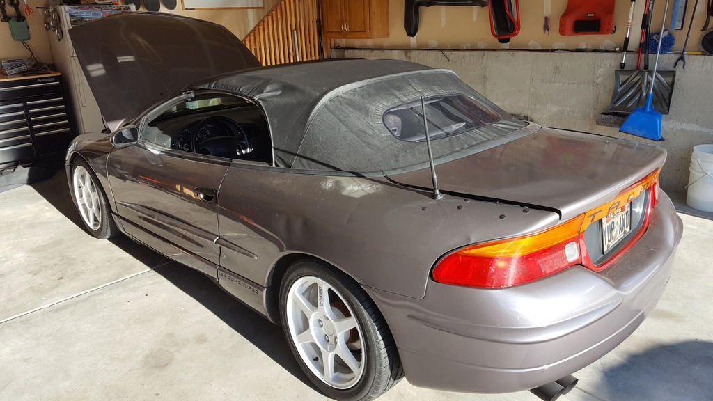

I've also replaced my top! Gotta say it's a pain LOL Even with a walk thru DVD there was a few things that weren't clear enough but the new top is much nicer and my old one was in terrible shape. Here's a few pics I snapped during the install. It didn't come out perfect but definitely is nicer than my old top.

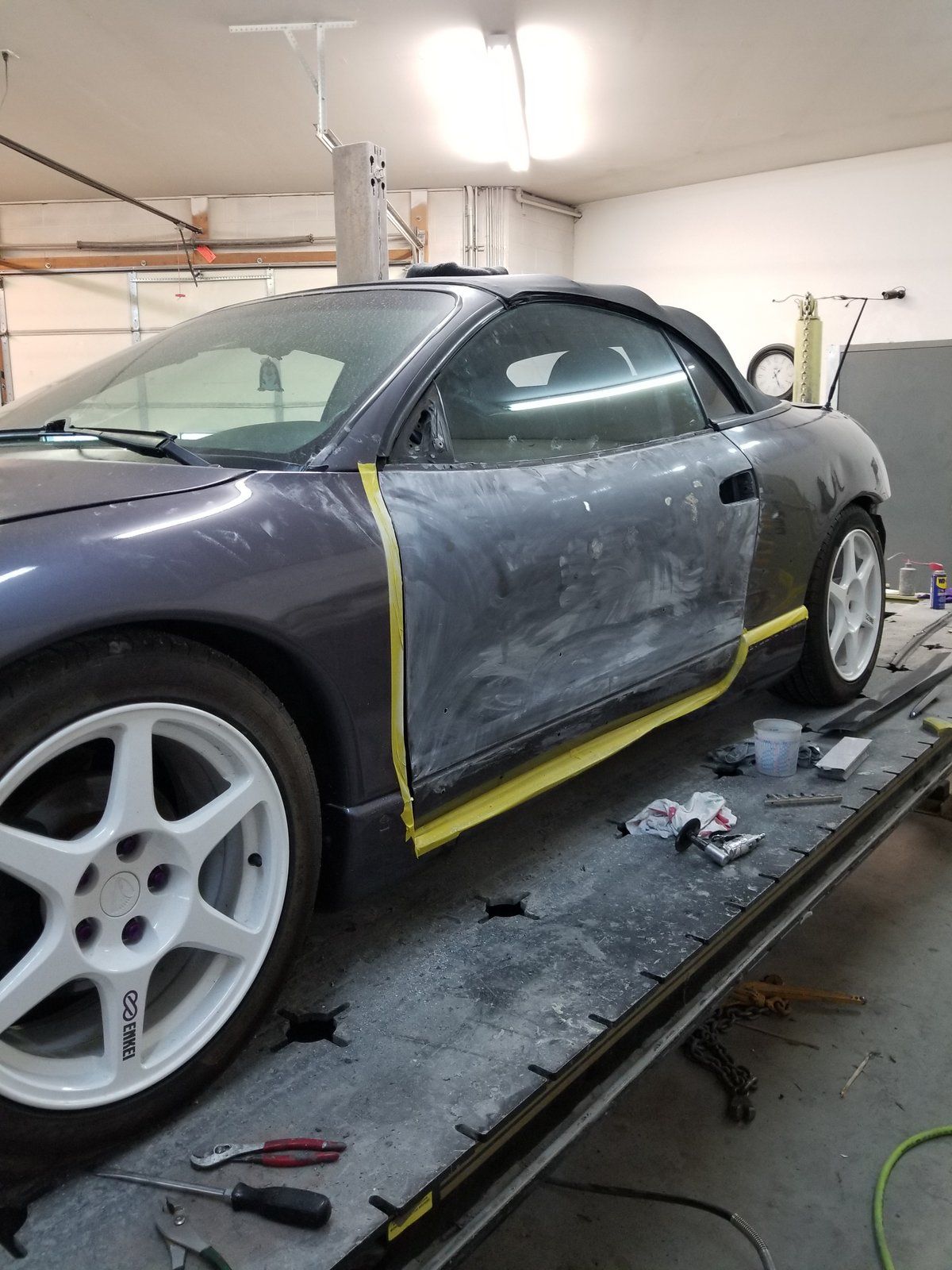

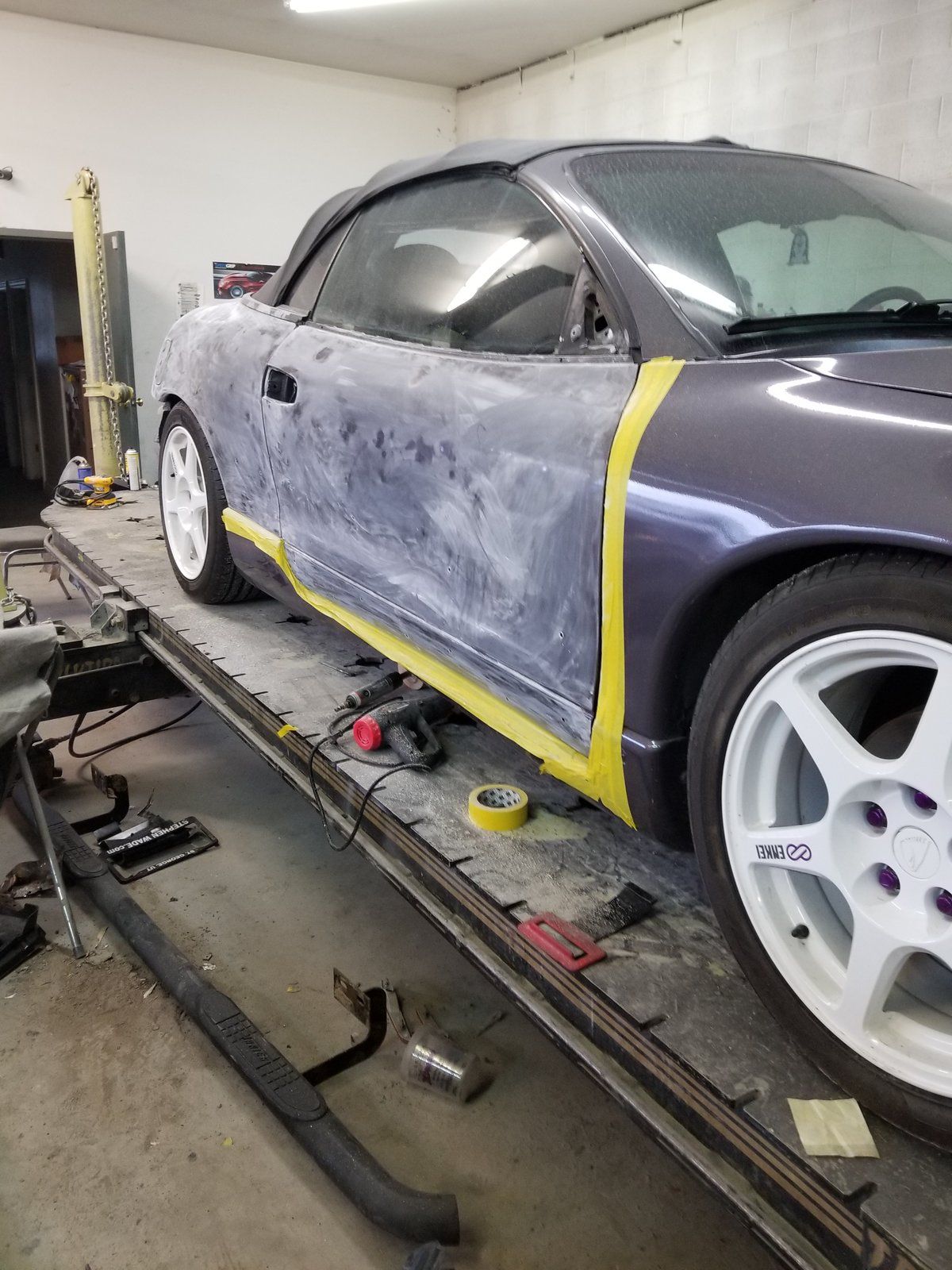

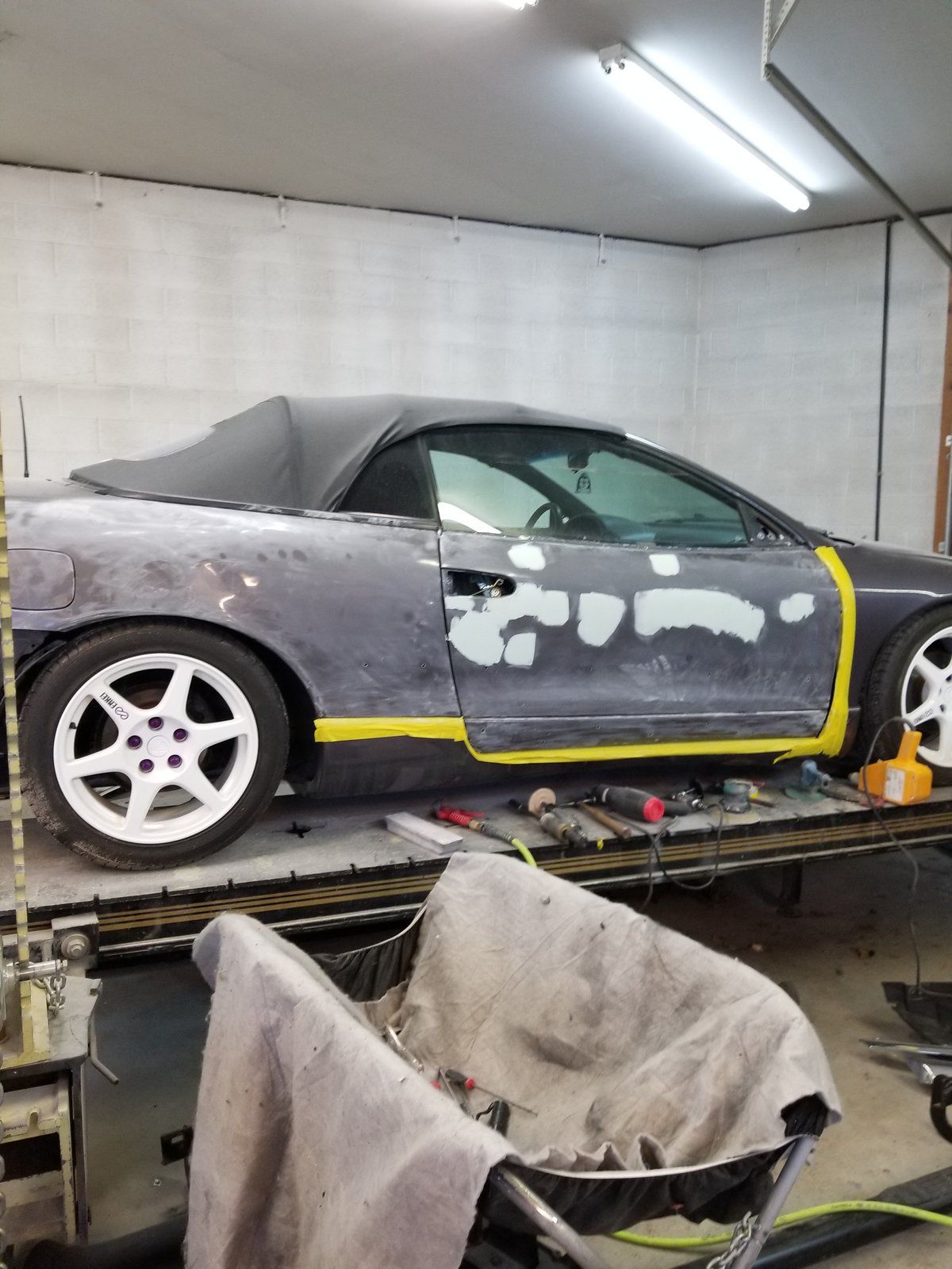

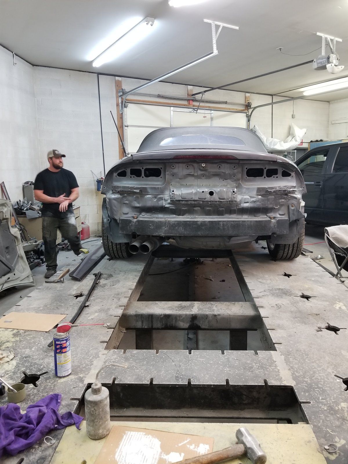

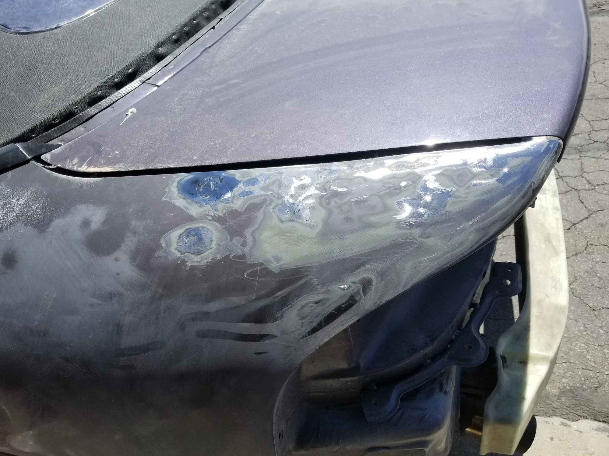

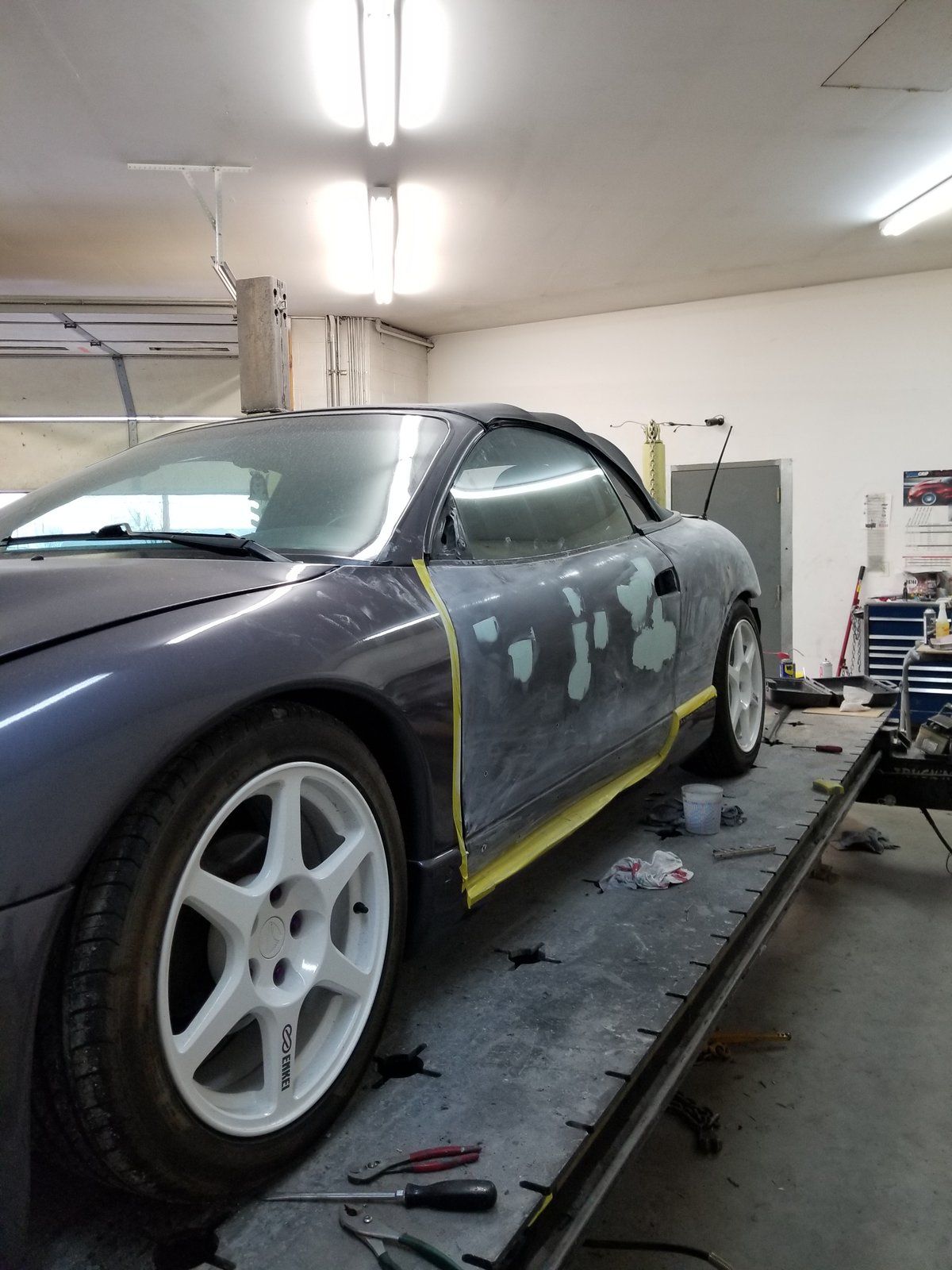

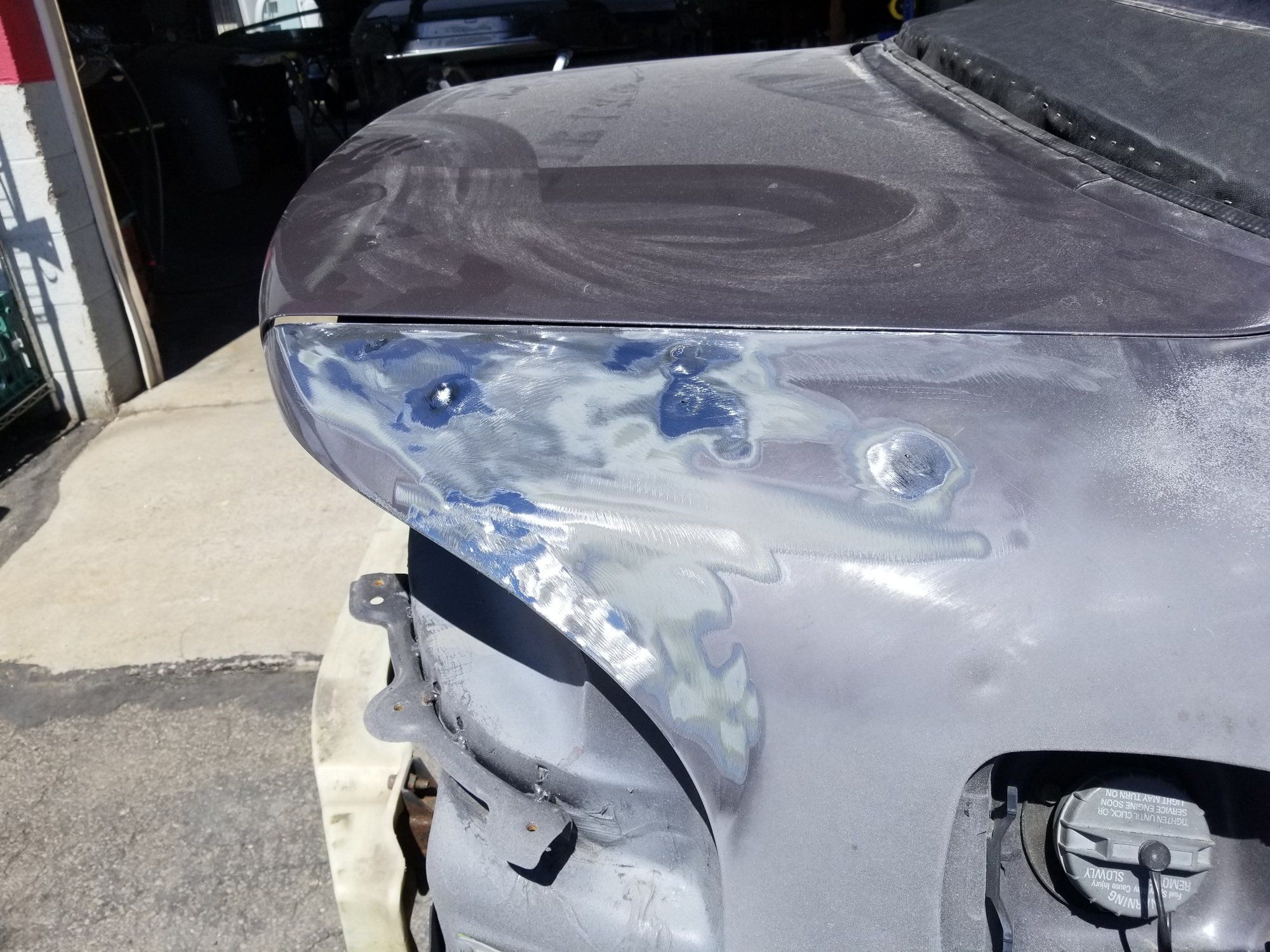

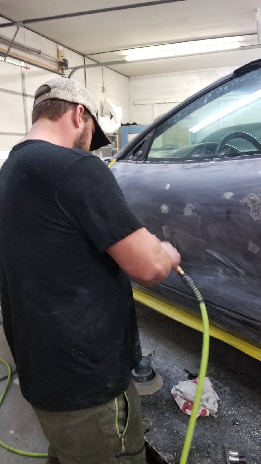

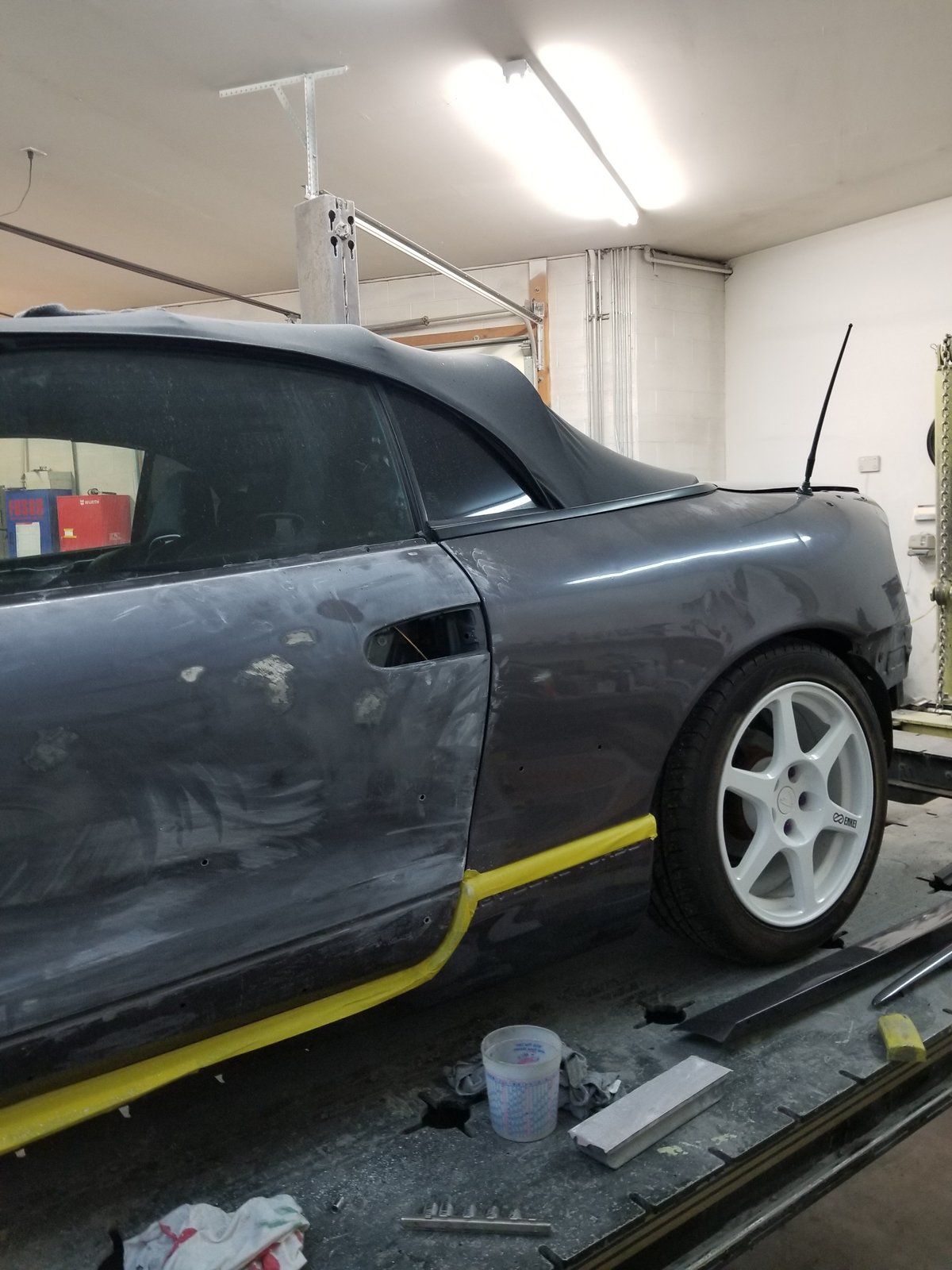

I'm back fellas! Finally got around to taking it to my friends body shop and we've started on the dings dents and pulling the rear end to straighten it out and match all the paint work that's already been done! Here's a few pics

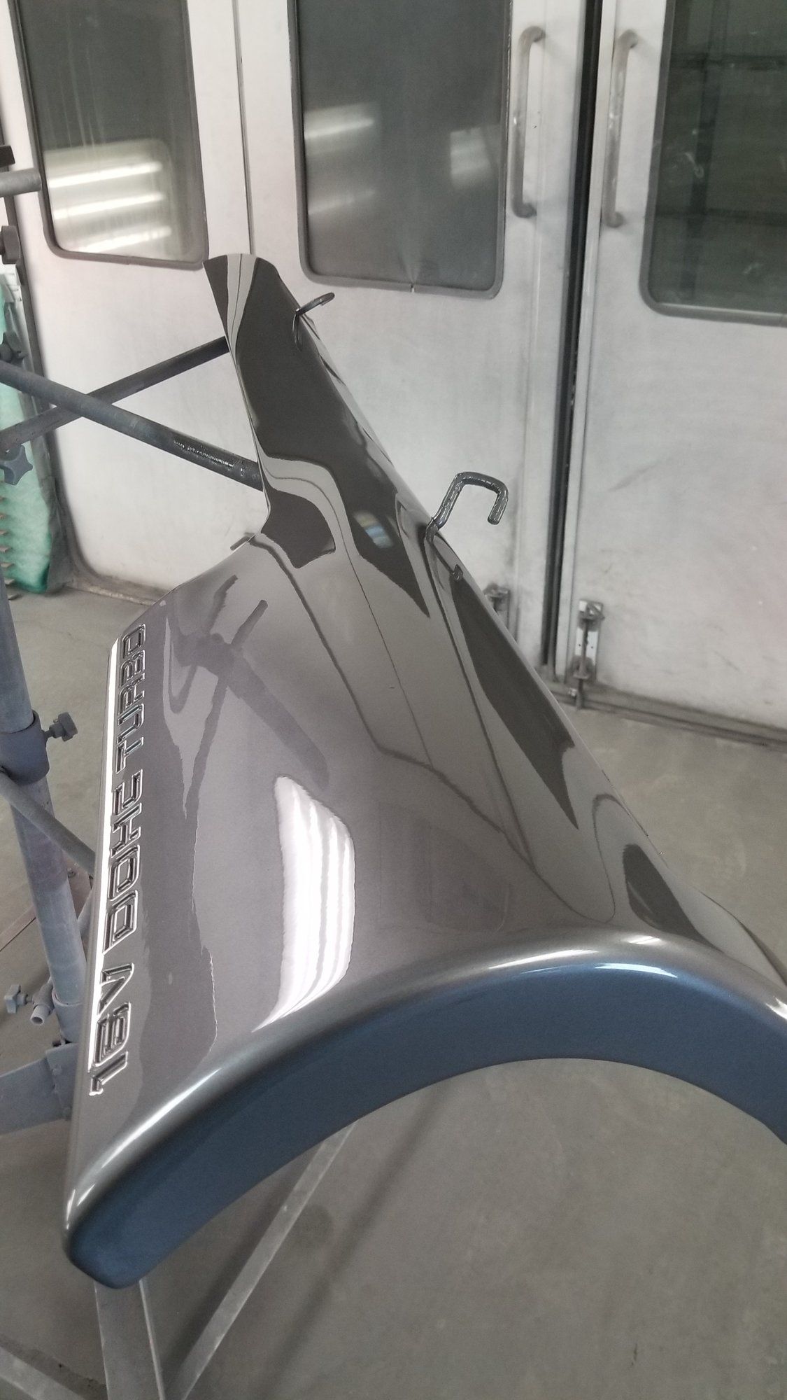

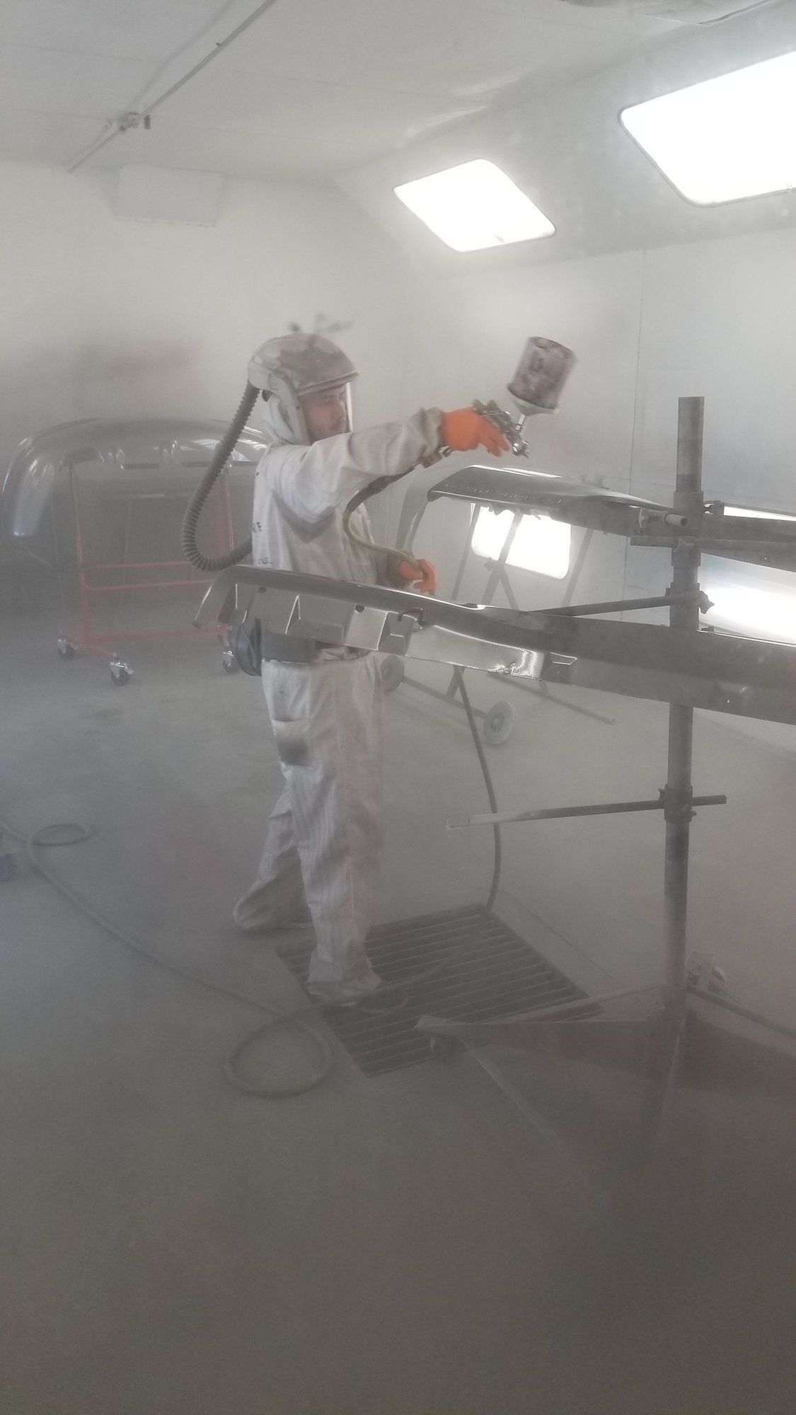

Hello gents! Recently had some more paint work done!

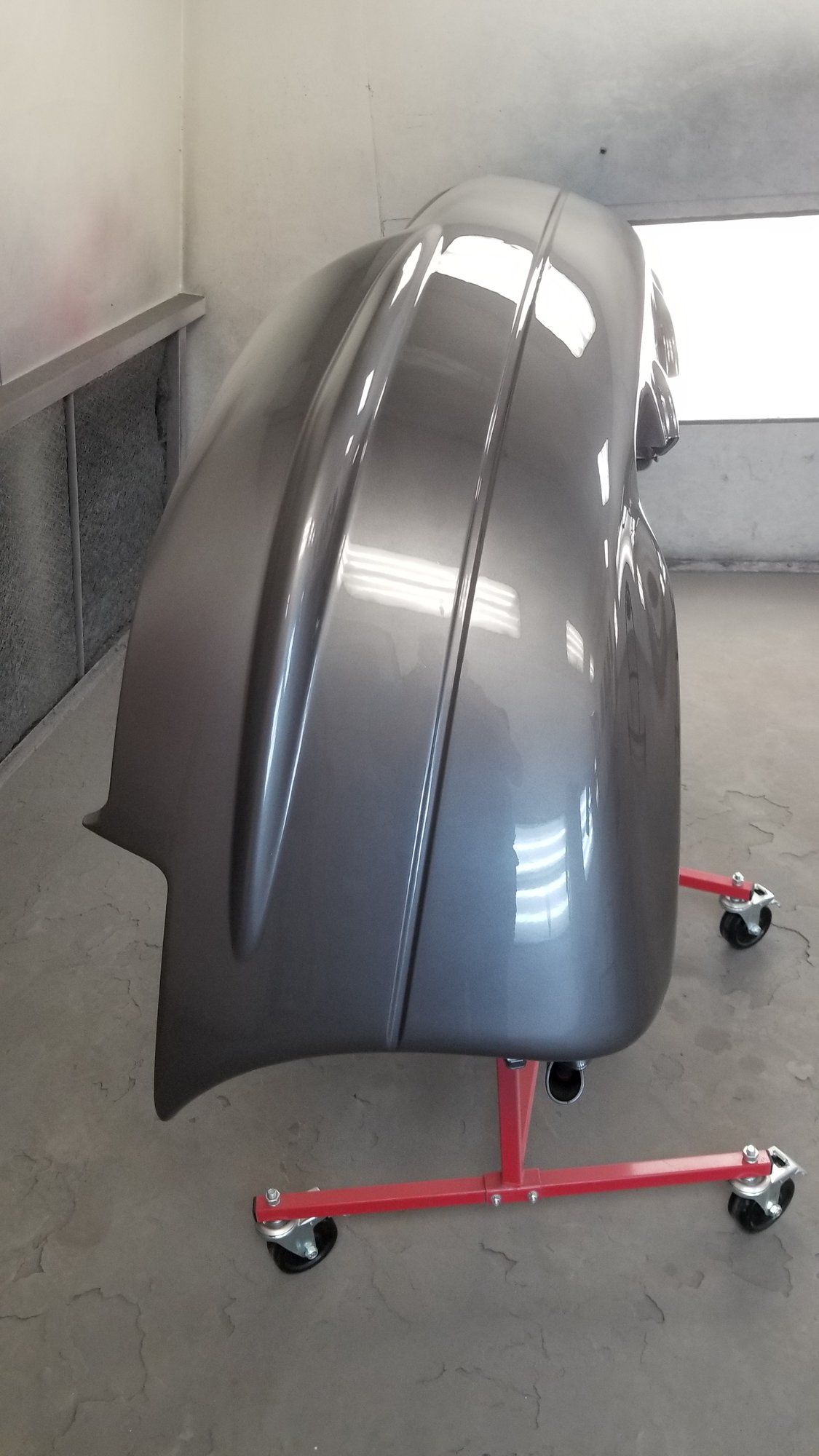

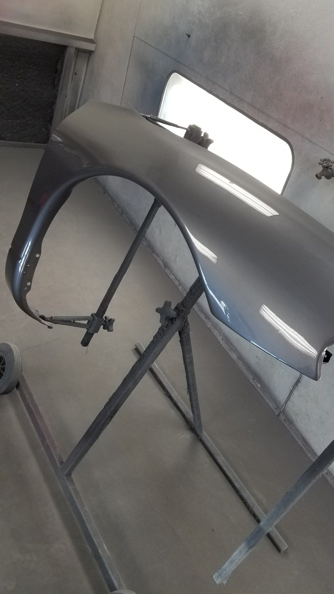

Prepped and painted the fenders side skirts and rear bumper!

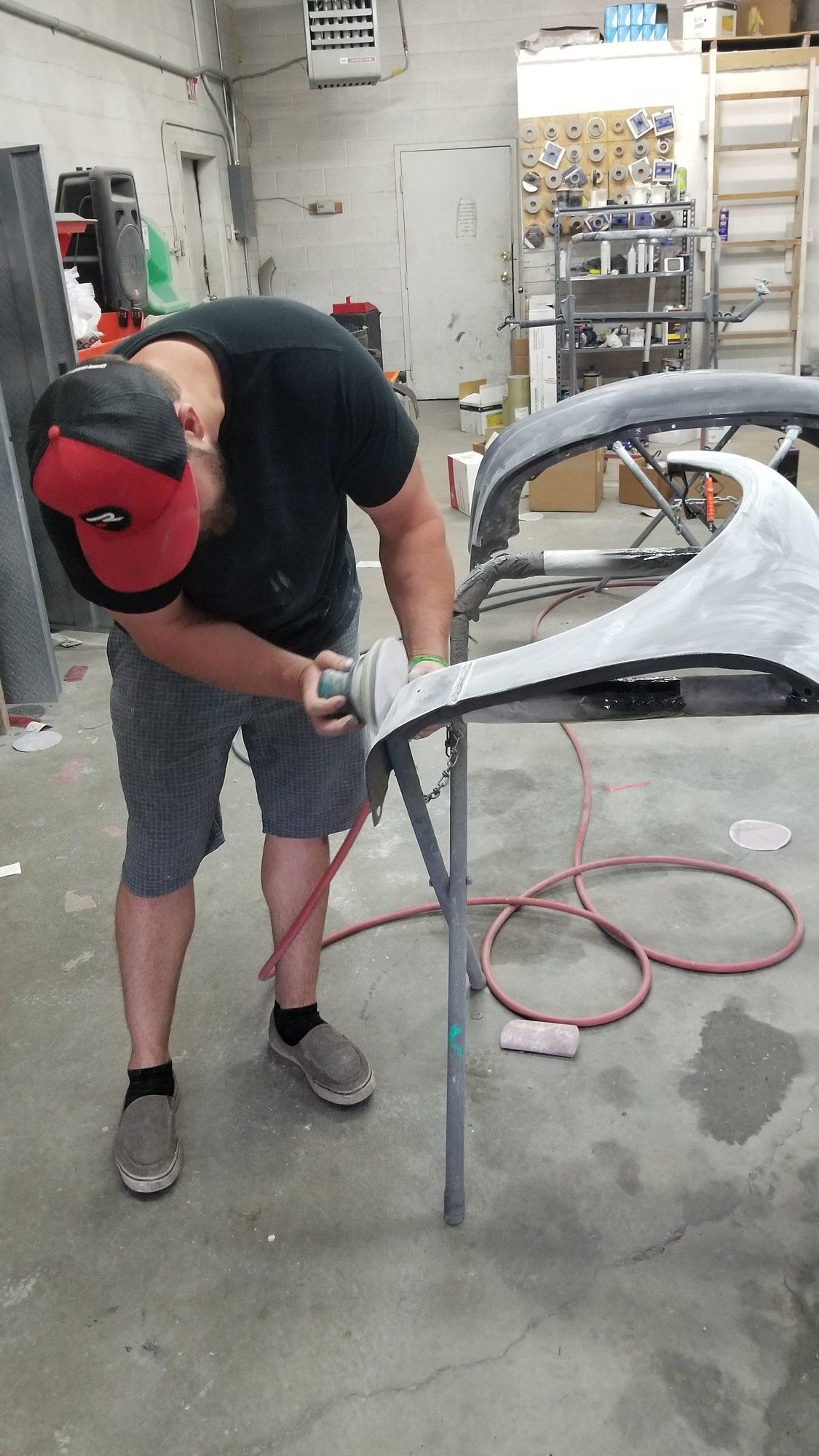

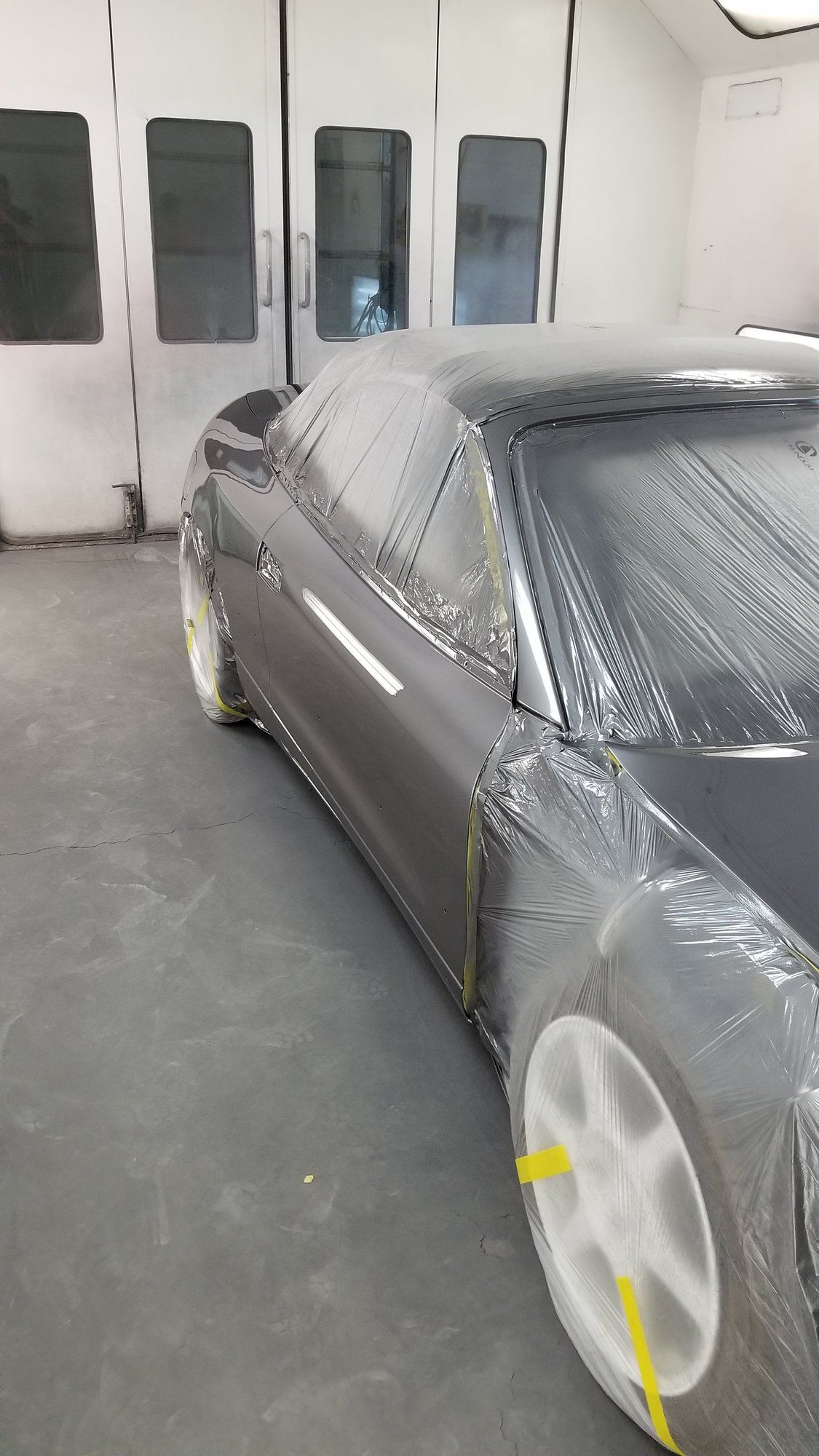

Its slowly but surely getting done! We decided to spray the whole car my friends pictured are the ones doing the work I helped a little in the preparation but they are definitely the ones spending the most time. We're hoping to have the car and the rest of the trim pieces, mirrors and door handles in the booth next weekend!
