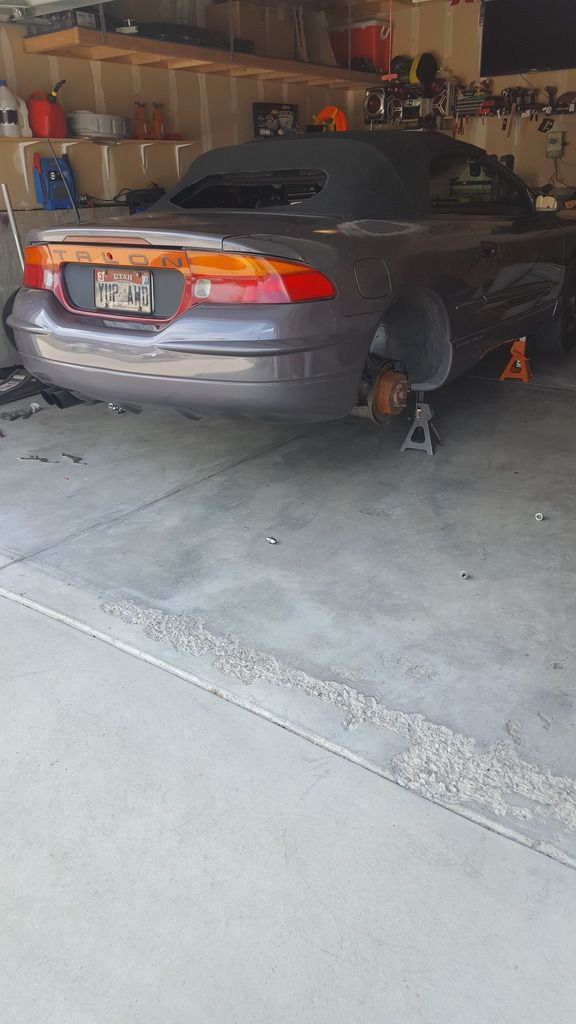

1998 Gs-t Spyder Auto.I did a manual swap and while I was at it did the awd swap. Fun little project so far.

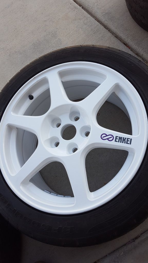

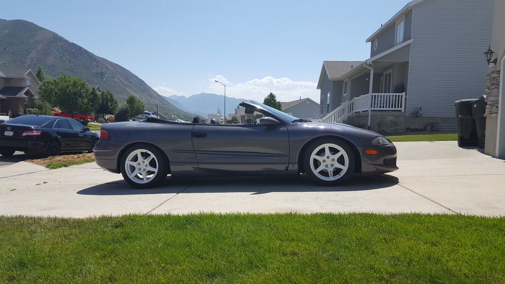

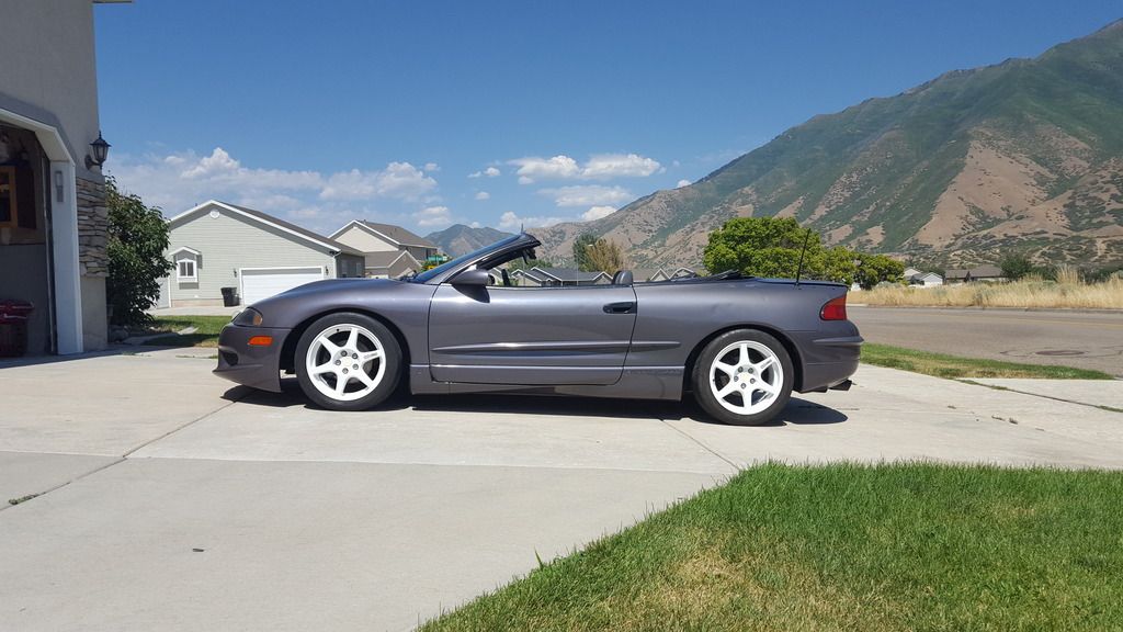

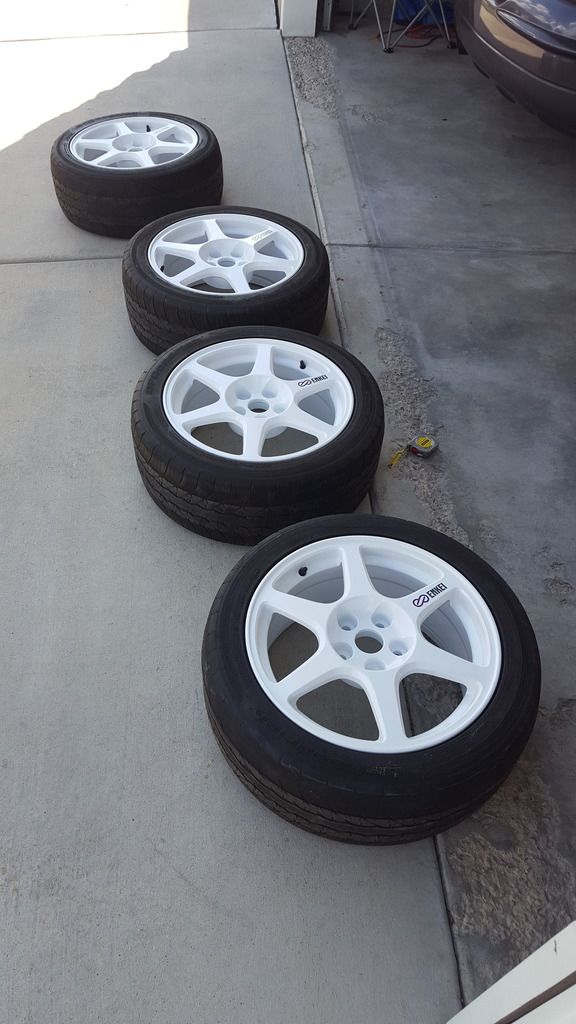

Remember these wheels? Look at them now! :)

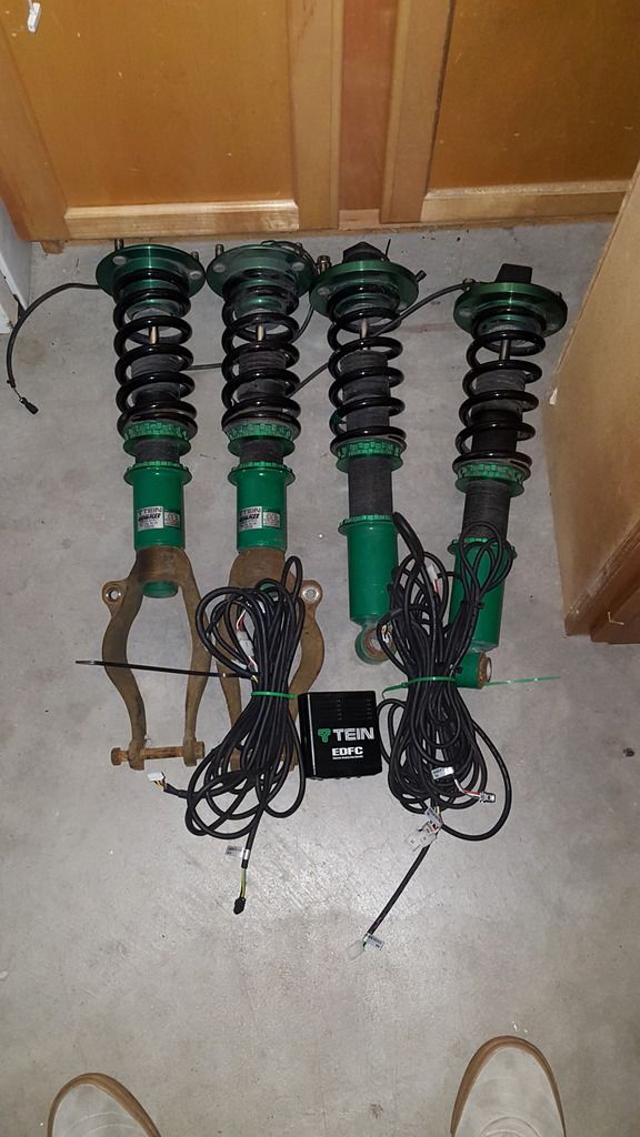

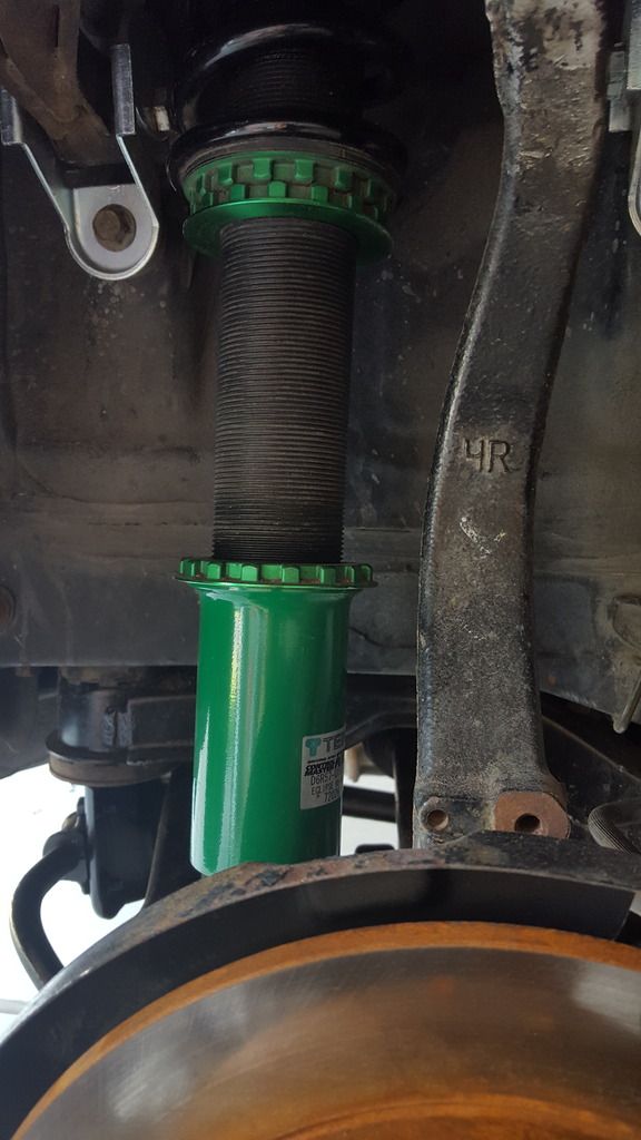

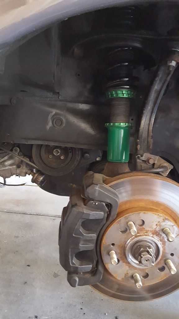

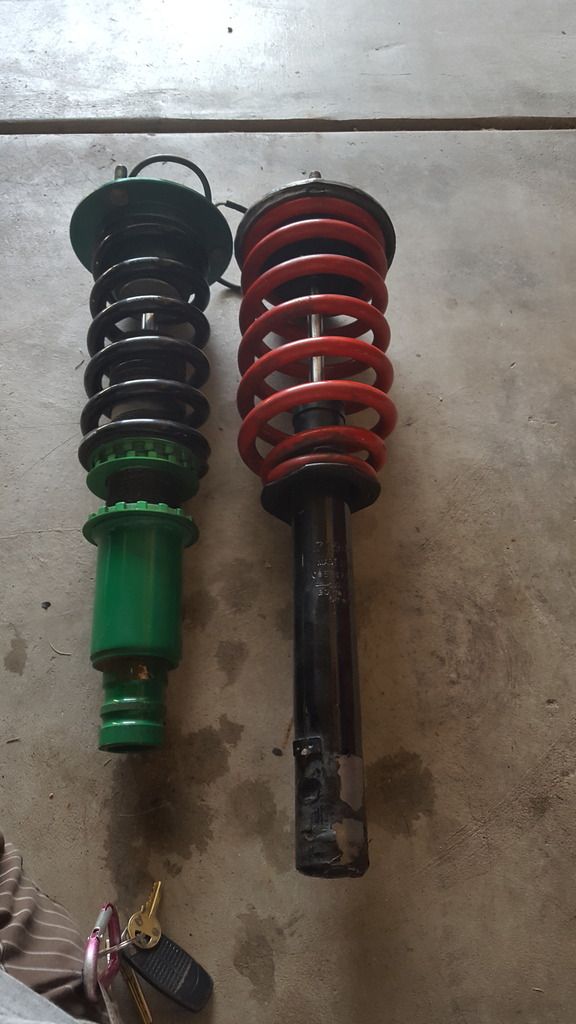

Also, Not sure If I ever shared but I picked up a set of Tein Flex Coilovers With EDFC for a stupid good deal, I literally couldn't believe how I got these in perfect shape with EDFC for the price I paid!

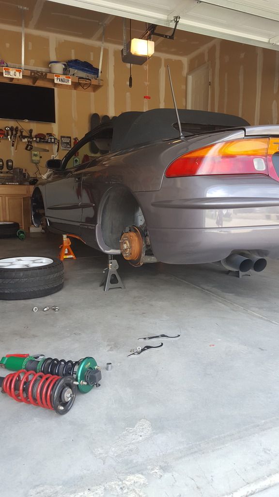

I've had the coilovers in my garage for about 3 weeks patiently waiting for my wheels to get back from the powder coater and having my buddy mount the tires, Got them back on this past Monday afternoon, Tuesday after work I got down to business!

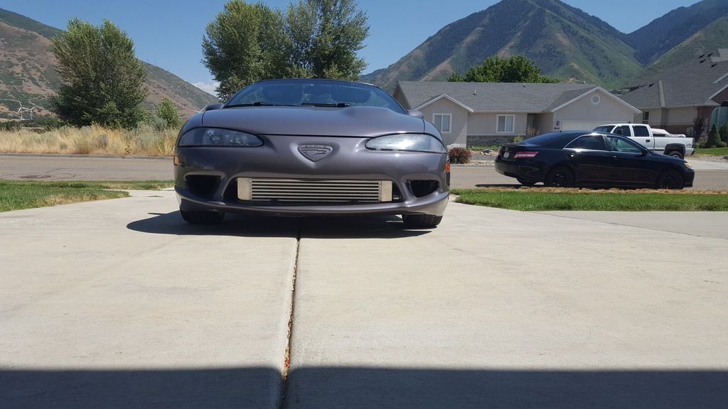

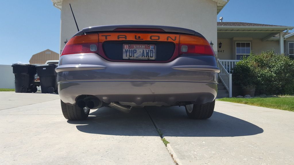

After what seemed like endless adjustments with the coilovers, Here's where I'm at and I'm happy! I'm considering going down a tad lower all around but haven't made my mind up just yet.
Without further ado!
Let me know what you think guys! Stay Tuned another update coming soon!

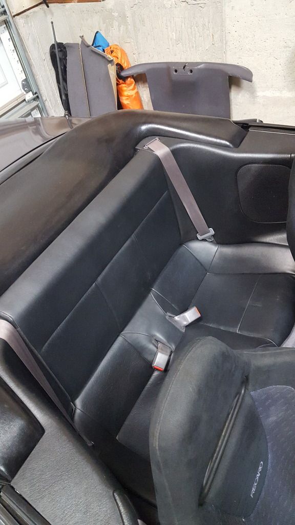

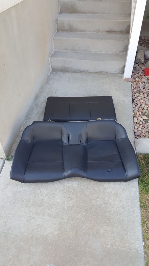

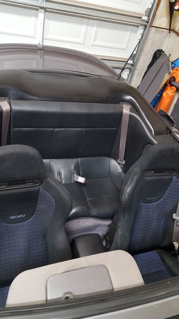

A local was parting out a wrecked 99 spyder, Ended up having full black leather interior, Since I already have Evo Recaro's the rear seats were all I wanted, Got them for a great deal and they look so much better than the grey :)

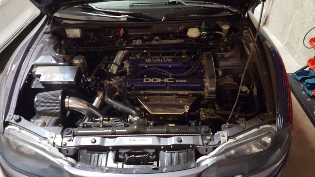

Also, I've successfully installed my 880cc PTE Injectors, as well as my 255 walbro fuel pump. Going to fix a few boost leaks and call a local friend to get a good street tune done I'm hoping to have her around the 20psi range very, very soon :D
Whoa! So thats what the back seat are is supposed to look like!? Been so long since ive had back seat interior in mine that i dont remember! Although a cage kind of hinders it!
In the future I'm hoping to do a cage that will go threw the stock seats, I'm sure it'll be a pain but I'm not a fan of the gutted look LOL.
That was my intention as well. I had good intentions to fab the back rest support and carve out the back rest to slide over the rear bars but i just havent had the ambition to do so. The car runs so its not on the high priority list anymore. Im working on a new project now so its on an even lower priority! Haha

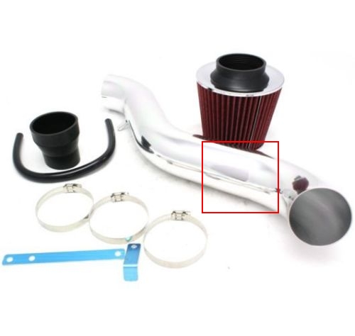

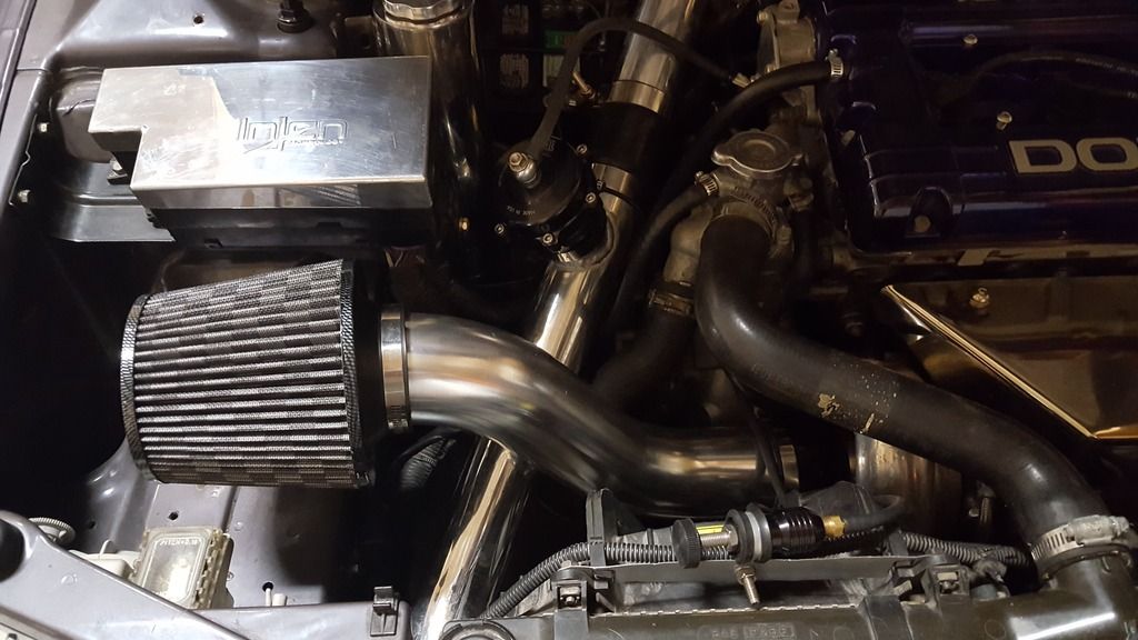

As I've probably mentioned before, I went SD a while back, tried for a long time to find a filter that fit the oval Injen intake without the Maf and the only option I found was 55 bucks! I couldn't do that so I started searching the old webs and found a brilliant idea!
A DSMR long ago found out a 88-91 CRX SI intake works as an SD intake for our cars with just 1 cut made to the pipe!
Here's where you need to make a cut, I did it just before the bend starts where the pipe is still straight
I also bought a 3" to 2.25" Reducer to fit my 16g and it fit perfectly!
Here's the installed pics
