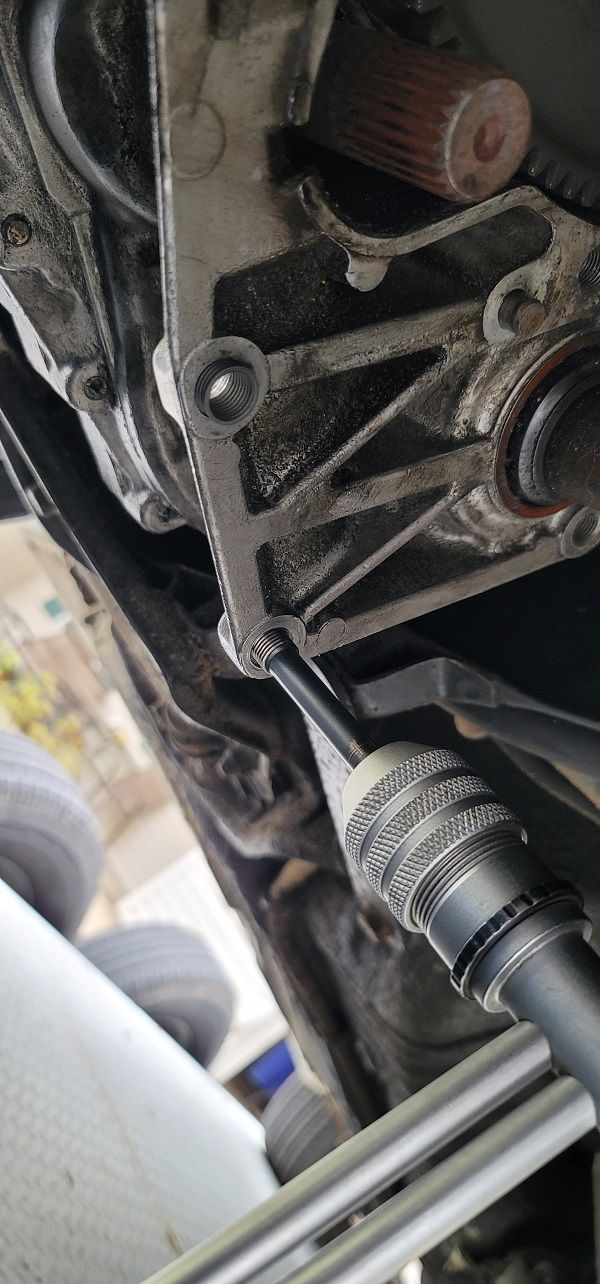

Nothing exciting, but I figured it best to start with maintenance/repair. I dropped the t-case to Timesert a few holes on the trans. Also had to repair a hole up top for the trans mount. The lightweight, thread-delete mod previously done just wasn't cutting it for me. ;) I replaced the fluids in the trans and t-case while I was under there.
NOTE: Timeserts are a great fix for this common issue. They are MUCH better than helicoils (worth the extra cost). Also, make sure you use carbon steel inserts and NOT stainless steel inserts, due to potential galvanic corrosion issues. And if you want to learn more about how to use timeserts, see my write-up HERE.

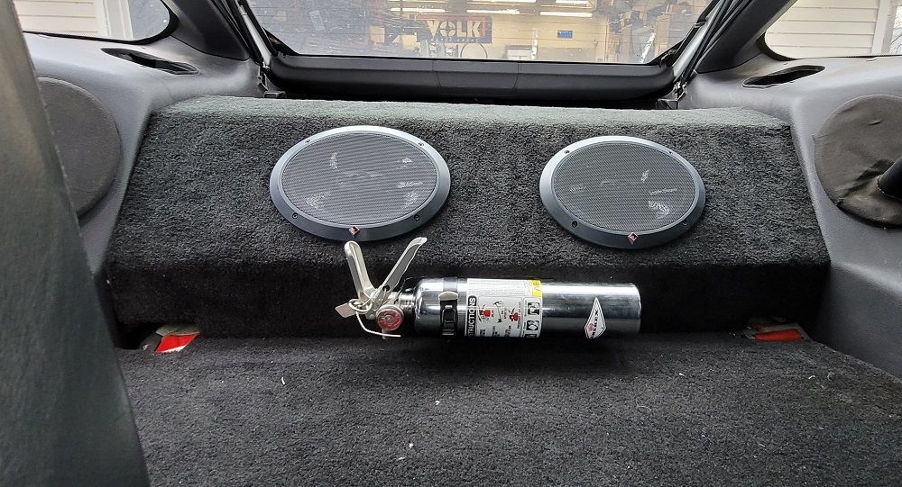

And being that this car has zero stereo components and that's just unacceptable for me for a streetcar, I added some 6x9's. This car has a rear backseat delete and we incorporated them into it. The OE spots are taken up by the roll bar. Turned out pretty nice though. I used DEI boom enclosures on the backside - hopefully that helps with sound. Certainly cleaned up the install. I also added a fire extinguisher.

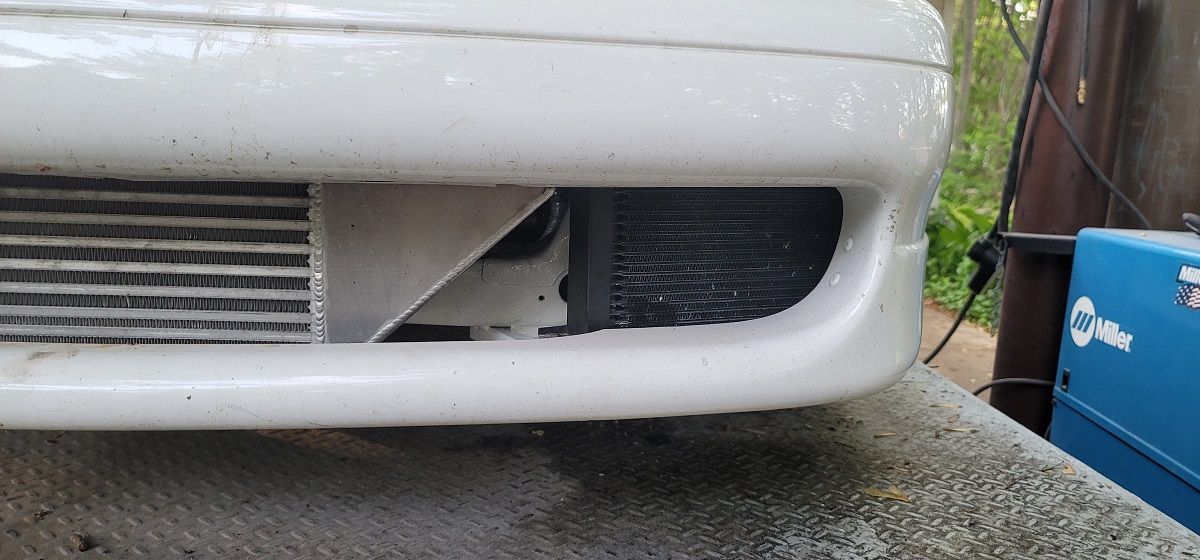

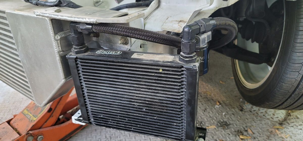

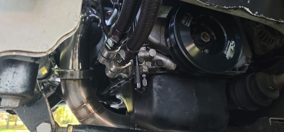

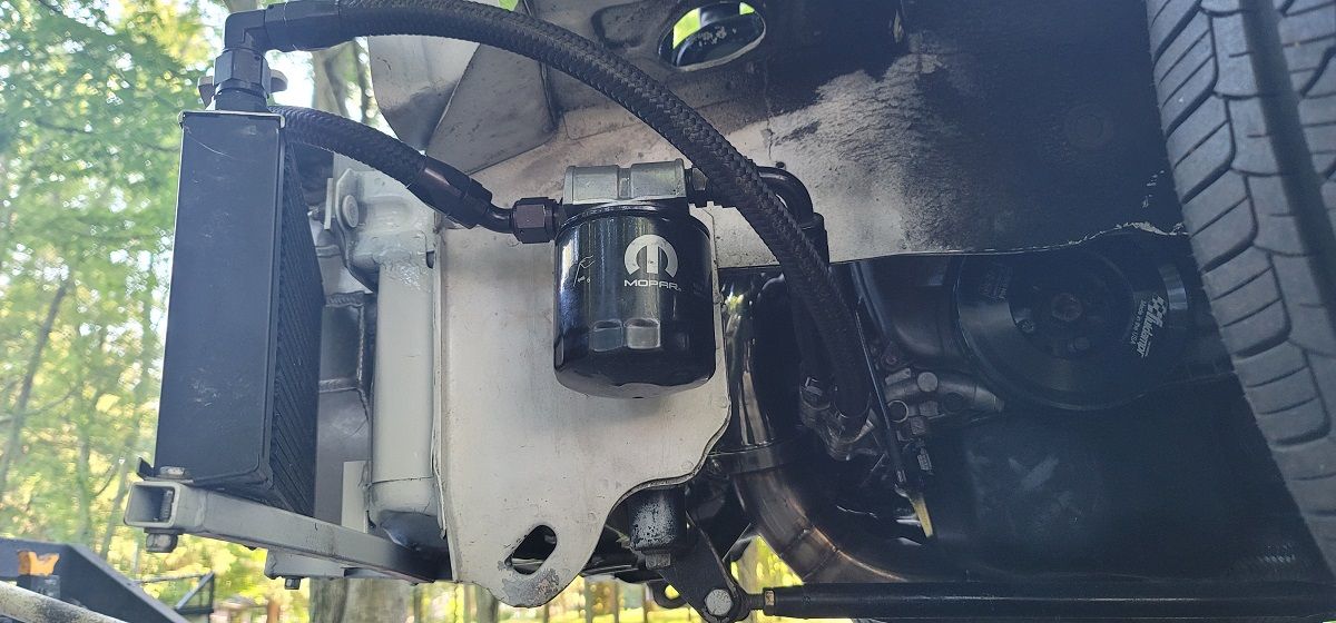

I got the oil cooler system back on the car. Dan and I put this system together back in 2013. Setrab cooler up front, a remote mounted oil filter, and a bypass adapter mounted to a forward facing housing. Pretty trick set-up.

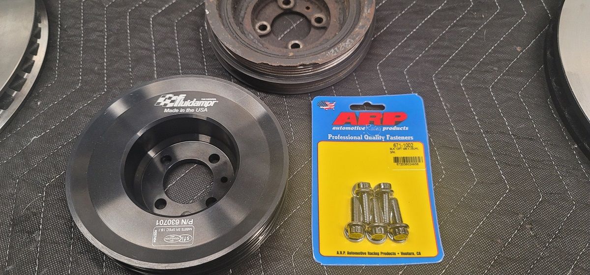

I also noticed the damper was old and beat up, so I added a Fluidamper and ARP bolts while I was in there.

I really like the remote mount oil filter. :thumb:

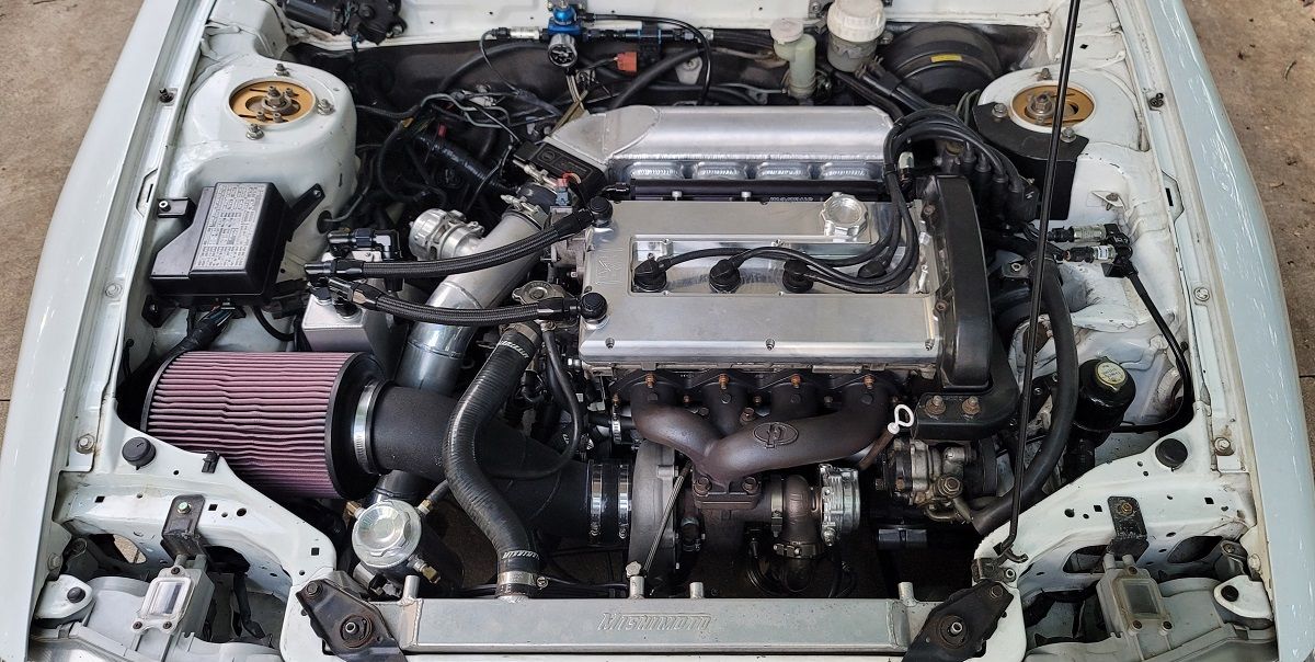

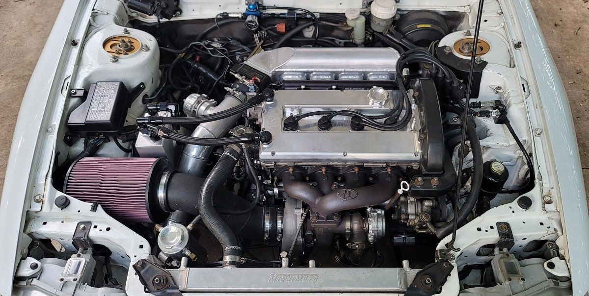

I got the plate installed and she got her first bath. I'll be scrambling to get a catch can installed tonight and will be hitting the dyno tomorrow morning! Engine bay pic coming soon, even though it's still a work in progress.
