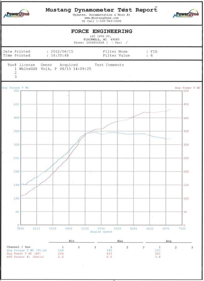

Dyno HP
433 whp
345 lb/ft
Mustang Dyno
Dyno Sheet Photo Link
Force Engineering
92*F ambient temp!! and 60% humidity. E85 fuel.
