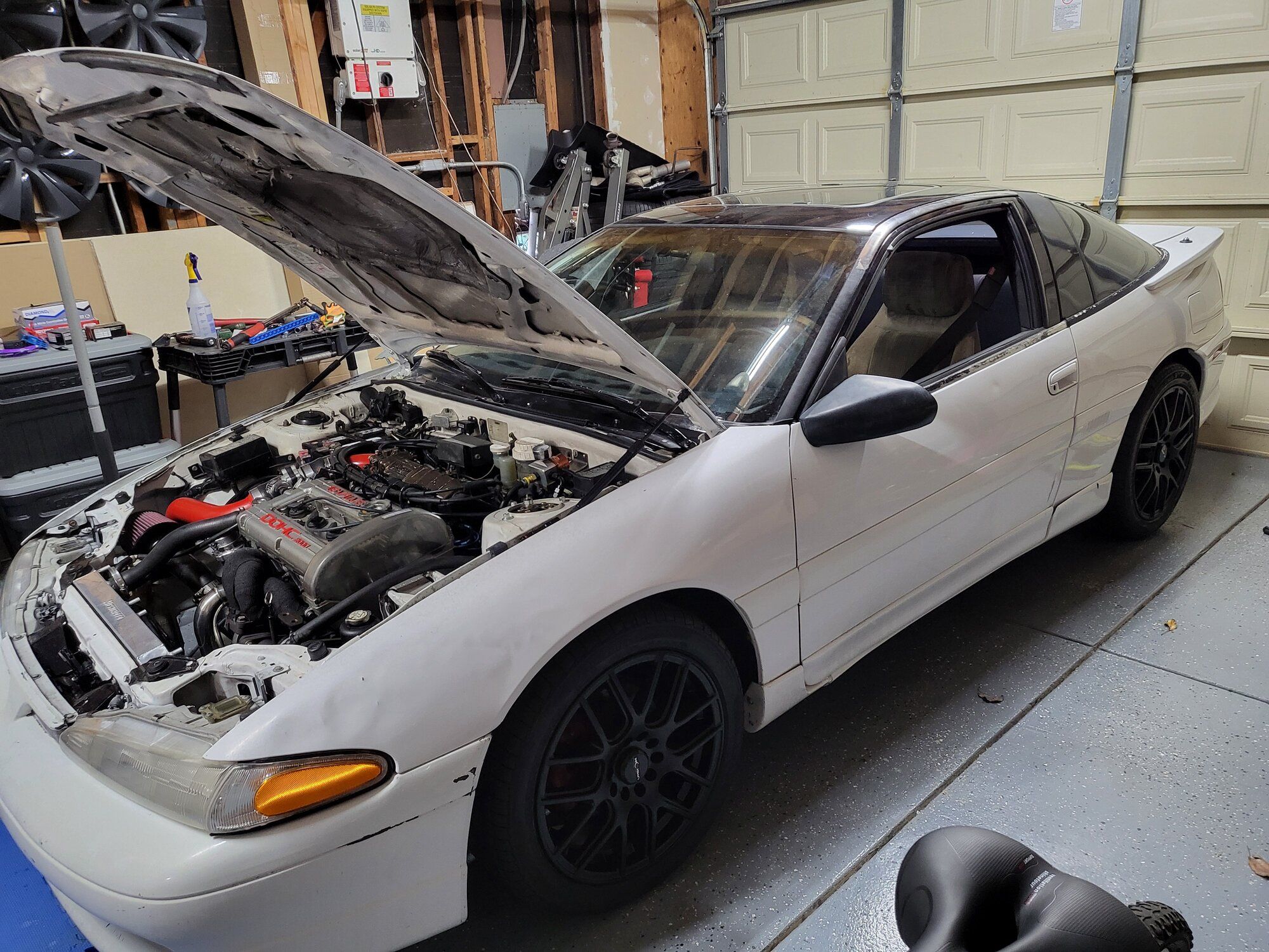

1993 Eclipse GSX

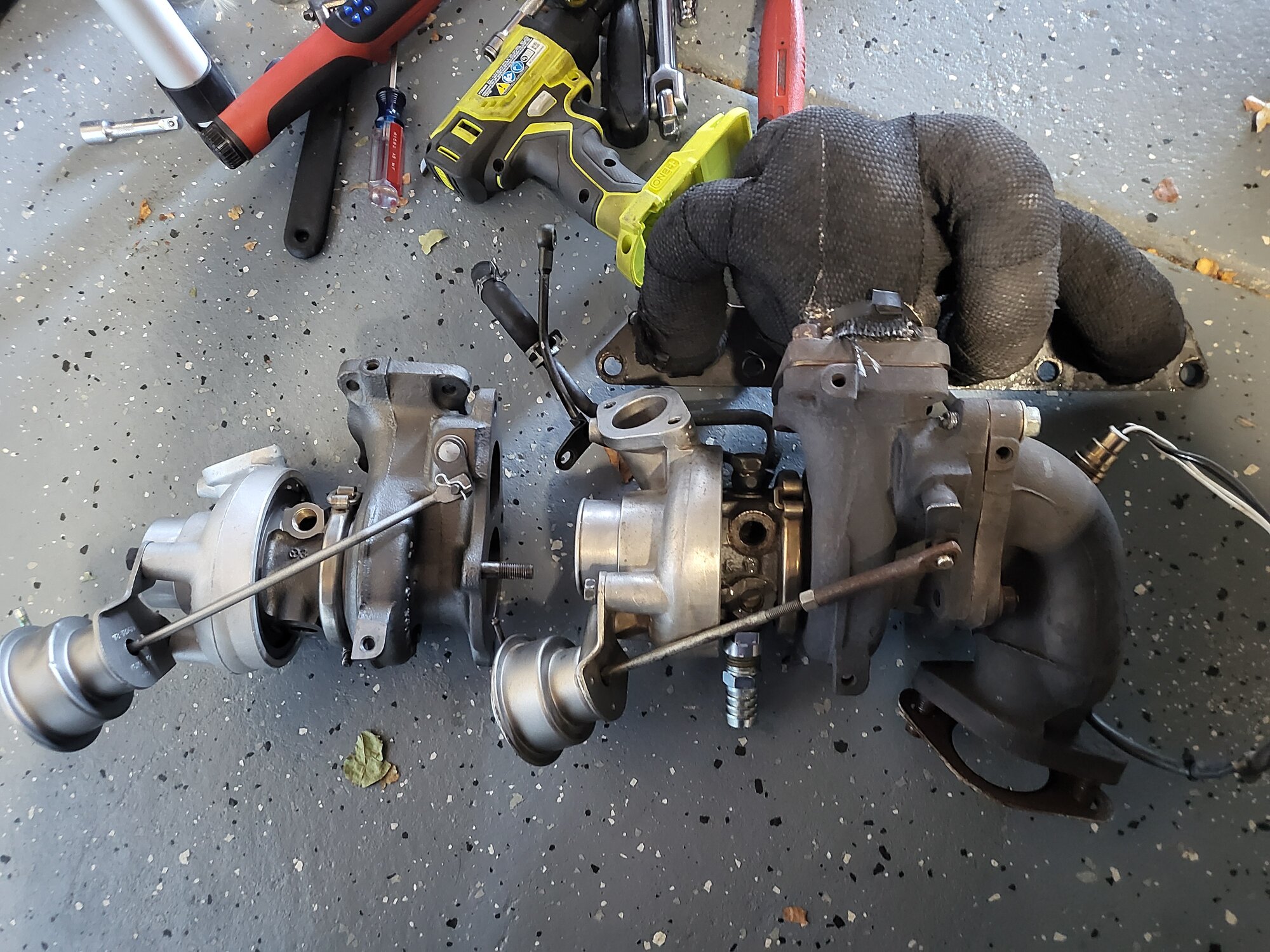

Bummer. Go for the E3 (big) 16G with the 7cm turbine housing. @JusMX141 with the turbo hookup! It's a really nice street turbo that makes good torque and still spools up decent.
This is the turbo I have been eyeballing. Seems to be a common bolt in upgrade. Nothing crazy but a better stock style.
Funny enough I googled "16G with the 7cm turbine housing" to do some research and he was in the first post I clicked on with some very helpful information about part numbers and housing sizes.
16g would be your best bet, however blown Chinese 16g knockoffs are a dime a dozen, could always rob the more open 7cm housing and adjustable gate actuator off one cheap for your 14b if desired. I think it’s been years since I’ve seen a 6cm turbine housing from a 14b that isn’t cracked.
I thought about doing something like that but I dont think I want to mess with the Chinses ones. I know some last but I also know some dont. Would rather pay a bit more for something proper that will last.

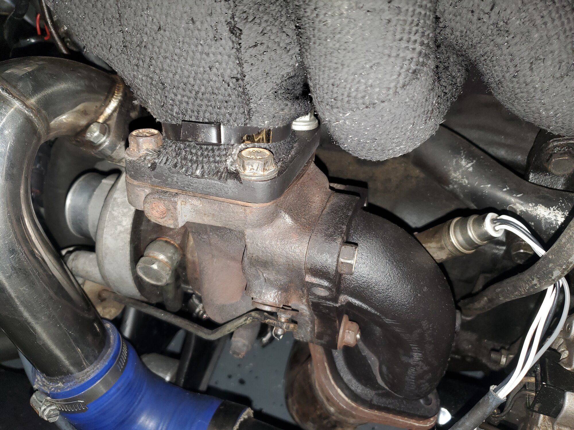

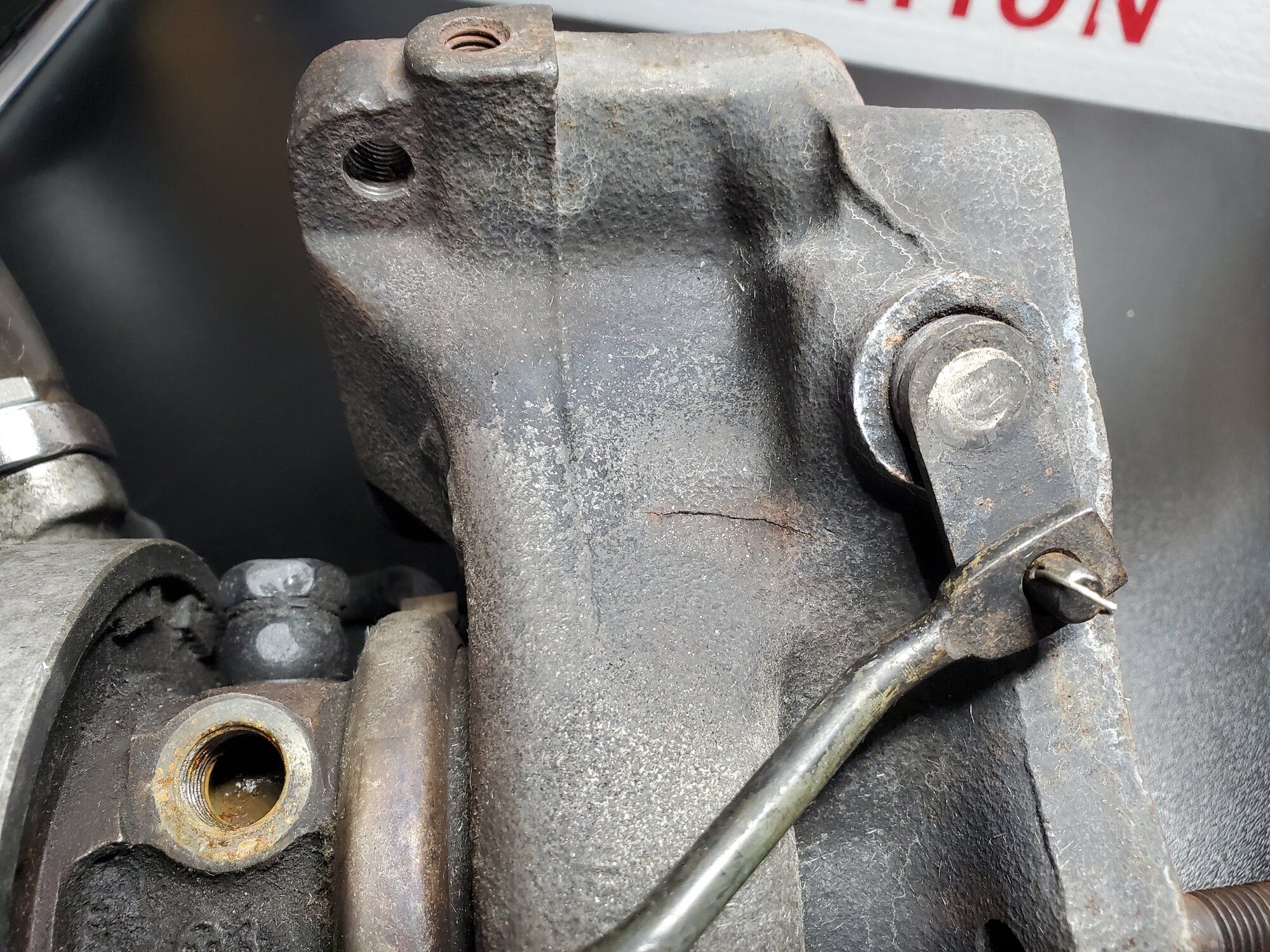

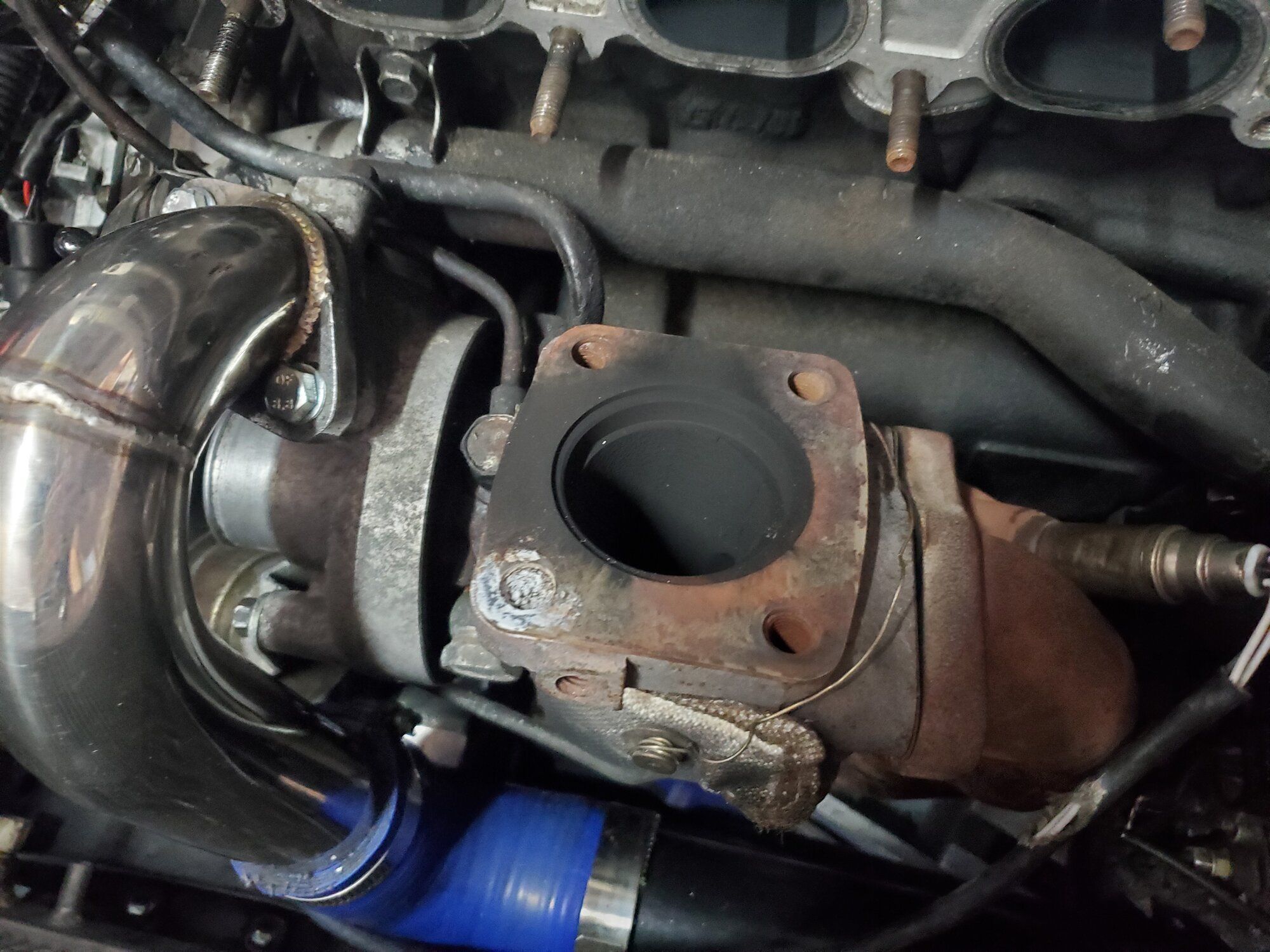

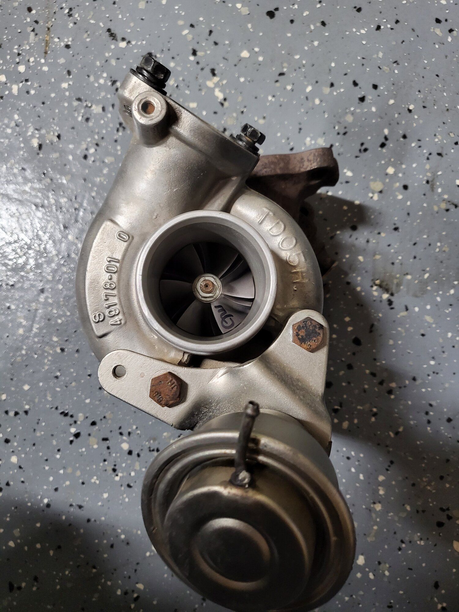

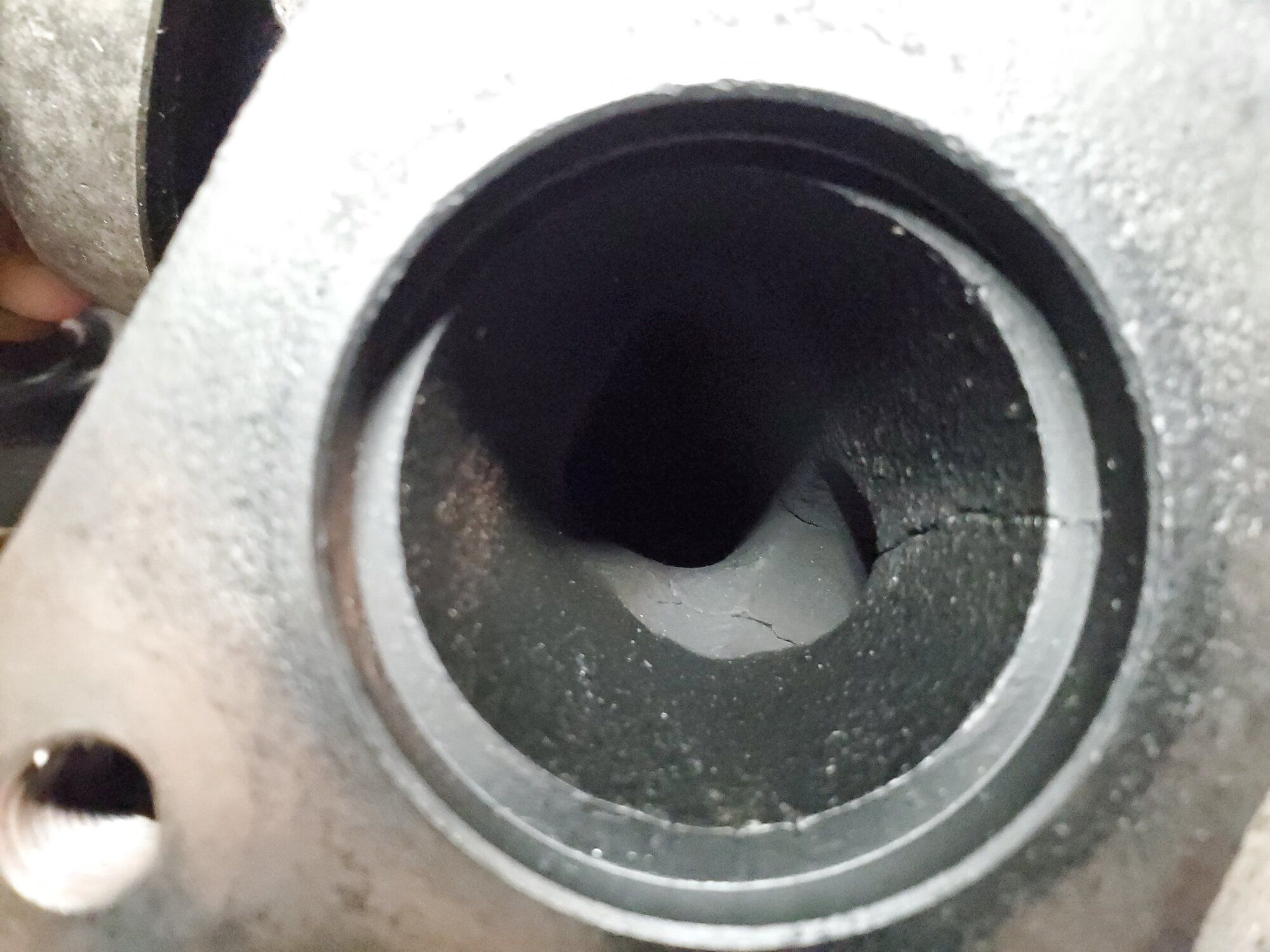

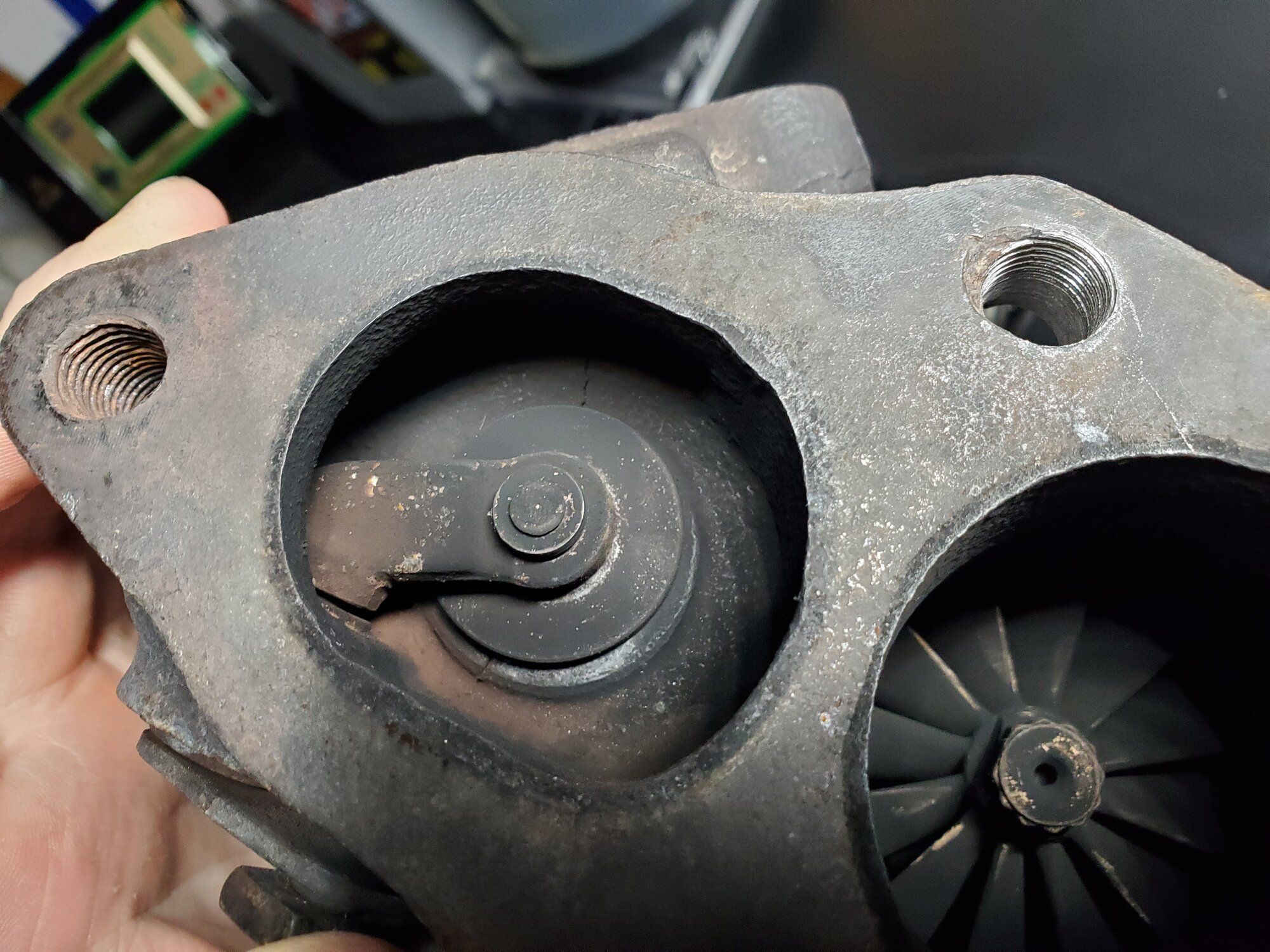

The crack isnt my only concern. The wastegate actuator is also not centered at all. This is not something I have personally seen before.
If your concern is the gate offset hit the shaft with a hammer and knock the bushing back into place. The lever arm should be flush to the casting.
That is one of the concerns. I didnt know it could be hit back into place. Tried this and it worked great. Sadly while I was there I found more cracks. Not just around the wastegate. I think im going to have to replace the turbo either way.
The limiting factor is your injectors. They're a tad on the small side for pushing anything more than a e316g while maintaining sub 80 idc, so anything larger turbo wise would require bigger squirts.
It's anecdotal but I was pushing damn near 80% with 10.5-.8 at 23psi on a evo1 16g, 91oct and fic 750s.
The e316g is sorta what I was thinking when I got the injectors. They were also a very good price. I actually was going to run the current turbo for a while until I felt that I needed more power but didnt want to go something too crazy. Still want the car to be reliable.
Some bonus pictures for fun...
This crack goes all the way through.
Here are 3 cracks near the wastegate.
Here is the wastegate flap thingy after I beat it back into place. There are cracks on either side.

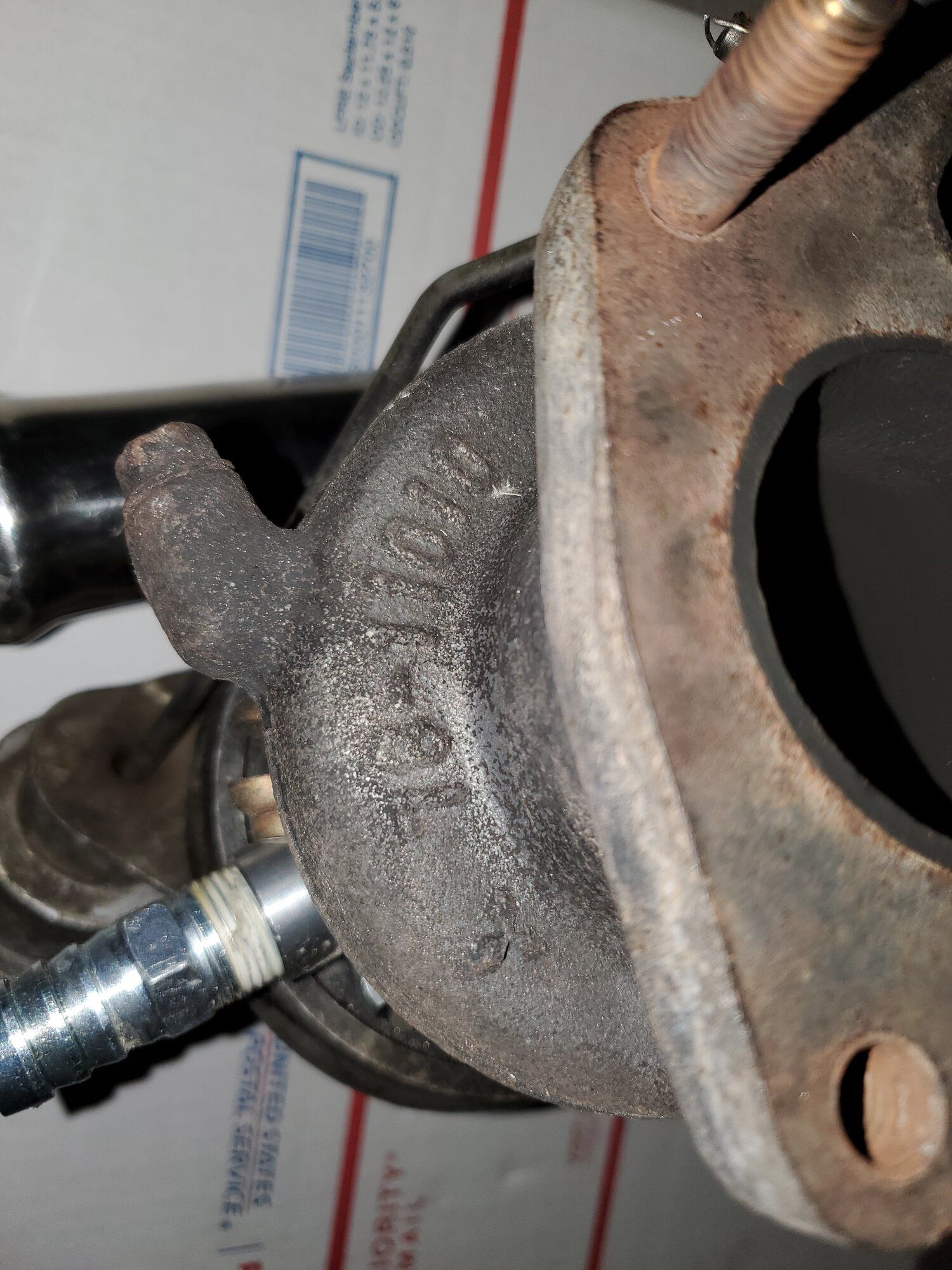

WTF is 11010?? I cant find much info on this number.

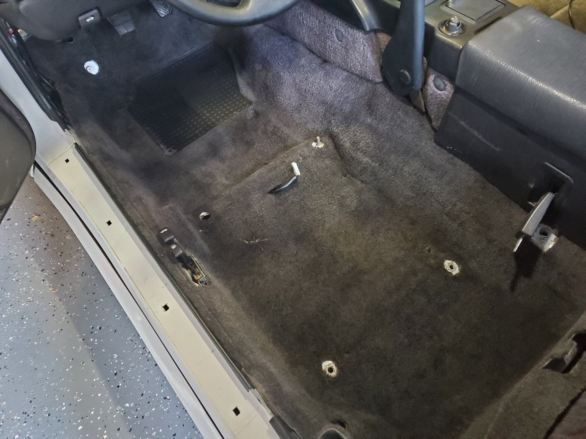

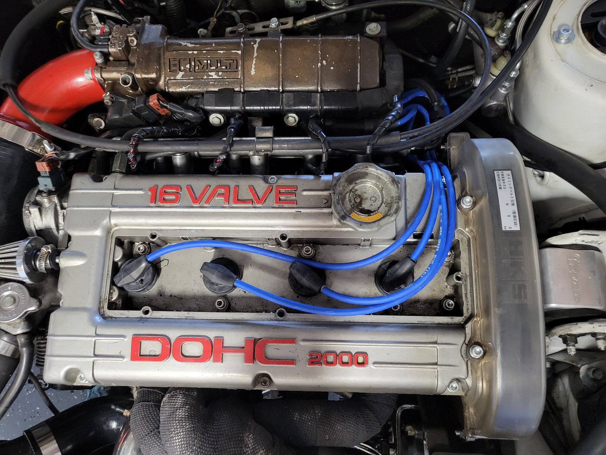

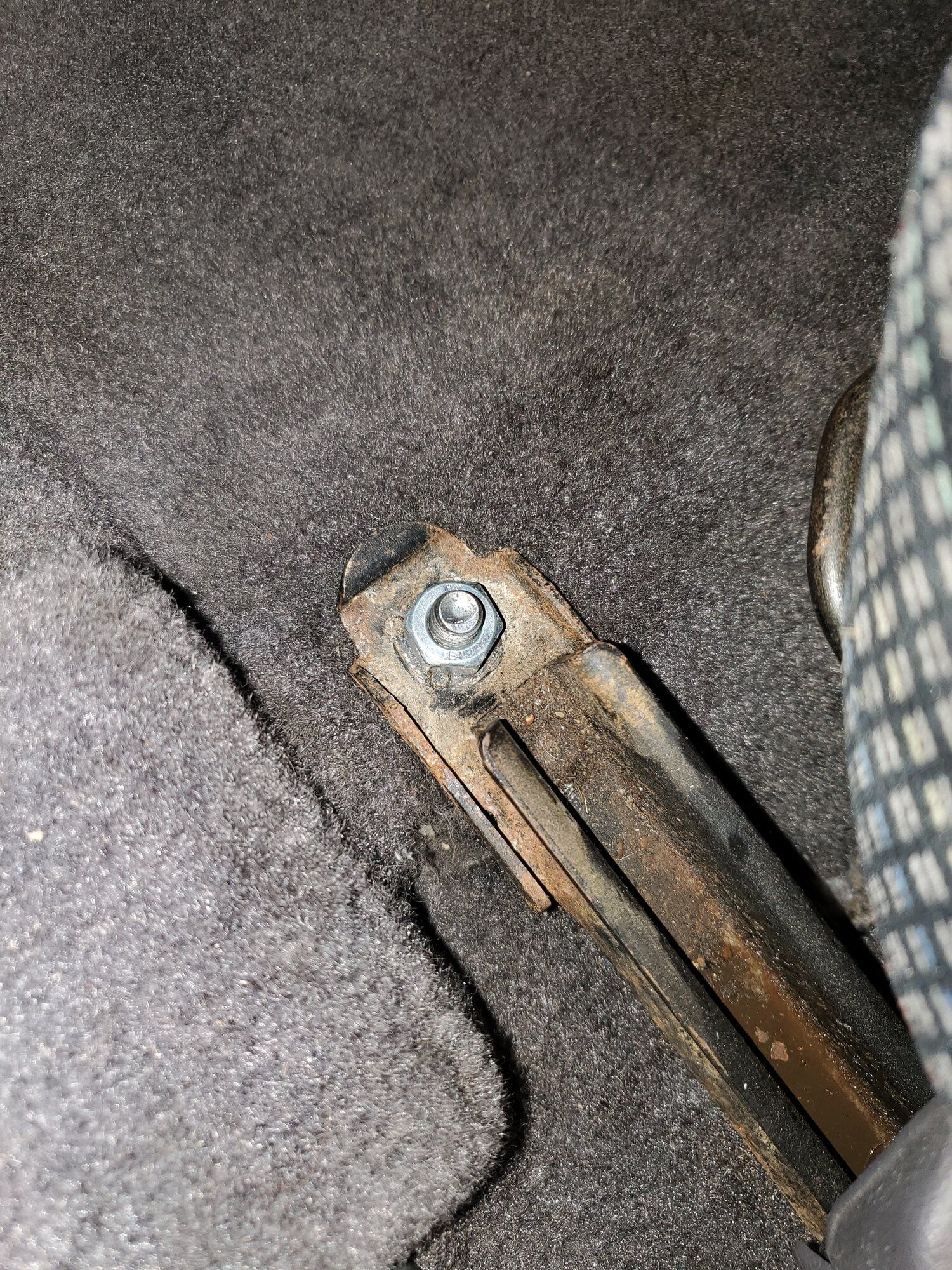

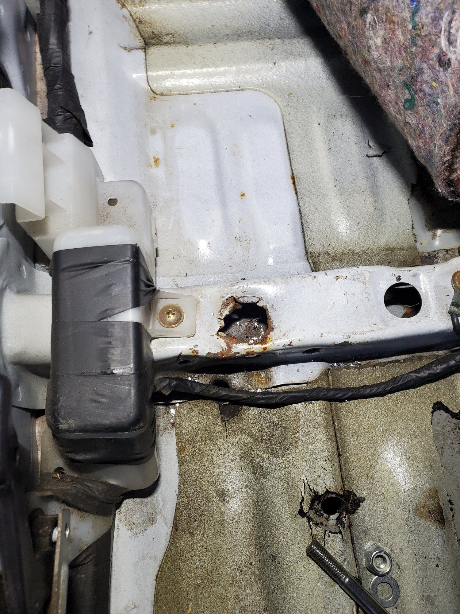

I finally got around to fixing the pulled out driver side seat stud. It looks like it was pulled out of the body at some point. Also shampooed the carpet and seat while I was there. Cant really tell because of the age but it does look way better than before.
Removed the turbo in exhaust manifold to address some leaks and some loose/missing/broken hardware. Also do a general clean up and inspection. Found my turbo will need to be replaced (See a few posts above). For the time being I cleaned everything up and reassembled it so I could still start and move the car around.
While I was here I sourced some hardware and cleaned up mating surfaces. No more leaks so far. You can see where the exhaust was leaking in the below pics.
Exhaust reinstalled and after a couple runs around the block. So far so good!

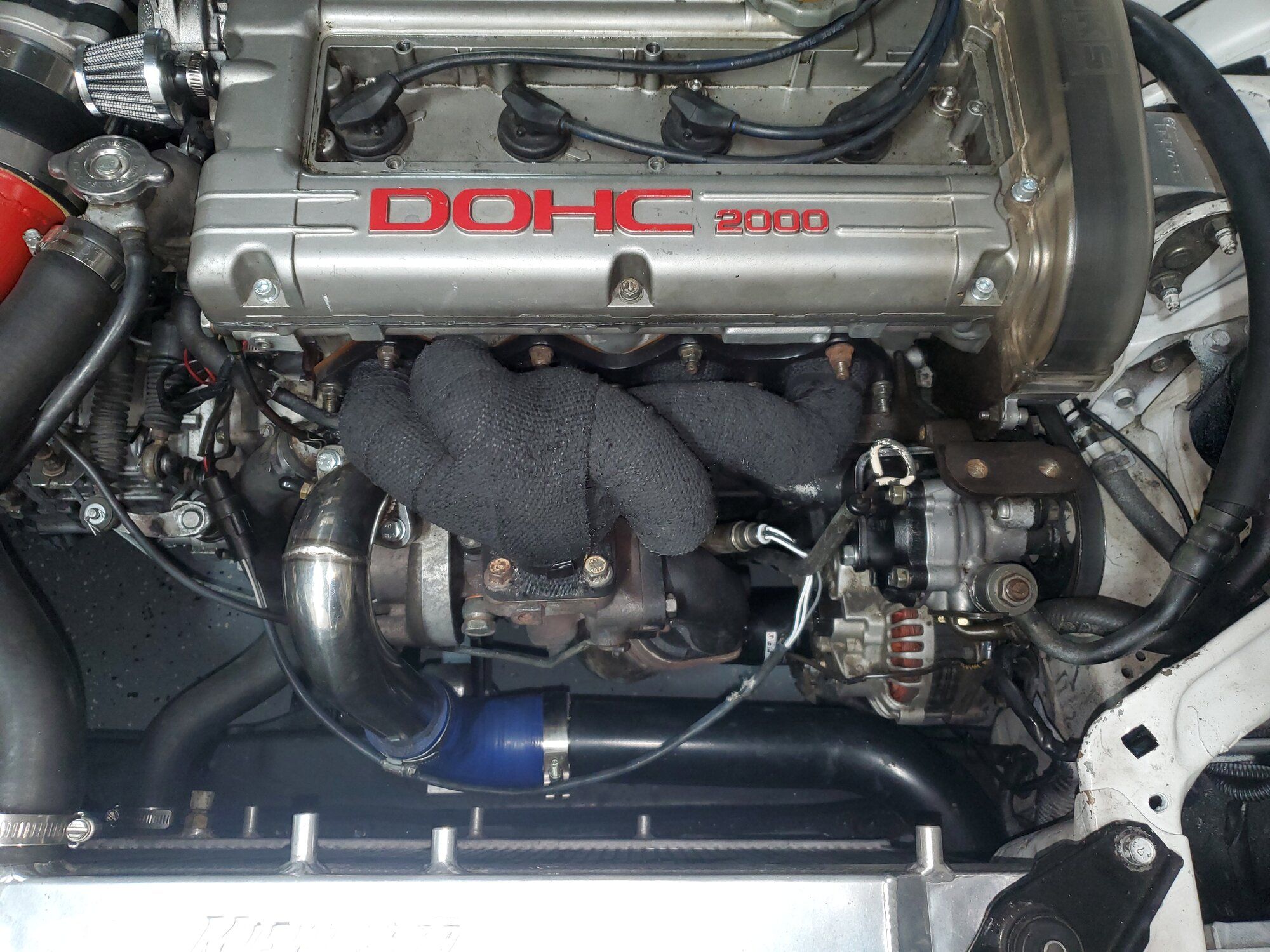

Wrapped the exhaust as I am told these cheap chinese manifolds can get quite hot and melt cooling fans.

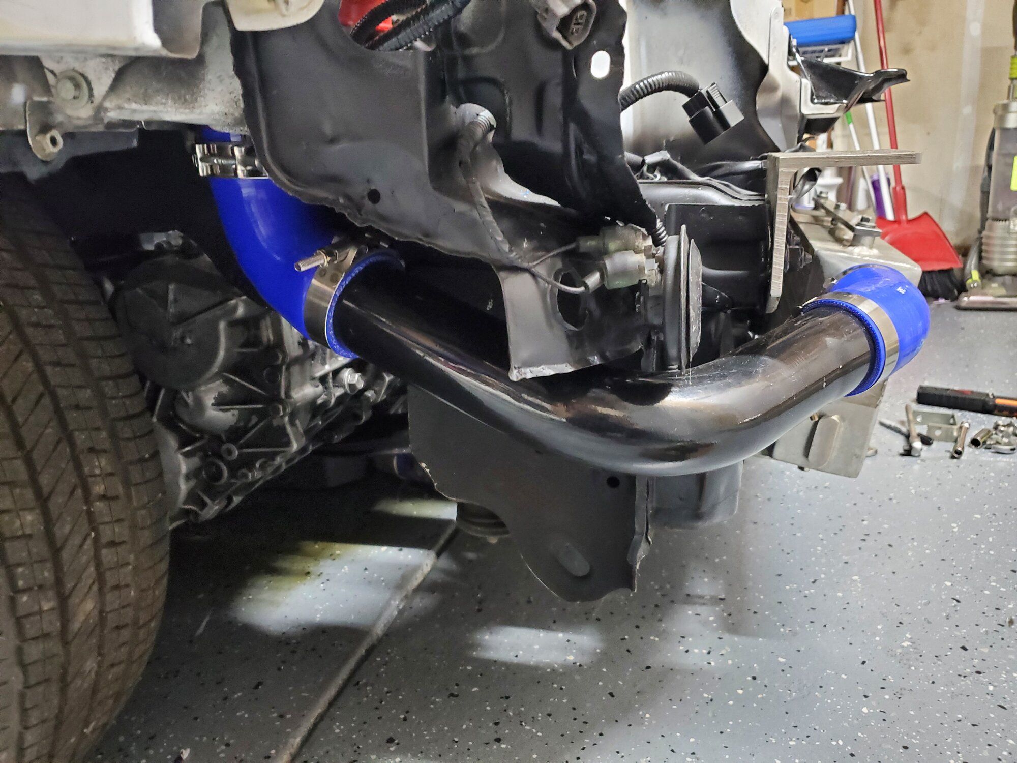

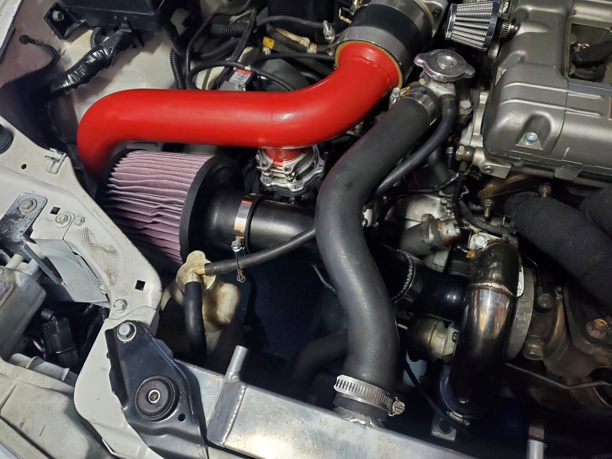

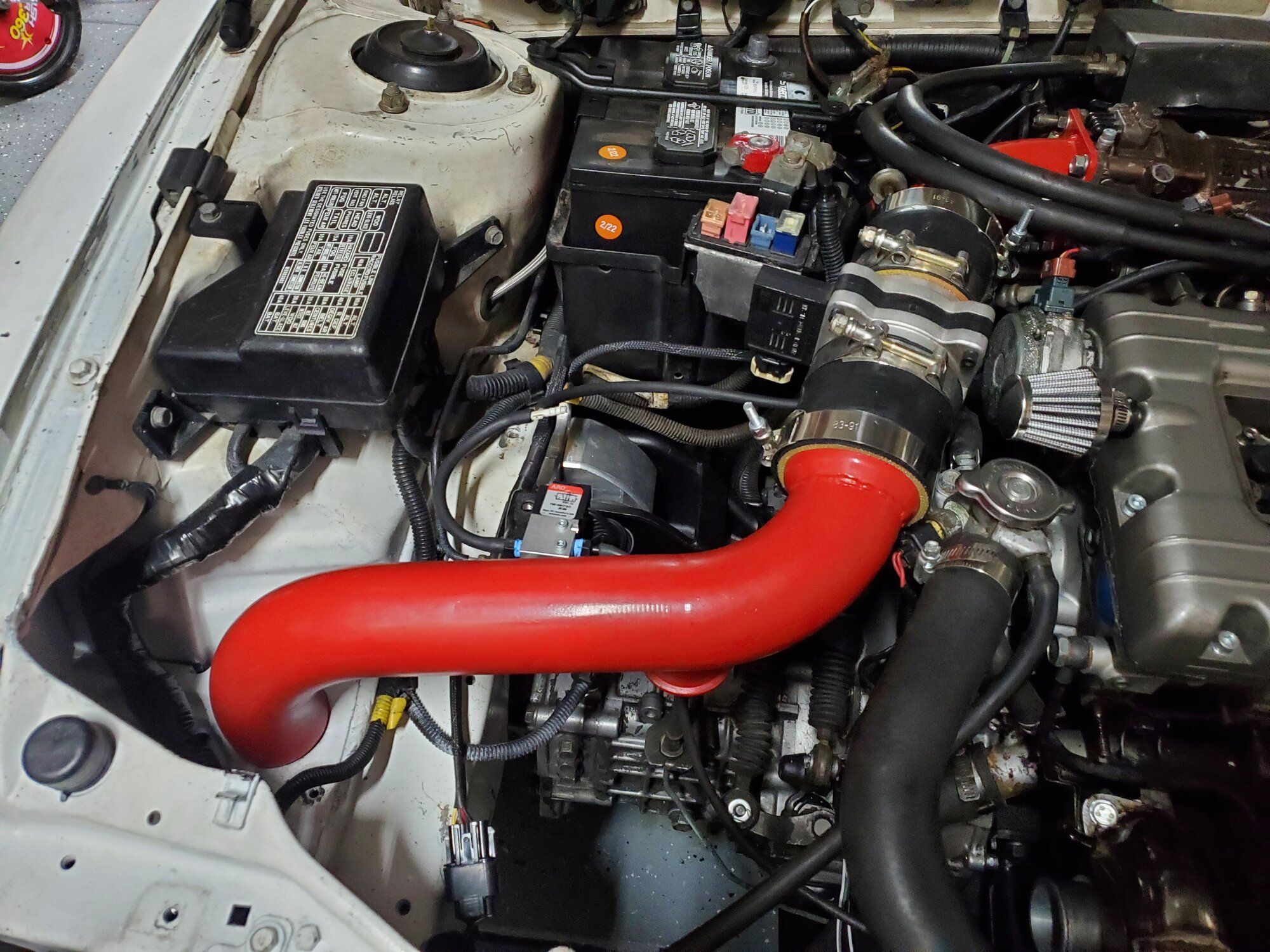

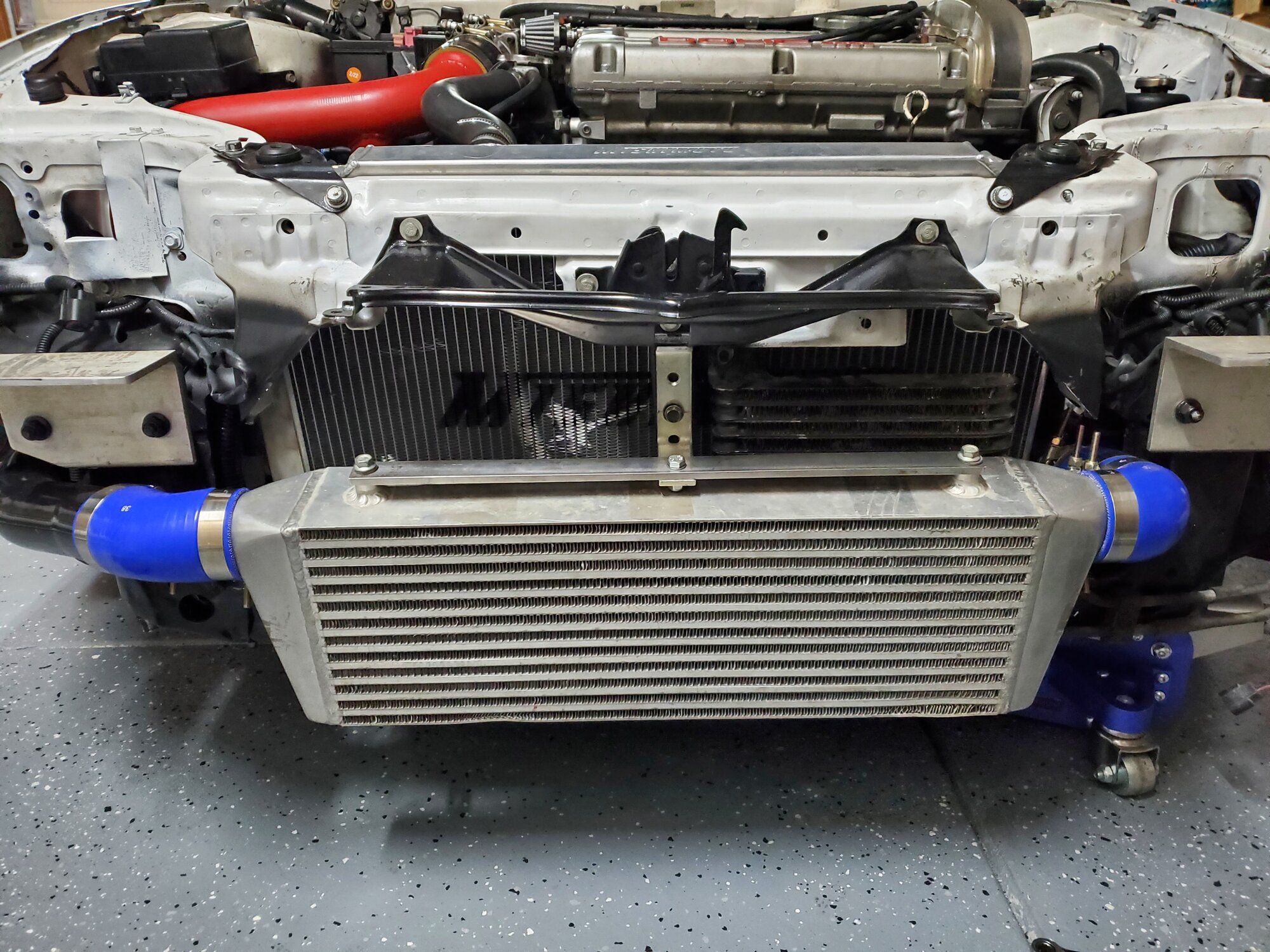

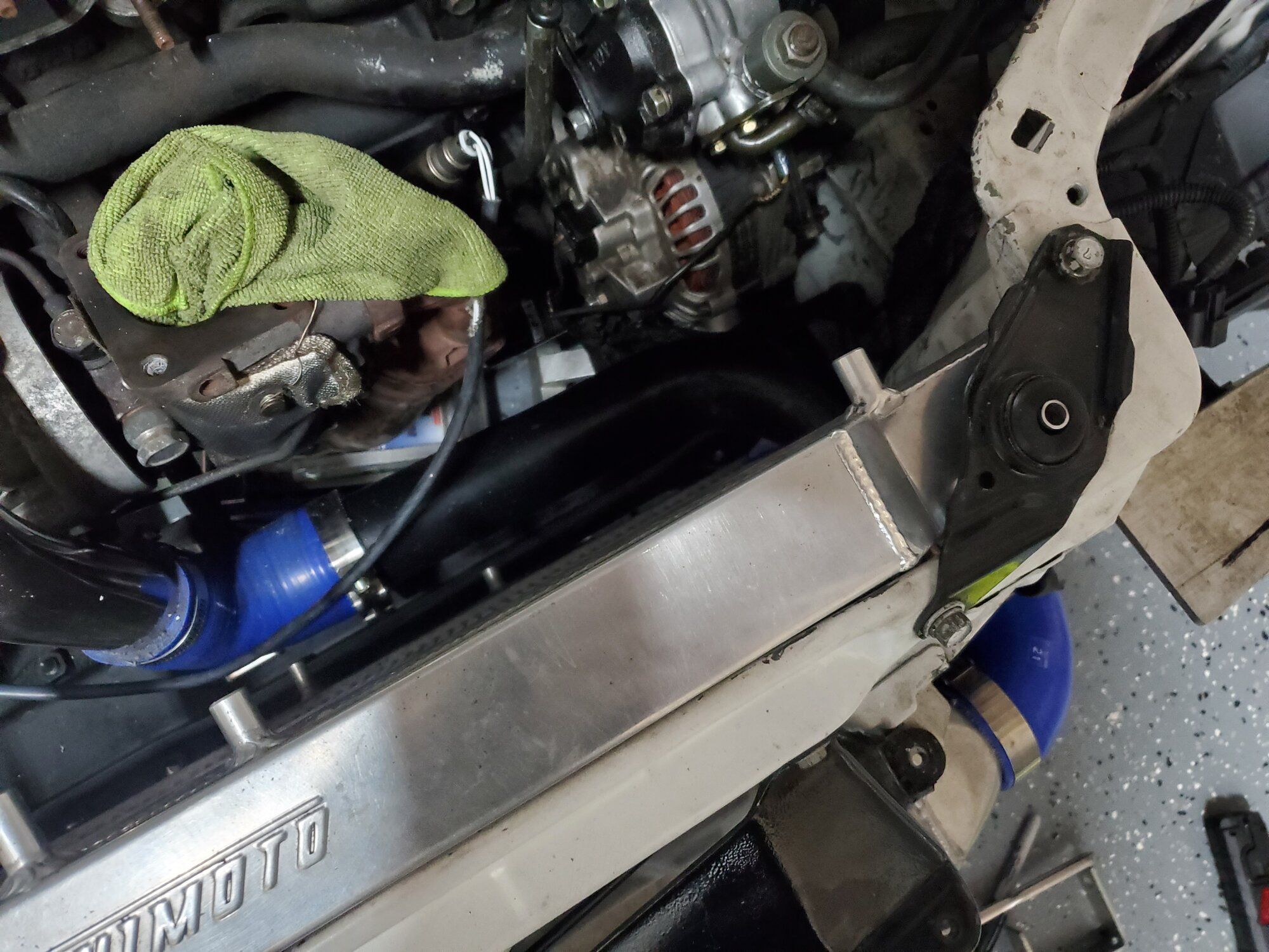

Finally finished fitting the intercooler mounting.

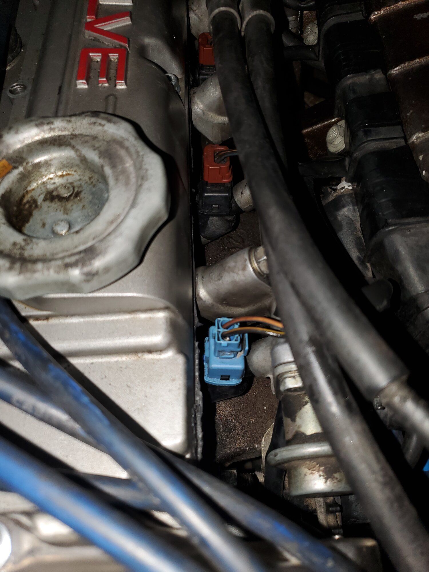

I got some 680cc injectors put in! Yay unutilized performance parts!

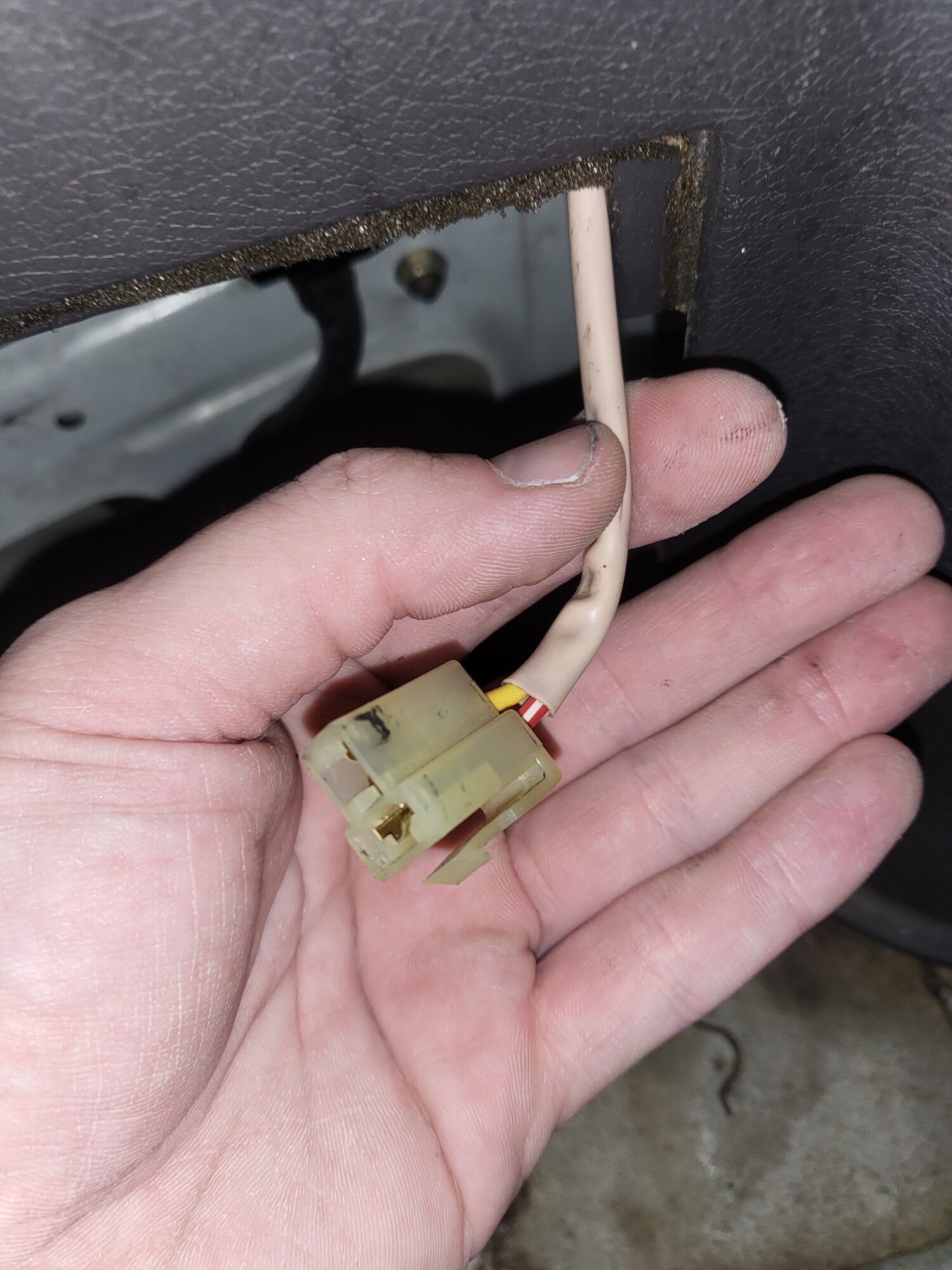

Dont mind the connectors... They are HORRIBLY brittle and exploded the minute I looked at them. I have some newer style plugs on the way that do not have those god-awful metal clips.

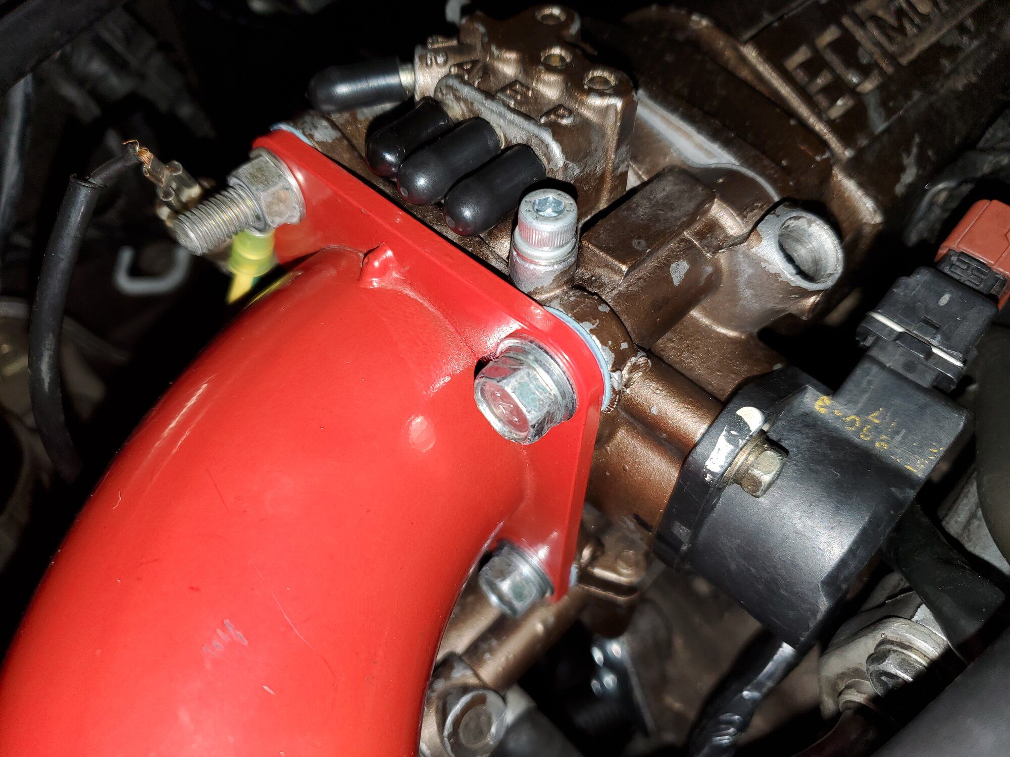

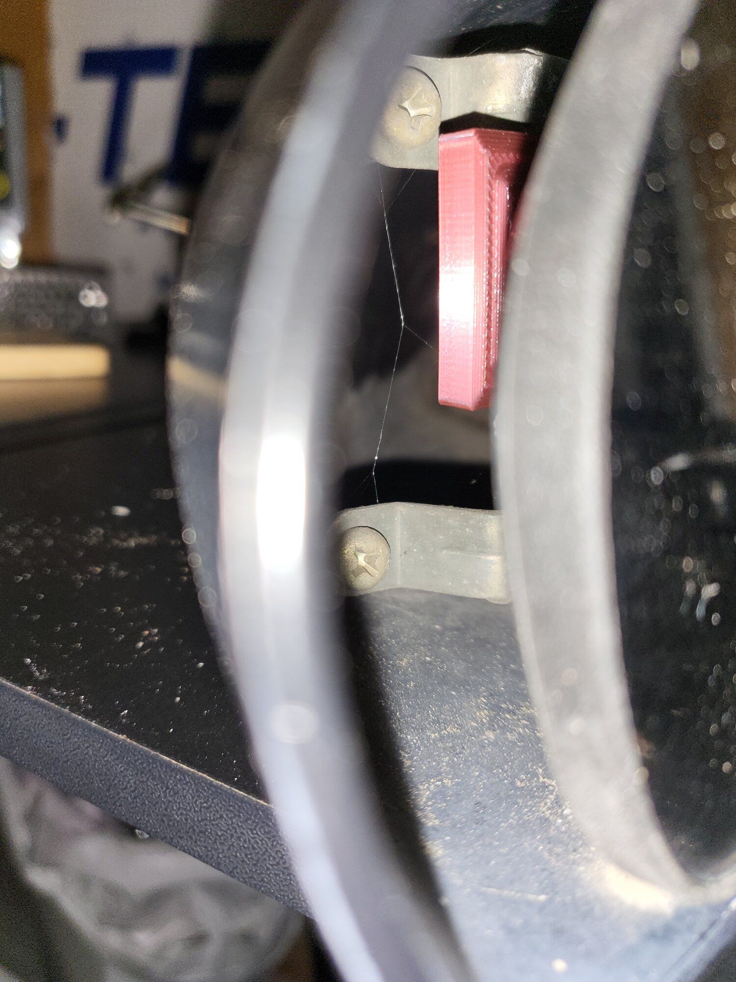

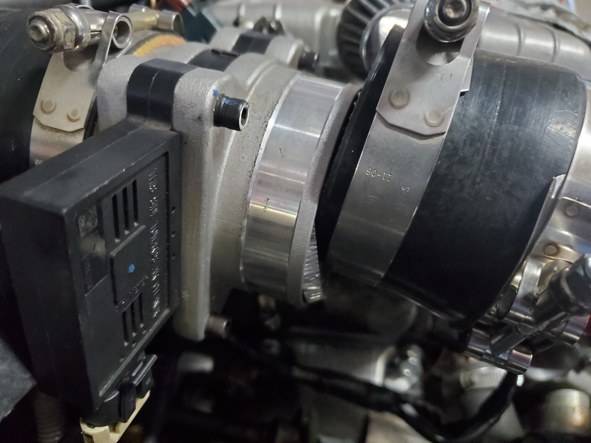

I am having a problem with the intercooler piping blowing off the MAF once I lift off the throttle after building boost. Its almost as if my blow off valve isnt opening fast enough and the built up pressure is blowing the pipe off. I did replace the spring in the BOV with a stiffer one because it was open at idle. This might have been the wrong choice, I dont know.

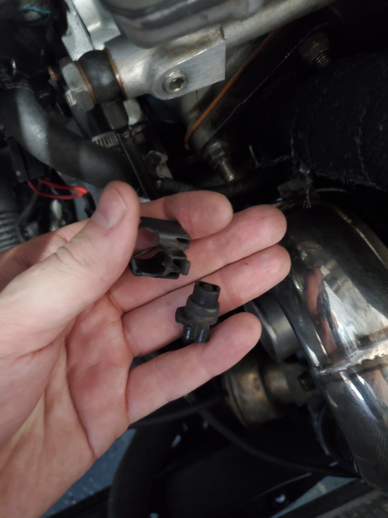

The pipe blowing off the MAF took out the AC coolant sensor connector. Luckily I do not need this and plan on removing the sensor and blocking it with a plug.

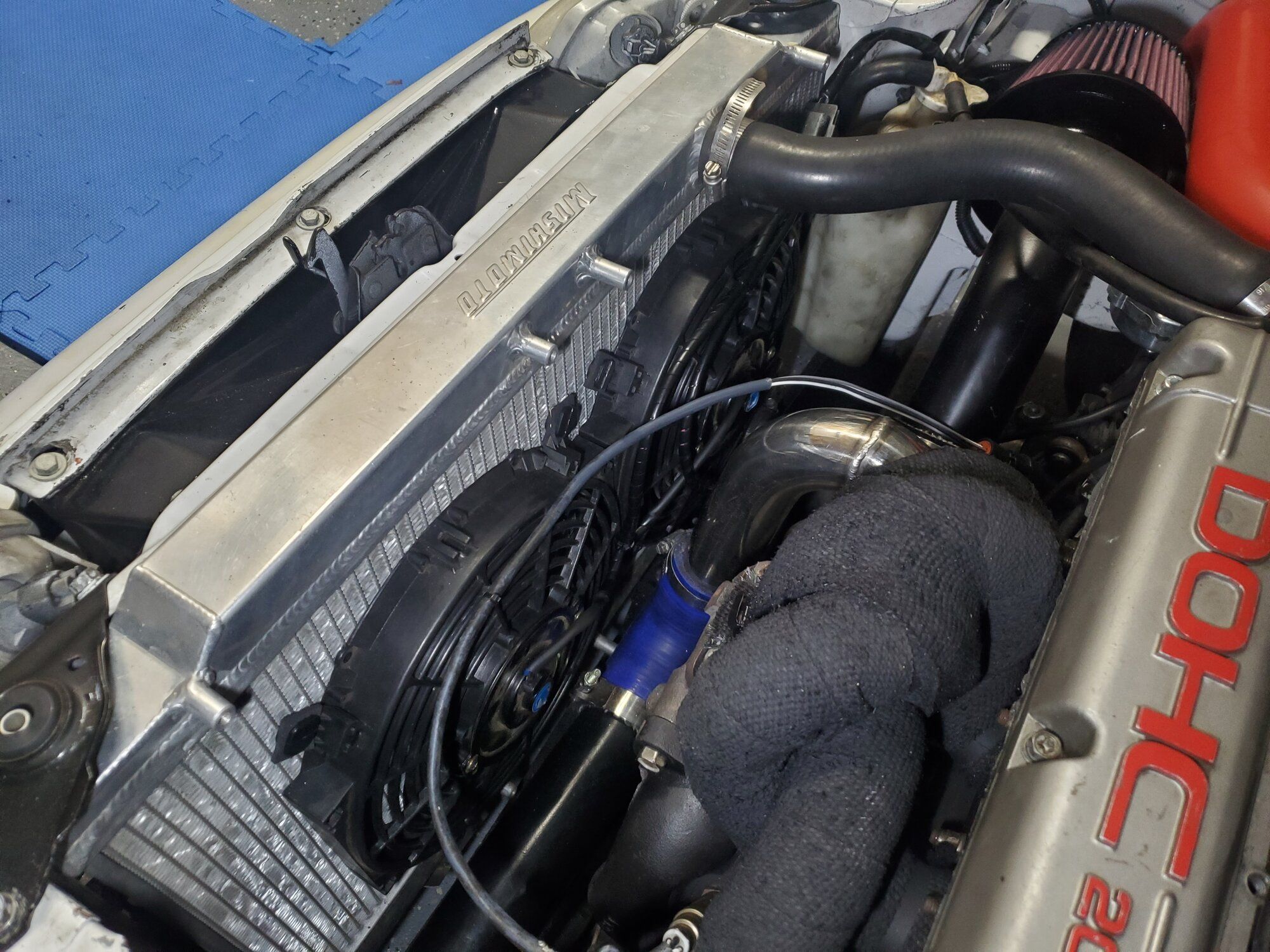

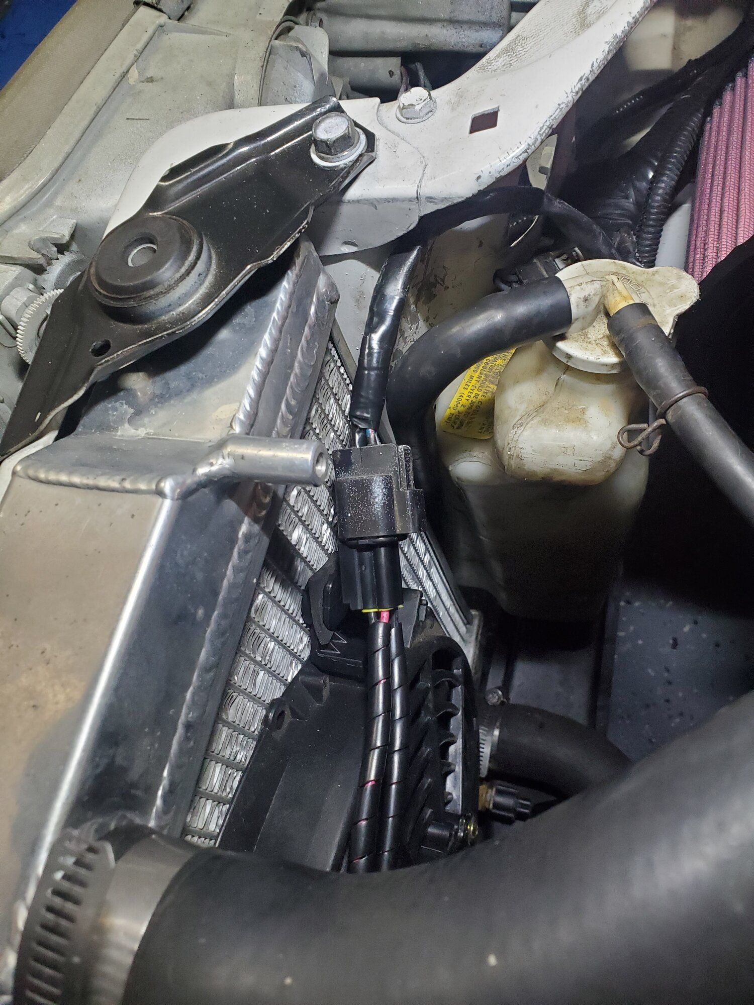

Cooling fans mounted and wired to stock harness.
Got the male fan end connector from ebay that wires to the stock body harness and a pigtail from @92AWDHX40 for the coolant temp sensor at the bottom of the radiator.
Jumped the coolant temp sensor side to make sure the fans kick on and they do. Hopefully the sensor itself works.

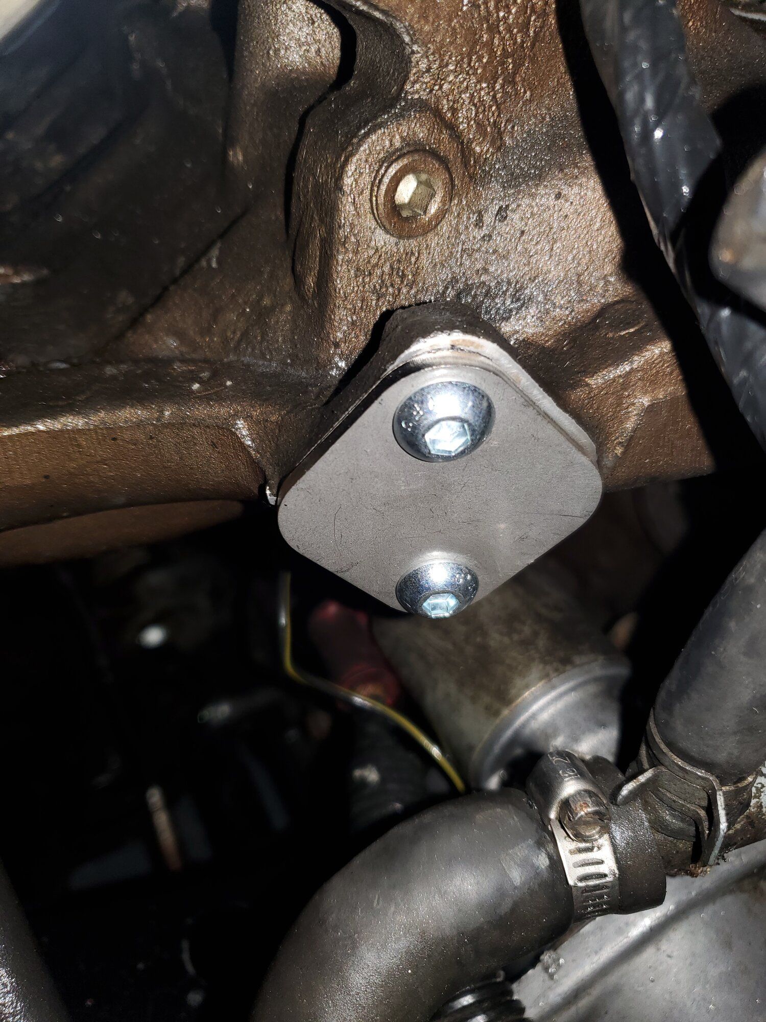

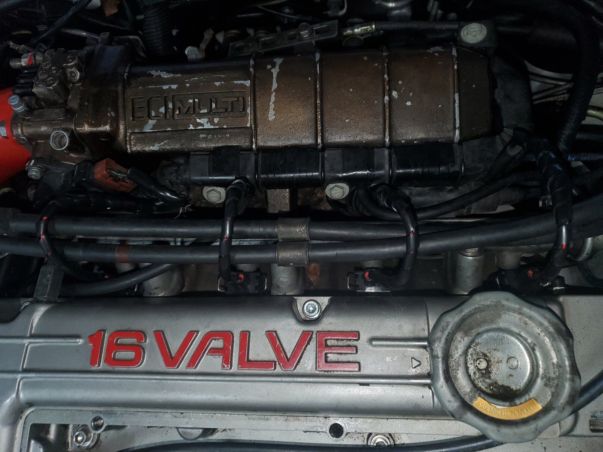

Got a legit EGR delete plate from RTM installed.
Also ordered both sides of the TB gaskets and the butterfly shaft seals from RTM while I was at it. Replaced the o-ring on the BISS screw as well. Now boost leak free!
Found I need to replace the coolant lines that go to the bottom of the throttle body.

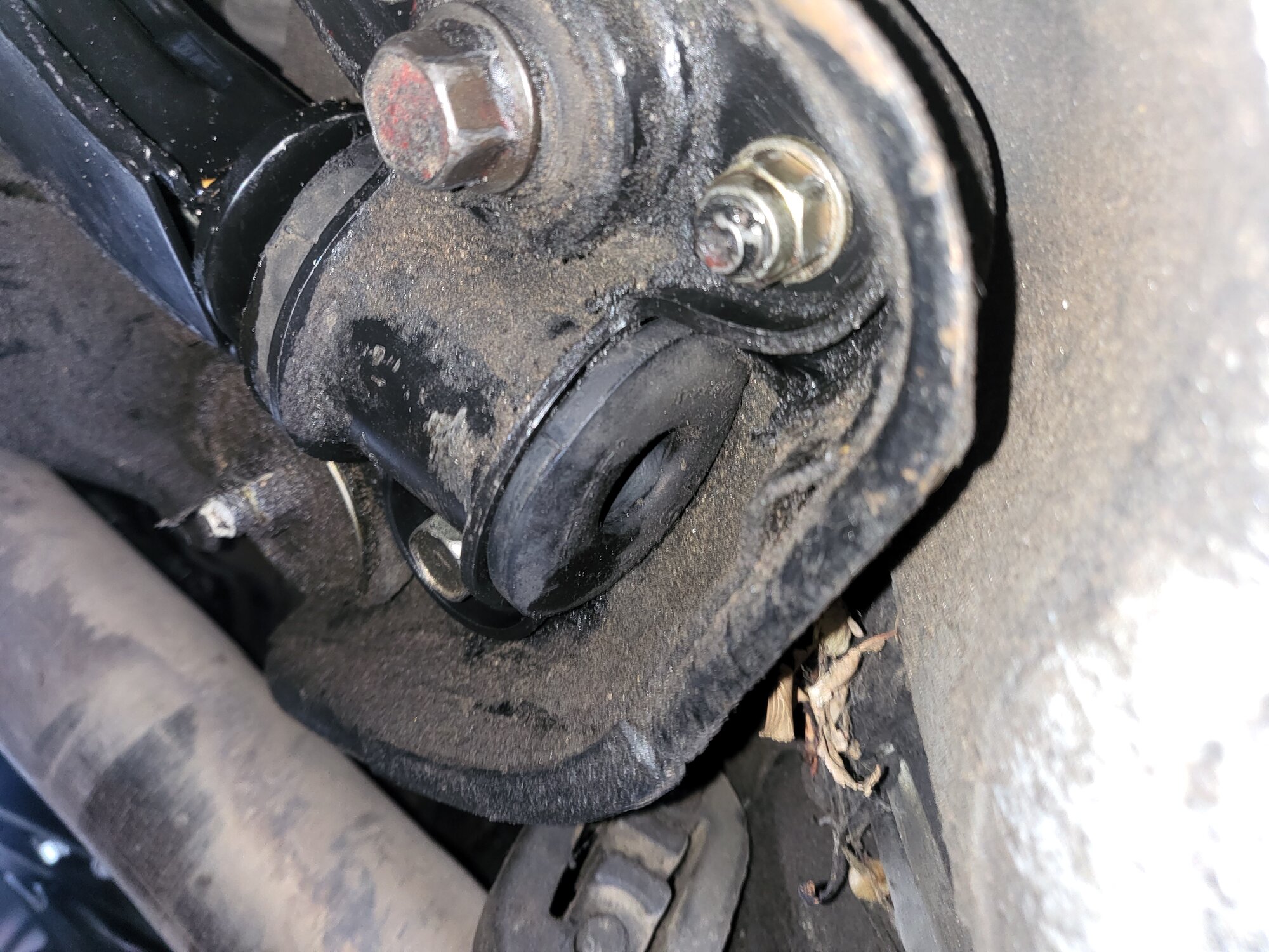

I went to adjust my clutch pedal because I am getting a very light grind sometimes going into gear. Looks like my linkage is warn pretty bad. Where the pedal links to the master at the adjustable rod with a pin there is a lot of slop.
Looks like I can get bushing kits to repair this. I will research my options.

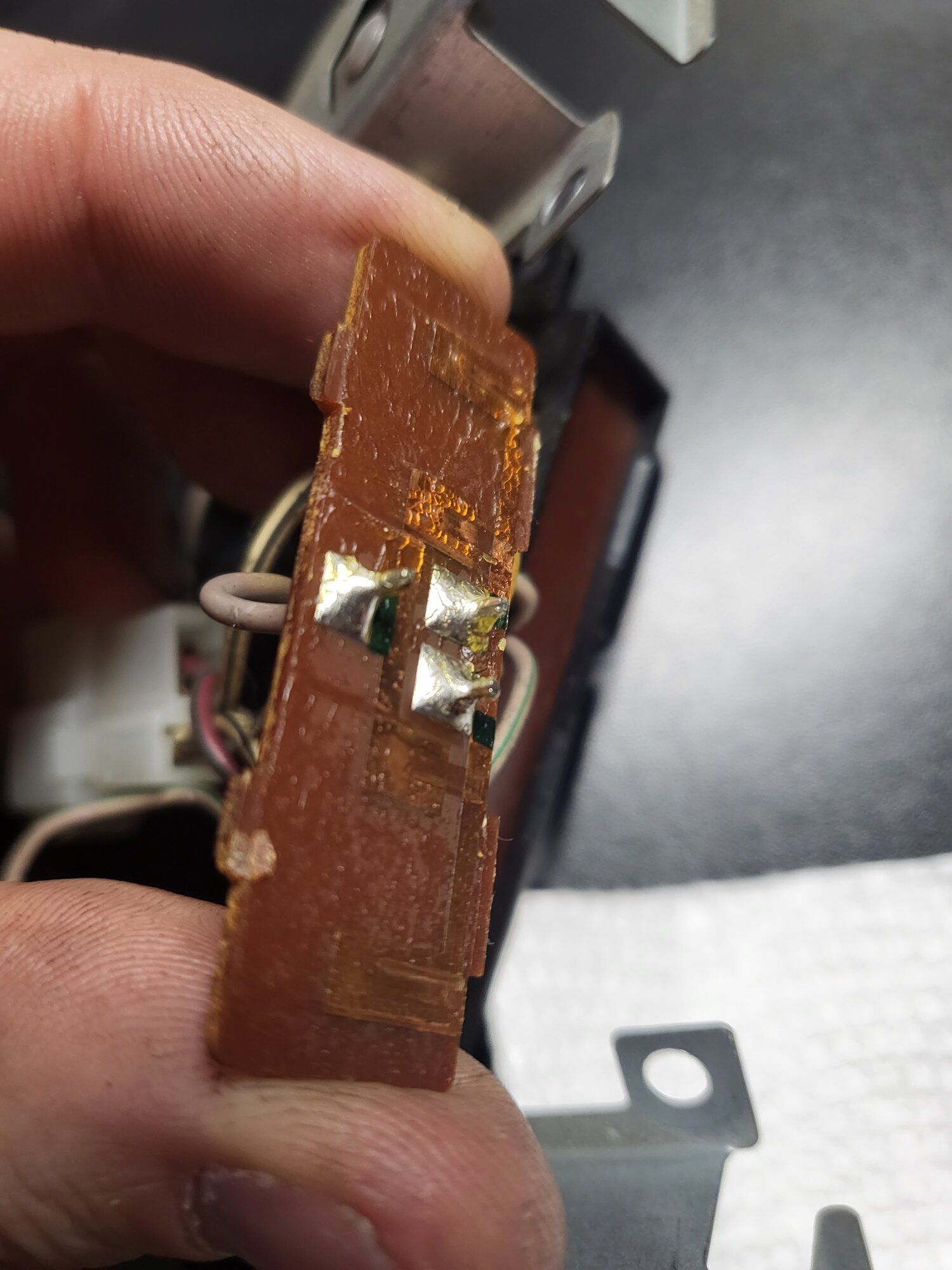

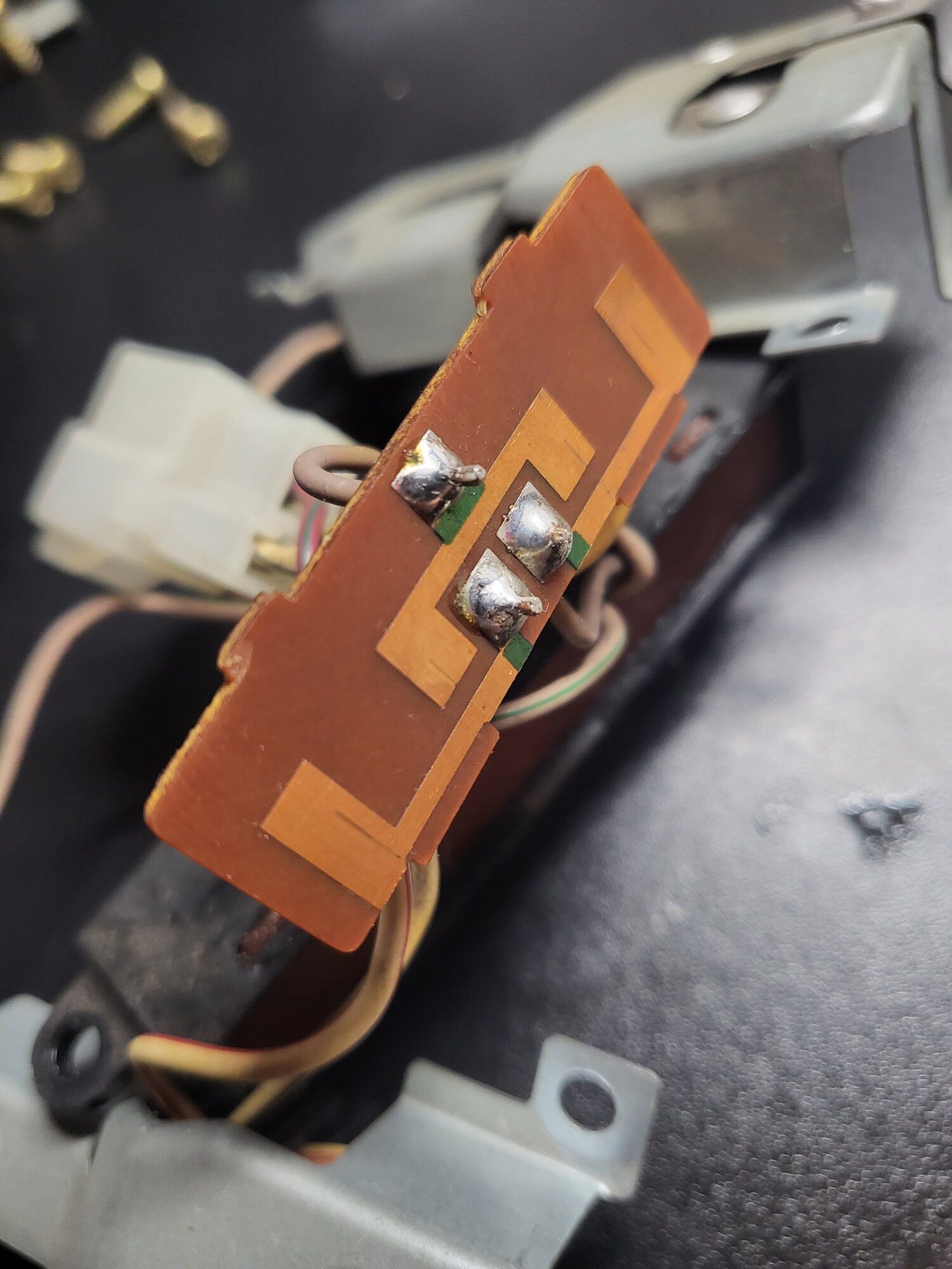

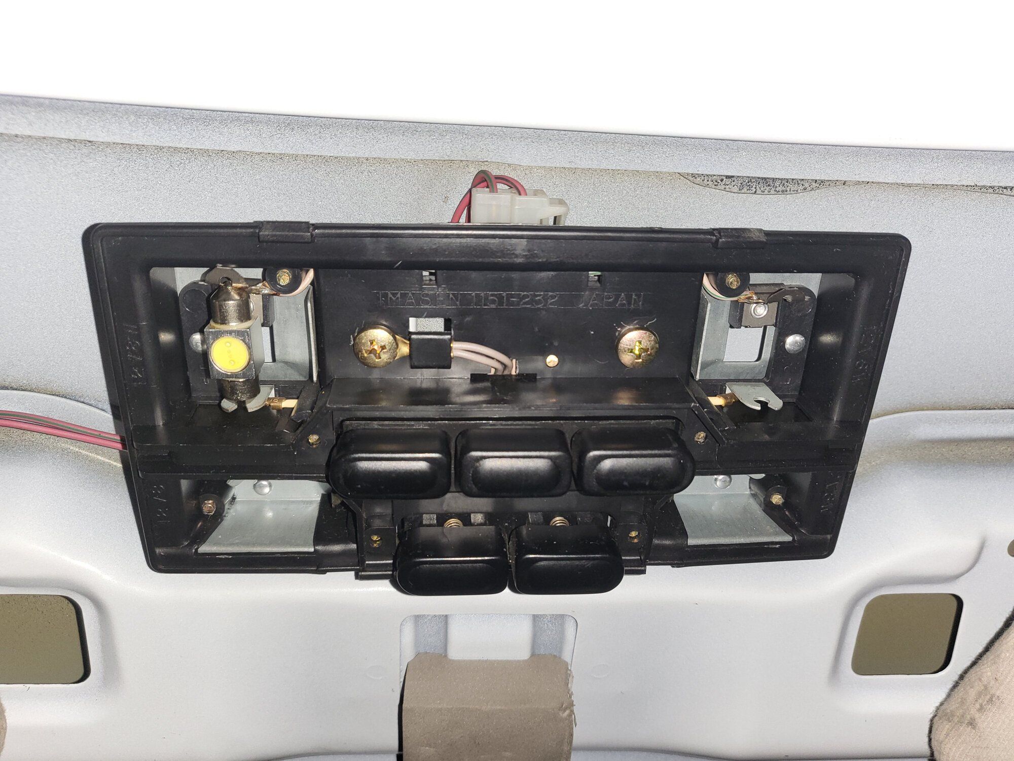

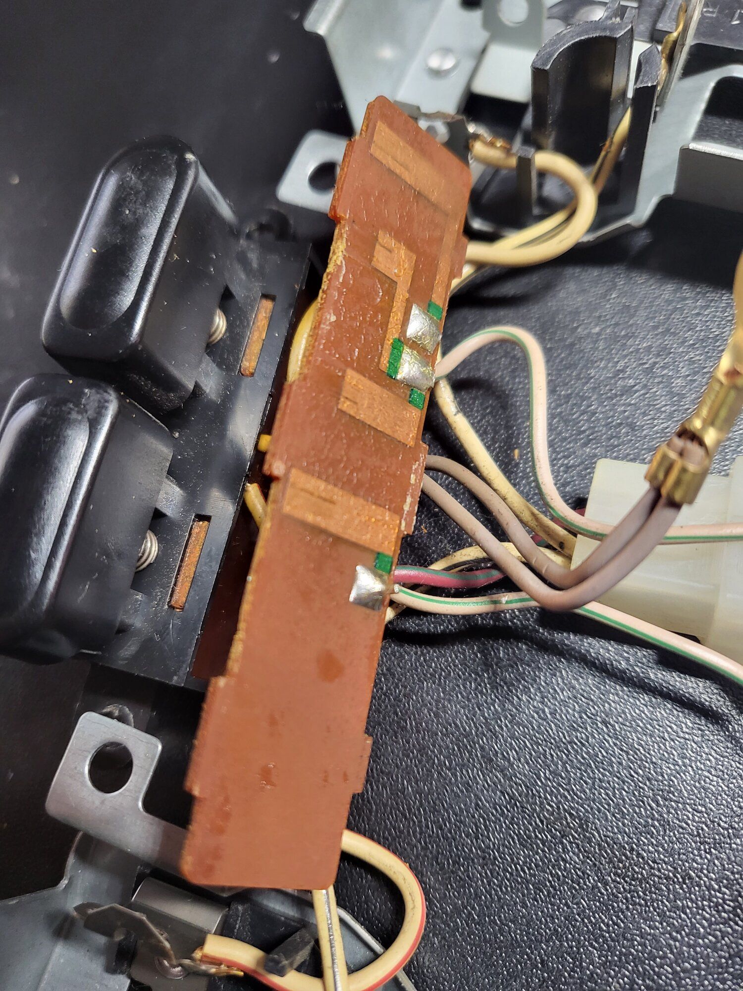

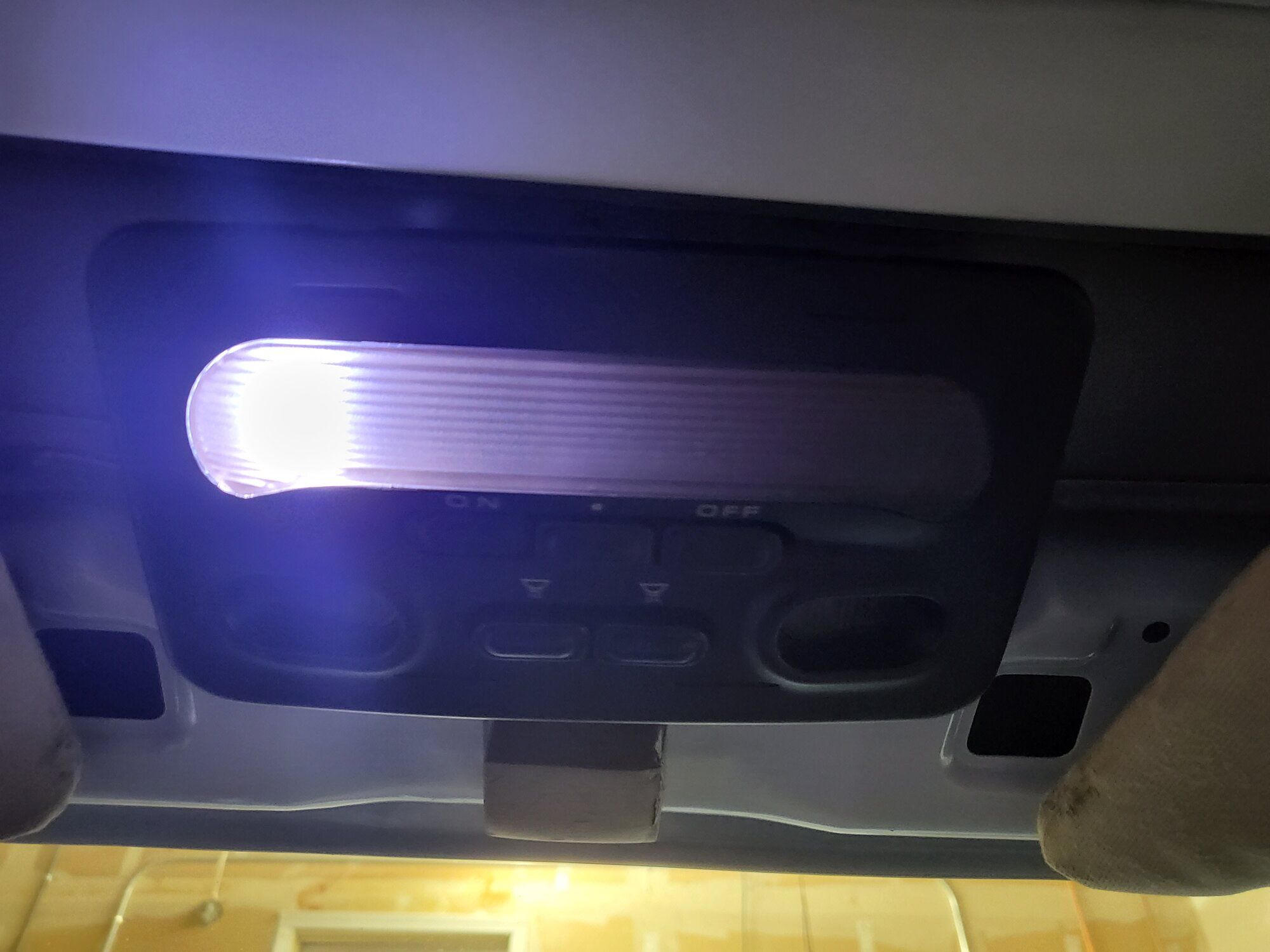

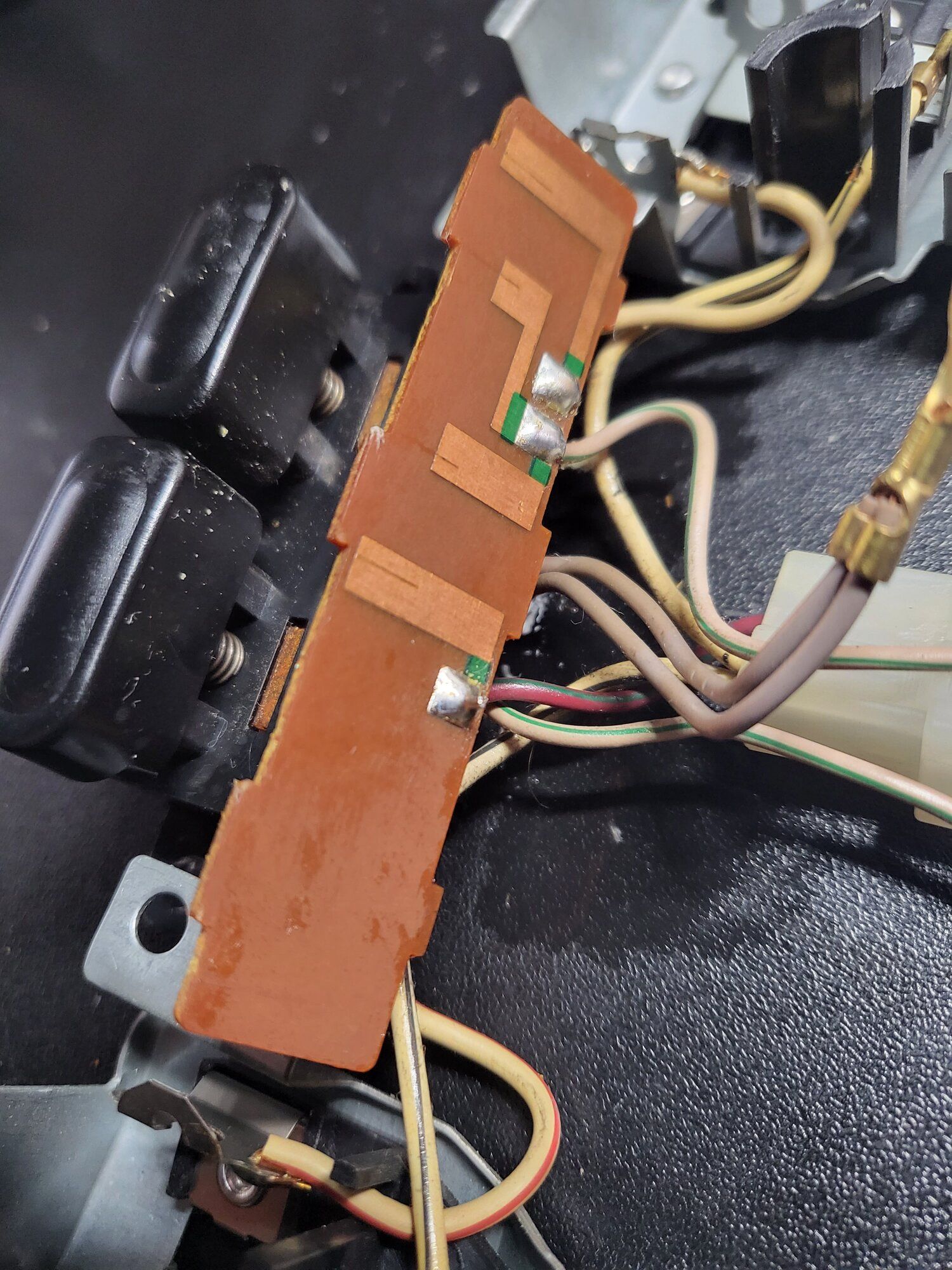

Decided to do something about my wonky dome light. Opened it up and found some cheap LED bulbs in there. One missing, two bad, and 1 still working. Quickly chucked all those in the garbage. Will order some quality replacements soon.
It seemed like the contacts for the buttons were not good. I could wiggle the buttons and the light would change brightness. Decided to take it apart to inspect.
Found what im assuming is dialectric grease from the factory. I cleaned this all off and reflowed all the solder joints while I was there. Working much better now!

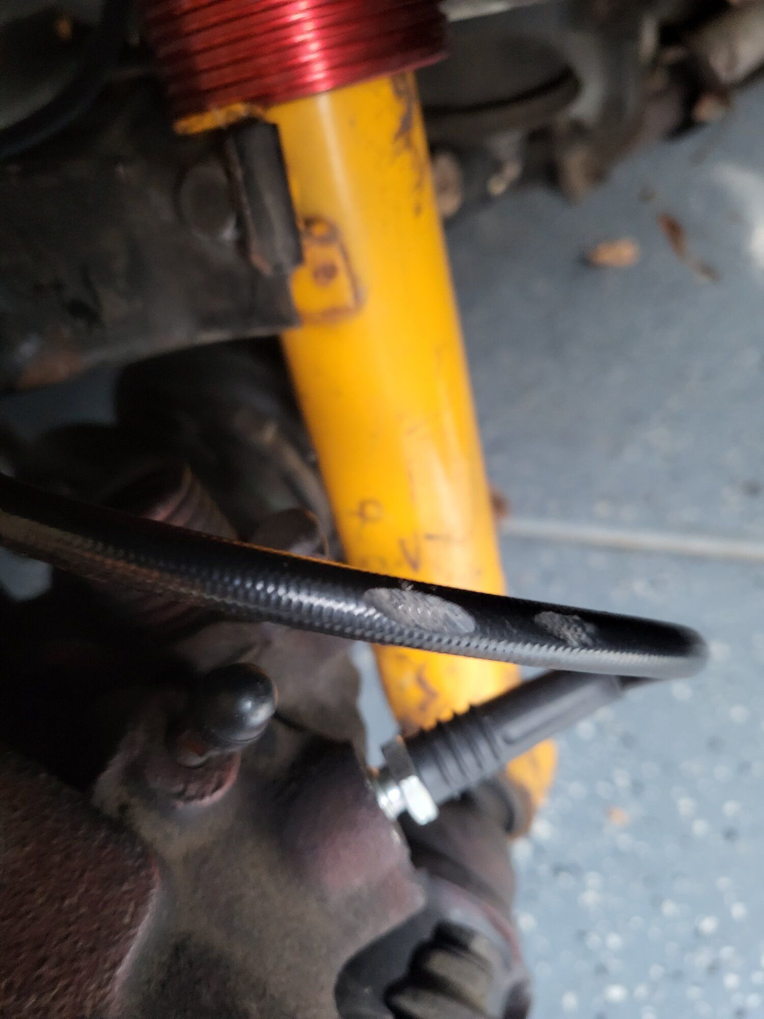

Found the source of my rear brake line rubbing problem. The line was very close to the inside of the wheel and there is a clean mark on the inside of the rim where it rubbed. I bent the bracket away a little bit to help clearance.

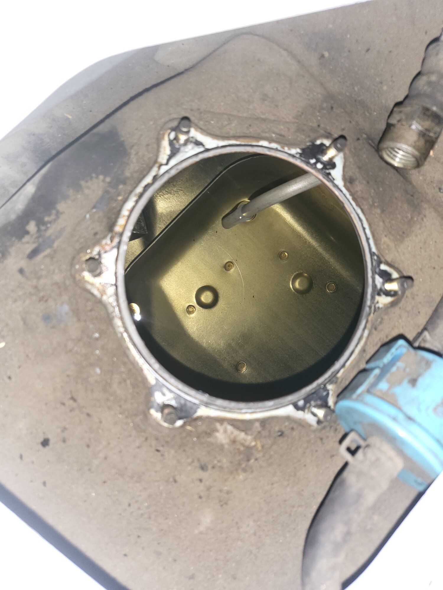

I tried to get the stock fuel pump out and could not for the life of me crack that fuel line loose. I eventually gave up and decided to buy a piece of rubber hose and cut the pipe in half and reconnect with hose. That is a project for future me.

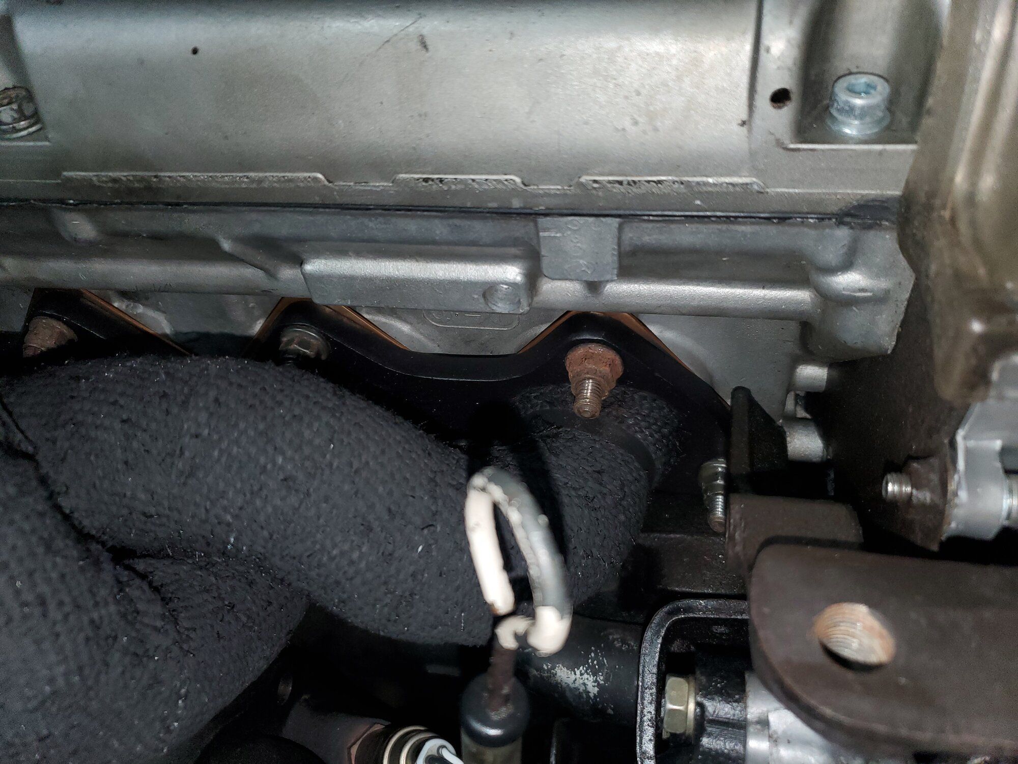

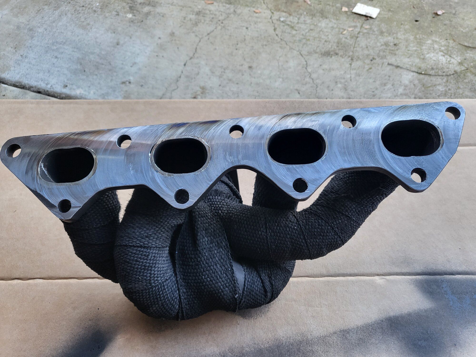

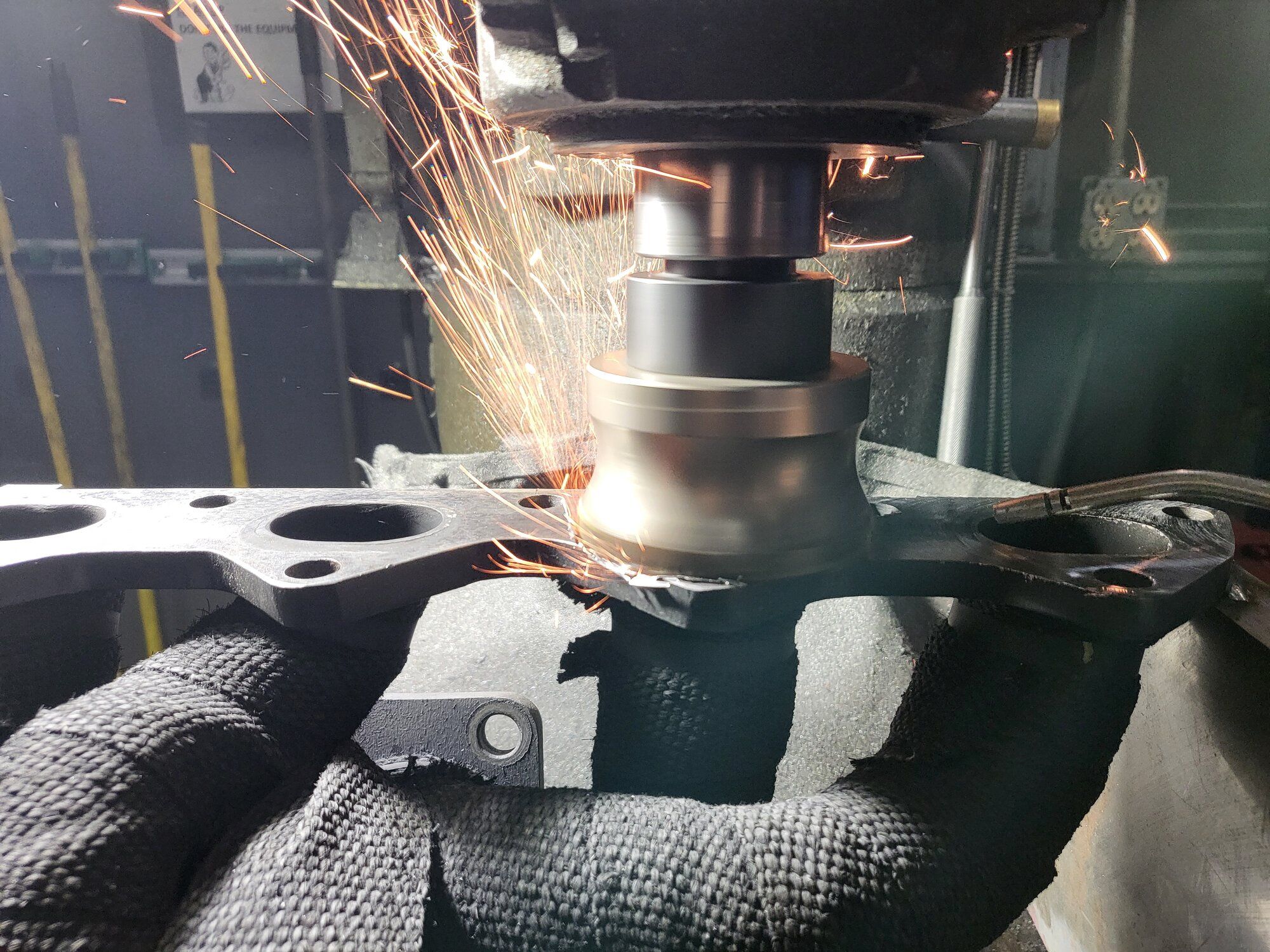

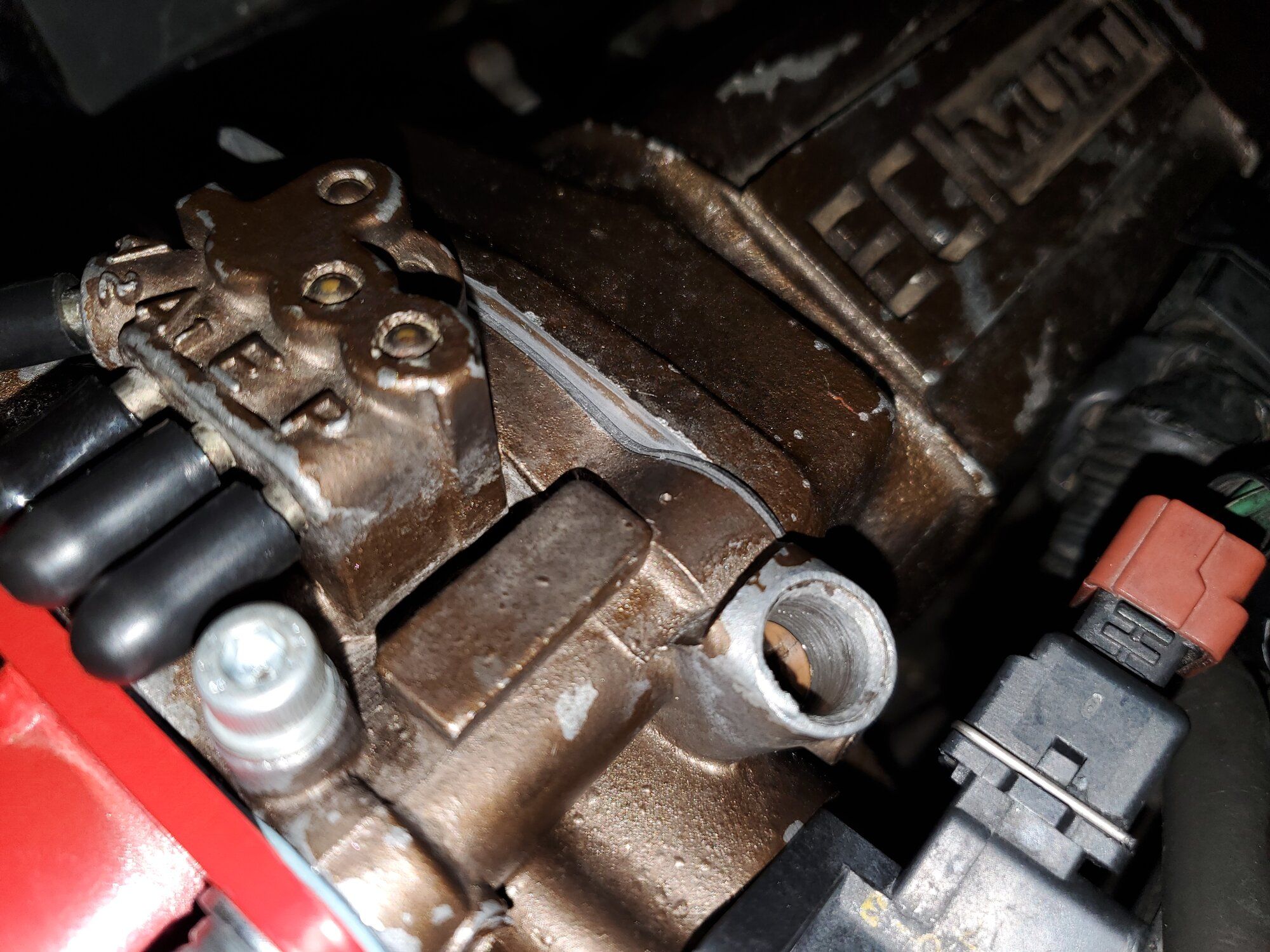

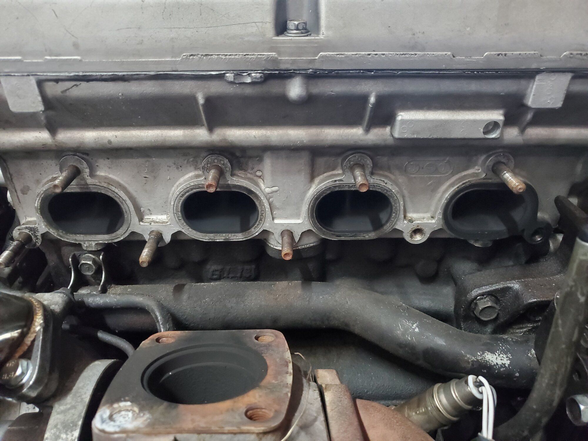

Last time I had the manifold off I noticed it looked like it was leaking at the gasket to head side in one corner. Was told this is most likely because of the cheap manifold not being flat.
Well... This was 100% the case. This thing was SO uneven it was almost not believable. I have no idea how the rest of it was sealing.
Made up a jig for it and put it through the milling machine. Bolted back up with no issues. We'll see how it holds up.

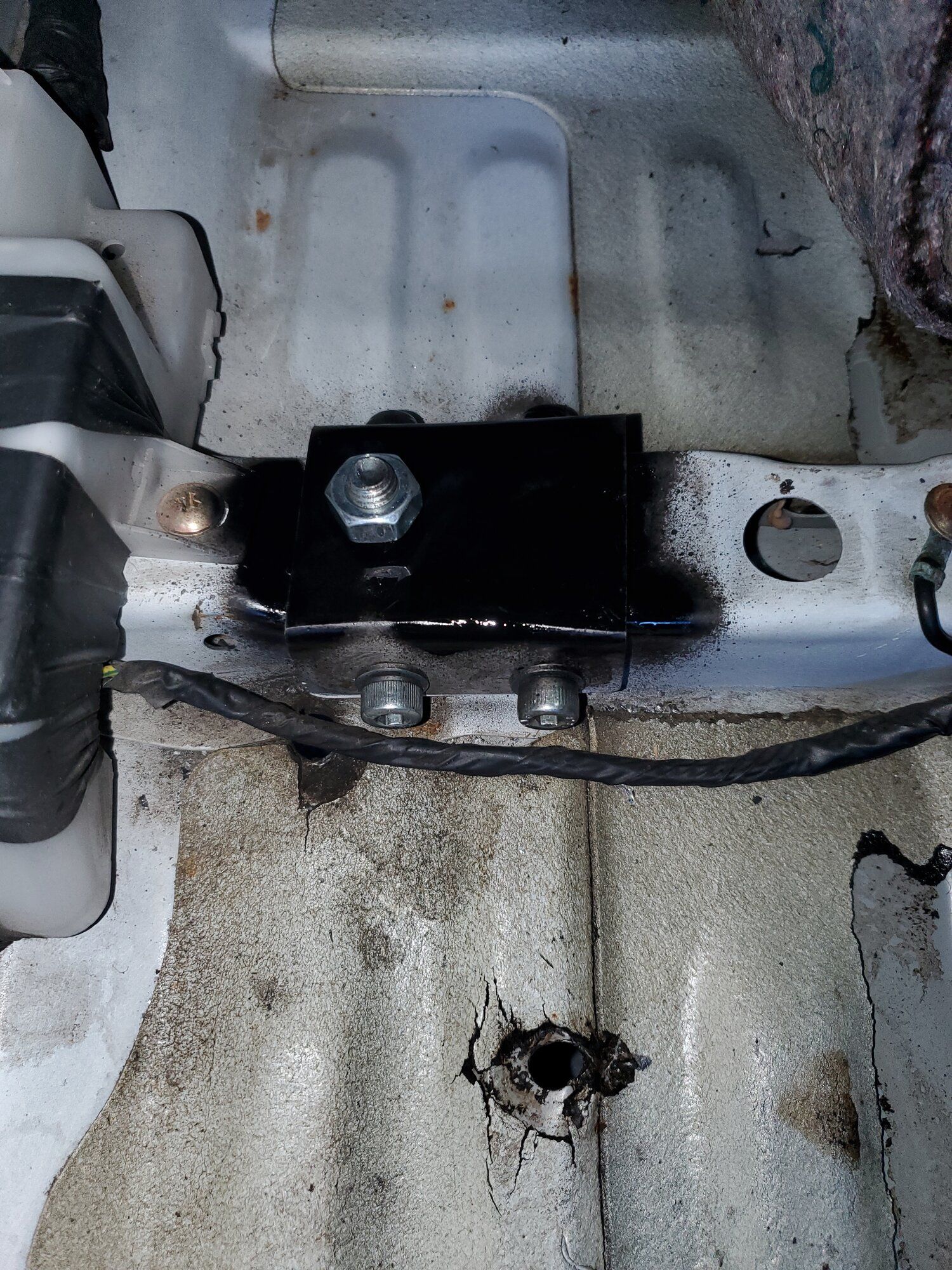

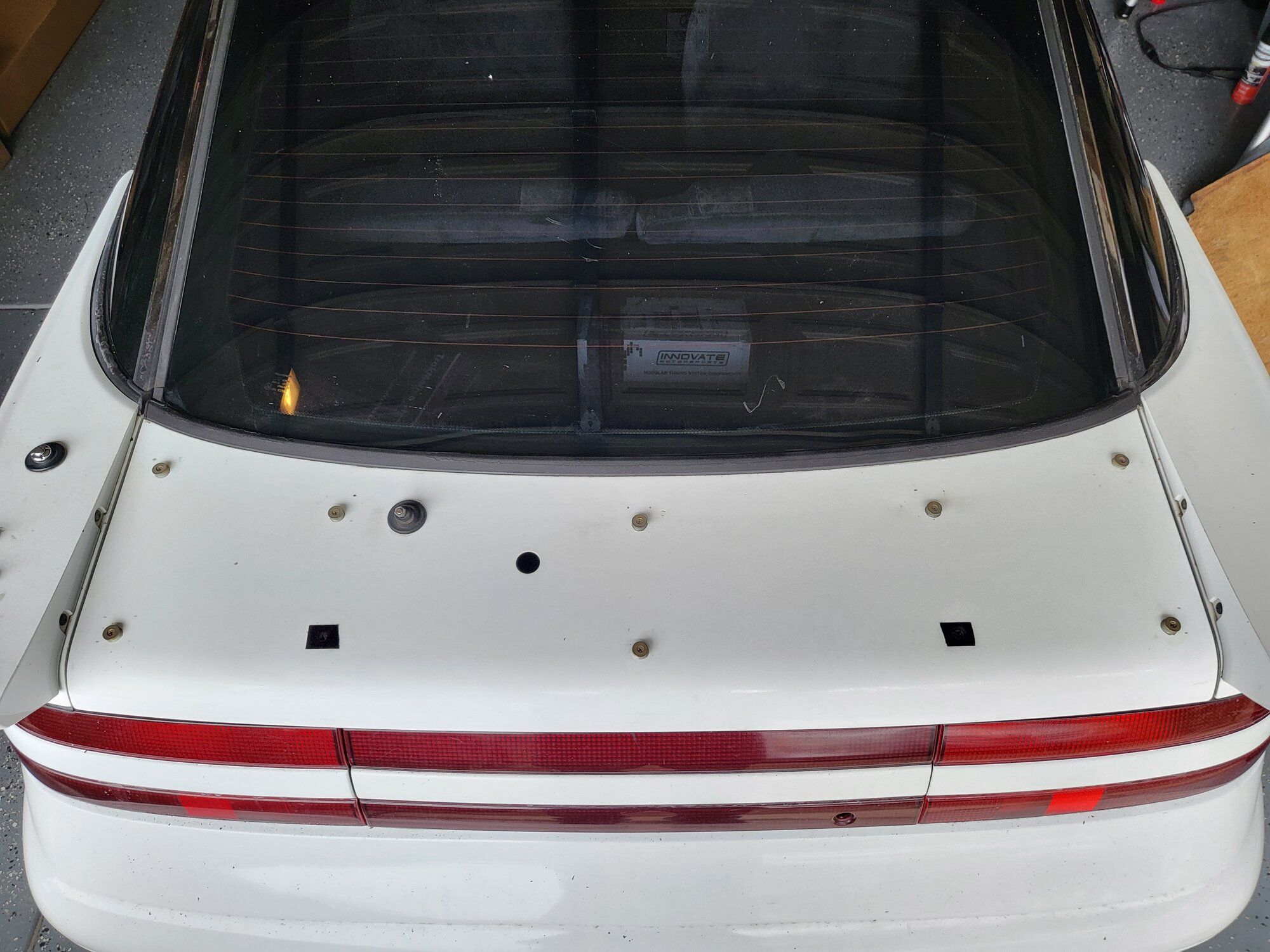

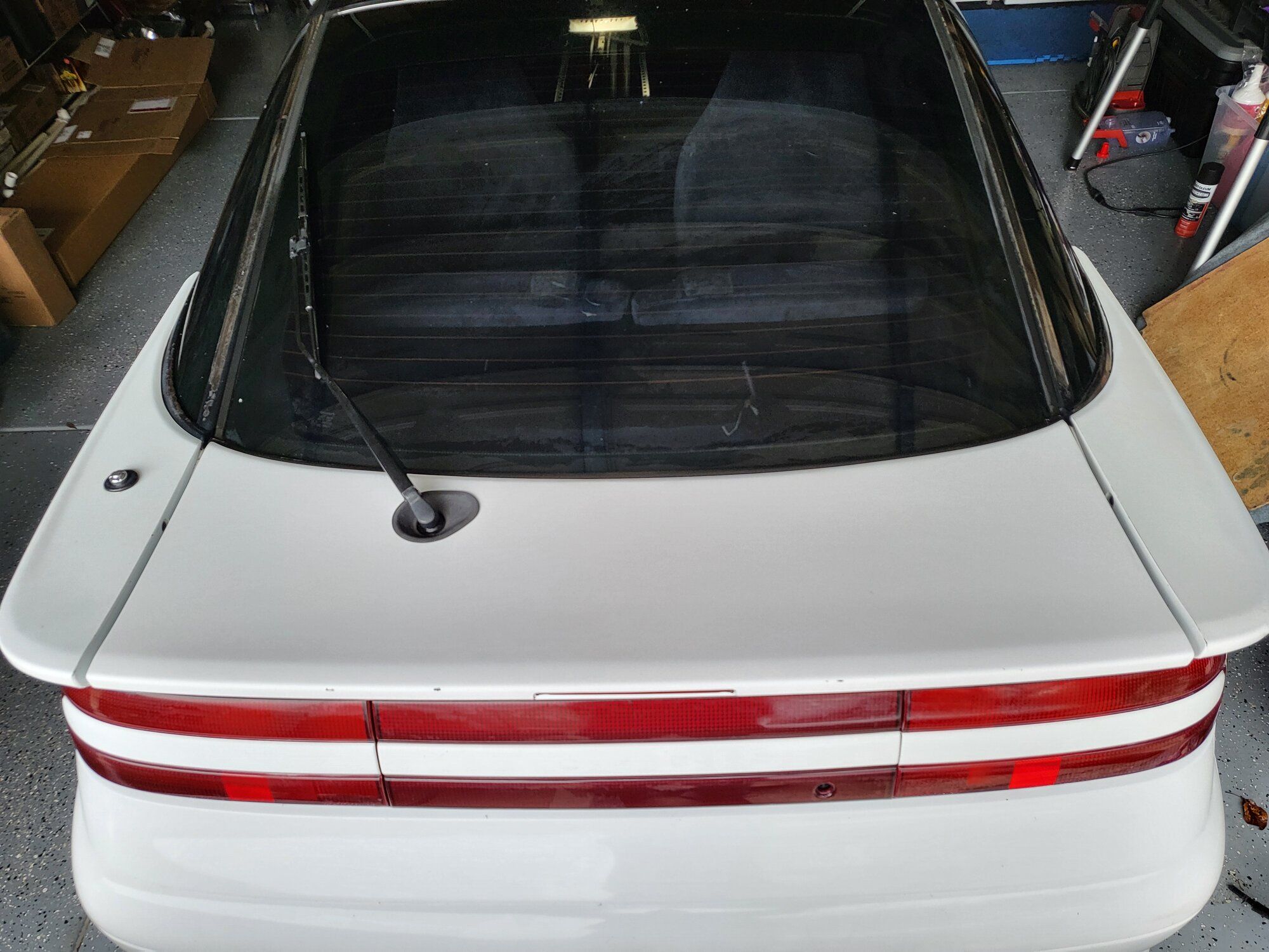

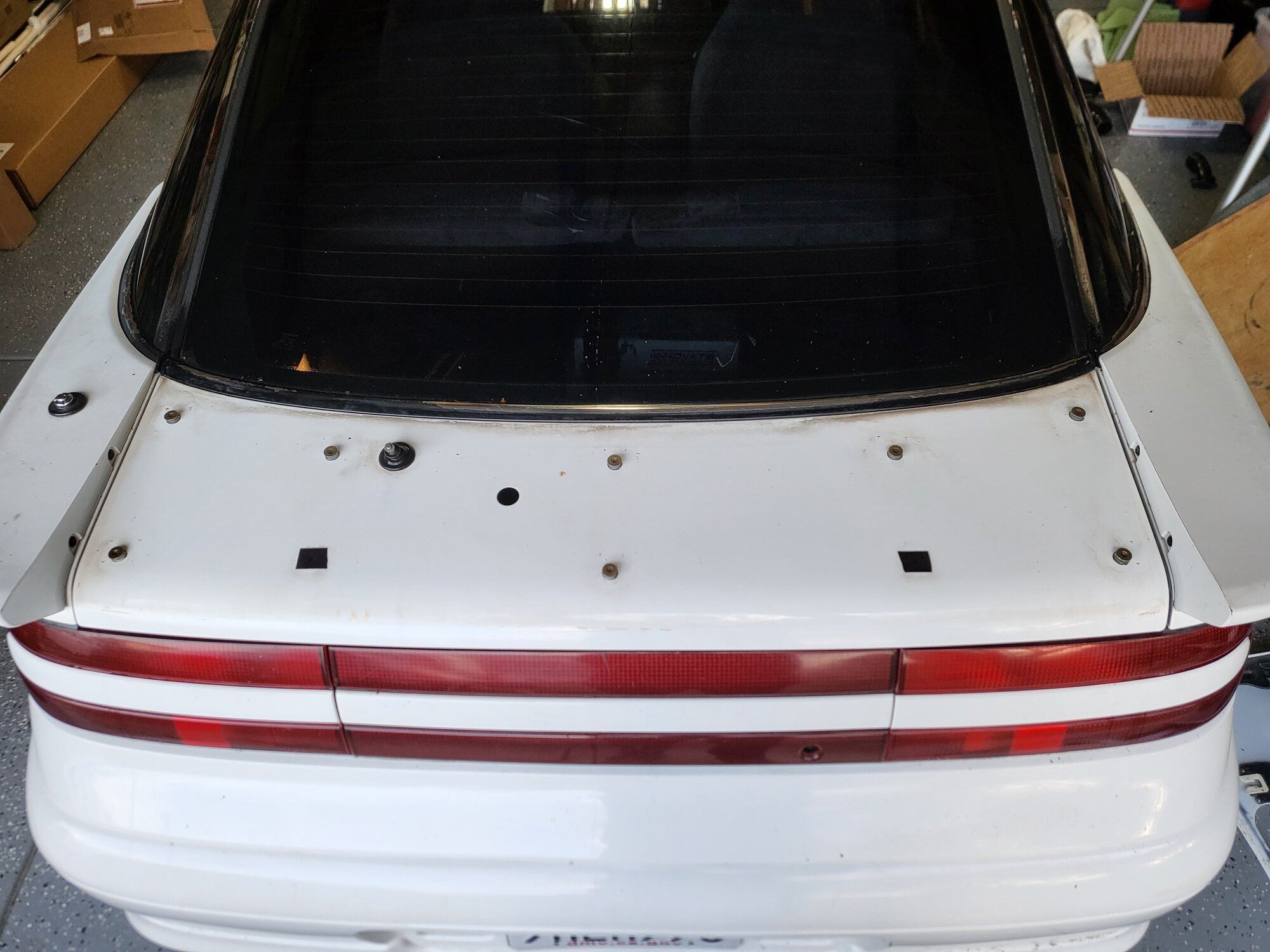

I left the car out in the rain recently and noticed that water was getting into the hatch and running into the trunk when I opened it. The spoiler fit was also loose so decided to remove the spoiler and inspect.
Found both of the mounts broken, which seems common. Had to hoopty them back onto the spoiler with some super glue and duct tape (not kidding). It seemed to work surprisingly well for the time being.
Also cleaned up the trunk area underneath and the spoiler itself. Also sprayed the black trim piece with some bed liner spray since it was half flaked off. Figured the bed liner would hide imperfections better.

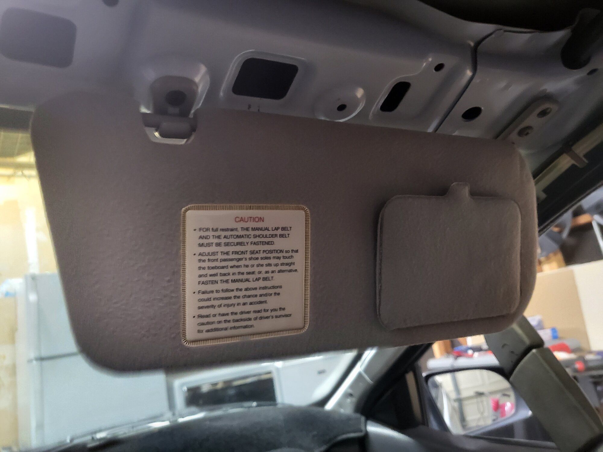

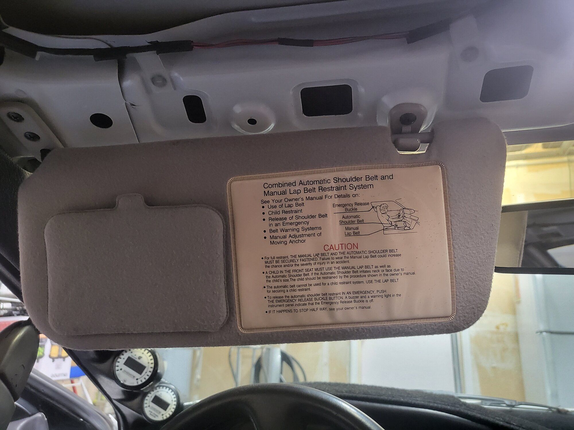

Got some decent sun visors put in. The old ones were literally falling apart. Thanks @19Eclipse90

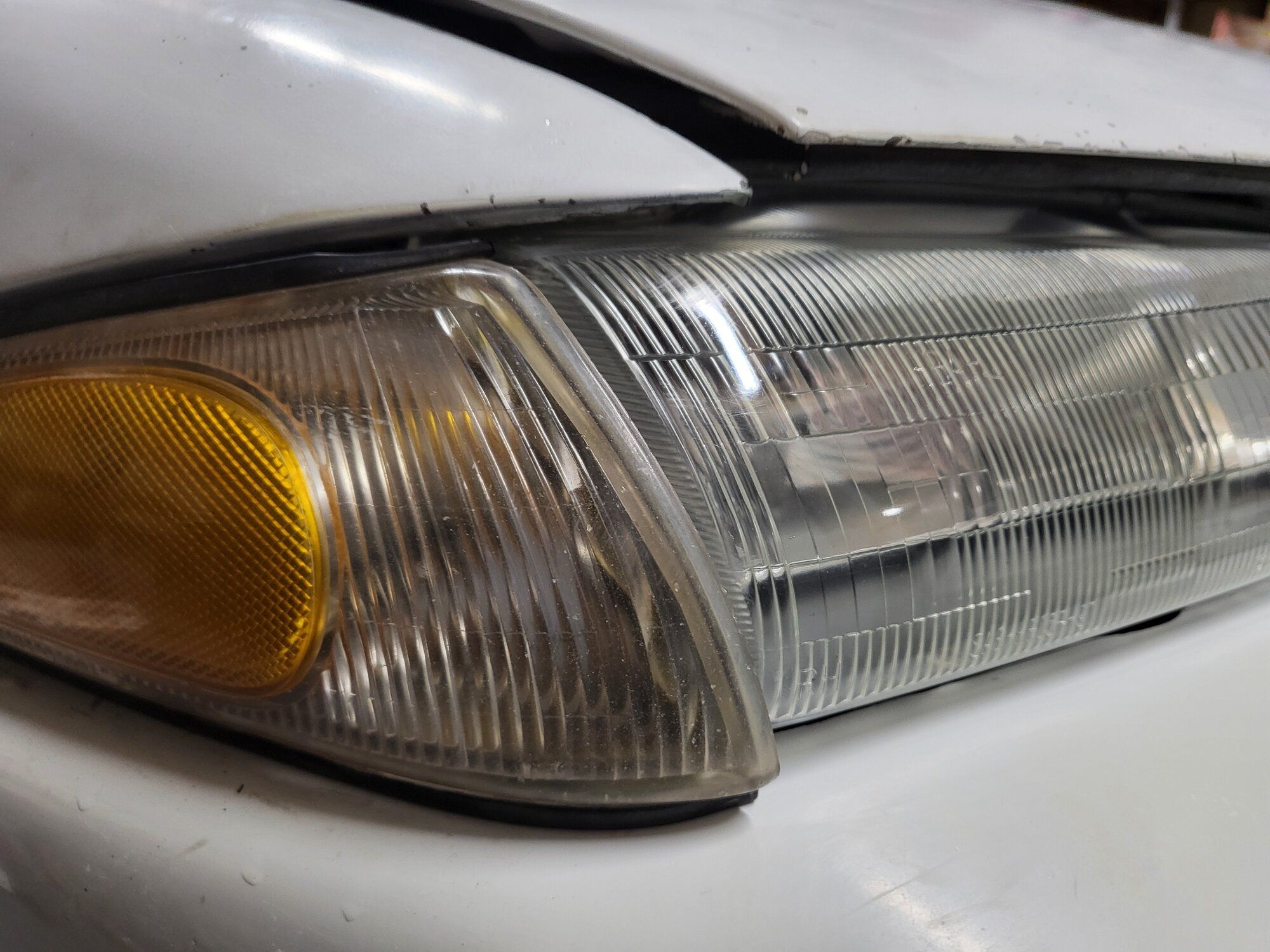

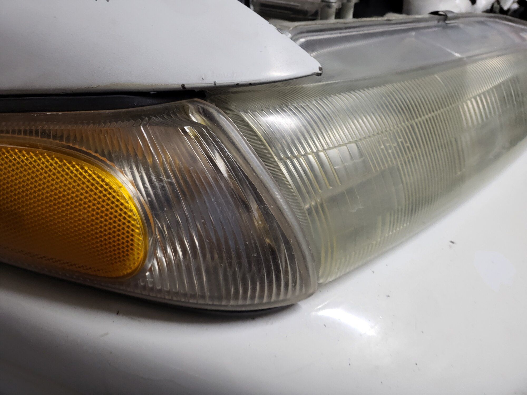

Took a slide hammer to the right side headlights outer mount. Had an issue where the corner light and the headlight were misaligned. Looks like the car has has a knock on this corner sometime in the past. Also polished up the headlights with a Sylvania kit after seeing Project Farms video on youtube comparing headlight restoration kits.

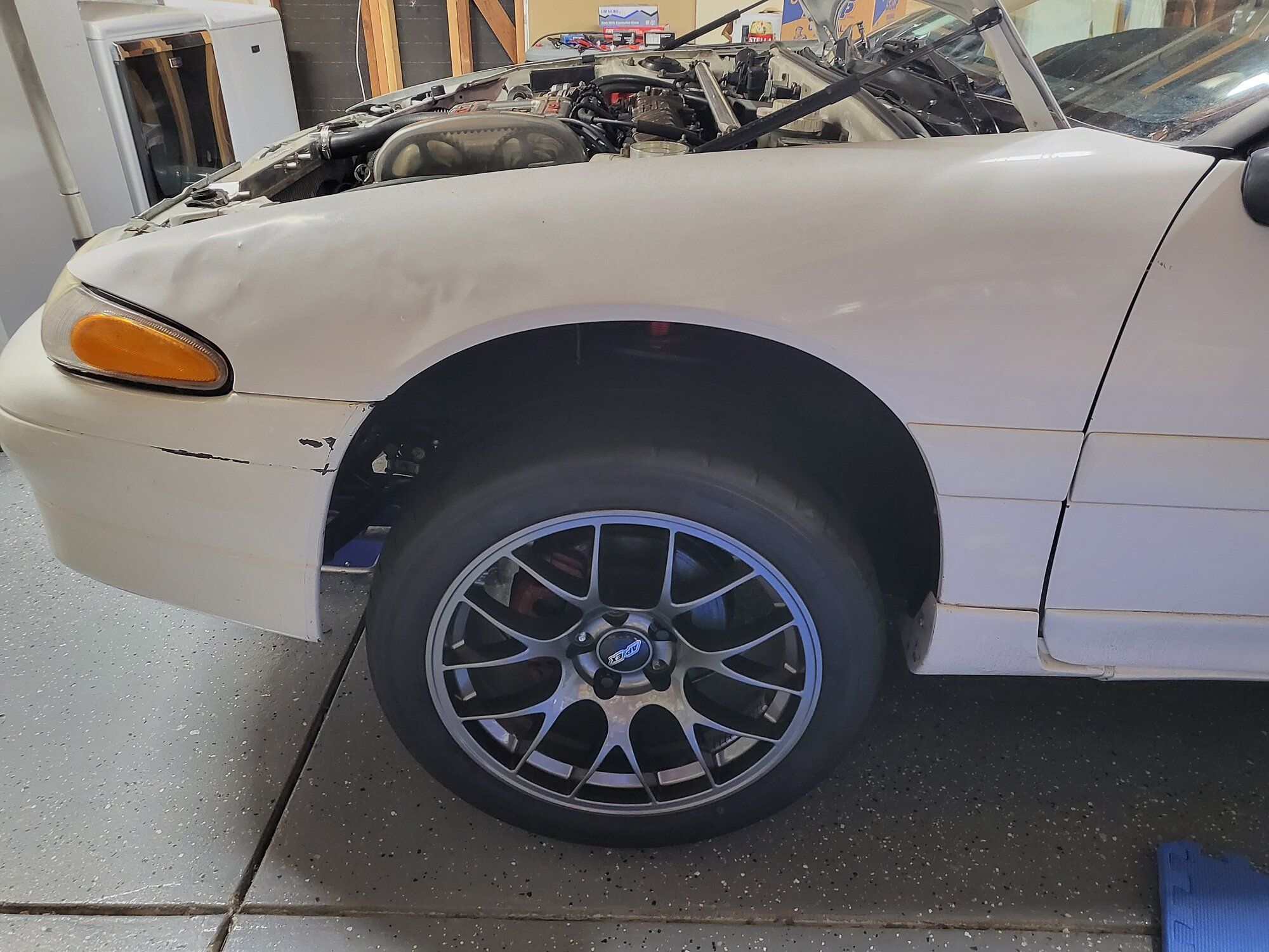

Alignment before.... Also shows the headlight after the restoration.
Alignment after.... Also shows the headlight before restoration.

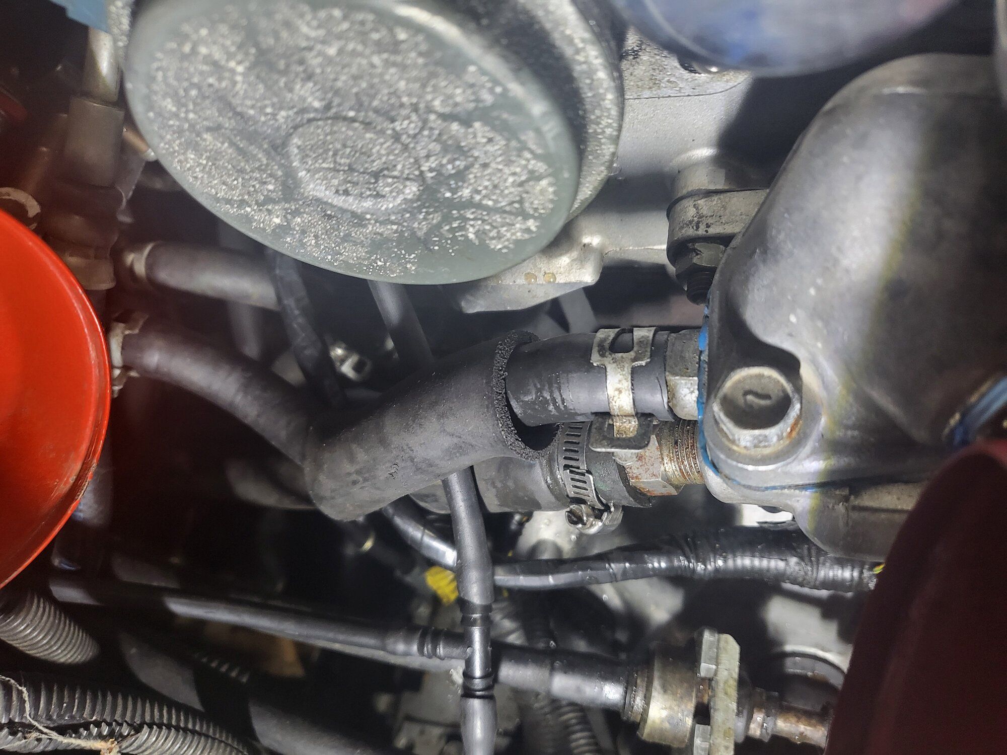

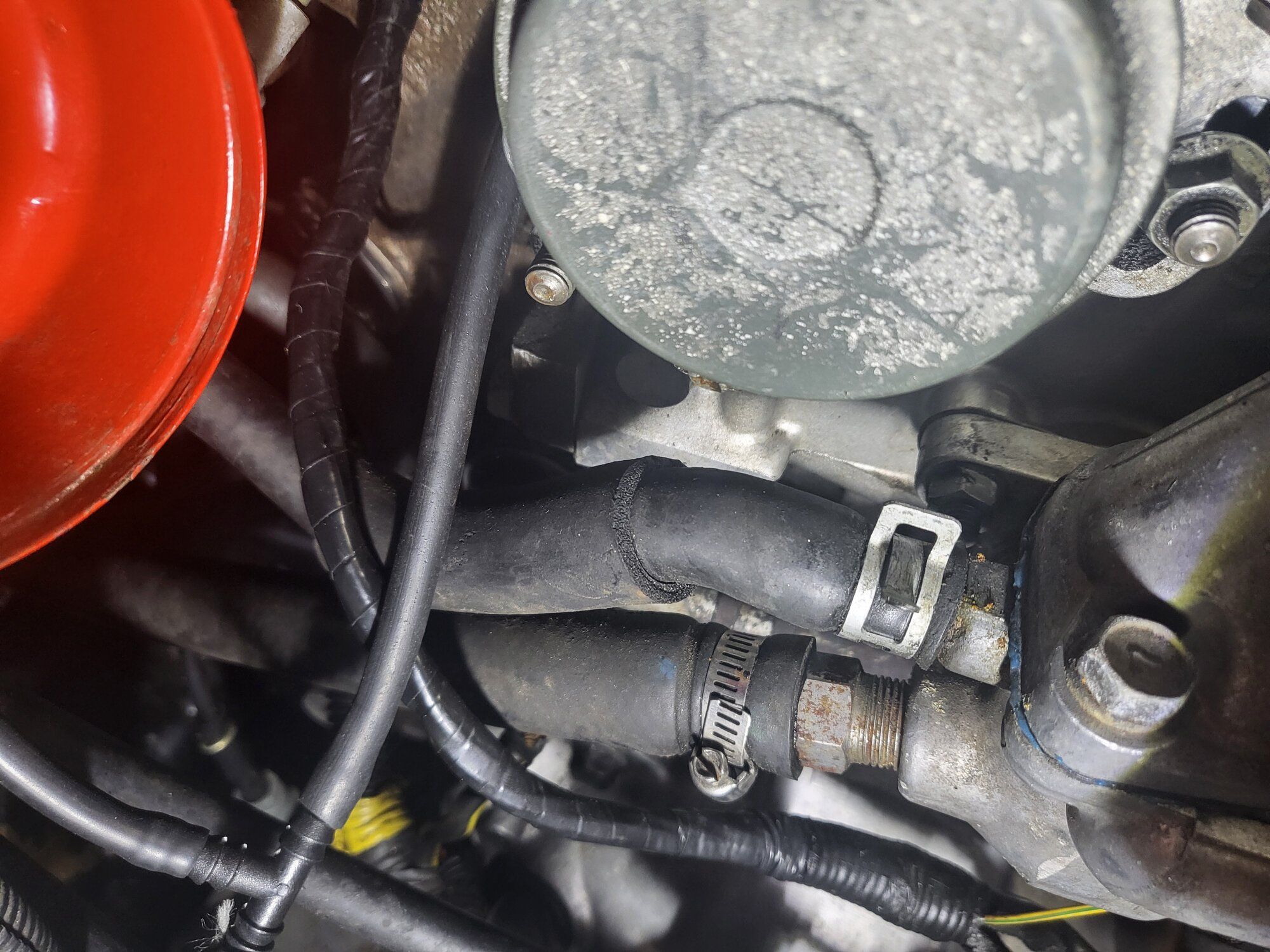

Replaced this coolant hose as the old one was quite soft and swollen.

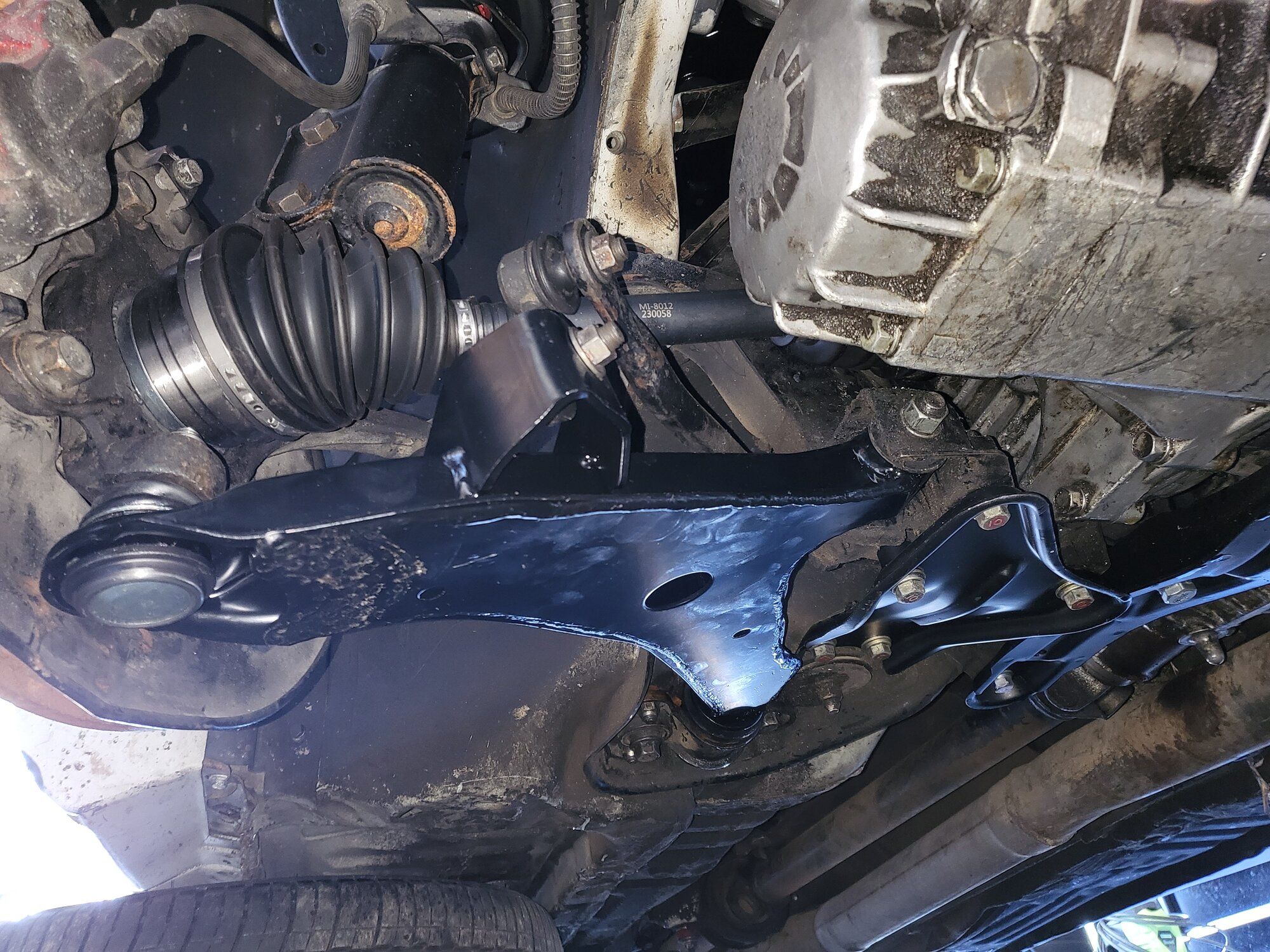

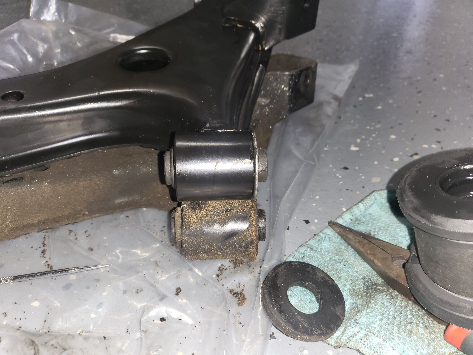

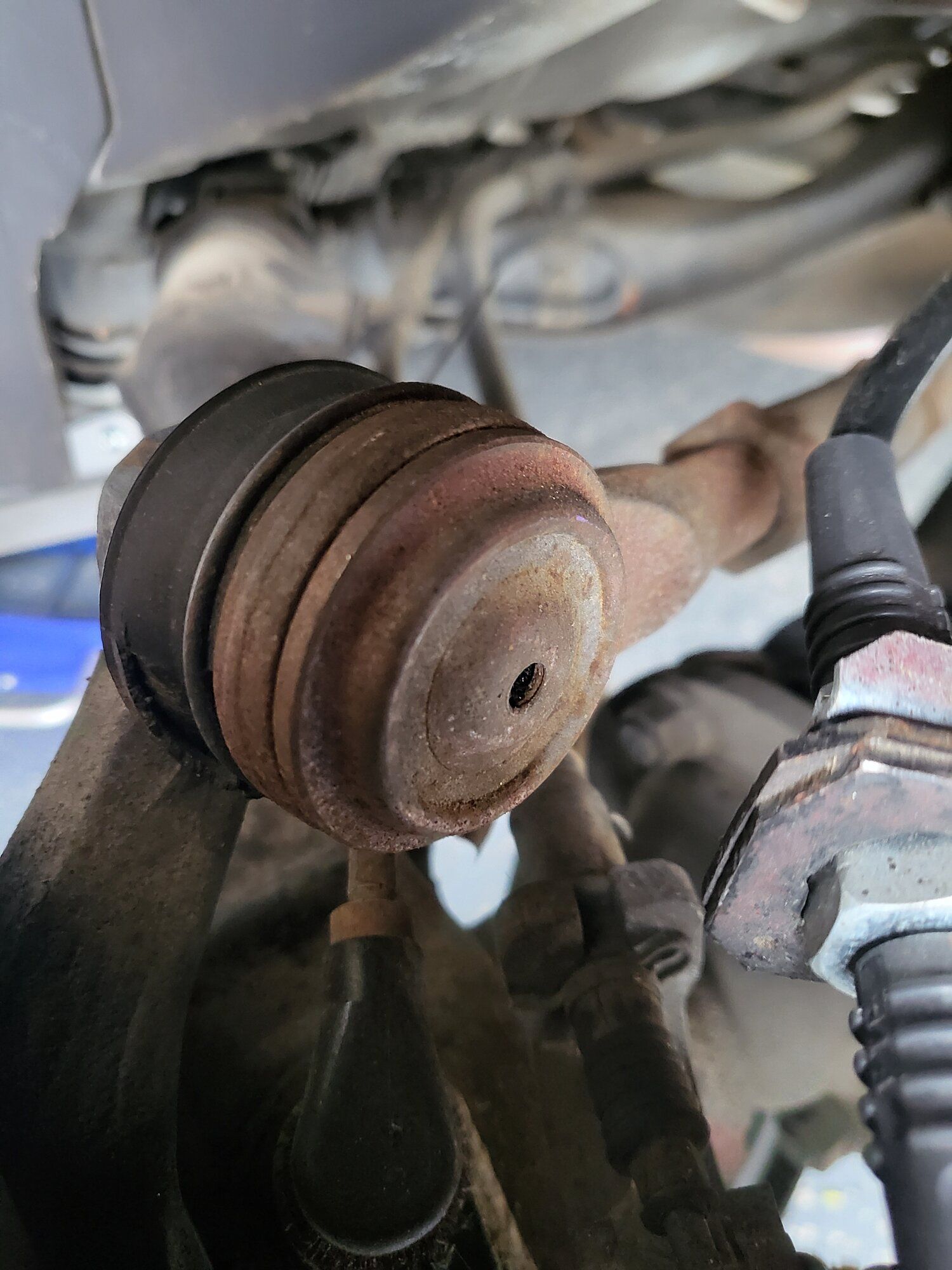

Trying to repair my right side front camber issue. Replaced the lower control arm which may have helped a little or might be just wishful thinking. Either way the problem is still present.

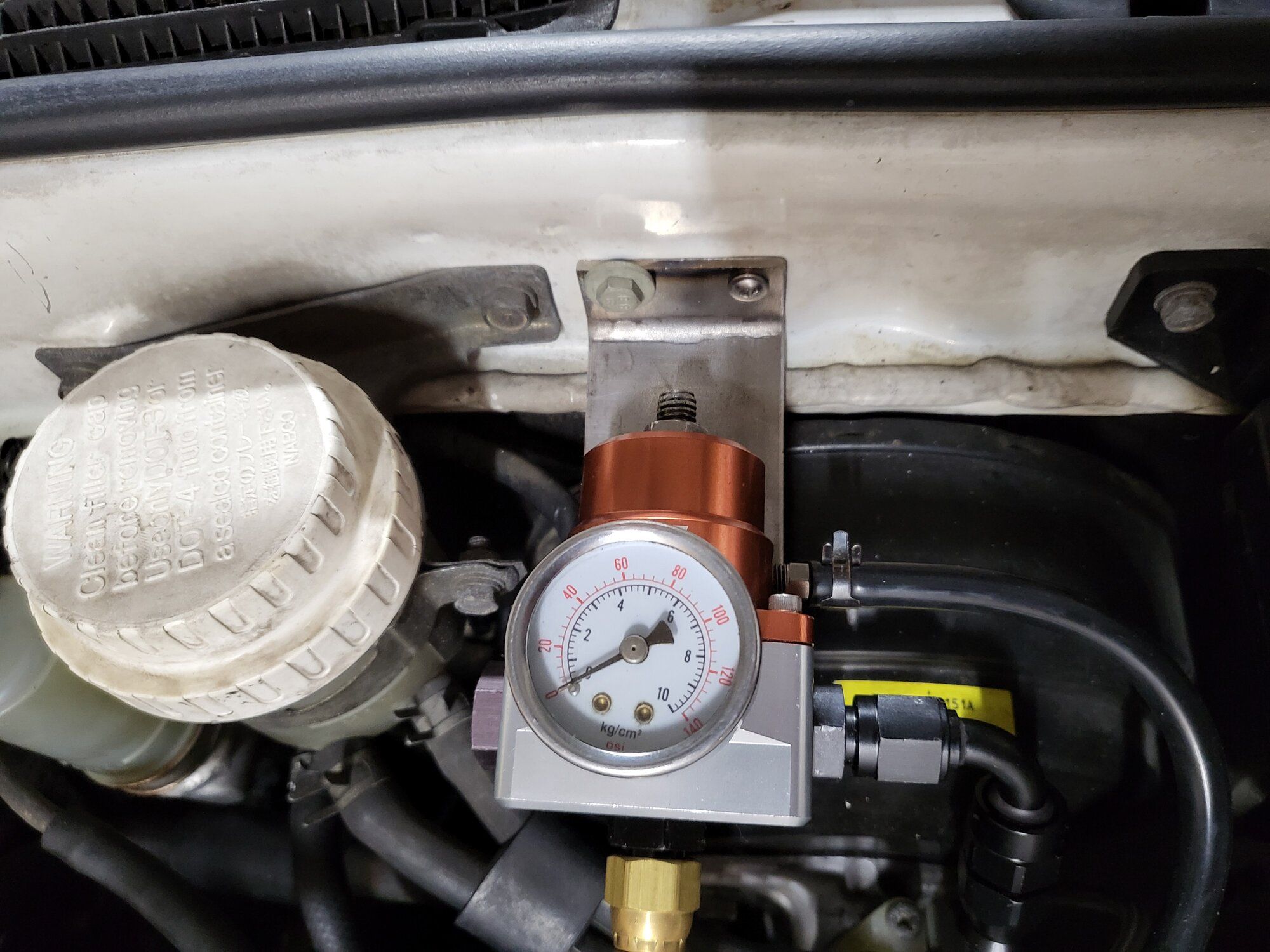

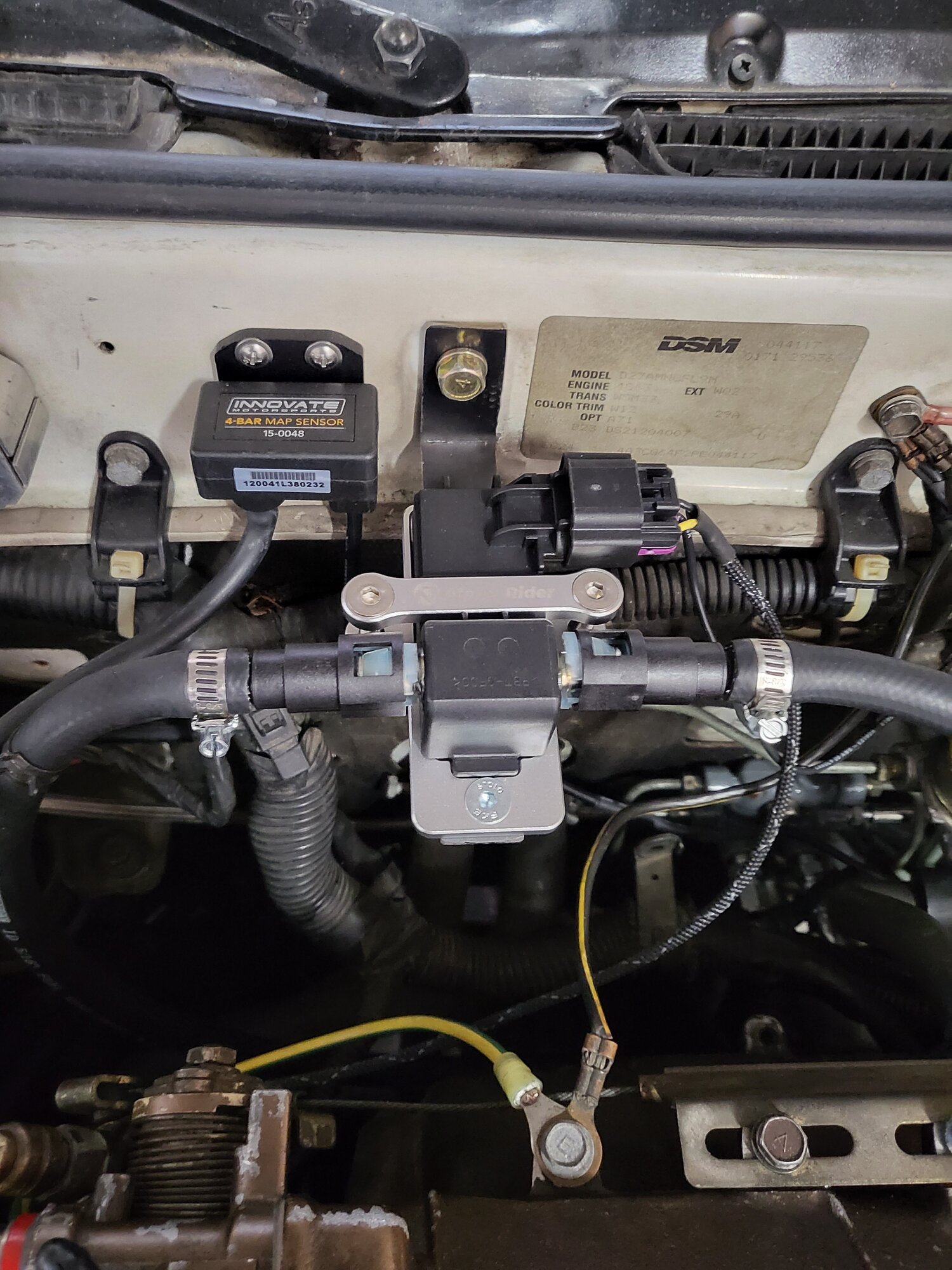

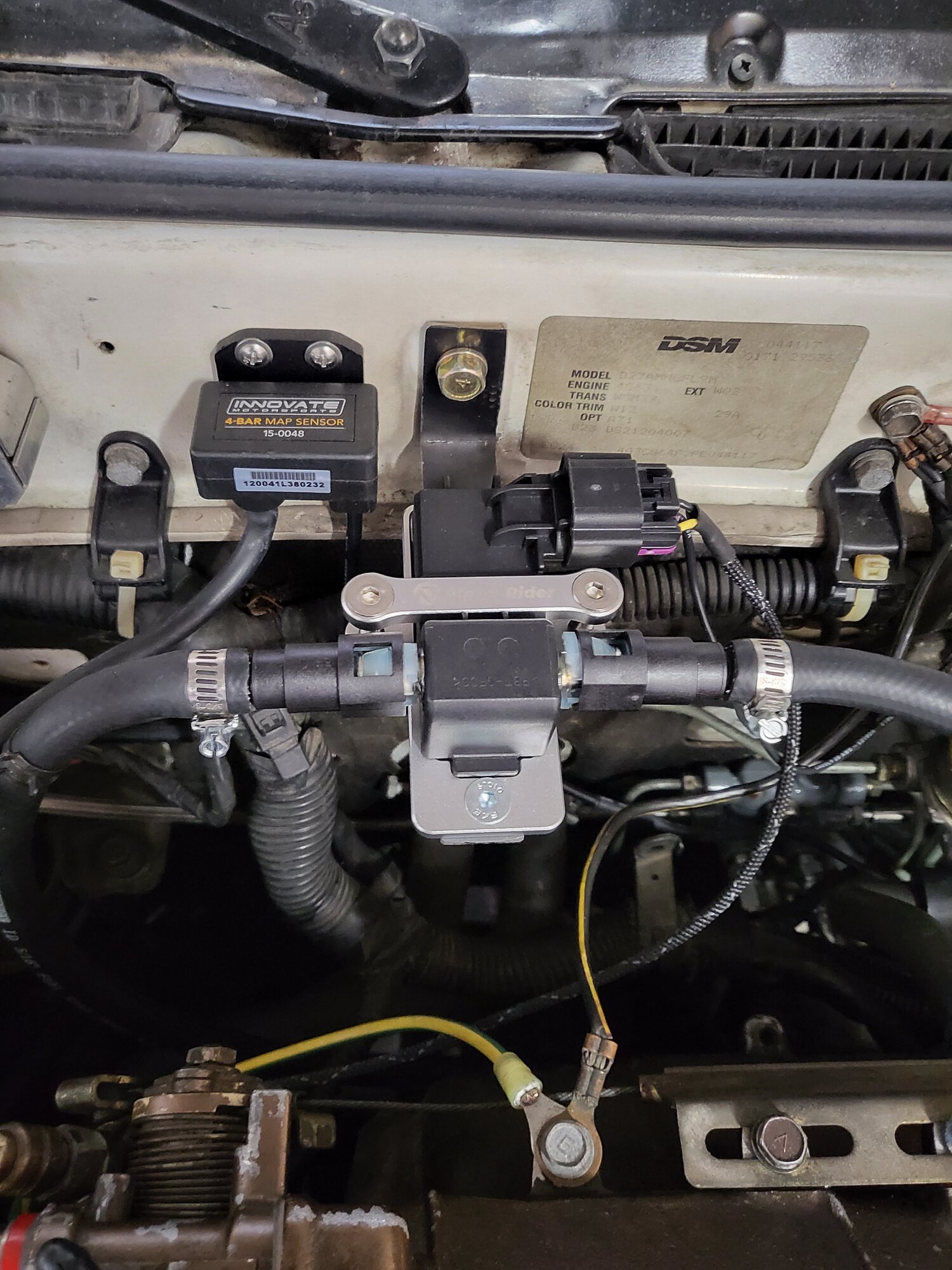

Got the AFPR installed.

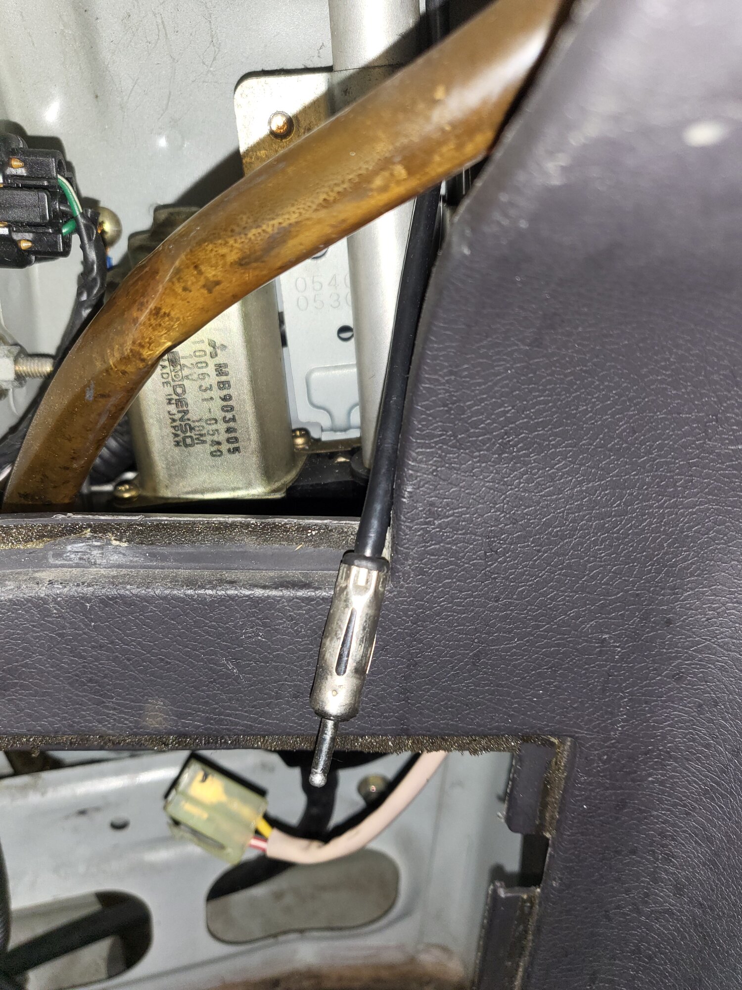

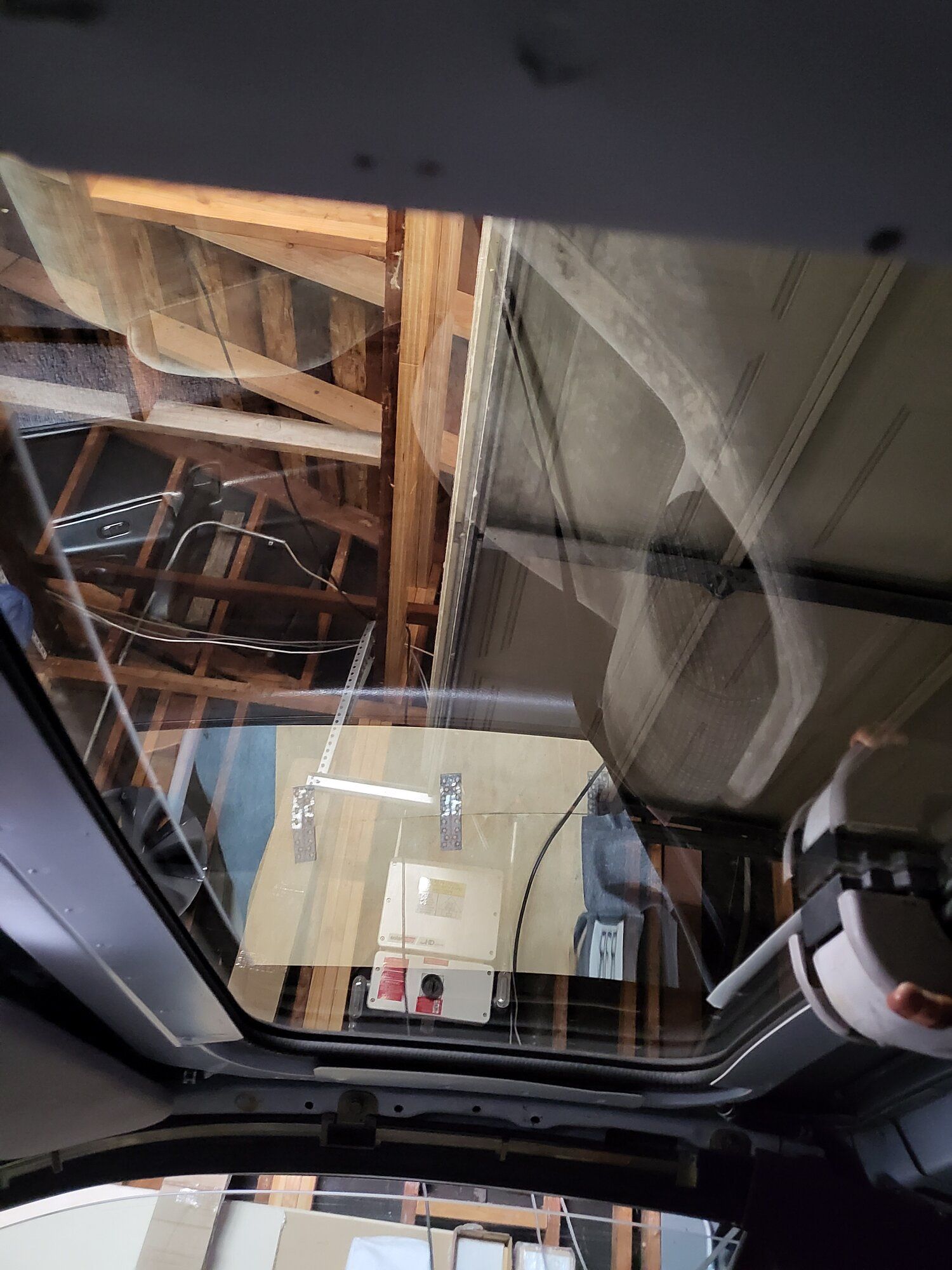

Fixed a REALLY annoying rattle! Turns out the sunroof hinges were loose. While I had the glass out I cleaned up the area and removed the old cheap tint from the glass.

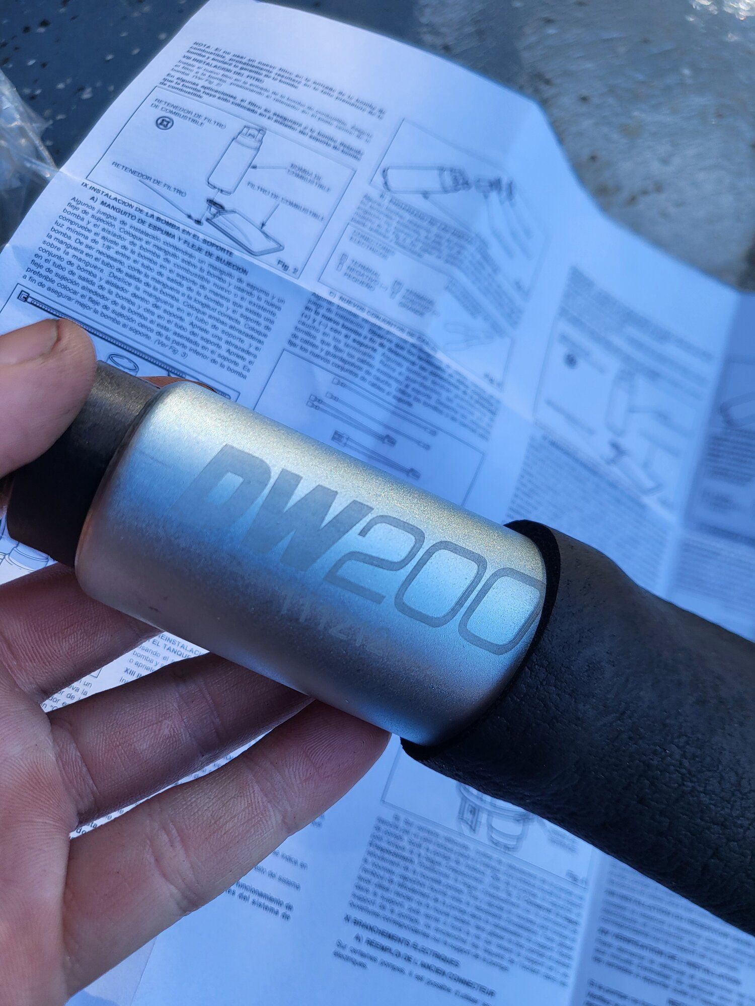

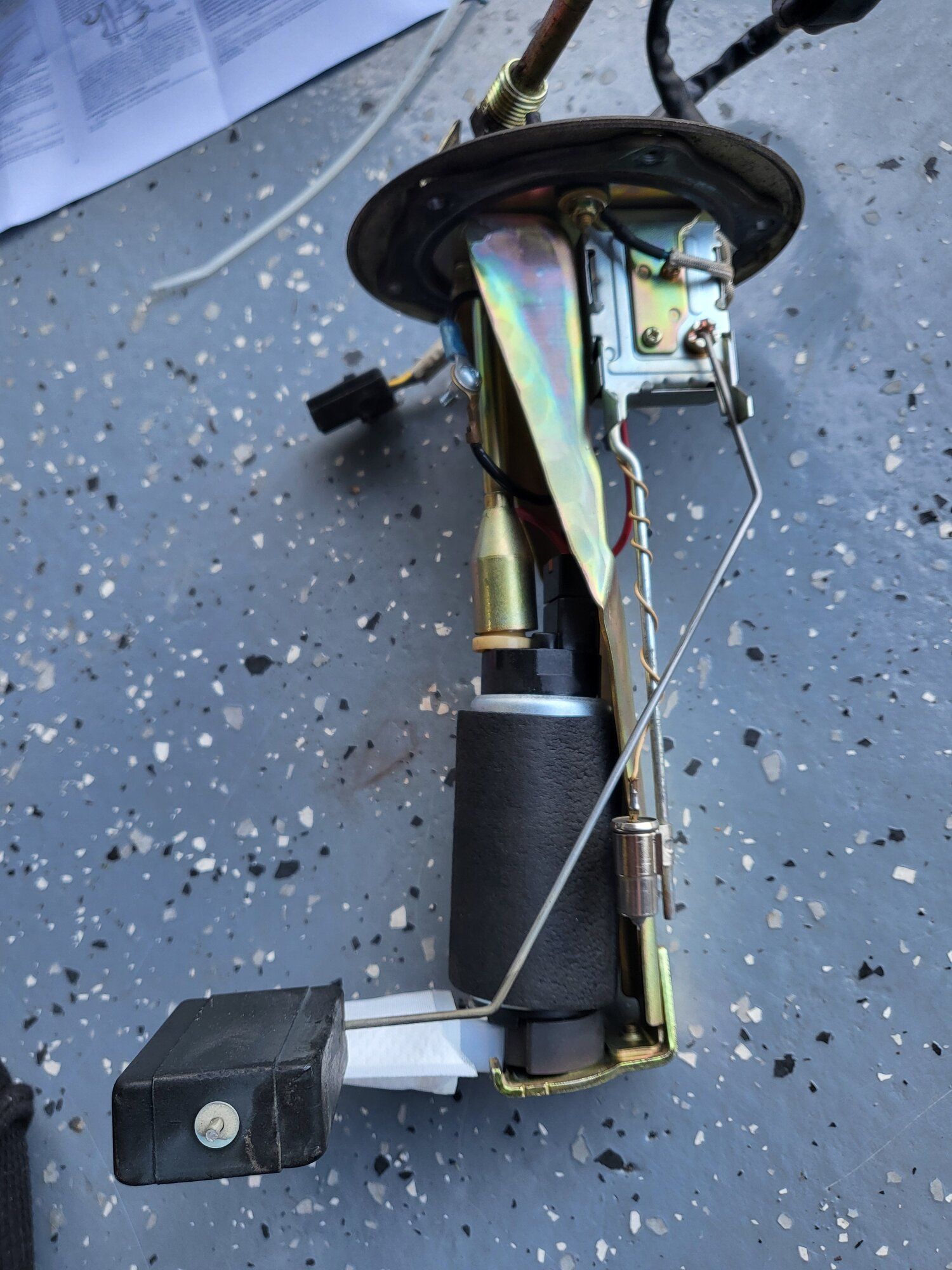

Got the new fuel pump installed. Took me 3 separate tries to get the line off the old housing. That thing was on there TIGHT. Pump initially went on kinda crooked but I was able to straighten it out. Checked the inside of the tank while I was there and it was surprisingly clean.

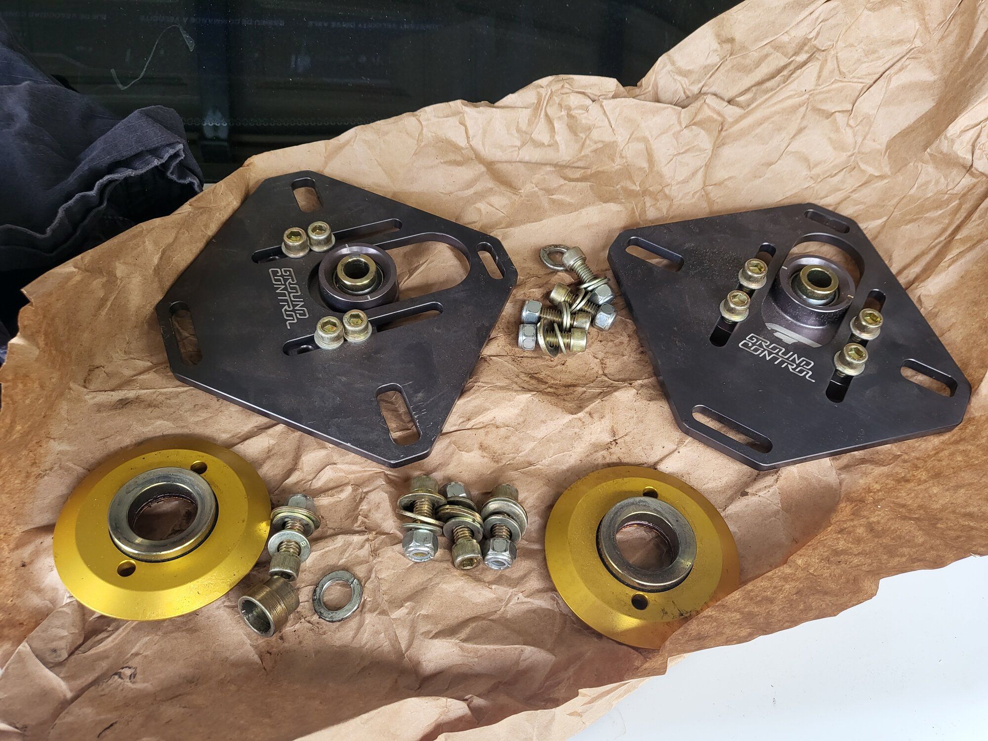

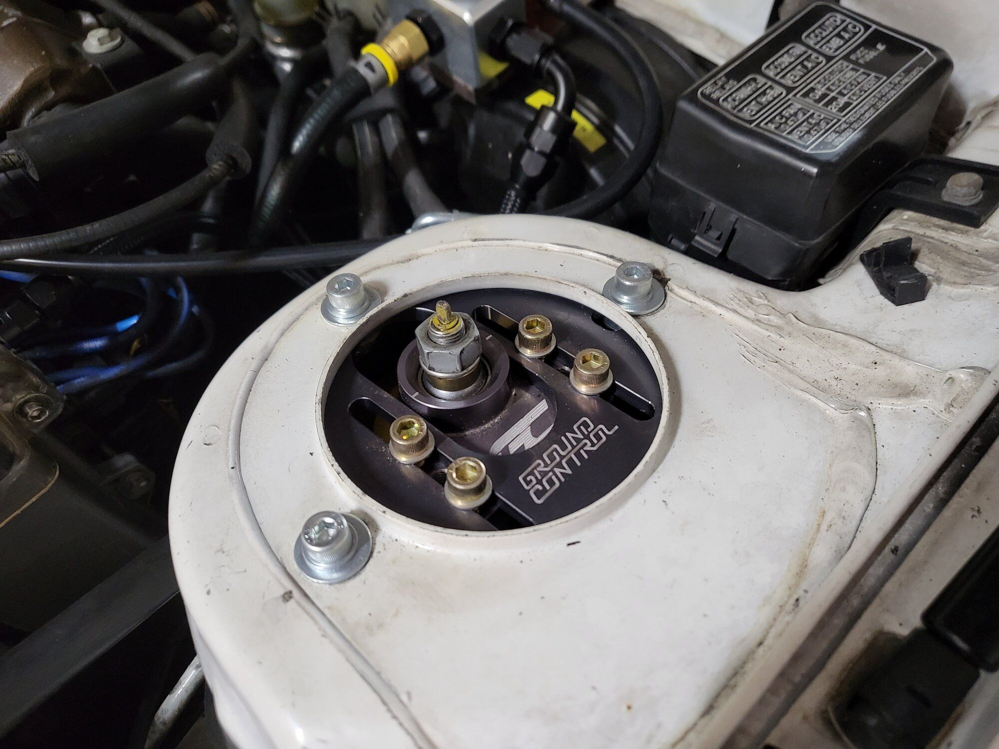

Got some Ground Control camber/caster plates from @Dhan who also sold me his GC/Koni setup a while back. This got my front right camber in check for the time being. Had to 3D print a small spacer to take up a gap between the top spring perch and the shock shaft.

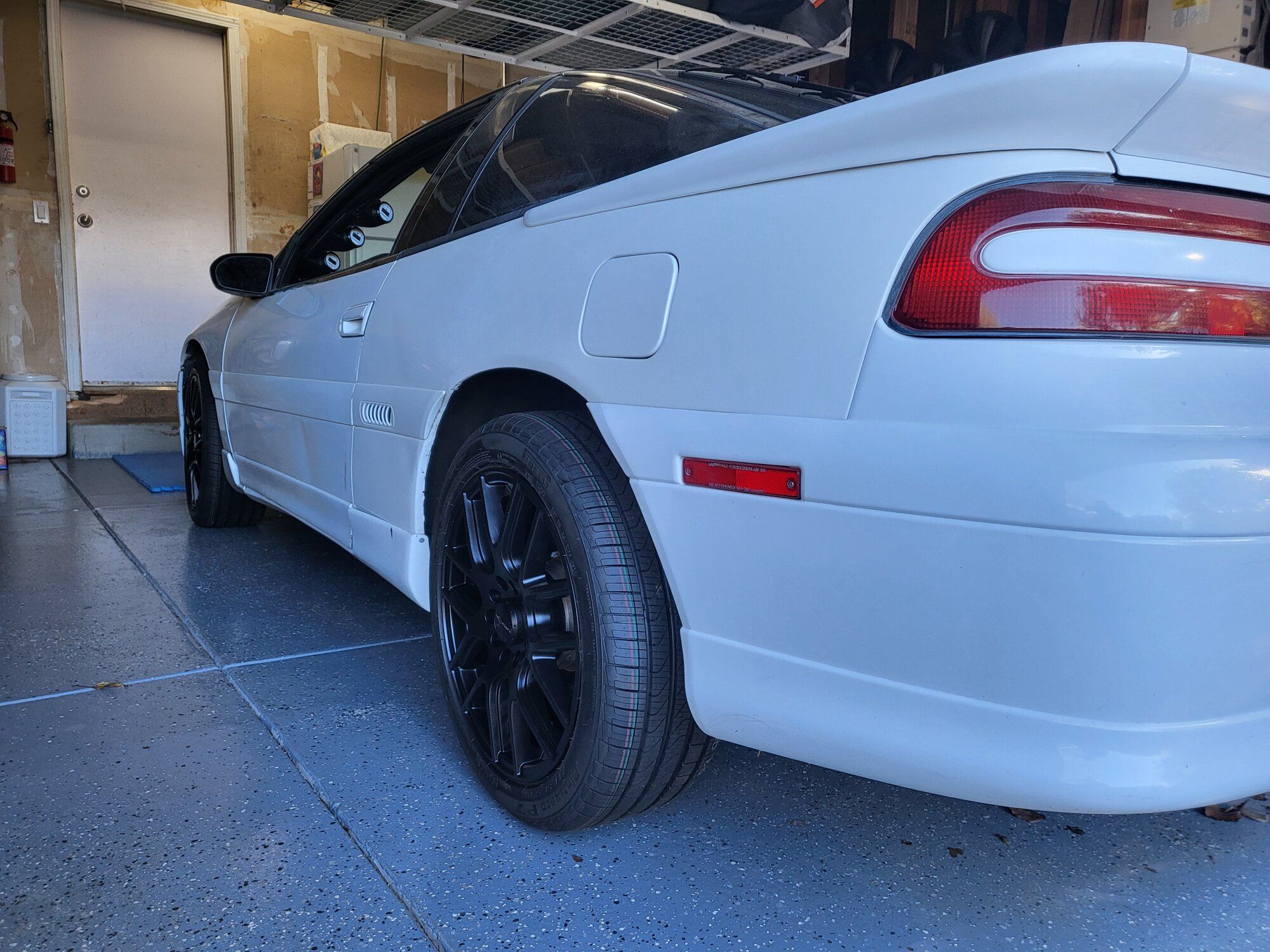

Got some new (yes theyre cheap dont judge me!) wheels and some tires. They were on sale through discount auto for about 800 for the entire set. The reason for this is when I received the car one of the slipstreams was 7.5 inches wide while the others were 8.5 wide. I have been searching for a replacement wheel for over a year now and couldnt find one so I caved and replaced them. I have also since done a home alignment but do not have pictures of that just yet. So please ignore the horrible alignmentness.

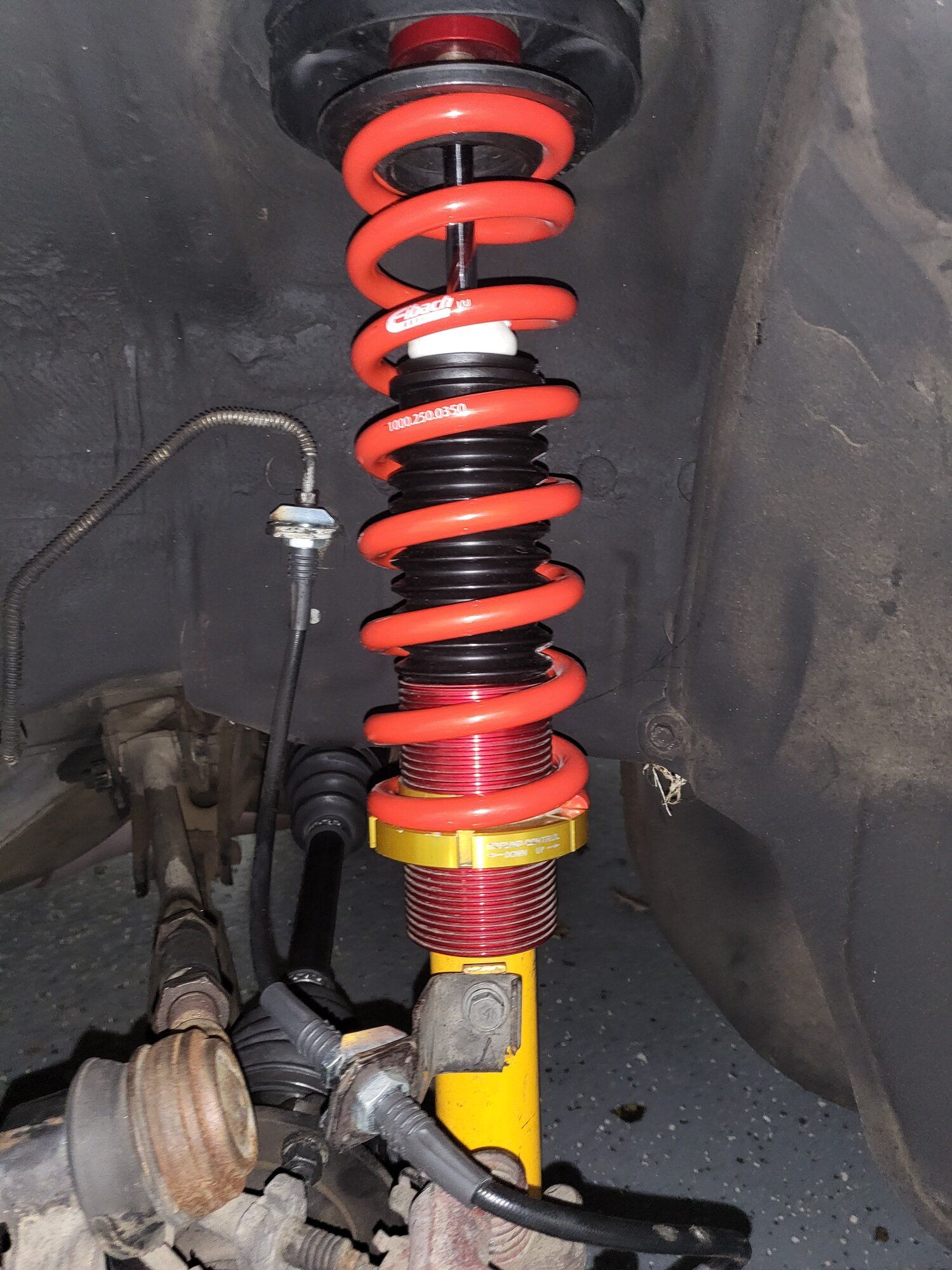

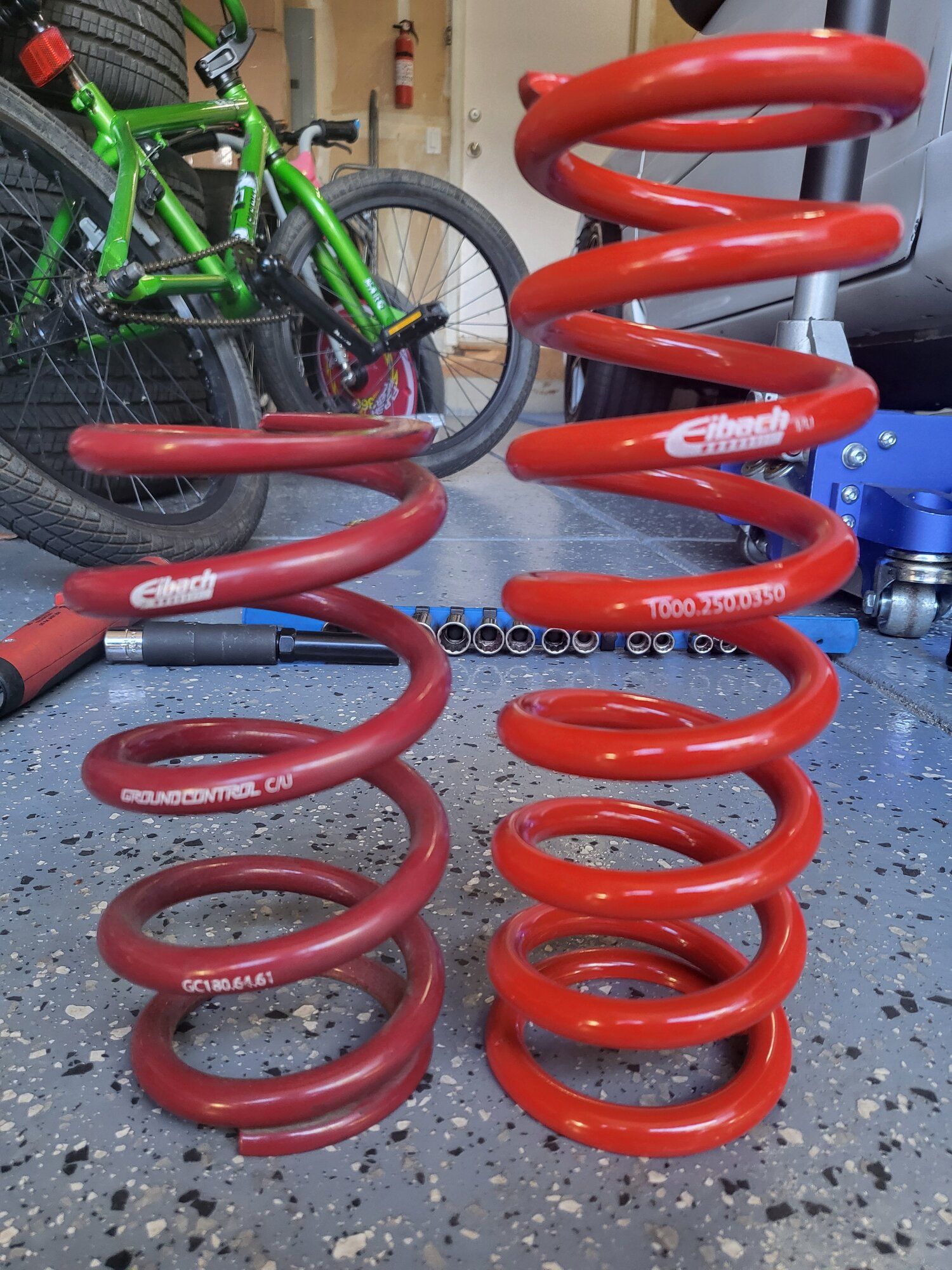

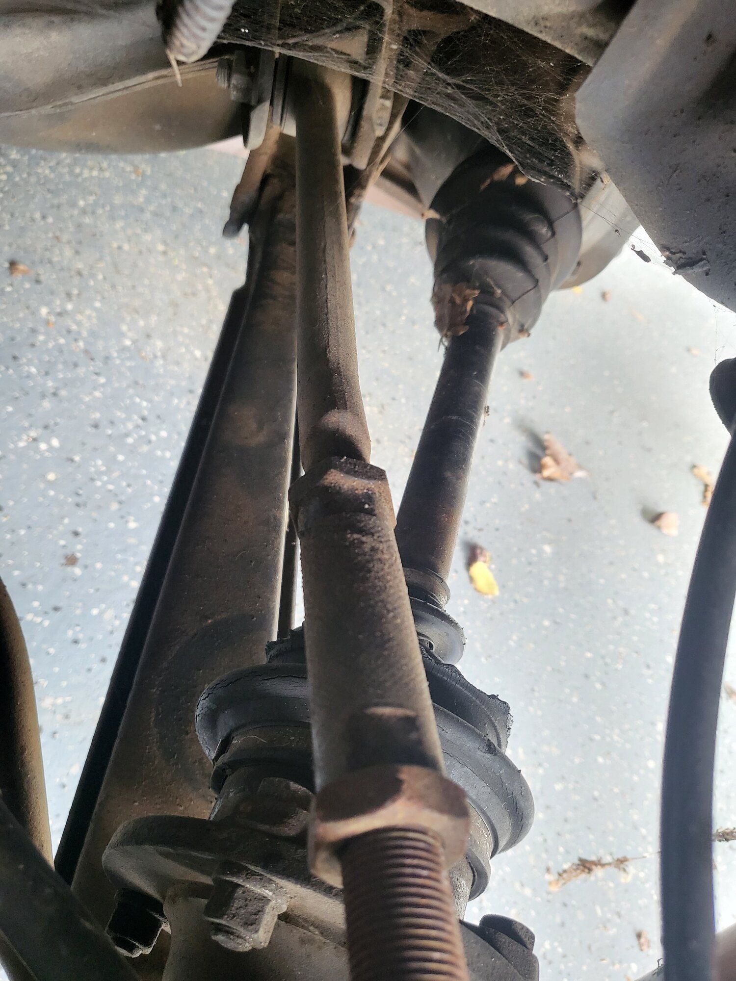

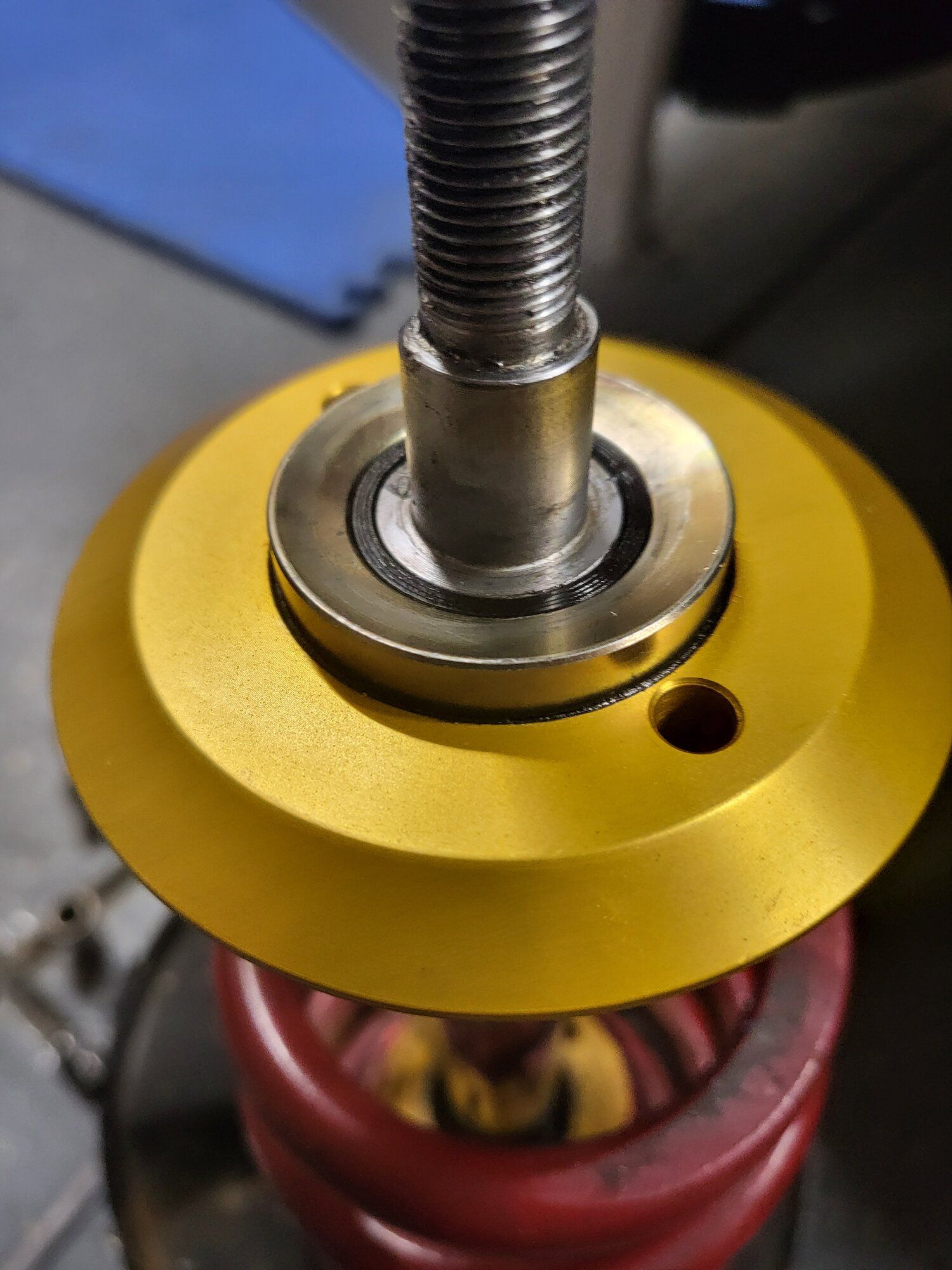

I have been really trying to get the suspension dialed in lately. In the picture above the front is as low as it can go and the rear is as high as it can go. This left me with literally 0 travel in the front and about 1/2 inch in the rear with no bump stops. I took some measurements and decided to change the rear spring from a 7 inch long to a 10. This gave me a reasonable range of adjustability. I also raised the car to have about 14.5 inches between the bottom of the fender and the center of the axle in the front and 15 in the rear.

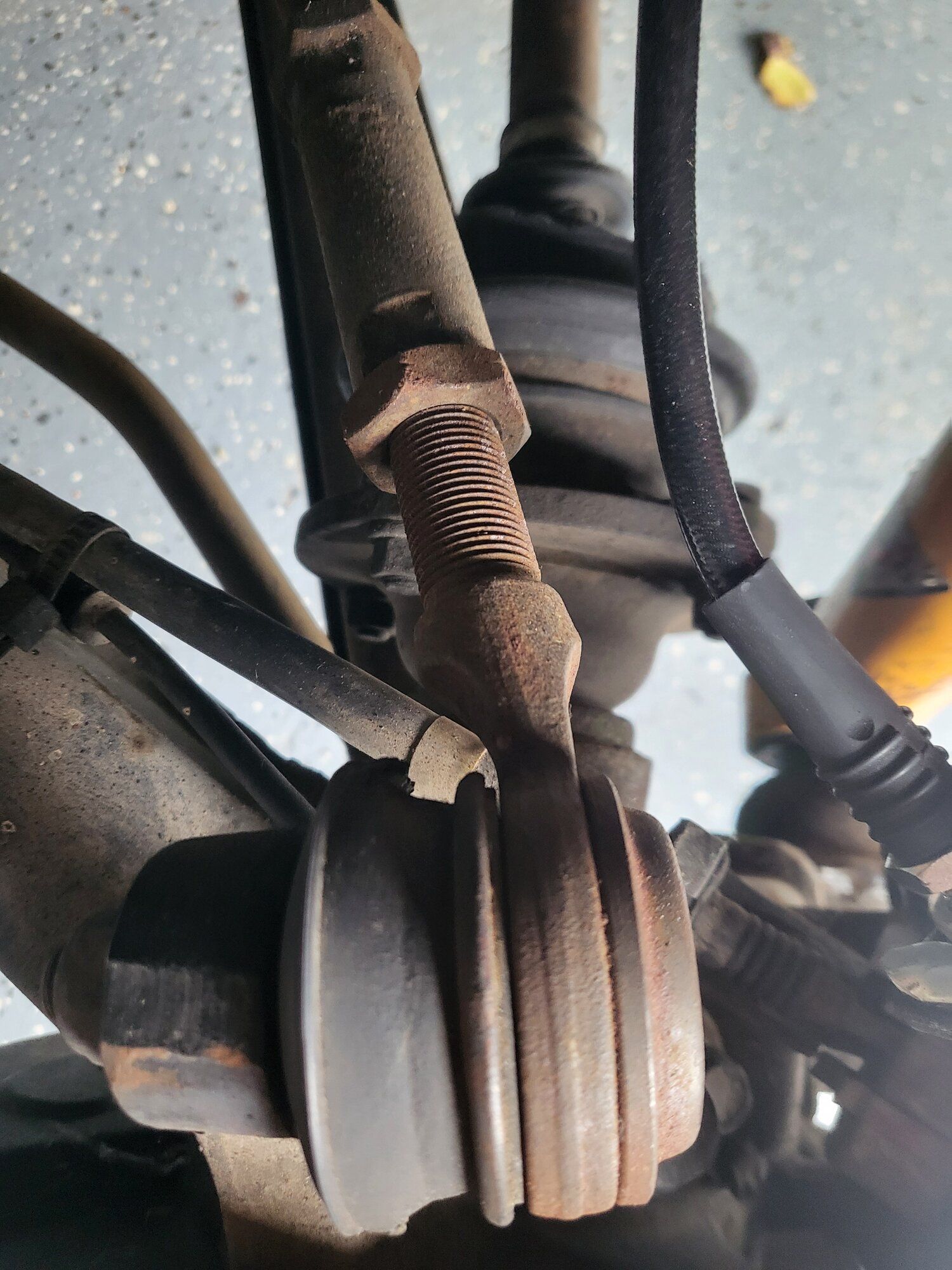

While doing a home alignment I decided it was time to change out the rear shaft that had a blown out boot. This shaft seemed slightly shorter than the OEM one but still fit. I had to pull it towards the hub to bolt it on where the OEM one seemed to naturally sit much closer. I guess time will tell if this is an issue or not.

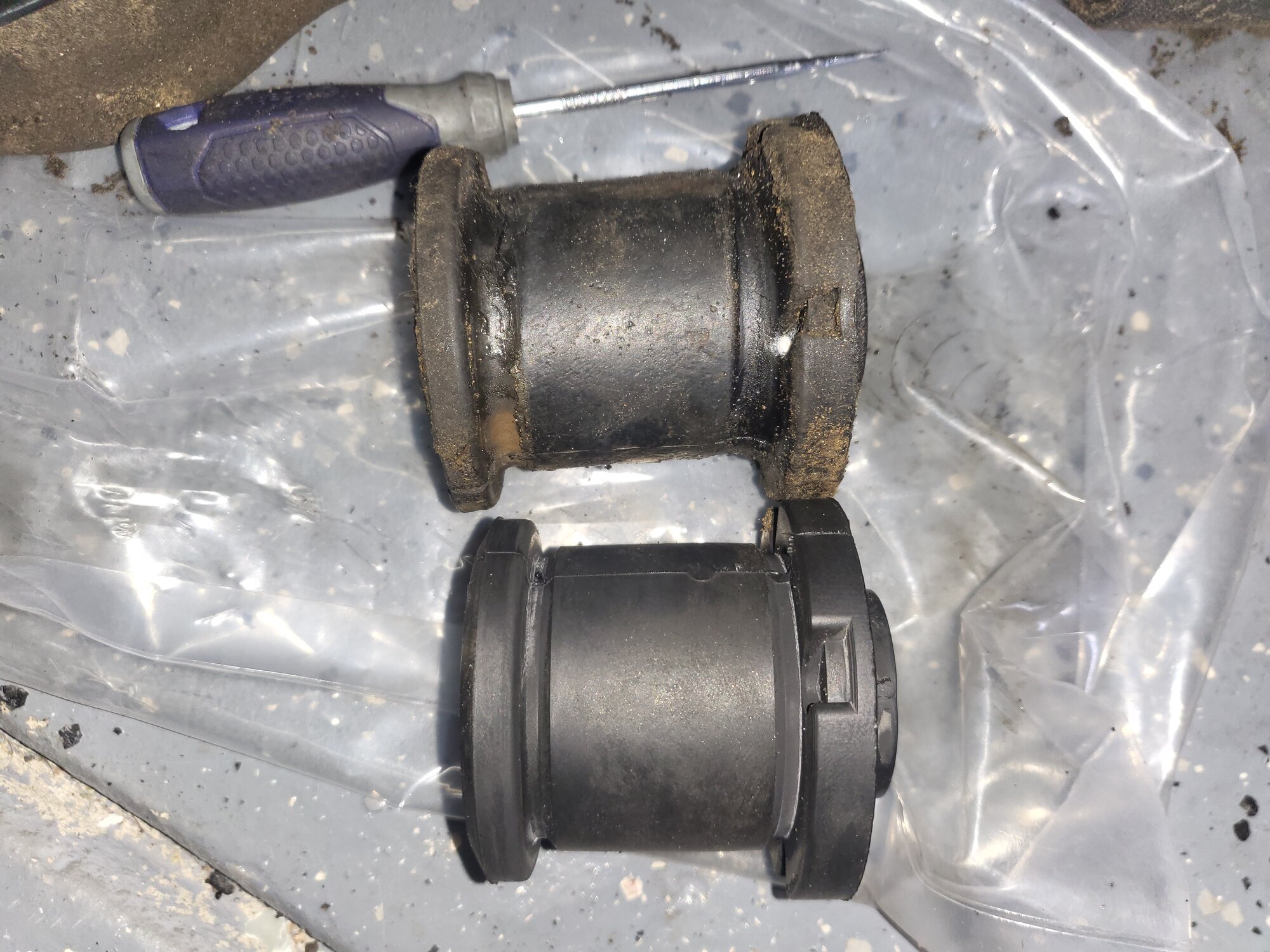

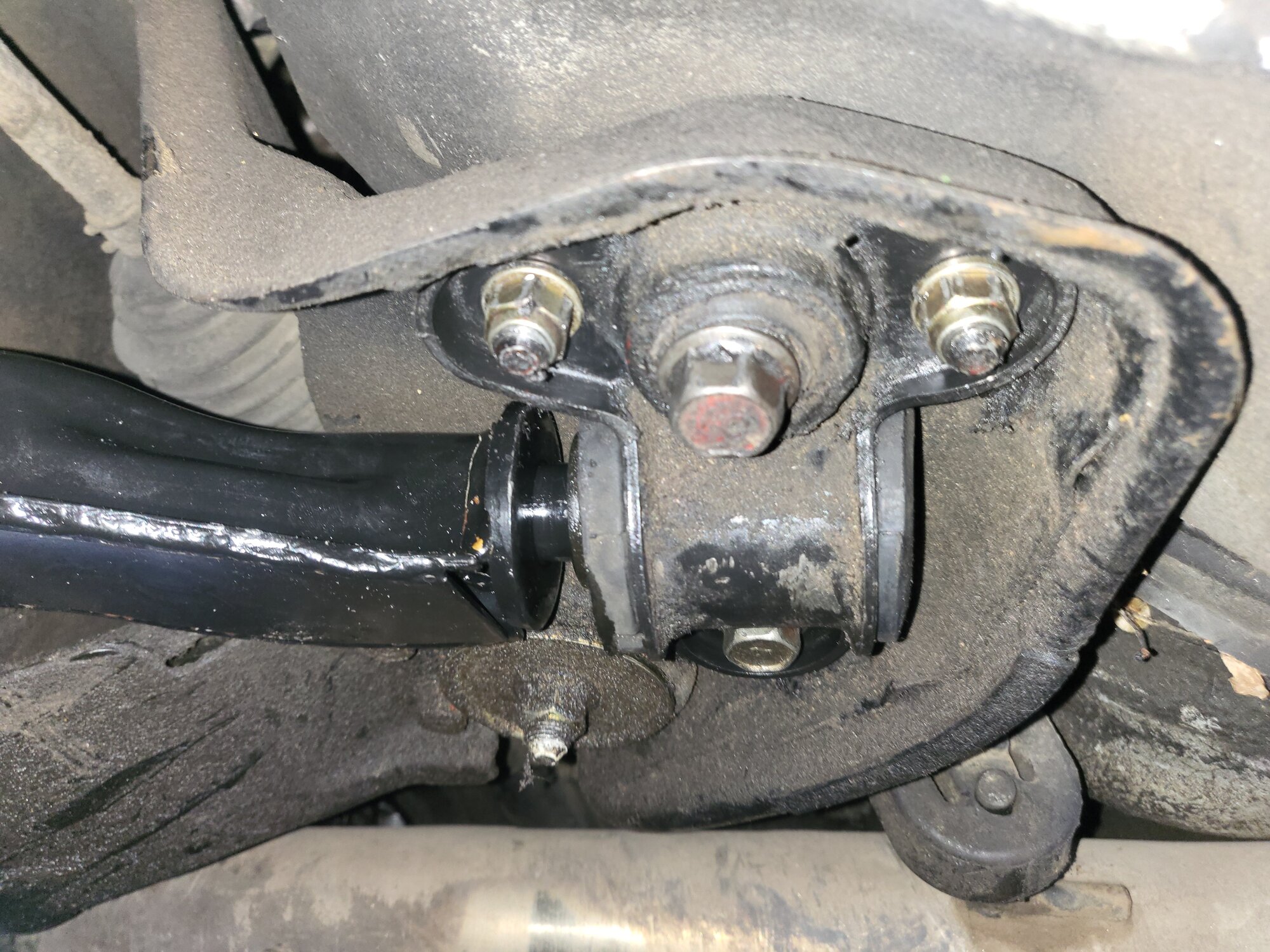

Can anyone help me ID this adjustable rear camber arm? I need to get new ends for them as theyre in sad shape. I cannot see any markings on it to identify it.

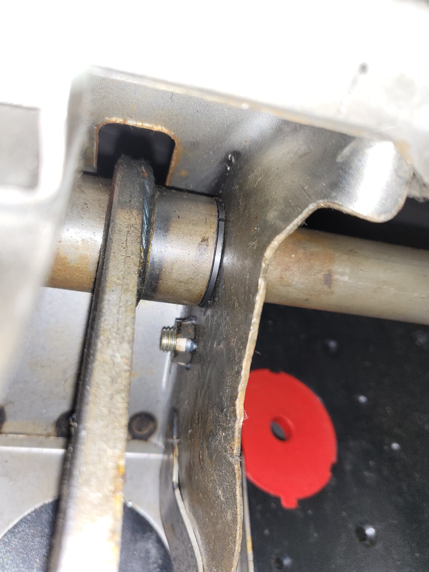

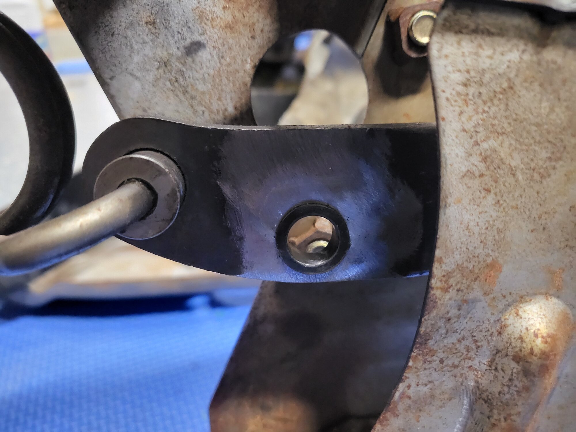

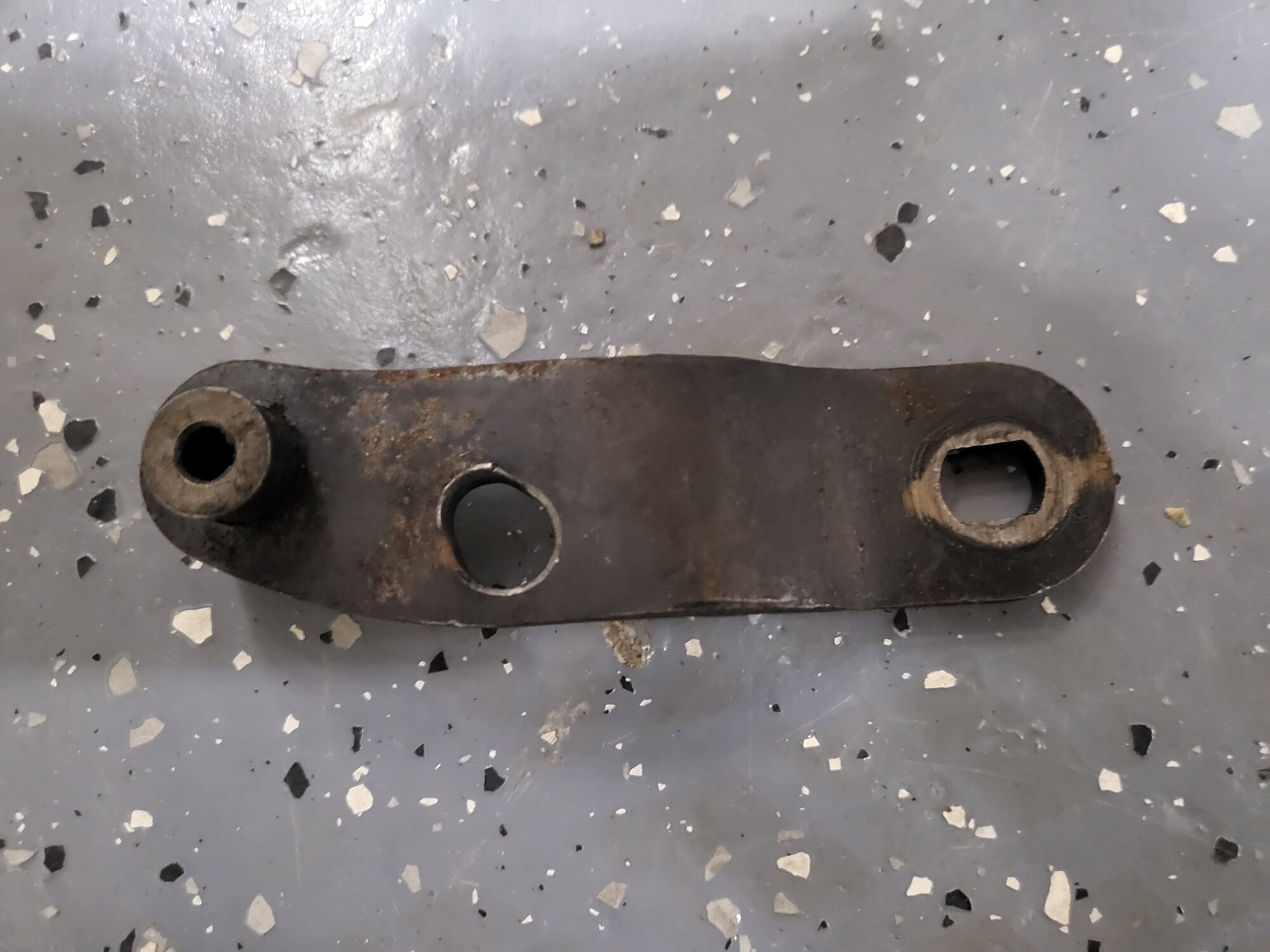

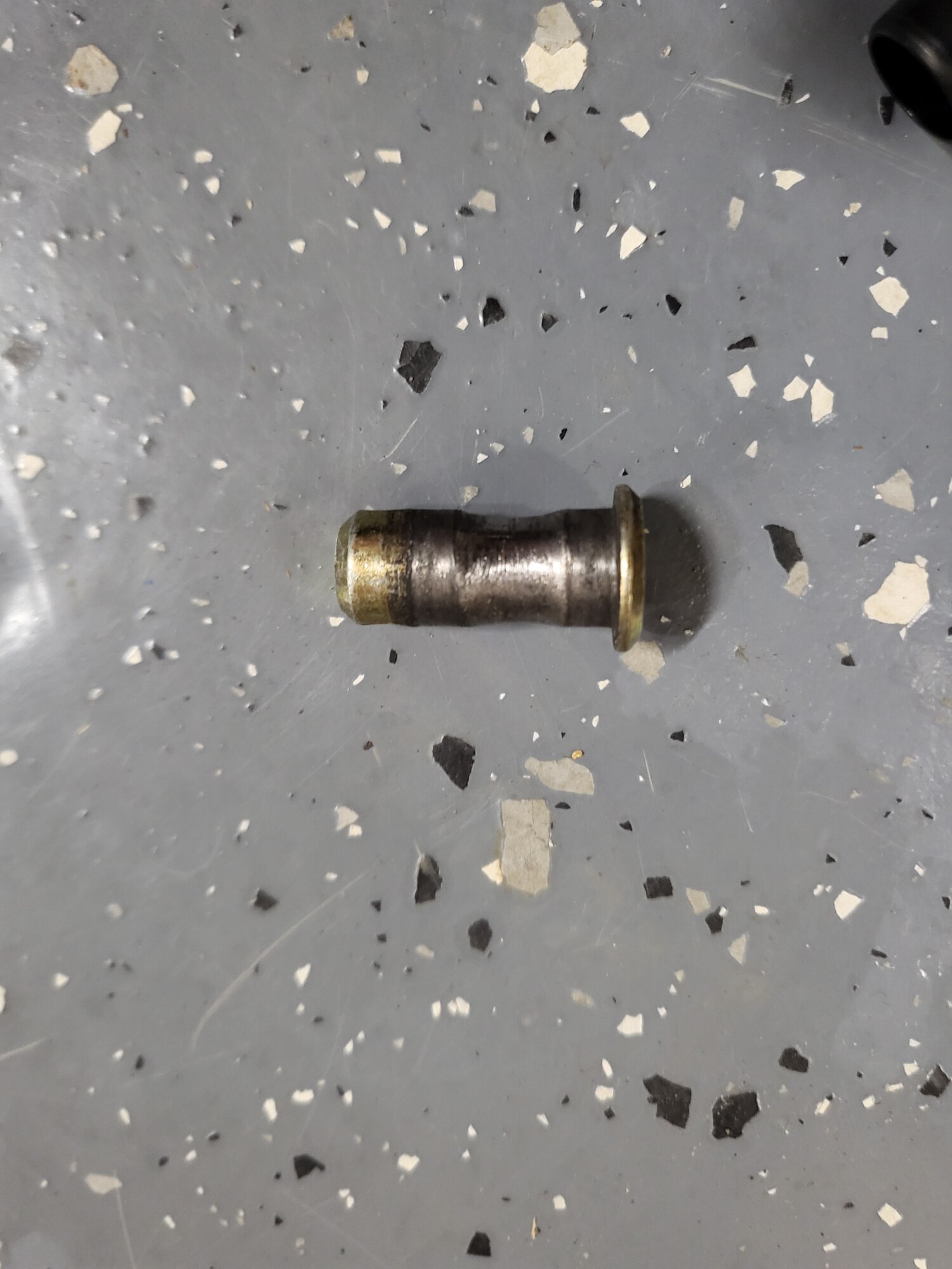

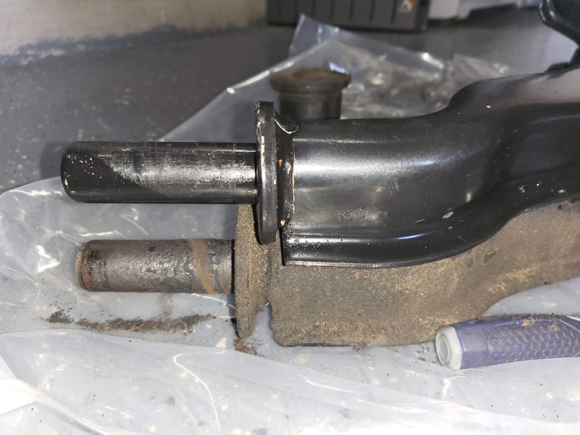

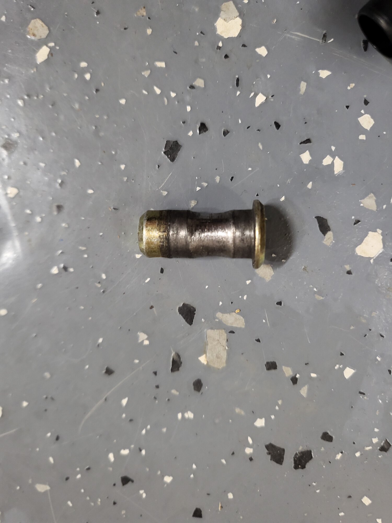

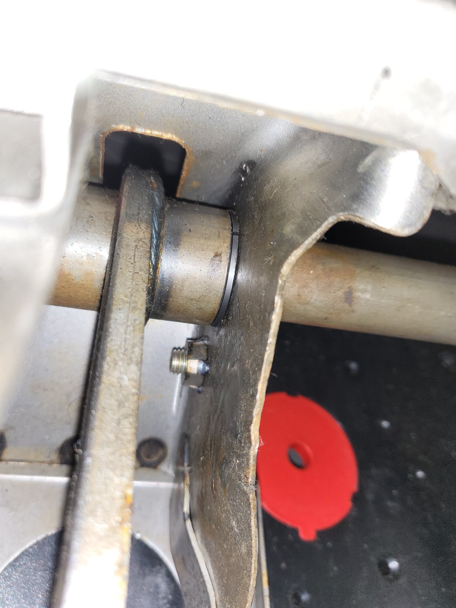

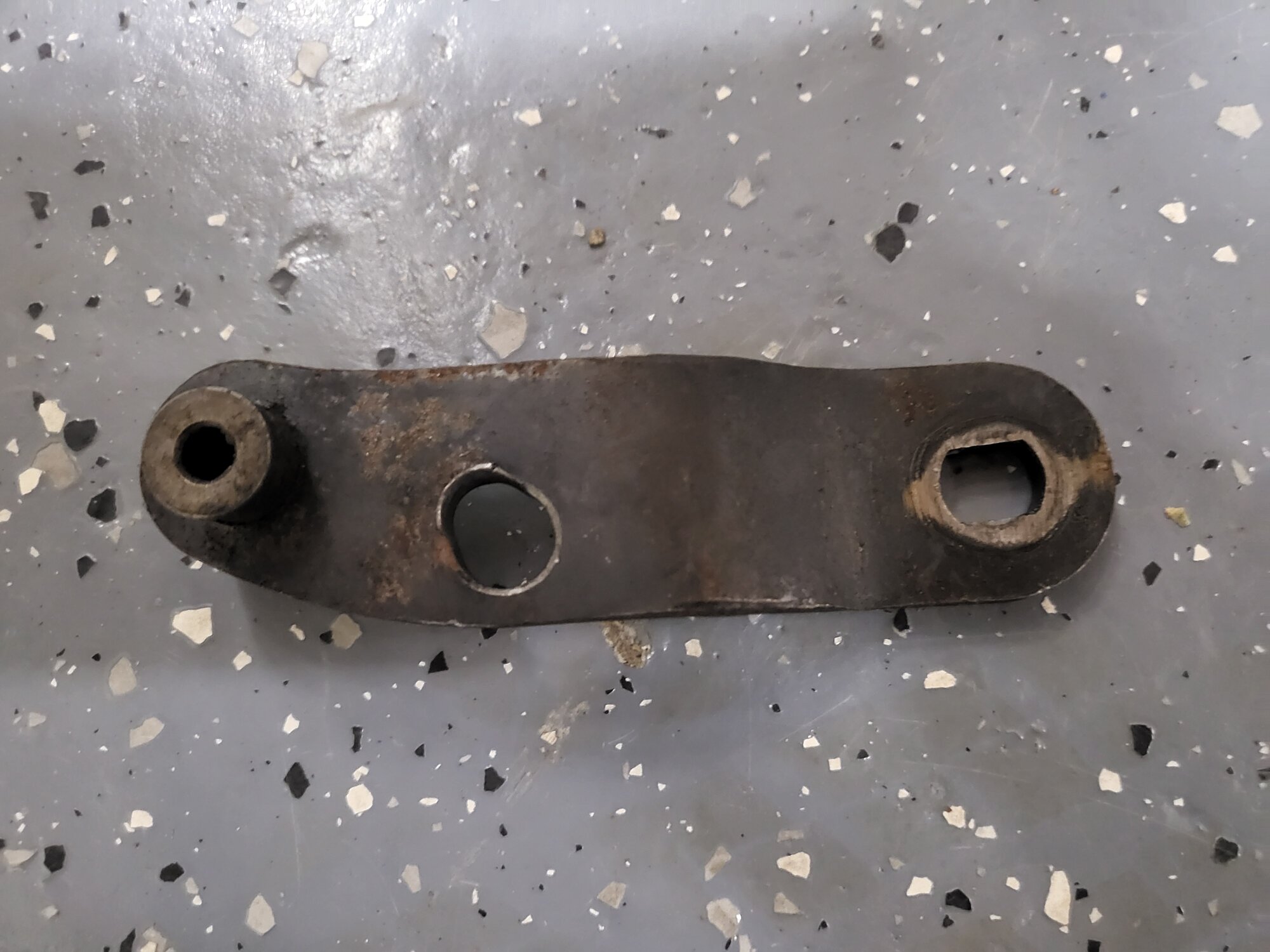

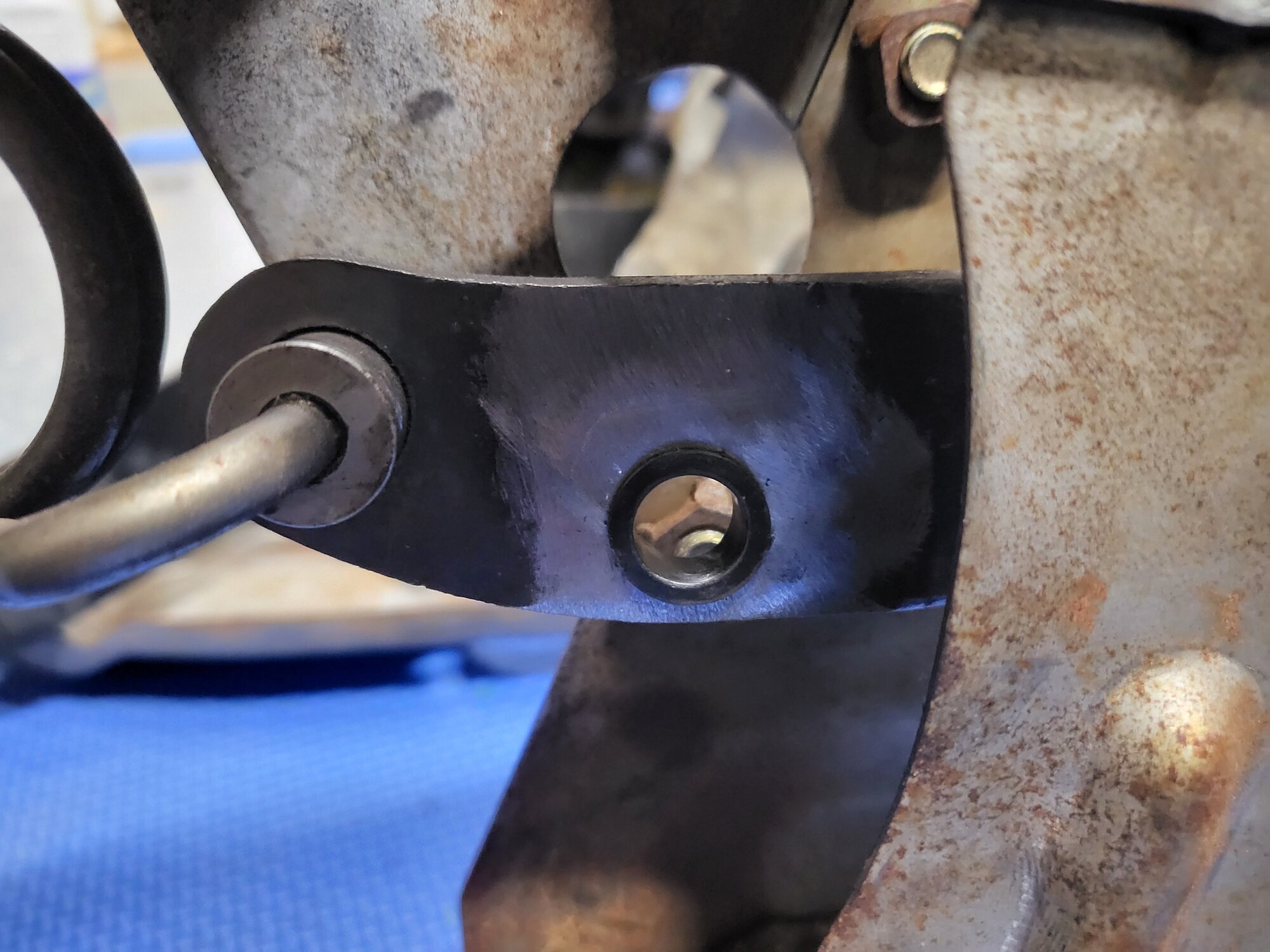

Decided to get the clutch pedal fixed. Linkages were warn out and such. You all know...

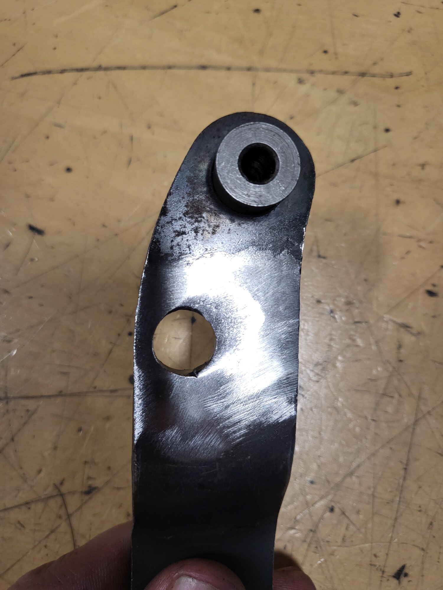

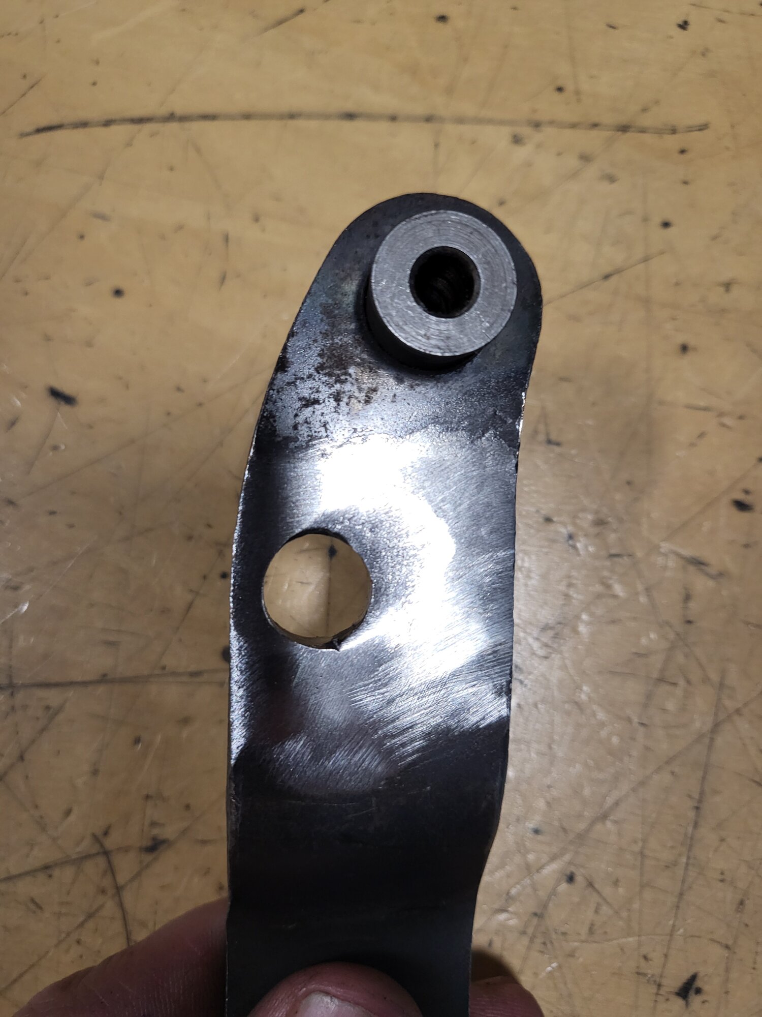

My slop was coming from this pin and arm being worn. There was no bushing to be found.
Replaced the pin and welded the arm up. Also replaced all the bushings in the clutch linkage while I was there.

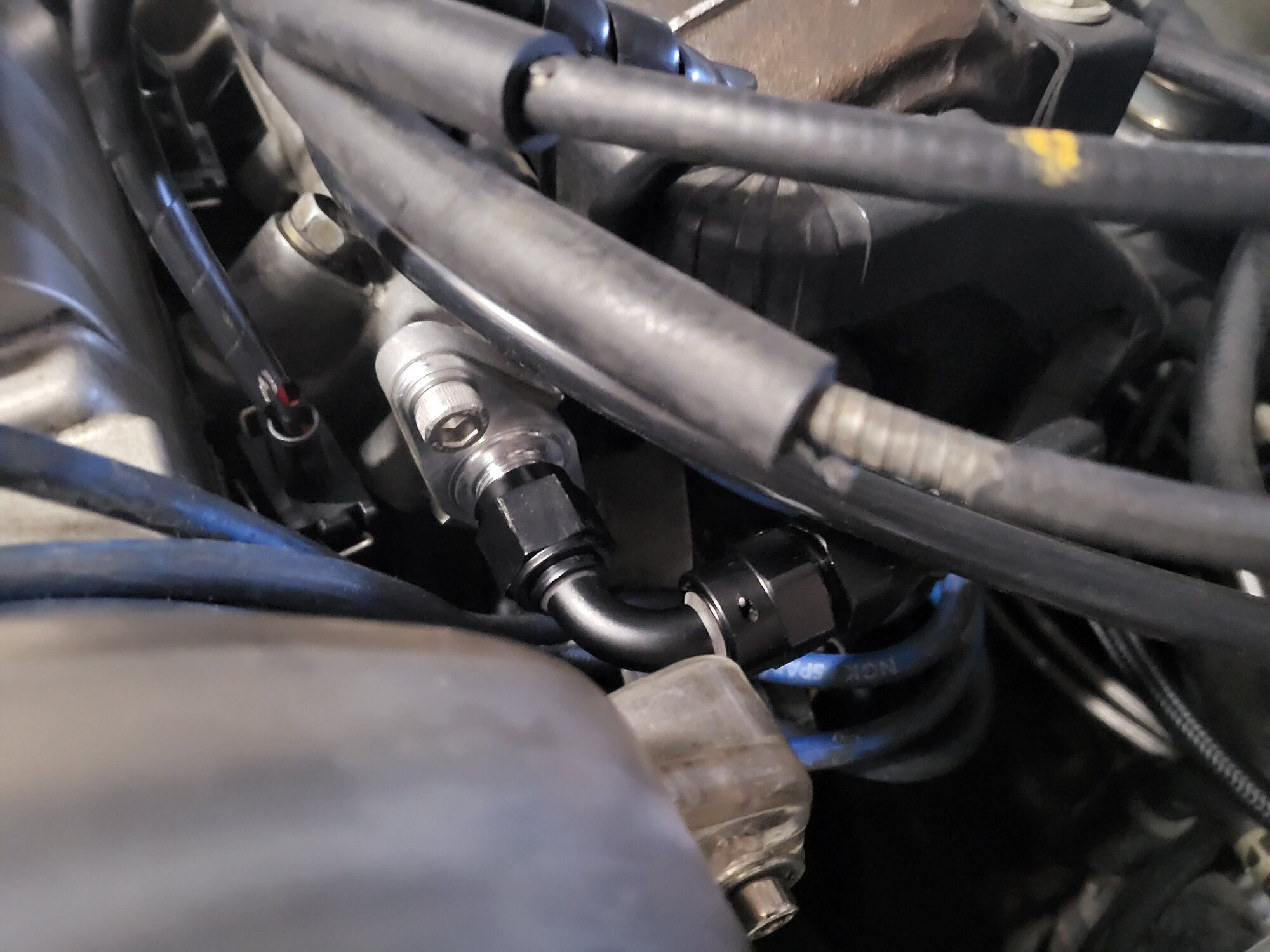

Started tuning with the help from Rix Racing. He convinced me to go E85 so I had to get bigger injectors and a flex fuel setup.
While tuning ran into some issues. I had to take my fuel pump out and re-seat the o ring at the top of the pump. I was losing fuel pressure.
View attachment 739497View attachment 739498
View attachment 739500View attachment 739501View attachment 739502
Hard to see but I think you have other problems. Look at the slotted hole where the lever bolts to the pedal. That's the usual suspect. Additionally if that hole is worn out the other side on the pedal is usually messed up too. Deserves a close look.
Believe it or not that area of my assembly was fine. No idea how. I chose not to weld it for the time being. Im sure thats going to bite me in the ass later on down the road.

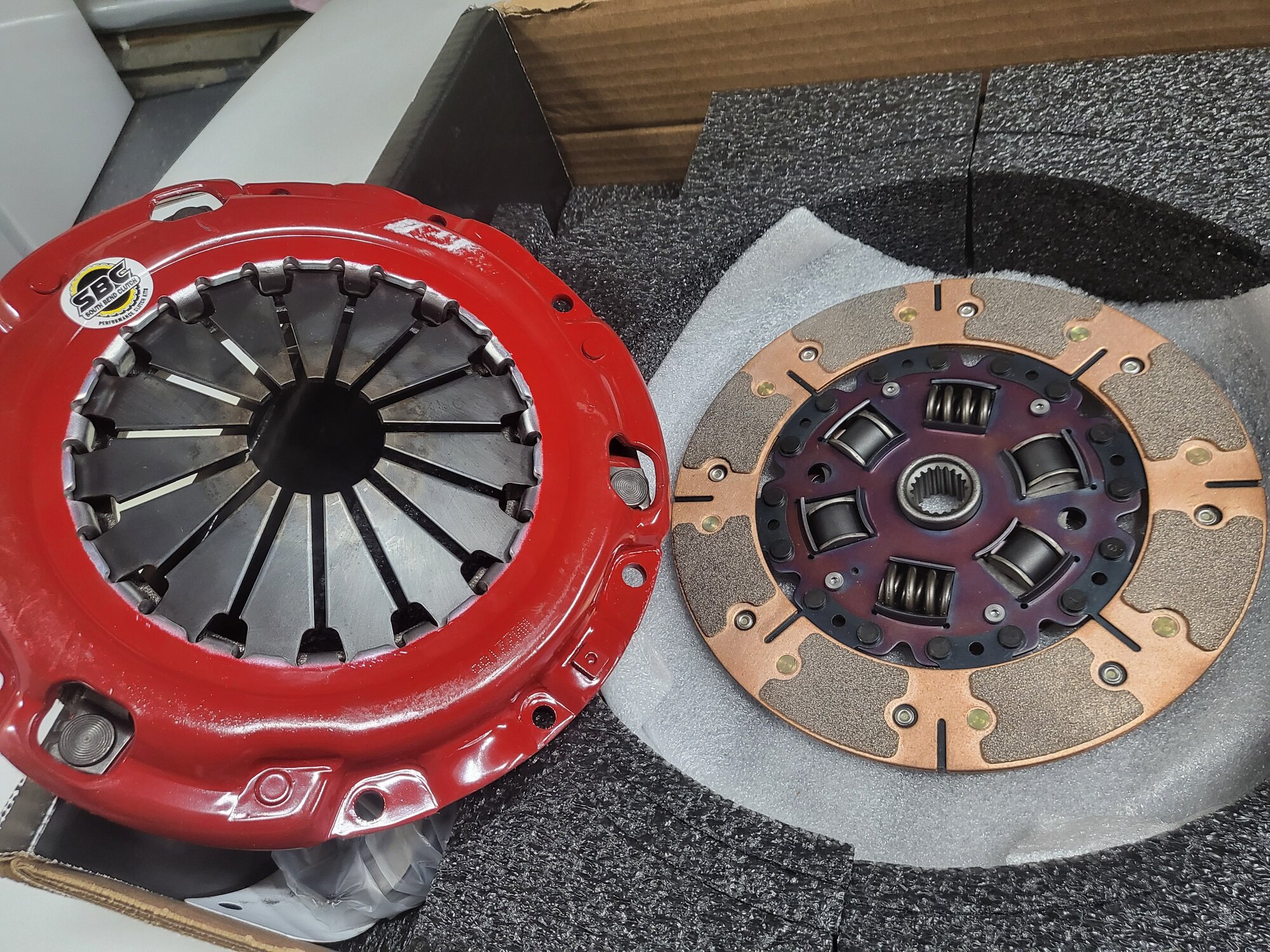

First run on E85 and I went to slipsville.

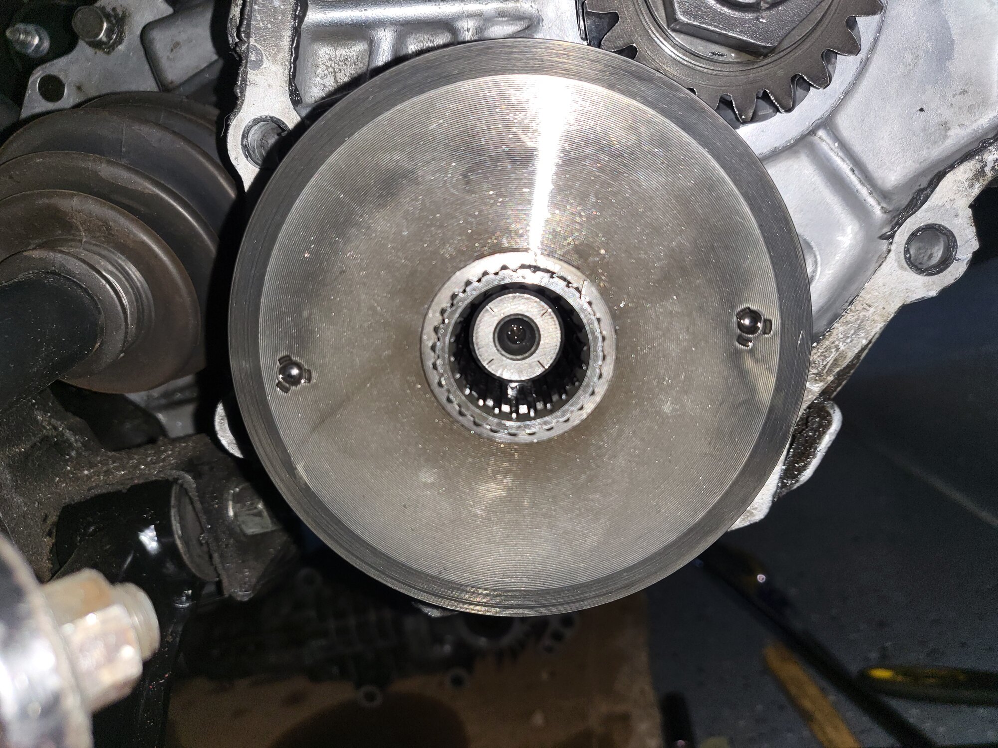

Went onto TMZ and got myself a South Bend setup. SS-Series 2200 pressure plate and B-Series Full Face Ceramic disk. So far loving the feel and it grabs extremely well. Didn't want to beat too hard on it since im still having it tuned.

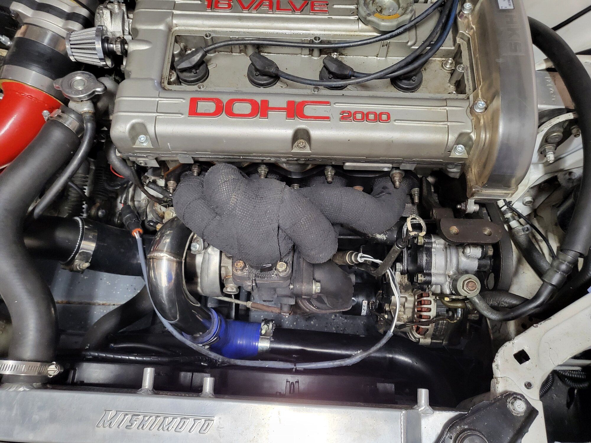

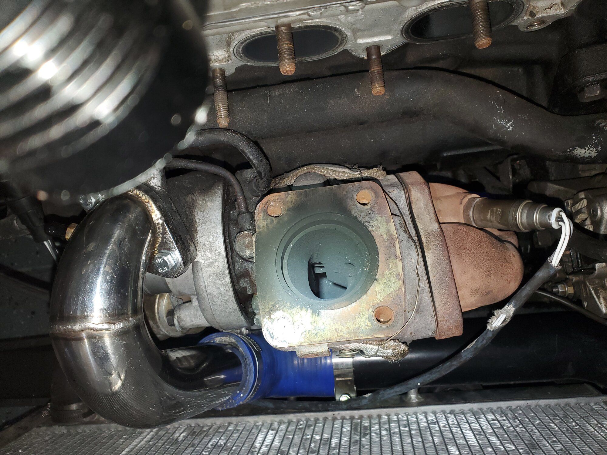

Since the car was apart, I decided to swap the EVO 16G to a modified EVO 16G hybrid thing Justin Whitesell made for me. Its 48/70mm instead of the stock EVO 48/68mm. New on left, old on right.

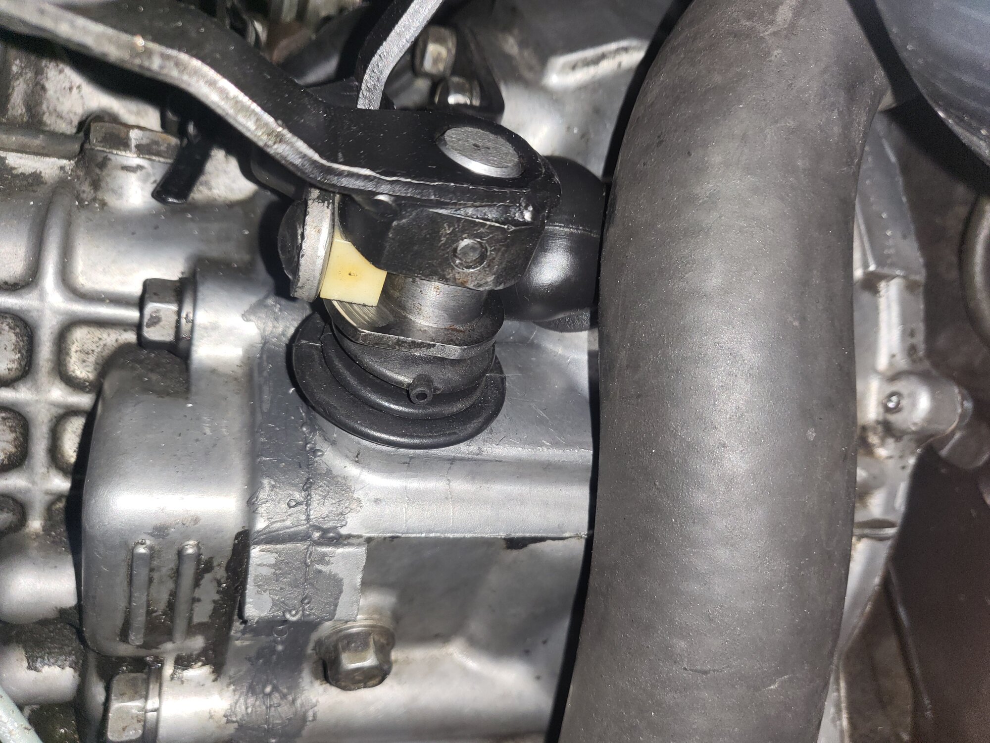

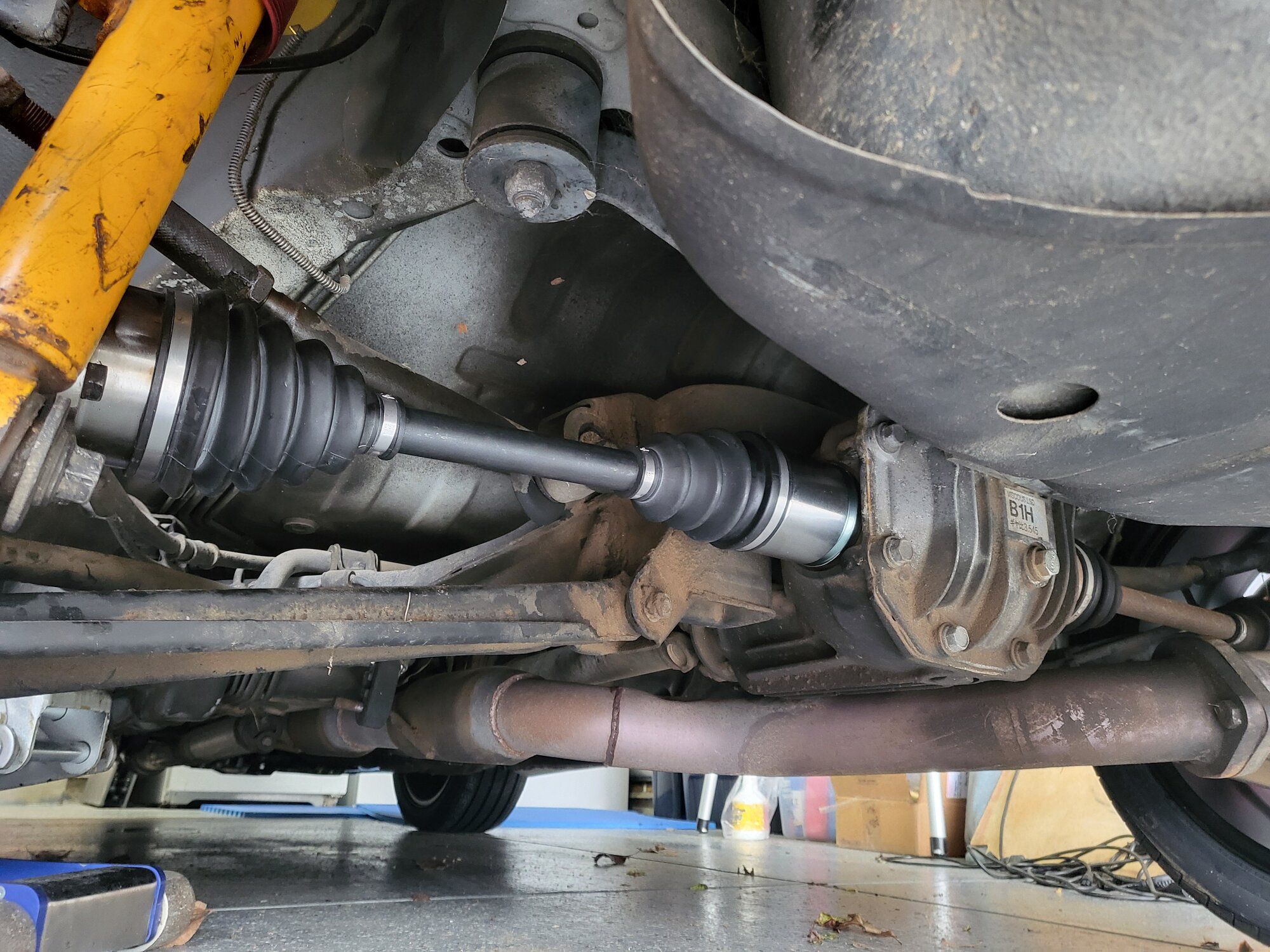

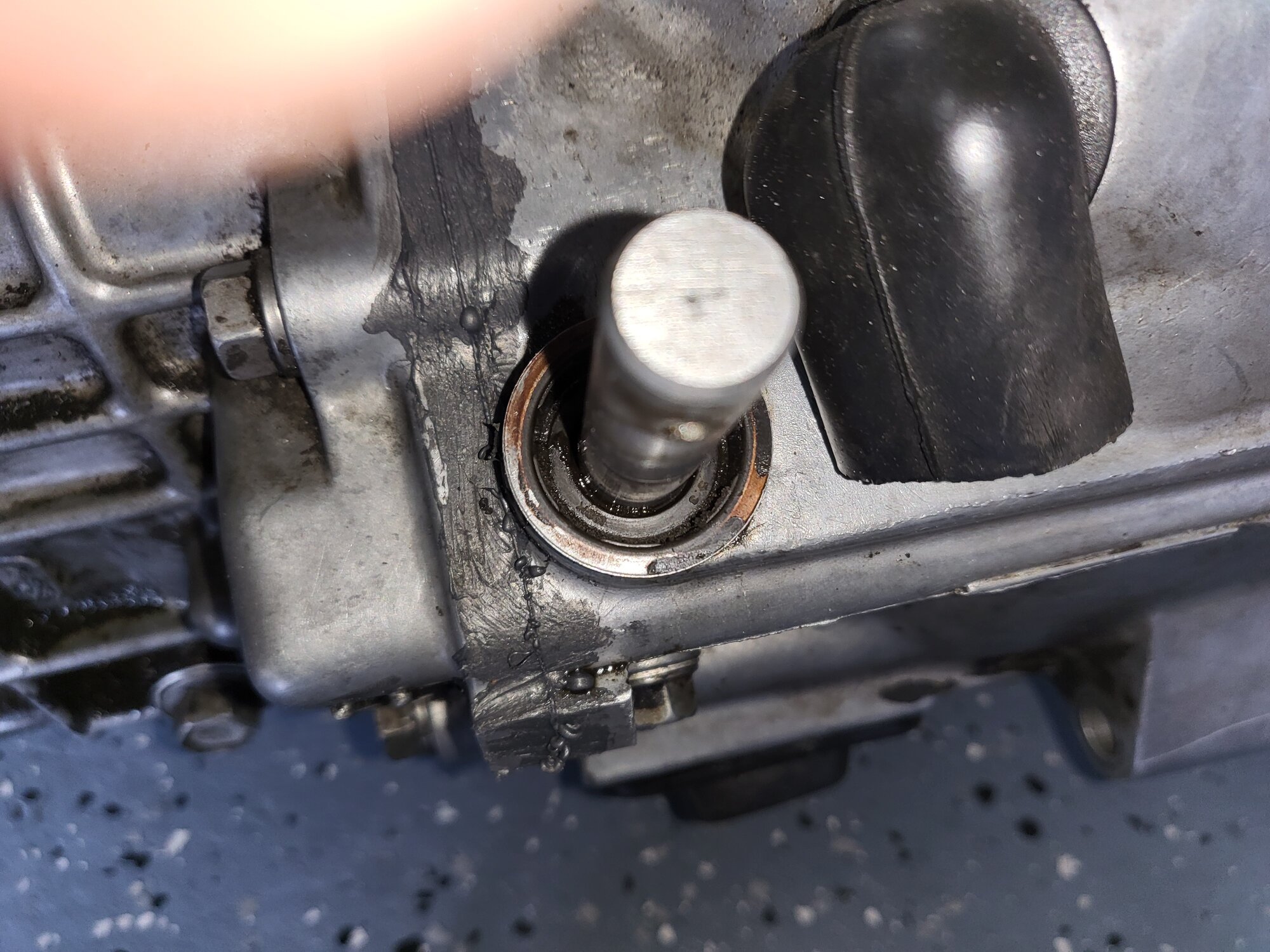

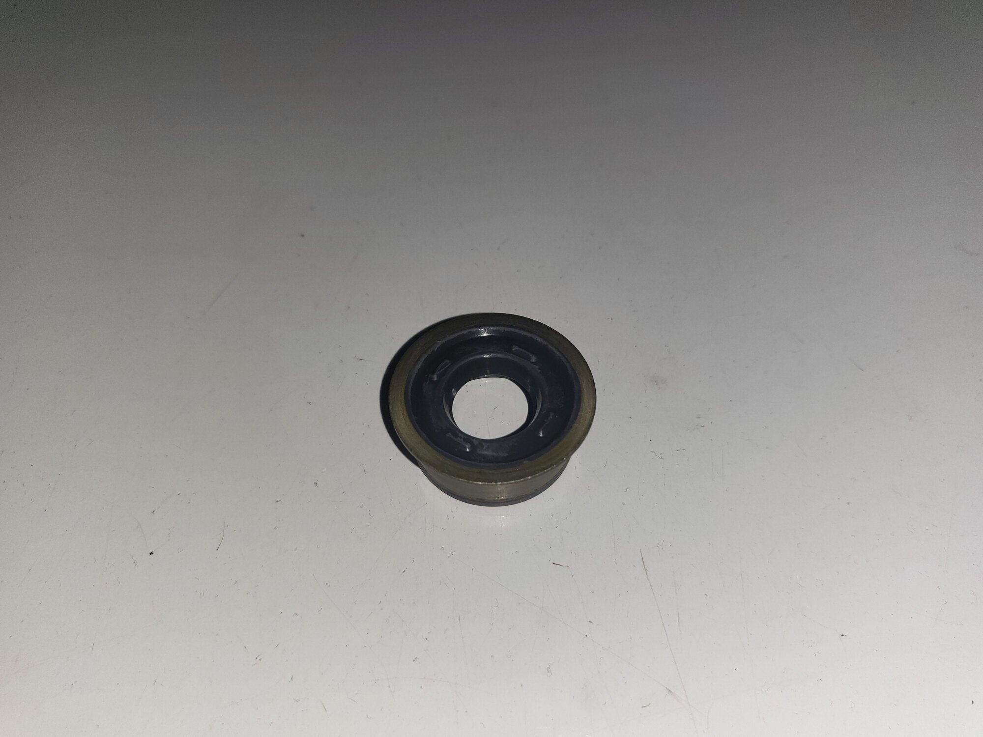

While I had the transmission out AGAIN I replaced both axle seals and the shift shaft seal and boot.
The seal part number is MD747660 and the boot part number is MD718557.
This is the tool I used to remove the tapered pin that holds the linkages together. I added a picture just in case the Amazon listing changes. It is basically a motorcycle chain breaker tool. Made the job easy and can be done without removing the transmission.

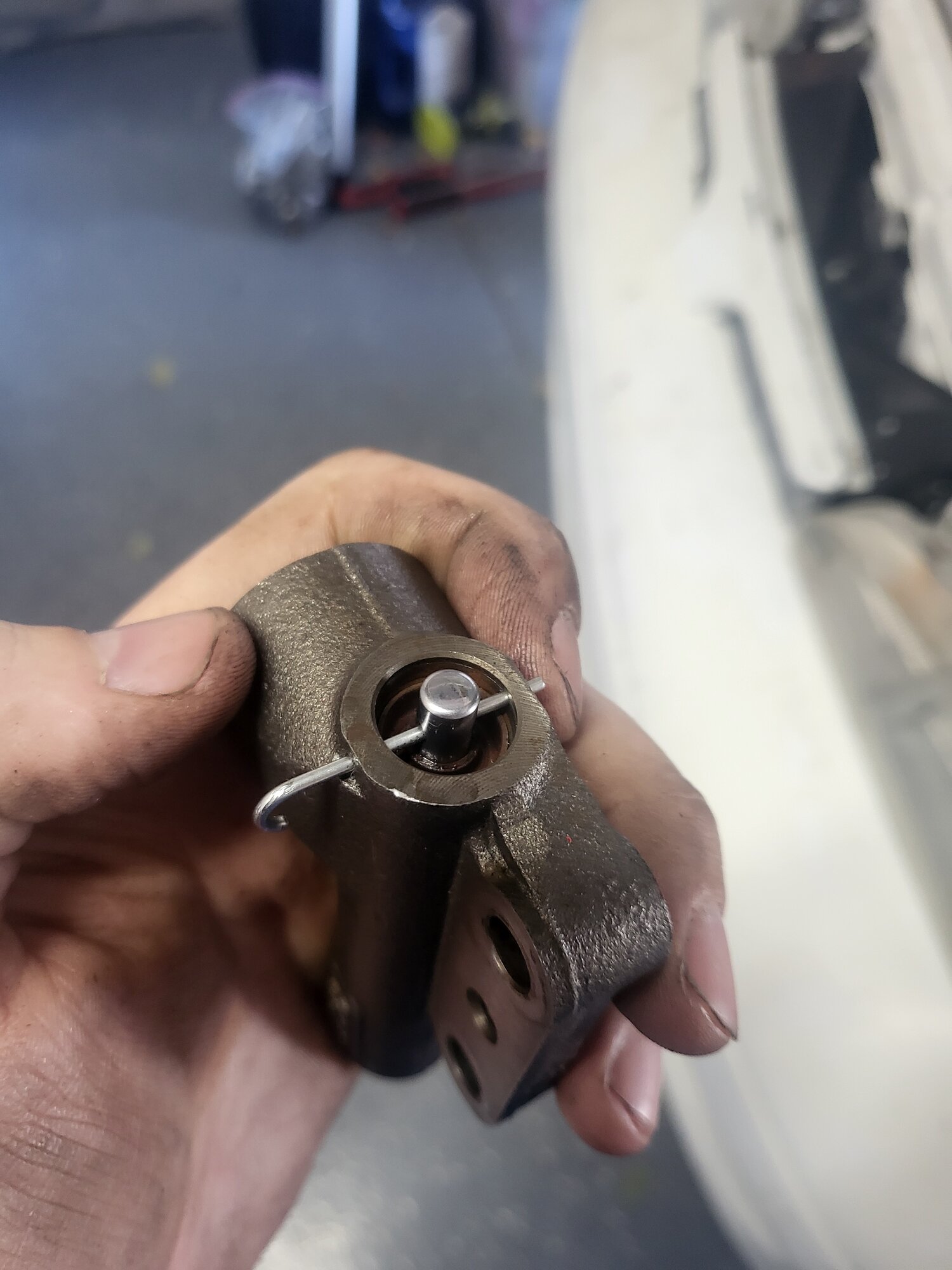

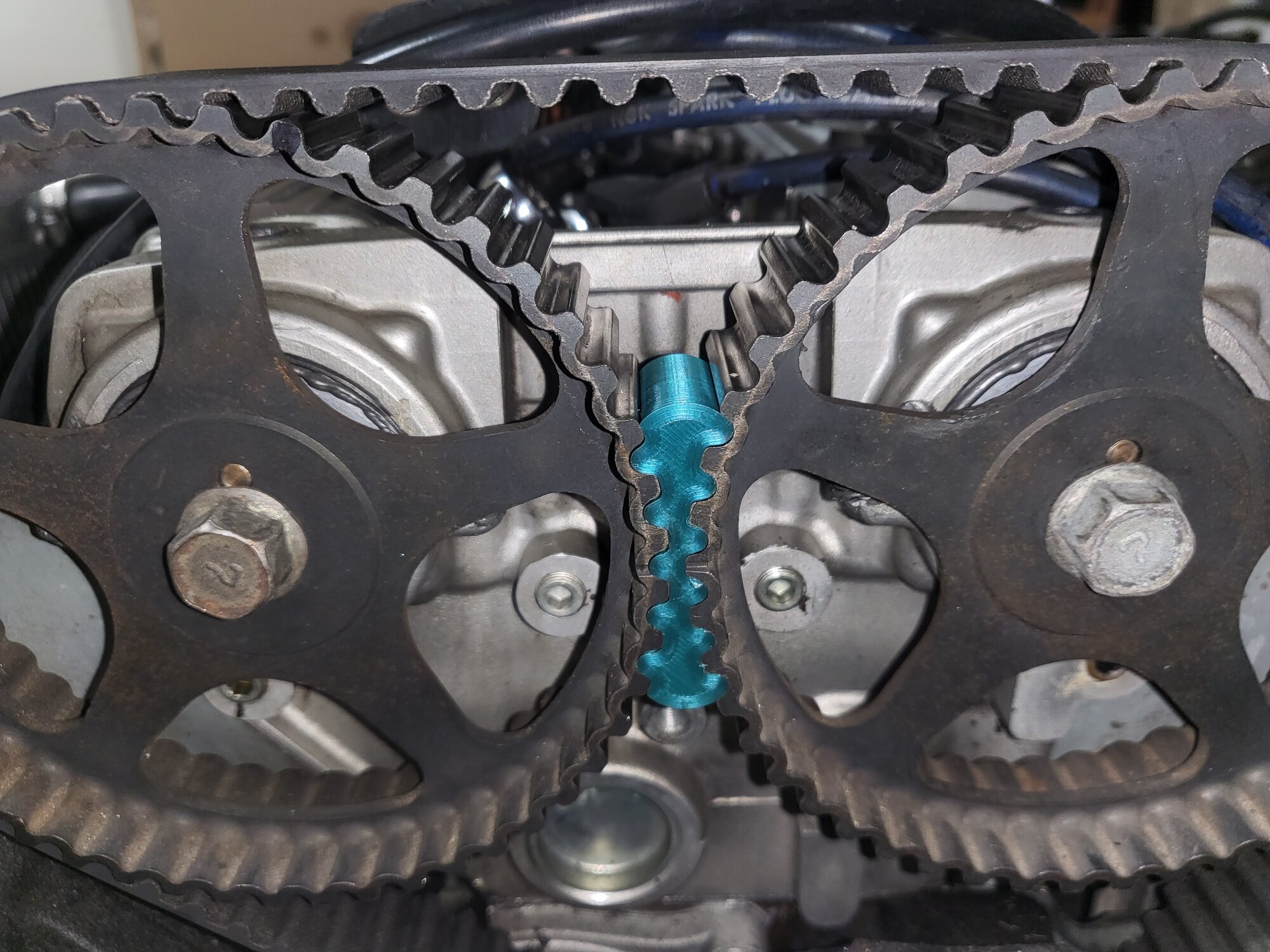

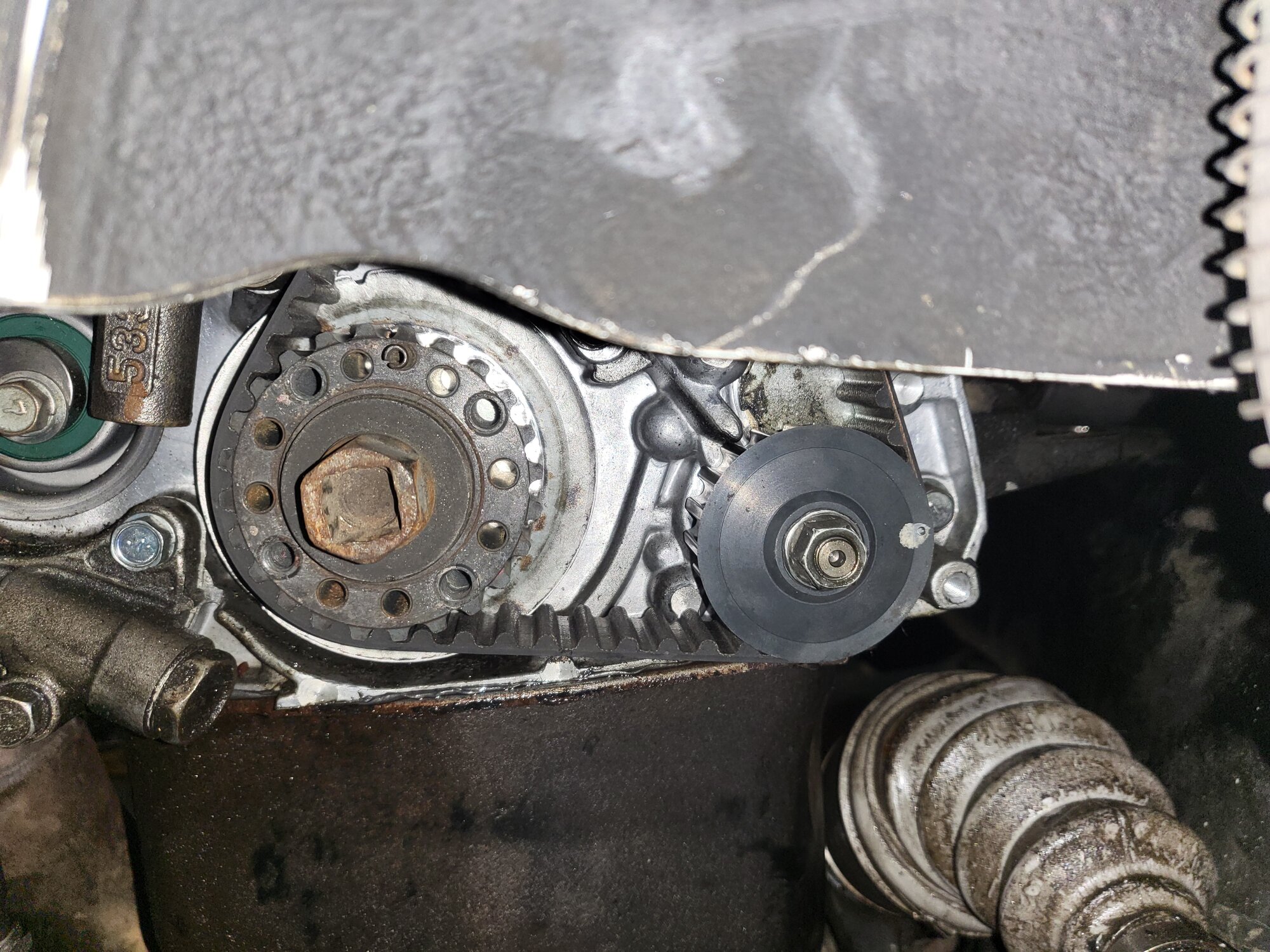

While doing the clutch I had an oopsie moment and the crank timing gear slipped on the timing belt. Turns out it was a blessing in disguise. It looks like the tensioner was not properly set by the previous owner that did the engine rebuild.
I 3D printed a cam gear tool and made a new grenade pin from a R clip I had laying around. Set the tensioner properly and made sure it was all tightened down. The image is of where the crank ended up after I got the tool into the cam gears, this is not where I set it to fix it. I seem to have not gotten a picture after it was repaired.

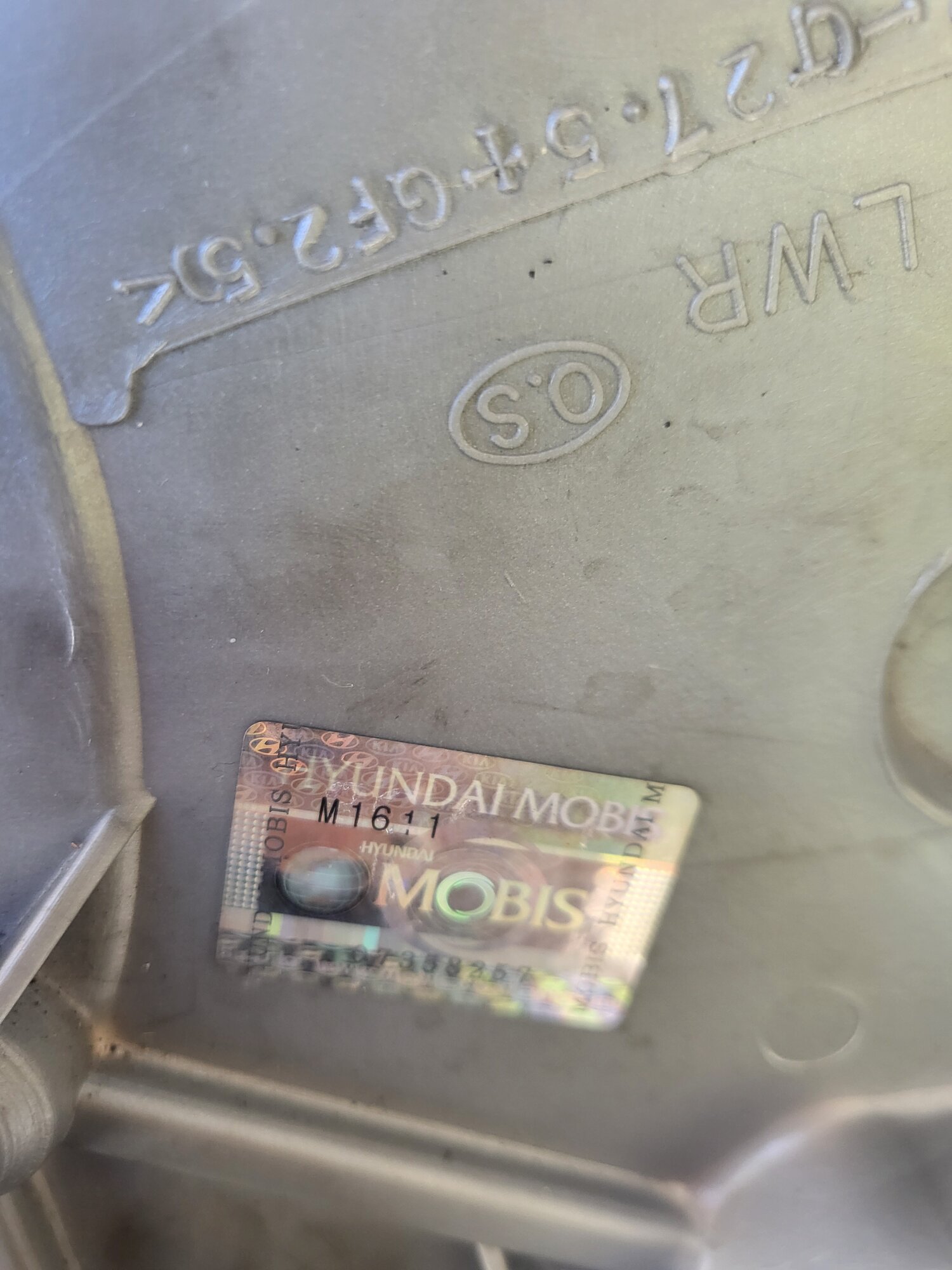

Since I had the timing cover off I decided to replace all the bolts with OEM hardware from ExtremePSI. The hardware I pulled out was not at all the right stuff. Which seems to be an ongoing theme with this car. Oh I found a Hyindai sticker on the timing cover!

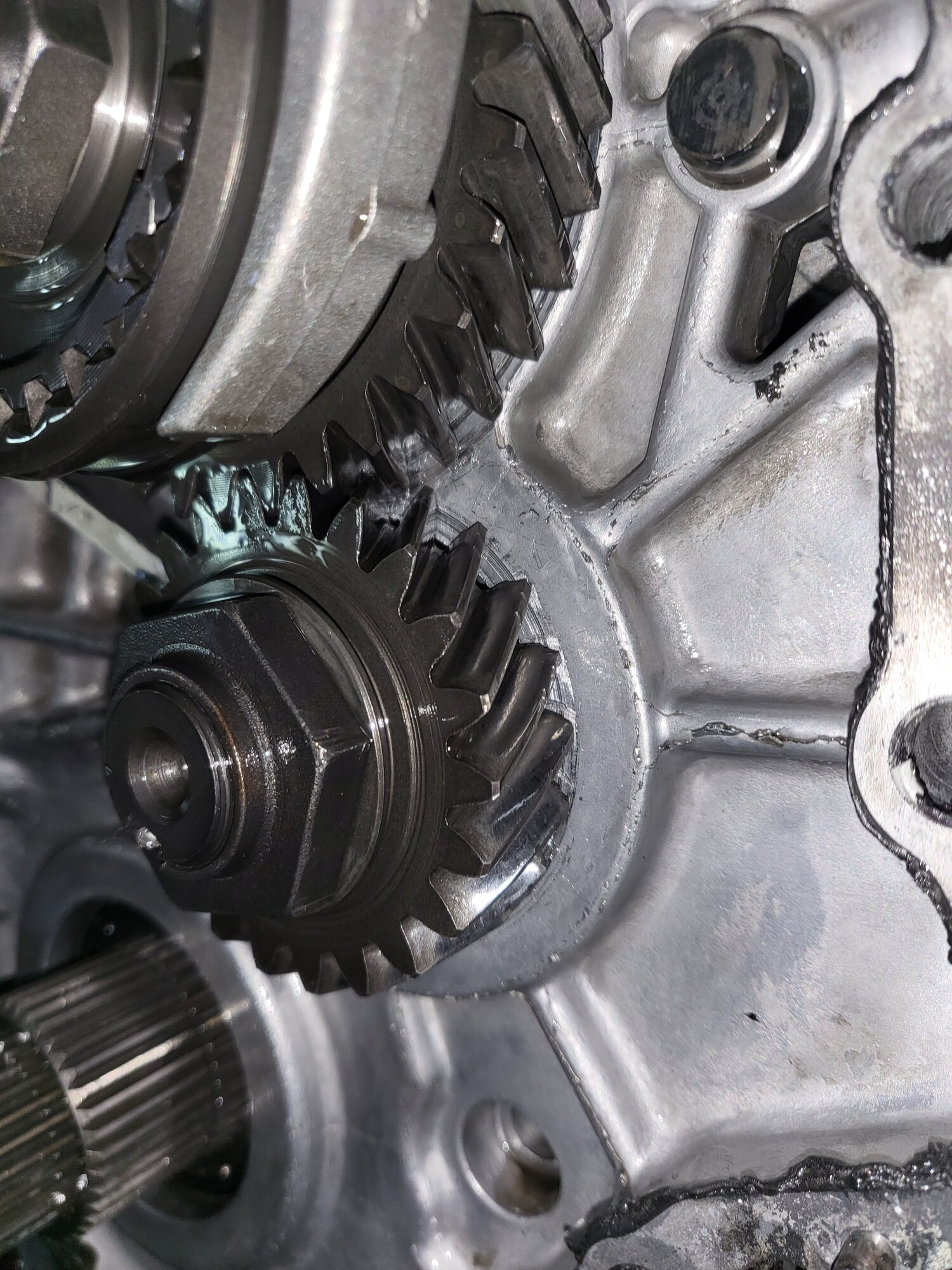

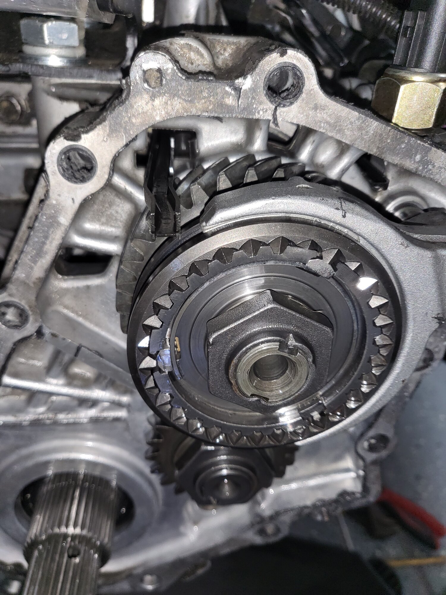

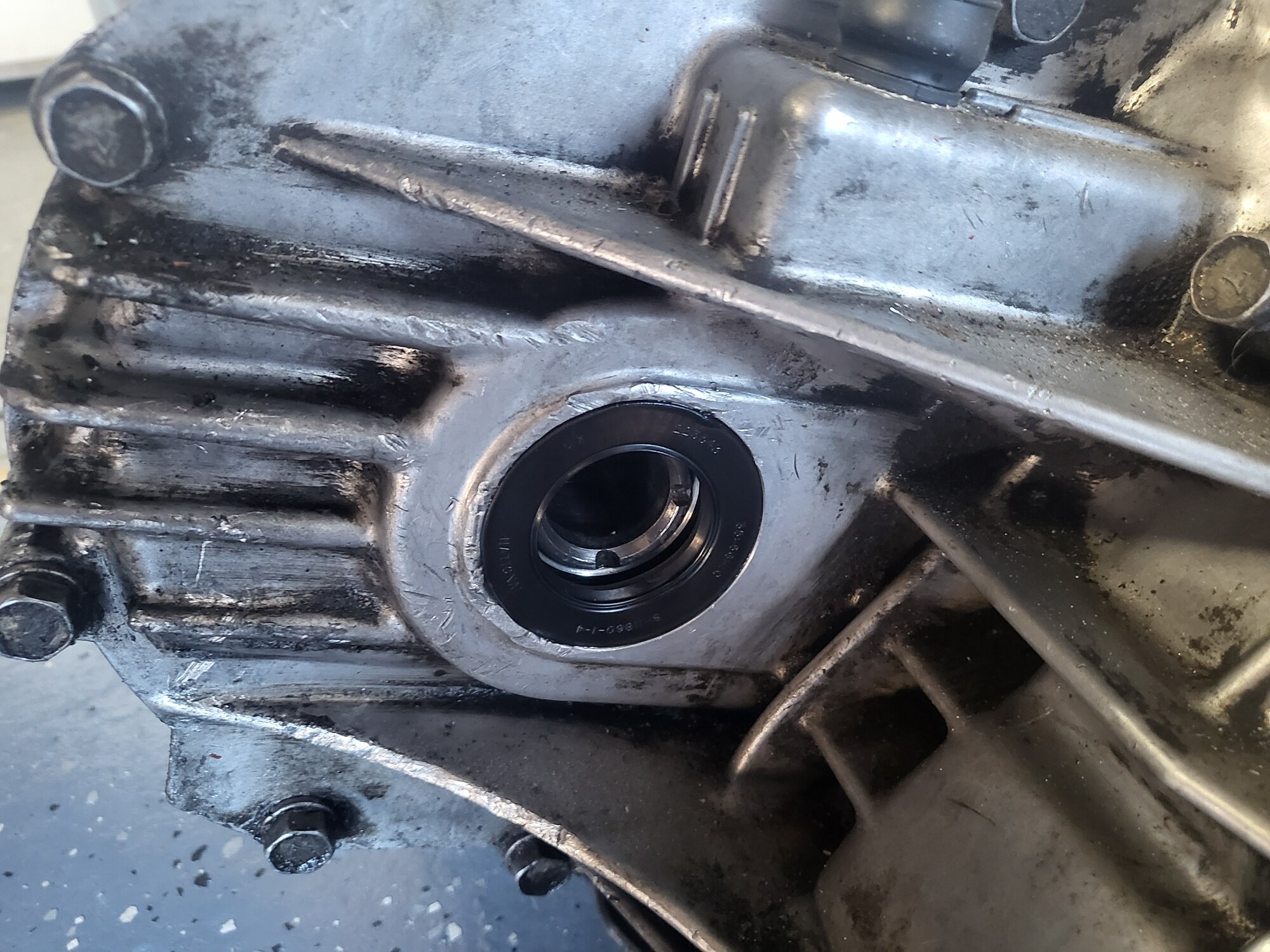

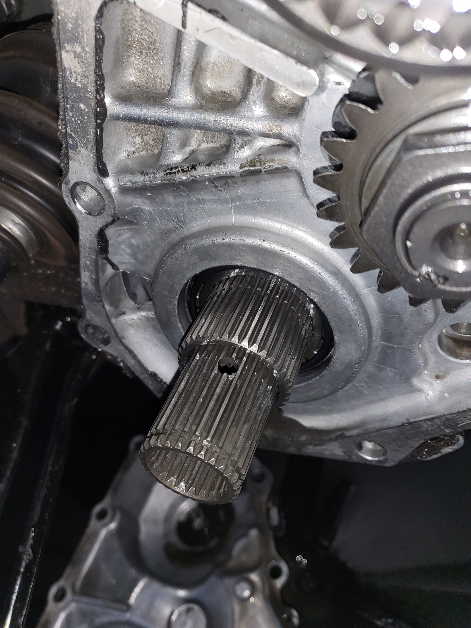

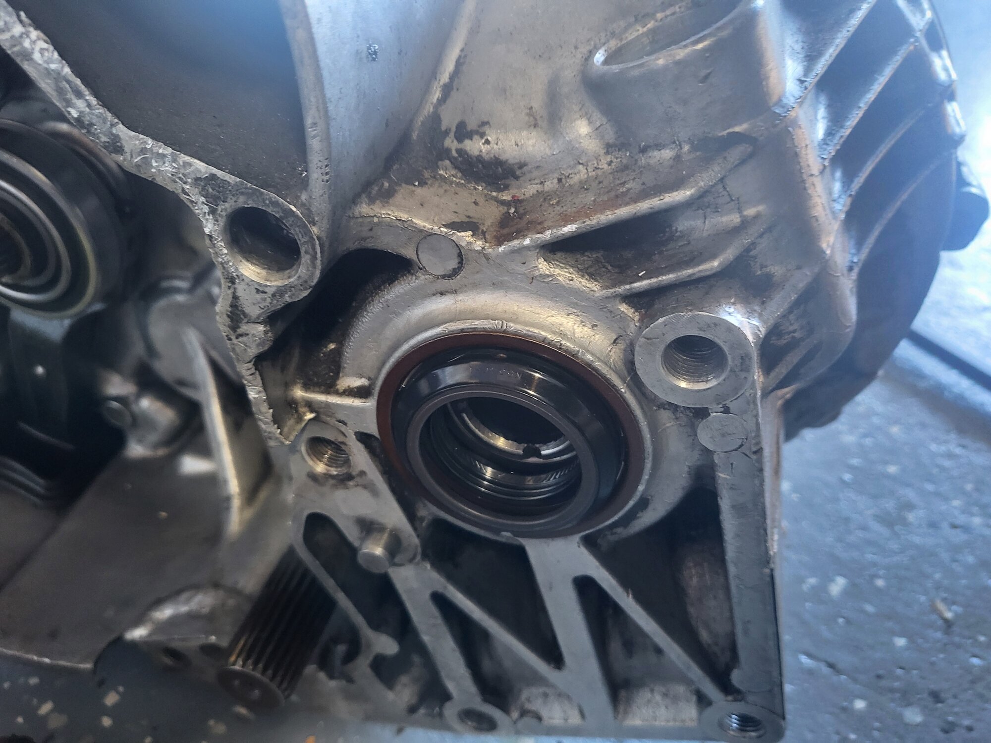

Replaced the output shaft seal going from the trans to the transfer case. The seal looked great but was leaking pretty bad. Didnt seem to get any pictures of the seal area but got some of the inside of the transmission!
Not sure why there is wear behind the gear in the 4th picture. If anyone has any ideas please share.

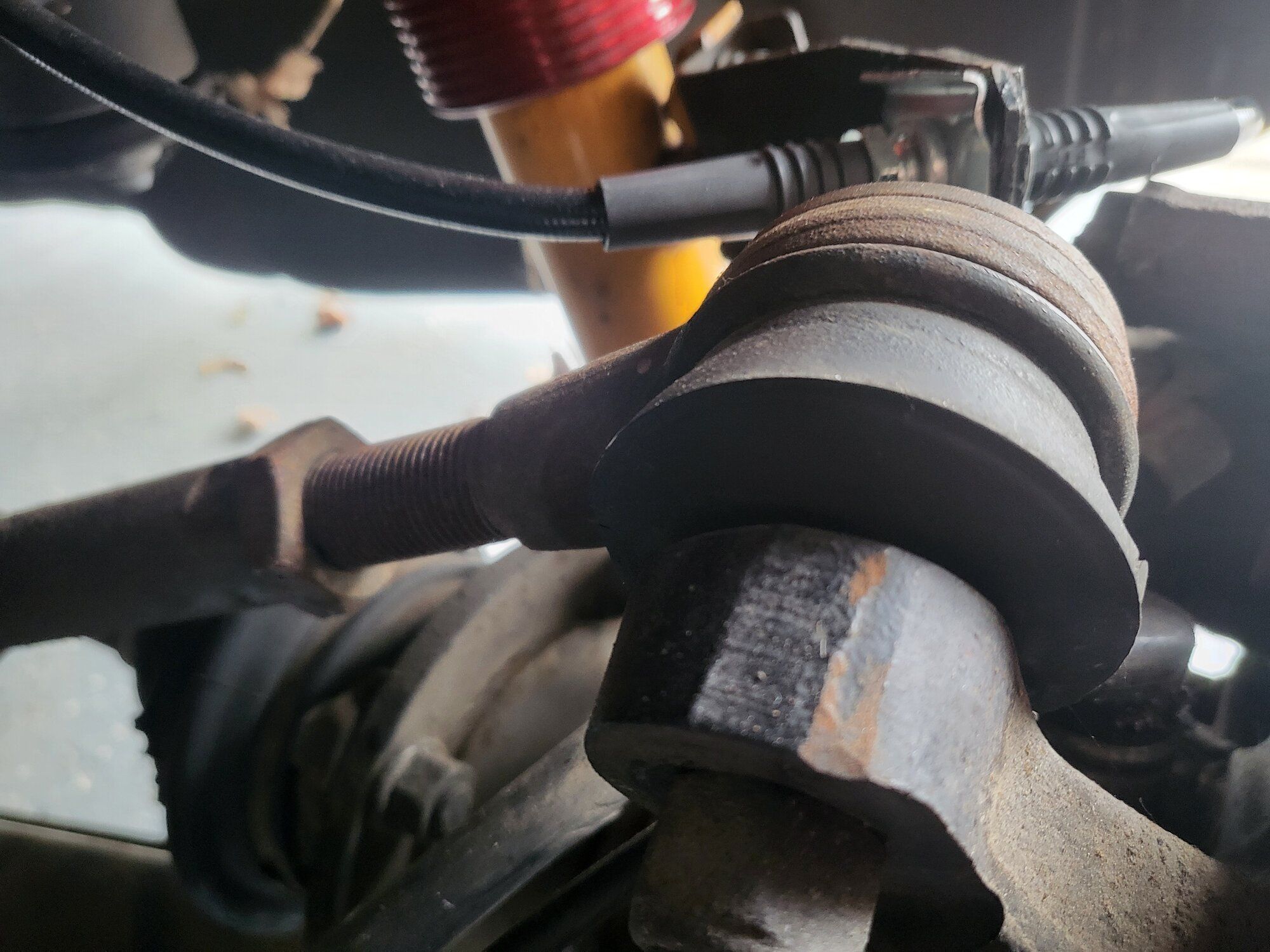

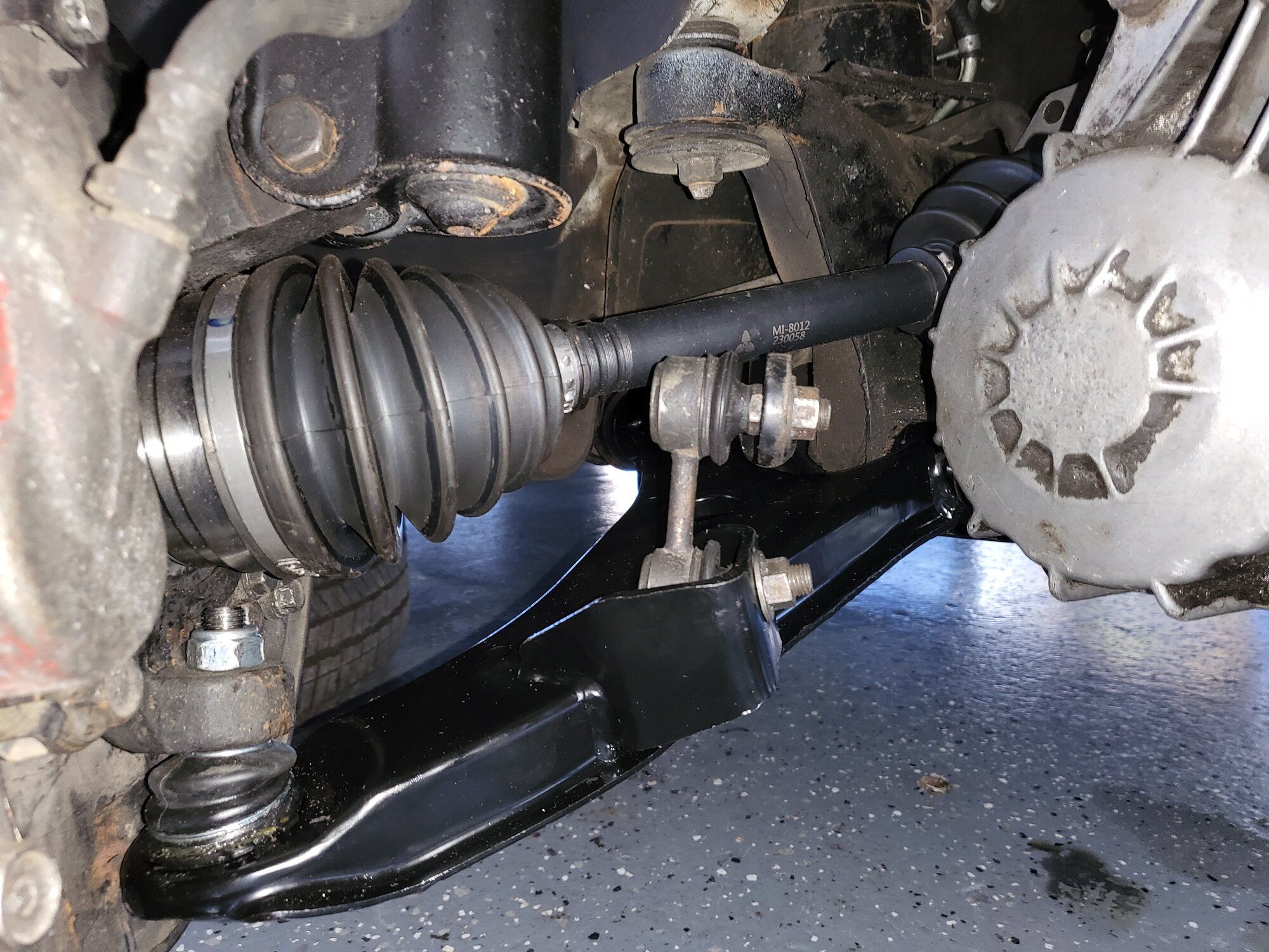

Replaced the front left lower arm. The Mevotech CMS9844 arm I got looks to be a little short and the rear bushing was also short. I had to reuse the old bushing for the time being. I plan on replacing this again very soon.

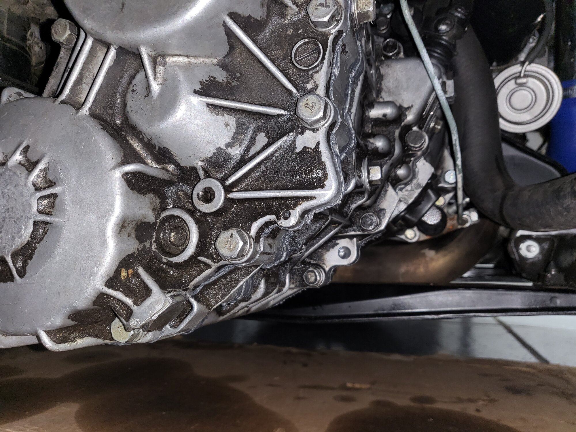

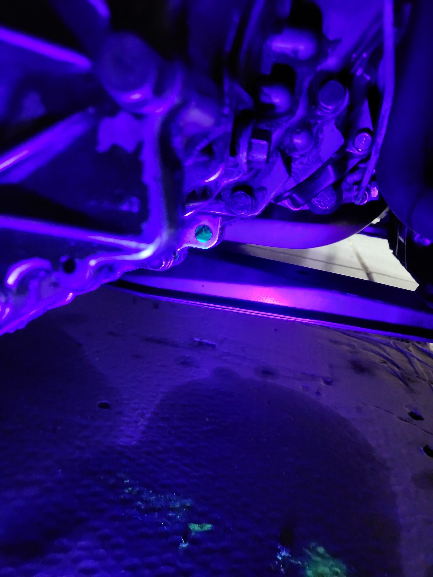

Trying to fix all my transmission leaks. After replacing the output seal, I still had a small leak here....
Pretty sure I caused this leak trying to fix something else. I was able to seal the outside of the hole but not the inside. Looks like its leaking into the hole and dripping out the end. Tried filling it with RTV for now and will see if that helps tomorrow.
Trying to figure out why my antenna doesnt go up. Found this plug unplugged and the antenna wire itself not plugged in. I cannot see where either of these go. Will need to dig into it more another day.
Snapped a picture of her ugly side. One day I may replace this fender, hood, and bumper...
Yes my alignment needs to be done. Thats on the list after the tune is done and the massive number of trans leaks are repaired.
