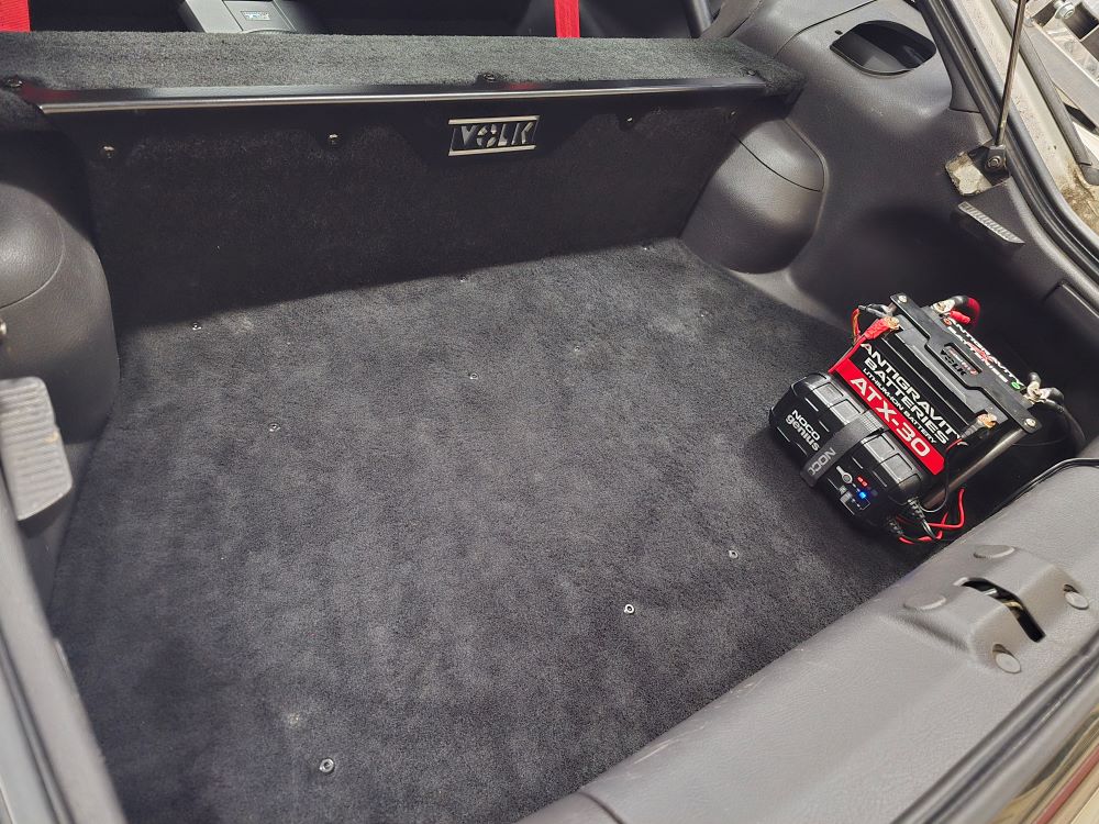

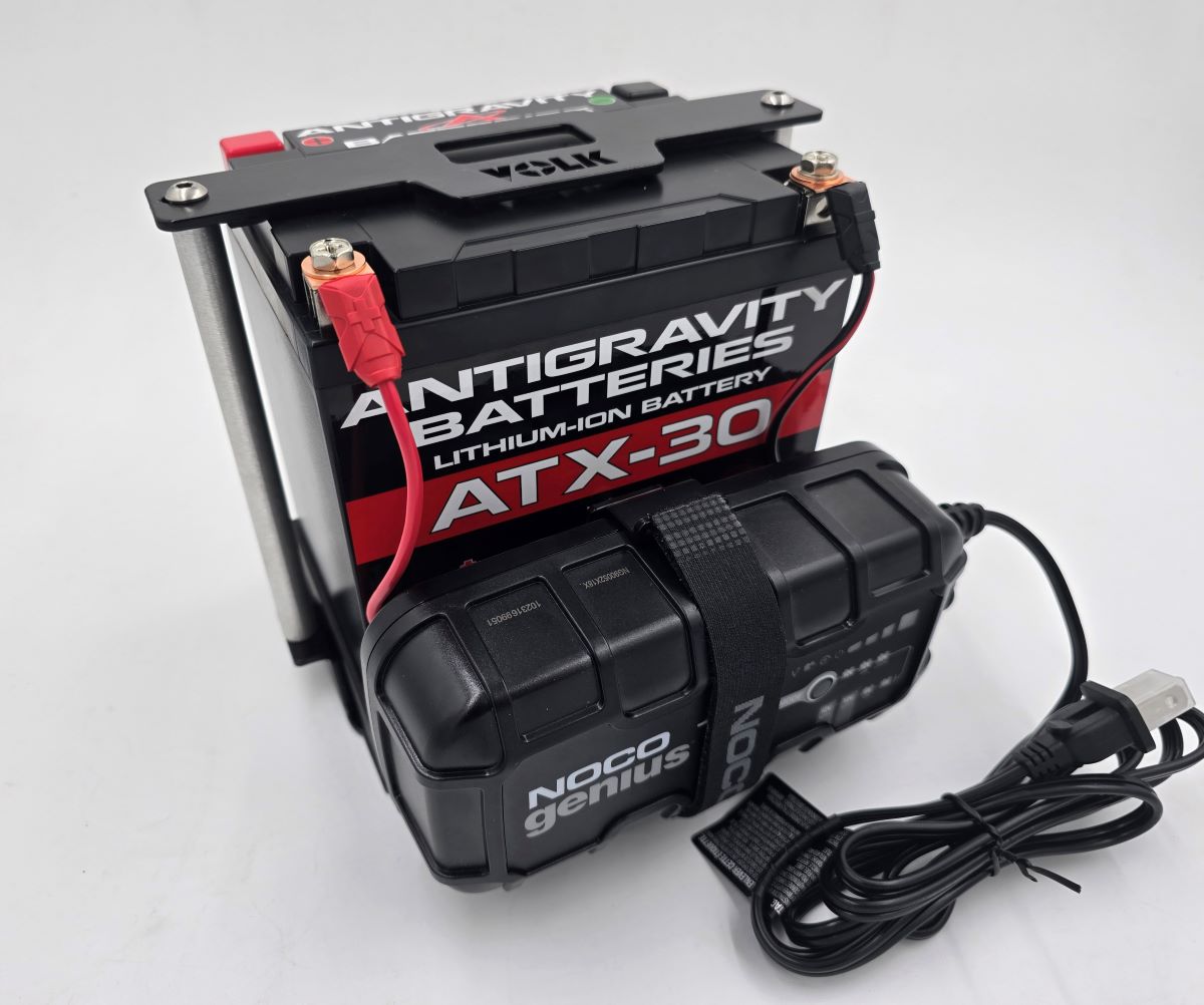

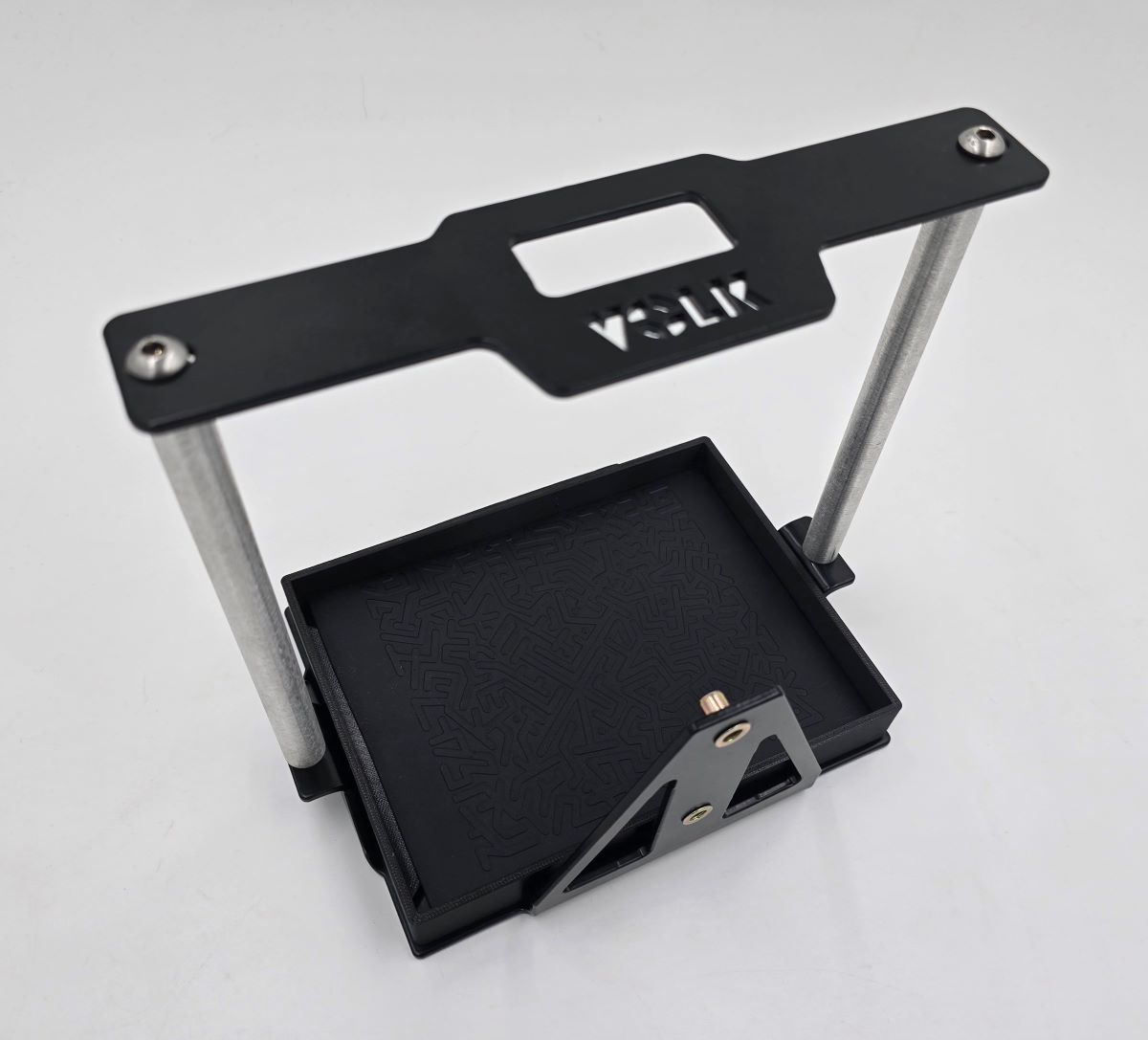

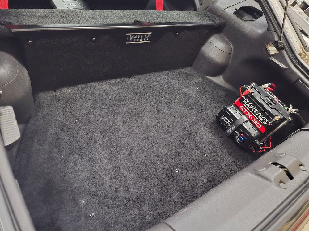

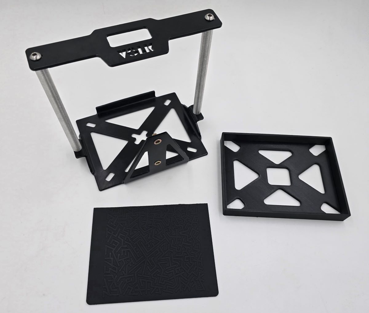

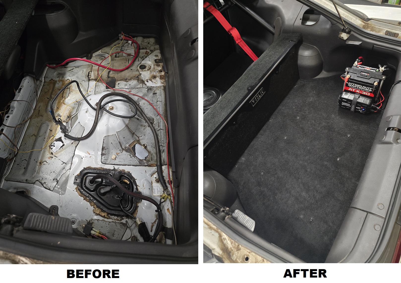

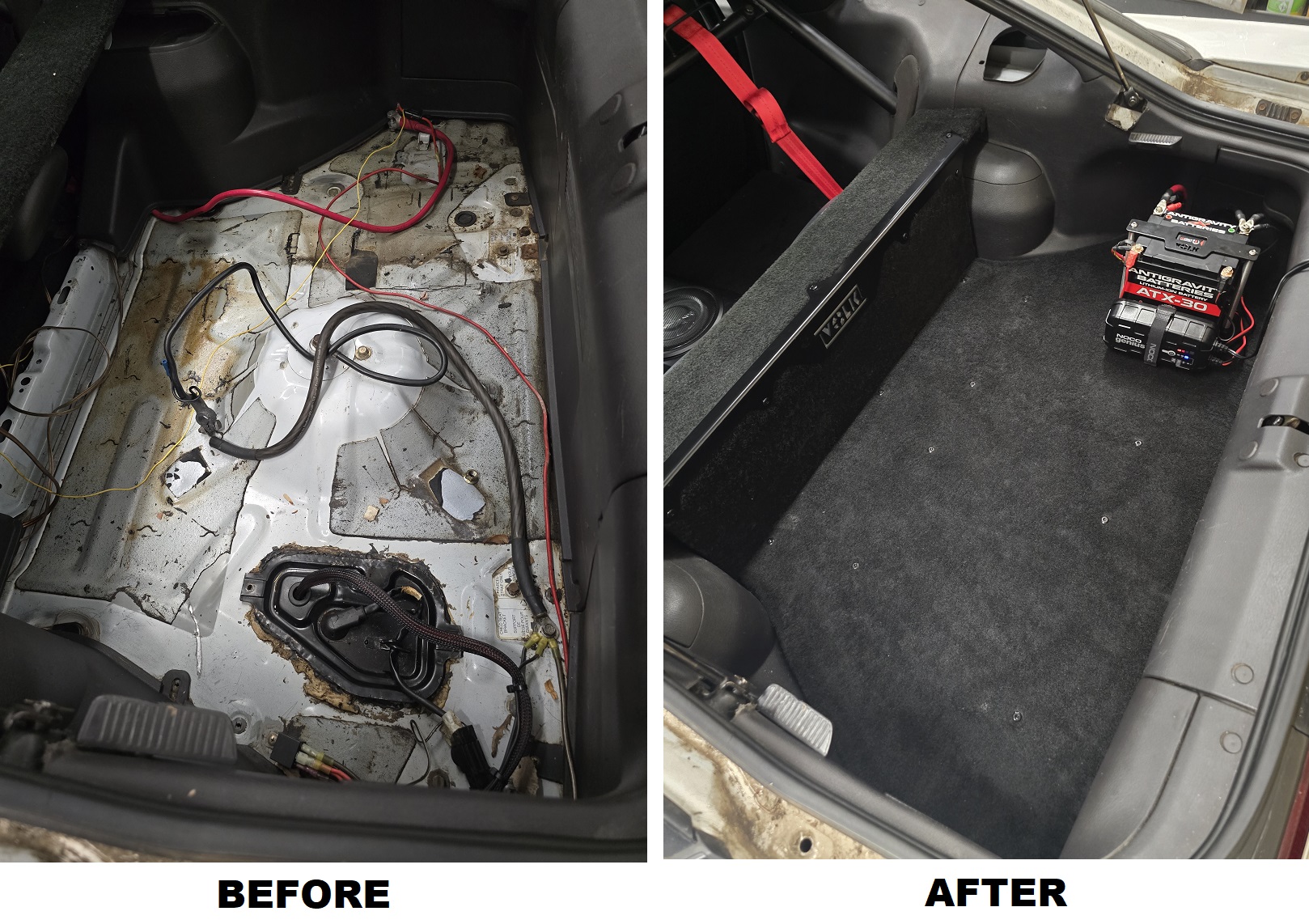

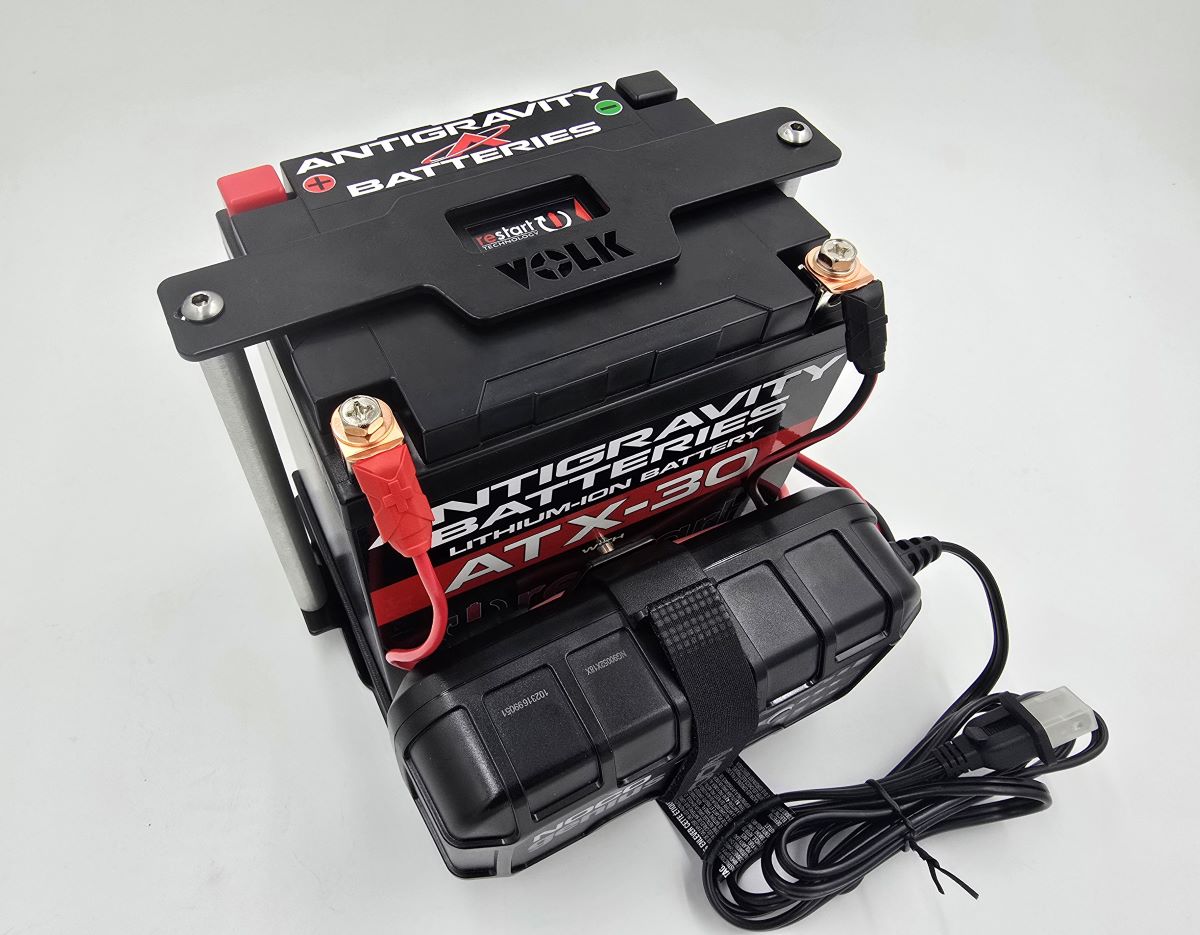

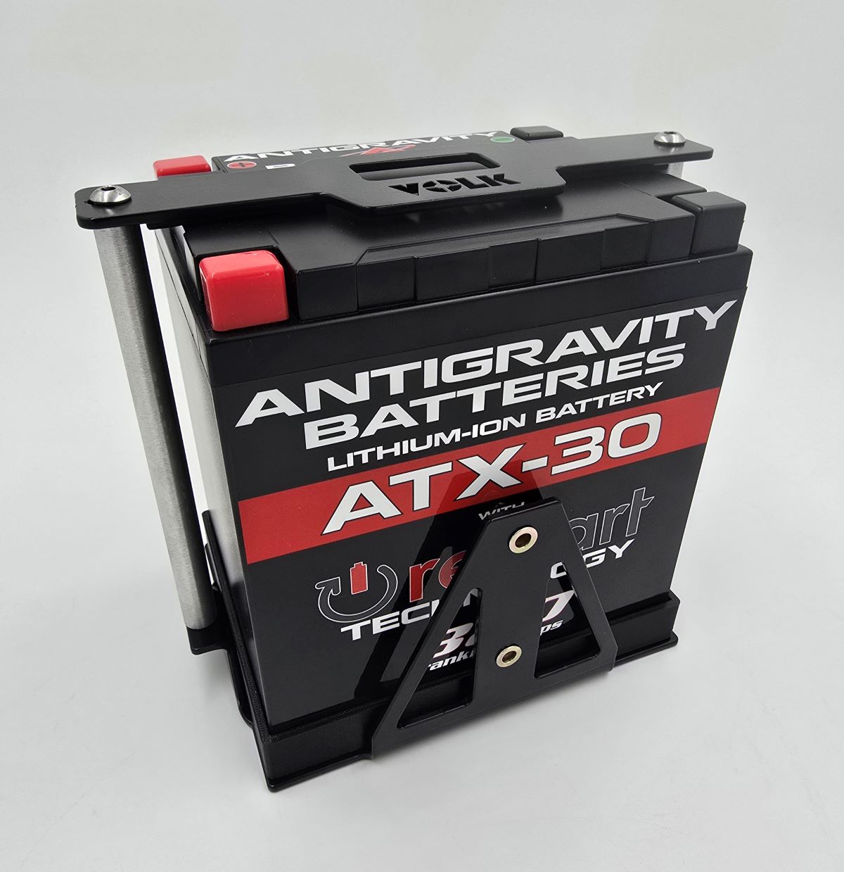

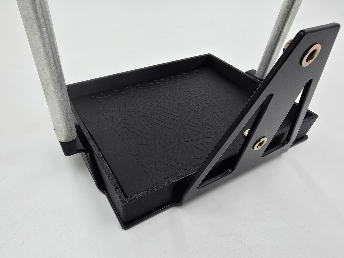

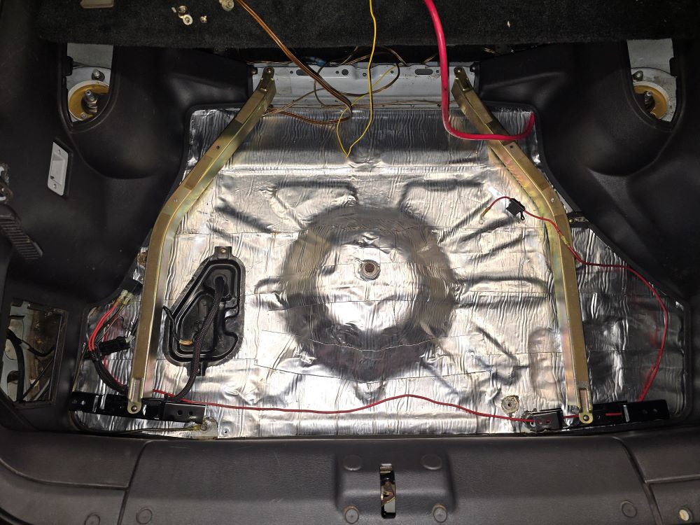

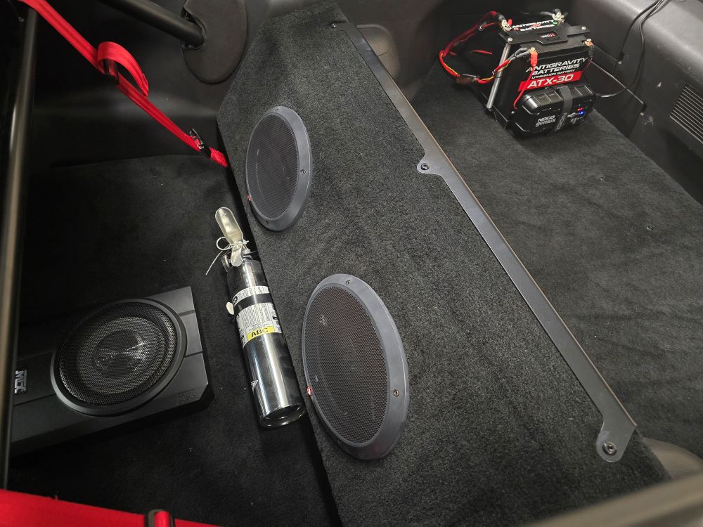

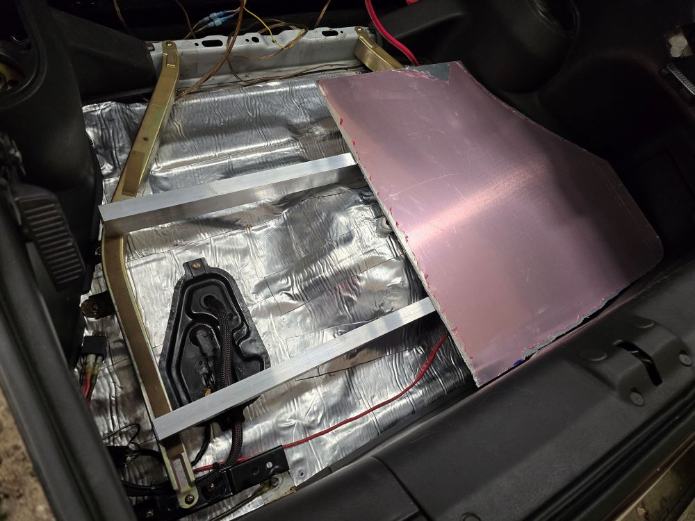

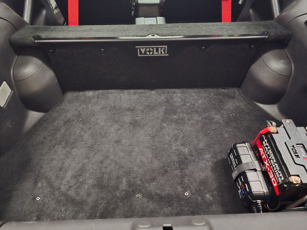

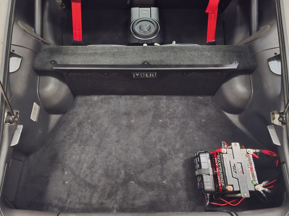

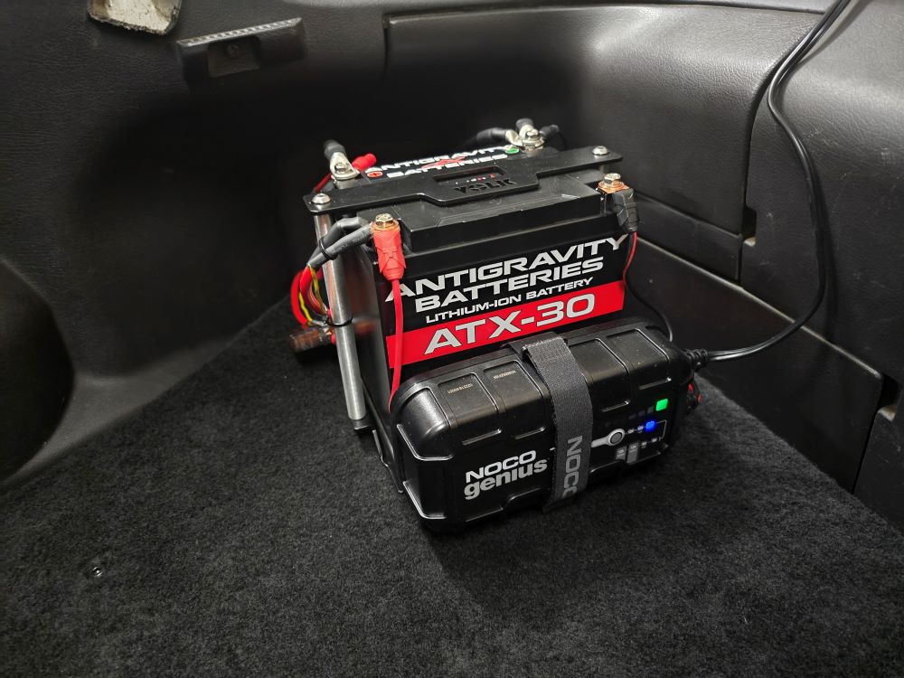

My DSM needed a new battery, so I decided to switch to lithium and whip up a prototype mount for it. Very weight conscious, it runs a separate tray and gel vibration isolator pad.
ATX-30 Battery alone: 5 lb, 7 oz
Complete mount: 2 lb, 2 oz
Noco Charger: 3 lb, 0 oz

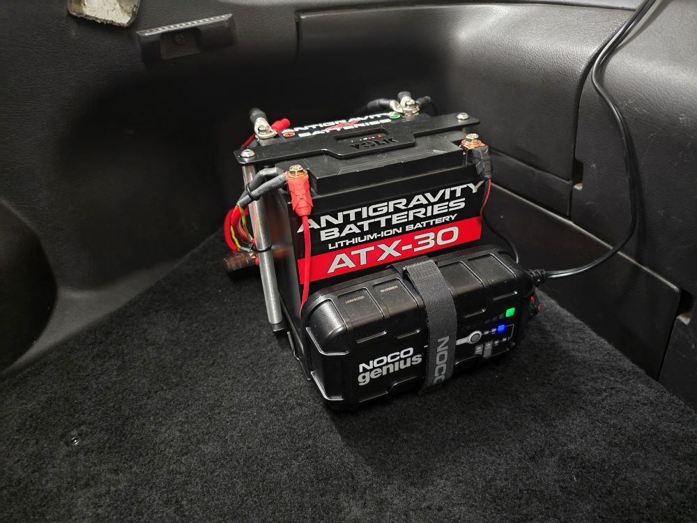

I liked the idea of the charger going with the car, being that it requires a specific charger. So the mount allows for a Noco Genius 10 charger to bolt directly to it. It can be used with or without the charger mounted.
This Anti Gravity battery boasts 880 cranking amps and has RESTART Technology (built-in jump-starting) so you won’t ever get stranded with a dead battery. Should protect it from excessive discharging which is good for me because this car tends to sit for long periods of time.
