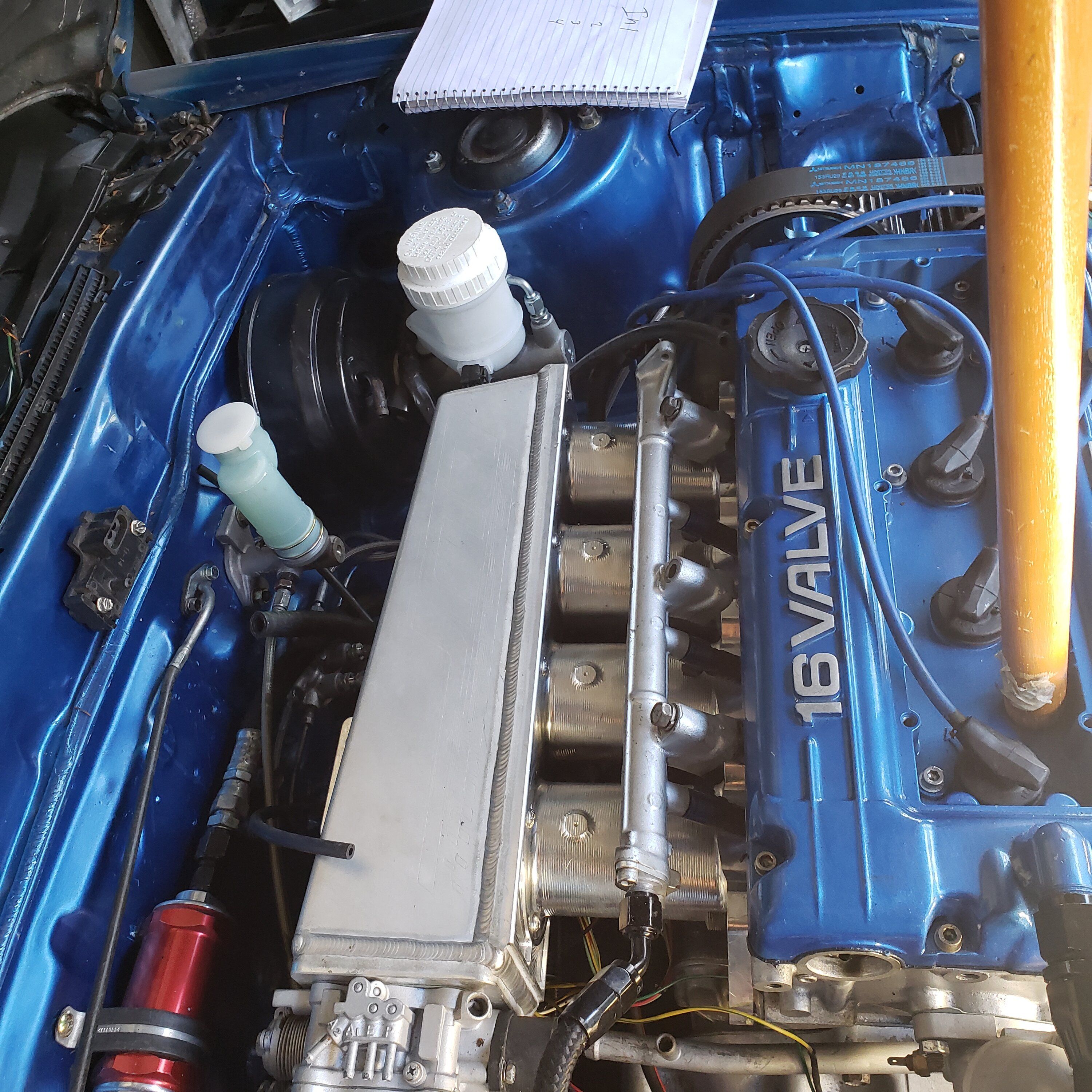

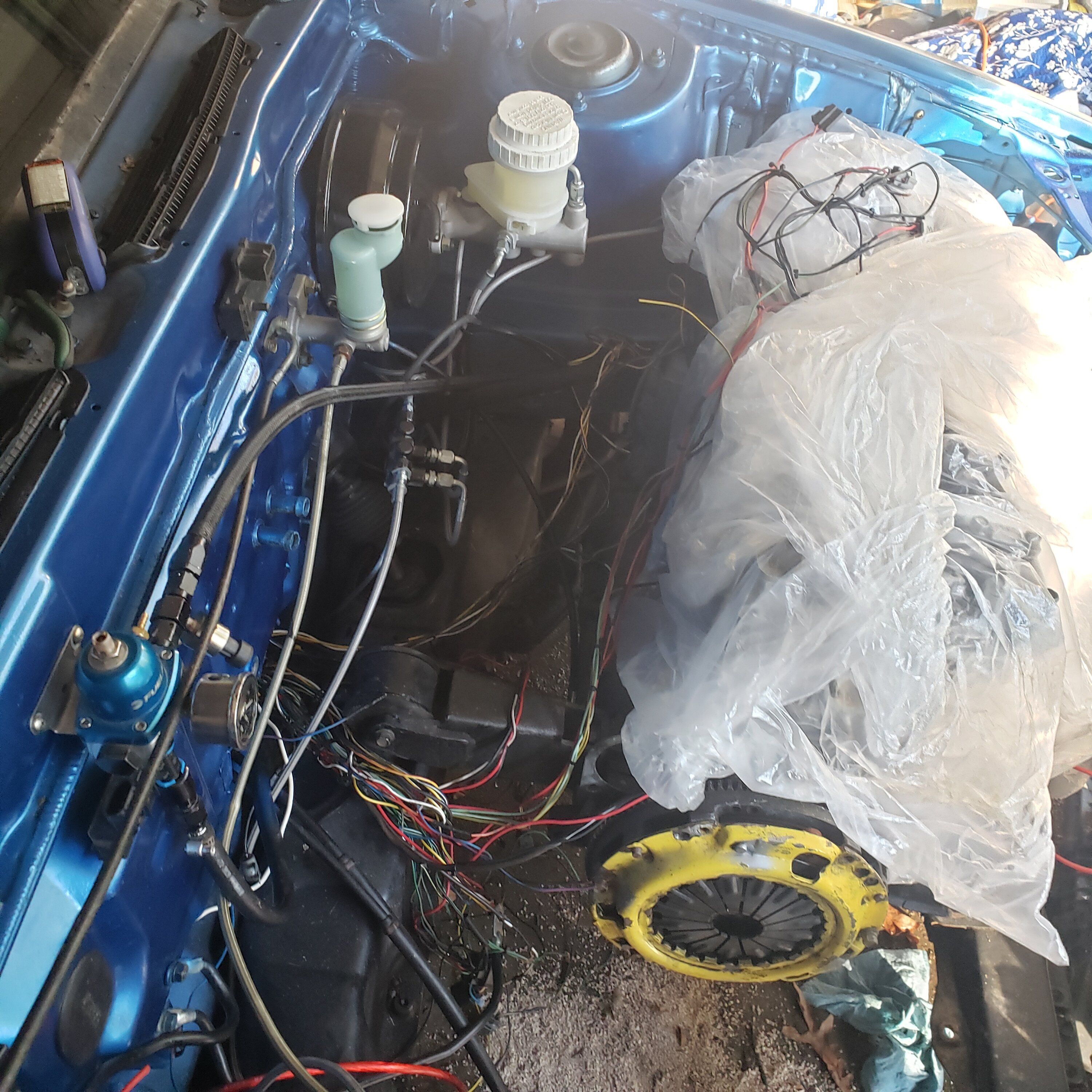

Yep new Firestone firehawks, mocking up the sirocco radiator. More pics later, I'm loving these tires. cleaning up my evo 8s for paint .

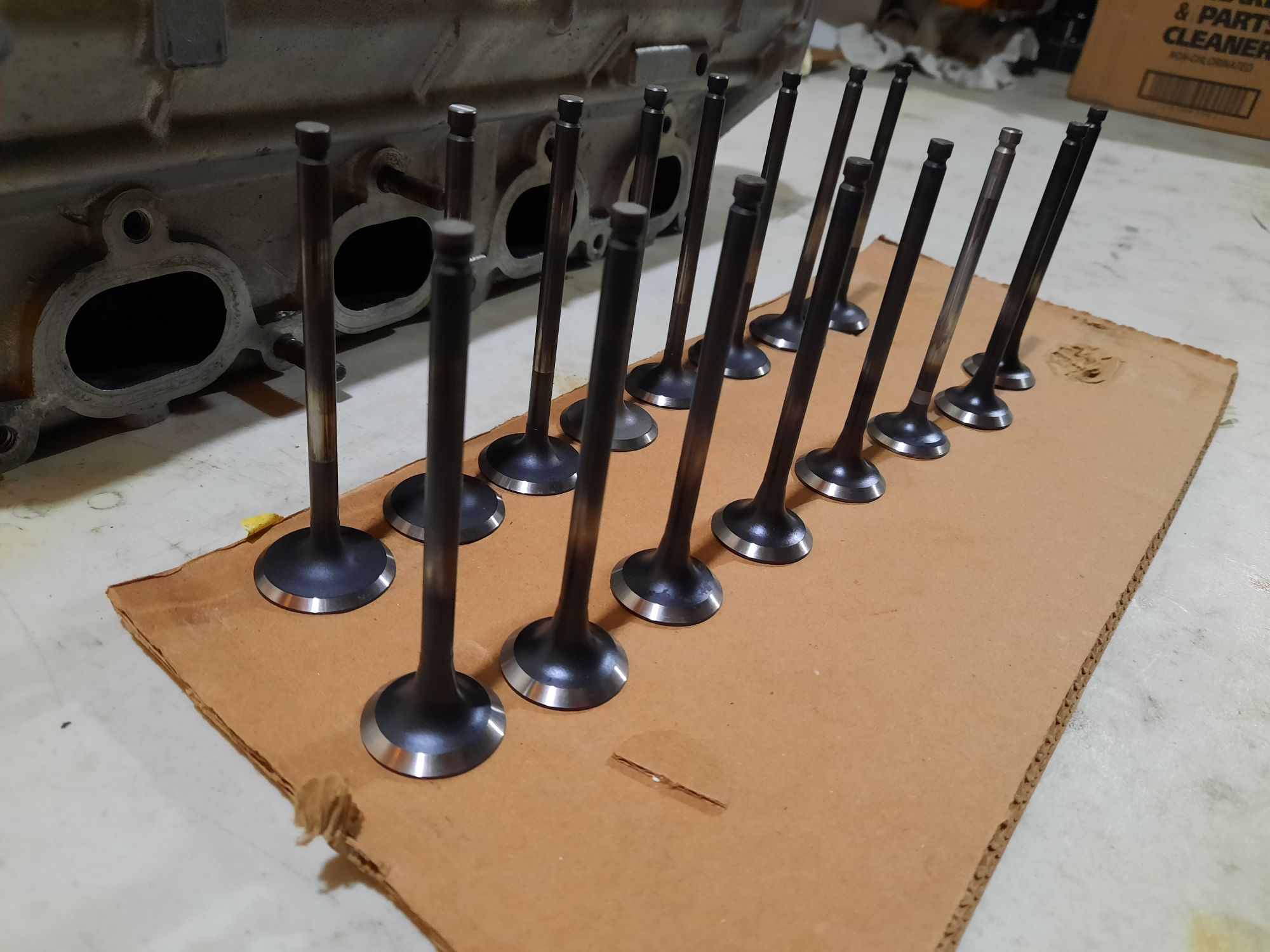

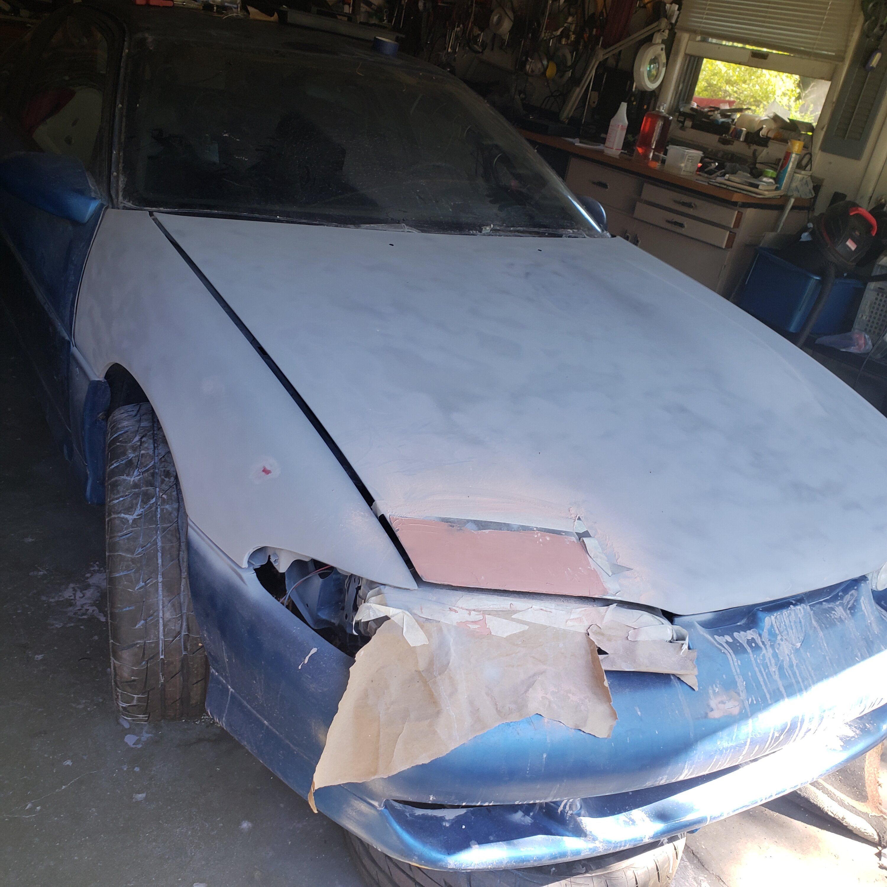

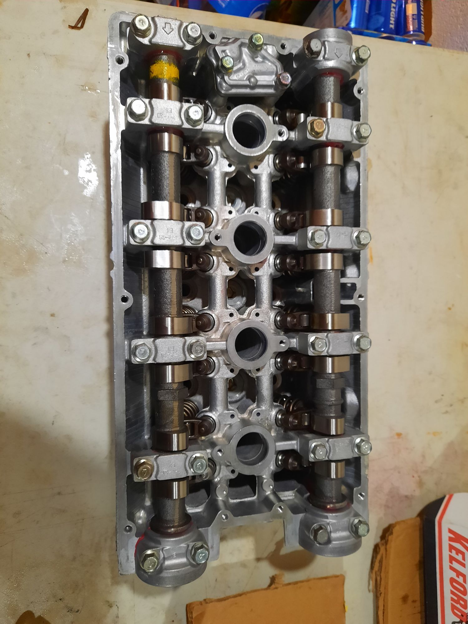

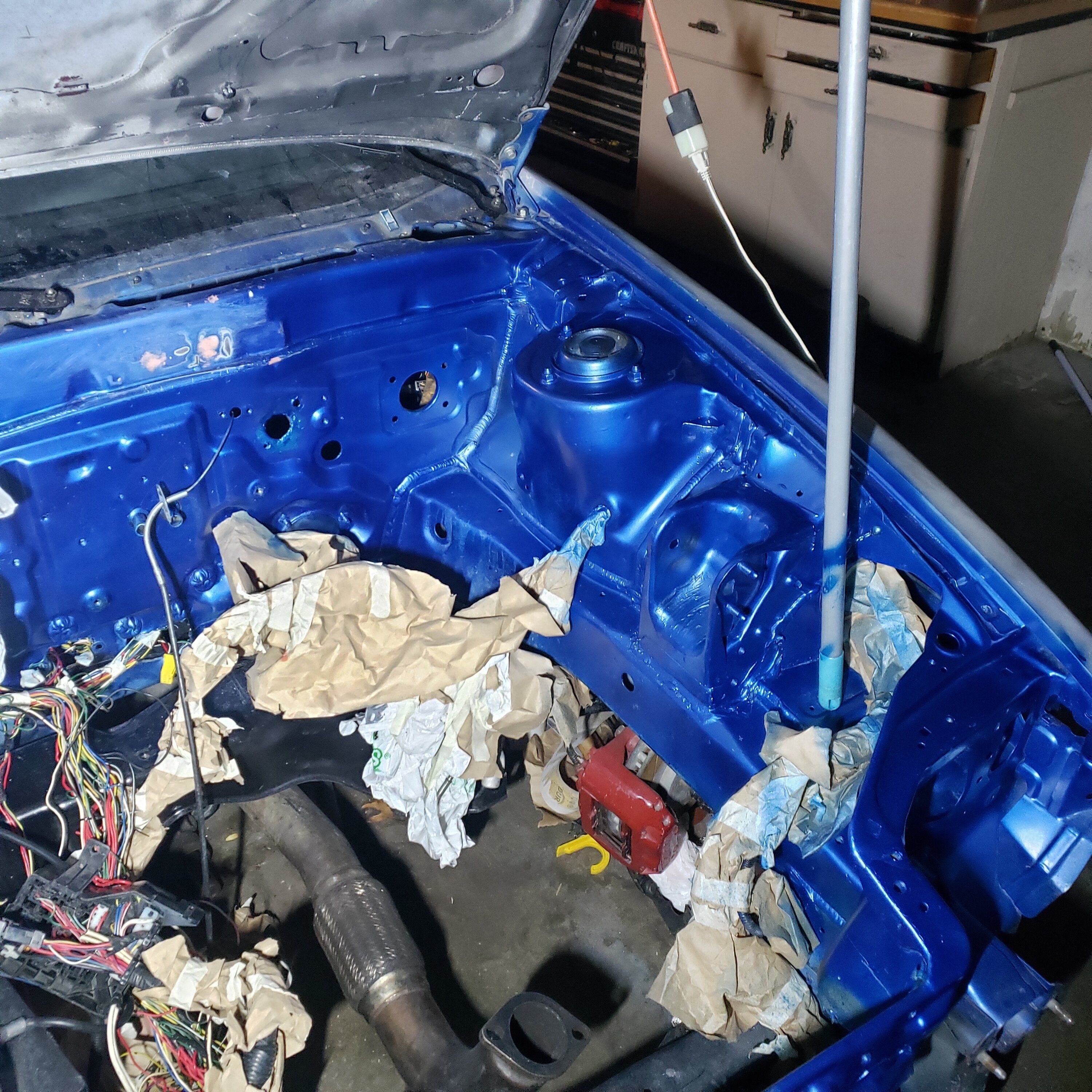

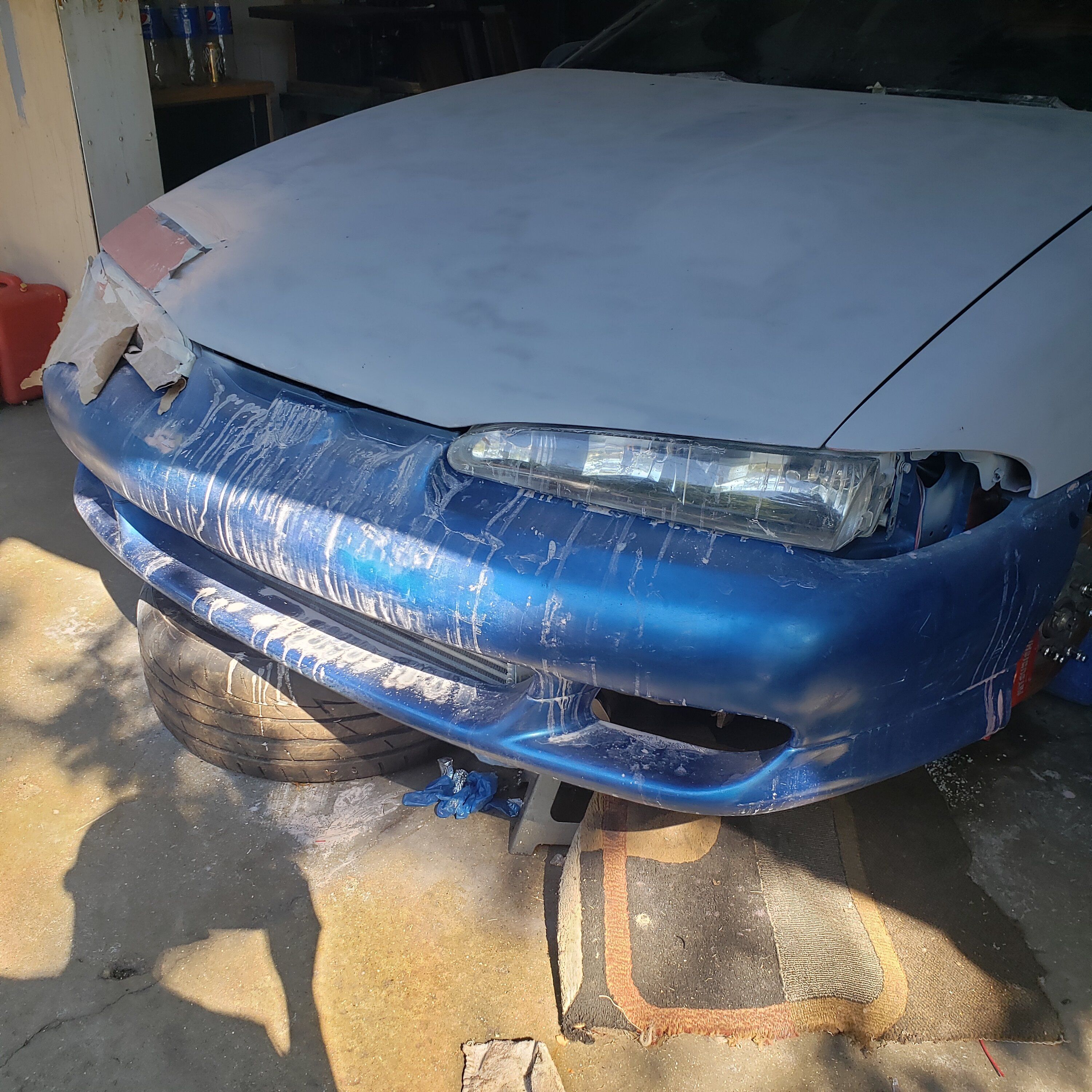

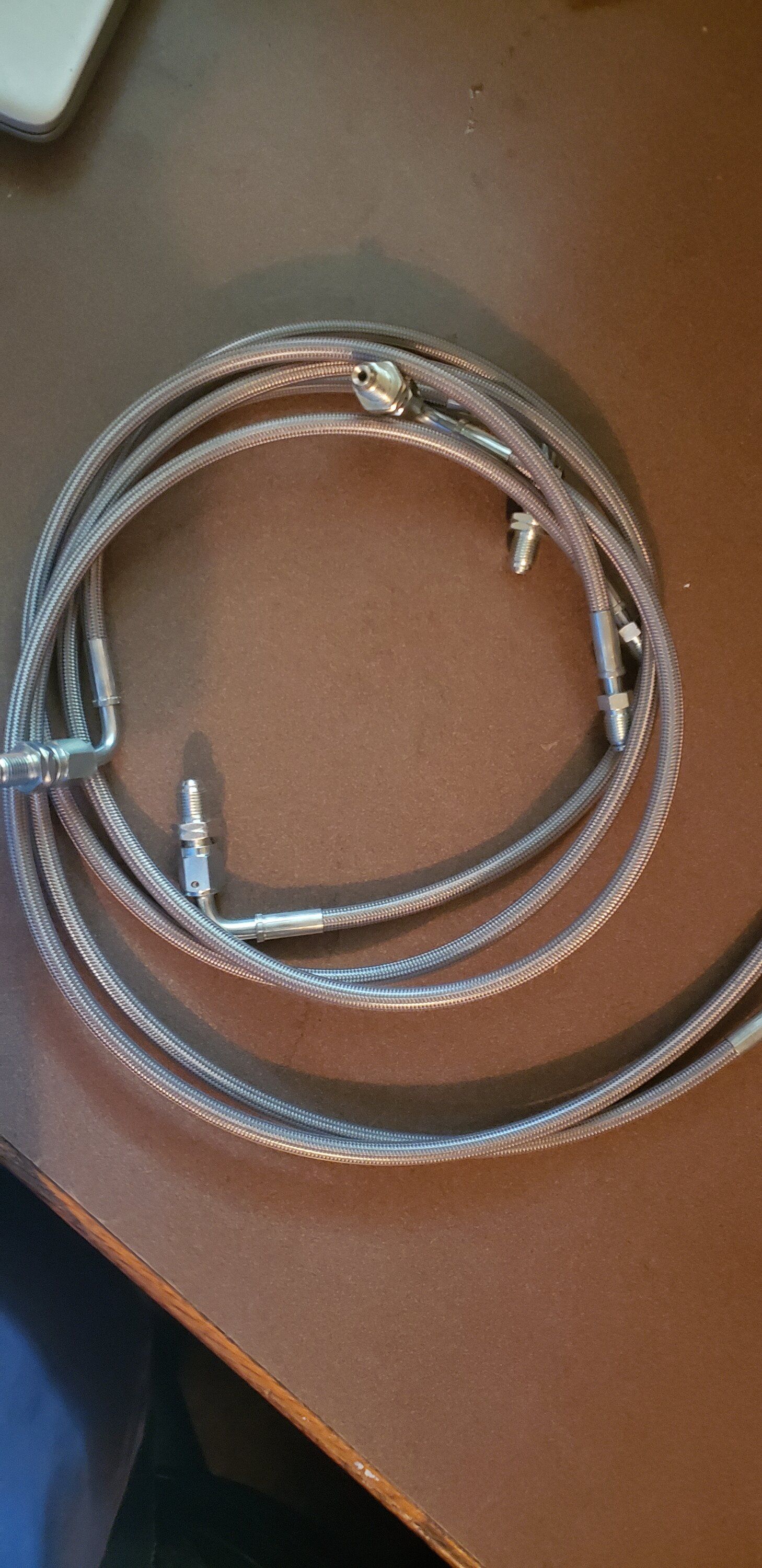

Well i decided to get some ss lines to replace the rusty brake ones in the bay from jnz i must admit these are really nice and look amazing under the bay with all my other siiver stuff i would say. I decided to replace my plastic bushings with some bronze ones from a fb member . Decided to try to save my hood so a bit of bondo and sanding is in the works, alogn with getting it straight as possible, since no shootout decided to to fix some stuff i hate looking at, The head is at the machine shop to get fixed, then my kiggly racing valve train is going in, lapping the valves, and kelfords 272s being installed in the weeks ahead.

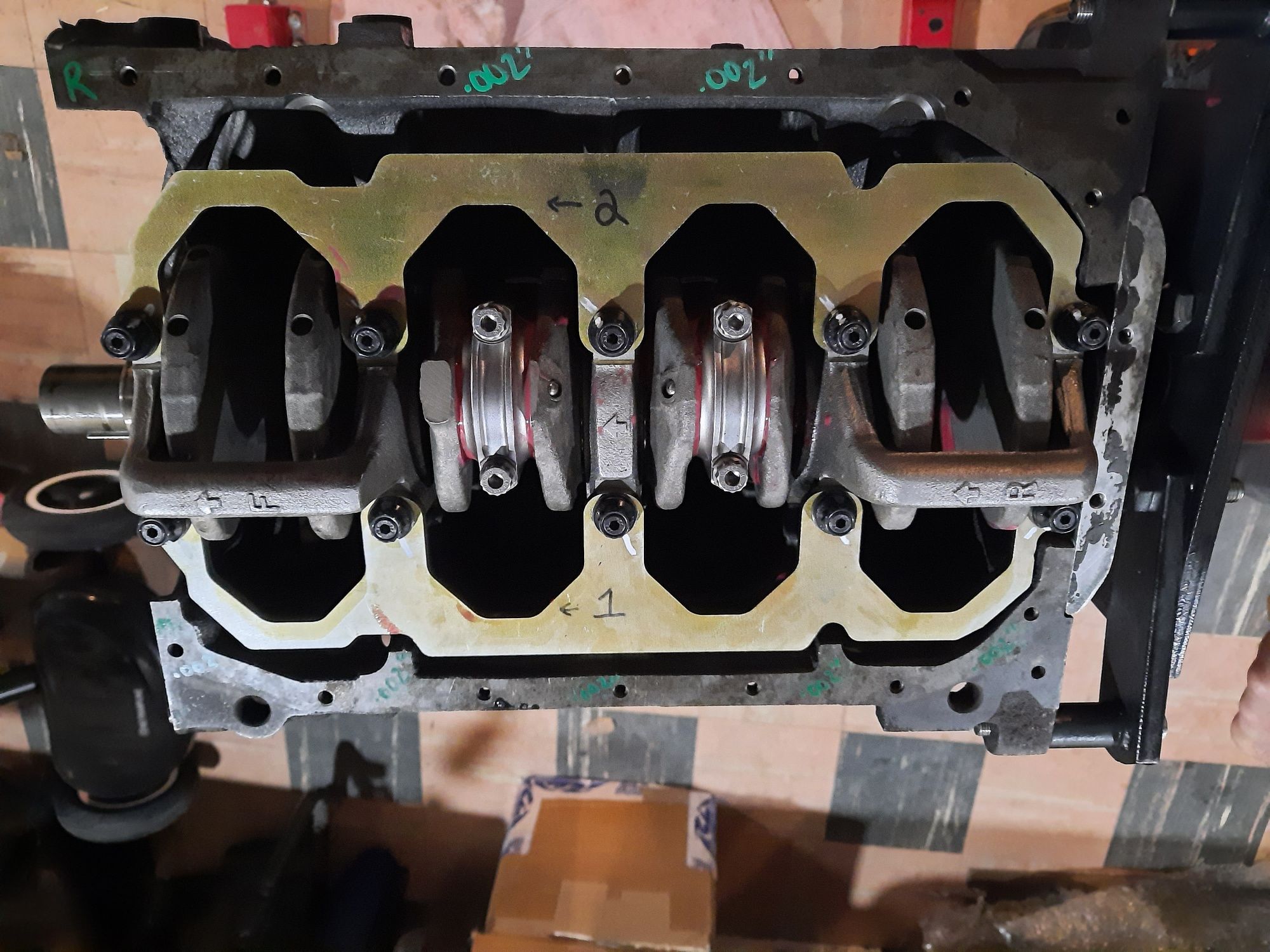

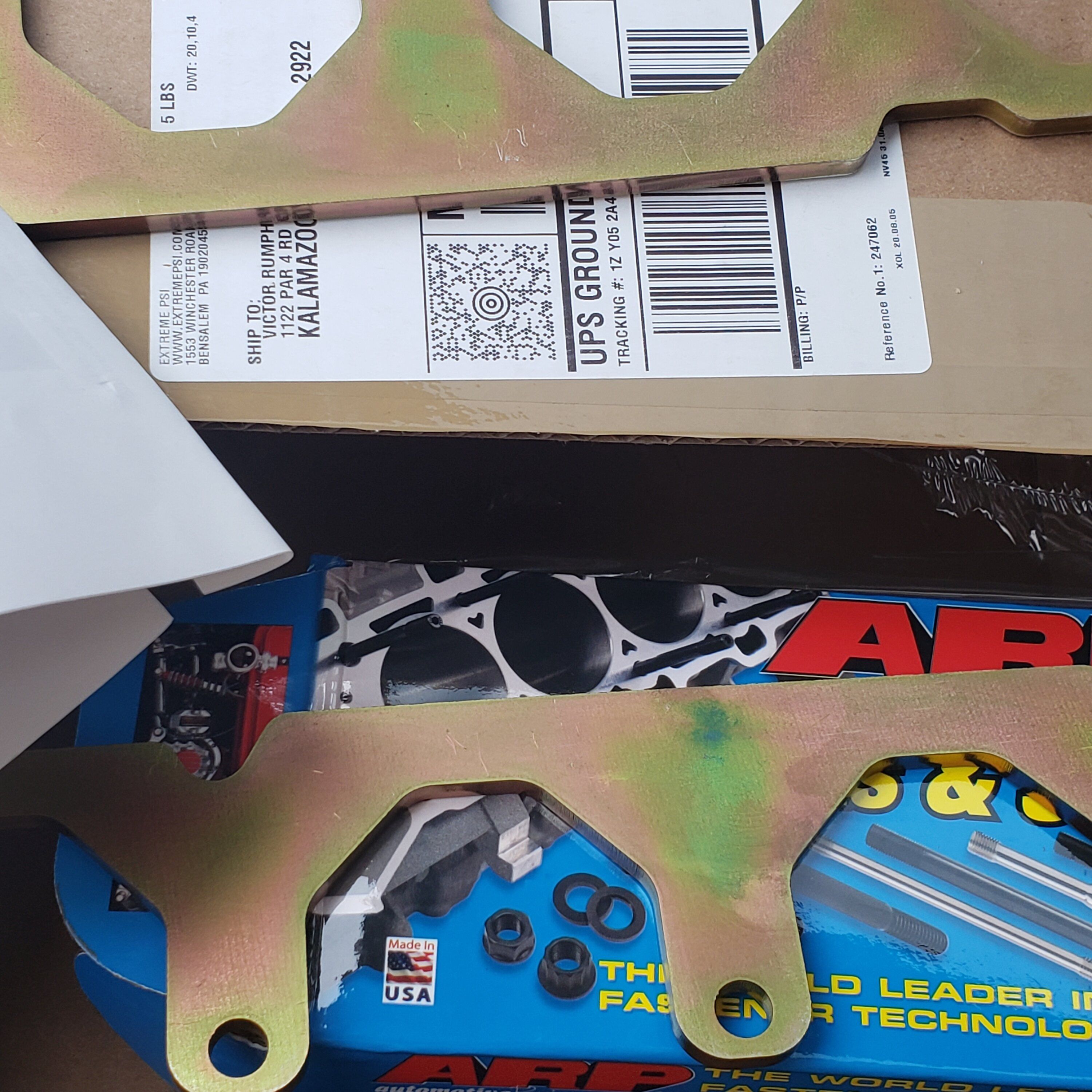

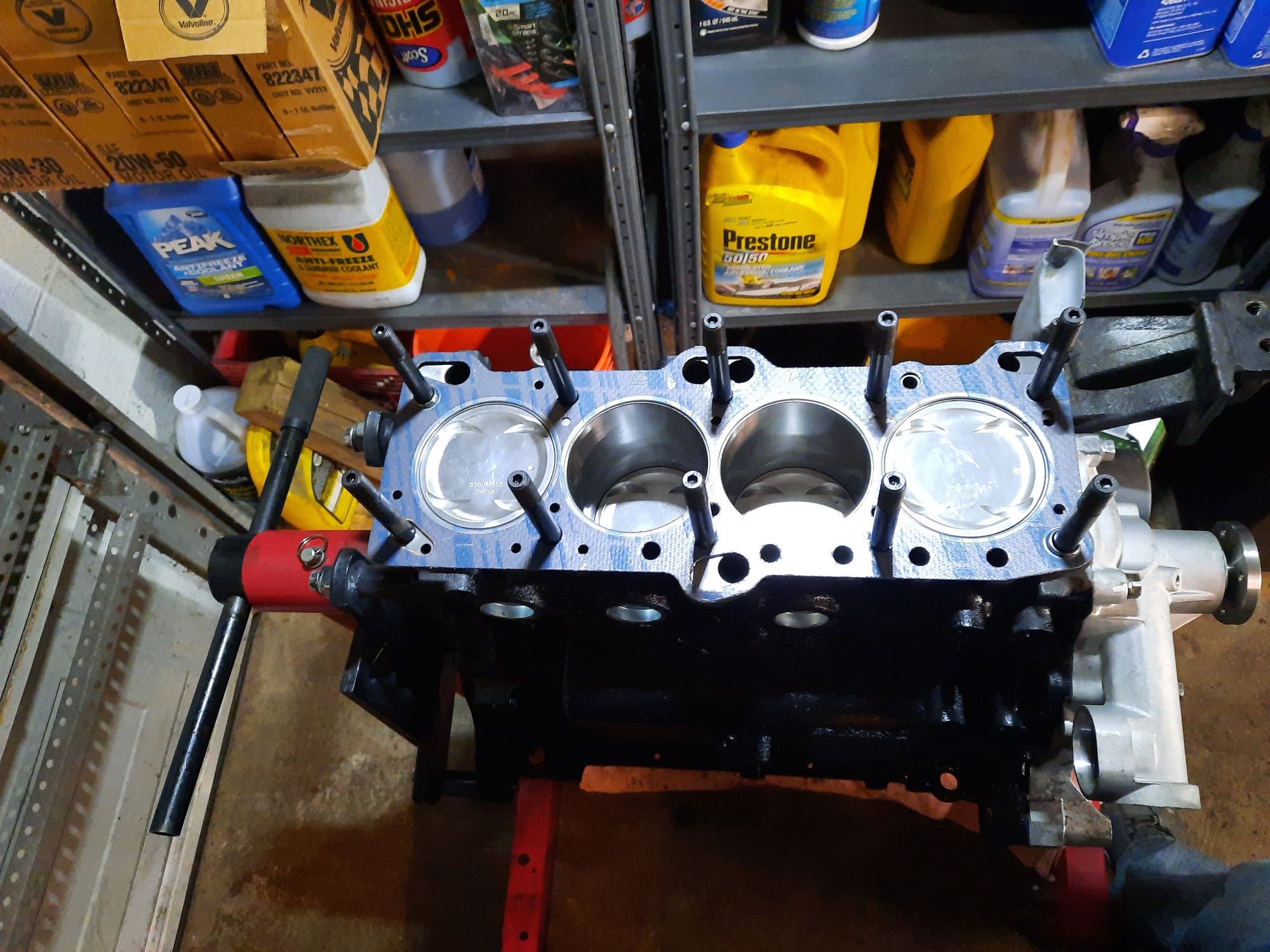

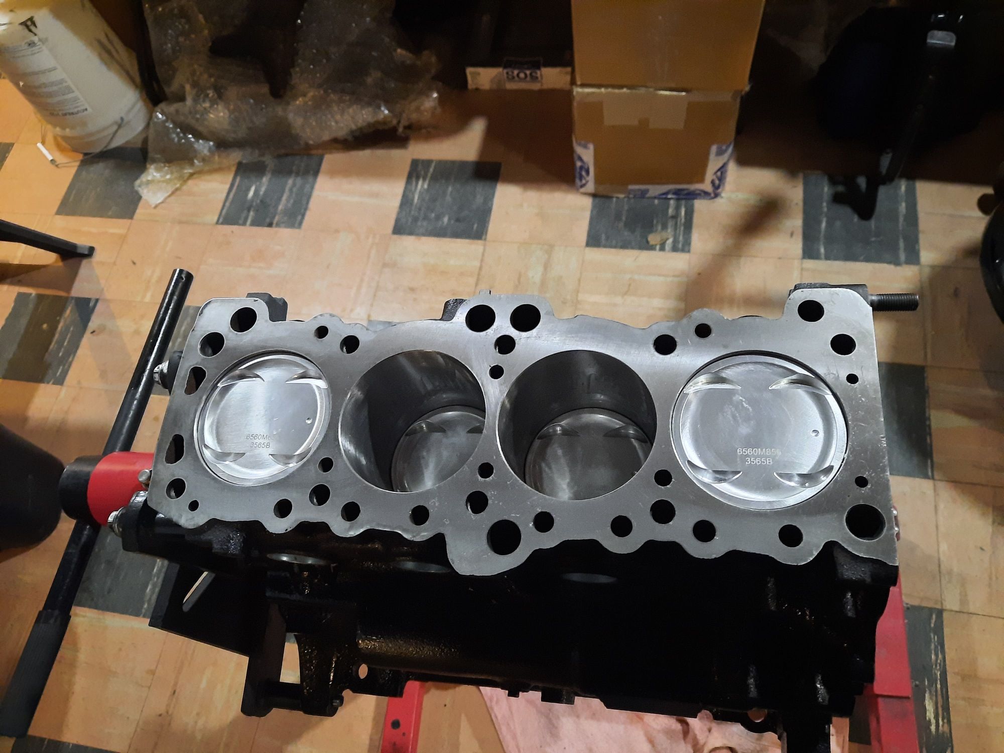

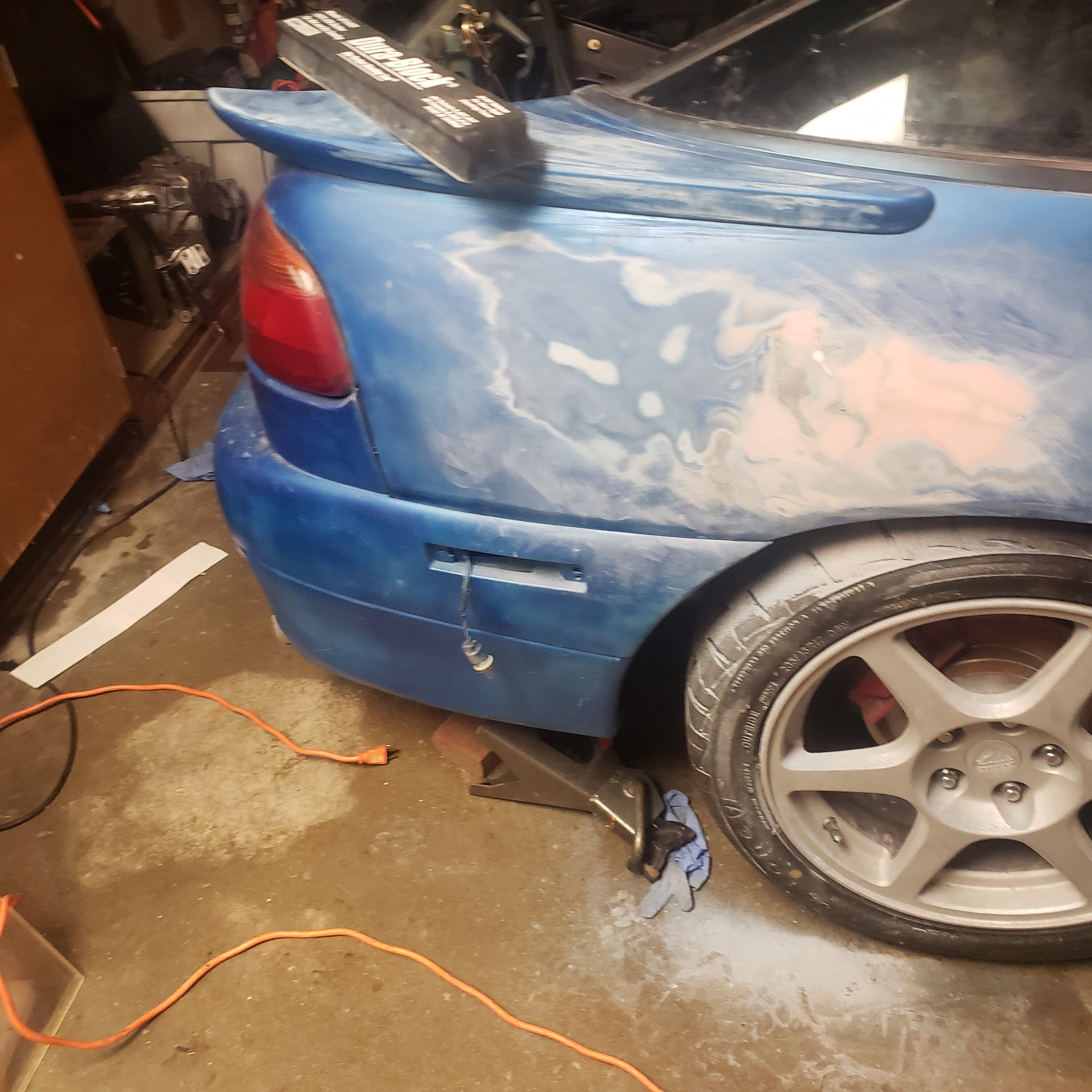

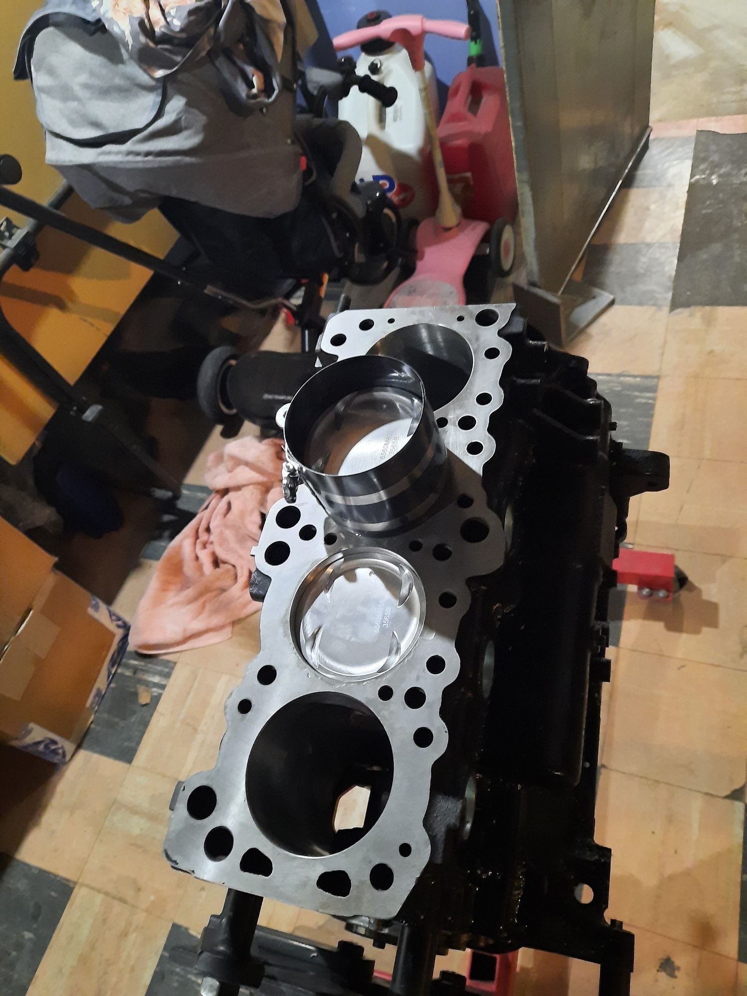

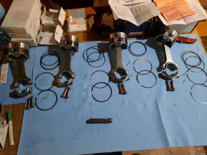

Ok well updates to the build finally decidd to do a full build, from block to head.. Head gasket issue on other setup. Im still waiting to get a new clutch too, Body work need, paint needed, coil overs needed, freshening up.
List

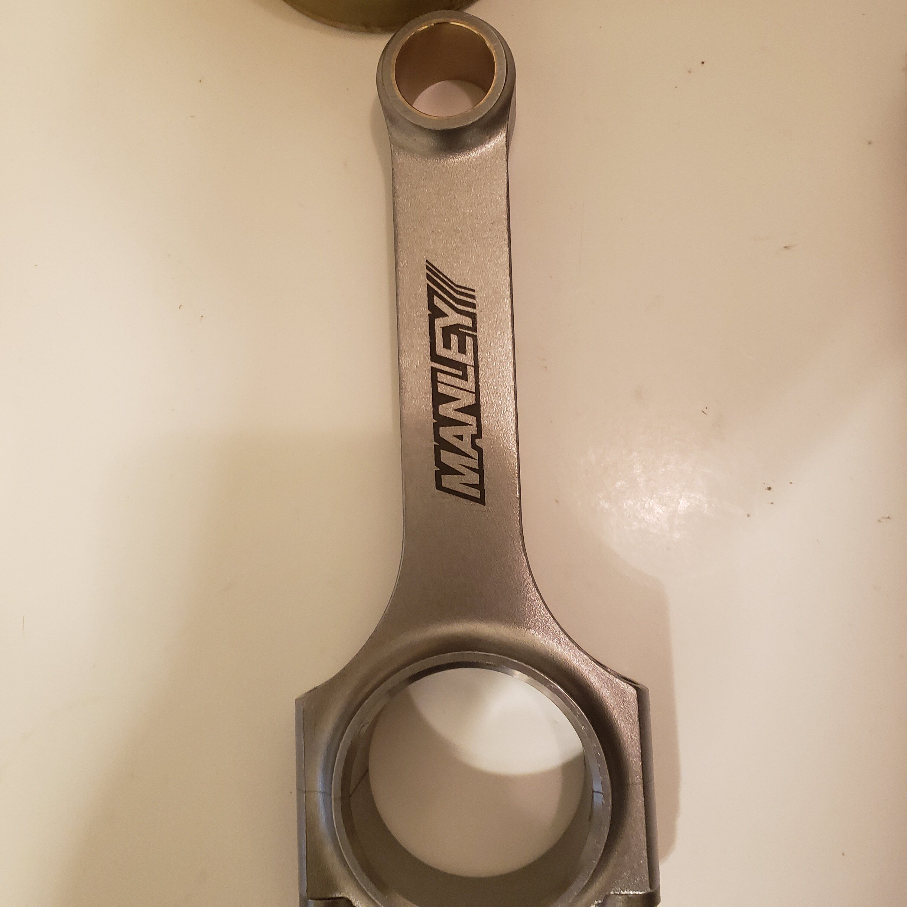

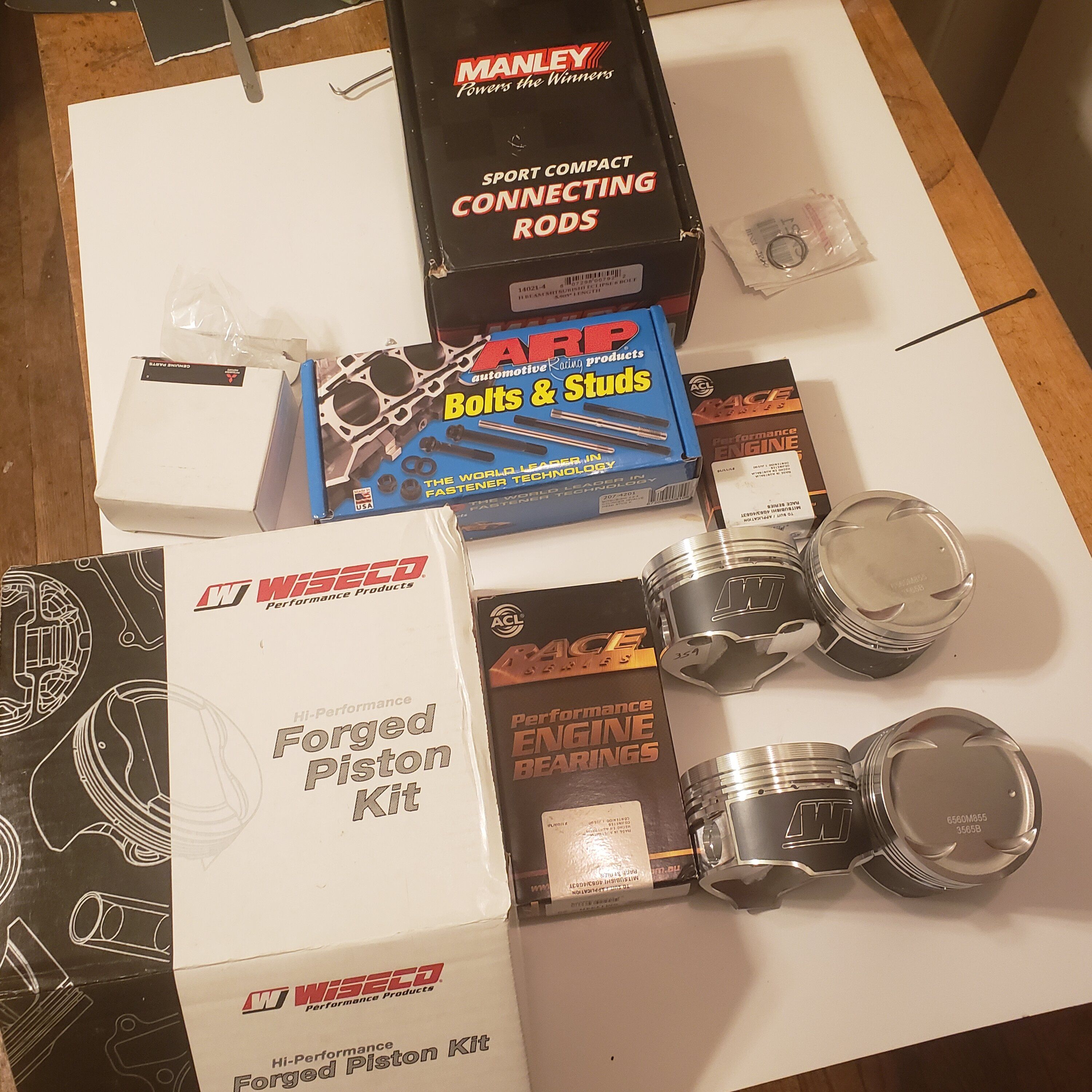

Manely rods
Weisco pistons 9 to 1

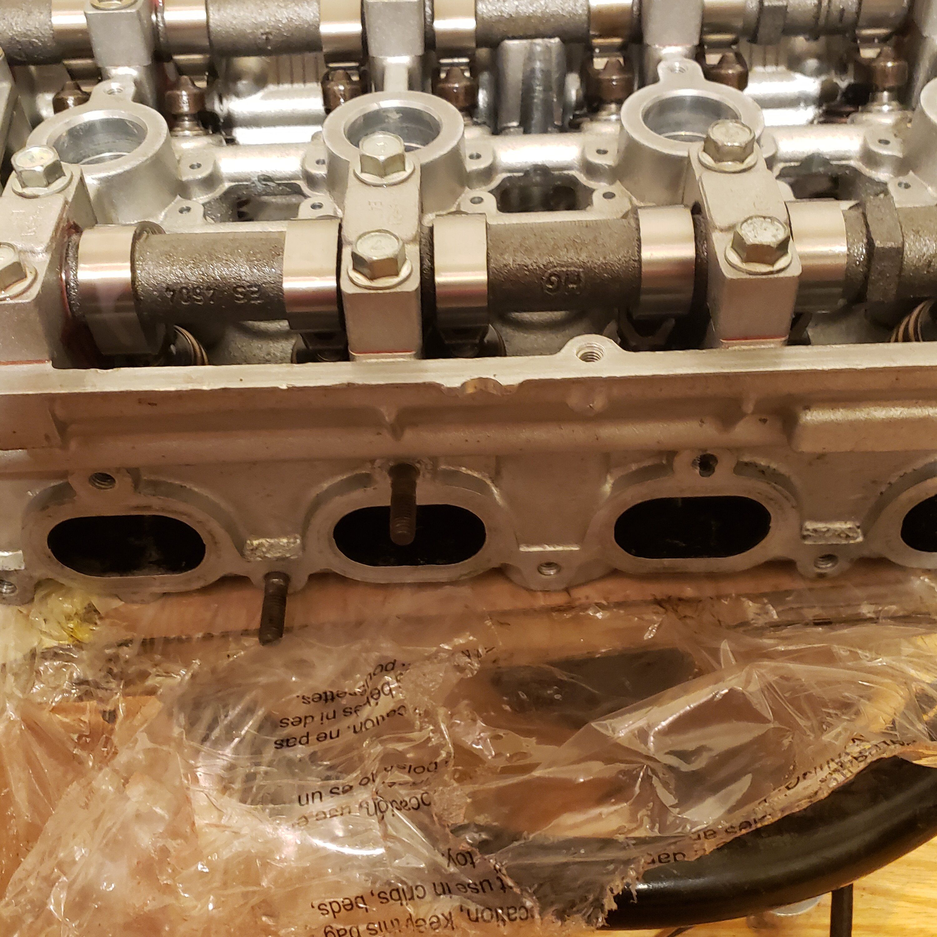

Kelford 272
Kiggly racing street bee hive vavle train
New timing components
Head cleaned up and decked
Block decked and cleaned up and painted bored out .20
Pictures on the way of the build .

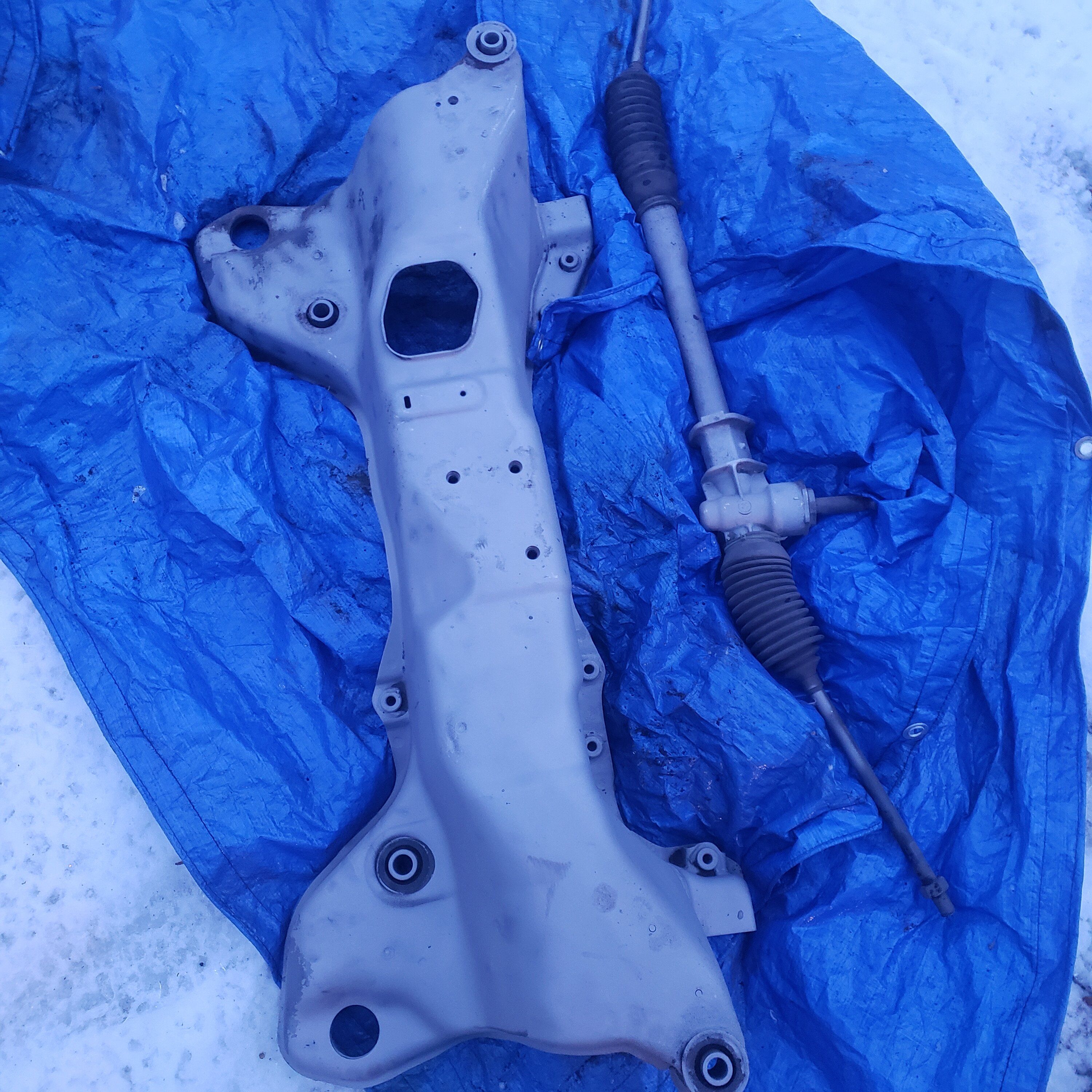

today I sand blasted my frame next step us to install my manual rack and get new bushings and tie rods. Its got etching primer in now later 2 costs of black satin duplicator color paint.
Nice work. Man! This is almost a full resto. Painting the under of the subframe sucks because of the different angles and crevices. I painted one side at a time, bottom then top. It’ll be so satisfying once you’re done with the subframe and it’s back on the car.

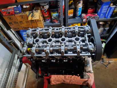

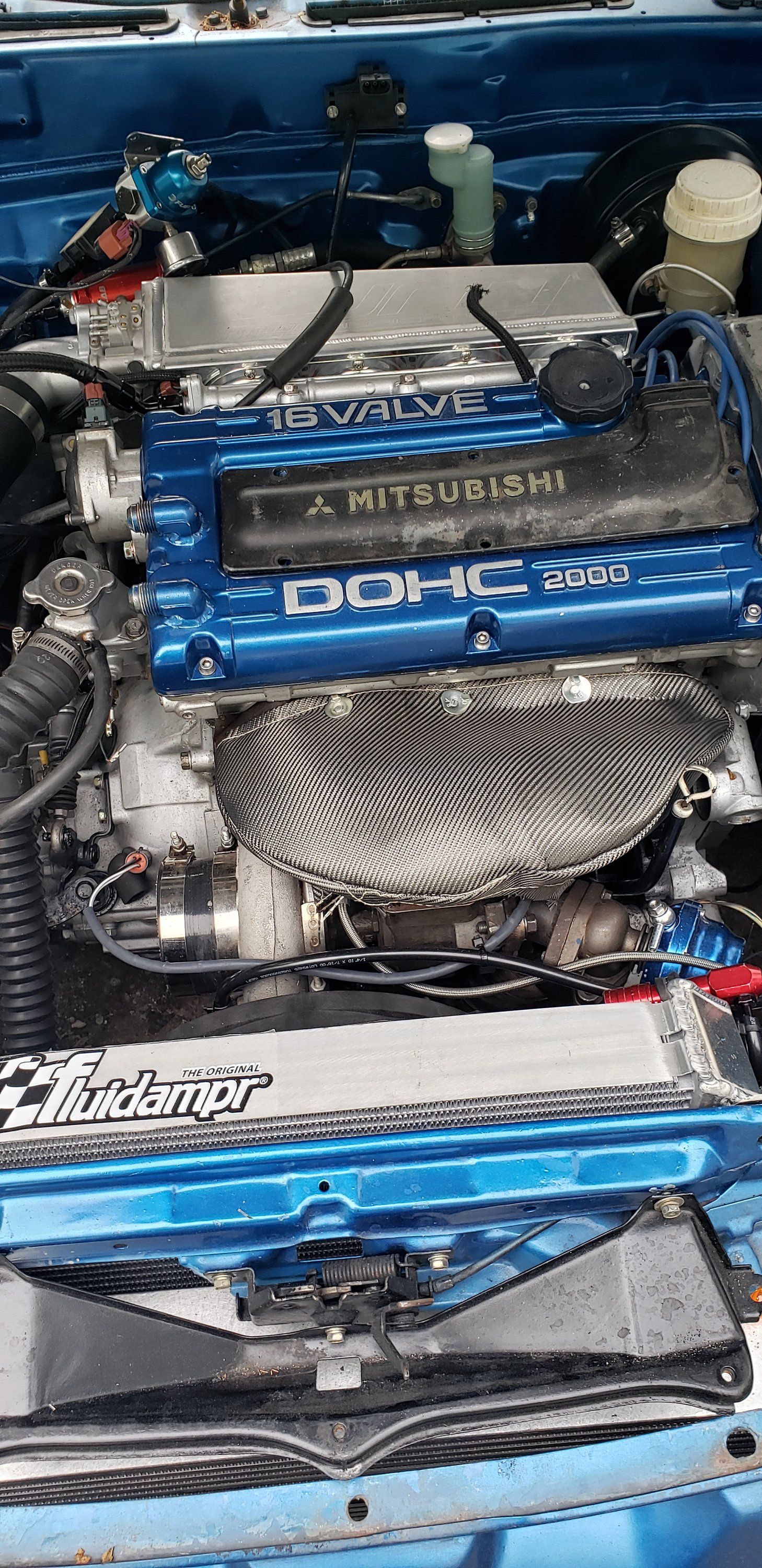

,Well its been a while but its finally almost done, my buddy pldsm, rafal hes became good friend here a two hours away. He has really helped me out ive built a engine before. This time he and i worked on this thing here and there. Weisco pistons, manley h beam, kiggly girdle, no balance shafts. Decked hot tanked, primed, painted, new oil pan, 12 an fittings for my hx40 i built . This has all specs with it, and matches the one he built for his 700 hp, engine..Dynoed on force enginering dyno, which mine will be hitting later. So im really excited this dsm has all the goodies i ever wanted and more. More updates coming.
Yeah it is , ill be getting it shortly im painting bay like yours, and misc stuff in the meantime, you go to the shootout, at norwalk.
