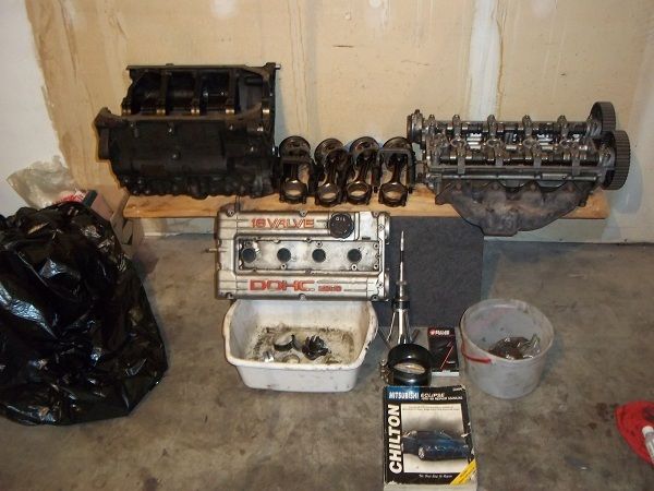

ok so its been a min since i posted any thing so i thought id drop in. anyway so i have been chasing down this fuel issue for awhile now it turned out a cap had puked all over the ecu board. well i long since fixed that by swapping in my old auto ecu till i can pick up an eprom for link. i must say for picking up this car for a beat ass 77 chevy 4x4 worth maby 600 bucks i got an alright deal she just needed a little tlc. ive come a long way with it and theres a lot more to go ive decided im just gona keep putting bolt ons till this tired engine gives up shes at 151xxx timing belt has been replaced at some point with gates. i have a spare 6 bolt im building. came out of my parts car with 60k on it. needed rebuilt cus balance shaft bearing spun. took it all to a shop to have it inspected and all was still well within spec so im just refreshing it with king bearings and new rings and a bse. this will be my first engine build so thats why nothing special is going into it. any way here are some recent pics of the beast and my new engine.

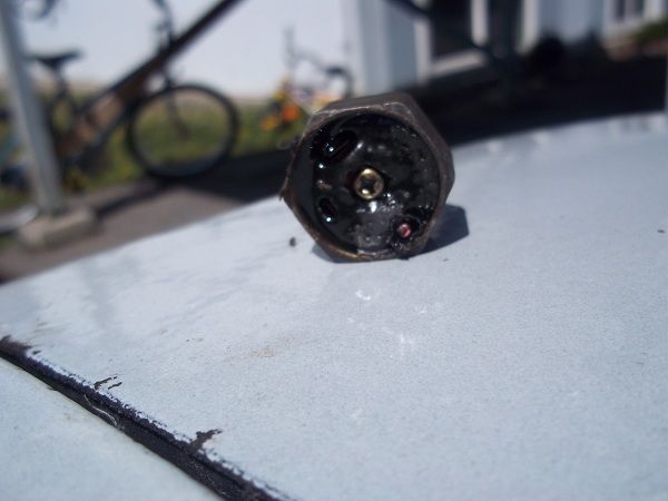

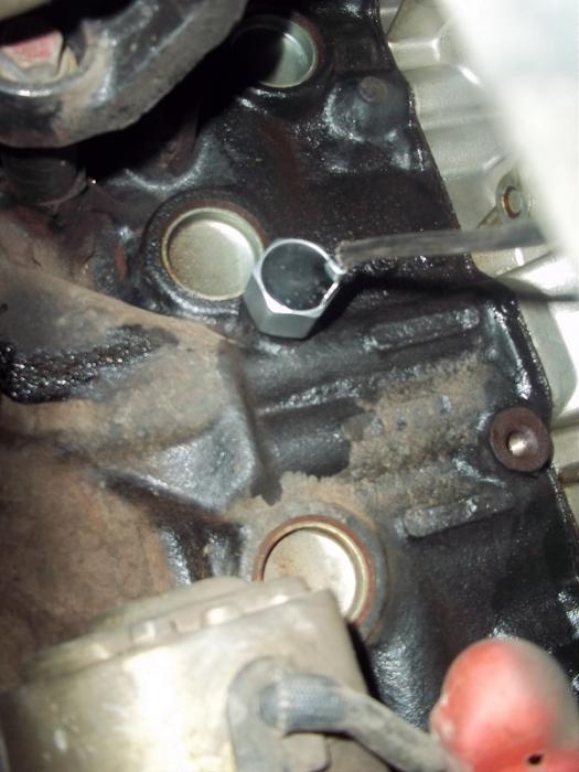

changing my o2 sensor and knock sensor tomorrow that should be fun. ive heard changing your knock sensor can be a pain in the ass.
ok changing the knock sensor was easy......getting to the knock sensor not so easy. i cut the wire off the old one, put a socket and extension on it and got it loose. i saw Several threads that said i would have to take my starter off??? in never had to touch it. just a good socket set and adjustable wrench. i also have no ac lines or vac lines to worry about either. any way the o2 sensor was super easy rented a set from the parts store and used the "crows foot" tool came out easy. she runs great

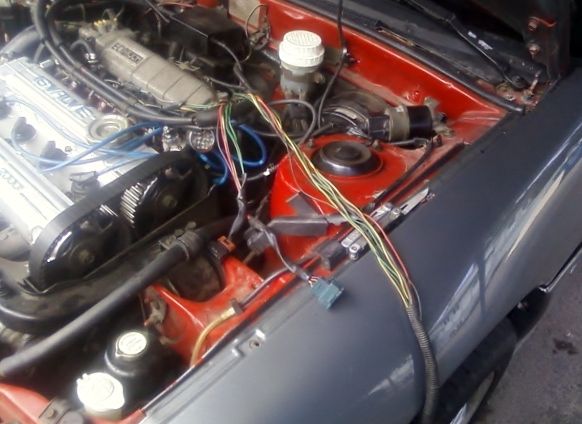

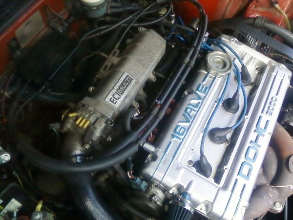

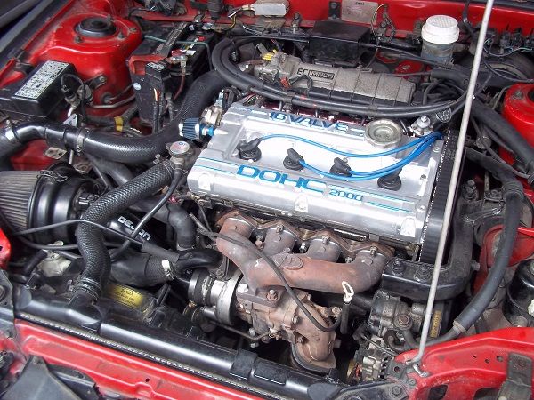

ive been bored latly so i decided to clean up the engine bay. so far i did a full vac delete its awesome only having three lines now and no egr. along with that removed the vac solenoid bracket and AC fuse box. deleted the AC condenser, lines and pump. next thing im going to try and delete is the cruise control. starting to look alright but cus i have an auto wiring harness is huge and every where.
If you did the emissions delete correctly you should only have two vac lines, one for the fpr, and one off the intake manifold that most likely tees into your boost gauge.
@ Bud92gsx i have my afpr vac line, bov vac line, and boost controller which i know isn't a vac line but it uses vac lines. LOL so yes technicaly i have only 2. and my boost gauge is tee'd into my afpr vac line.

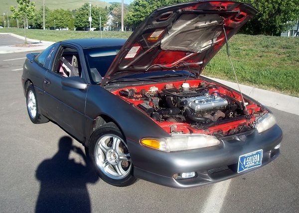

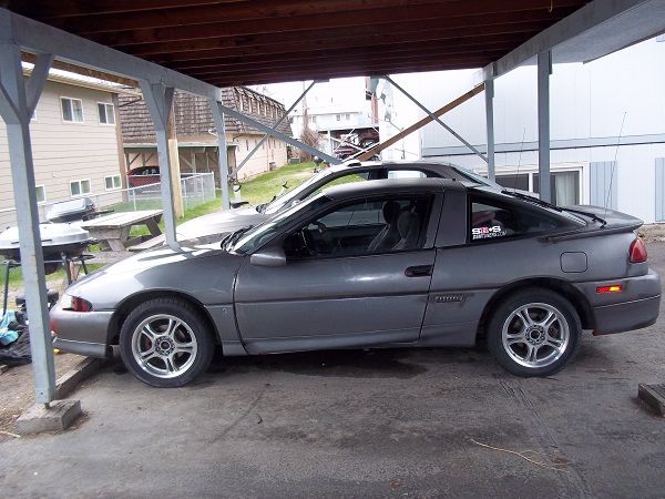

heres a few pics after a awsh and wax in some sun shine. let me know what ya think. shes a little rough but shes beautiful in my eyes. i would love some input in my build as well. ideas or suggestions
Nawwwwzzzzzz
Seriously, how bad is the suspension with it being a northern car? I'd look into replacing the bushings and getting parts either replaced or blasted and powder coated. I'd focus on trying to do whatever you can to save the Chasis before worry about more power.
Good luck!
Well the rear suspension is solid the front on the other hand is is shot. Struts are HORRIBLE. But all the bushings look good but its only a matter of time with how bad the front struts are floats like a caddy LOL. I was looking into coil overs and energy suspension bushing kit next tax season. This car was pretty baby it was originally owned buy an old man who sold it to his son and shortly after the tranny went into limp mode and the kid thought the tranny was shot and he sold it to me.... well he traded to me for a beat ass 77 4x4 chevy that was stuck im 4wheel drive and had 245000 on the original 350 and 200 dollar laptop.
