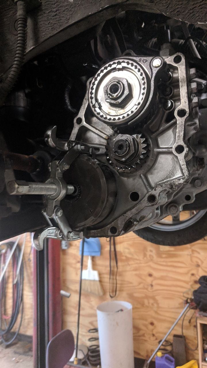

My non leaky transfer case is in. My output shaft seal has been replaced. honestly the hardest part about it was getting picks in there to get the old seal out, the rest of it was cut and dry. Went to swap my o2 housing over to my holset and one of the studs wasn't lining up so I couldn't slide it on.. tried to get the stud out and it snapped flush in the BEP housing... so it's currently at the machine shop. In the meantime I have the non turbo waterpipe installed, my new alternator in. and am currently waiting on a few pieces.

Did the VC come off easily with that puller? I need to put a 23 spline shaft in my trans.

Yeah Marty it's pretty easy.. i'd recommend pulling the rotor/bracket/caliper off and getting them out of the way so you have more room for the puller. (also so you could hook an impact to it) just make sure not to lose that little ball bearing that holds the shaft in. make sure you have good snap ring pliers

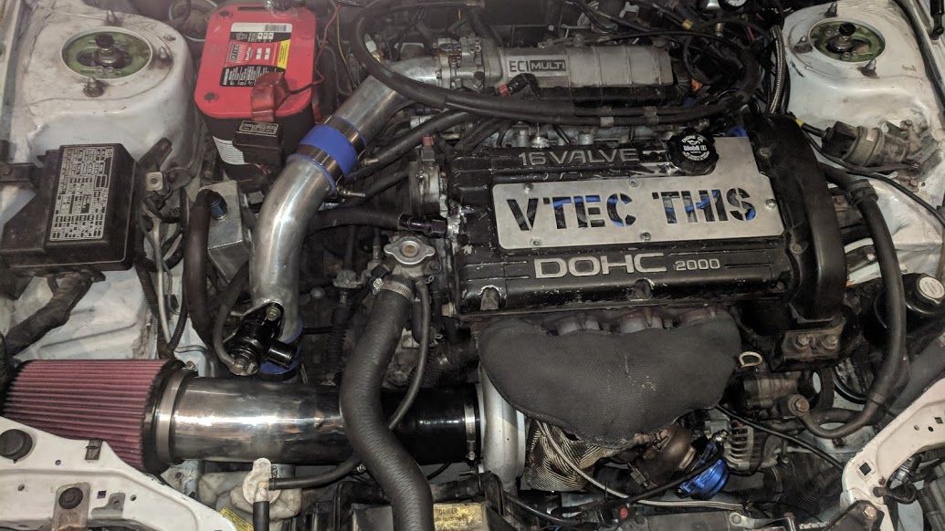

Getting the fans and everything else to fit was kind of a tight squeeze. I had to modify the stock passenger side fan to fit around the coupler.. took some trickery but I got it in. I'll take some pictures here soon, I've been slacking.
More slacking.. Made a 4" intake from silicone intakes.com and a 4" filter from stm. total cost for that bad boy? 85 bucks shipped to my door.
I also switched to speed density and am going to move my wideband o2 from the front spot to a secondary location to get my front o2 running as it should be again. my laser is set up with the wideband run farther down and it seems to run much better.
