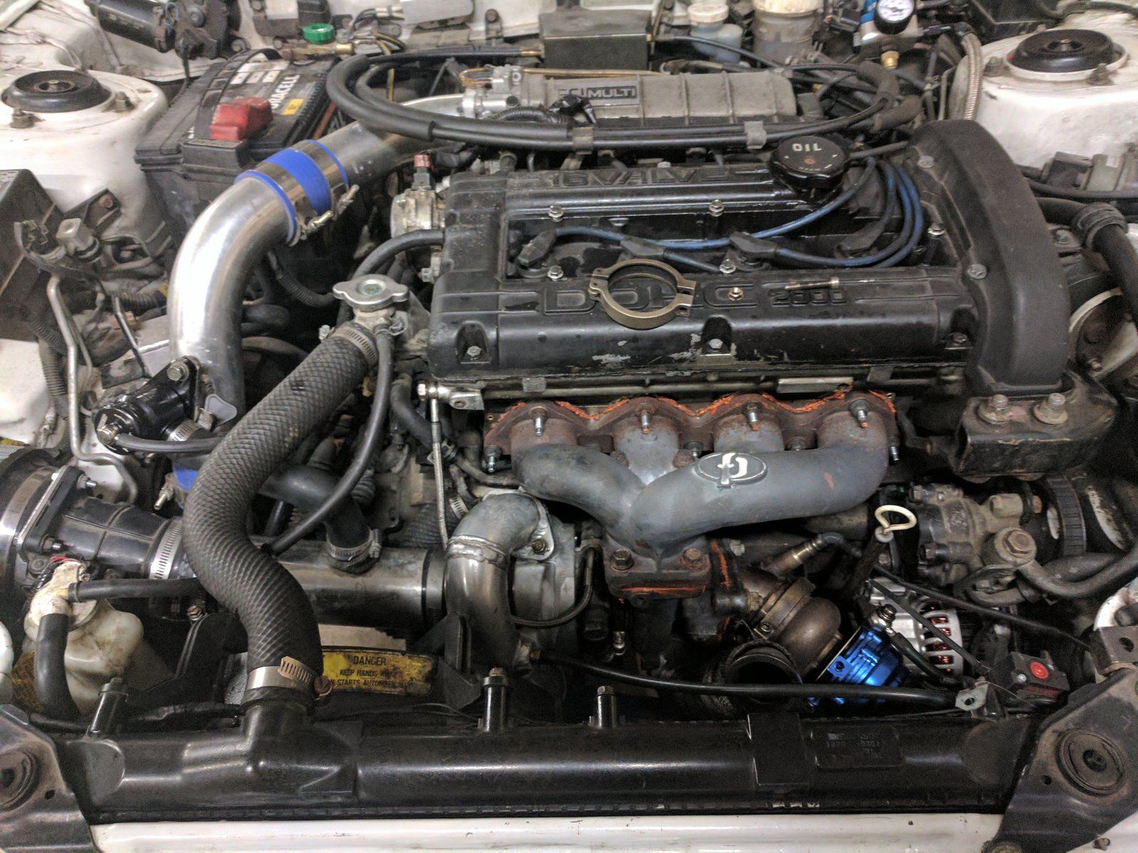

Right now I've ended up with a PR fmic, fuellab AFPR, custom intake piping, a montero MAF, Evo III 16g, 44mm EWG setup mounted to a PR o2 housing, FP manifold. ECMlink, MTXL wideband. FIC 850cc injectors, walboro 255, JNZ short shifter.
The head gasket is factory with 94k on it, stock block. stock head as of this moment. I have a set of comp cams to go in with some evo8 valvesprings and retainers.
Transmission.. has an ACT 2600 kit in it backed by an ACT streetlite flywheel, I do not care for it due to how easily it wiped out my clutch pedal assembly, Had to pull it on 3 separate occasions, I ended up taking my assembly to a local fabricator who welds race car chassis, 20 bucks later I had my pedal assembly welded and it has been holding up for almost a year now.
I had the new model 68hta installed in my car from feb 2016 until late may 2016, I removed it to go back to an evoIII 16g because in my opinion, for a street car it is quite laggy, It made first gear completely useless and second wasn't much better. Don't get me wrong it hauled in the upper RPM range but for EVERY DAY driving.. I wasn't impressed. I will be posting back to back ECMlink logs, the 68hta against the evoIII with no other changes, hopefully to give some people useful information if they are thinking about making the same jump I did.

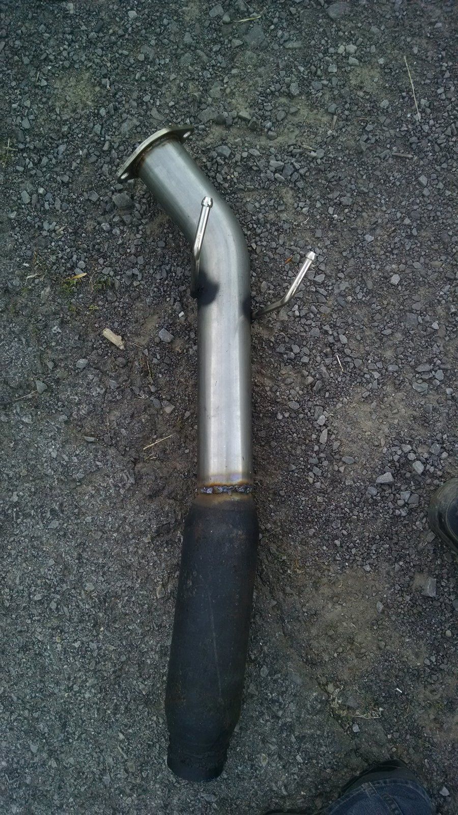

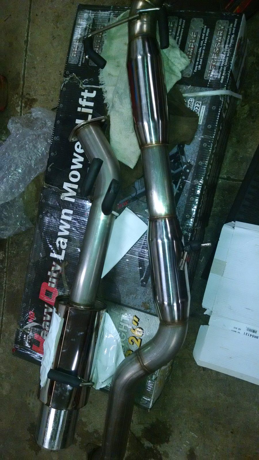

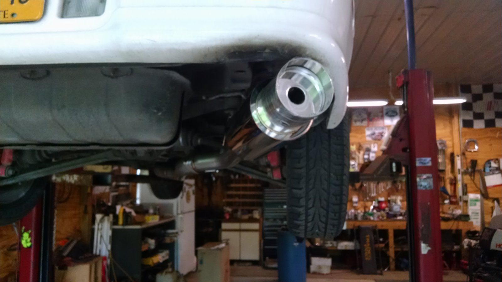

Alright guys I was gonna post a thread on the forum but I don't really have enough pictures to make it a decent how to.. but I recently purchased the 1g AWD stainless exhaust off of amazon (140 shipped!?) So.. heres what I got.. and here's how it fit.
Overall it LOOKS good. I'm sure this is a ripoff of a larger brand of some kind, don't really care as I was only interested in the piping that didn't have my horrible welds all over it.

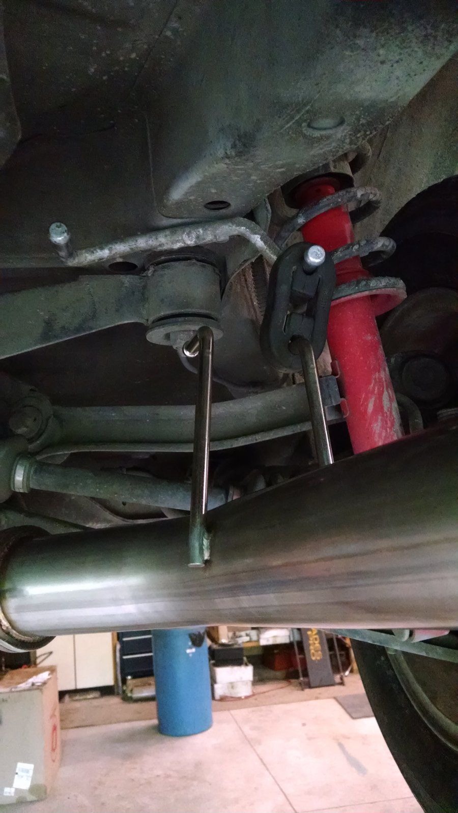

Exhaust hangers? Not quite so much, if you do buy this setup be prepared to grind an reweld your hangers wherever you need to. I never even attempted to use the horrible fart cannon on the back on that thing.
It looks better without the silencer in there.. but I refuse to run one of these on my car for any reason.
Cut and welded on a 2.5 inch moroso spiral flow muffer I had laying around from a different project, yes I know my welds look horrible, but they work right?
Actually if any welder can tell me what I was doing wrong to make it look that way that'd be great, I just kind of go by feel and that bead did not feel good.
Overall if you don't mind grinding and rewelding the hangers for 140 bucks you can't beat it. I almost can't custom build an exhaust for that price.
One important note though, this is a catback exhaust so if you don't have a test pipe you'll have to cut and extend the pipe 20" and rotate the flange to meet the downpipe.

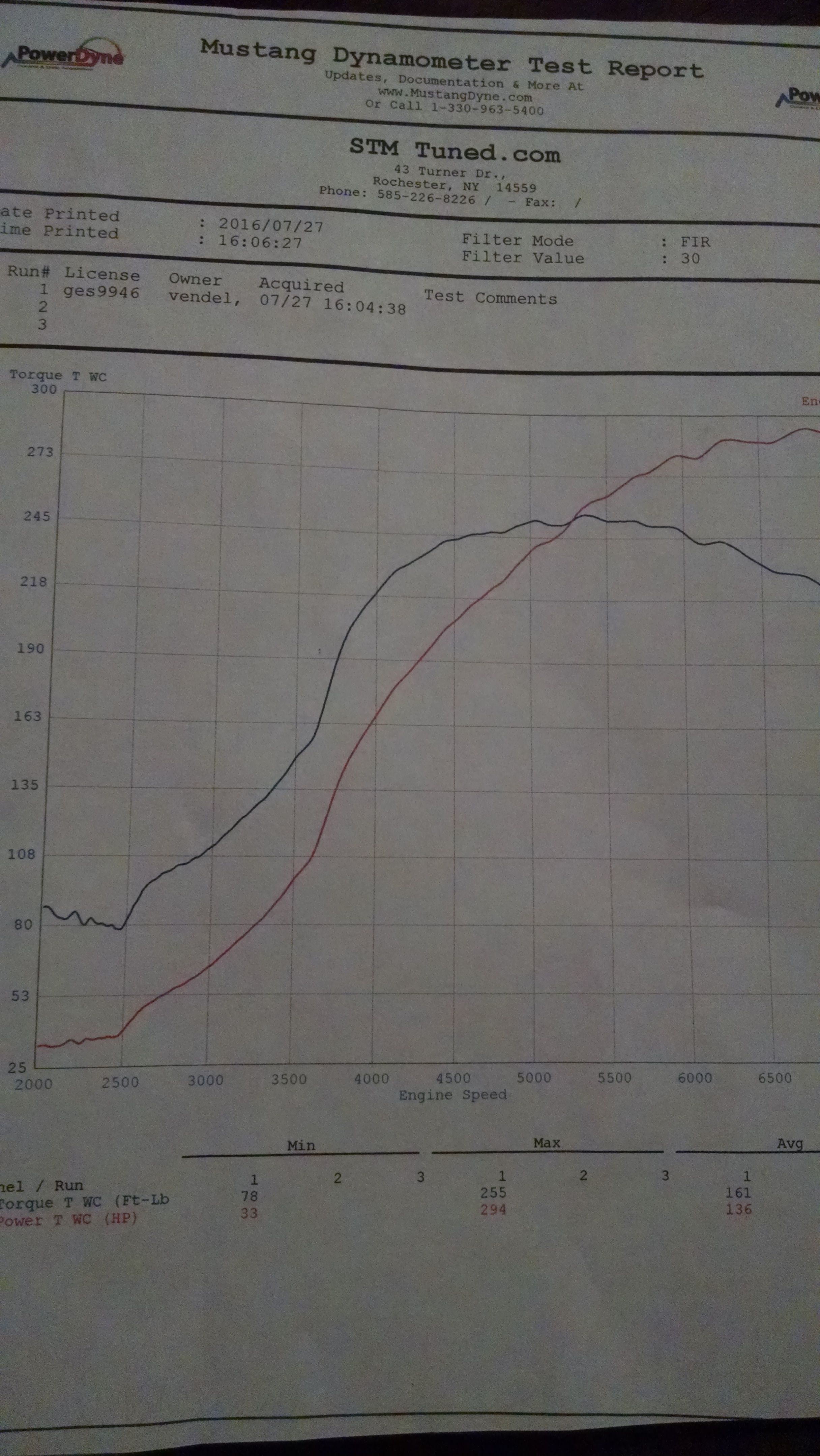

Took the car out to get dyno'd at STM last week, put down 292WHP, 264torque. not terrible on a mustang dyno, equates to about 345whp 310wt if it were a dynojet. 25psi on pump gas with a 16g. so not terrible either way you look at it.
I plan on installing the 68hta back on the car and taking it back to STM to see what kind of gains Ill get in power and to see the loss I'll get in spool. Hang in there and I'll post the dyno video, graph and log.

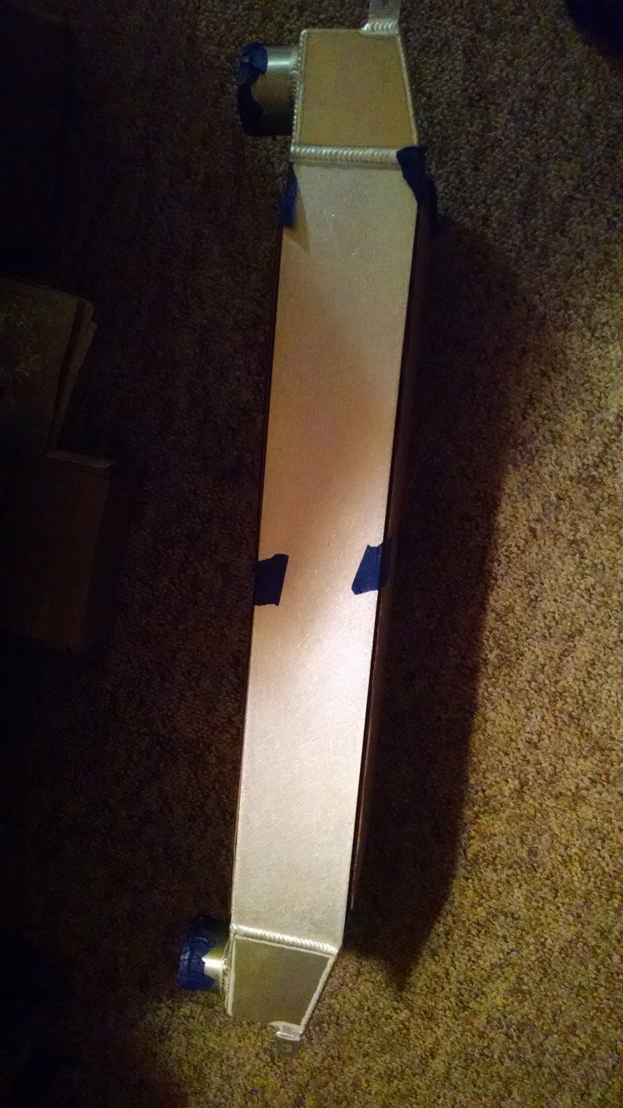

New 4" ETS intercooler may not allow that, I have not mocked it up yet so I have no idea how it'll compare with the PR FMIC.

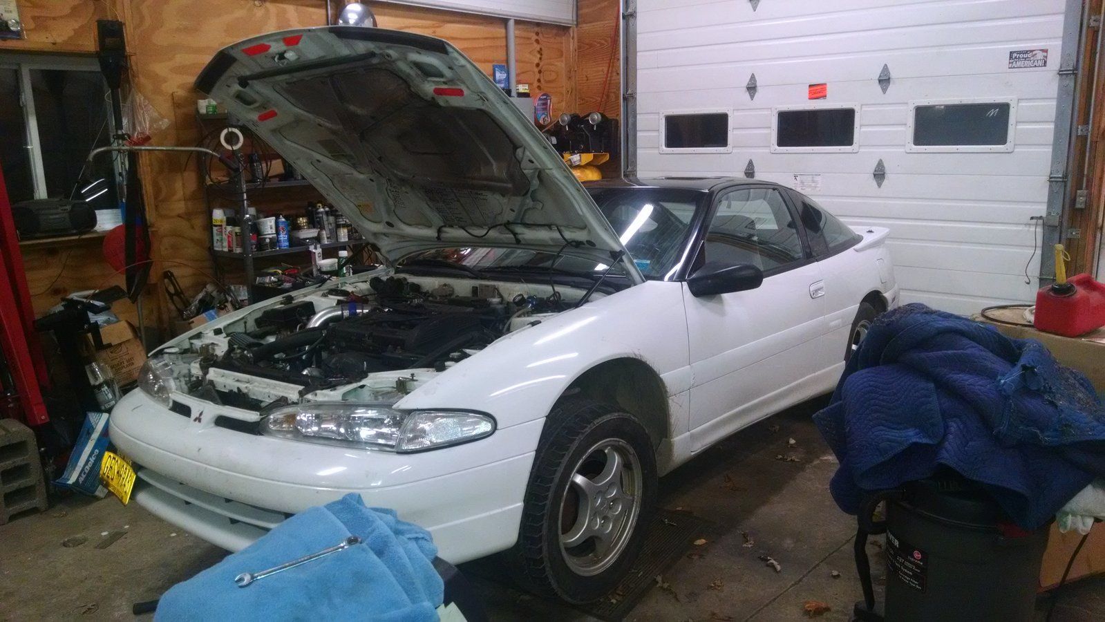

No real progress on the GSX, first snowfall today, I'm still being kind of lazy, the rebuilt trans/transfer case is coming back soon, so I think I'm going to do the trans swap, turbo swap and pull the front end off at the same time. I'll take some pictures as I go along.

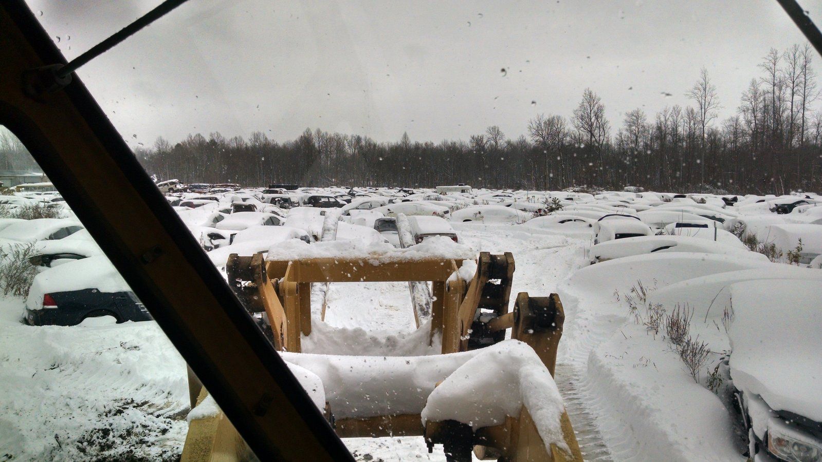

This is a view of my playground, My job is to sort, and generally just be responsible for almost 3,500 cars in the yard, there's cars all the way to that treeline
And we got another 10 inches last night. Gotta love new york, it's supposed to be 48 on friday, so all this will be gone by saturday again.

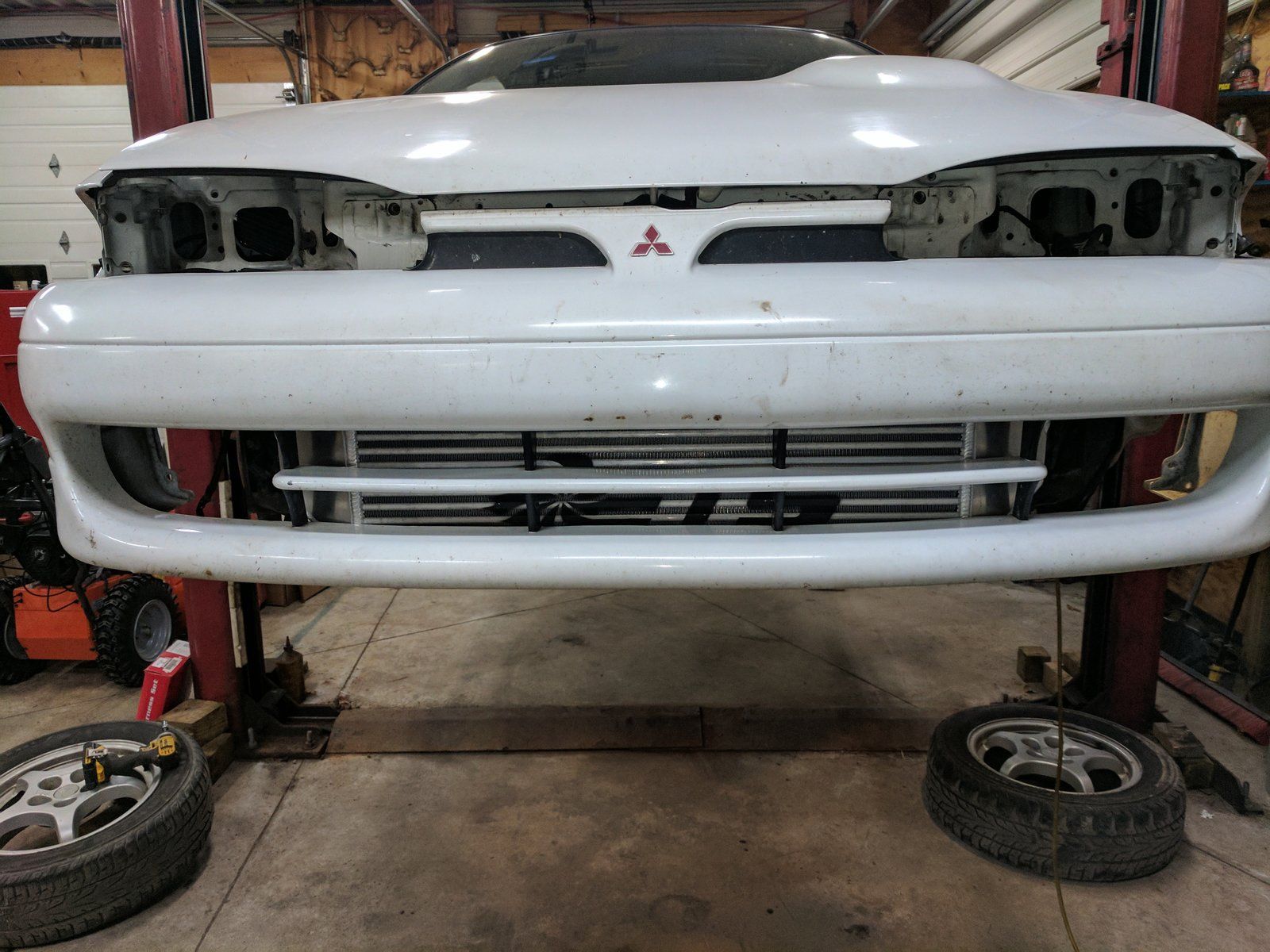

First off.. IF you have a PR FMIC and switch to an ETS you might hate yourself as I did because where I had to cut my reinforcement bar to fit the PR FMIC is EXACTLY where my ETS one bolted to.. So I had to get a new rebar. @Michael Helsel I'll be heading down your way in late April, I'll bring the Rebar and PR fmic if you were still interested in it, dodges the cost of shipping.
ETS Intercooler bolted up nicely, small amount of fabrication but of course I didn't take any pictures of that. Fit's perfectly behind a completely stock rebar.

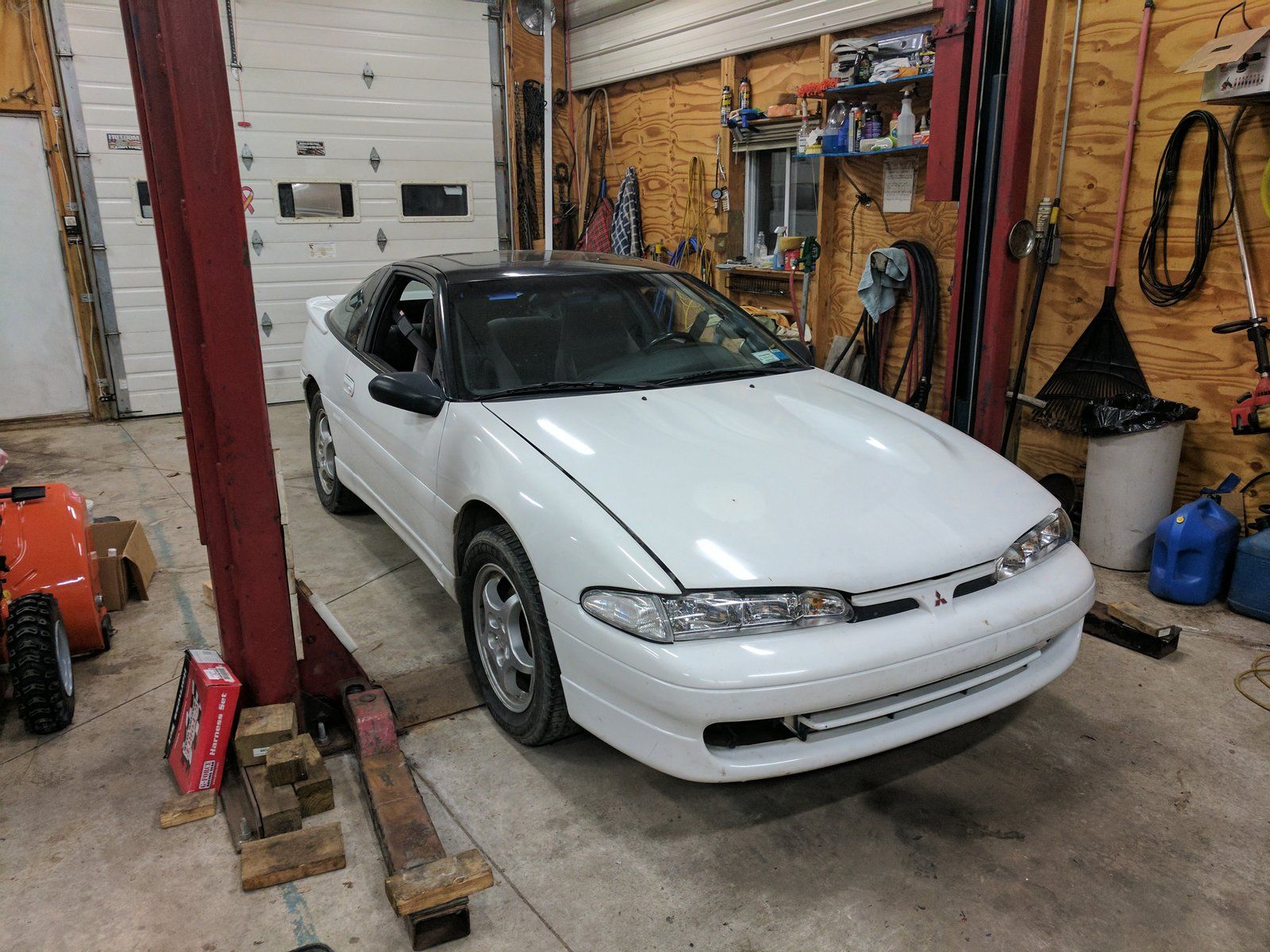

Sometimes when I roll my sleeves up and stop complaining.. and have a lift to pick the car up a few feet off the ground so I don't have to bend over things seem to go faster. LOL

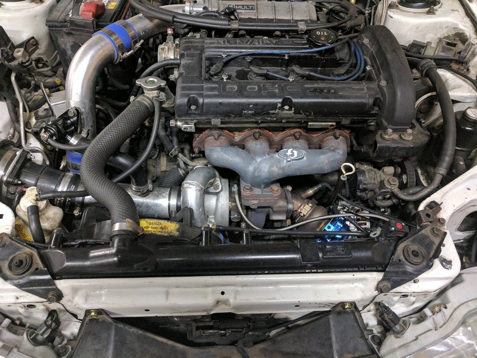

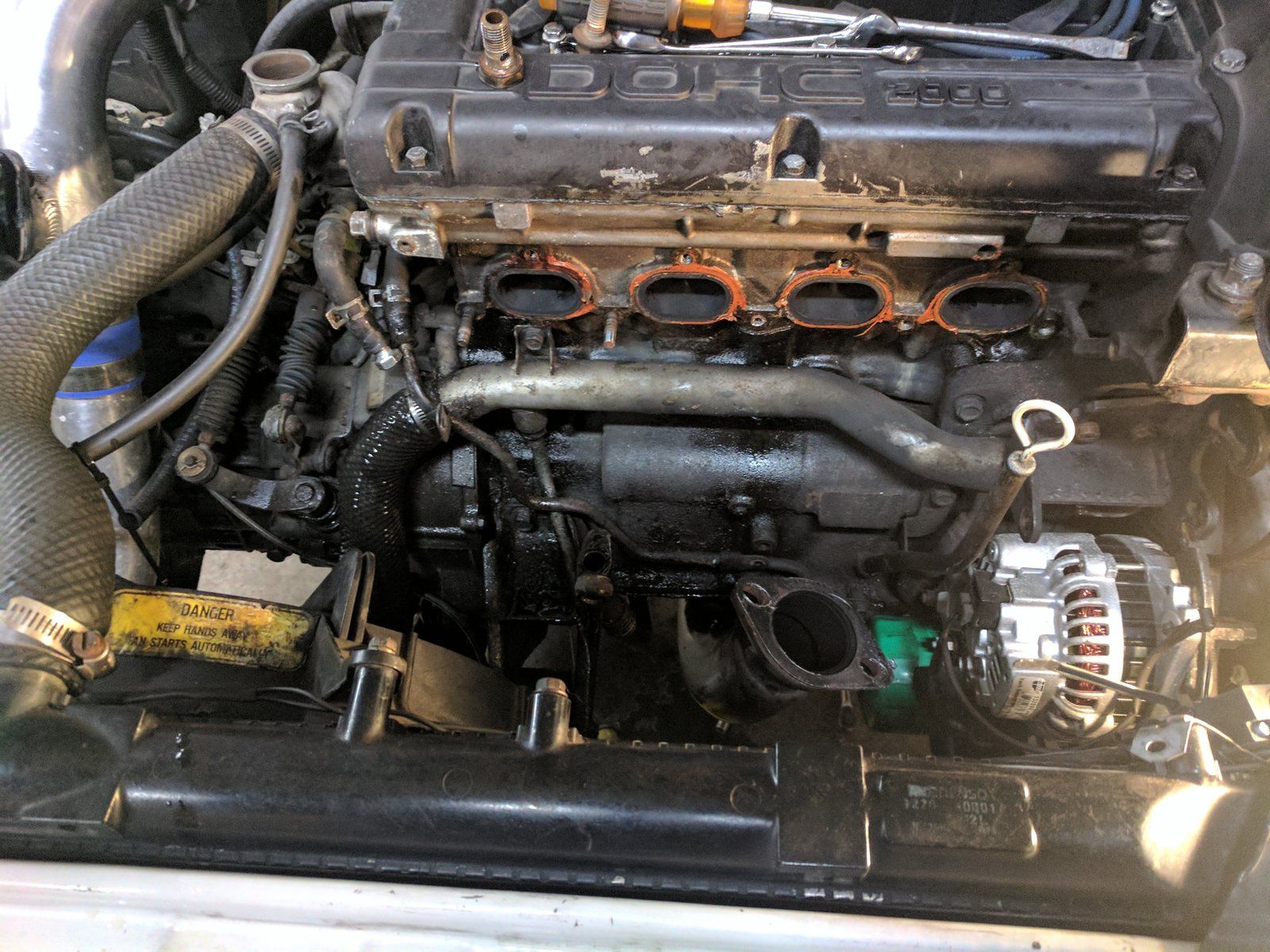

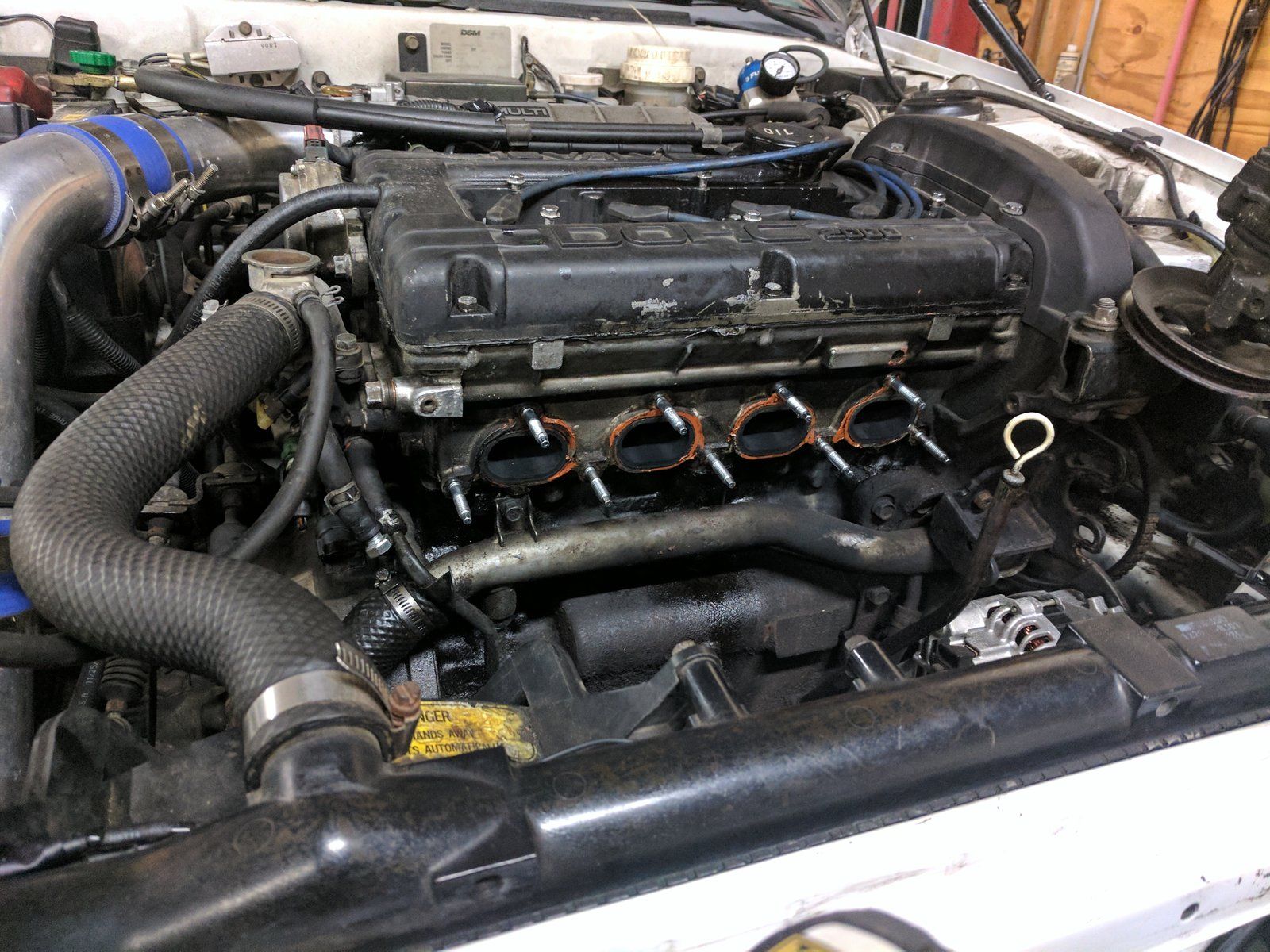

I got the v2 68hta out, swapped over my o2 housing and got the V1 68HTA ready to go in, installed some manifold studs and swapped my feed lines around, going from feeding from the OFH (recommended for v2 68hta) back to feeding it from the head (recommended for the v1 68hta since it is 16g based)
So here is where I ended up tonight before shutting the lights off since I walked around and swore for 15 minutes but still couldn't find my new turbo drain gaskets.
I'll clean the RTV before everything comes back together, just got lazy towards the end. Although if you look closely you can see where I modified the PS bracket so that I don't have to pull it to get to that manifold stud.

Well.. v2 68hta is out. v1 68hta is in.. I'll have logs soon, I still have some more work that needs to be done before I can turn the boost back up.
