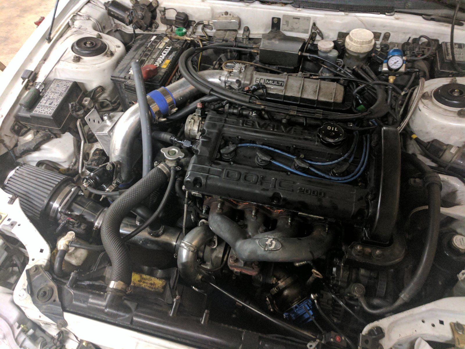

Something clean and simple... sort of

Ended up ordering a catch can from Gamble garage, he came recommended so I'll give it a shot. All I'm waiting on now is the weather to fully break so I can paint this new welded valve cover, then I can start tuning with the v1 68hta!

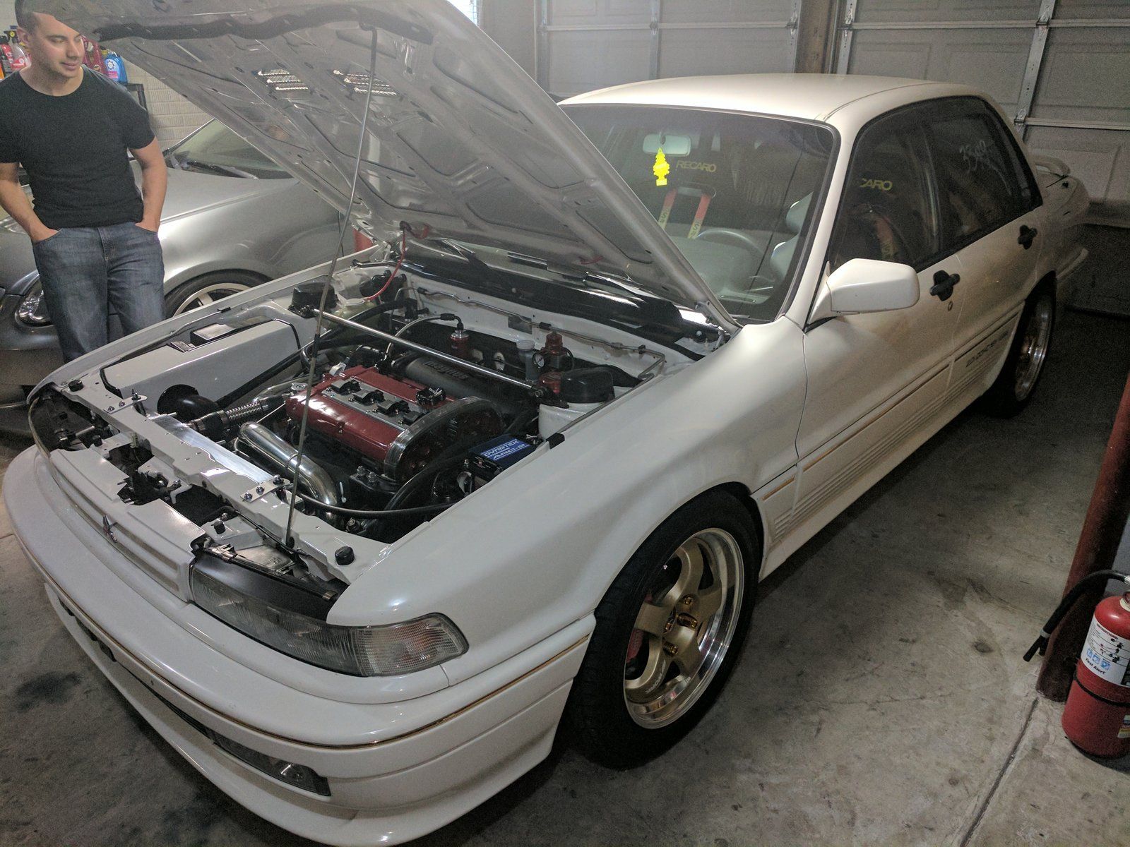

Got back to his place and finally got to see this beast in person.. Pictures honestly don't do it justice guys, 1837 is beautiful, and the car is insane to ride in.. @GST with PSI the offer still stands for you to come up and use the lift to swap trannies! LOL

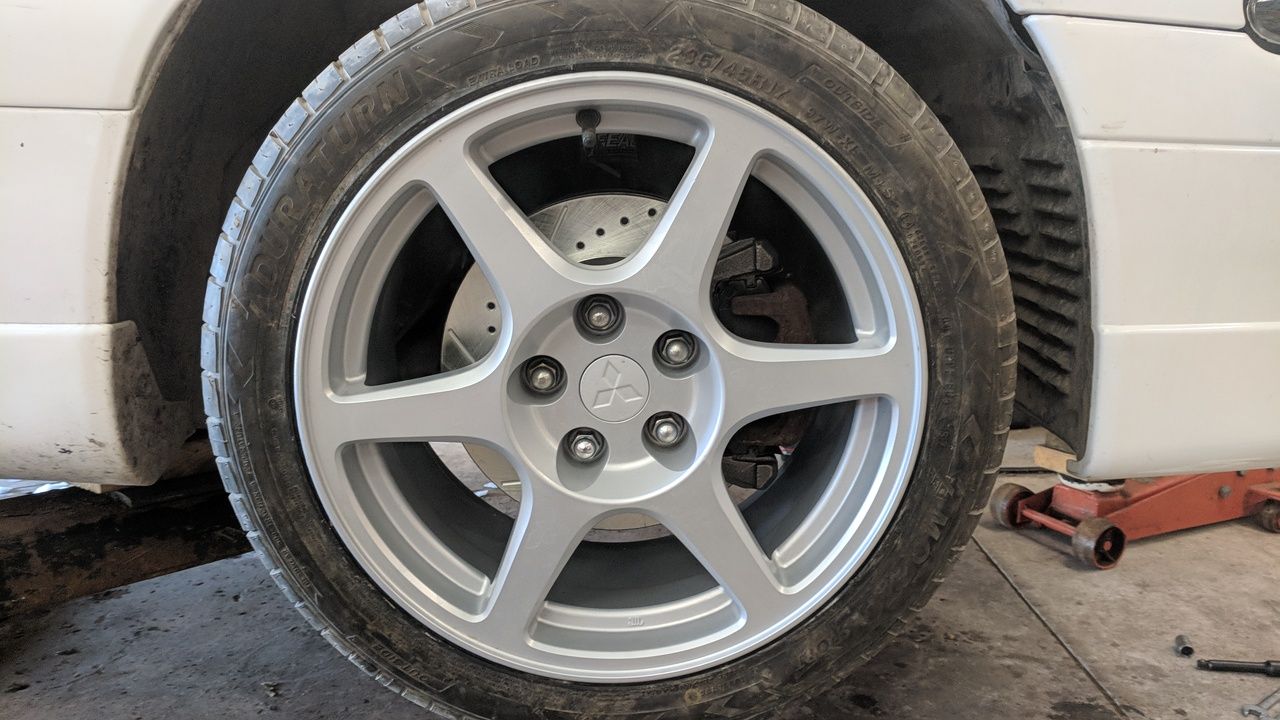

Well.. I've been sidetracked with a few pet projects.. an 06outlander recently came into work.. So I'm grabbing the caliper brackets! Just picked up a set of 17s for the GSX as well.

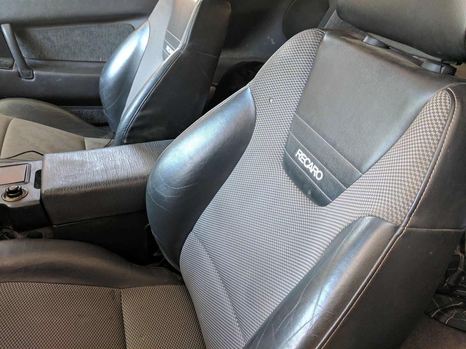

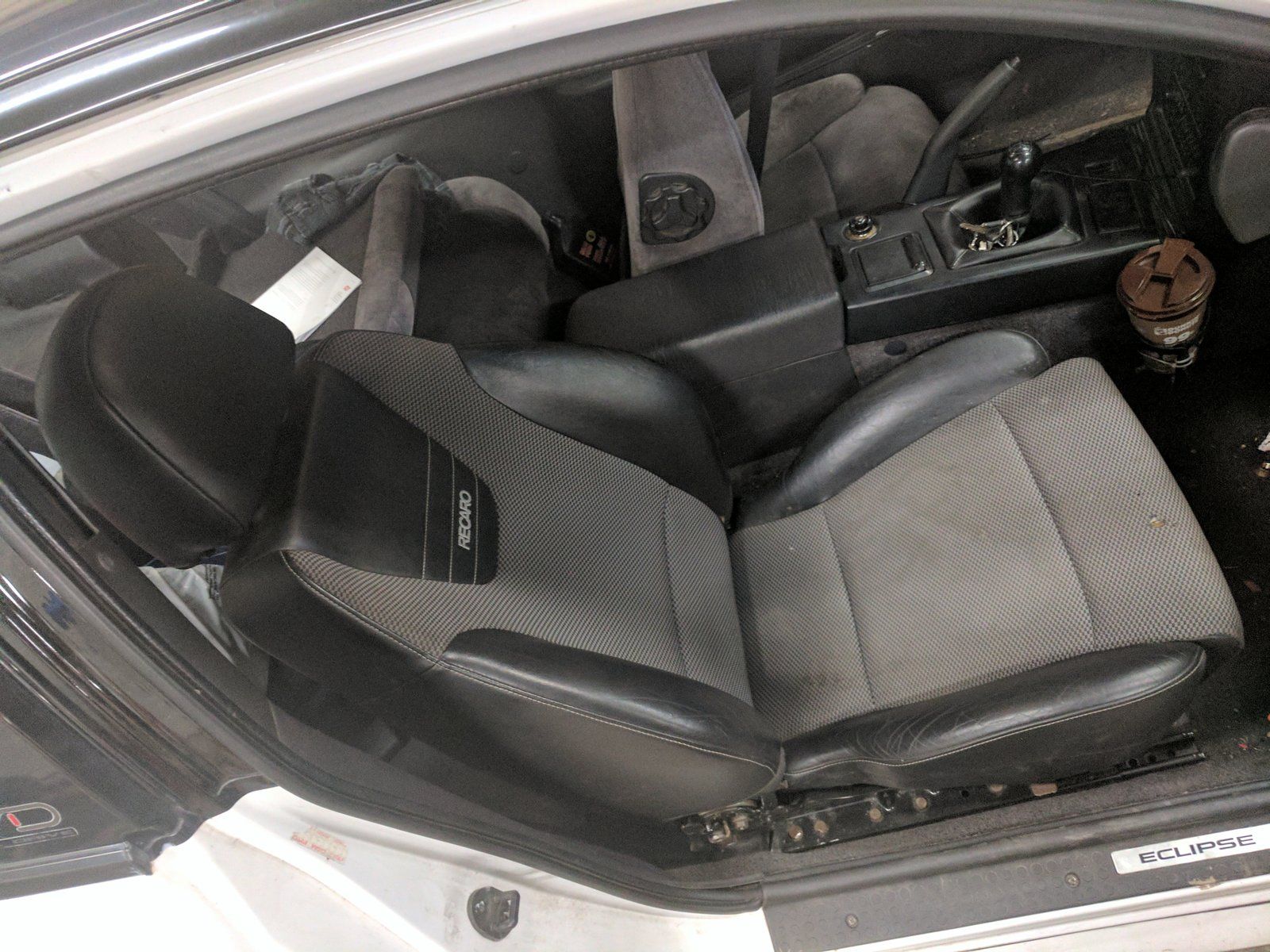

Seats came out of an 06 Ion Redline.. They are extremely comfortable.. but they also do not fit.. AT ALL. Passenger side is almost done.. Driver's side will be even more difficult. I do not recommend attempting this swap.

Looks good doesn't it? Too bad it doesn't fit.
The brackets I used for the drivers side were height adjustable.. and well. that didn't work out so hot. I'm going back to the drawing board on these. Currently they physically fit but the drivers side sags hard on the drivers side.

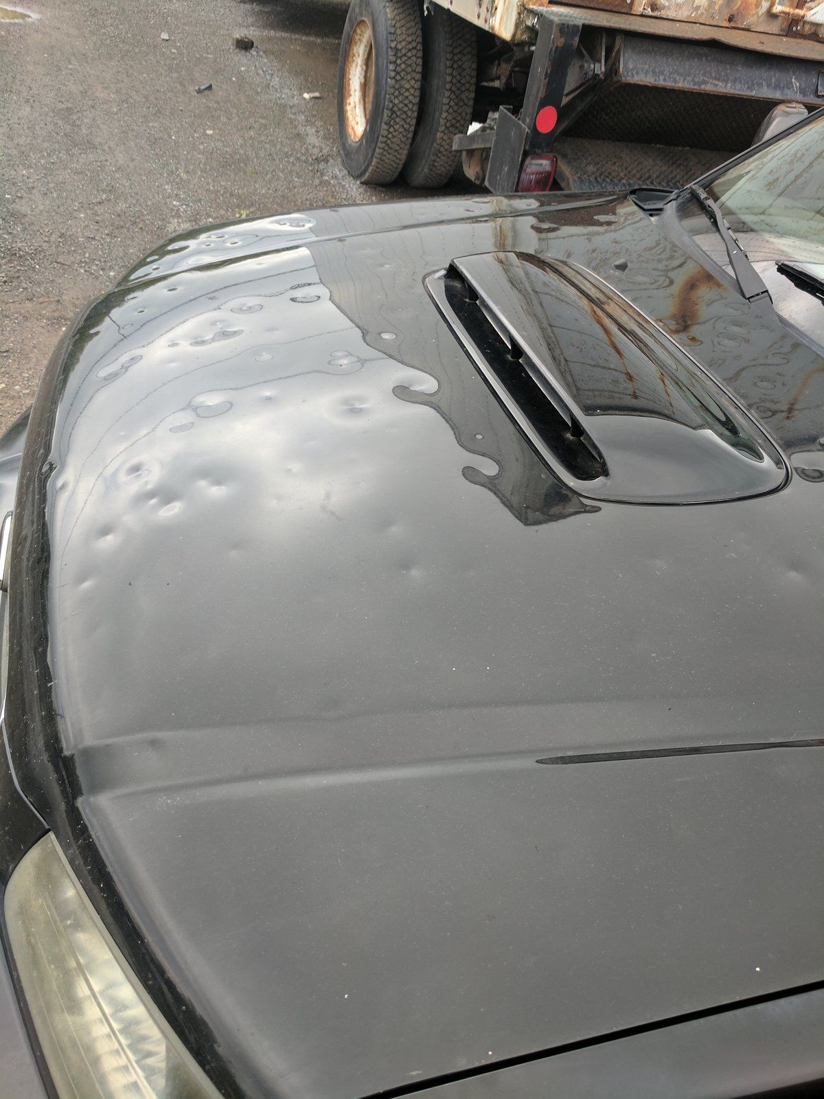

Then.. A few days ago THIS happened.
That was the start of it.. they got up to about golf ball sized.. thankfully I didn't have the GSX in this.. but I was driving the Forester.
And apparently my insurance agent decided not to put comp or collision on my cars like I asked him before he got fired. Go figure.. So now I'm screwed.

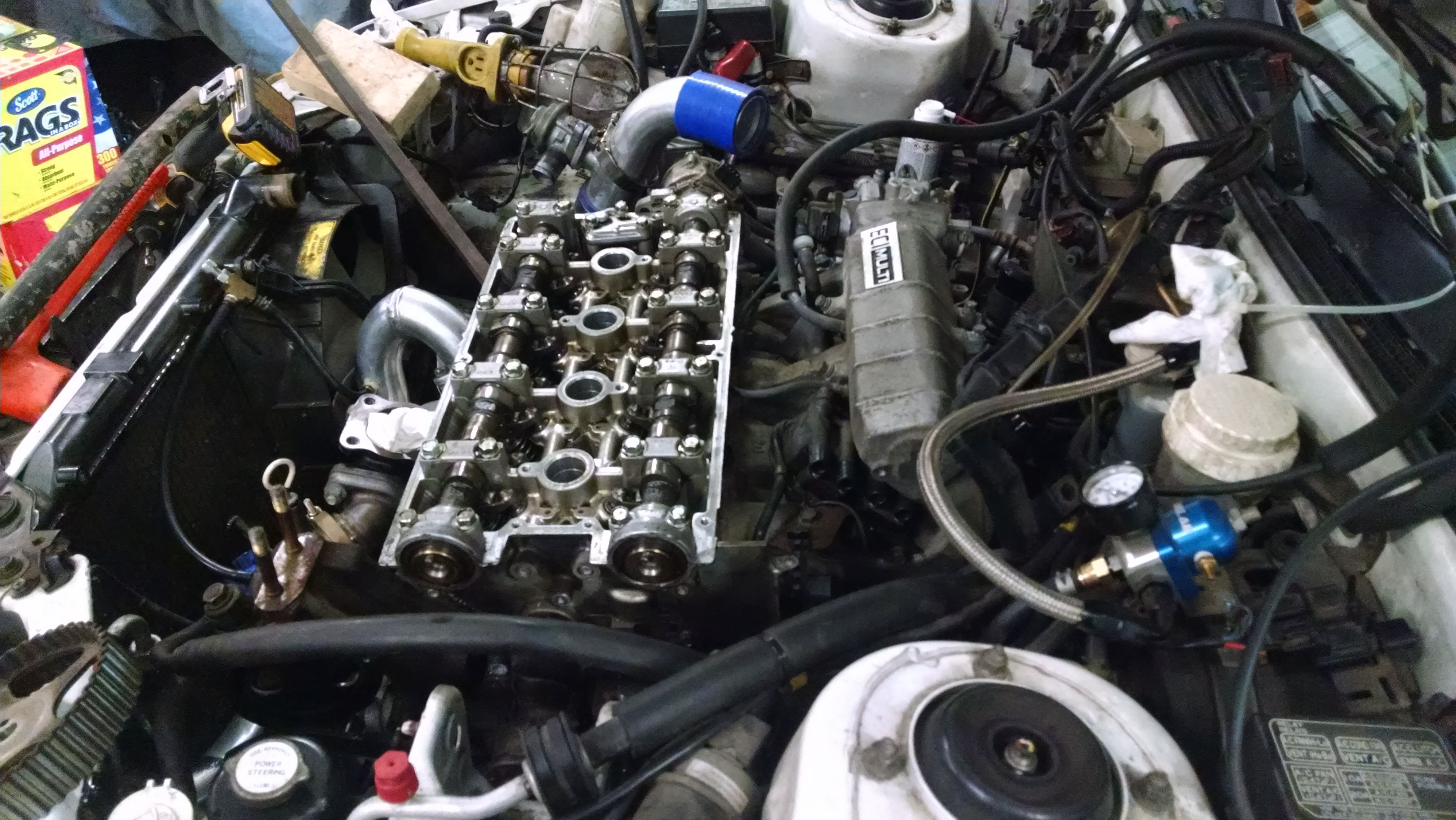

Catch can fun! Finally got around to working on this damn thing.. after I lit the car on fire a week or so ago.
I do have to say this, as much as I'd been putting off running AN lines because I thought they'd be a nightmare, it wasn't so bad.. a little annoying trying to figure out how to route it all but I was using -10AN vibrant pushlock hose from STM. Good stuff.. just fair warning, make sure you get your lengths right because once you get those pushlock fittings on they're a PAIN to get off.

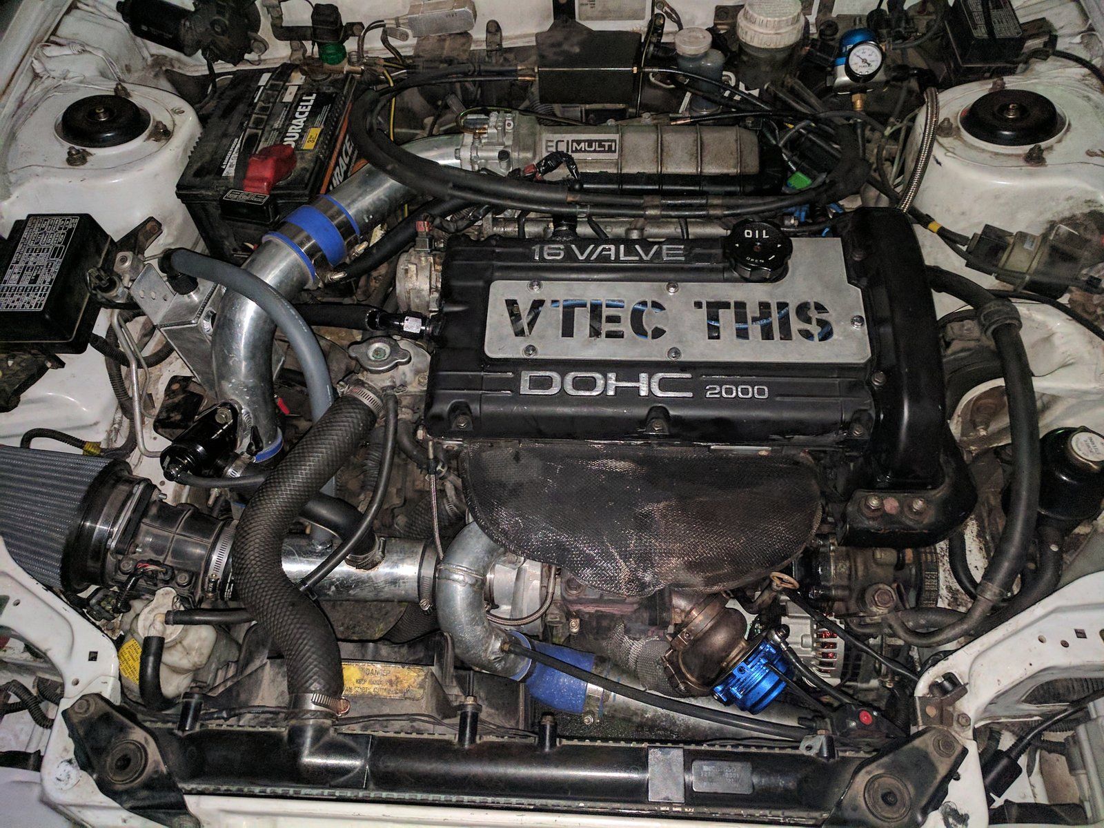

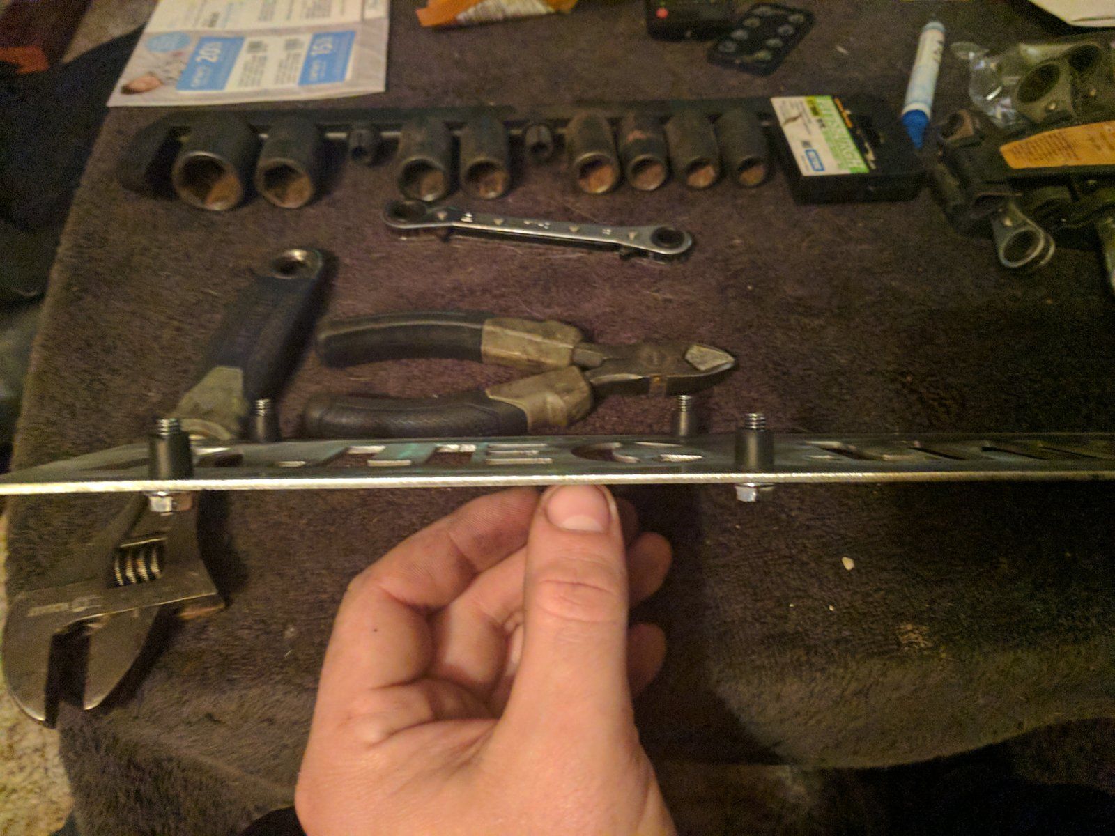

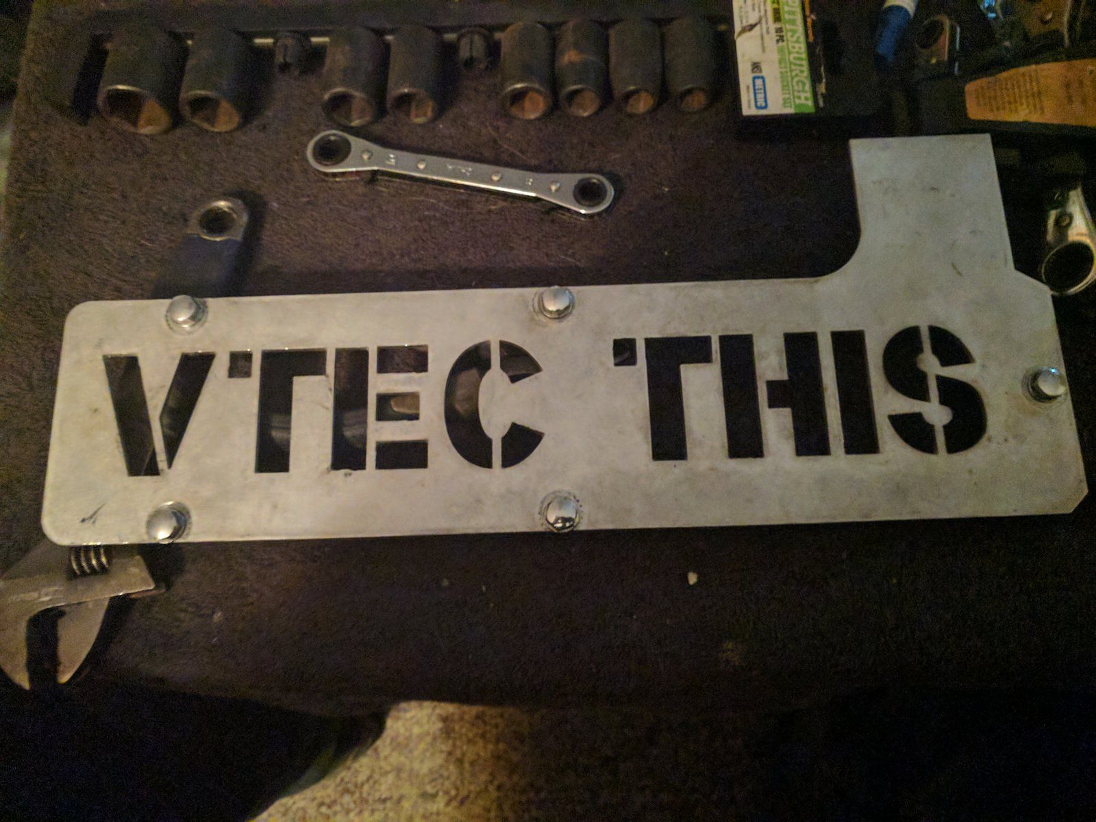

Also.. Decided to put my @Gamble97 spark plug cover back on to go with the catch can I purchased from him a few weeks back, thanks again it looks amazing!
The only issue I was having with it was it was squishing my NGK plug wires.. so I decided to get a bit creative. I grabbed some stainless bolts from the top of an acura TL (all the 99-03 3.2 acura TLs/CLs use stainless mounting hardware on the upper intakes.) so I took some of those.. and some vacuum line. and.. well you get it. I made spacers. Yeah. Pictures.

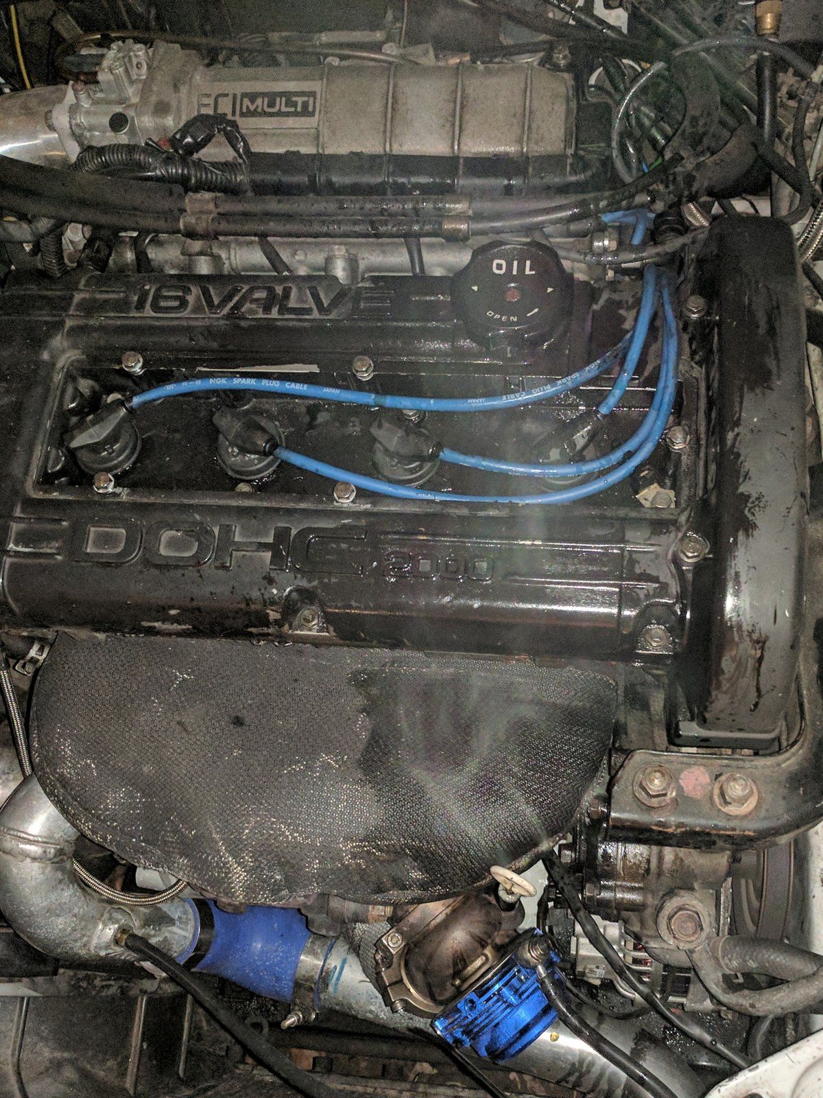

Yeah.. I'm still trying to clean up the oil mess from when I decided to do a 3rd-4th pull and puke oil all over the engine bay and it lit my manifold blanket on fire :/slowly but surely.

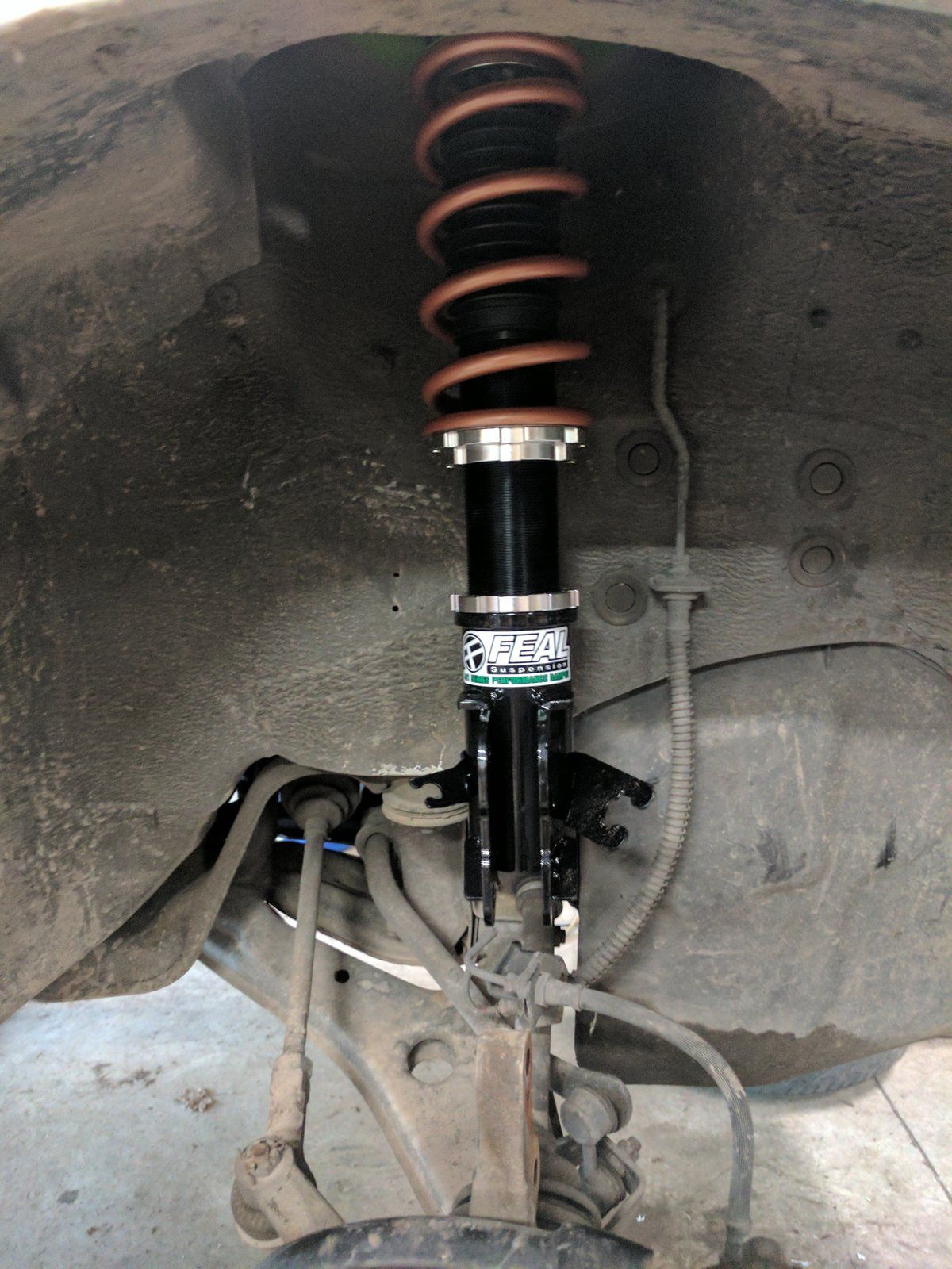

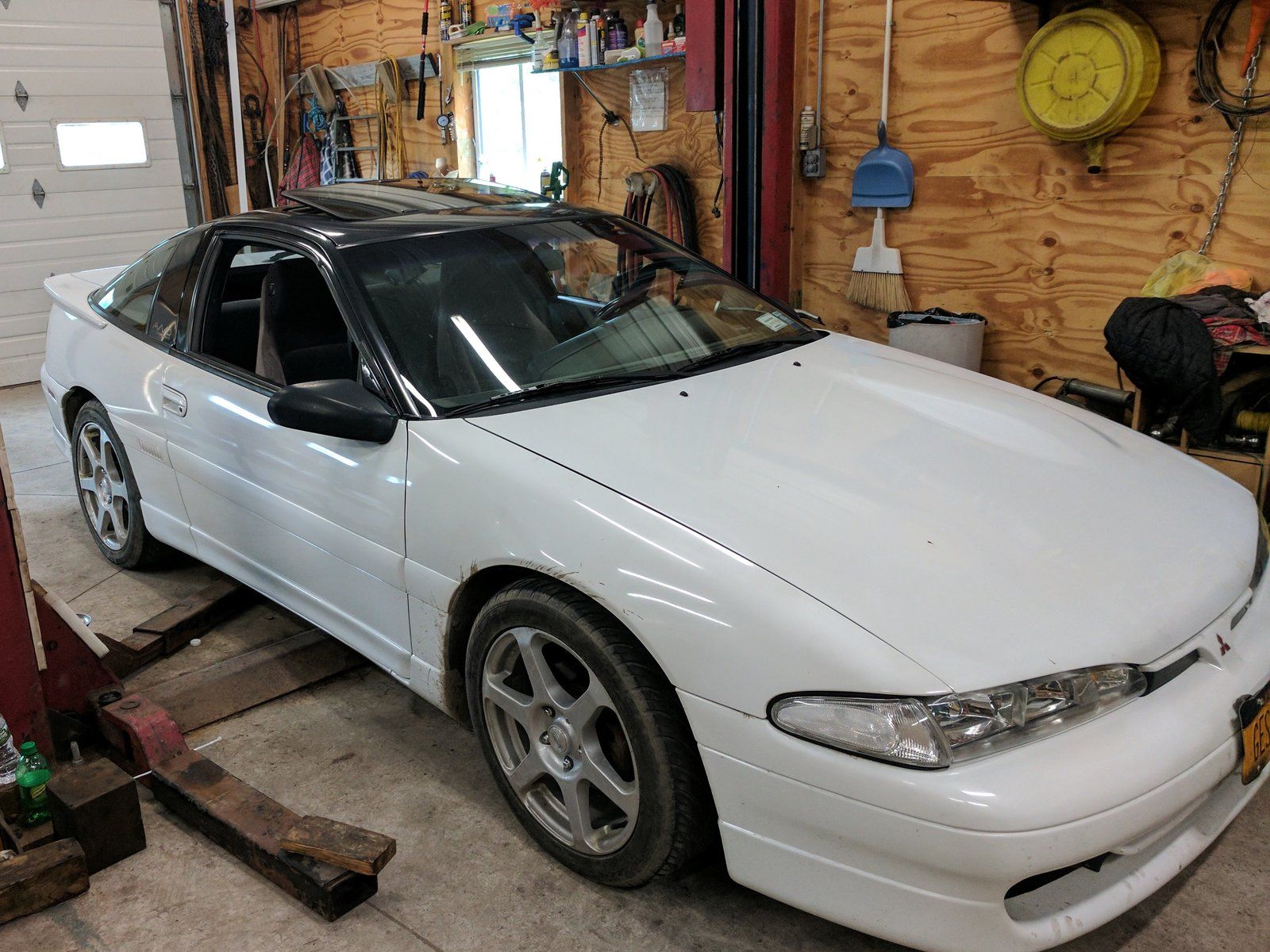

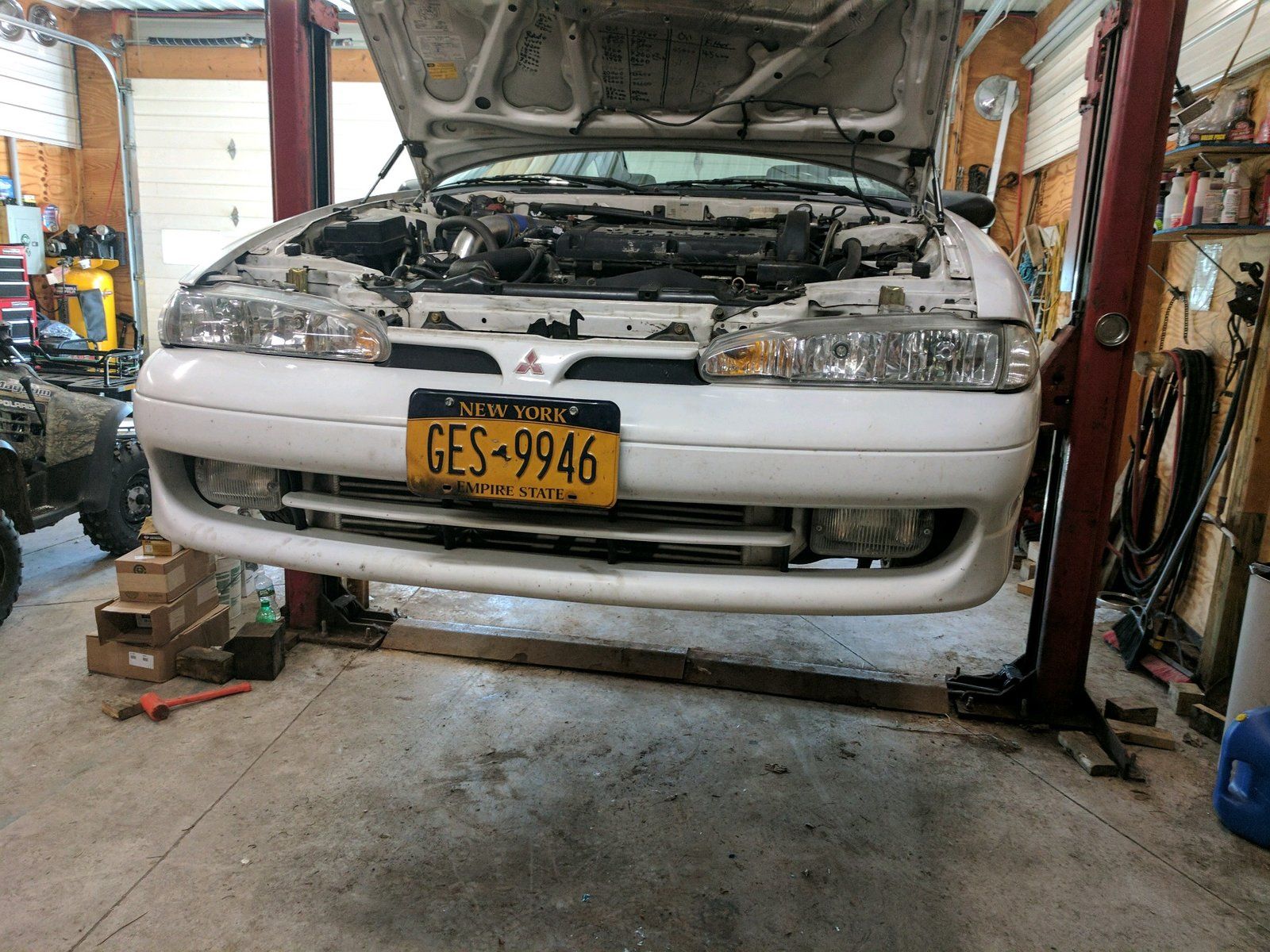

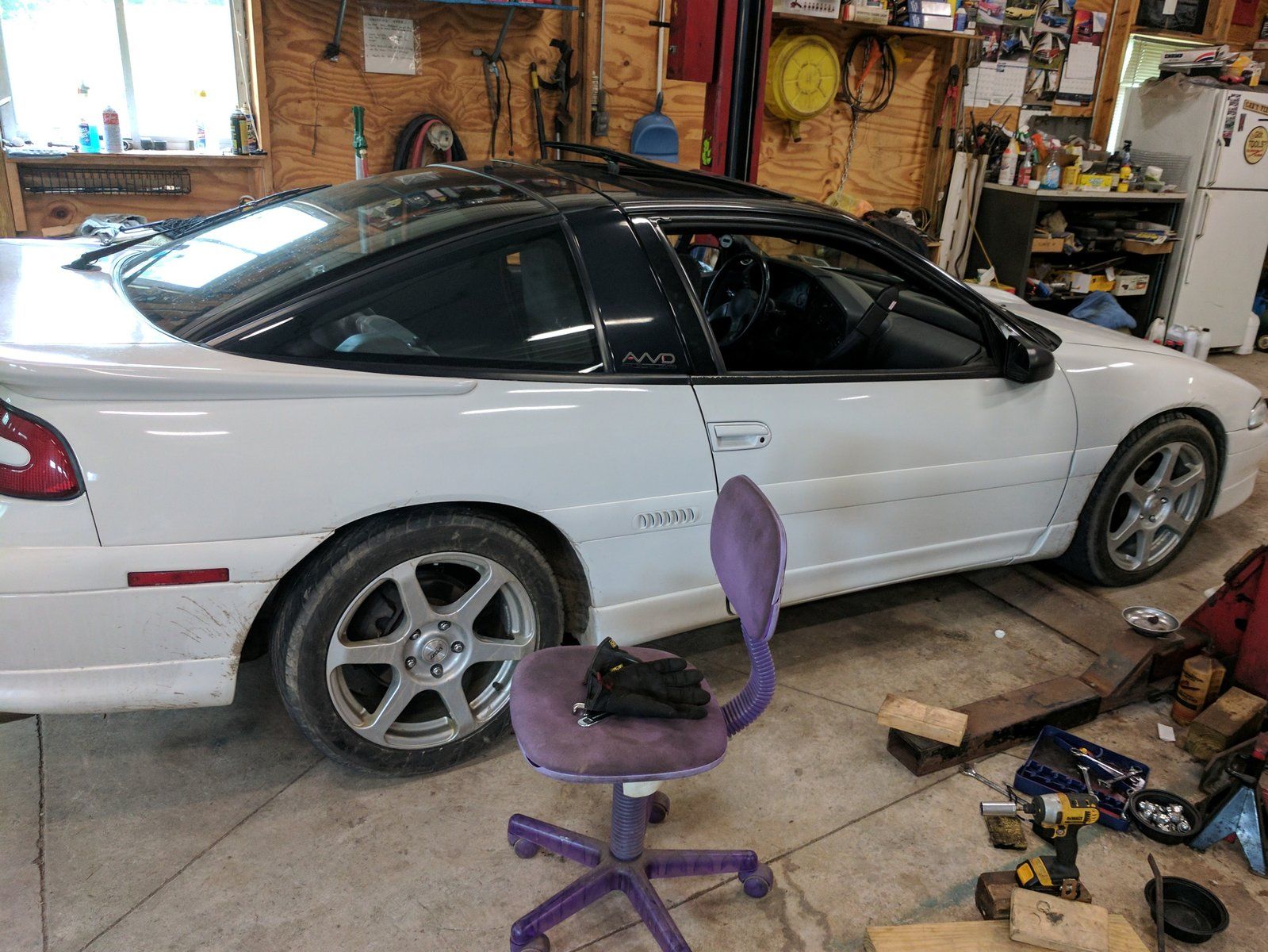

Guys! I bought some coilovers! Feal 441s, I can't thank the seller enough for hooking me up, and now that I've got them installed I absolutely love them. It was a bit of a learning curve at first getting them installed and figuring out where I wanted the height to be, I was aiming for a bit of a "raked" look, the back end up a bit compared to the front. My car has always had horrible issues with the back end squatting hard, hopefully this helps. Pictures.
Don't judge the chair! It's survived a lot.
Still playing with the v1 68hta at 30psi. It's doing very well.. next step is some evo8 enkeis, new tires.. and.. that's about it. I've got bigger things to worry about. Daughter was born on 7/3/17 at 3am. Since then everything has kind of taken a back seat.

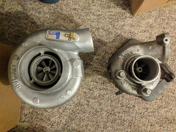

Also picked up a new turbo.. Justin built for me. It's an hx40 stuffed in a 35 comp cover.. so that'll be fun.
