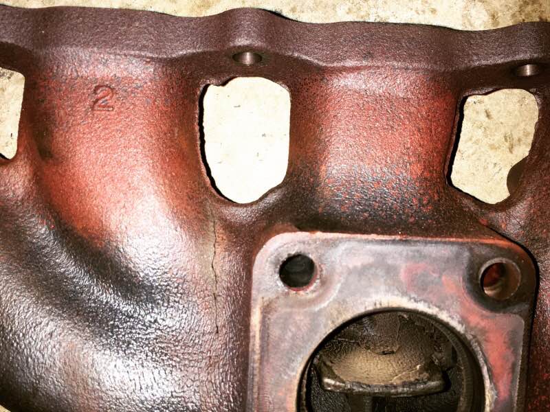

Picked up a used trans for a pretty good price locally, it was dirty as shit but looks to be in ok shape from what I can tell(we'll see when I bolt it up haha). Got the trans about halfway out, just got to unbolt a couple more bolts and drop it. Decided I'm gonna take this opportunity to clean up/inspect and possibly port my turbo, debating getting a 16g and just upgrading while I got it all out which is my ultimate intention. I got some pretty nasty oil leaks from the turbo lines gonna clean those up and replace all the gaskets.

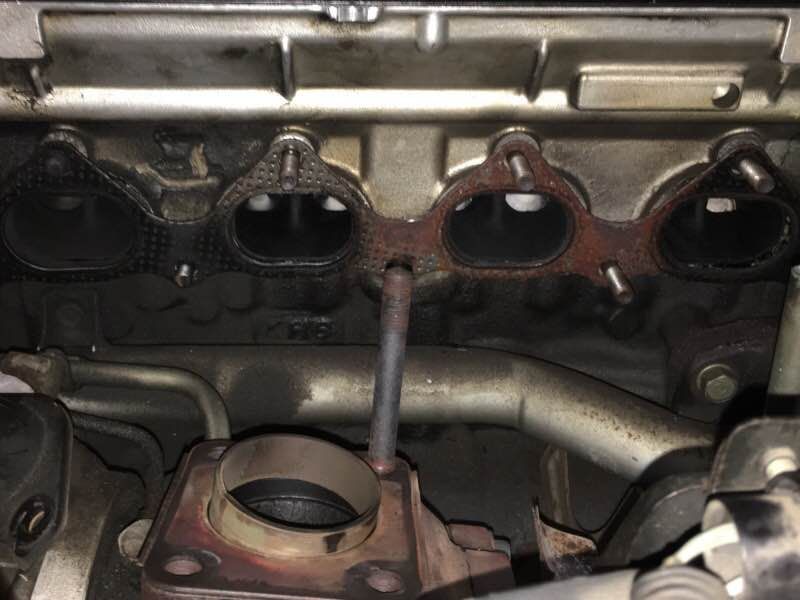

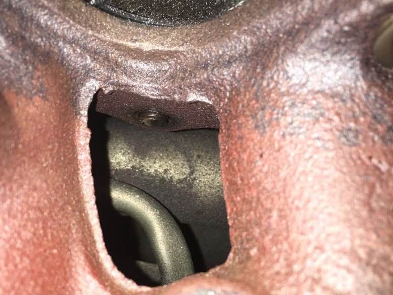

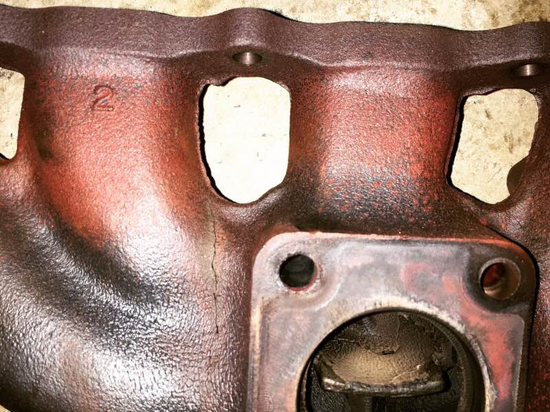

I got somewhat lucky on the exhaust mani, one bolt was already broken when I removed the heatsheild and another snapped when I nearly touched it haha. All the rest came out no prob and the two that broke didn't snap at the head so should hopefully be easy to get them out. Thank god for pb blaster ;)
