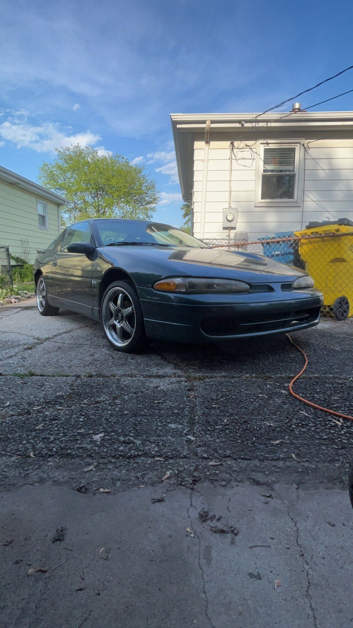

I bought this car in May of 2024. The previous owner of this car owned it for the past 20 years. In Chicago in the early 2000s he used to street race it. He blew up the original engine at some point and installed a replacement with a bigger turbo, bad oil pressure issues which caused that one to blow up and installed a JDM 4G63 with a big 16G turbo which is what’s currently in it, had transmission troubles at one point and had some work done to that as well.

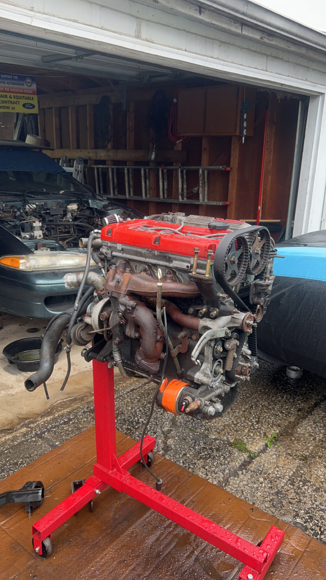

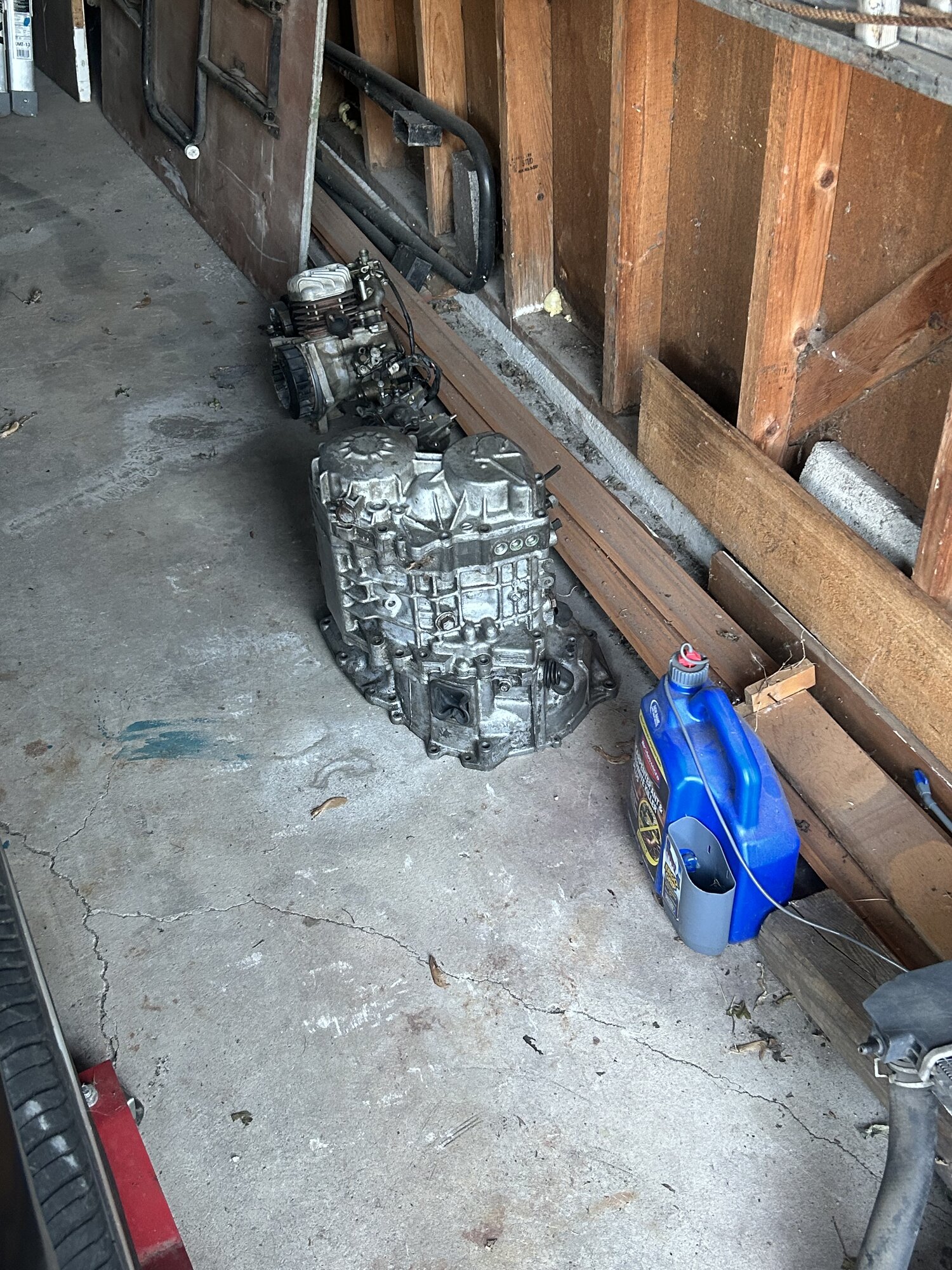

The car does run, but needs going through. The transmission Bell housing is cracked, the turbo drain leaks, there are missing and wrongly placed bolts everywhere. I already have a transmission case and am speaking with a shop to get the cases swapped and the transmission rebuilt at the same time just so I can be sure I won’t have any trouble when I get it back together.

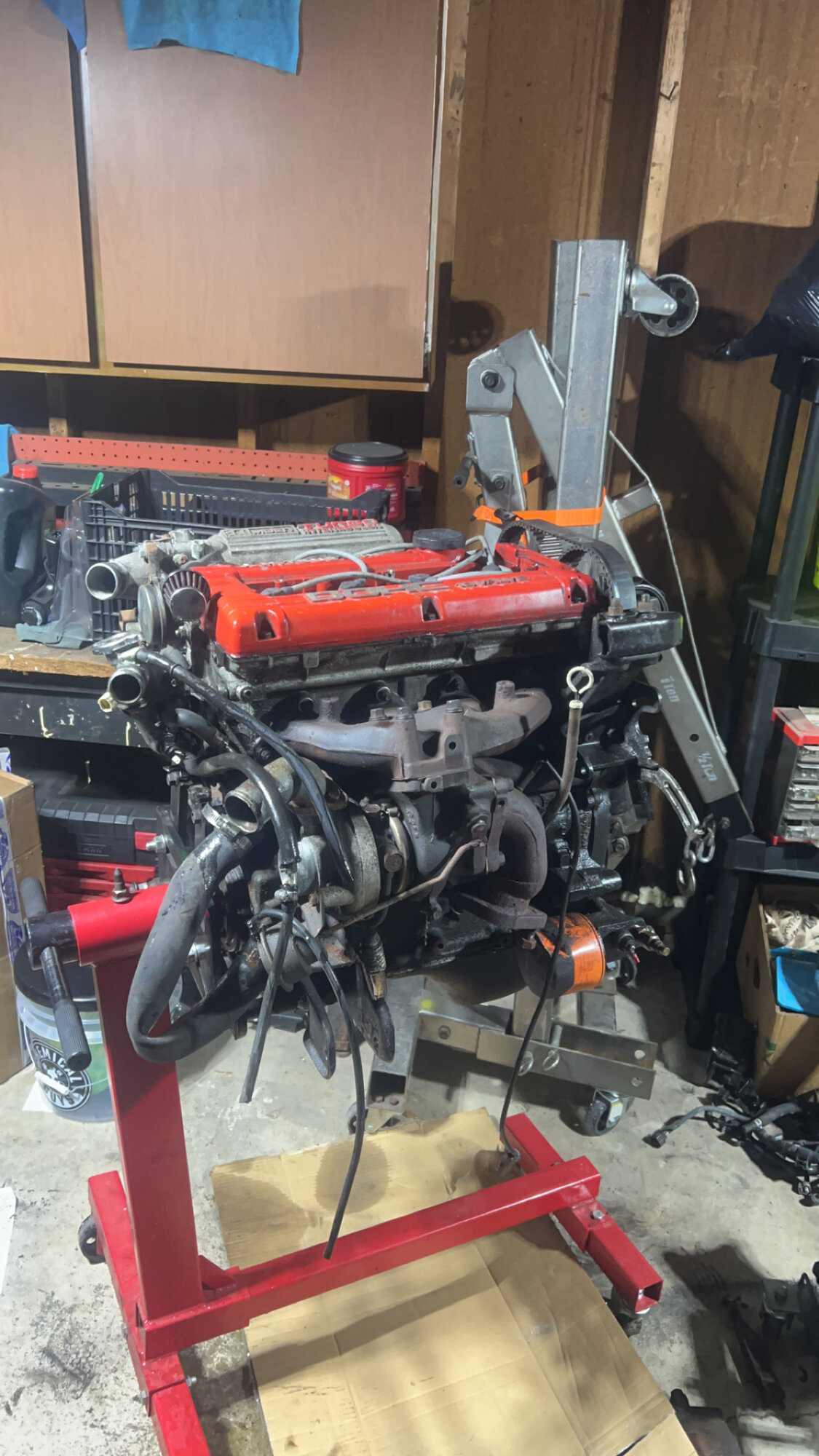

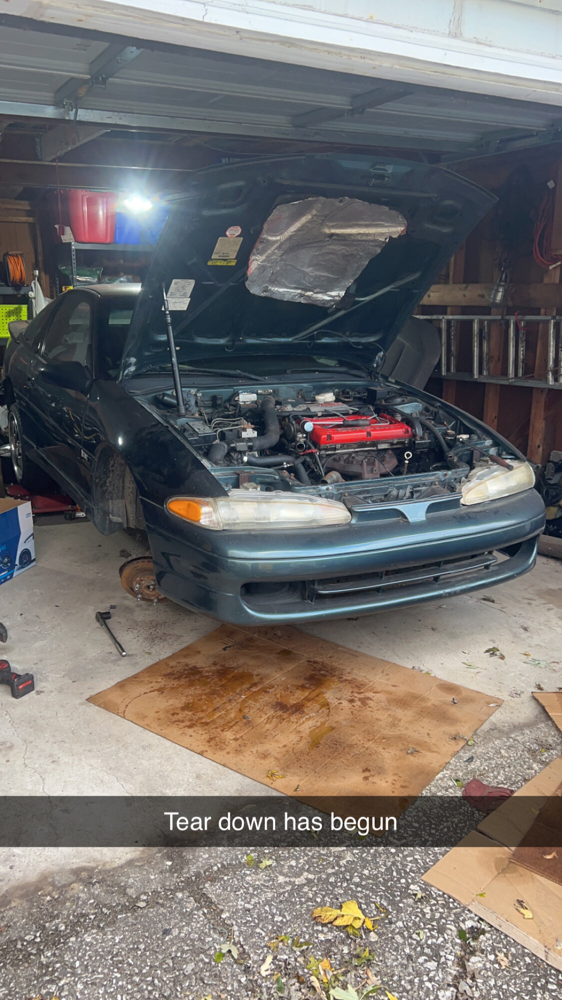

After letting it sit for months under my ownership, mostly working with the previous owner, (not the guy I bought it from but the guy before him), to get a replacement title for it I finally have a title and pulled the engine and trans. I’m hoping to get the trans sent out soon and I’ll start buying parts to reseal the engine and clean everything up before it goes back in.
If anyone that reads my long winded story this far has any suggestions on what clutch or fuel pump to use I’d appreciate the input. I also need to find the driver’s side engine mount bracket that bolts to the engine as well as the plate that goes between the engine and transmission.
