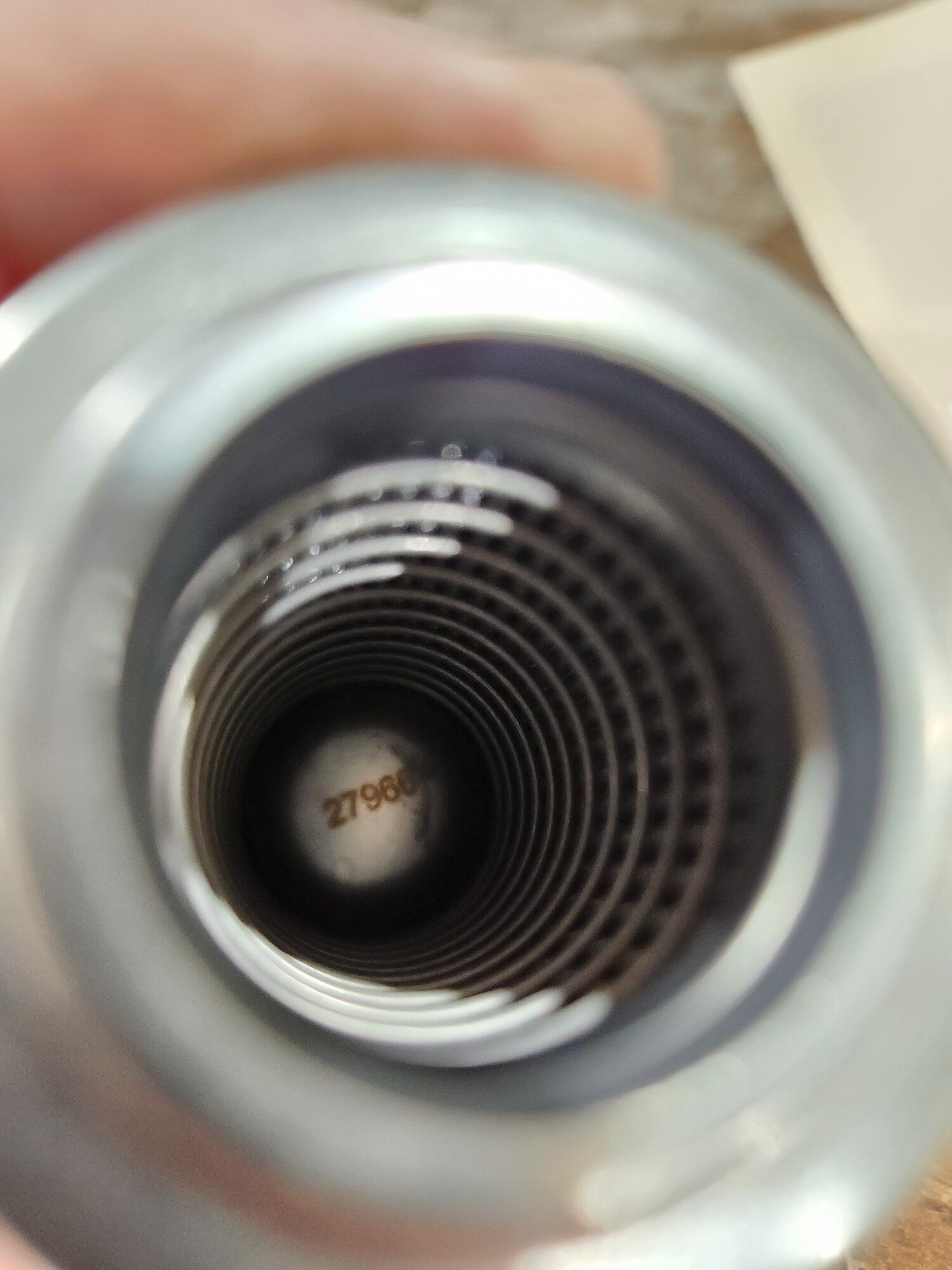

Well I found a FuelLab filter at STM, and I took a screen shot of the ad. It says "universal fit" so that makes me think that "most" elements would fit in the FuelLab can, as long as they seal at the inside port. IDK, what do you all think? That twisted up element still has me scratching my head :hmm:

I don't know, but they have Fuel Filters all listed under the "Universal Parts" heading and I think that's what they mean. It's not for any particular kind of car.
In the Fuelab technical data sheet for the 828 and 818 series filters (yours would be an 818) they say "Use only Fuelab replacement elements only when replacing element." Geez they said "only" twice.

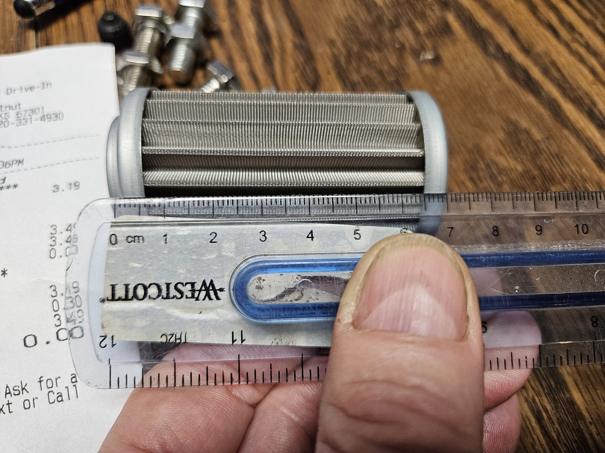

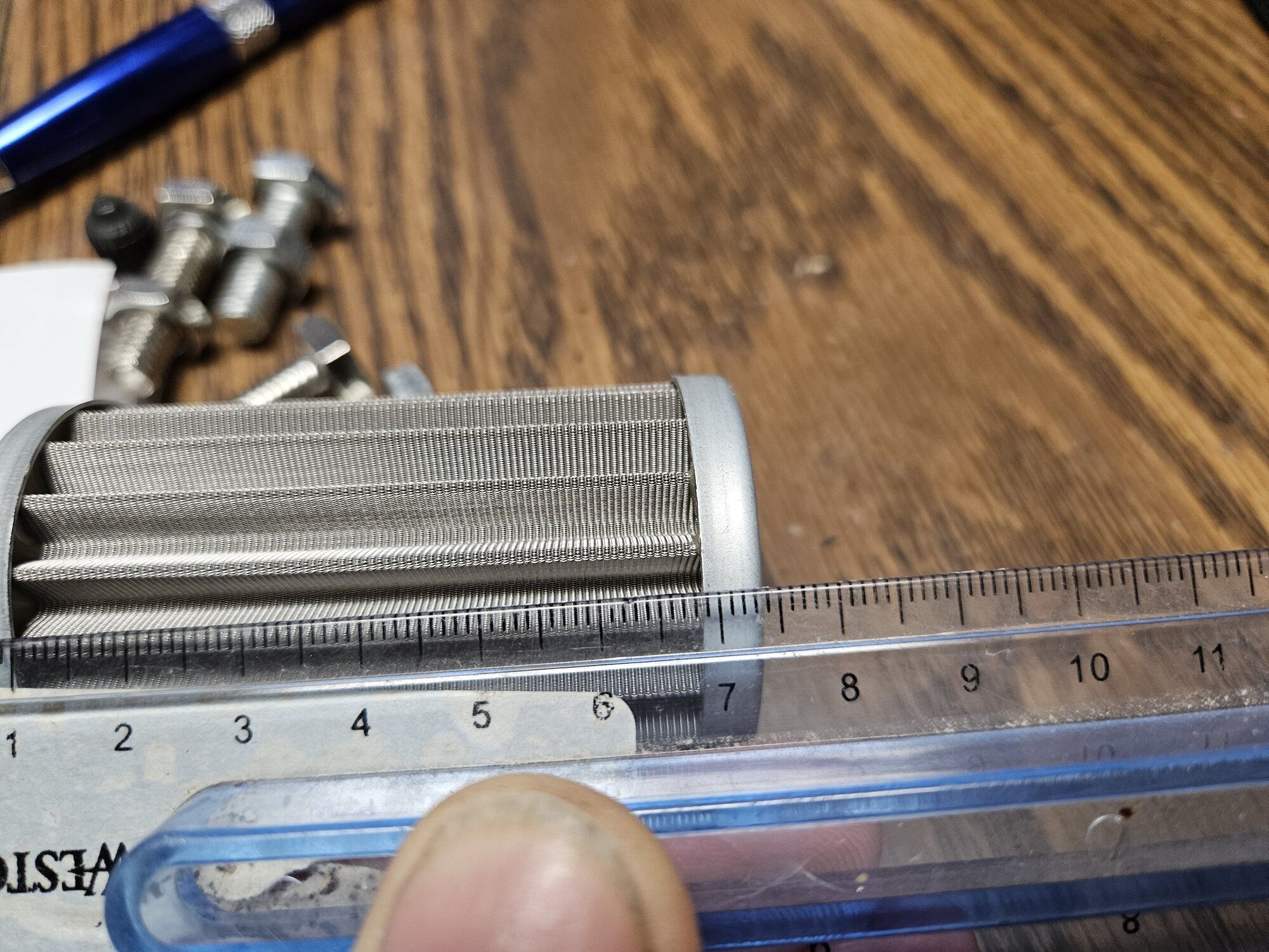

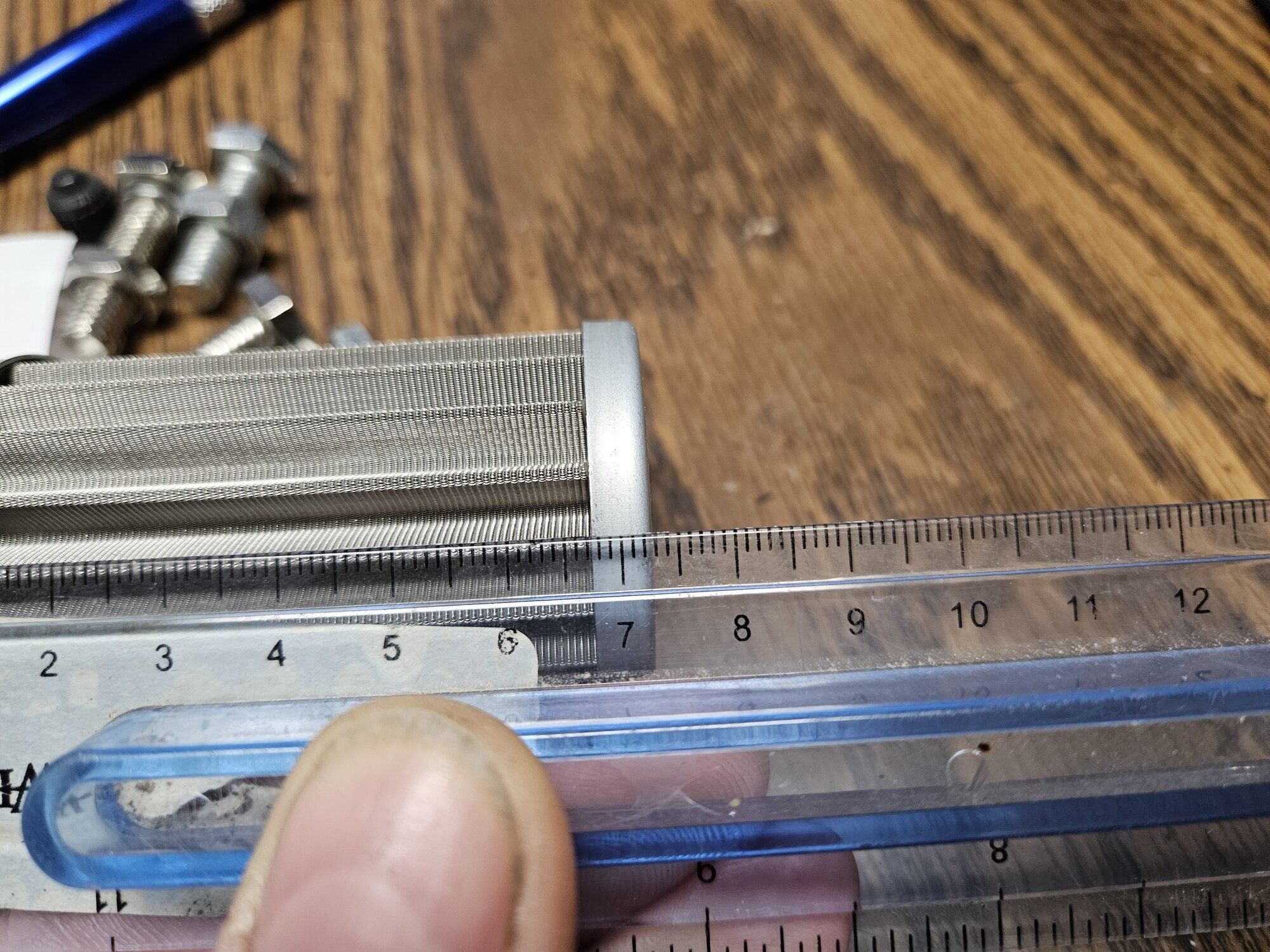

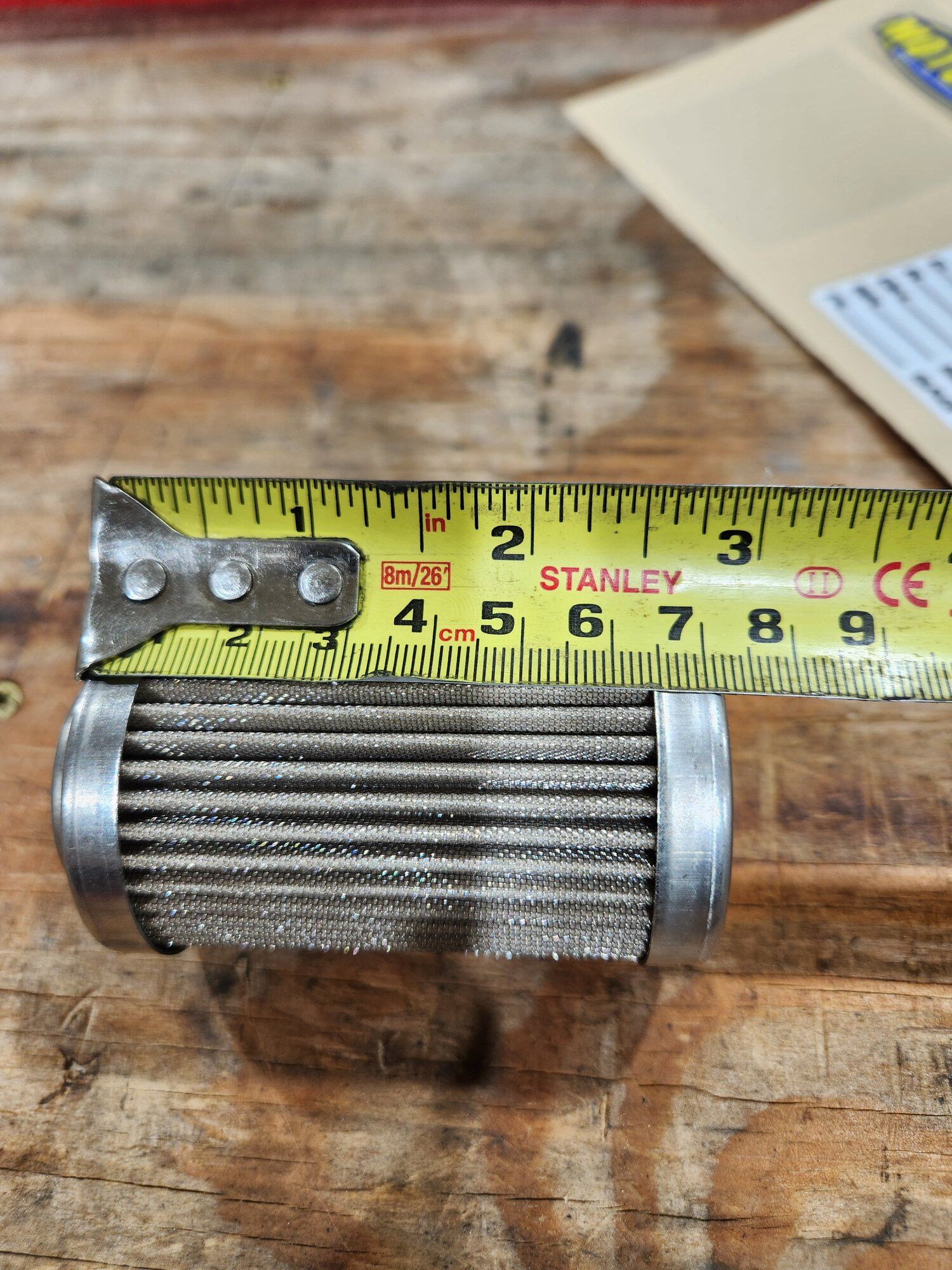

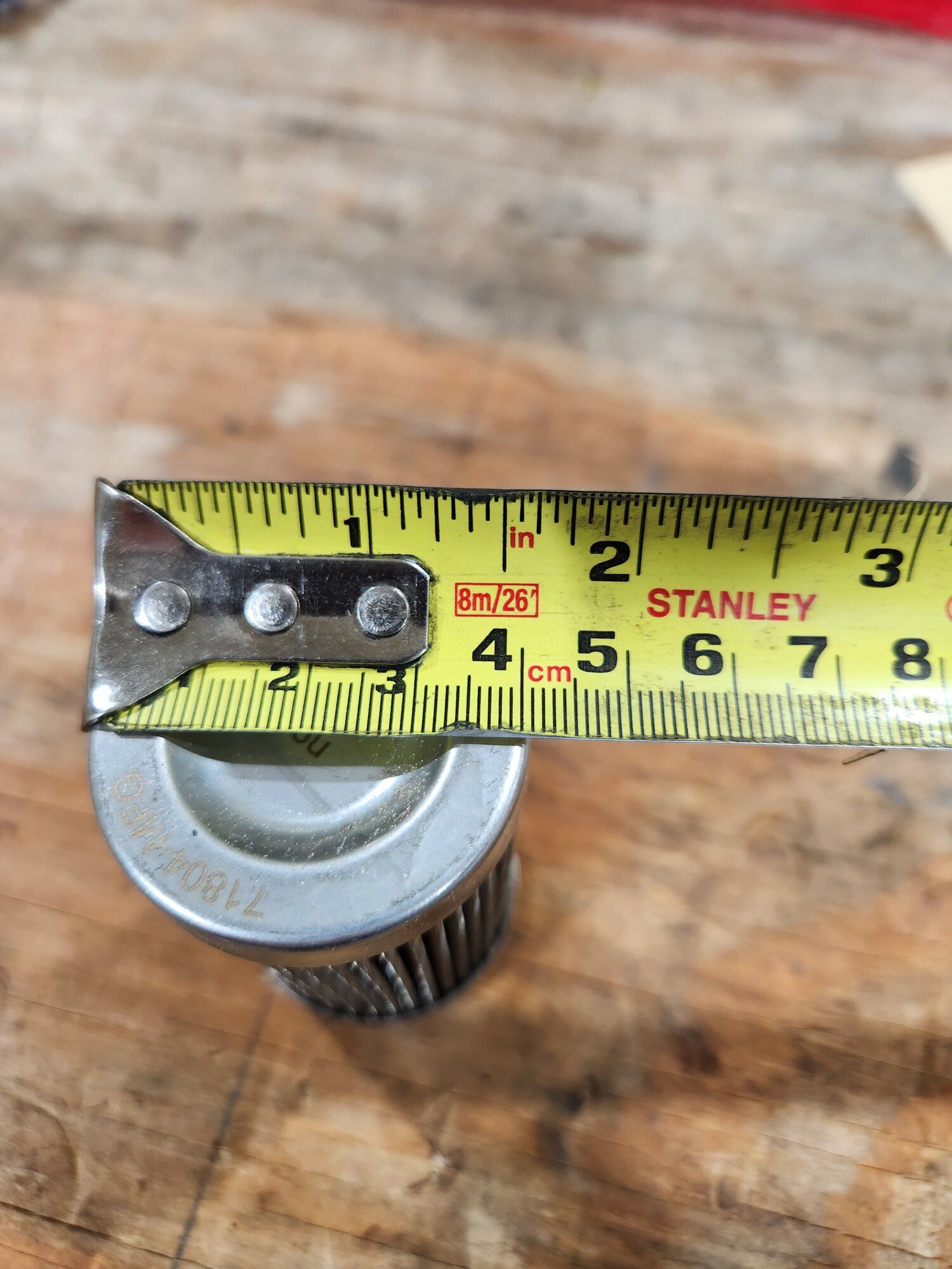

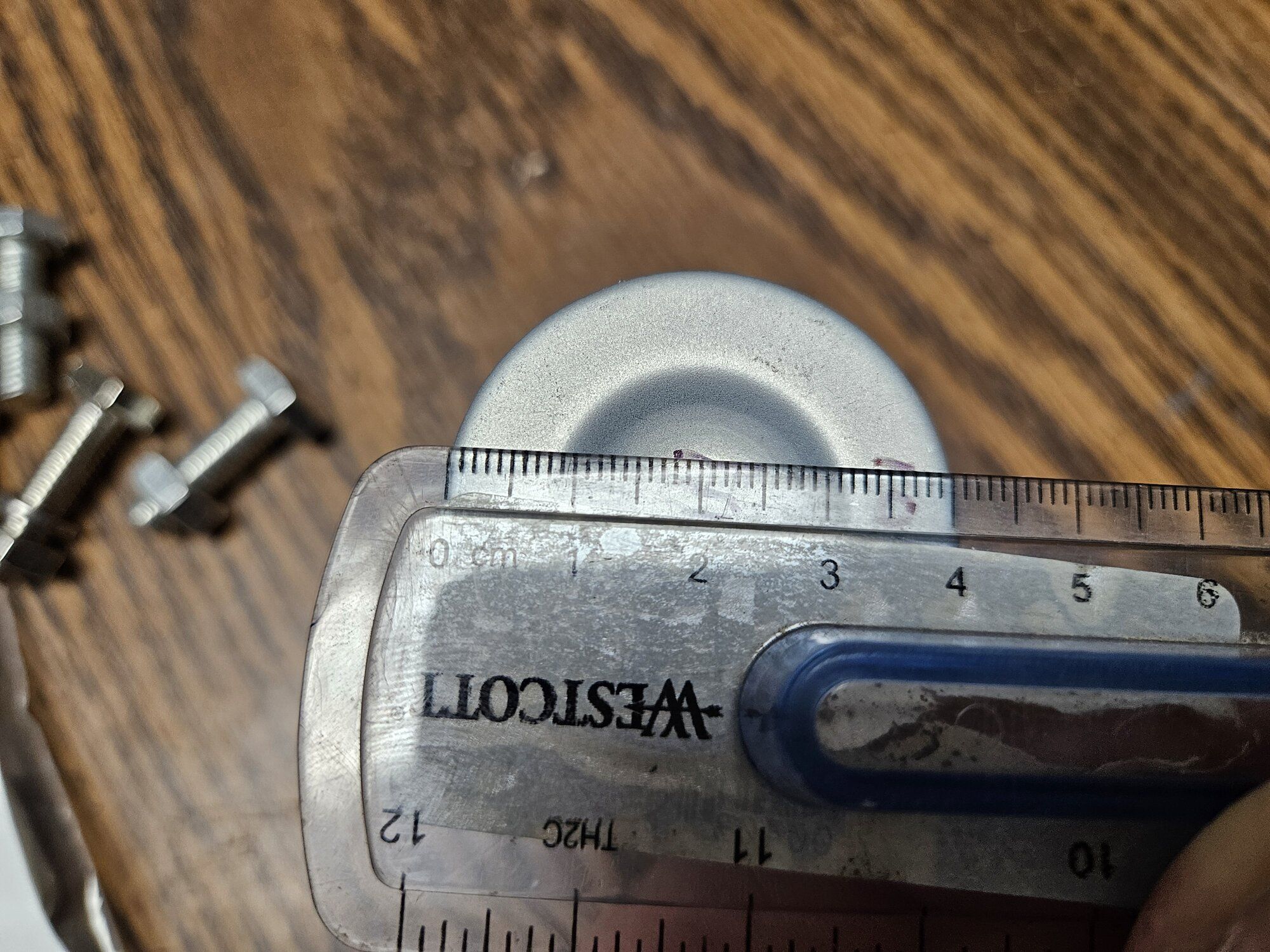

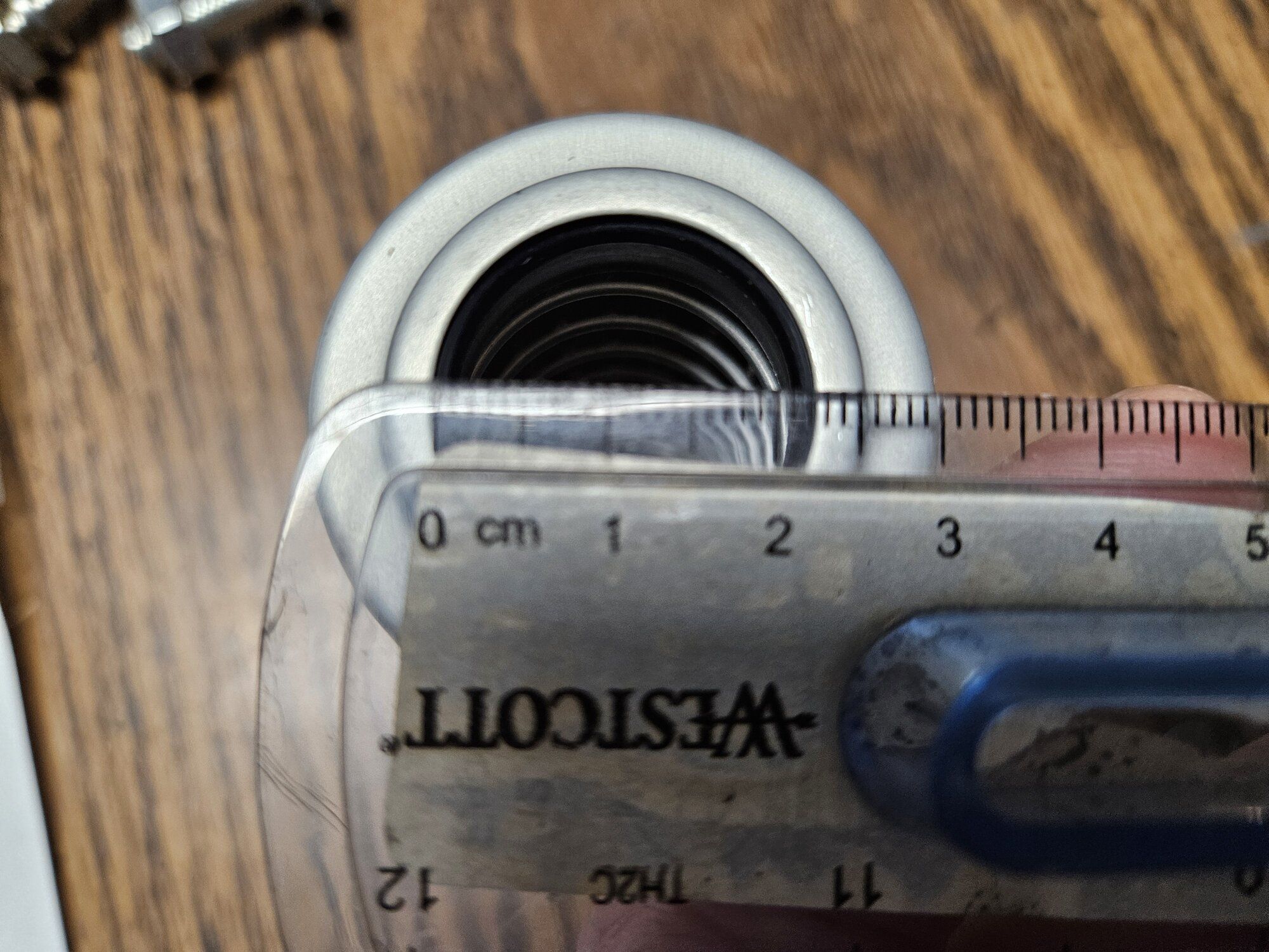

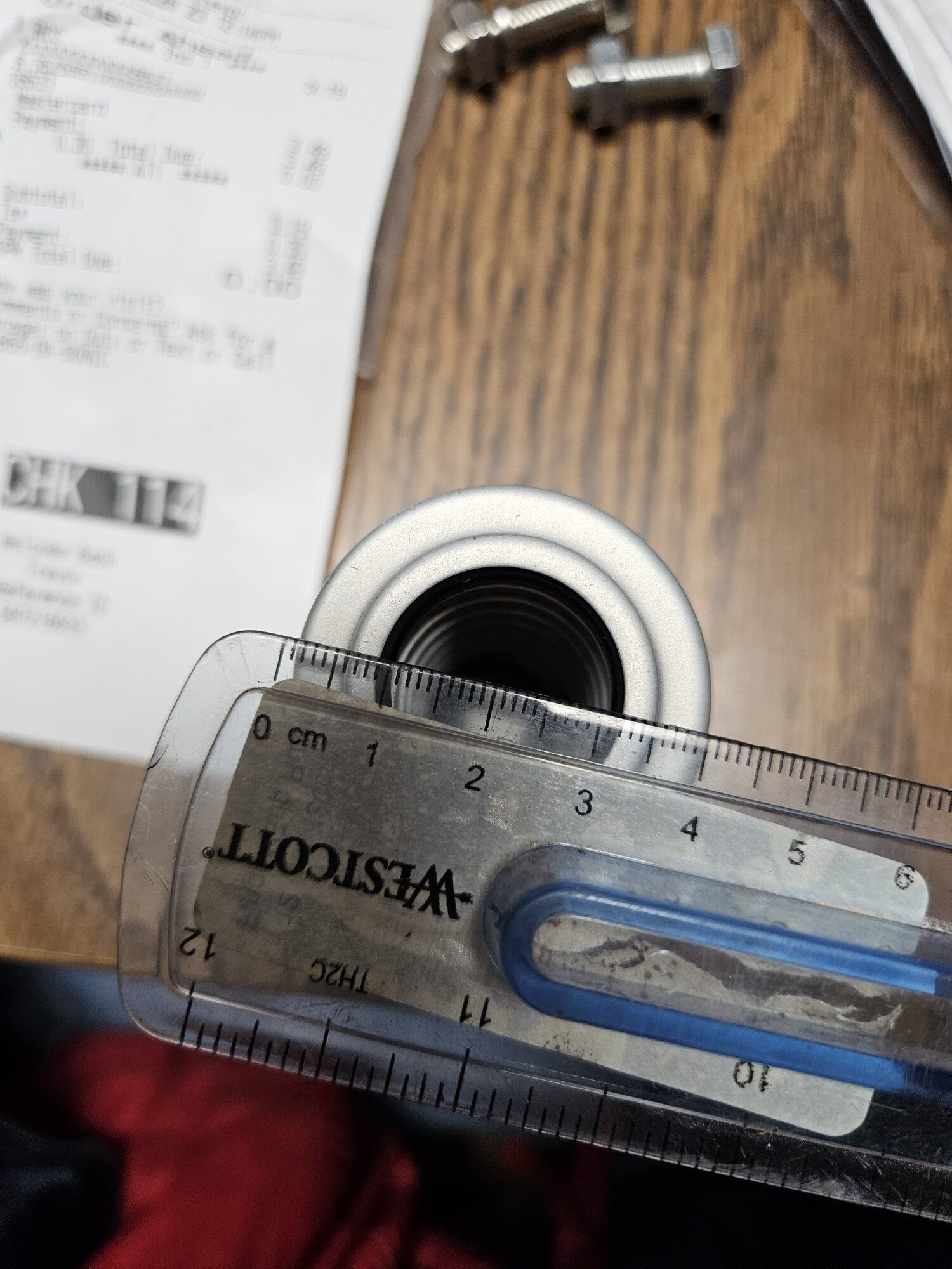

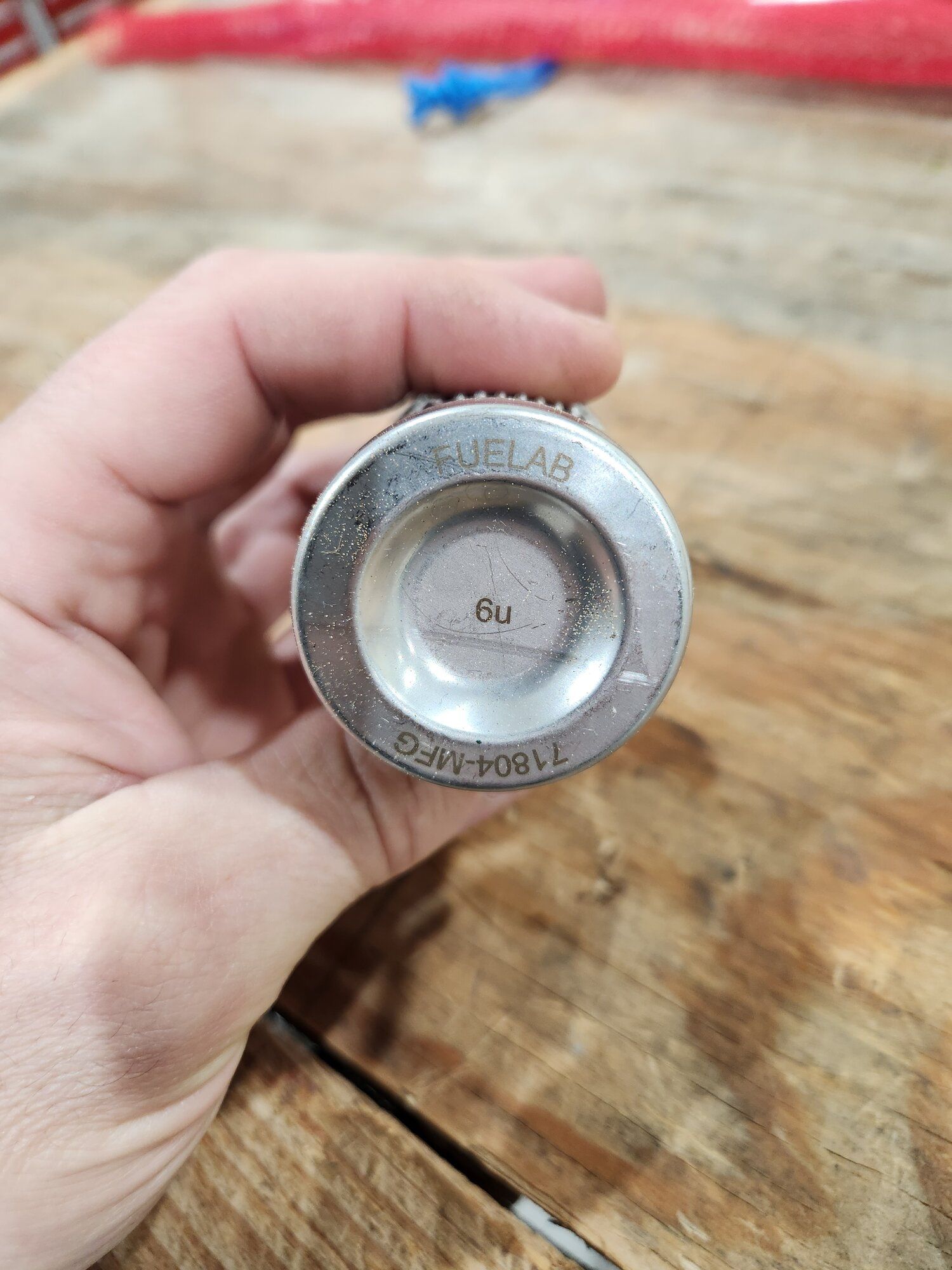

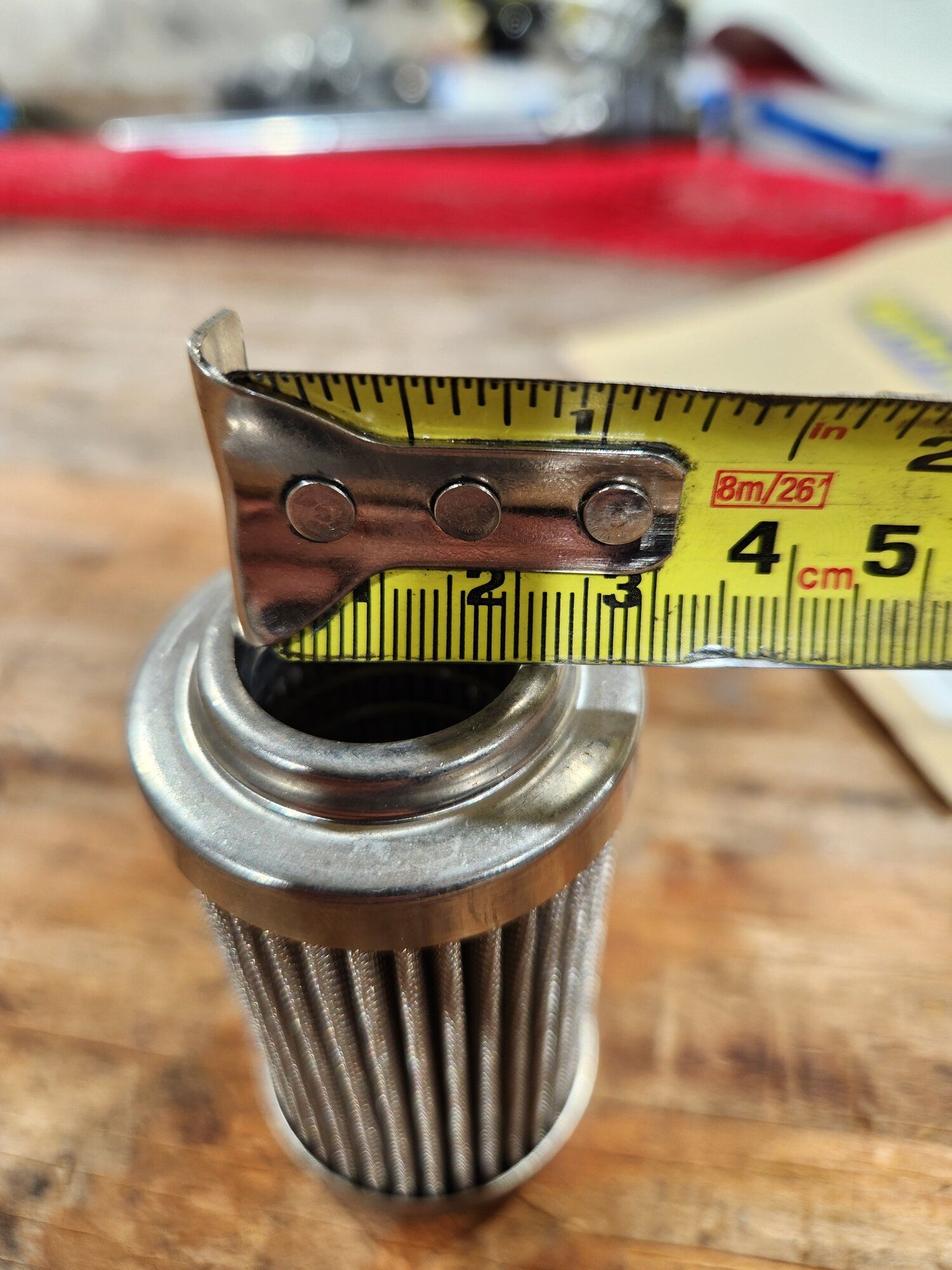

And Aeromotive measurements (believe me, they fit great, nice and snug on the inside port). :thumb:

That has maybe 5 hours of run time, if that, on gas. Just one I put in over the winter for when I cycle the motor.
Yep. Same size different element. I have ran them before. From your investigative information, I ran a high pressure pump into a clogged filter (thats what your picture showed I think). Clogged with what, I still don't know WTF it is.
Oh man sorry. You were asking Rob. My bad.
Oh is that the one you show measurements on up in post #406?
Yeah the usage I really wanted to know was on Rob's in post #402.
Hey, man. That one had about 300 miles or so on it running pump 93. 20 psi of boost, 43.5 base FP, on 660 injectors, 6AN PTFE feed and return 320 pump. I should've used the paper filter it came with for the first startup and couple tanks of fuel instead of the E85 filter. Oh well. I was battling inconsistent afr and there was minimal tank debris in there, so I swapped the filter and then, after pulling the pump I found my REAL problem. The 4 pin oem harness quick connector in the trunk had a bunk connection that I audibly heard the tone of the pump change when I bumped and wiggled it!! Bingo! Sorry for the drawn out answer but wanted to cover some important points in there, haha.
More info - good! I just assumed the one you showed was brand new since it looks brand new.
And I clean mine everytime I remove it and put it back in its blister pack. It hardly sees any fuel while it is in. It just sits there.
Gosh, not many. I changed over to AN lines and put a new trans in about the same time but haven't been able to drive her because of the mainshaft being broke, so I'd say maybe 200 miles. Under 500 since I was having E issues for a long time now, if you look back at some of the dates. I might even be able to see the odometer in some of the pictures, I'm not sure.
Oh man, not much run time at all. That seems really bad. Like the element must have been really flooded with some goo or little particles or something, or maybe it "grew" goo while just sitting there in-between uses.

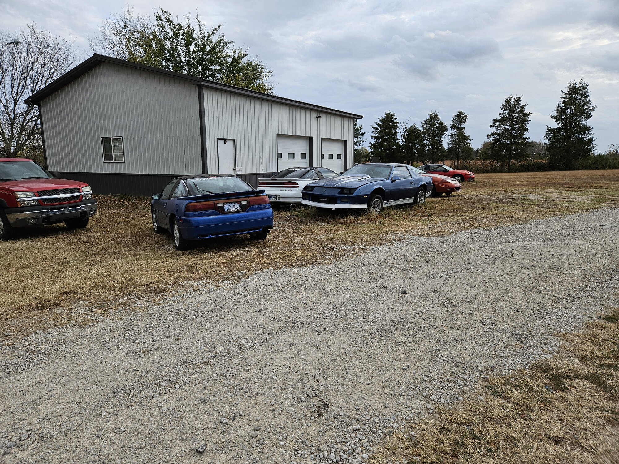

We have storms on the horizon so I moved the Ole Girl out from under the tree she usually resides under (soon to be a 20x30 carport, yay). I was super happy to hear her fire up and move on her own, even tho her mainshaft is STILL BROKEN (which breaks my heart too). :f-u: Man she's a fun car too! She needs a good car wash after the storms go thru.
