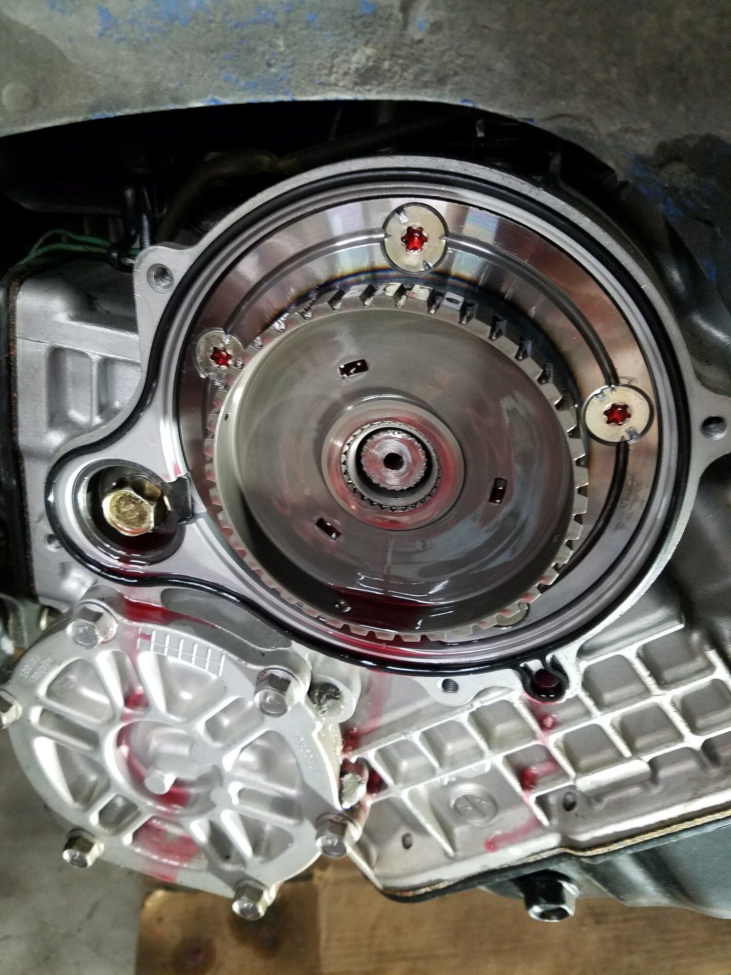

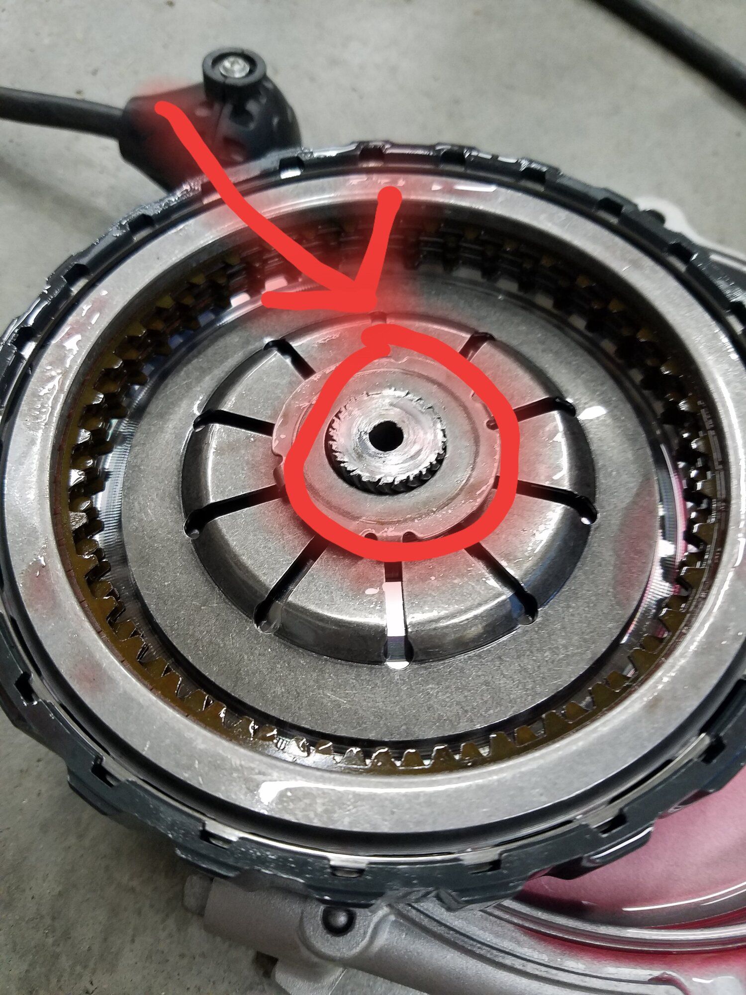

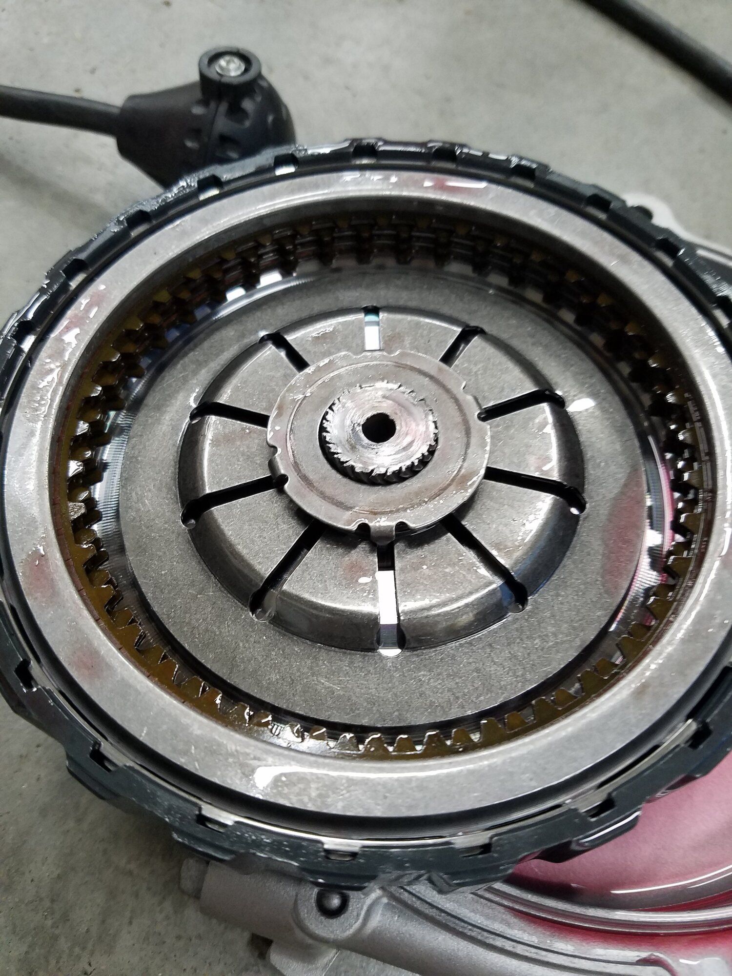

Well this is horrible. Less than 50 miles on a fresh rebuild from DTR. Lost OD Sunday on a half mile drive, yes DRIVE not boosted romp. Just about to call this shit quits. Getting too old to fk with this stuff.
That is a SNAPPED output shaft. I was logging when this happened so I know it wasn't under load, or much, it was just a drive. :(
I rebuilt an extra OD unit and was just going to swap them out......then I pulled the cover. FML

I don't understand how an output shaft fails on a drive. If it's a fresh rebuild, could you tell the place that built it. You could reach out to IPT and see what they think. These cars a one issue after another. Hope you are able to continue the game brother.

Now MAYBE, it has something to do with that fact but IDK yet. Every weekend has been a downer so I am just taking in LIFE this weekend and finding FUN THINGS to do so I can smile. I have another shaft coming for the trans. My oldest son got one from Dacowgod. Tim has told me it takes a complete teardown so IDK what I'm gonna do, but I drove it with 3 gears just to make sure it still moved. I will probably hire the removal and reinstall and see if a local transmission shop can do the work (I really don't trust anyone but me and the members on here).

I do have a spare, untested transmission but my trans guy called and offered to guide me thru replacing the mainshaft. Of course he does it everyday so it sounded not too bad since it is all brand new and was shifting wonderful and firm. I have to get the trans out first and with Mothers Day (Y'all don't forget your mothers!), I don't see me working on the car until I can get it out and not have any projects that need the lift for a week (for me maybe more than that, but it is what it is).

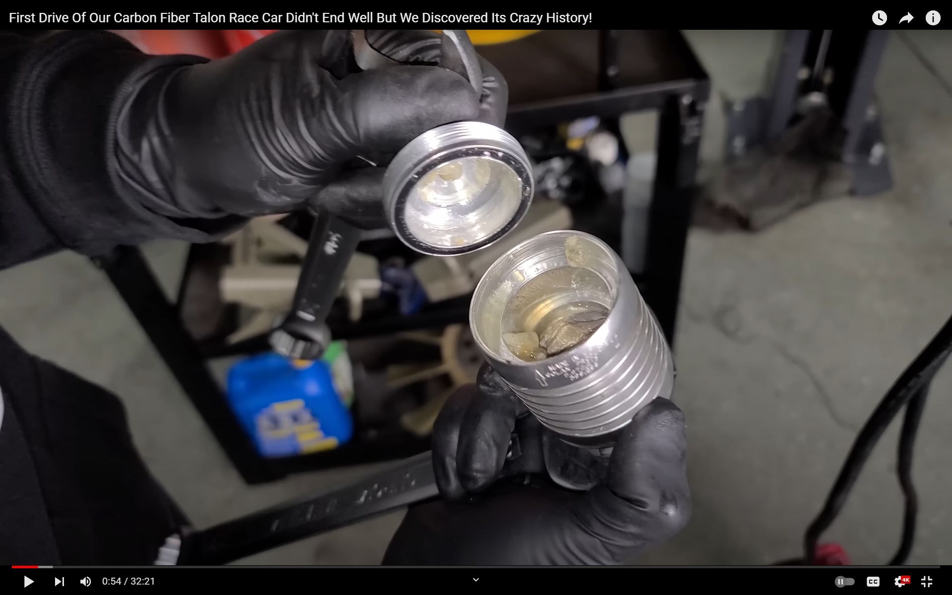

Here you go Jeremy. The most fun to watch instance of E85 goo, gel, whatever we want to call it.
YouTube video uploaded by LegitStreetCars just 2 days ago, Feb 18 2023.
If you watch the whole vid, it's kind of fun to see how these guys gradually gather up respect for the car.
Link right to the goods:
