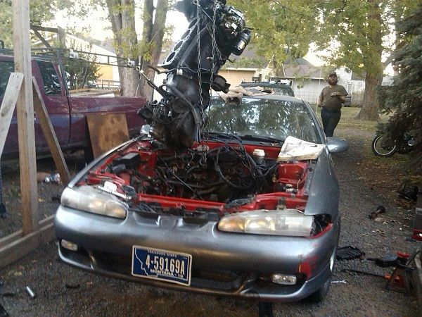

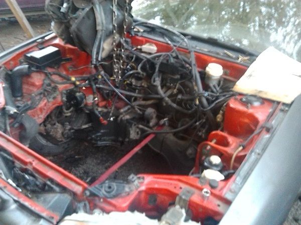

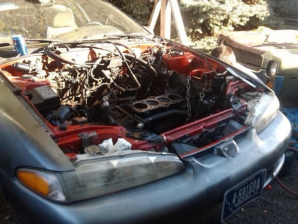

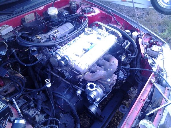

Ok so lets start this off by saying its time for a new engine. The talon is going to be down for awhile like maby a year undergoing some major changes.

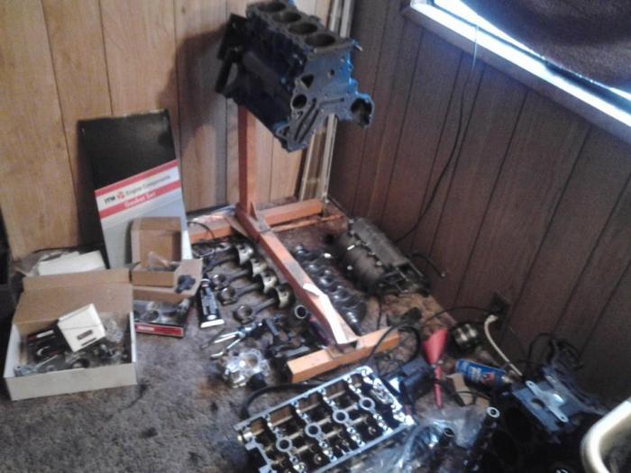

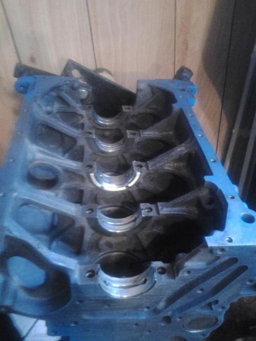

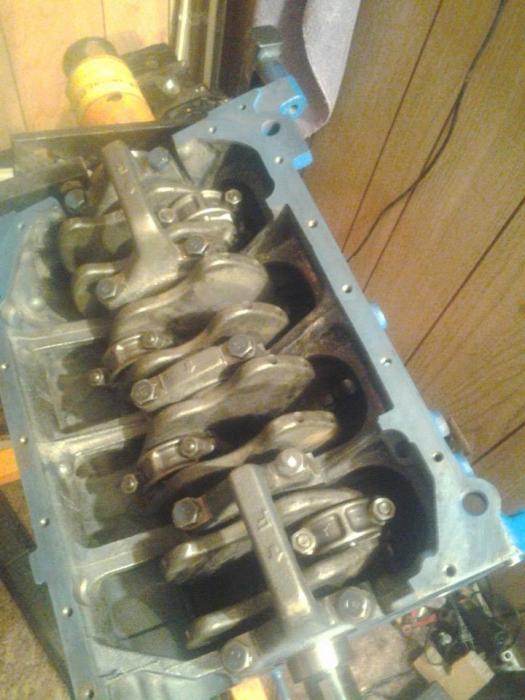

So about a week or so ago i started hearing and occasional tick from the bottom end well i changed the oil and noticed a tiny amount of metal shimmer in the oil. So i cut my oil filter open to check for any major amount of metal. Well there wasnt much but it was there. It was silver and copper material so im guessing its bearings. I'll know later today when finish tearing the block apart. Any ways engine is all removed and such. Heres some pics, ill post some more later after im done tearing the block down with the verdict on what happened.

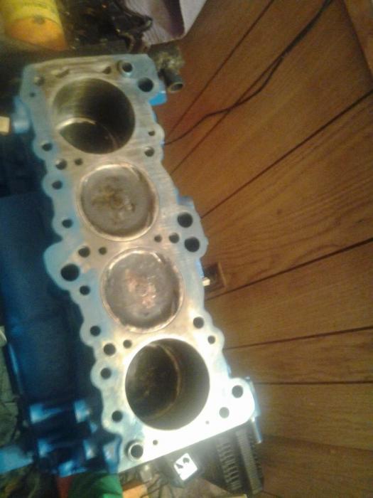

ok so i never came back for un update of what happend. damn balance shaft berings were eating themselves. rods and mains were in great shape. any ways just got every thing back from the machine shop every things awesome. just need to order misleanious stuff to put it all back together.
other things im doing while its down sending in the TB to be rebuilt at throttlebodies.com. getting link and a vsrf intercooler kit. I am also painting the engine bay black and doing my own custome wire tuck.
Looks good man, glad to hear the rods and mains are ok. Are you just having the rest of the block and head double checked?
already did have it all done. crank was polished, rods reconditioned, block was hot tanked inspected and honed. there were only 80k on the engine im rebuilding every thing was within spec for just a refresh. every thing was checked and done buy a shop.

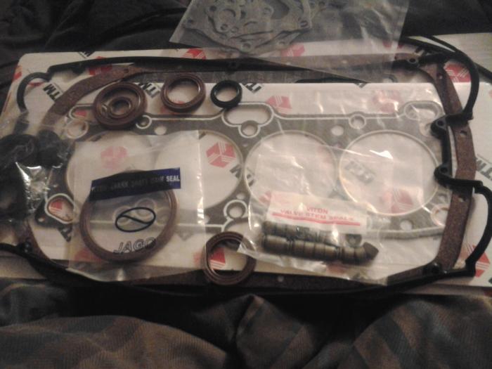

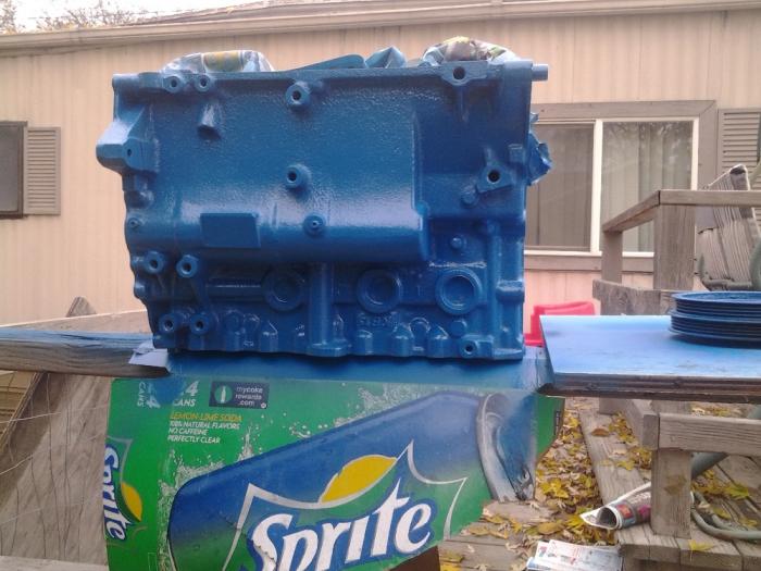

ok so its been awhile. but I had a little money trouble for a min so the build got put on the back burner. but now were back at it got most of the parts ordered and received. I got my gasket kit, rings, bearings, timing kit, new timing case and oil pump with a BSE all in the mail this week, so this weekend I get to start to putting it back together.

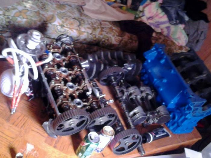

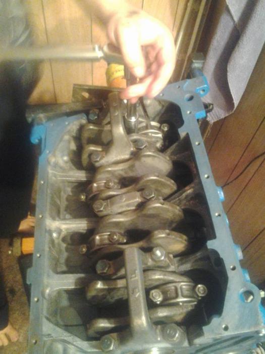

alright got some work in last night. got the rotating assembally all together it was good. got to know my new torque wrench. heres some pics
ok well I got the front of the engine all done with a lil help from my little girl. we had fun. just gotta wait for my new oil pan and finish cleaning up the head and it will be complete and ready to drop in..... YES.

yay parts will be here next week. got a oem oil pan gasket cus ive heard bad thing about aftermarket ones along with an oem intake mani and TB gaskets. paper gaskets with boost pressure seems like bad waiting to happen. also had my throttle bodie rebuilt by steve at Throttlebodies.com. also new ngk plugs and wires. new shaft seals for the tranny and new motor mounts. now all I need to get is fluids. getting mitsu auto tranny, rear diff, and tcase oil. along with some high zinc content break in oil for the motor.
the dealer ship and no theres a gasket there. its a rubber one with grooves between the bolts for the rtv to sit in. its the exact same gasket that came off my car when I tore it down. unless it leaked and one of the previose owners fixed it. but I just went to the local mitsu dealer ship.
