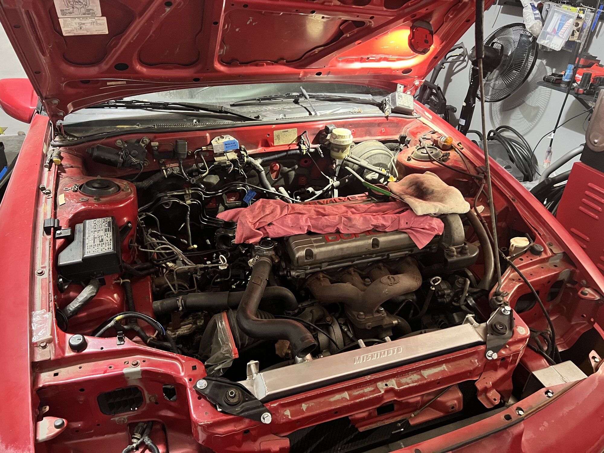

I was hoping to have some fun in the snow and I did. Stock suspension and the 68HTA helped to not get stuck once when Jeeps were. I went a little crazy in a parking lot and it got a little hot twice and spilled from the overflow but she is absolutely fine.

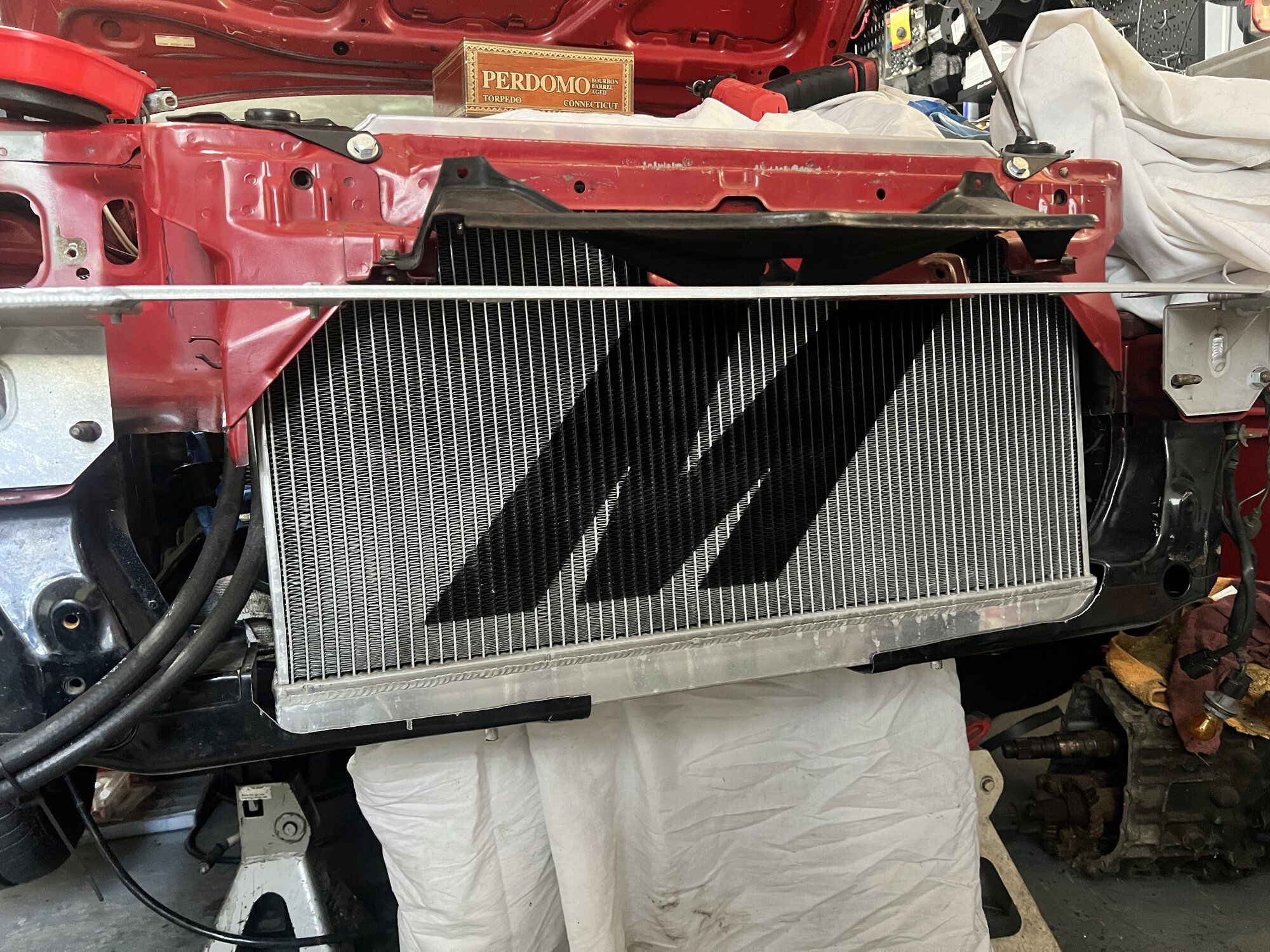

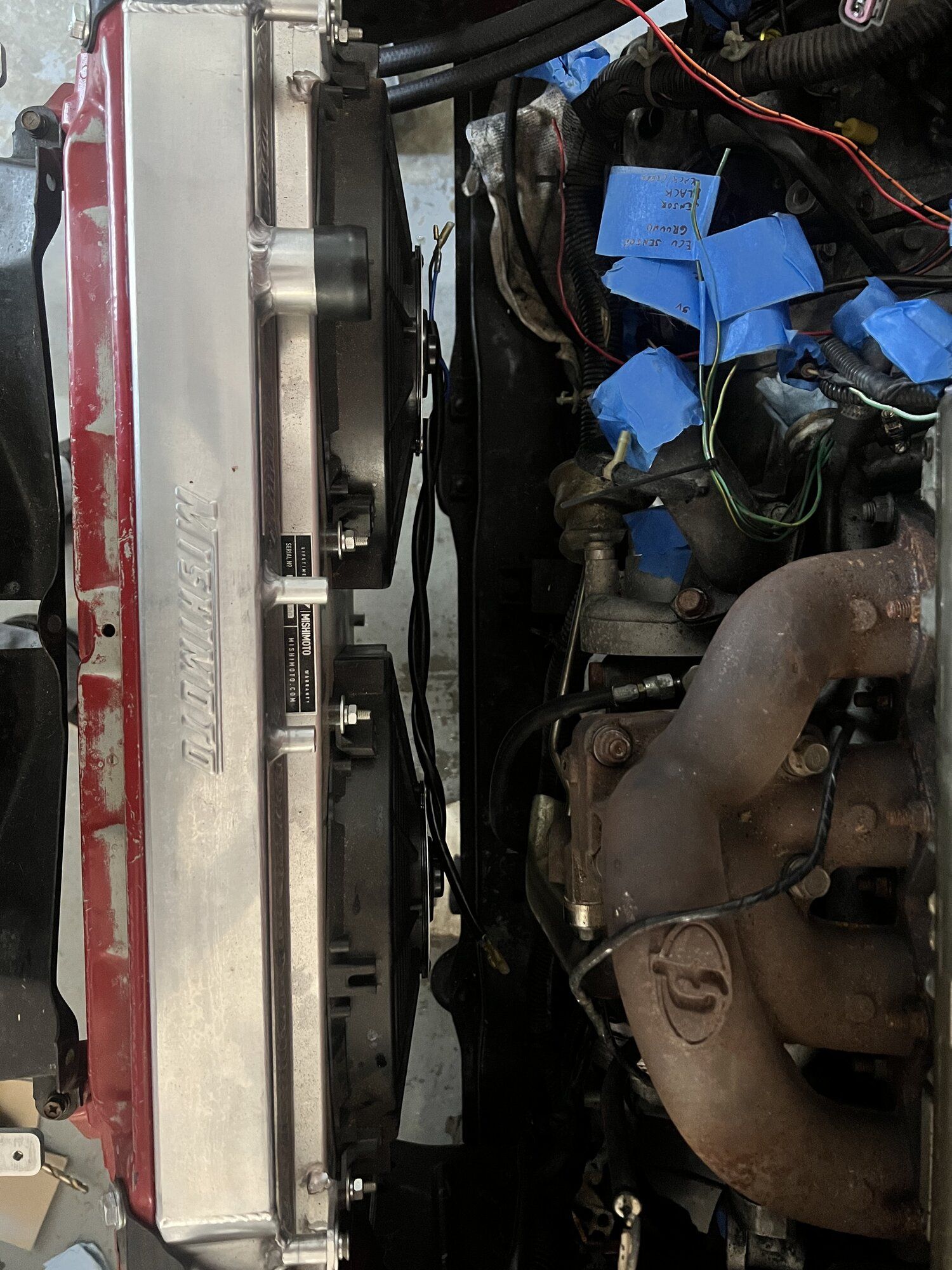

I had some slight past operating temperature spikes during the summer so I got a Mishimoto radiator and fans to fix that. I’ve had every other hose and a thermostat for awhile. Slowly but surely.

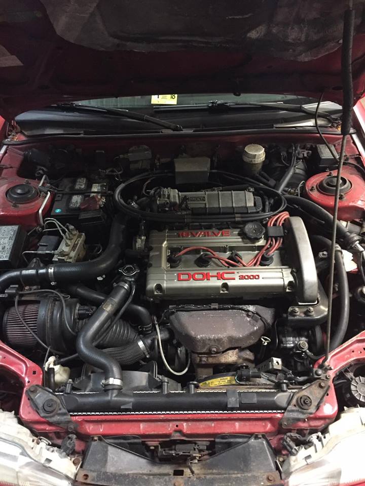

I’ve honestly been working too hard at work to have the enthusiasm or energy to work on my own passions for a while. I made the decision to get it running and driving before my birthday July 31. It was running before I started modding in 2019. I was rushed to find a house to not deal with constantly worrying about moving with a month to figure it out and have been sprinkling my spare change at random issues and house needs for years. Parts just sitting. I’ve bought 5 cars since and the truck and the daily have completely new suspension, tune up, lift kit(Subi), wheels, tires blah blah blah. The Eibach dropped, front and rear camber arms, 392 wheeled Dodge Magnum 300C swapped just needs some decent weather for me to start swapping the front end. If I put that in this it would run 9’s 😡. Well it’ll be running soon.

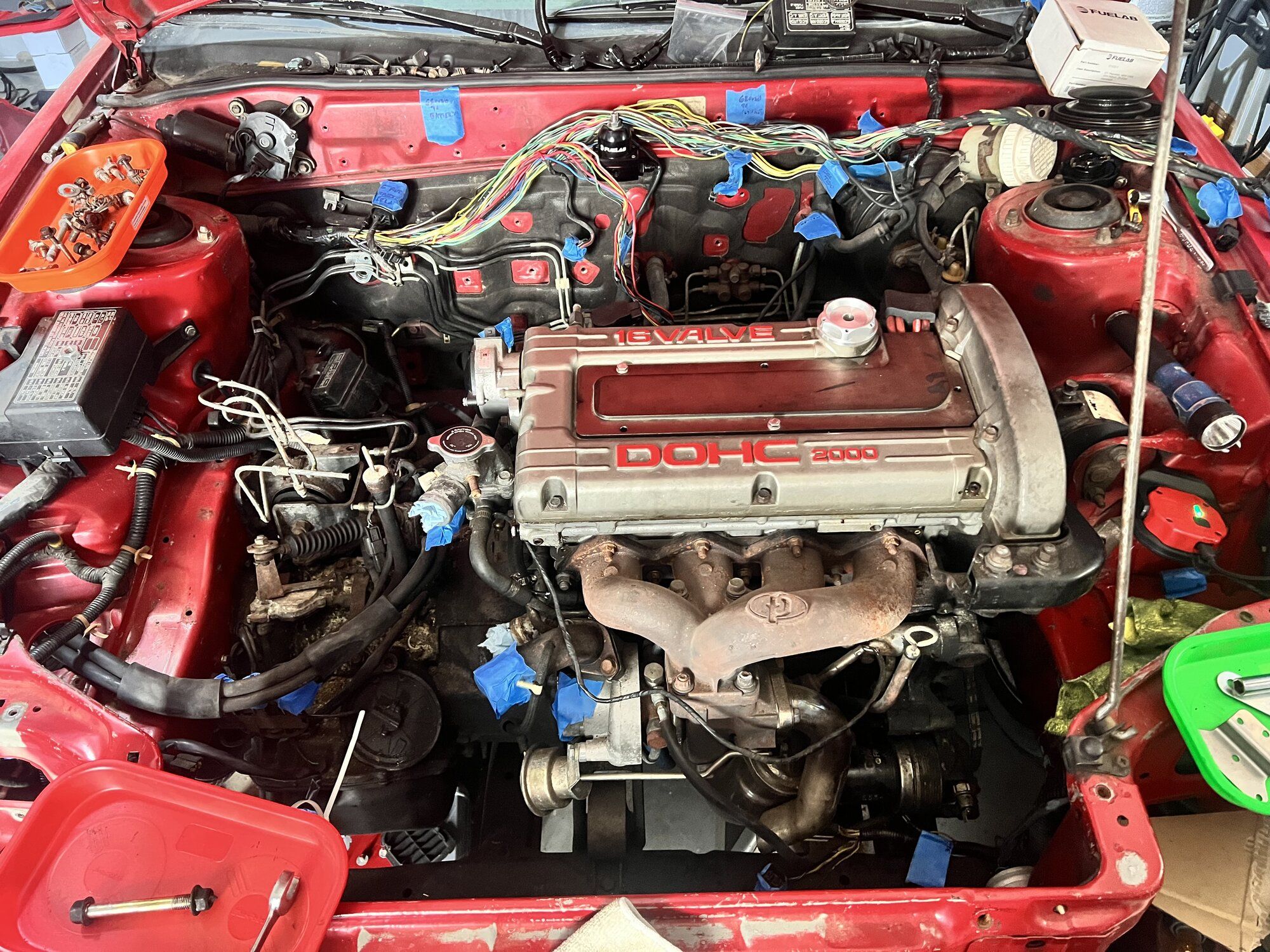

Friday night-Monday night.

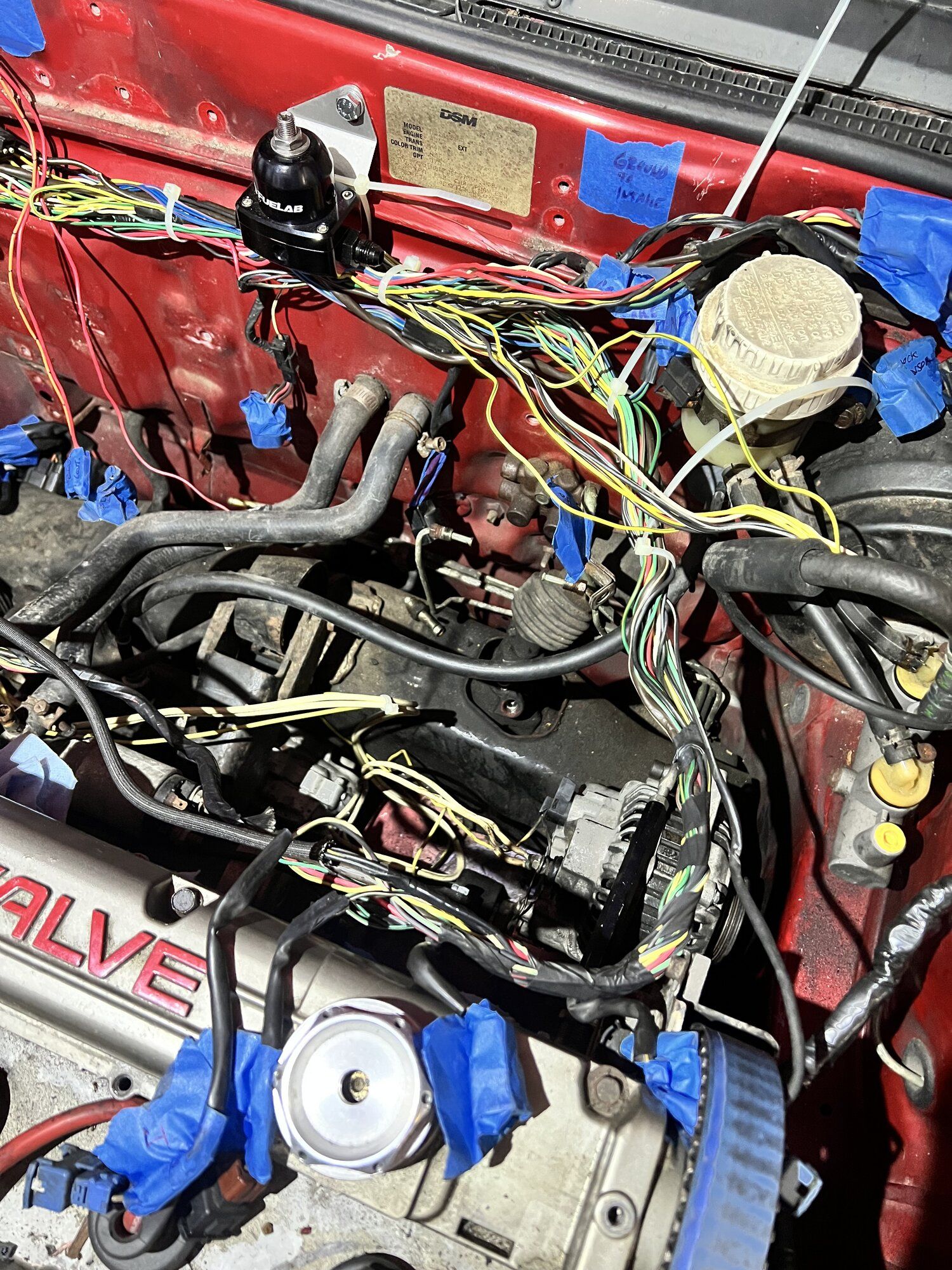

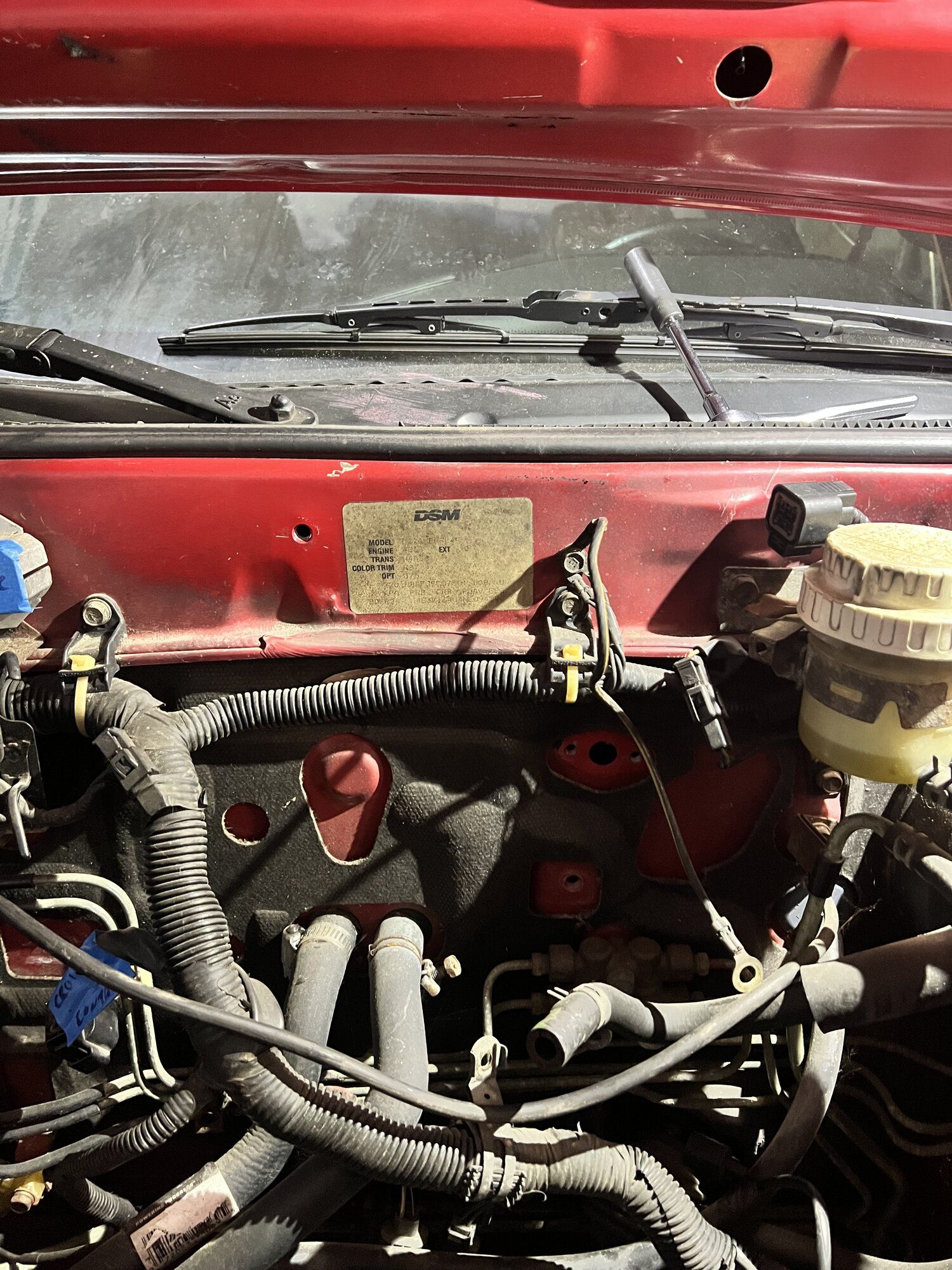

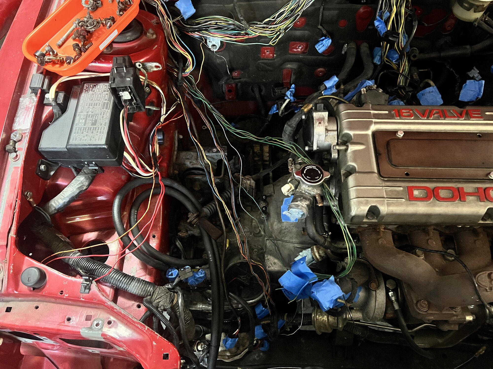

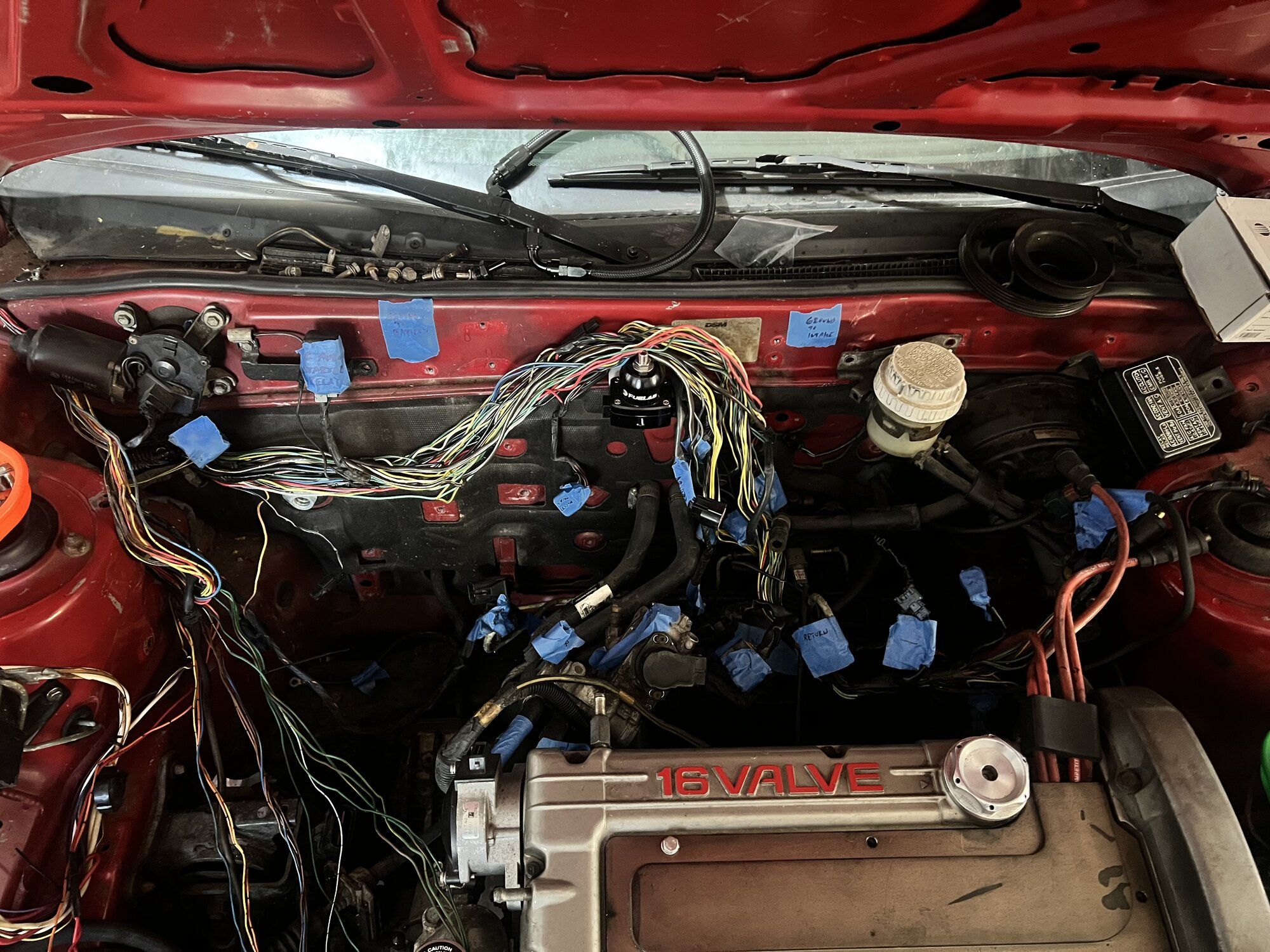

Back harness stripped and labeled
Alternator and power steering out.
Jay racing kit waiting until after the block is clean.

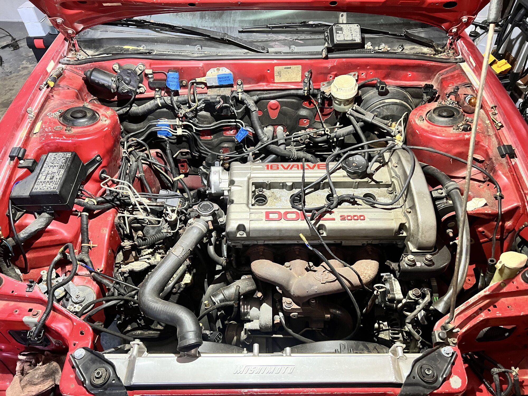

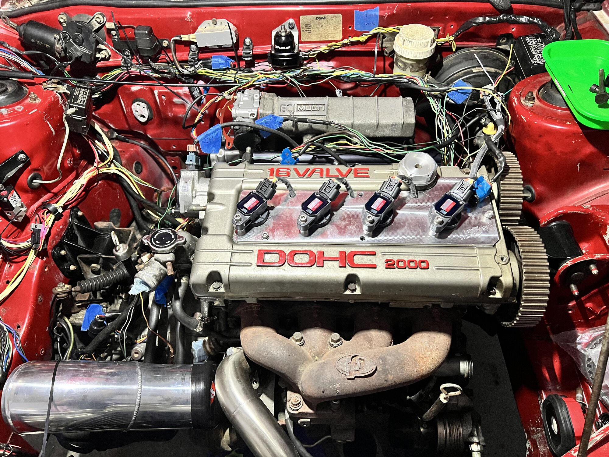

FPR mounted.

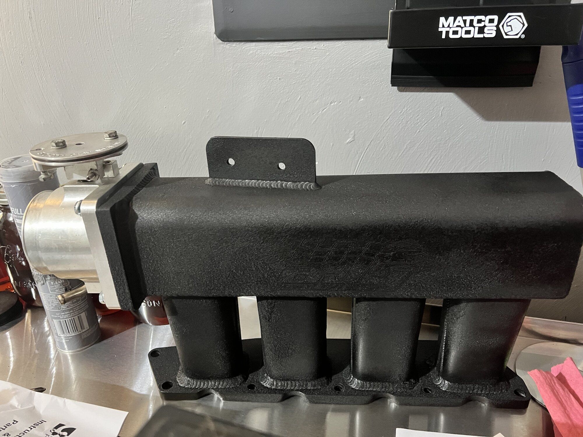

Intake manifold prepped and shot with wrinkle(it’s better then what it was)

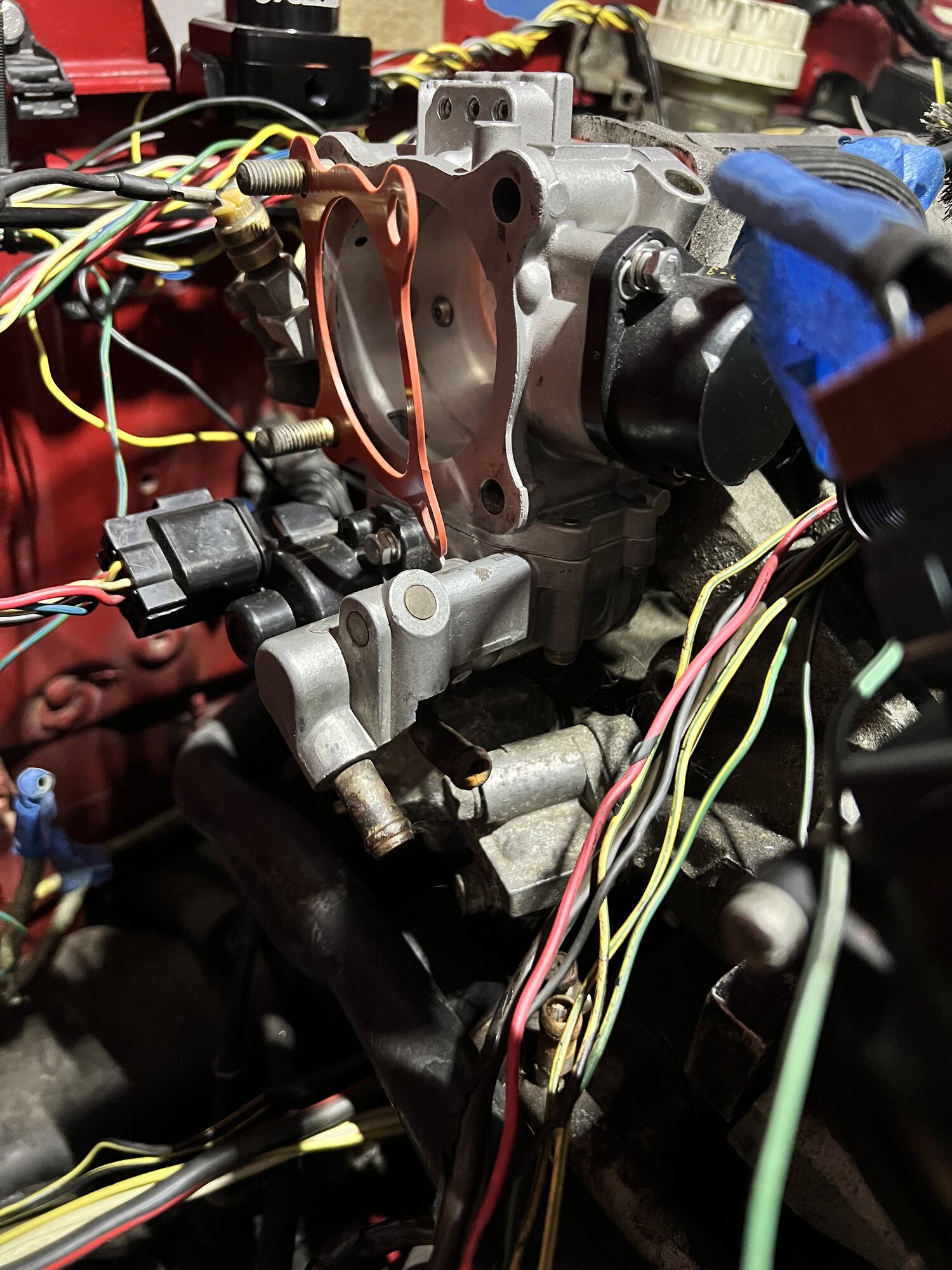

Mounted an old Wilson 75mm TB but has a DSMPT 60mm I believe.
I need a JMF coil bracket.
Need to shorten, eliminate and wrap the harness.

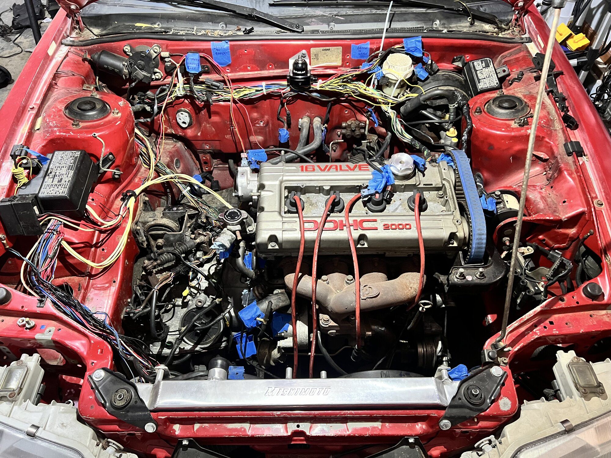

Clean the engine bay.

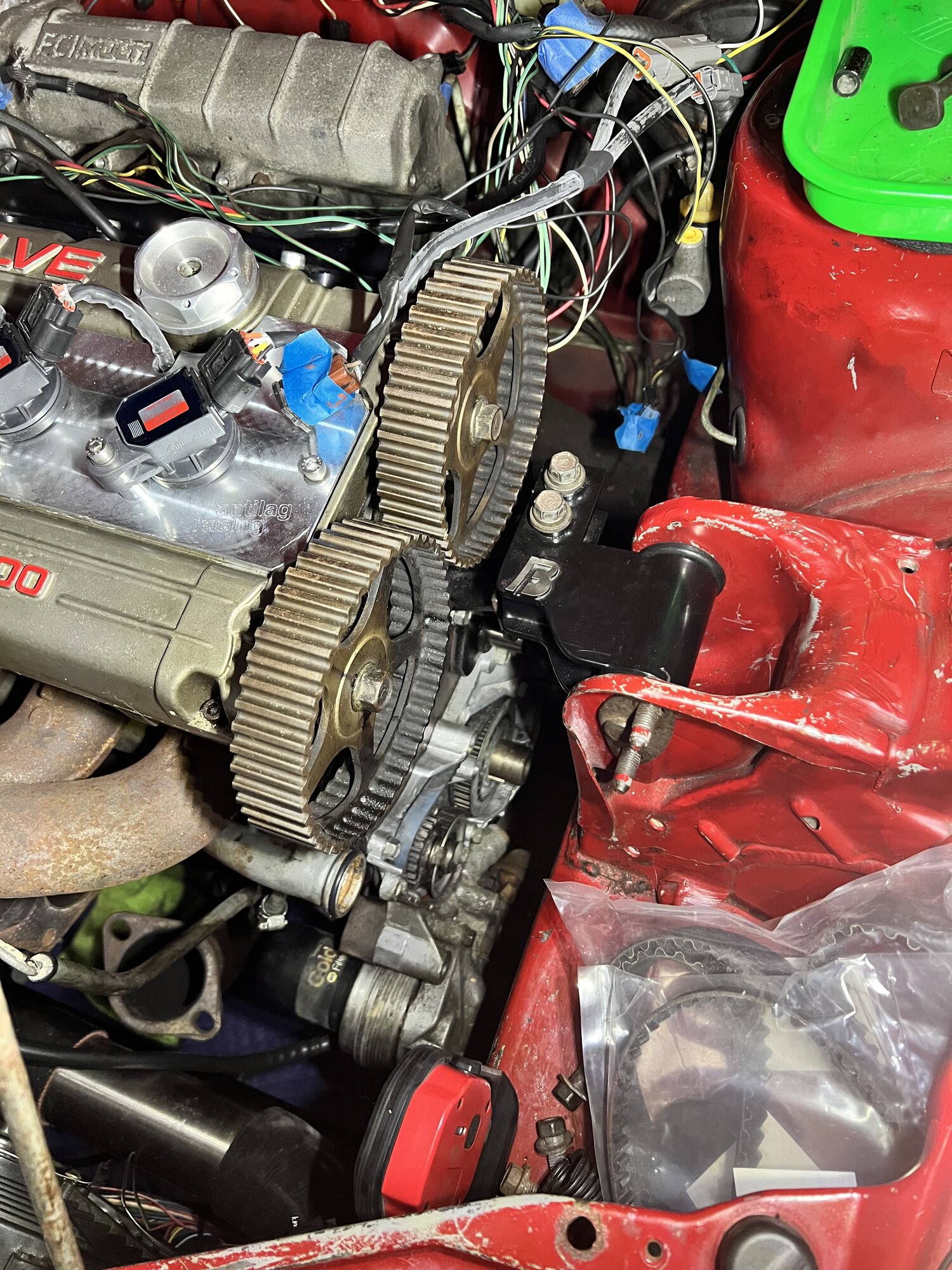

Tbelt, waterpump, and seals.
Rebuild and throw on a straight gear oil pump.
Probably keep stock head but throw in the ARP’s.
A little bit of work ahead of me.
I’m still figuring out the wiring. Speed density labeled and ready but I’m in between map sensors and don’t know if the resistance in the RIFE sensor would kill the DSMlink but I have a Omni 4 bar.

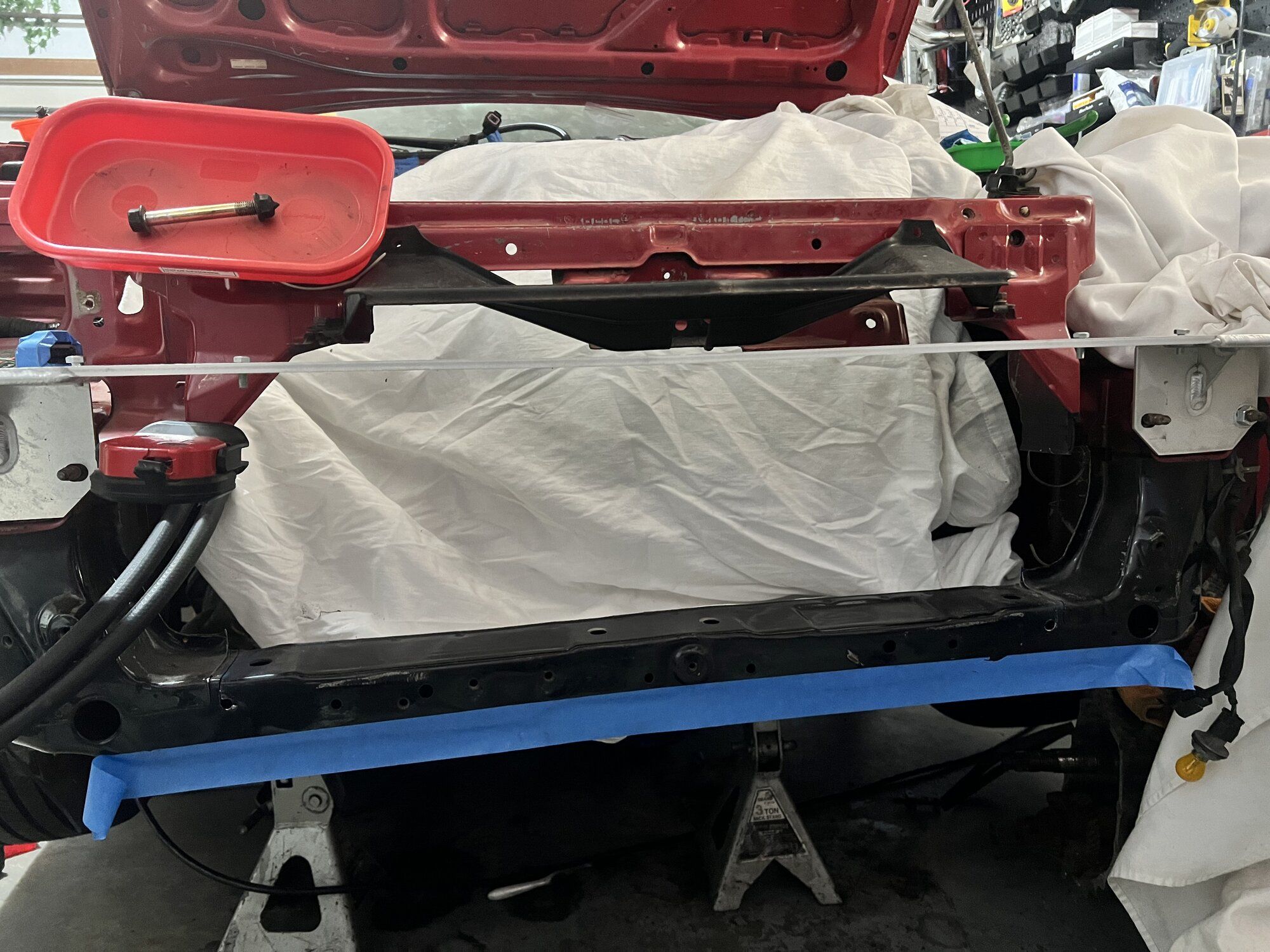

Second thought was the radiator support and really wanting that extra room. I just need to finish up some stuff with shop tools I just didn’t feel like driving to get.
Glad to see another VA 1g in progress.
Well I’m hoping I can drive it by my birthday the 31st of July. It’s just how far do I want to go.

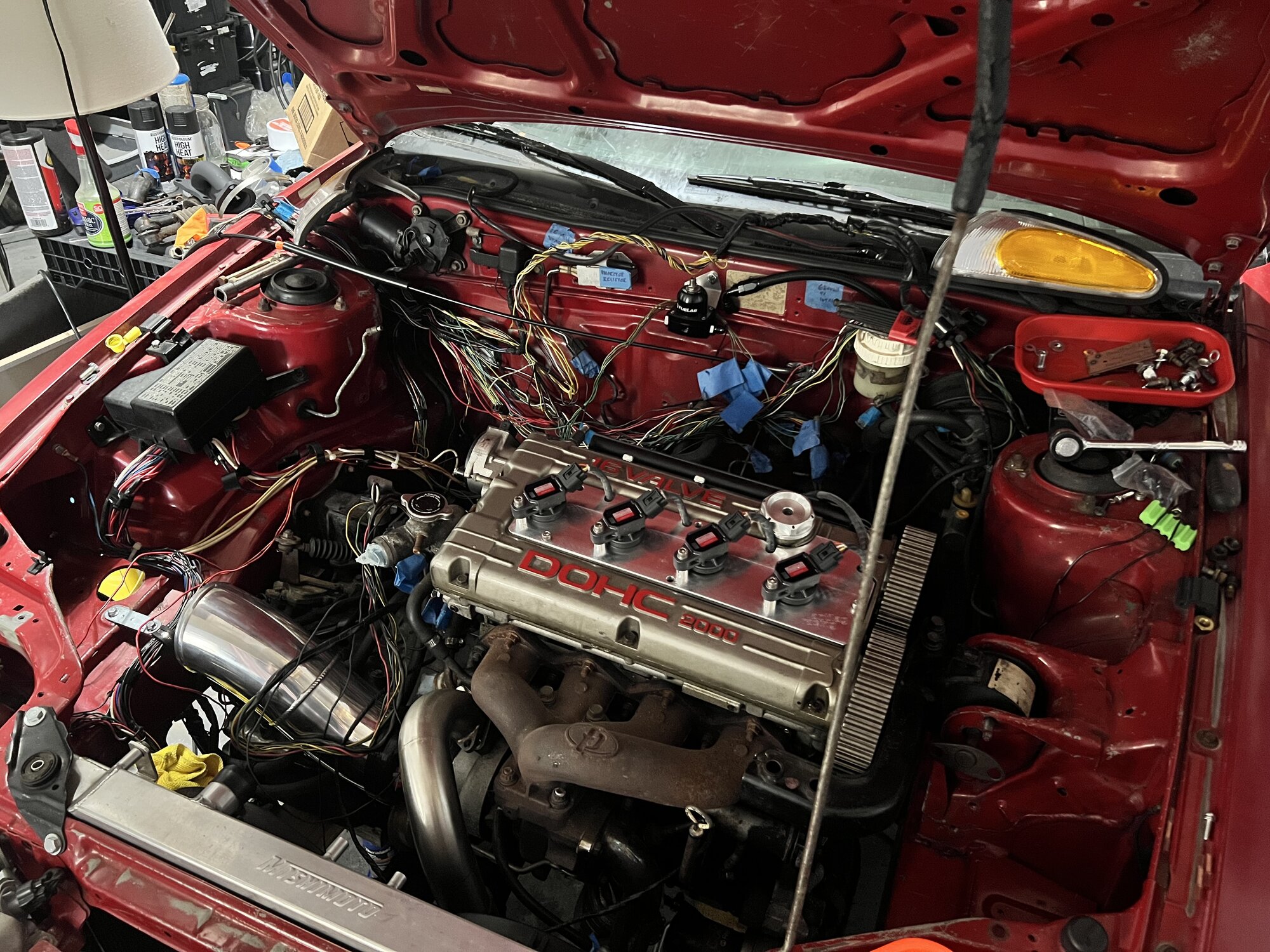

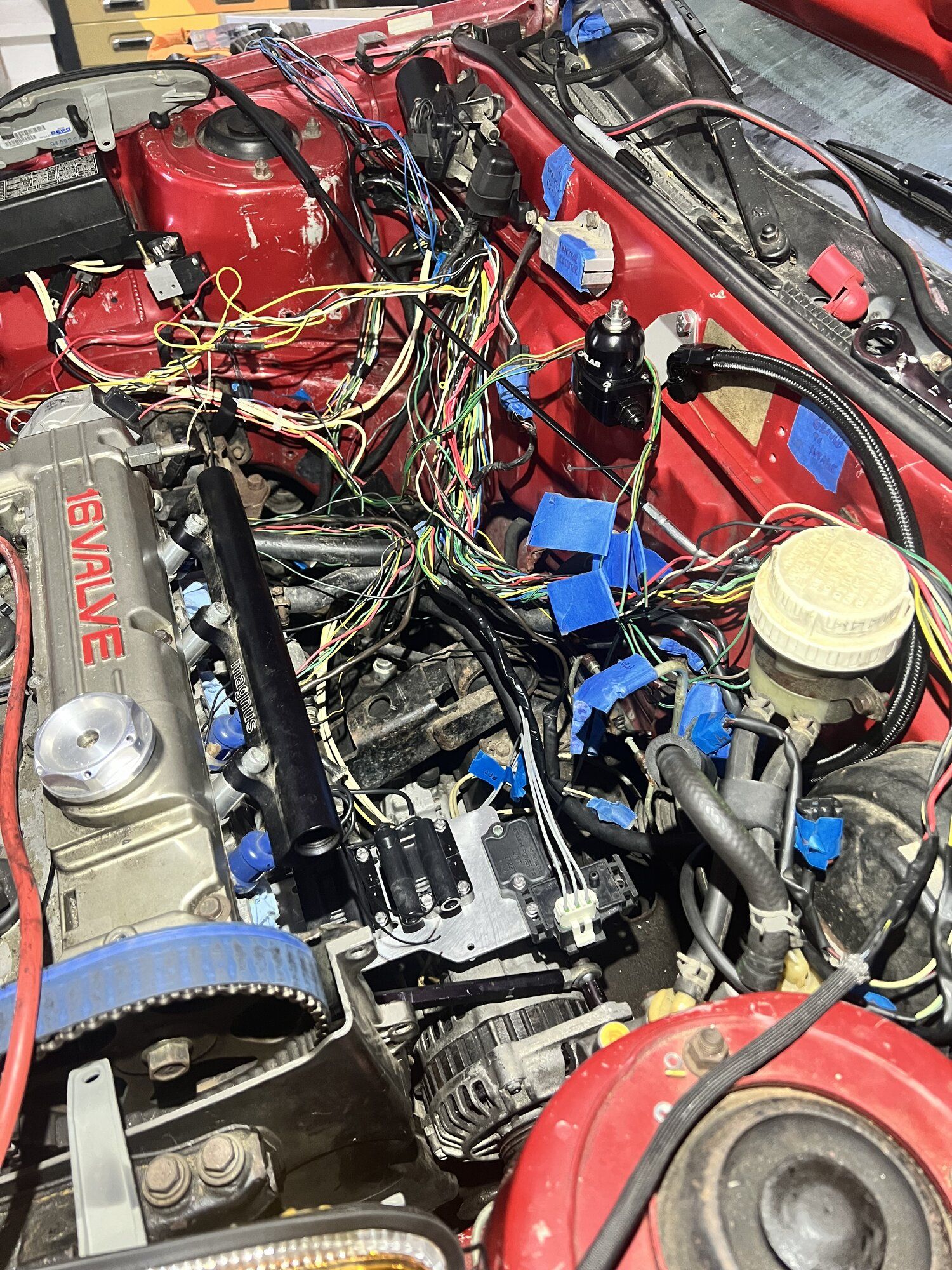

I keep on sorting the wiring where I want it to go.

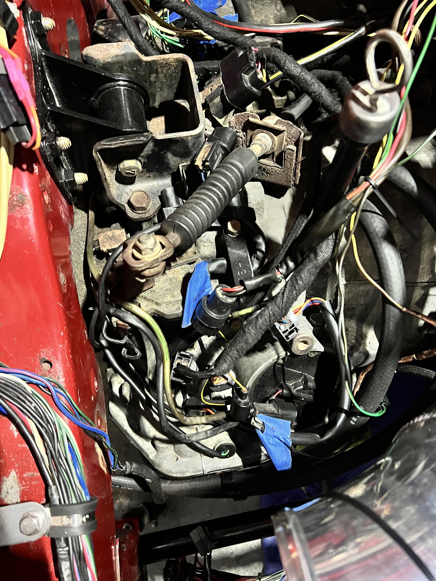

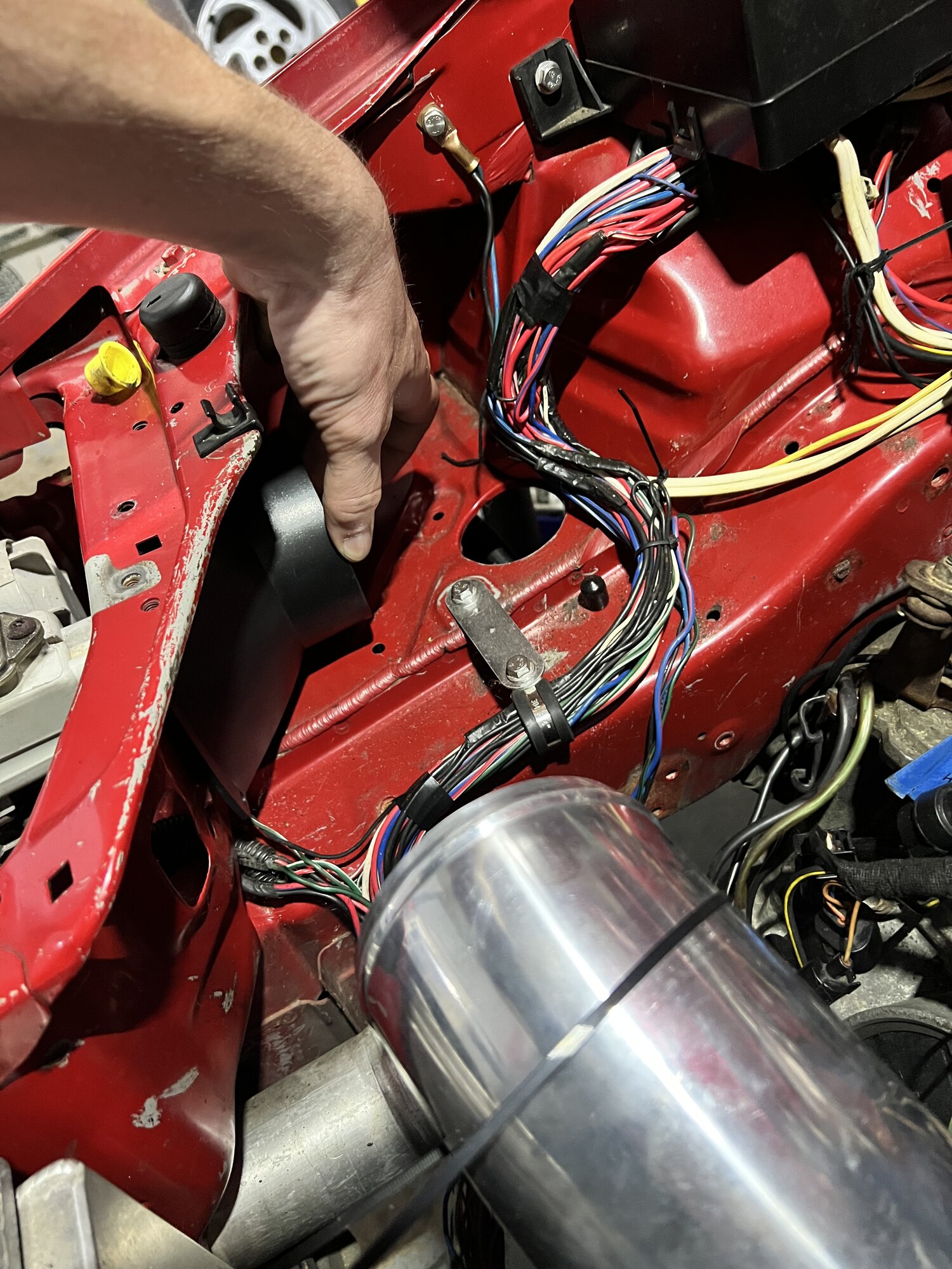

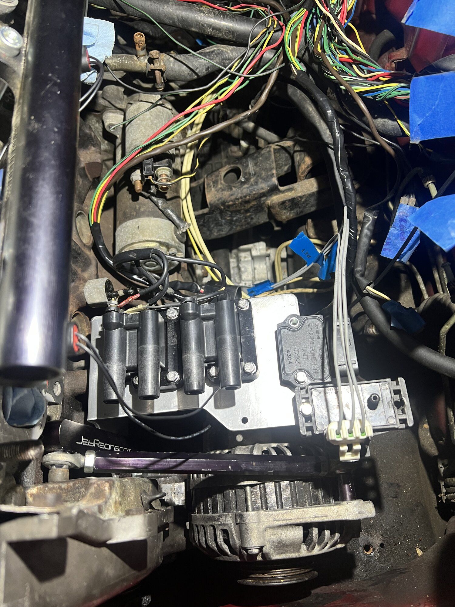

Decided I needed to break out the Jay Racing relocation kit out and get into the radiator support harness to get the wiring out. I had to cut the charging light wire but plan on running a wire to it. I also had issues with the lower bracket fitment so I took it to work and used the bench grinder to clearance it some more to not hit the cover and oil pump.
I have to figure out where I want the ignition. I might use the windshield washer area behind the light or the cruise control area if I can’t find a JMF bracket. Slow but steady.
As it sits. I’m in between ideas on a lot of things. JMF coil bracket with new coils mounts with new transistor for reliability. Accidentally broke a stud on one so I might have a paper weight and threw around the idea of just going COP with Denso coils to clean it up a little and sell the rest. My BJ’s manifold is strictly for a 75mm throttle body and I’m staying small frame so might sell that whole setup and get a JMF street and use this bored out stocker I’ve had. I don’t plan on wrapping the harness up until it runs so I will look messy until then.

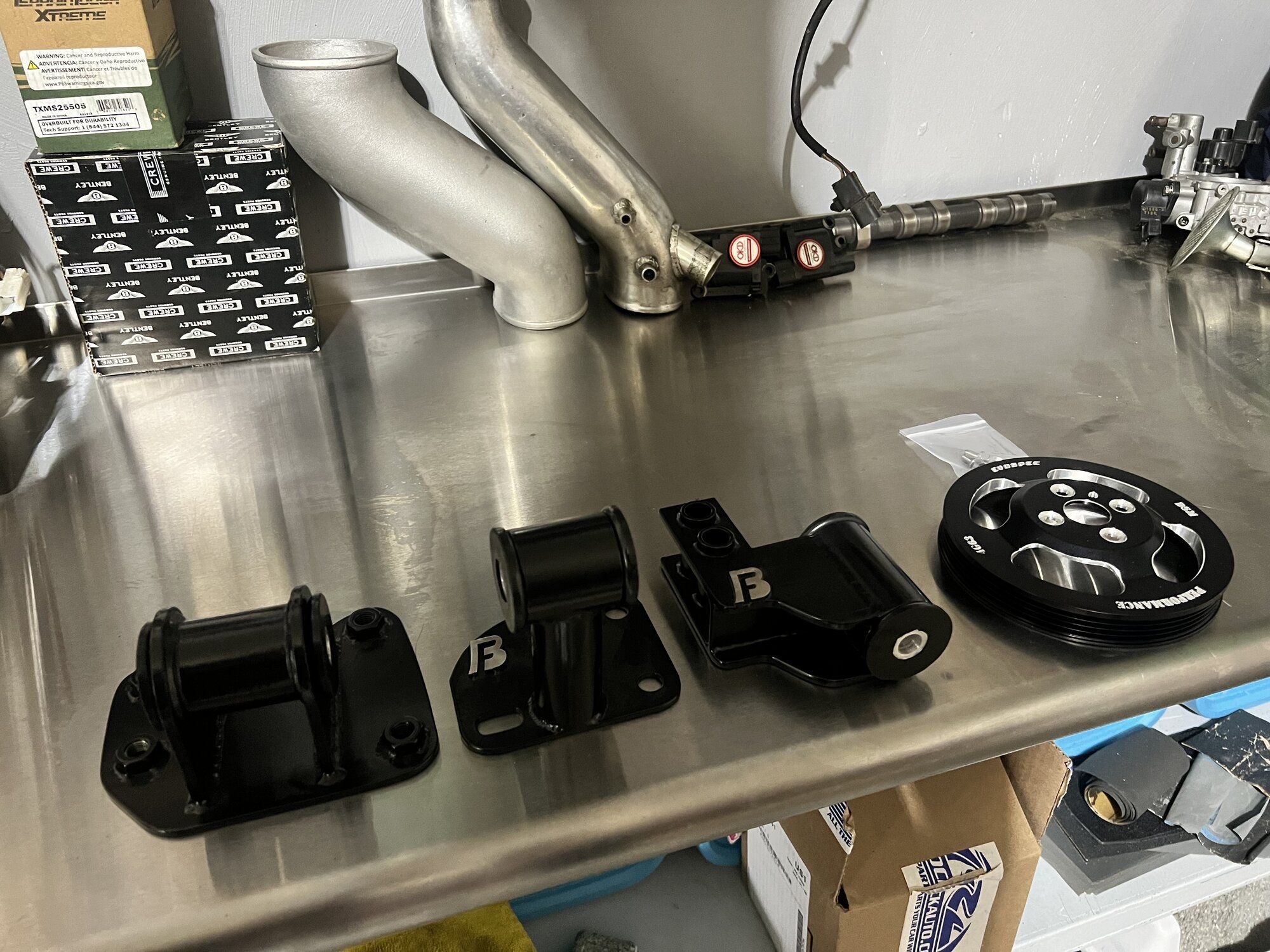

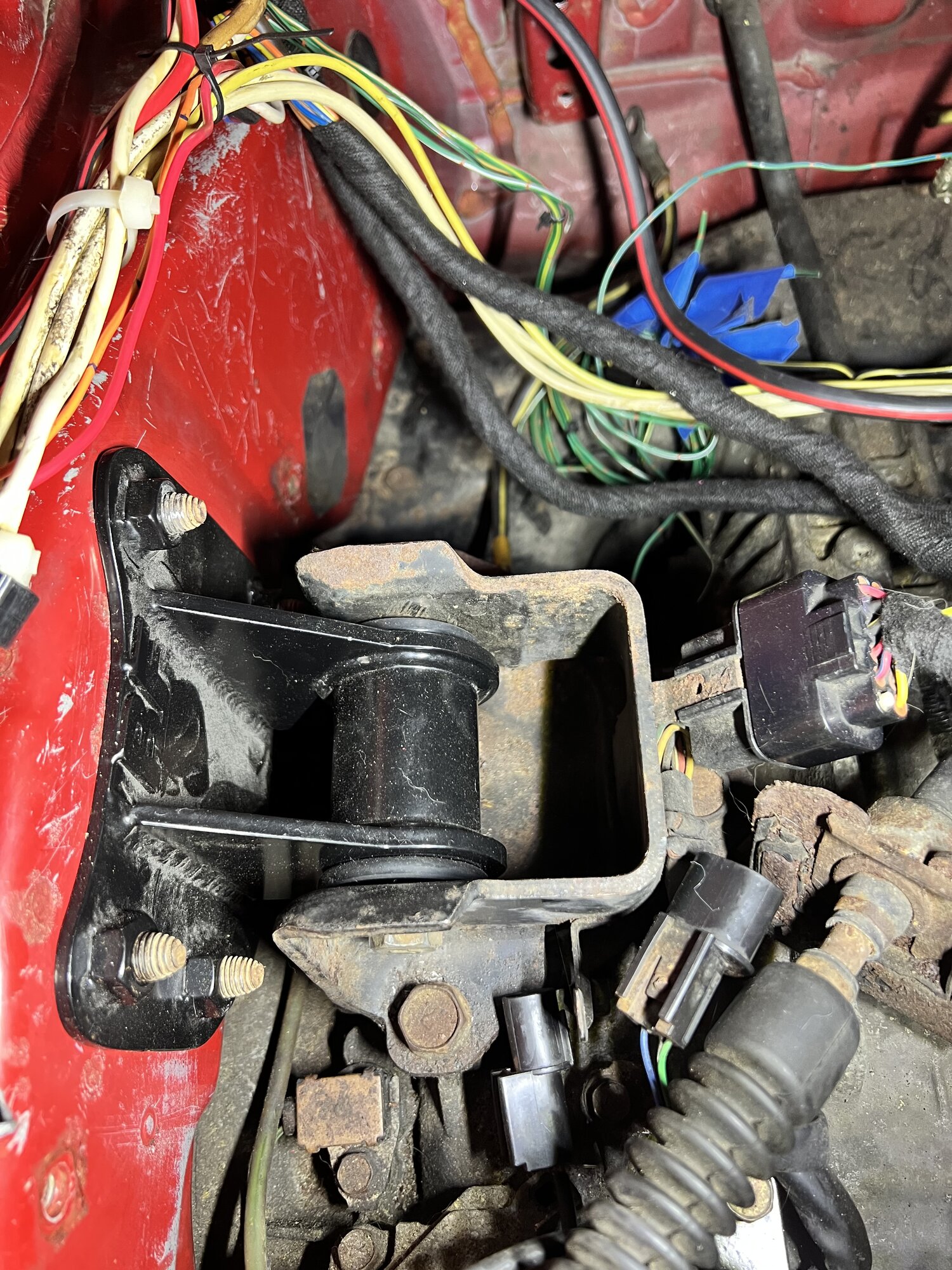

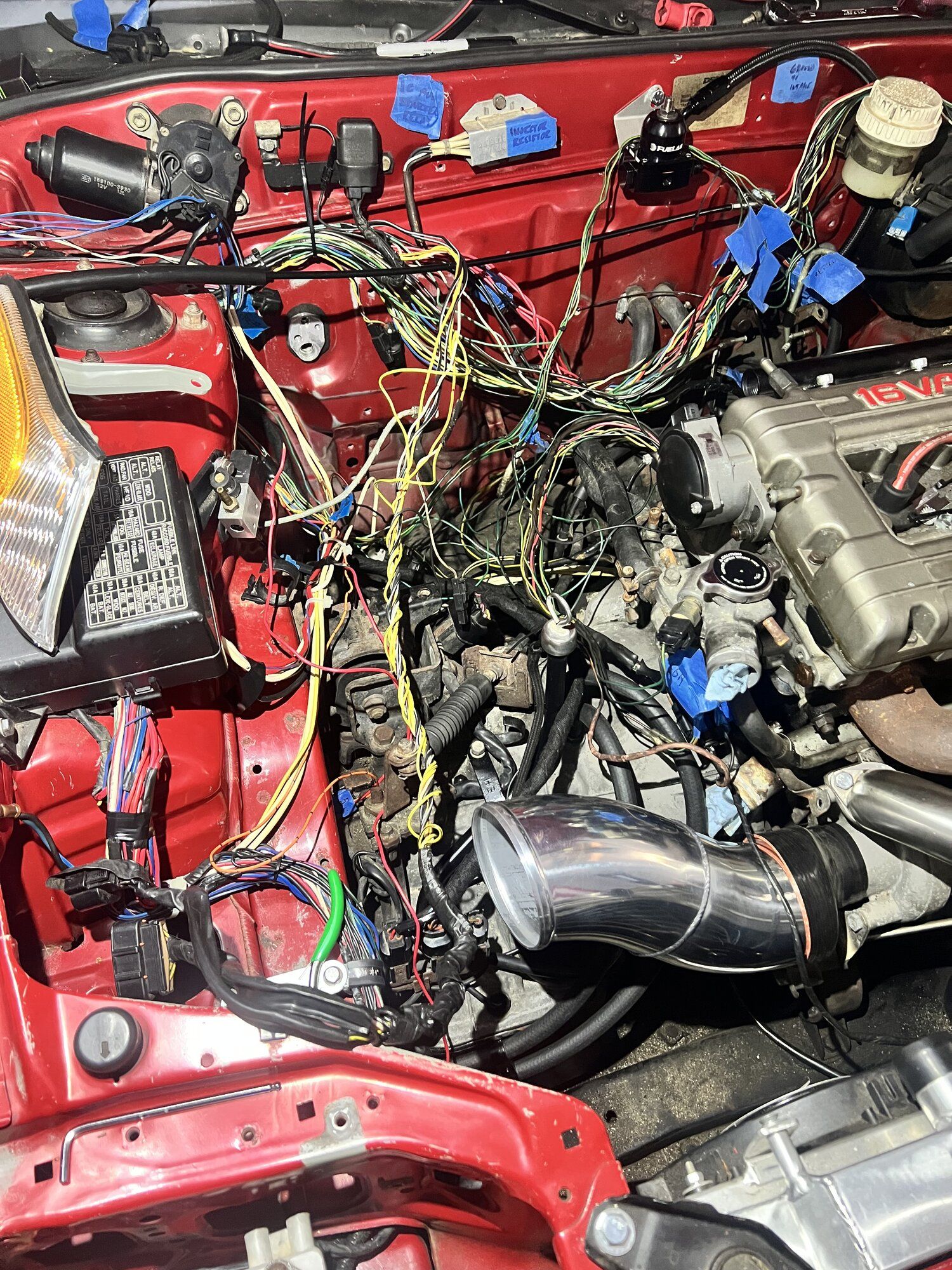

Some parts came in. I realize there’s no point in doing anything twice so do it right the first time. I can justify making sure the engine and trans are where they should be and using the inner rib for the waterpump and alternator relocation while not hammering the frame rail in doing it any other way. The cross member was ordered with the mounts somewhere else so I hope it’s close to completion. That will take care of some extra room and the front mount.

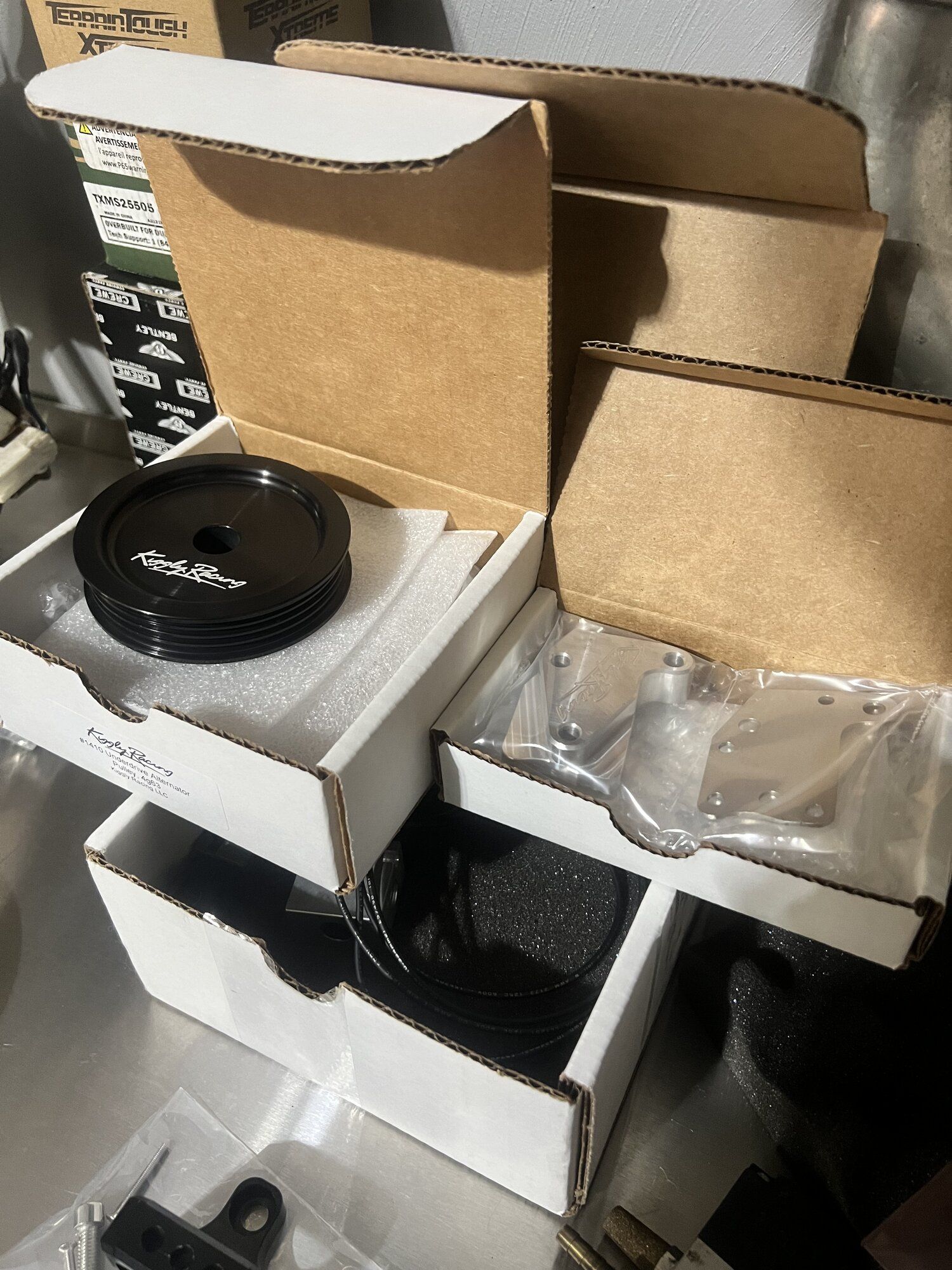

Some more things came in. Boost controller from ECMlink because I do not want issues with the ecu and resistance, Kiggly alternator pulley and HLA. Issue with the valve now is mounting as the mount I bought for is seems to be specifically for a MAC valve and nothing else 🤦🏻‍♂️. I’ll pull the alternator again and have our alternator/starter guys go through it and pretty it up before finishing up that leg of the harness. Probably going to pull the trigger on the Antilag COP kit and just be done with it so I can finish that side of the harness for routing purposes. There’s still a lot of small things that add up but I think it’s closer than it seems considering I have 95% of the parts sitting here mocking me. It’s all just time and enthusiasm as I always have other projects, house and life stuff to do. I have a 4 day for July 4th weekend so fingers crossed more physical progress is made.

Picked up a front crossmember from BoostedFab at the Shootout. I had already installed the mounts which was a pain until I stepped away and loosened some more things. Timing, Trans and front all line up better than I expected. I recommend them. Now just to wait on this EatonMotorworks rack job to come back in so I can bust down the subframe from the 90 and put some bushings in it.

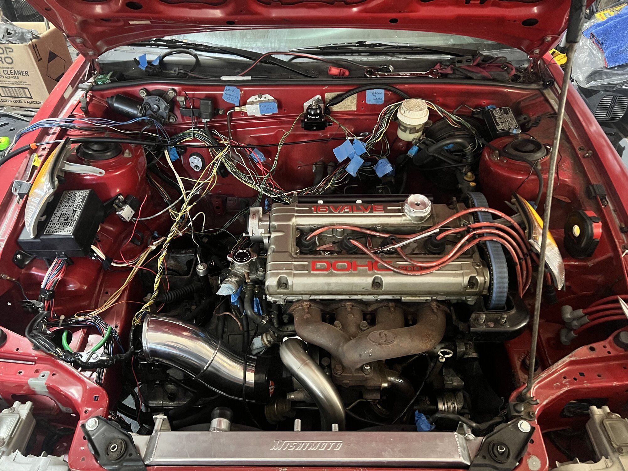

Measured and searched over and over for my plans on the intake. Finally found a $10 dust hood that had close to the measurements. Fits great behind the headlight. Just remove the panels, knock the anchors off and trim. Ram Air. I’ll use some sort of rubber sheet to block off and make a funnel behind the headlight which shouldn’t be in the way of anything once done. I do need to buy a ,expensive for a coupler, cobra style one that’ll come off and flare out to finish.
I figured I need some room for the intercooler piping so unbolted the trans connector bracket. Just need to figure out where I want them.

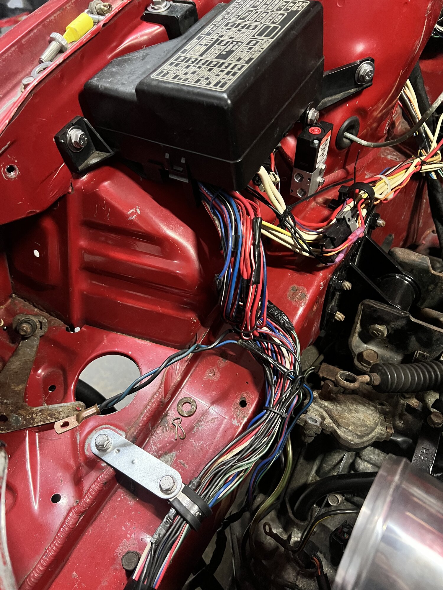

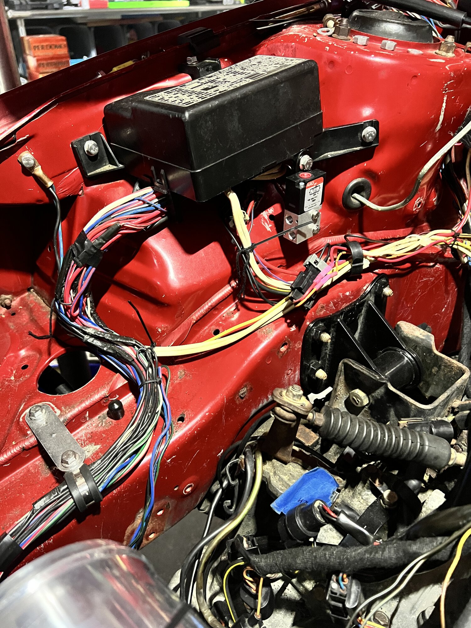

Mounted the boost controller on the fuse box for ease really. Drilled a hole in the lower cover. Seems to fit quite well.
I’m going to justify needing a JMF manifold to bring the elbow where I want it and for easy access to everything else.

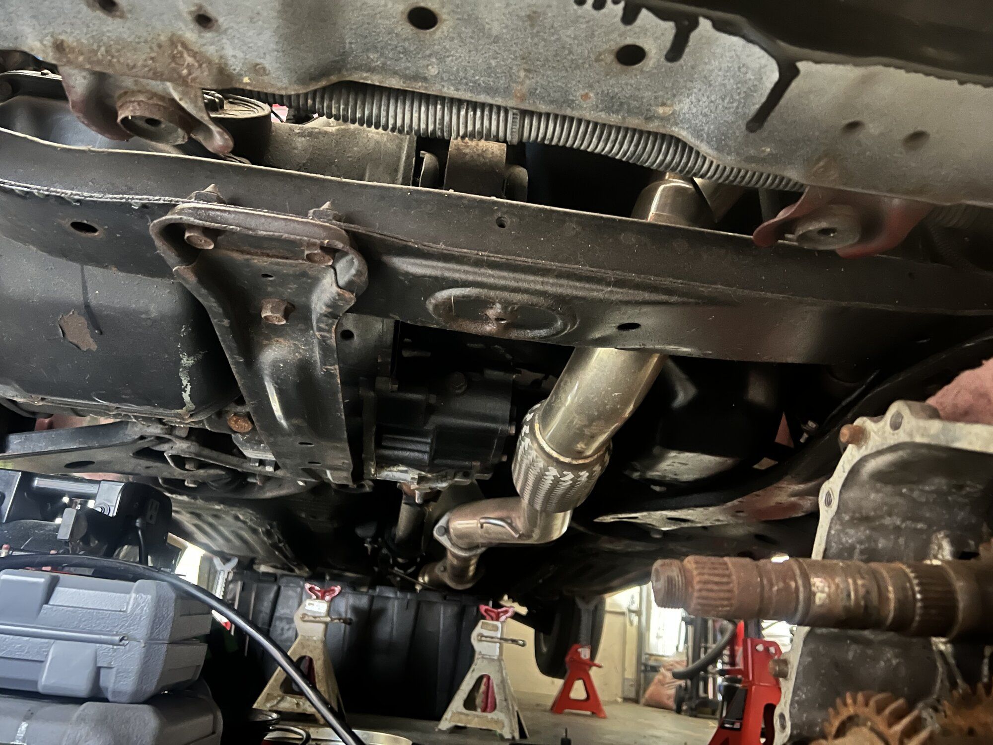

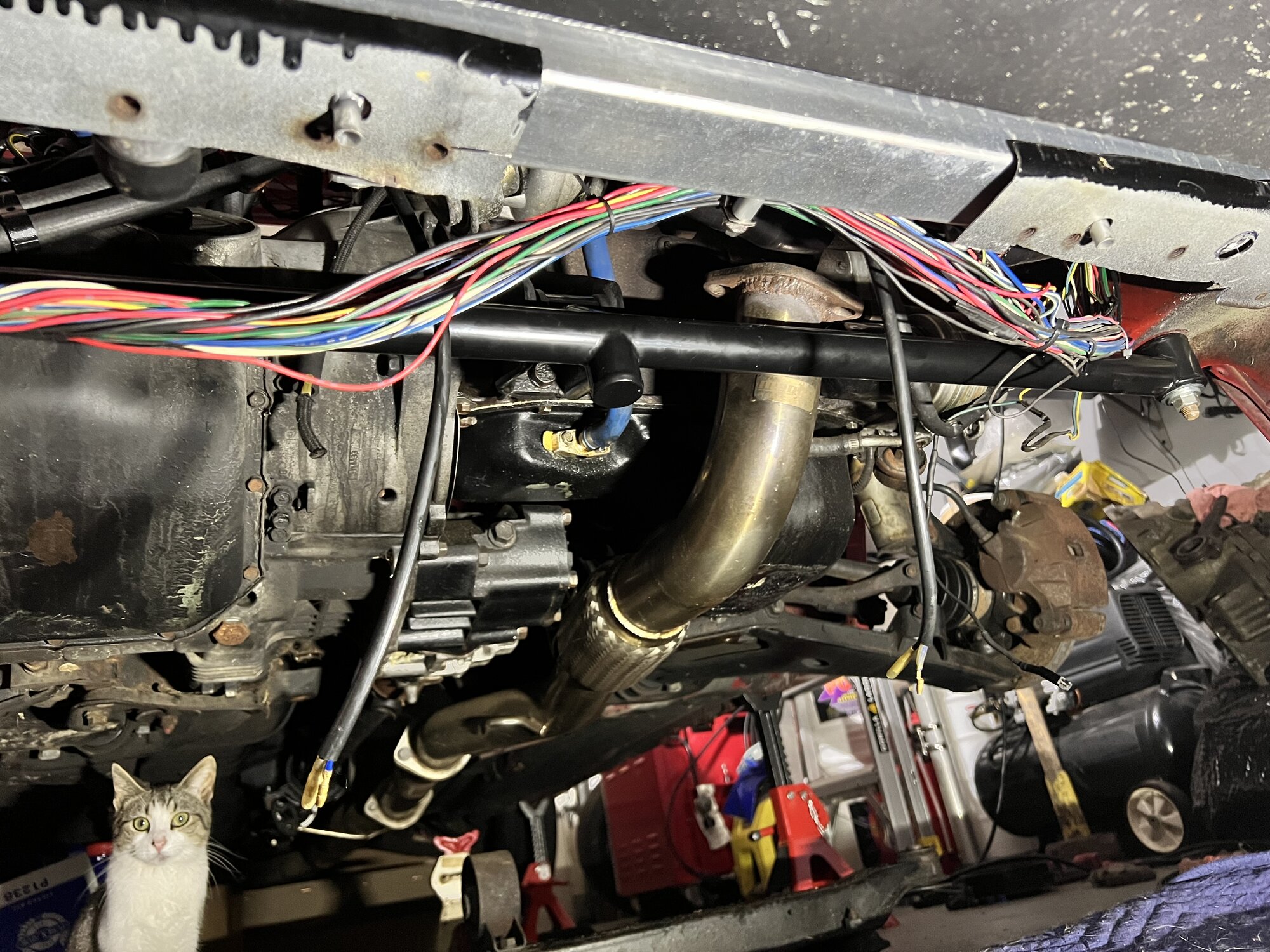

My screamer O2(I know) was touching the lower intercooler piping so picked up a recirc’d on, cleaned and heat coated. Will most likely wrap the O2 as best I can and do the downpipe. Everything is getting some sort of heat barrier for just that little extra hp.

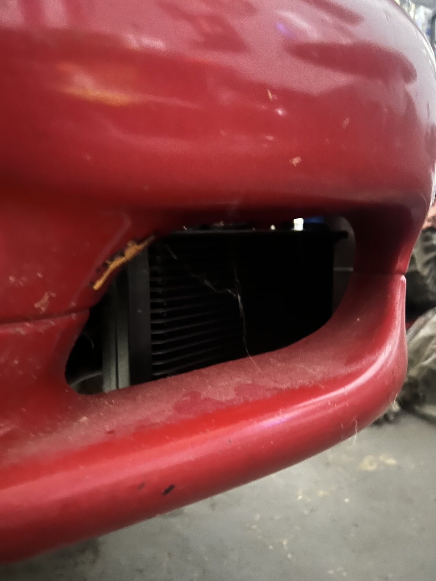

I got a couple things done in some downtime this weekend. Changed some ideas for functionality. Intake behind headlight is out. I just want to put the lights in and be done and a true cold air off of the bumper is a little cutting and a bracket away from it behind the fog light cutout.

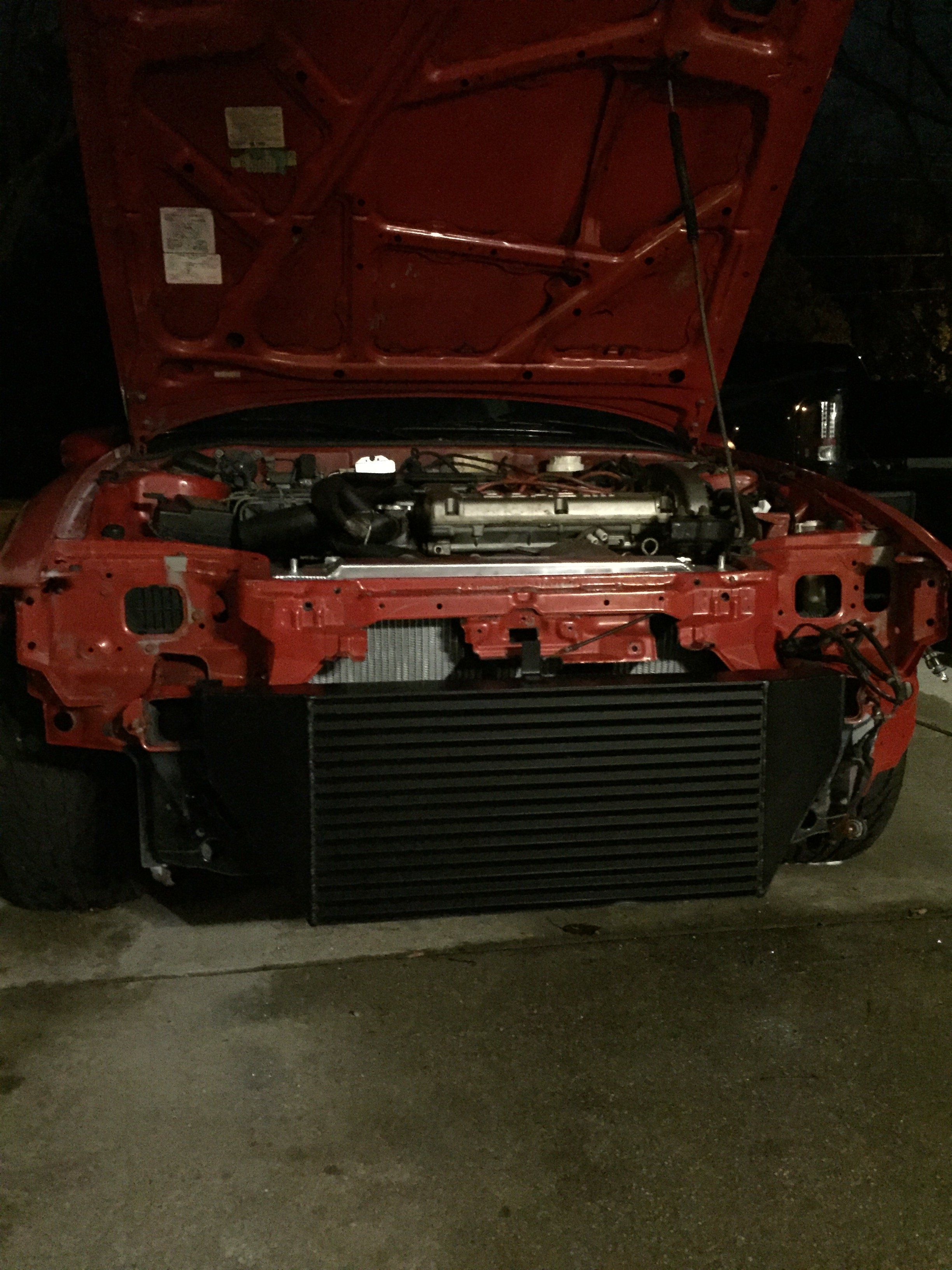

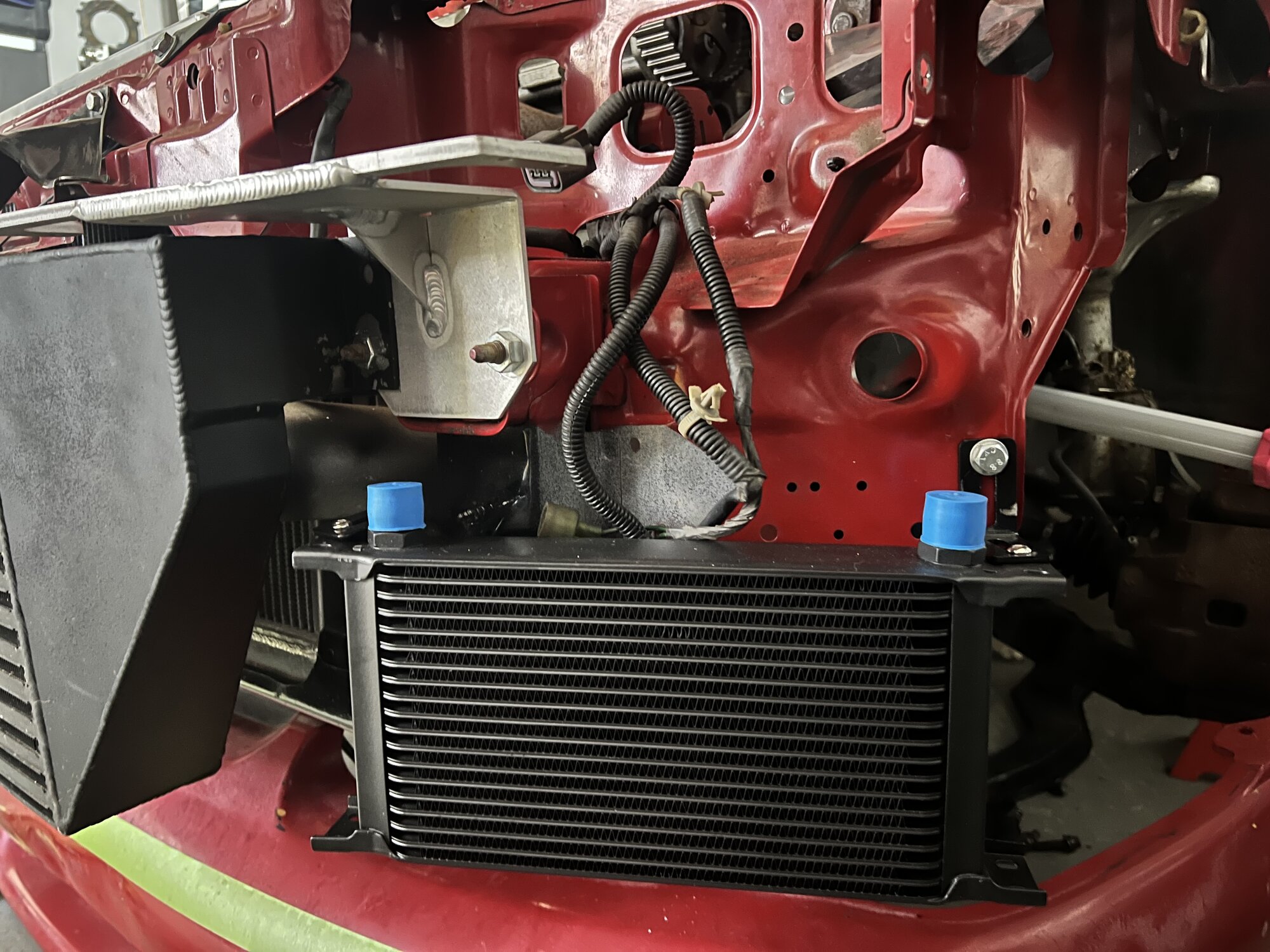

The trans cooler is going to the rear but I’m going to have to find the right spot.

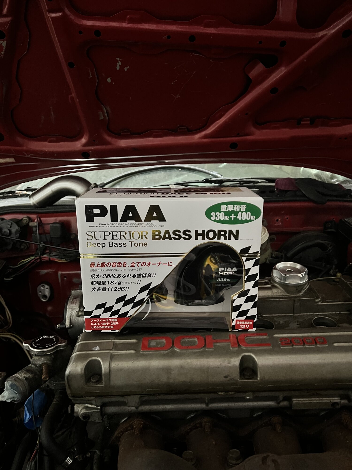

I had stock horns. My boss gave me some #5 combo ones. I bought PIAA deep set. Just get it right and be done with it.
Also moved the harness off of the fuse block to make room for activities in that area. Pulled the alternator powers through and think the body and main harness on the front and passenger side can probably be wrapped up after the alternator wire gets a new section to the alternator.

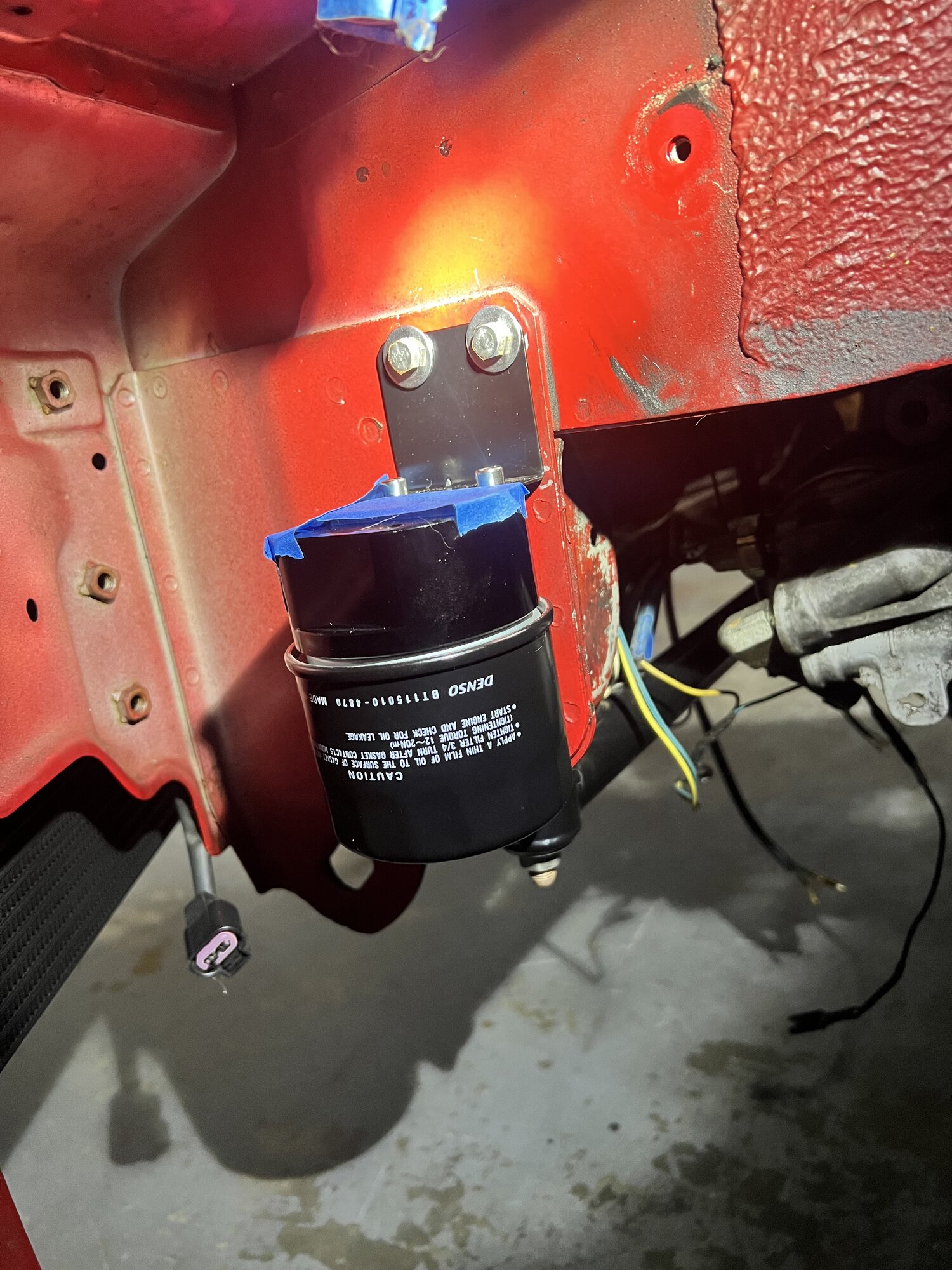

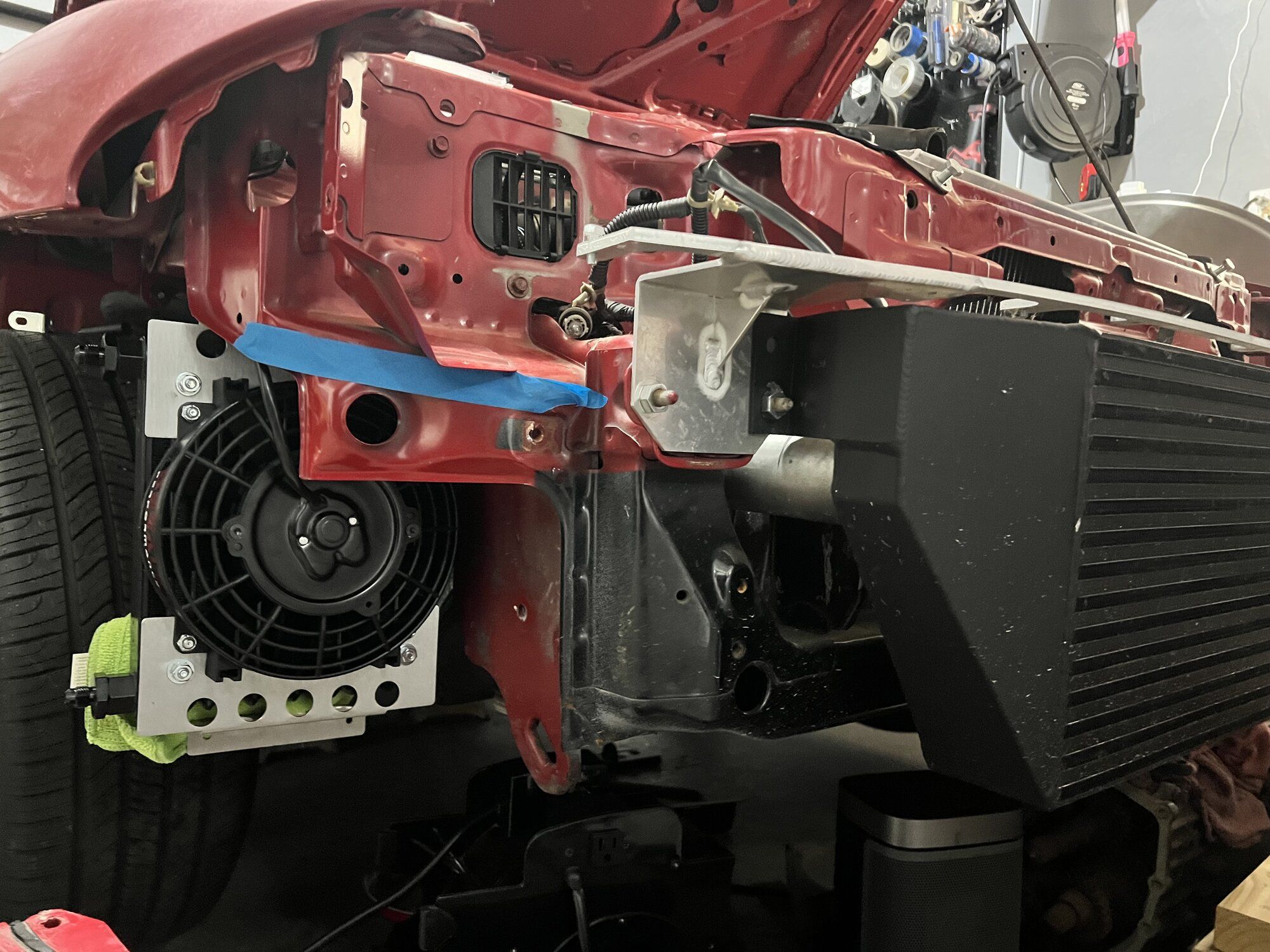

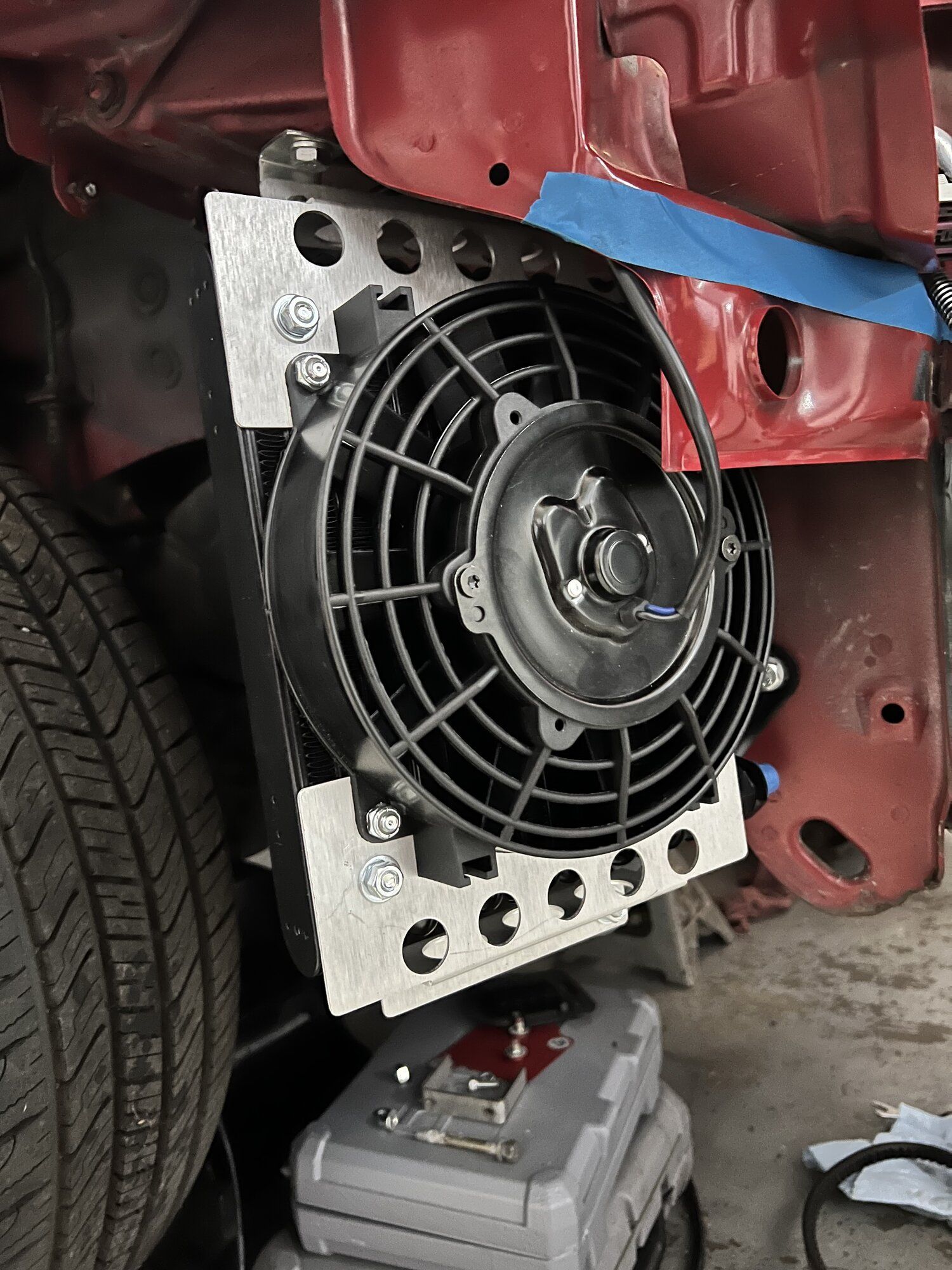

I need to replace my oil cooler what brand is that you are using.
Combo #5 special from Amazon 😂. 19 row htracing. It’s really two L brackets and a straight bracket off that left lower corner that could mount to the crossmember. It will be solid.
