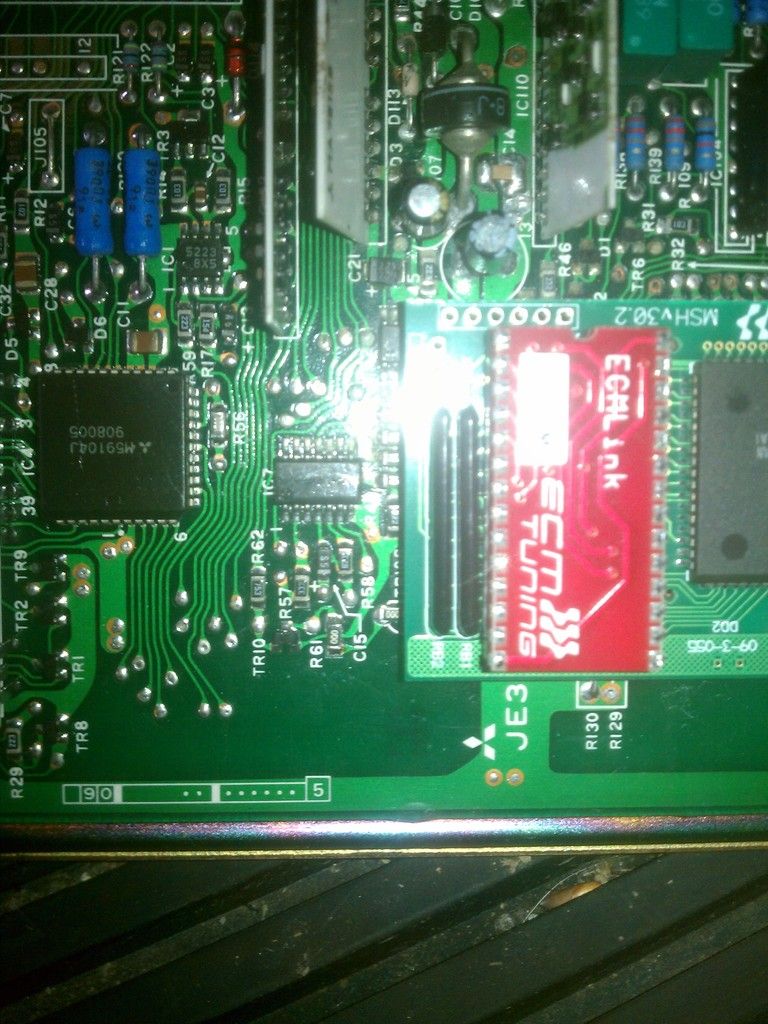

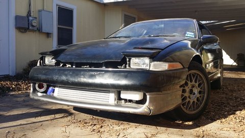

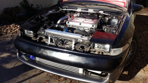

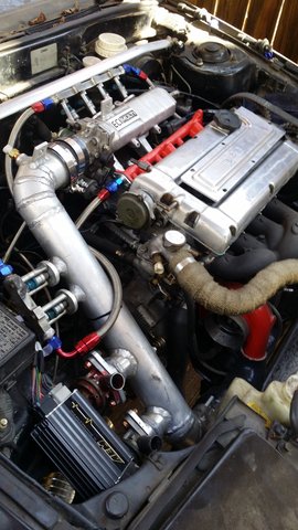

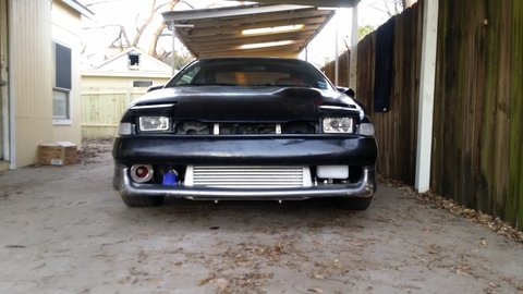

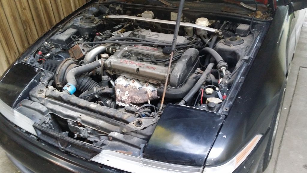

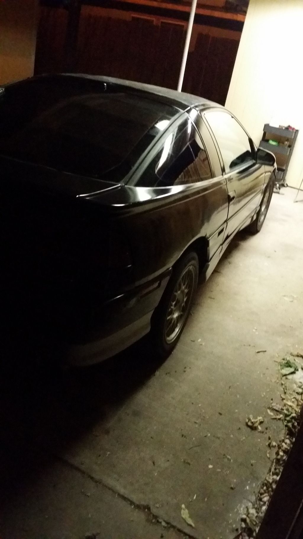

A build log for my 90 talon with a gt30 variant. Speed density on e85 with goals of low 10's on stock shortblock.
Im building this car with the intention of having a 10 second car for under $4500 dollars with some style. Perhaps even closer to $4000 or less once I sell some of the stock items, and this is with car, mods, tires, etc. Eventually I will make a price breakdown, but many of the items used to build the car were purchases lightly used off of these forums.

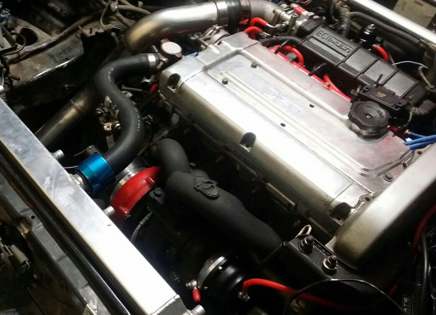

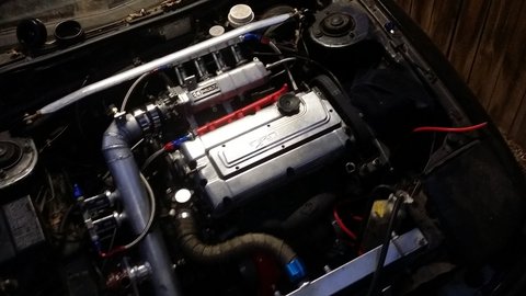

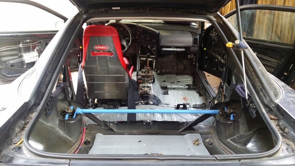

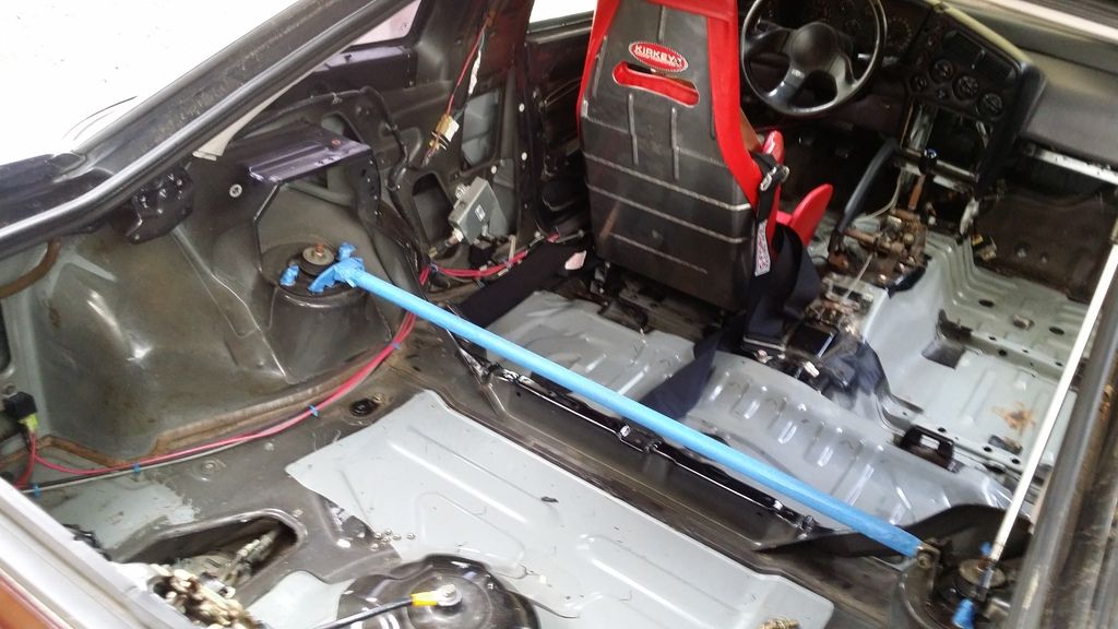

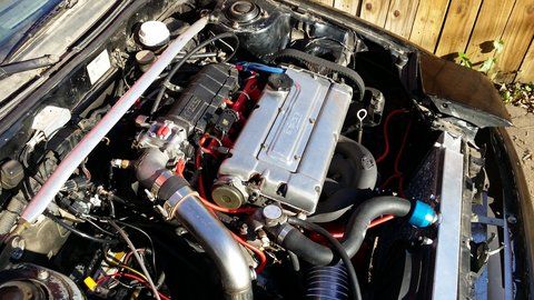

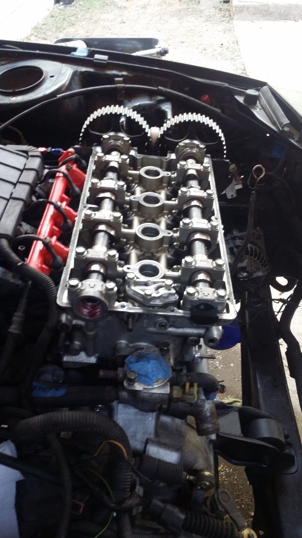

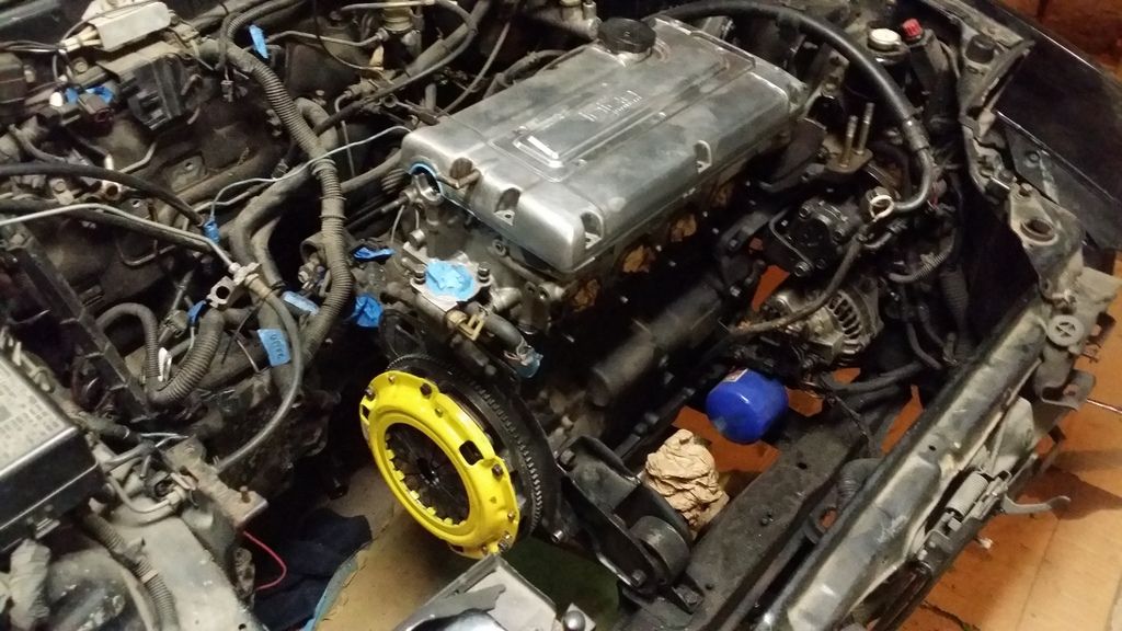

I obtained an fp3052 locally and feel that it will help me to my goals of having a 10 second car that retains the ability to spool quickly on the street. I have done quite a bit of weight reduction and I plan to make the interior pretty custom. I plan to use nitrous and methanol injection to make stretch both ends of my power curve; both increasing low end and adding top end.

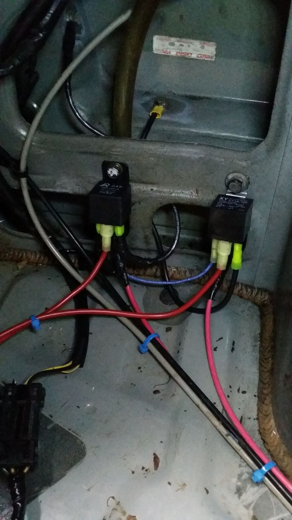

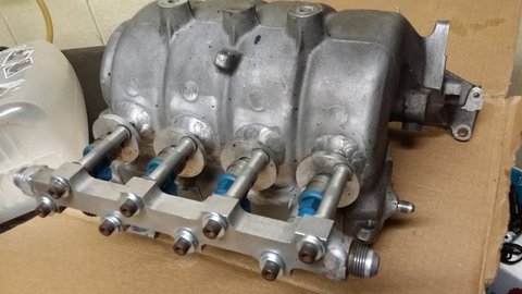

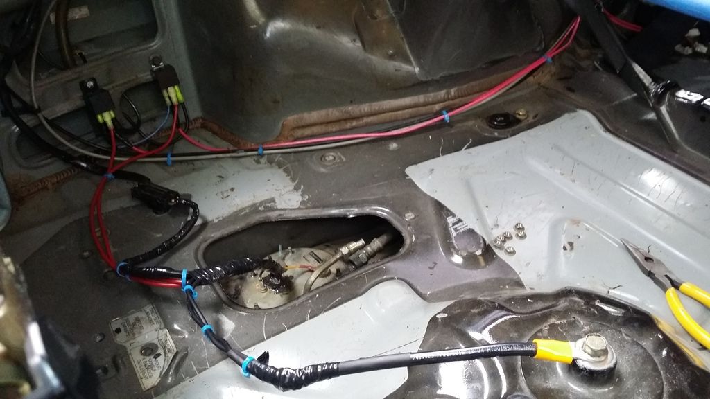

I rigged up my own dual fuel pump setup, and I pieced my own water methanol kit together. The methanol will actually flow through the fuel solenoid during a wet shot on spool, but at max spool the nitrous will be cut retaining only the methanol injection (60% methanol by weight).
First start up after this build is only days away, so I will update this accordingly.
