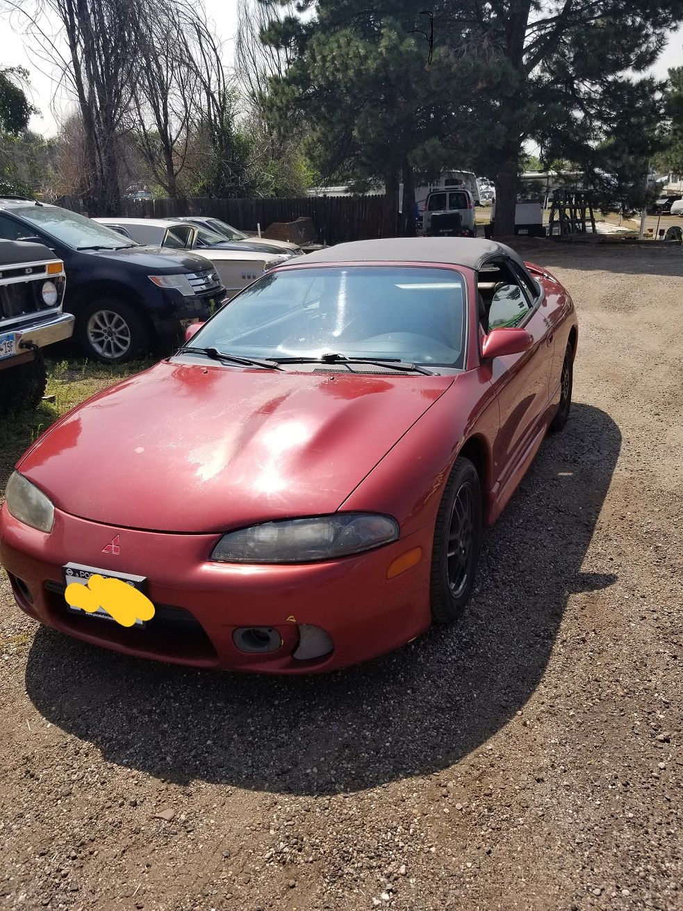

AWD Spyder Street Sleeper
AWD Spyder swap
Right now the engine is being built. 2.3L stroker. I am working on buying all the parts as I wait for the engine. Hoping to get a built transmission as well as get an HX40. Fuel minus big enough injectors has been purchased (450 pump, lines, rail, FPR, etc). Link is installed on the car. Last thing will be a custom exhaust from a shop locally.

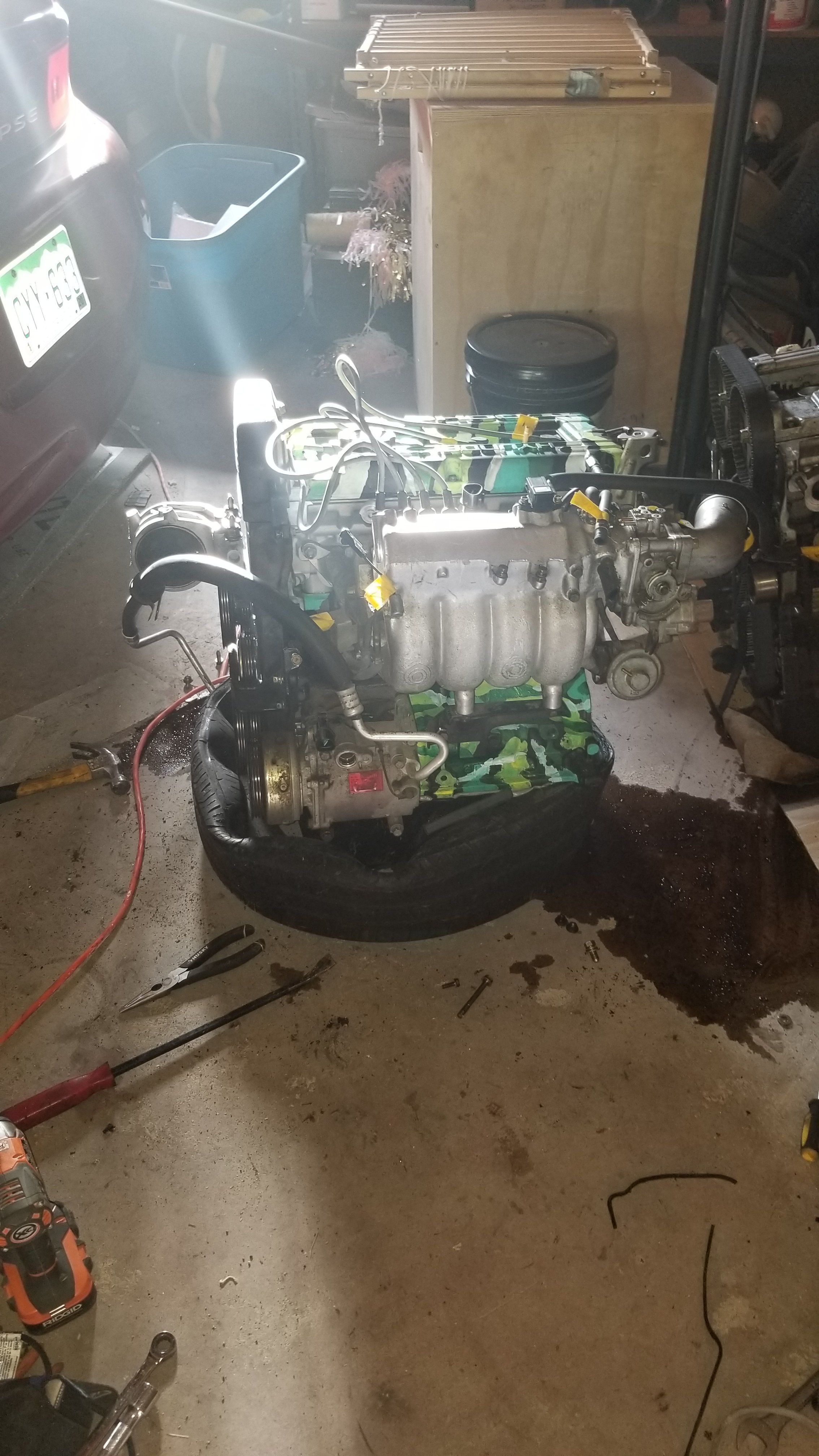

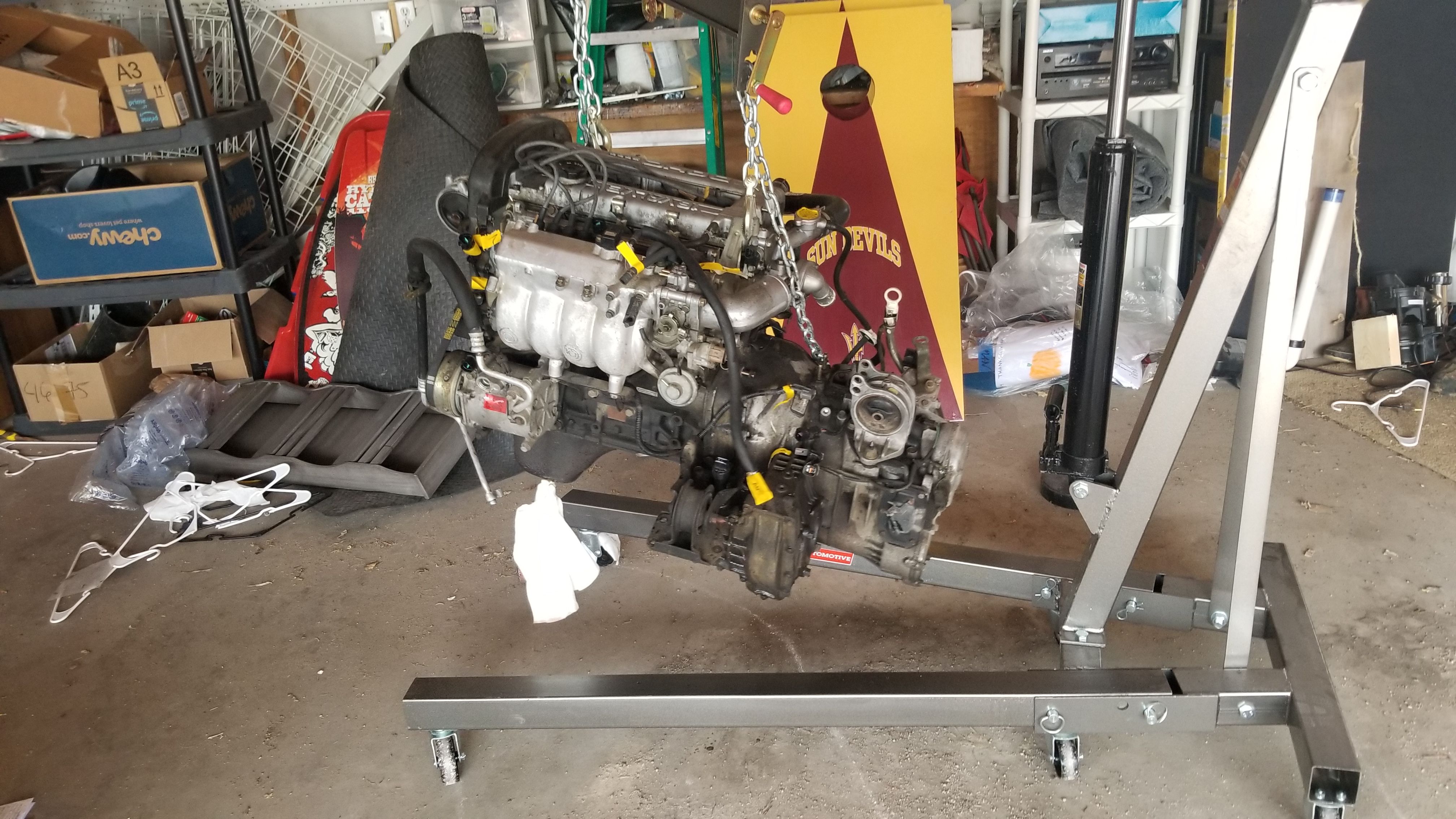

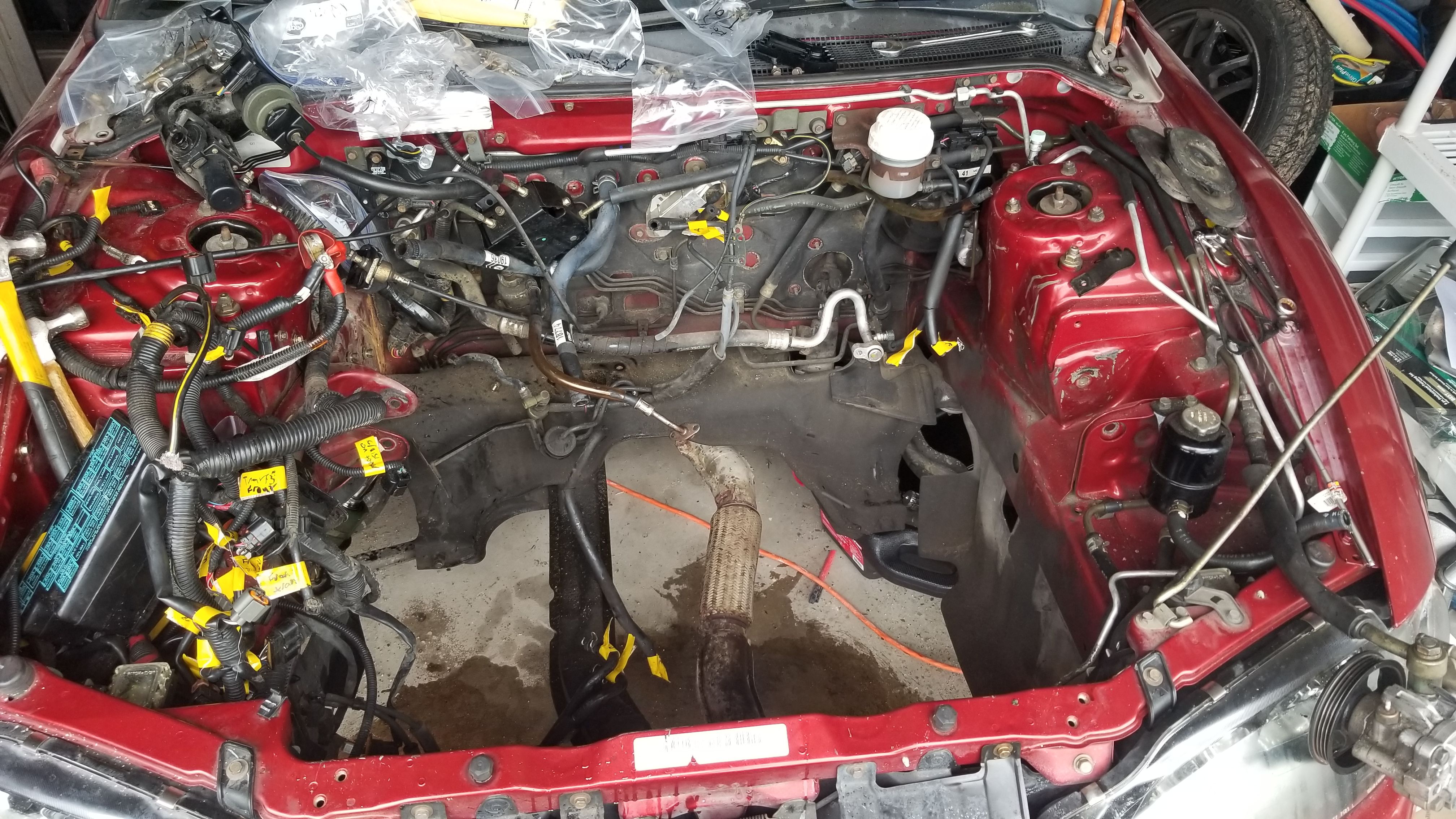

So I have the engine removed and have most of the accessories on the new engine. Next is marrying the new engine with the new transmission. I'm currently waiting on some bolts and installation parts. I'll be using the kiggly adaptor kit for the 6bolt to 2g auto transmission.
I also ordered a T3 exhaust manifold from Morrison Fabrication. unfortunately that puts me about 6-7 weeks out on getting her running how I'd like. Pondering installing the stock turbo and manifold for now to get things started.
Seems like it's been forever since I updated. Engine and transmission are in the car. Turbo and manifold are mocked up but not tightened down. Next will be finishing the fuel system, but I think I'll be upgrading the fuel pump to the 525 Walbro Hellcat. I really just need about 10 hrs of work locking everything up and some welding to complete the AWD swap button up.
