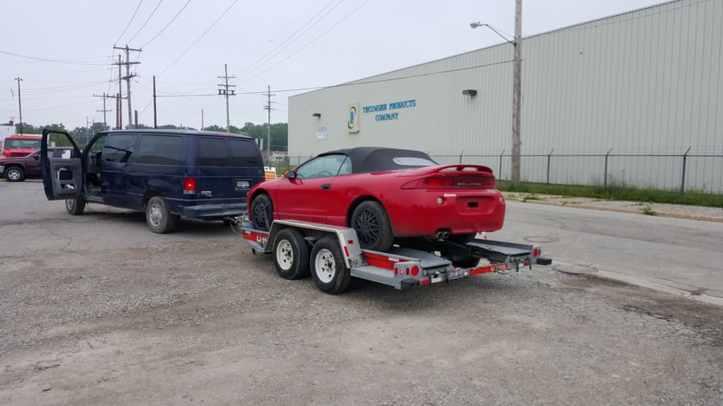

After being out of the dsm scene for about 3 years and parting out my last dsm I knew I wanted to get back into it but wanted something different this time around started to look into shells and found a clean spyder shell across the boarder ( I am in Canada ) about 500 miles away from home, drove up there to check it out and bought it on the spot for a steal. Went back on the weekend to pick it up with a friend of mine and she is currently back home waiting to have a few things done to it. Goal for this car is to beat the current 10.4 for fastest spyder and still be able to occasionally street drive it. For this year going to focus on cleaning up all the wiring and swapping the car to awd auto having the sheepey manifold built and getting parts.

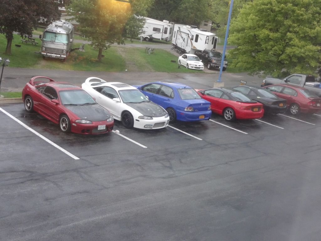

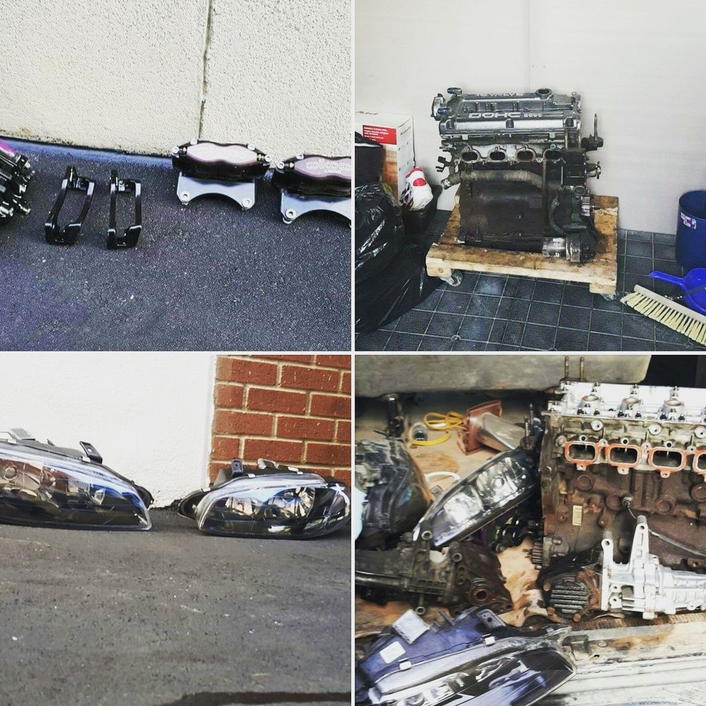

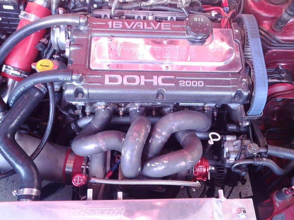

Here is some pics of my old car.

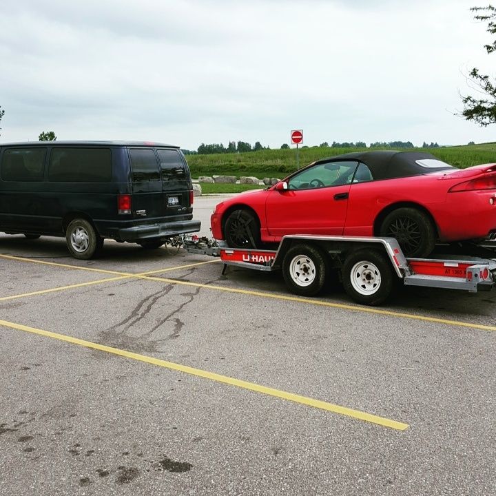

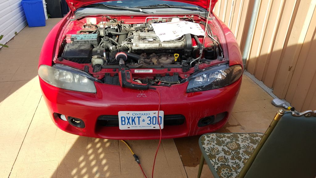

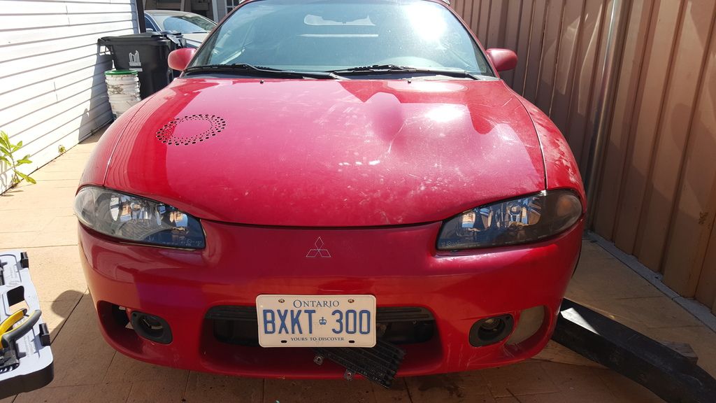

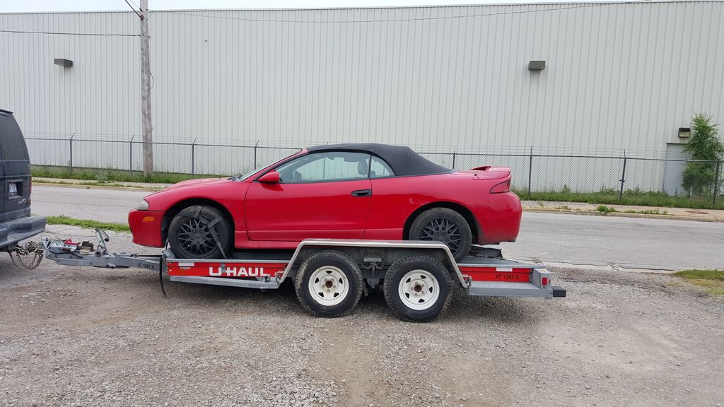

And The new Spyder.

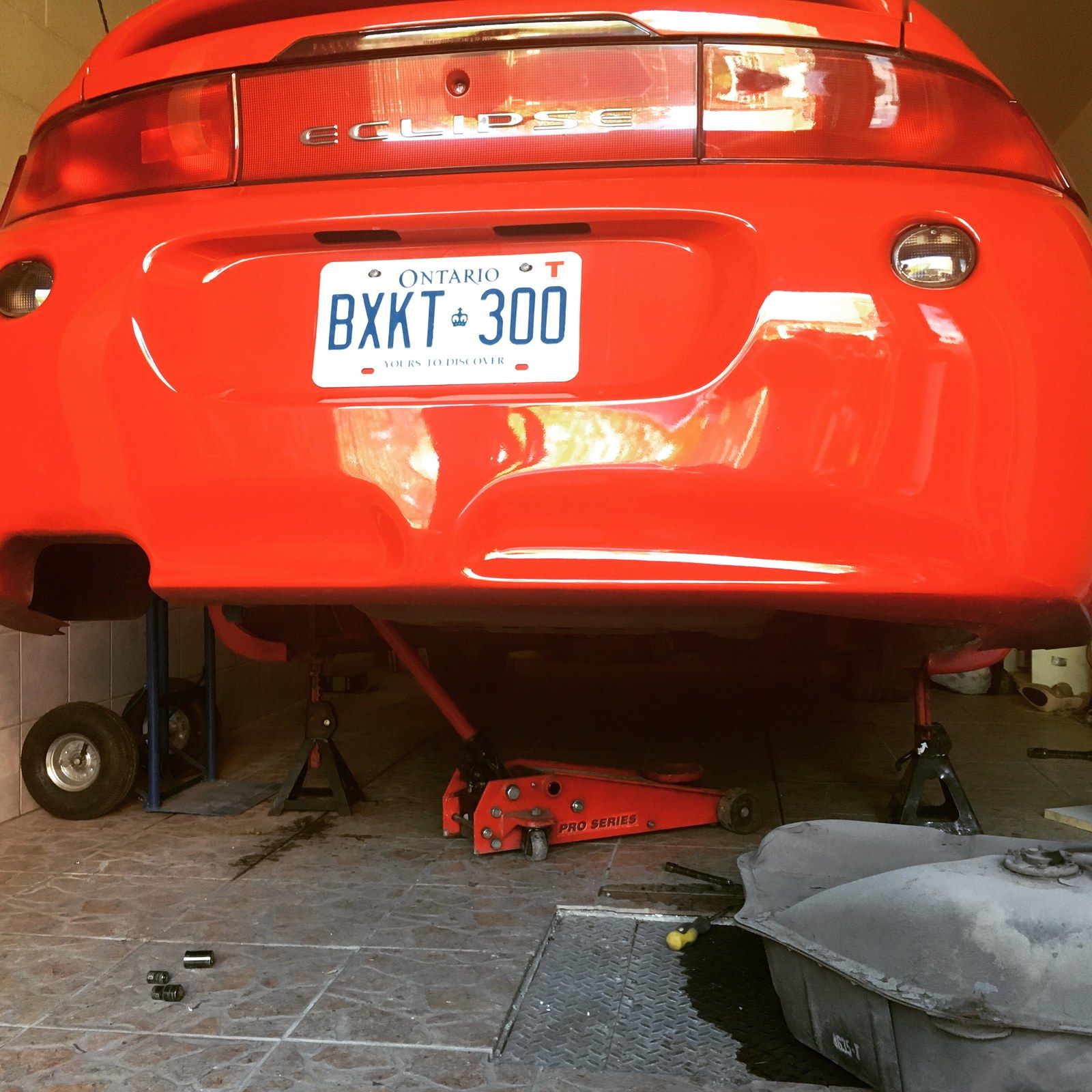

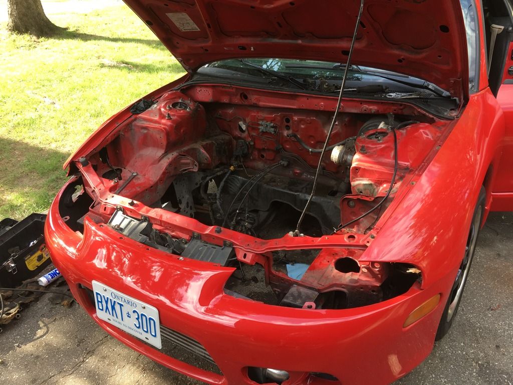

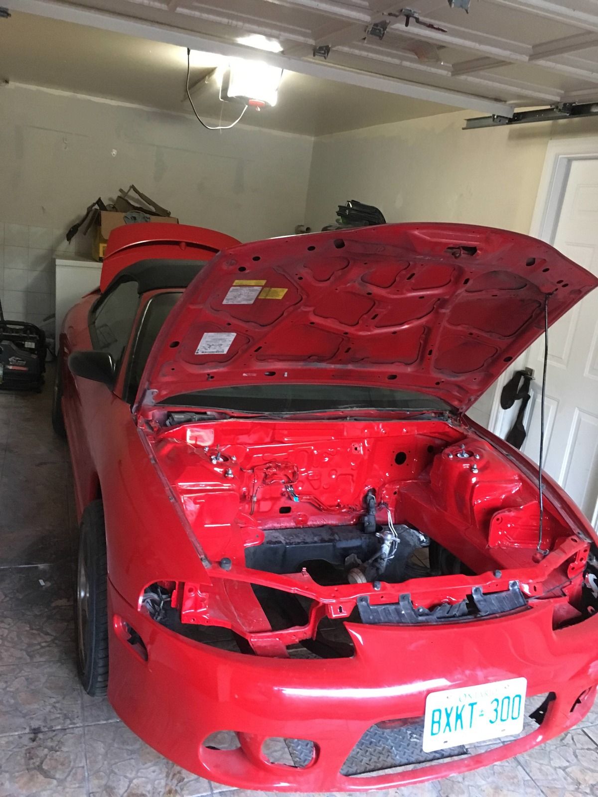

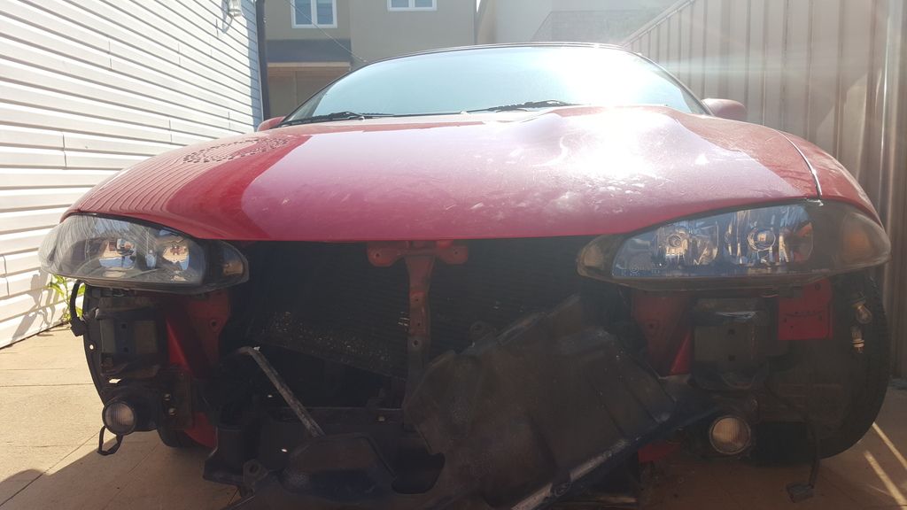

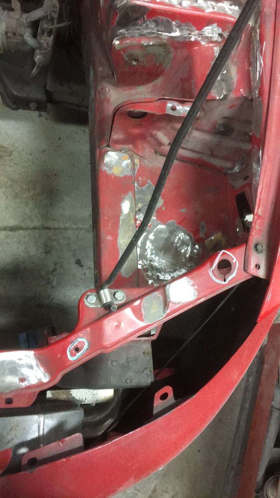

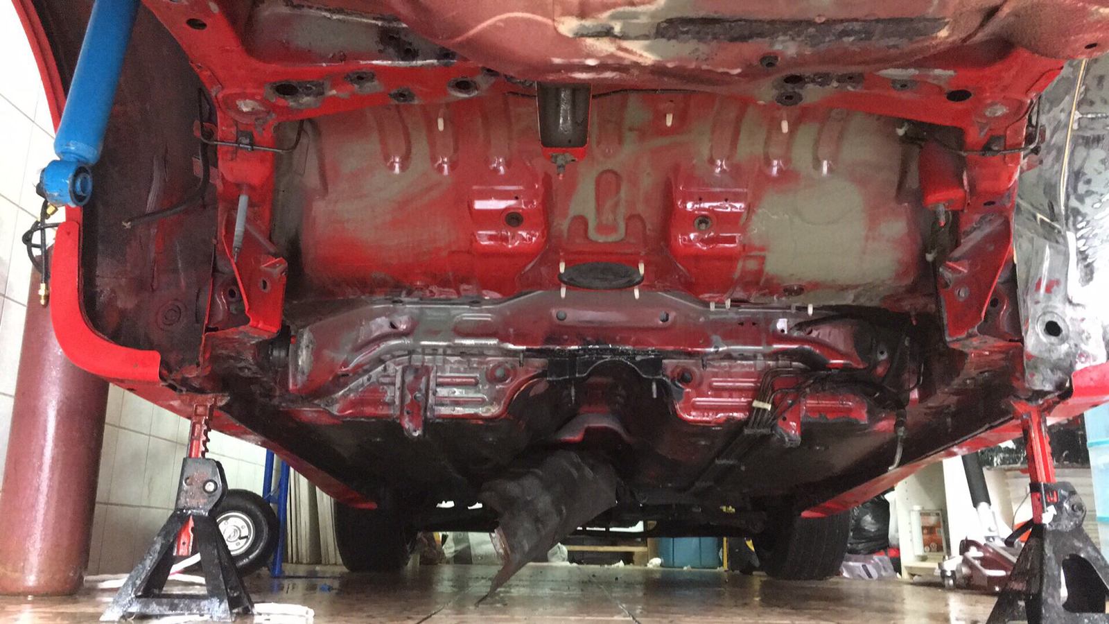

So far cleaned up the headlights and just tearing stuff apart A/C has been deleted along with power steering and cruise control just buying some time until I can pull out the motor and clean the rest of this mess.

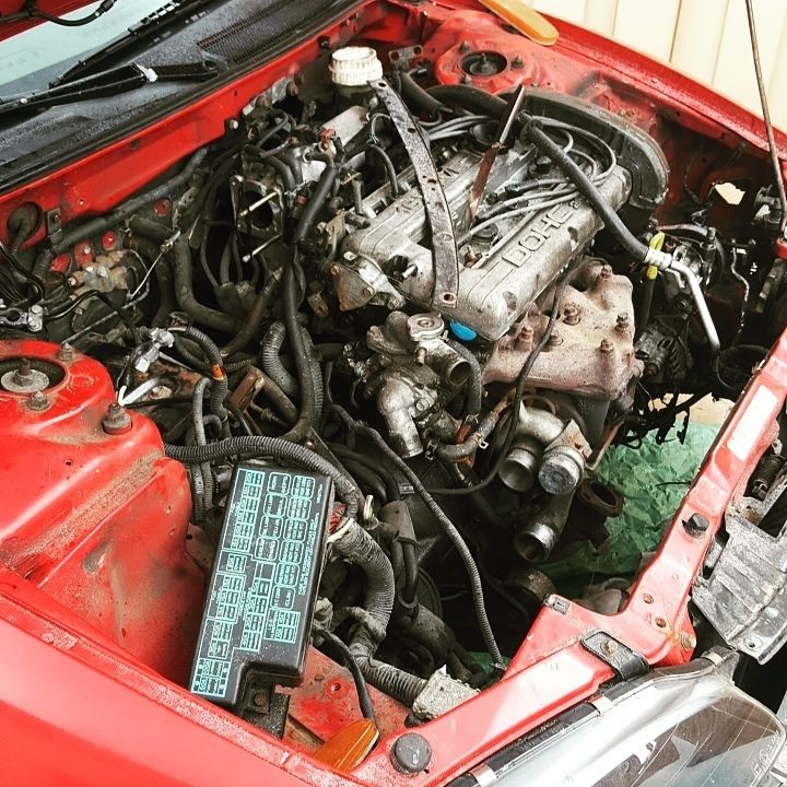

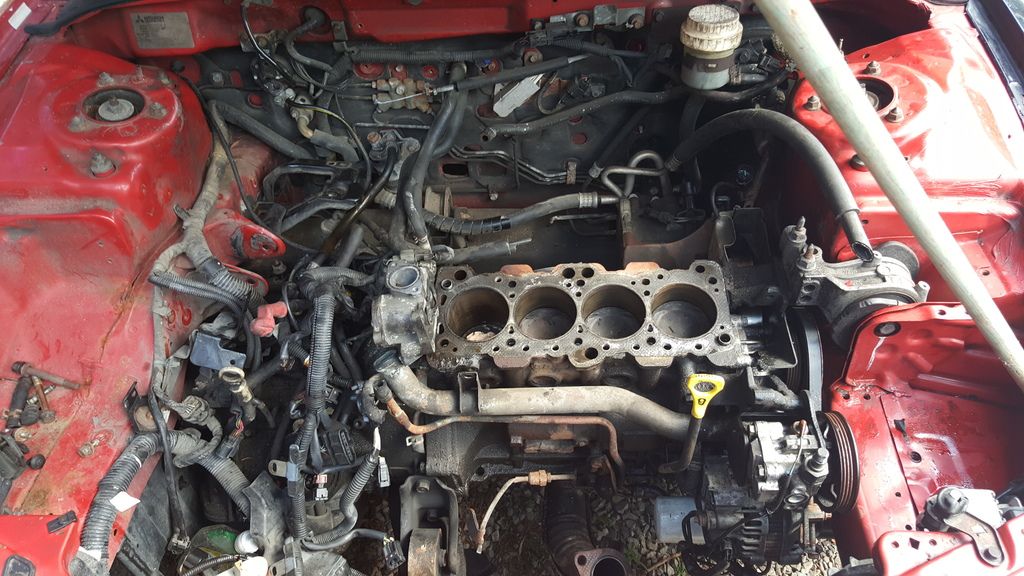

So pulled the head off today and cleaned up a few more things old owner blew out 1st rod and piston. Also sourced out a local 6 bolt long block to rebuild.

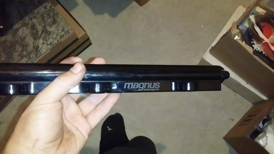

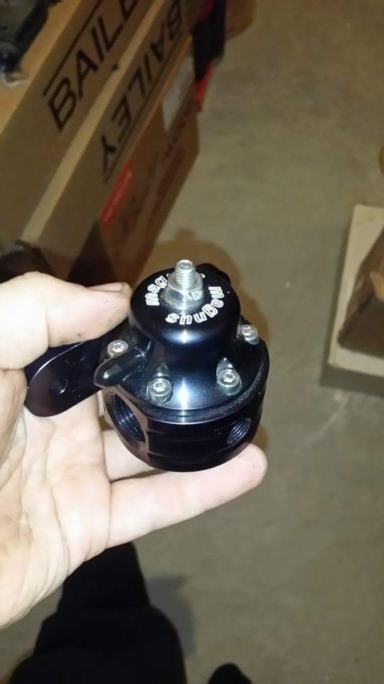

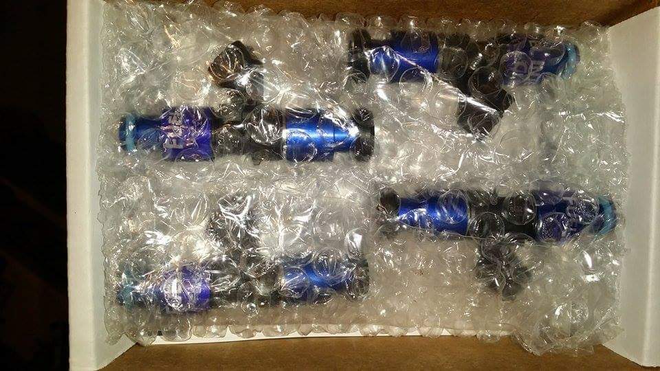

FIC2150CC injectors dual 044 bosch pumps magnus fuel pressure regulator and rail.

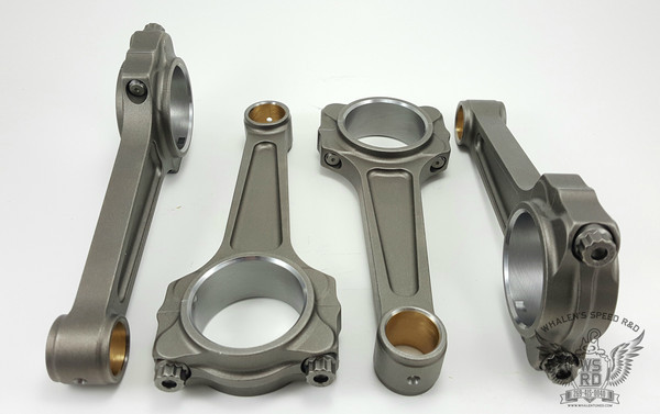

So ive picked up a block will be a fully build 6 bolt haven't decided on a rotating assembly yet.

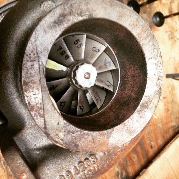

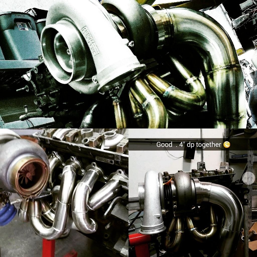

And now best for last ( Hot Parts Kit was made my Sheepeybuilt.com and is supporting a borg warner s472 )

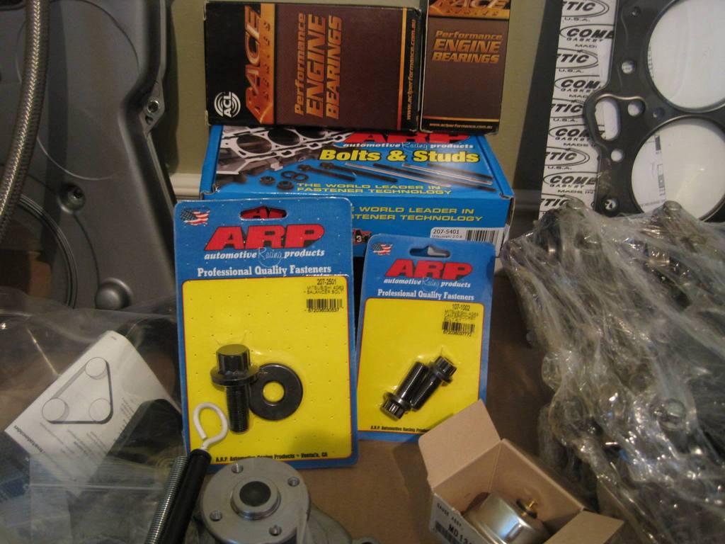

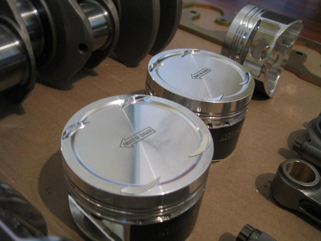

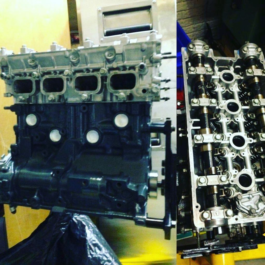

So here is another small update Engine has been put together and a few more parts have come in enjoy the pics !

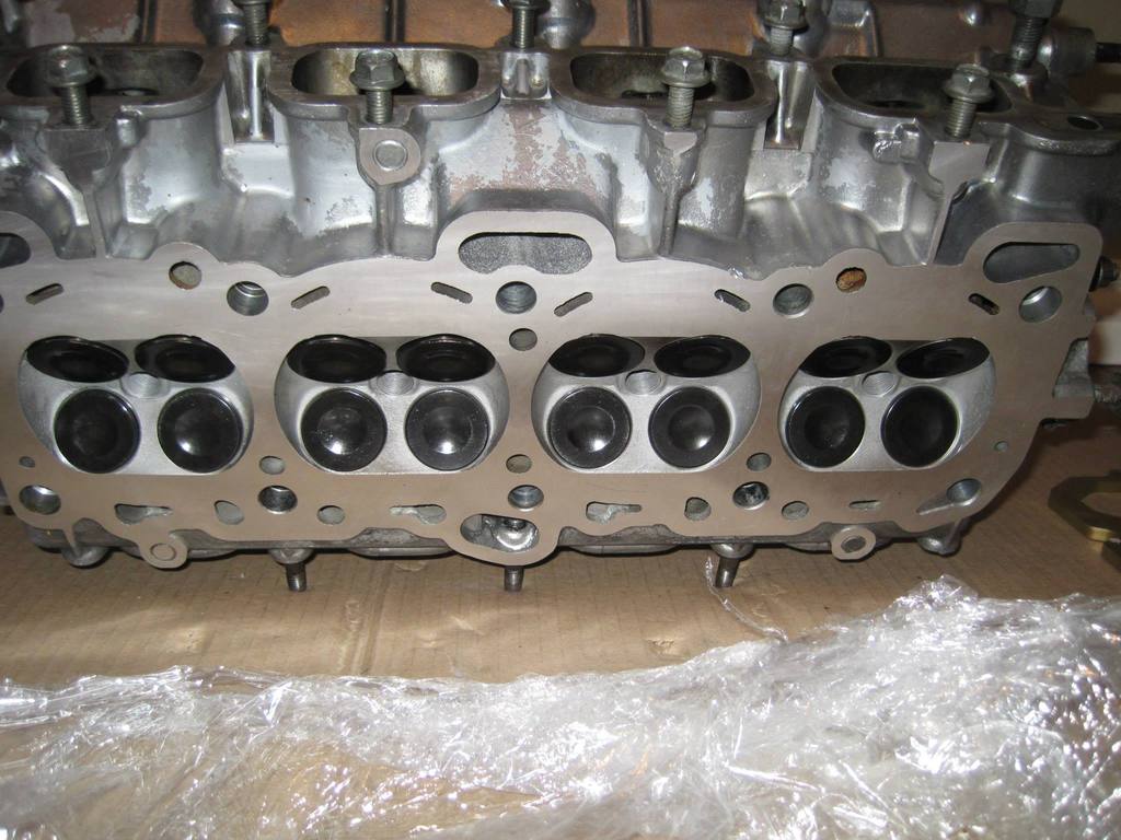

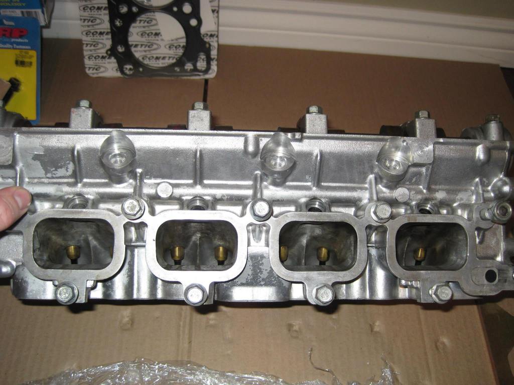

Magnus Stage 3 Head
6 Bolt Block

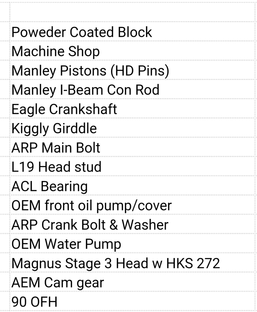

List of whats been done to the motor and parts used
MISC

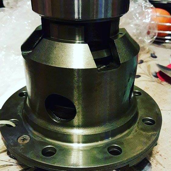

Evo Rear Diff
Hot Parts Kit From Sheepey

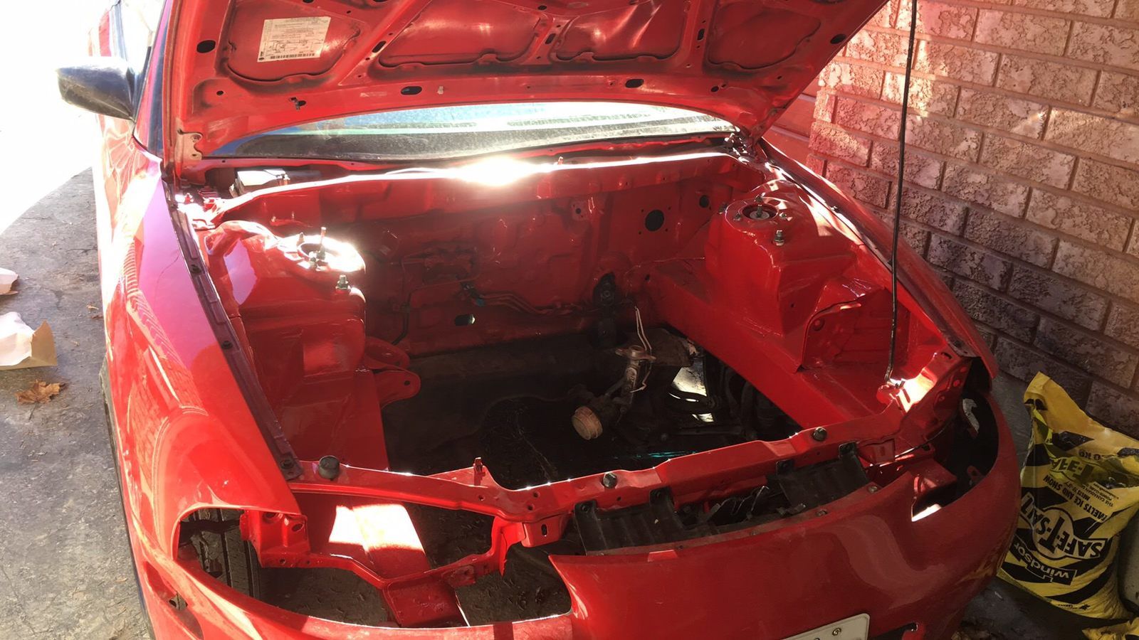

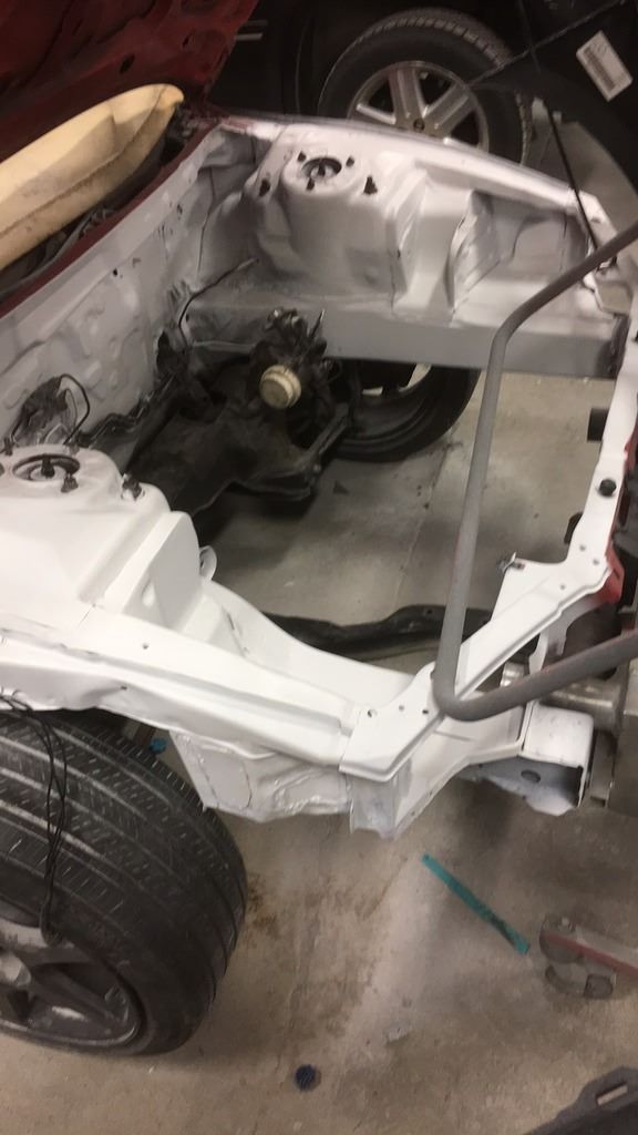

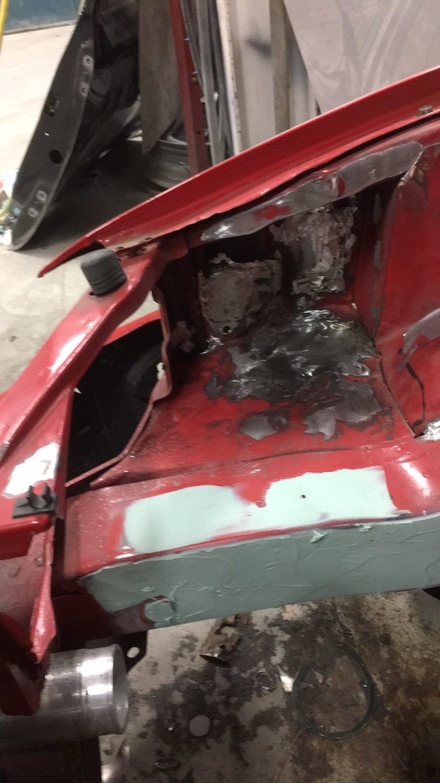

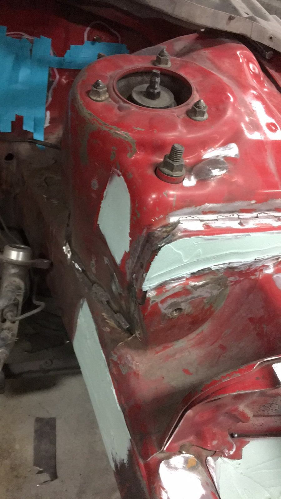

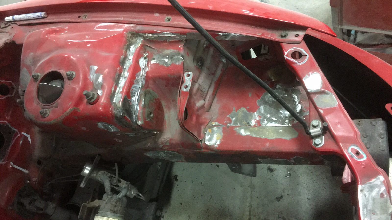

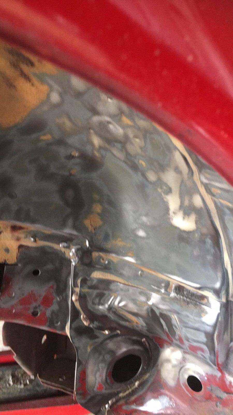

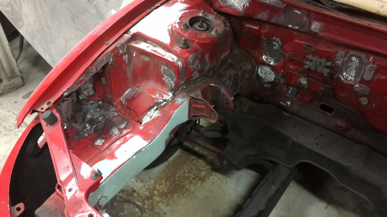

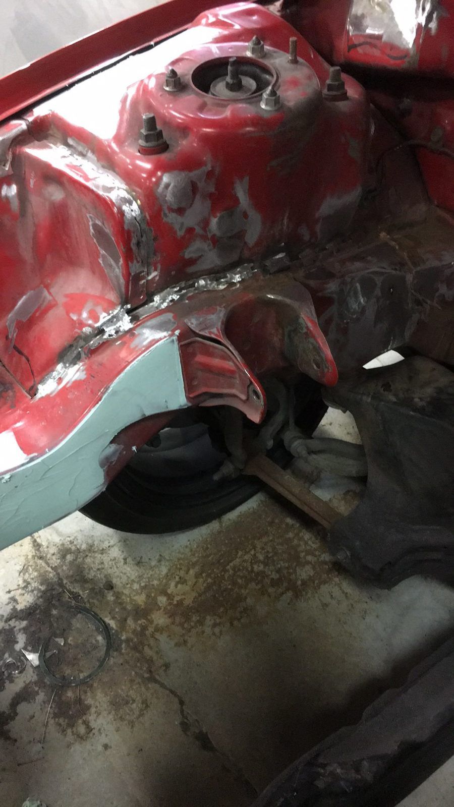

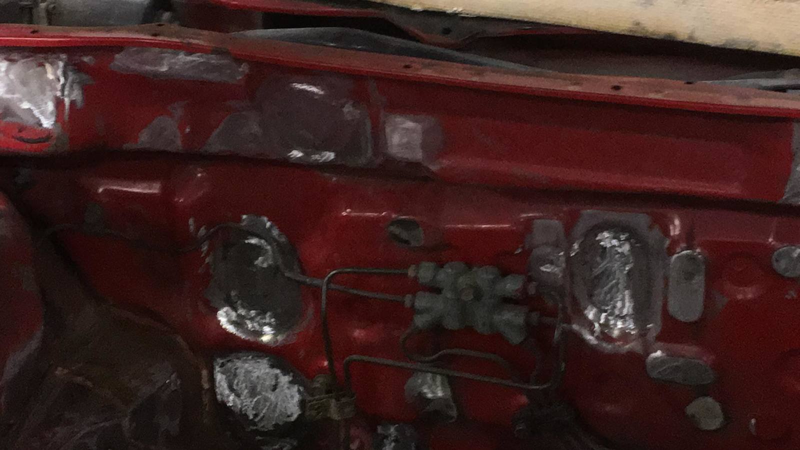

Got a few more parts and sent the car off to the body shop to shave and repaint the bay.
Enjoy !!

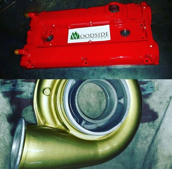

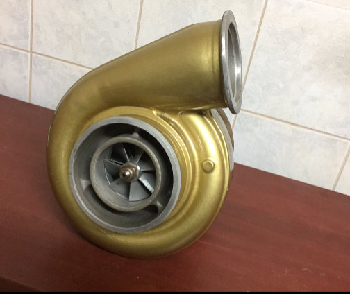

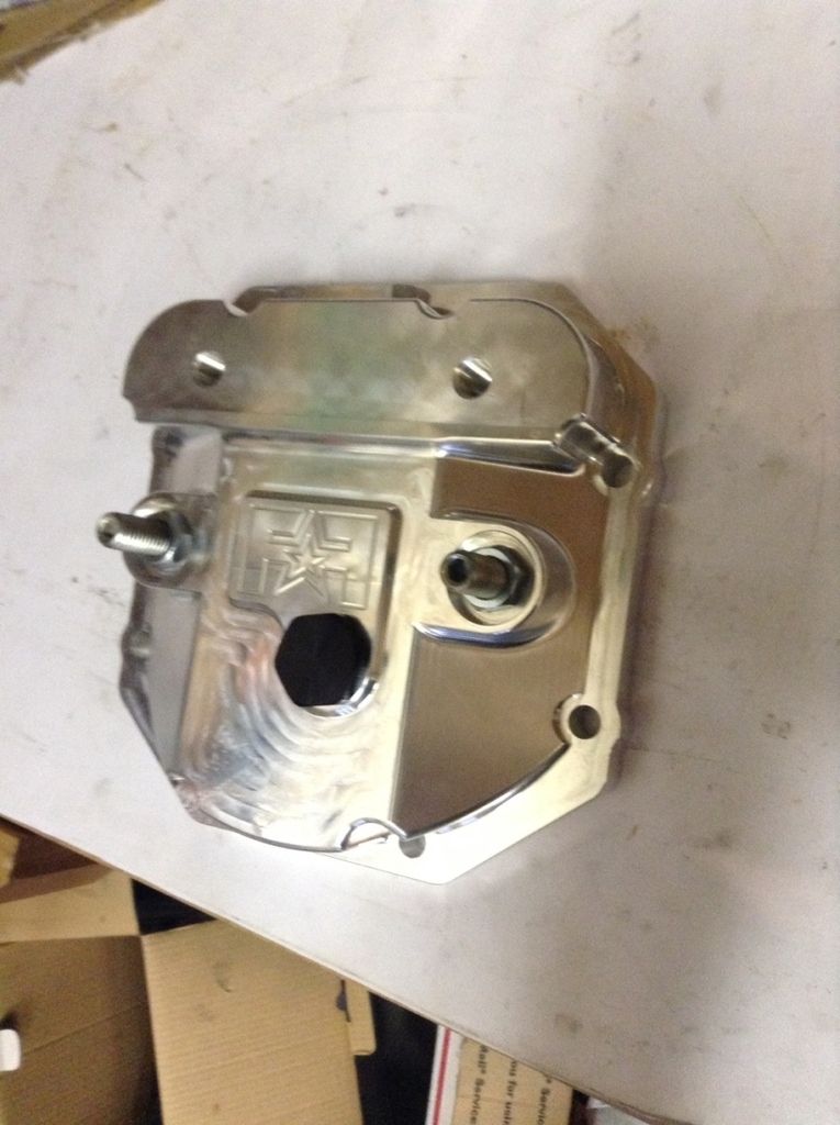

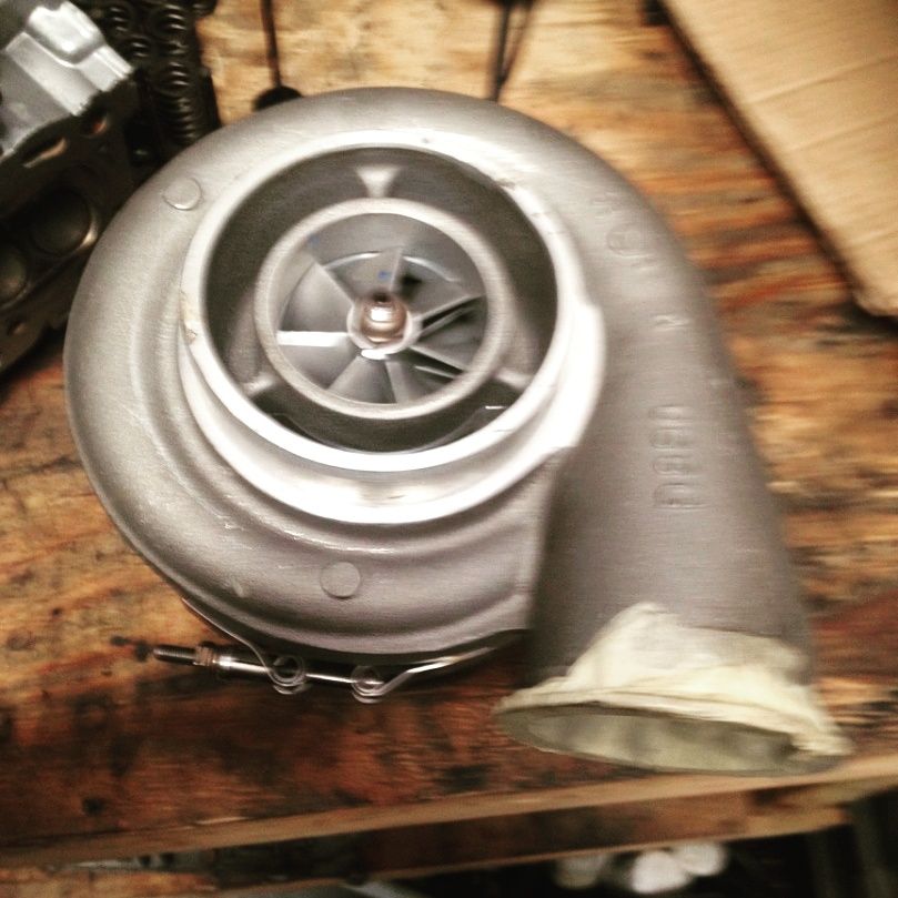

Turbo and Valve cover shaved and coated by our very own Jason Drew

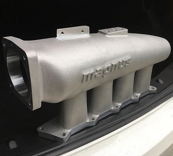

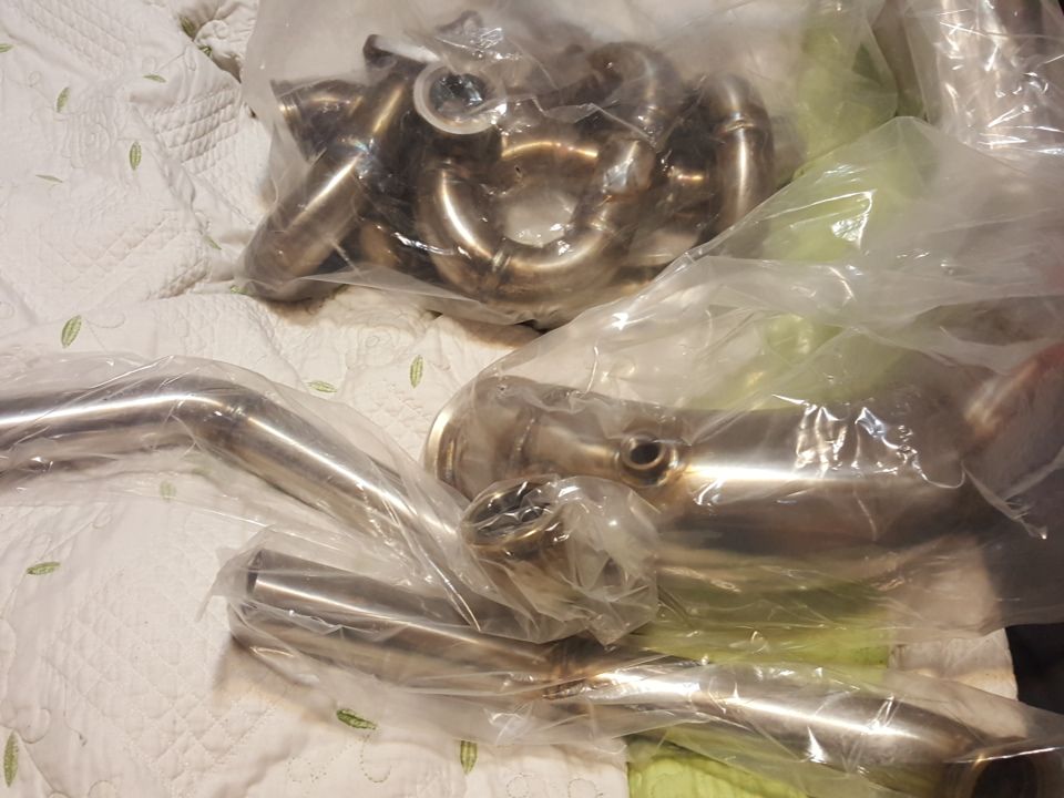

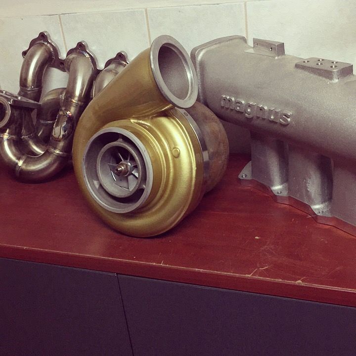

Also picked up a Magnus manifold

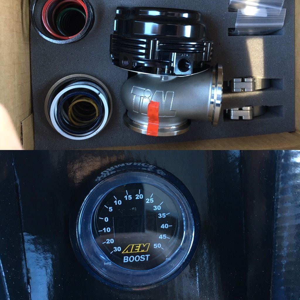

Both wastegates also came in tial 40mm and aem boost gauge.

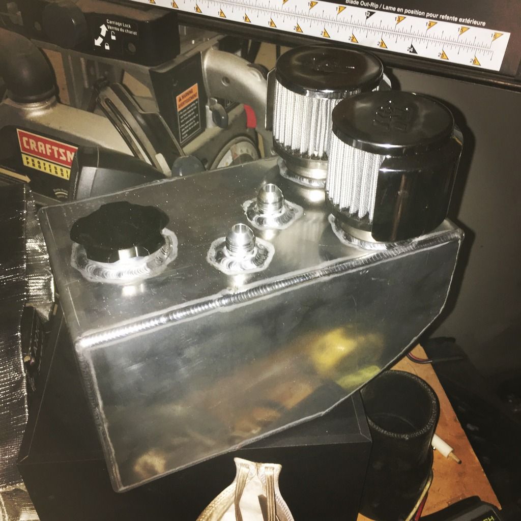

2g catch can and overflow made by a local shop

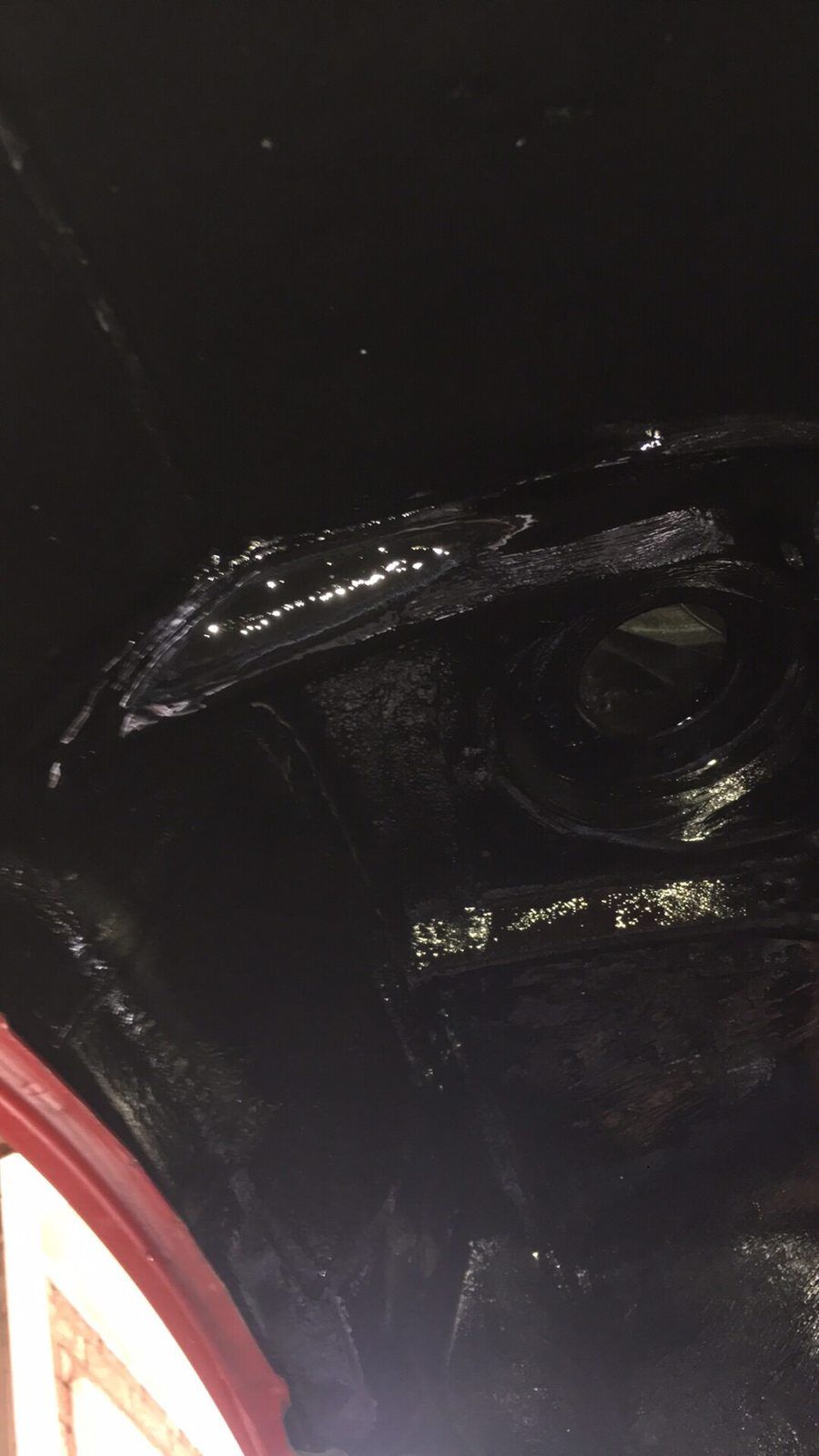

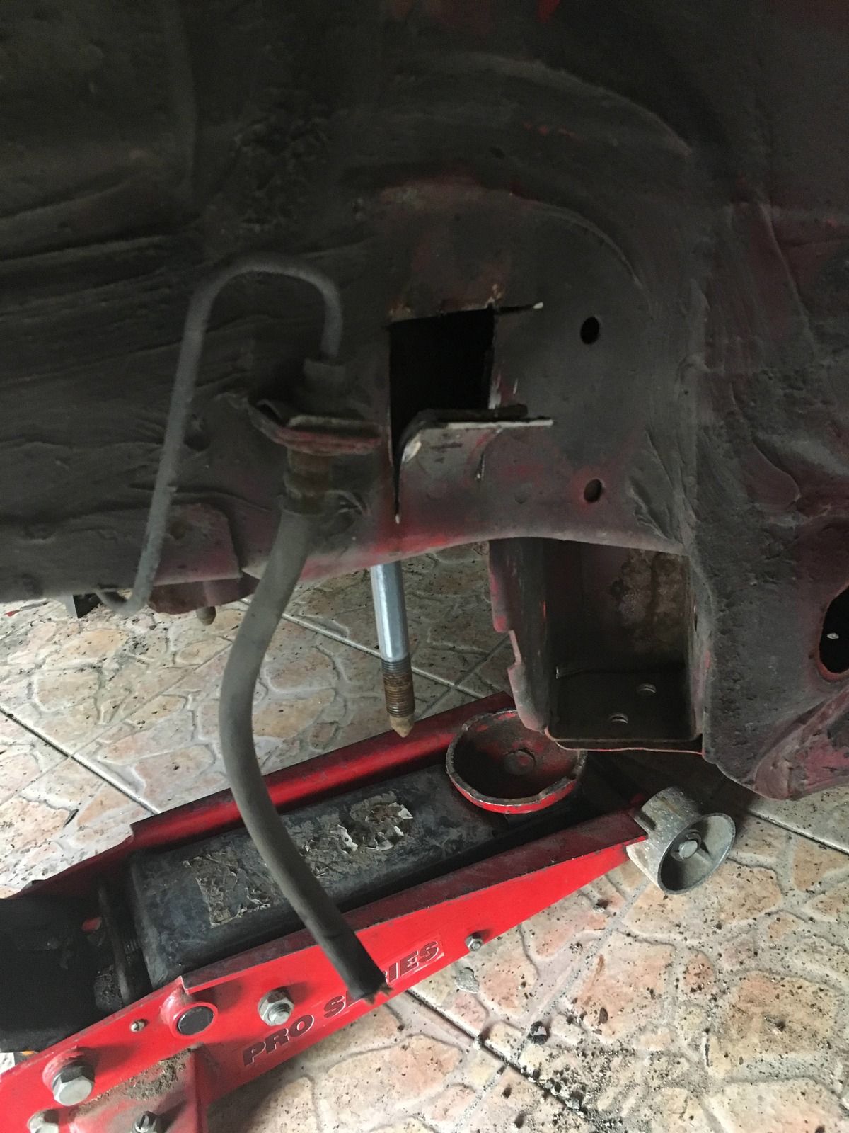

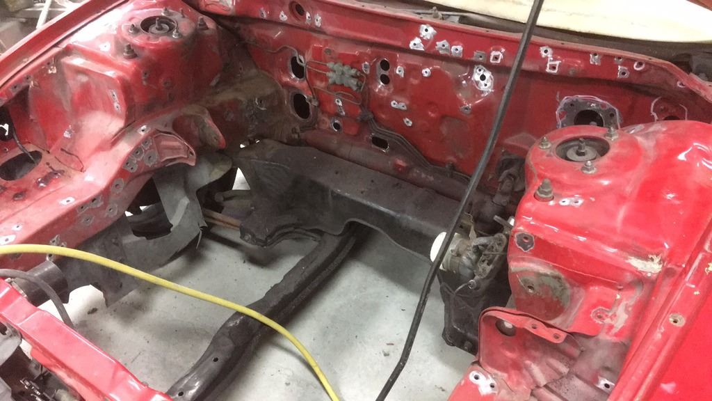

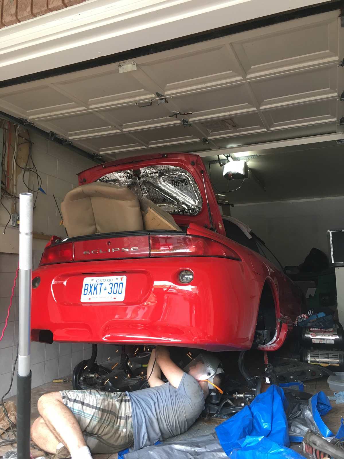

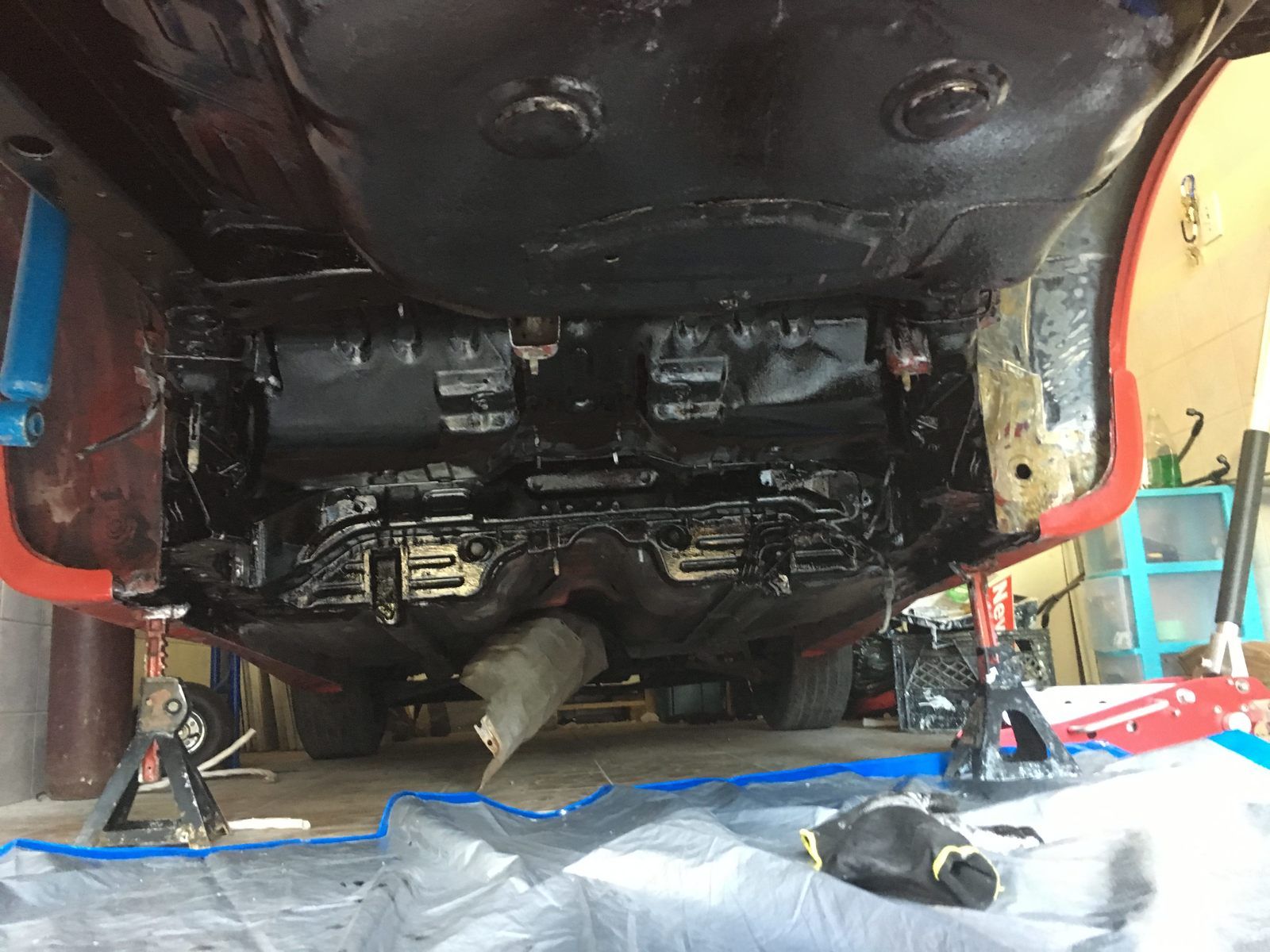

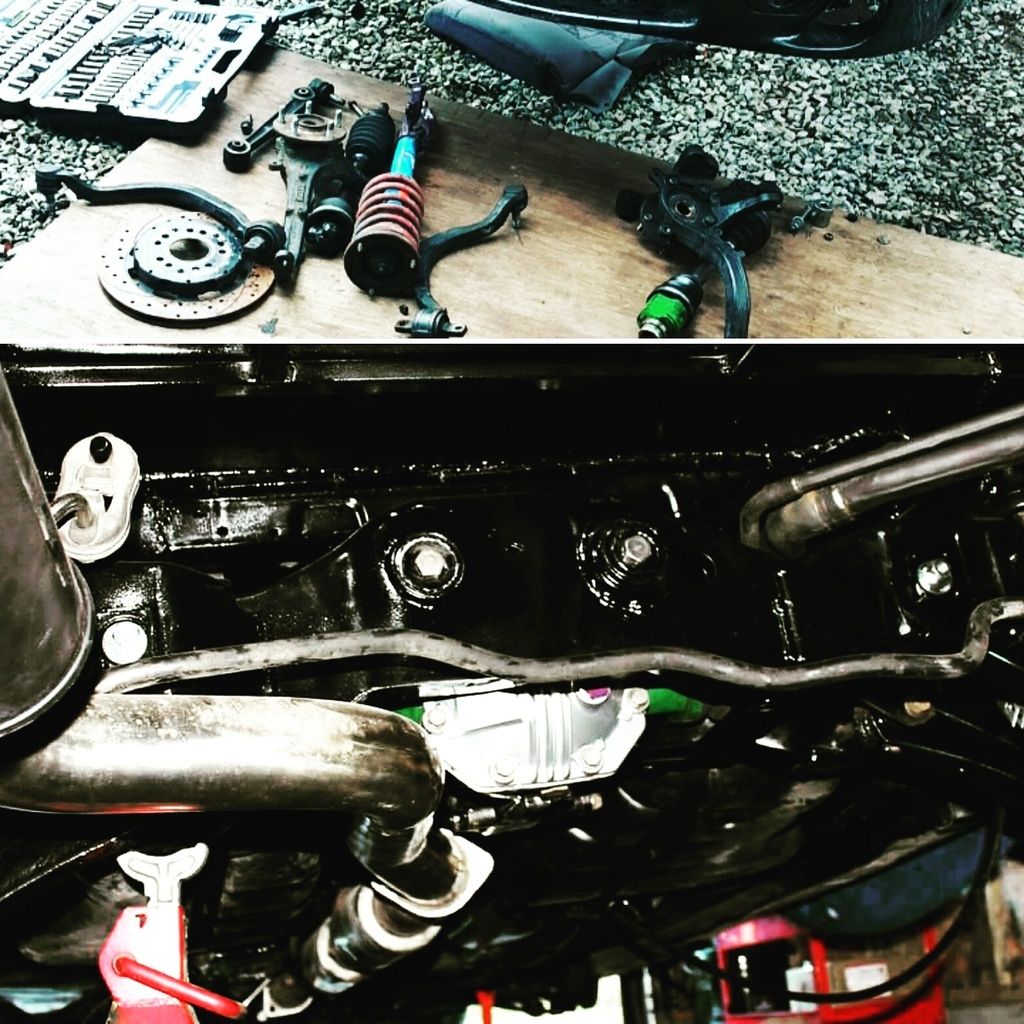

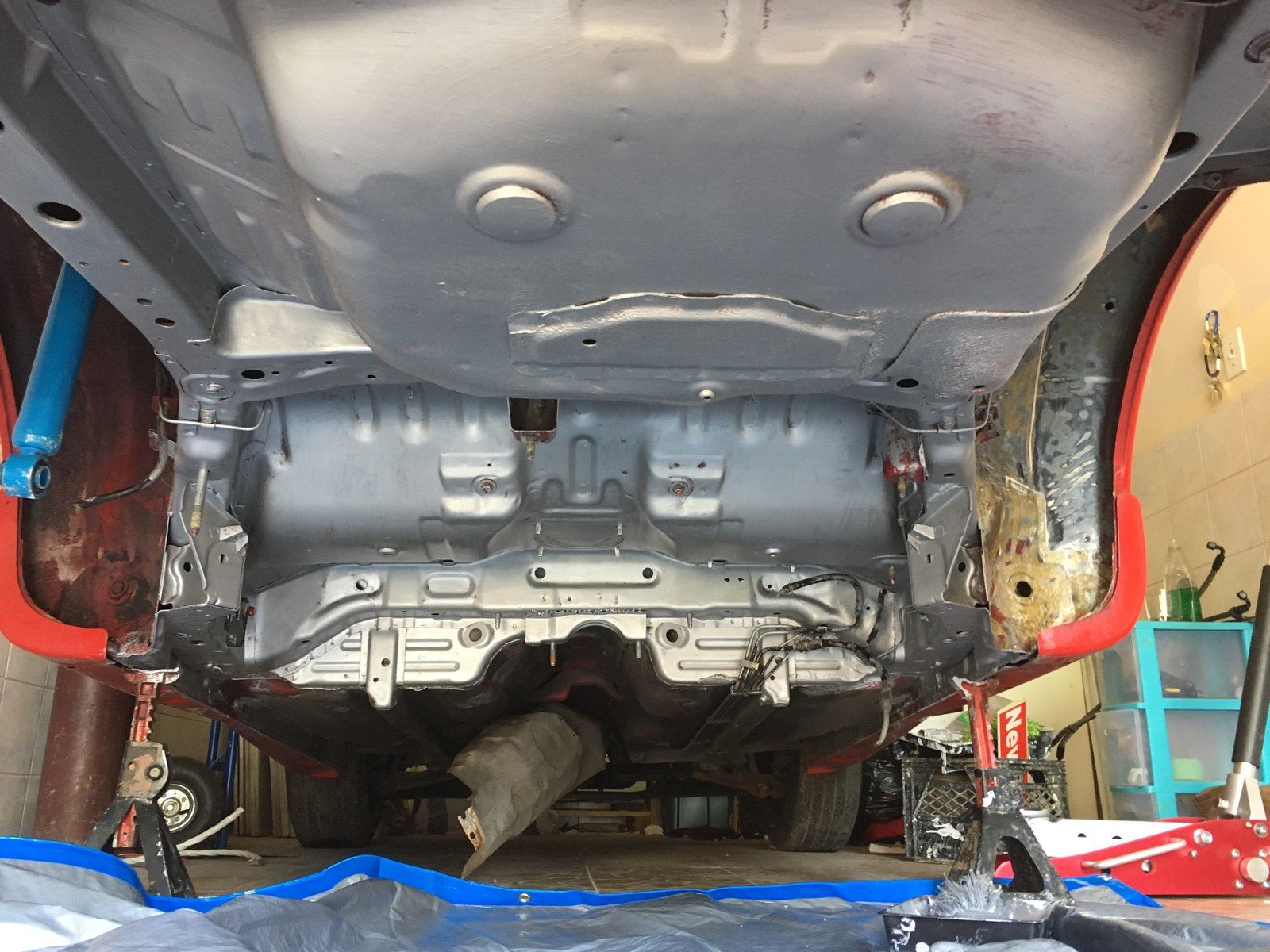

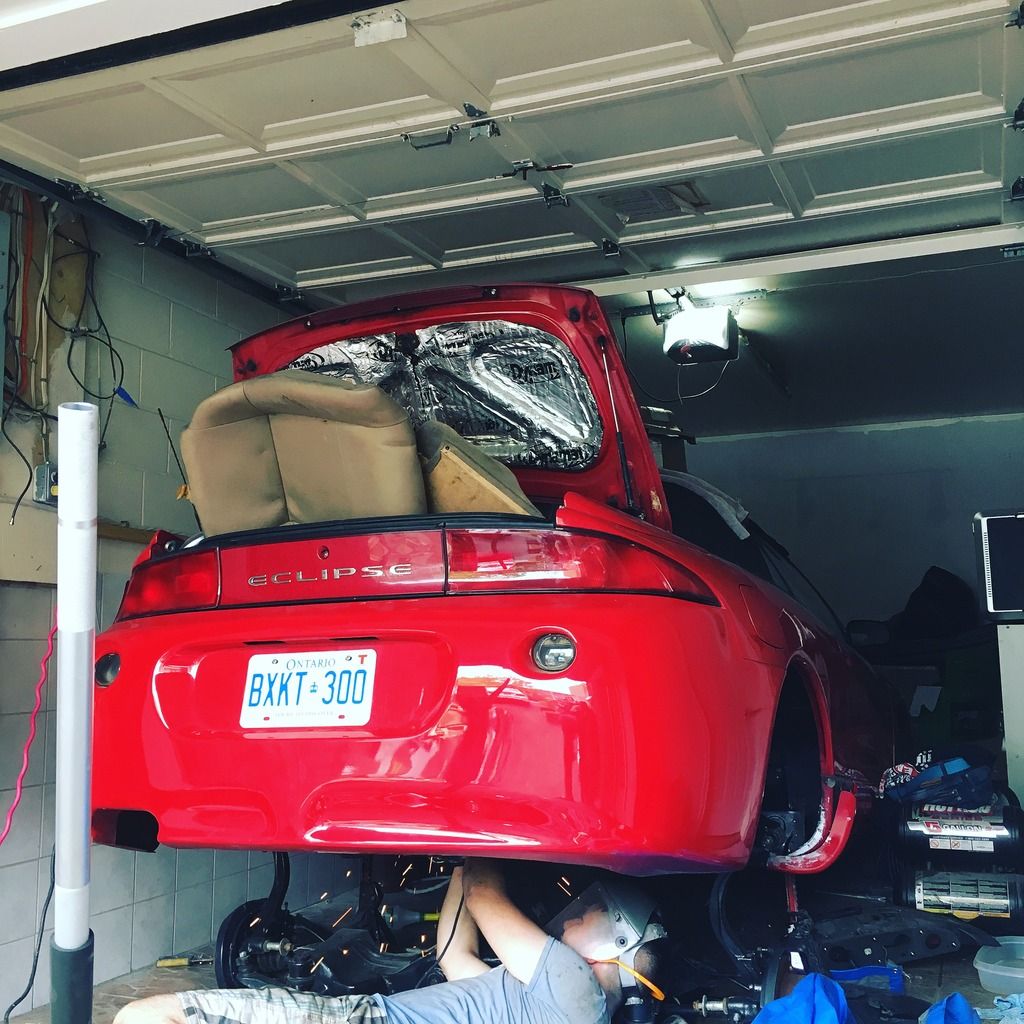

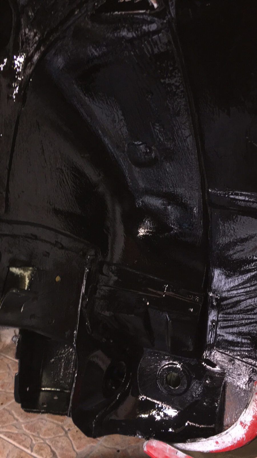

So the Awd swap is completed while i was under there i cleaned it all put and sprayed it with rust bullet. Now starting to assemble long block this weekend and hope to have it in soon doing also a parts haul on Saturday!
Here is a pic of my s472 that drew coated along with the sheepey many and Magnus cast, going Tuesday to pick up the rest of the parts to put this thing together.
