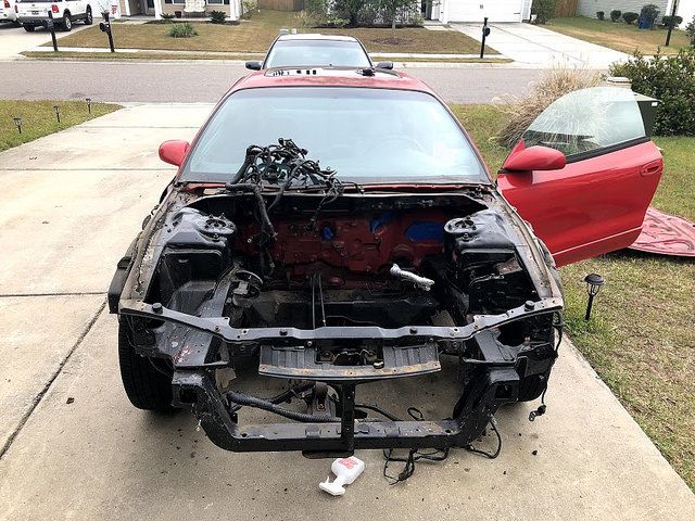

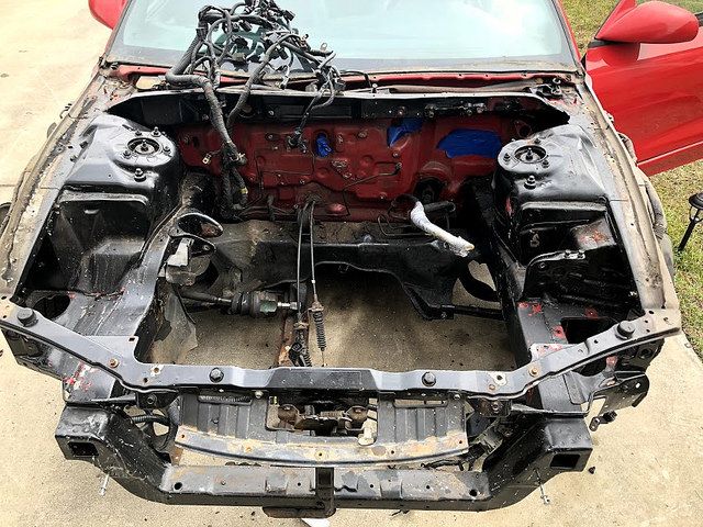

Engine Bay Shave, Paint, Tuck Project (Prep Stage)

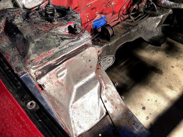

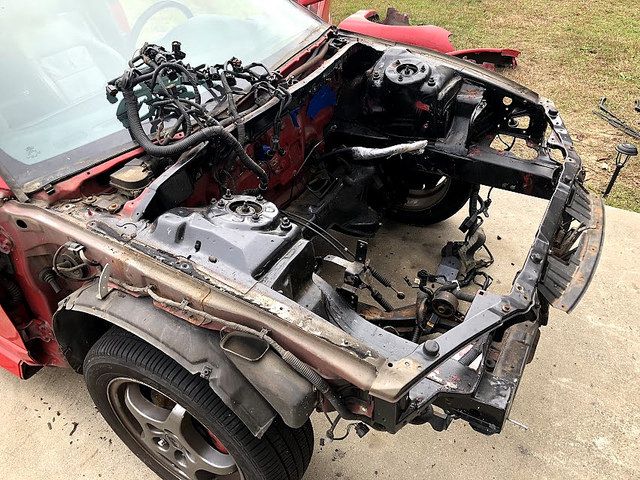

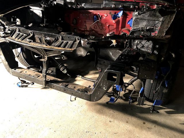

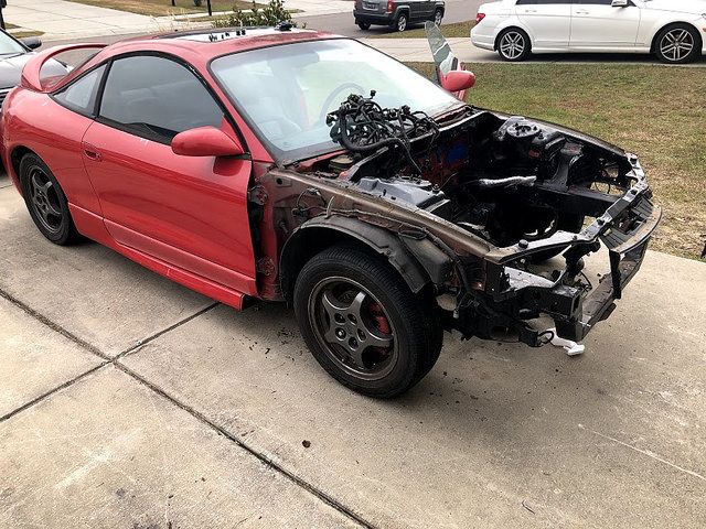

About two weeks ago I started to remove the main engine harness and body harness from the car. I was able to fully remove some other items too.
- Full main engine harness
- Shifter cables
- A/C system
- P/S system
- ABS lines and unit
- All brake lines beside rear lines
- Full body harness
I have decided to hold off on the full interior and dash harness until everything on the outside is complete.
Here are some progress pics:

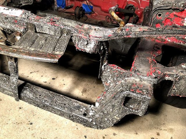

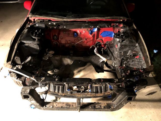

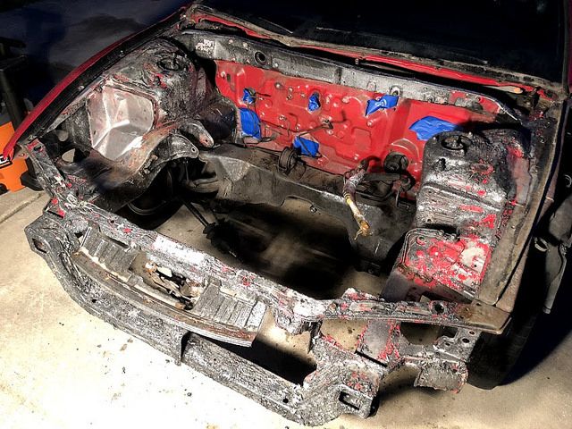

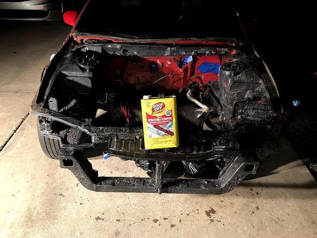

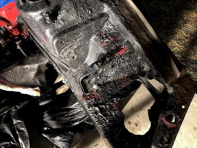

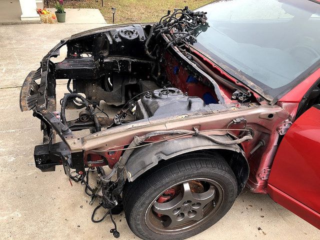

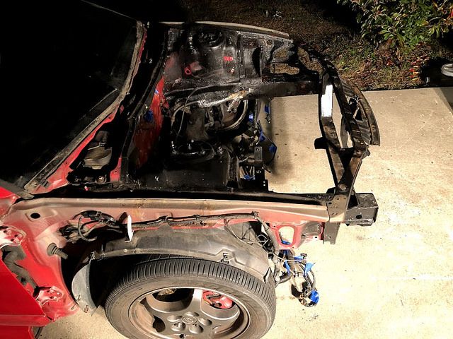

I normally used Jasco Paint Stripper from Lowes, but I saw that Goof Off makes their own version too, but its Sprayable. It even came with its own spray bottle. It made it so much easier to apply with no need for paint brushes or anything else to evenly spread it around.
I eventually removed the full body harness after spraying down the engine bay that day/night. A lot of the sections of the engine bay that are bare metal is purely from the paint stripper and a paper towel. Eventually I went around to some of the hard to reach and thick areas with a plastic and metal scrapper to see how much I could remove.
I currently don't have any current engine bay pics because it has been raining for the past few days and possibly for another couple of days.
I will post more pics once its not rainy and I have some sunlight to take good pictures.

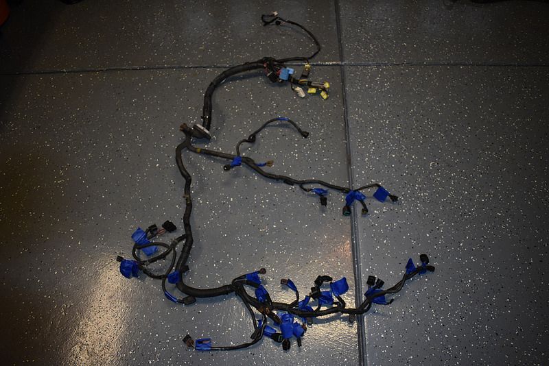

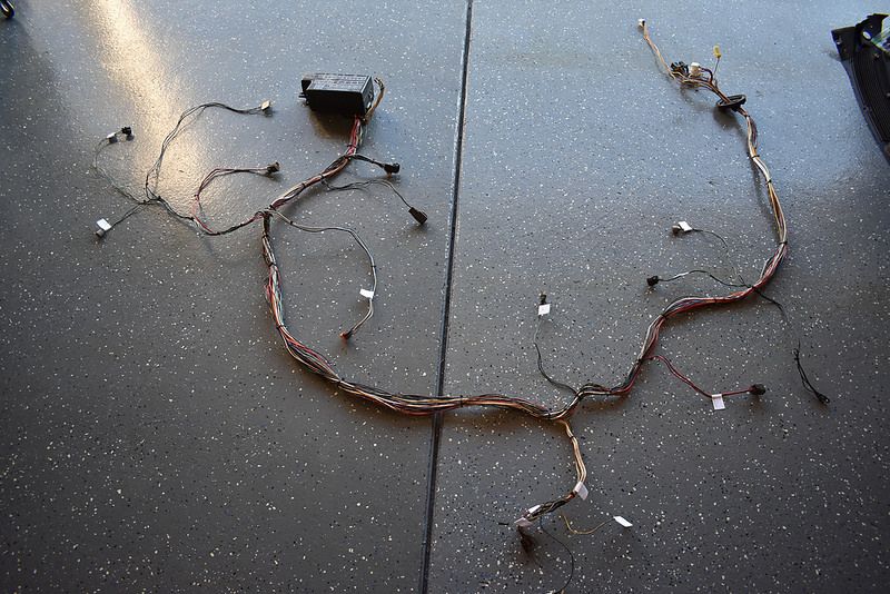

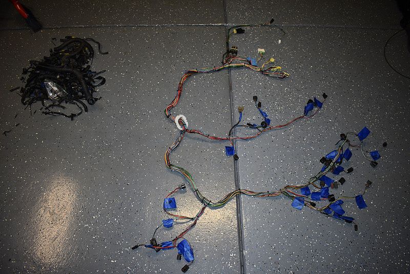

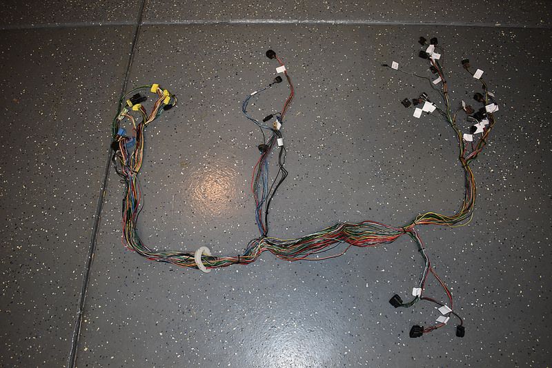

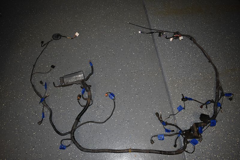

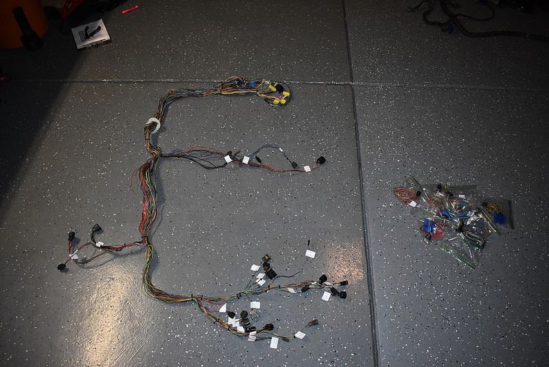

After removing both harnesses from the engine bay, I decided it was time to start one of my favorite parts of making an engine bay clean and organized. I decided to list all of the connectors that I didn't need from both harnesses. Here's a list of some things I've already accomplished with the project.
- De-loomed engine harness
- Inspected all connectors and wires
- Listed all connectors I wanted to remove from both Engine and Body Harness (Shown Below)
- Removed unnecessary connectors from engine harness
- Relabeled harness
- Temporarily reshaped harness
I will now be working on the body harness and following the same steps from the engine harness.
Here are some progress pics of the Engine Harness:

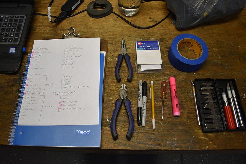

Some of the tools I used:
Connector lists for each harness (Stock list and then removed list):
Before (Engine Harness):
Connectors removed and harness relabeled (Engine Harness):
Before (Body/Chassis Harness):
Connectors removed and harness relabeled (Body/Chassis Harness):
Updated the Engine/Body Harness Project post with better pictures of the connectors I removed.
I have 3 lists:
- Engine Harness Stock Connectors
- Engine Harness Removed Connectors
- Body/Chassis Harness Stock/Removed Connectors
Also posted pics of before and after of the body/chassis harness.
nice start its coming along im going to work on redoing my harness as well agan.
Yes its a slow but steady process. It rained all last week and kept me from working on the engine bay. So I took the time to nearly finish up the harnesses.
The next step is extending all of the wires coming from the fuse box. Once I get that done I'll be ready to rearrange both harnesses for a more efficient route and re-sleeve them.
