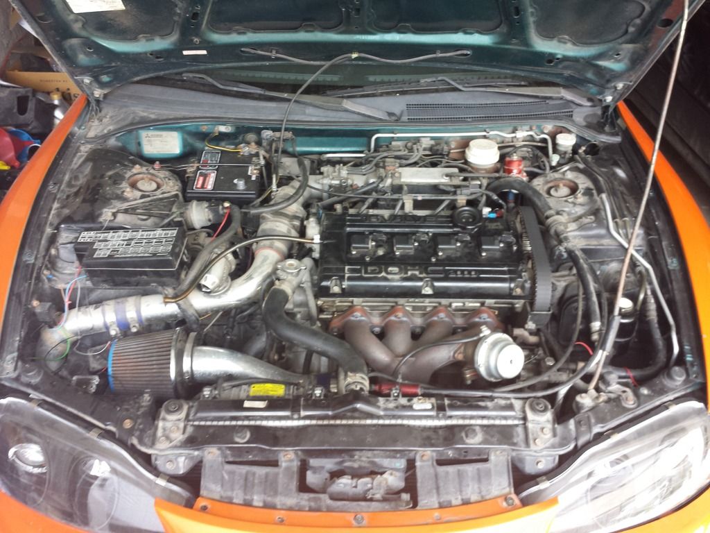

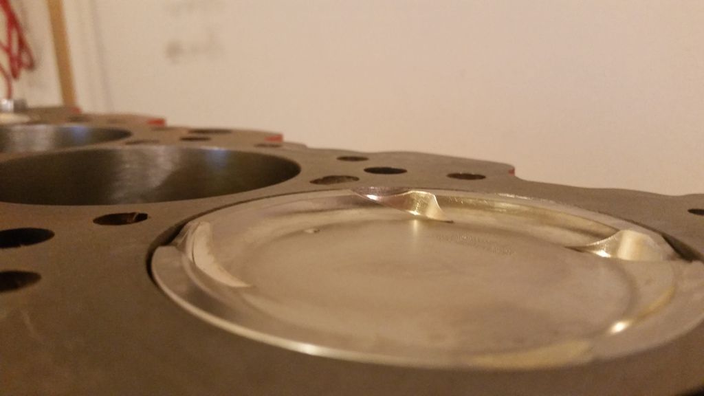

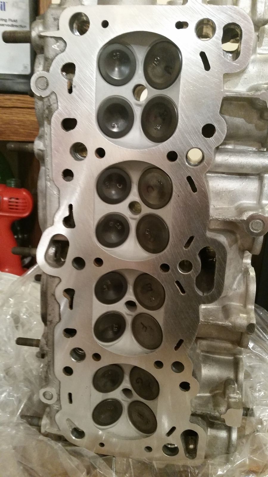

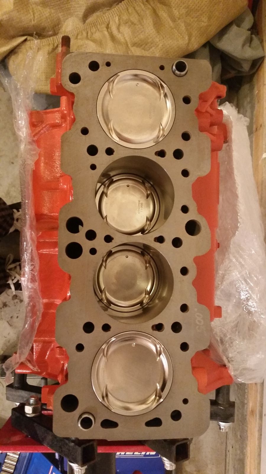

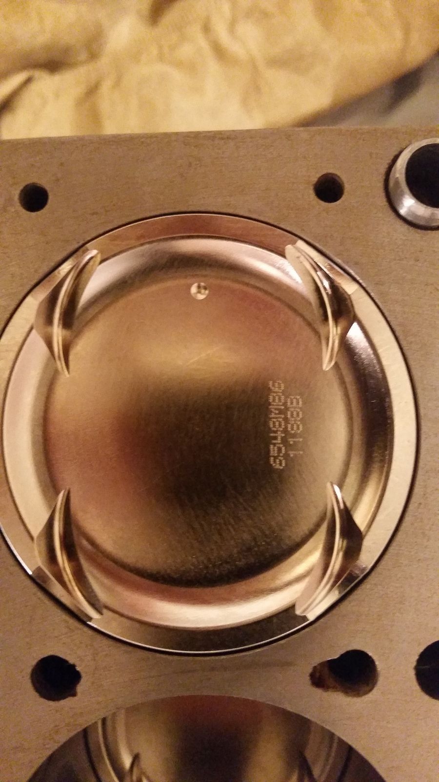

Bought this car back in summer of 2012, didn't know a thing about DSMs at the time. This was my first turbo car, my first AWD vehicle as well. It came with a built block (stock crank, eagle rods, weisco pistons) and a rebuilt oem head (all stock) as well as a godspeed ebay turbo kit. It was nice looking on the outside and it was running and driving, boosting hard. After a couple hiccups, (snapped belts, intercooler piping coming apart, finally rod bearings) I decided to re-do the whole car. Some pictures of when I got her:
20130717_154828_zpsedst32l5.jpg 20130717_154623_zpsngd6neav.jpg 20140411_130728_zpskty5ldqb.jpg 20130717_154513_zps6l6w16zd.jpg
Previous owner gave me this sheet of mods done to the car, no receipts, and upon tearing down the whole car....dude was actually telling the truth. Too bad all the bearings on the crank got roasted (found mitsu bolts on the aftermarket rod caps, think they were reused and all the bearings just got hammered on)
Main reason I believed the guy is because of how fast this car was at the time. HOLY SH!T was it fast. Like, chirp the tires going into 2nd fast. Can't reach the dashboard fast. I was blown away.

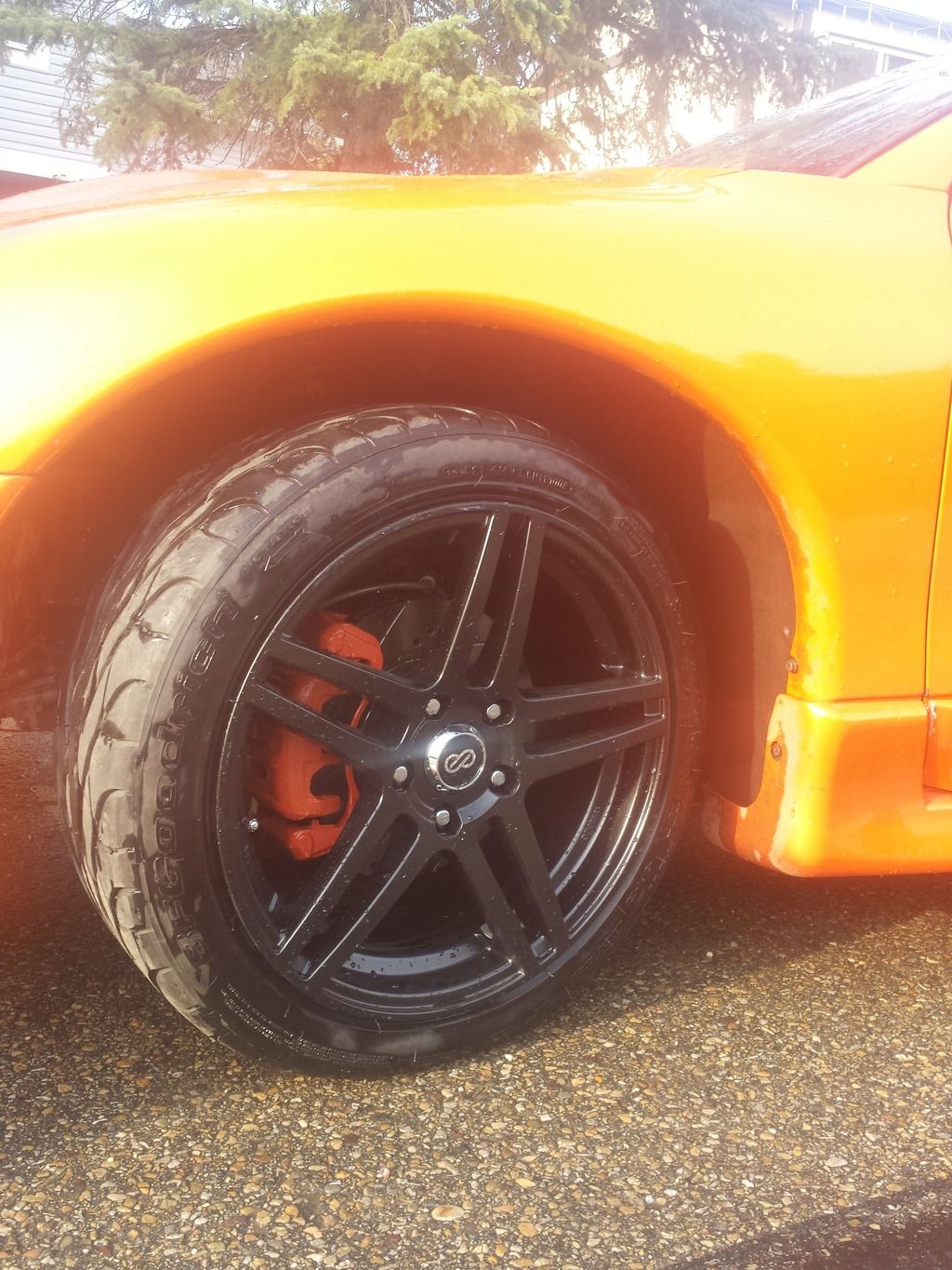

Then I bought these rims for it, Enkei RSF5 17x7.5 +40

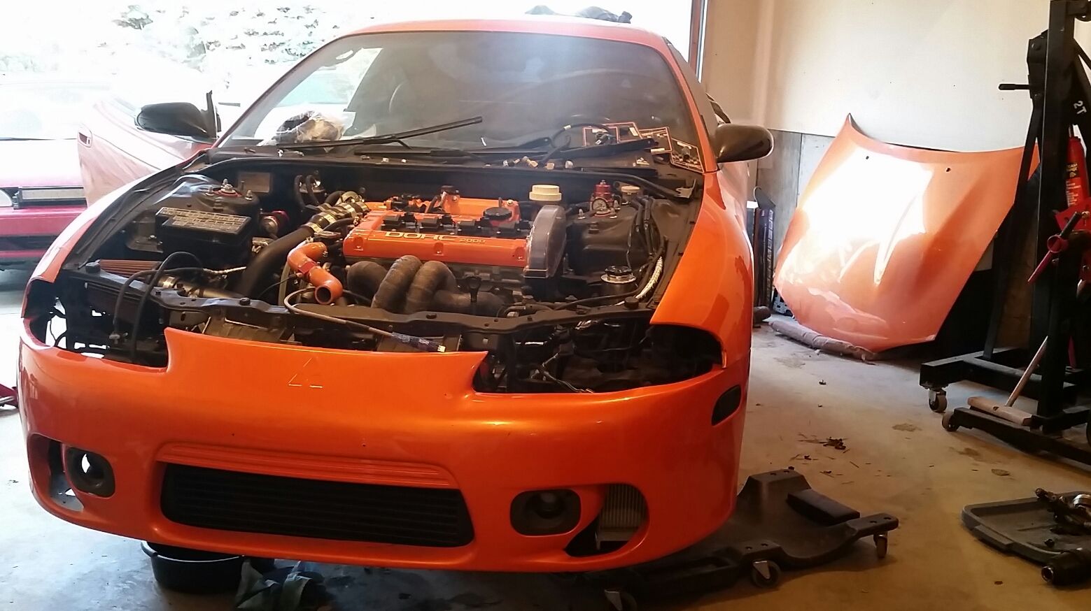

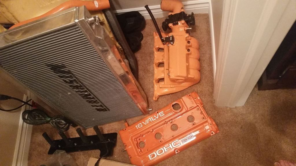

Only when I first had the rims, my brakes were all grimy and dirty and my stock shocks were worn and looked like crap. It just didn't look right to have a nice rim over top of all those old ugly parts. So I redid the brakes, got new rotors and ss lines, painted them orange, etc....then came the coilovers.....then the new control arms/ball joints.....and it kind of took off from there. Before I knew it, almost the entire car was taken apart. I'm just finally now starting to get it all back together after a fiasco I had with a shop(long story).

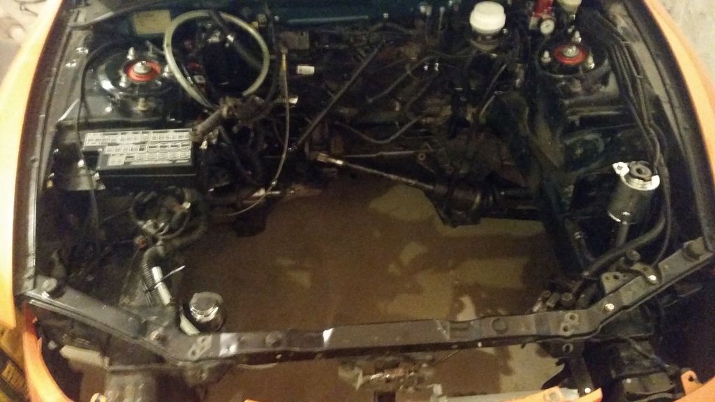

So here we are, this is what I have to work with:

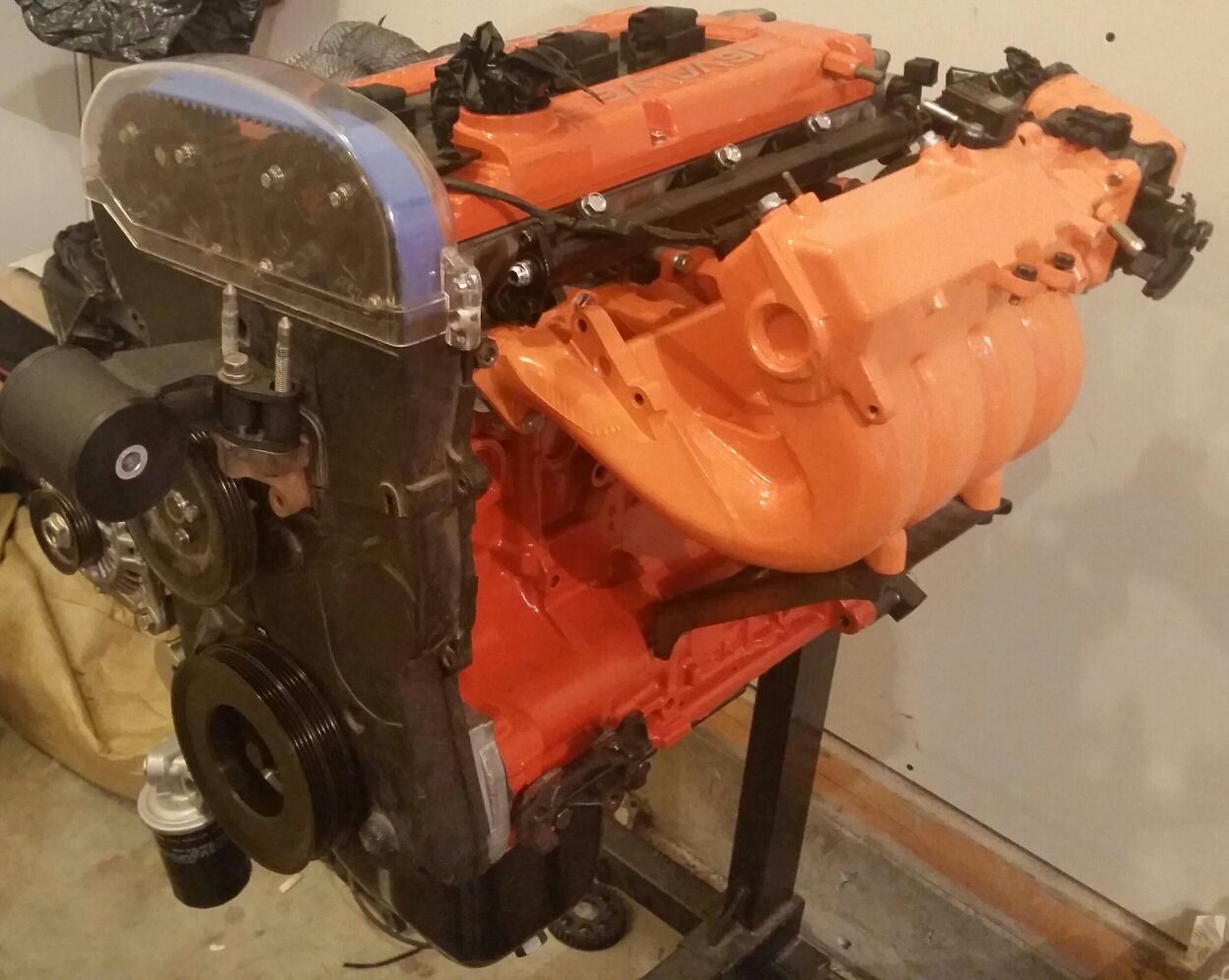

20150706_130045_zps6vg9riia.jpg 20150706_125852_zpszj2li7n4.jpg 20150706_130127_zpsszdetsnc.jpg 20150706_130205_zps54yxjyvv.jpg 20150706_130239_zpsupueytv5.jpg 20150706_130406_zpswffqepdl.jpg
20150706_130055_zpsk8fcque1.jpg 20150706_131118_zpsltudot68.jpg 20150706_131140_zpslaan1gfh.jpg 20150706_132141_zpsihmlcqml.jpg 20150707_173316_zpstugqir4f.jpg 11539027_879669495437885_4946129875543115941_o_zpsf3ca0pp2.jpg 885585_879669882104513_8587612916095134928_o_zpspfsthdgh.jpg 20009_879669325437902_6247963738023996494_n_zpszssj19xd.jpg20150707_231707_zpsxdsl04ys.jpg 20150707_231843_zpsn9eb8zef.jpg 20150707_231822_zps1up2ktxn.jpg 20150707_231804_zps3w5xqvwj.jpg 20150707_231916_zpseqokw6xe.jpg

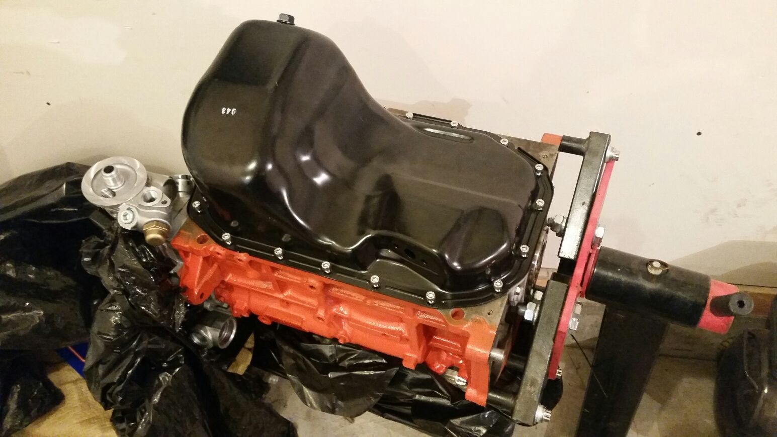

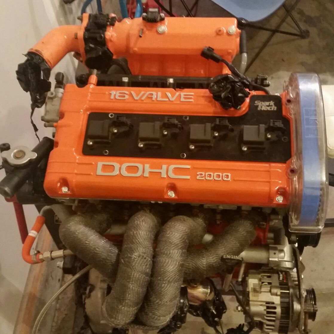

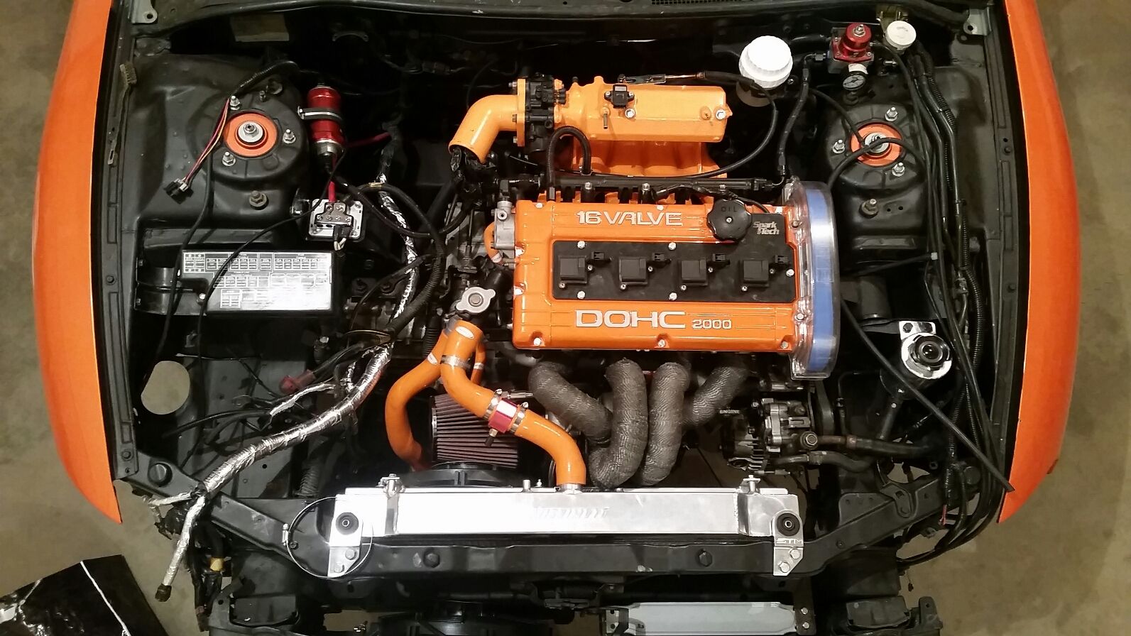

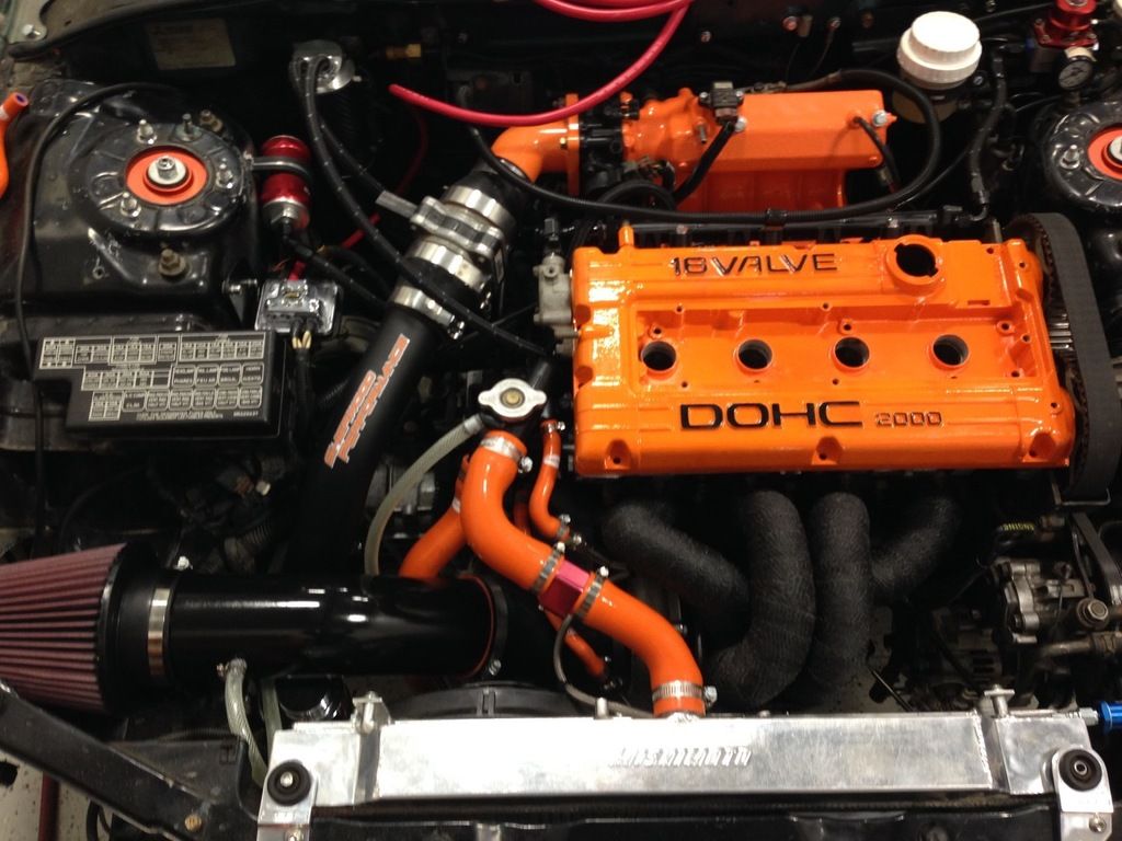

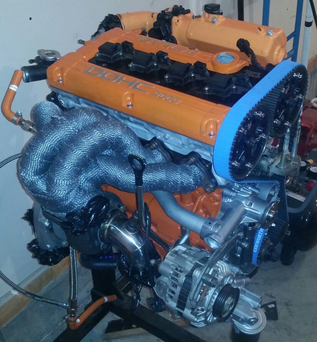

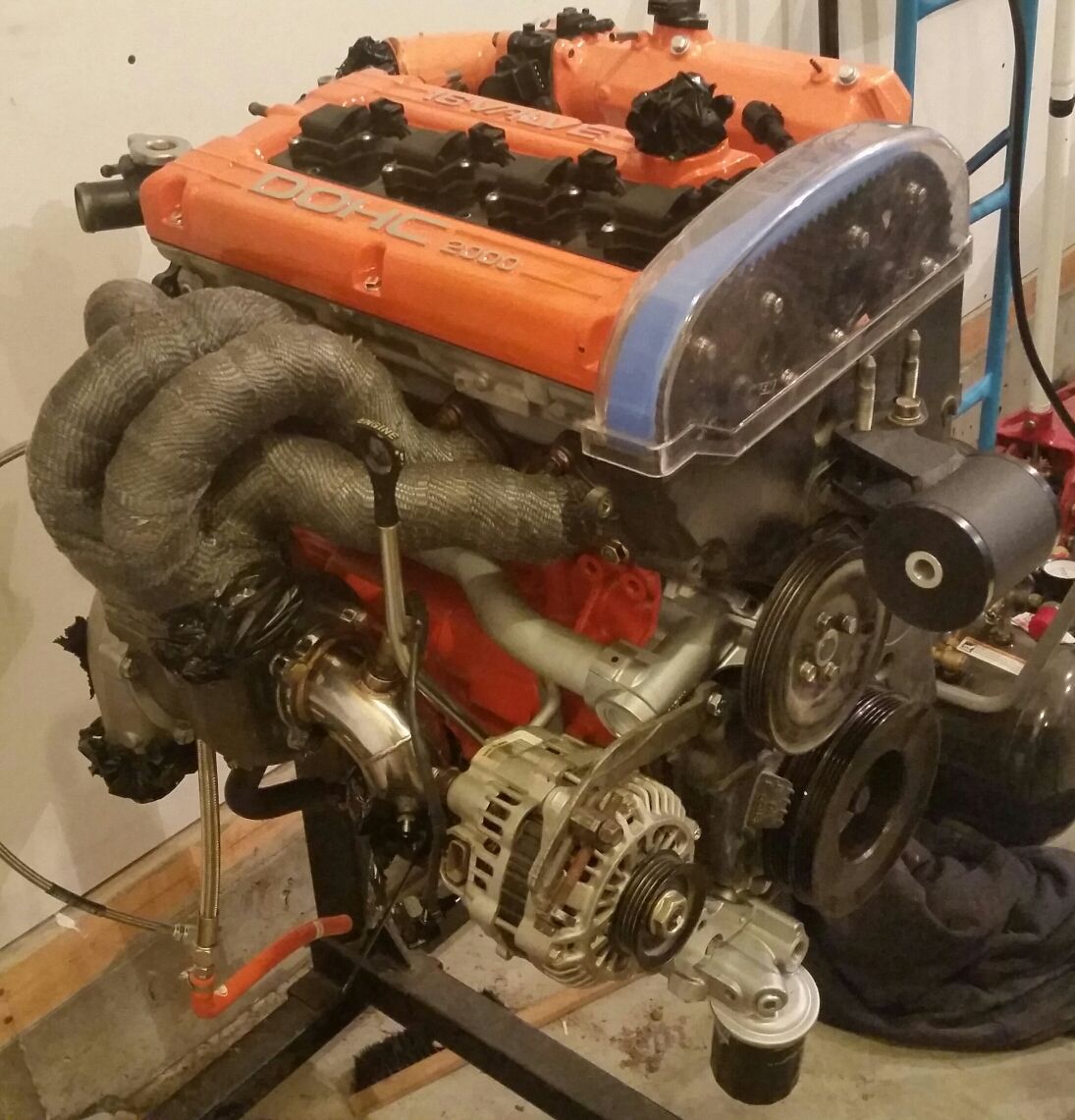

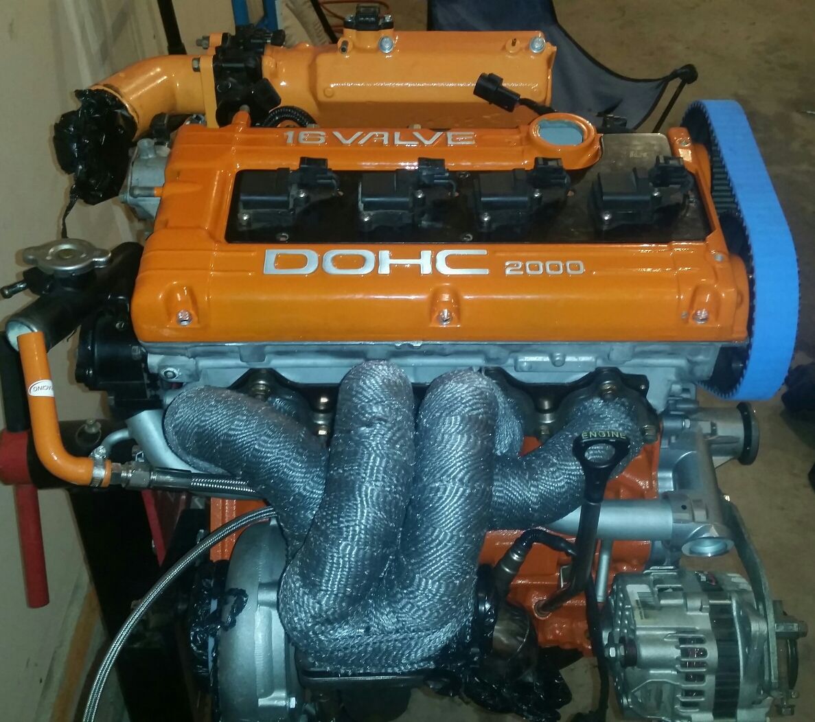

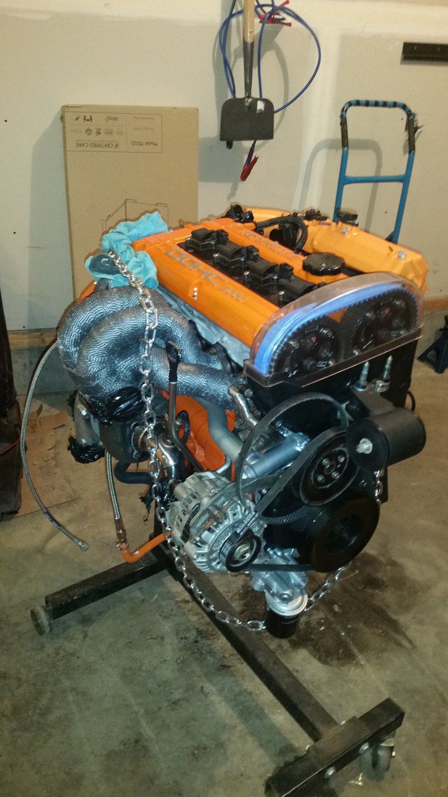

It kinda sucks to see the engine bay so bare. This is what it looked like right before I got bad news about my bearings, and what I intend to bring the car back to:

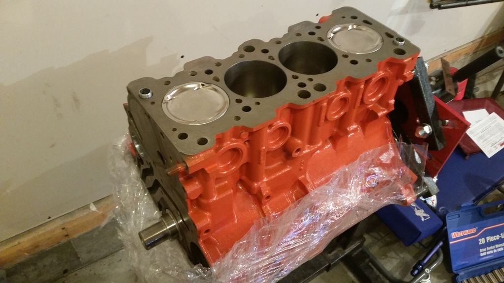

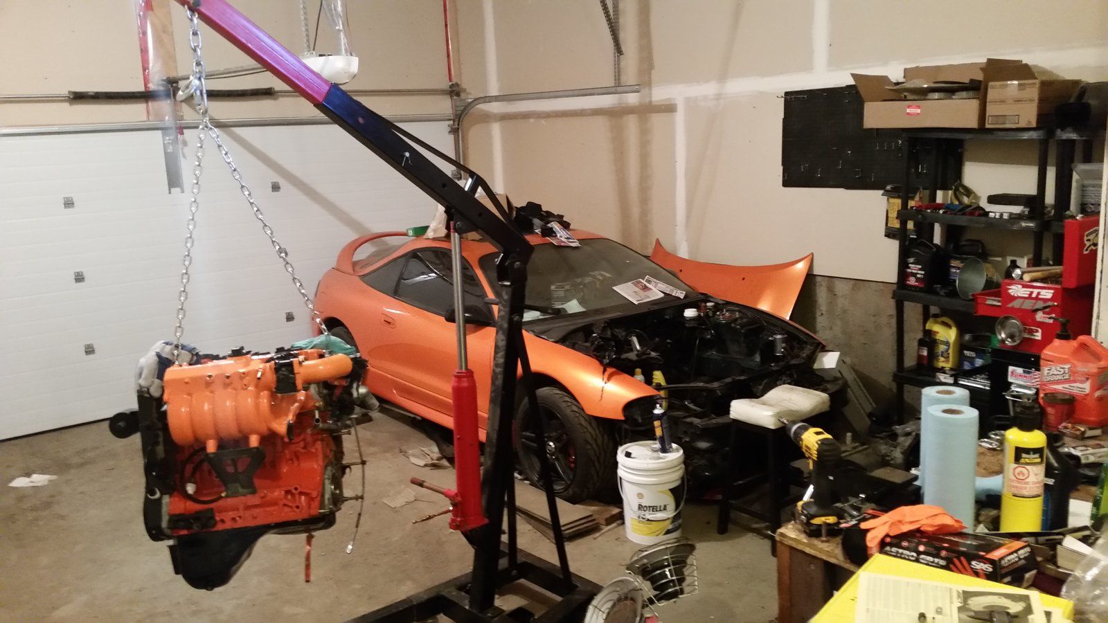

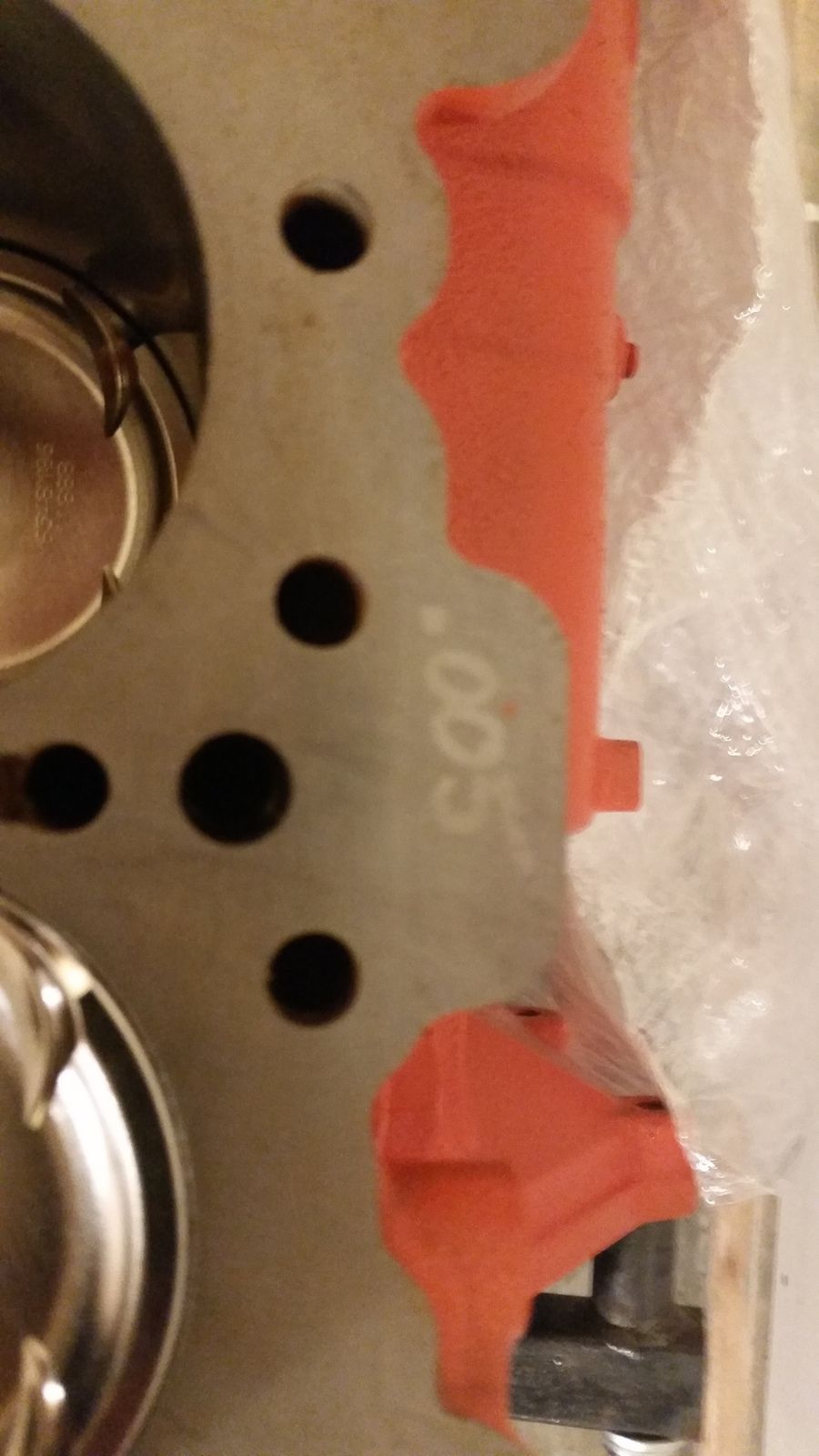

Too bad I got the car back in pieces, ah well. Want somethin done right, gotta do it yourself. Oh yeah, this is my first build(go easy on me!) only the machine shop assembled my block and valve train for me, so a lot of hard stuff is out of the way :D

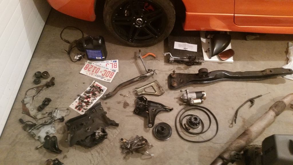

All of this stuff was left in the hatch loose, I get to make sense of the bolts and whatnot. Should be fun!

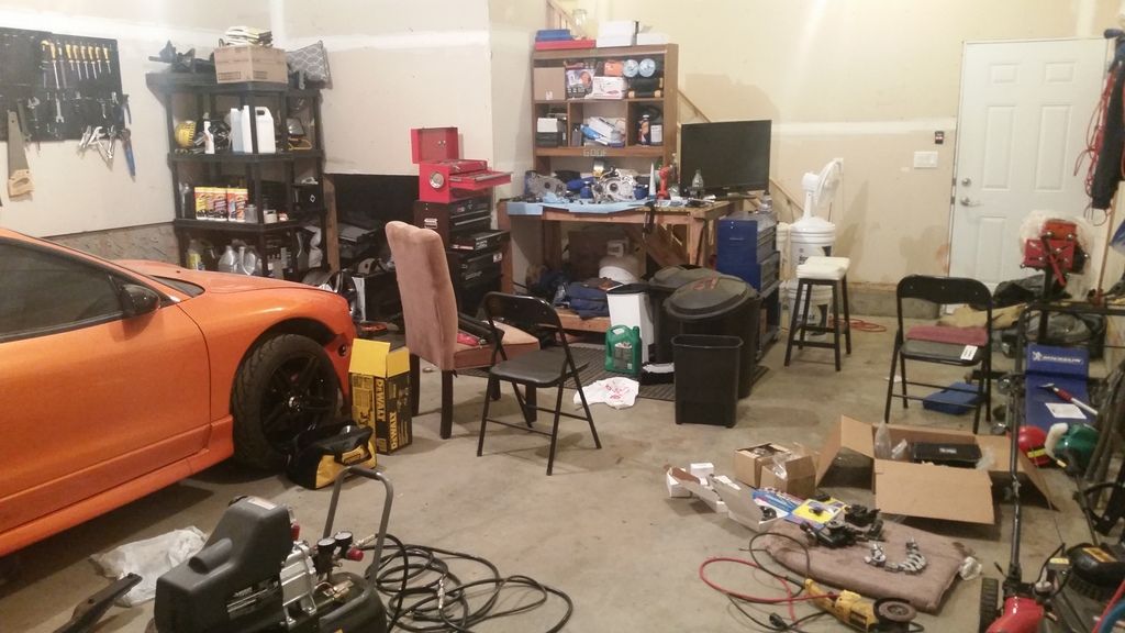

My messy-clean work space I get to do everything in. It's organised trust me.

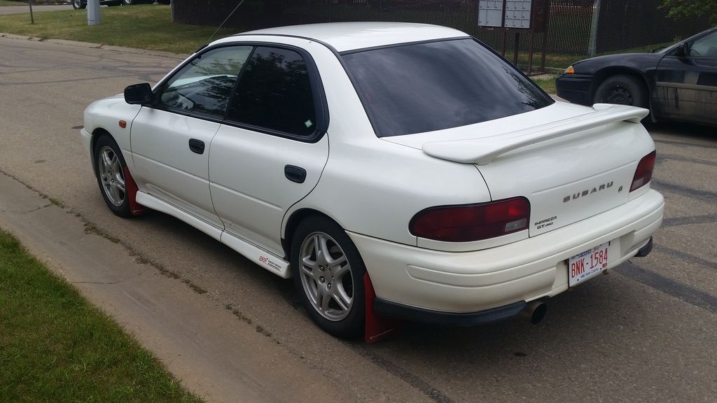

And this is my current daily driver/parts getter. Without her this project wouldn't be possible. It is a European market 1996 Subaru Impreza GT AWD. Pretty rare car to have in North America, she's left hand drive :hellyeah:Profile

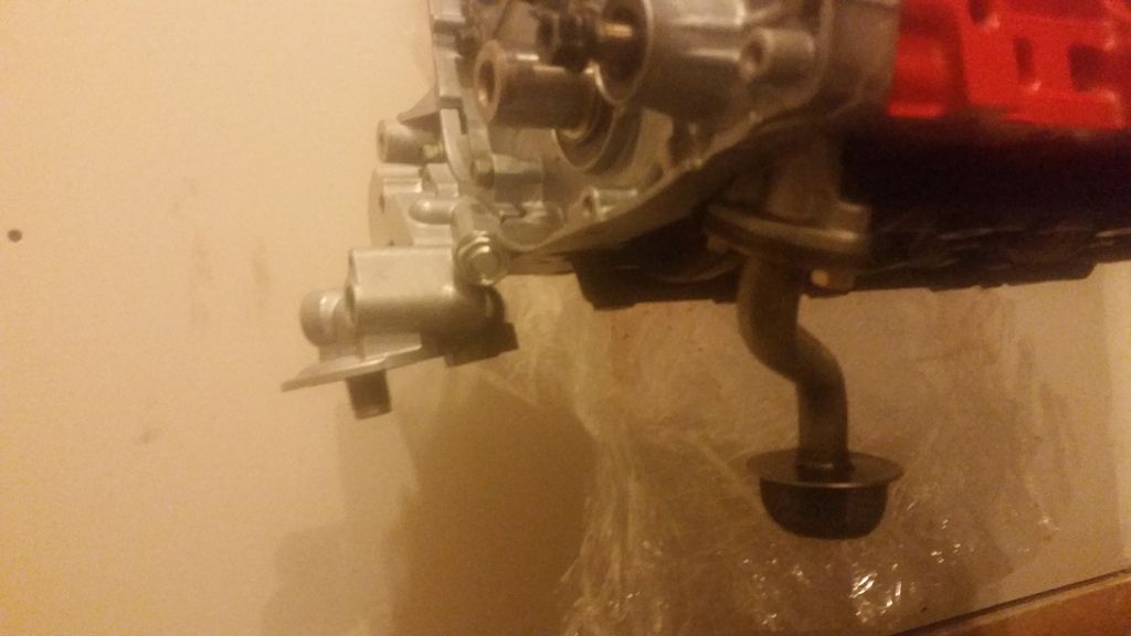

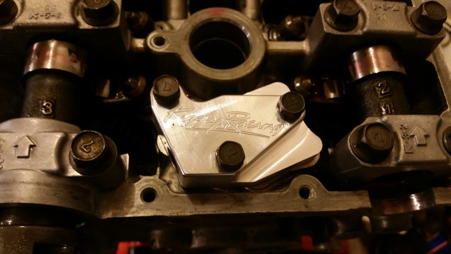

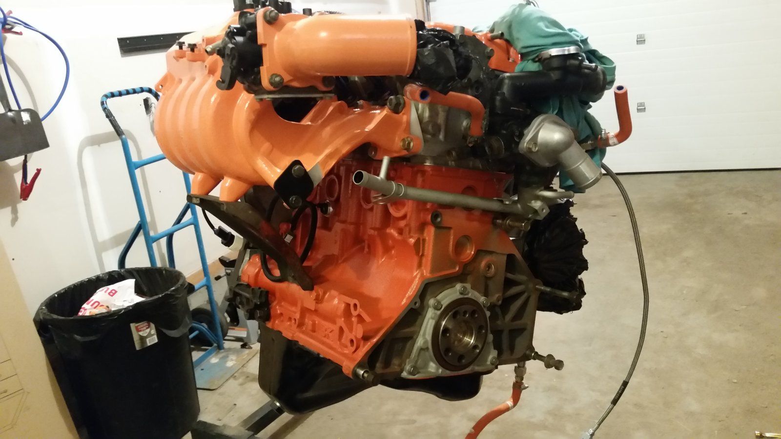

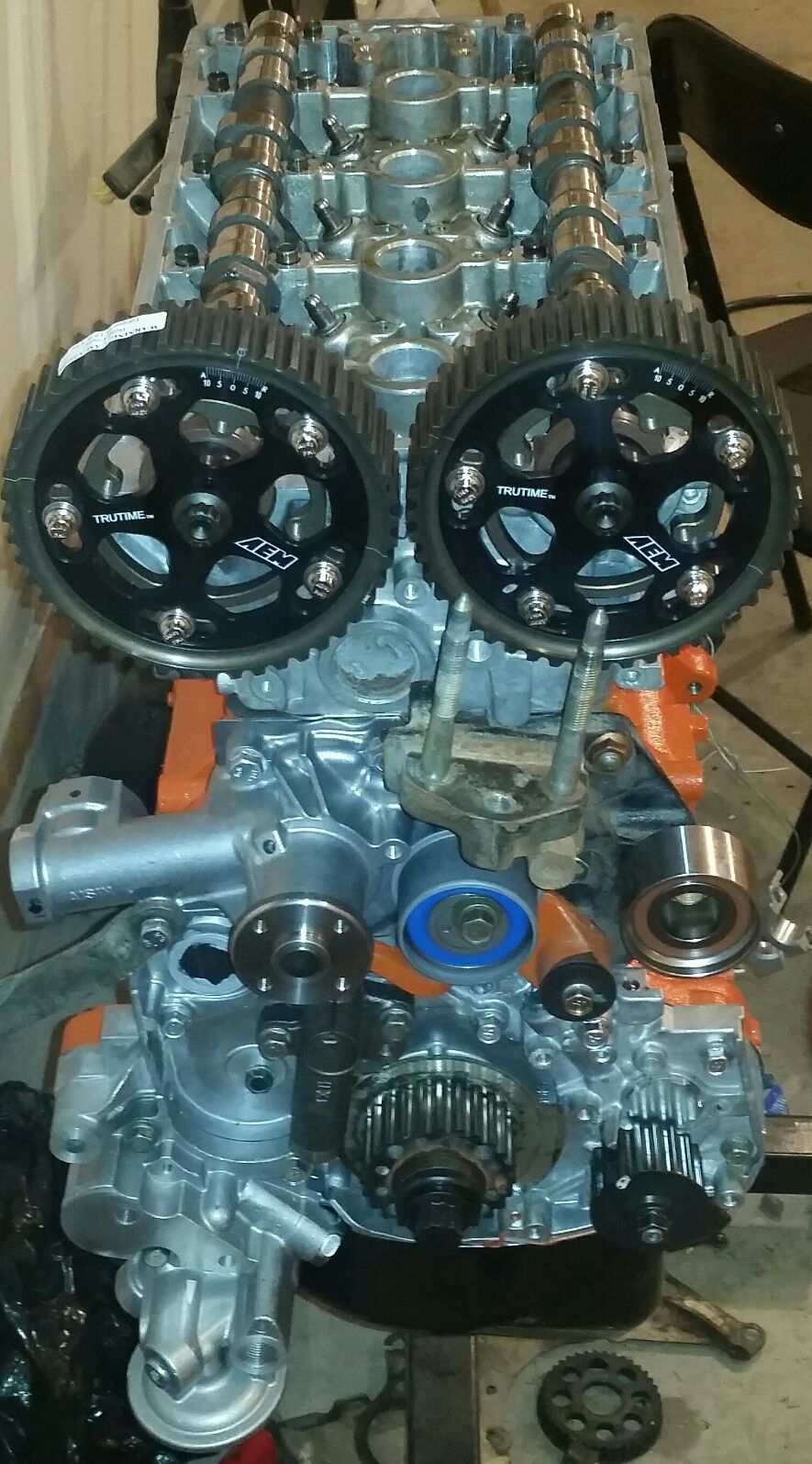

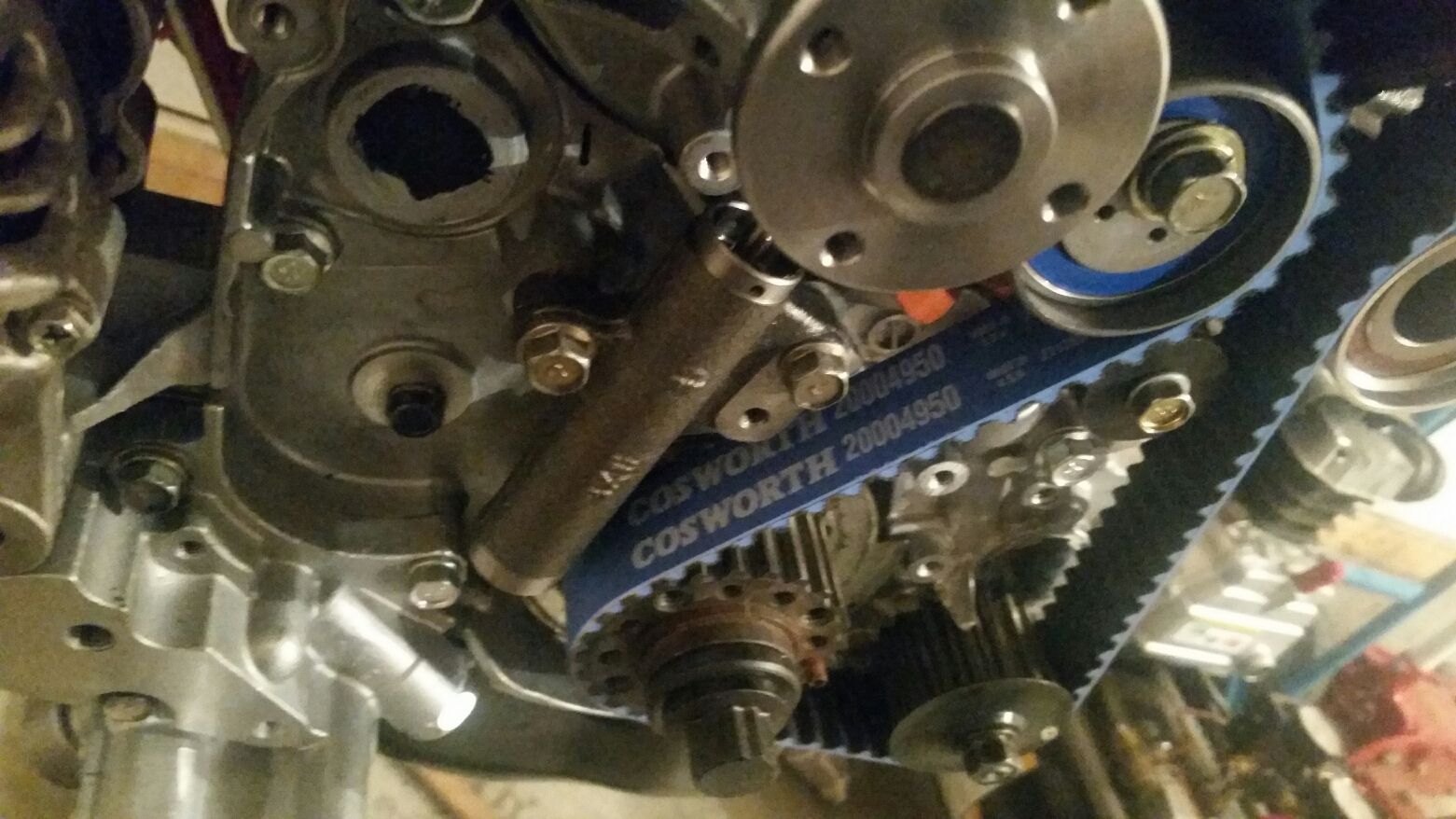

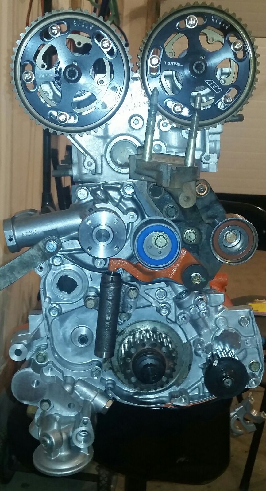

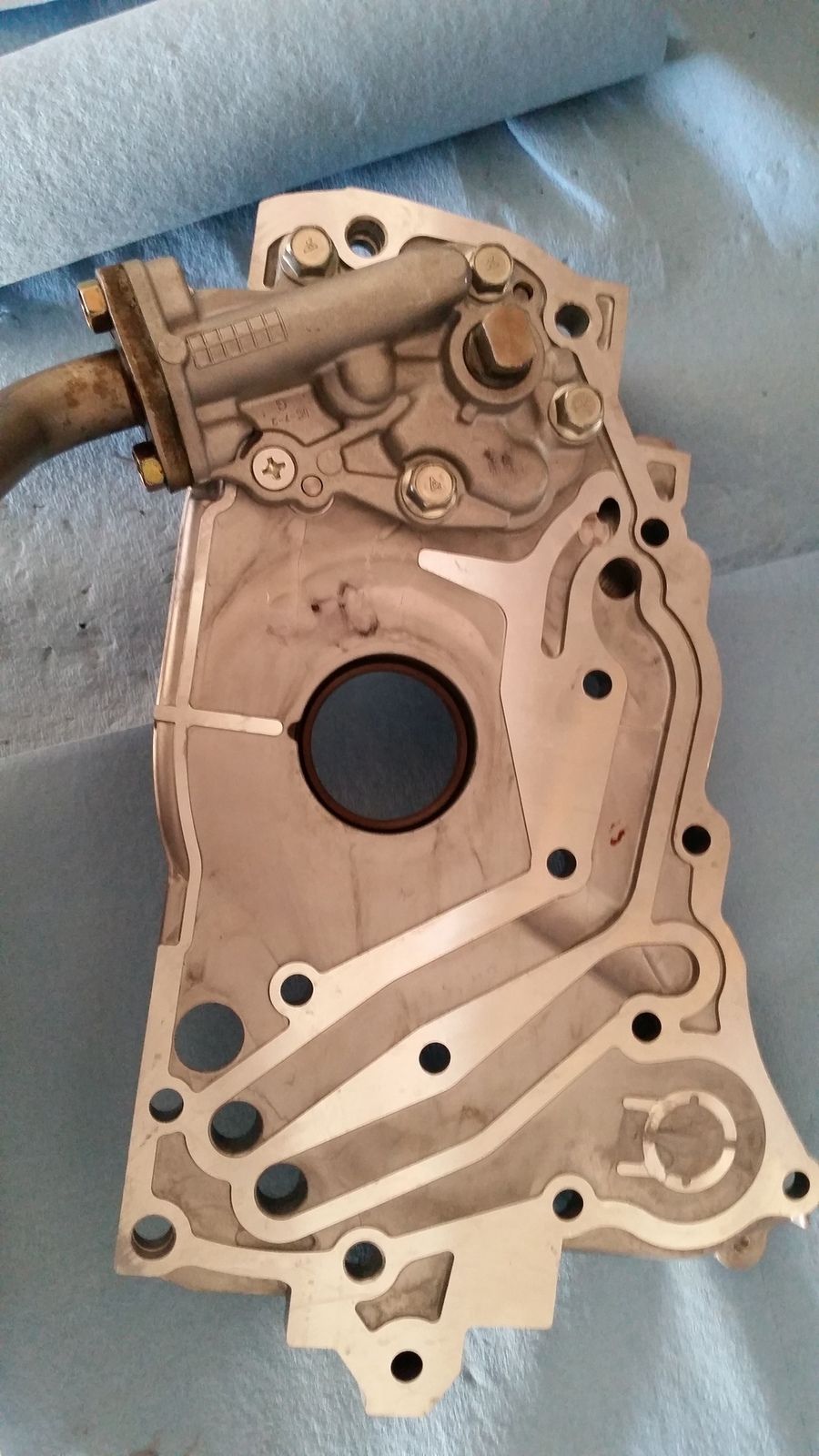

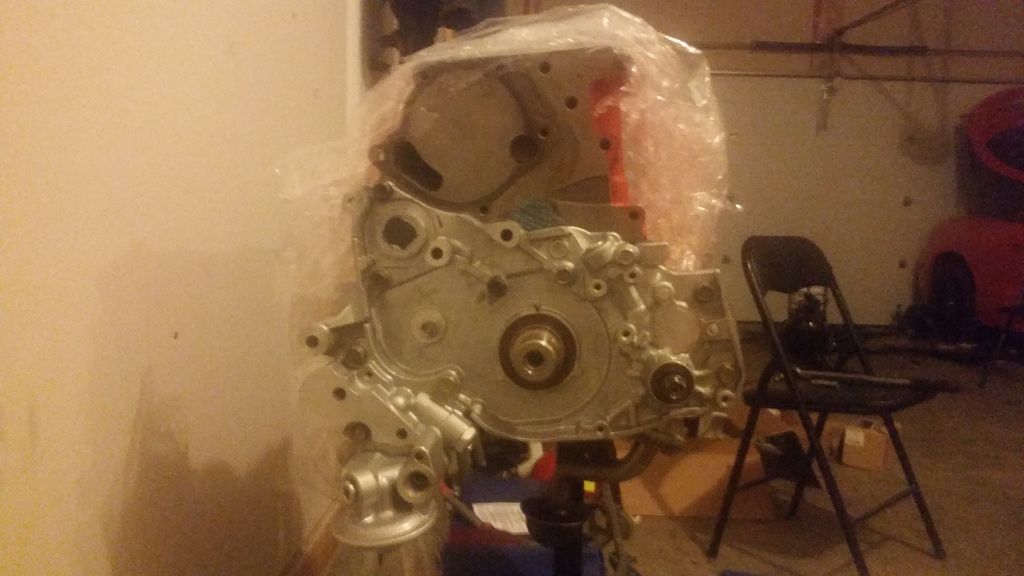

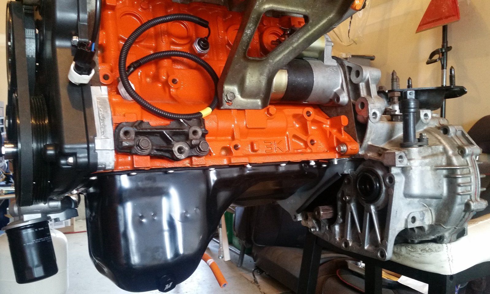

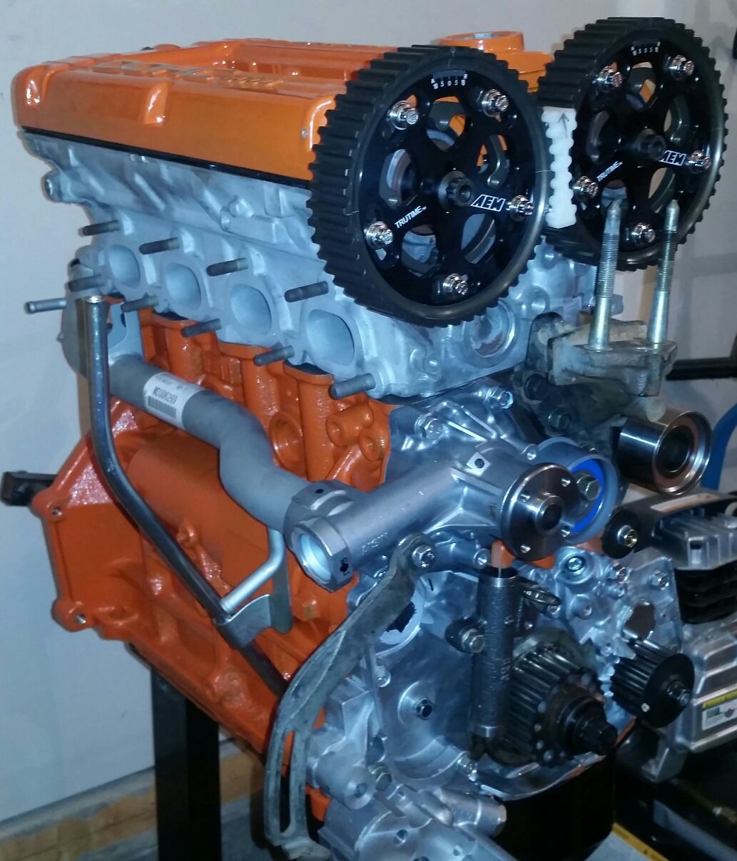

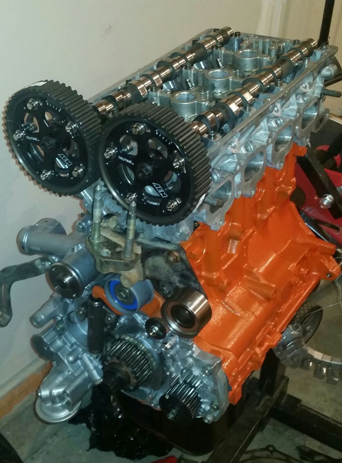

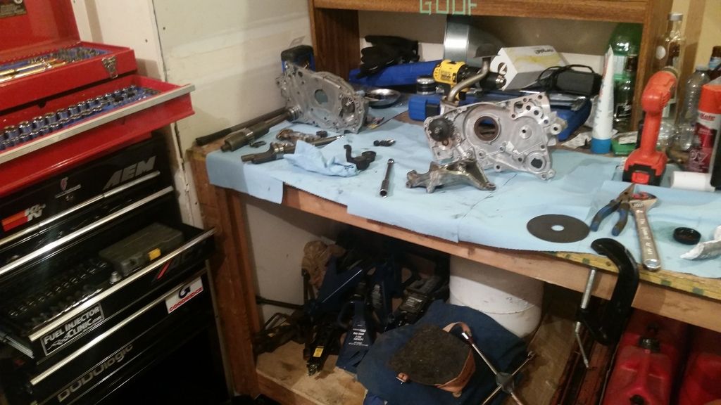

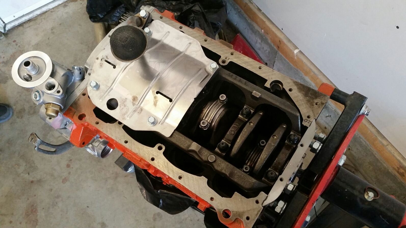

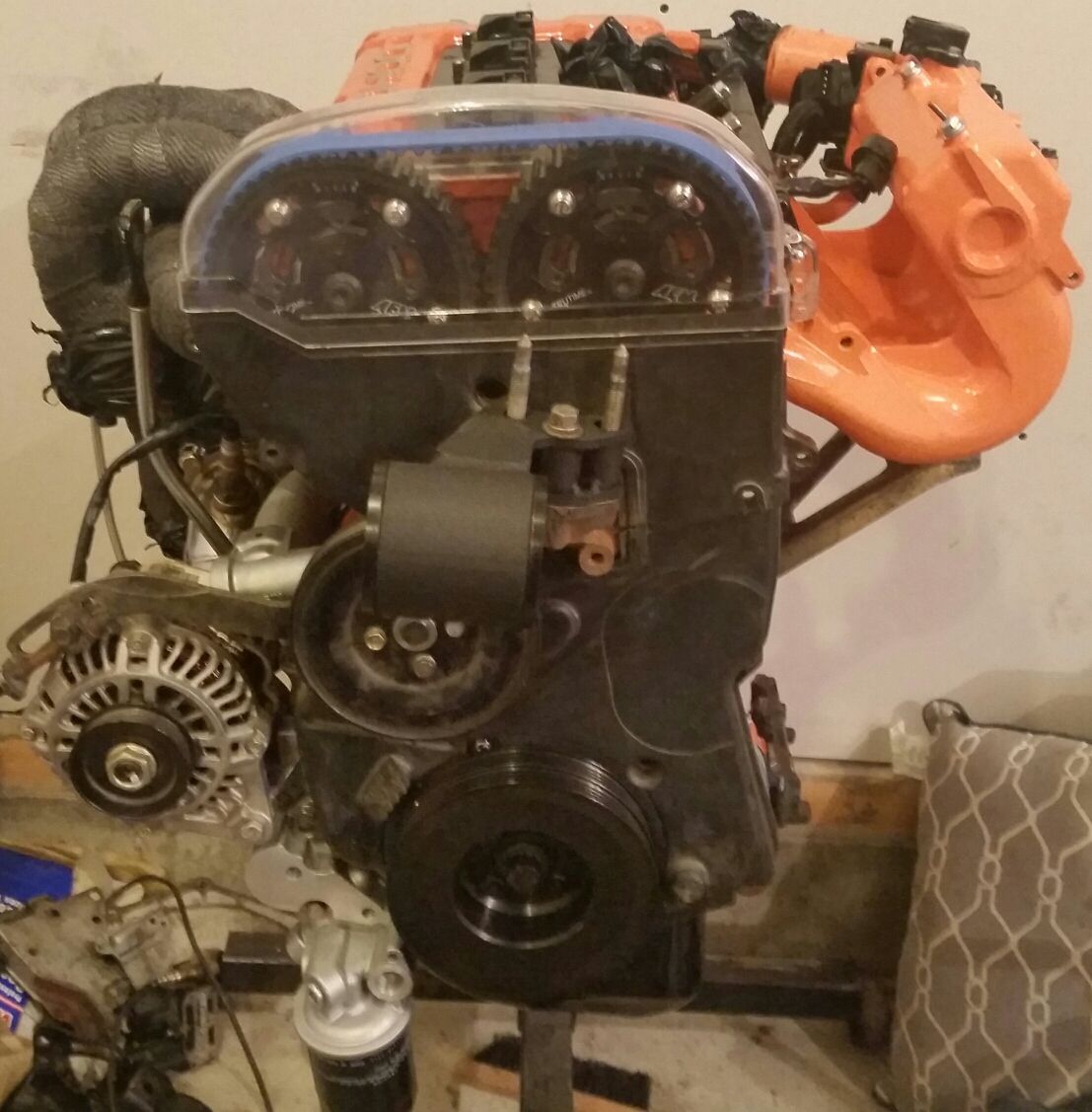

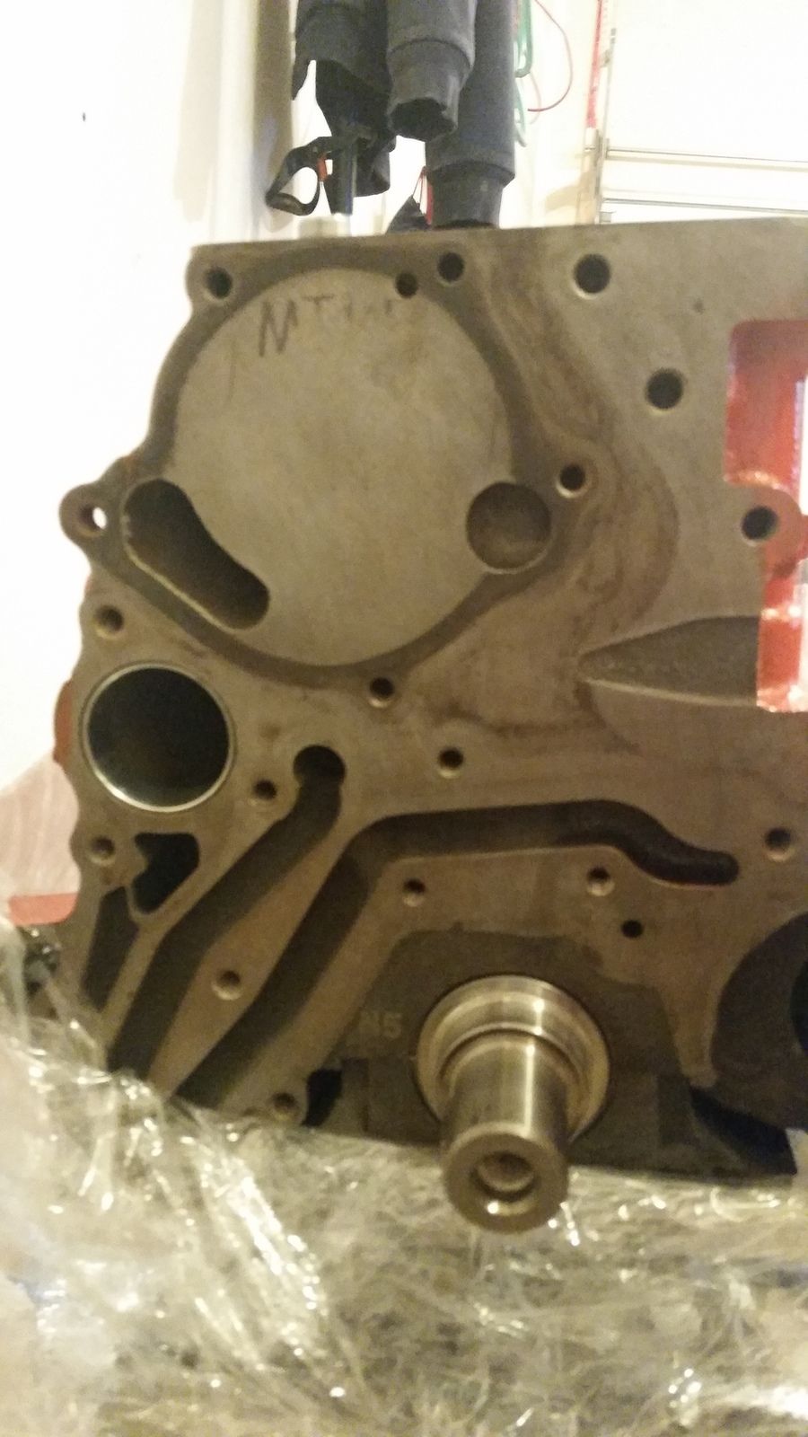

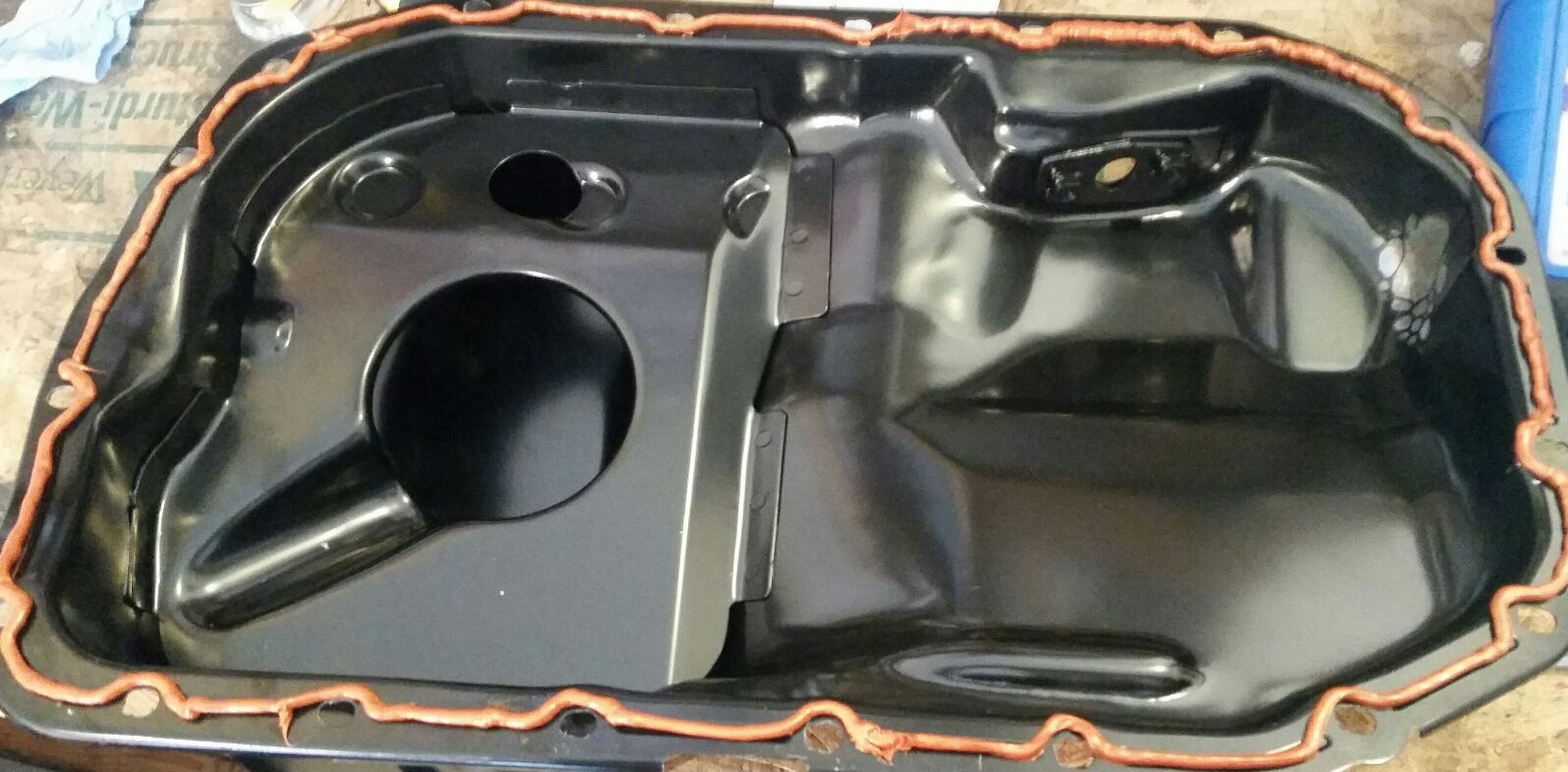

At the current moment I'm just finishing up a balance shaft elimination using a new front case with OEM Mitsu parts. I'm waiting on the crown nut/plug and o-ring.
Small bit of progress, still missing some bolts for other things. Gotta get a list together and source new ones for the tensioner, water pump etc.

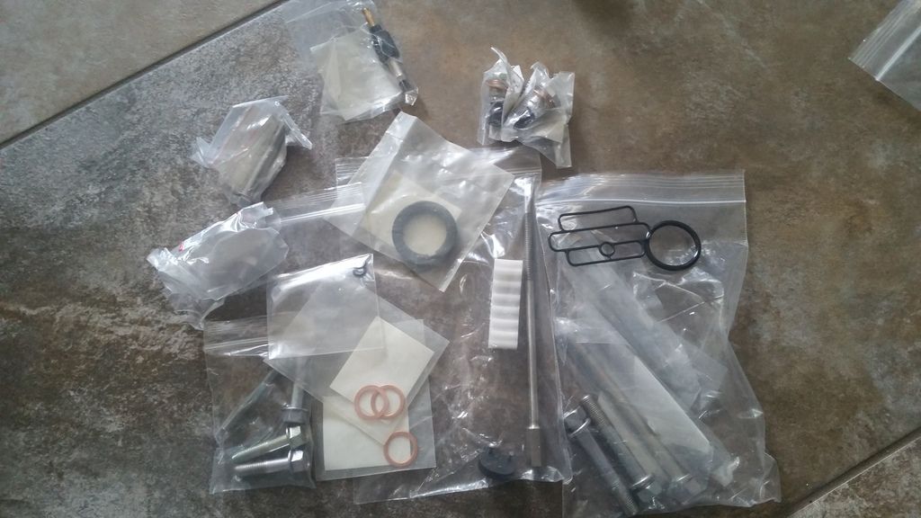

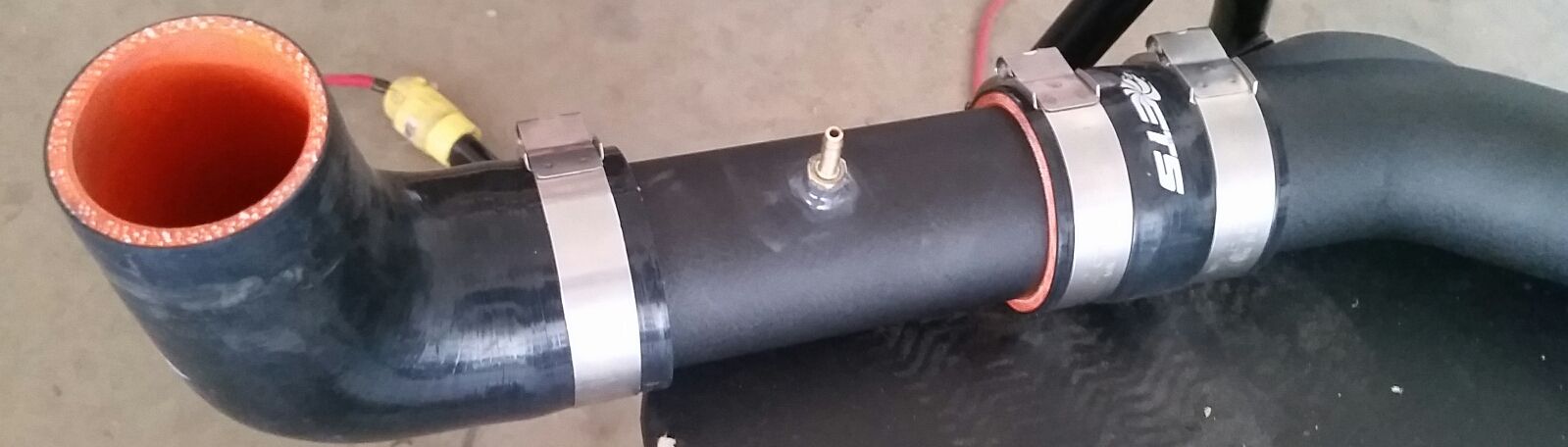

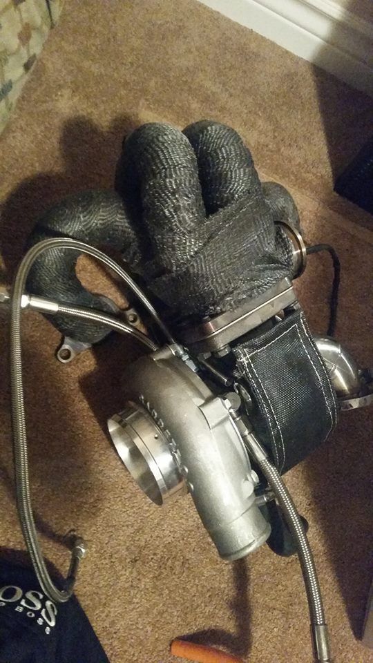

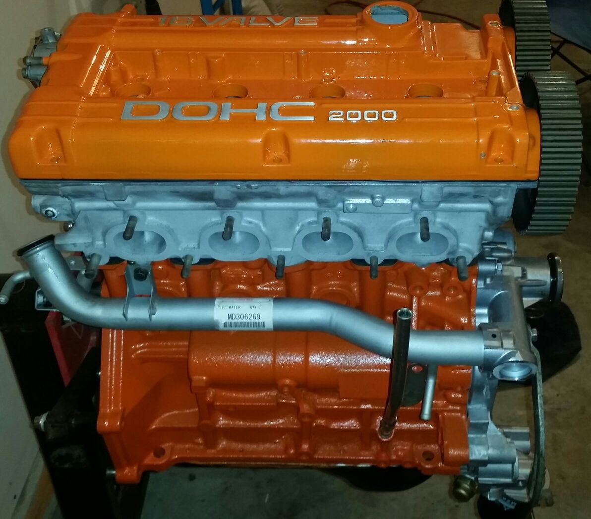

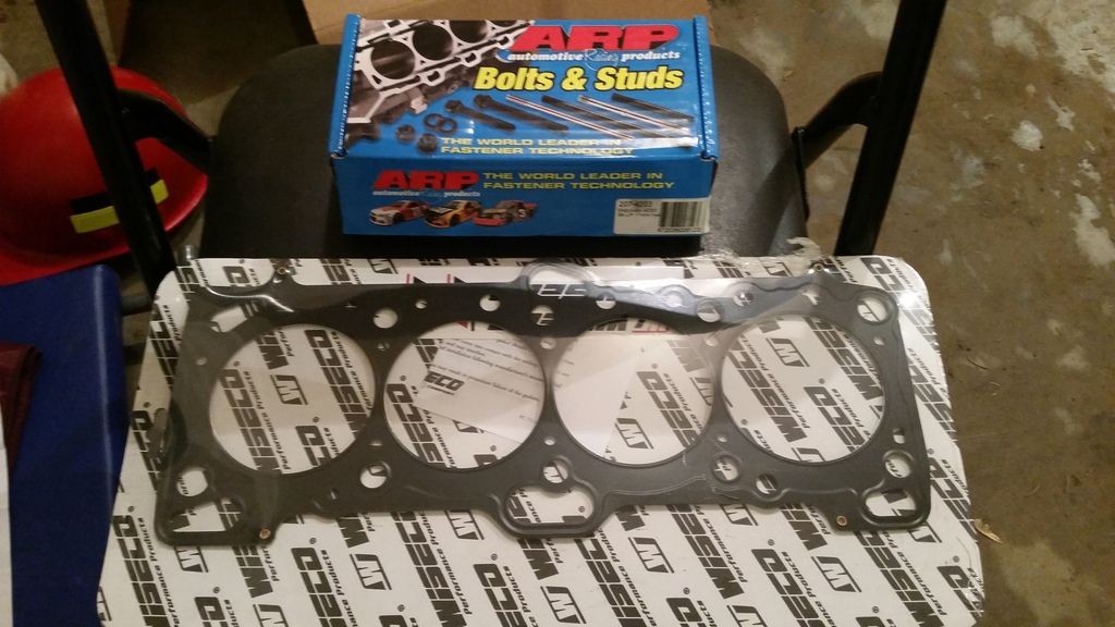

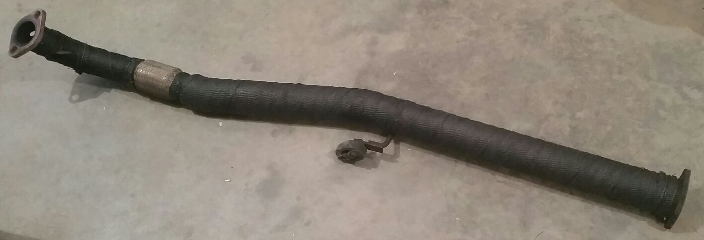

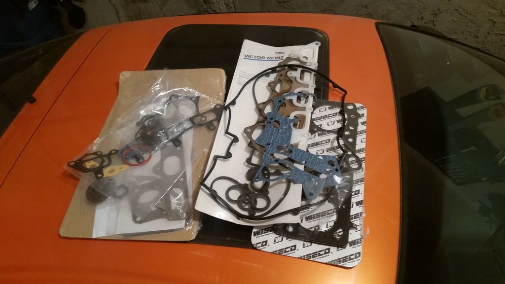

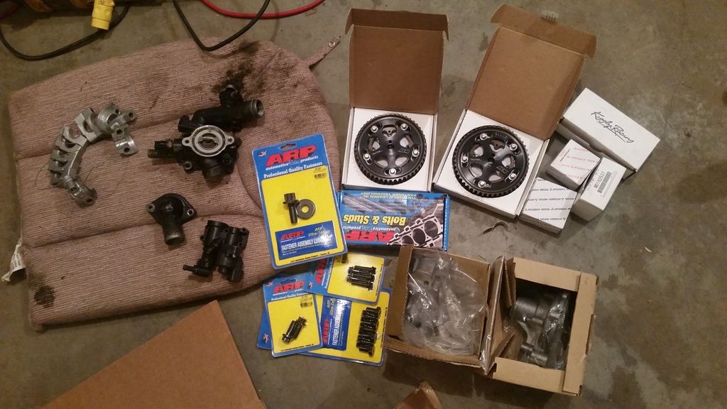

Got some stuff from ExtremePSI today:

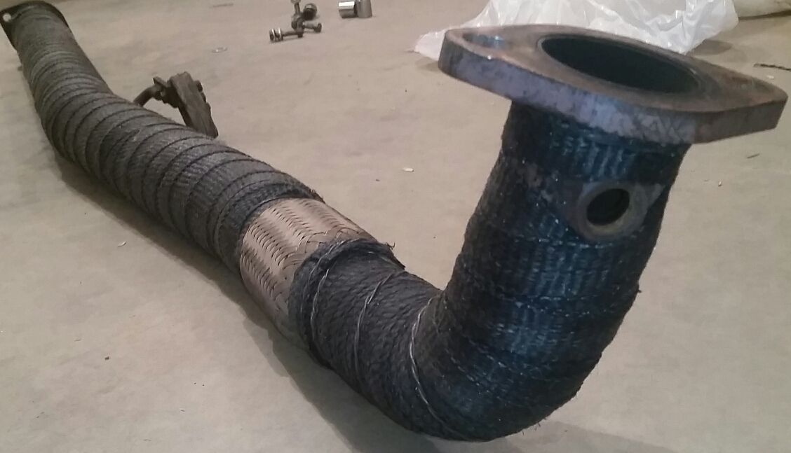

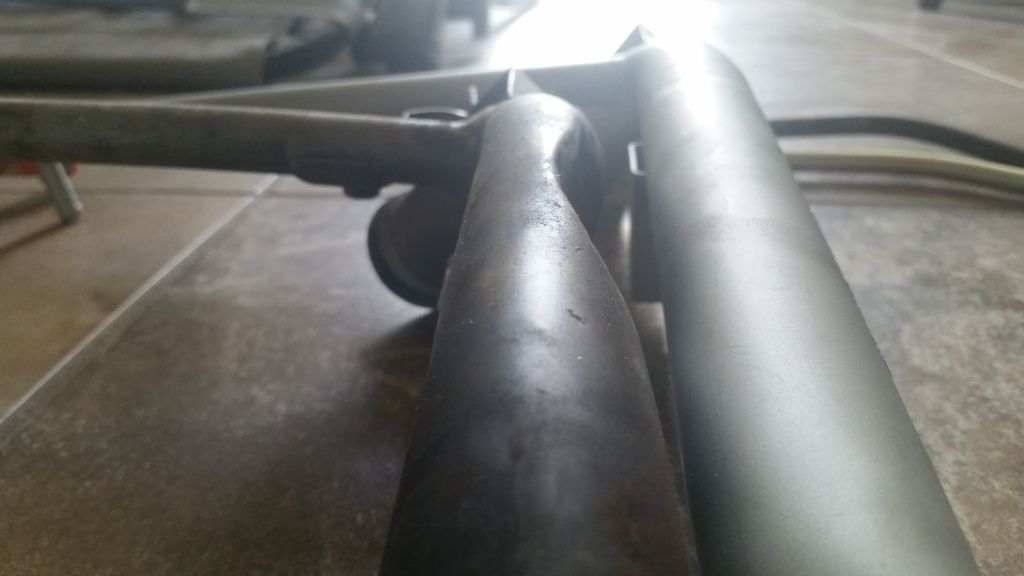

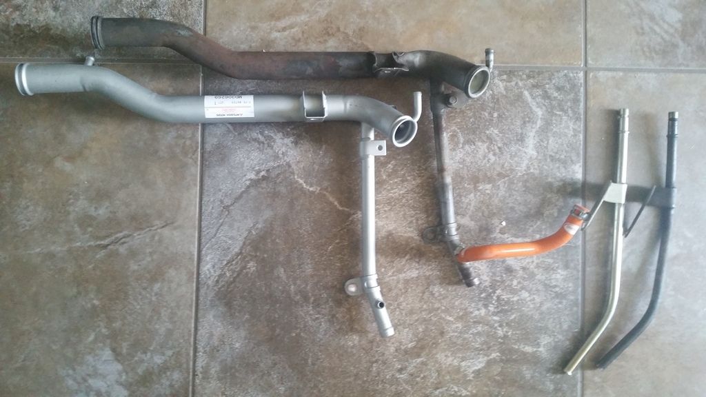

Out with the old, in with the new! Check out how much the previous owner crushed my old water pipe:

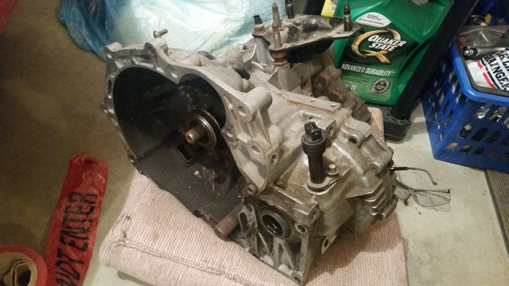

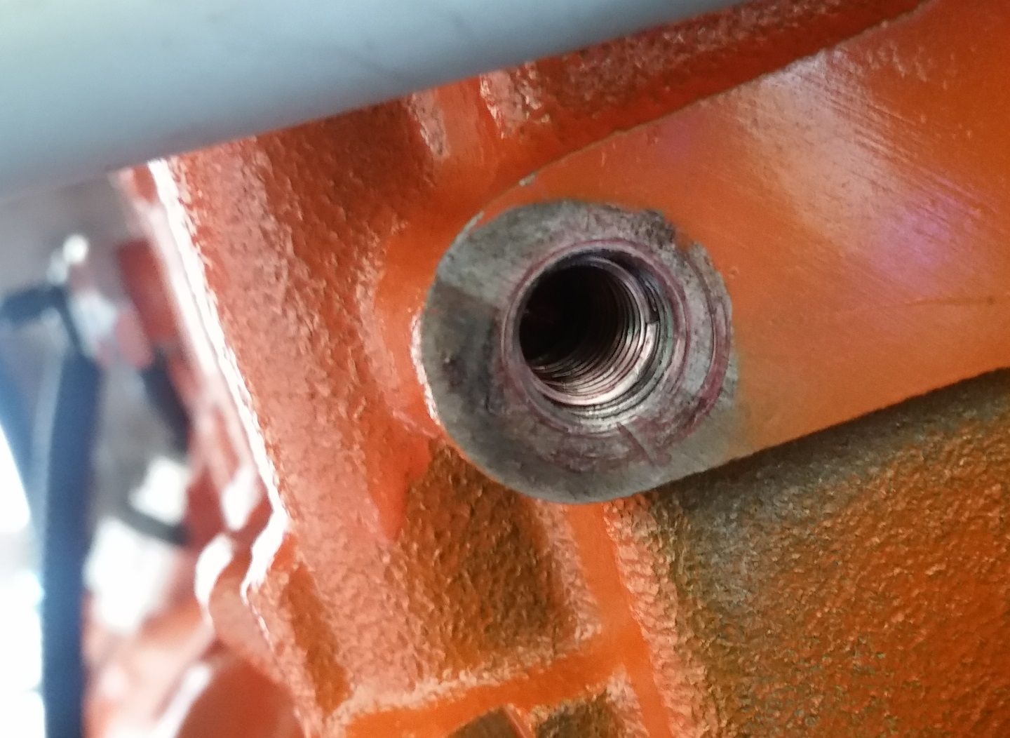

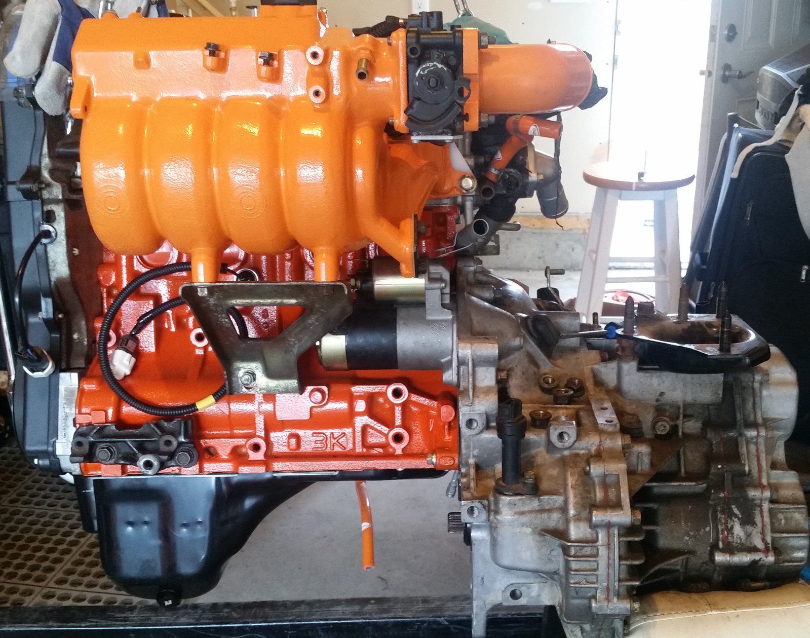

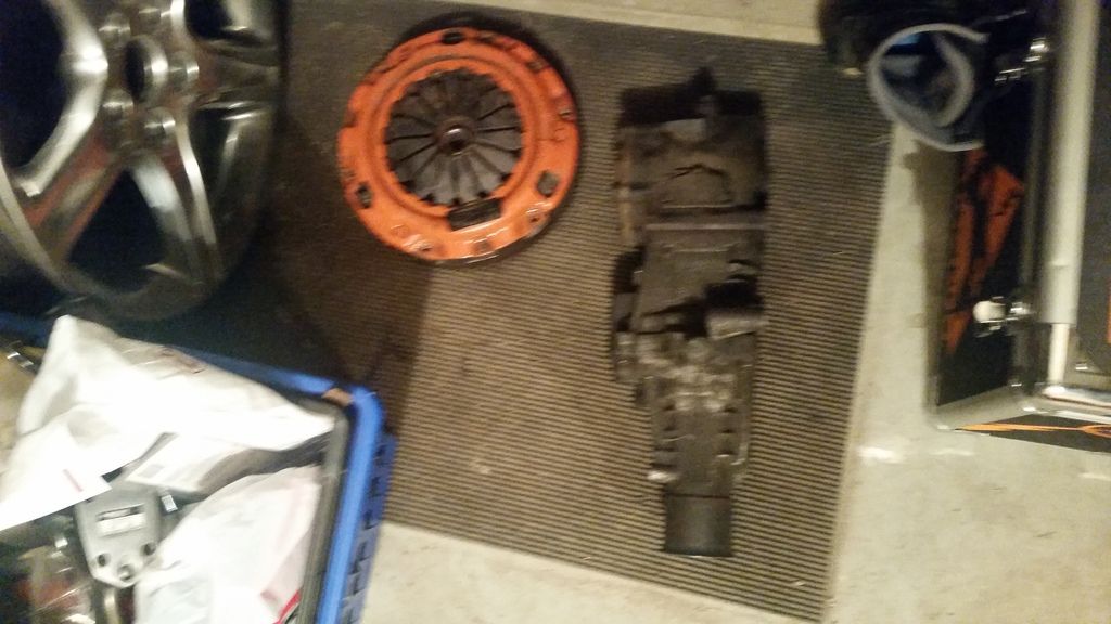

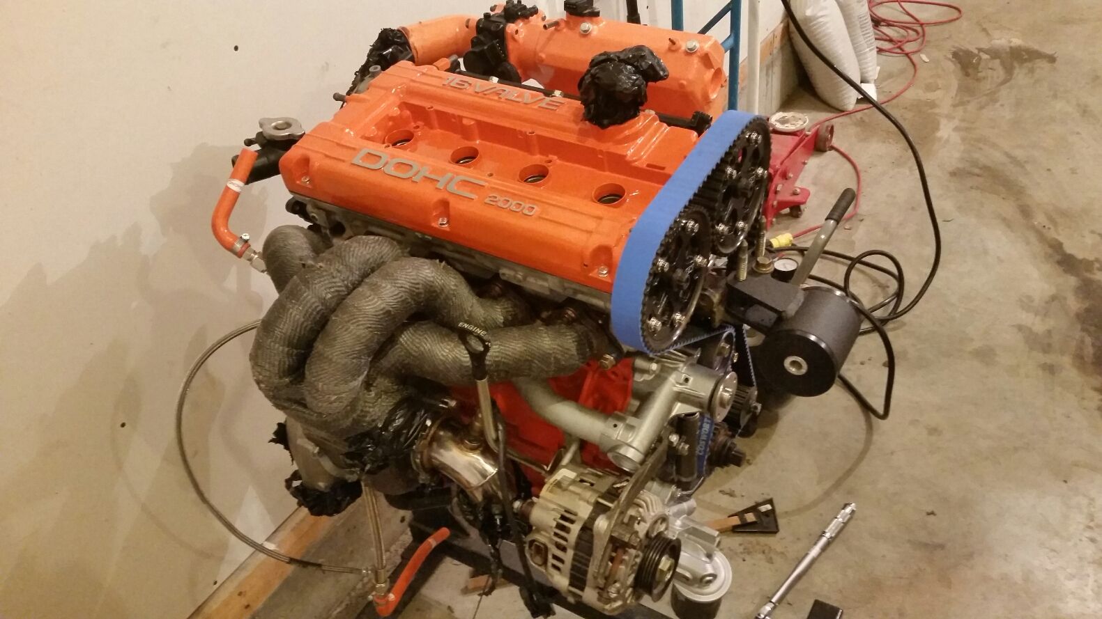

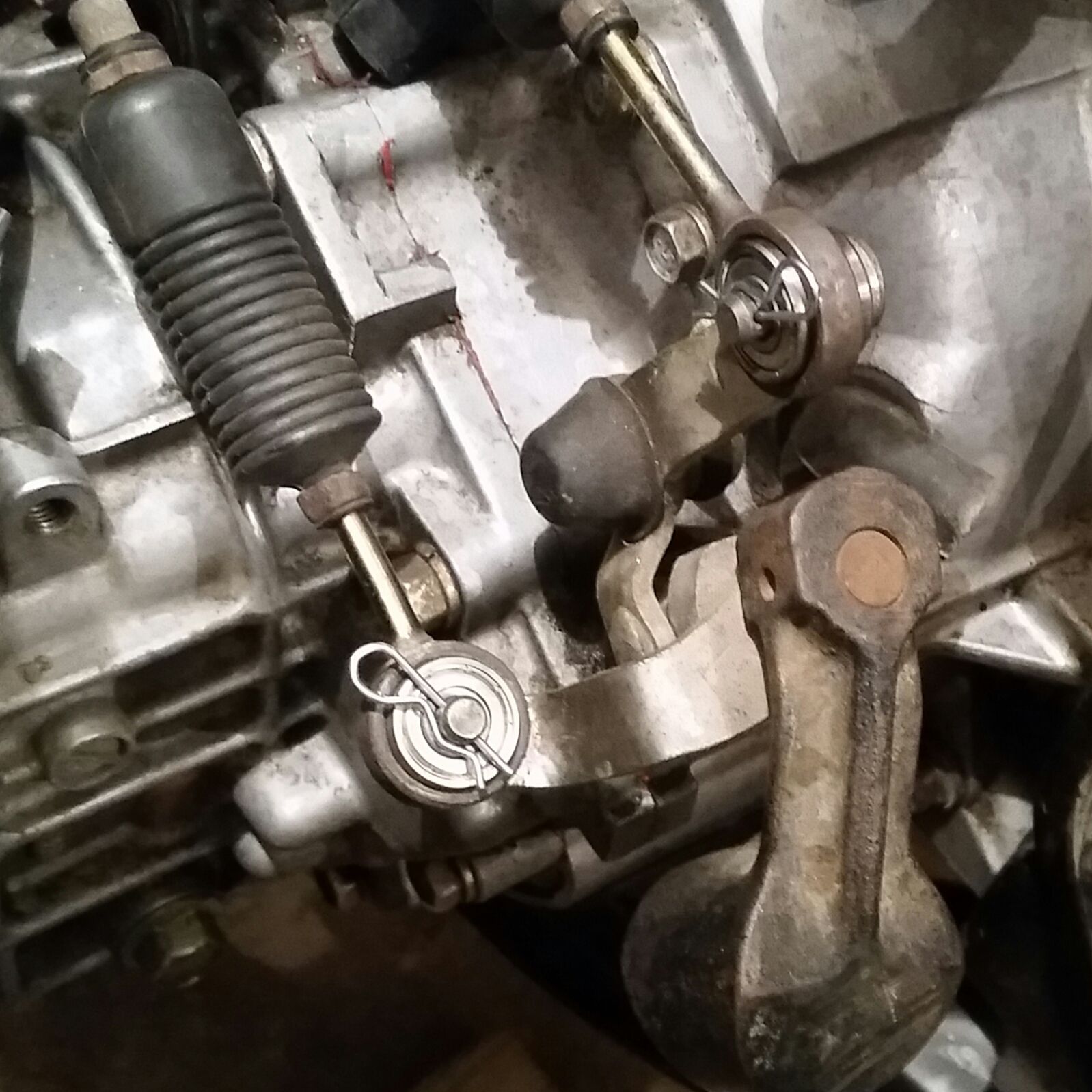

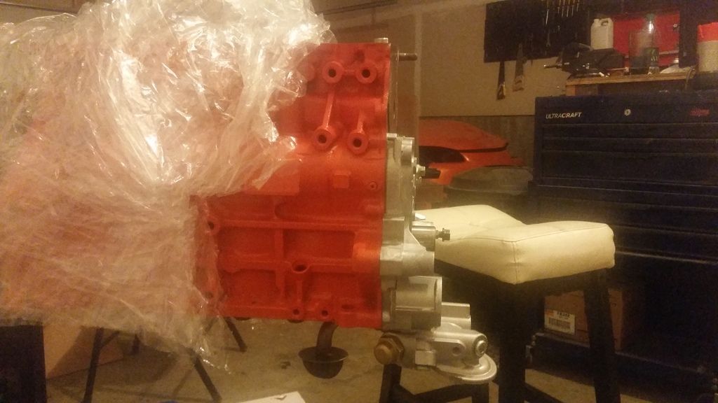

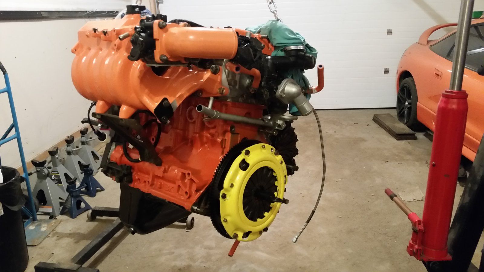

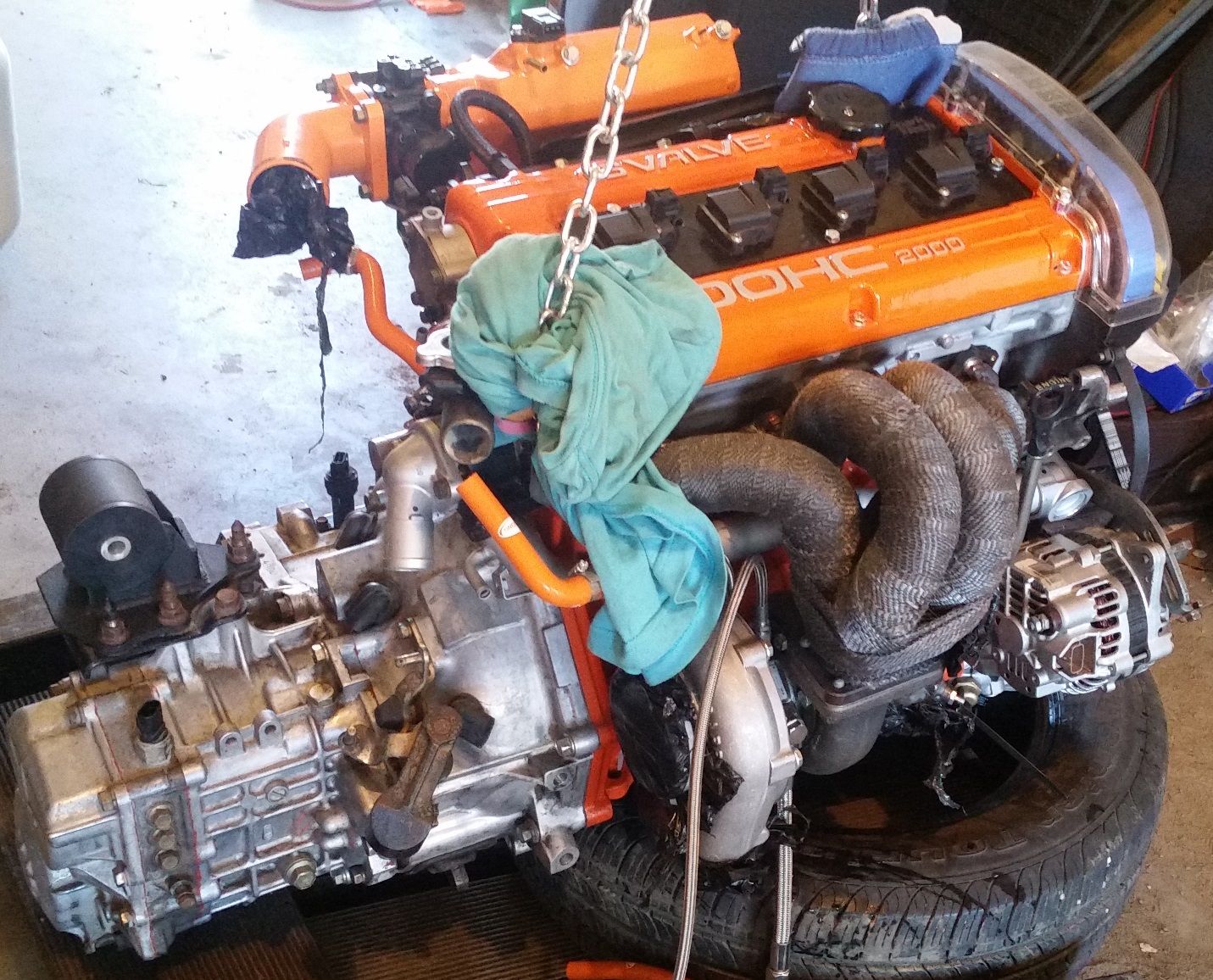

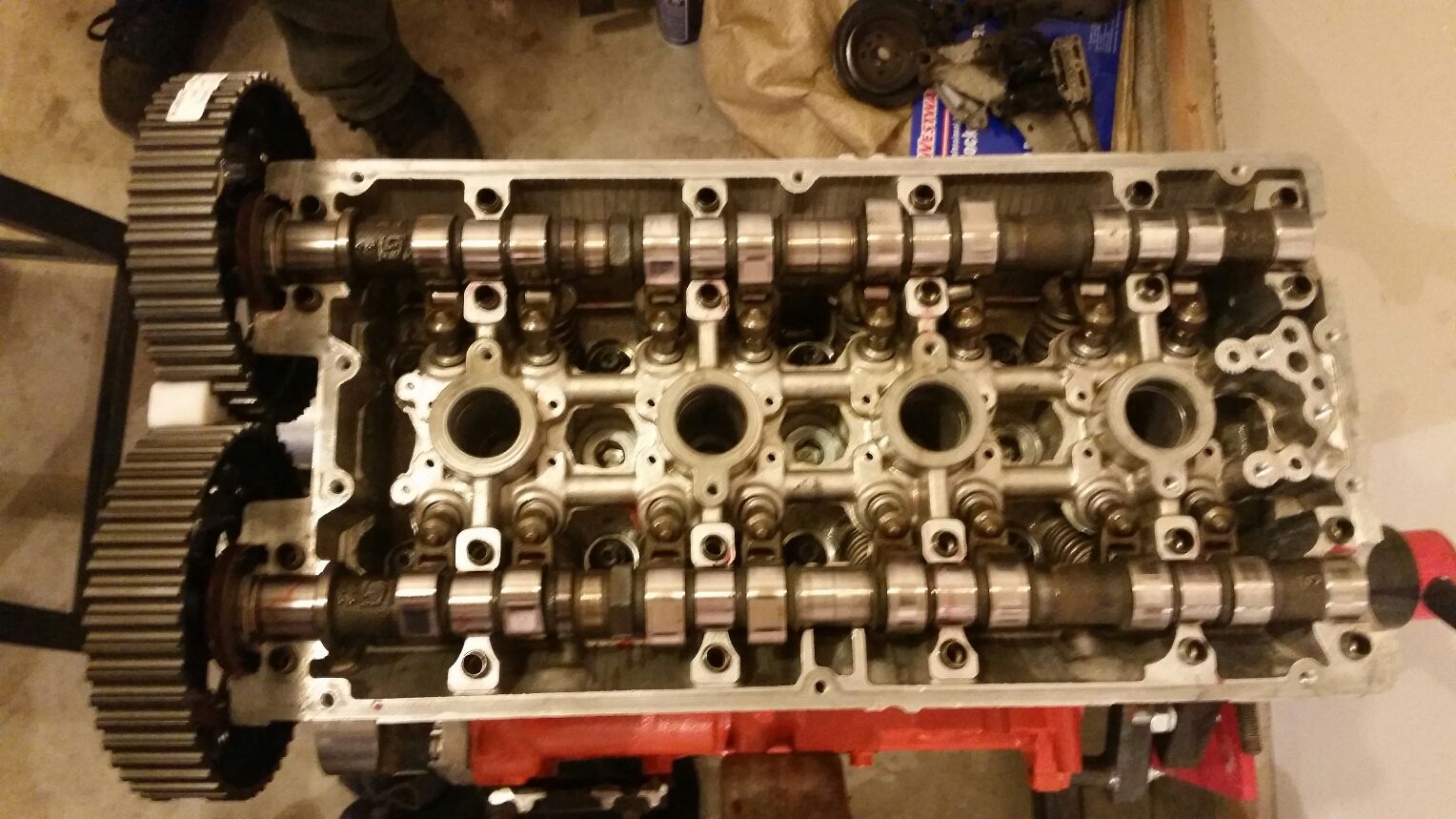

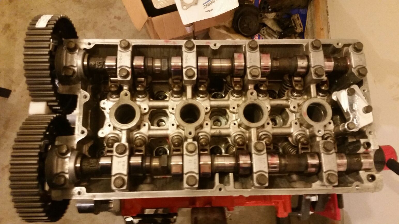

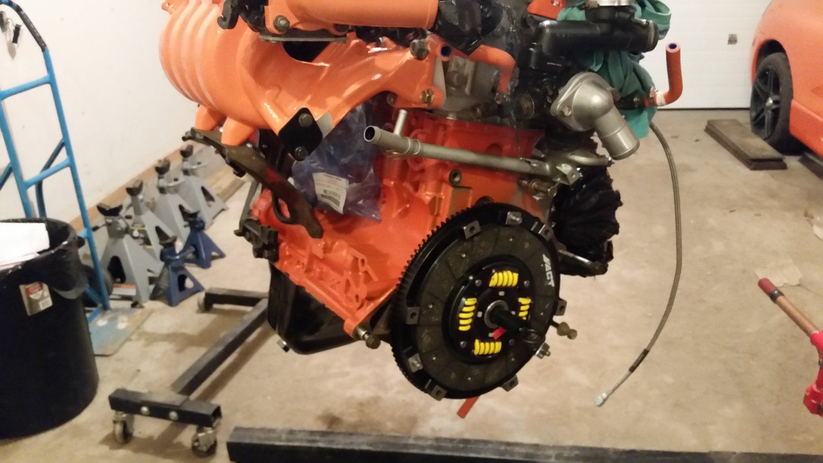

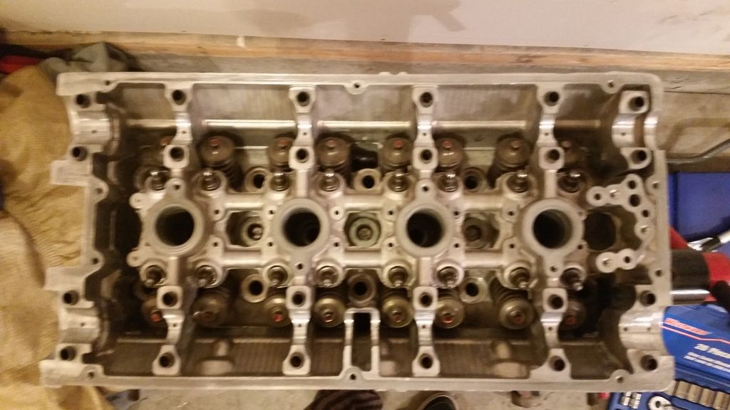

So it's been a while, I'm finally not too busy working to get some progress done. In the last week I've rechecked my timing/tension 3 or more times, hunted down any missing bolts, got all covers/brackets/pulleys/belts in place and put on the clutch assembly. I've got to repair one bolt hole (one of the transmission mounting ones on the intake side) with a helicoil but after that it's transmission time! Which of course has a new fork, pivot ball, throw out bearing and clip to go in as well.
20160409_182147[1].jpg 20160414_150509[1].jpg 20160414_150525[1].jpg 20160414_160254[1].jpg 20160414_162358[1].jpg
Got the thread fixed and tranny on today :D. Next up so to prep the engine bay, gotta finish deleting the cruise control box then clean/repaint. Really glad I was able to get an M10 x 1.25 Helicoil from the machine shop that did my engine, I couldn't find one that size and thread pitch anywhere. (I gave the tranny a good clean after taking these photos before anyone says anything LOL)

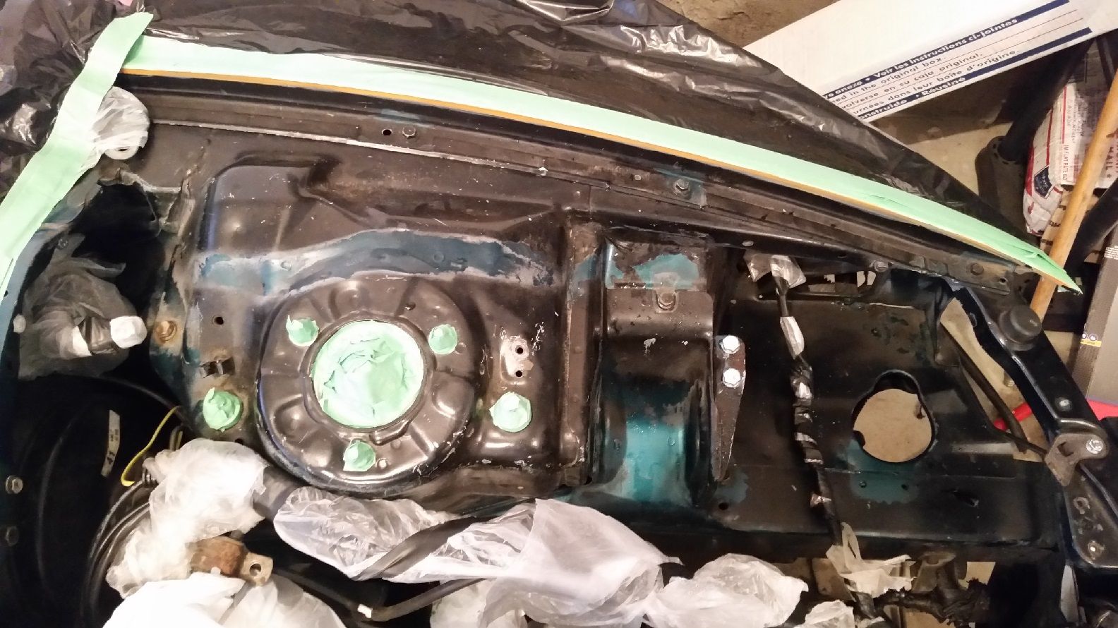

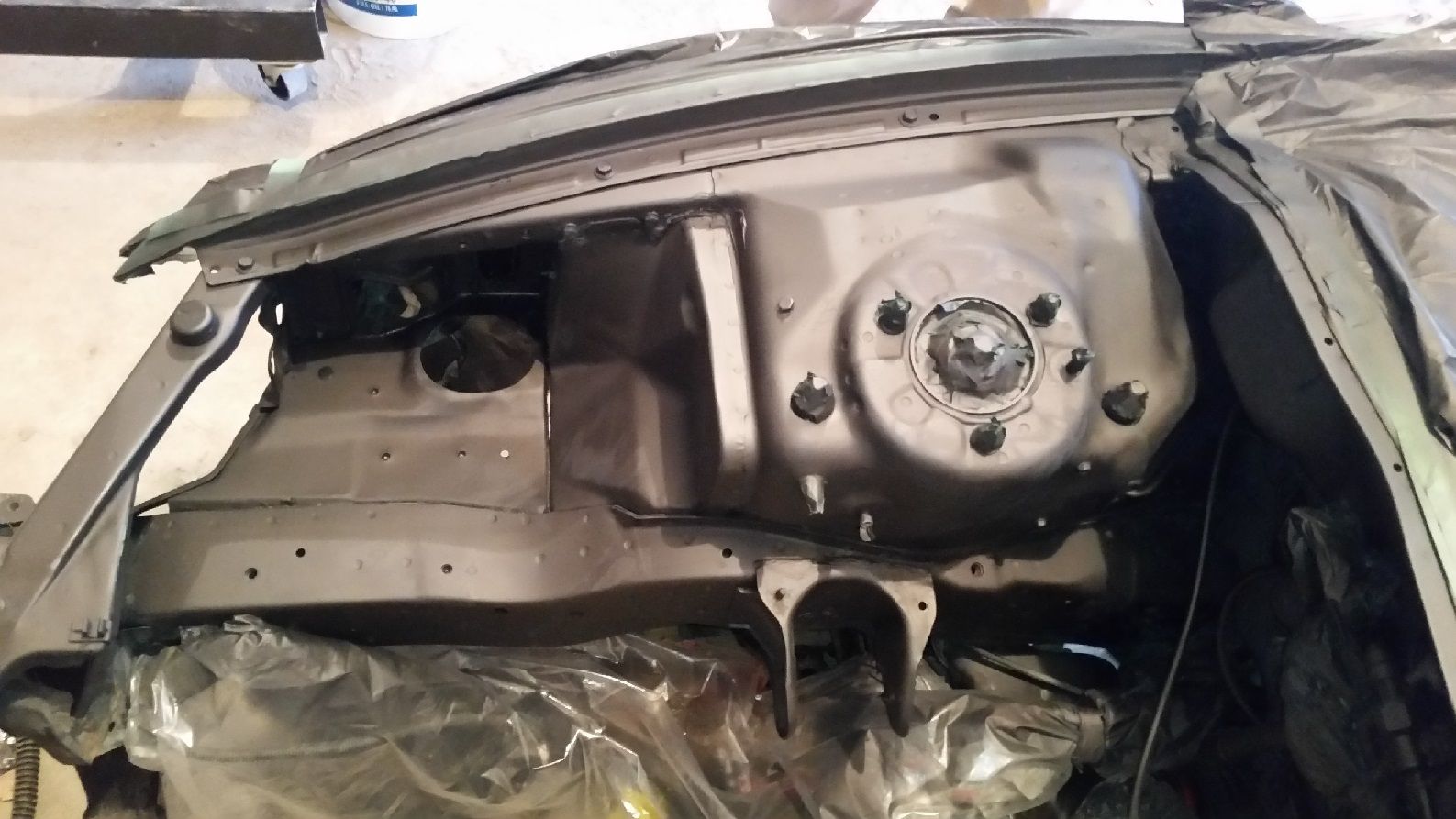

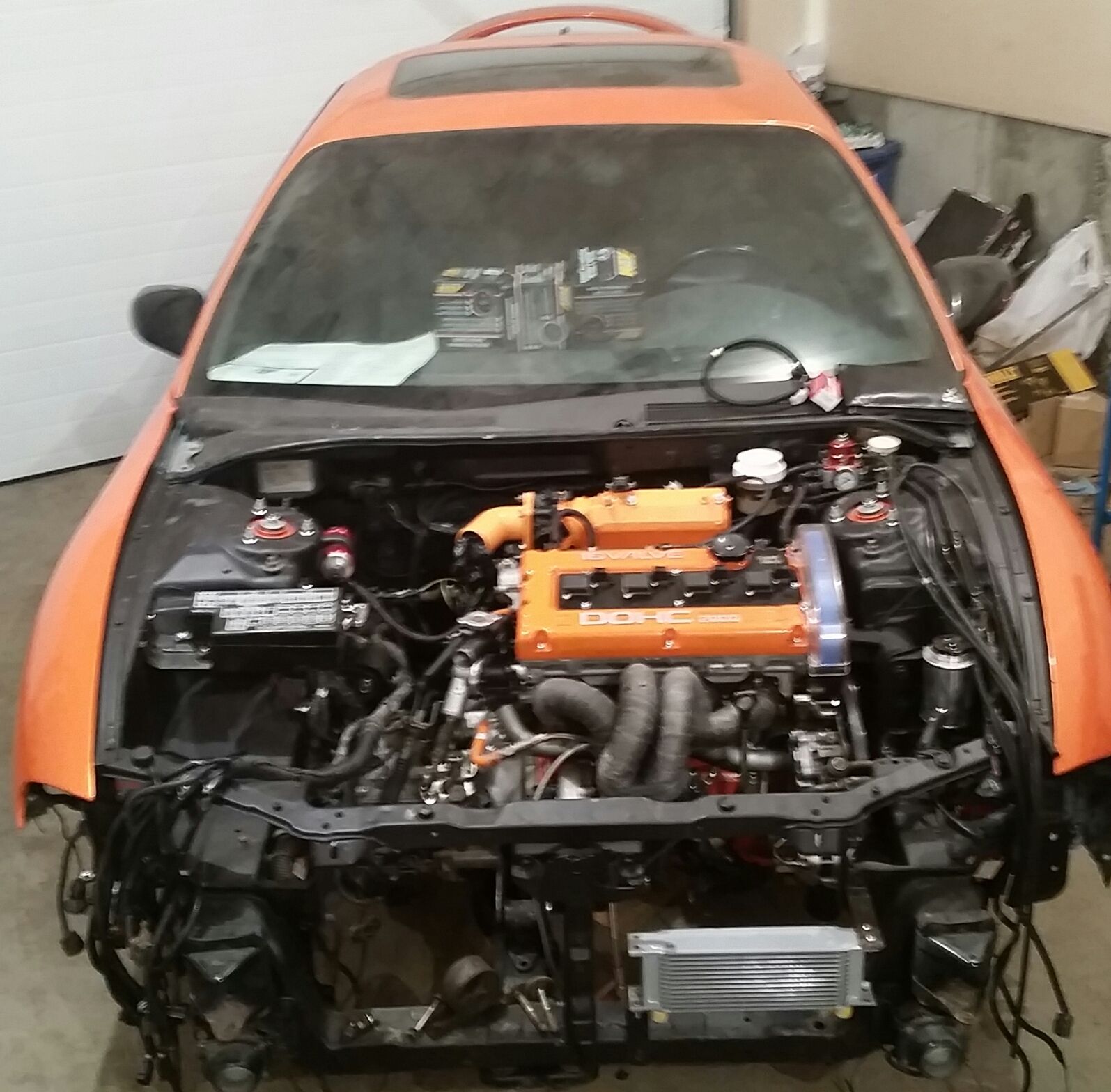

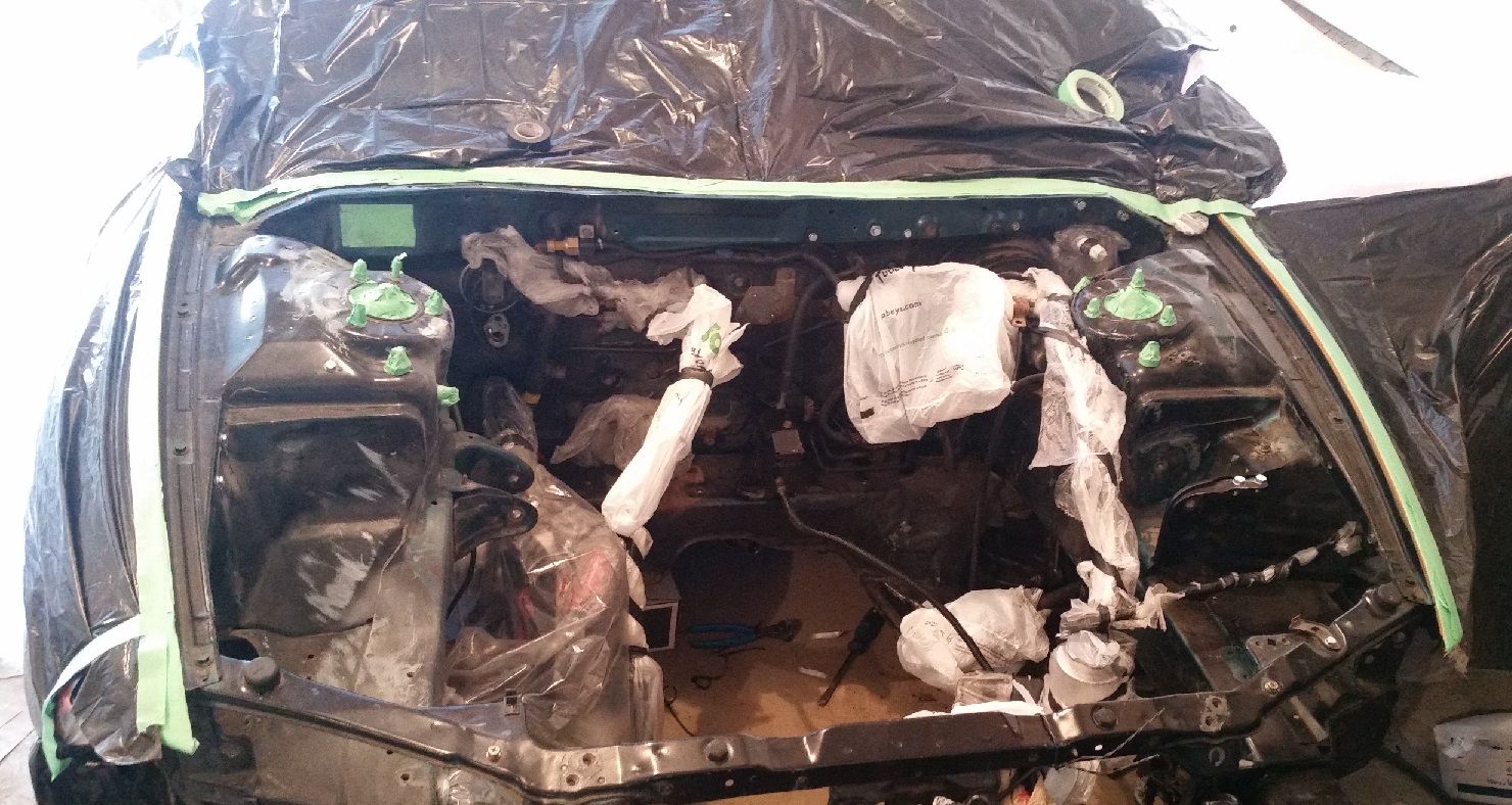

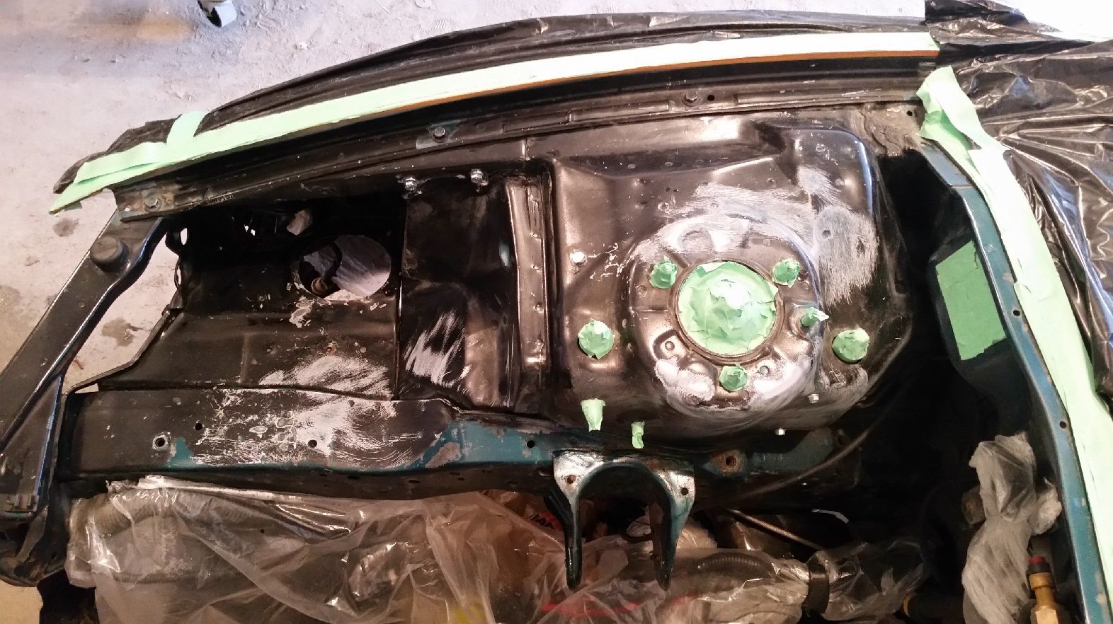

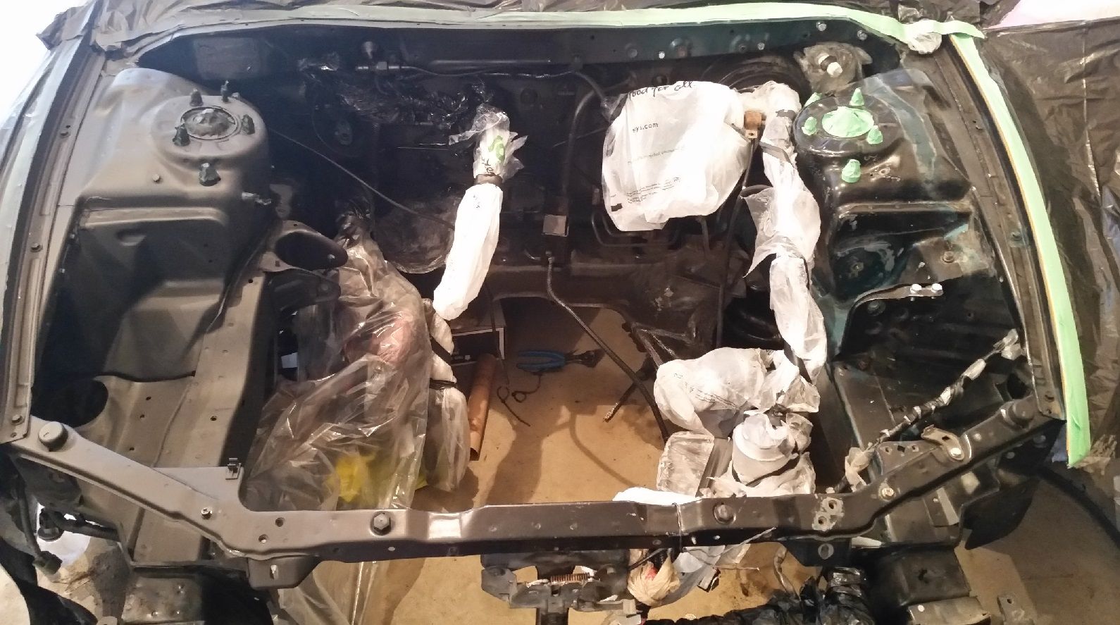

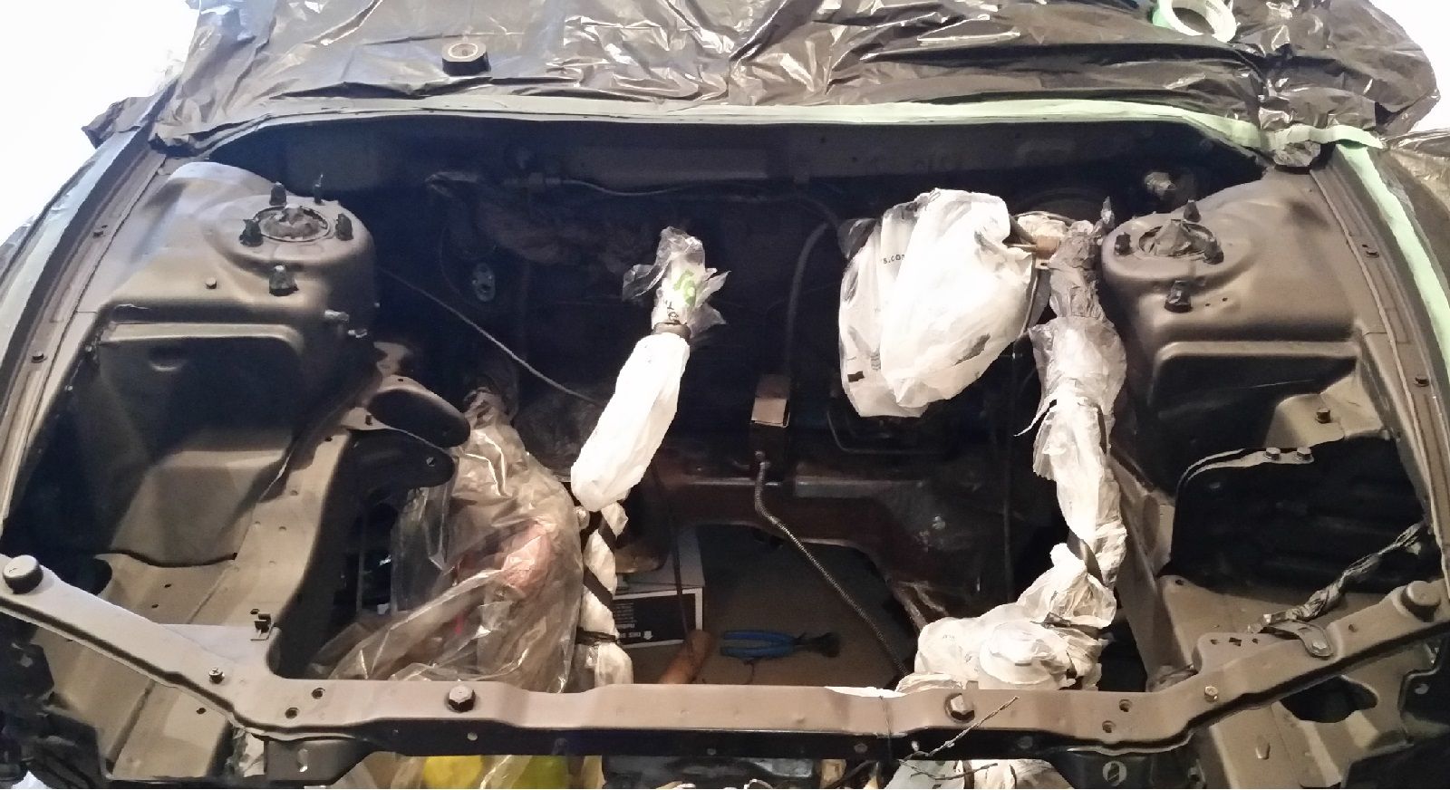

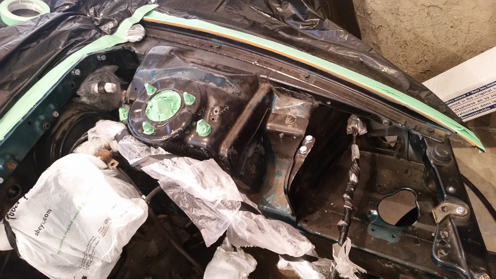

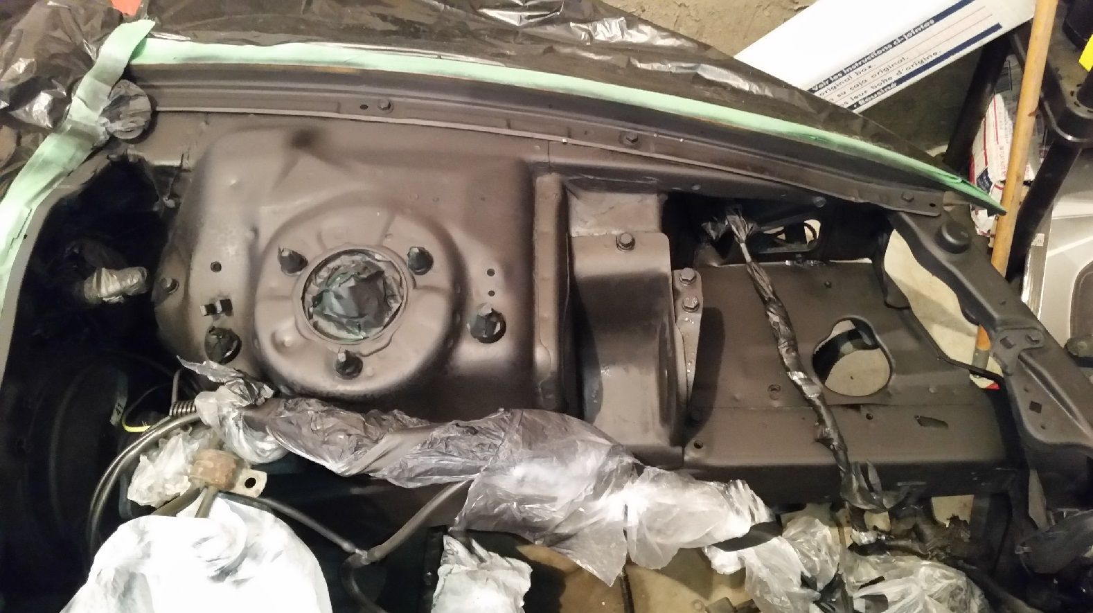

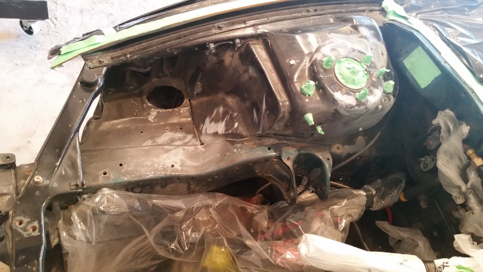

Engine bay "painted". Started with taping off/bagging stuff. Pretty banged up, half green half black mess.
After a good steaming/degreasing. Cleaned up nice and shiny but still scratched and patchy.
First coat of black primer vs. starting
I ended up liking the flat black so much I'm gonna stick with it. Originally I was going to go gloss black, but seeing how well it turned out (especially for a rattle can job) I'm gonna keep it this way. I think the engine will "pop" more in the engine bay in the final picture. I'll be spraying the underside of the hood to match as well.

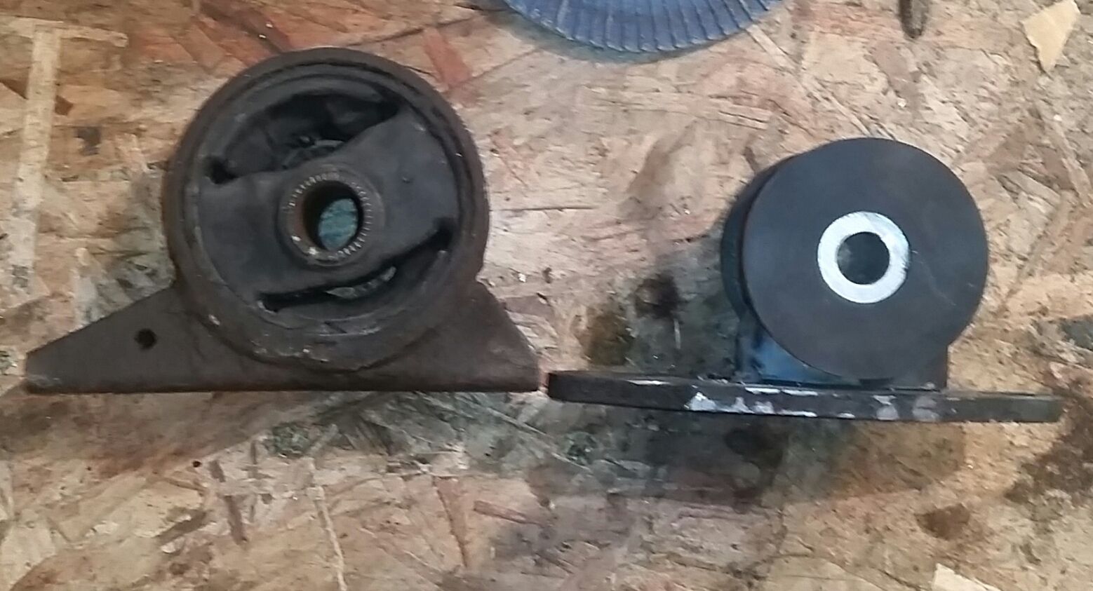

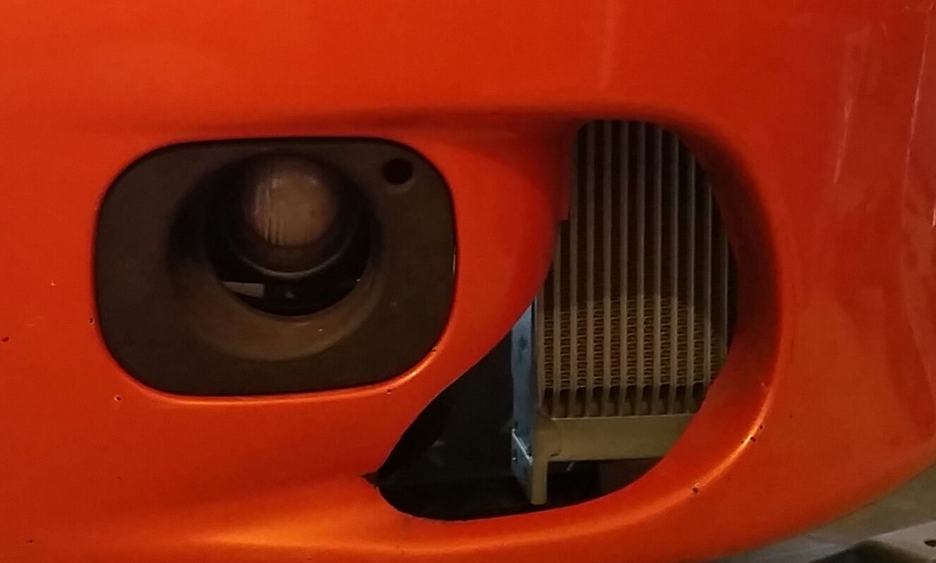

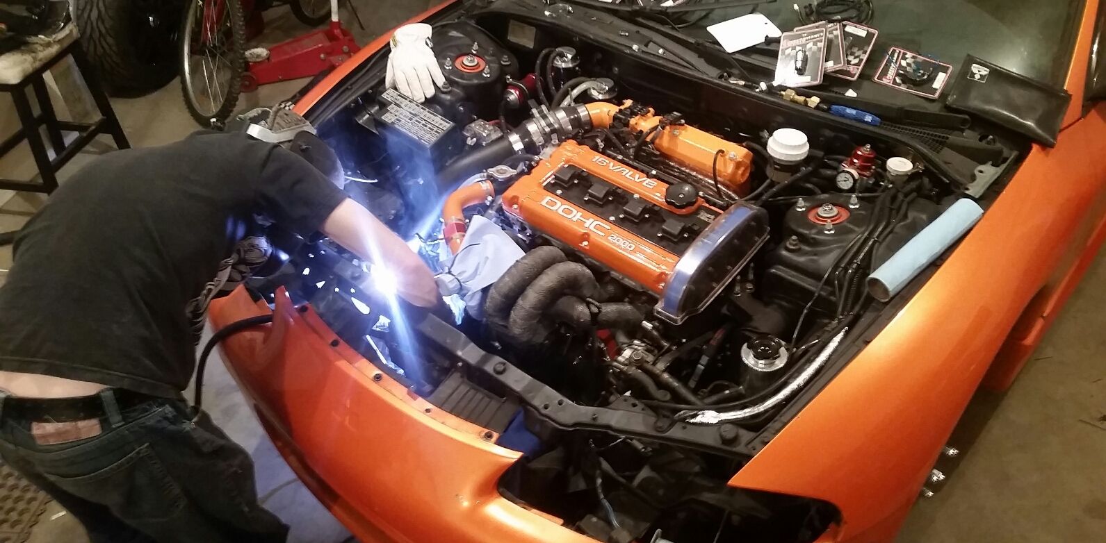

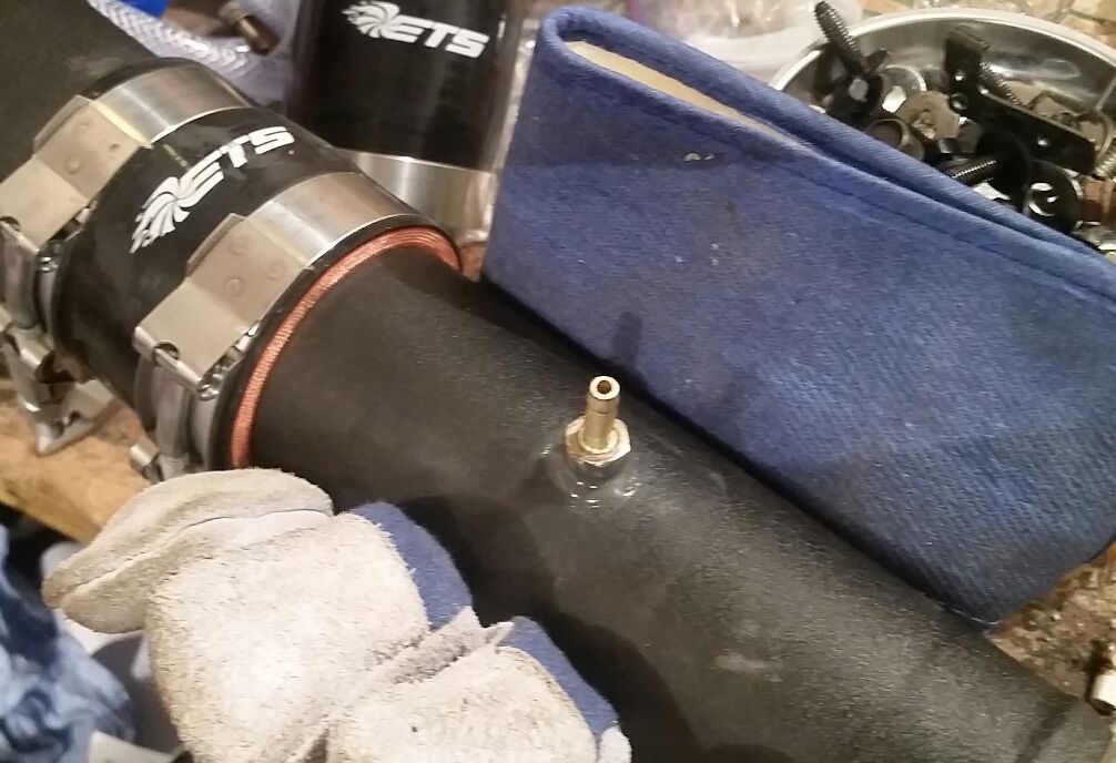

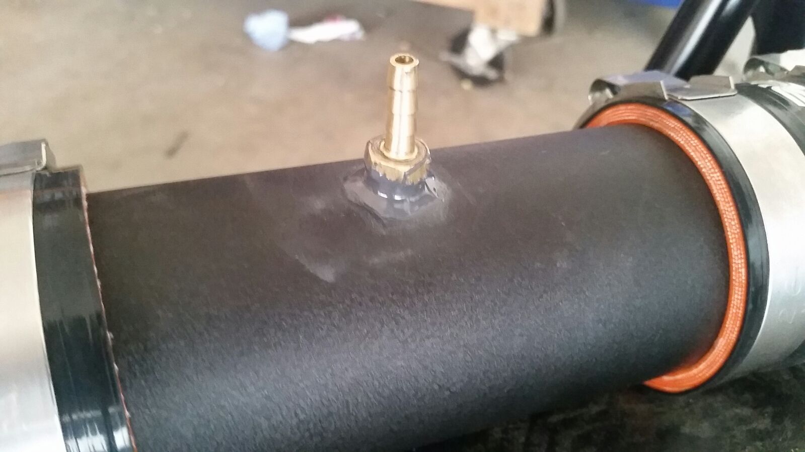

A little bit of grinding n welding and bam, front mount modified. Before and after pics:
Oil cooler mounted using brackets off of a parts car evo iv. I'm gonna get that oem plastic scoop deal and snug it up
